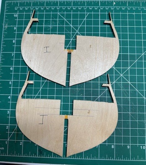

In addition to the cuts made to the center keel, cuts also need to be made to a couple of the bulkheads that will be in the way in order to accommodate the “ladders to the berth deck” illusion.  So, the gun deck beams from Bulkheads I & J were removed now (other gun deck beams will be removed similarly later) as well as some deep cuts.  According to the USN plans (and looking again at other builds), it appears all of the gun deck hatches going down to the berth deck are 5’ wide, which translates in our 1:76.8 scale to 0.78125”.  So, the openings in these bulkheads were made that wide.
250716f-BulkheadBashCuts.jpg.967189d36fc08840c2ecf6ad00b53f45.jpg   250716g-BulkheadBashCuts.jpg.e2553980b0b79d3764ce1acca5ae5650.jpg

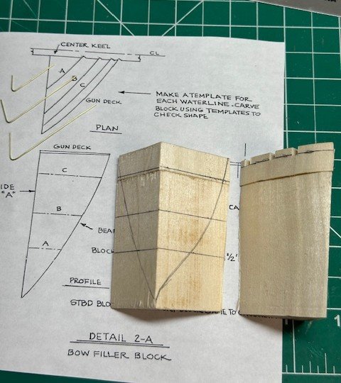

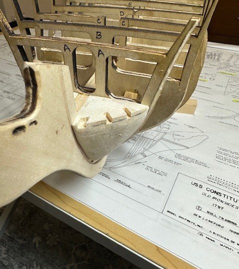

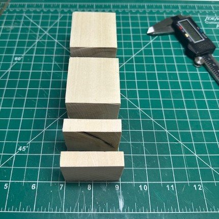

BOW FILLER BLOCKS
Yes, another update, I have moved forward on the ship and began working on the bow filler blocks.  All in all, I think the completion of the bow filler blocks went smoother than the stern filler blocks.  Mostly, of course, because much of the work was essentially a rehash of the process used at the stern.
The kit provides us with a 2” x 2” x 6” long block.  The plans suggest that you cut that larger block into two 2-1/2 x 1-1/4 x 1-1/2” blocks for each side.  Rather than full 2-1/2” lengths, I cut two 2-1/8” length blocks and two shorter ½” length blocks.  Employing a technique from Tom (@usedtosail), I will mill the required notches for the knightheads, gunports and head access frames into the ½” pieces, as it will be easier to do it this way on the mill.  I will then glue the ½” pieces onto the larger pieces for final shaping.

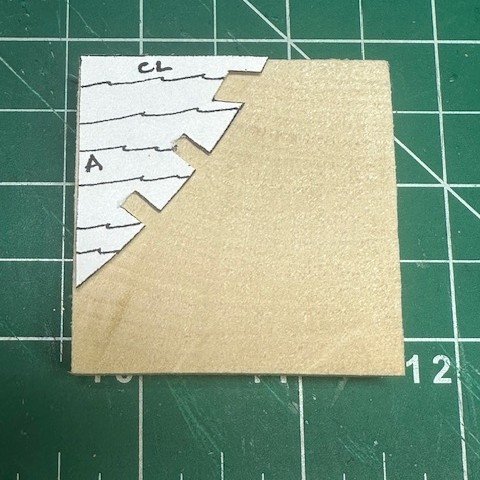

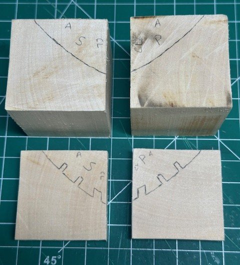

Trace the Gun Deck top view onto each block to ascertain cuts to be made.  Note that I have written port and starboard designations, as well as the Bulkhead A and Hull Center Lines, on each block to help keep them organized in my head.
250804b-BFB_TopNotches.jpg.9c51e42e449a217745b4f0015e3e8d63.jpg   250804c-BFB_Tracing.jpg.07b839ec4c32a55bae8d4e272efef37b.jpg

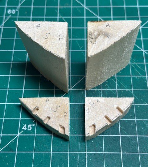

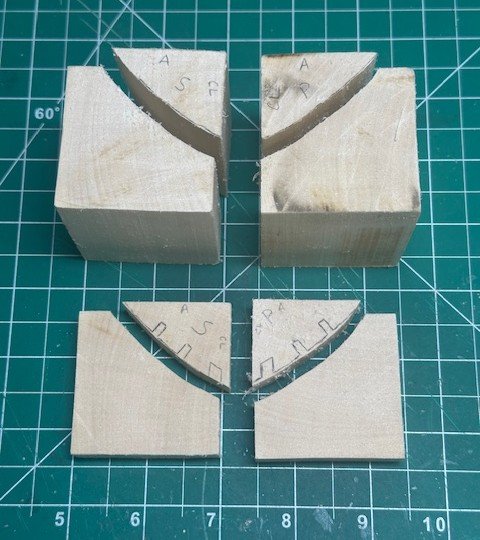

Then, using the scroll saw, I cut out the bow filler block shapes.

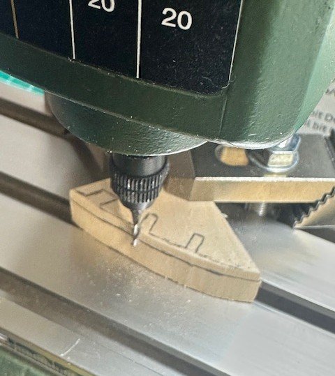

I then moved the top part of the blocks to the mill and cut out the notches.  I scribed and then drew a line for the 1/8” depth notches, as suggested on the plans.
250804e-Mill.jpg.68ae074f6a1351fd0fb085cc0e71f233.jpg   250804f-AfterMill.jpg.231d6a185d2399406053aa82b16ea264.jpg
I then glued the halves together and let them cure overnight.

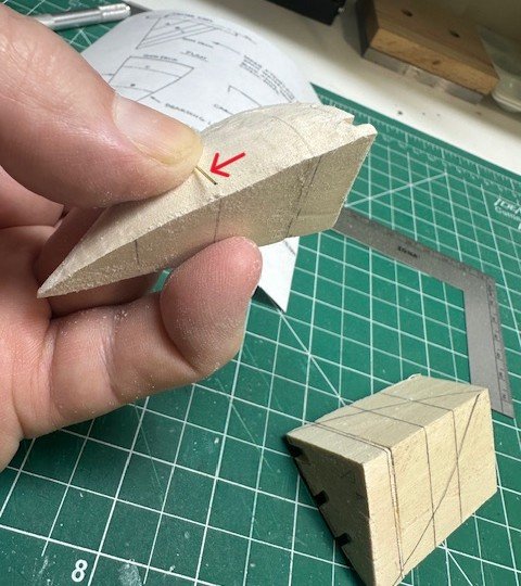

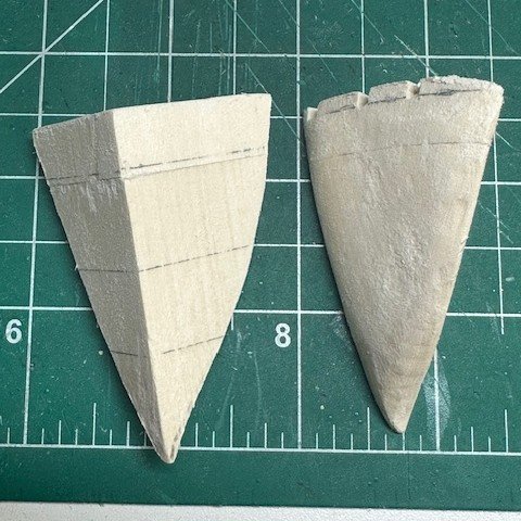

I then drew the A, B & C markings and bearding line shapes to determine how the blocks would be cut and shaped.  I also used the same technique I did for the stern filler block shaping, using small 0.51mm brass wires cut to the A, B & C lengths shown on the plan view, which helped me determine amount of sanding to check the shape.
250804h-ShapePatterns.jpg.e7b7245182dd9e0a0a6c3c0f8f532421.jpg   250804i-BrassRodMeasure.jpg.0481cd3b6b3c97958dbd4eb1ec9f34c1.jpg

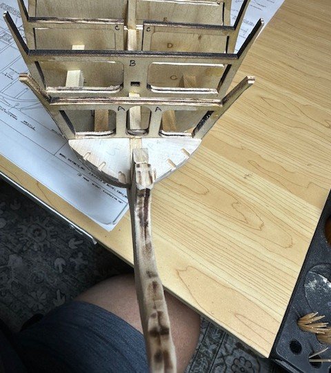

Although I know the bow filler blocks will need additional shaping when we get to placing the hull planks, I think we’ve got the blocks shaped well.
So, I glued the bow filler blocks in place.  Everything seems to look good.
250804k-BFB_InPlace1.jpg.a1c3a55abf9a368903562bc6116e0024.jpg   250804l-BFB_InPlace2.jpg.4bef87da4085bc5a75c6591a33f01614.jpg

Out of curiosity, why did you cut the filler block such you had to mill out the notches in the top half blocks? If you had made the top half blocks thinner and the bottom half blocks thicker, you could have used your scroll saw to cut out the notches. The end product would have been identical, just simpler. In any case, you did a nice job.
Jon
Excellent question, Jon!  And I guess my best response is to use the 🤷‍♂️emoji and say "I dunno...".  Didn't really think about doing it that way and using the scroll saw for the notches.  Perhaps it was because my scroll saw is out in the garage and the Proxxon mill is in the shipyard and more convenient to use.
I think I am more accurate with the mill, too, than with the scroll saw blade.  Was planning on using the mill again for the upper bow framing notches, too.  Hmmm....

Love the technique with the brass wire to guide you through the shaping..
Thanks, Peter.  As simple as it is, it really did help me get the blocks to the more accurate shape that they need to be prior to gluing.  But not for the brass wire measurements, I probably would have quit shaping the blocks multiple times before hitting the mark.  But, in measuring, I would be as much as 2-3mm off in sanding/shaping.  So, I kept at it.  Hopefully, that will save a lot of additional sanding needed once I actually get to the hull planking.

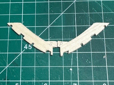

Another “mini-project” done (well, mostly done), so another short update.
Bow Knightheads and Timberheads
Using the plan copies that I had made to cut up and use as templates, I cut out the spar deck framing piece and outlined it on a 3/32” section of provided basswood sheet.  I also flipped it and re-outlined it for the port side framing.  Using my scroll saw, I then cut the framing for both sides and sanded to shape.
250810a-BowFraming.jpg.0d1ad4ad35dff68f5ba6487d7a8368c7.jpg   250810b-BowFraming.jpg.e1f634a760b9ba2c6afe063c88329bd4.jpg
Using the same outline the template” process, I also cut out the knightheads and timberheads for both sides.  Several of the build logs I have used for research and guidance mentioned that the lengths of the plan’s pieces might have been a little short, so I added 1-2mm to each of the framing pieces as I cut them, so I could adjust as needed when I fit them on top of the filler blocks.
I worked on the starboard side first and used the knighthead #1 piece and the timberhead #5 piece (the one closest to Bulkhead A) to have the spar deck frame to sit on for fitting and adjustment.  A bit of sanding was needed for the spar deck frame to sit well in its “slot” between the center keel and Bulkhead A, and the notches both in the filler block and the spar deck frame needed some small widening in spots for the frames to fit well.  I also tested the height of the spar deck frame, as well, against the existing tops of Bulkheads A, B, etc., to make sure the spar deck planking will be level.
250810d-BowFraming.jpg.a16e04f77739e3c555f70ca8bf194f4c.jpg   250810e-BowFraming.jpg.8ec2924ff492a519d4b10ba90fcfe4b0.jpg
I then repeated all of this process on the port side of the ship.
The plans also show the addition of planksheer supports, stiffeners and bridle port header and sill.  Using some suggested 3/32” square strips, I added the planksheer supports just above the spar deck level.  I’d like to hold off on any stiffener additions until I get a better idea of how the bow area will be completed,, and I’m holding off on the bridle port frames until I get to the gun deck gunport framing, as that will all be done at the same level and I want it to be as accurate as I can.  Whether these are good decisions or not… we shall see.  It will be easy, though, to add (I think) when needed.  I also need to do some additional sanding, both inside and out, to smooth things out.
250810g-BowFraming.jpg.854d4675615f13bbfd036f3c110ce766.jpg   250810h-BowFraming.jpg.57c342b18e7727397752415c21719275.jpg

So, it’s time to make decisions about the stern configuration.  I have said several times that my goal has been to build this ship as an “1812-ish” version of the Constitution.  In reading up on the history and seeing several adaptations in Michele Felice Cornè’s paintings, I decided to give his 1812 six-window configuration a shot.  Some of the various stern configurations are shown in the Anatomy of the Ship book.
Let’s first see how all of the kit-provided stern frames look as they are positioned on the counter block.  As others have noted, there were some subtle shape differences between the six provided frame pieces.
251012d-SternFraming.jpg.c65b72b5679718fa3ab6e8992fe9789c.jpg   251012e-SternFraming.jpg.e81ea596d544e4325c1cad11616dd66c.jpg
The fantastic builders who have done detailed gun decks have also taken different approaches to how the Commodore’s aft cabin (and the port and starboard staterooms) would be displayed, if at all.  If there is going to be any visual presentation of the aft cabin, whether from the exposed spar deck or from the stern windows, some alterations to the kit-provided center stern frames were going to be necessary.  And, of course, with the alteration in the number of stern windows I had decided to include vs. the kit’s 3-window configuration, I was going to need to add some stern frames to help support the additional windows.
So, using the kit-provided stern frames as a template, I cut some new stern frames that would allow for the appearance of an open Commodore’s aft cabin, if visible.  When duplicating these new stern frames, I left some additional frame piece at the base of the frame in order to fit it into the counter block (more on that in a bit), as well as an extension (just in case, for fitting) of the horizontal piece that goes back to Bulkhead R, which will be the wall separating the Commodore’s forward and aft cabin areas.
251012g-Sternframing.jpg.bdffce27e02c6f850733f5561d20808a.jpg      251012h-SternFraming.jpg.c7f44496b38ee0146dd526fa26808593.jpg
On the two outside stern frame #3 pieces, I milled openings to display the access from the respective staterooms out to the bath and lavatory areas in the quarter galleries.  (As I look at these openings now, I may not have cut them quite large enough, but I’ll assess that again soon.)
As a part of my research, I learned that Issac Hull’s crew that had won the battle against HMS Guerriere presented him with a model of the USS Constitution as a gift.  That model has been on display at the Peabody Essex Museum in Salem, MA.  This battle took place in August 1812, so that’s a good date for me to use as a guide for the stern configuration.
Also, as a part of the stern configuration and the exposed gun deck, I needed to cut out the “bump-out” section of the Commodore’s aft cabin where the lounge chair sits.  After cutting it out, I replaced the support beam with a nice solid piece of wood.
OK, now a brief discussion on my latest trial-and-error failure.  I indicated earlier that I had made the “legs” of the new stern frames a bit longer so they would fit into notches I would make into the counter block.  This would help in securing the stern frames more securely, right?  Here’s the mill work I did in creating those notches.
251012n-SternFraming.jpg.a6b82c4df3e43032554e243ddccefcaf.jpg    251012o-SternFraming.jpg.17e0e01bcb663ac500153b5113f395fa.jpg
Yeah, this did not go well.  The stern frames fit poorly and it was going to be even more difficult to make all of the joined pieces… the stern frames, the altered counter block, and the filler blocks… look right.  So, I decided to discard the now-mutilated counter block and make a new counter block.  I will now simply securely glue the stern frames (without the extra length at the base) to the counter block.  With some calculations and measuring, I determined where the stern frames would be placed so that the six-window configuration would fit properly.  As a few other prior builders had done, though, I did affix some support tracks to the counter block to provide additional strength and support to the stern frames.
251012q-SternFraming.jpg.3dbe73fcd1462881931201827edab23d.jpg    251012r-SternFraming.jpg.f2df82da6e23adfcfa8383fbc99d9484.jpg
251012s-SternFraming.jpg.053ee8a999aba57eb94b497c95df2e59.jpg    251012t-SternFraming.jpg.512f9a74f9640da7b498f152343745df.jpg
As the new stern frames were placed and secured, I also began working on shaping and securing the two deck beams at the rear of the spar deck level.
251012v-SternFraming.jpg.5a50f14340c13fb482b4c4bb4cde47a1.jpg    251012w-SternFraming.jpg.f483fc5639b214abe216d4d5043b1de2.jpg
251012x-SternFraming.jpg.bab4a6543dc215c74a447b6781fff5ec.jpg    251012y-SternFraming.jpg.2794d9bbf77688ee2760772cb80b4937.jpg
