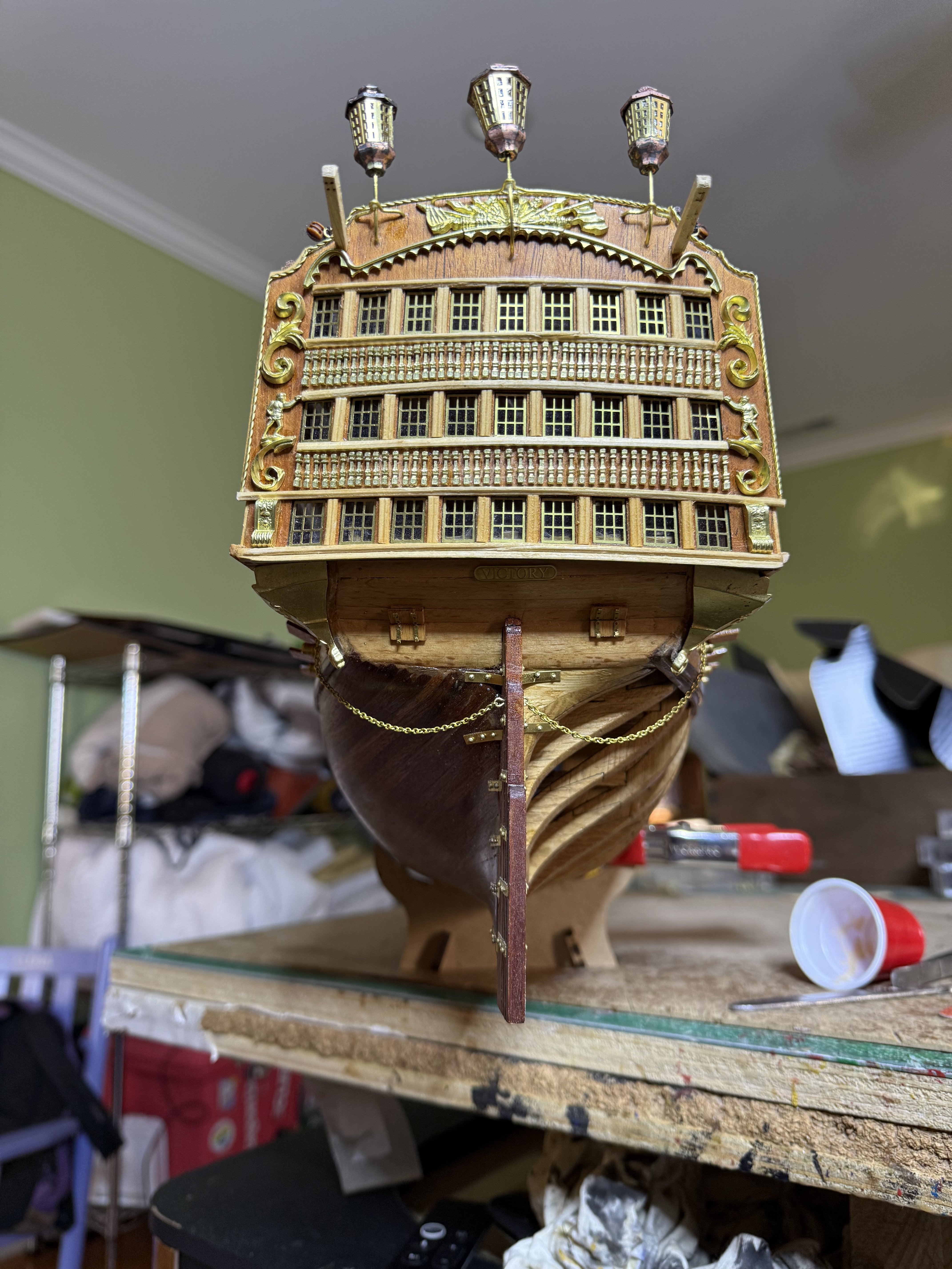

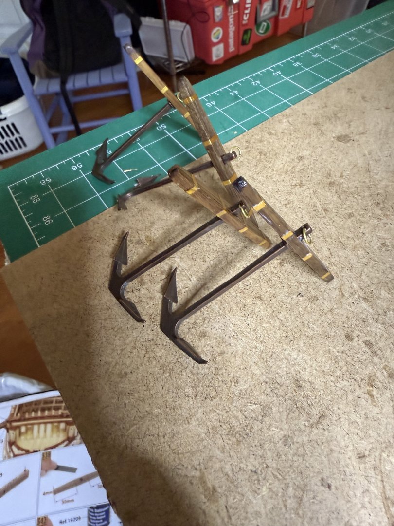

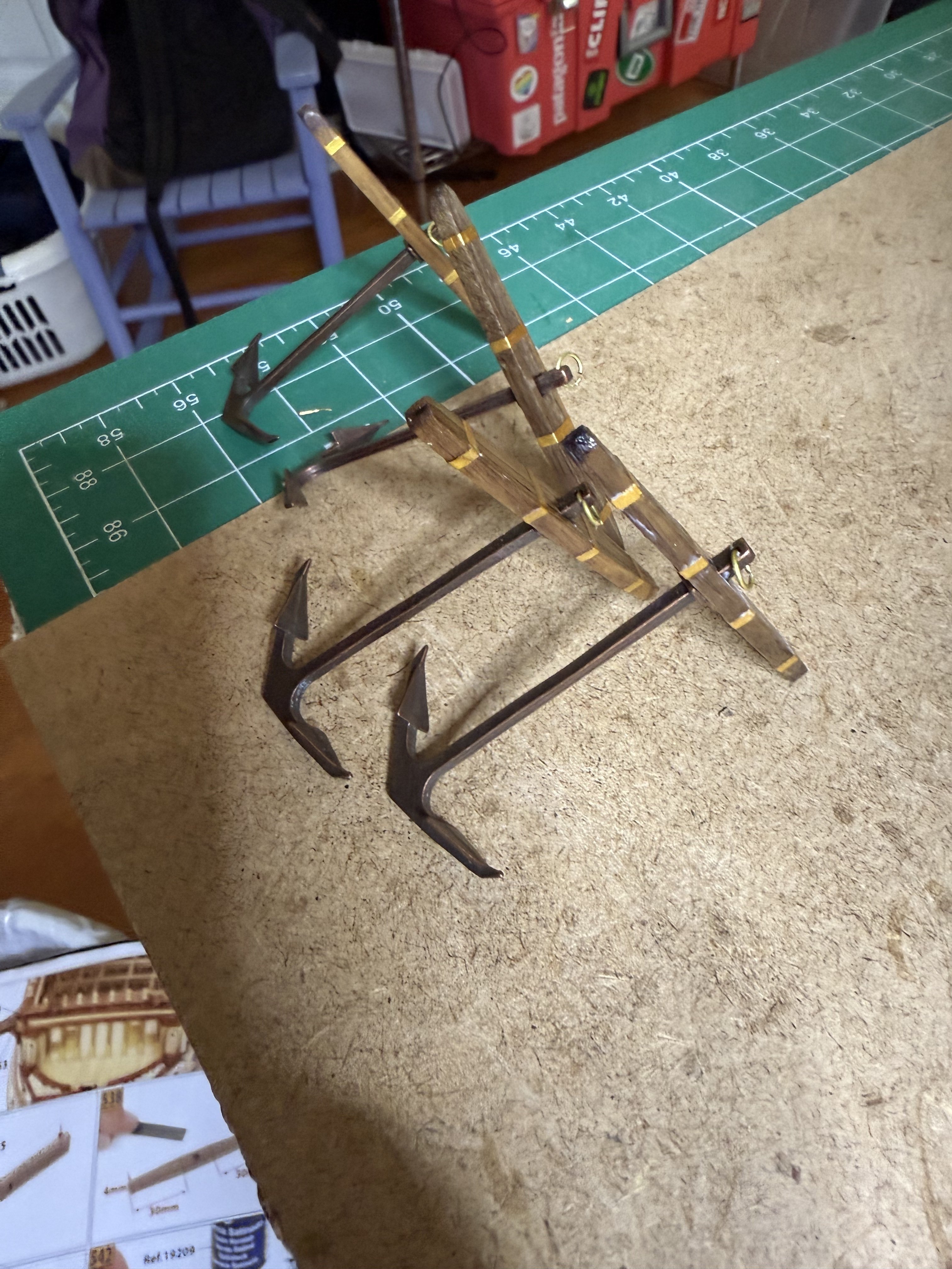

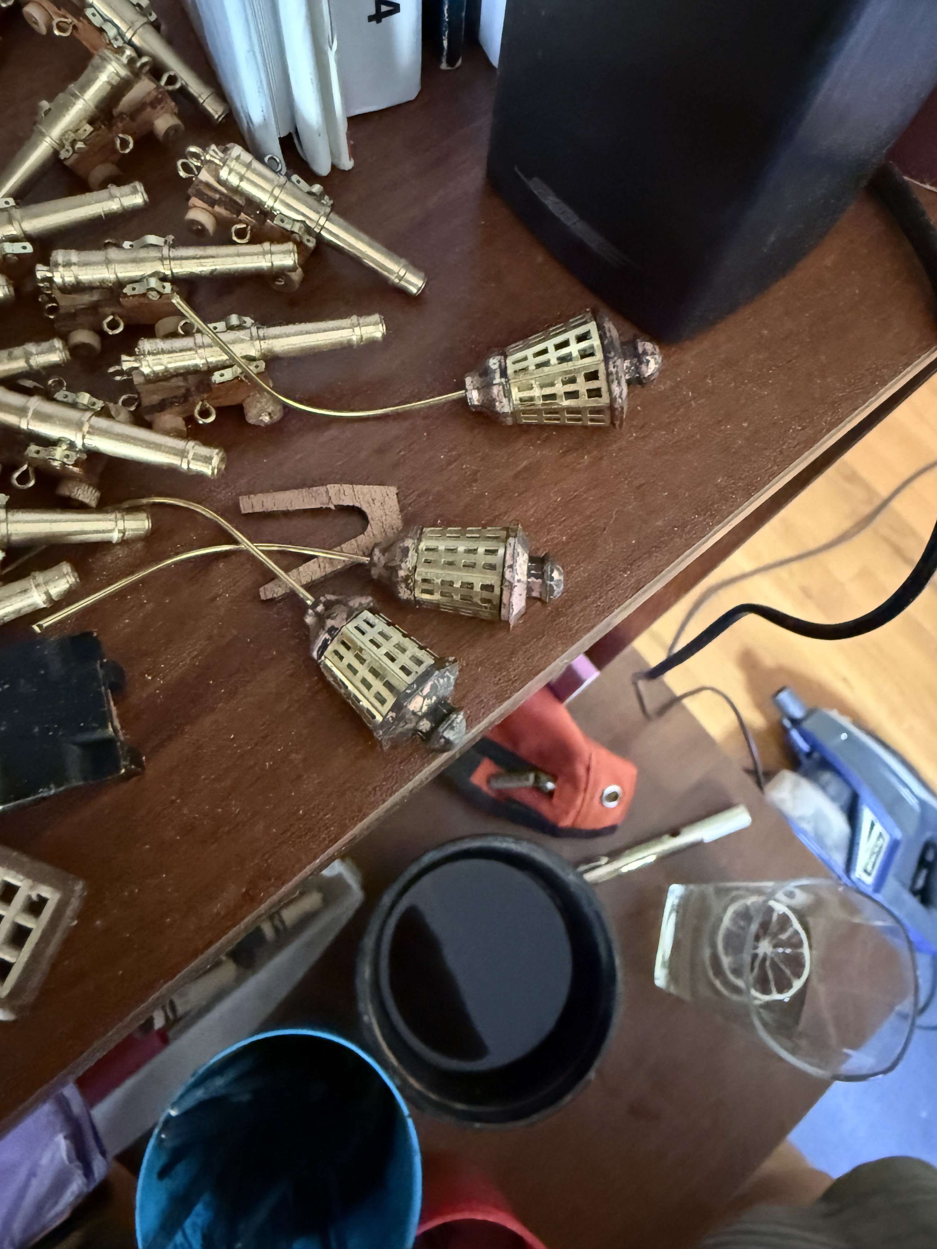

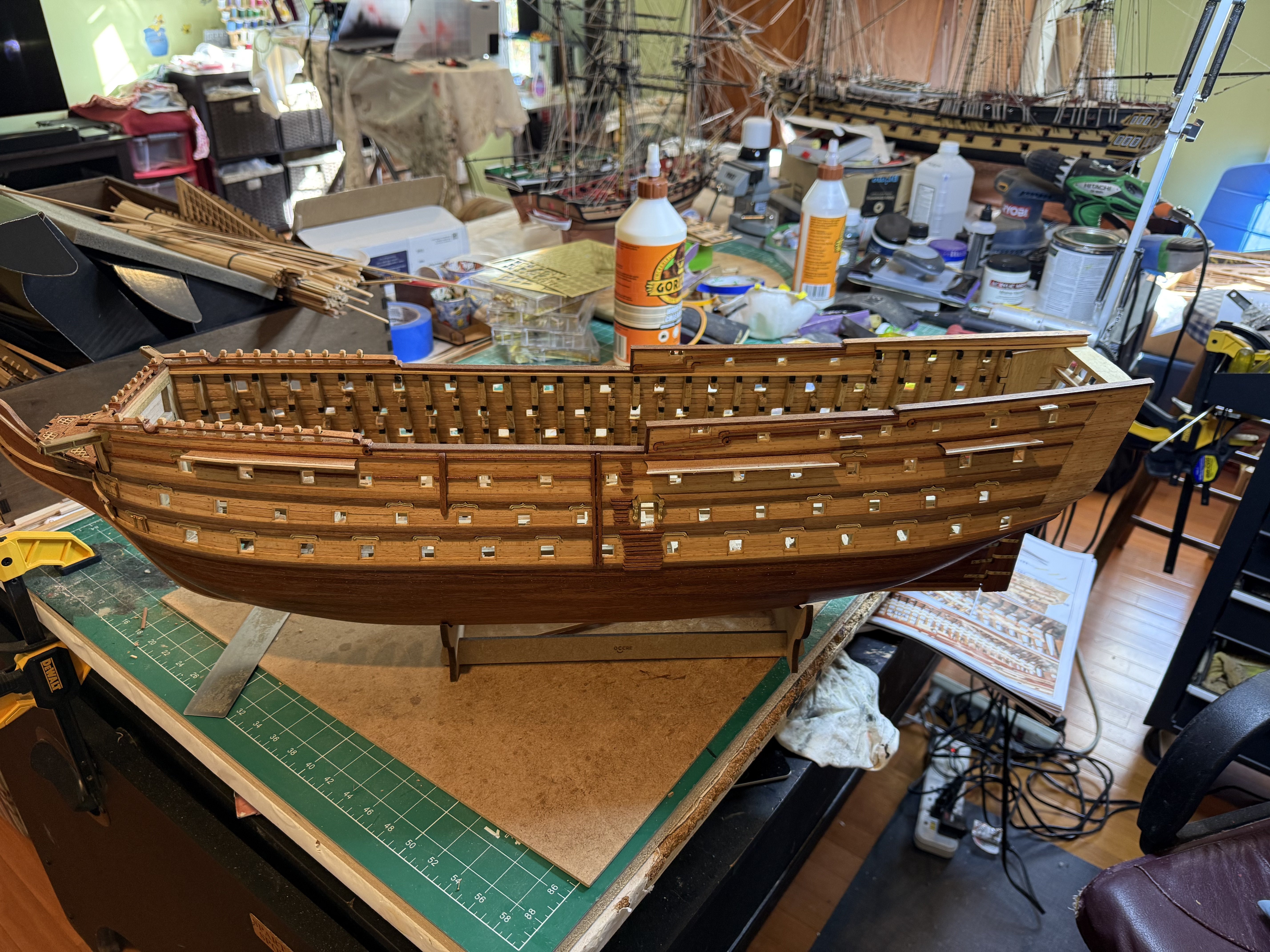

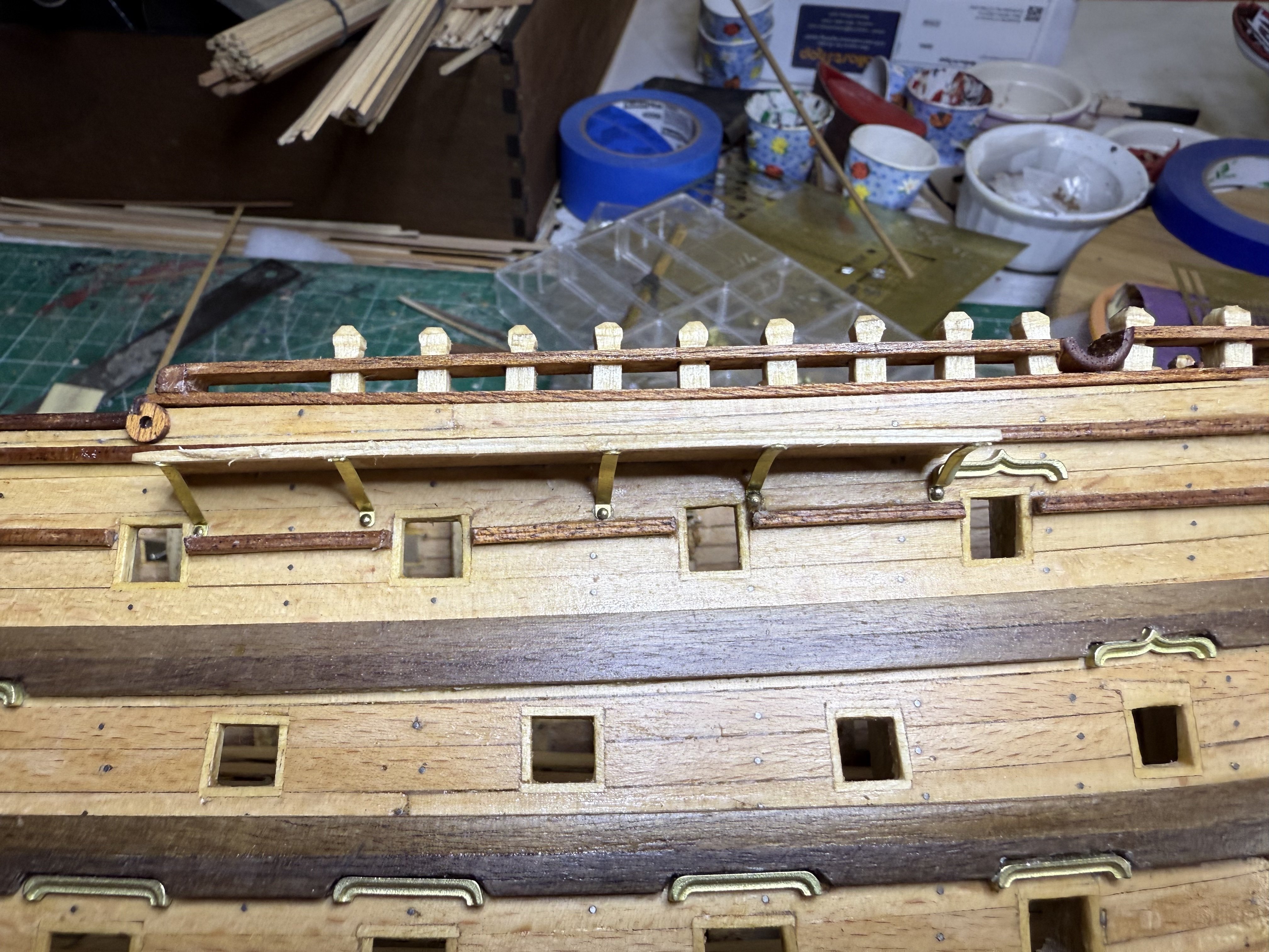

Next completes the anchors and lanterns
IMG_0870.thumb.jpg.dd6d86a79a5171ba130d480bb391611e.jpgIMG_0869.thumb.jpg.9f0753b4966ec11c04602bebbfce52fd.jpg
Followed by the catheads.
IMG_0872.thumb.jpg.326cd6c75953b3efc00cc2a128e620b5.jpgIMG_0871.thumb.jpg.5f331d05e77159a0129b725df27c2e46.jpgIMG_0873.thumb.jpg.147842705707265f6d4d1f37006b0406.jpg

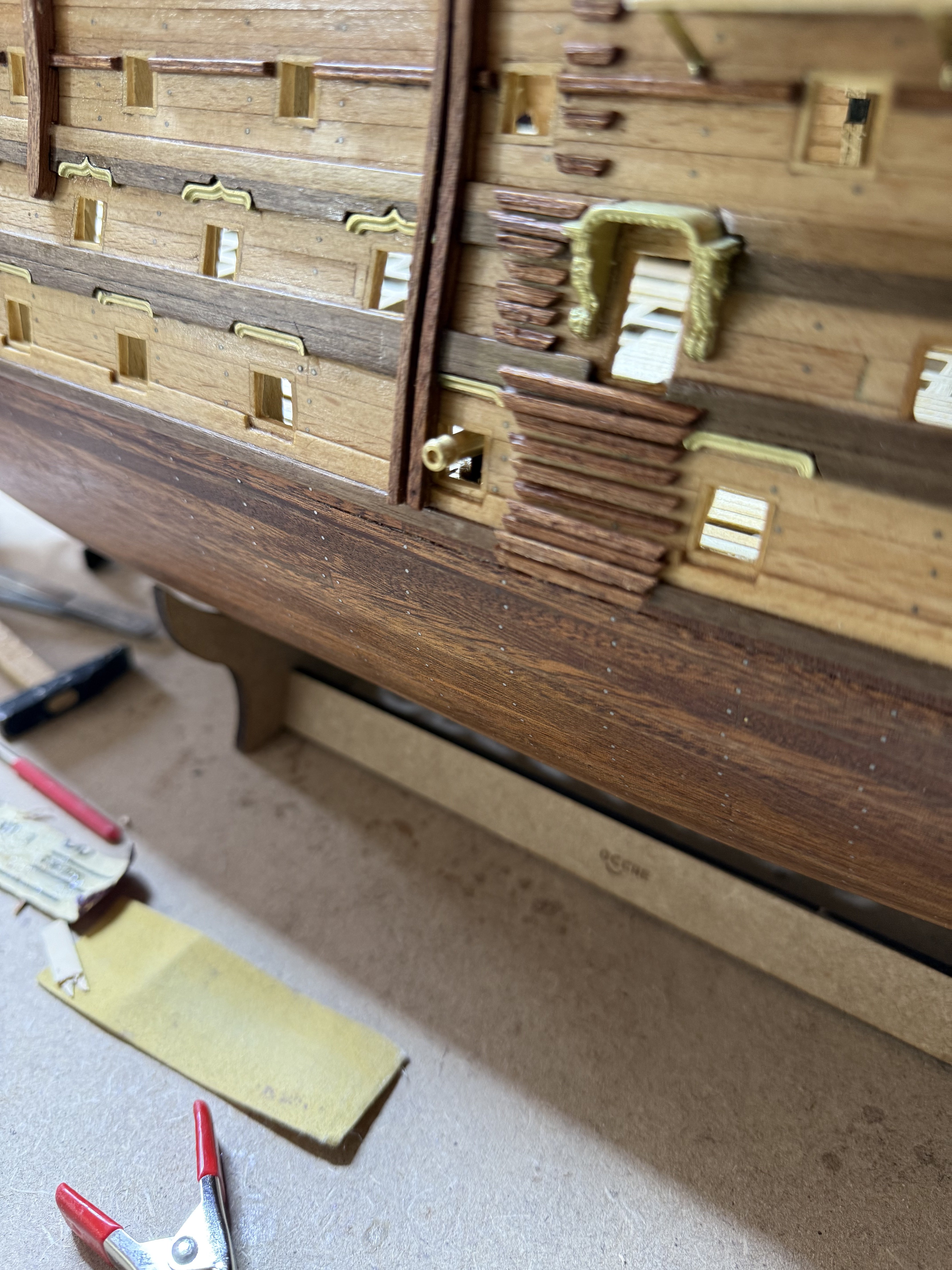

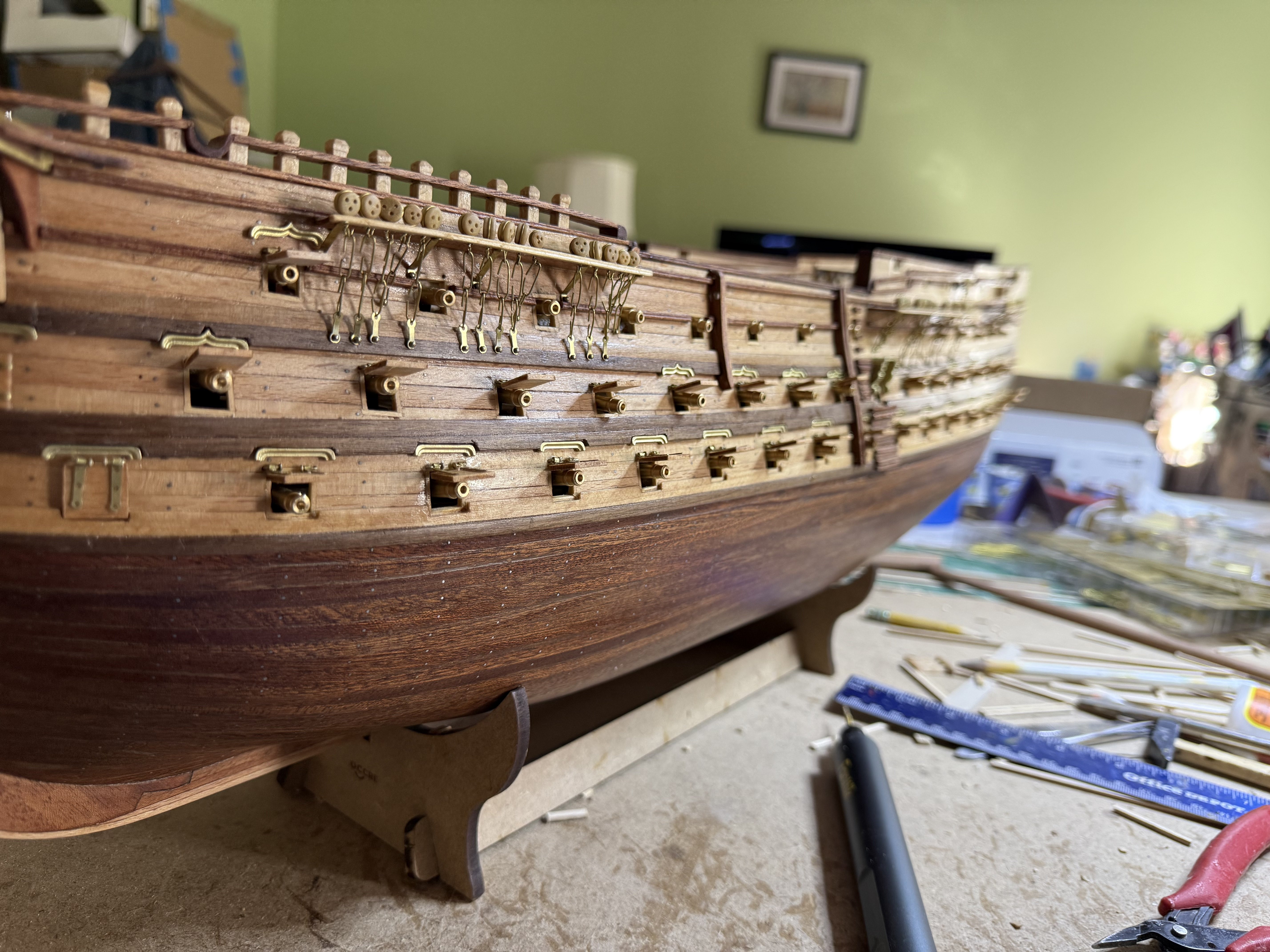

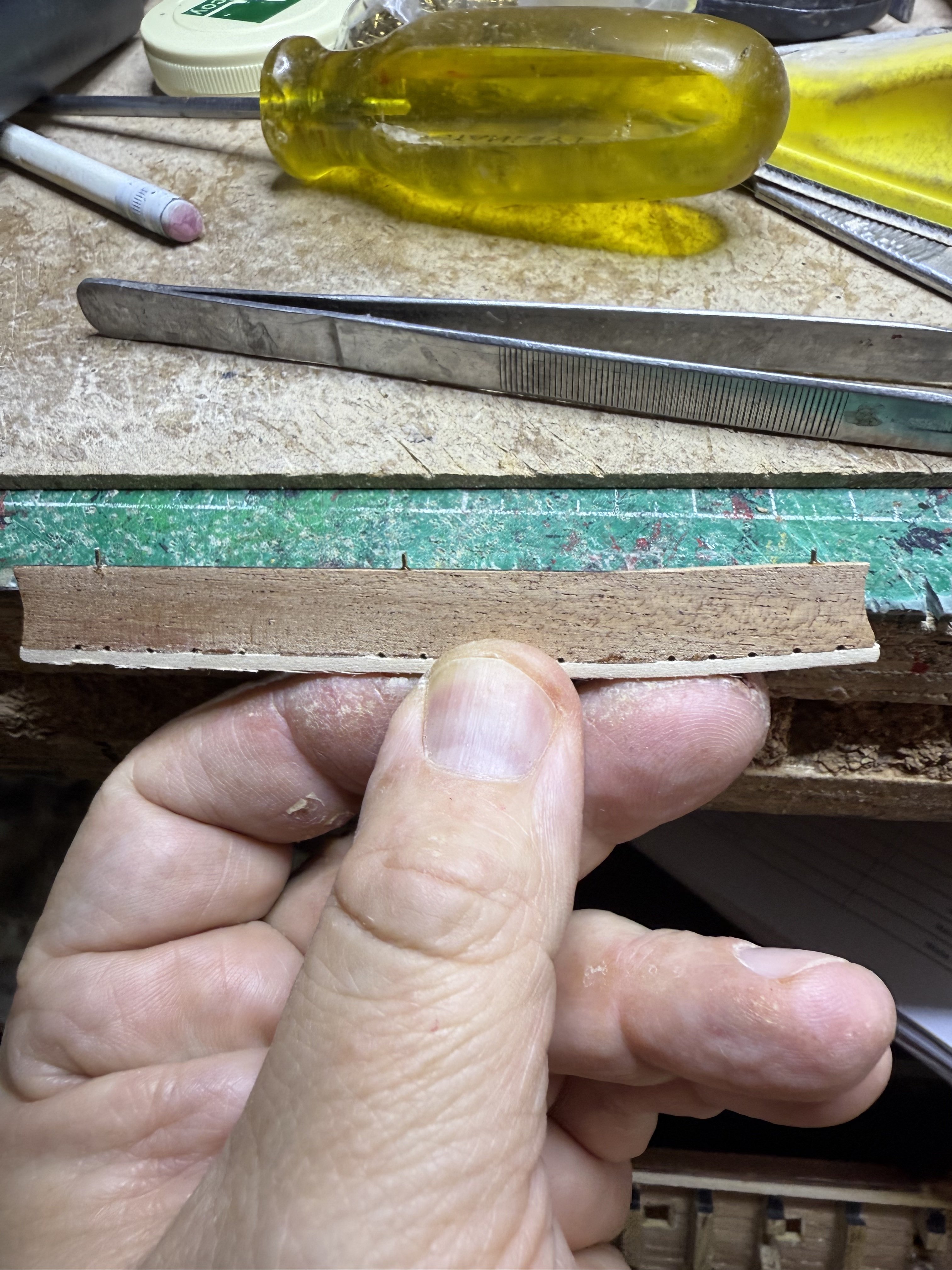

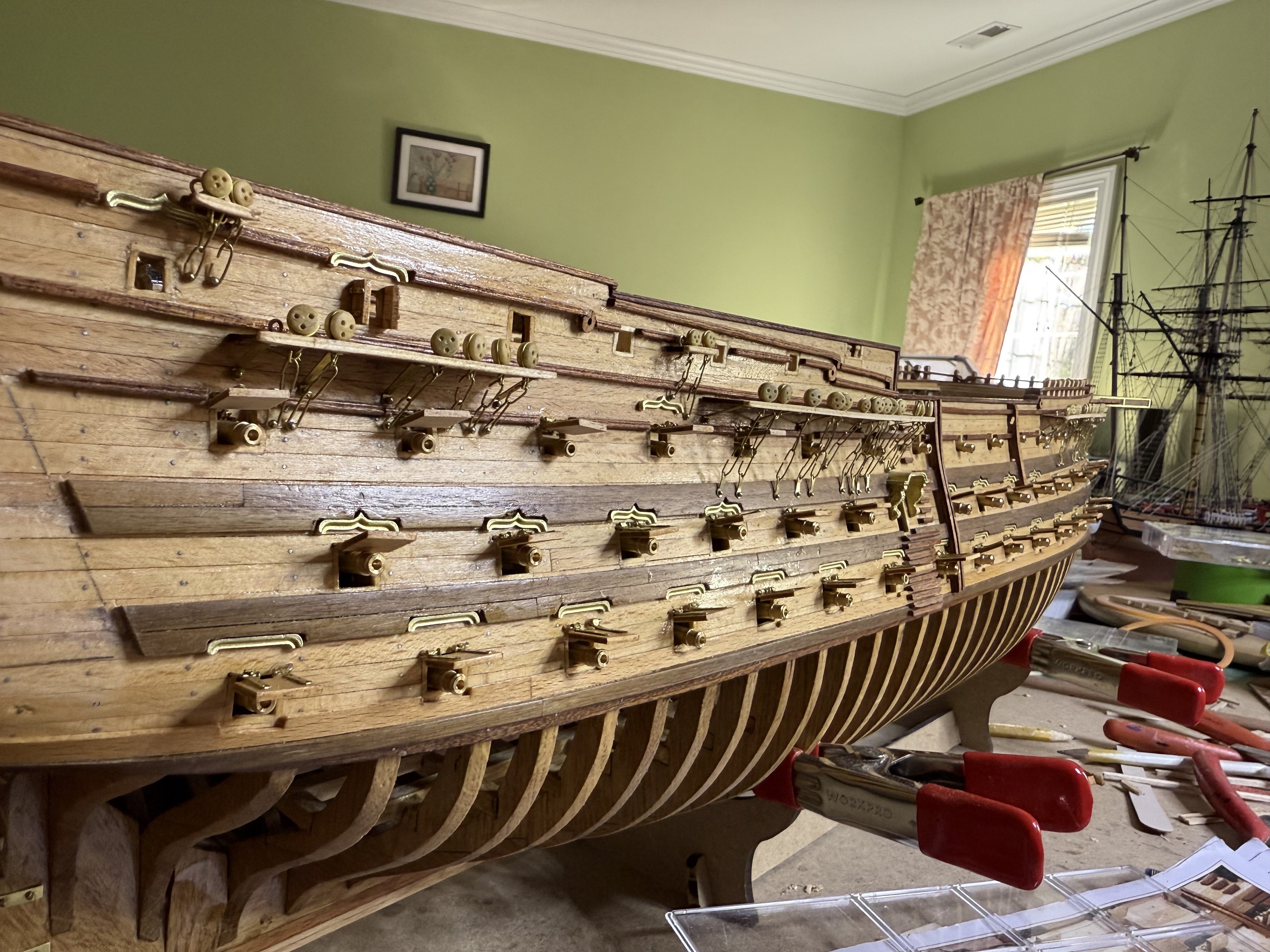

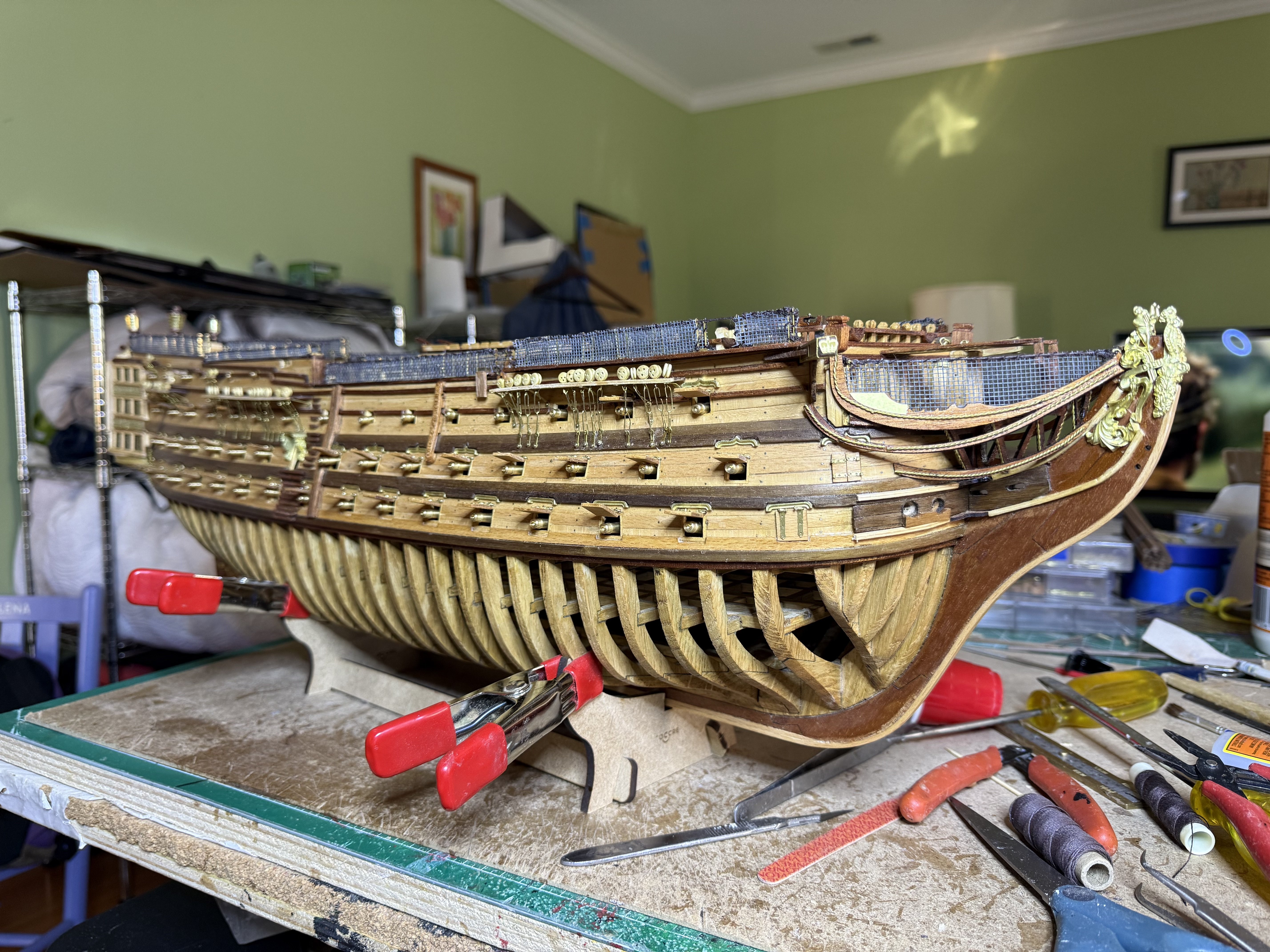

Next were the channels.  Although not called for, I drilled holes into the channels for pins
Followed b y hole in the hull to glue and secure the channels a bit better.  Things look pretty even. The instructions are a bit lean on placement relying on a lot of careful observations of the pictures.
IMG_0882.thumb.jpg.084c75937d30ae565ad06d99e6c821d2.jpgIMG_0881.thumb.jpg.aeb8d54011e49e2de7f69f24f605154b.jpgIMG_0880.thumb.jpg.b163ea0b823953e28bf9141bd22acf9d.jpgIMG_0879.thumb.jpg.4dd9f764d6d838ecf397d3bca6ee7094.jpgIMG_0878.thumb.jpg.bb238ee2151d0764e5f8d148840b8367.jpg

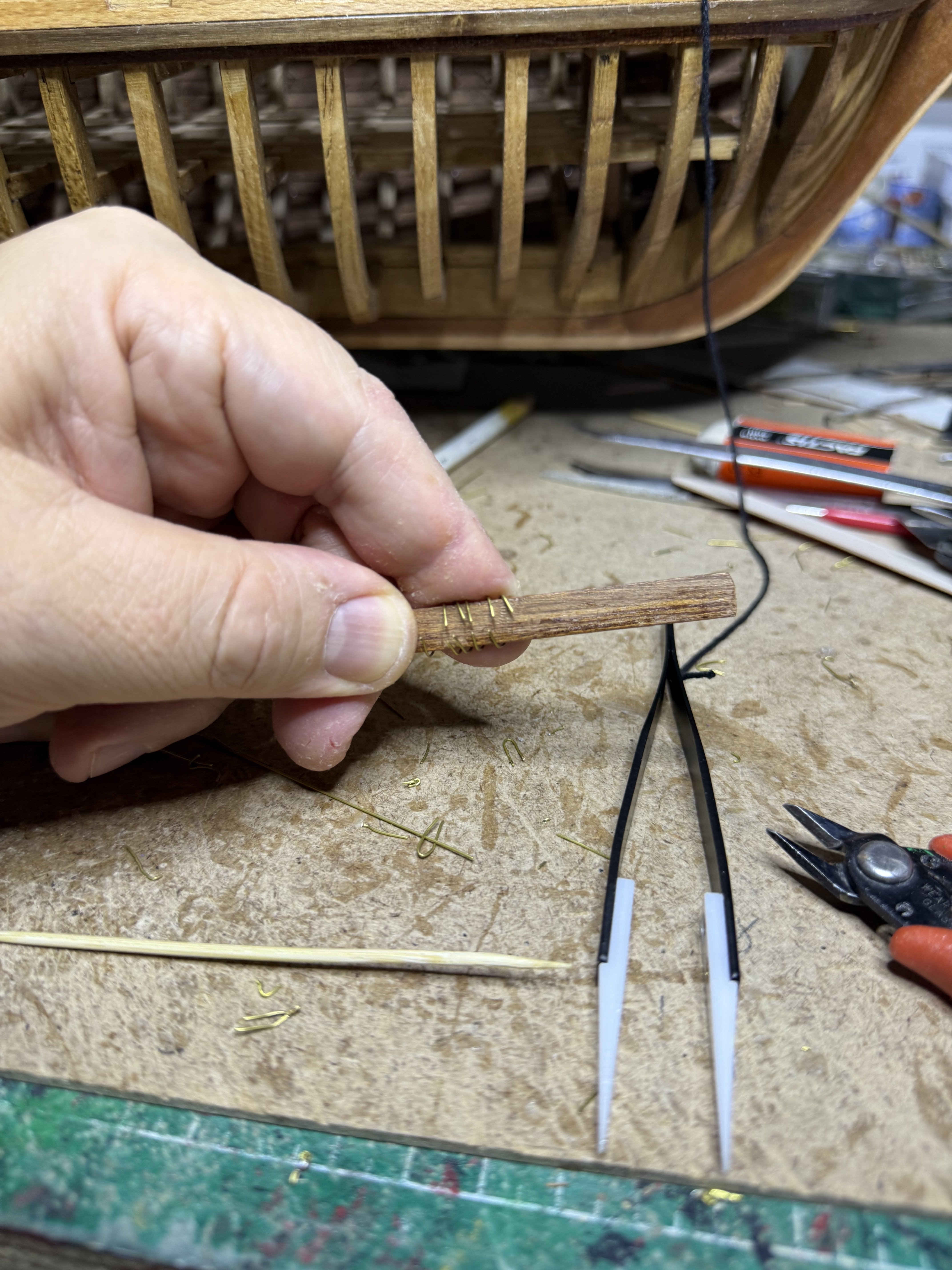

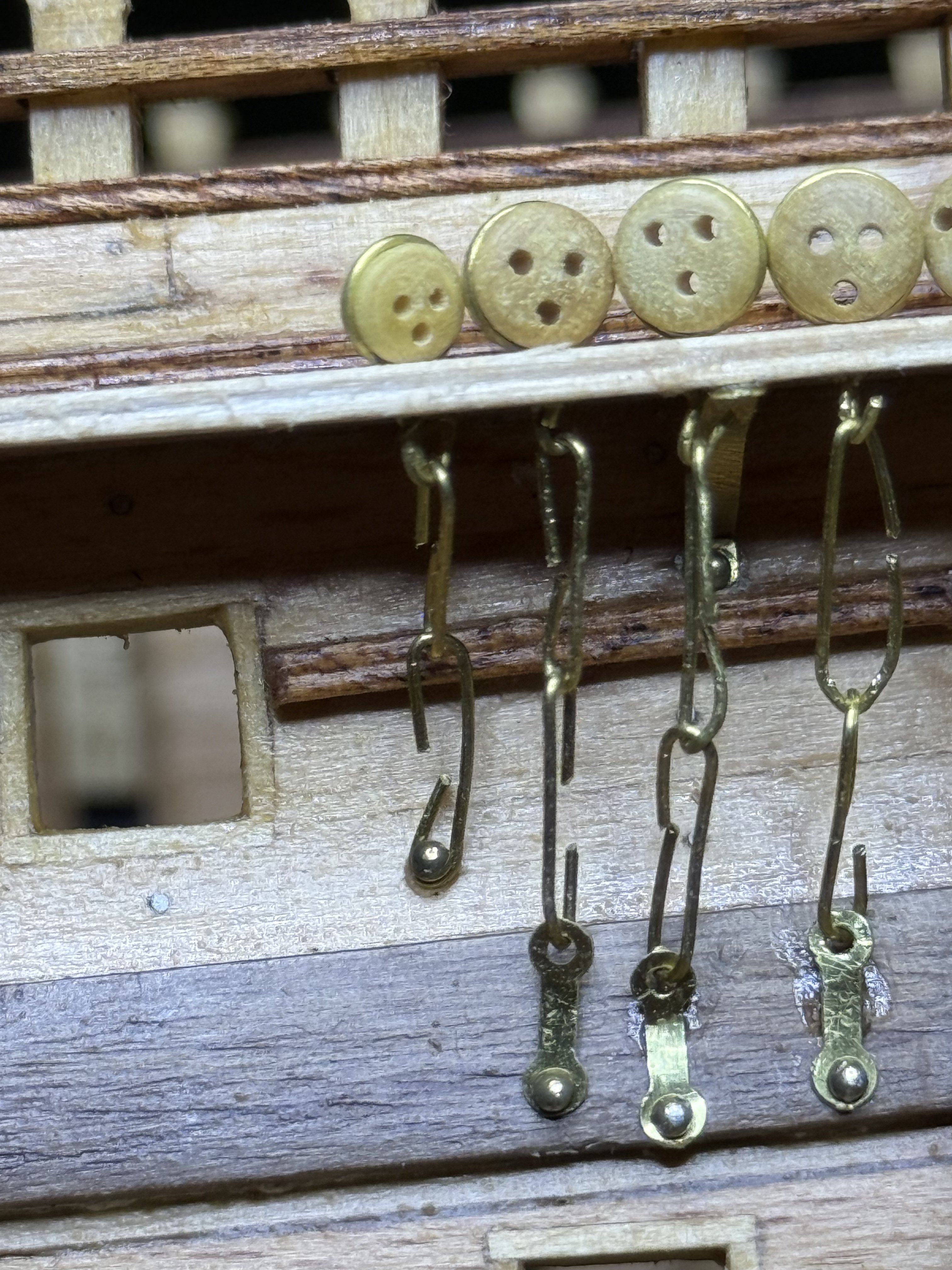

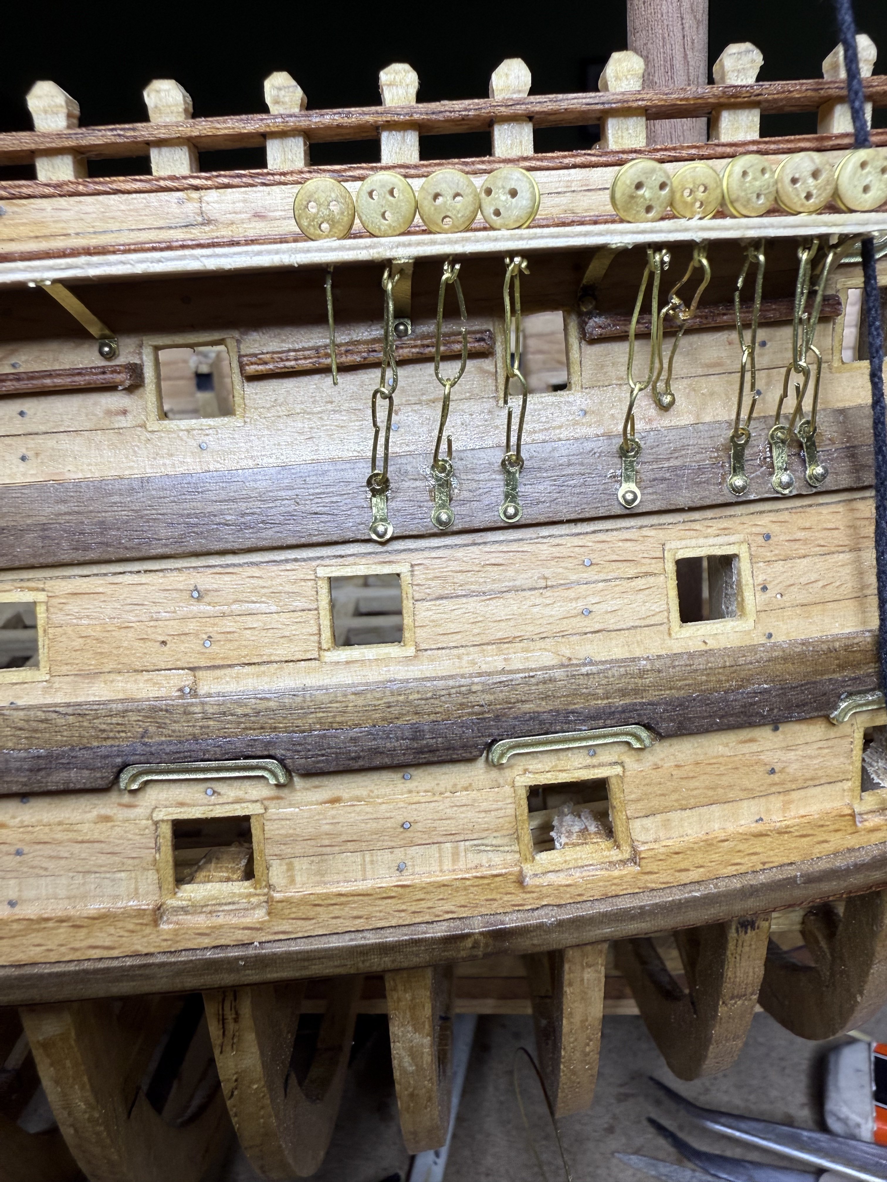

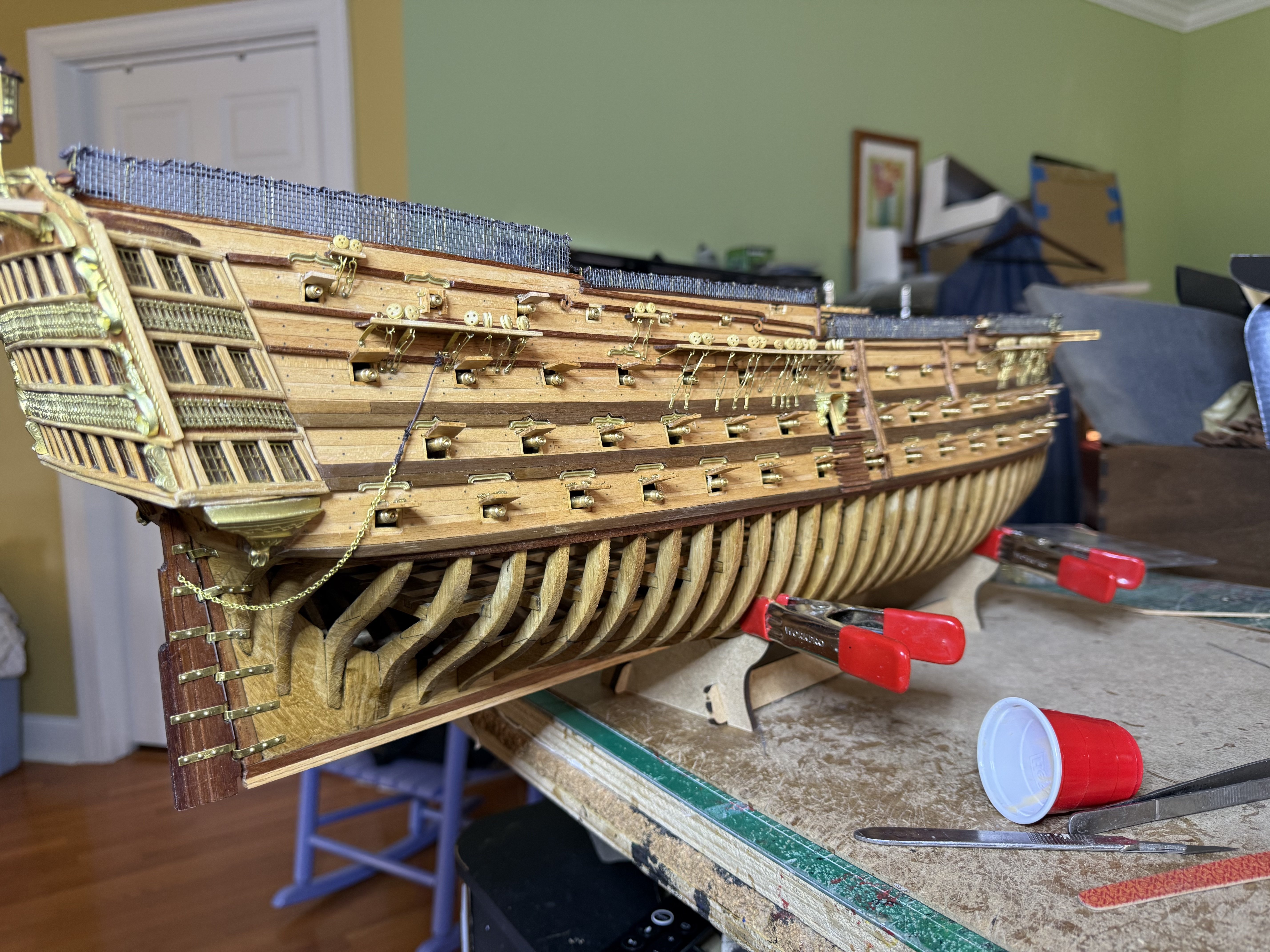

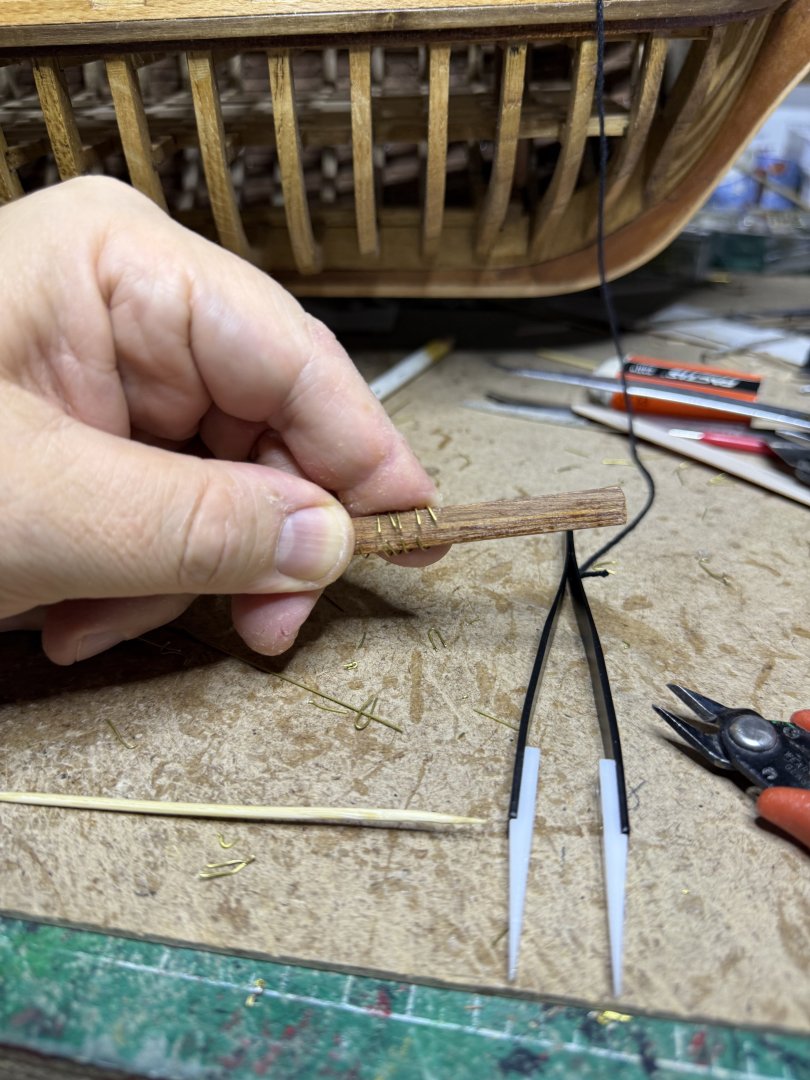

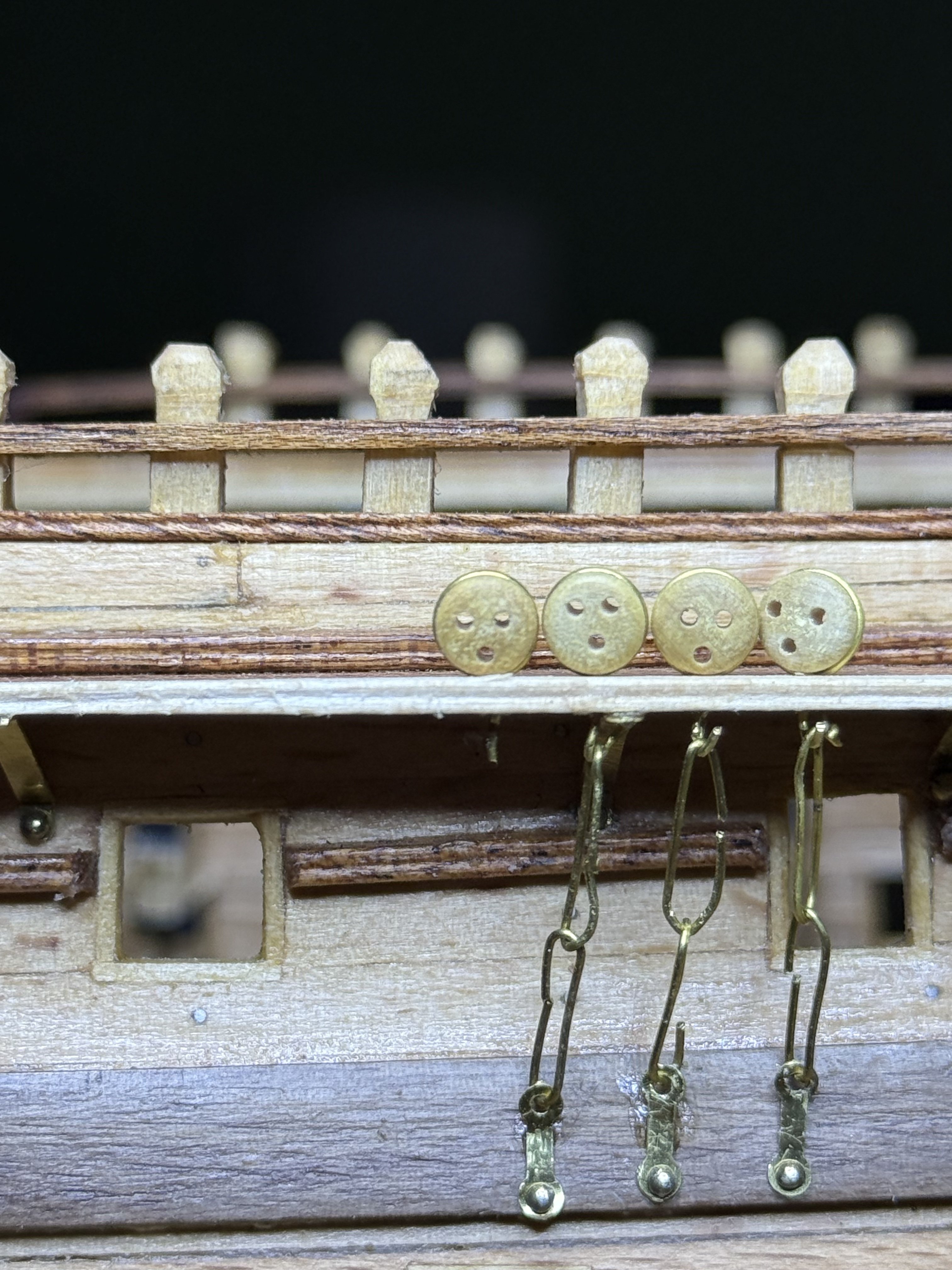

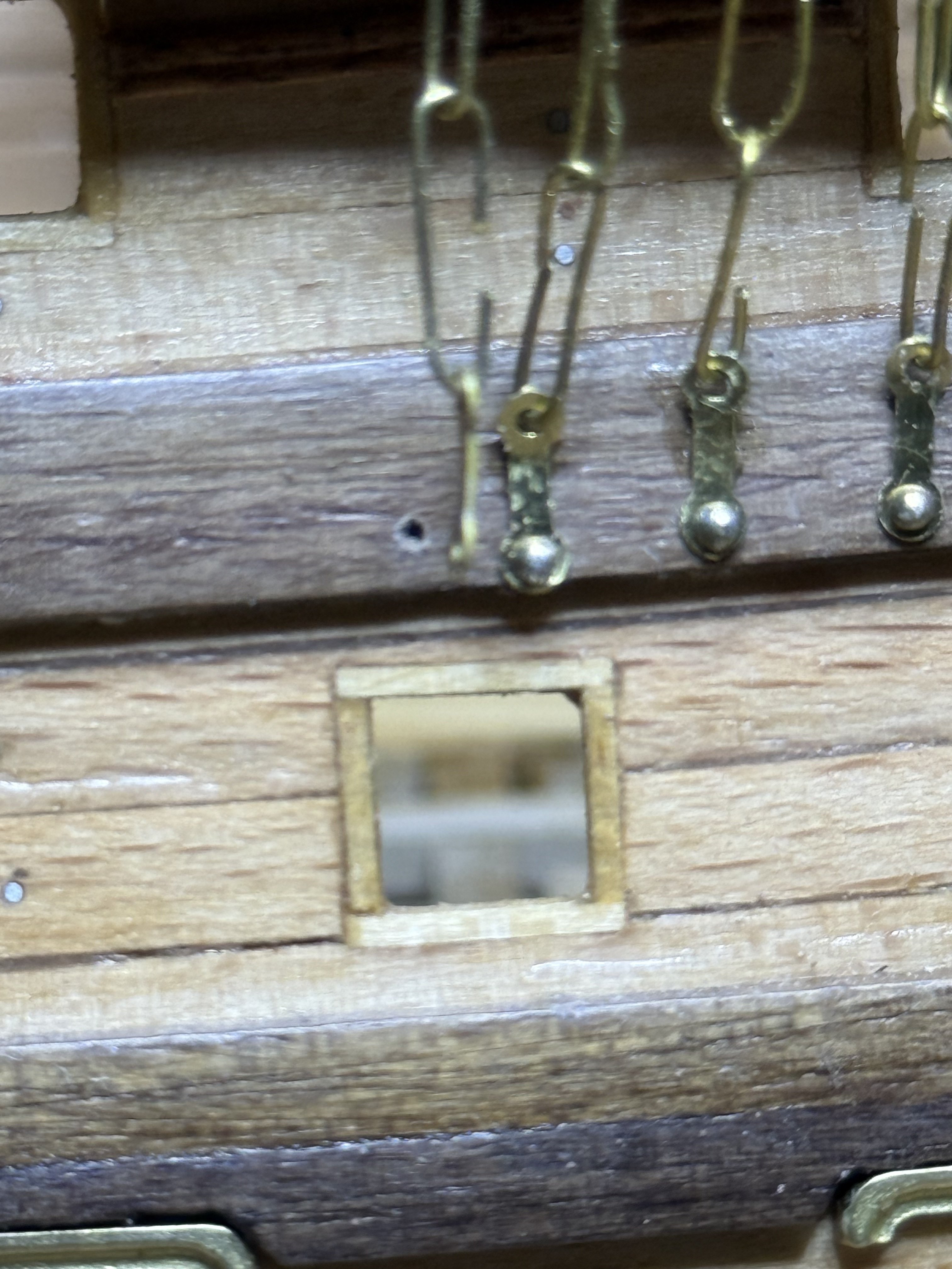

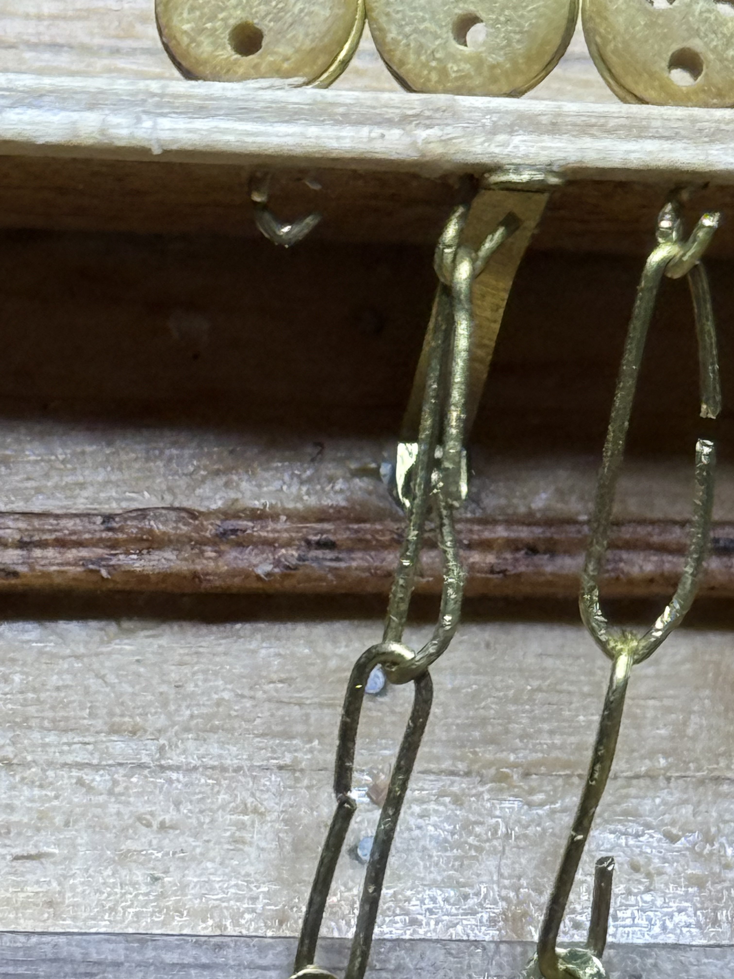

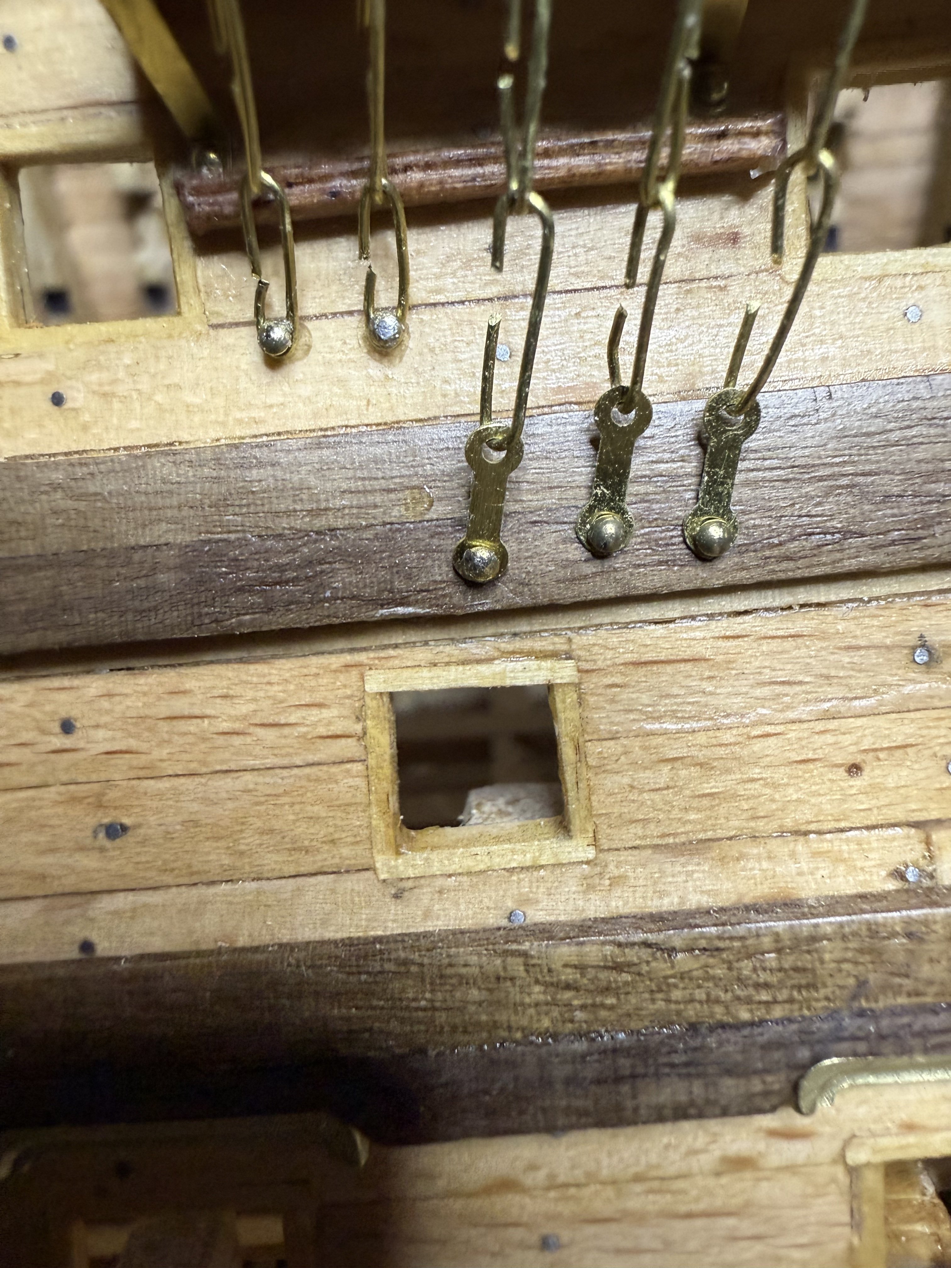

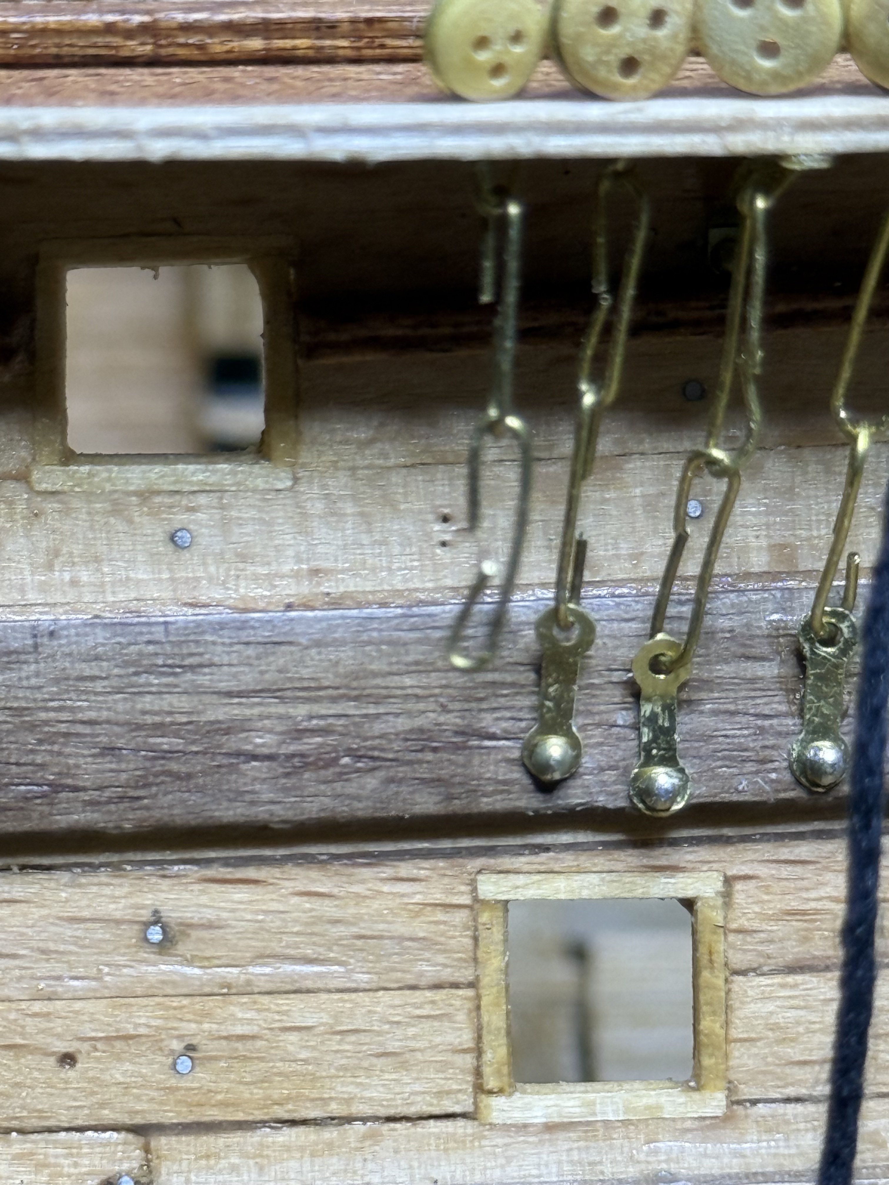

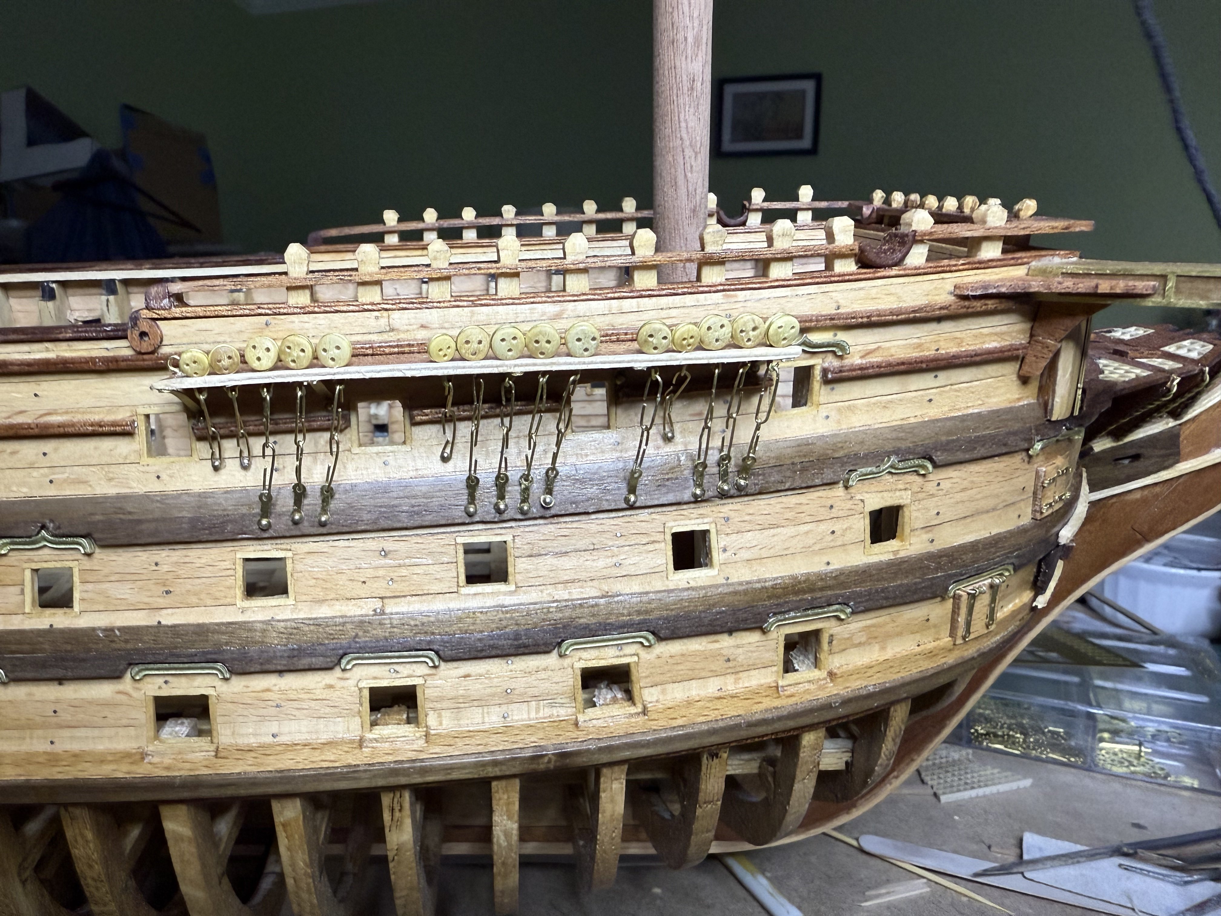

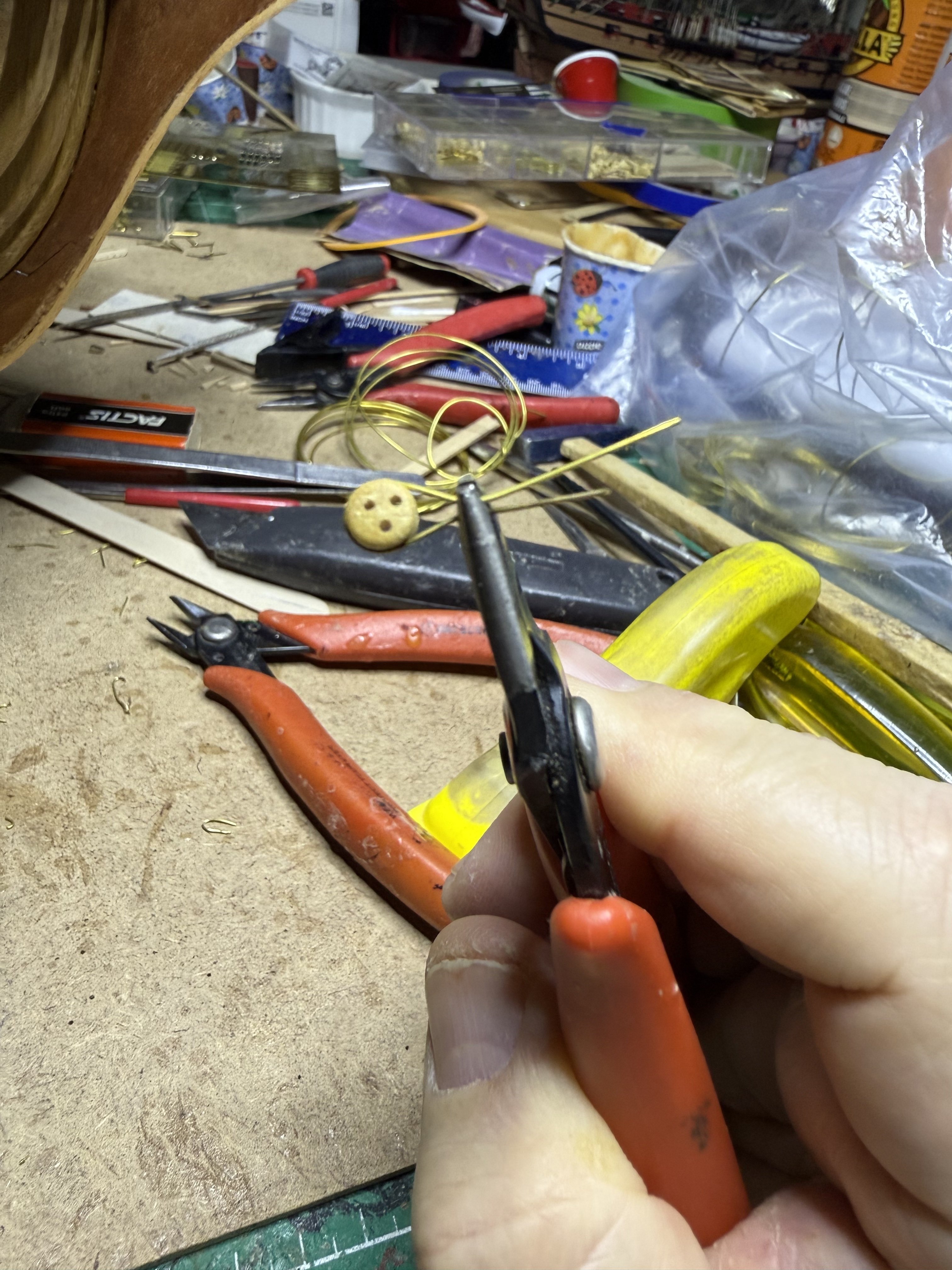

Now completed the chains. Do not know why Occre not using photo-etched chains like Vanguard. Only have the buckle and you need to make the chains out of wire. The wire guage the provided not strong enough so used  one that I had left over from other project (always keep the left overs as they often help in other builds).
First wrap a piece of wire around a deadeye and twist
IMG_0913.thumb.jpg.834f0f6960a5347584843f02eaf04e79.jpgIMG_0914.thumb.jpg.a5691d9d70a5940f85bde50c530d2385.jpg
Next cut off one limb and insert into the channel
Trim it the bend to form a loop
IMG_0919.thumb.jpg.41cd8dc4051464a0e9efad11159cca7d.jpgIMG_0920.thumb.jpg.39af47cb8d30b221cec63cdafa3728ae.jpg

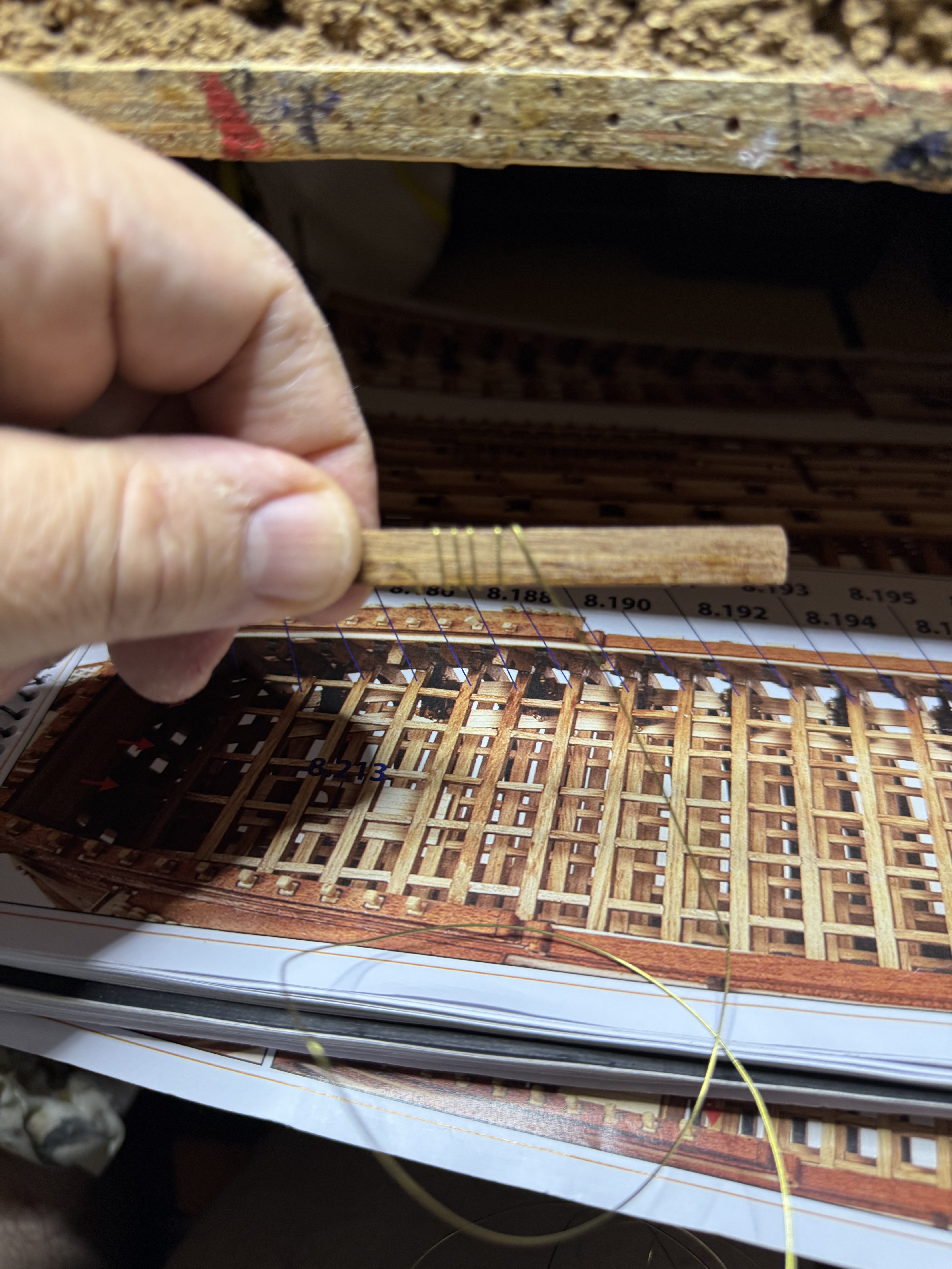

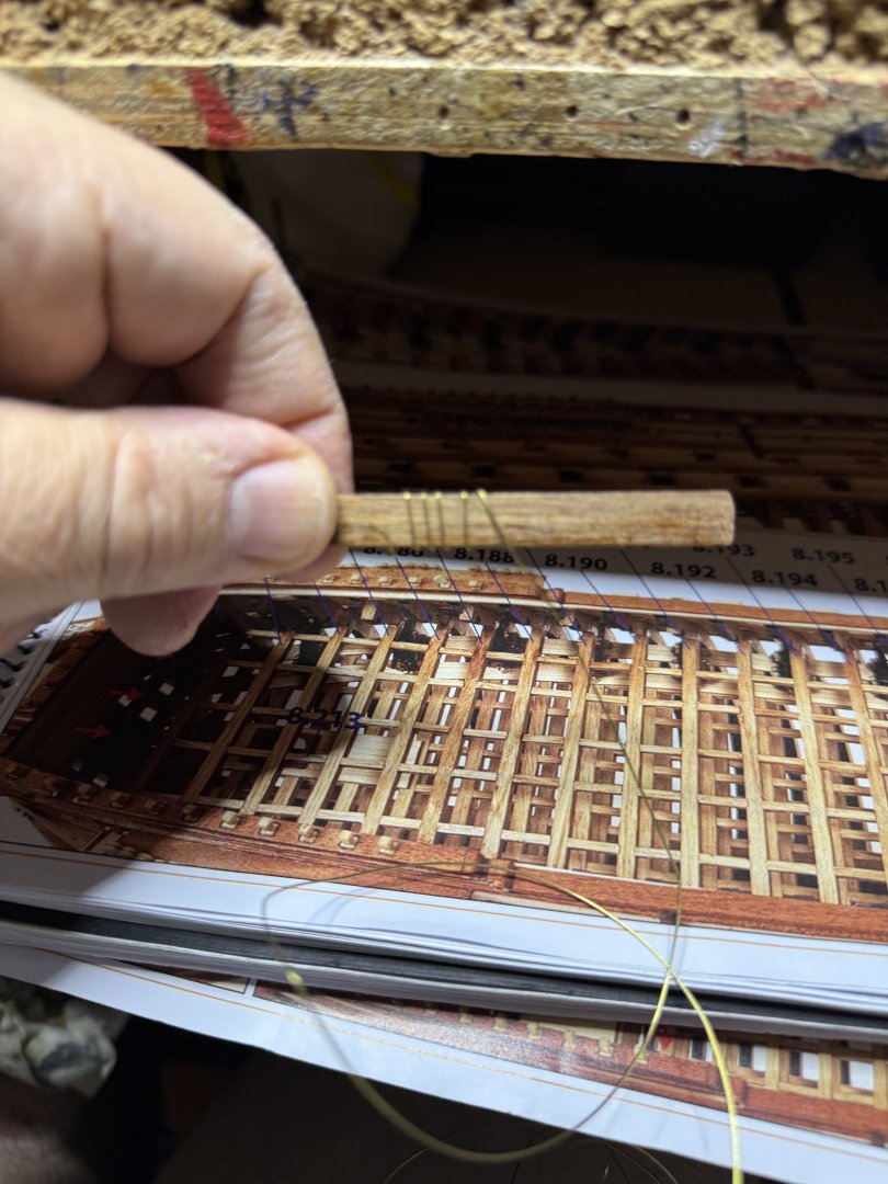

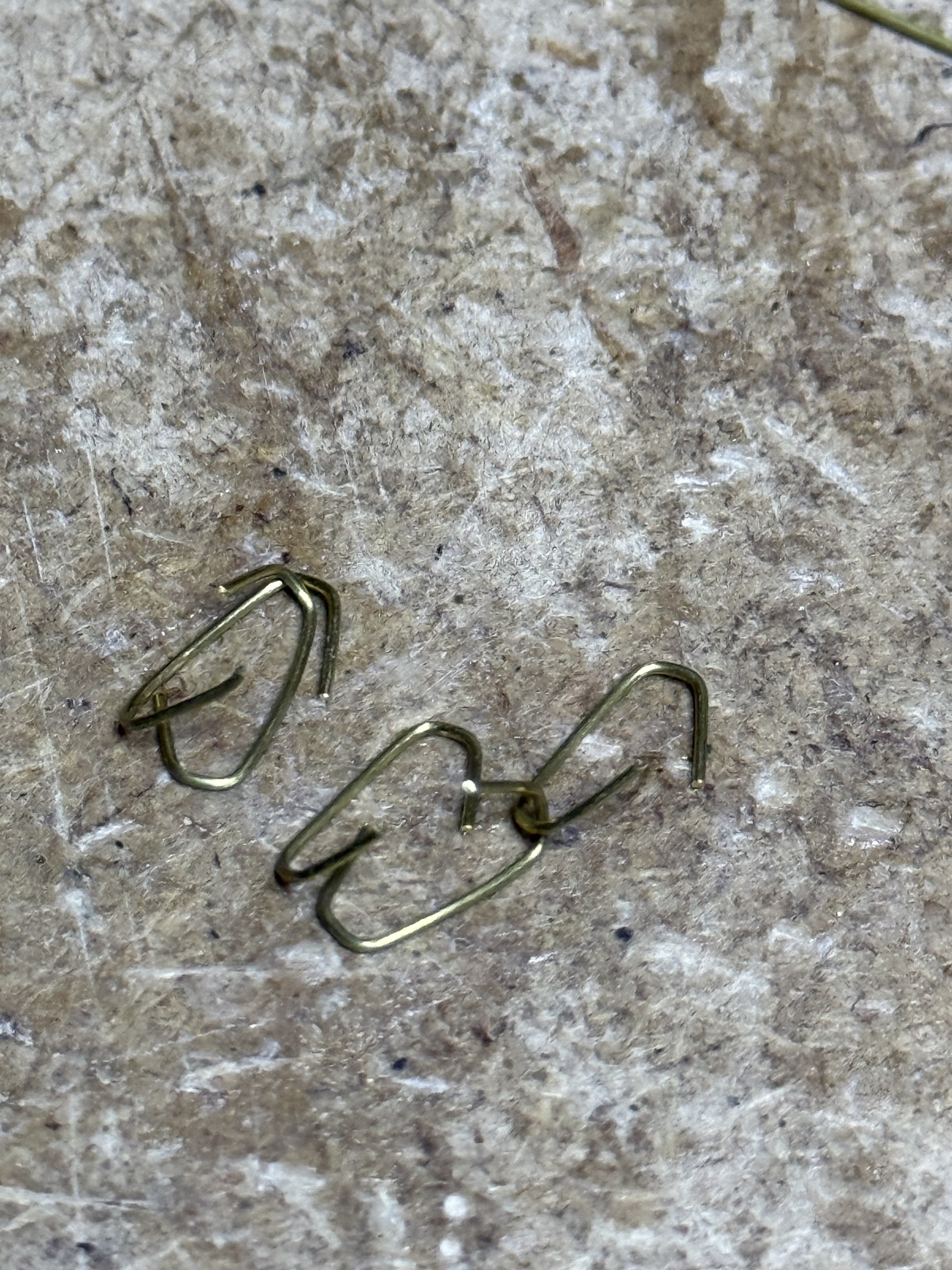

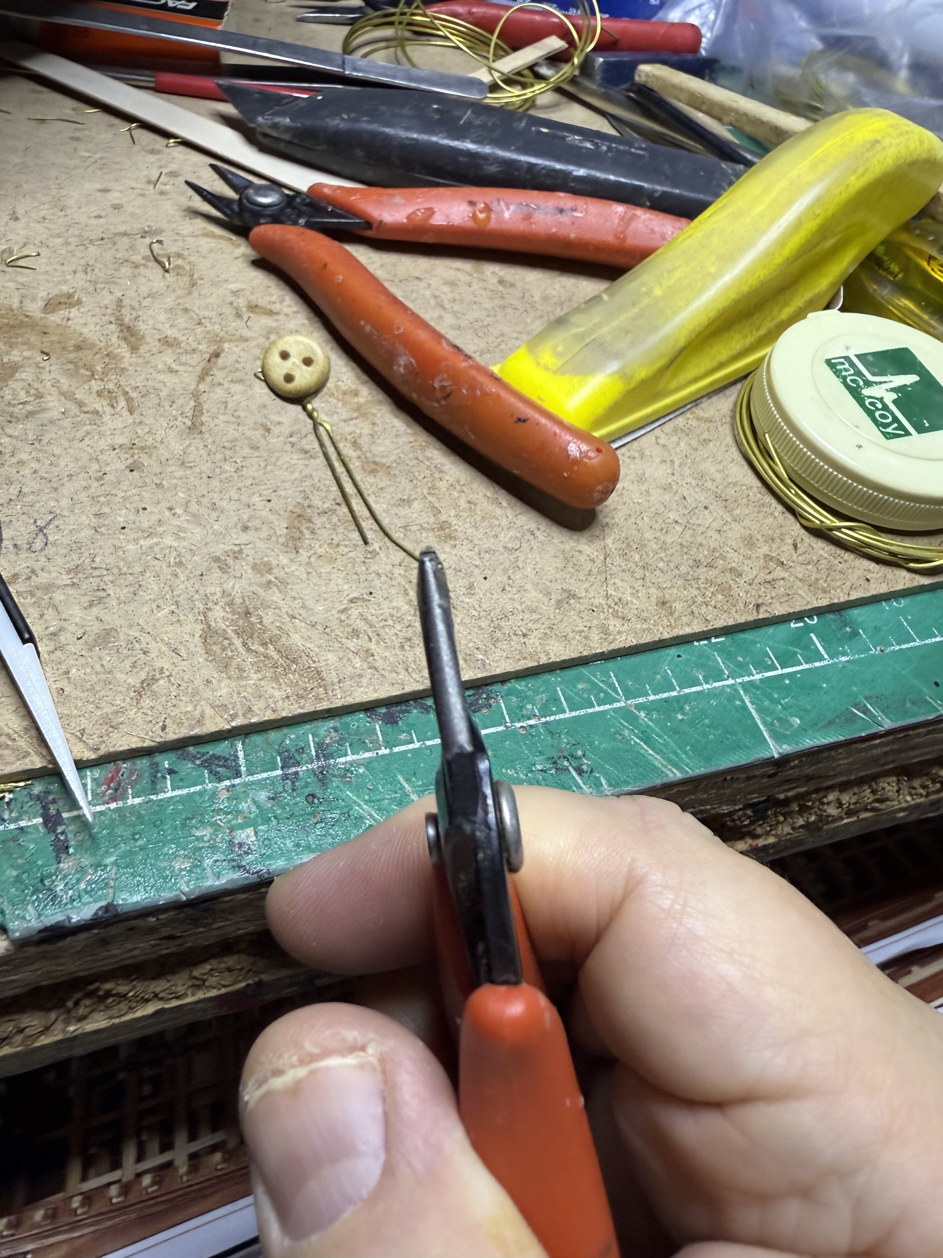

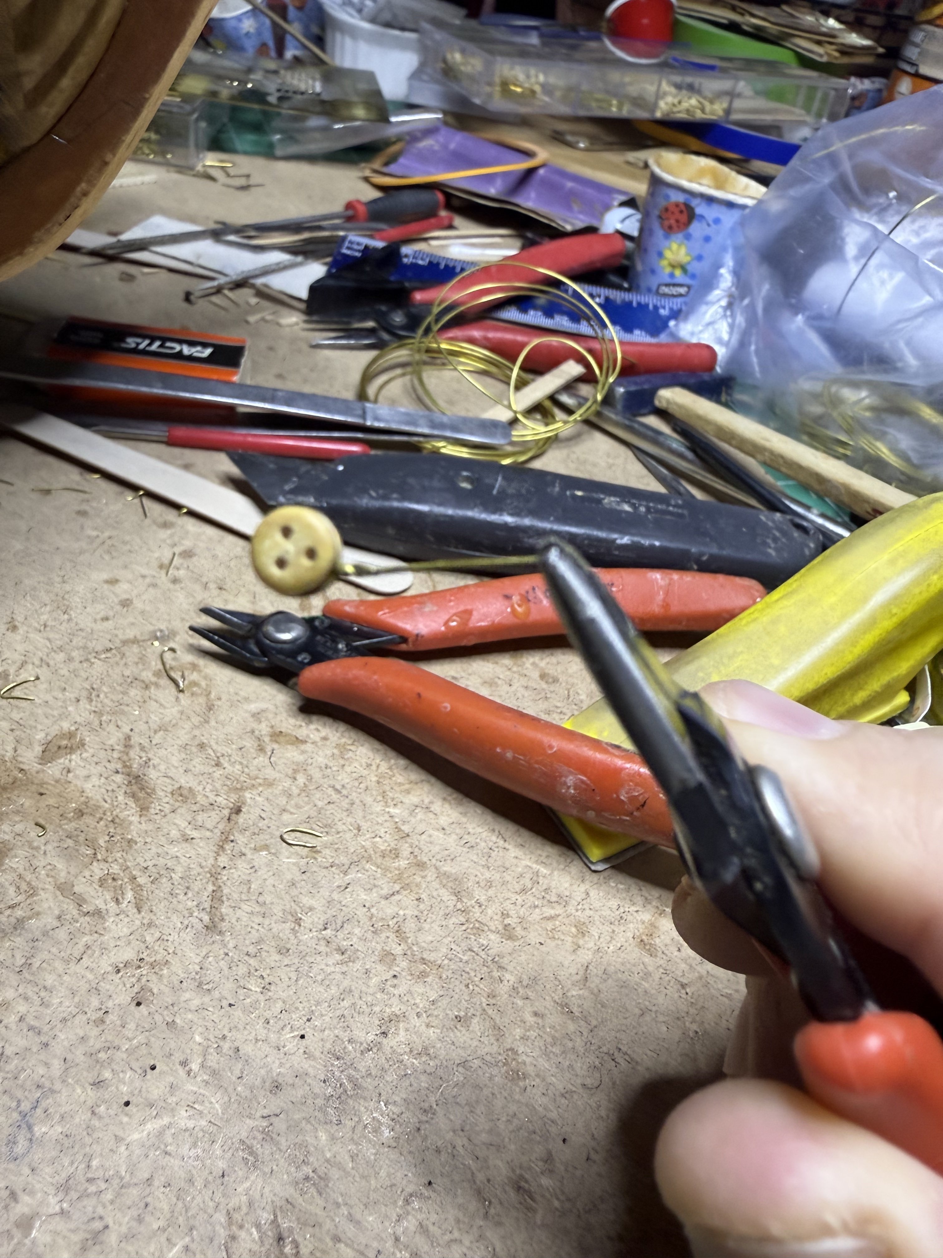

To form the links I wrapped wire around a 10mm board
then cut one side of the spiral
next release them
Linked 2 of them then attached to deadeye and added lower buckle ( a bit of adjustment needed) and mark and predrill hole
IMG_0924.thumb.jpg.c6f48ea9c381bd9750b49280ff6a3796.jpgIMG_0928.thumb.jpg.da8369e9eb5aa61af5816690c2cc49a4.jpg
For the backstays no buckle are used
*IMG_0925.thumb.jpg.a5a50f8383f29e84593df3791a0ed012.jpgIMG_0926.thumb.jpg.6067913fd52ada1caef52b410c79e8dc.jpg

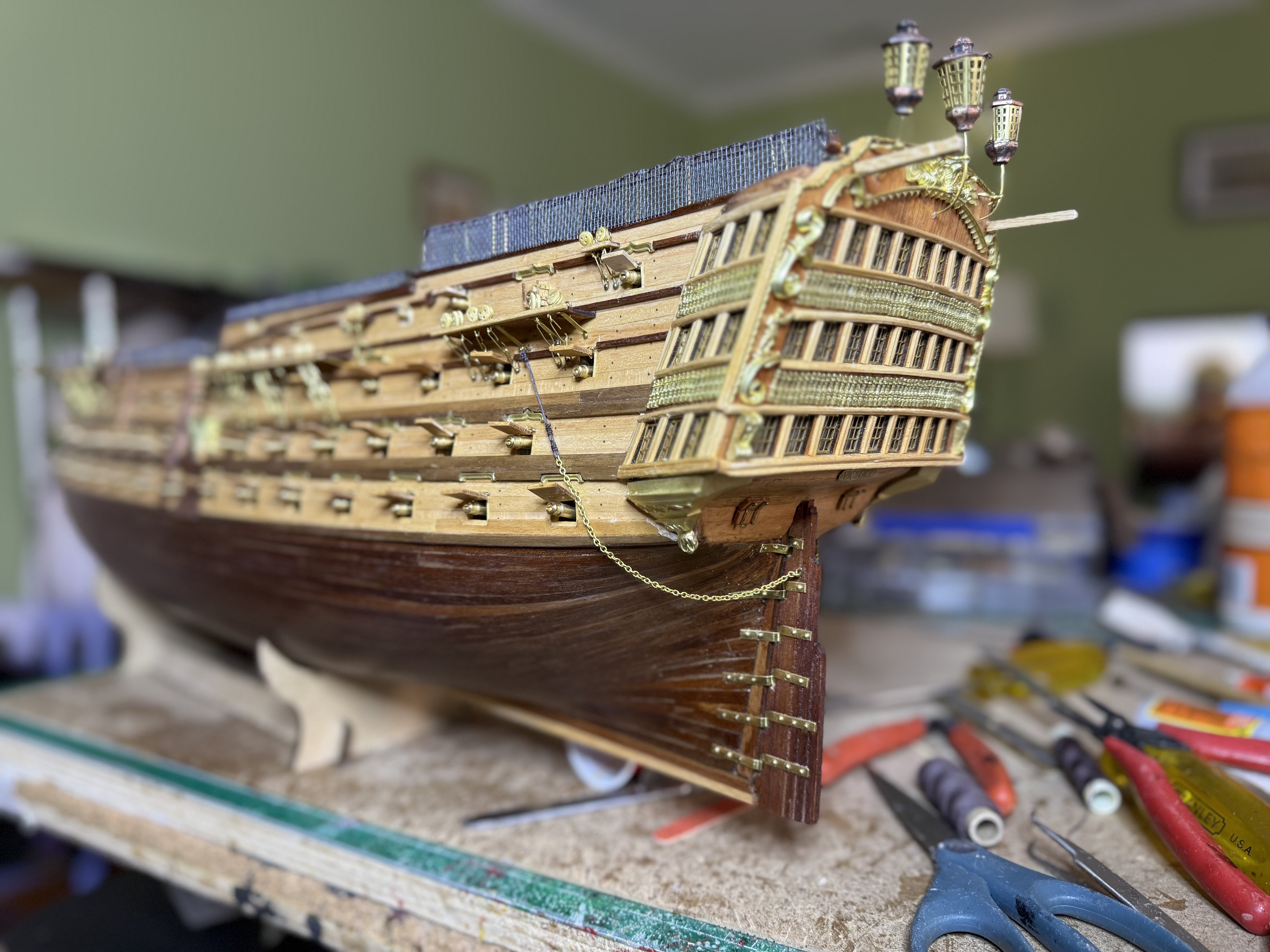

Here is the completed work
IMG_0930.thumb.jpg.6cc170b65098ea547115370fa25d796f.jpgIMG_0929.thumb.jpg.2689e860801add547768f09702dc3f70.jpgIMG_0927.thumb.jpg.4aea9b01e8b358b56b8f0d0930112378.jpg

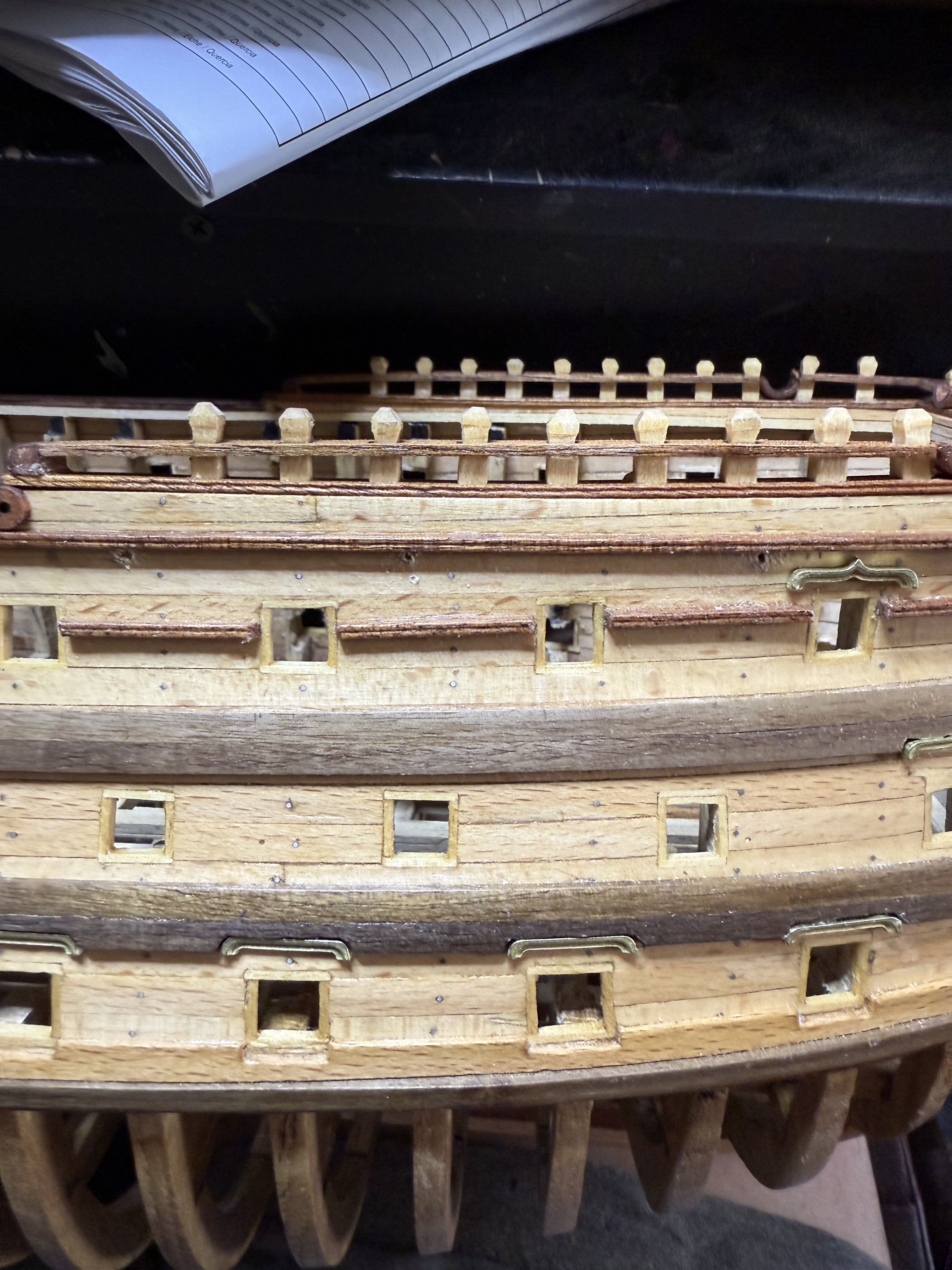

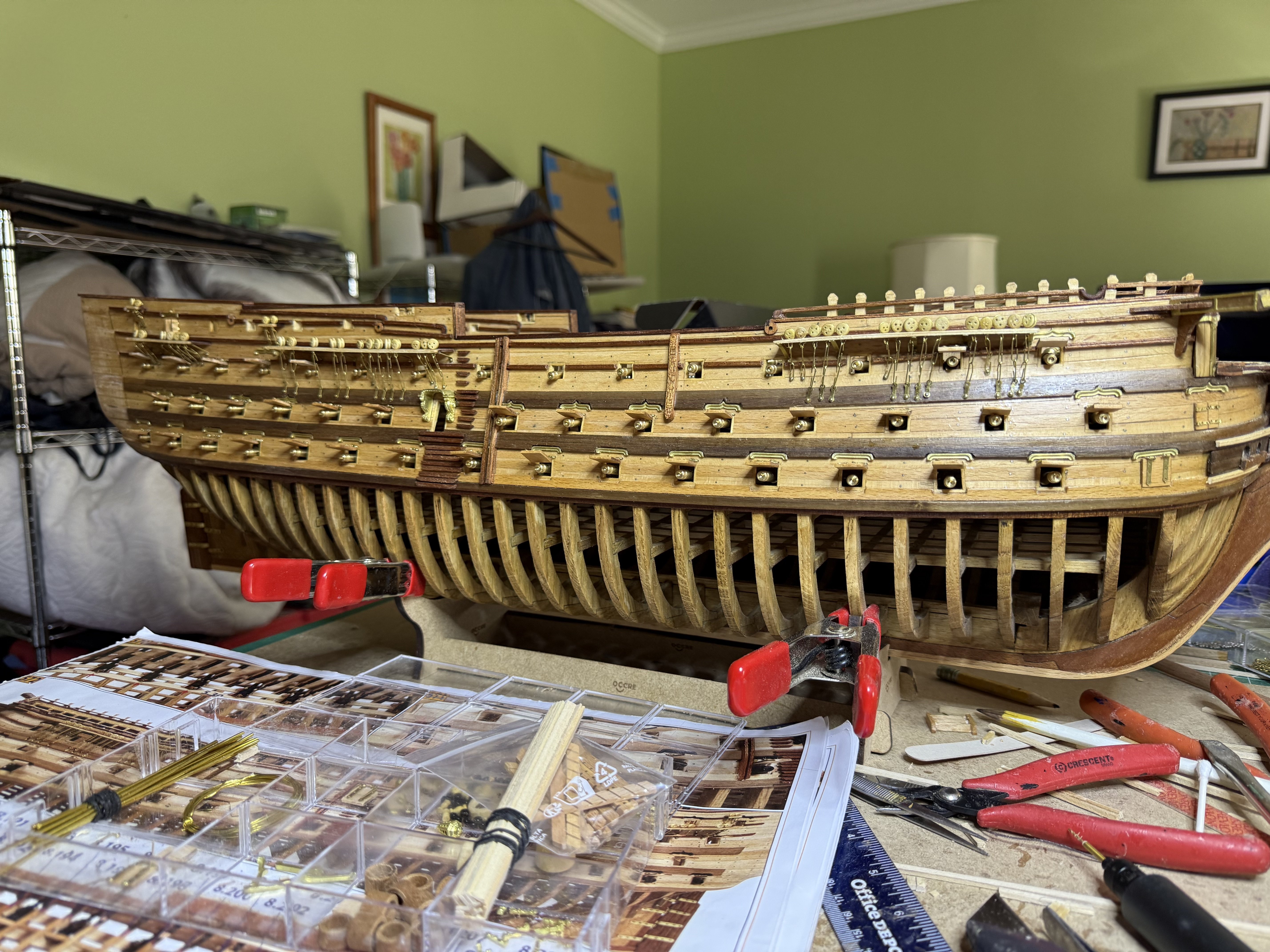

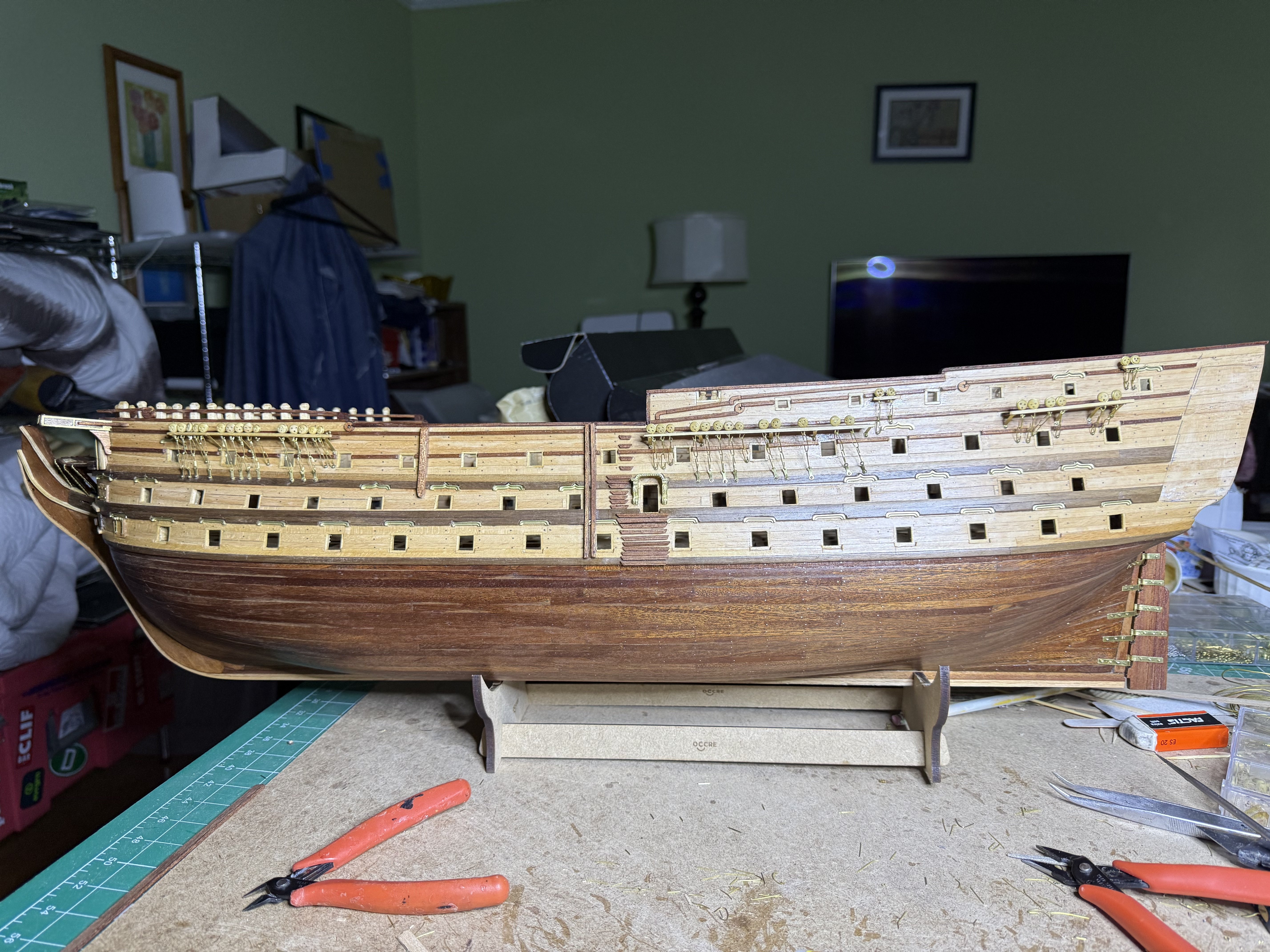

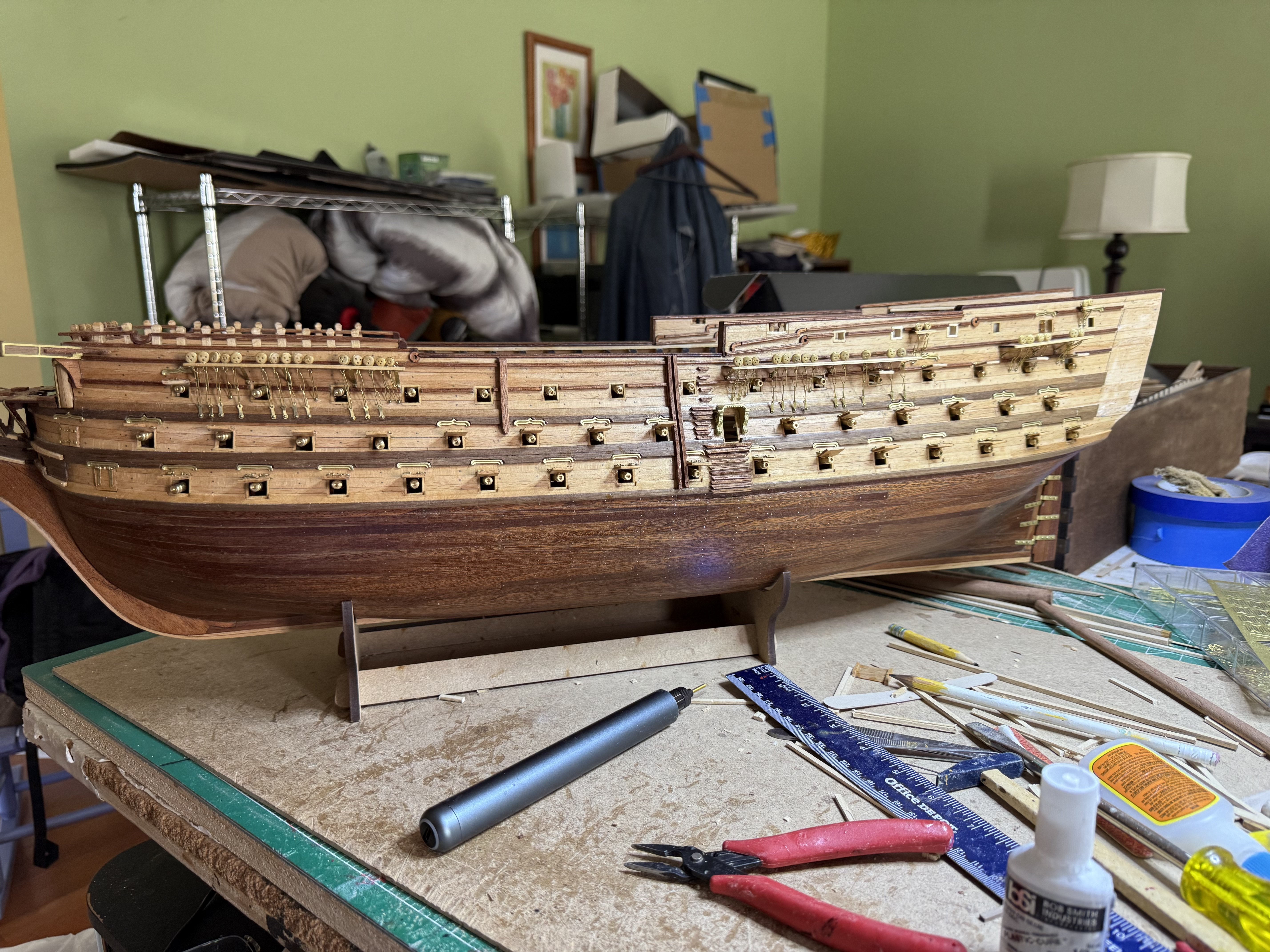

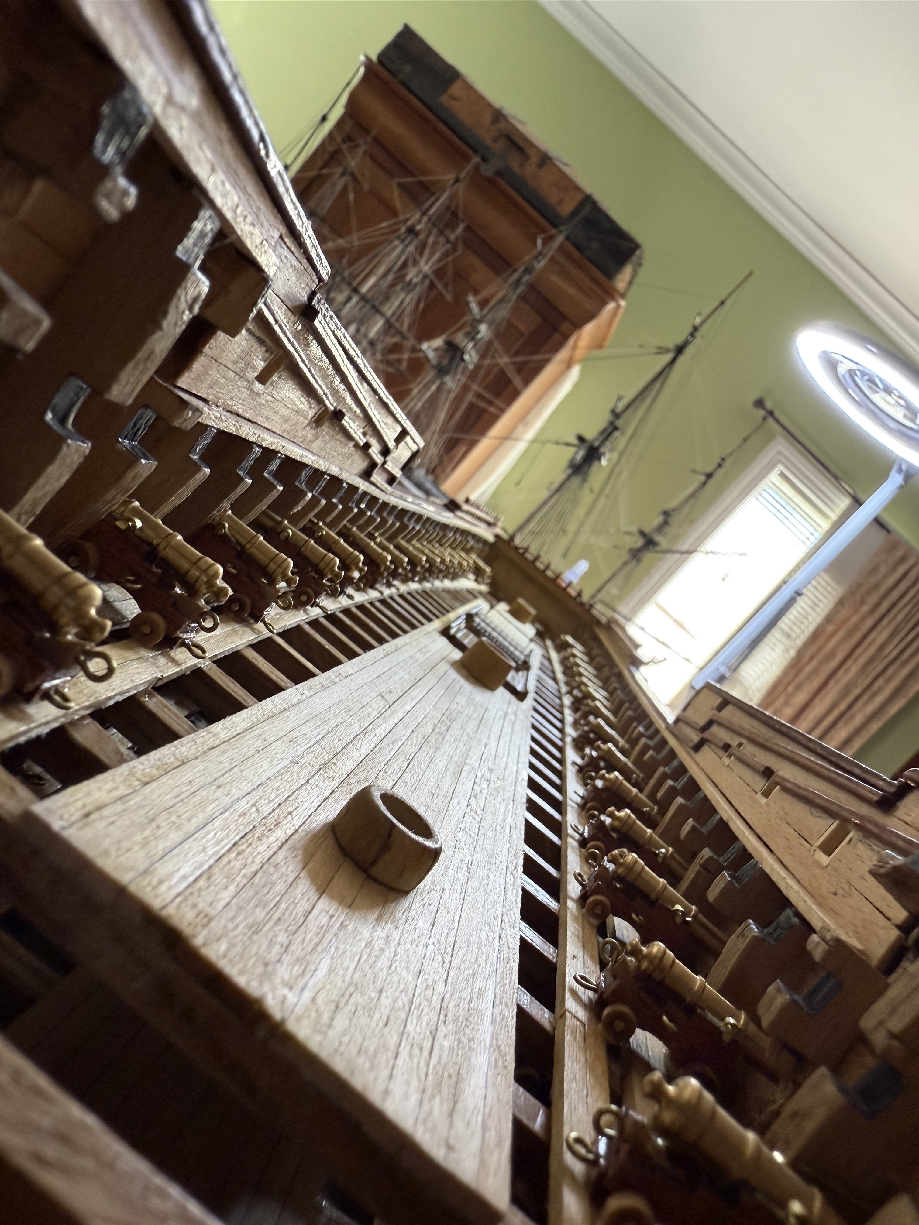

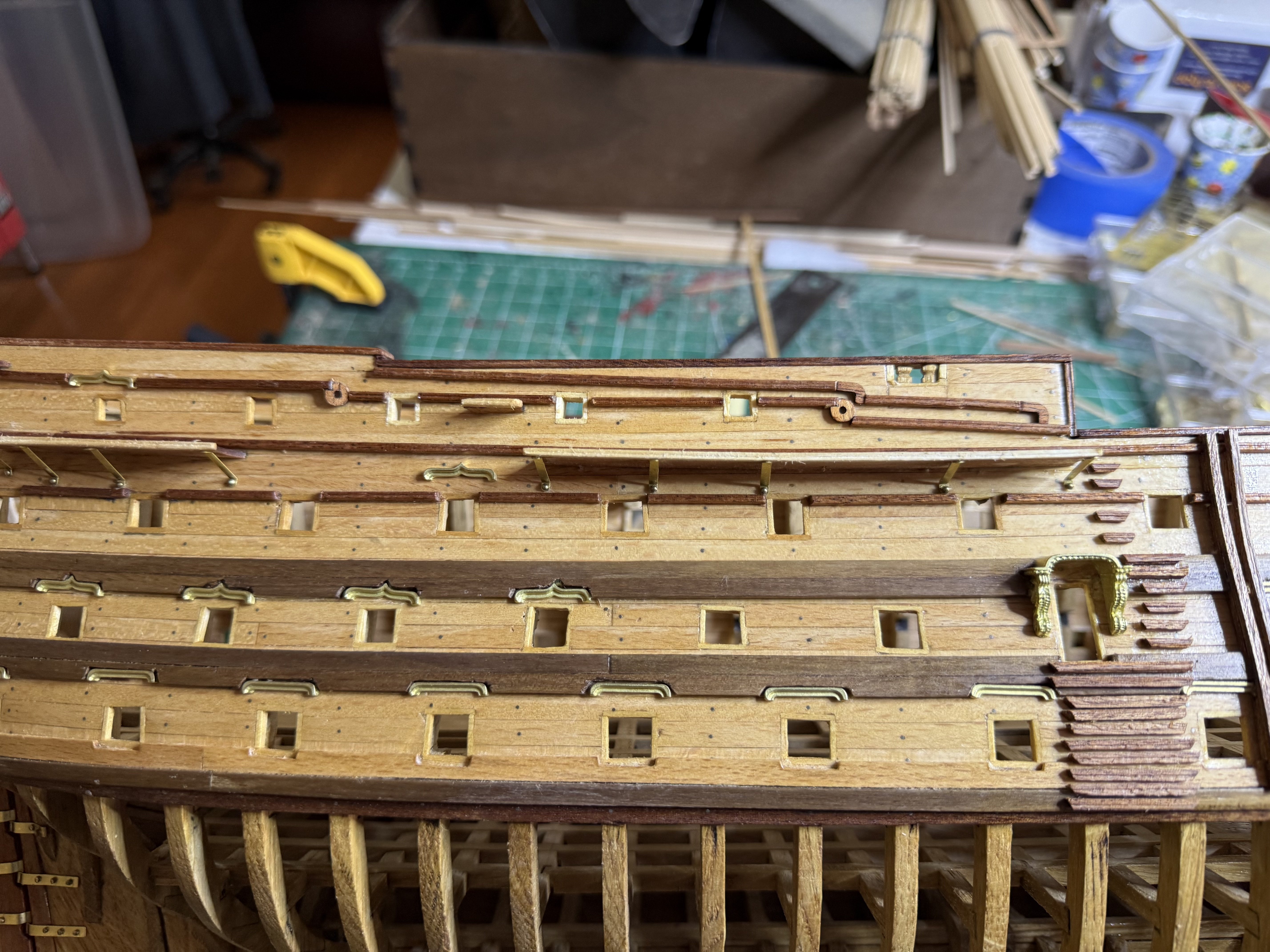

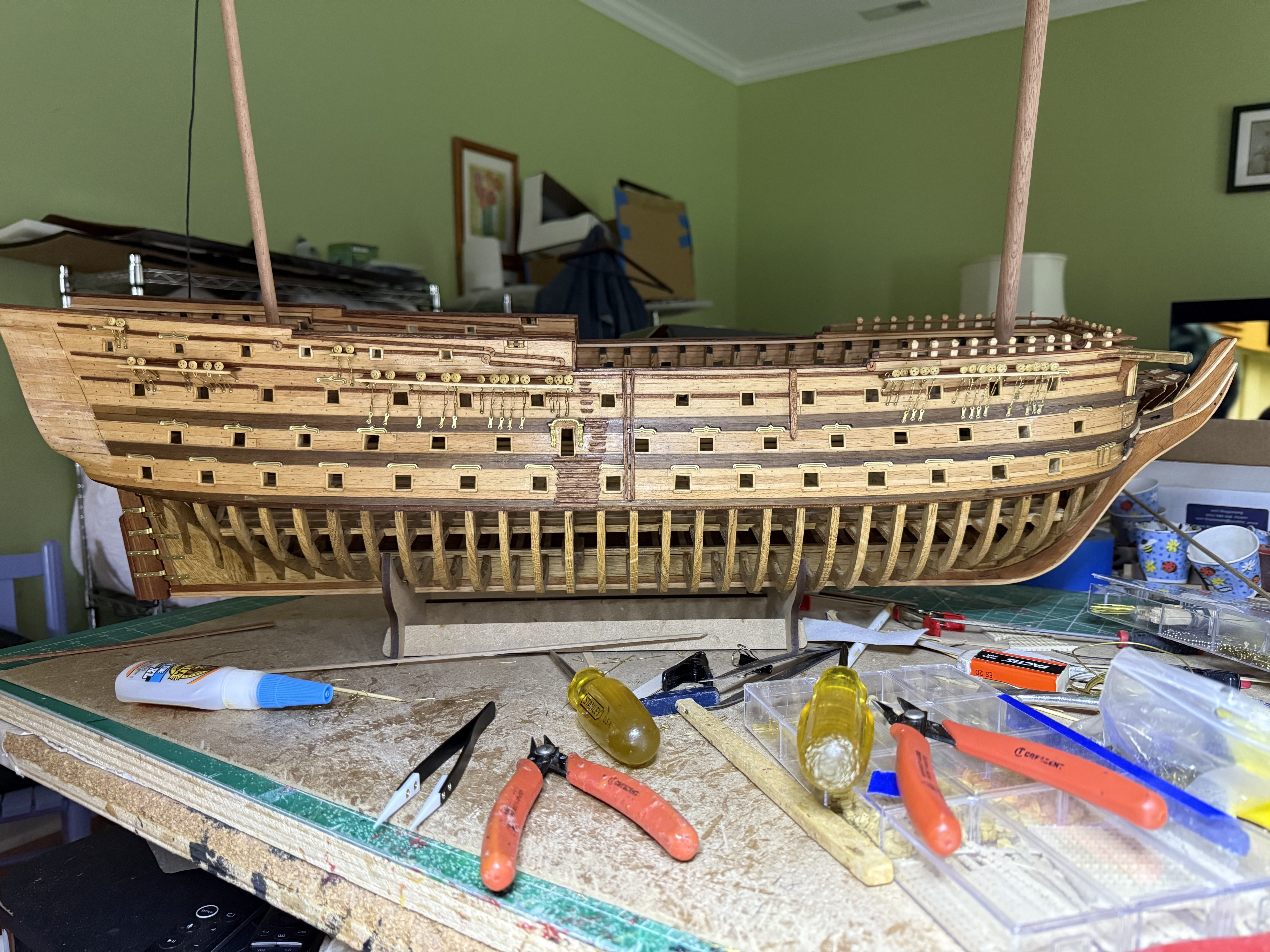

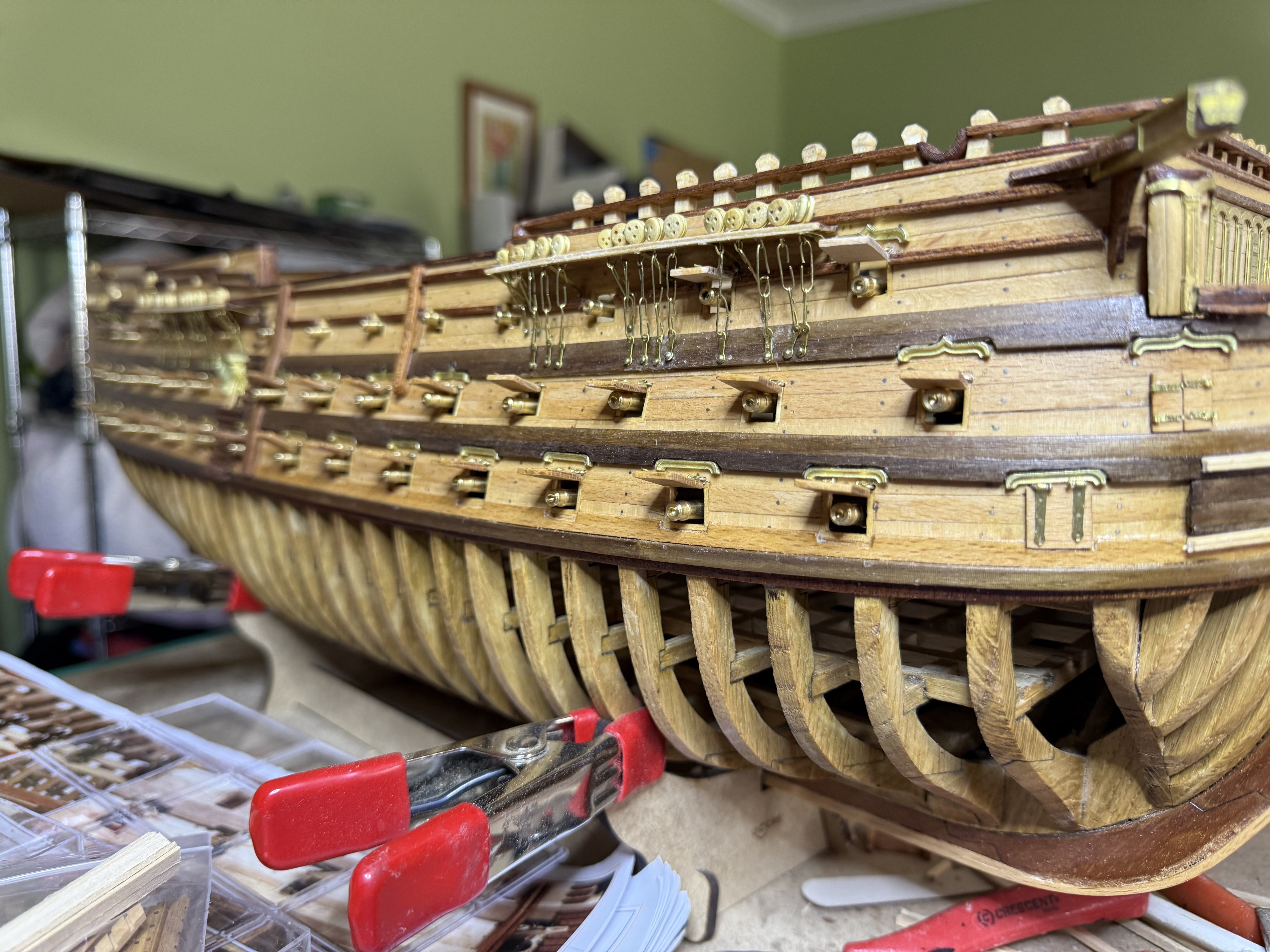

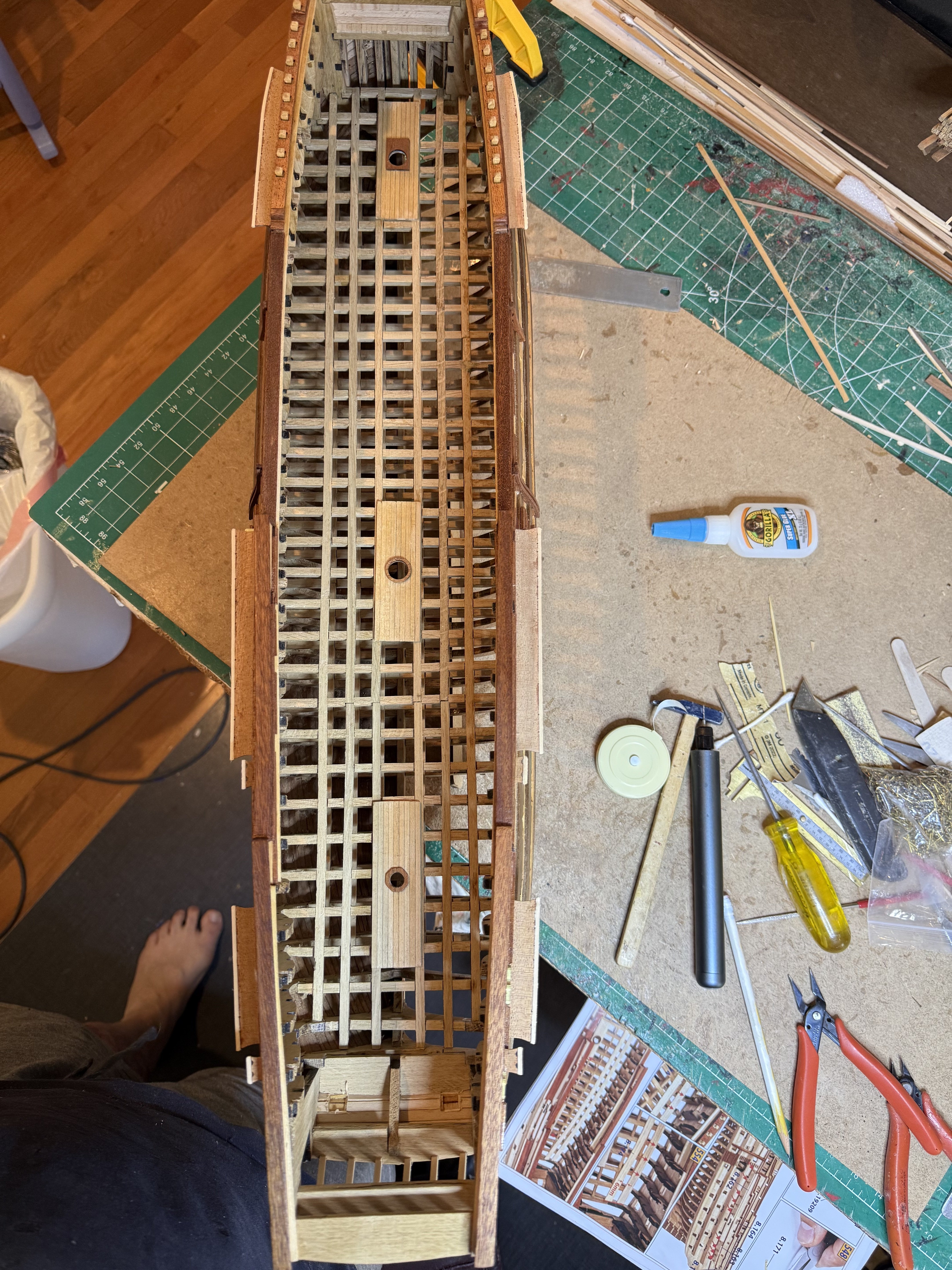

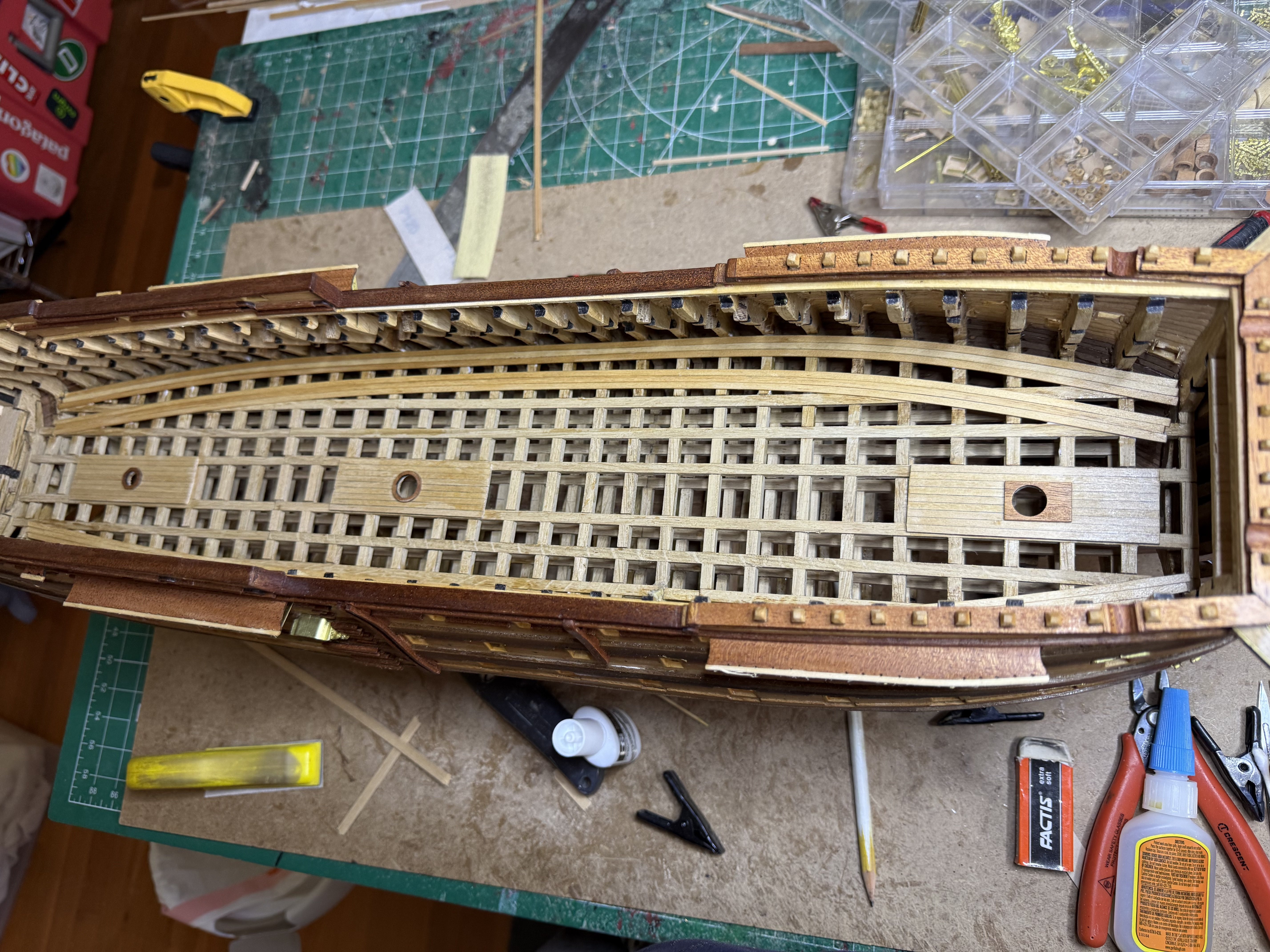

 A lot of work over the week so far. First the lower gundeck ports fixed into place
IMG_0968.thumb.jpg.e592a9793e58e5b58861fcbdfb47003a.jpgIMG_0967.thumb.jpg.4f5814fd1e7a6f4f8c1cd28a820fc3da.jpg

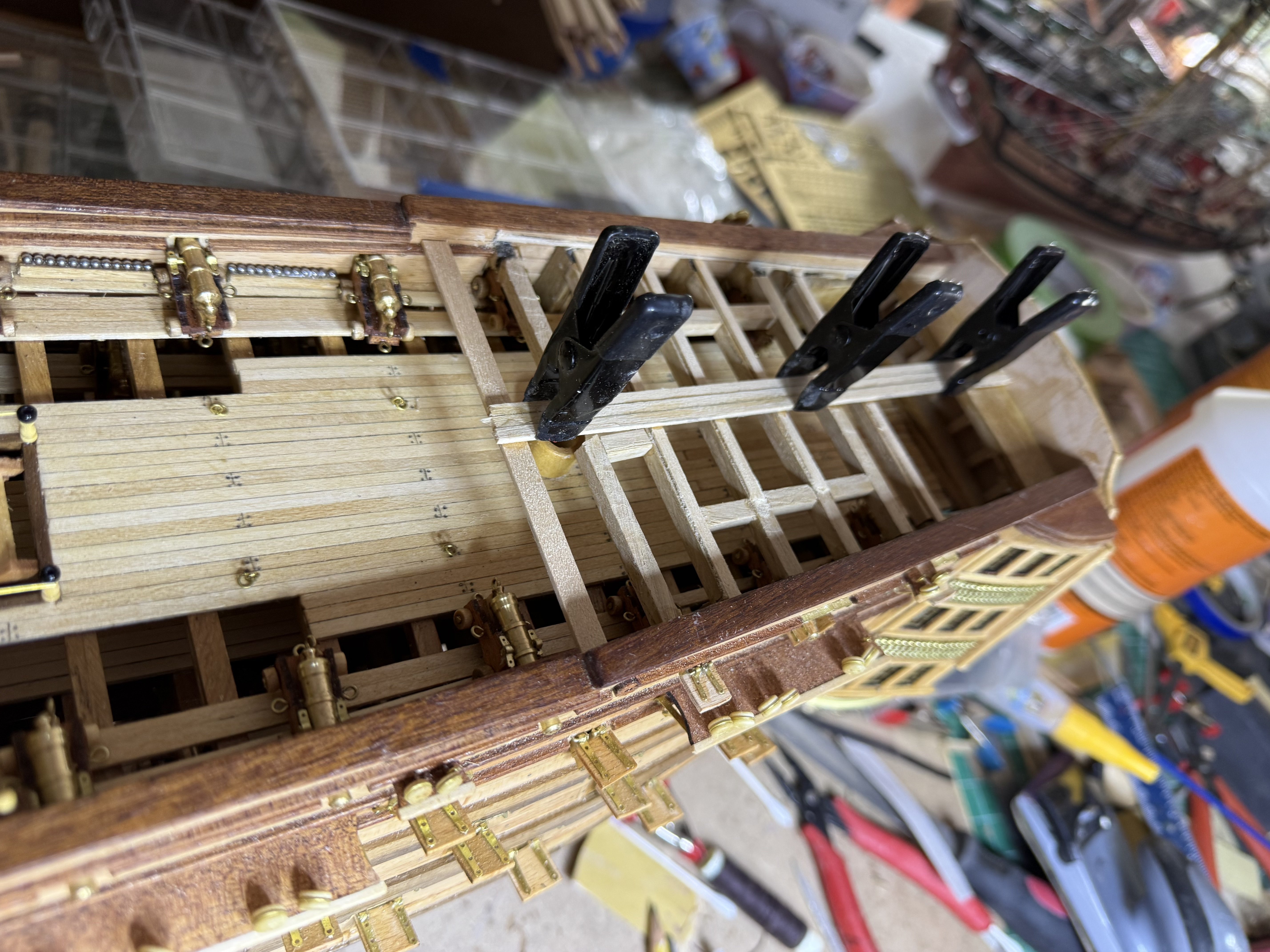

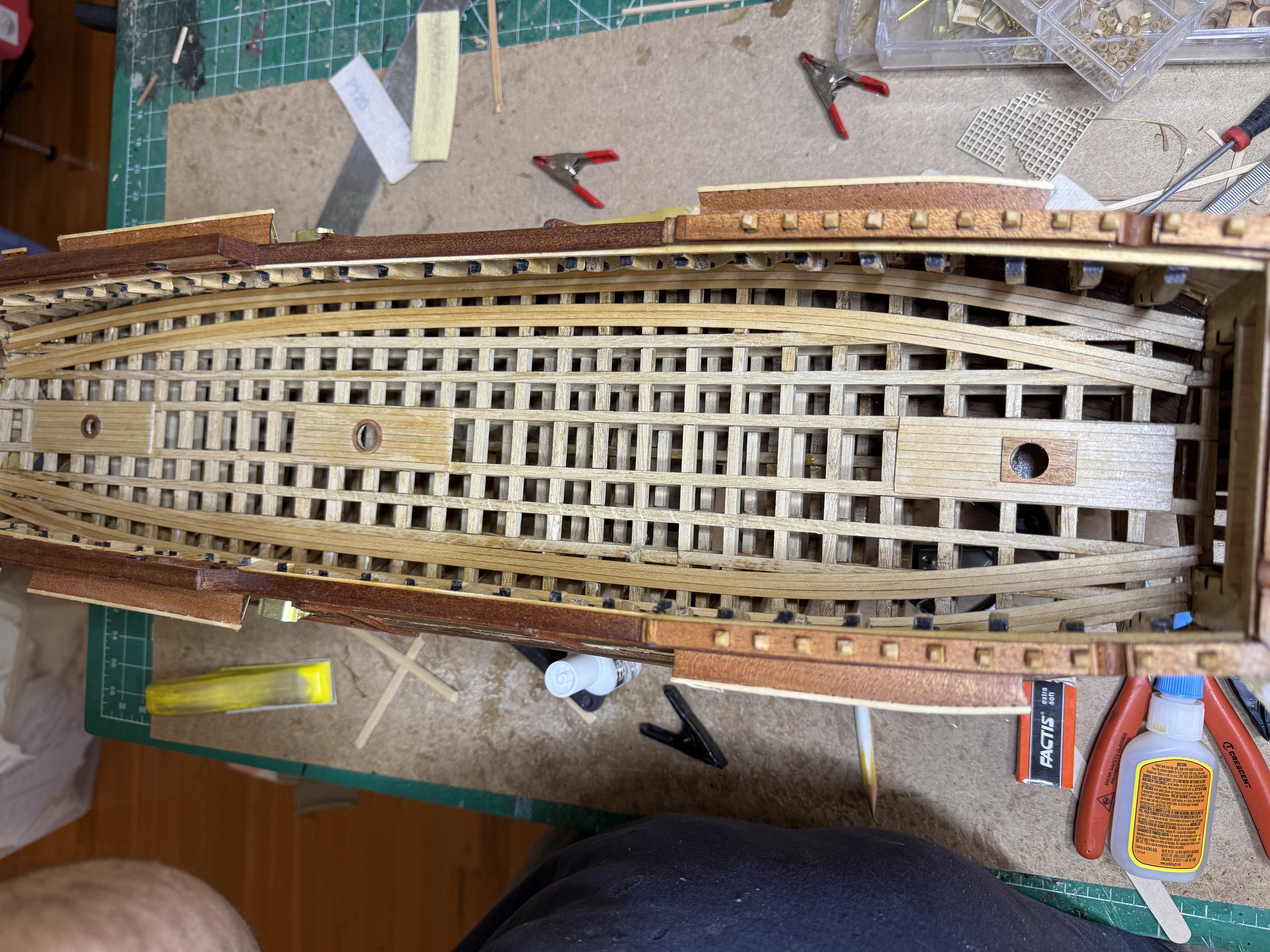

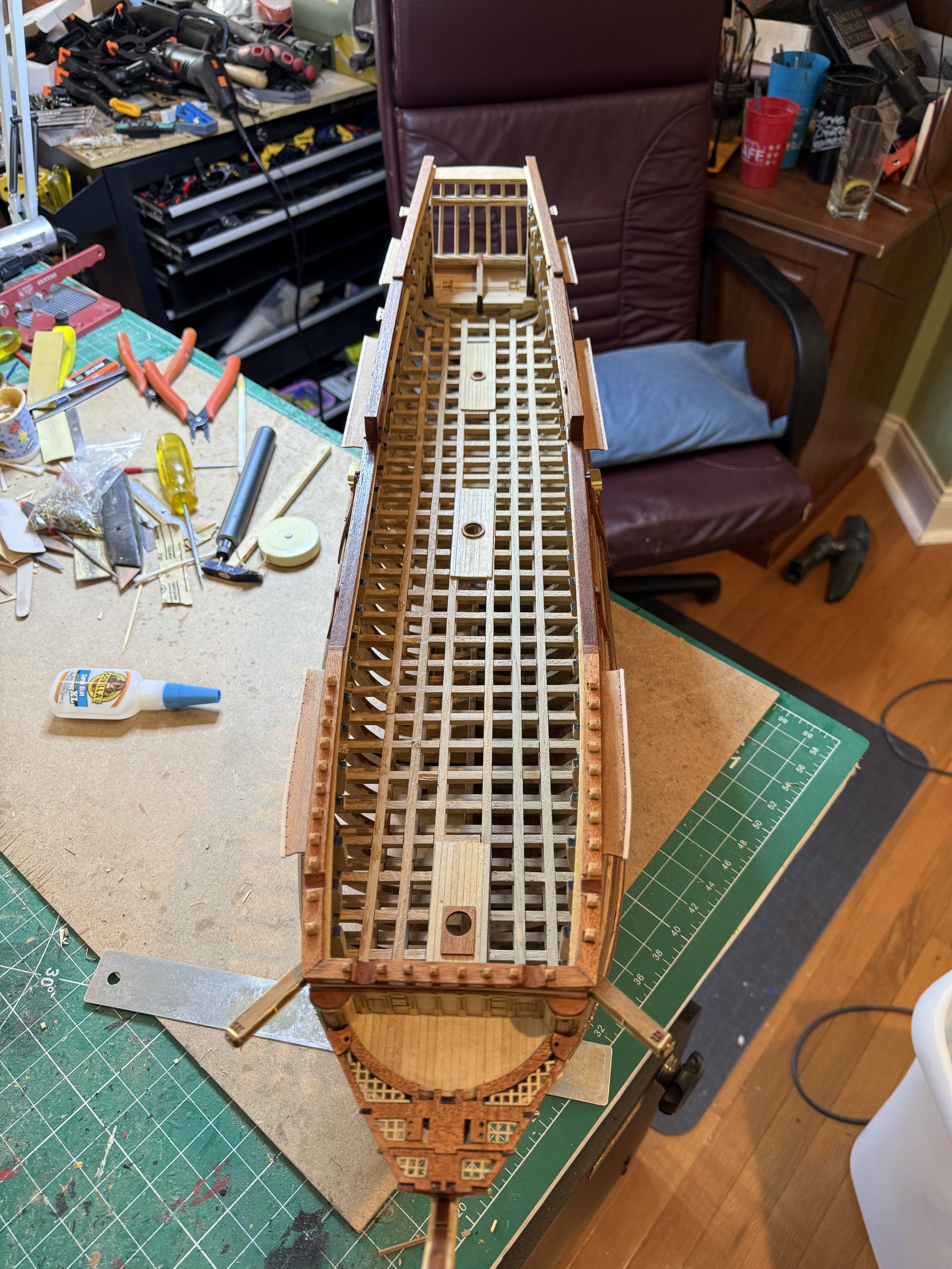

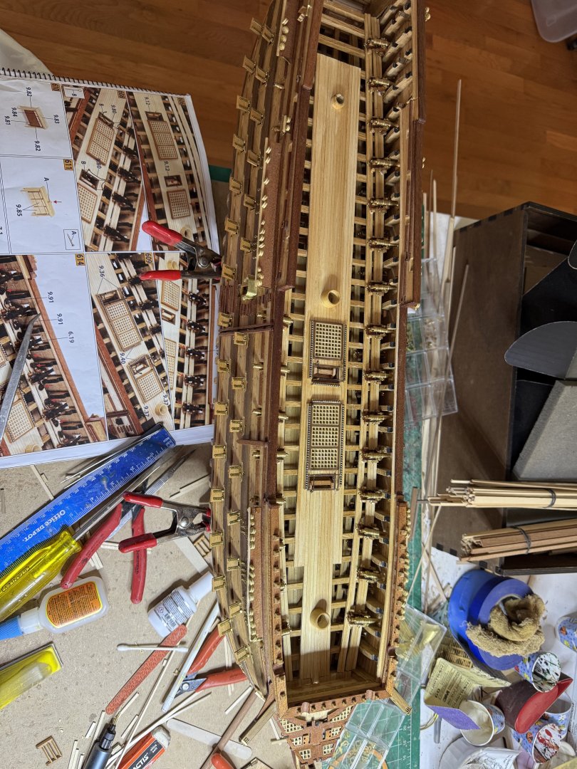

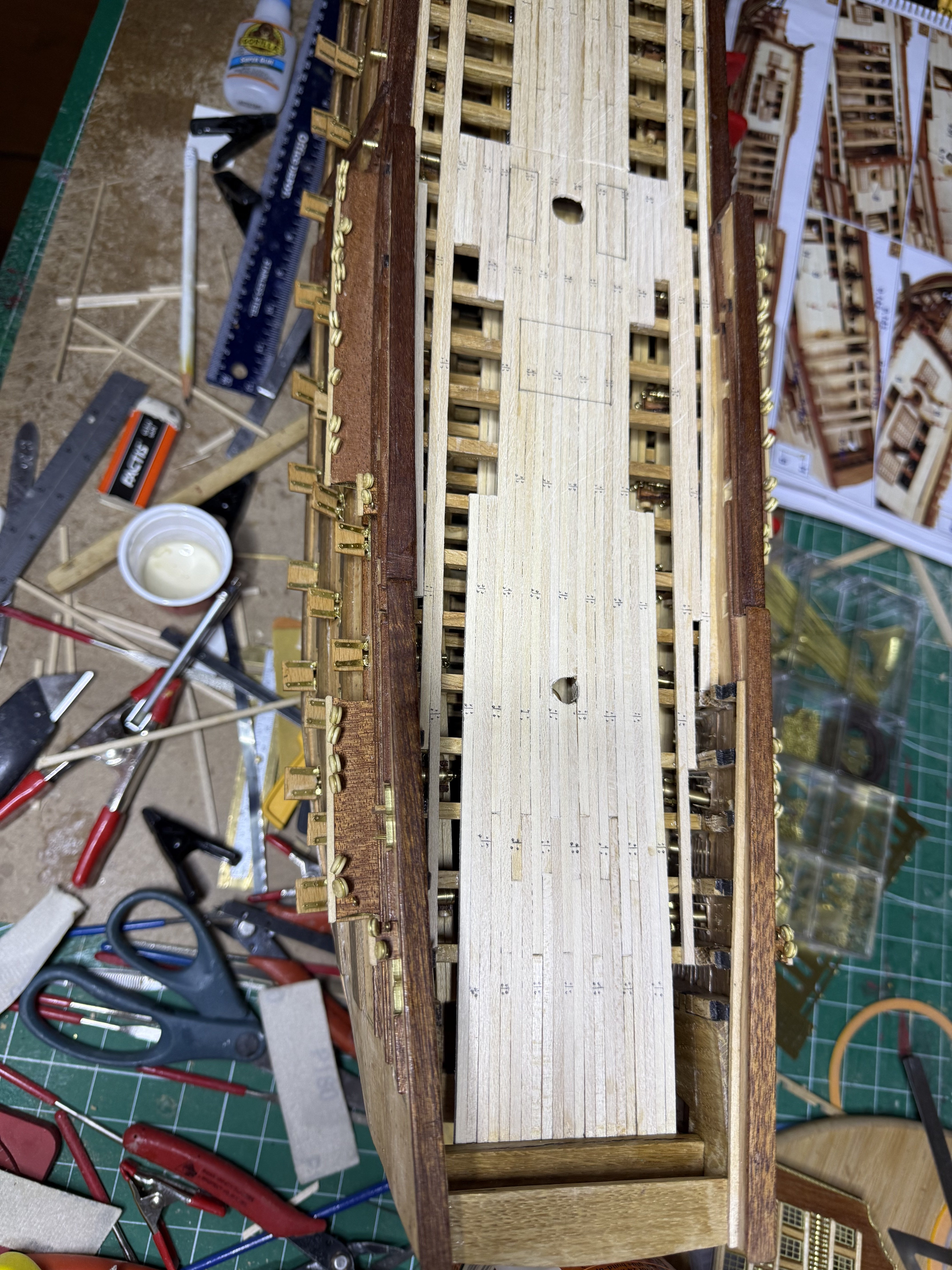

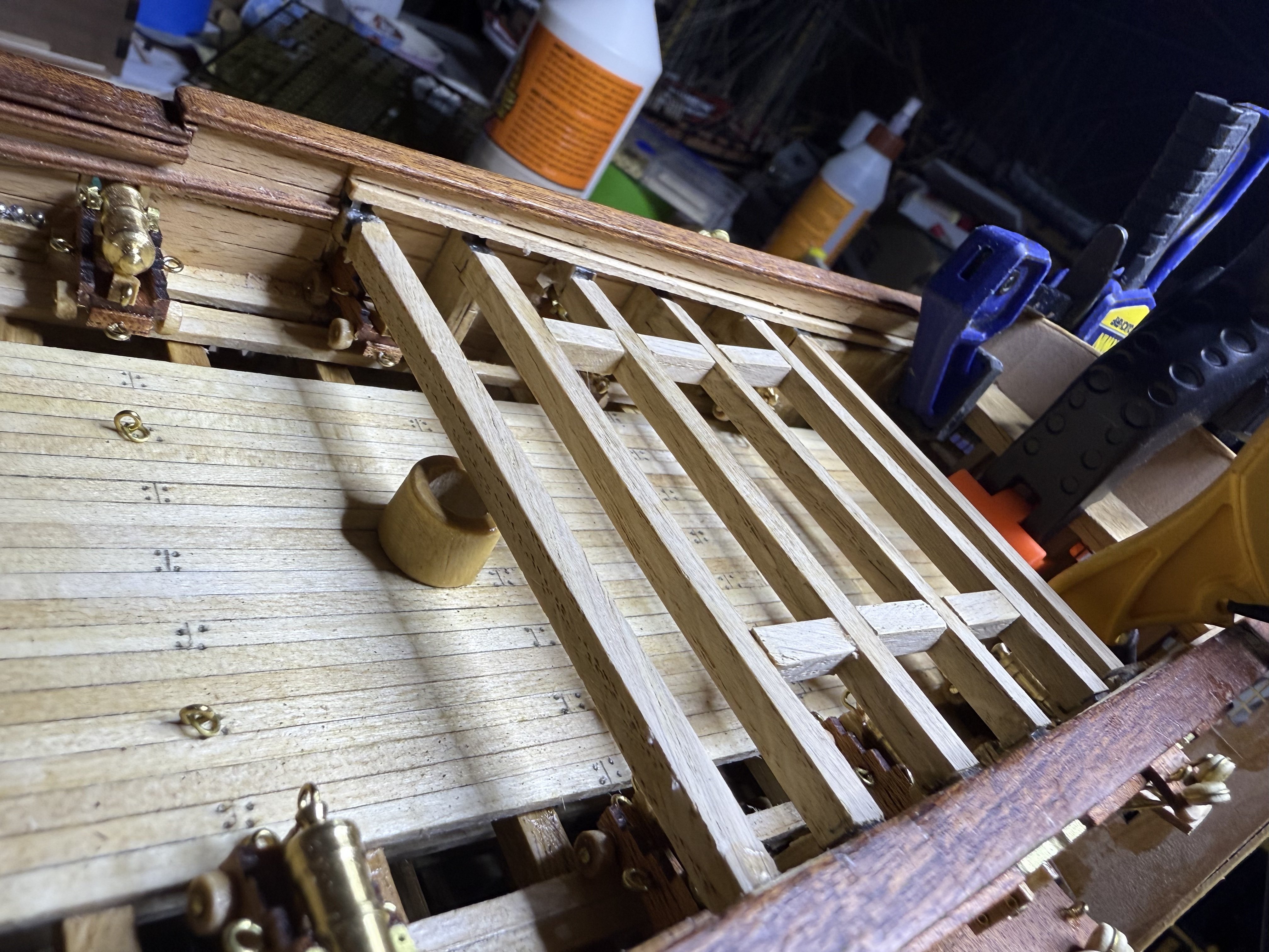

Next the second lowest gundeck  beams added
IMG_0936.thumb.jpg.22e339c50d42a8d0f781fa6a90313c75.jpgIMG_0963.thumb.jpg.8a5677bba87d8d1a686d7e5fa500caba.jpgIMG_0964.thumb.jpg.d6c2f6fd82e47f5f98ce5acf9374b25b.jpg
Followed by partial planking

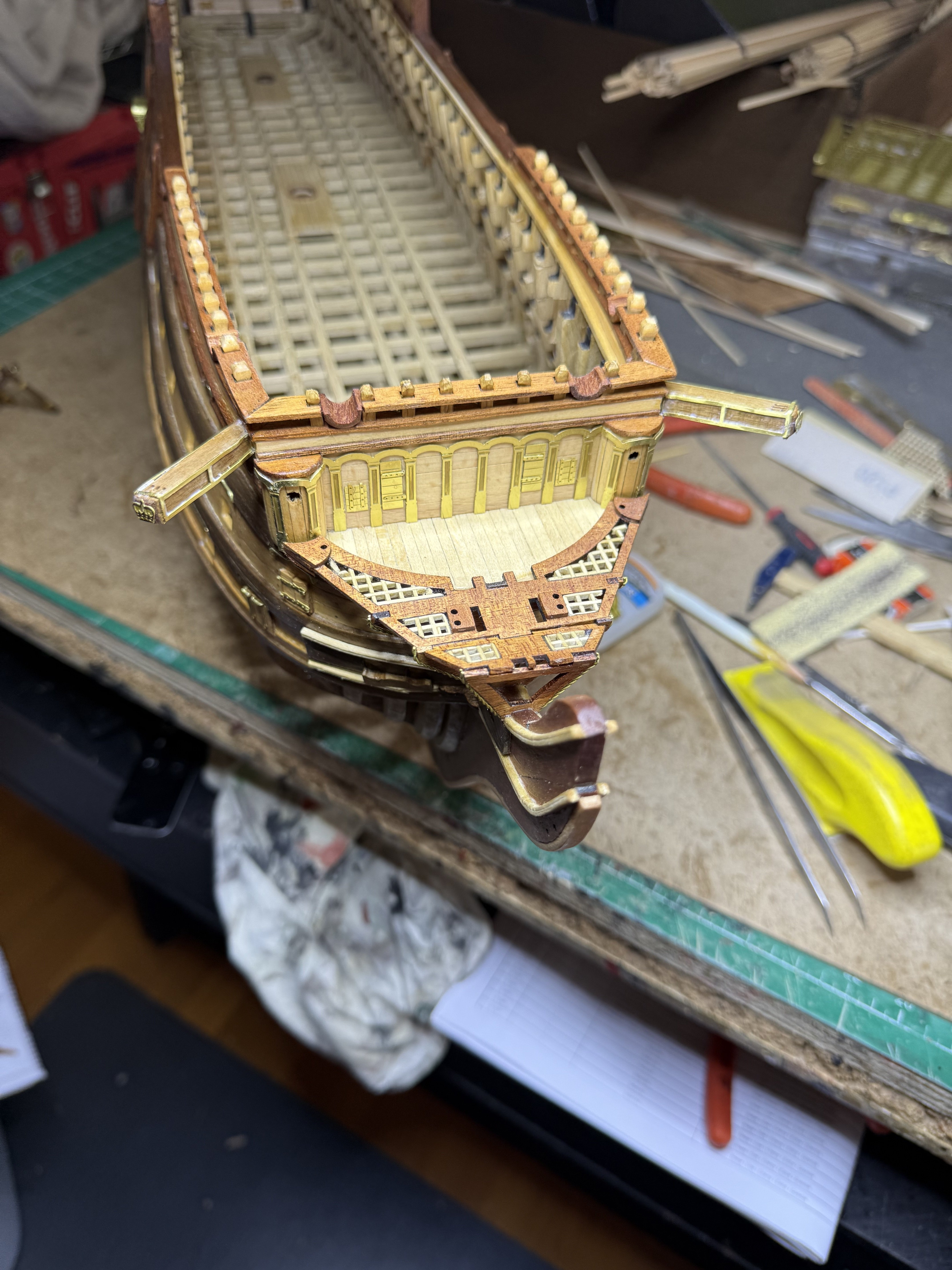

Next the bowsprit opened up.
IMG_0969.thumb.jpg.6d00508948b6b5a2acba2149cfc932ad.jpgIMG_0970.thumb.jpg.1cc4da34af209609654a18afb7938211.jpgIMG_0971.thumb.jpg.413c6095ce263f6ef7e595f7276e4913.jpg

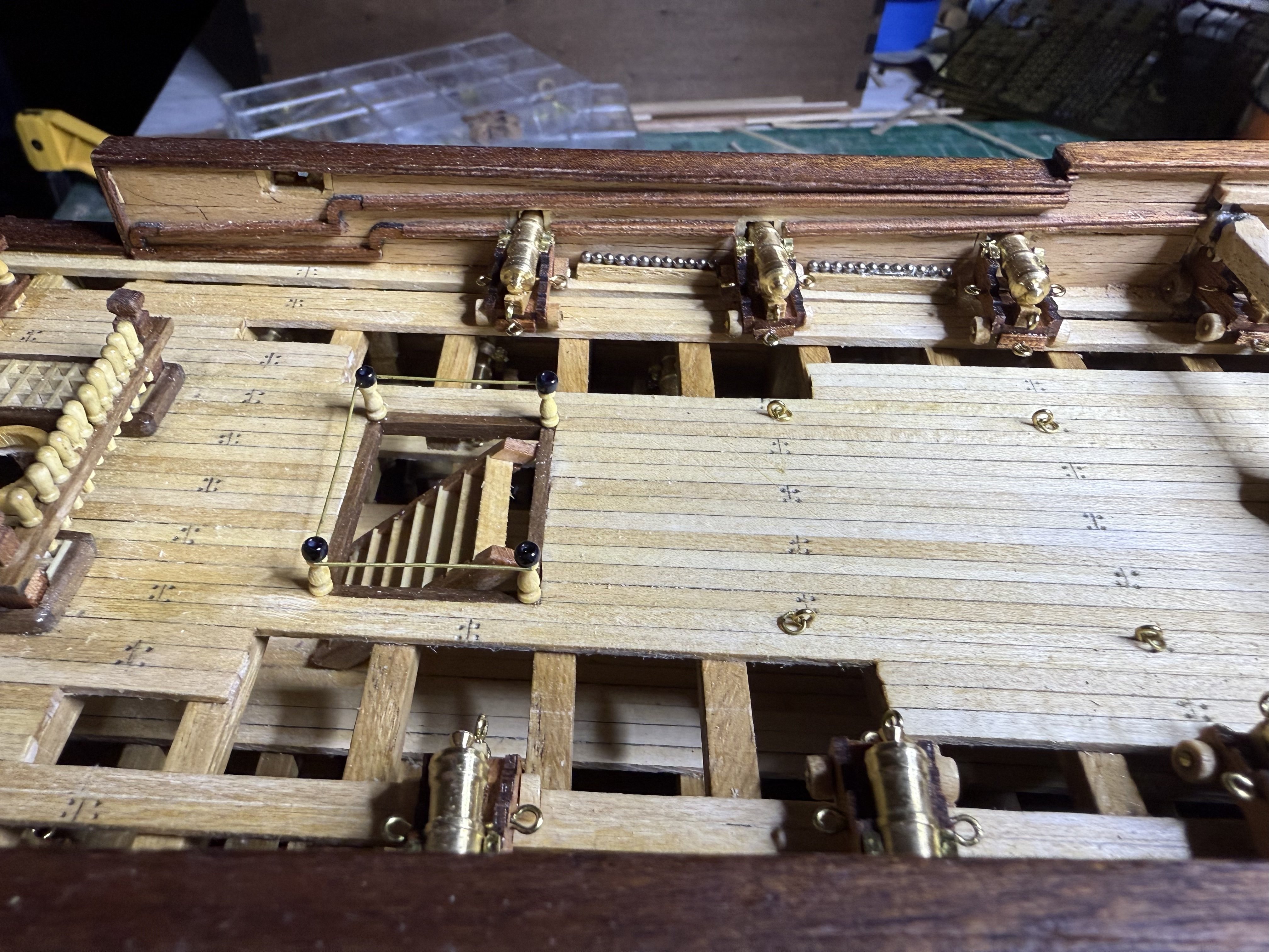

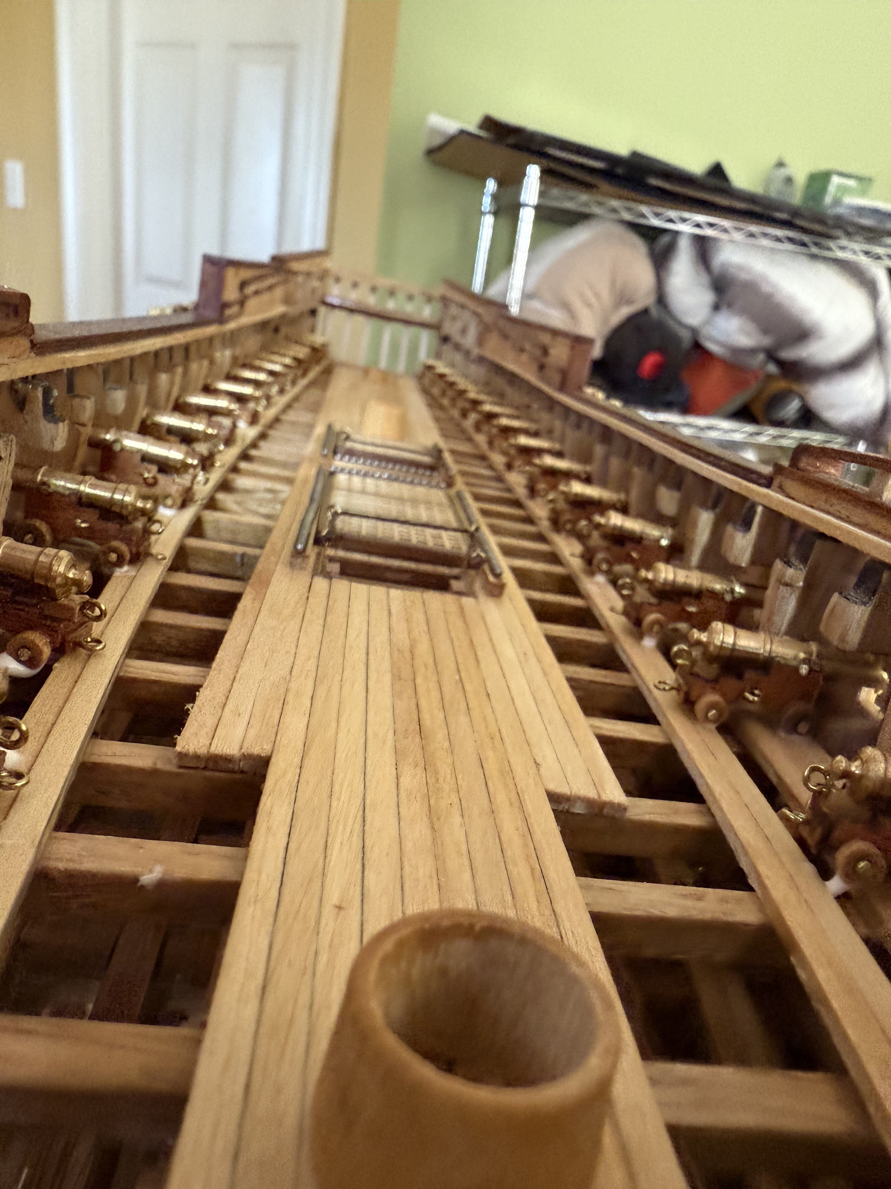

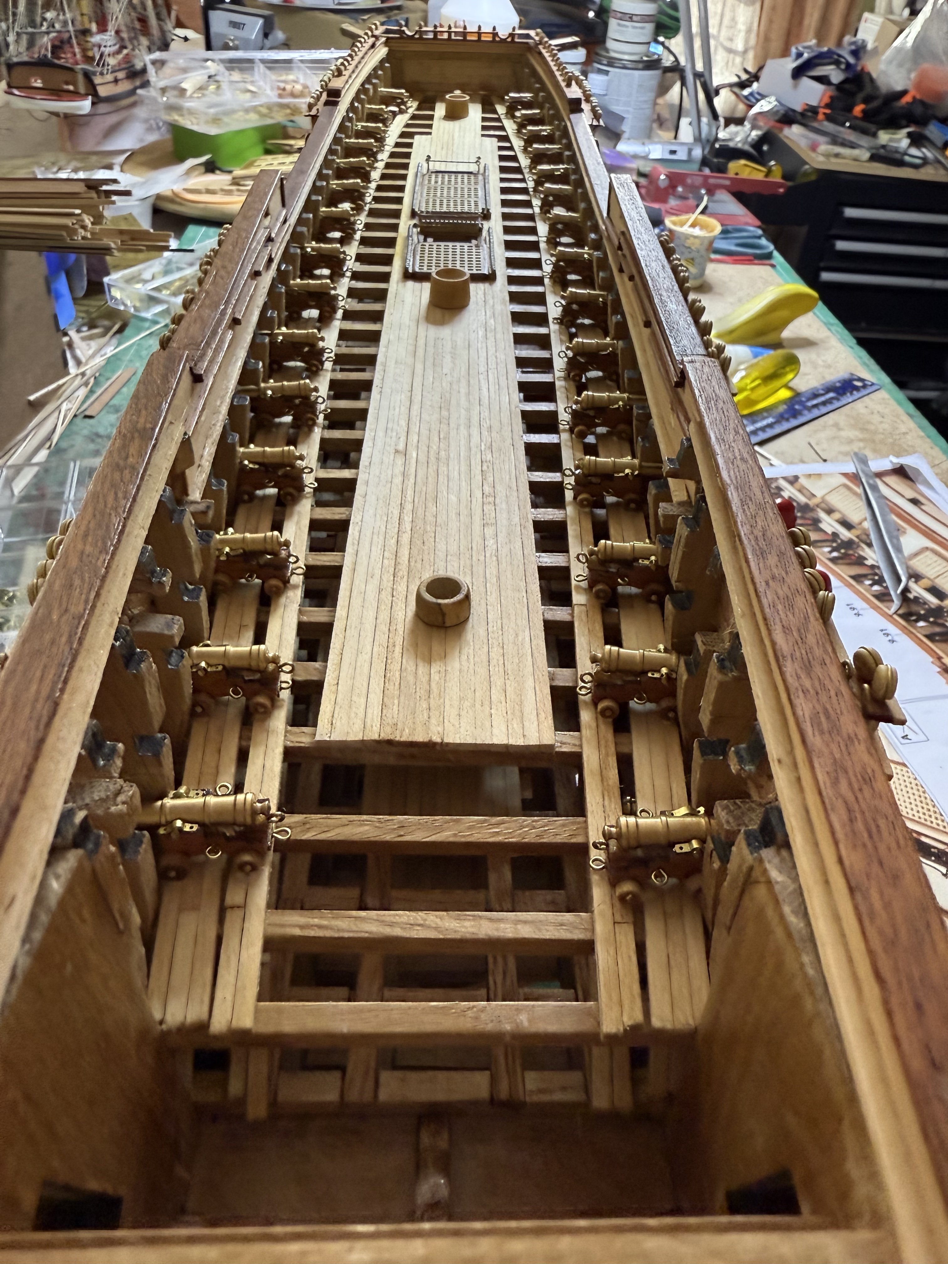

Guns added next
IMG_0973.thumb.jpg.cb09e3a5cd971fdbb81bc86eff8fb85e.jpgIMG_0972.thumb.jpg.a048852aa85d5769c6160d985c14ea13.jpg
Then the gunport lids
IMG_0976.thumb.jpg.fa8838a47638fb6258c2b51c48fcb334.jpgIMG_0978.thumb.jpg.0f30fad18108f3672e73917597194720.jpgIMG_0977.thumb.jpg.a0f7350c379b0a659eaae128449e3eaa.jpgIMG_0979.thumb.jpg.5ed0daf95bcabe281042ffe1bbd88942.jpg

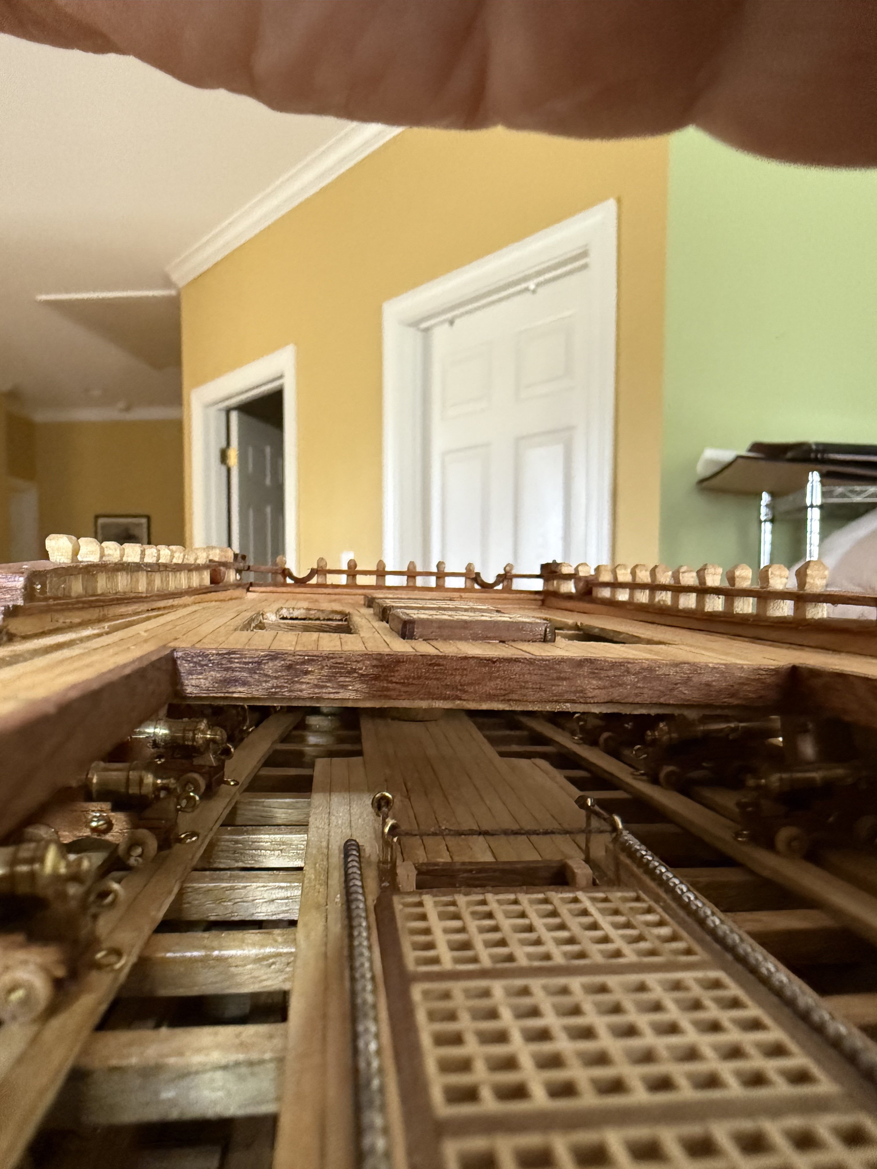

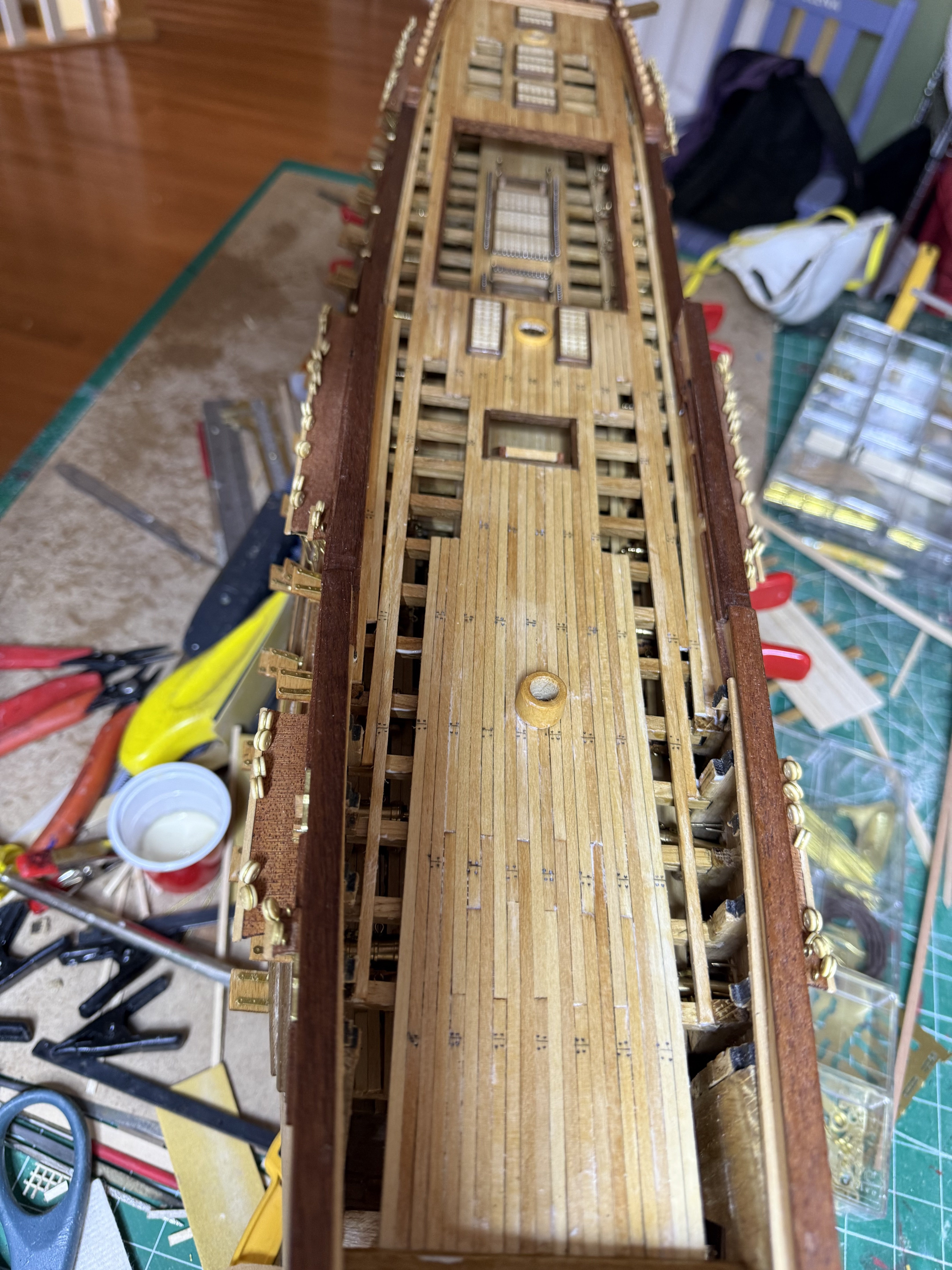

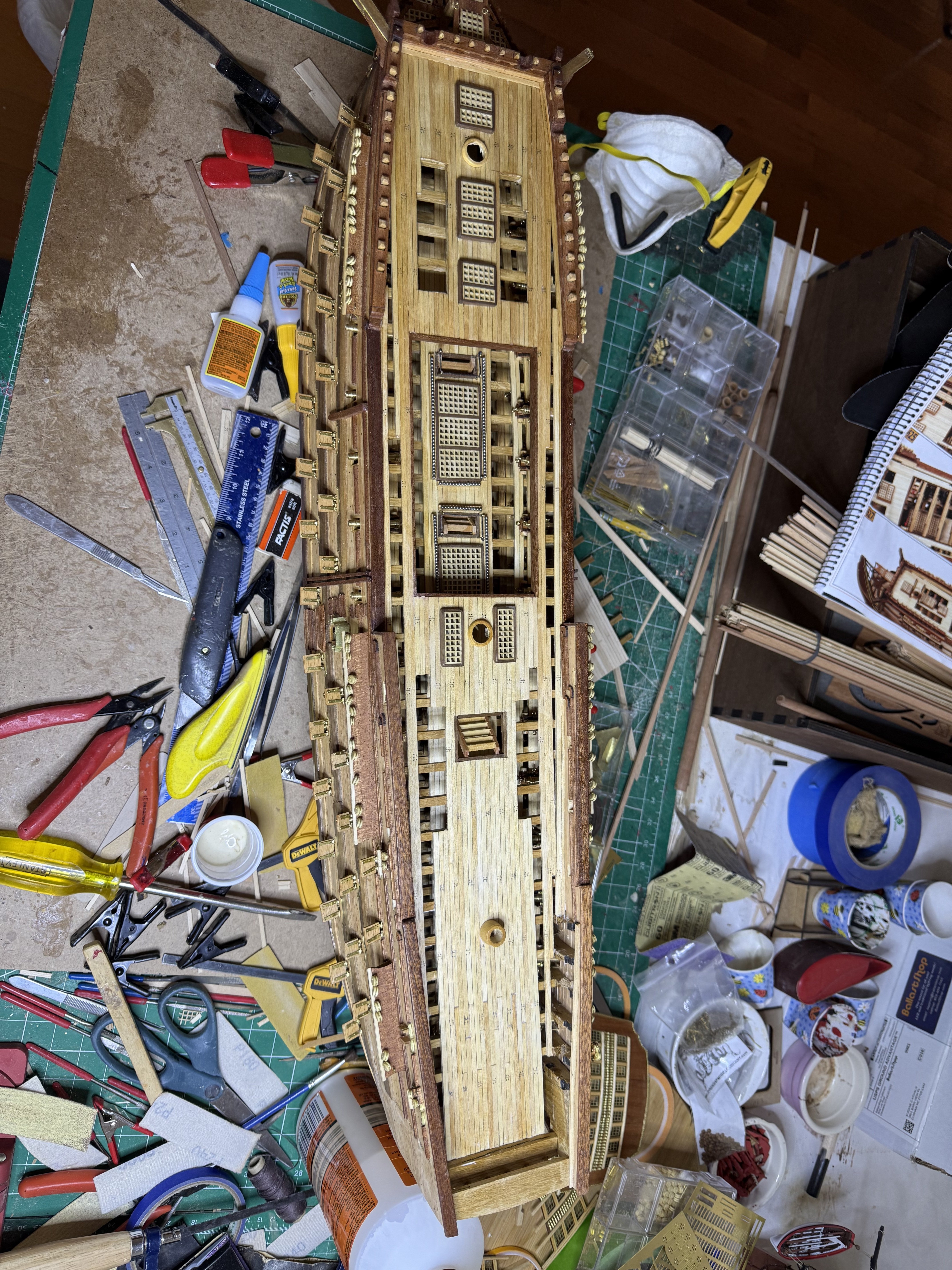

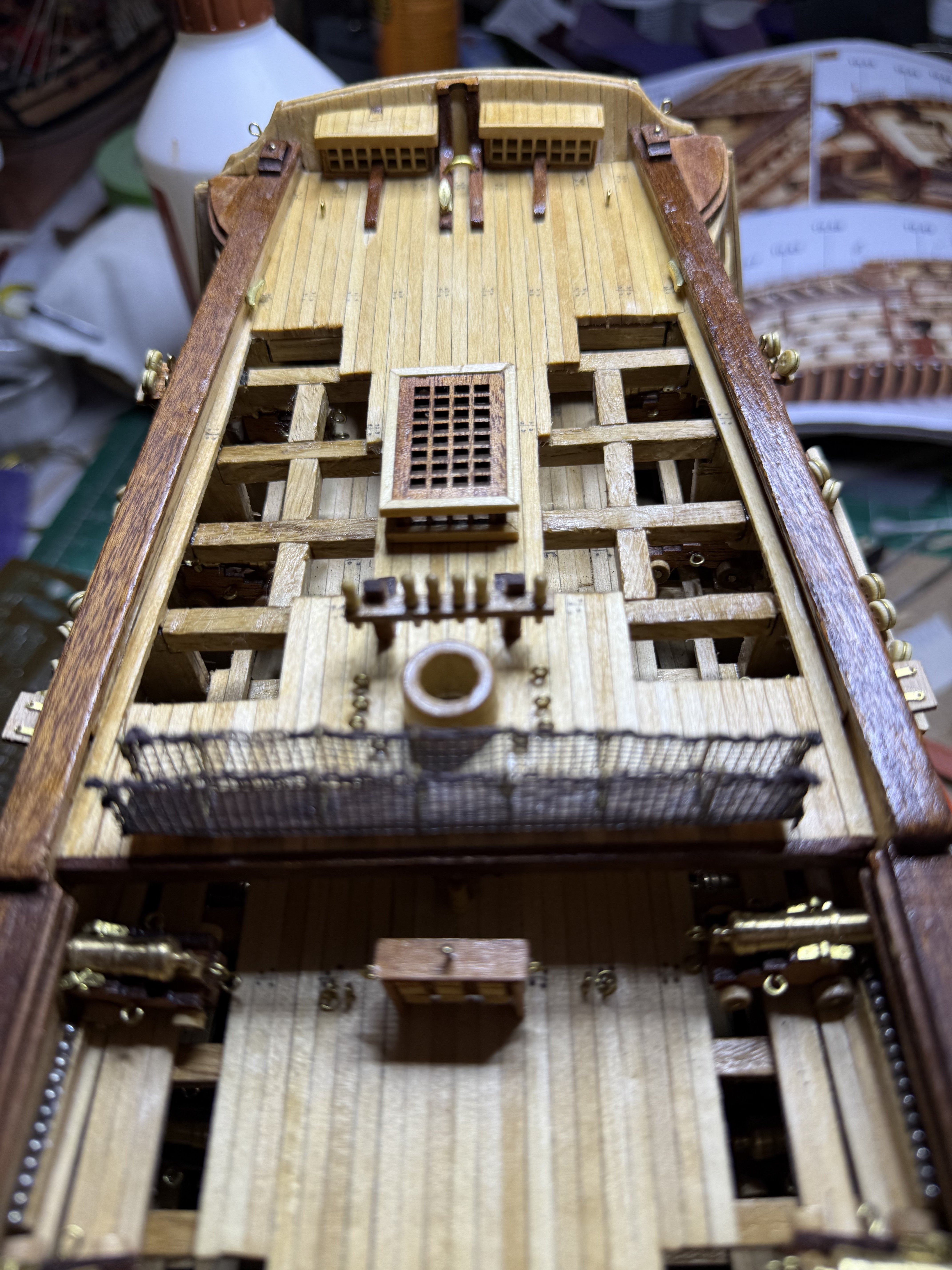

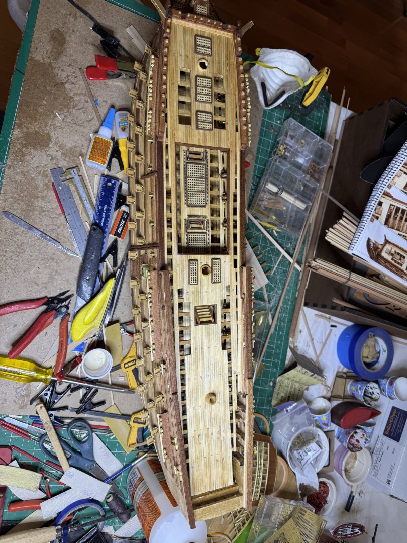

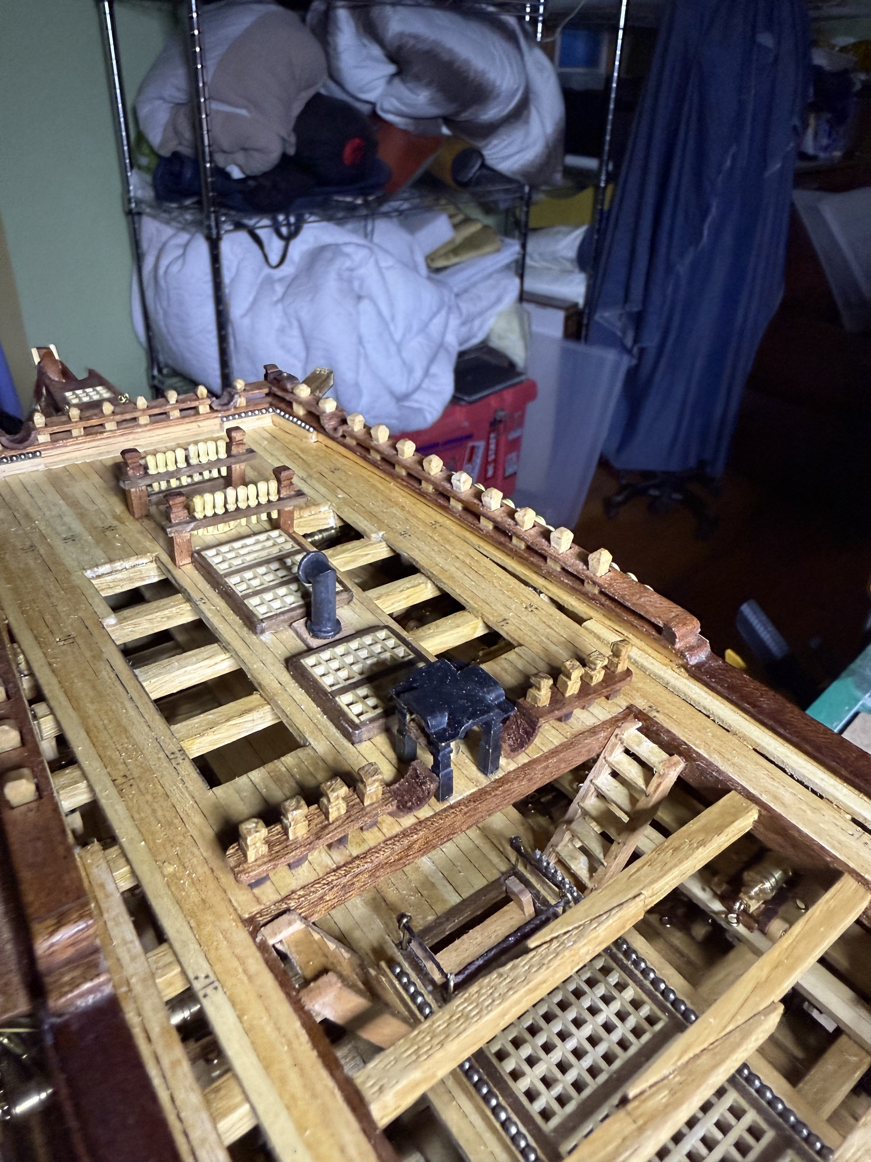

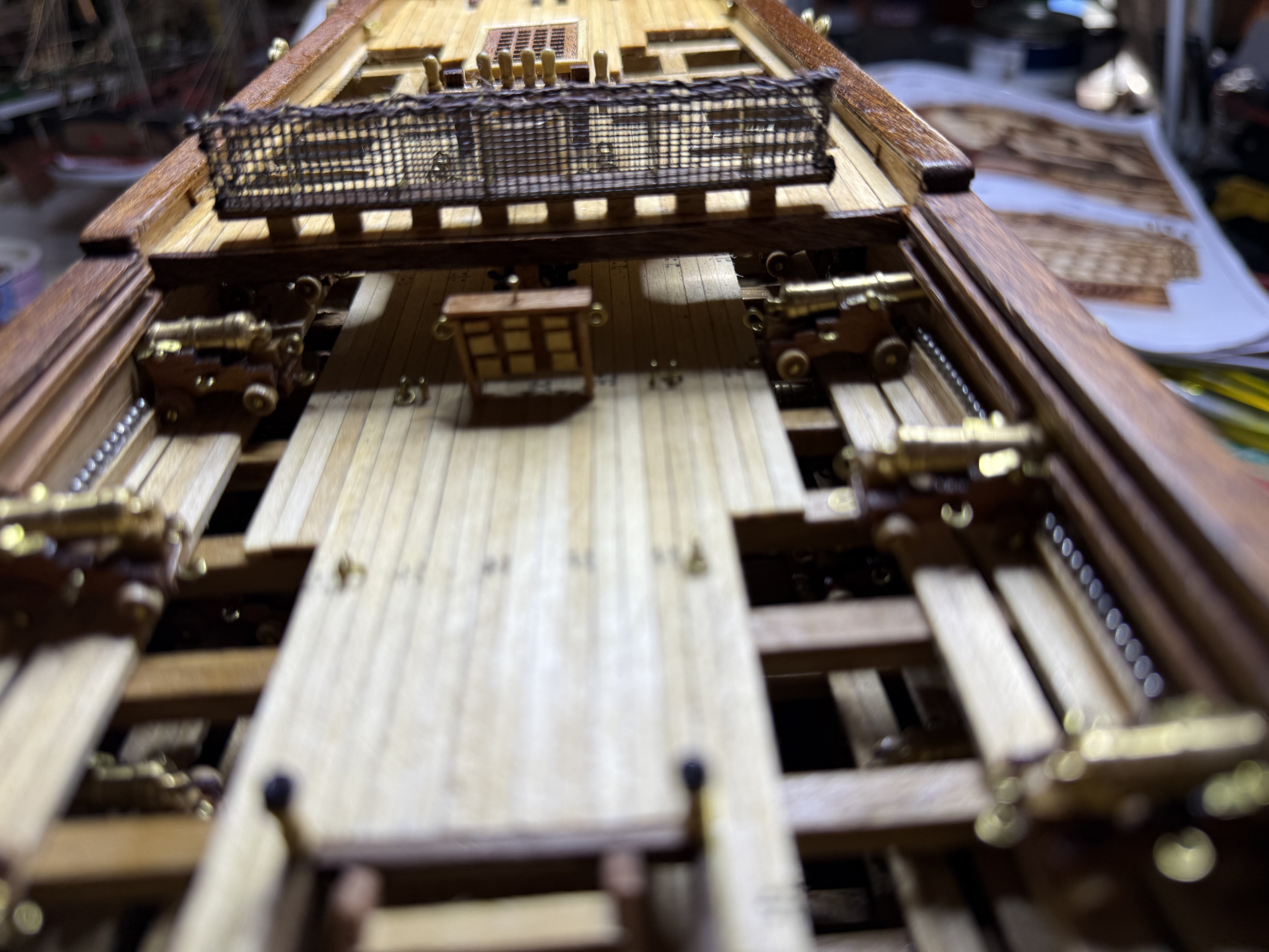

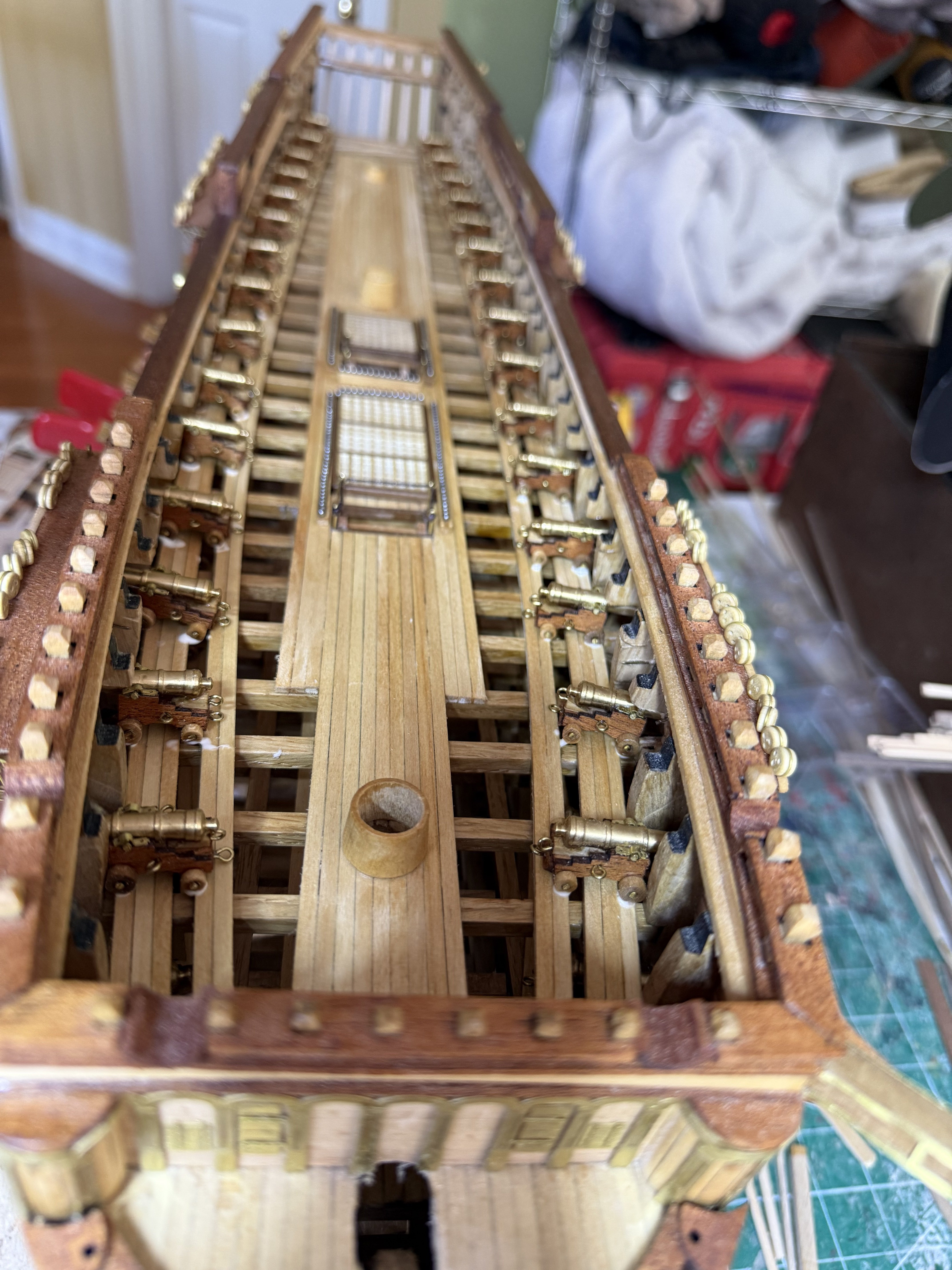

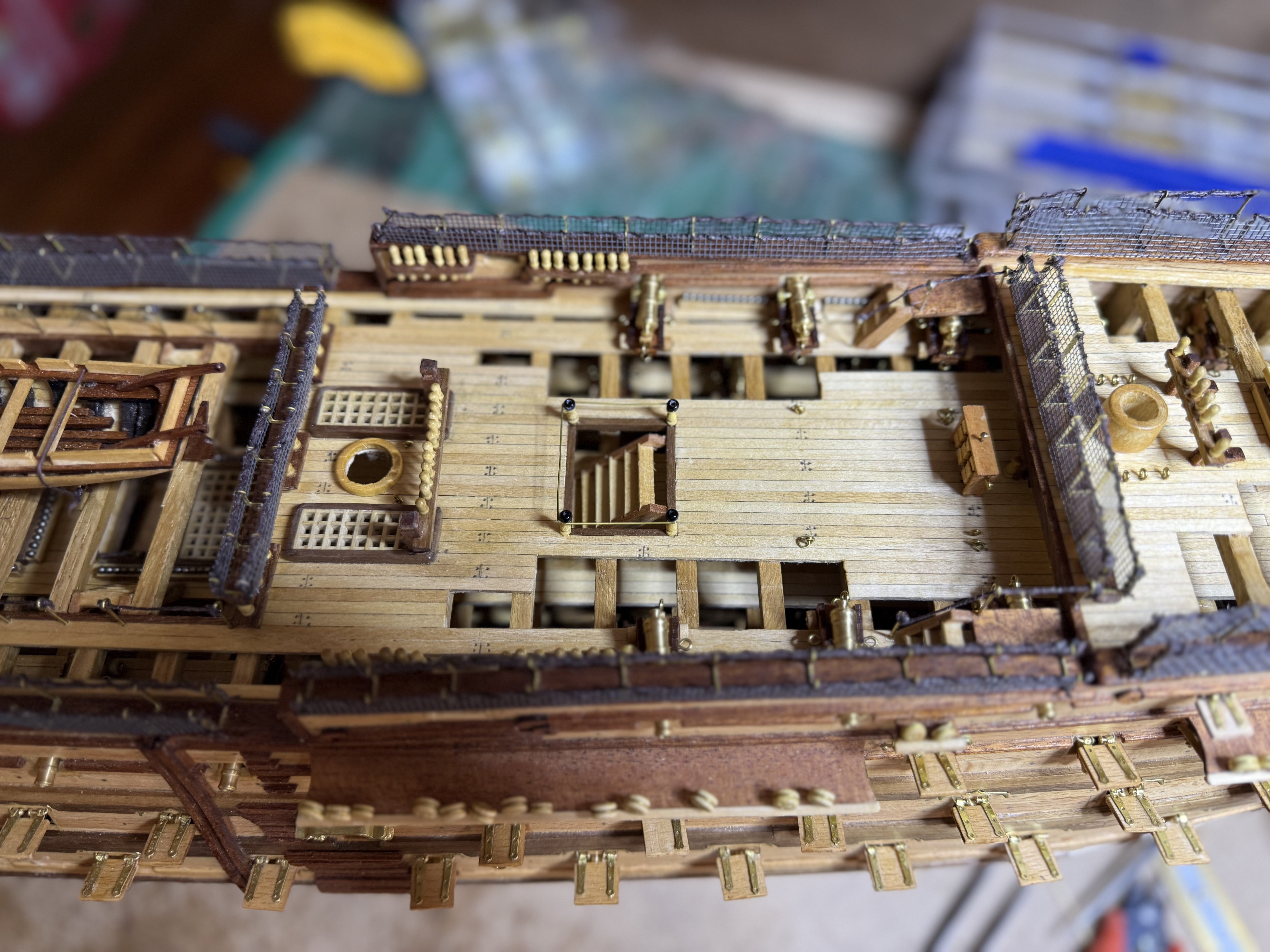

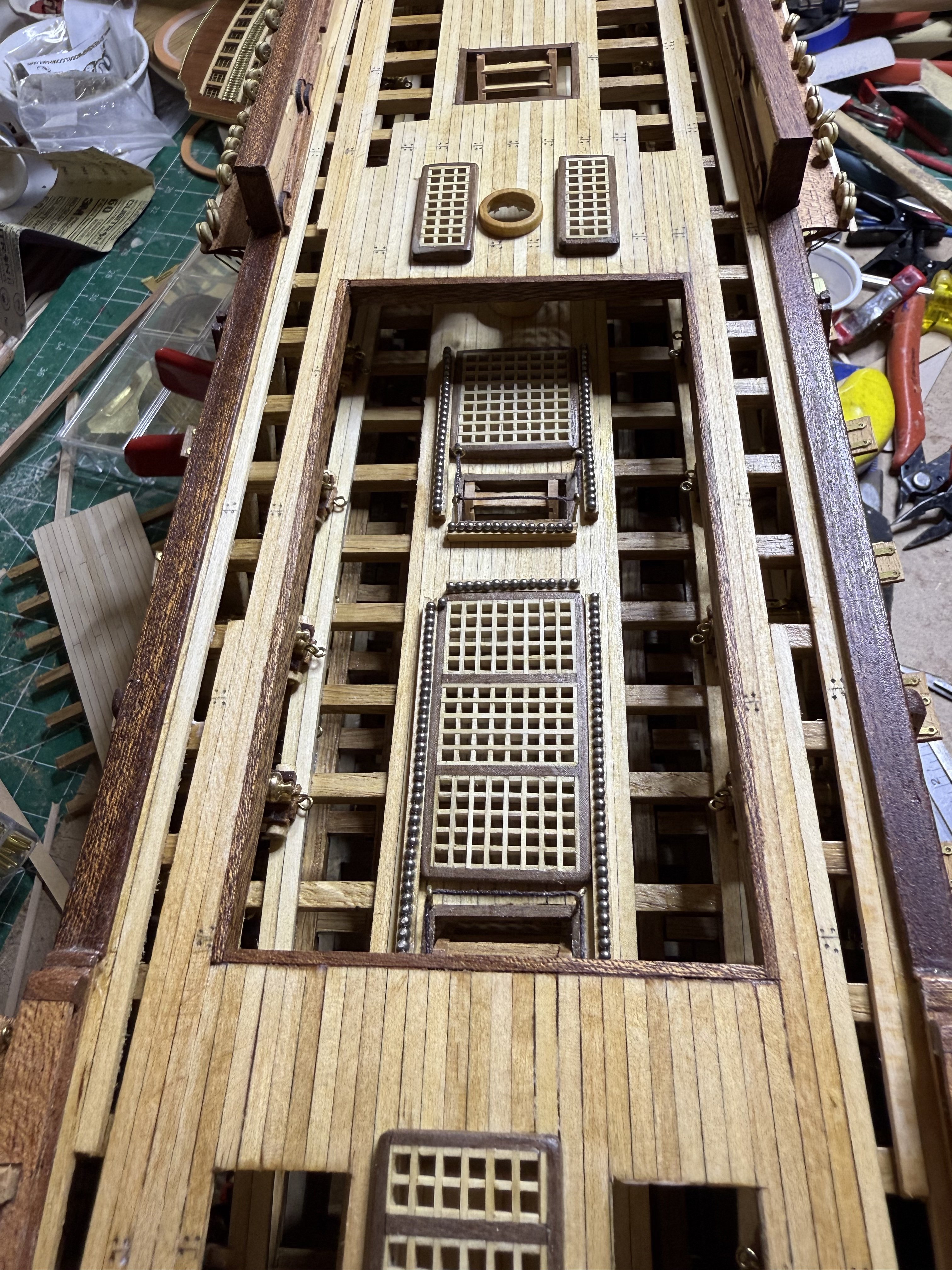

Last for the day the next set of deck beams added. For this deck no longitudinal bracing.
IMG_0974.thumb.jpg.3f11a967e4236ac85ab3b1e3a4821403.jpgIMG_0975.thumb.jpg.f304012f4a765b6249b4e257ef93f630.jpg

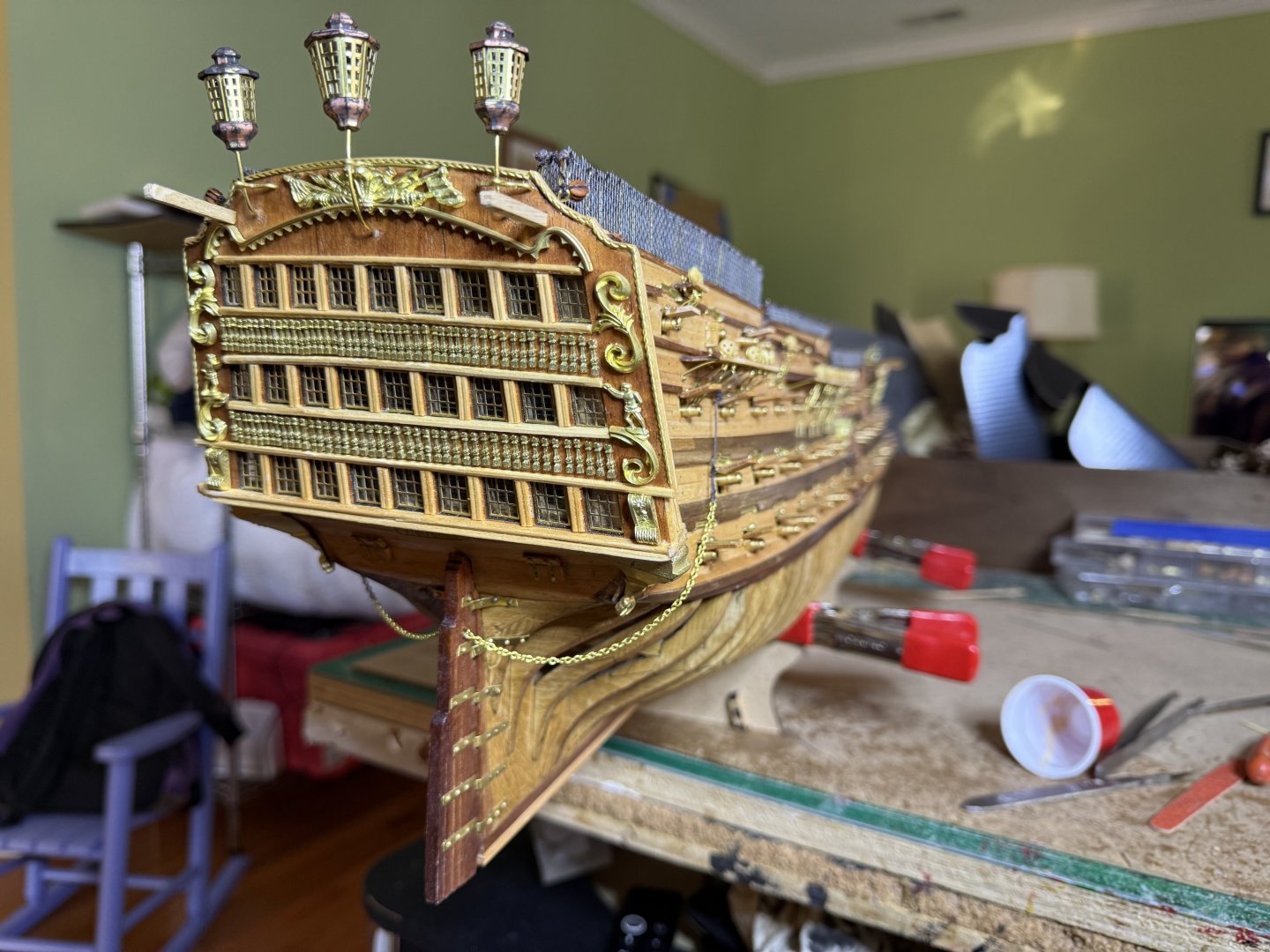

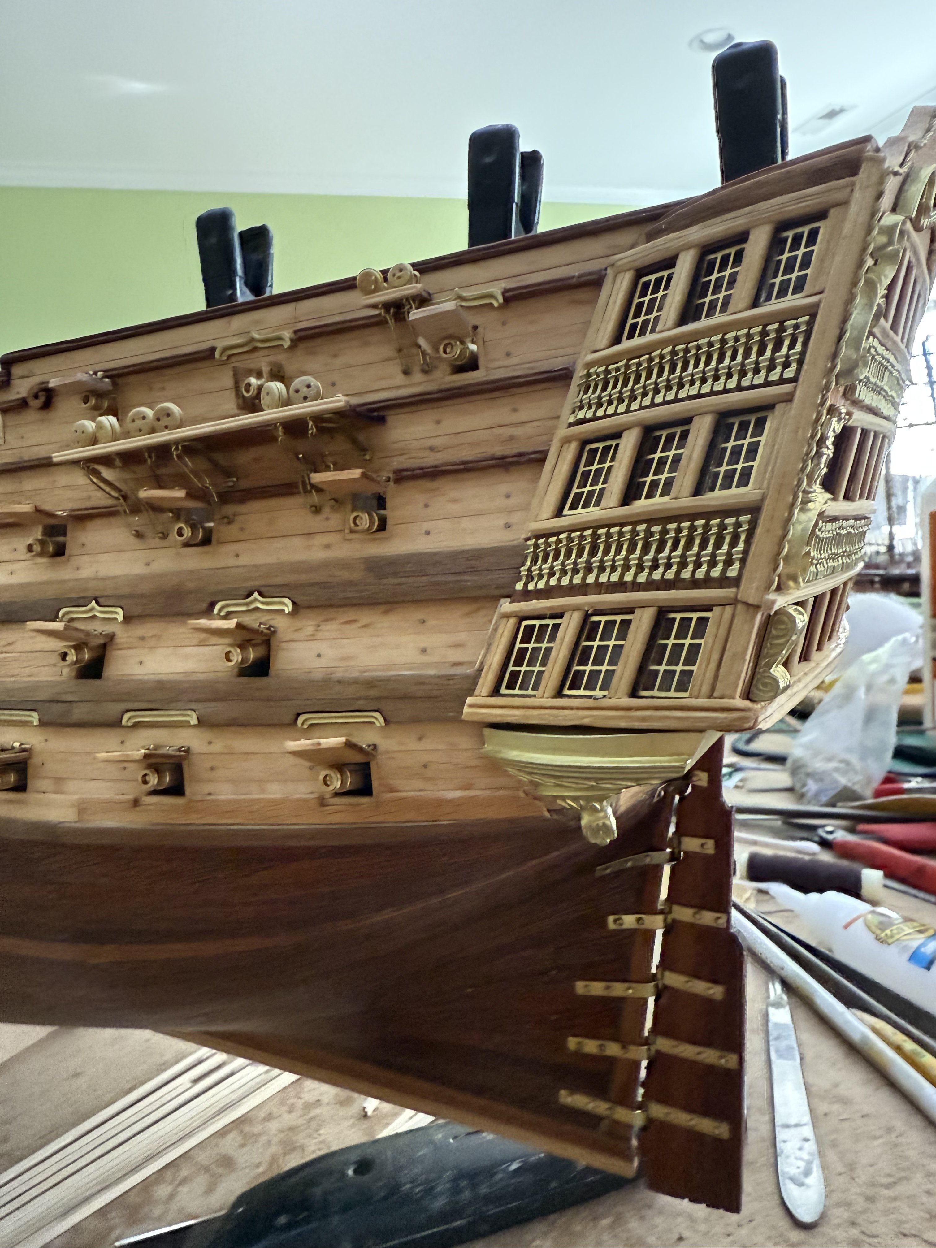

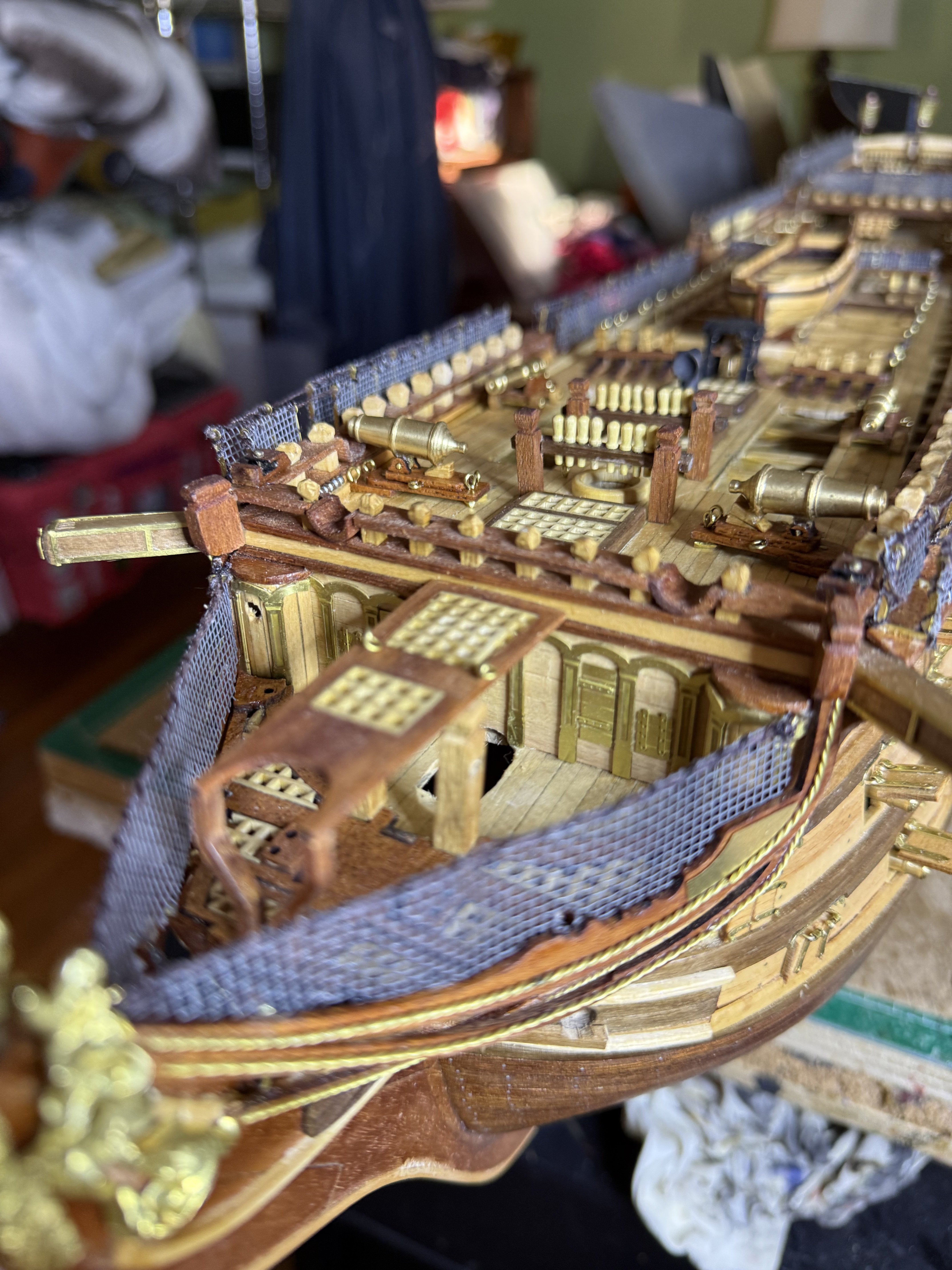

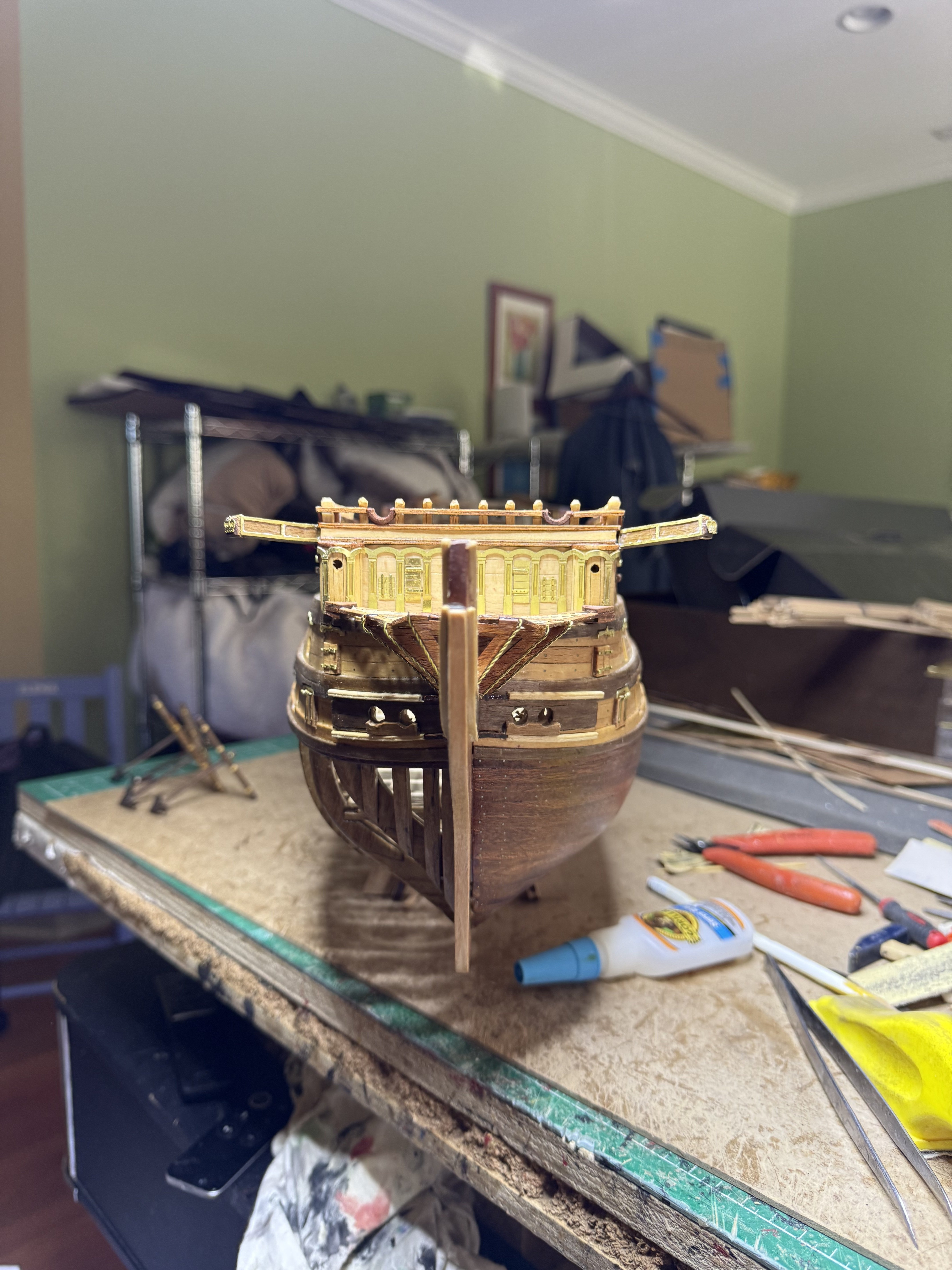

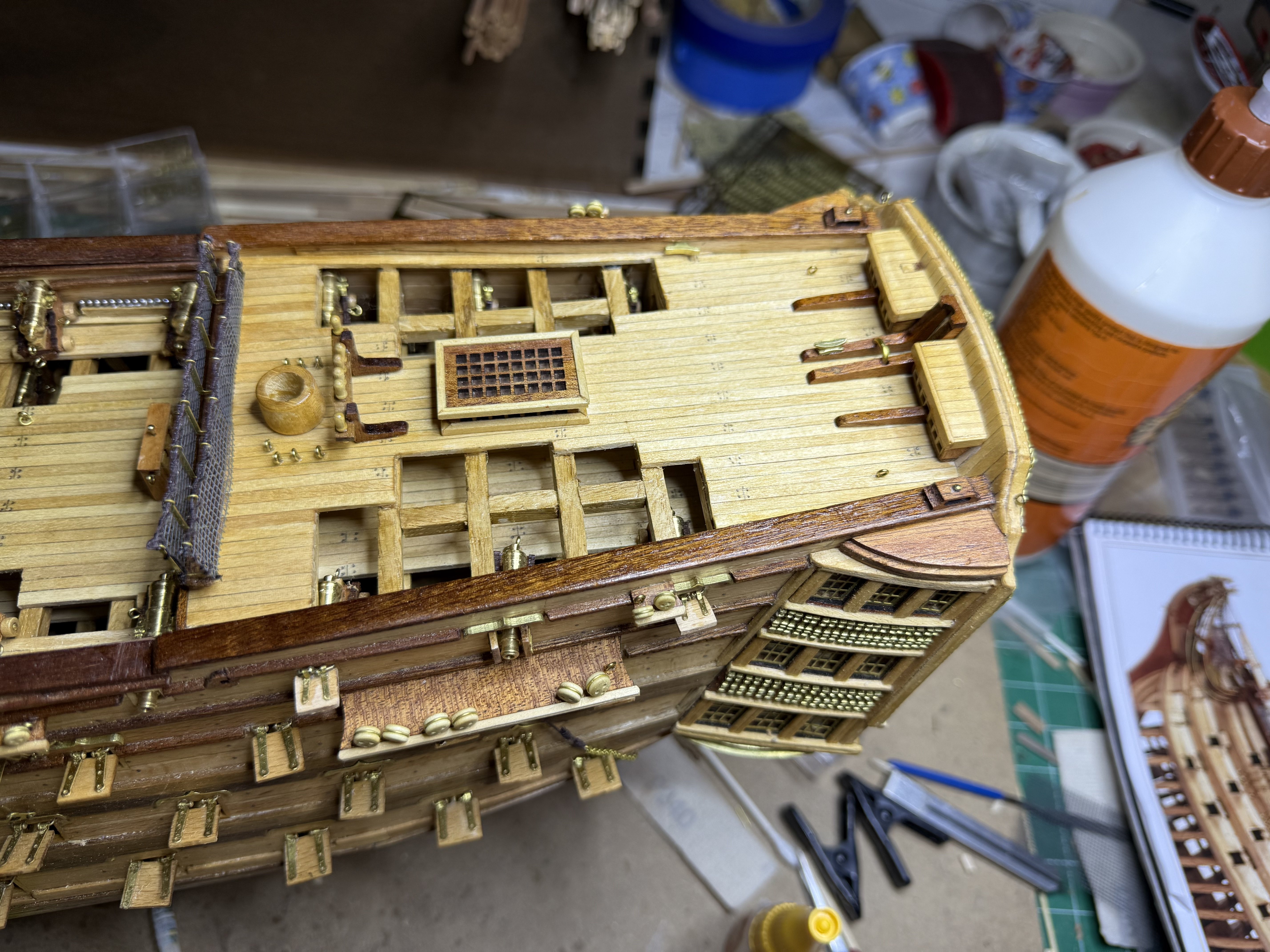

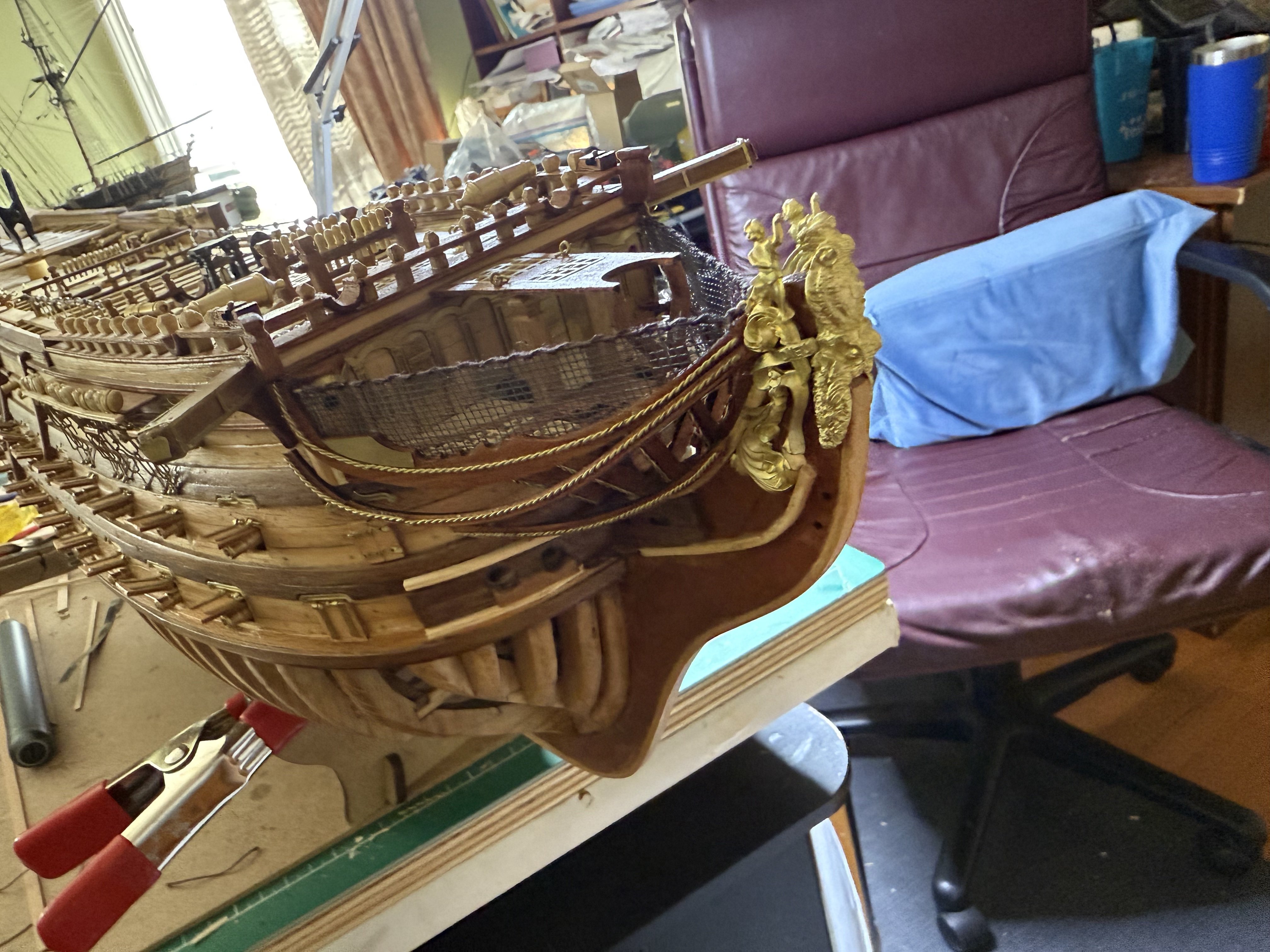

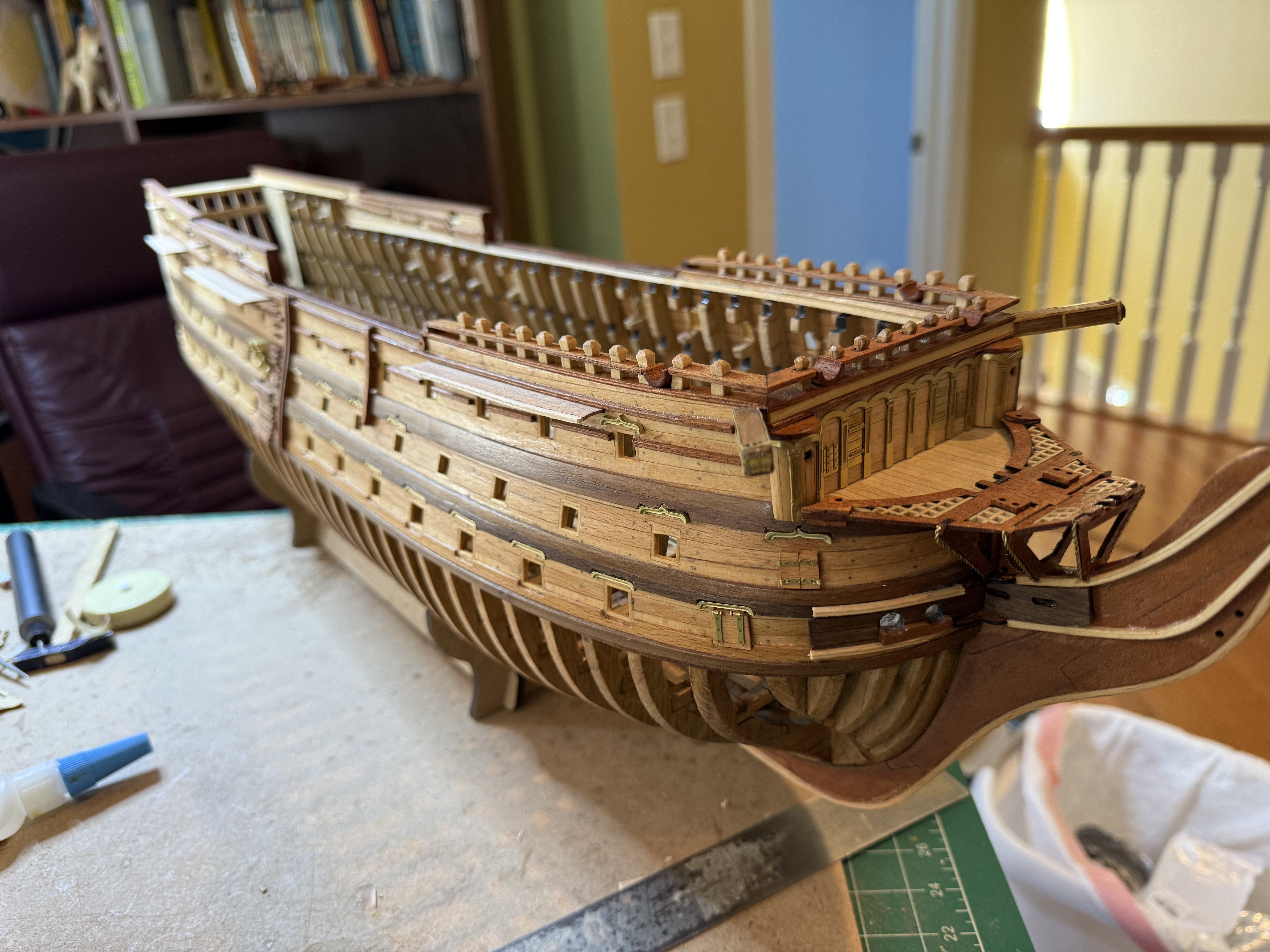

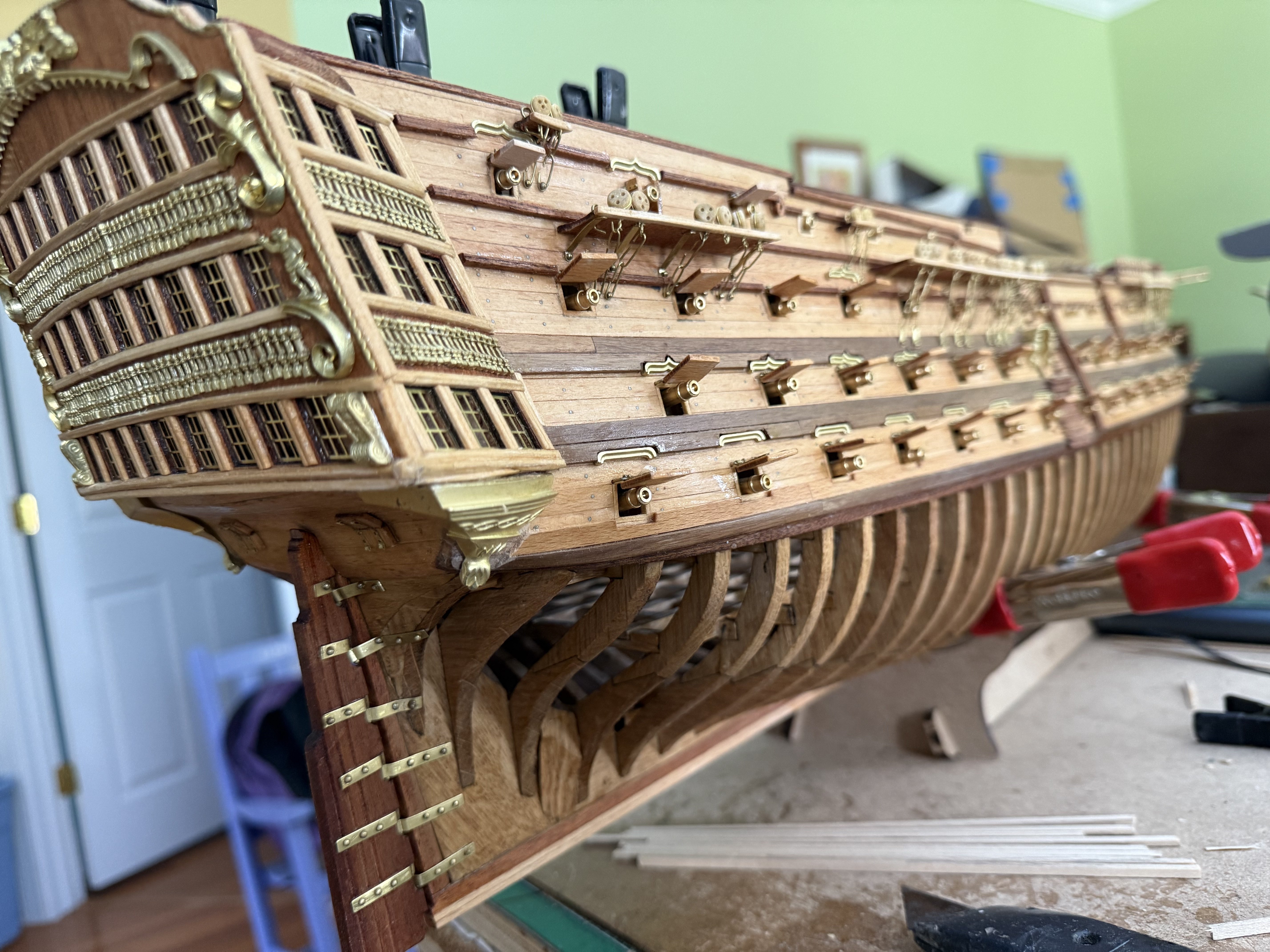

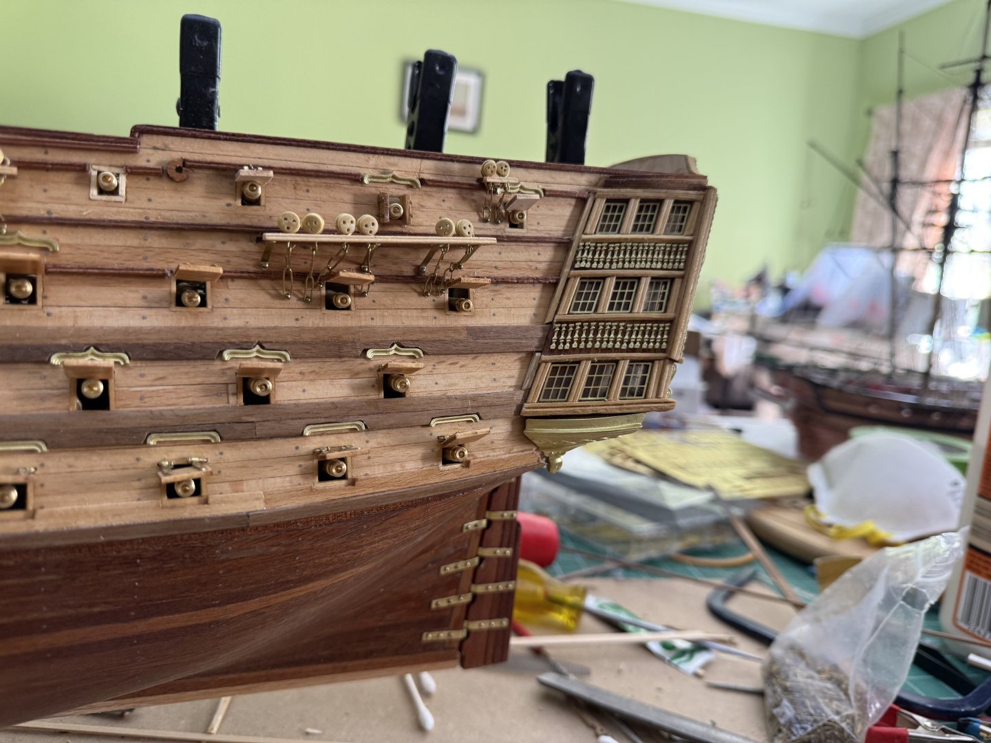

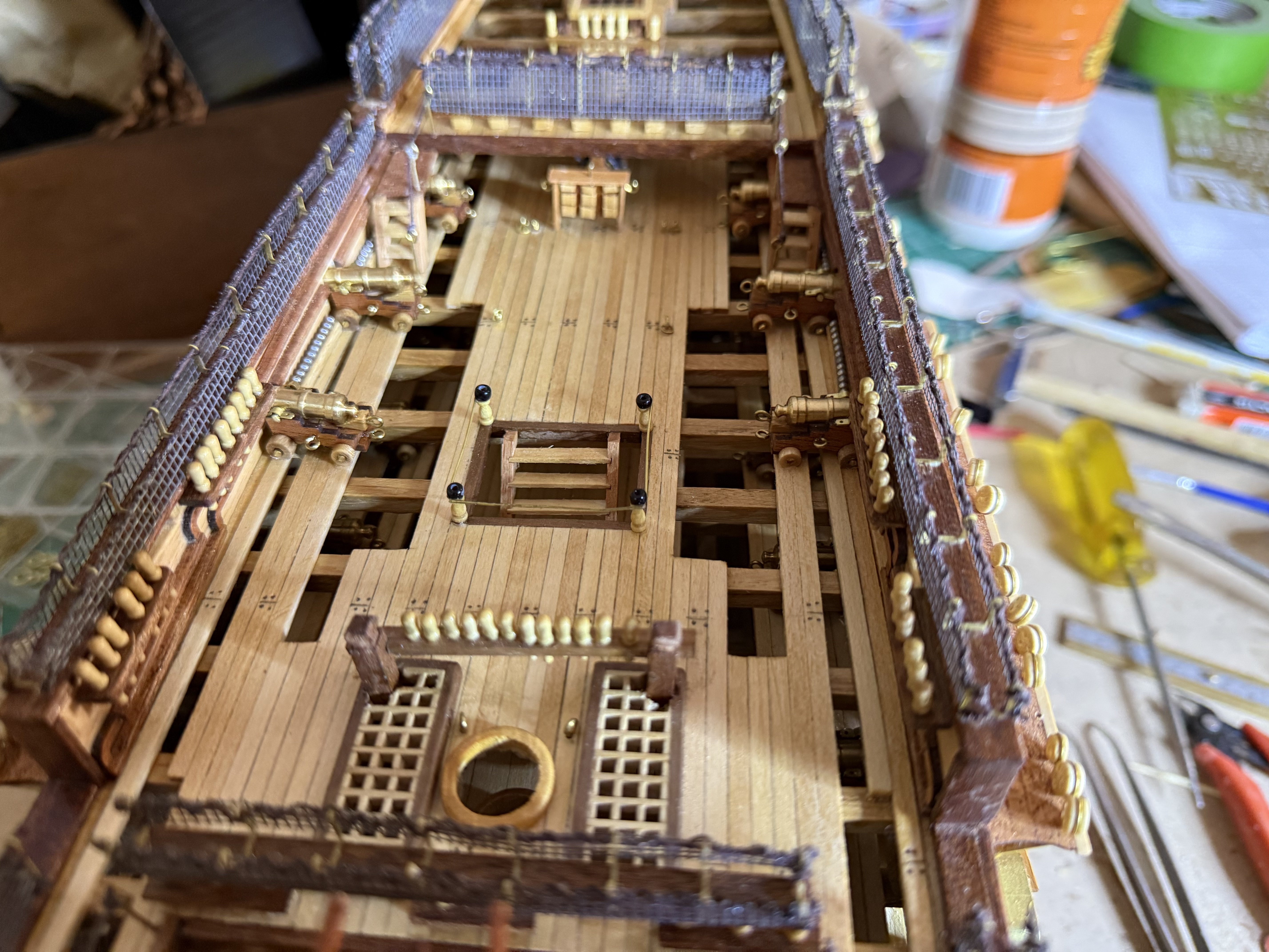

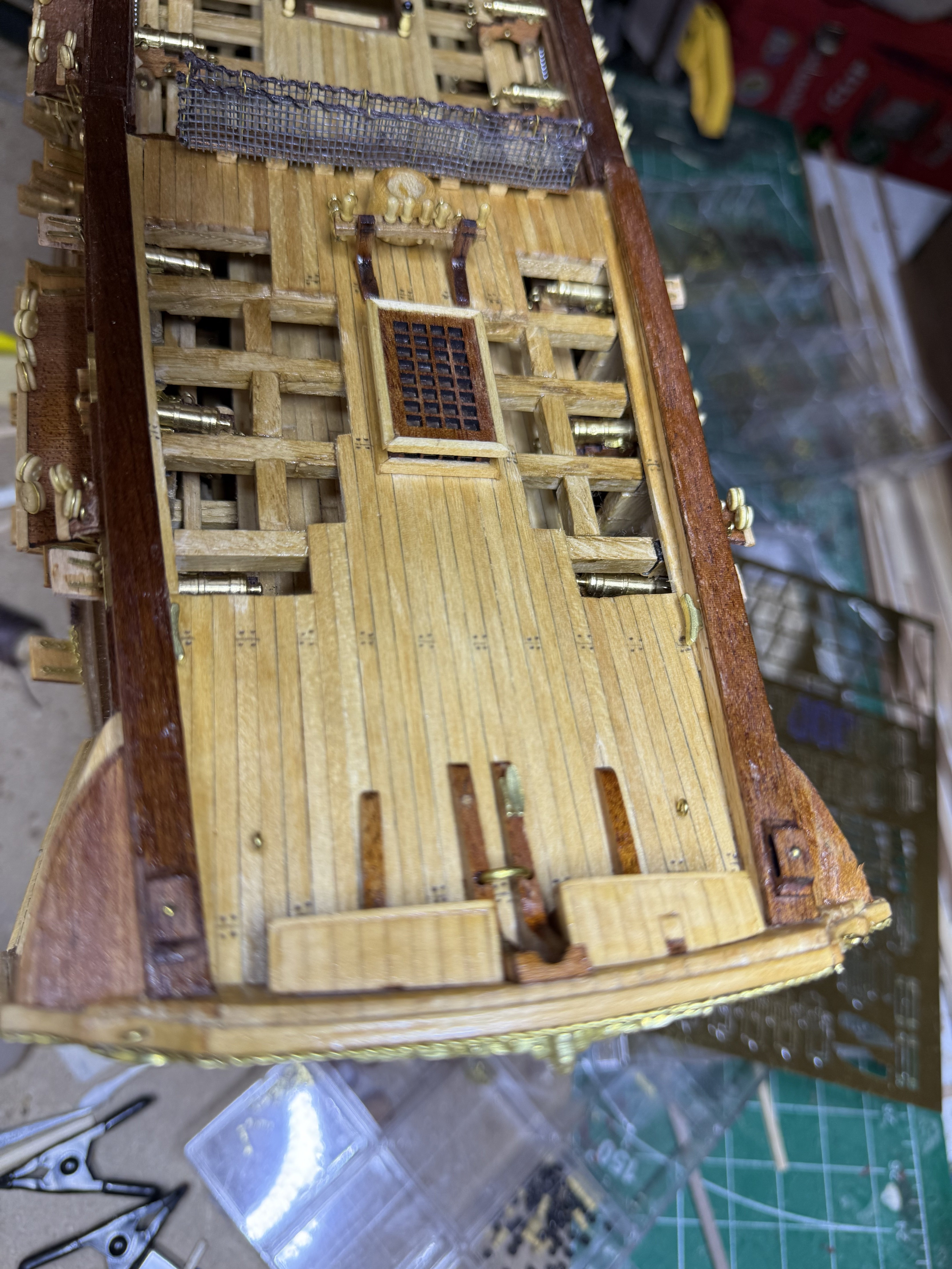

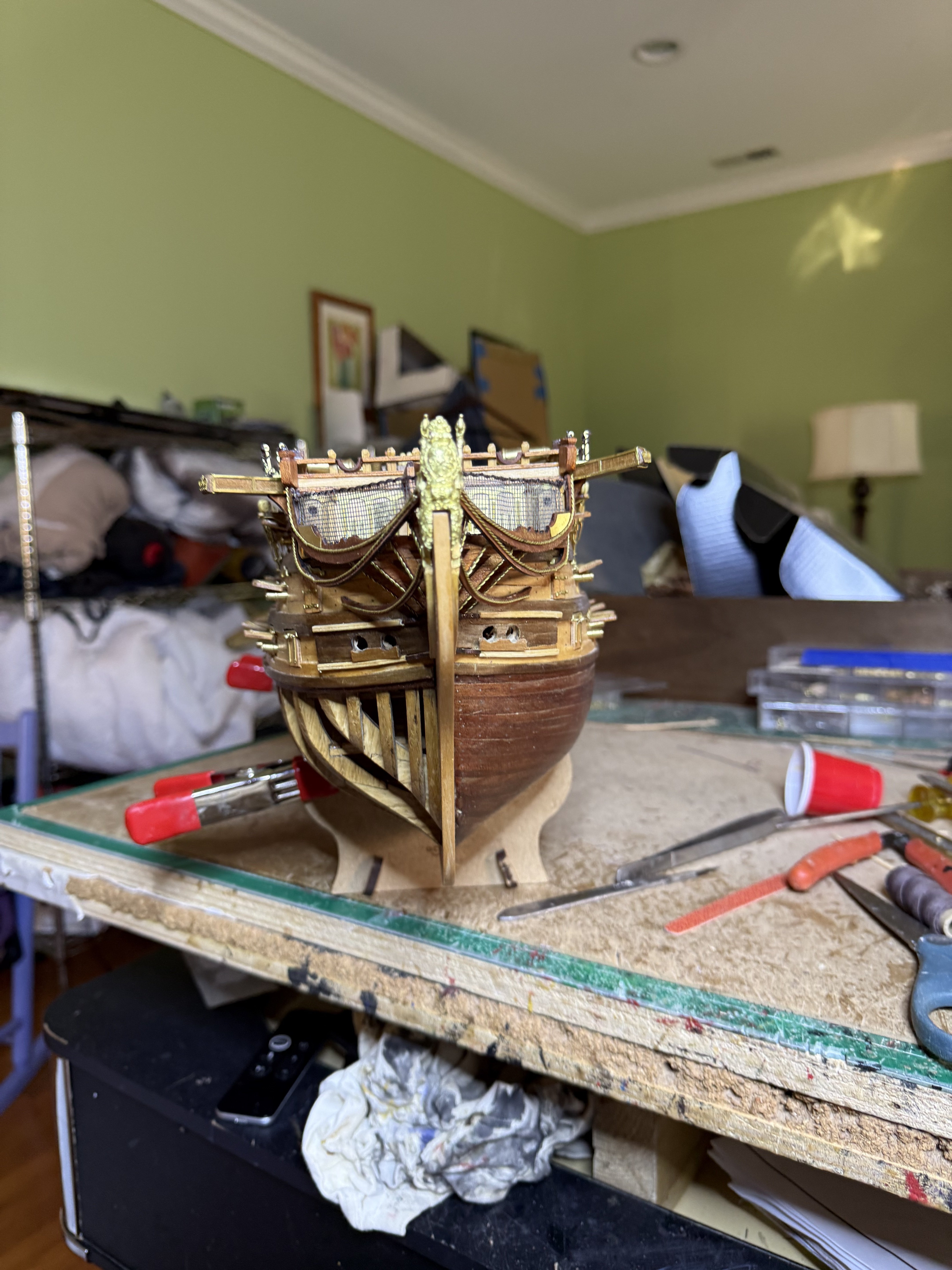

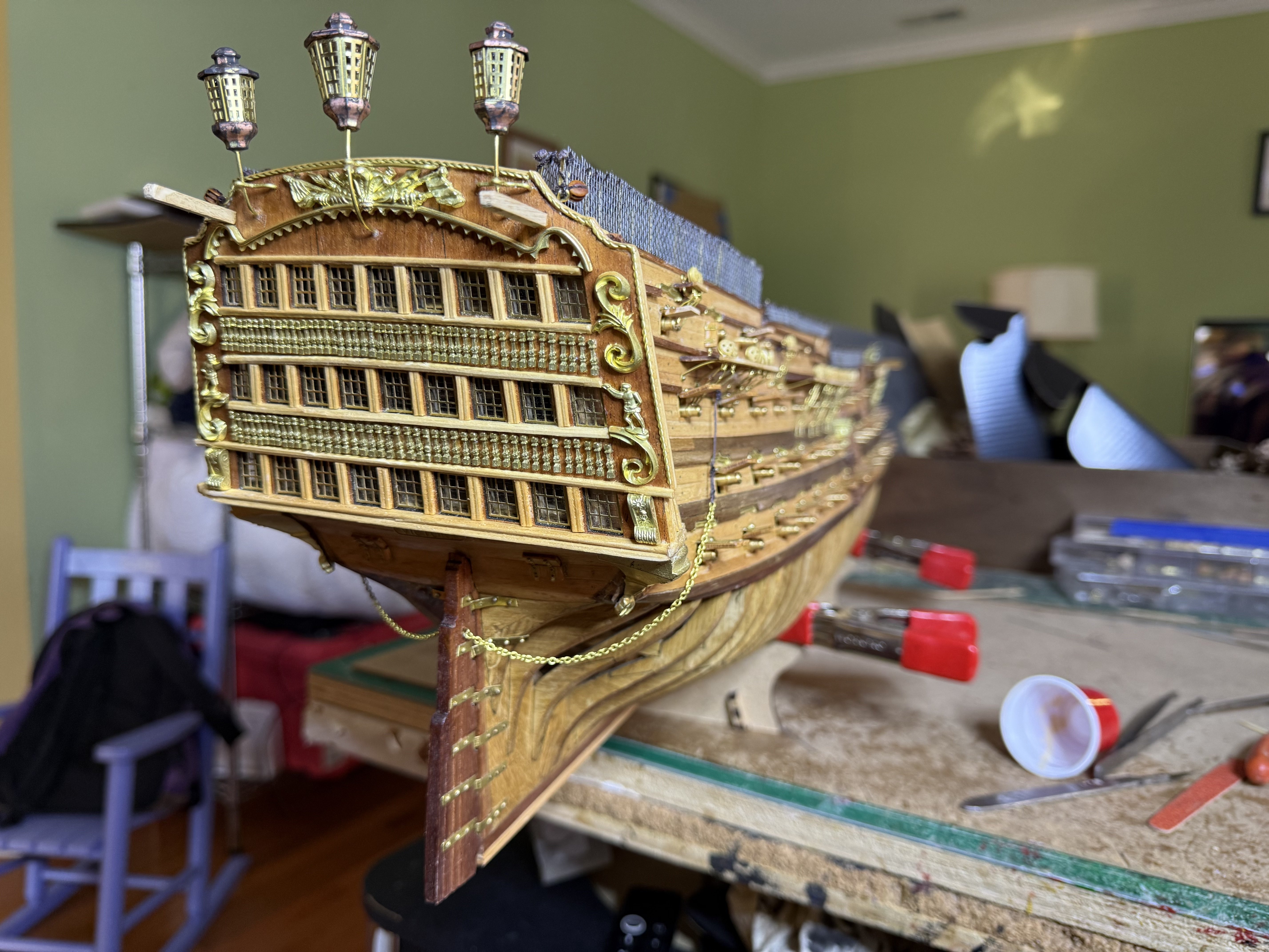

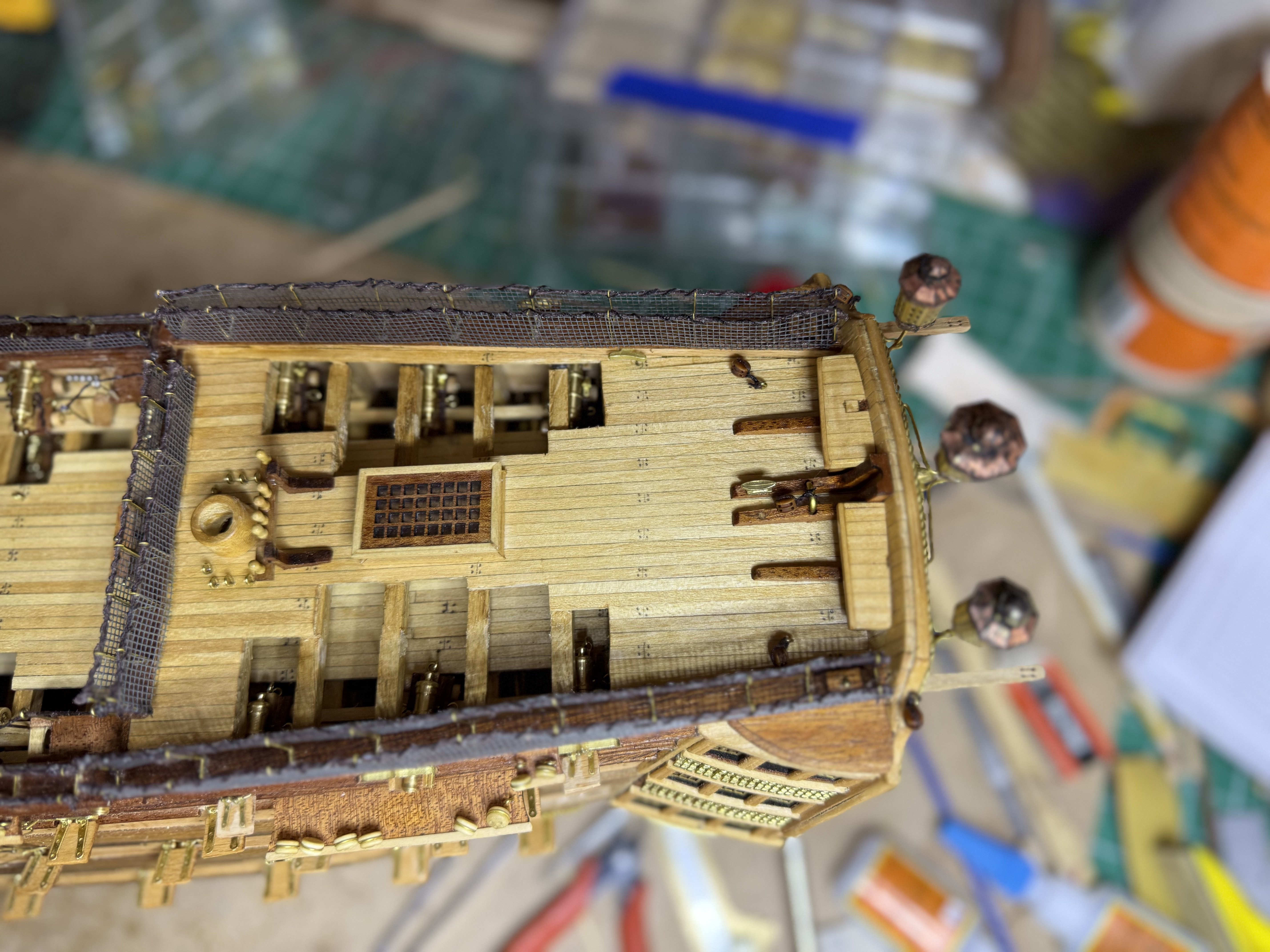

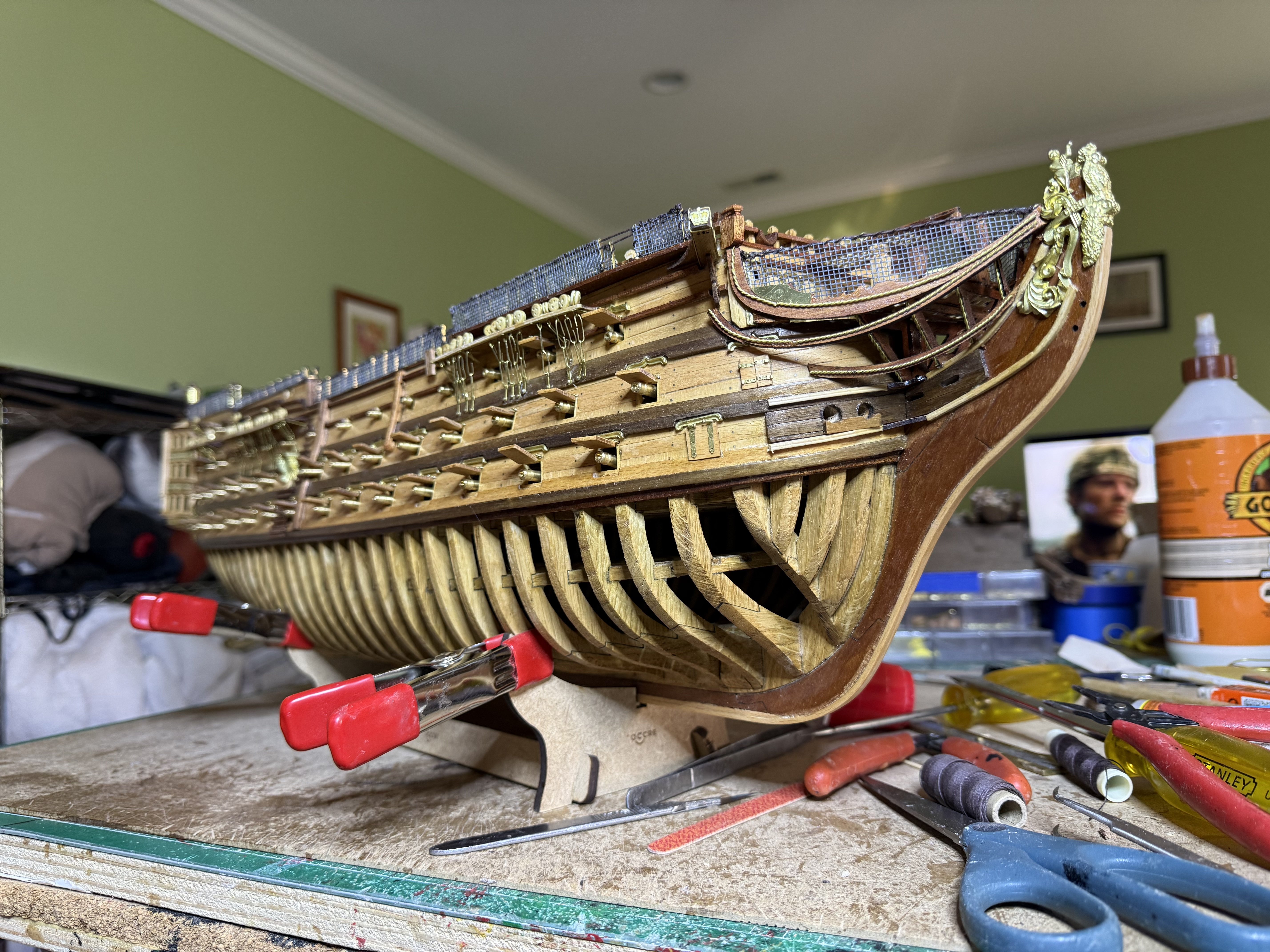

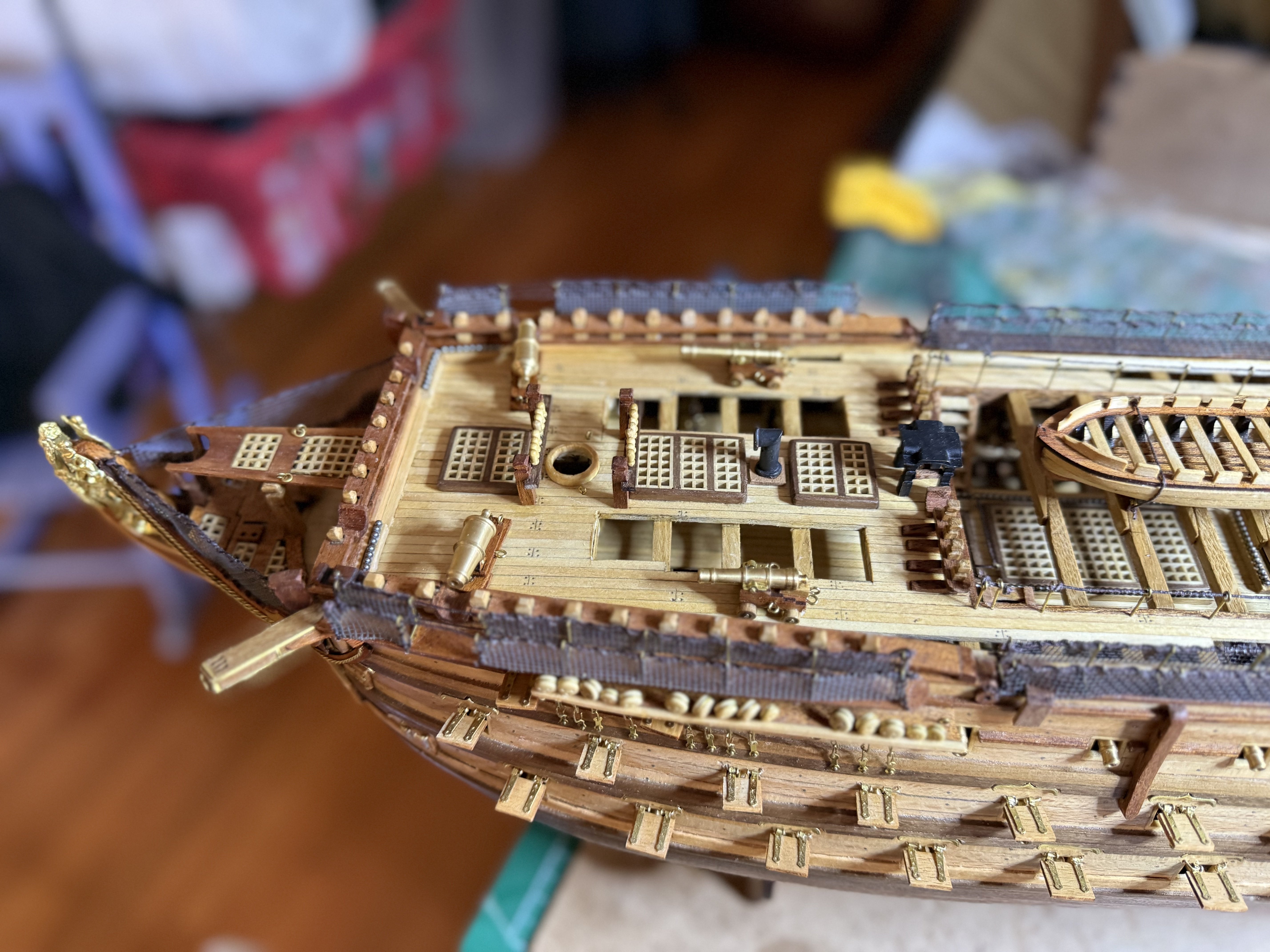

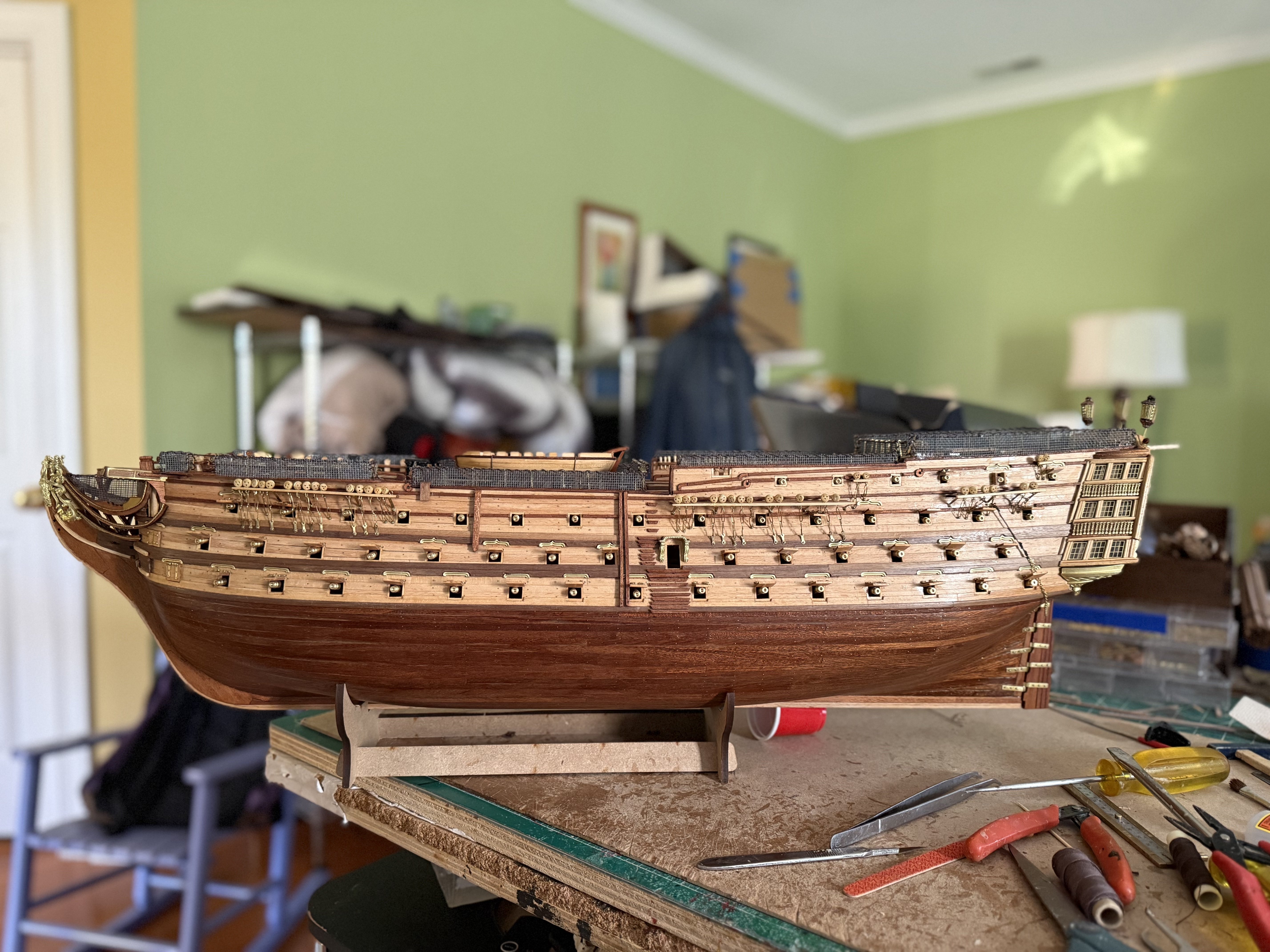

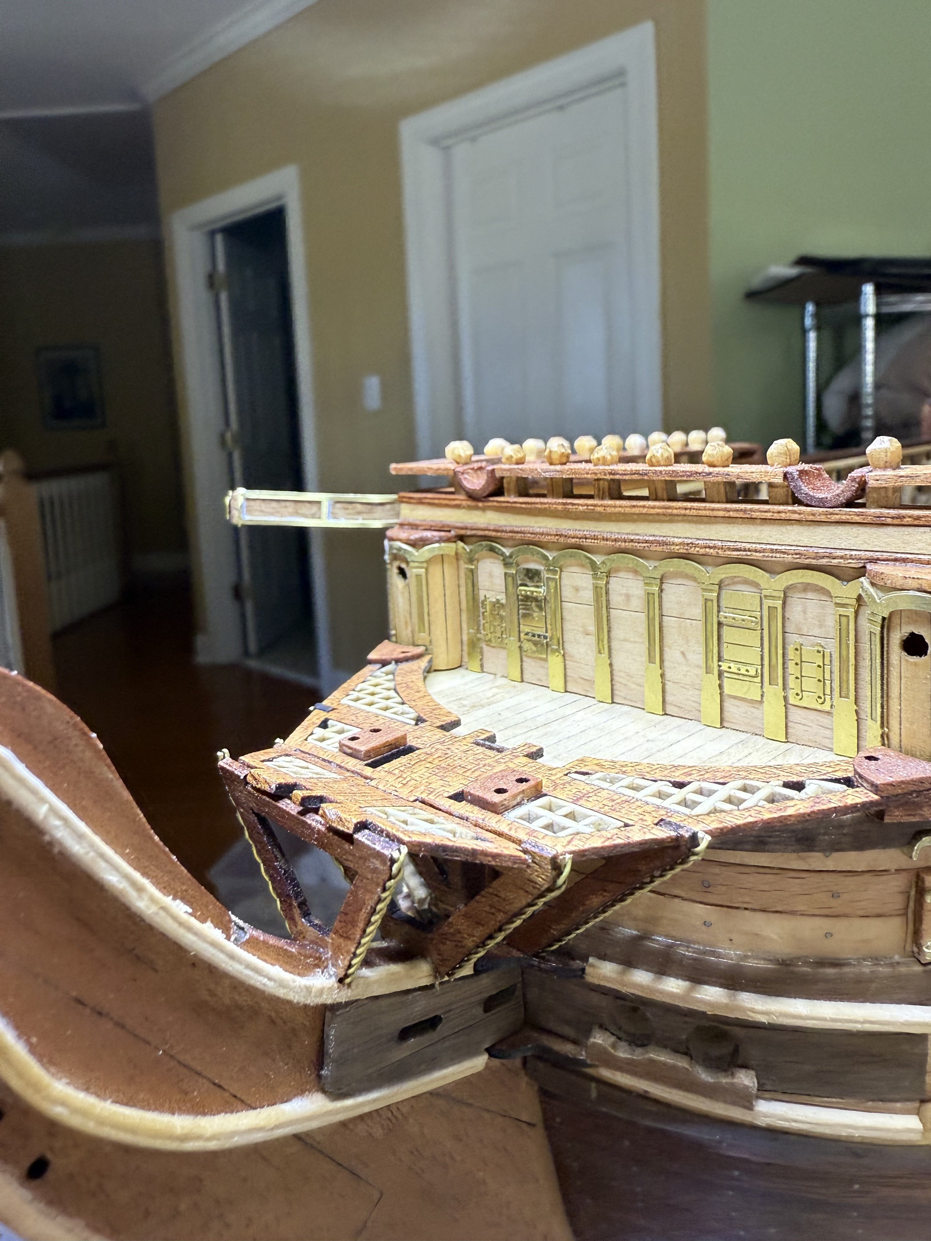

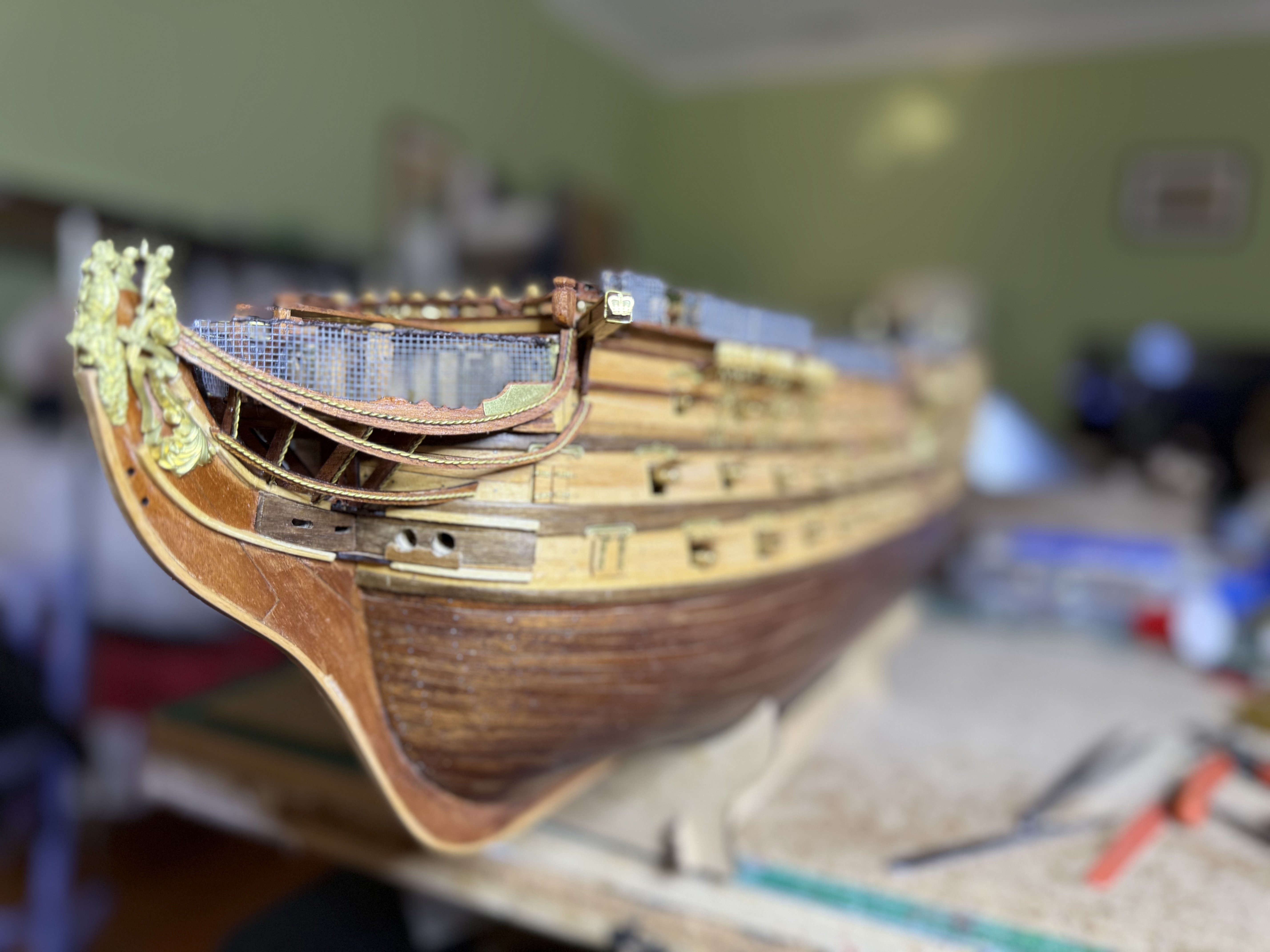

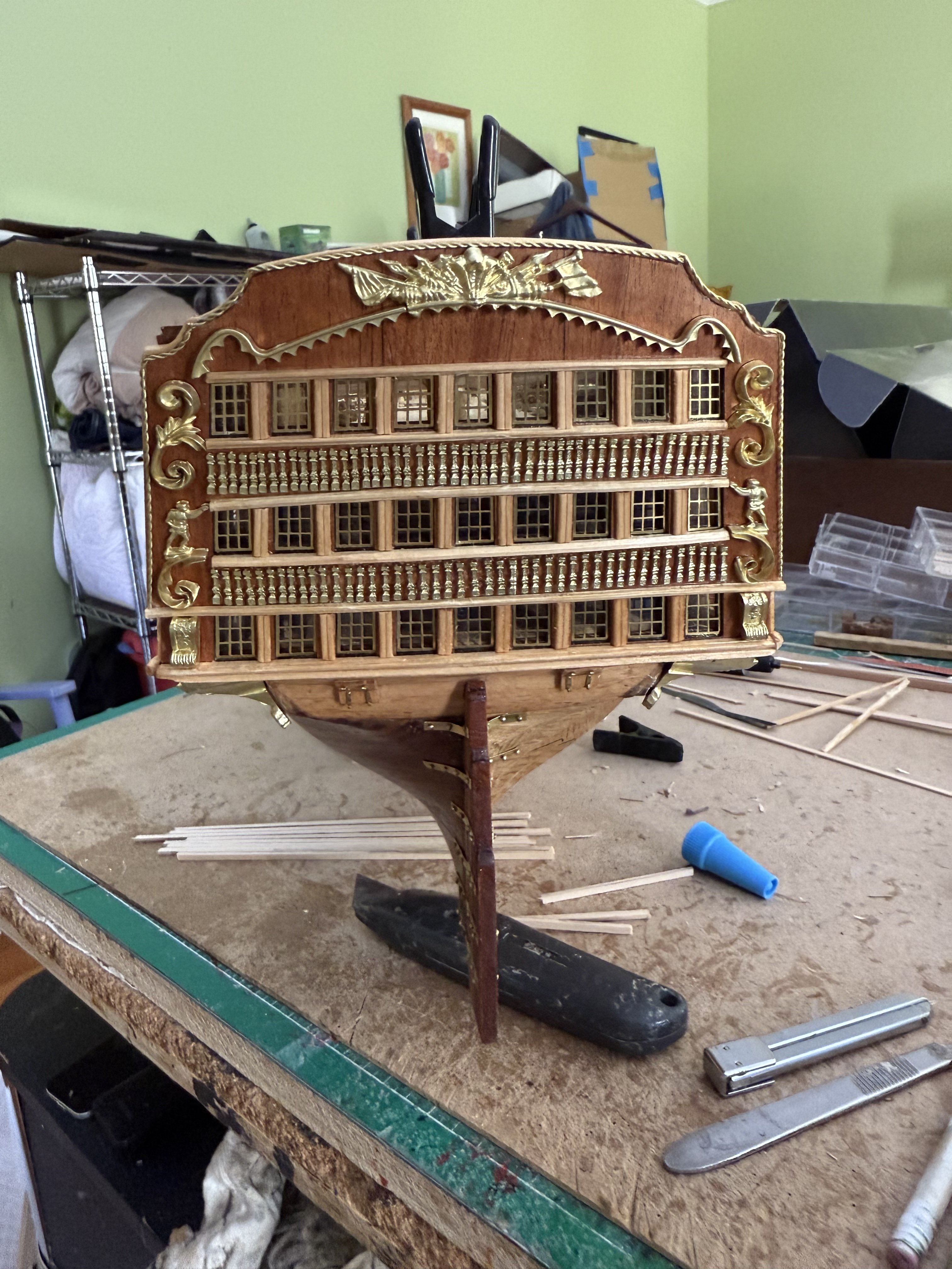

Last couple of days spent putting on the side galleries, planking the poop deck and various decorations and bow netting. Boomkins will go on when finished with the rigging as I otherwise always break them
IMG_1051.thumb.jpg.bba62a52cd3178fca7774a59bbe86825.jpgIMG_1050.thumb.jpg.b7aa679ce0b79c44d10b274f8f7e6f2e.jpgIMG_1049.thumb.jpg.21fce0269e49226283b813740e071104.jpgIMG_1052copy.thumb.jpg.1b0c011fde380beecd92f283377e2fac.jpgIMG_1053.thumb.jpg.2168ec578ee2d517af5bd051ddcb3a73.jpgIMG_1057.thumb.jpg.30d5a9a2ca3092c76a1f04eab42c6166.jpgIMG_1055.thumb.jpg.64f8aa852c4cb60c8954eaed904691e0.jpgIMG_1054.thumb.jpg.fb7a50d5d43ab37177ba7cc296d1e8be.jpgIMG_1056.thumb.jpg.2180db158043ec14c068b9bcfed83b37.jpg

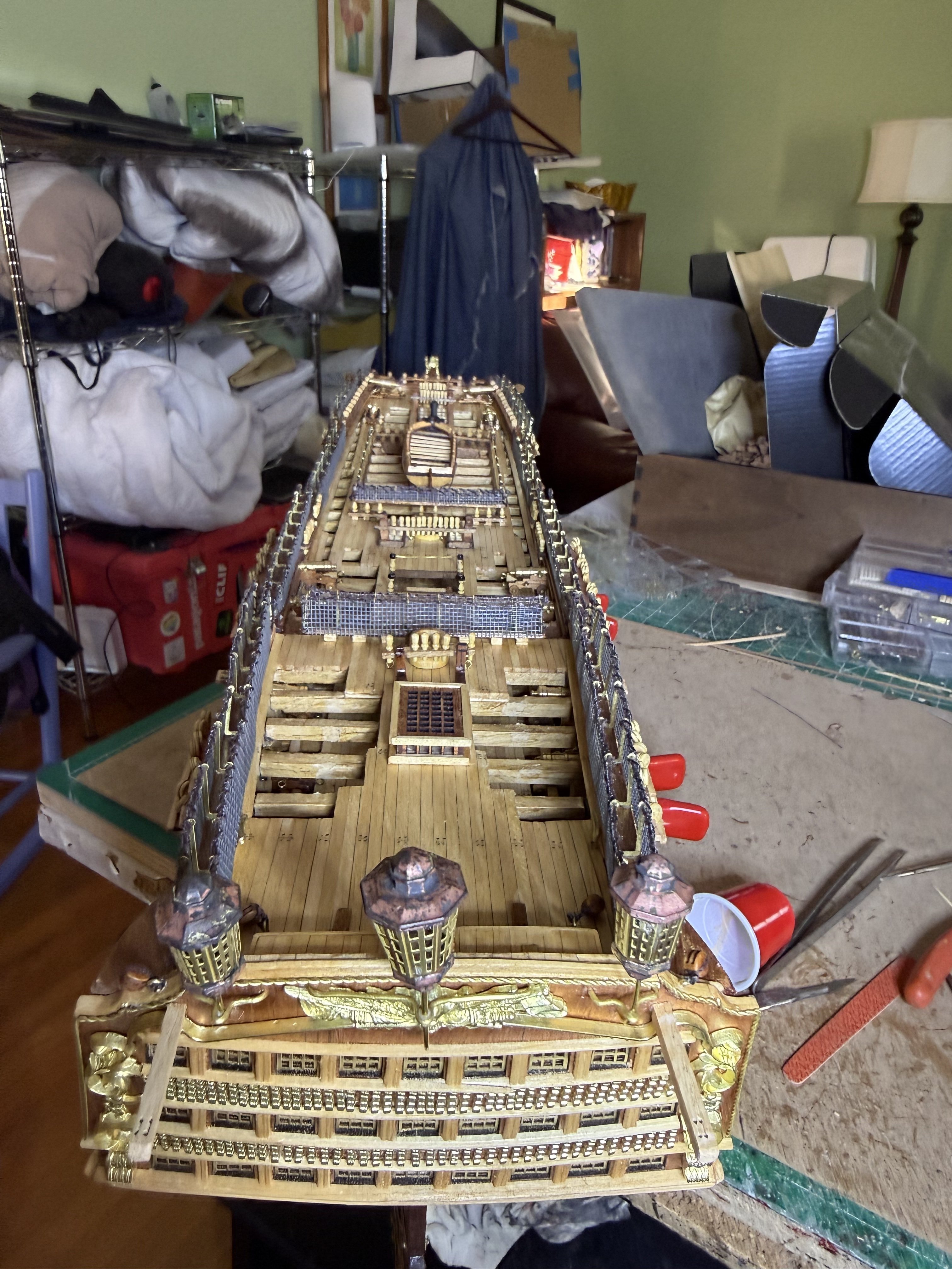

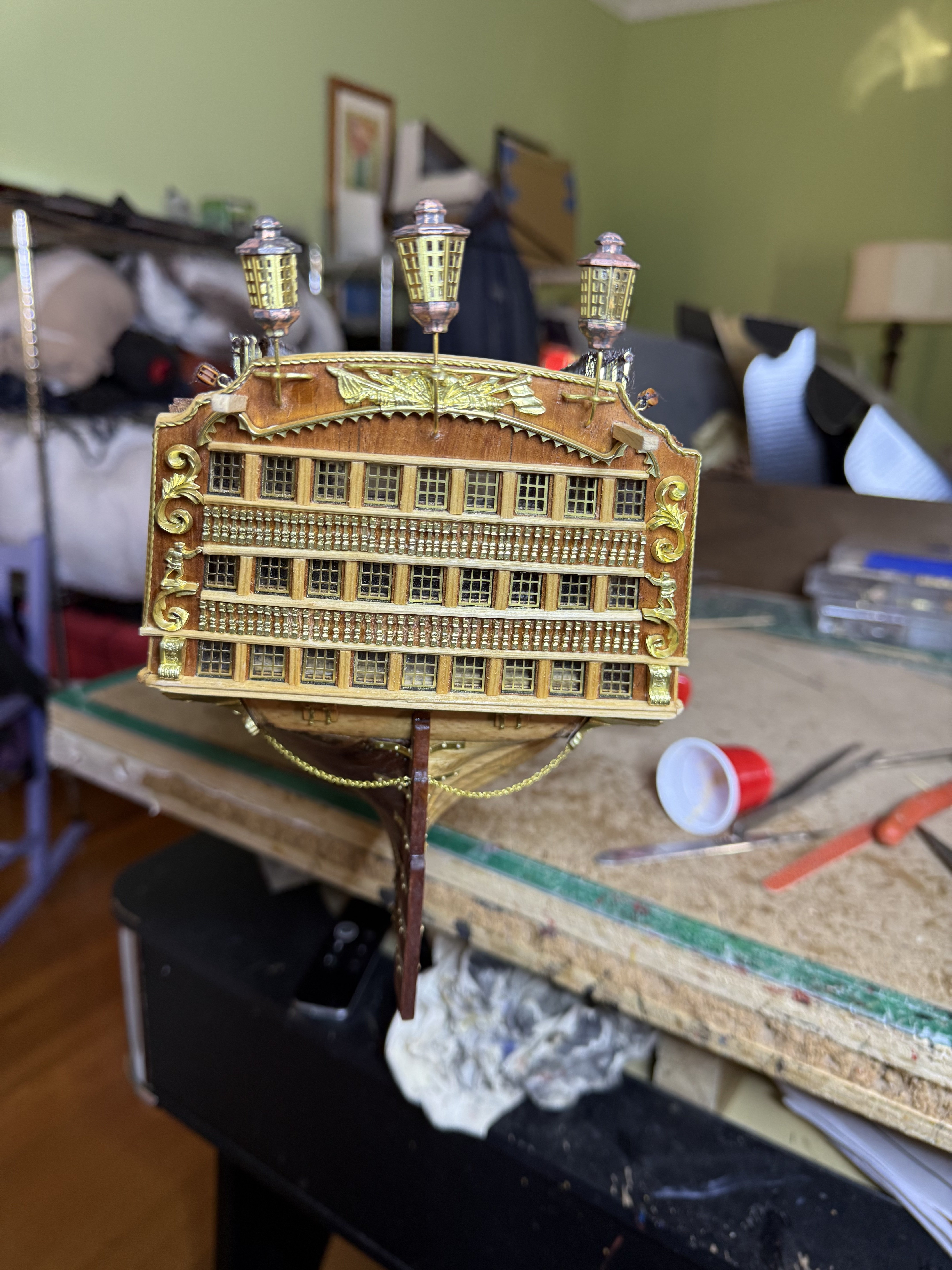

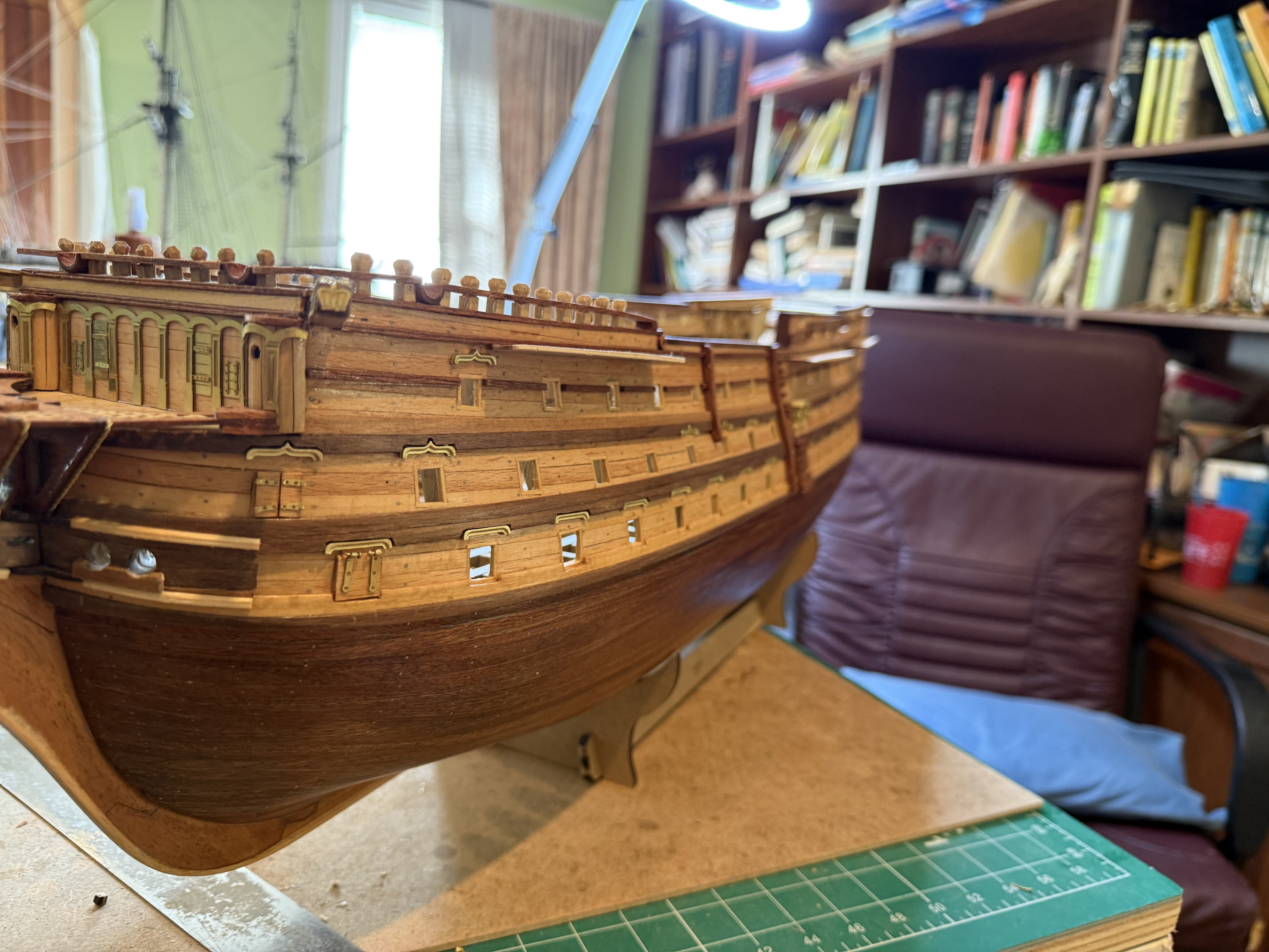

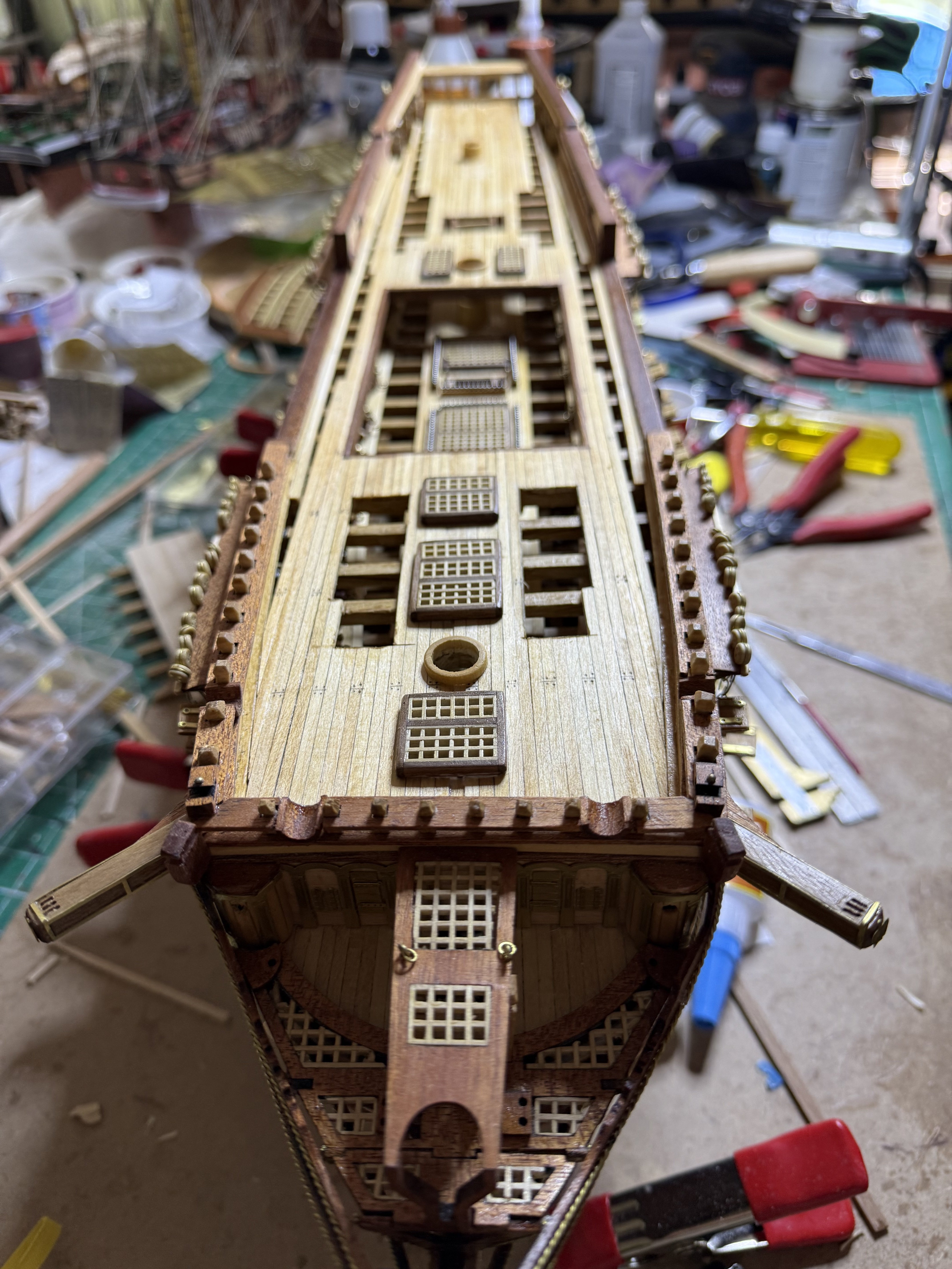

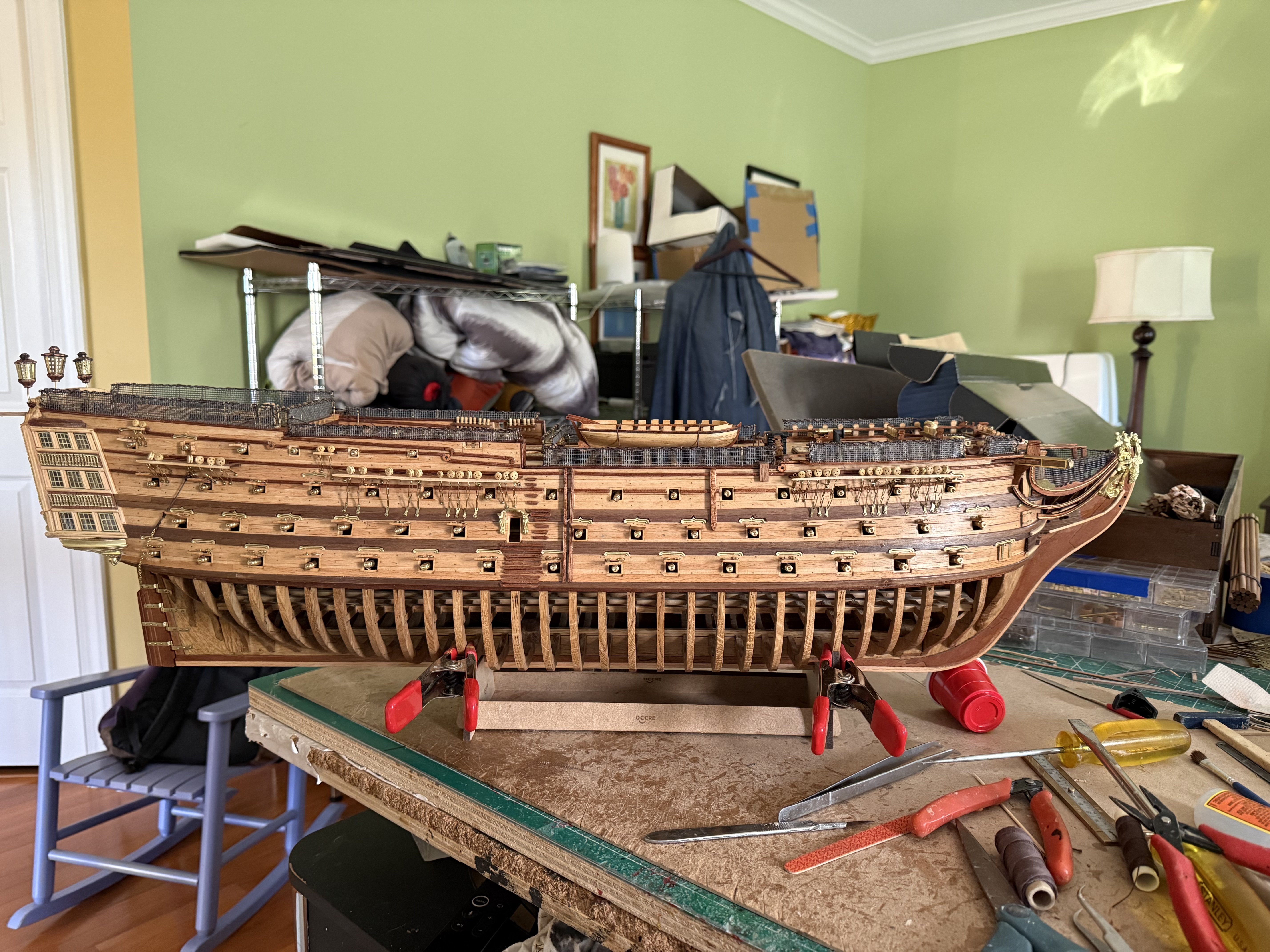

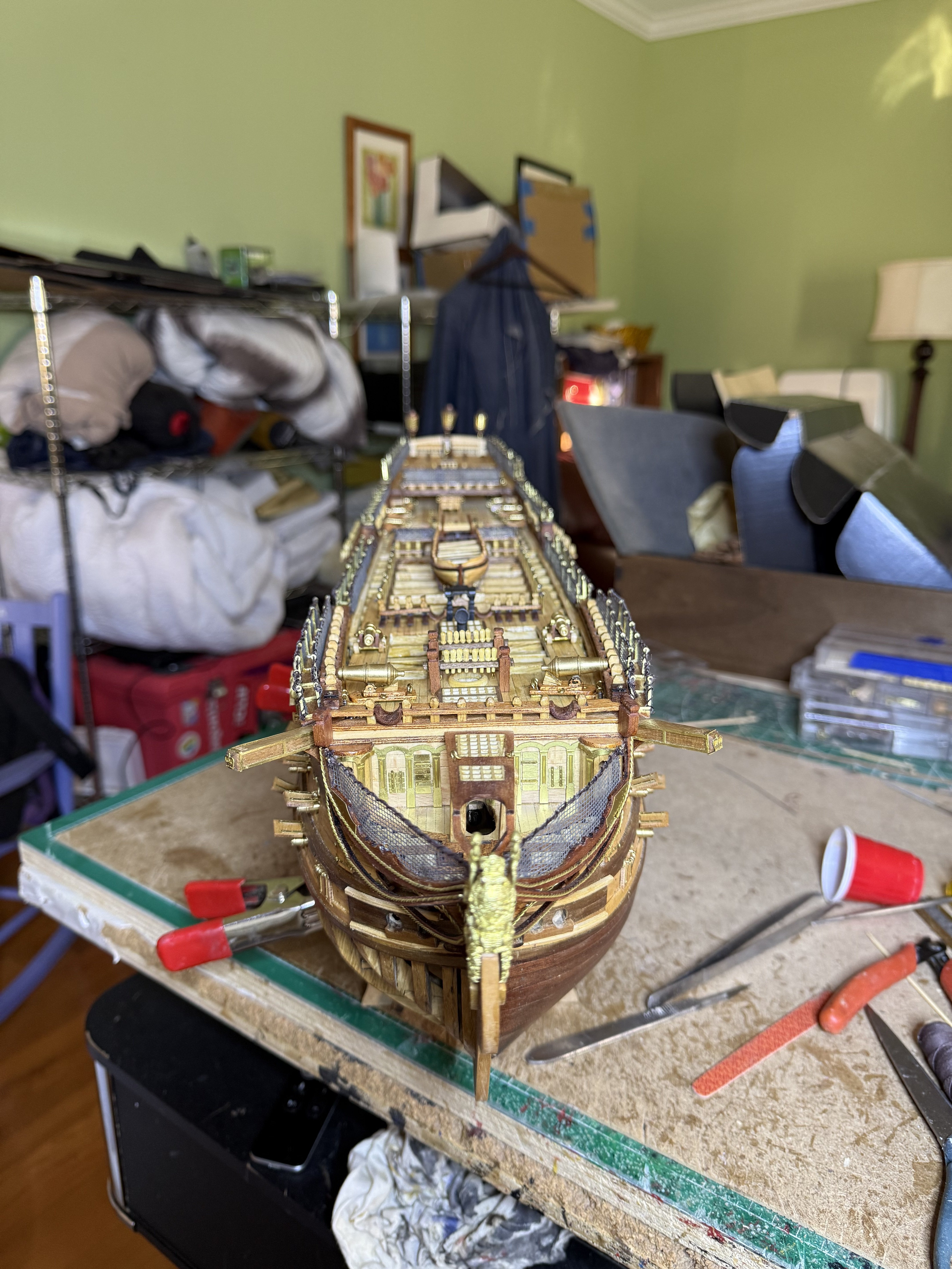

Last work for the day. I think another 2-3 weeks to complete the hull minus a few things I add later like the anchors, flag pole and davits As i tend to break them while doing the masts and rigging as they stick out. Big pain will be adding/sewing in the nettting.
IMG_1063.thumb.jpg.7db3d3948f30574578e6c5d1e3393159.jpgIMG_1062.thumb.jpg.ead147cdb69c7b1b9475f68c3513c946.jpgIMG_1061.thumb.jpg.fc8e3de3e5e0b2a0f9922f7d5261fbca.jpgIMG_1060.thumb.jpg.480dca28f408c99be8480c3eddebffc3.jpg

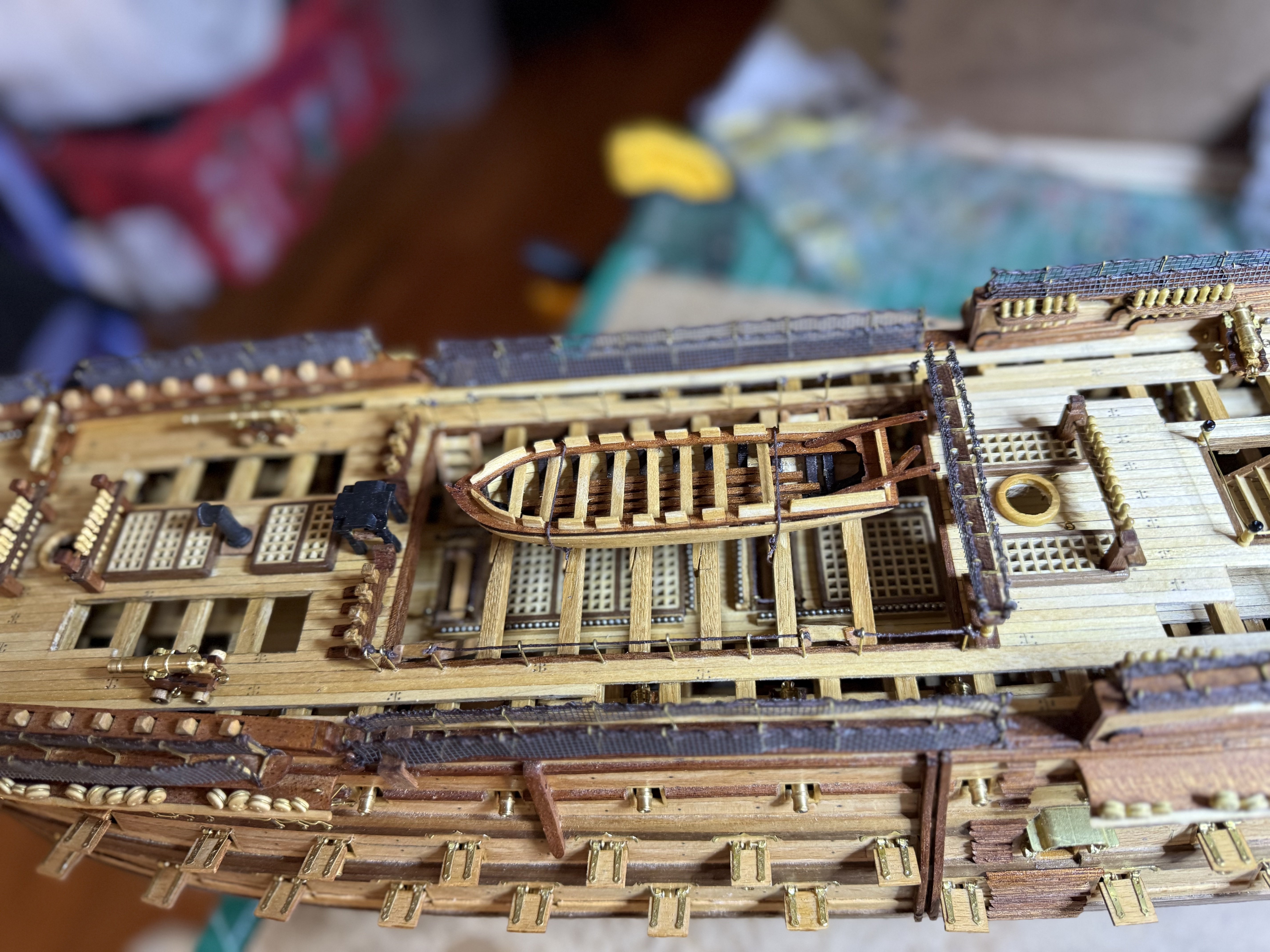

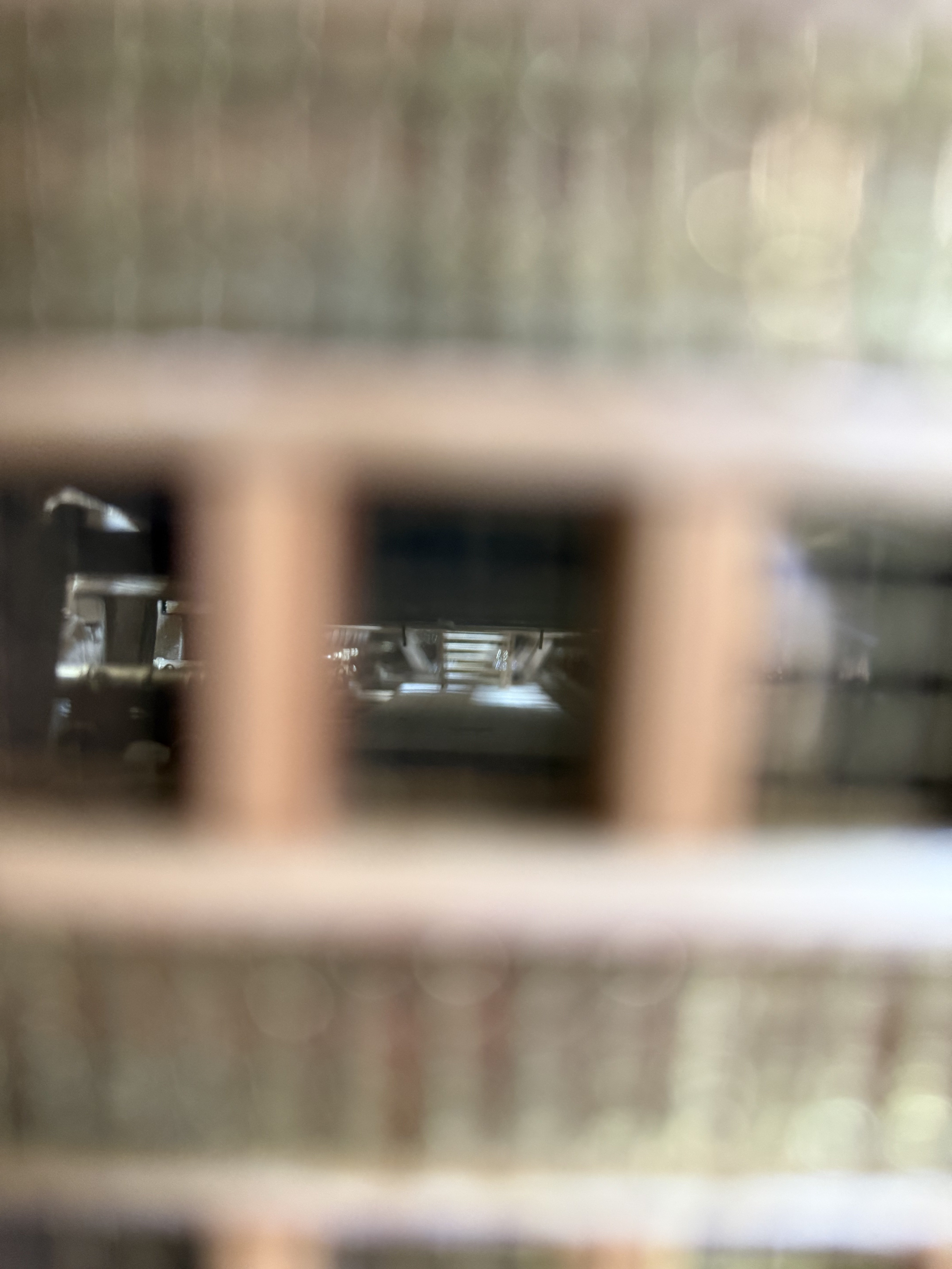

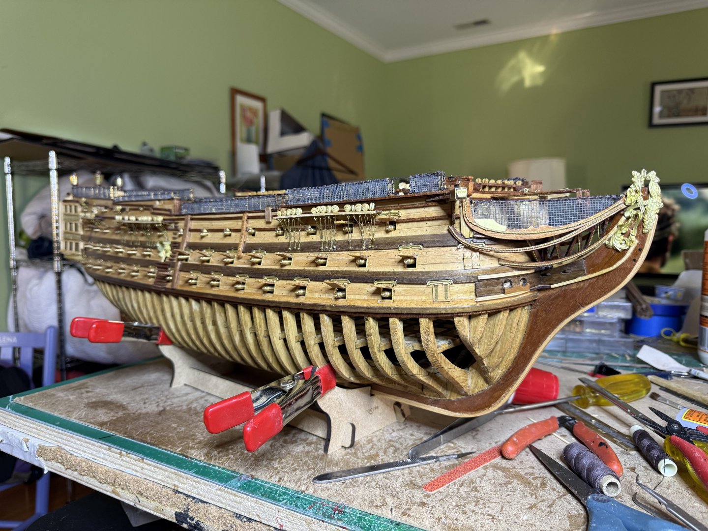

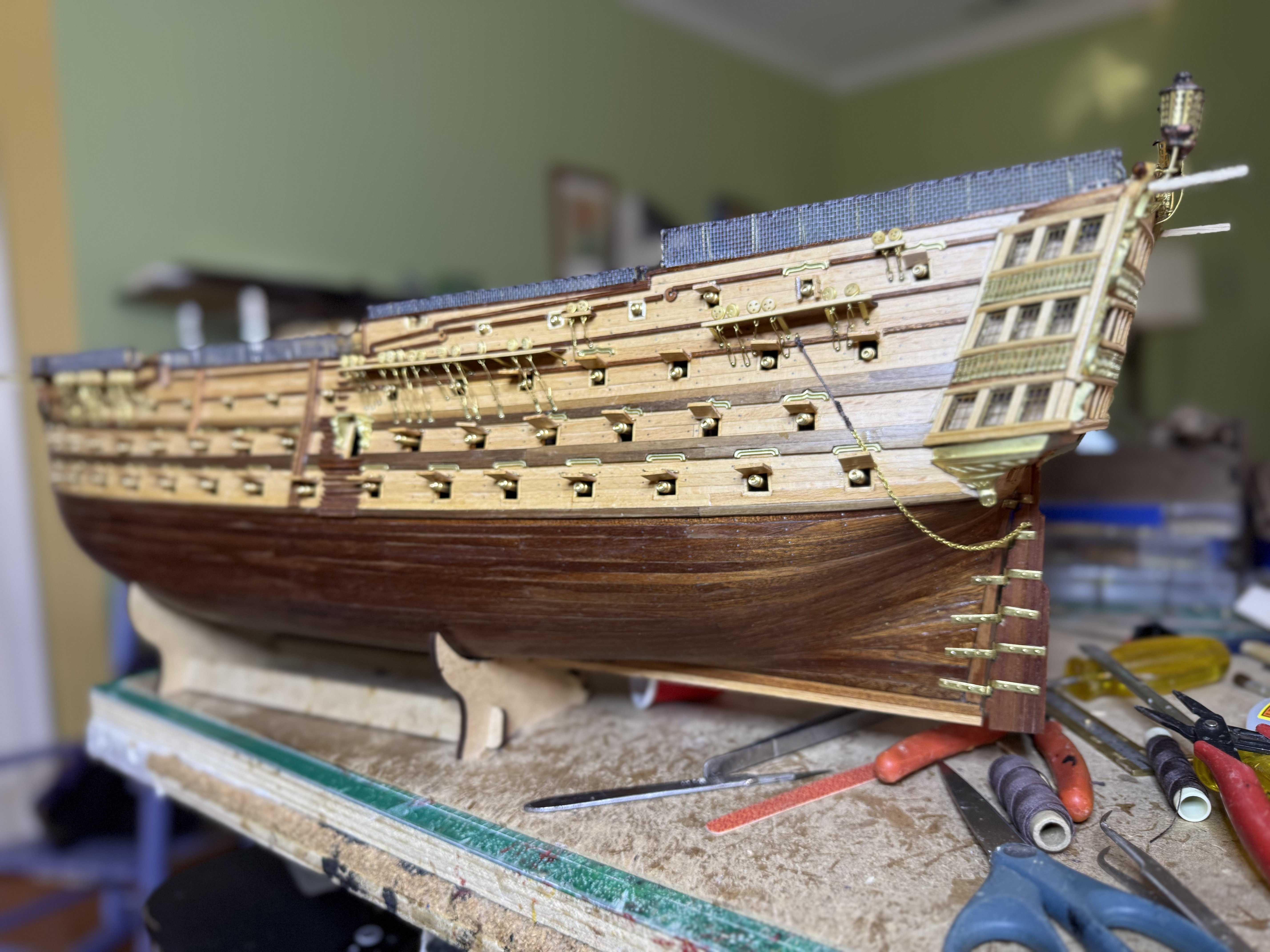

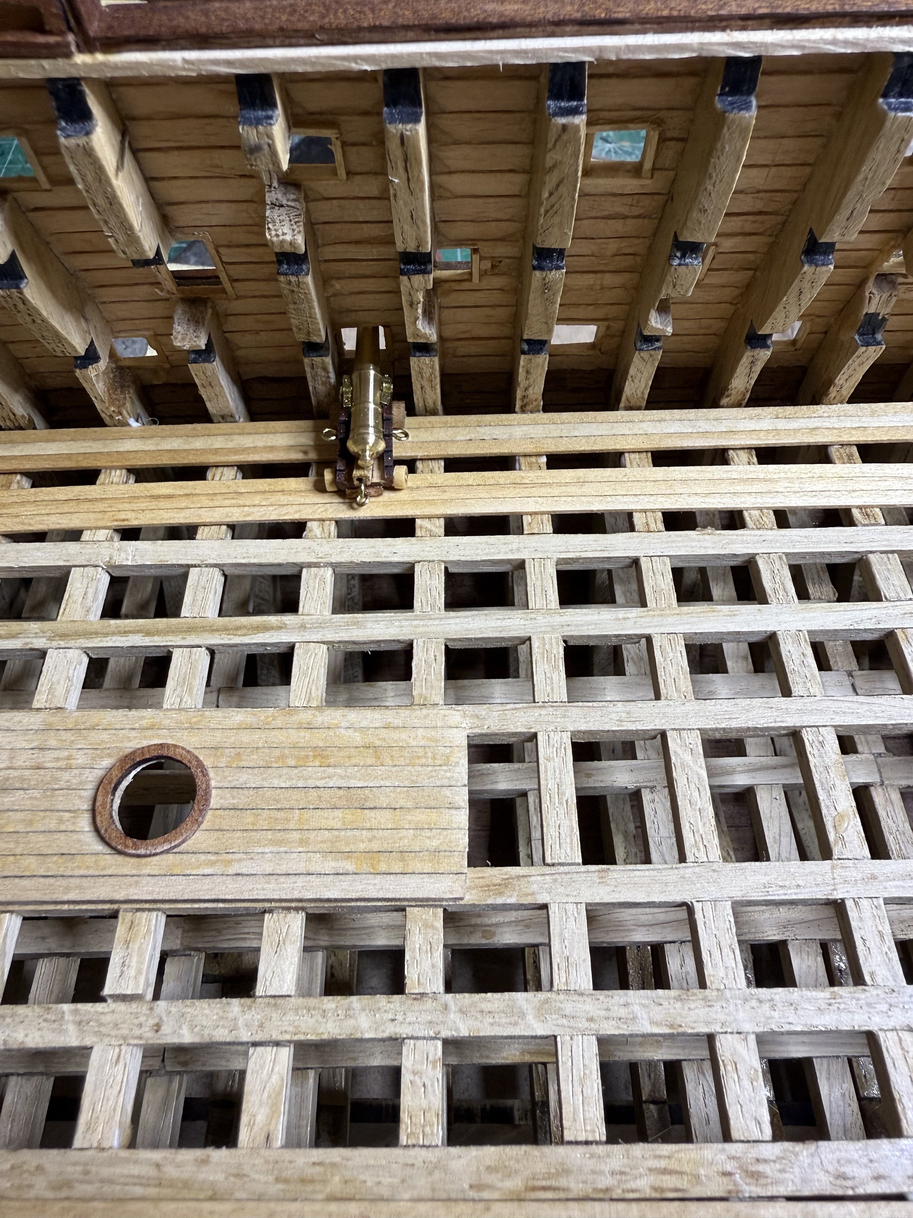

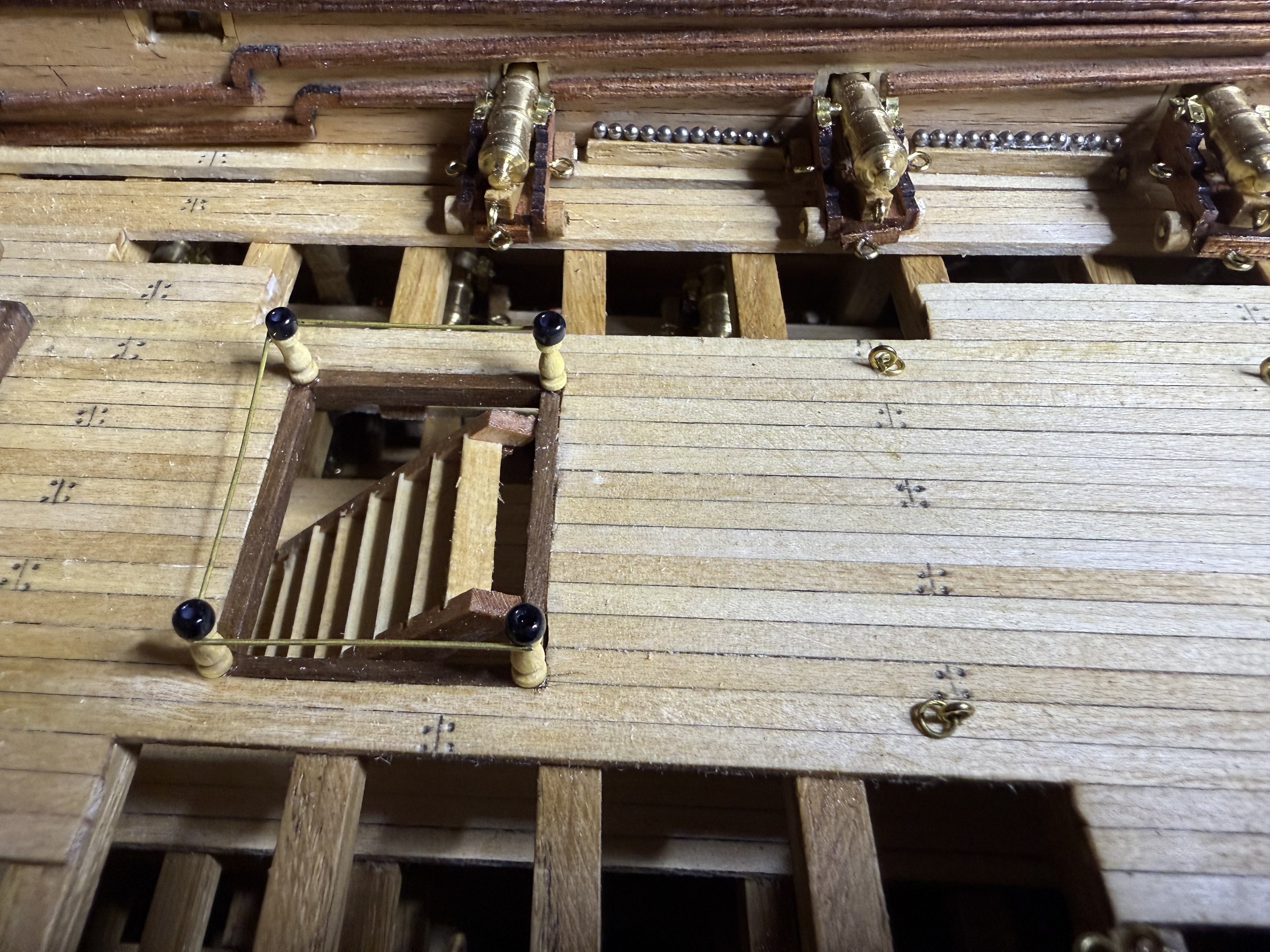

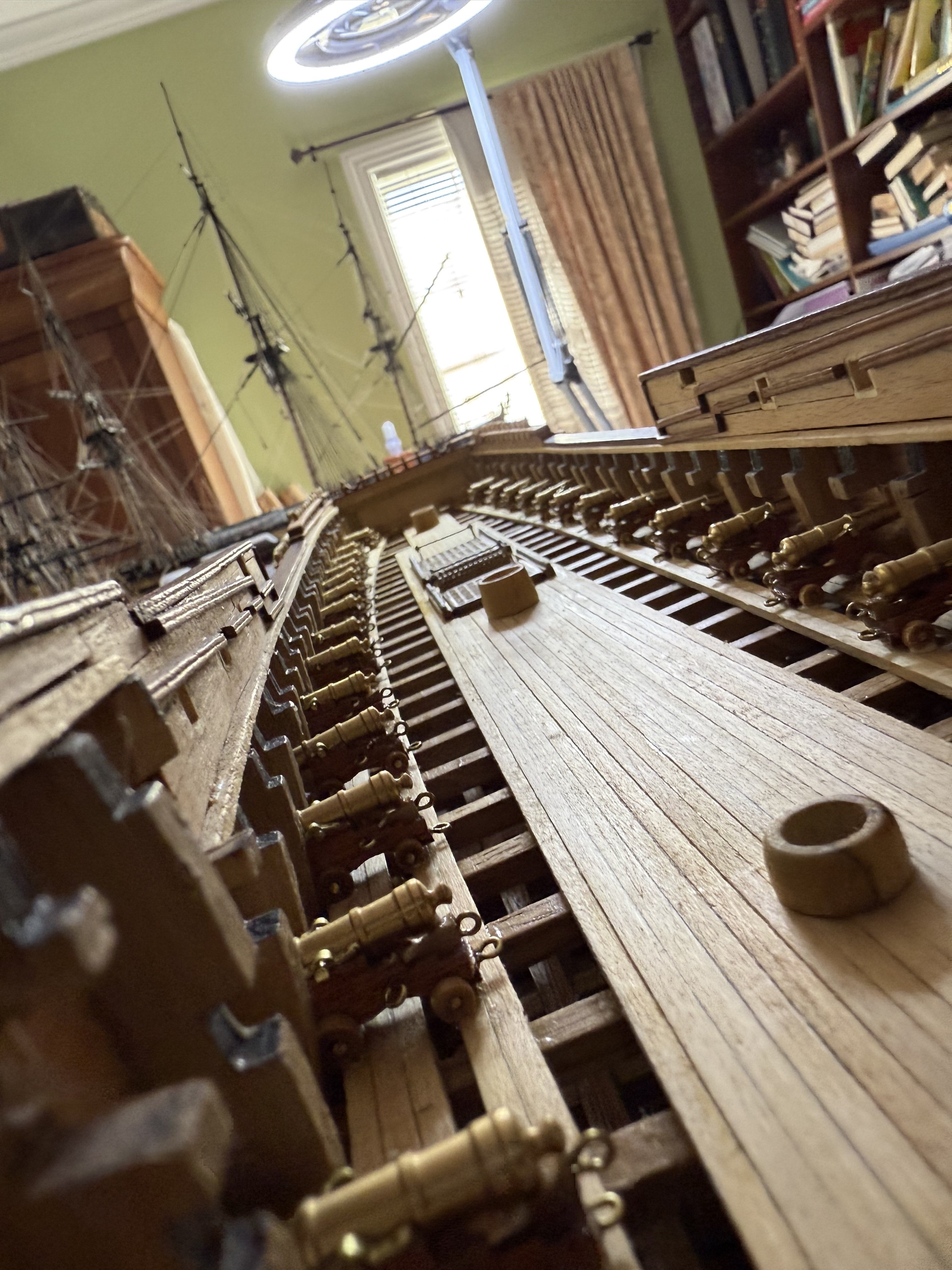

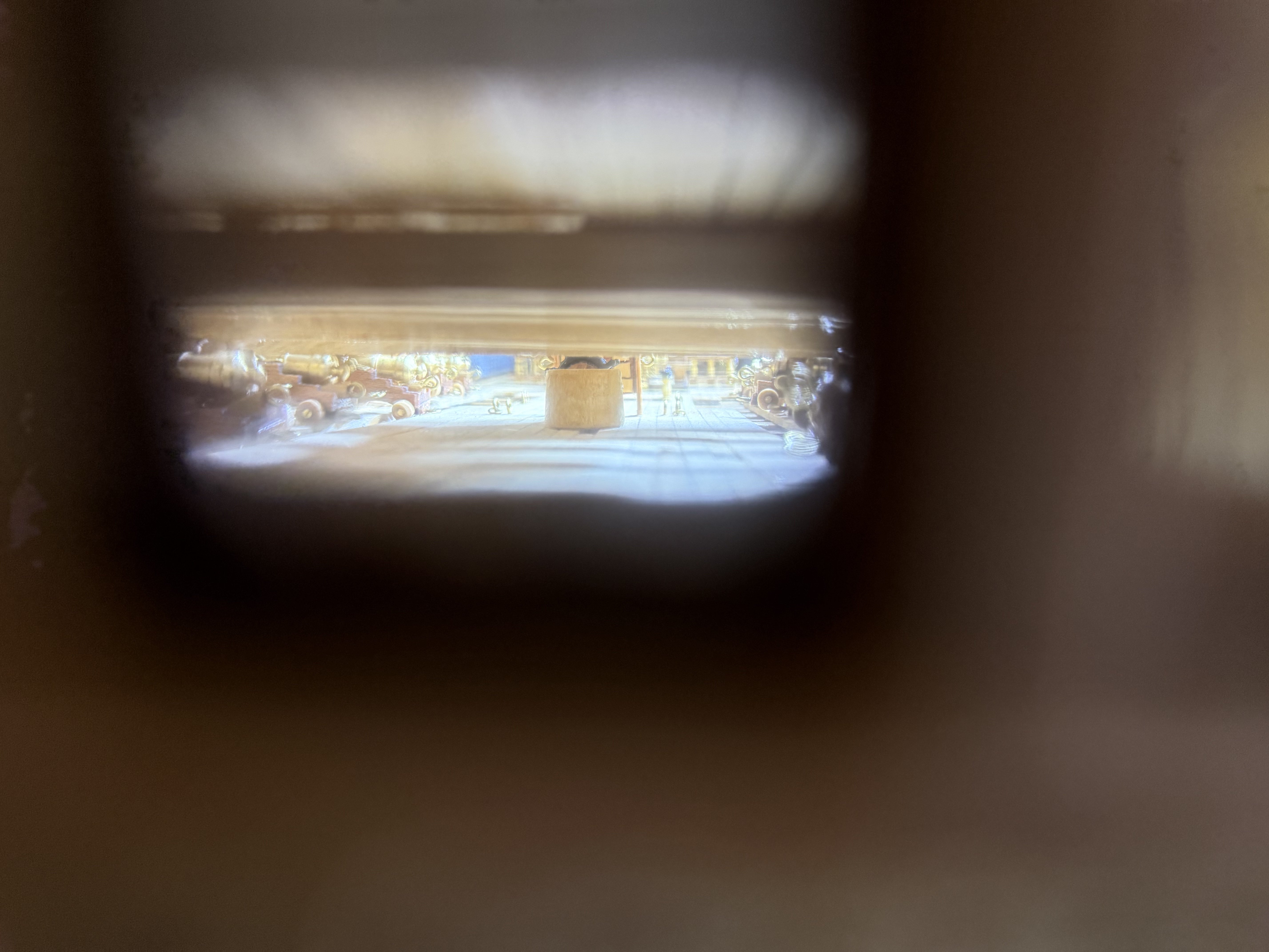

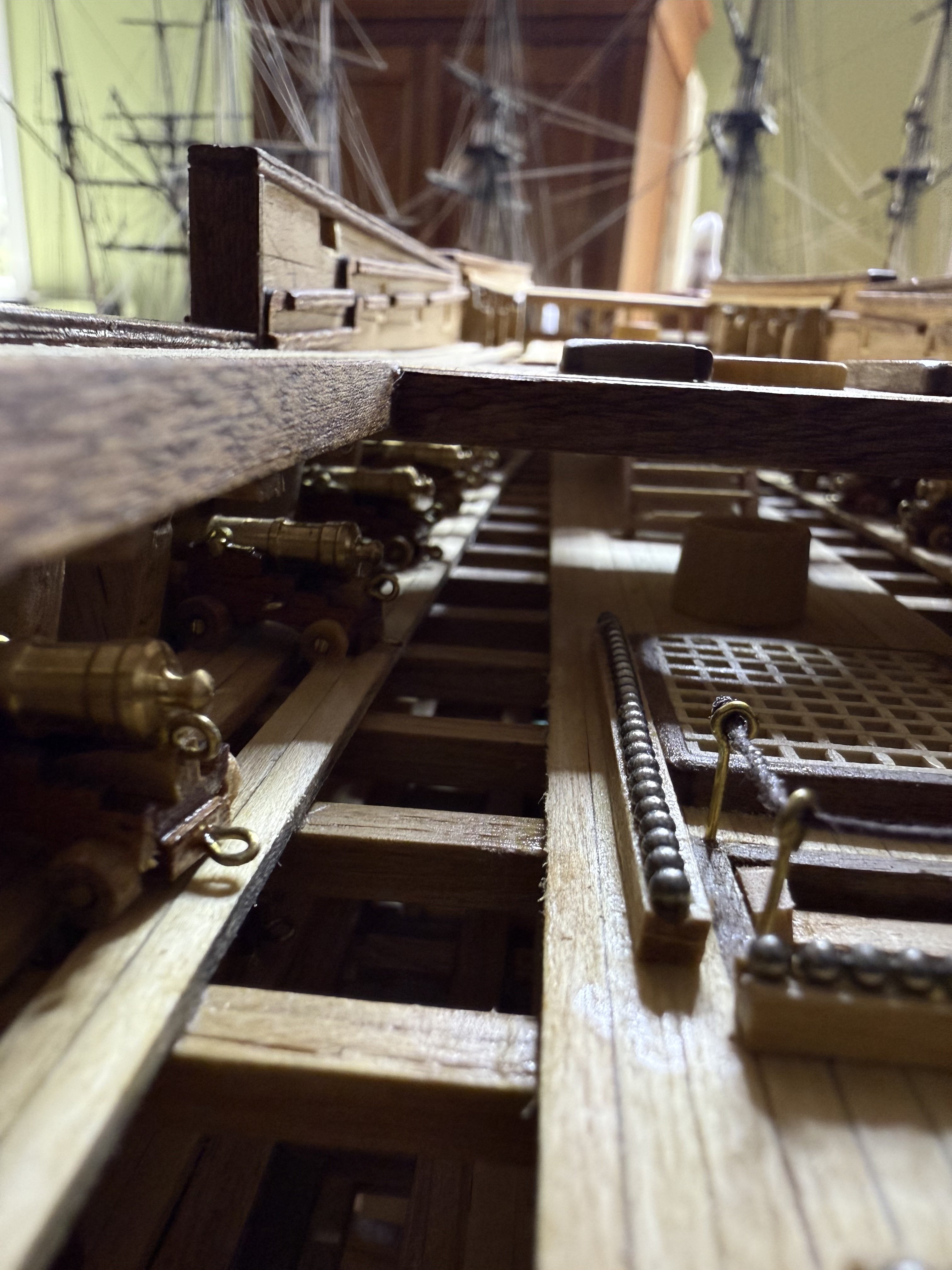

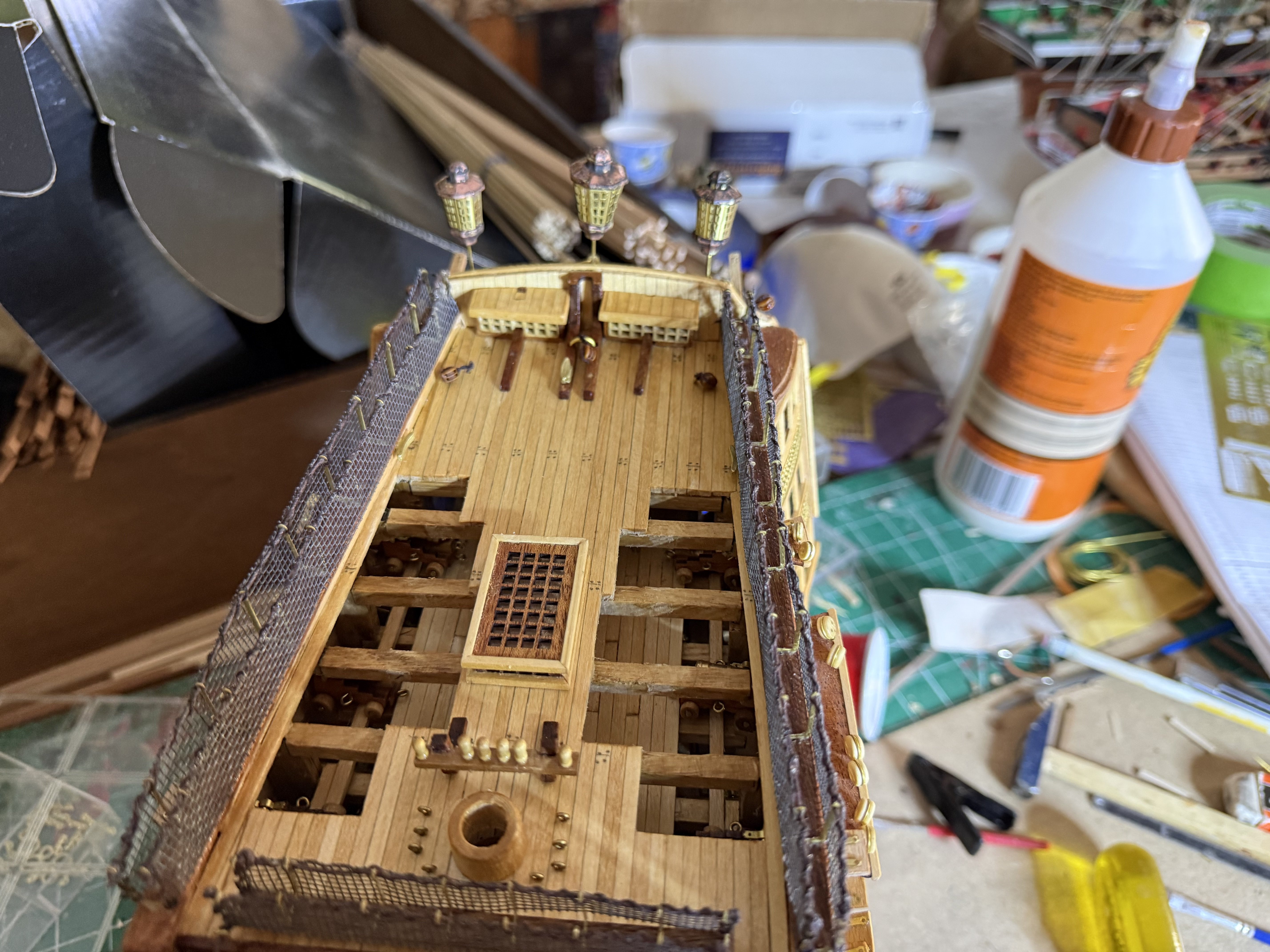

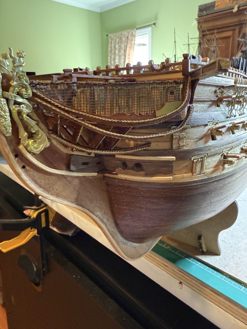

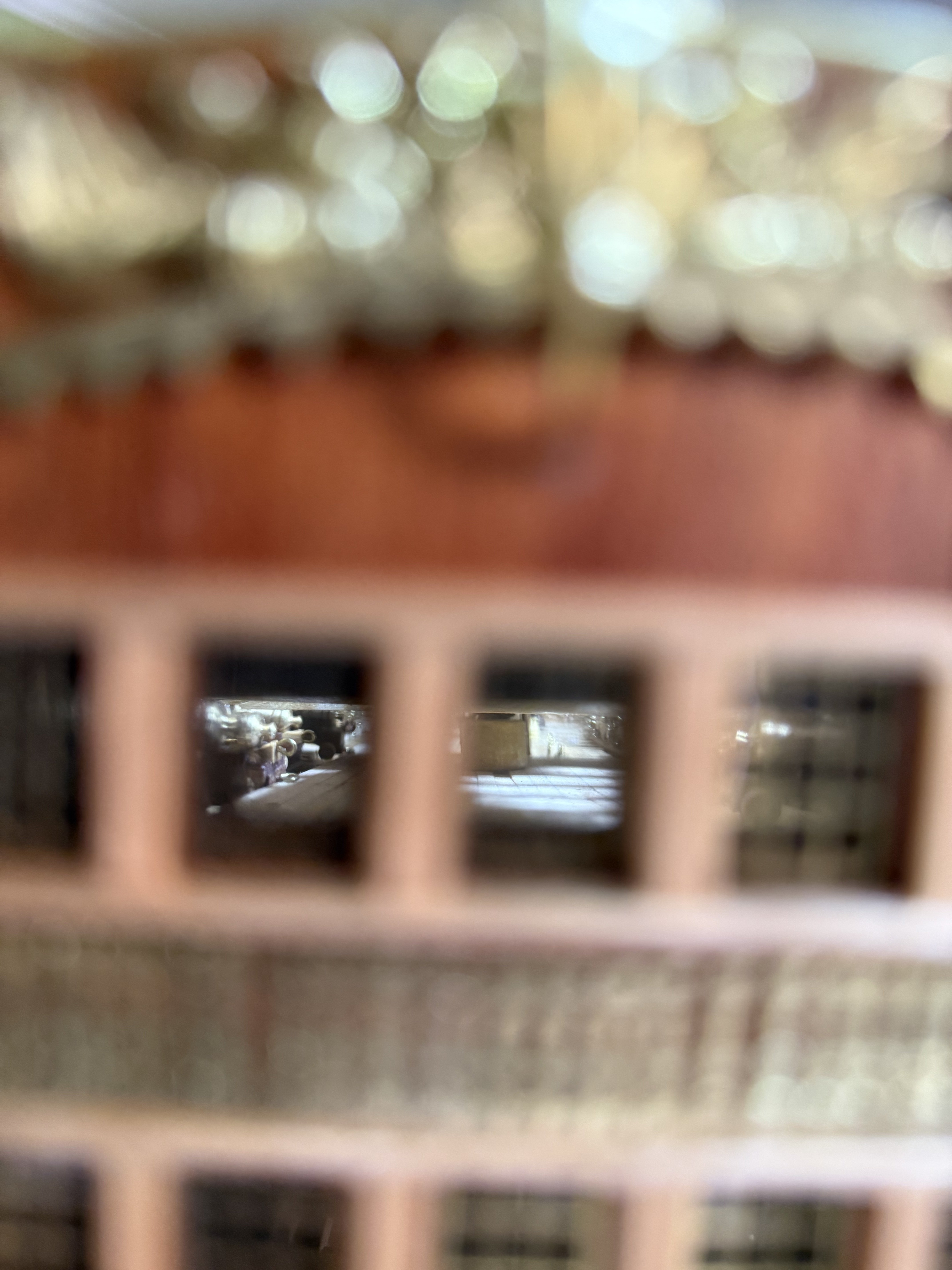

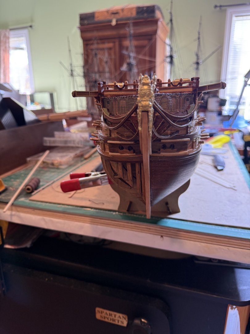

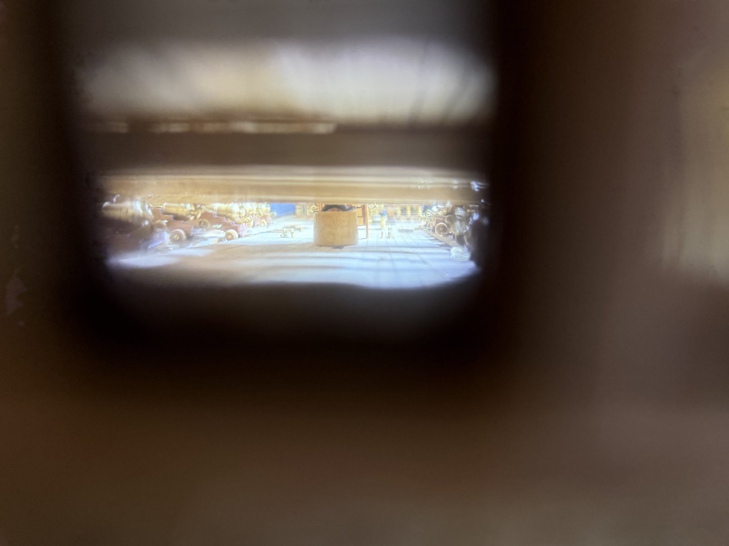

okay, the hull, minus boomkins, ship's boats on the davitts and the anchors (all added after rigging) is complete. Some pictures are views through the stern windows to see the lower decks. Looking at the mast plans, they don't provide a laser cut tops but require you to assemble them from multiple pieces pf wood. For a kit this expensive a bit cheap.
IMG_1074.thumb.jpg.4c1f294e522f99e6107a684113424a12.jpgIMG_1075.thumb.jpg.e8c8470f1833b978c398d37f7e2fa4f3.jpgIMG_1076.thumb.jpg.cda6e3b80855a4245f1bbc1c436a6843.jpgIMG_1077.thumb.jpg.84fabe6e518cbffe2b0c09b7692498b5.jpgIMG_1078.thumb.jpg.34a4b1d8d8059f0c0fd821e41afadcdd.jpgIMG_1079.thumb.jpg.86a8d9f2a7ed0c5e29b57b37f7f58031.jpgIMG_1081.thumb.jpg.7324c7c676c3bc7a296dc89275619e75.jpgIMG_1080.thumb.jpg.ff1c3fa1dfe912252472d07cba2129d3.jpgIMG_1090.thumb.jpg.e43b01619391266d0cc7a14eb5874198.jpgIMG_1091.thumb.jpg.b355a1bb218269242b7bd8349b9c3563.jpgIMG_1092copy.thumb.jpg.124a7f6fa1a33528e86a56d9b1e93458.jpgIMG_1093copy.thumb.jpg.24ac579ec7153358630af2f98ce8ec85.jpgIMG_1094copy.thumb.jpg.7335e3d062b98b0786df62b7c899cf25.jpgIMG_1095.thumb.jpg.43822811815e51b8381105bdd7b5d80b.jpgIMG_1089.thumb.jpg.5654263d6ac5c0465db3f3ef63a8445d.jpgIMG_1088.thumb.jpg.610bce9f5153256e3d993ee071318a97.jpgIMG_1086.thumb.jpg.640a7be84eb44f6435a3f5fb23f1a93c.jpgIMG_1085.thumb.jpg.38bf46fa3a074a39eedbc7a9ebe73a01.jpgIMG_1084.thumb.jpg.a3b9e95be9e3c9eeb5e332bfaf075db9.jpgIMG_1083.thumb.jpg.06924cbc97e3867585a881c6f49653ce.jpgIMG_1097.thumb.jpg.a4ced3bda44abb9a5959384ab1d269cb.jpgIMG_1099.thumb.jpg.f2da6640c9472f149a91f818b826d5cd.jpgIMG_1098.thumb.jpg.c2a902a9f2919b66ddd19fb6aa170a0a.jpg
The hammock nettiings took some time but I got a variety of nice curved needles (upholstery ones) which made things a lot easier.

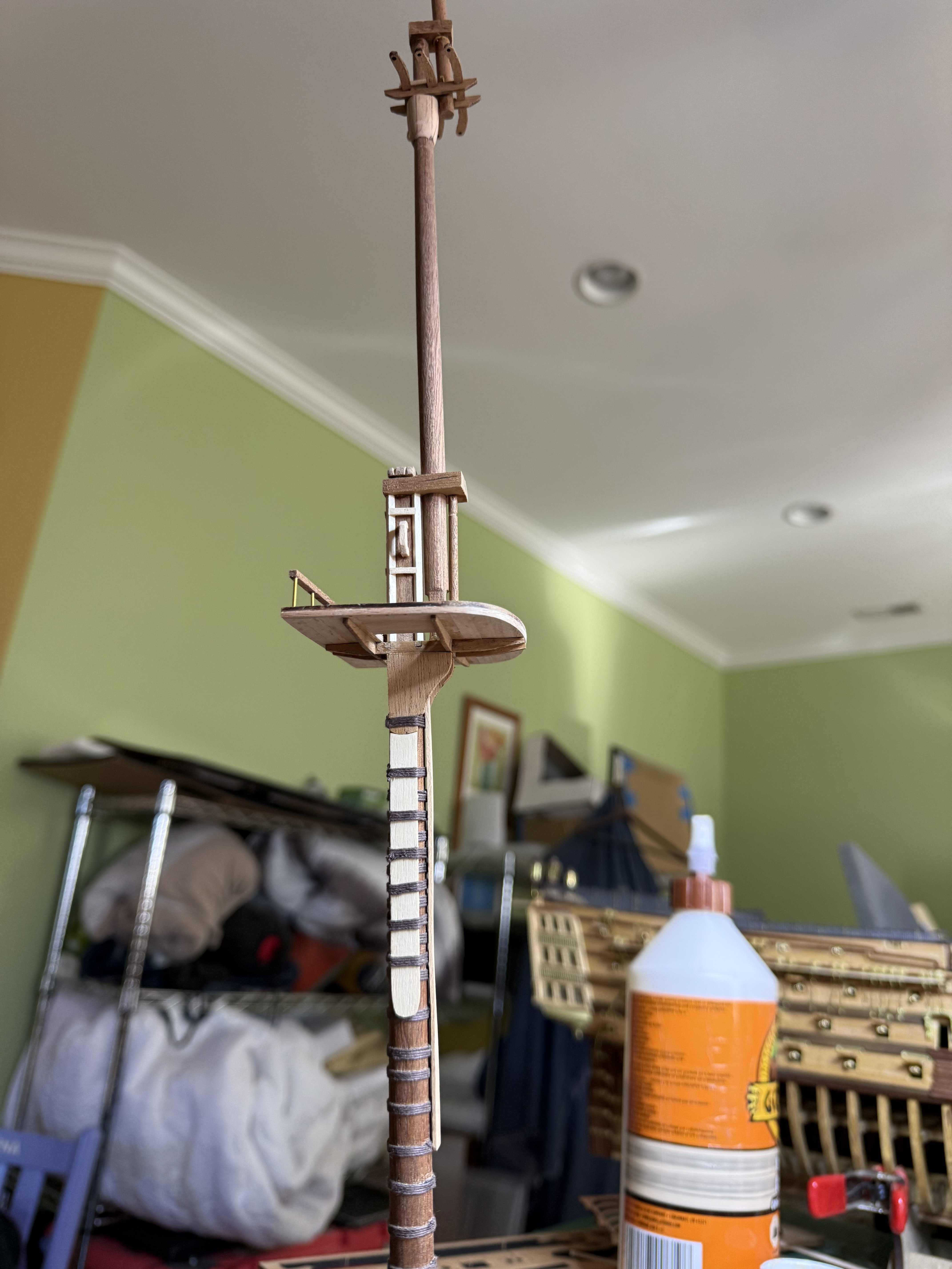

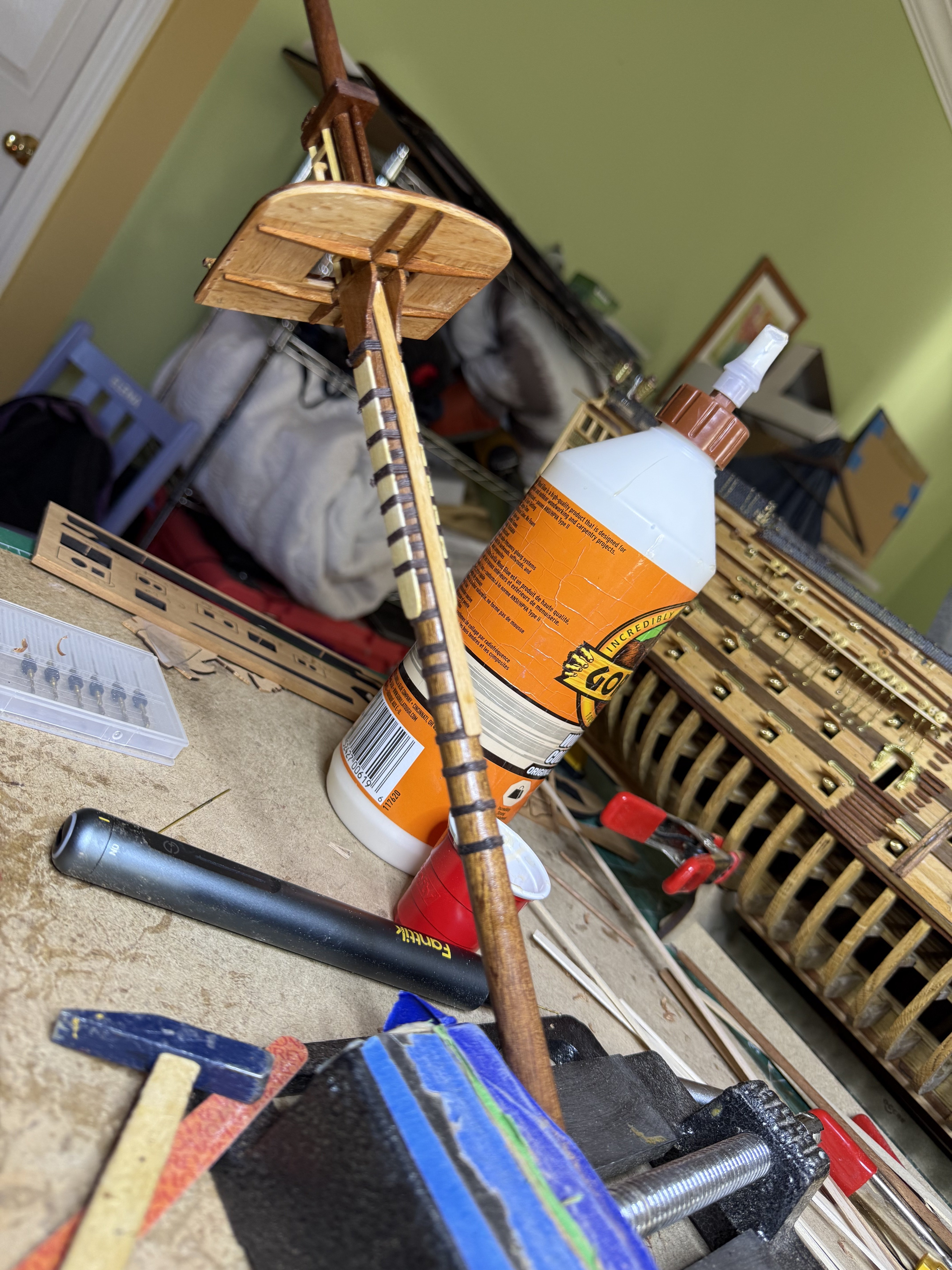

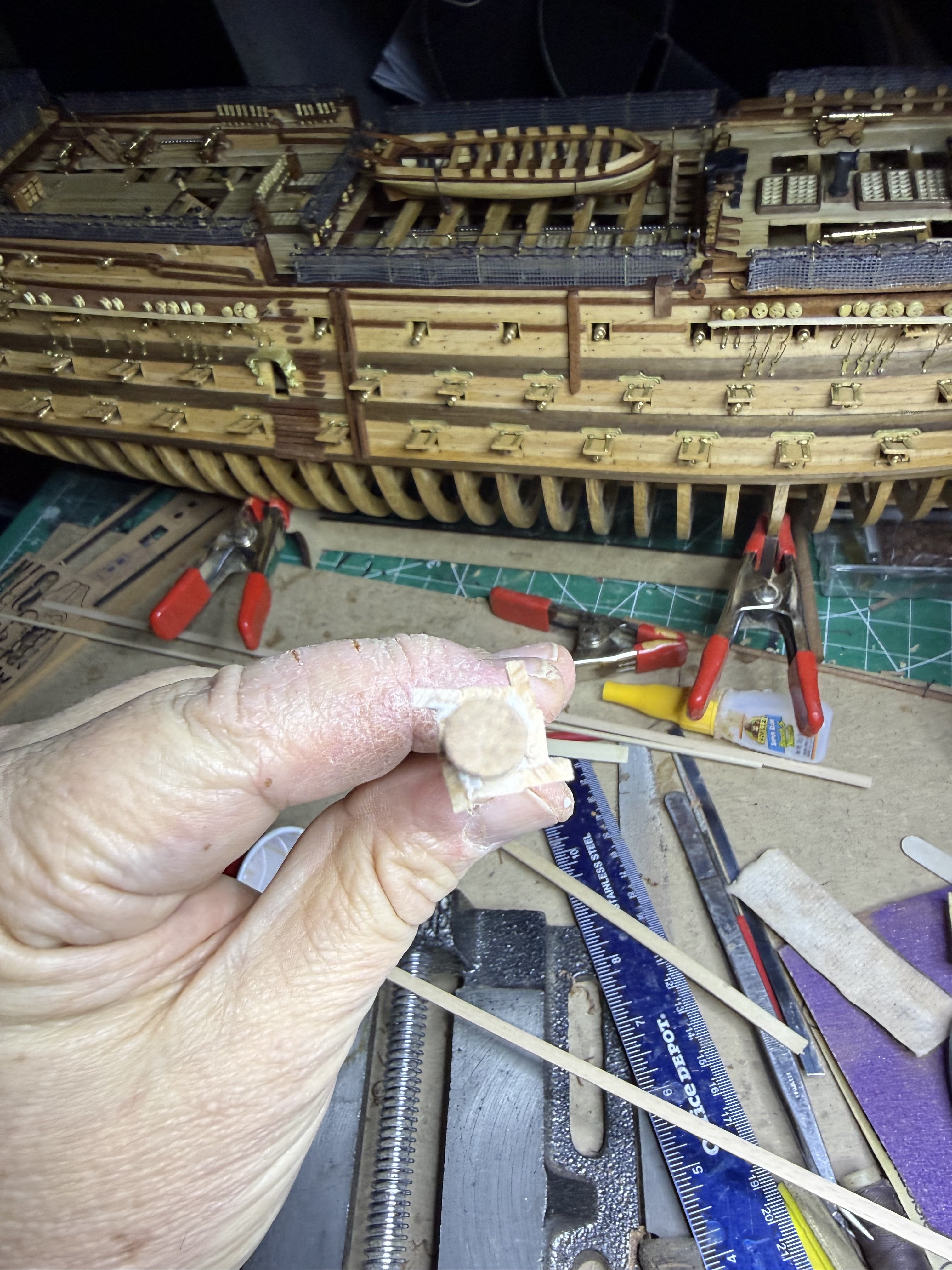

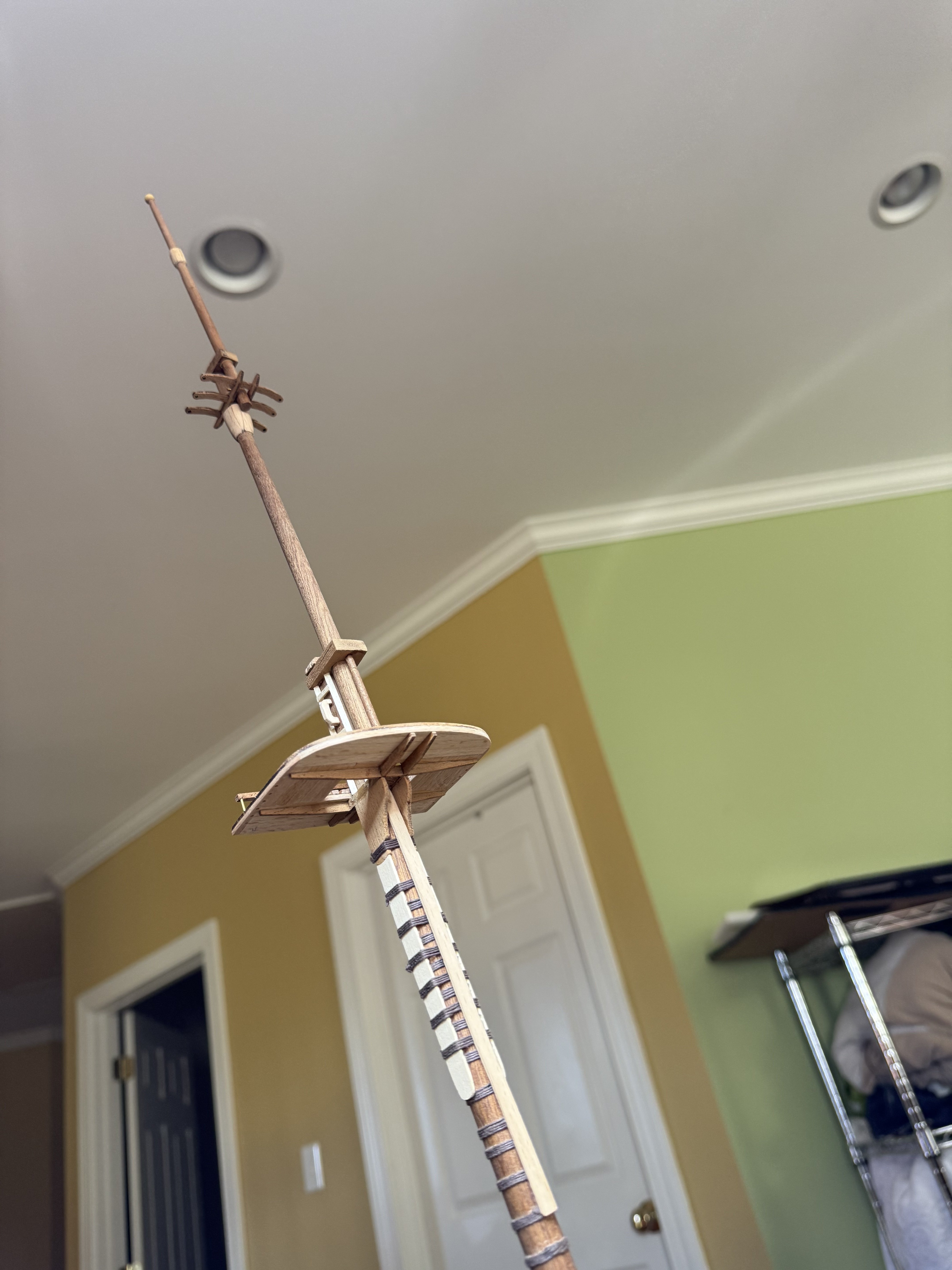

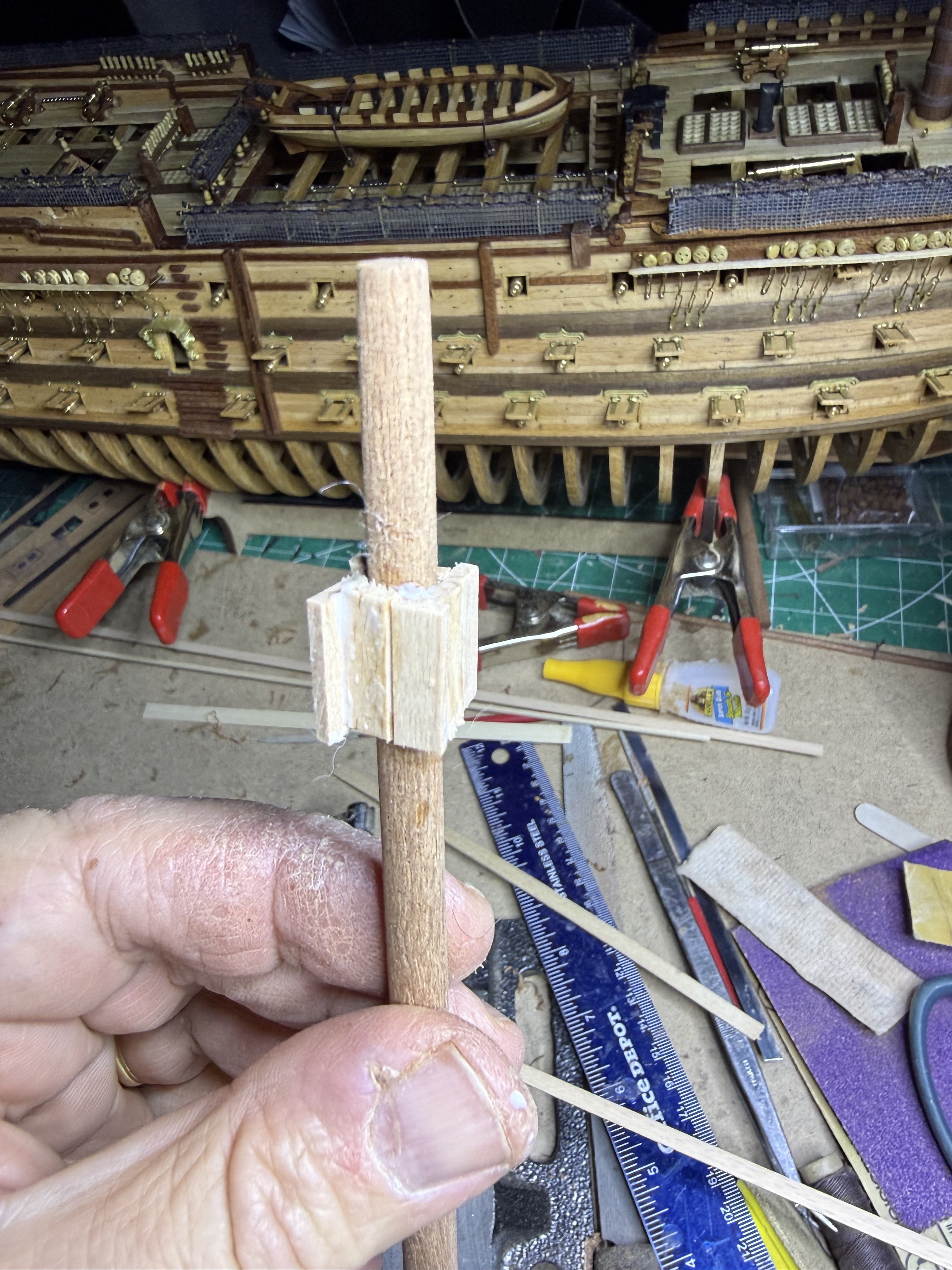

Now for the masts.  First  as I earlier complained, the fighting tops have to be assembled from 2x5 ,pieces of stock. Here is the instruction page provided.
The written part that accompanies the picture book is rather useless, basically saying assemble as in picture.  The part list gives the dimensions for the pieces.
Turned out the assembled pieces were  not wide enough for the premade edges
IMG_1103.thumb.jpg.4d4e93228f60a867f61fb02b4b547c35.jpgS
So added to each side
Next glued the edging on instead of the plans  recs to add ribs first
IMG_1107.thumb.jpg.59669a95ab69e5fd7d823afc7c323dee.jpgIMG_1108.thumb.jpg.b3d5ee391f257fc0476aad797441c141.jpg
Next sanded the top to shape and marked for the ribs
lastly added the ribs, sanding the inner edges flat
One of the mast construction plans.

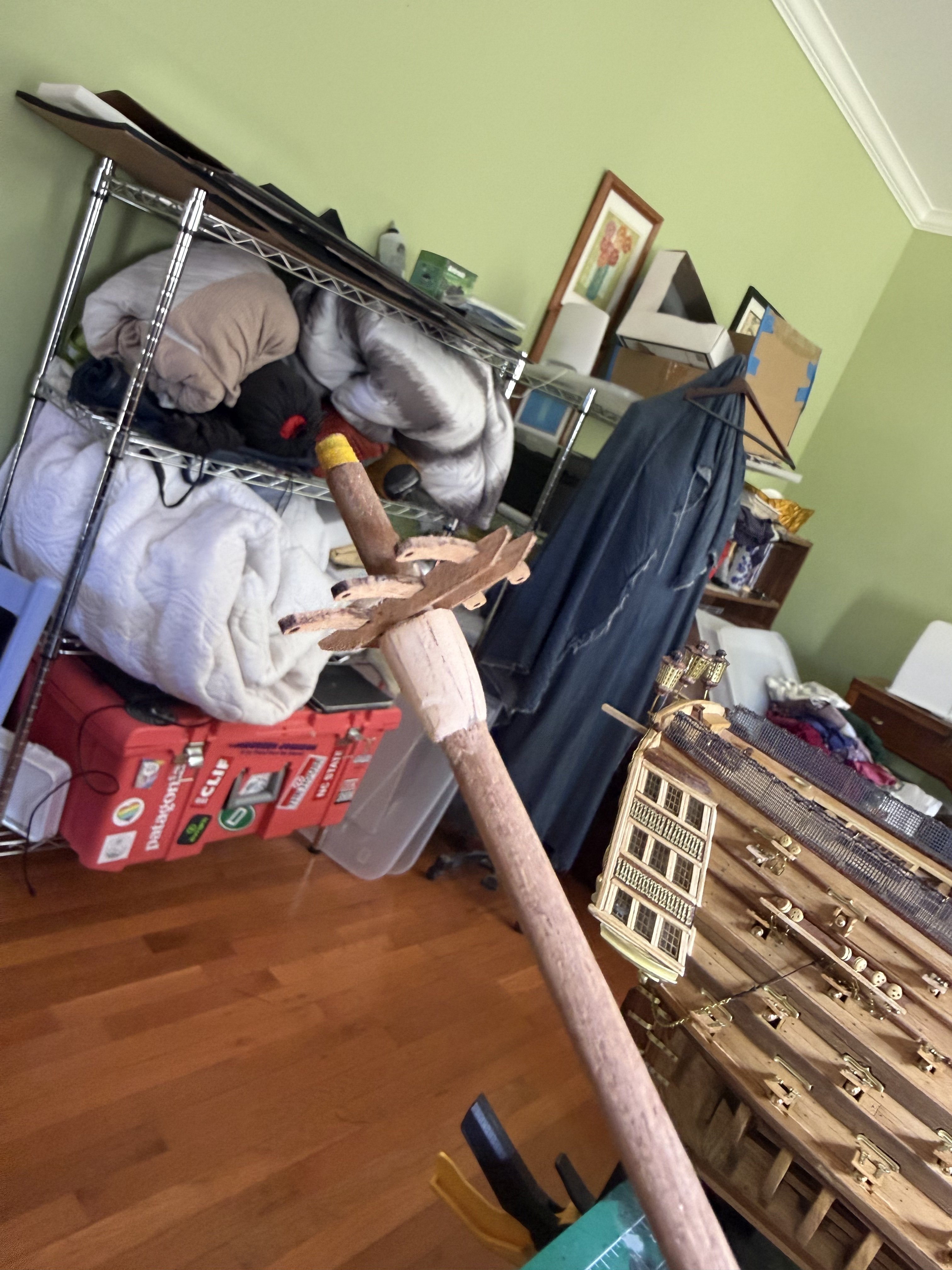

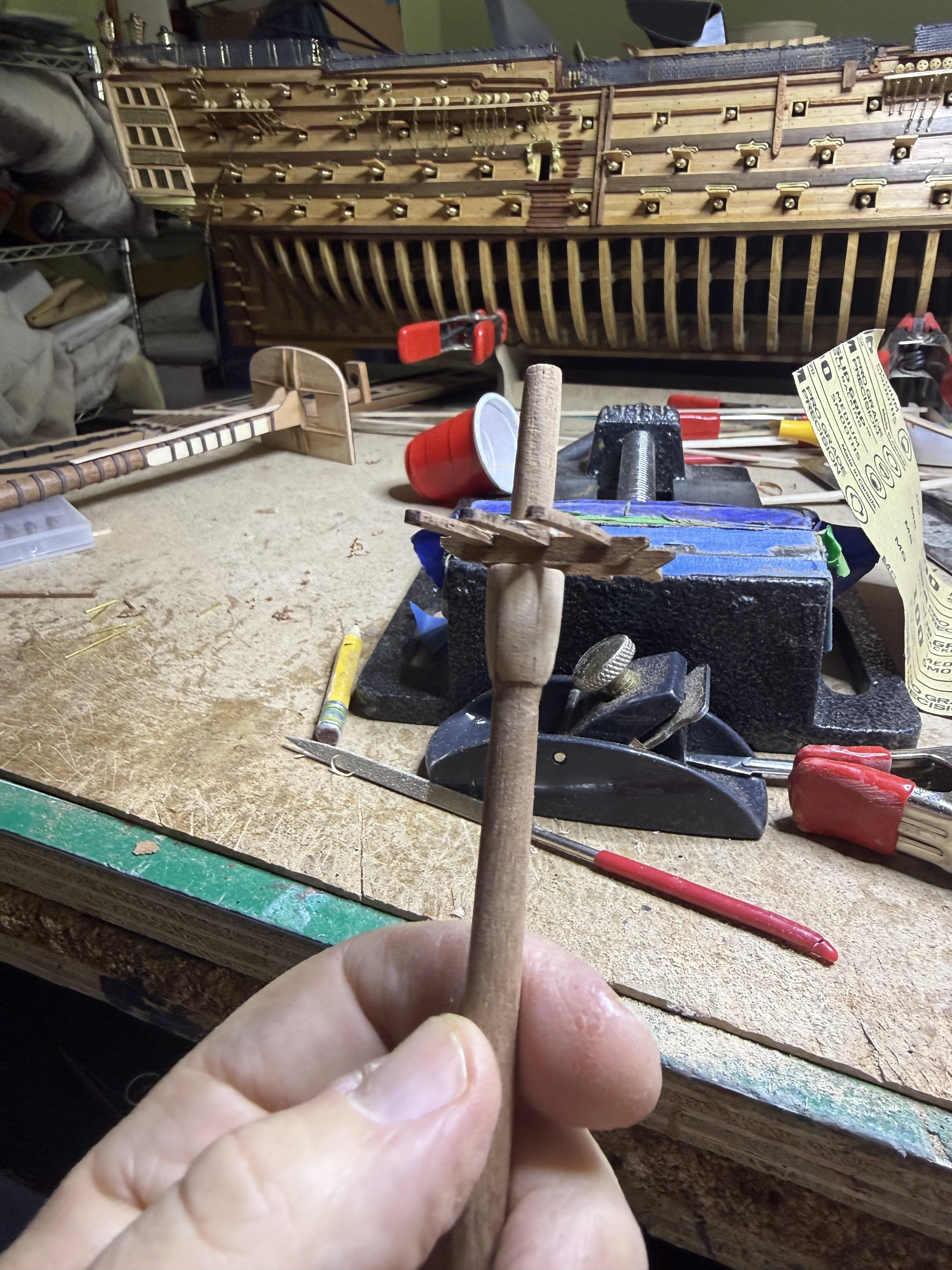

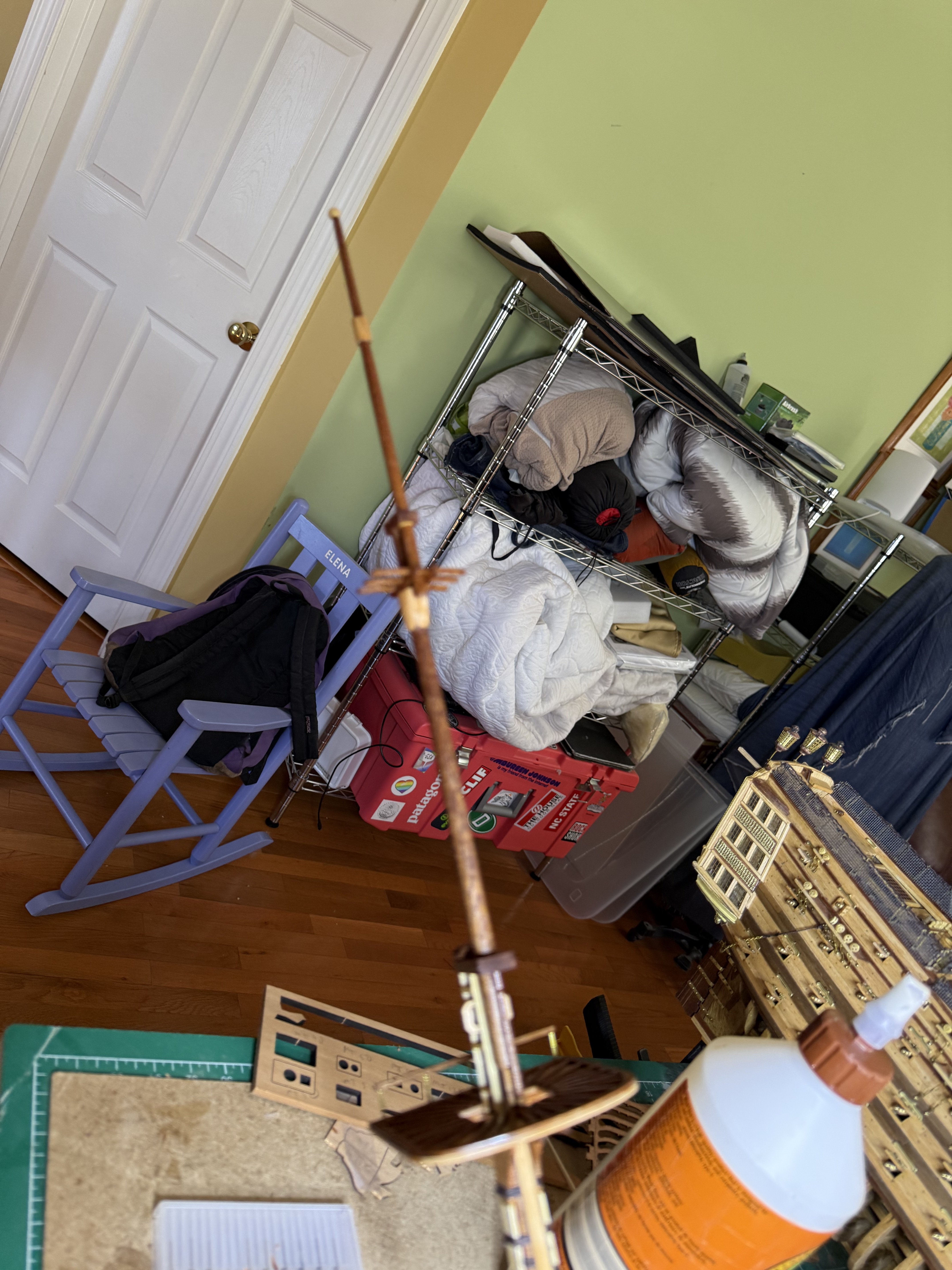

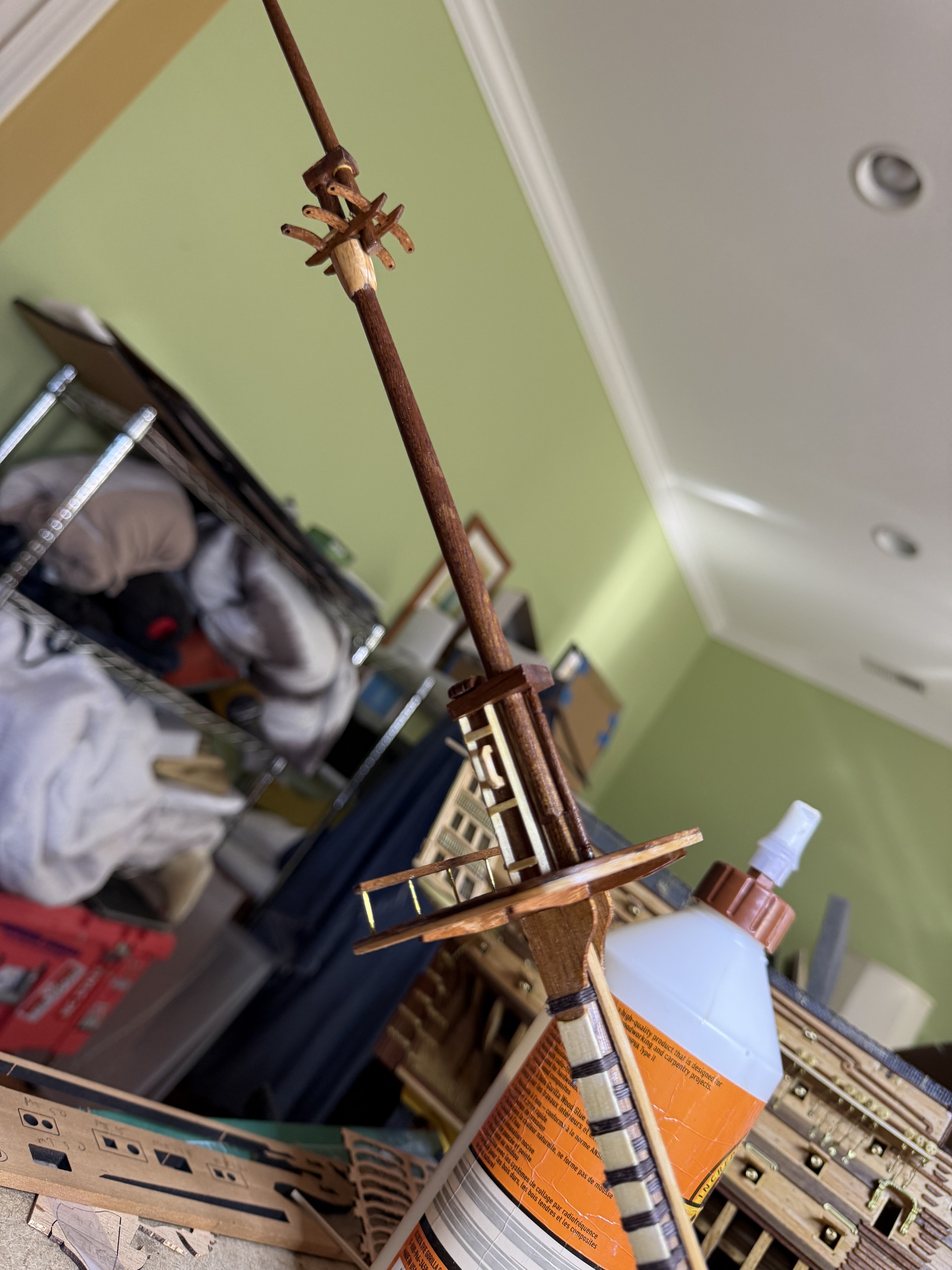

After putting up the Christmas decorations, spent several hours making the bowsprit. Most tricky thing is getting the angle correct for the mast. I was a bit off and glued in a filler piece. Once sanded, can't see anything.
IMG_1144.thumb.jpg.0fb0f3c2c428af56bb156805a3a46e6d.jpgIMG_1143.thumb.jpg.418cabeba5e032d1de2af703894160cd.jpg
Next had to carve out an insert for the pulley
and also make a figure 8 loop from 1 mm brass wire for the spritsail mast
IMG_1146.thumb.jpg.324107d00e9ea827ab9c5e16a1bba6f4.jpg'

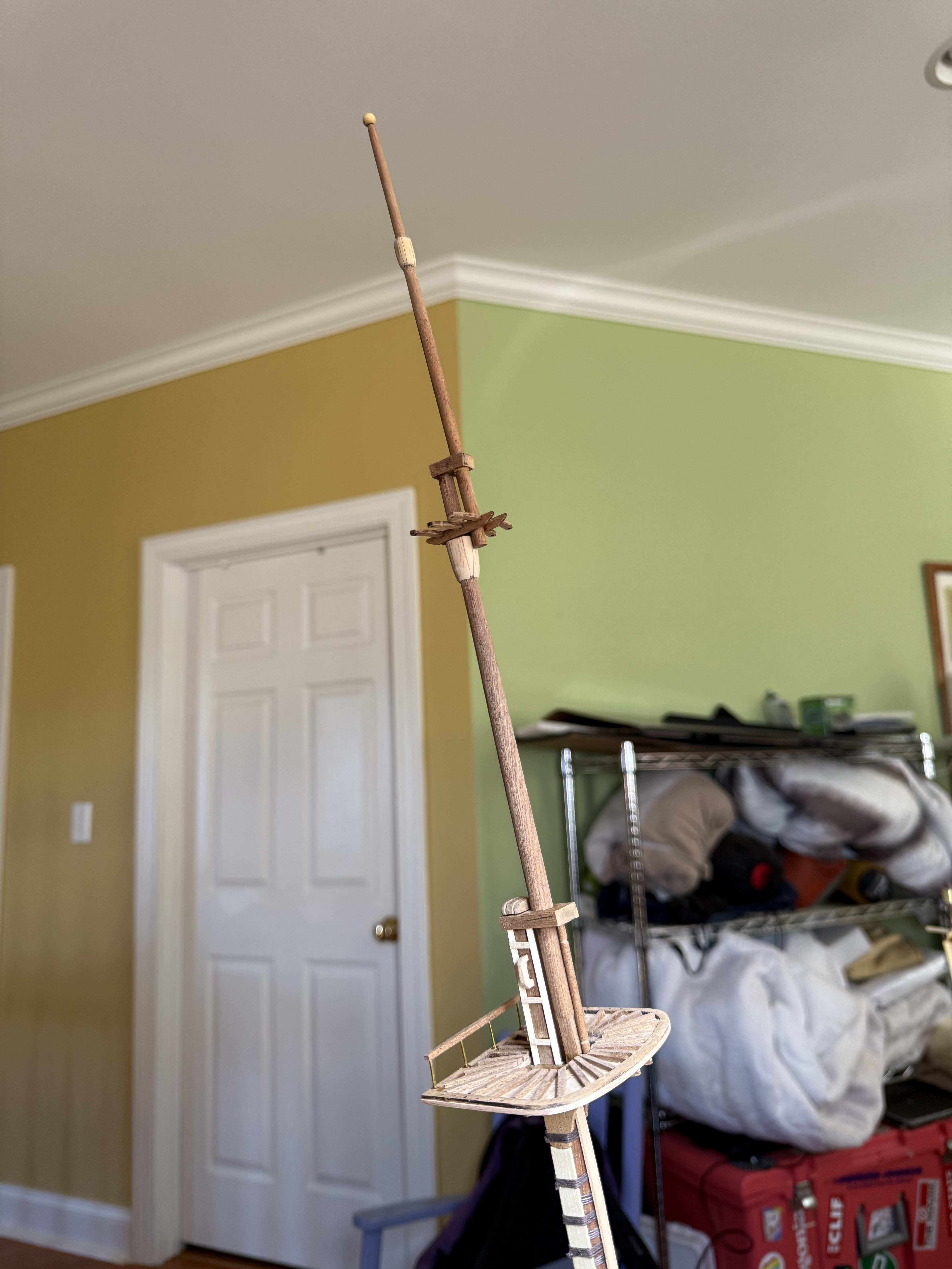

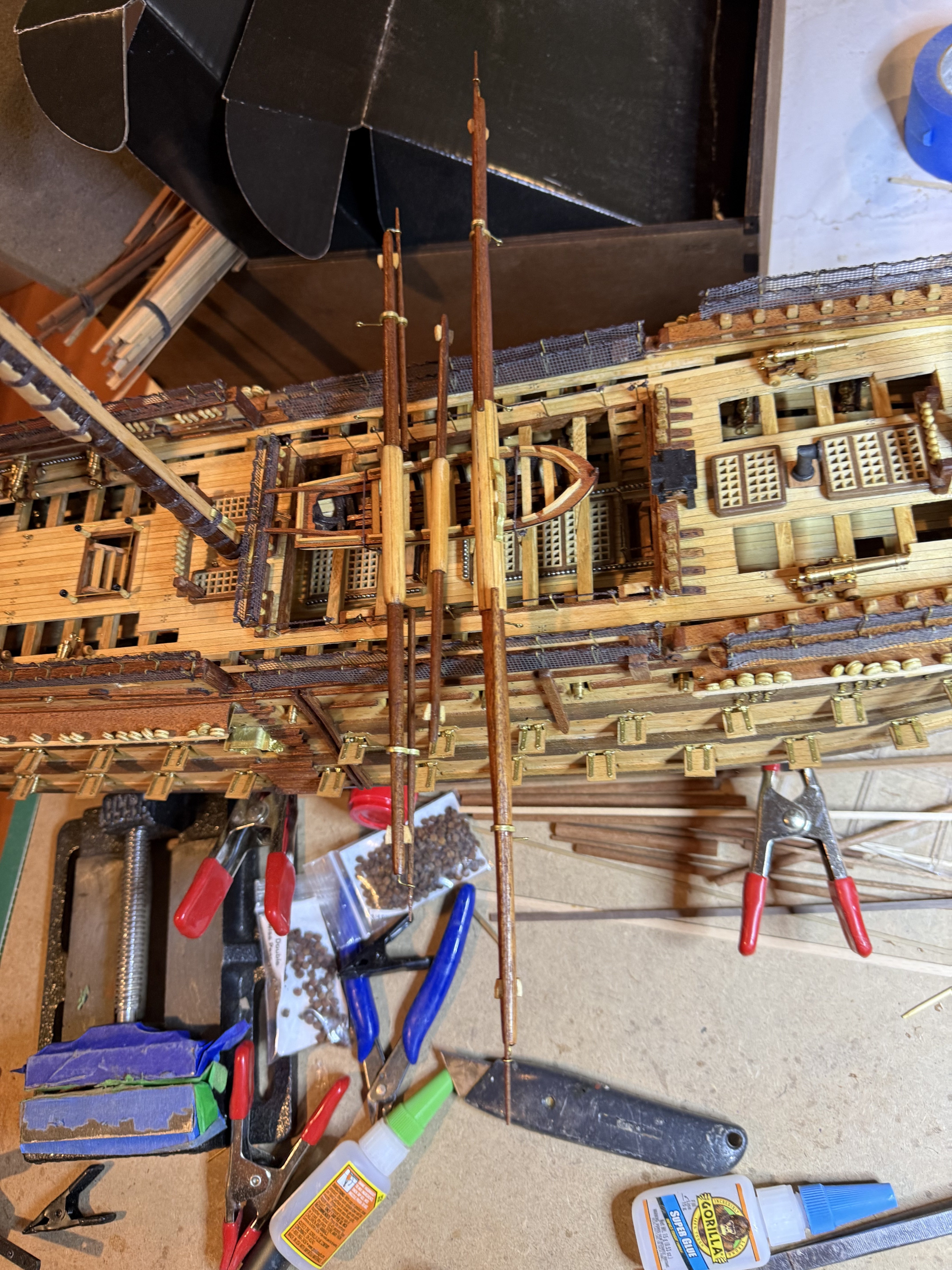

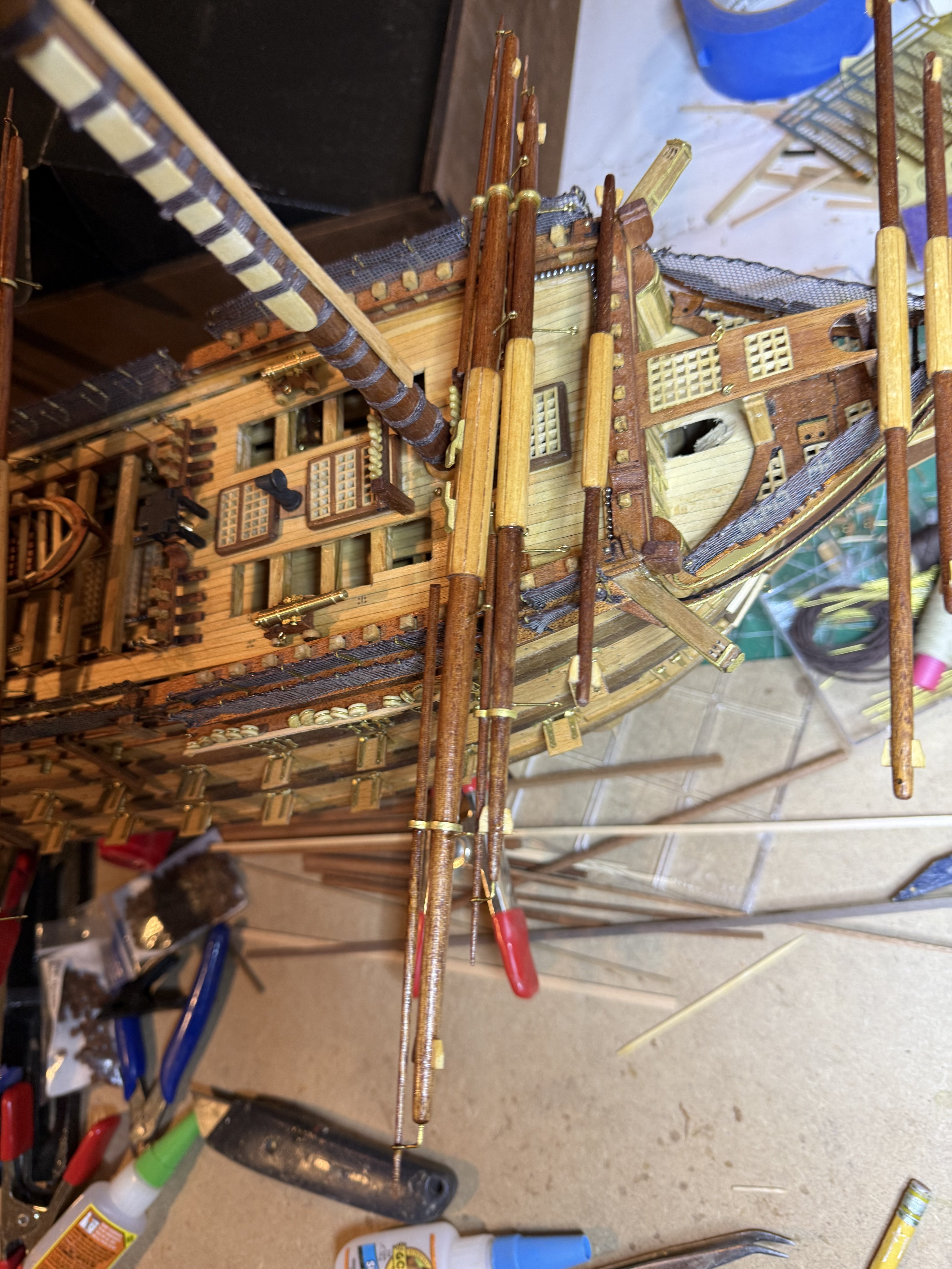

Once completed the masts line up pretty straight.
IMG_1149.thumb.jpg.8c64ab257a22c965838878dc046bf9af.jpgIMG_1148.thumb.jpg.2ba9bed04b3012066d9fe5ab440f2ca1.jpgIMG_1147.thumb.jpg.c2054456bbeb923132179af9bd61615c.jpg
Tomorrow will start attaching the various blocks and deadeyes the the masts. I will attach the bowsprit much later once done with all the shrouds as it gets in the way and end up breaking .
For the weeks work, Masts rigged, example below

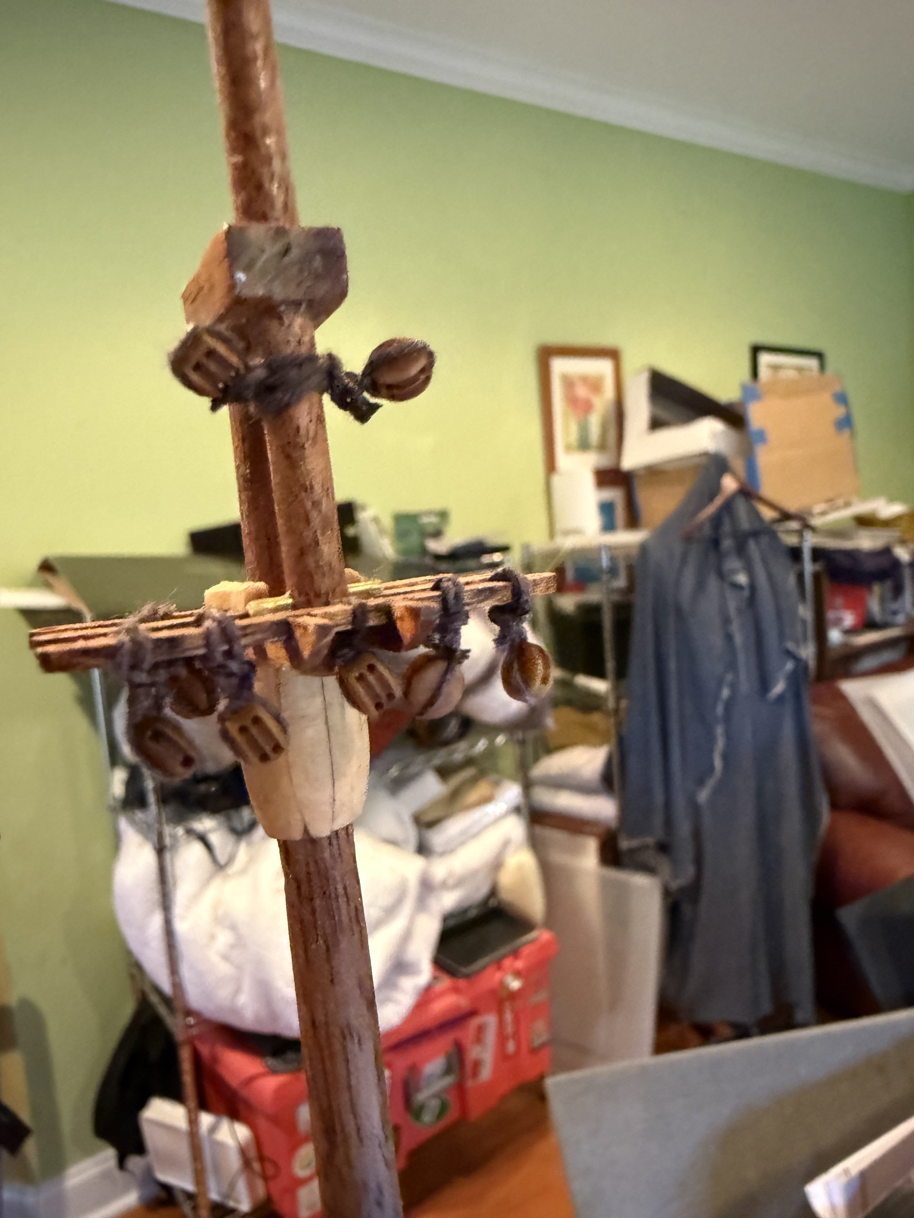

Yards all made , sealed and poly'd.  Next will be putting all the blocks on. In this model there are only 2 kinds of blocks 4mm single and 4 mm double.  i opted to buy realistic ones from Syren as once I got used to using them on my Vanguard builds I just could not go back to the cheap single holed ones as the ships look much better in the end.
IMG_1158.thumb.jpg.32d95bcd220f32e2332e602e47d2635c.jpgIMG_1159.thumb.jpg.768a7aabc16f897d2a36f7ccdede169b.jpgIMG_1160.thumb.jpg.5e91cbb8e117100e42e96d491be8d2f6.jpg
I'm surprised Occre only calls for 4mm blocks. Actual blocks on Victory ranged from 24" quarter blocks for topsail sheets, to 6" blocks for buntlines etc.
Just sayin'. 🤔

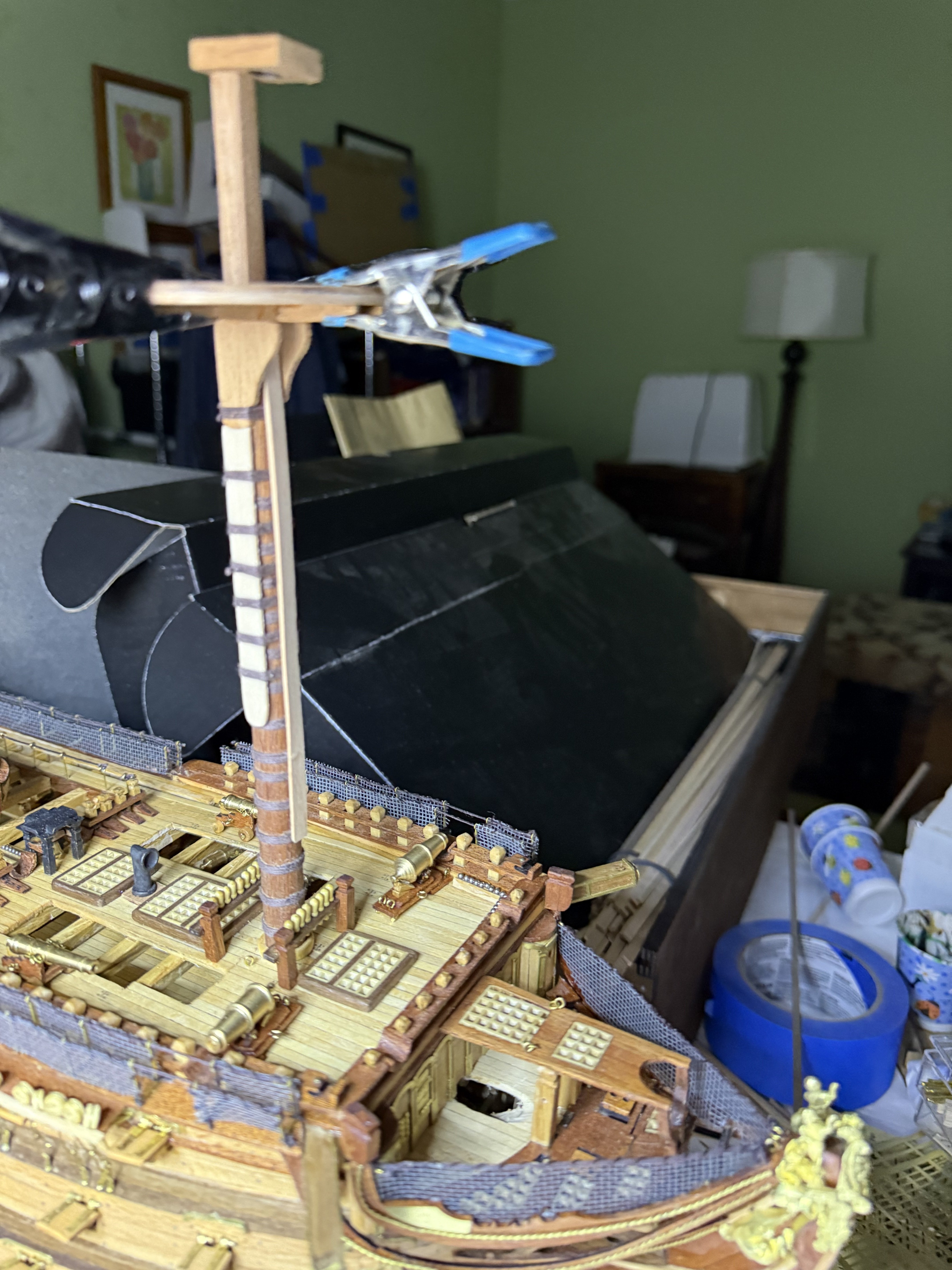

Spent the week rigging all the various blocks to the yards. Finally got to use my new gadget, a quad hands,making the whole process easier
Here with yard in place
IMG_1170.thumb.jpg.8aa8ab6cf33017d3941f89d6c6506a83.jpgIMG_1172.thumb.jpg.921b8e3bfe6f95b237133f731a95a724.jpg
Also used third clamp to hold blocks for tying
Sorry for the focus.

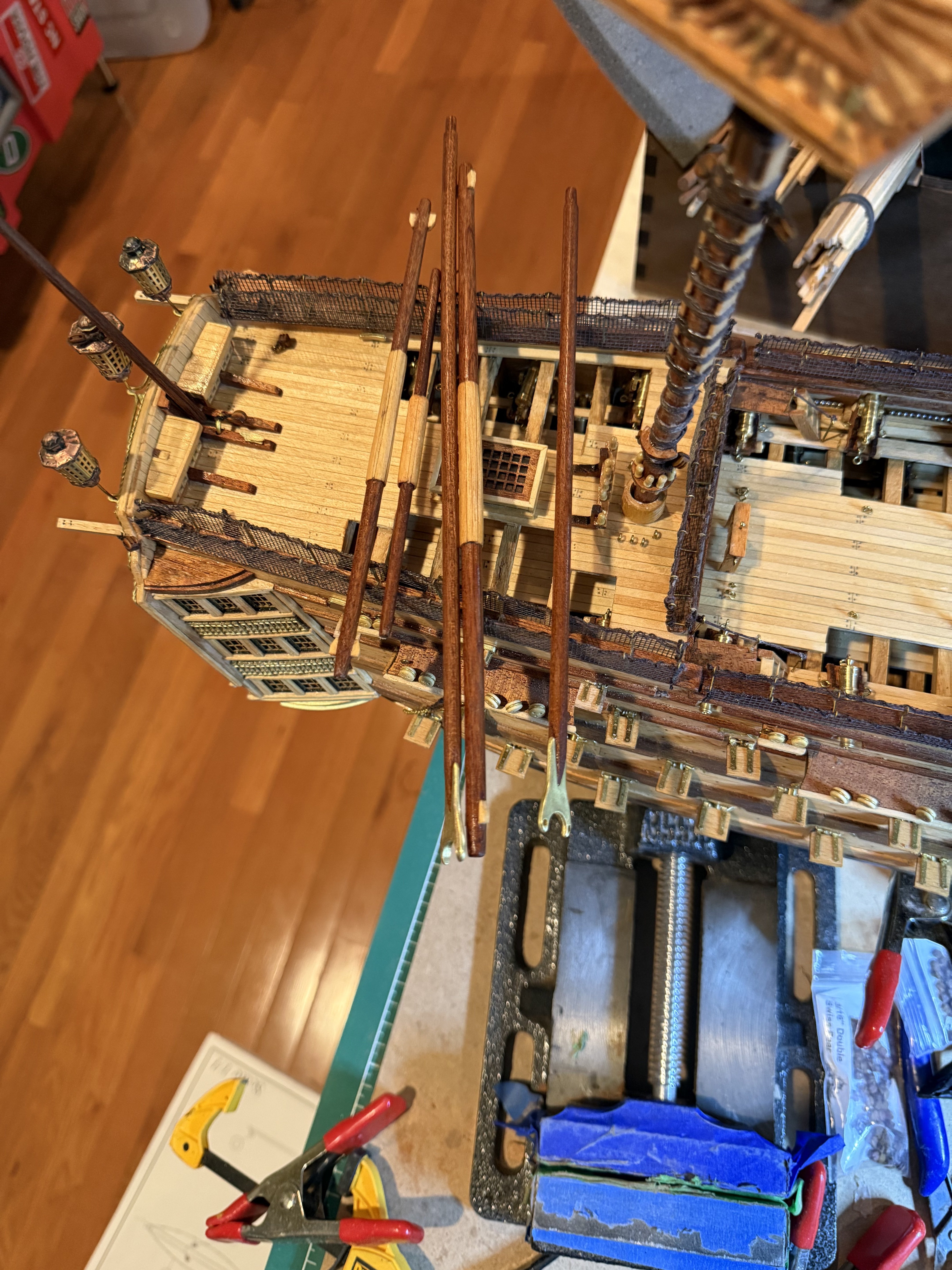

Finally pinned the yards temporarily in place.  Usually at this point I like to attach the yards then do the shrouds but as this model will have sails, I will do the shrouds first as it is easier to bend the sails onto the yards with the yards off the mast and the sails would get in the way of setting up the shrouds.
