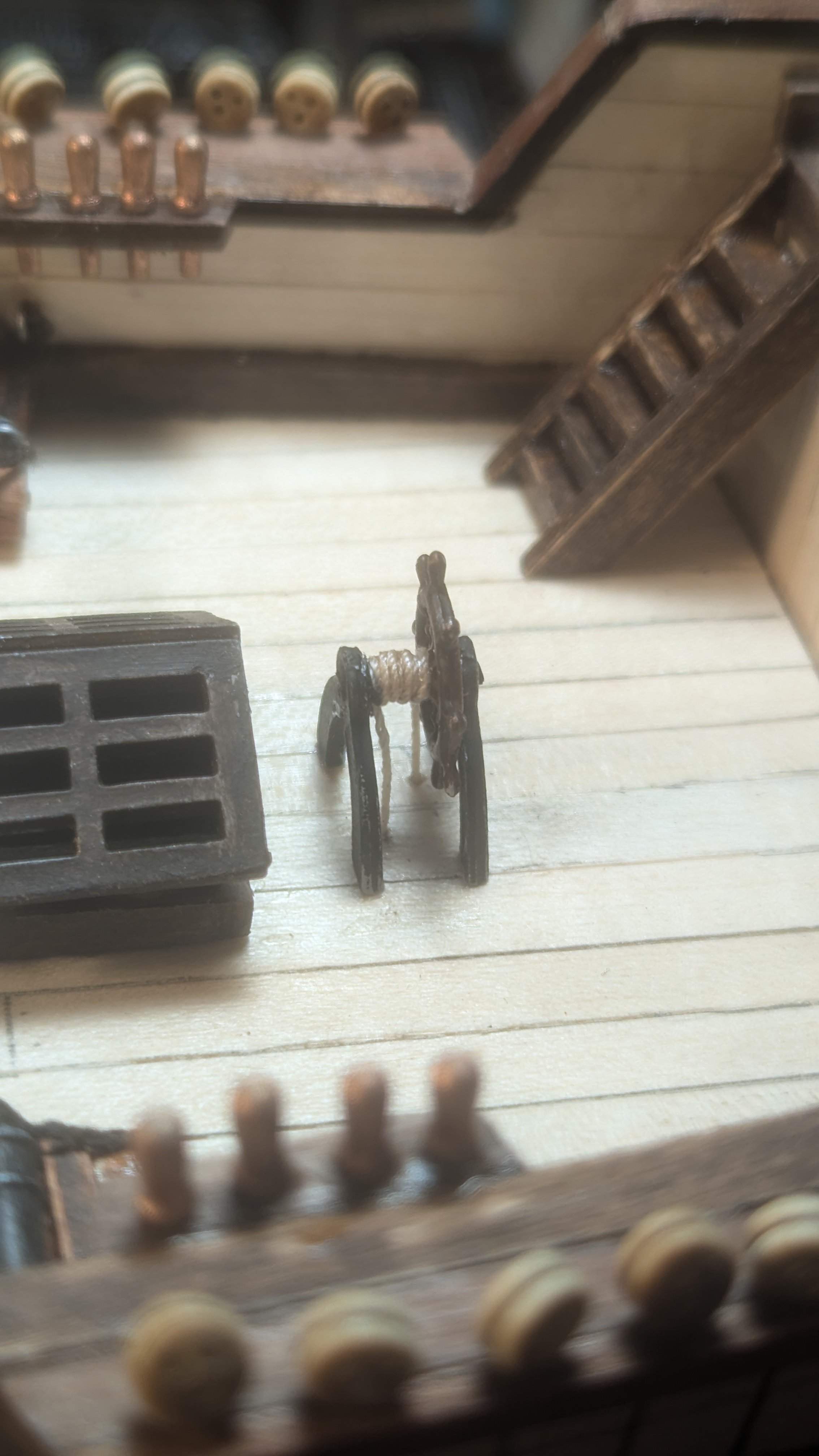

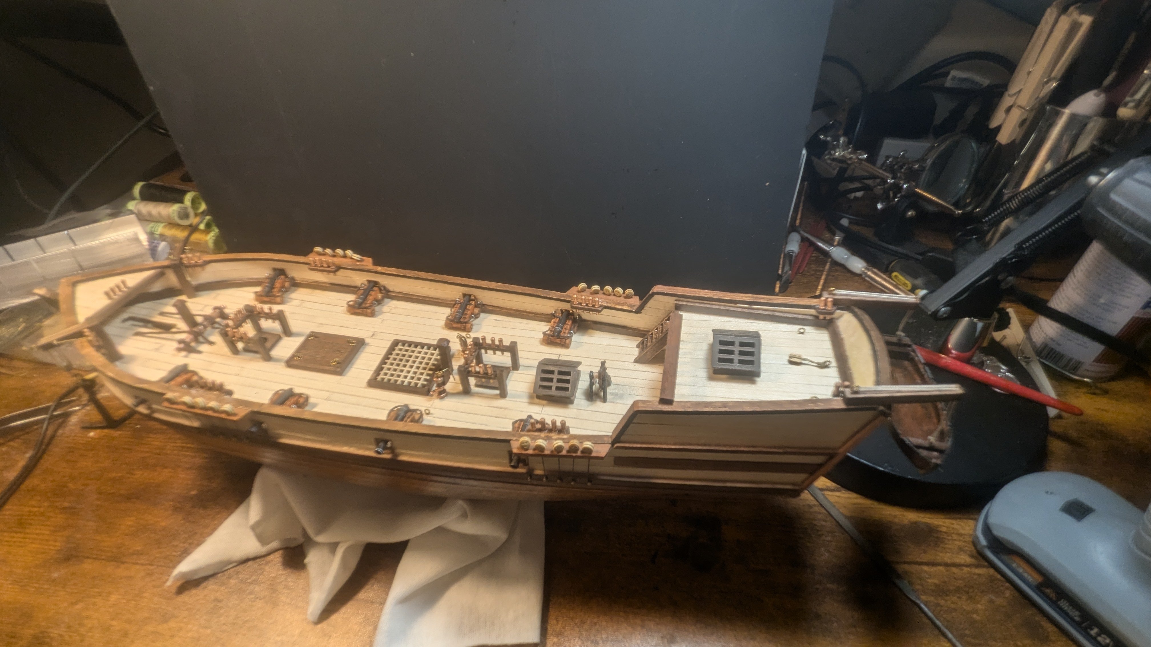

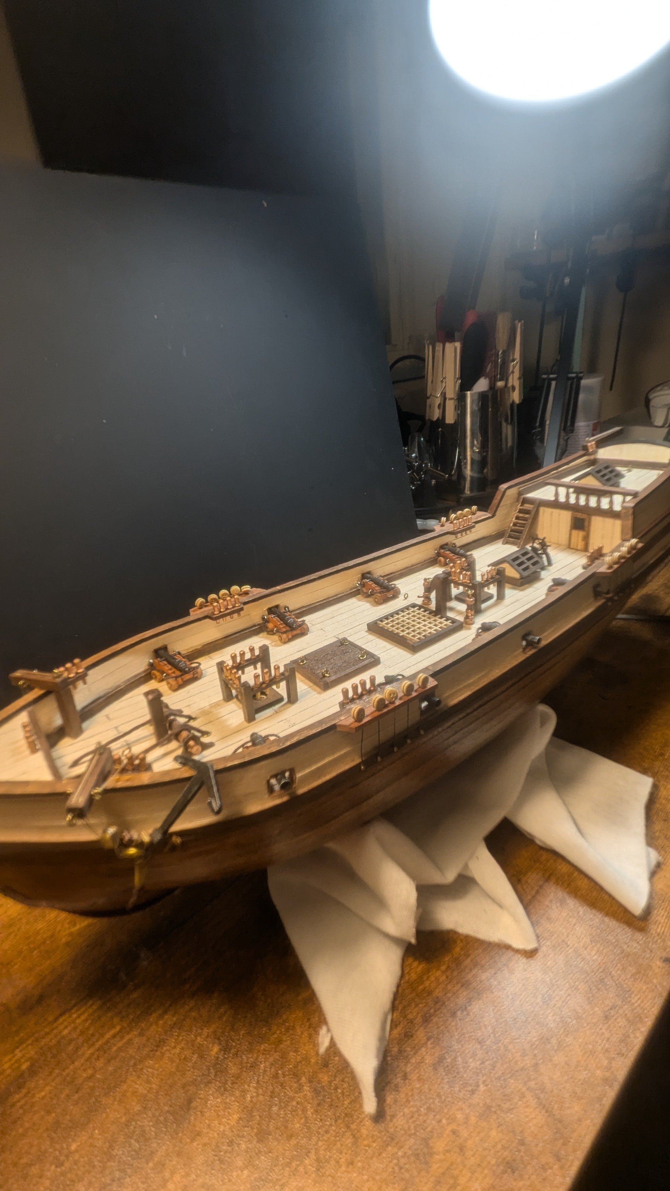

Ahoy all,
With the addition of the ships boat, everything that needs to be on the deck is now on the deck! I may add some accessories after masts and some rigging are up, but this is a big milestone:)
Ships boat:
And here's how everything looks at this stage!
It's hard to get everything in one shot, excuse the blur. PXL_20251111_041933594.thumb.jpg.0bd1bfa236a8c0d1cee17b2ec2f73a39.jpg

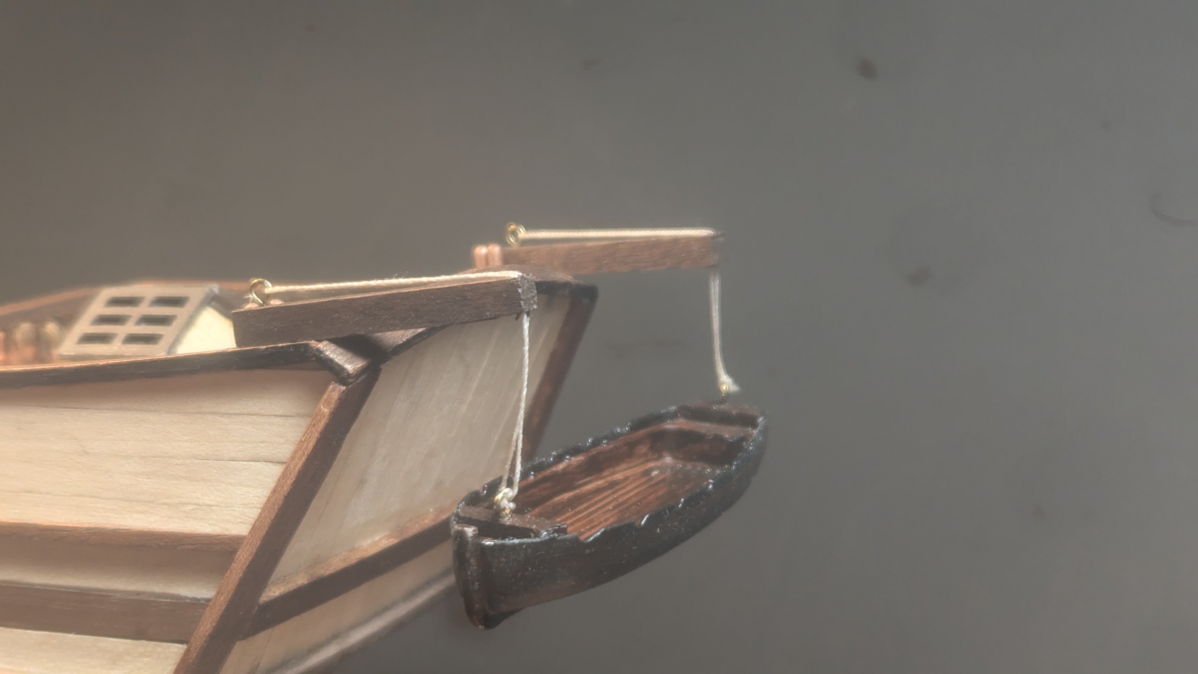

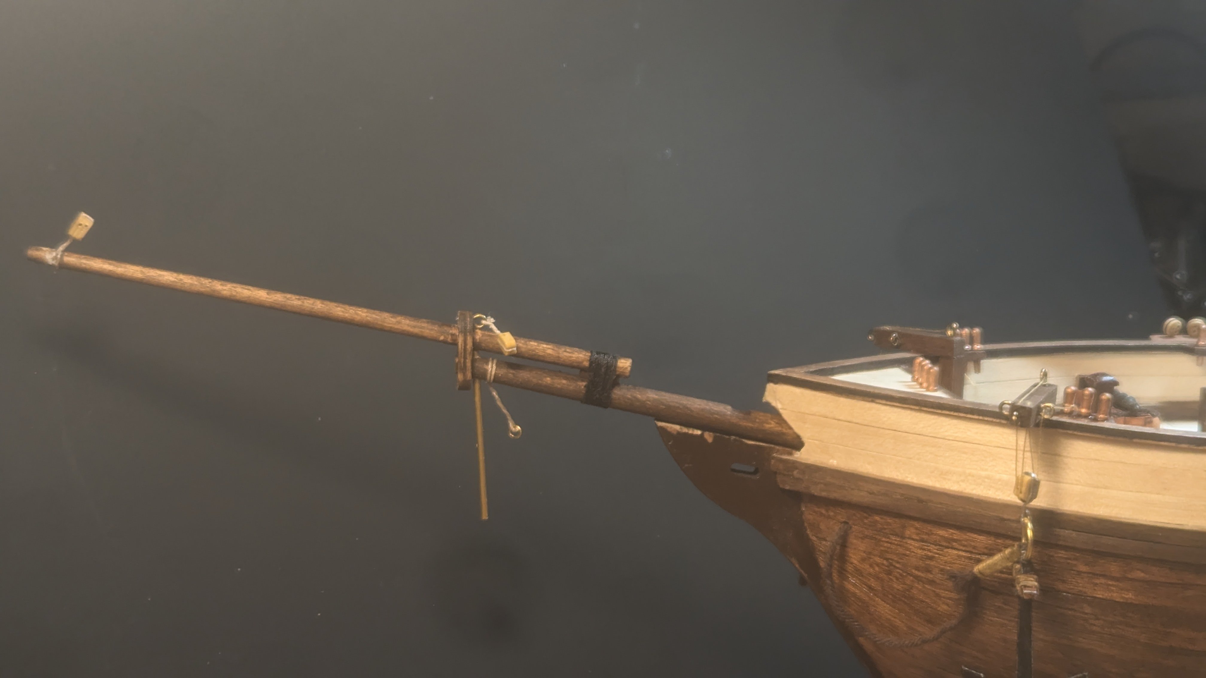

Today I also worked on the bowsprit:
Before:
After:
And a dry fit on the boat!
Not too shabby! Hatches are being thoroughly battened! That hole where the bulwarks meet needs some tidying before I lock it in place.
Wooo!
Best,
James
Very nice work!
Before going on to the masts and rigging, you may want to check that the blocks aren't backwards (the one at the tip of the bowsprit looks like it is). Real blocks are basically pulley wheels in a casing, but many modeling blocks just have a single hole to represent this. So you would want to set it up so that it looks like the rope is passing over the wheel, not below it, if that makes sense.
26 minutes ago, JacquesCousteau said:
Very nice work!
Ahh good eye and thank you for pointing that one out, I learned this lesson the hard way when doing the anchors, I shouldve known better haha. I think I may have been getting tired last night when I put that final block on. Thank you!!!
James, very impressive work considering that this is your first.The hull with it's deck furniture look very nice. 👍
8 hours ago, Geordie Tyne said:
Congratulations on the completion of the deck. Your Albatross is looking very nice, indeed.
Regards
Thank you Geordie!
Appreciate you saying that Keith, thank you!

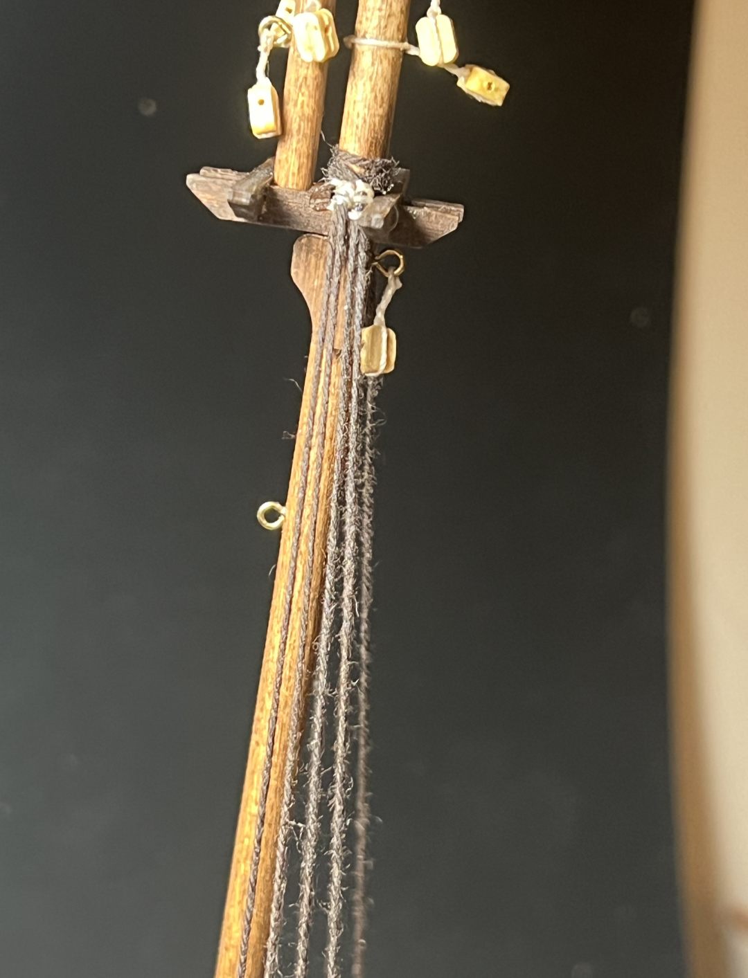

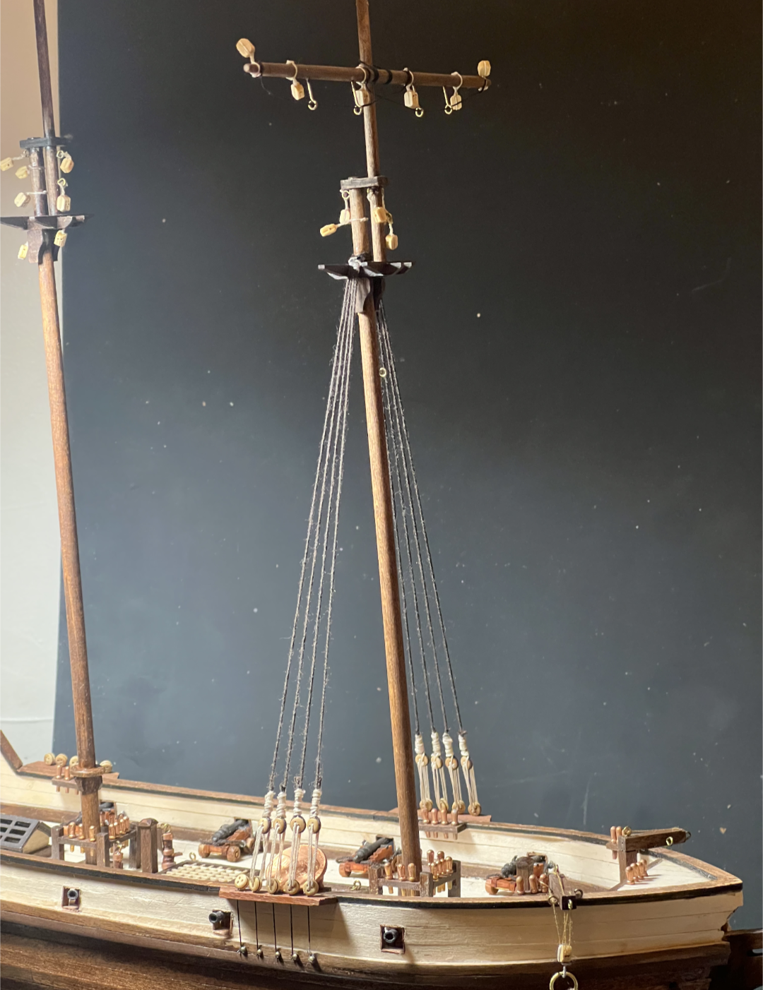

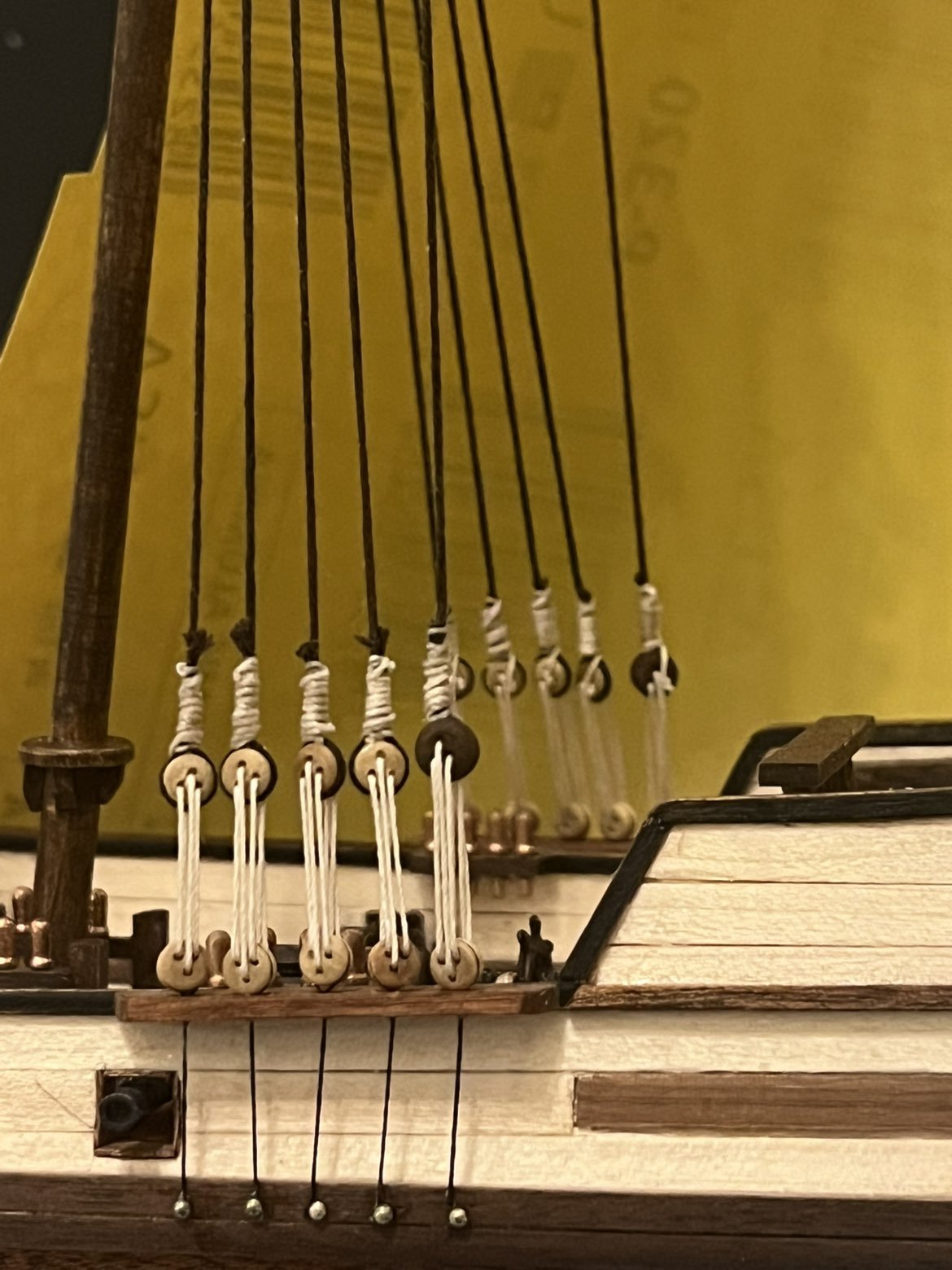

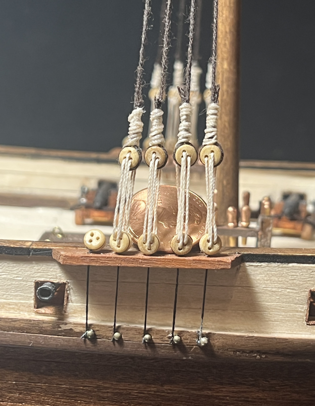

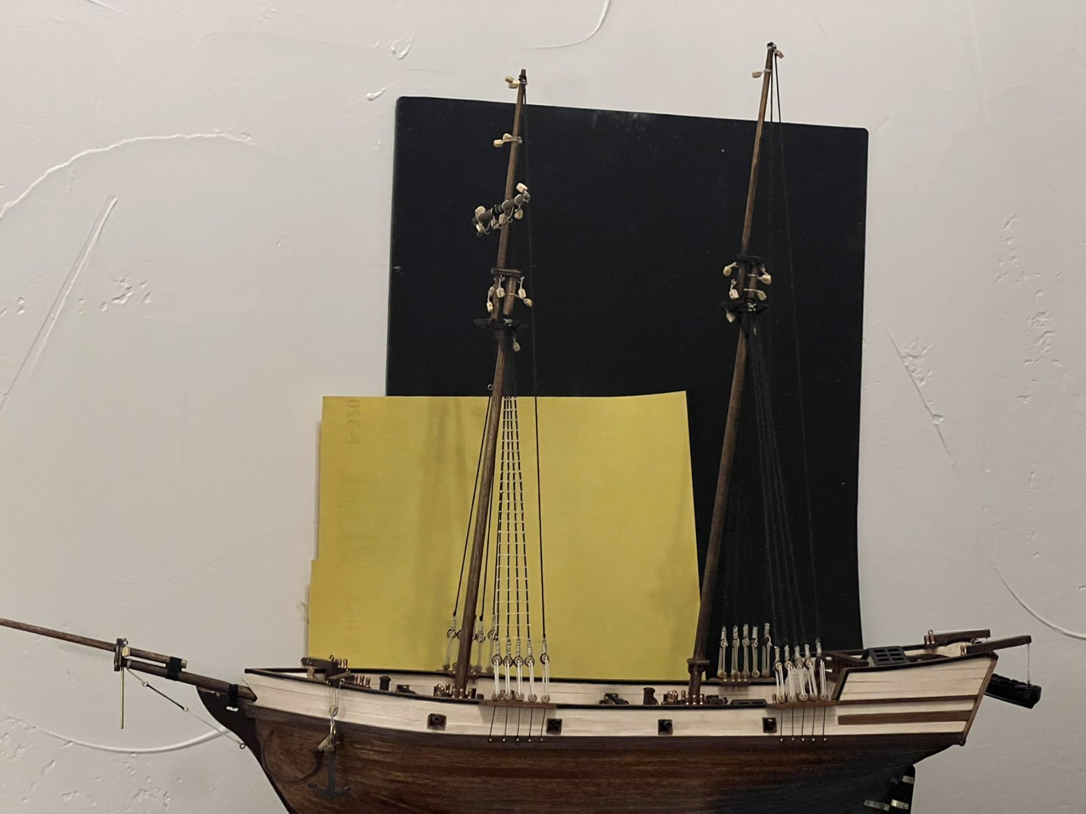

Hello all,
I may have jumped the gun a bit, but I really wanted to try my hand at the shrouds. I hope my installation of the foremast won't have any ramifications, if so I'll adapt as they come!
The process went fairly smooth, 2 of the bulwark deadeyes snapped off and had to be replaced but otherwise it went well!
Screenshot_20251115-005233.thumb.png.243a62c9c94f5cb46202d5c8a3f7d2c2.pngScreenshot_20251115-005224.thumb.png.941804066b8a44d6c375111bcfe1658d.png
I am (unfortunately) using the kit provided cotton thread for the main lines since I don't have any polyester thread thick enough (yet). But I passed over the thread with a lighter and it looks better now than it does in these pictures.
Also, after a quick headcount, I am 4 deadeyes short for what's needed. Unfortunate but I still have my dad's old modeling scraps and I remember a few in there that could work.

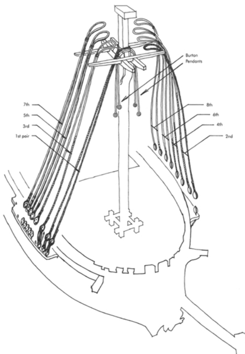

Up at the top, I tried to mimic this diagram from a new rigging book I got:
Petersson, L. (2000). Rigging: Period ship models. Chatham Publishing.
This worked out very well I think.

With that supplied thread, a coat of beeswax can help keep some of that fuzz down.  Great job so far!
Edited by SiriusVoyager
  - Eric
Thank you! I did apply beeswax to the thread, but those strands just keep popping up, the lighter worked well but I'm very afraid of accidents. I've been applying beeswax before and after the rope is taut and it's working fairly well.
HARK!
The shrouds are done!
I ended up being one deadeye short of what was needed after another dive down the floor vent, but my dad's old scraps had 2 that were close enough in size. Although slightly different I like that they stand out. I used them for the backstays(?)

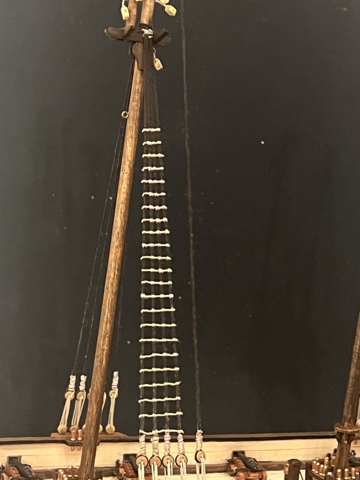

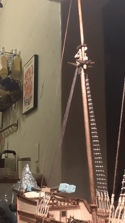

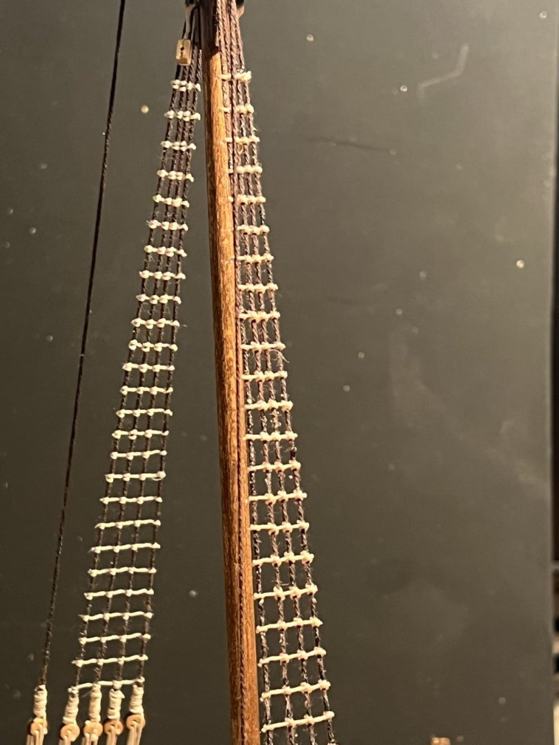

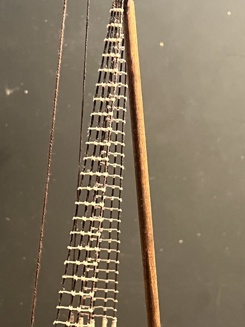

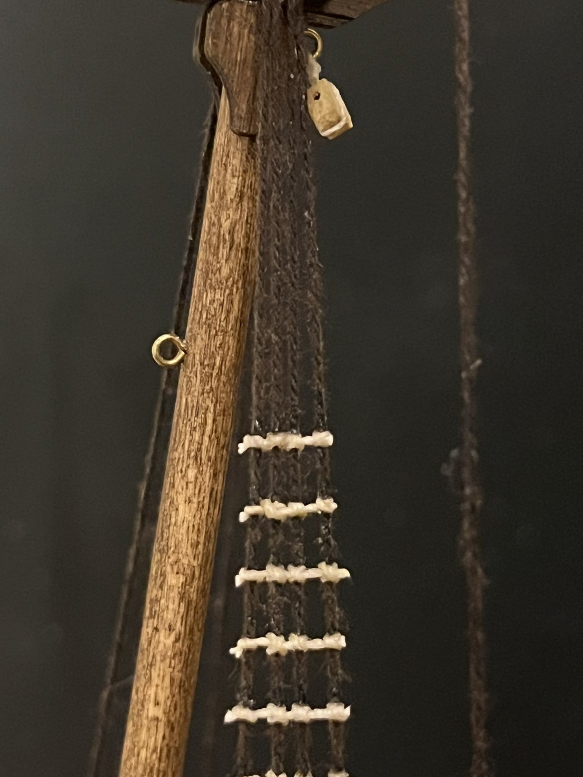

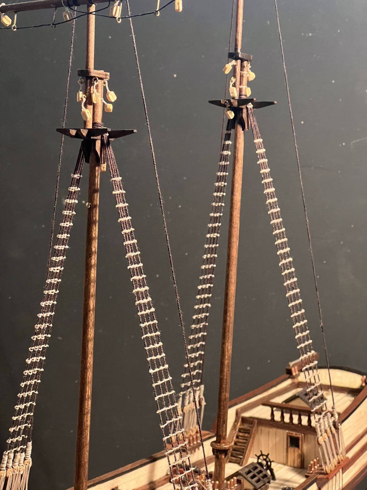

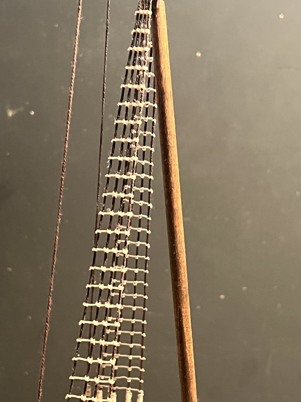

I also have begun the much loved process of rat lines on the port side. I do need some input from anyone if possible:
I am happy with the result so far (feedback welcome as always), but I'm not really sure how high up on the shrouds I can realistically go using the clove hitch. Where I'm at here, the lines are just getting too close together and I'm worried it'll look more and more mangled if I go further.
Should I switch to a different knot? Or maybe do a hitch on every other shroud so there's still room to see some horizontal line? Let me know your thoughts!
Aaaand here's where I'm at! Only a few more dozen or hundred or so clove hitches left and I'll be done with the rat lines!
(The masts are aligned well, the angle just looks weird here)
Thank you all for the support and input, I wish you well on whatever you are working on this week!
Best,
James
56 minutes ago, vvvjames said:
backstays(?)
Correct.
The height, I don't know,m.
Maybe higher would be nicer. But would it be useful in a 1/1 scale?
Nice work
 Your Albatros is looking awesome, James. Wonderful ratlines. They would look more complete if you could get up to the bottom of the cheeks but go as high as you feel comfortable with and don't worry about it.

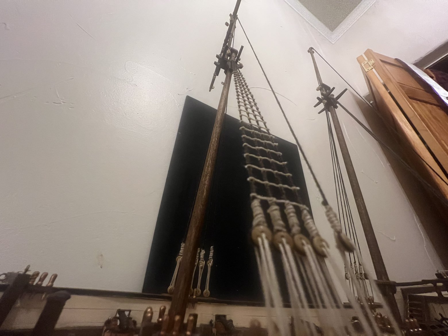

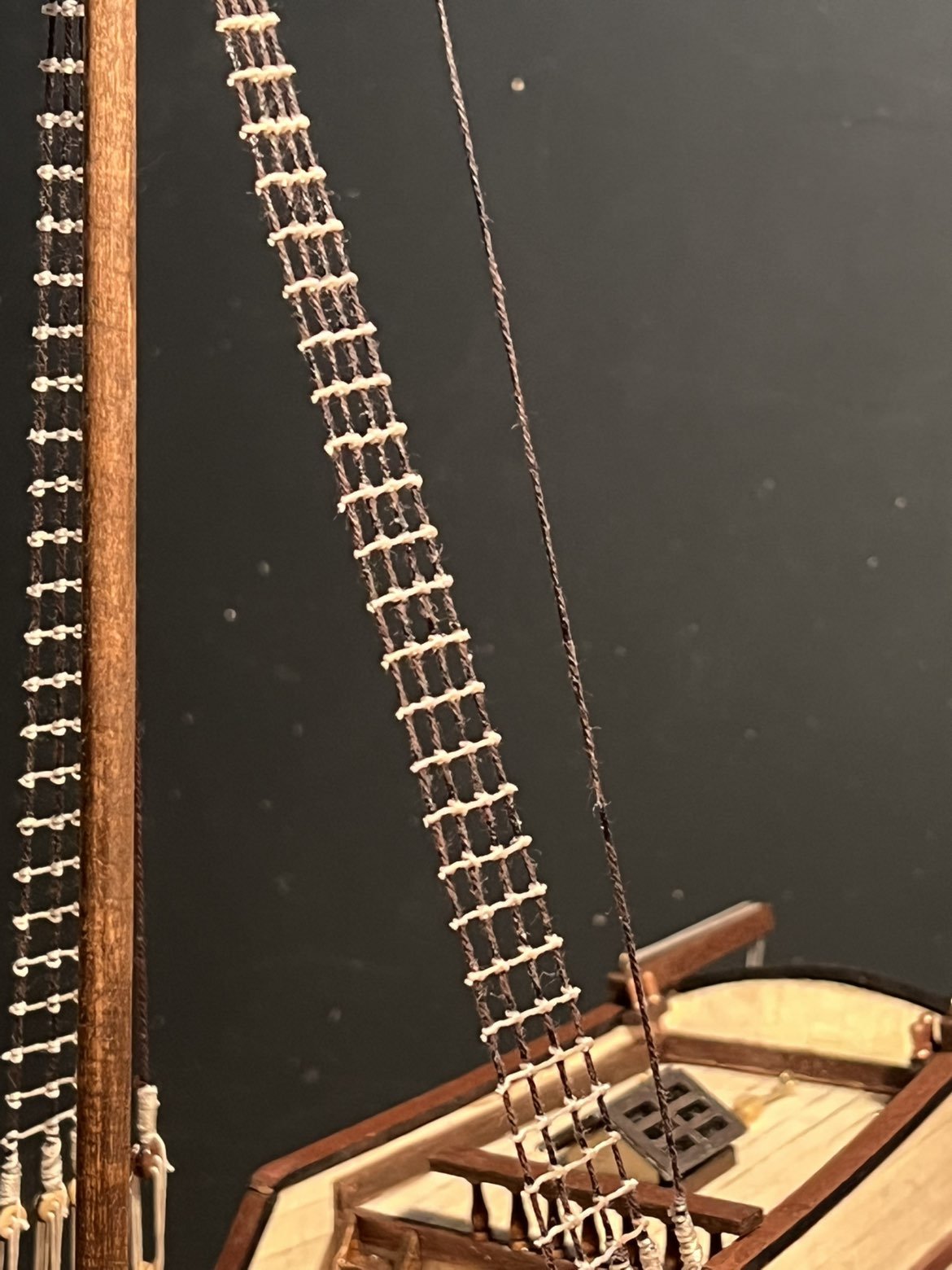

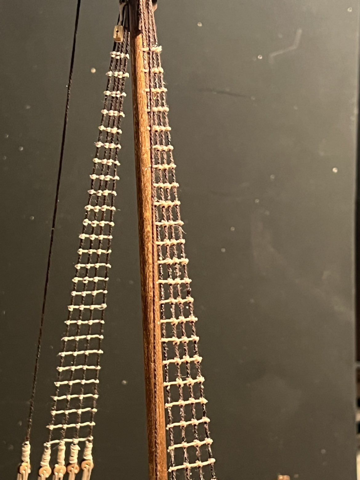

YARG all,
Thank you for all your comments and support. Another milestone has been reached!!! (I will continue viewing every knot as a milestone)

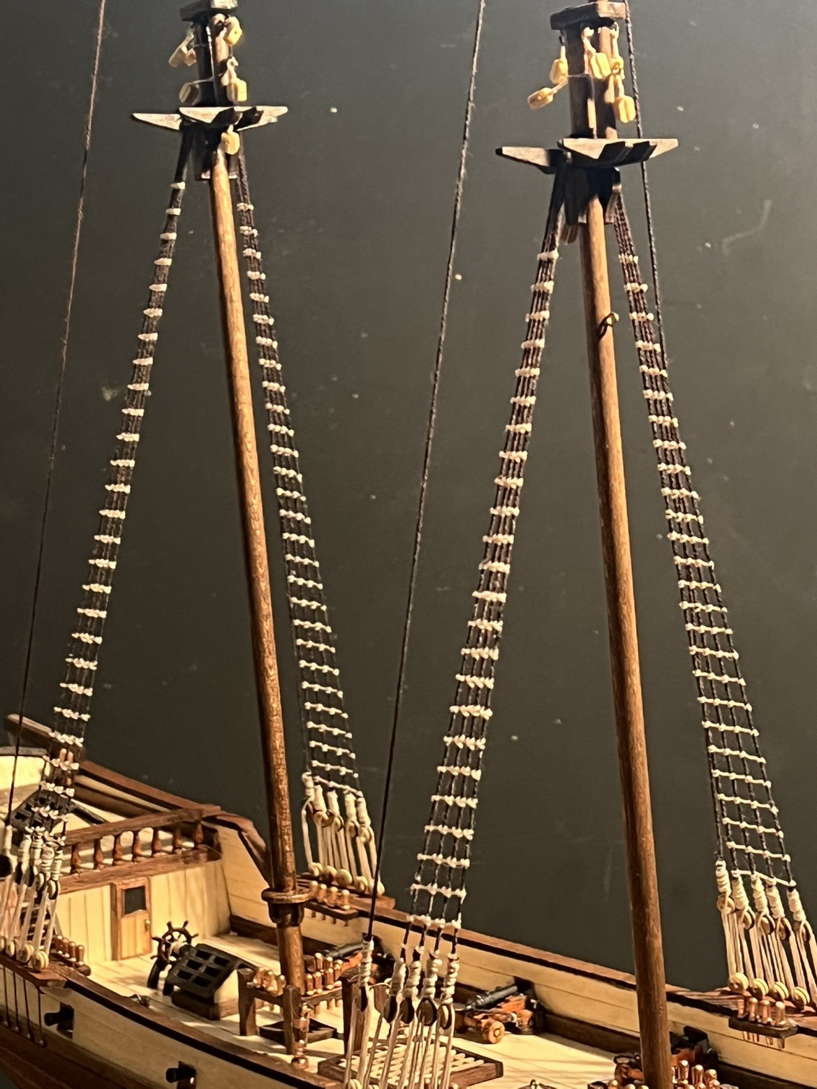

The rat lines are DONE, and upon completion I had the thought that I have now tied many more clove hitches than the average person. I have been fantasizing about a pilot  on the intercom saying, "does anyone on this plane know how to tie a clove hitch?!"
 Id be the first to stand I think.
ANYWAY, here are some pictures:
Port:
Closeups:
And a 2.5 hour time lapse (if it works):
I took some advice from another post about the jig I used, just two pieces of wood of the same width as the ratline spacing, sandpaper attached to the inside. Works like a dream.
Here's that post:
And that's that!
Best,
James
Edited by vvvjames
Added link to ratline jig
 James, nice job and congratulations on getting those clove hitches tied but Bob, @Knocklouder has you beat by miles when it comes to tying clove hitches and he loves every minute of it. He's never happier than when it comes to tying clove hitches.
Those are the straightest  Ratlines I have ever seen,  wow. :cheers:. How do the say  "Hats Off",  Yes I do love ratlines,  why, cause as soon as you are done them it's Rigging   Time.   Lol  😉  Great work
