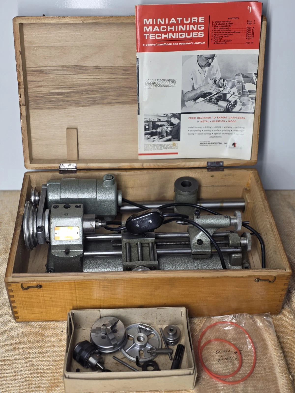

Thanks Y.T. but I bought this, today. It will not only serve my basic needs quite well, but it is 'also' simple enough that I'll be able to easily make all of my own custom accessories, etc. using the bigger machines at work. First project will be making a duplicator/repeater for nice curvy stanchions, etc. I already have the concept designed. I just need to get the machine in my hands so I can get actual 'working' dimensions. This thing should be great fun to mess with and design gadgets for! 😁
Not sure if I'll keep the original motor, pulleys and belt system. I'll play with it and see how it goes. If I need more power and torque, I have a 24VDC 500-watt motor and power supply that I can adapt to fit this thing. I also have a good supply of pulleys and V-belts too. Can't wait 'till it gets here!
Thanks for all the informative replies to this thread. I've read them all and used all of you folk's feedback in my decision. "Thank You All!"

Congratulations! It looks hardly used and clean of corrosion. One issue I was having with mine like this is that the motor interferes with a work piece. I wish the motor would be separated off the lathe and mounted of a common board further back to be away from work piece. This however kills the advantage of lathe being compact.
I doubt that I'll ever have that problem. I don't intend to turn anything but small diameter stock.
Congratulations! Long may you enjoy its use. I notice the very useful manual is included in your purchase.
You may find, as I did, that a small shim might be required to align the head and tailstock. Some tool bits might also require shimming to be accurately on center. I never felt a more powerful motor was needed.
Thanks David! I have plenty of shim stock at work. Can't live without it even on the big machines. It's also nice to know that the motor will probably be fine, however. If it 'is'... that's one less fun project that I'll get to tinker with! 😔 LOL
I don't remember what the spindle-thread is on the SL, I think 12 mm x 1 mm or 14 mm x 1 mm. You may be able to find ES-collet adapters with this thread. Or someone may be able to turn it up for you. A useful set of say ES16- collets can be had for little money these days. This so much safer for working on small parts, than working close to fast rotating jaws on a chuck ...
You may also consider running the lathe off a momentary foot-switch. This keeps your hands free and in an emergency, you just lift your foot to stop the lathe, rather than having to reach for a switch.
As the motor is an ordinary brushed one, you can use an electronic light-dimmer as speed-control. Over here in Europe with dimmers that plug into wall-sockets into which then your lathe can be plugged. They are cheap. You loose power, but for working on small-diameter parts that loss of torque doesn't really matter. I have used such configuration for many years.
