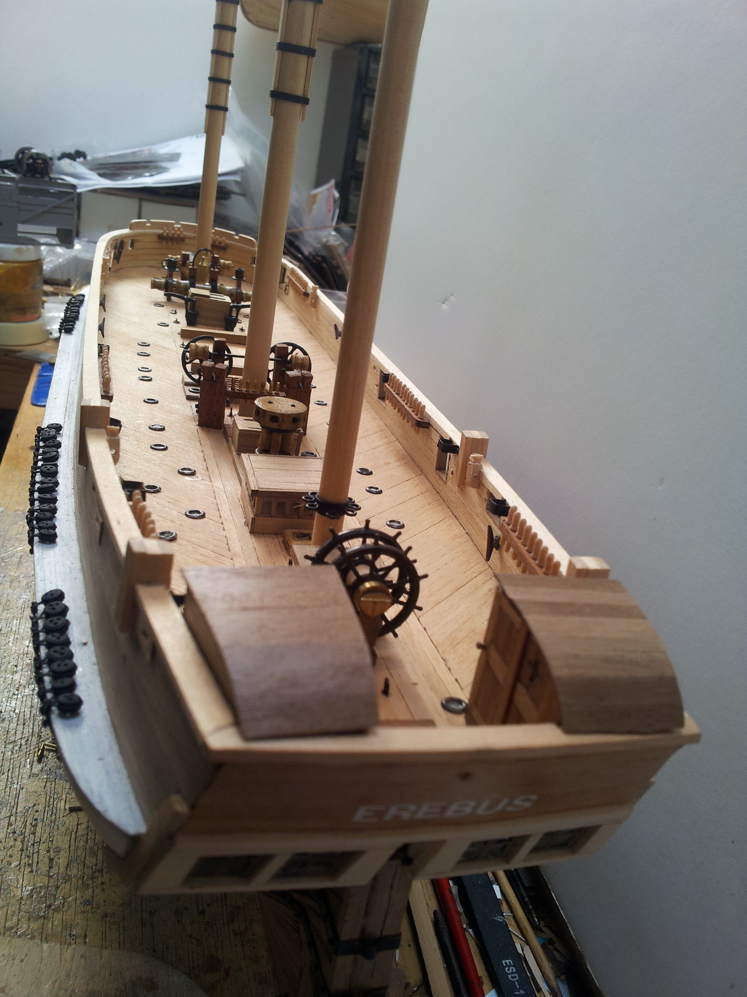

  7. Thanks for the likes and looking in everyone, finally started to construct the catheads and like on my Terror i drilled and filed a square hole to accept the supporting piece below the cathead - also made a new knee from some planking strip to replace the ply one, next job will be drilling holes and cutting grooves to imitate the sheaves. Also made a start on the posts for the stern davits (the two for the boat skids/ ice bridge are 4mm the others are 3mm). Take care all Keith

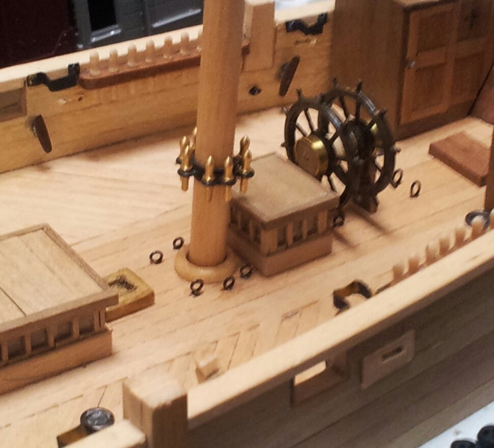

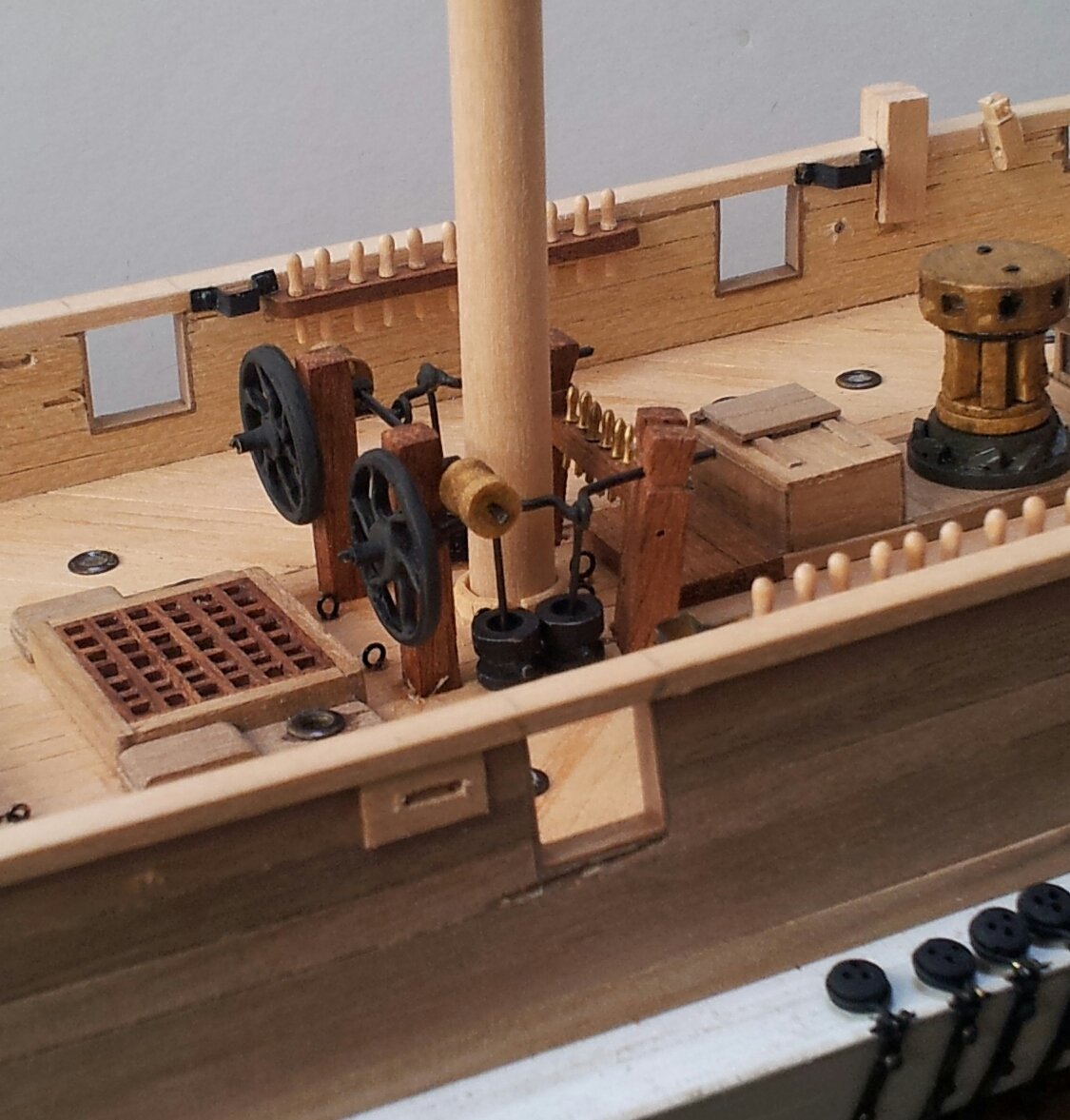

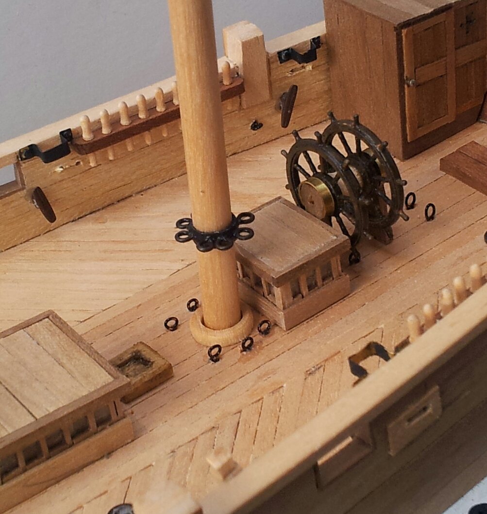

  15. Thanks for the comments and looking in everyone- been slow progress in shipyard- lethargy due to heat and garden shed building taking up time! made and added the stern davits the same as on my Terror build. Also added another band to the fore and main masts under the bibs for the yard trusses - not really clear in pics but also fitted an omega shaped loop for the futtock stays from the tops (should actually be a shackle) and fitted a u shaped piece of brass strip with 3 holes drilled for the yard truss - the bracket is fitted to the yard with a planking pin and left free to turn. On my Terror i rigged rope trusses and chain collars then seen the mention of the foreyard still having its heavy iron truss attached on the wreck in Matthew Betts book! The trusses are from Billings with the central mounting hole moved forward and the old one cut off and files to bring them closer to the mast. Also made the small map/ chart /plotting table -used the kit one cut slightly smaller, cladded with veneer and shaped walnut legs added. Take care everyone and thanks as always for looking in. Keith
