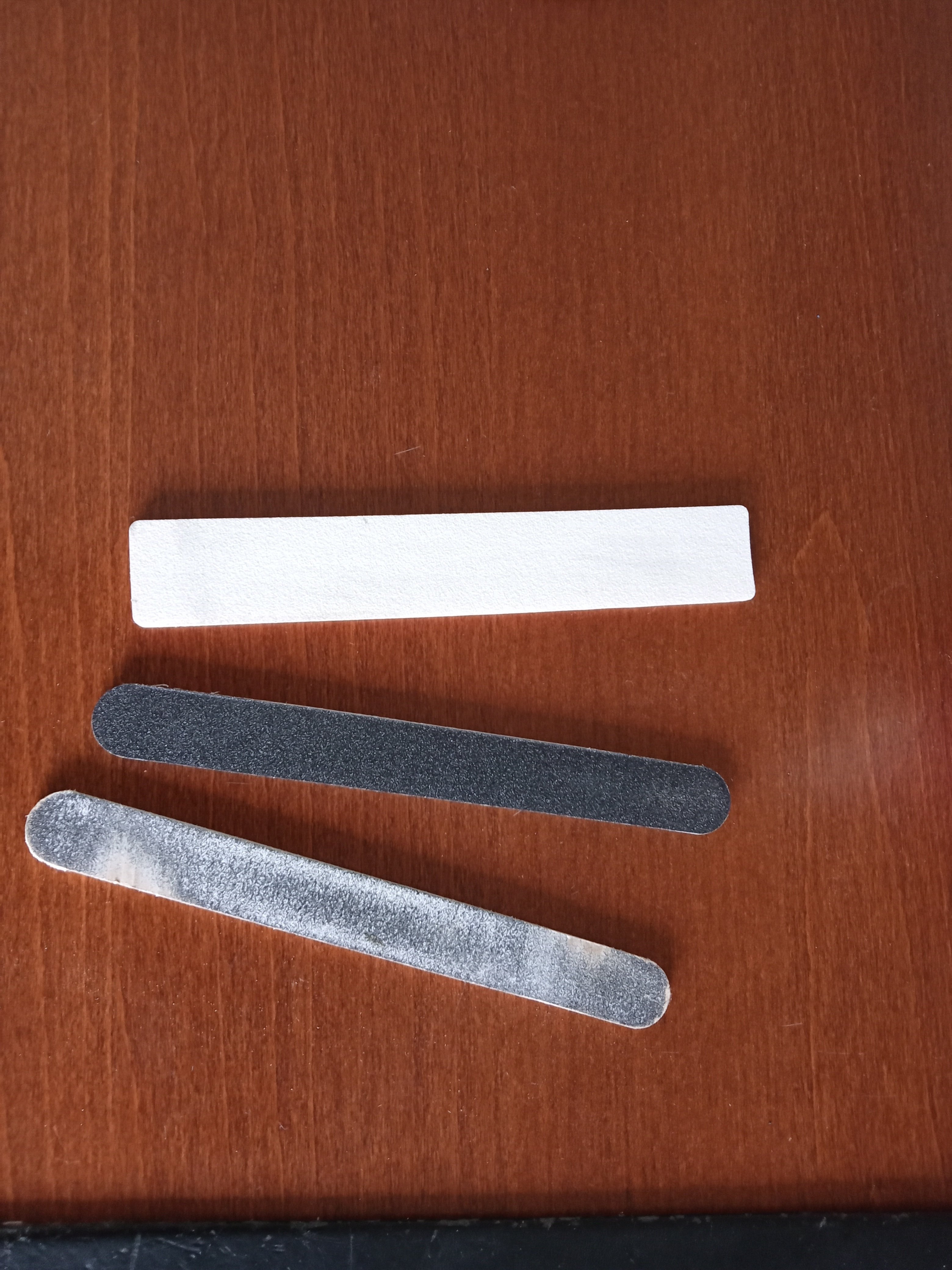

Hey Ross, I'm currently working on the SYREN, which I see you have on your shelf. It has similar issues with how to sand the inside of the bulwarks given their inward slope. I've found that flexible sanding sticks work well. I've found them online at various sites, they come in a wide range of grits. They have enough "give" to conform to the fore and aft curvature of the bulwarks and, importantly, they do not have any grit on their edges which means I don't have to worry about un-intentionally sanding the tops of the bulkheads which would cause problems with the deck planking sitting too low and screwing up the placement of the gun barrels in the ports. I hate sanding and use power tools wherever possible just to get it over with but I would be leery about using them on the inside of the bulwarks where is is really hard to judge how much you are taking off, and where. Keep up the good work, your log will be a big help when I get around to the ESSEX.
