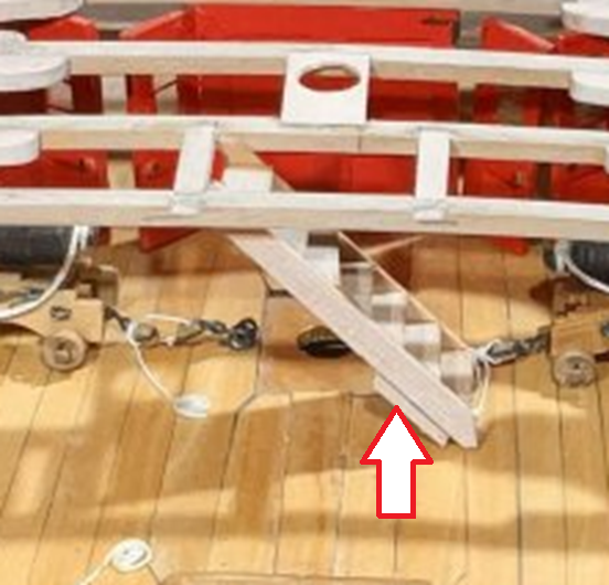

Good morning Kevin.
May I ask, what is the item behind the closed stringers at the elevation of the lower three treads just above the deck?
Alan
Alan O'Neill
Not sure what you mean Alan, the step actually goes in three more beams that are not yet installed. The only thing behind the step are some blocks on the deck and the bulkhead.
it seems to be attached to the backside of the ladder, behind the closed stringer at the bottom.
I put an arrow on the photo to point it out.
Alan O'Neill
Interesting! Thanks.
Alan O'Neill
Odd... 9" versus 10"... to save weight.
They would start with 10" and spend extra time cutting away 1"!?.

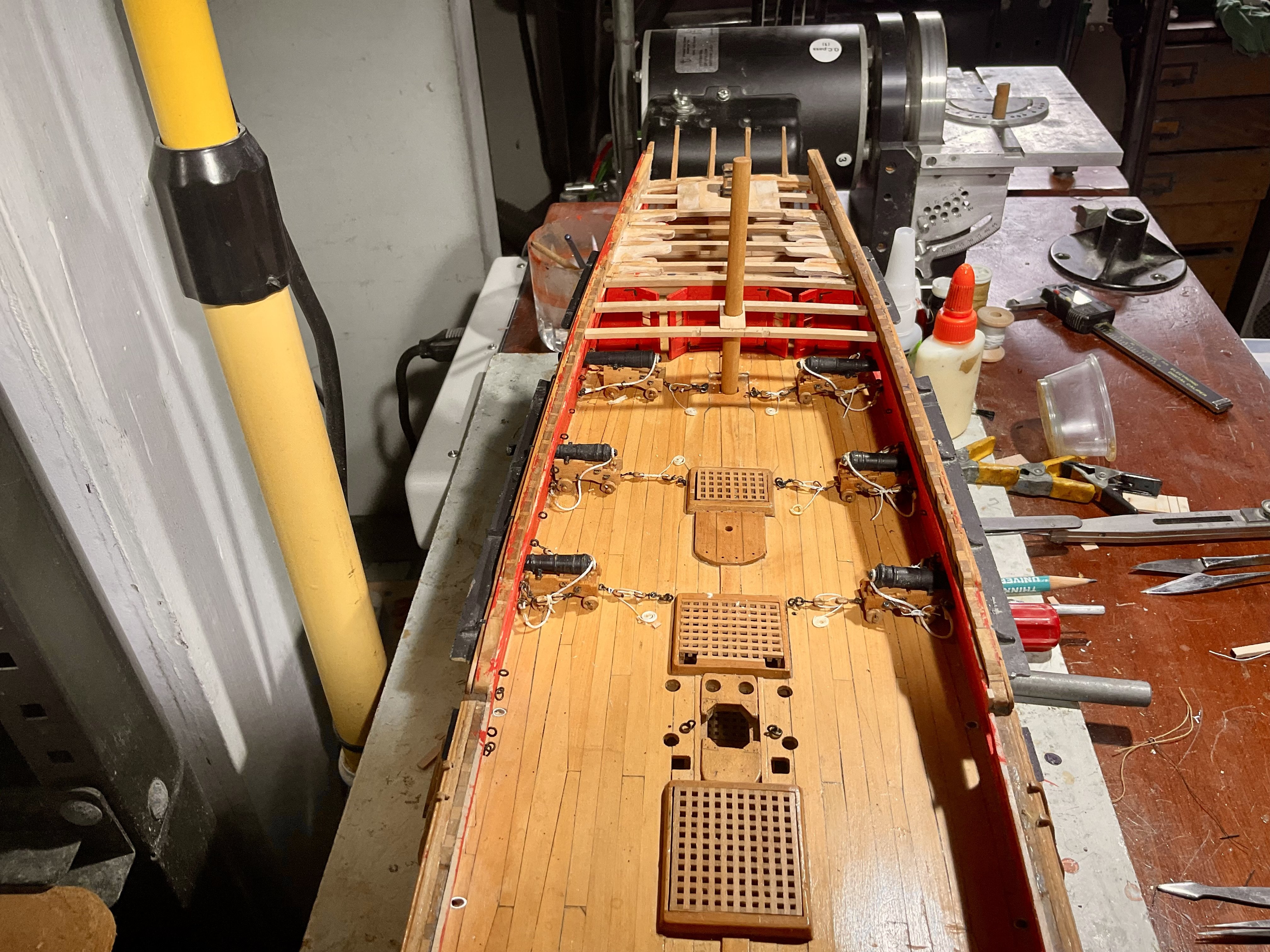

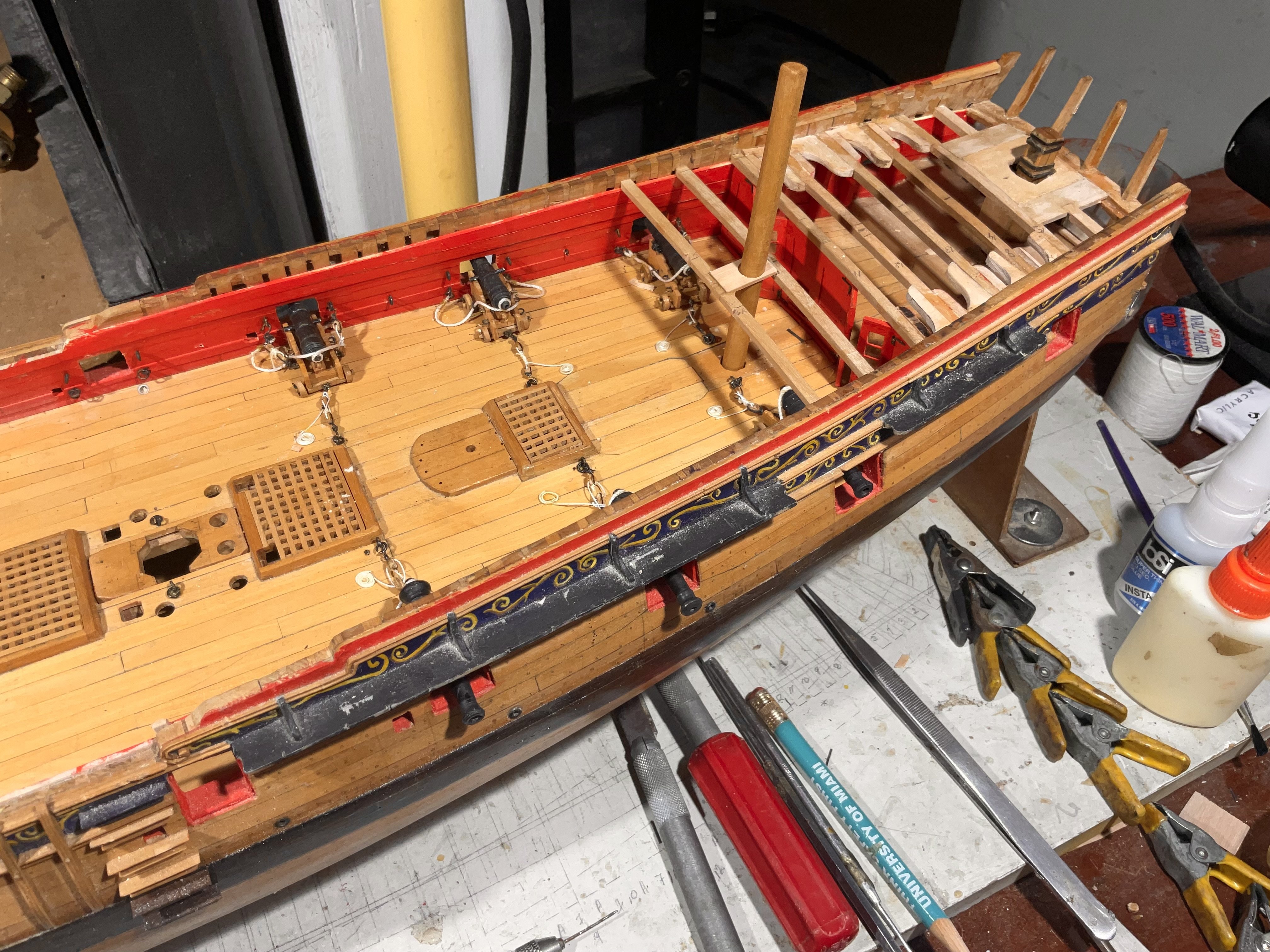

Great video Kevin. You'll note that some of the eyes for the gun tackle are located within the hanging knees, both next to the ports and cast. Look at the 3D photo you've included. As I recall I fitted the deck beams temporarily then added the hanging knees. This helped locate the iron rings. You can then remove the deck beams, rig the cannons then install the deck beams permanently. Also, it's good to know I'm not the only one who has to constantly reinvent certain techniques. Fortunately, I had an extensive photo log so that has helped me remember previous techniques.

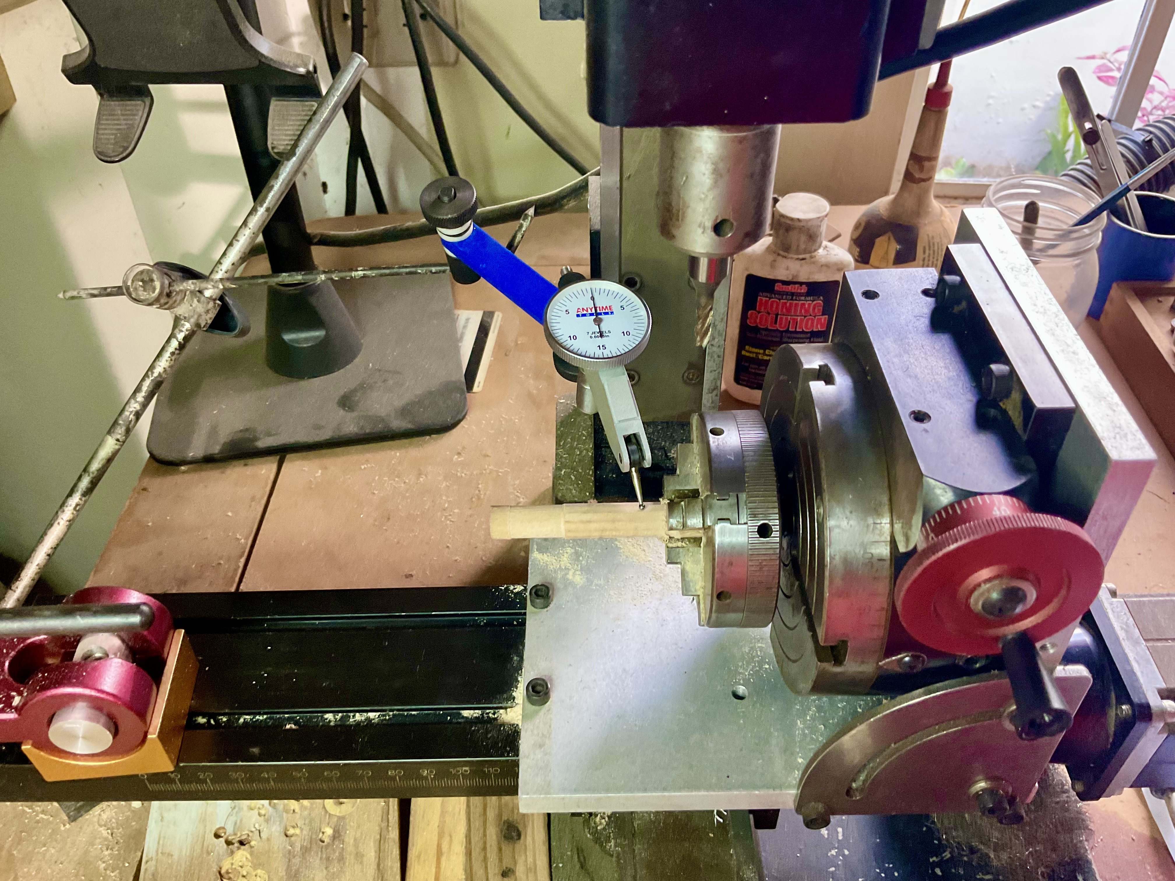

Looking good, Kevin. I also use the four jaw chuck to hold square stock. Theoretically, it should be dialed in with an indicator but I believe that's more for precision work in metal. Sometimes I need to move the part to the mill then back to the lathe. In order to get the centering correct again make a small tick mark on one of the jaws of the chuck and the wood indentation adjacent to it. That way you'll get the same centering after transferring the piece back to the lathe.
