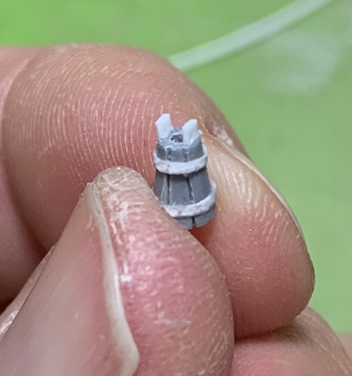

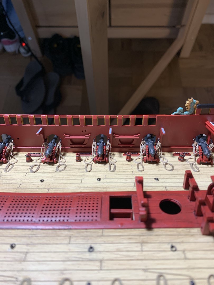

So, I’ve managed to make some progress.  I finished painting the deck hardware.  On the one hand, the degree of detailing I put into the lin-stock tubs may seem like overkill for something so small, that is largely overshadowed by the waist gangways.  However, I truly enjoyed the process of engraving them, boring them out, banding them, painting/weathering them, and making ears and annealed wire handles for them.  It gave me the sense, once again, that I was engaged with the project, in the limited time I had available.

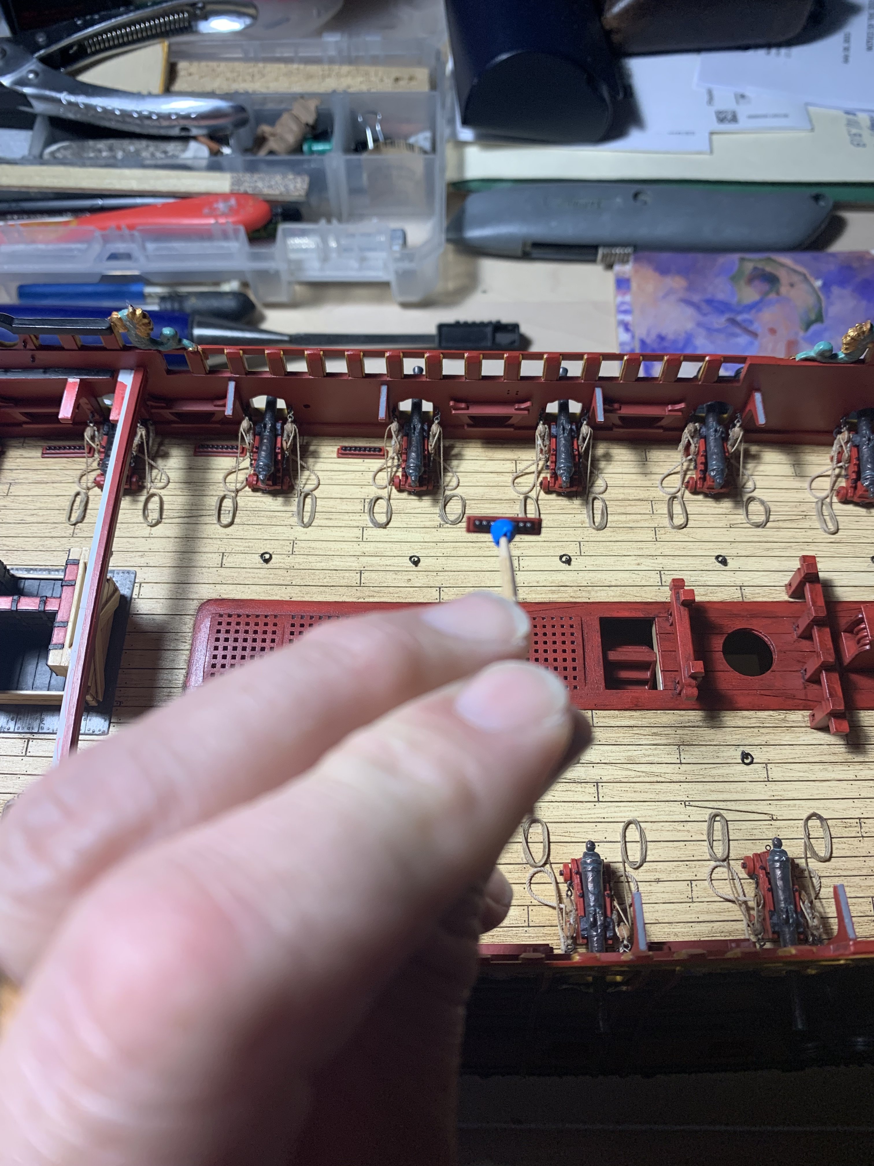

For placing these tiny items where clumsy fingers fear to tread, I found that wall-tack putty rolled around the end of a toothpick enabled me to place these items precisely, in the limited time before the CA sets.
I did make one shot-rack placement error, but it will be completely concealed beneath the f’ocsle deck.  It wasn’t worth creating a paint repair problem.

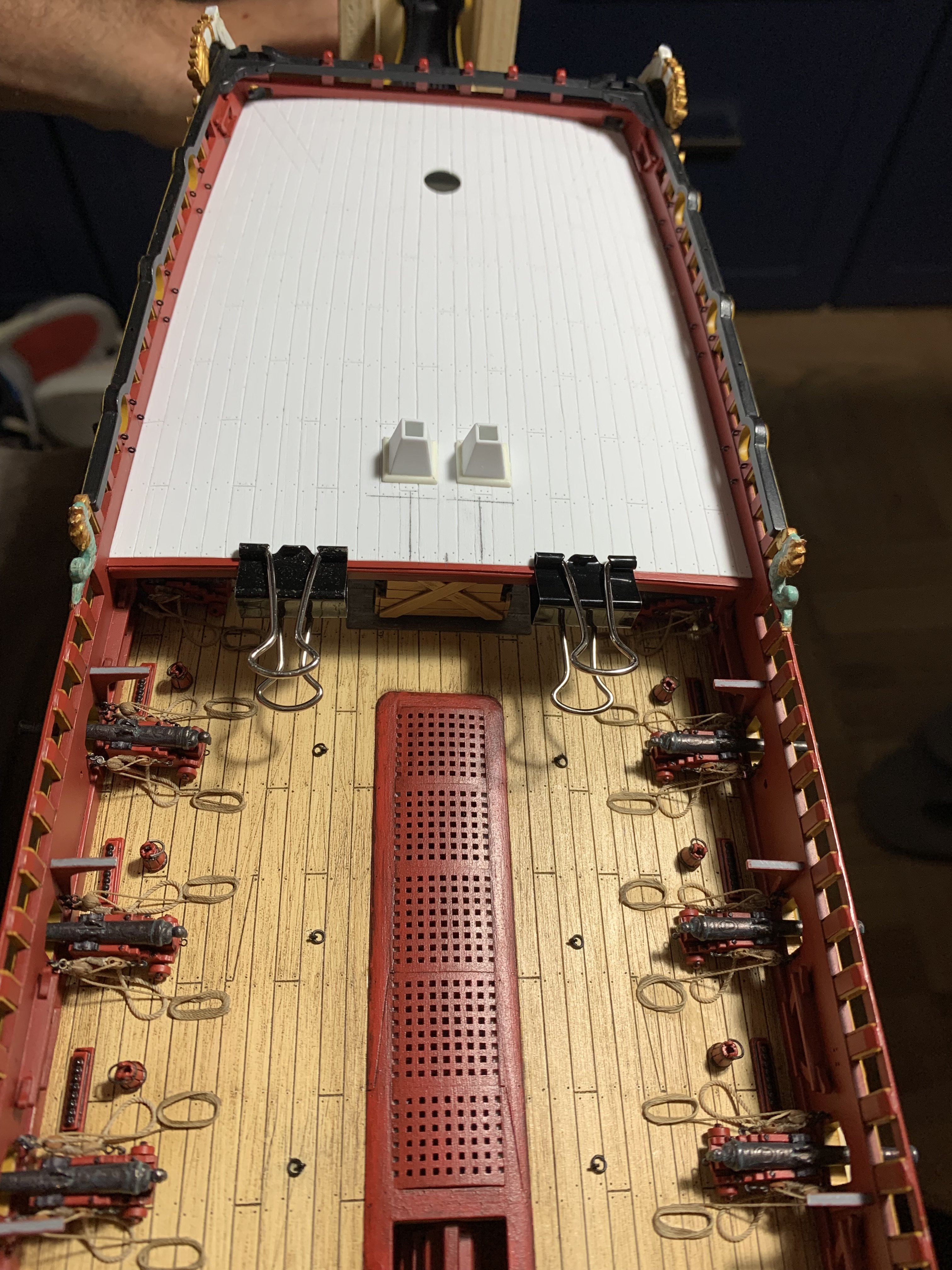

Now, I still have cleats and blocks and cavals to place on the main deck.  I still also have to belay sheet and tack lines to the inner bulwarks for the eventual rigging.  I had momentum, though, and wanted to continue making significant progress.  I decided to begin detailing the f’ocsle deck as a motivator to finally route my belay points on the main deck, so that the whole project can move forward.

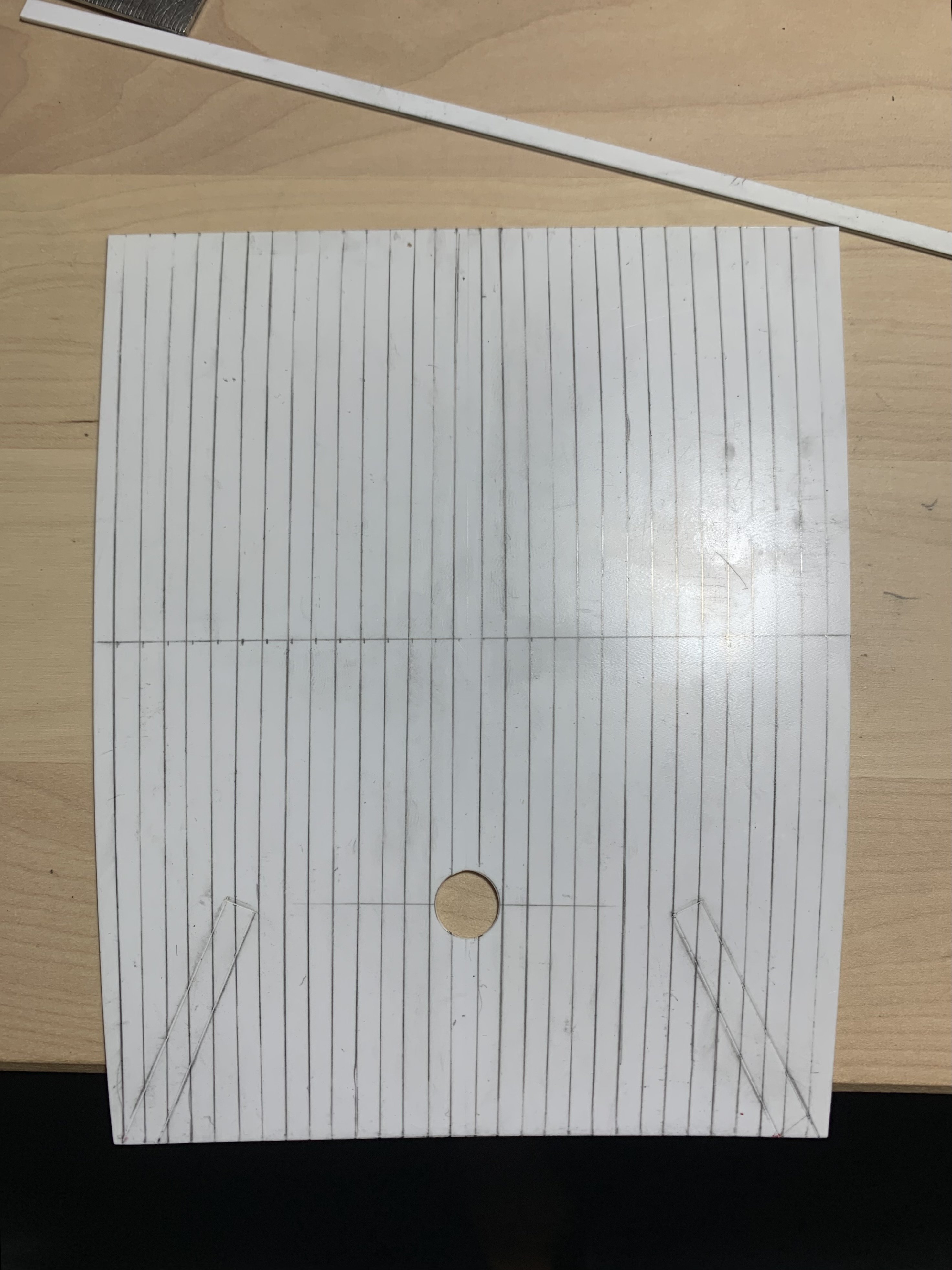

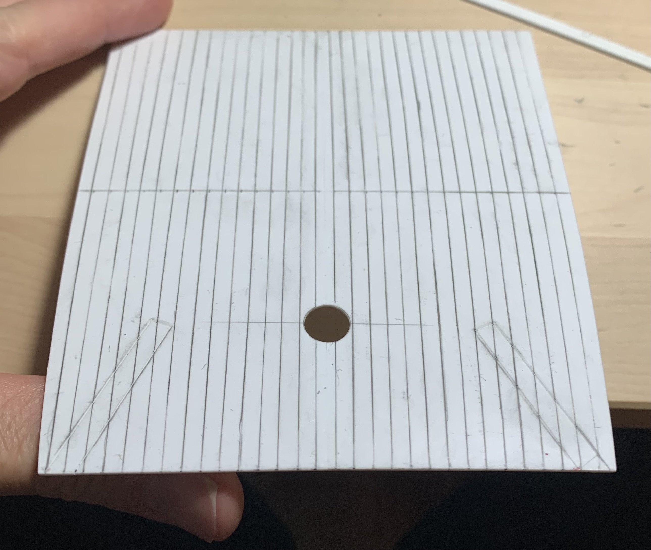

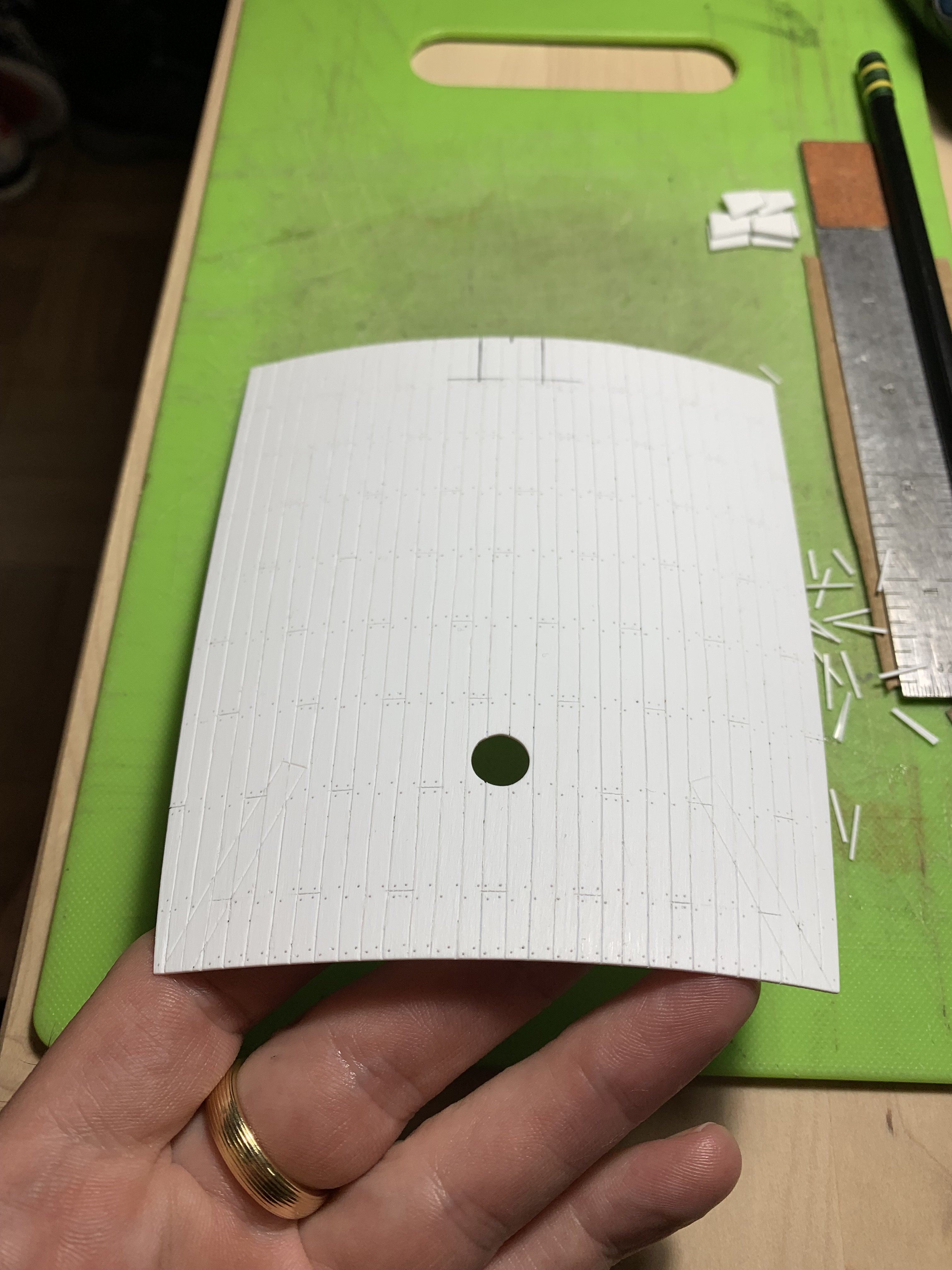

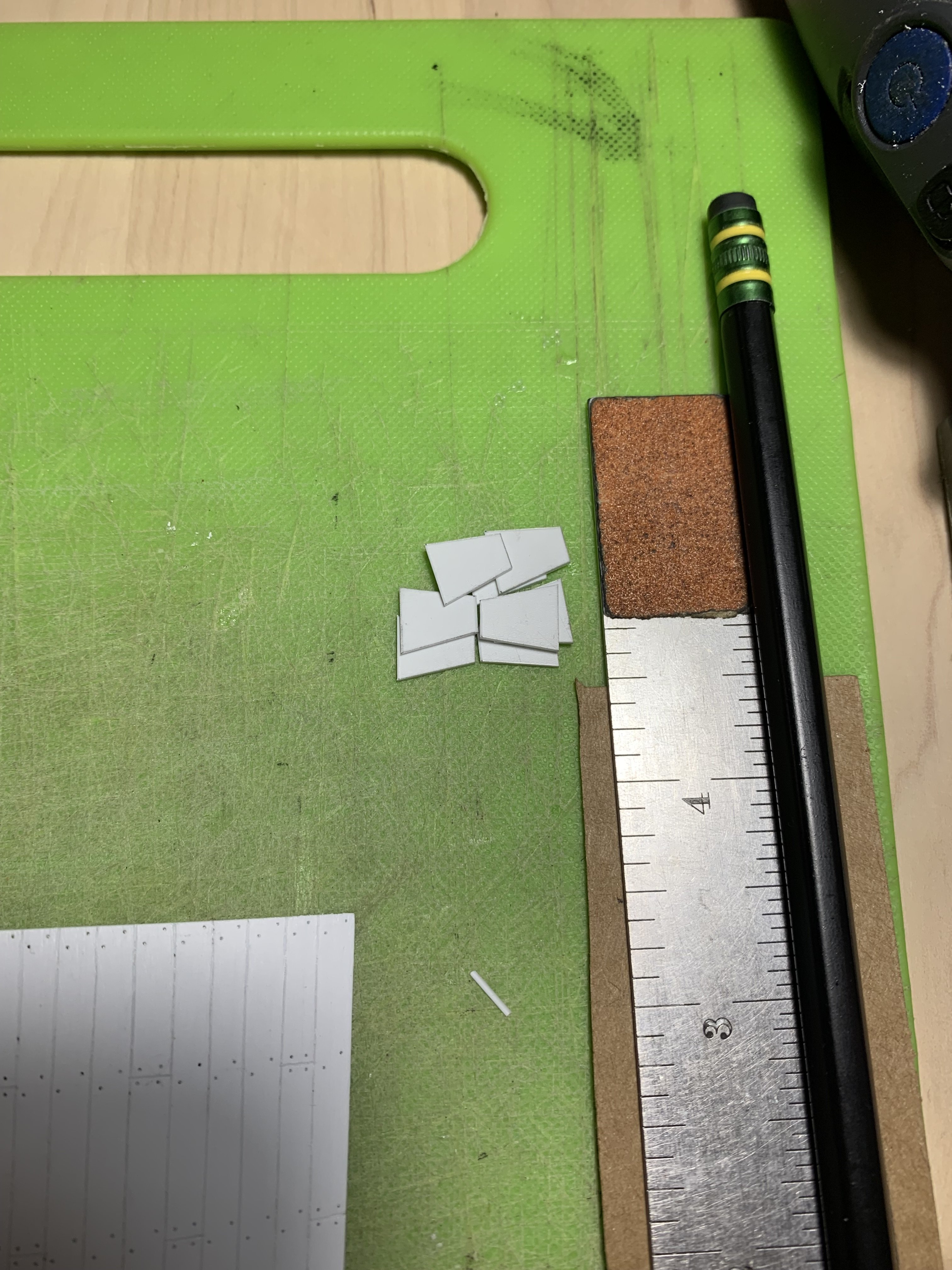

A few of these plank lines are a little ragged, but from most perspectives those flaws will not be very apparent.  I found that, at first, I was moving a little too quickly with the engraving, and not taking enough score passes to create a clean channel to back-drag the tip of my blade.  The proof will be in the paint, when those lines really jump out, but I think it will be okay.

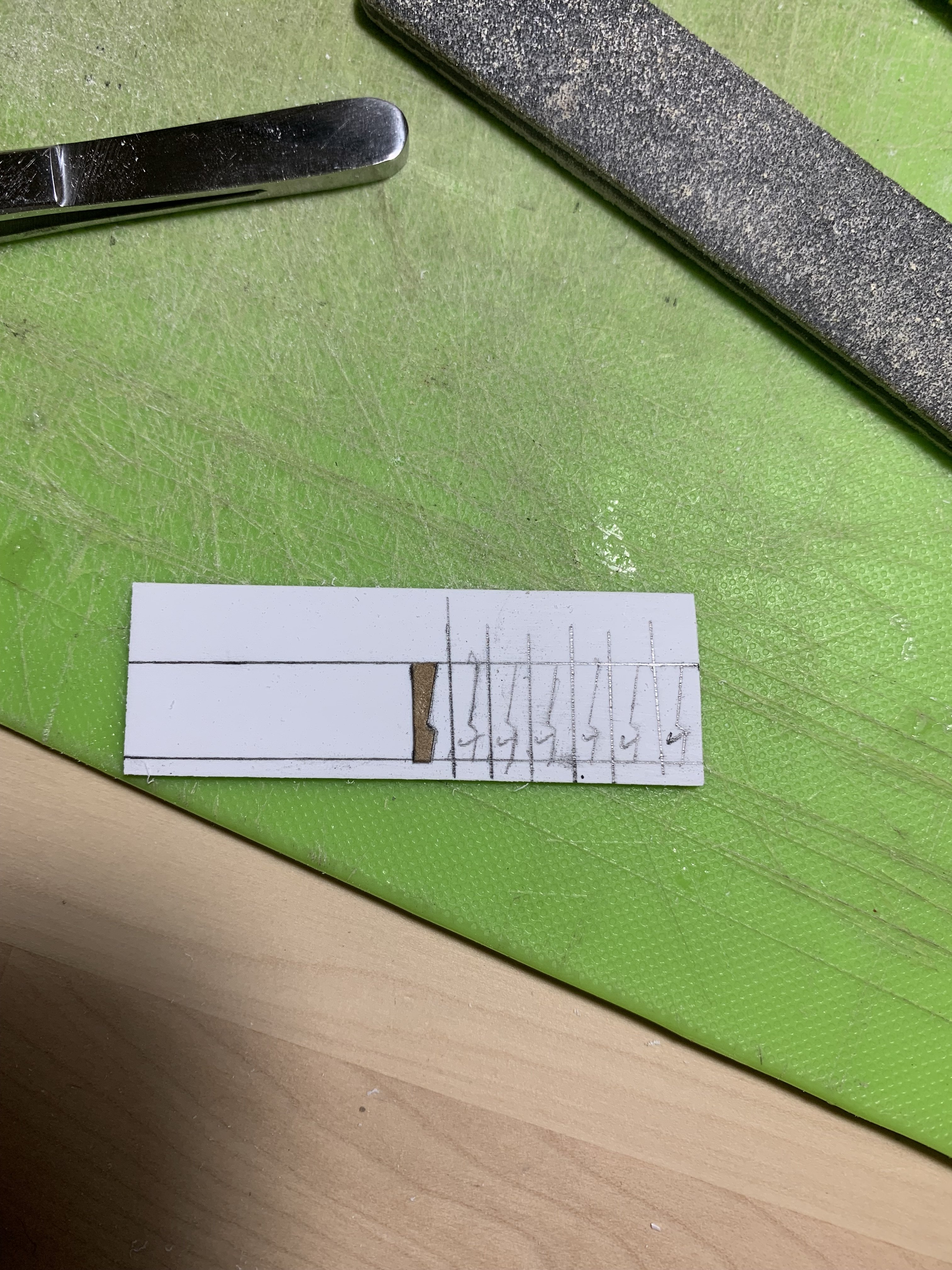

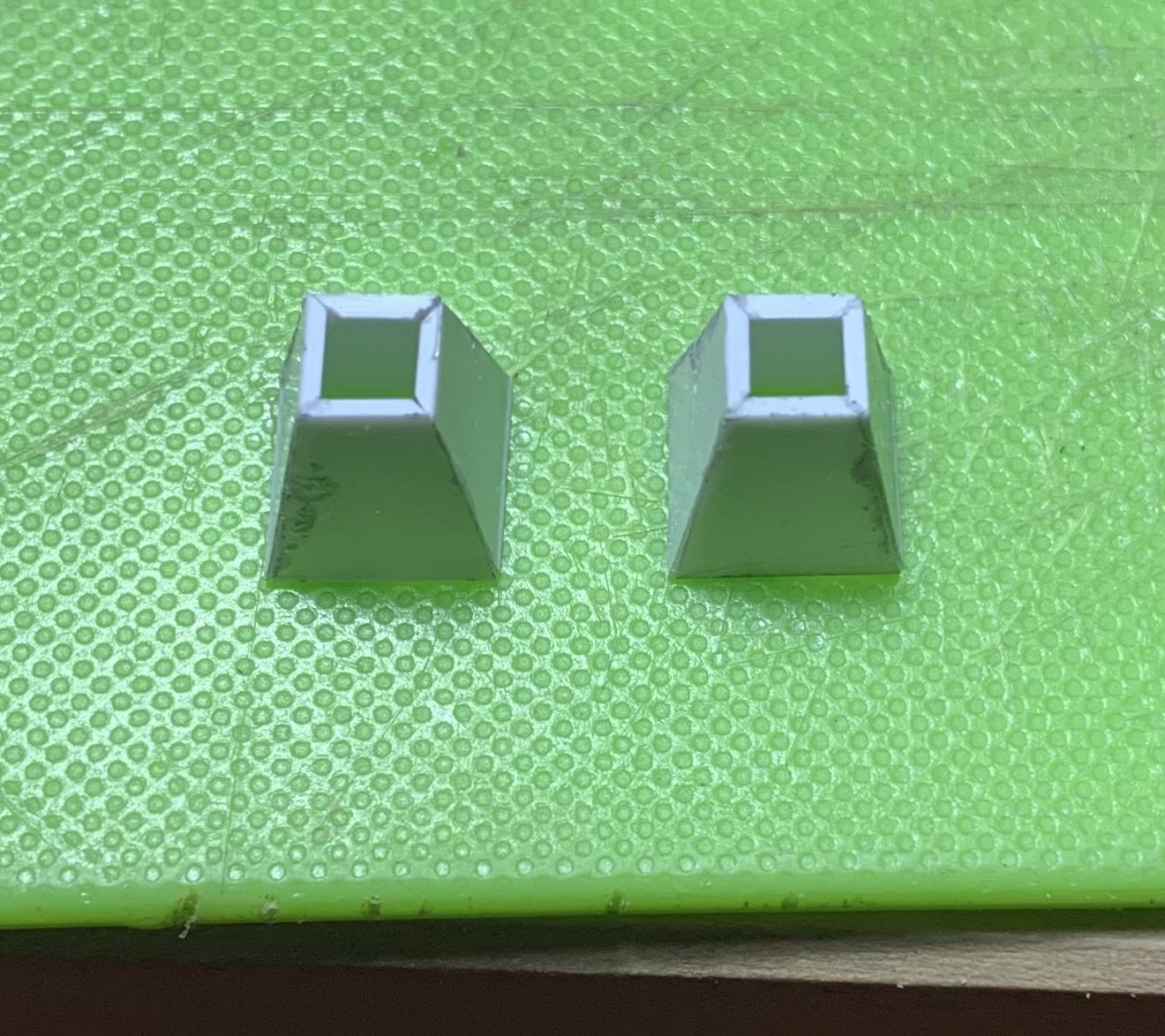

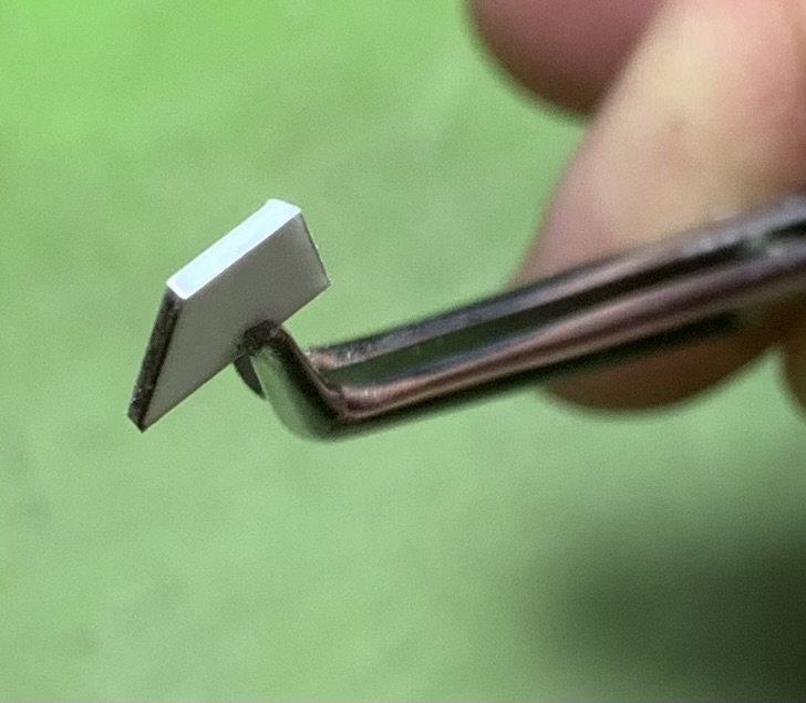

Next up, I decided to make the galley chimneys:
I blacken the edges with graphite, so that I can more easily gauge the bevels I am filing into them.

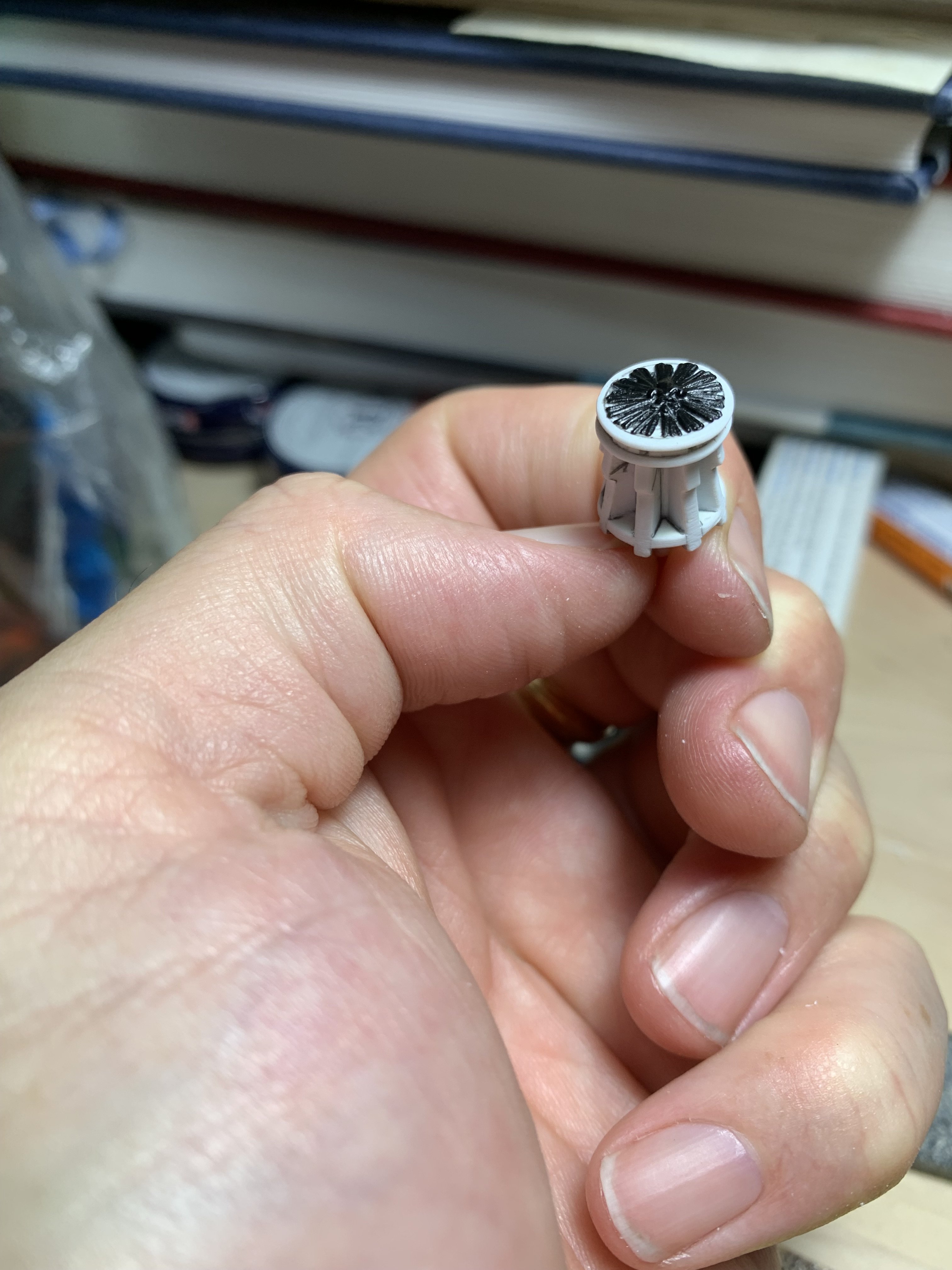

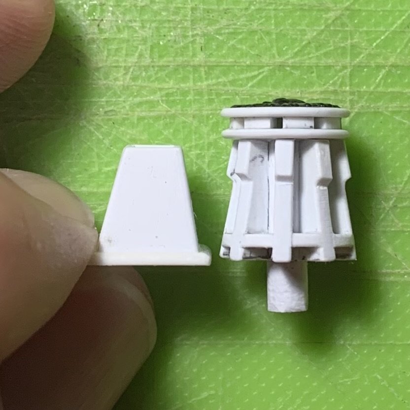

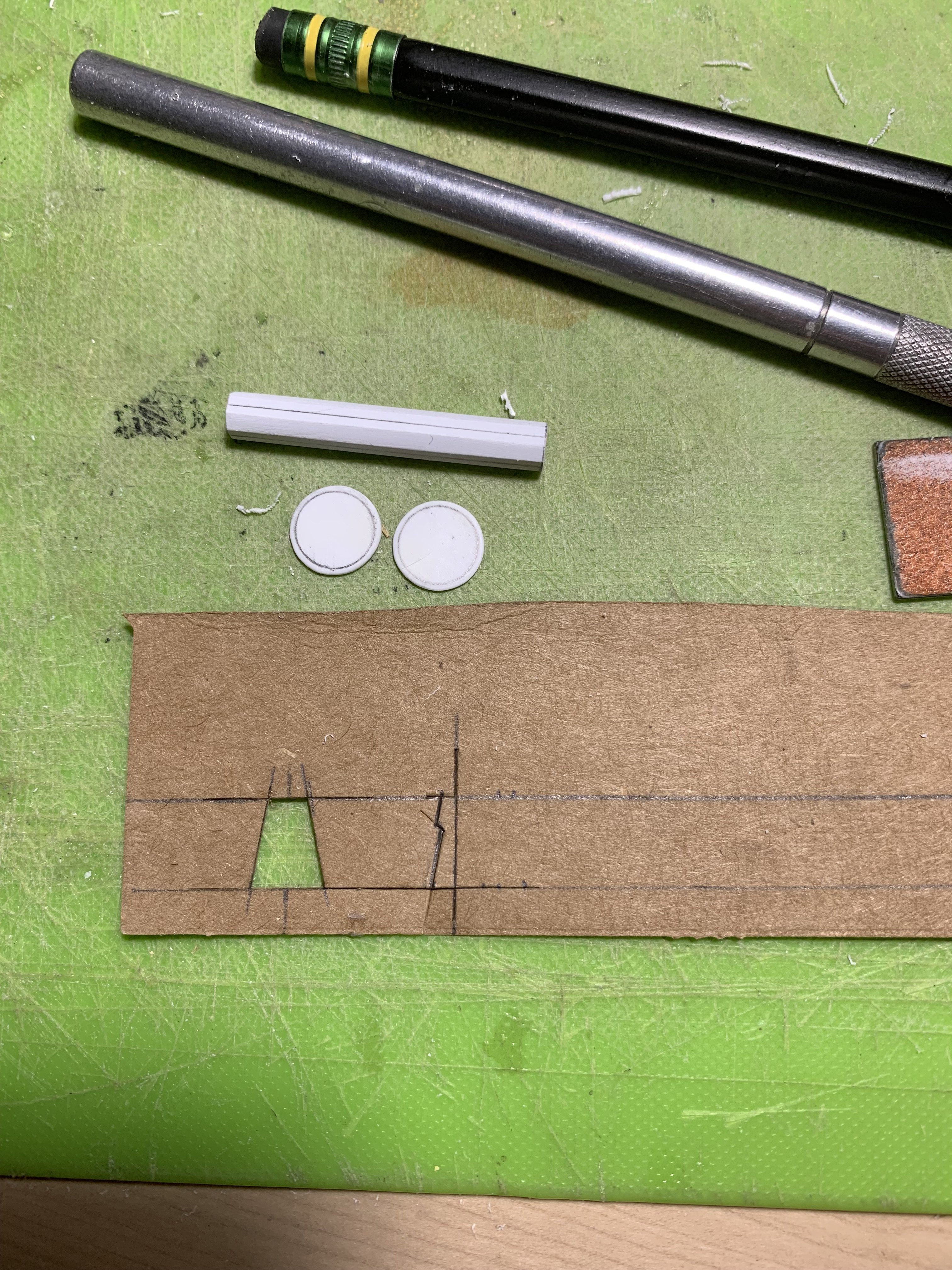

Next up - I wanted to make a f’ocsle capstan because I see evidence of one on the Louis Quinze model at the musee.
A montage:

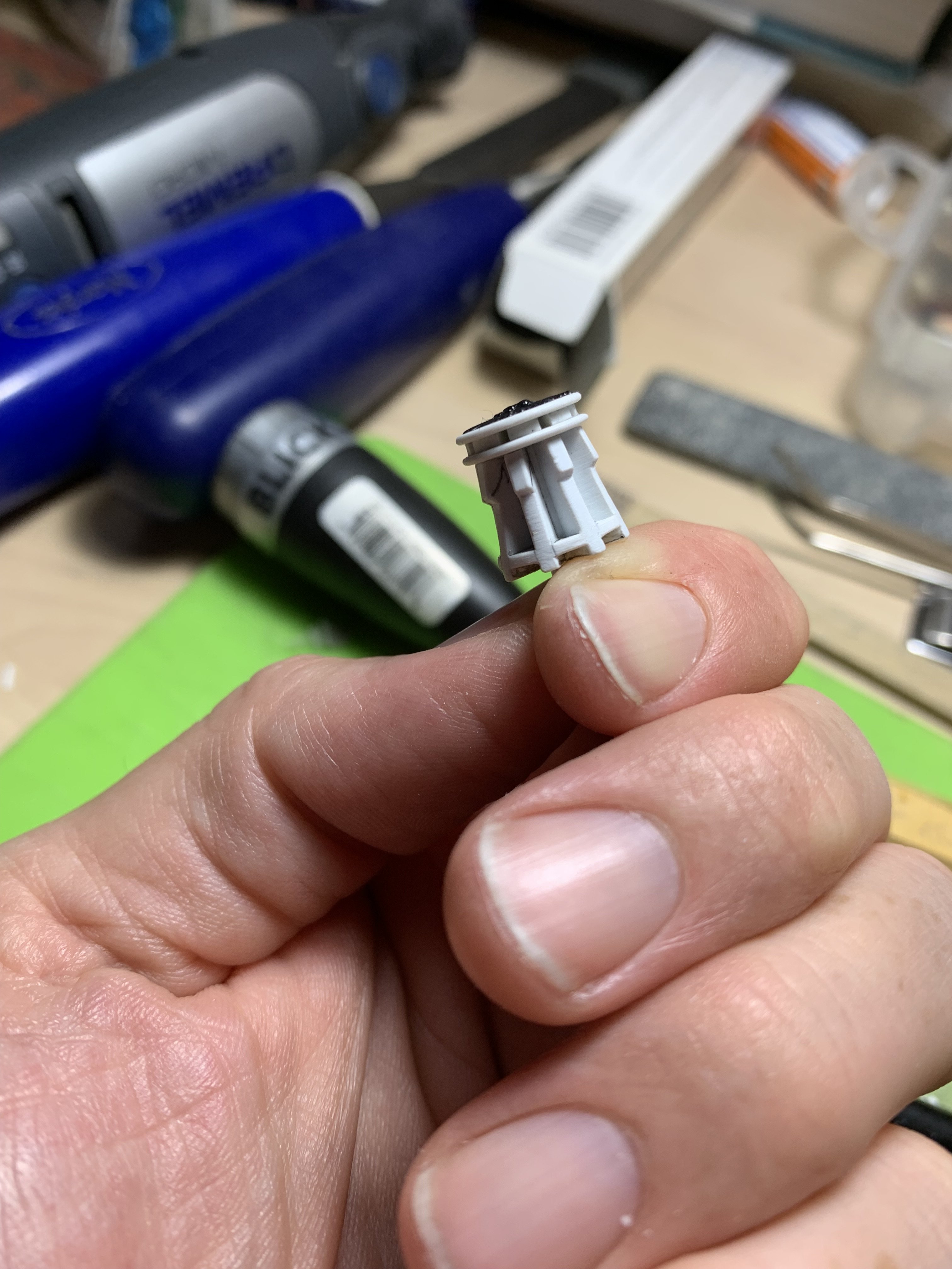

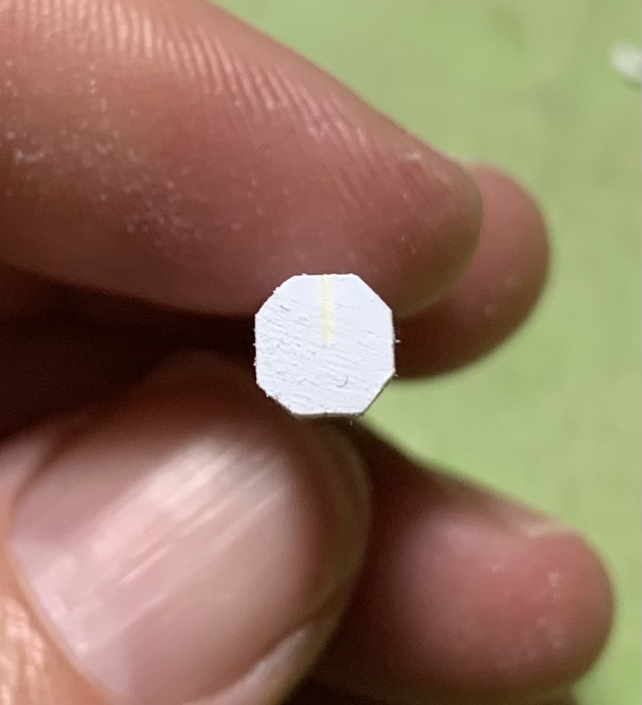

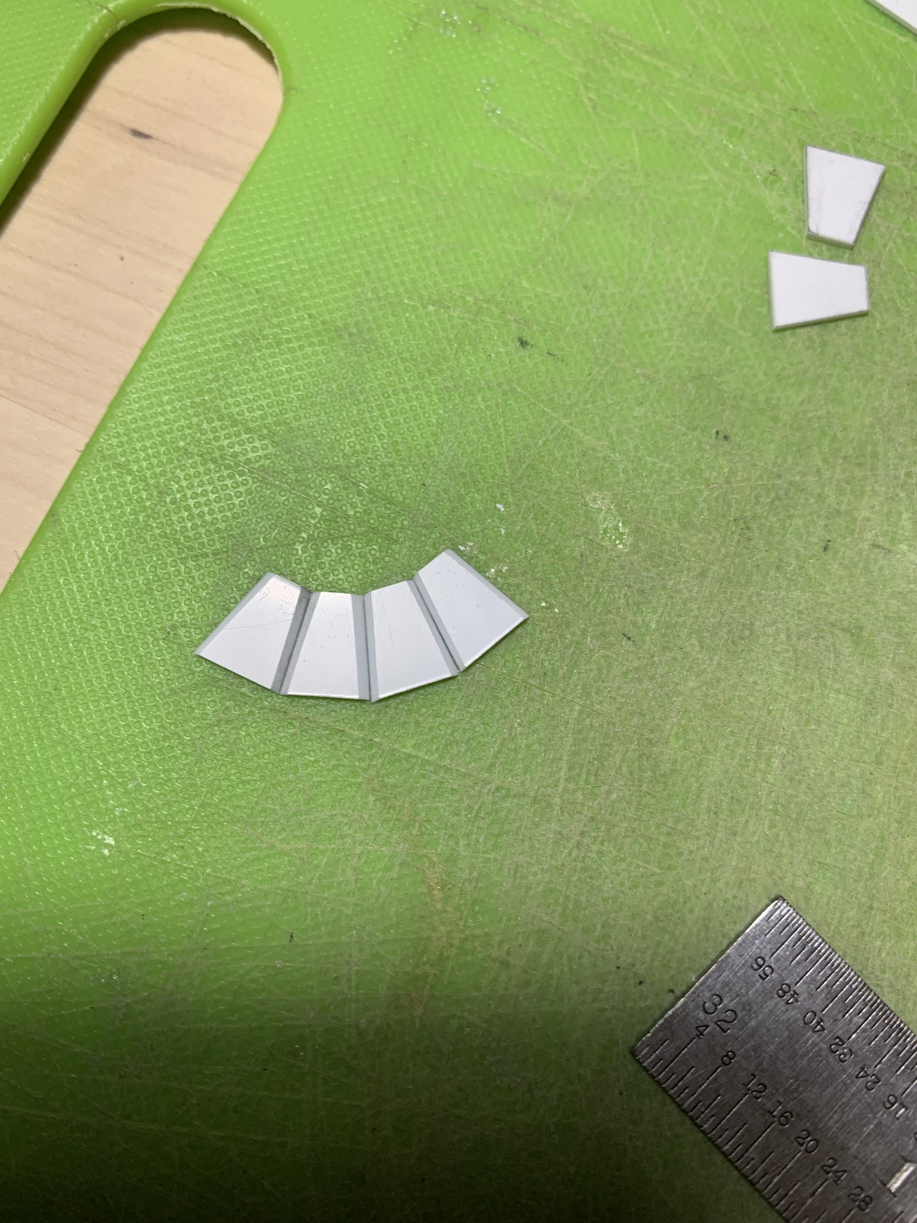

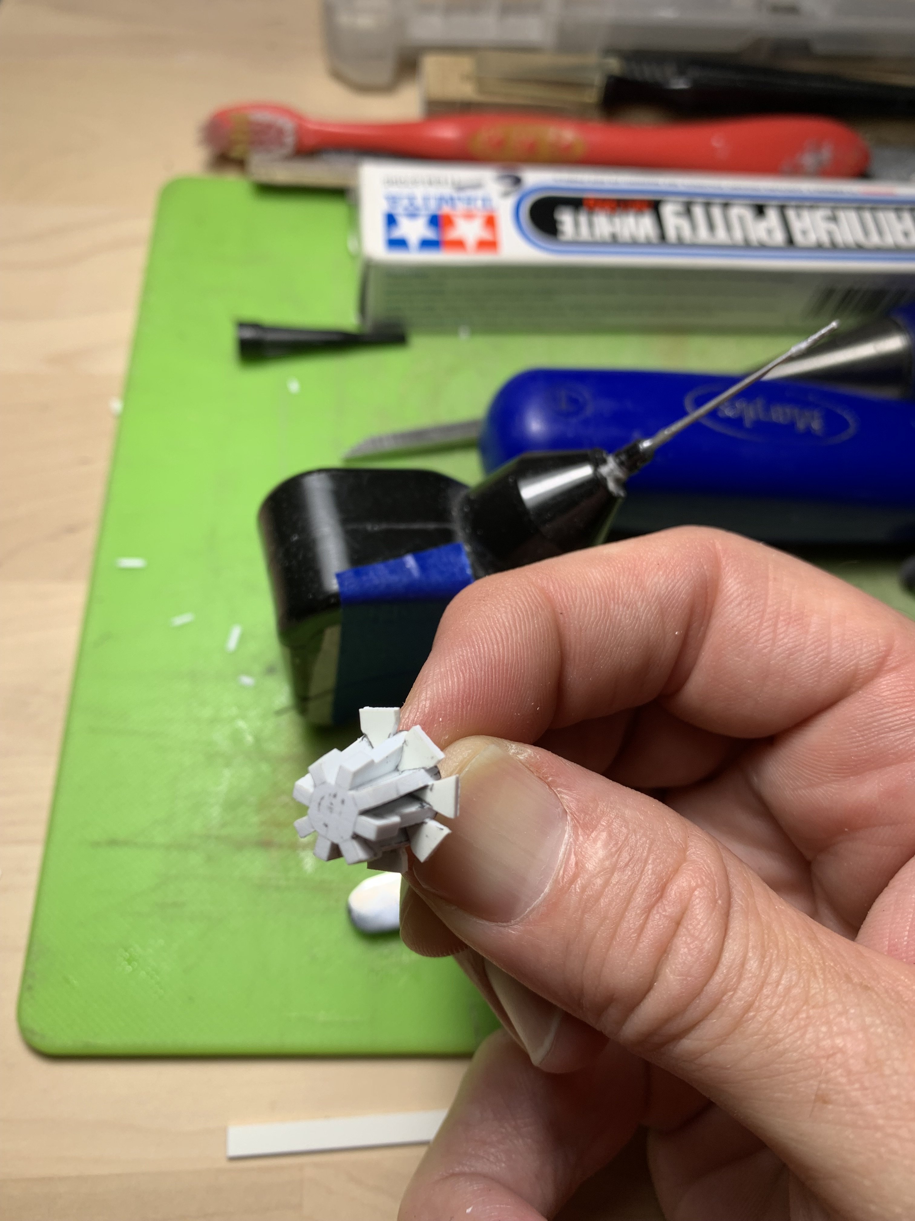

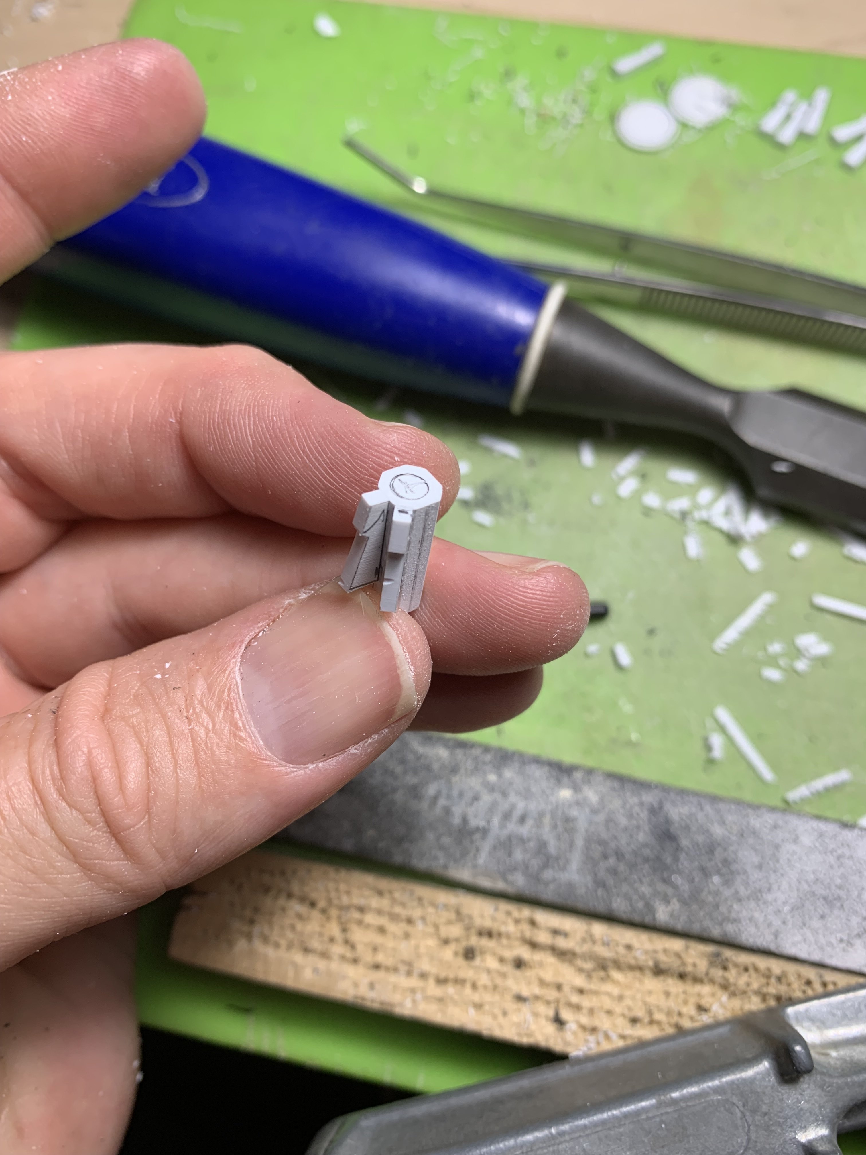

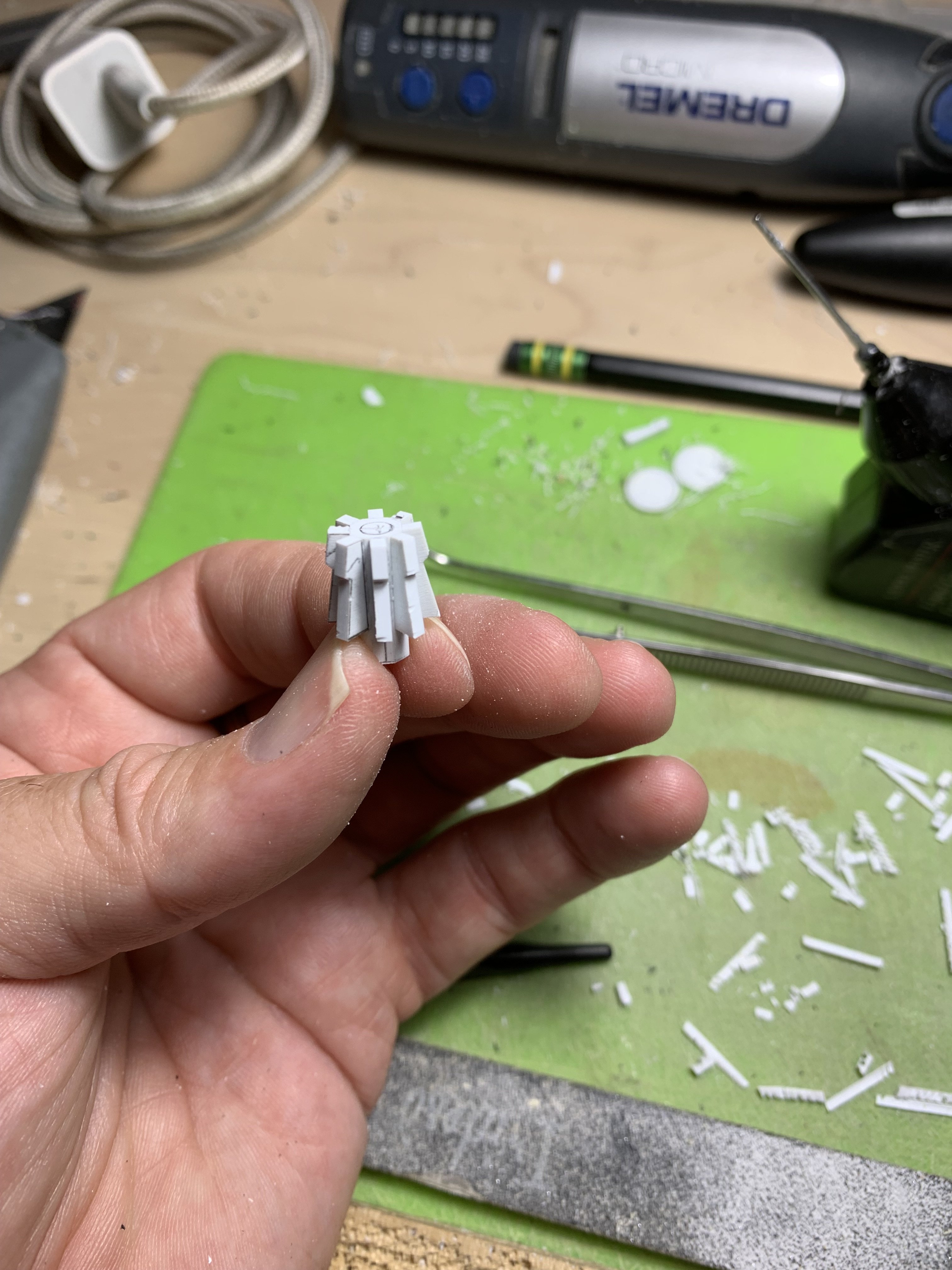

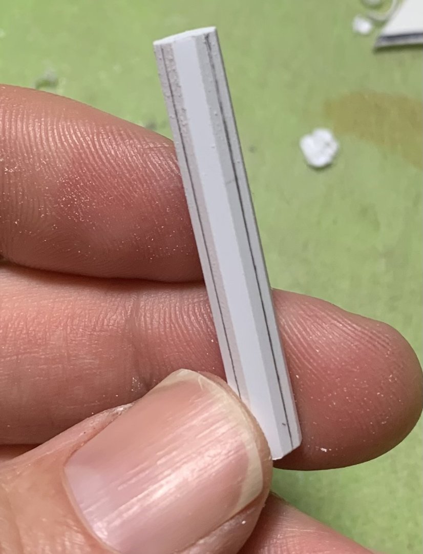

The foundation of the machine are 4 pcs of .100 square stock cemented together, and then trimmed to 3/16” square.  I then faceted the barrel into an octagon:

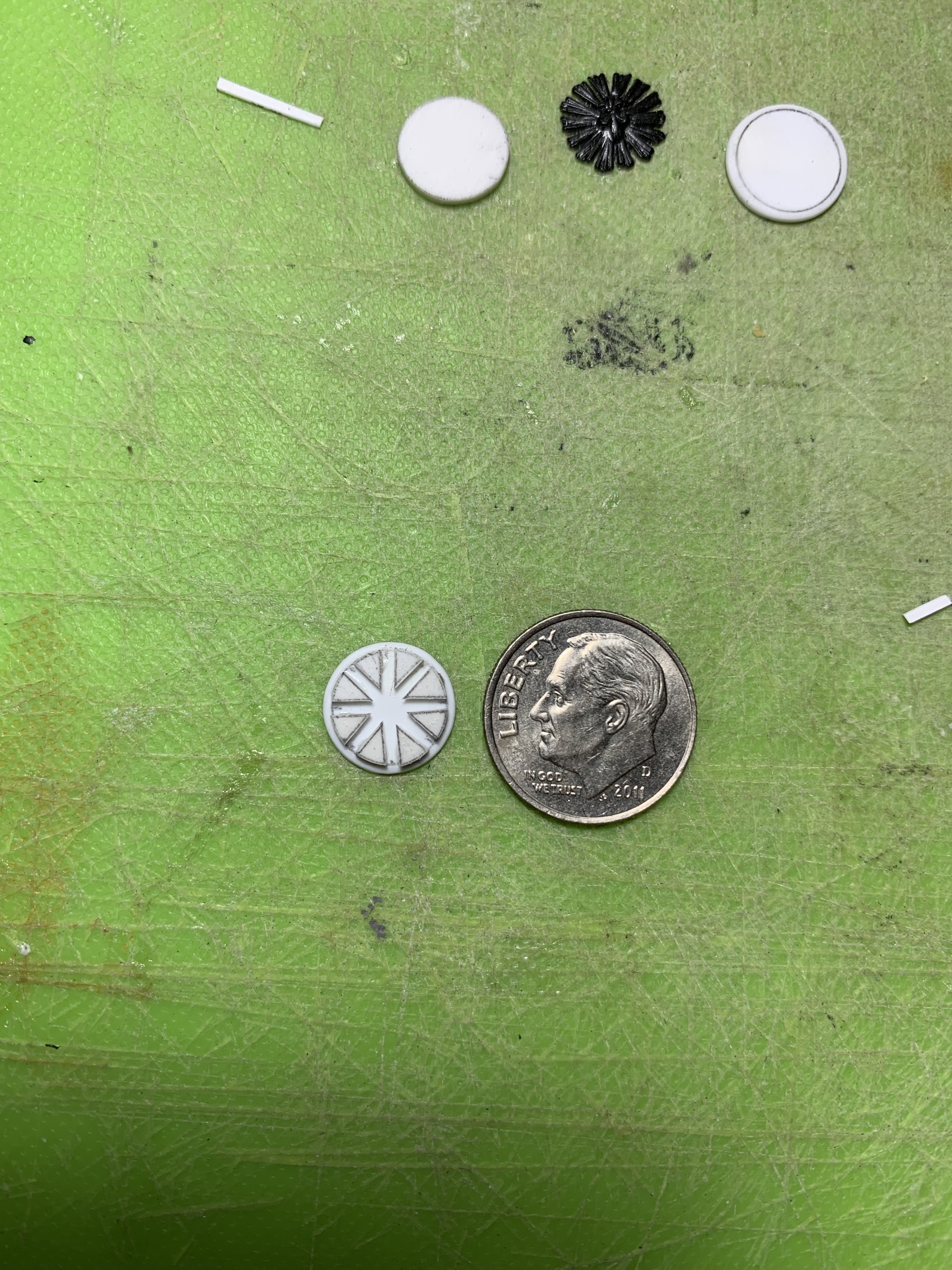

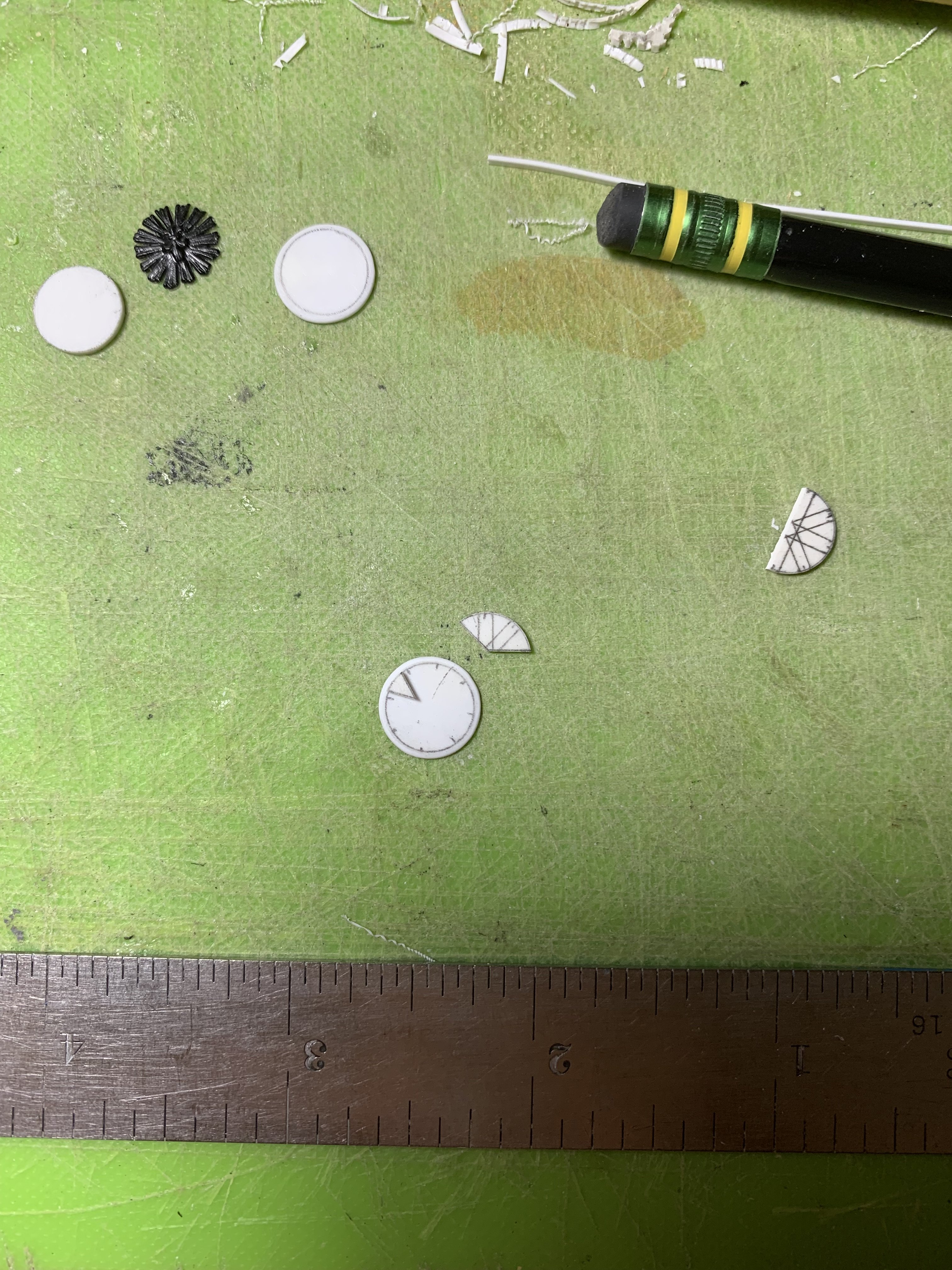

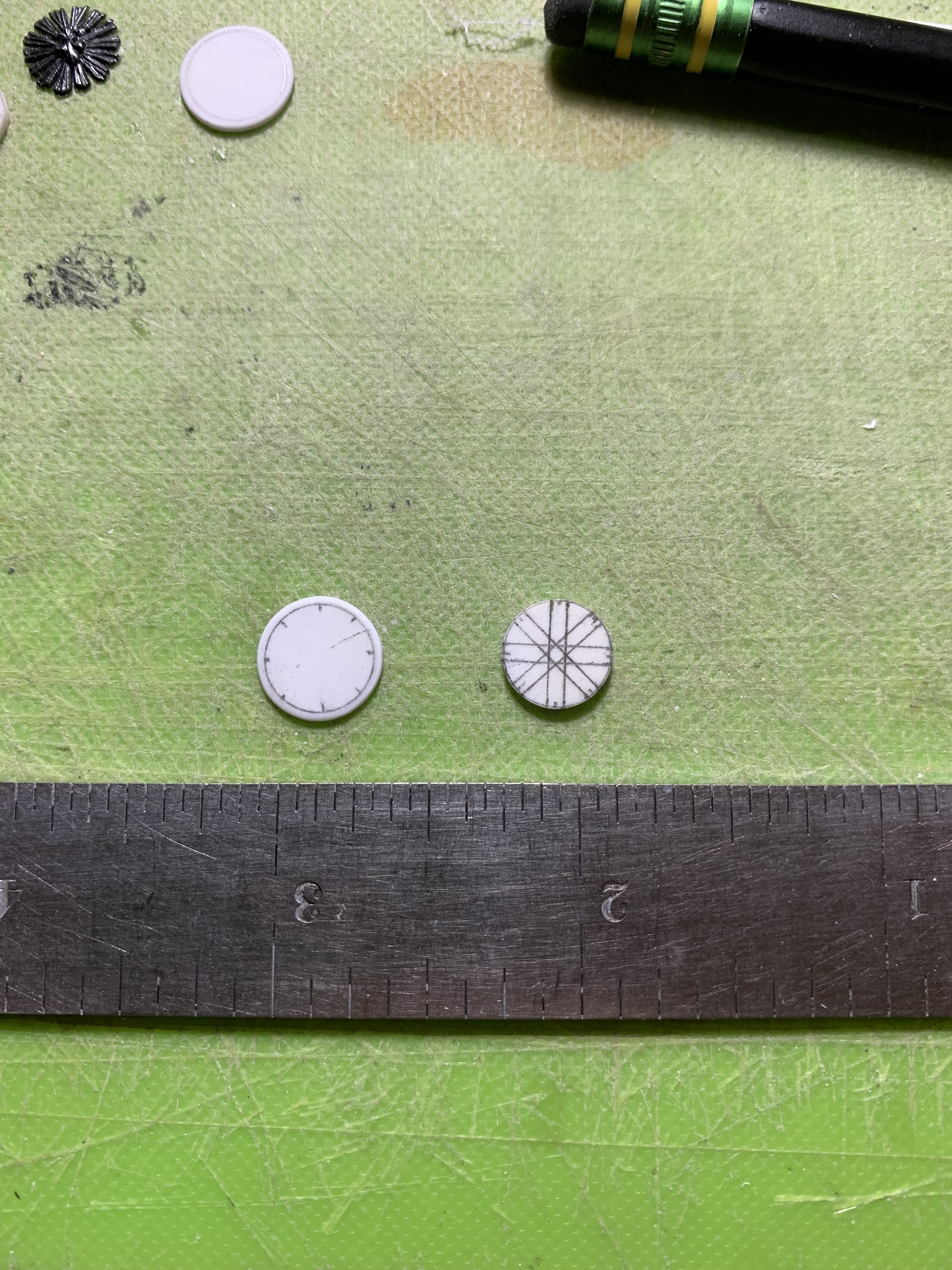

I am always looking for places where I can re-purpose the stock ornamentation, and these radiant fleurs from the quarter galleries seemed like a fitting complement to this machine.
The capstan will stand four scale feet above deck and the capstan bars will just clear the height of the chimneys:
All-in-all, this little machine was one of my favorite elements to make for this project.  I still have to make the capstan locking pawls that engage at the foot of the machine.

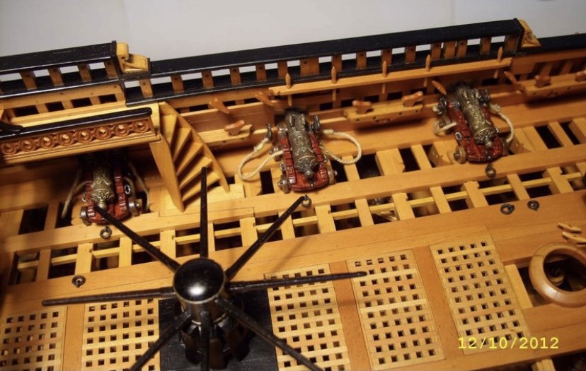

Very nice, but why did you make an 18th-century capstan, especially since you are putting so much effort into this project? As the capstan may be considered quite an iconic element of a ship, I thought you might like to see some graphics from that era. Admittedly, they are a bit schematic, but still they show the type of capstan used in that period and in that place. Actually both capstans, that is main (double) capstan and small (single) one.
Claude Caron, Traité des bois servans à tous usages, 1676:
CaronClaude-Traitdesboisservanstoususages-1676-2.thumb.jpg.b0339a523371cdab4a8bb43a92275eba.jpg
CaronClaude-Traitdesboisservanstoususages-1676.thumb.jpg.908324725cd10add783eb0094f0c86dc.jpg
anon., Construction des Vaisseaux du Roy, Havre de Grace 1691:
ConstructiondesVaisseauxduRoy-HavredeGrace1691.thumb.jpg.b5483877ca4a27fc30583aafe666ae06.jpg
F. Dassié, L'architecture navale, Paris 1677:
François Coulomb, Livre de construction des vaisseaux, 1683:
FranoisCoulomb-Livredeconstructiondesvaisseaux-1683.thumb.jpg.65e9b7fdb83898e11dfe4613bb4f4b53.jpg
Hello Waldemar!  Your observation, on this point is well-received.

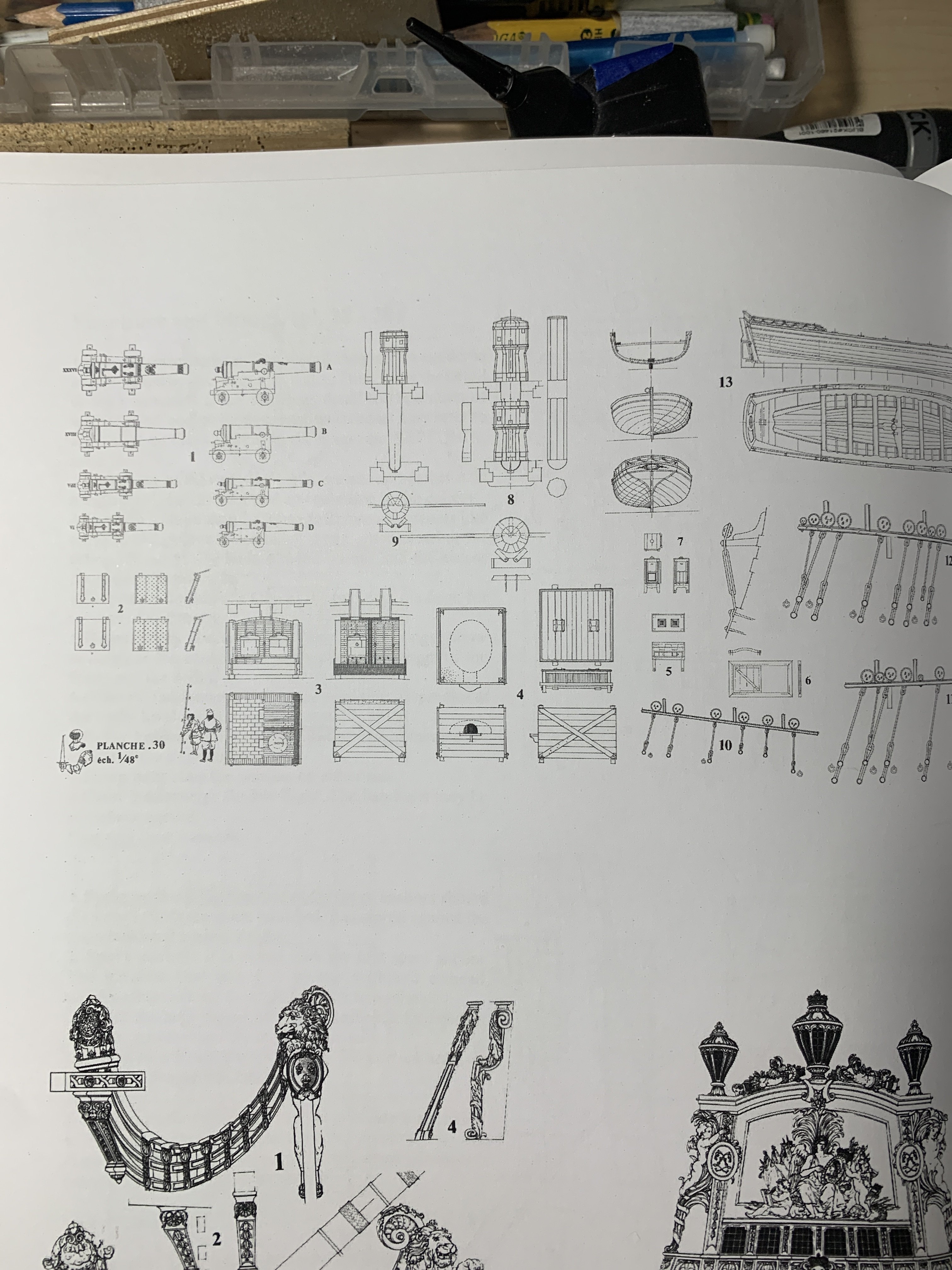

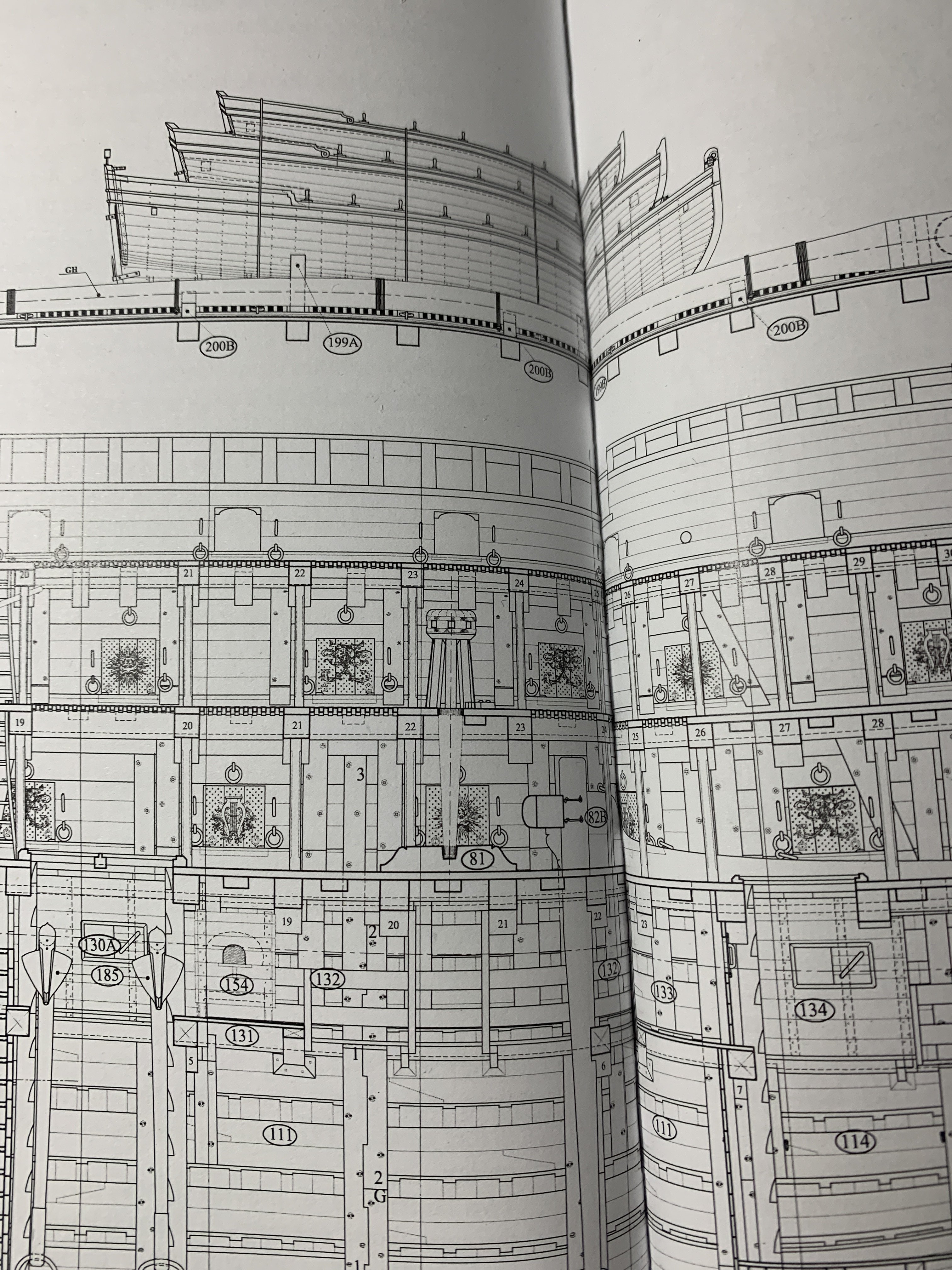

Honestly, I did not think to consult the Album de Colbert.  I, instead, referenced Boudriot’s L’Ambiteaux:
And Lemineur’s SP:
Interestingly, the style you reference shows up on Lemineur’s Francoise, which is closer to the 1670’s.  I did not think to look here, though, before you raised this question:
Generally, I assumed that by the late 1680’s, France had shifted to the more familiar drum capstan.
