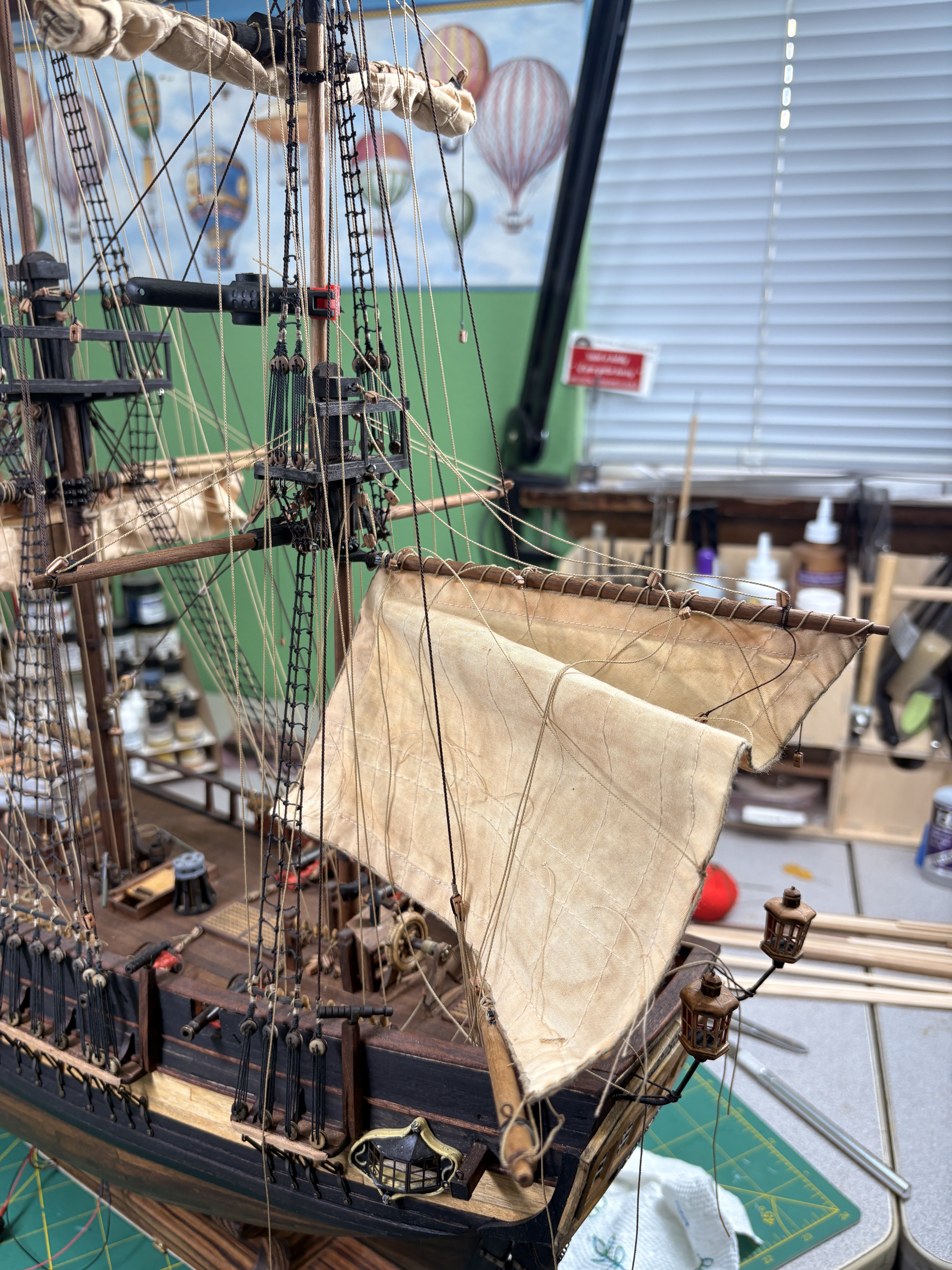

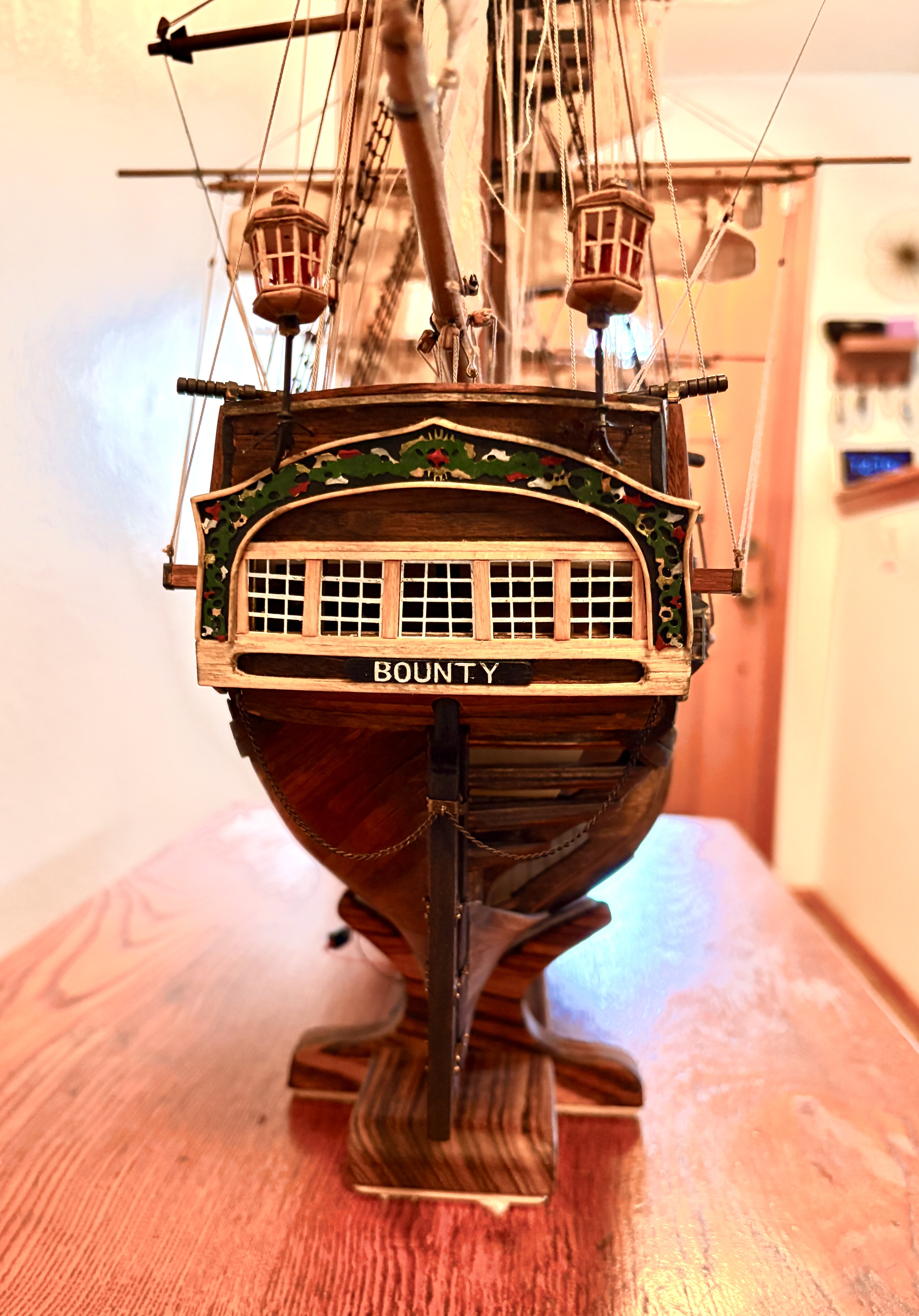

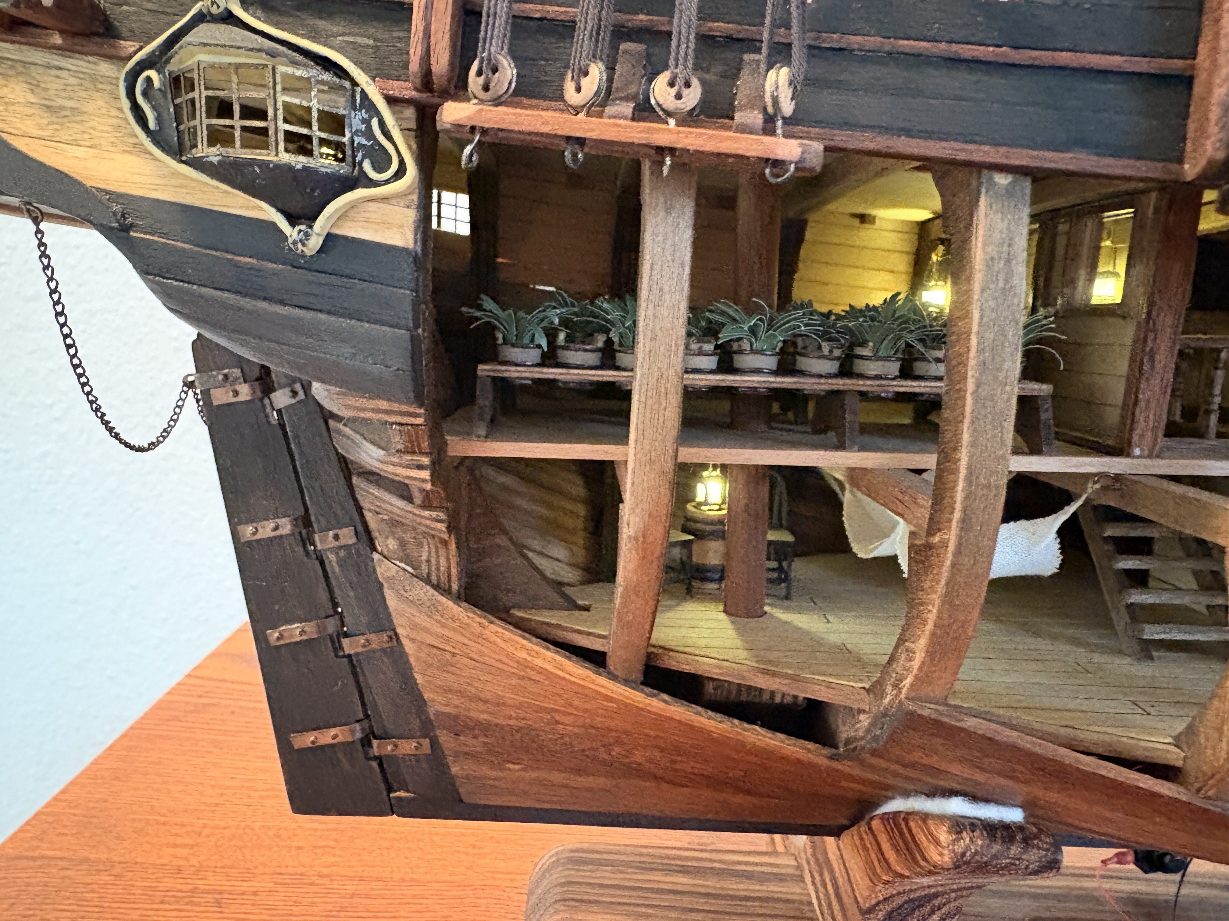

At the bow of the boat there are two lanterns, and you mounted them on small metal tubing to allow led lights to go up into the lanterns. My question is how did you bend the tubing without it crimping?
Lee Richards
Lee Richards
They are on the stern... but I get your question.
I used a brass tubing which is softer and easier to work... using a small amount of heat and a thread spool as a form, I just heated it up and bent it around the spool.
As a side not, unfortunately, I bumped the starboard side tubing during some of the rigging work and broke the wire going to the light in the lantern... about made me cry!!
I tried for several hours to get a piece of the wire pulled out to reconnect it... in the end, I had to give up... just is not possible. Makes me sick!
But stuff happens!
Lyle
Lee Richards
Hi Lee,
Another method you can use is to thread a solid wire slightly smaller than the inner diameter of the tube through the tube before you bend it and removing the wire after bending the tube. I have done this with stainless steel tubing used for HO scale (1/87 scale) lights. It is the method used for Ngineering LED lights for railroad models. Provided the bend isn’t too sharp it works well.
Jeff Betcher
Current Builds:
Completed Builds: Lively of Baltimore 1813 - The Lumberyard; 1/72 Canadair CL-215 water bomber Ontario markings, 1/72 Canadair CL-215 water bomber Newfoundland markings; 1/72 Canadair CL-415 water bomber Ontario markings
Future Builds: Future Builds: HMS Bounty - Artesania Latina; Tender "Avos" Master Korabel; NRG Half Hull; HMS Speedy Vanguard Models
But stuff happens!
Hi Lyle,
Yeah, stuff does happen, too often to my models, but I must be clumsy. 😬
But more importantly I hope your wife and you are doing okay and you can return to finishing your wonderful Bounty when time allows, I'm looking forward to seeing that and hoping it will inspire me to get mine finished after coming up 14 years! 🤭

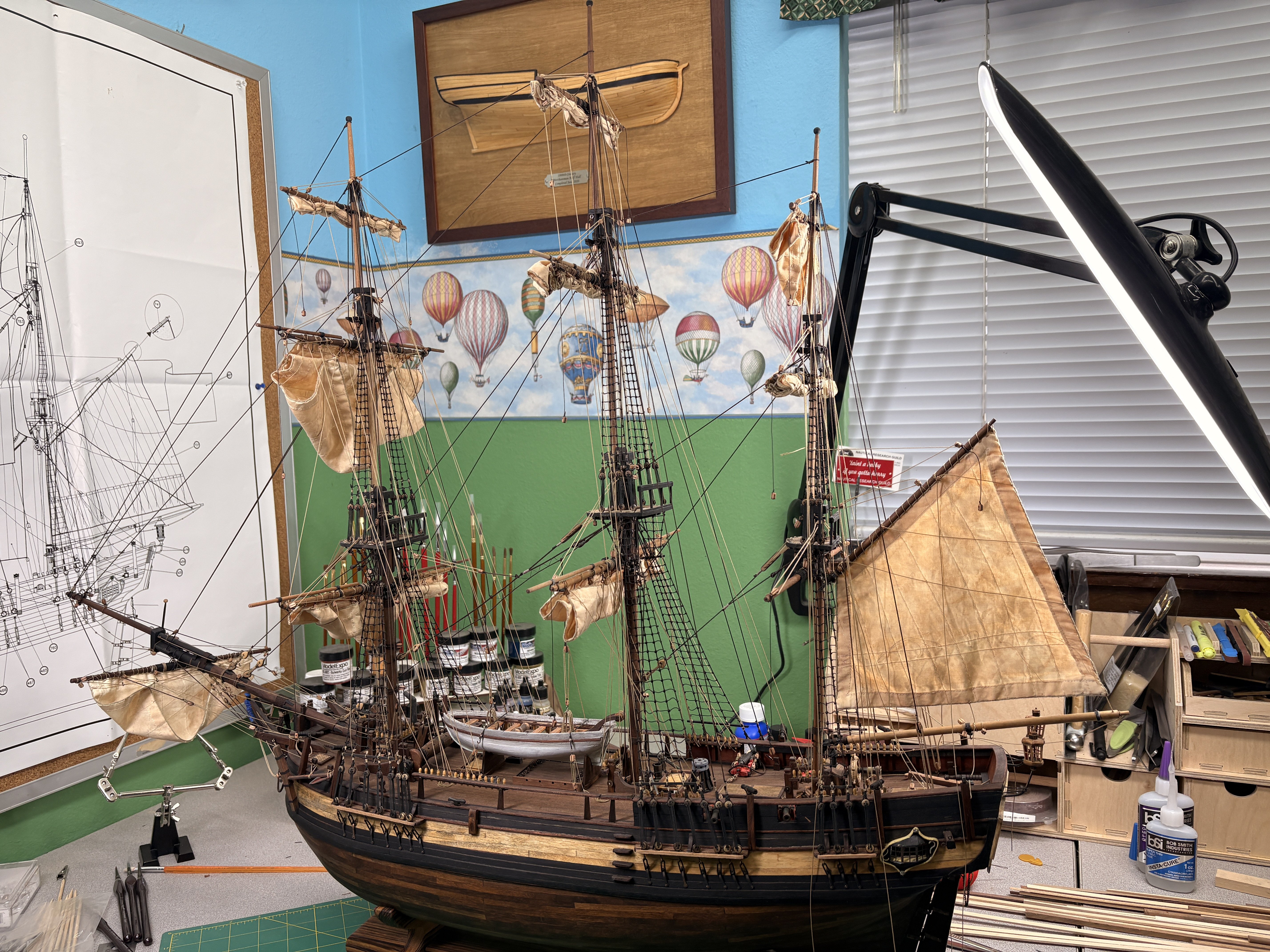

It has been a while...
I lost my wife a year and half ago. It has taken some time to get my life back on track!
I've finally gotten to the point that I am looking forward to getting back to work on the Bounty. I've spent the last several days dusting her off and re-familiarizing myself with where I left off.
Did some new lighting in the shop to help with these older eyes and sorting through the tools, etc.
Ready to get back at it!
I expect to do some sail work over the next few days and weeks and will begin posting updates again very soon.

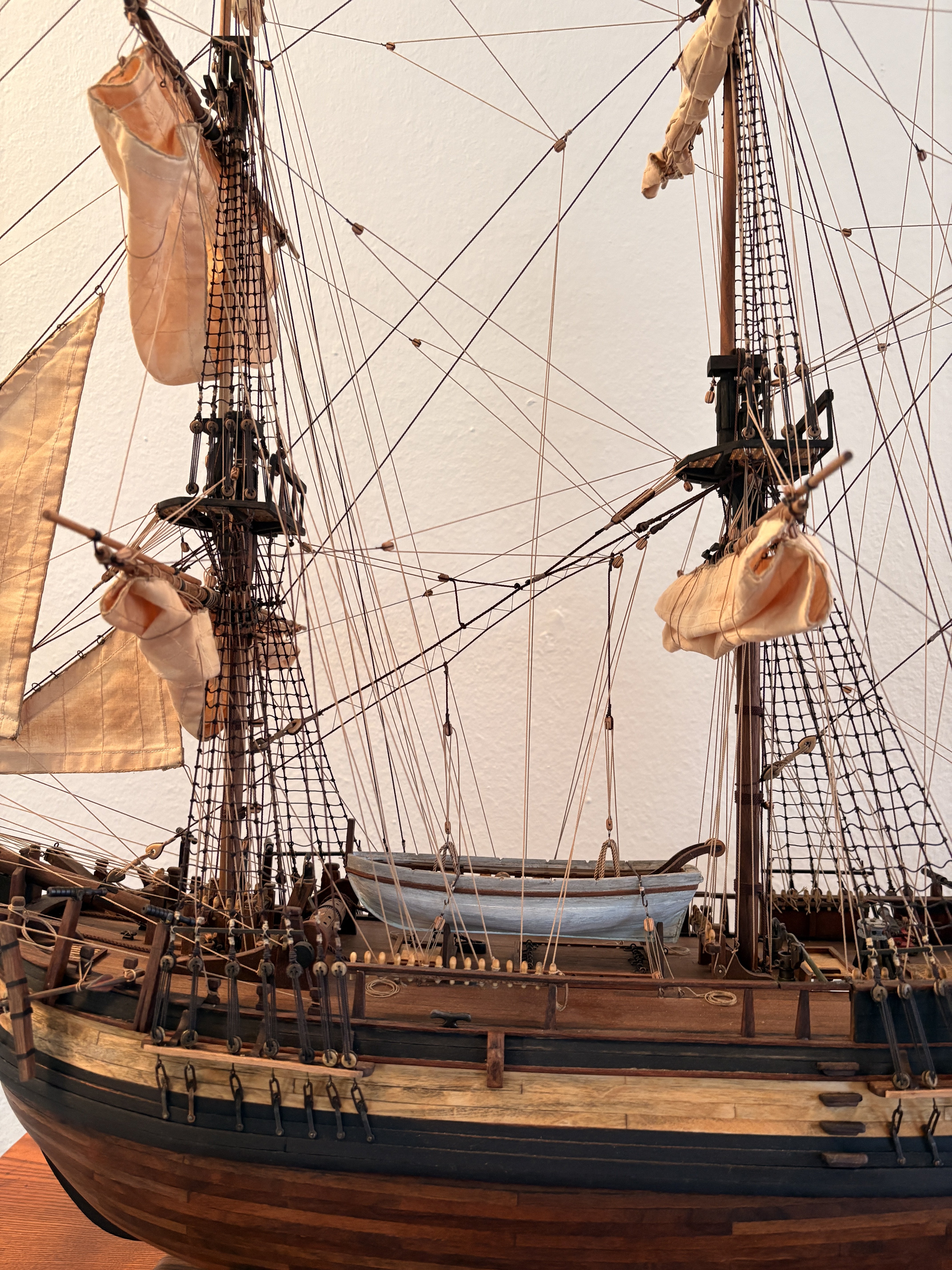

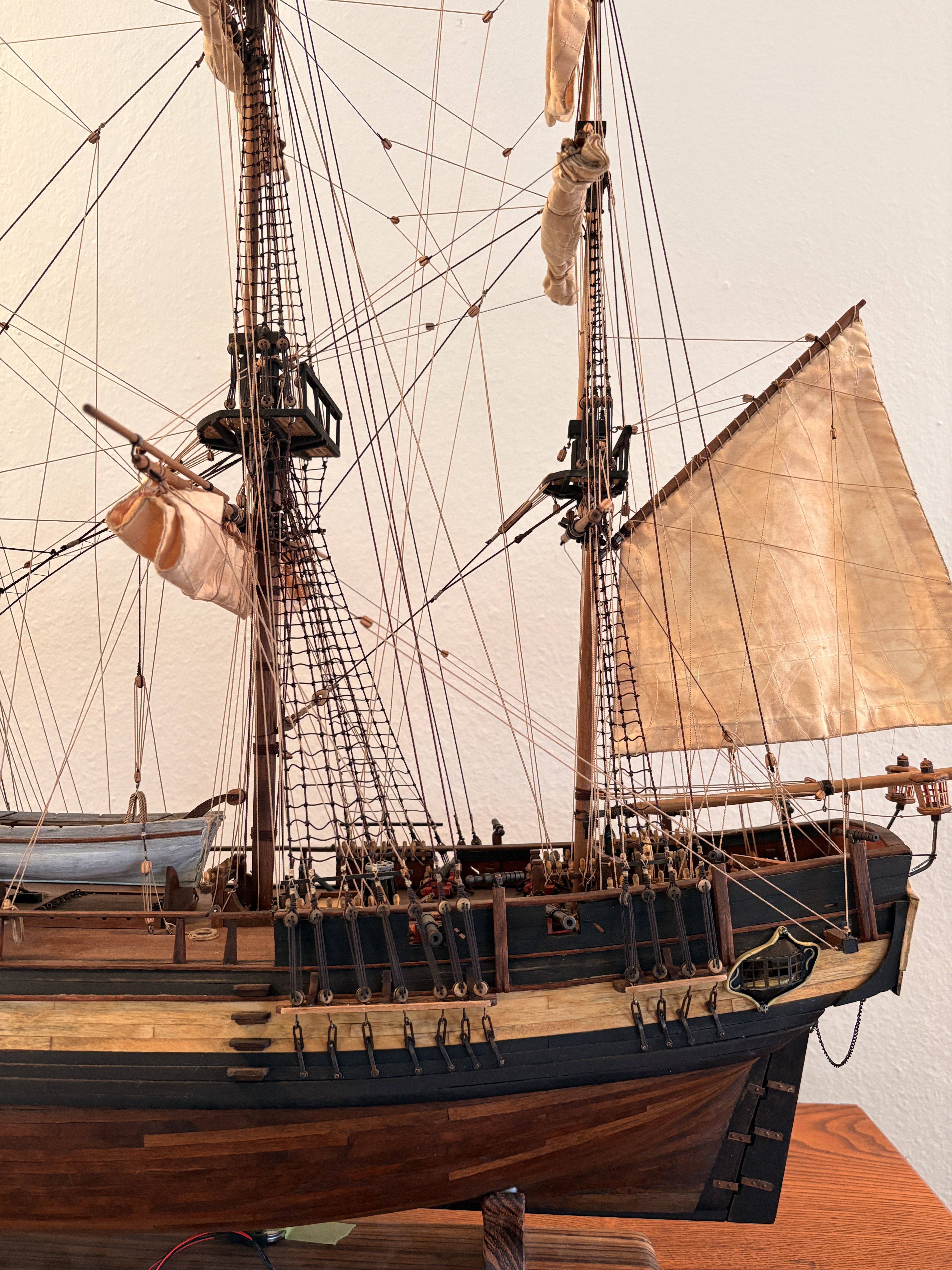

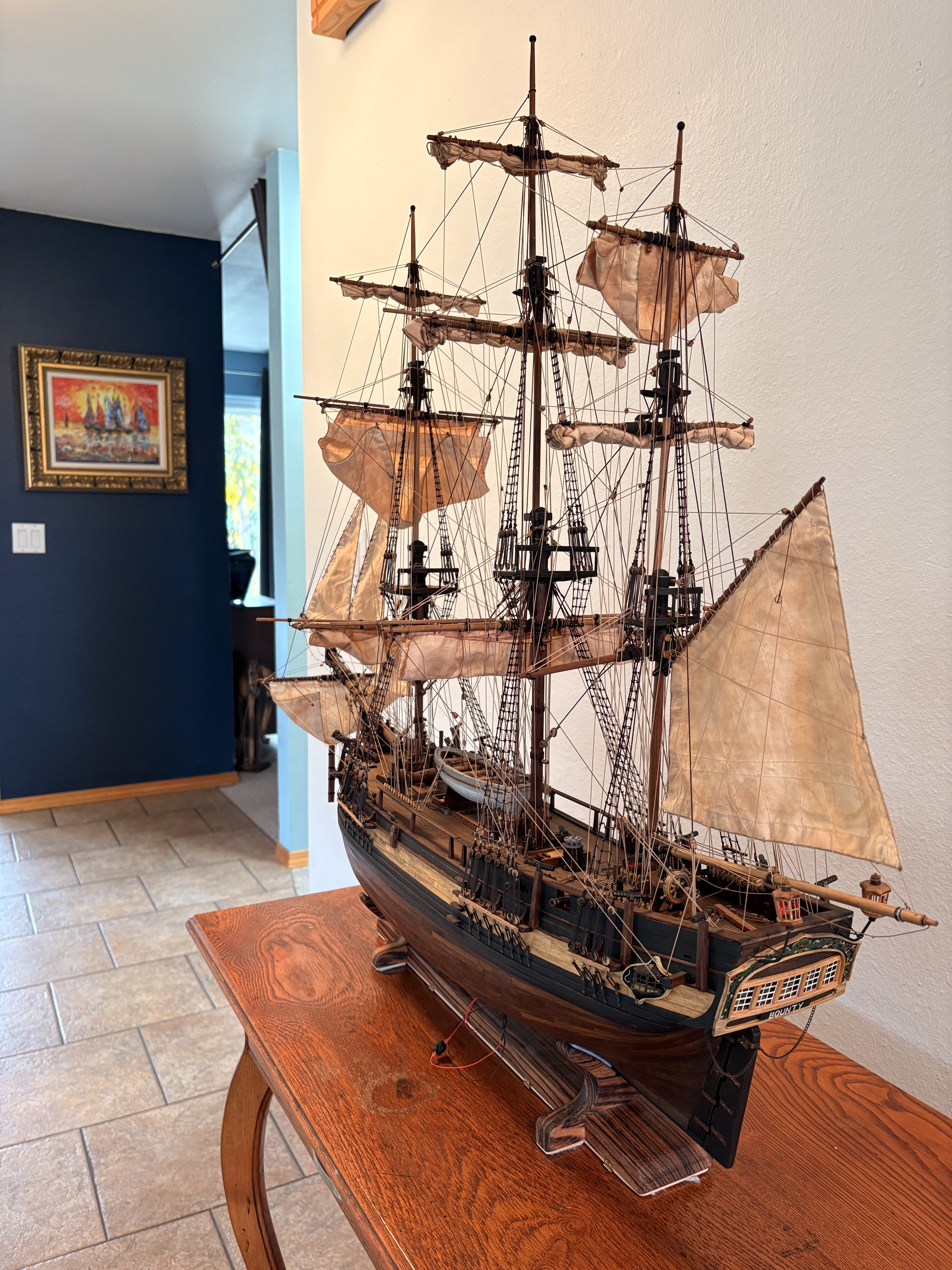

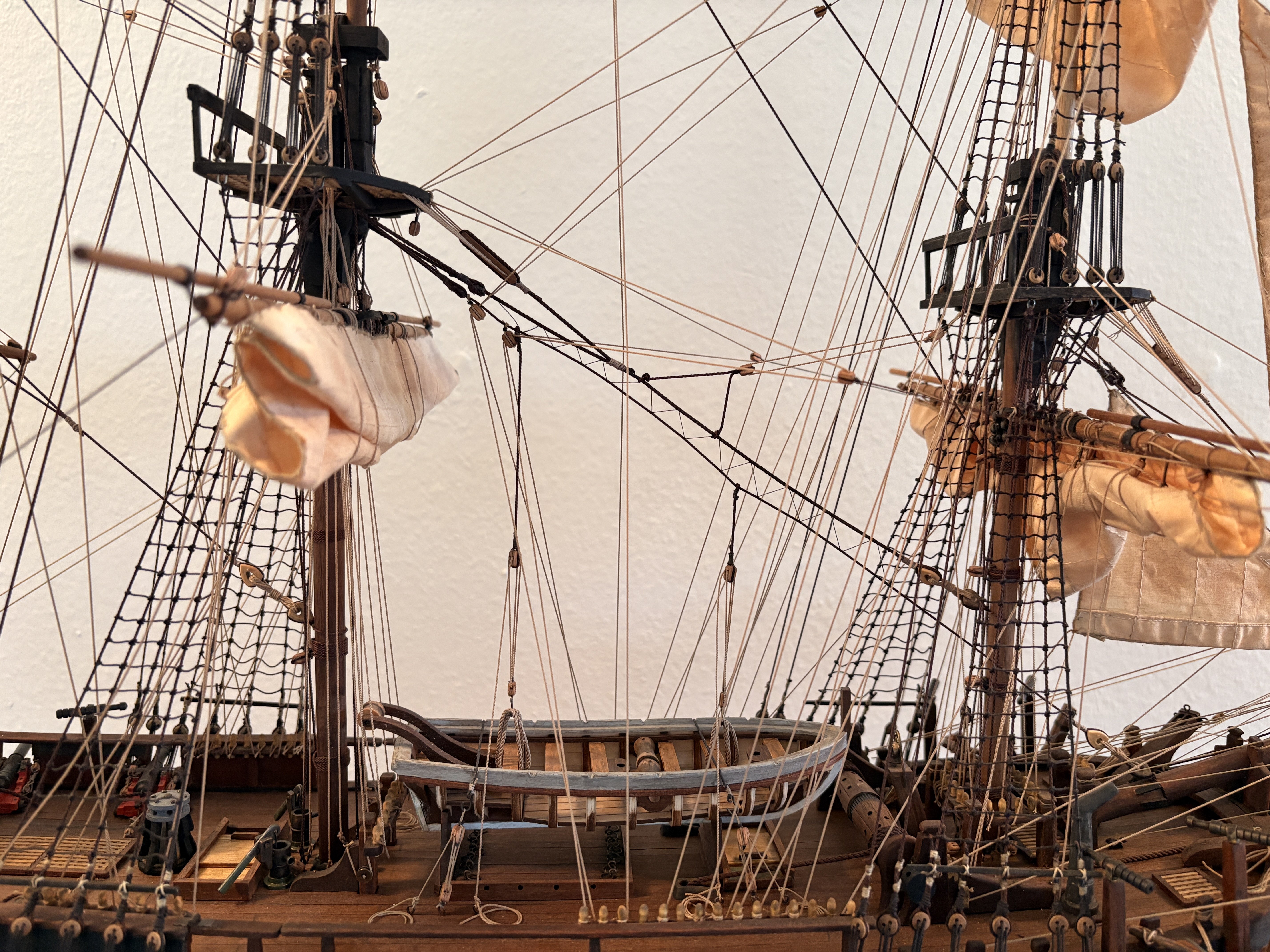

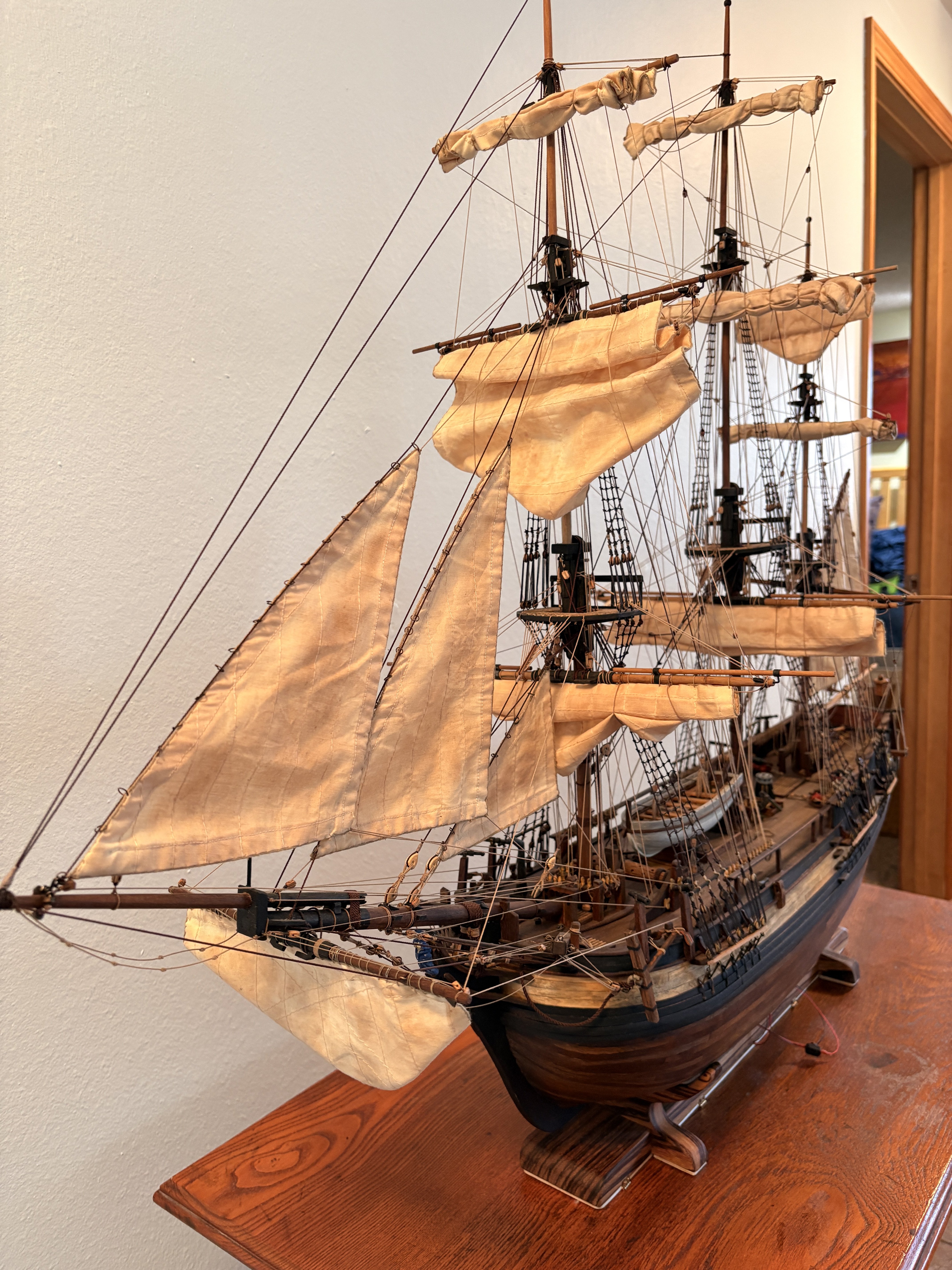

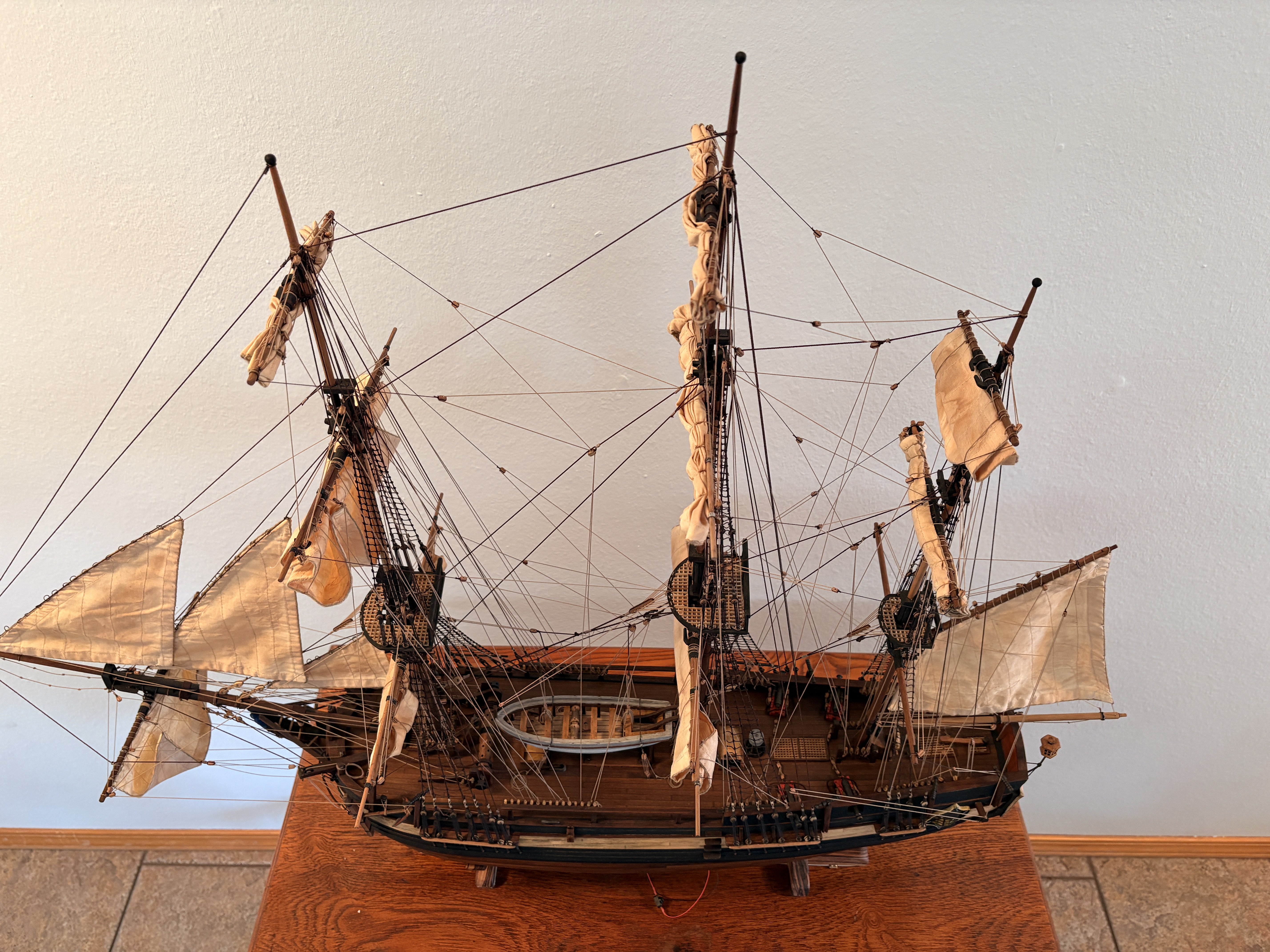

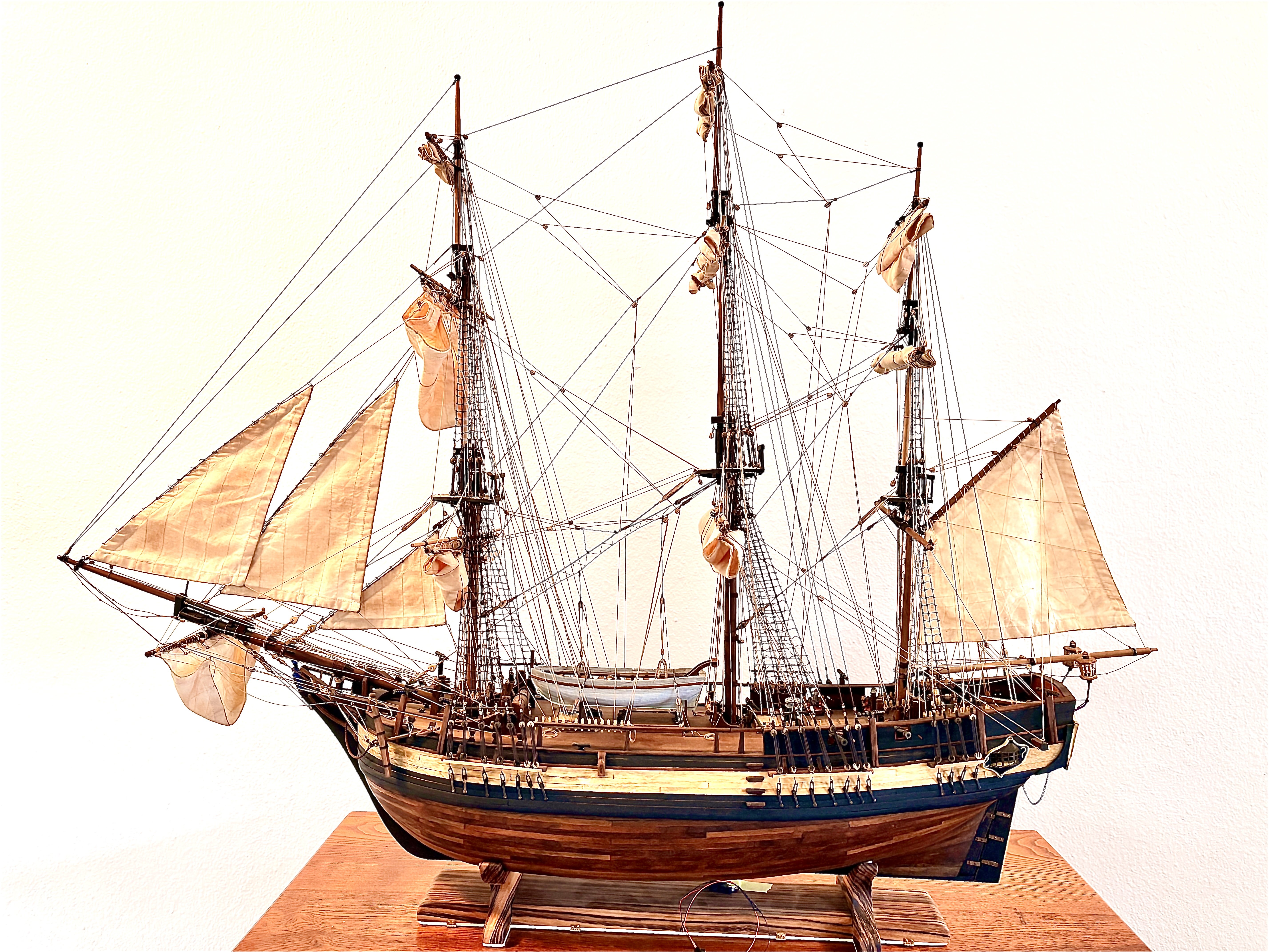

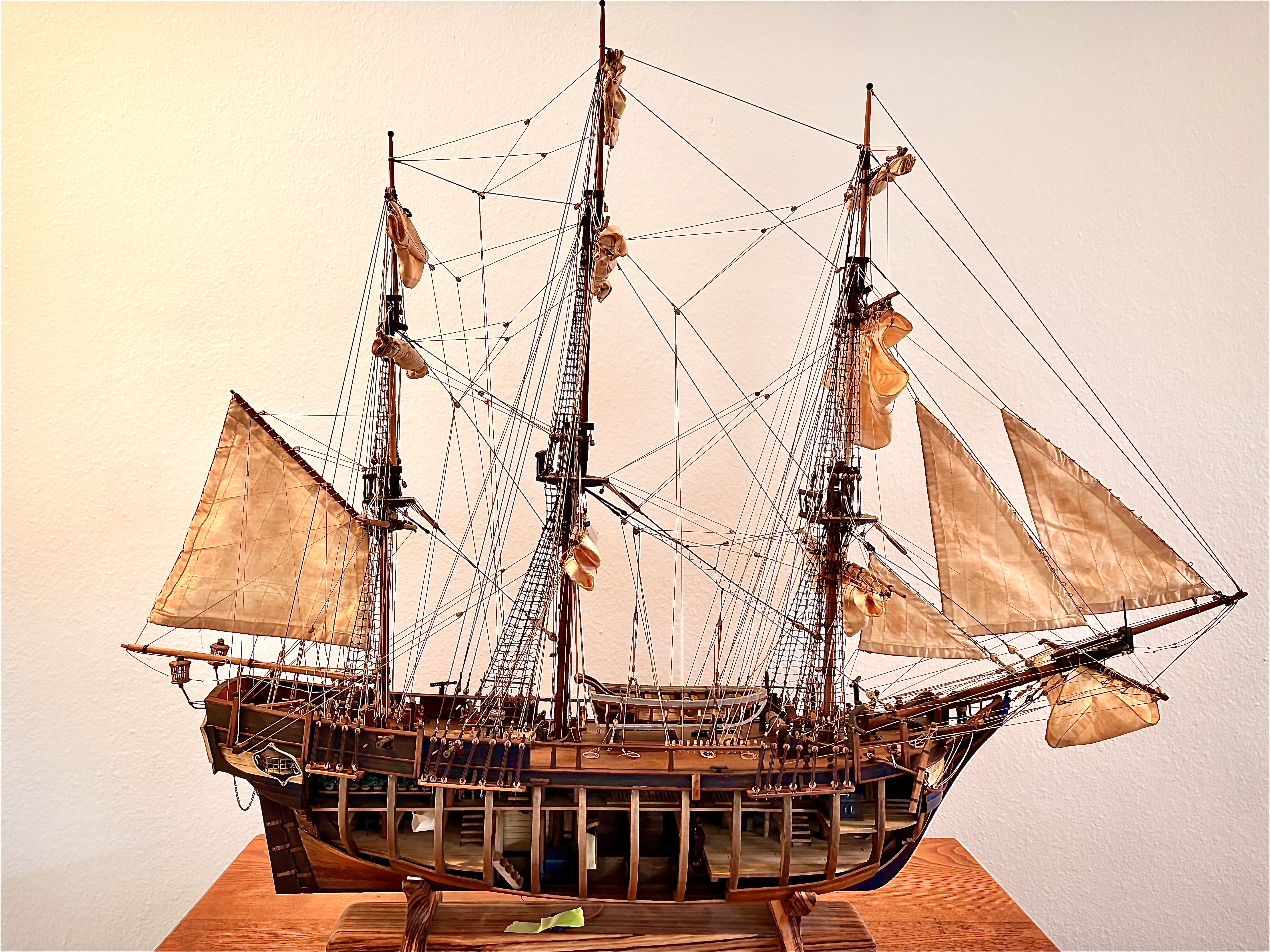

My first build up date in a long time but I am finally back at it.
Finished up the sails on the Mizzen mast and hung one between the foremast and the Main mast...
Gonna take some time for my fingers to get back in the groove! And for my hands to quit bumping into things!
It has felt good to get back to work and I look forward to making more progress over the winter. Still planning to finish this winter but a lot left today. Especially, the finishing and detailing work.
Couple pics below:

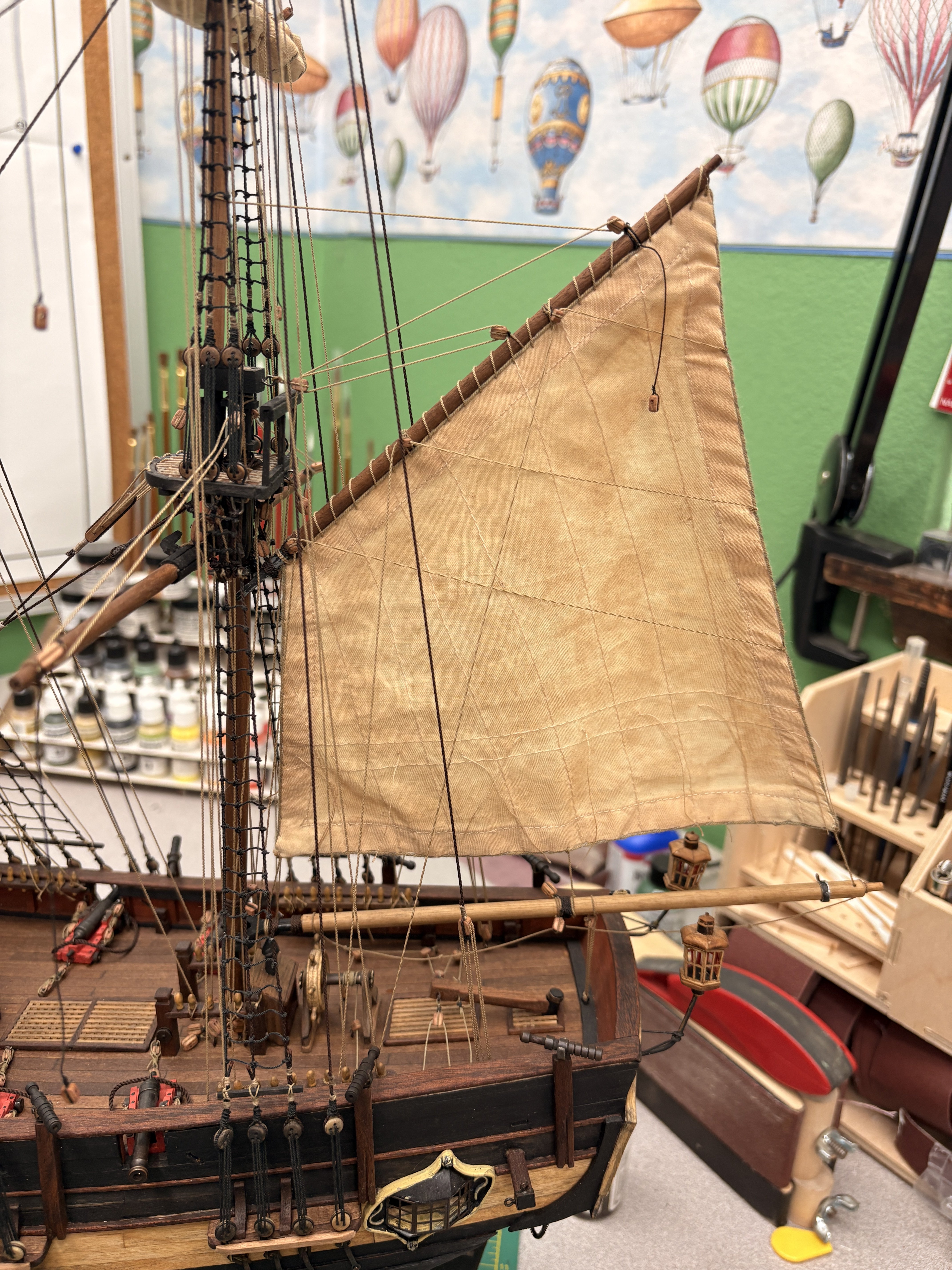

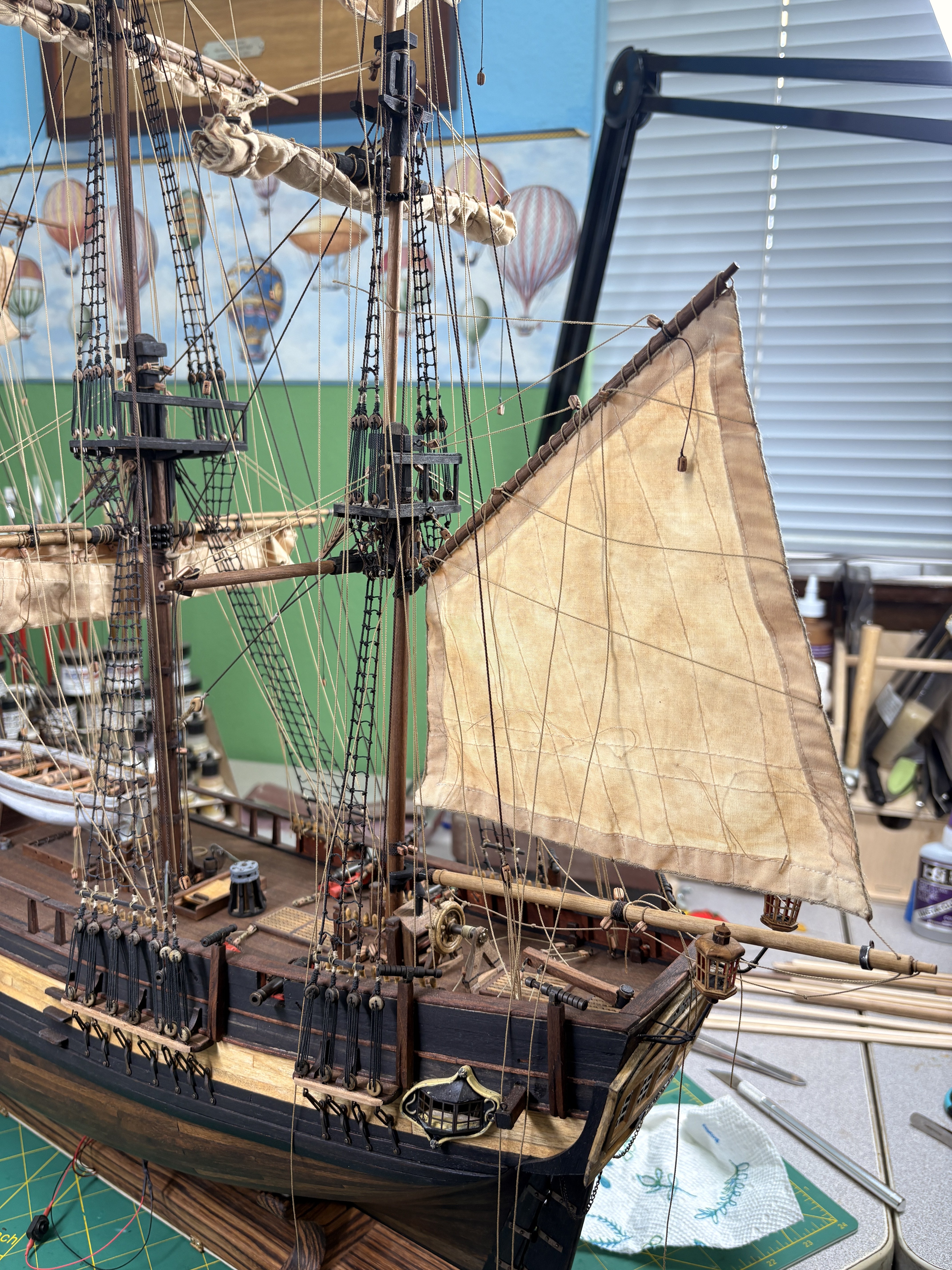

Thanks for the support!
I do appreciate it... it is a process getting back into this work. My fingers and arms have forgotten how to be steady and my ham handedness is making life a bit more challenging as I move on! So, a little slower and some changes to reflect the changes in my attitude!
After much thought and actually hanging a few of the sails between the fore, main and mizzen masts, I decided I don't like the look for my finished product and have removed them altogether... I think the look of the rigging and deck and having the ability to see it without those sails is an improvement... for me! It may not be for you!
Having said that, I finished the Mizzen mast and sail with the exception of a few lines that will come up in the next few shop visits.
A couple new pictures:
IMG_4582.thumb.JPG.87597e212300d9f2f905460a09ced1fc.JPGIMG_4583.thumb.JPG.28da9946a506a227e4ee408663c860a2.JPG
IMG_4584.thumb.JPG.1f210b6db577aca1698bee070c291e90.JPGIMG_4590.thumb.JPG.0c9318ac8ef7224b47335288266692e5.JPG
Next update in a few days!

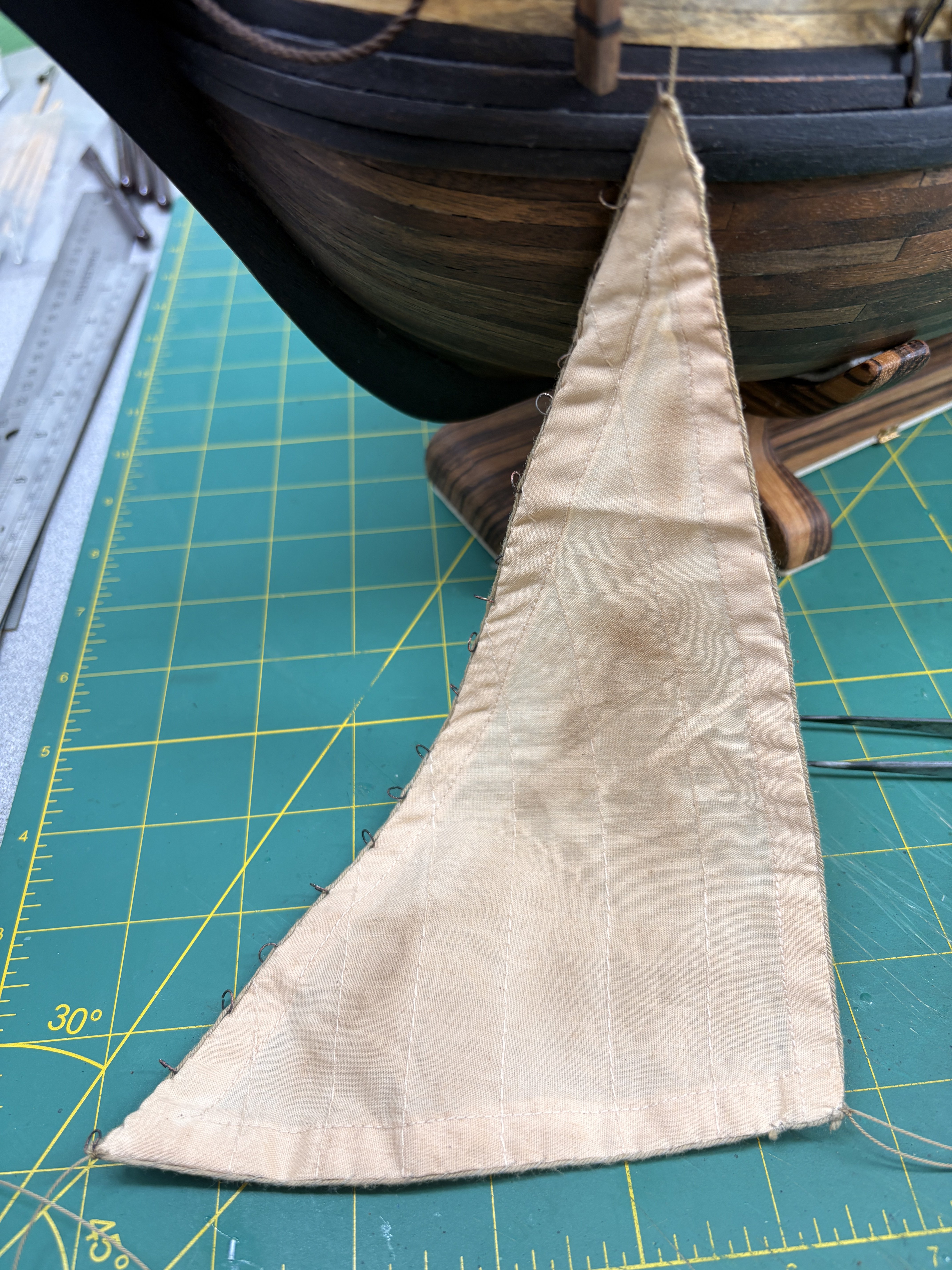

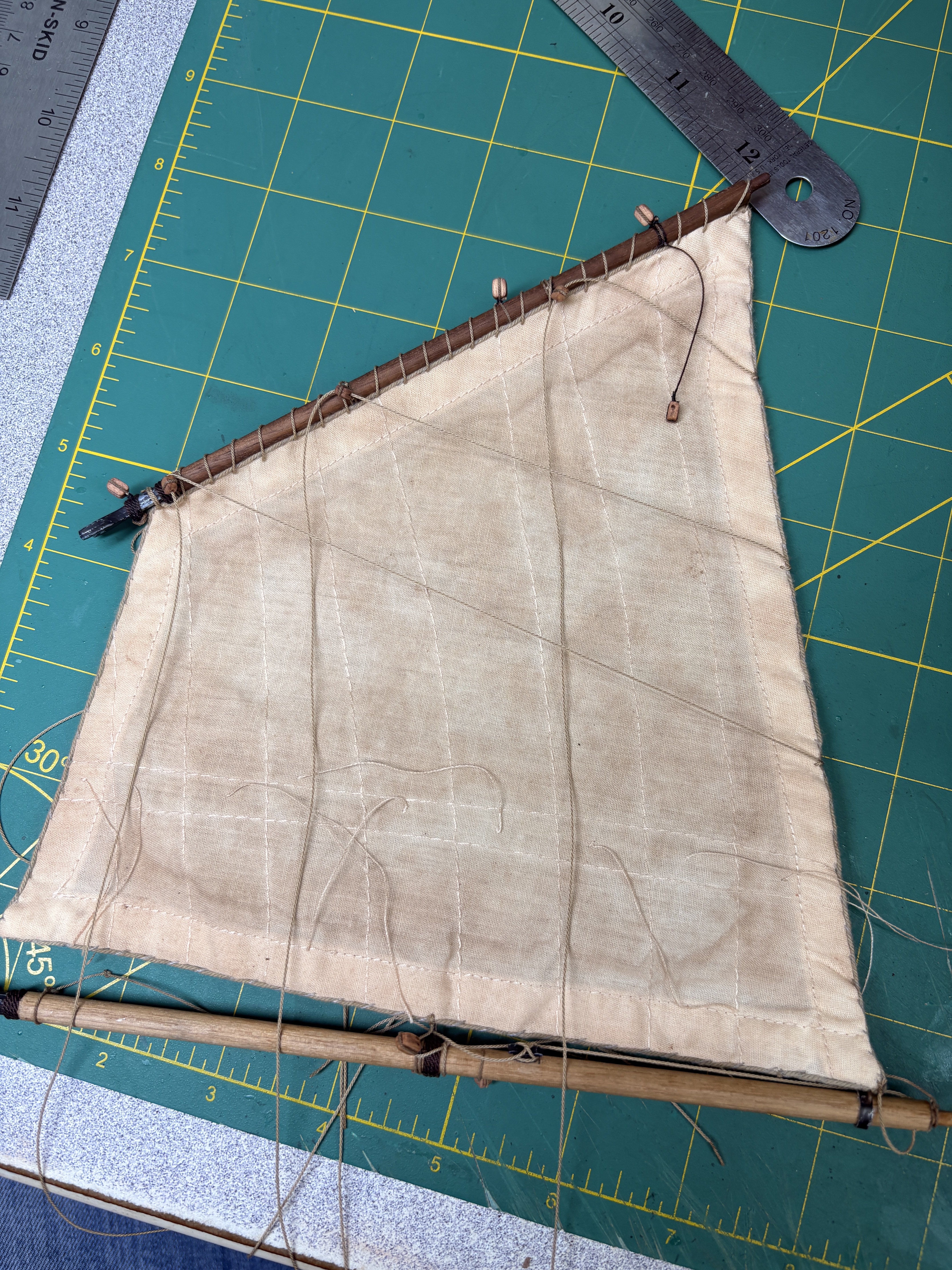

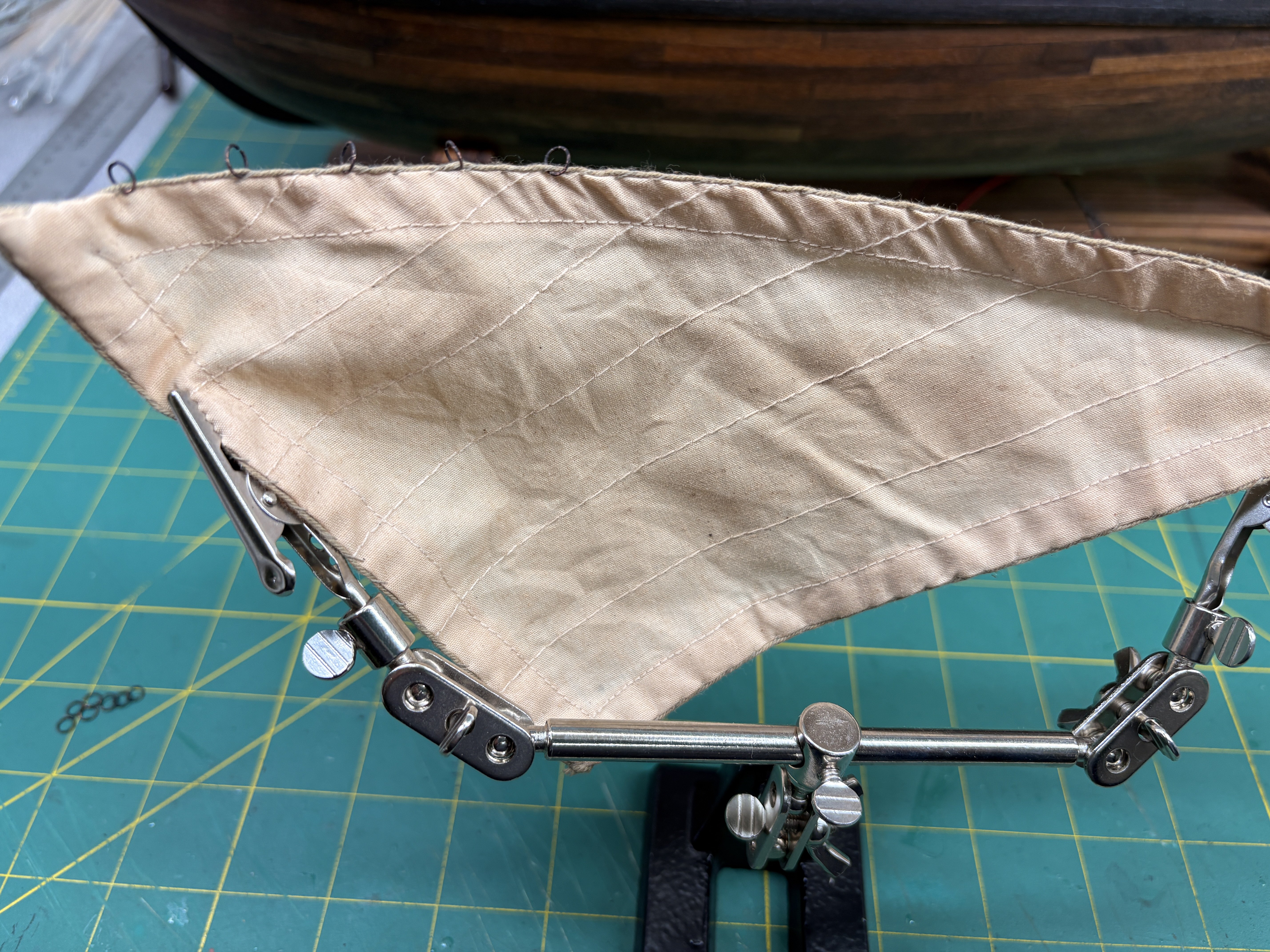

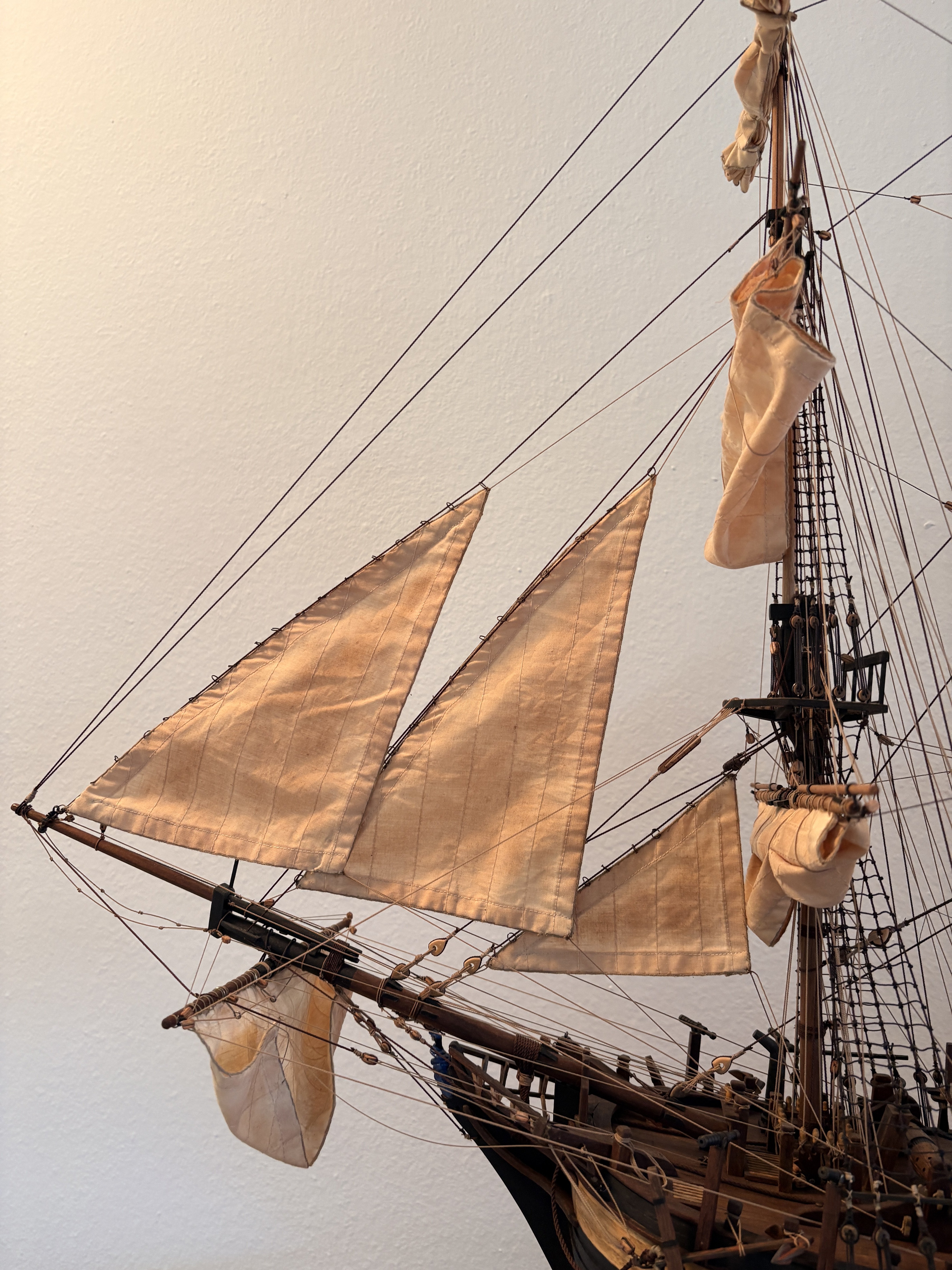

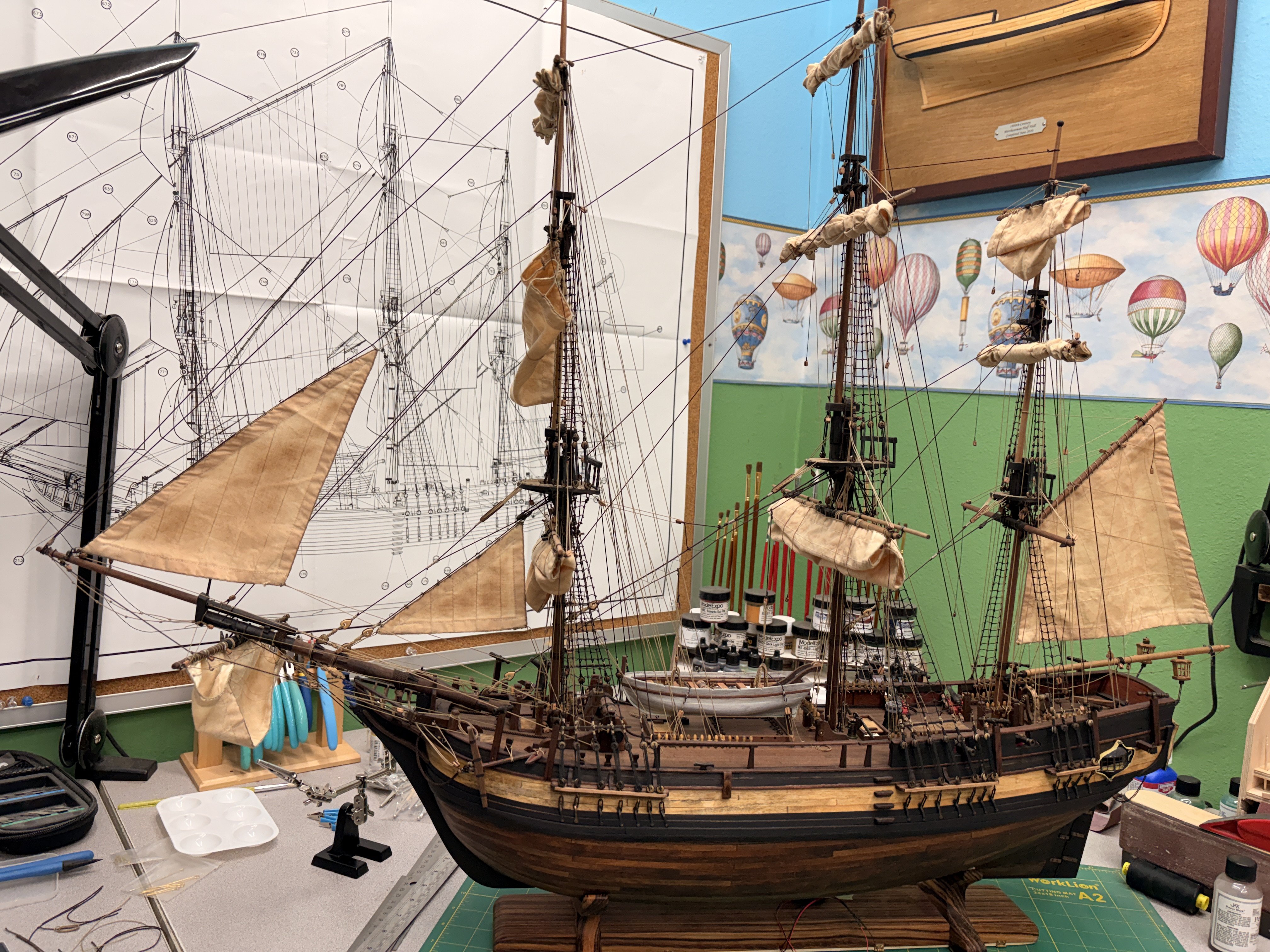

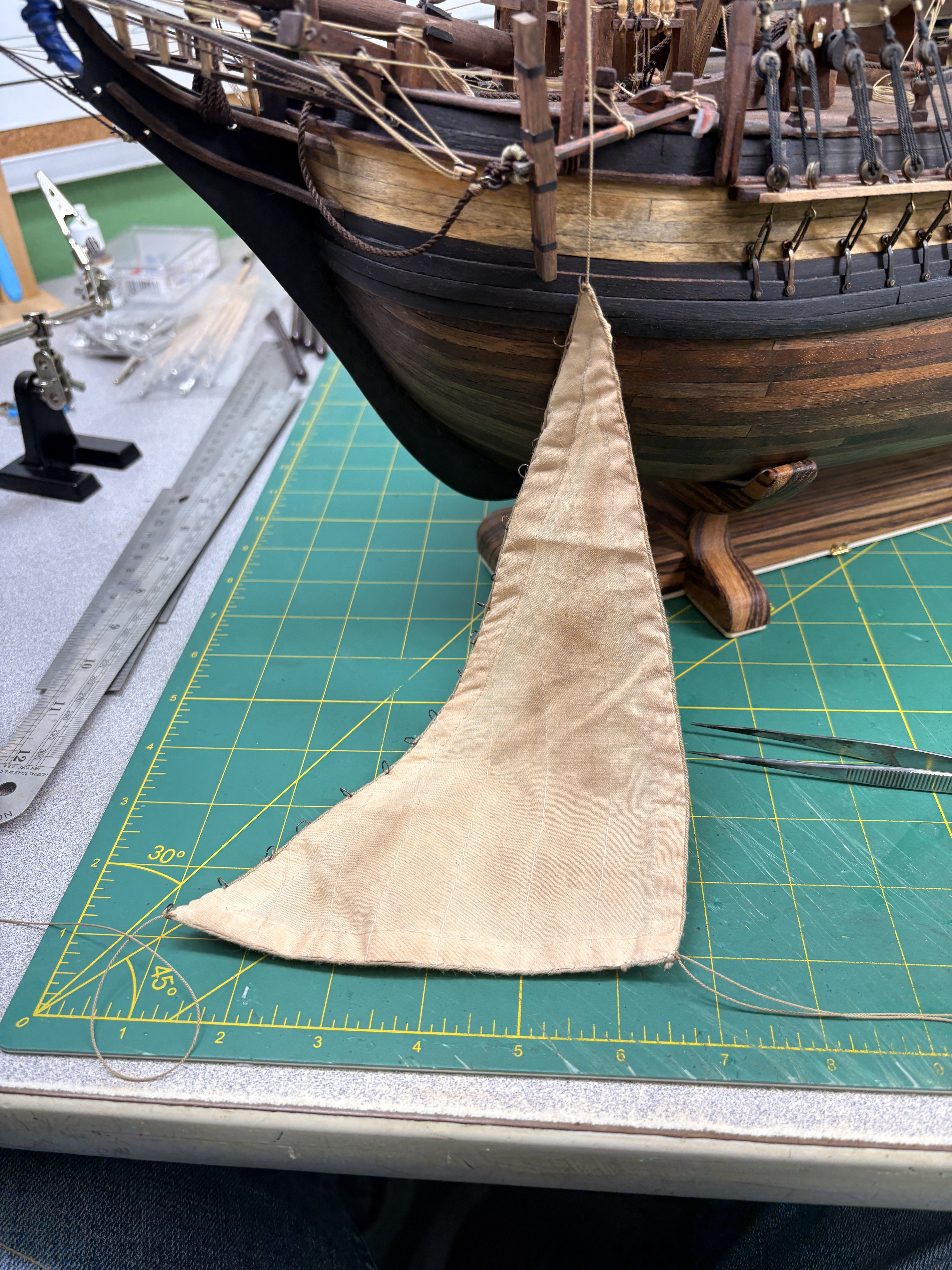

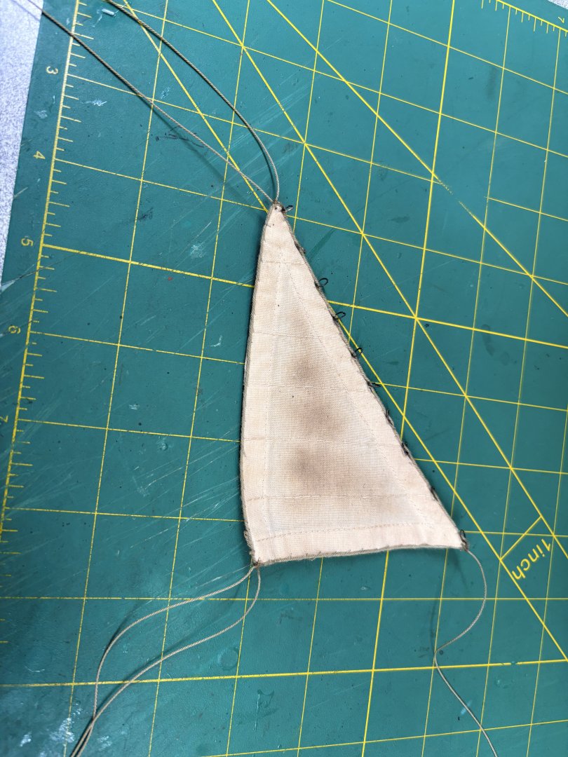

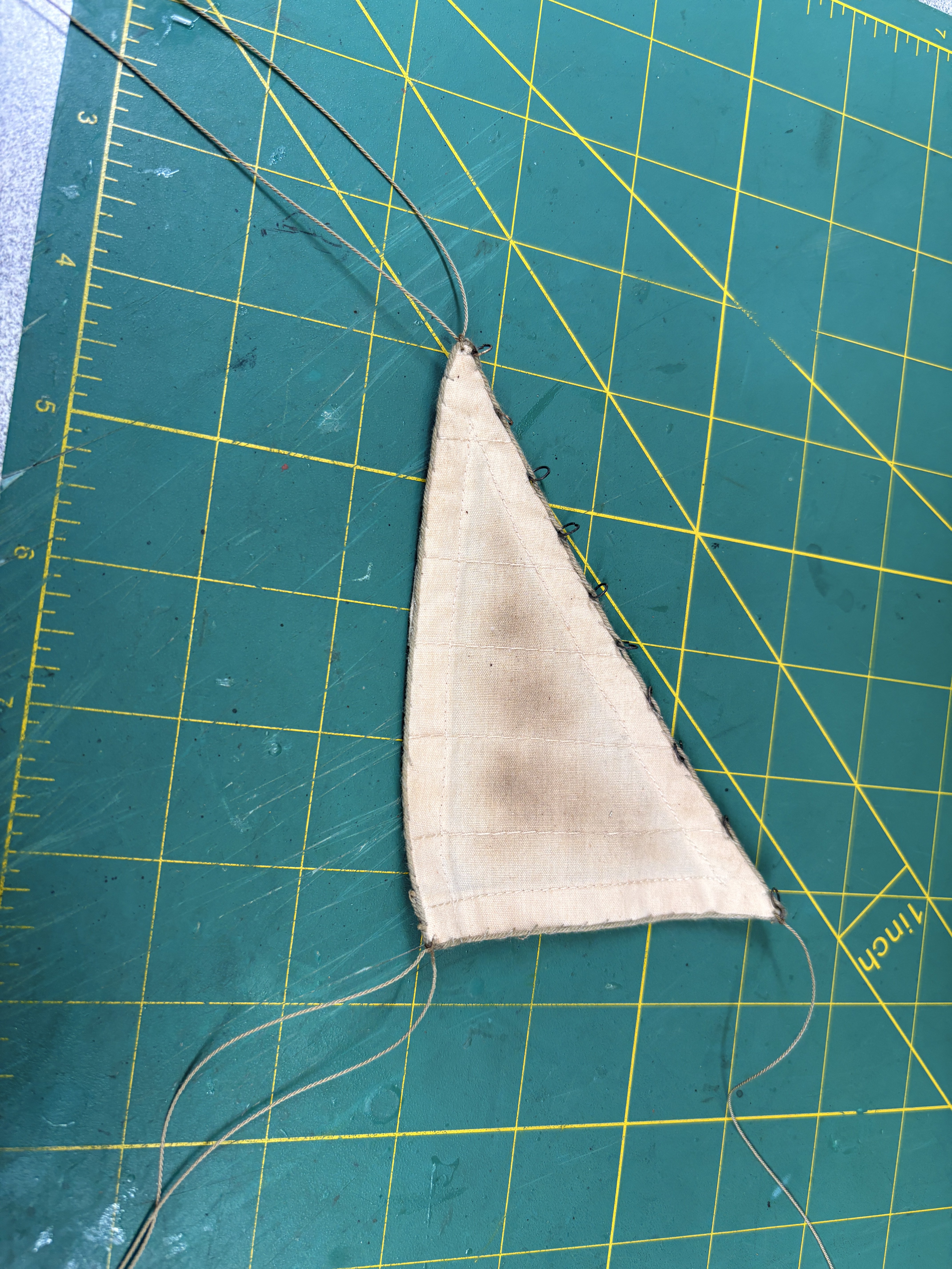

Jib sails in progress...
These are the last sails I'll be mounting on this model... one more to go!
Installing the rings after "aging" them.
Rigging lines installed and ready to mount.

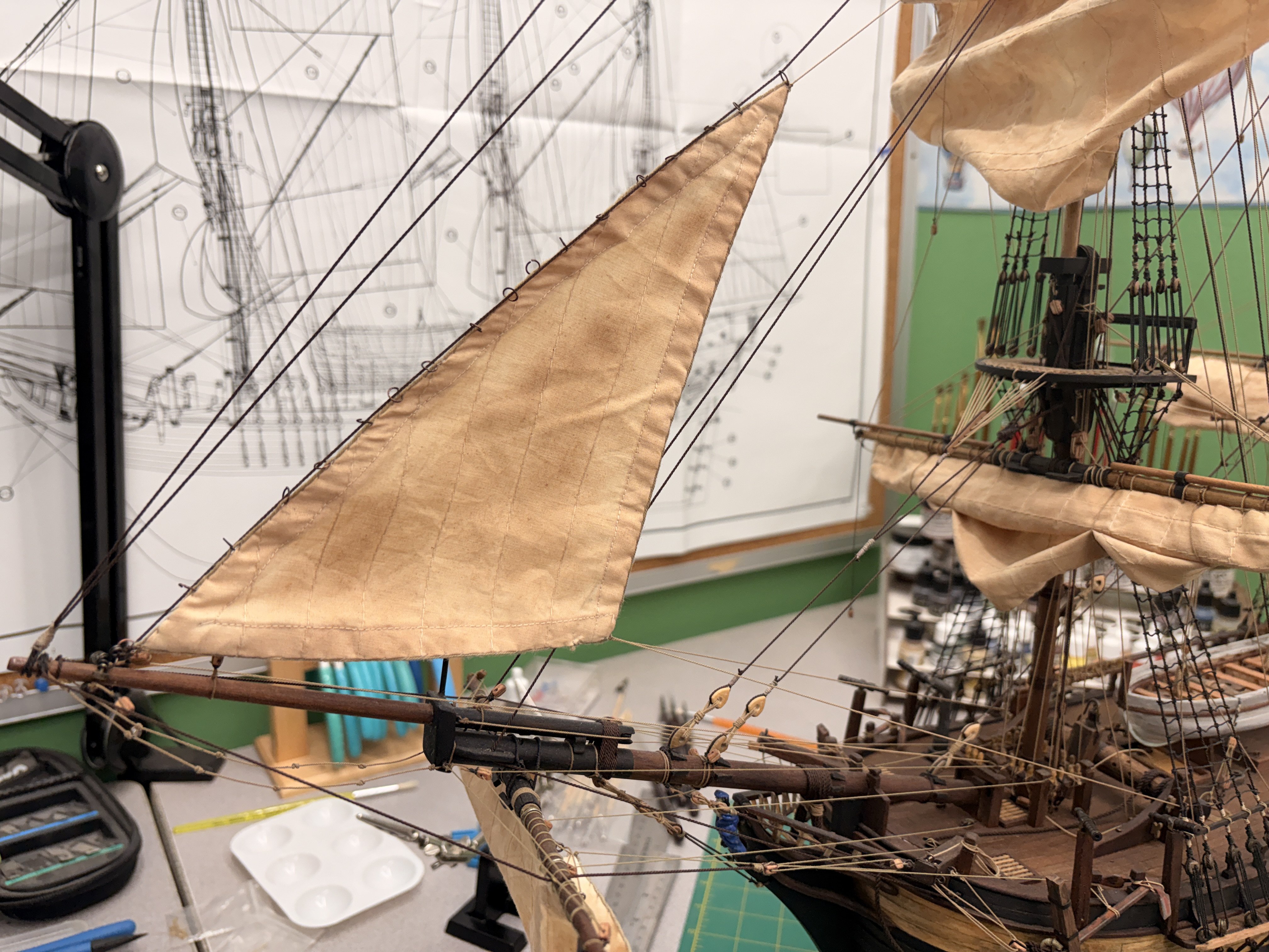

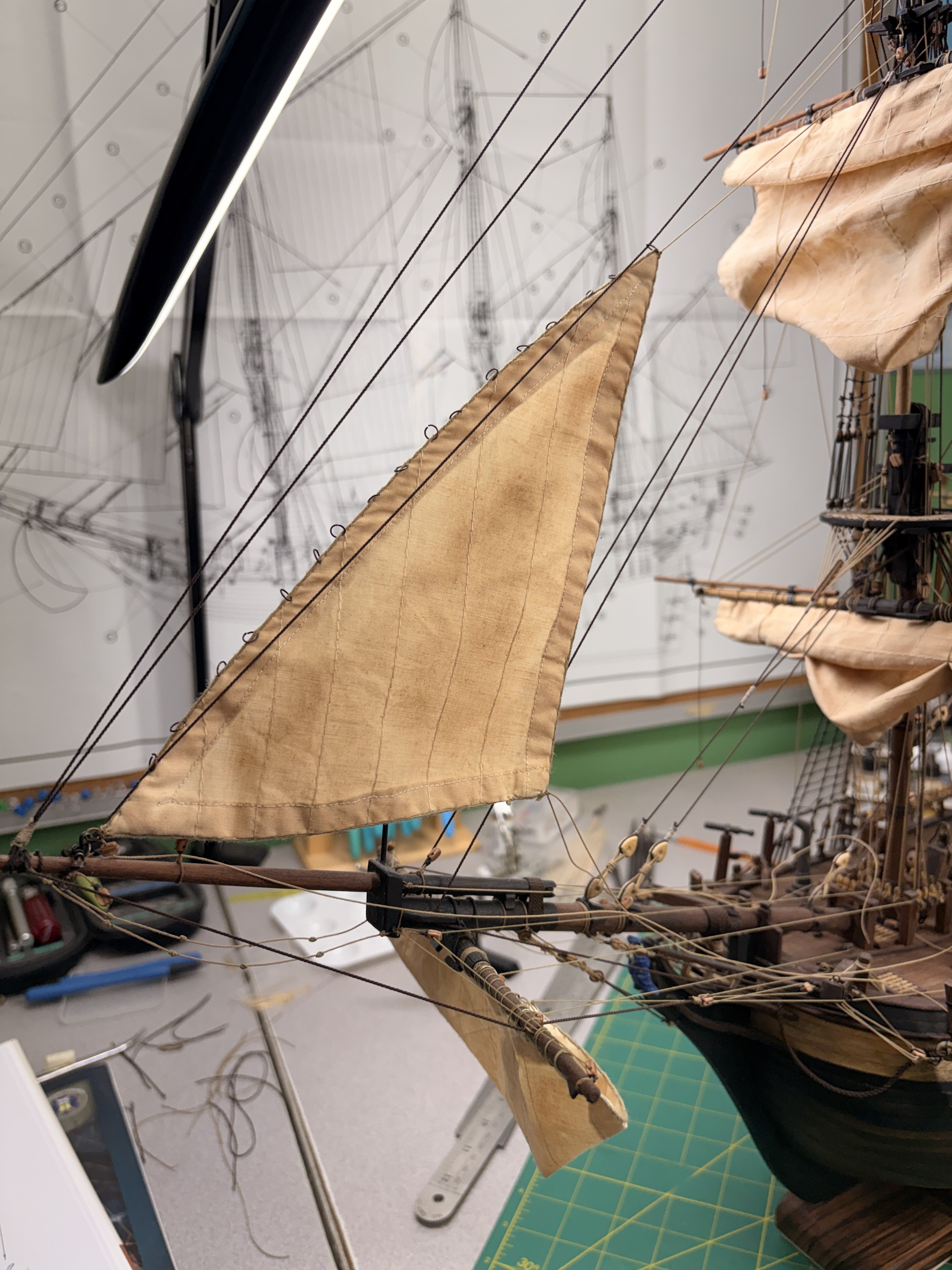

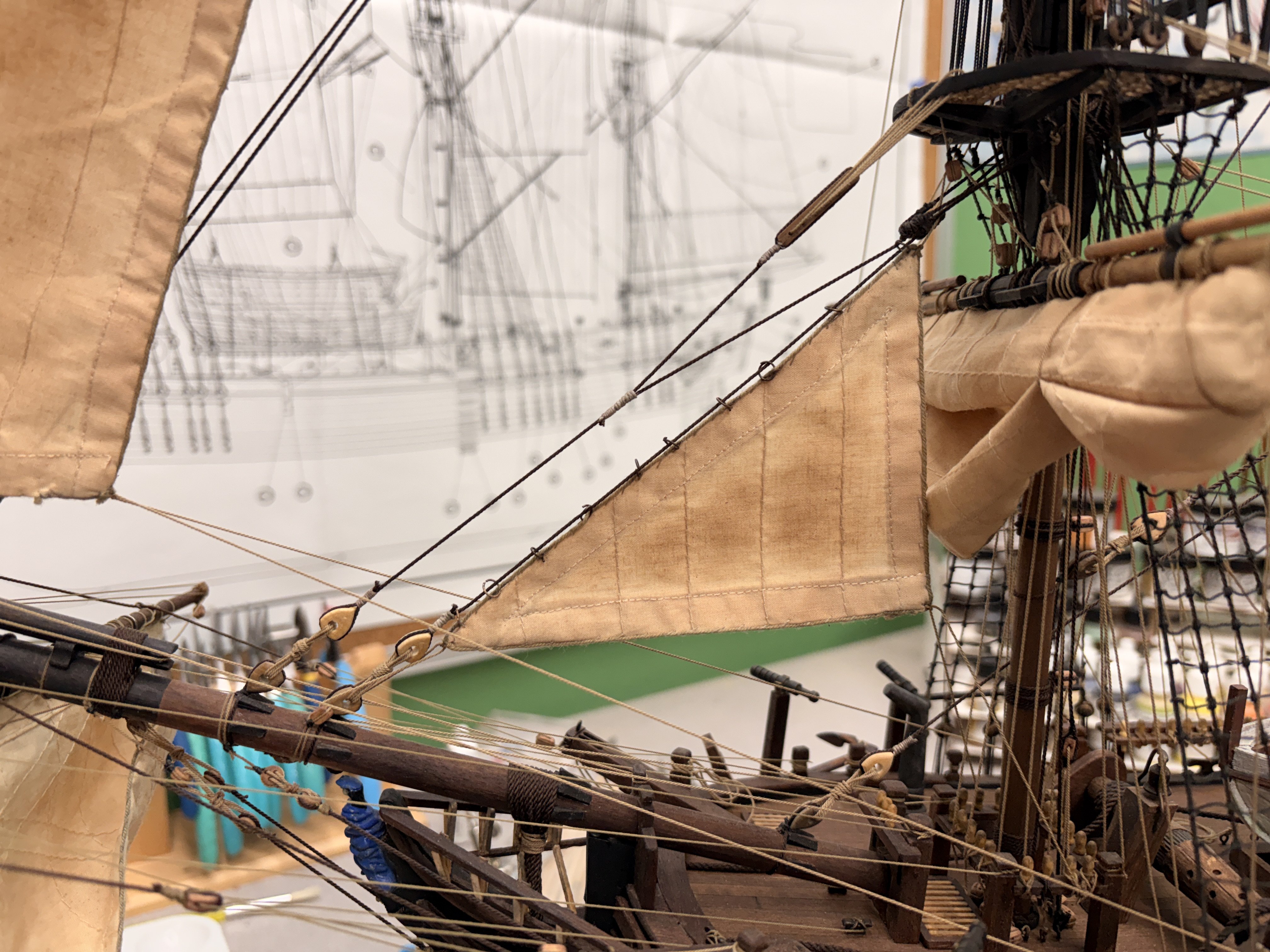

IMG_4610.thumb.JPG.9bf4b0a9f7ca2a599cef12a198fab65f.JPGIMG_4611.thumb.JPG.b41b87a3544696036ea099d9aacacaeb.JPGIMG_4612.thumb.JPG.49eee9bc4524754e100ea8943d0dd637.JPG
Mounted and rigged
IMG_4613.thumb.JPG.c4ca19fdc9af6adb9919b9abc4ebfc58.JPGIMG_4614.thumb.JPG.17e6492716b9934e9540a5451707abeb.JPG
Second one finished!
One sail left and final rigging... lots of final rigging!!

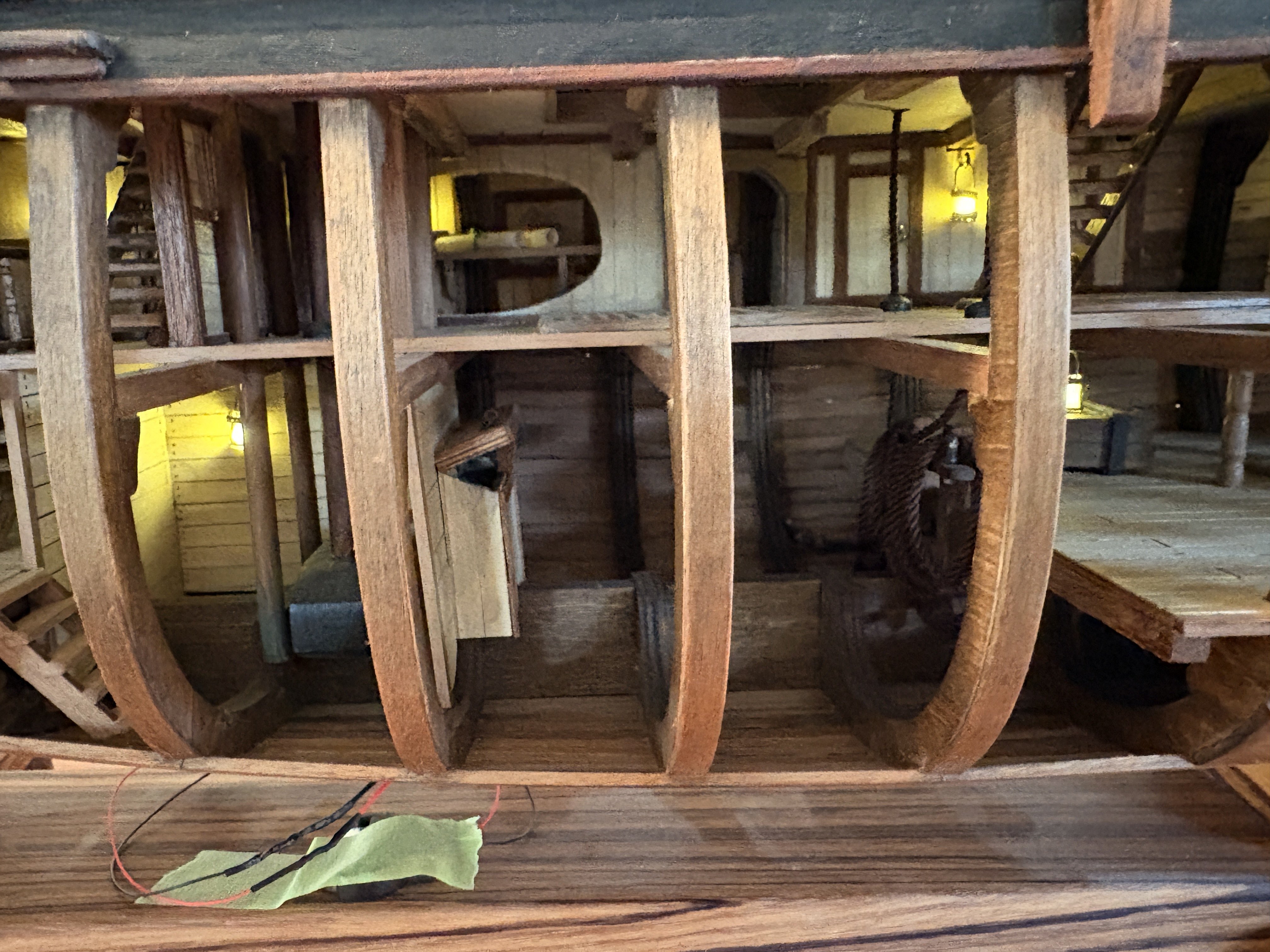

After 4 years and 1300 hours of work (albeit with a hiatus in between), I completed the build portion of the HMS Bounty!
I still have touch-up work, detailing (a lot!) and staging to complete along with building a case but the actual build was completed today!
I will continue to update as I work through the next several weeks to finish her up.
Pictures:
