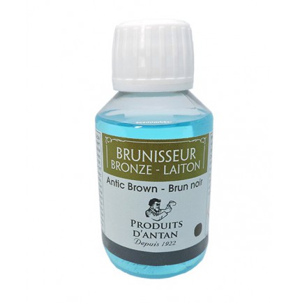

Much preparations can be found on line
For fast darken effect on brass (selenium) :
Brunisseur de laiton
For more slow grey-green effect on brass (unknown composition I hav'nt tested) :
Patine vert de gris pour vieillissement du laiton
Before, the piece must be well cleaned with acetone
After, a stop vernish can be required, I use simple water, and finish with a light polish by smooth clothe
