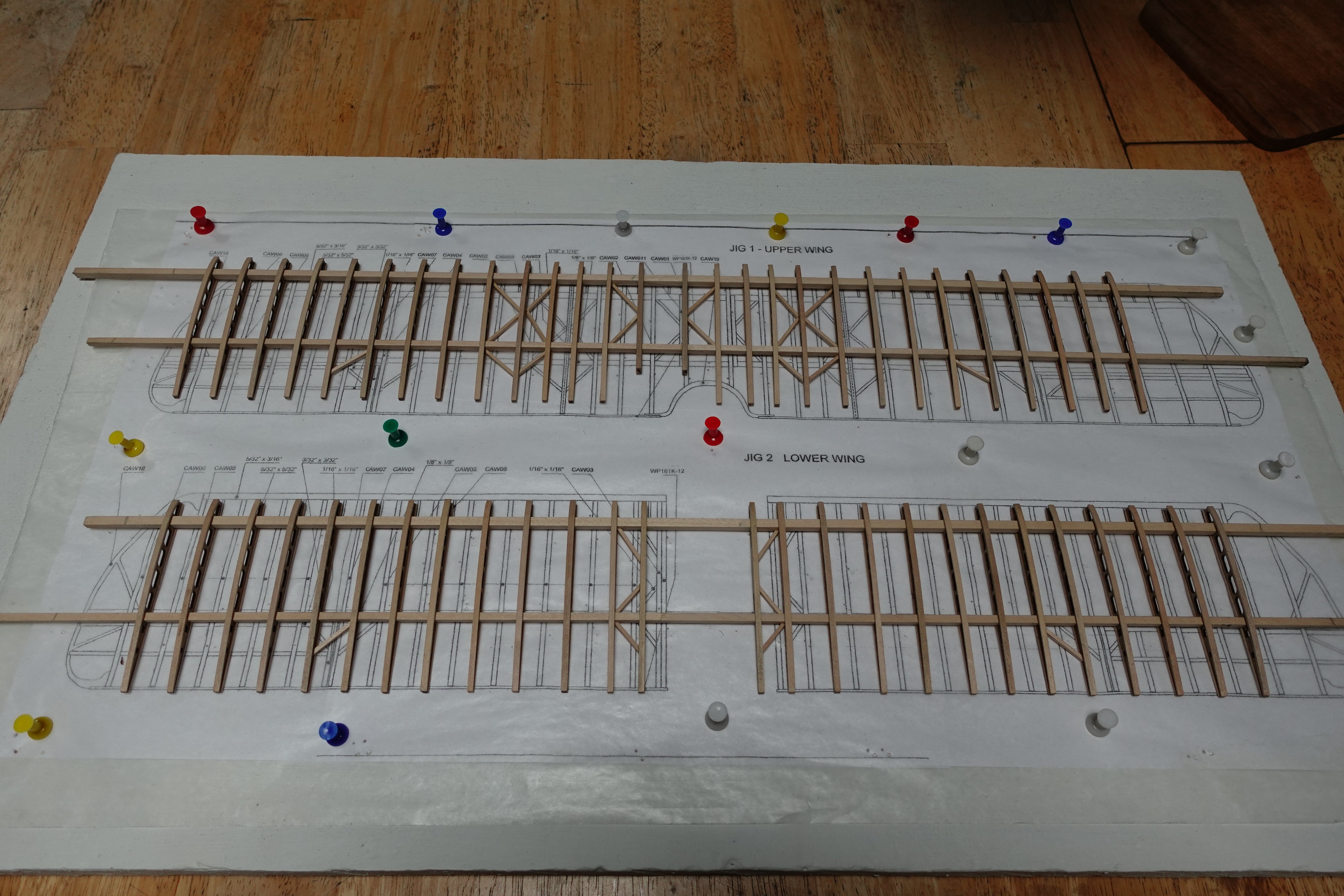

Have converted a ceiling tile to a workspace where I can pin down everything for assembling the wings and was all excited to start that today. However - the spars provided in the kit are not long enough for the entire length of the wings. This is rather annoying/disappointing and the Instruction manual makes no mention that I can see about how to proceed. In fact the manual talks about having to saw the lower wing in half and then reassemble it to get the correct angle on the lower wing. But as it is that is not a problem because it seems you have to build separate wings anyway. But I am concerned that the top wing will not be very strong if it is actually two wings glued together just at the tips of the spars... Might have  to see if I can buy some longer pieces of wood for the spars.
But here are all my ribs:

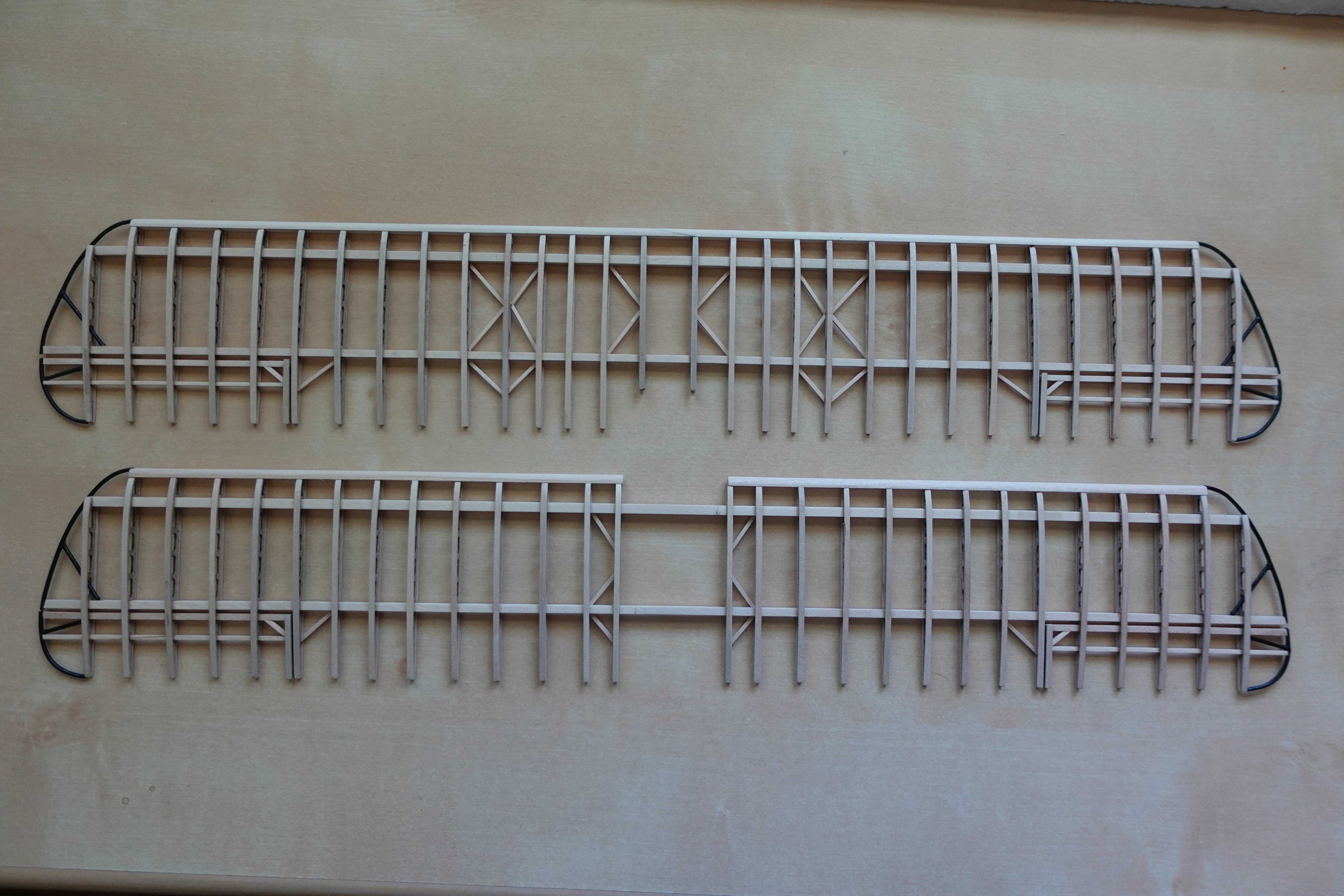

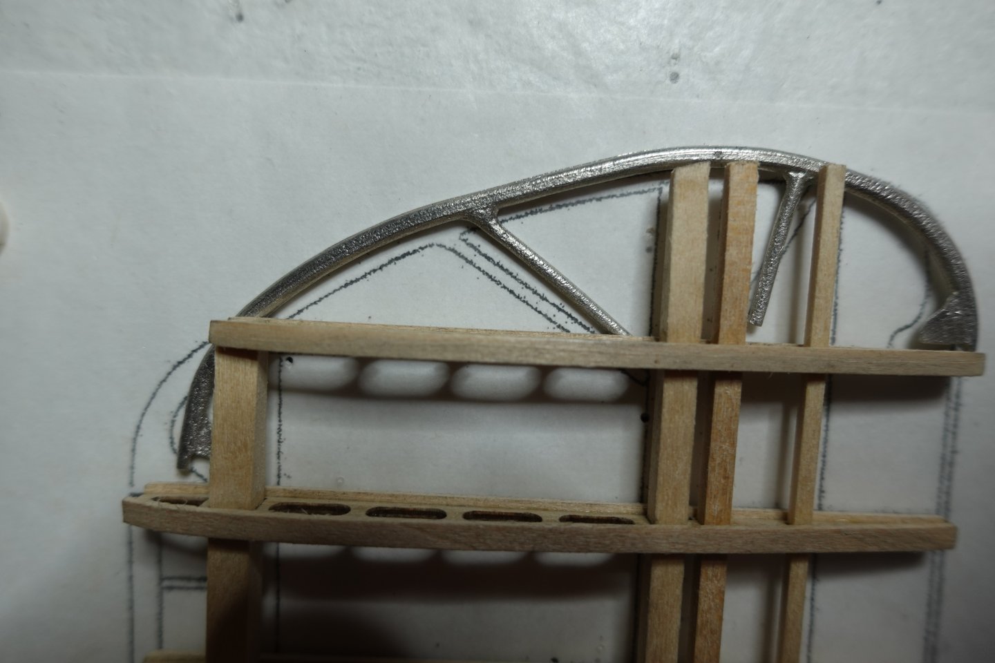

Cant believe I havent posted for 2 years. Well, I havnt been completely idle but must admit I (surprisingly) got a bit frustrated with the kit because of how bad the supplied wingtips are. I spent way too much time trying to make them fit before I finally made my own.
Here I'm adding all the ribs to the main spars.

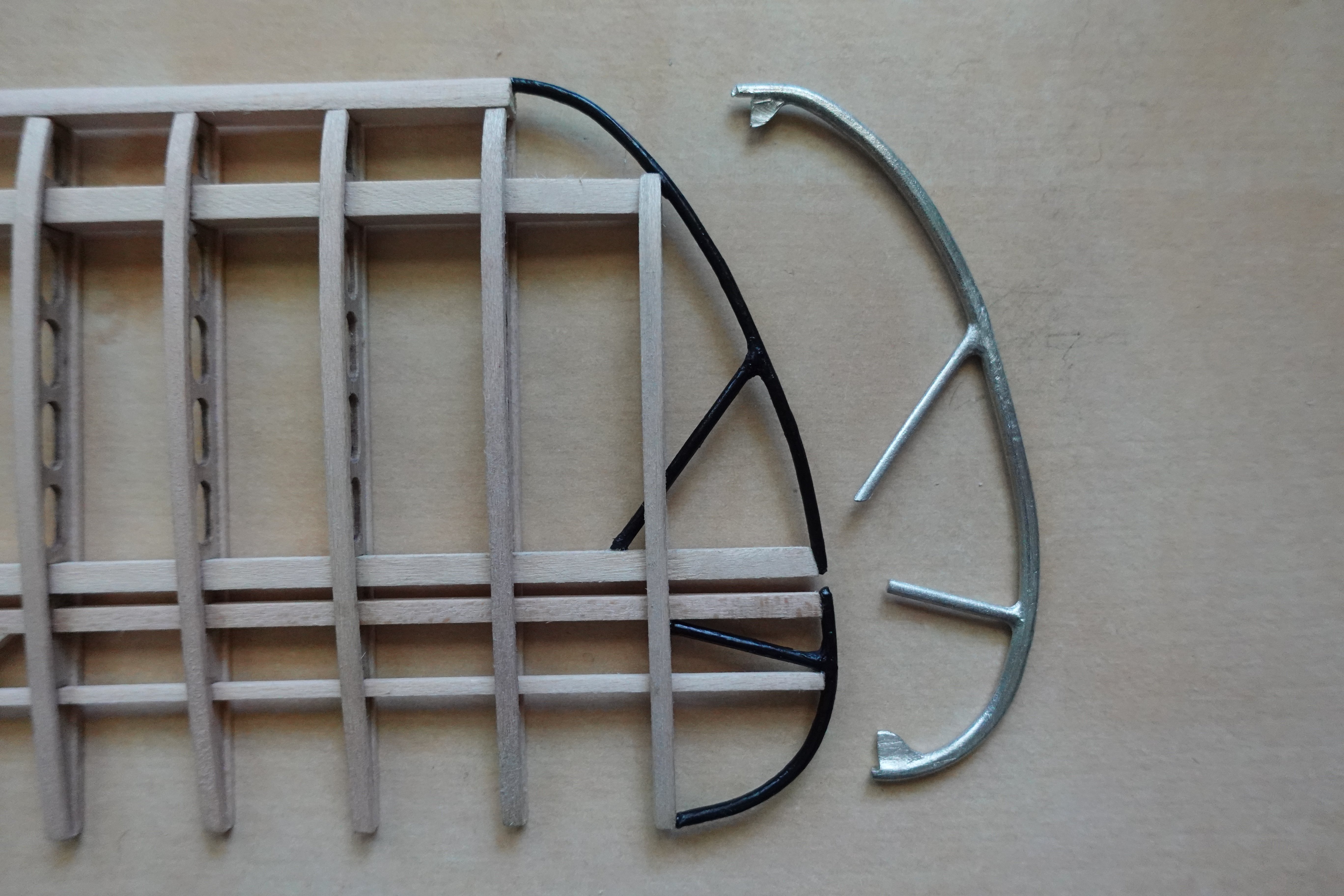

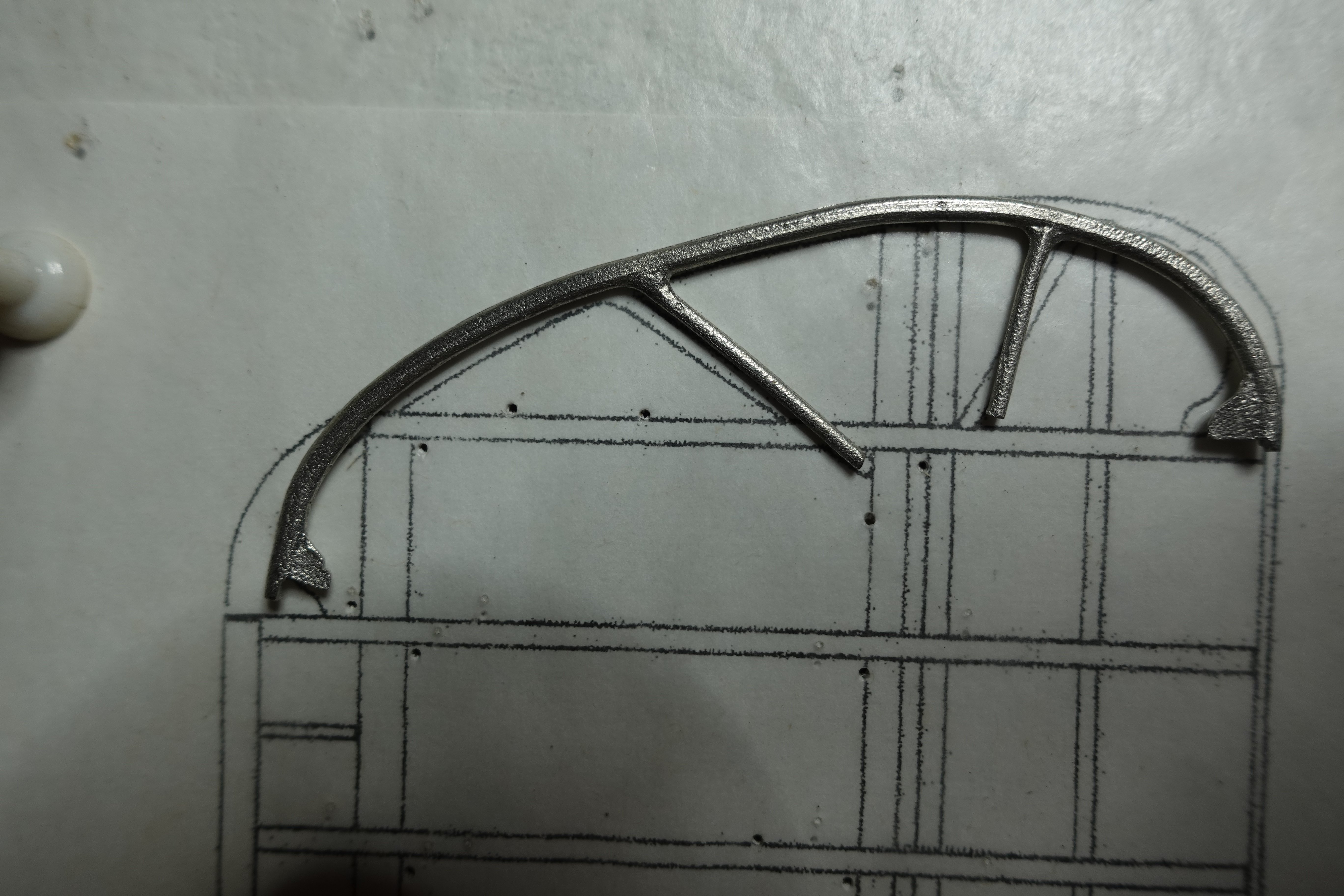

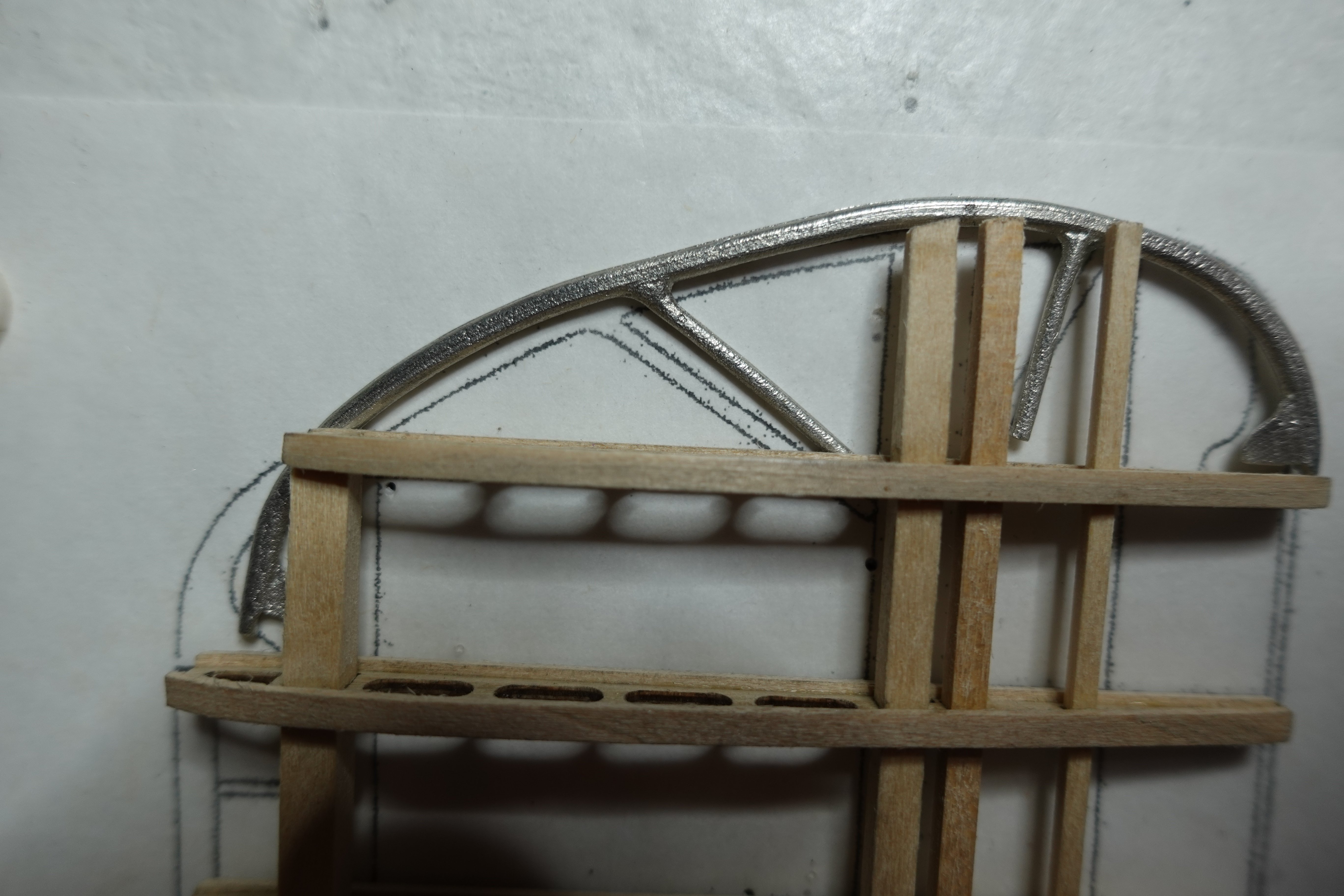

This to show how the supplied wingtips are just too small. Its not a lot really but enough that it just wont fit. Tried bending them in different ways but was afraid the pewter would eventually snap. So finally I decided to make my own. They are by now means perfect but good enough I think.
The main structure of the wings is finally complete and I have been working on painting the braces.

Looks like you've done some excellent work on the engine, prop, and wings.  I have this kit on my "shelf of doom".  I built the engine and prop then completely switched gears and built the Artesania Latina Sopwith Camel instead.  That is disappointing about the wing tips....I dug my kit out and compared the ones I have to the plan and they are very similar to what yours looked like.
