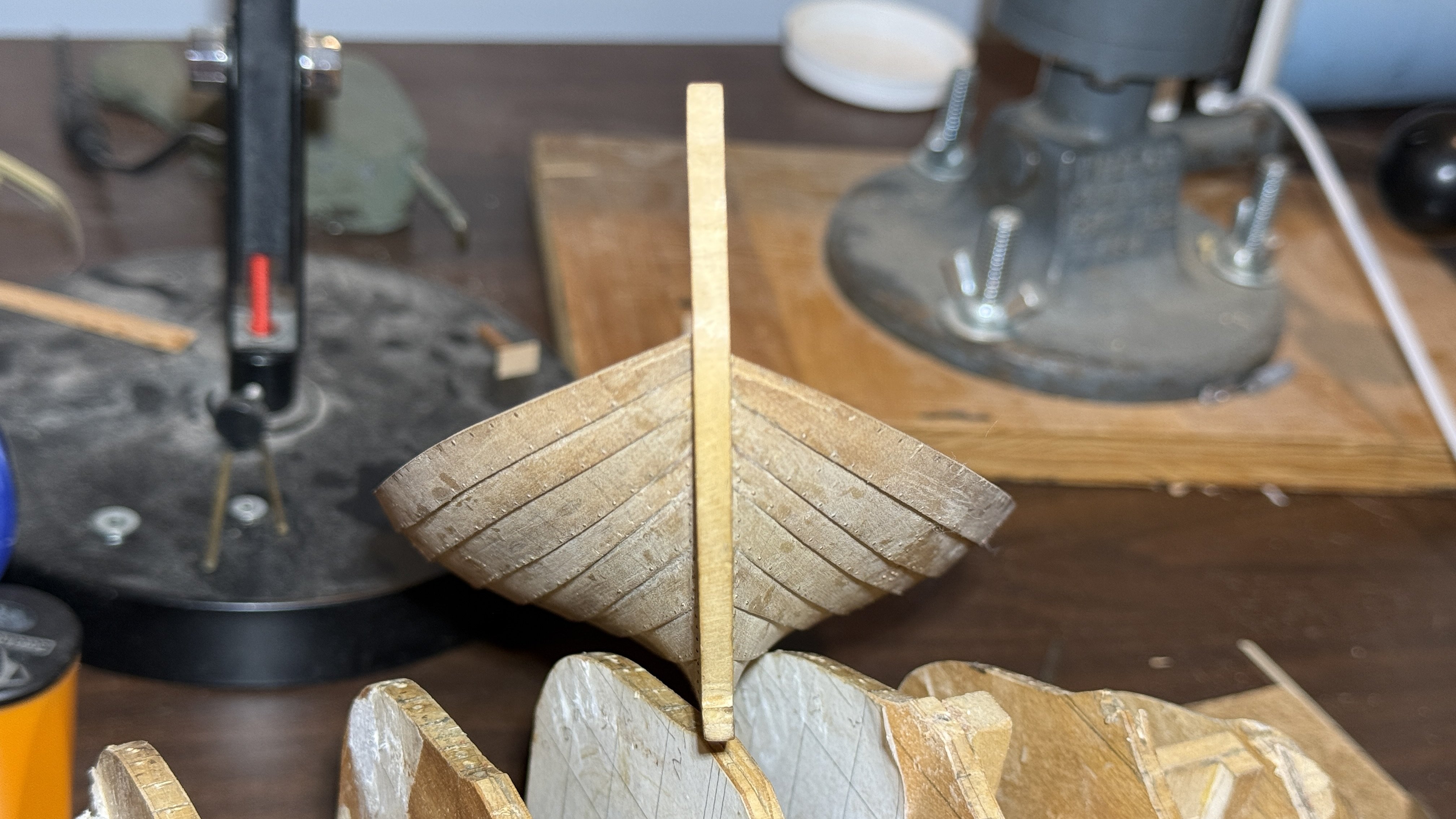

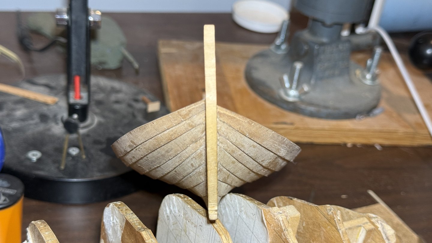

When the model was set aside, 5 of the 6 planks forming the 4th strake were in place.  Since finishing the workshop about 3 months ago, I've only managed finish the 4th strake and add the 5th.  As there are 10 strakes, this is a small milestone - half way through the planking.
IMG_8881.thumb.JPG.9a97425b0d3bccd4352b2aaaef44e115.JPGIMG_8882.thumb.JPG.3751506ce08d7f5adeaf09ce76021b44.JPG

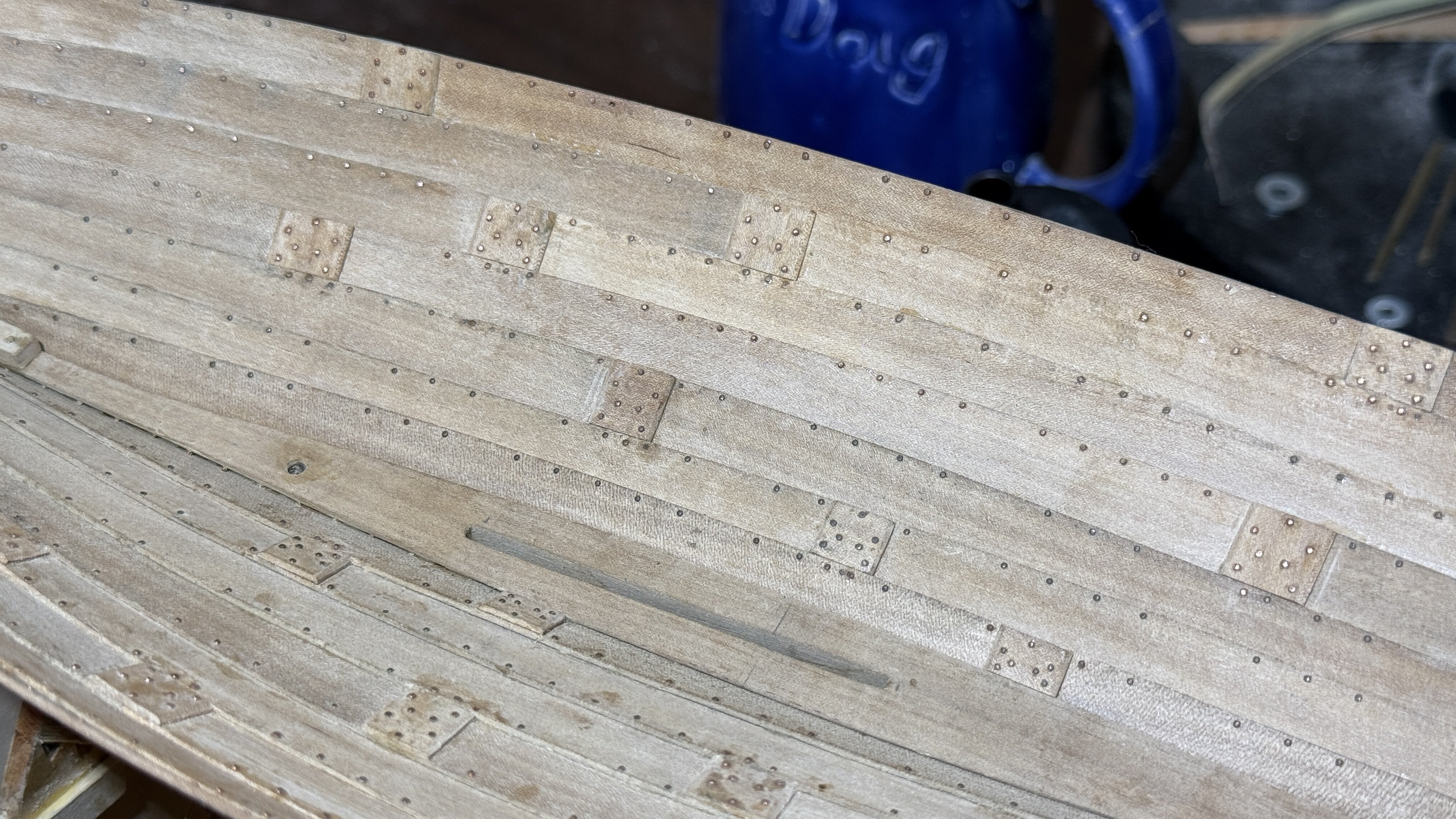

Most of these rivet heads shown here wiIl be covered by the deck, which is at the top of the 5th strake amidships and about the top of the 3rd at the stern post and forward end of the cabin.  I included them as practice and also for the sake of construction photos such as these.
I stopped adding the butt blocks.  Some where never added because they interfered with the building jig.  For the others, clamping the next plank in place sometime drove the faux rivet heads into the block.  I'll add the rest when all the planking is complete.
IMG_8885.thumb.JPG.f514541ec3b7534d6d3d3a260f26462c.JPGIMG_8884.thumb.JPG.a2c1576a06efabae4c7484466d36d2db.JPG
IMG_8889.thumb.JPG.8abbecf4a402ee4ca4e3d62acdf5ac2f.JPGIMG_8890.thumb.JPG.3c01c3f7788f2ffd9f4567cbfc73e065.JPG
I know people for whom the hull is only a chore and the rigging is their true love.  I am the opposite.  I truly love a nicely formed hull, so I've spent a great deal of time to do the best job I can.  I've fallen short of my own expectations (which did NOT include perfection), but I am not entirely displeased with the results so far.
I don't mind learning from mistakes, but the bad part is that I repeat them too many times.  My new favorite saying is "I never make the same mistake twice.  I make it 4, 5,6 times, just to be certain." Worse than repeating mistakes is when I cannot figure out how the mistake occurred.  The most painful mistake has been asymmetry of the planks at the ends.  I measured and re-measured so many times I am flummoxed how this is occurring.  I thought the problem might be cutting the gain too wide and later using it to line up the next plank, instead of using the next mark on the stem or stern post.  You don't want the gain on the plaIMG_8891.thumb.JPG.54ef61da72d4809e4e802df5f2e989ae.JPGnk underneath exposed!  But I know I did not cut them wide enough to account for the errors I have encountered.  I was unwilling to replace the planks due to the risk of causing more harm than good, and the time it takes to shape a plank and add all the faux rivets.  Some bad planks were not discovered until one or two more had been added.  I resorted to scoring a curve along a spline clamped to the hull.  The spline is aligned with the point it needs to be at the stem/stern and lies right along the plank edge starting a few scale feet away.  This picture is exagerated - I never had to trim off quite that much.
In a few cases where the offending plank had already been covered by others (no exposed edge), this effort resulted in a hole in the hull where it meets the stem or stern post.  I repaired these with a putty made of wood glue and sawdust. I will use the same to fill in the gap left you can see above where the garboard strake meets the stern post - another dissappointment.  I used dust from the same wood as the planks and it blends in rather well.  It is still noticeable - I would say it detracts from rather than ruins the appeal.  If I were leaving it natural, if not happy, I'd be at least satisfied with the results.  It matters even less given the exterior will be painted and the repair will be covered up on the inside.  So, not executed as hoped or planned, but acceptable.  Those in my model club are chiding me for being too picky, but I feel I could do better and I think it is OK to strive for it.  Onward we go.....

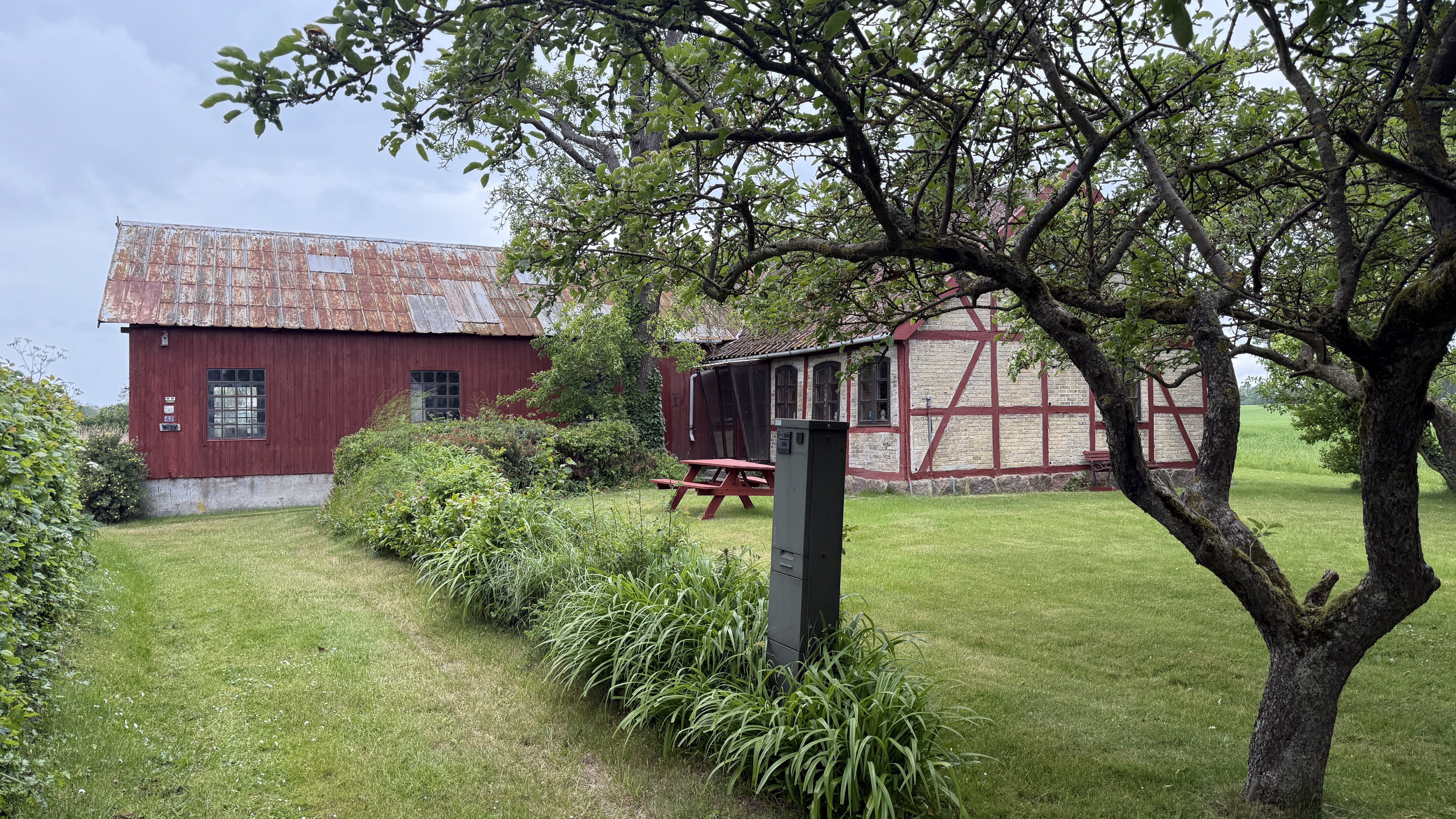

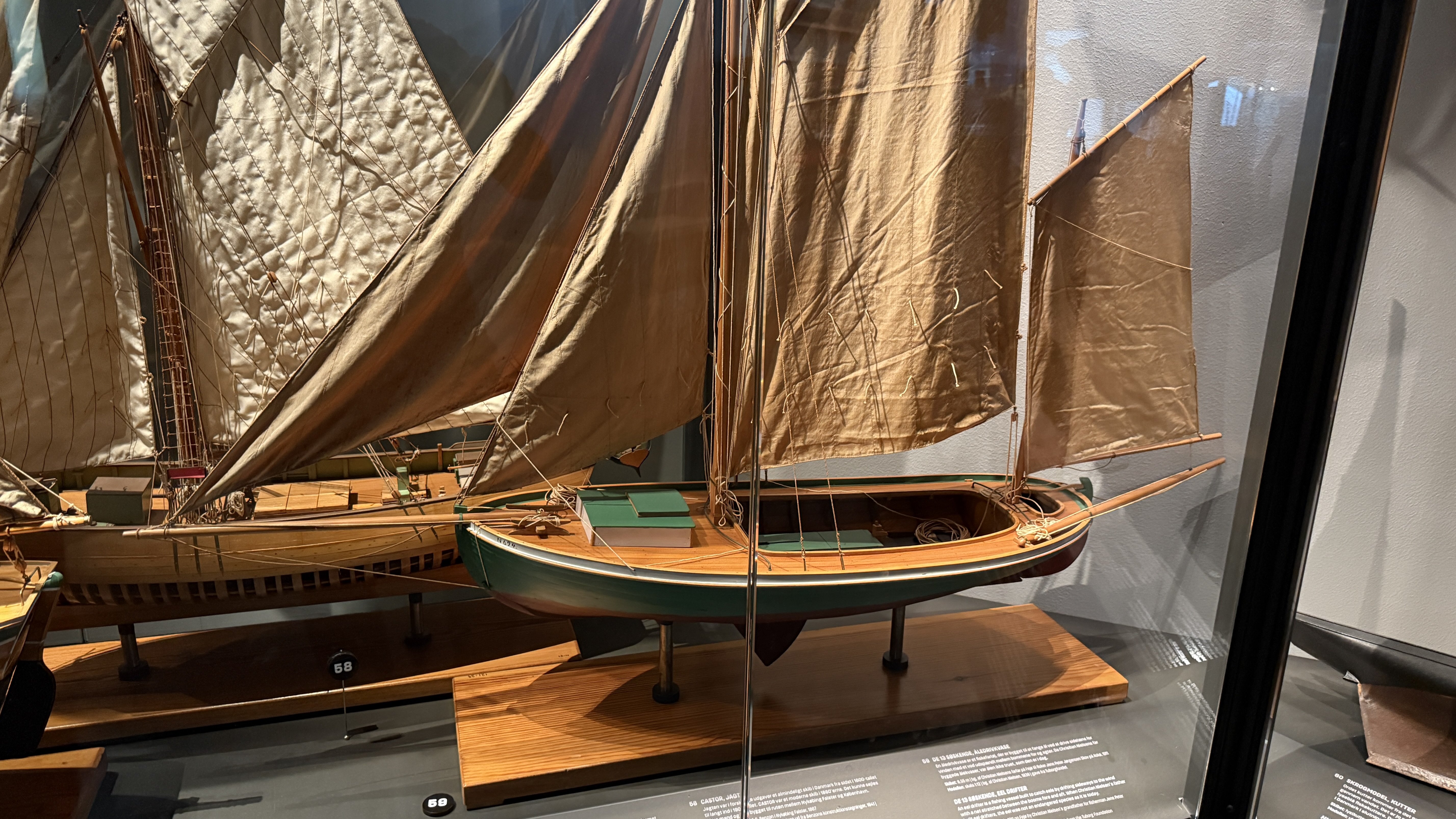

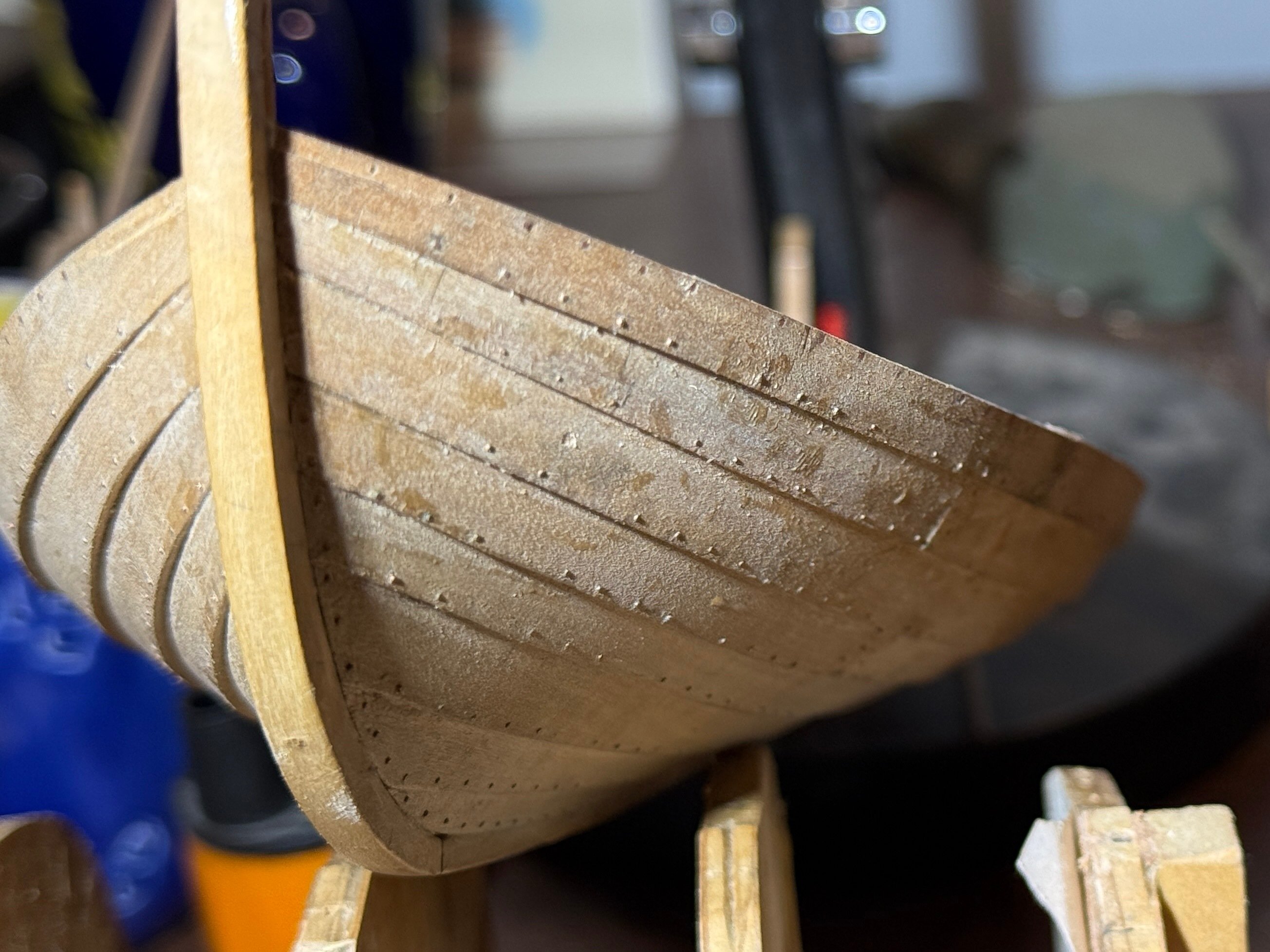

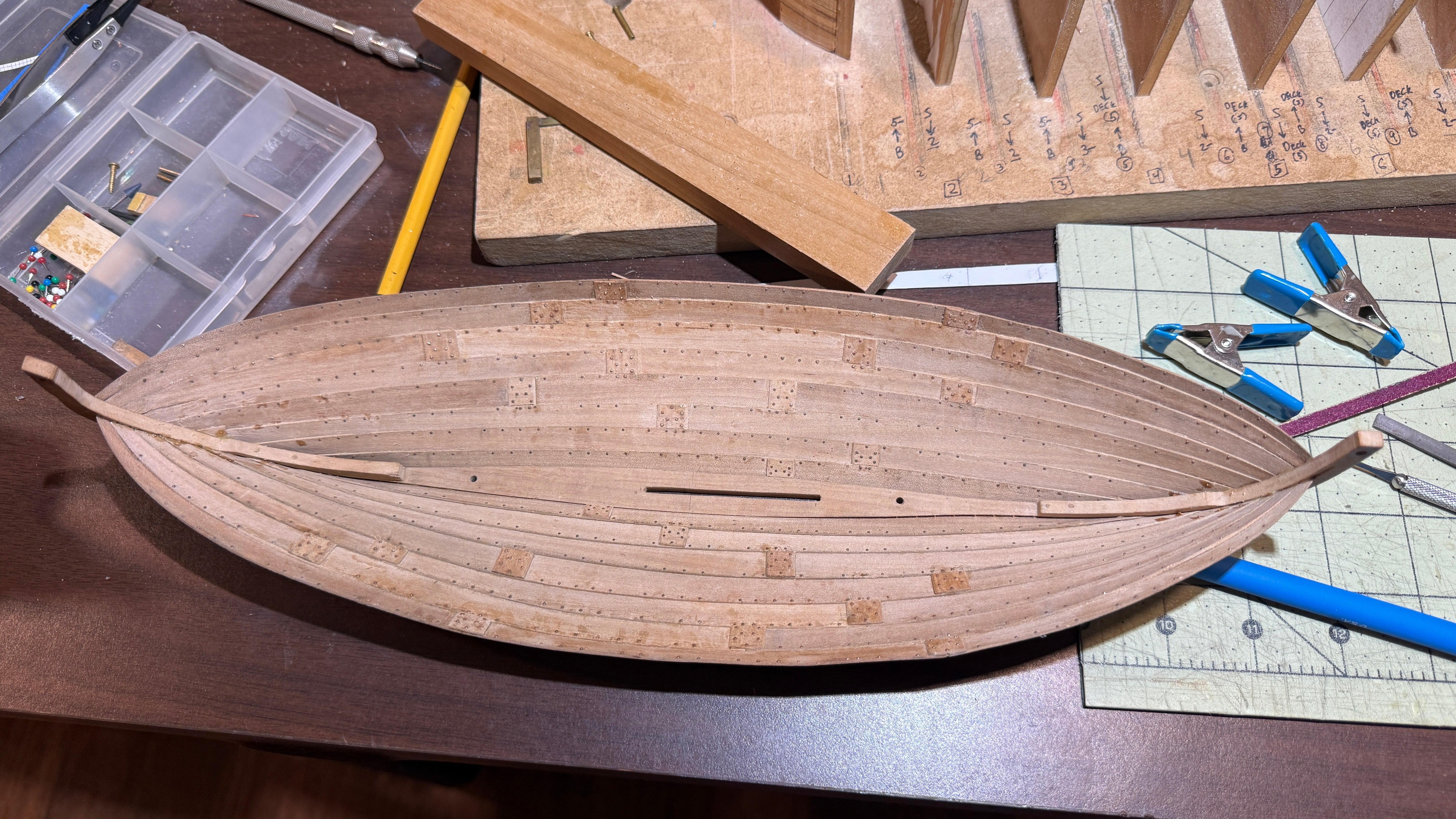

Since the last update, only 4 strakes added to port and 3 to starboard.  That makes me 75% done with the hull, minus some touchups that will be needed at the end.  Not much to show for 10 months, but I did have a really good summer, including 3 trips to Europe (the first since before COVID).  The first of these was back to Denmark, which I think I last visited in 2008.  I saw Christian Nielsen's model of this same boat (Christian Nielsen is the grandson of the builder, also named Christian Nielsen), revisted her sistership Viktoria in Roskilde, and even traveled to the small island of Fejø to see the workshop in which she was built.
Overall view, 75% completeFocus on butt blocks.  75% complete
Stern, 75% complete
Bow, 75% complete
Christian Nielsen's model (grandson of builder)
Former home and workshop of Christian Nielsen, the builder
