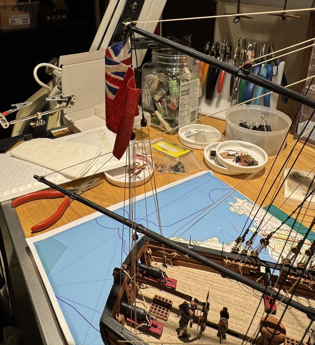

Thanks Druxey!
Actually those stays are just temporary to hold the masts steady while I work on the shrouds. They'll come off and be replaced with real stays, which is why these are white.
In earlier photos, you can see the hearts that you're talking about that the forestay will later get rigged to.
As for the mainstay, I don't know how accurate it is, but I'll be following the provided plans, which have it running to a heart that you can see located on the foremast.
I'm glad you're keeping an eye on my work!

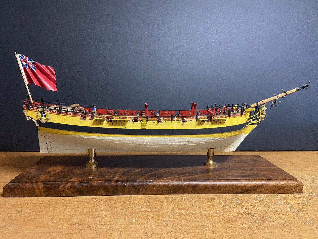

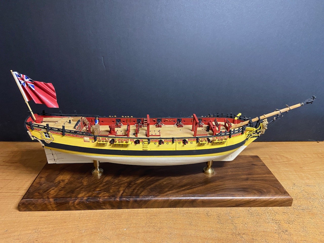

Also, I like the way this model looks so much that I'm afraid of ruining it when I get into the rigging.
I quickly made a flagstaff and mounted the kit's flag. Also, started looking at building up the stern lantern.
In the meantime, the Wolf makes a fine display...
IMG_1496.jpeg.09b9ae8cde4b052e09b7bc3a194081e9.jpegIMG_1497.jpeg.64779bf29fcad3d4f0a6aa83e7d1ca26.jpegIMG_1500.jpeg.50815bcb2b3ffab1468f12636ccbb927.jpeg

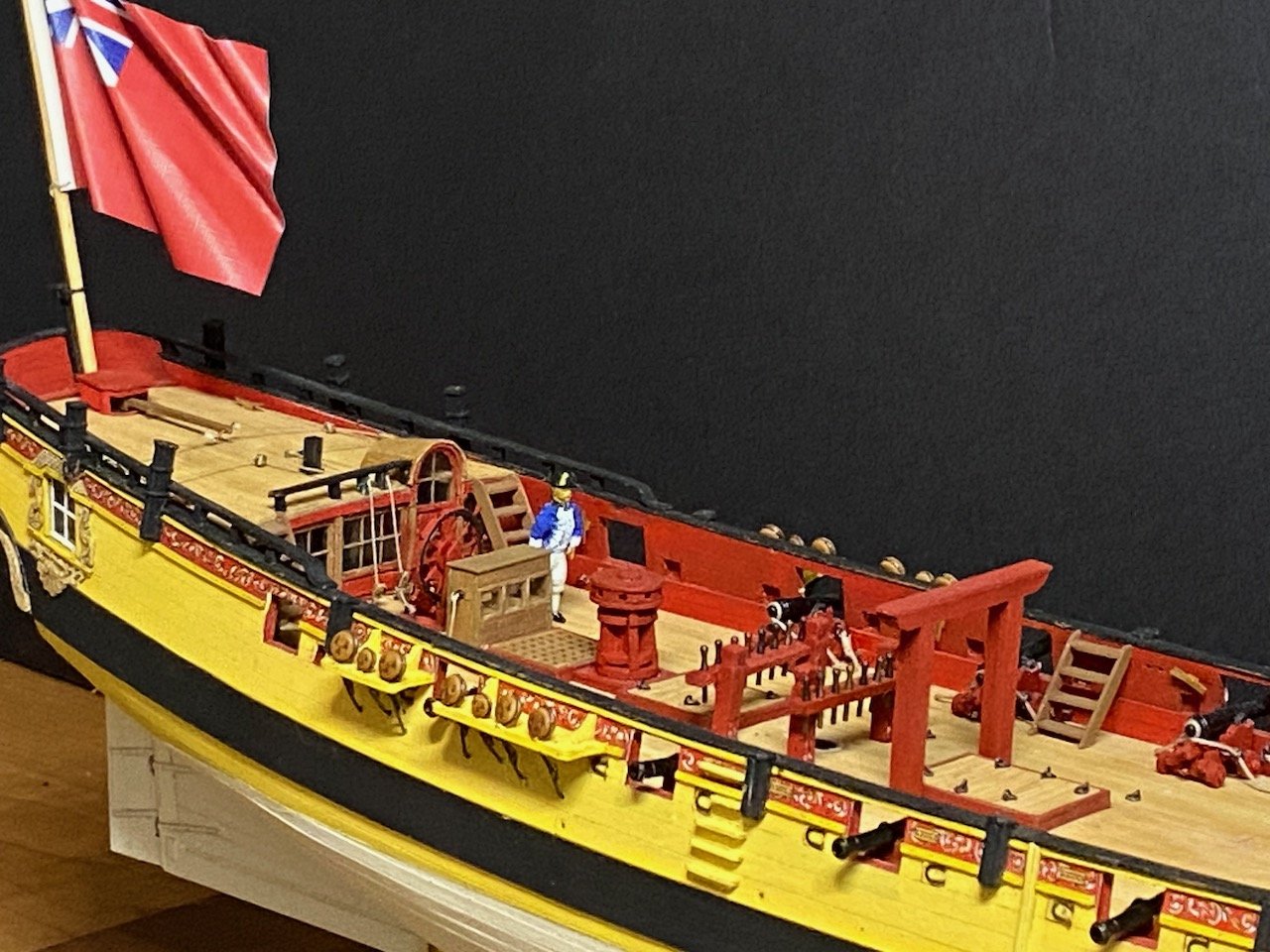

I've since given the flag a shot of matte clear lacquer to take some of the sheen off of it. If it bothers me enough, I'll just print my own flag, as that seemed to work pretty well on the yacht Mary model
Note that I haven't placed the deck pumps. They're done and ready to be mounted, but to prevent damage to them, I chose to leave them off. I may just tack them into place like I did the officer figure, so they can be removed should I eventually decide to rig.
Regarding rigging, though this is more lightly rigged than a three-masted square rigger, like a frigate, those larger ships have larger masts and yards, and I think they may actually be easier to rig, at least for fat fingers.
Thoughts?

It looks great as it is. If you're not in the mood to rig it but think you might change your mind in the future, I think you could leave it as-is and add the masts later. Another interesting option might be to add stub masts or just the lower masts, which wouldn't add too much to the space requirements but might give it more of a "finished" look.
It's looking great Clare. I found her sister, Speedwell, very easy to rig.  As I recall the Wolf rigging plan provided was very good. As well, you can find excellent rigging instructions in our Speedwell, Vol. 2. She does have a rather nice lofty rig so your display space will need to double perhaps.

What a nice looking model, Clare.
Suggestion: make your own silkspan "draped" ensign. It's a lot more work but worth it, especially for a non-rigged model like yours. I just did one for my latest, a gun brig (attached quickie shop pic).
BTW: really nice baseboard, did you make and finish it? I like it. Please tell me it's not made of paper!🤨

Hi Greg, at 1/72 scale, I've found the spars to be very thin and light and the rigging lines to be very fine and a bit complicated for my fat fingers. With the card stock being softer than wood, I'm a little worried about ruining what has otherwise turned out to be a very nice model.
However, your reference to Speedwell has put bug in my head! I'd notice how similar the HMS Wolf model is to Speedwell, but I never followed up to see if the two were related until you just brought it up. Now, I understand they were sister ships.
This has me wondering about taking up the challenge of converting an HMS Wolf kit into an HMS Speedwell. 🤔
It would require a redesign of the deck layout, which means that the laser-engraved decks can't be used, and some parts would have to be fabricated. But, the main issue is that for an HMS Wolf to an HMS Speedwell conversion to have real value, I think it would have to be fully rigged.
If I did that, I'd probably also want to complete the rigging of this HMS Wolf for comparison.

Hi Ron, no the base isn't paper, but wouldn't it be cool if it was? 🙂
On the flag, I think the quality level of the paper model works well with the kit flag, though I had to hit it with some matte lacquer due to the shine that you Also, I'm mostly trying to illustrate how nice the kit turns out. The only thing not of the kit is really the deadeyes and blocks. If I end up eventually rigging the model, I would consider at least printing my own flags, like I did with the Yacht Mary model I recently completed. I'll get to the silkspan flags at another time.
On the base, I just bought a walnut board from the Rockler woodworking store in the area, a 48" x 5" x 3/4" I believe. Cut it and routed the edges and a little sanding and satin finish. I'm in trouble if I need a wider board, as this is as wide as they carry. But, this works for most of my models. Anyway, that and the Amati brass pedestals sure beat the cardboard cradle that comes with the kit. It's not bad for what it is, but I much prefer brass pedestal or rod mountings.
