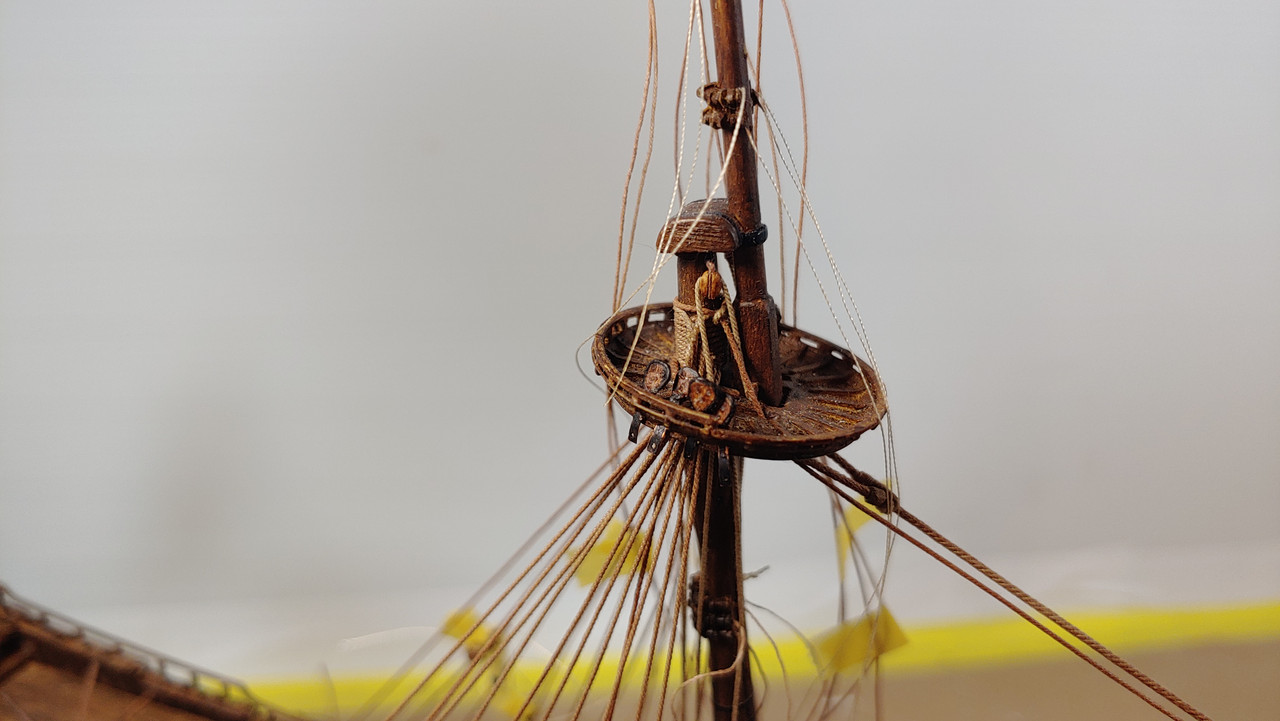

Made some more progress on the Mizen mast, the Crojack yard is installed, I used a 2mm block for the sling and 1.5mm blocks for the brace pendants and lifts/sheets, rigging the parrel strop was a little challenging with the Lateen yard in the way and looking back it would've been a lot easier to mount the Crojack yard first , also completed the lower Mizen stay and lanyard. Up next I need to rig the lower Mizen shroud lanyards to tighten up the Mizen stay a bit more before I move on to the main top gallant halliard and crowsfeet.
