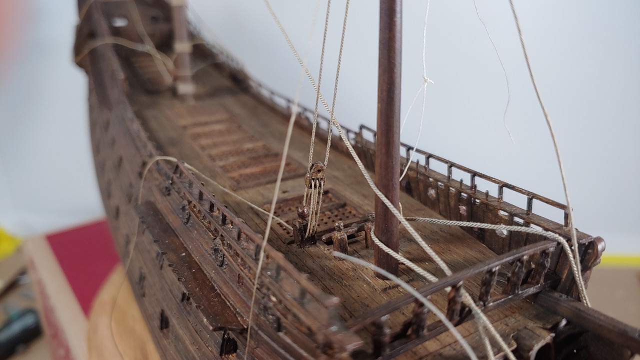

rigging line color is too bright, looks like sintetic rope... wont to stain them ?
These pictures of Vasa museum model - as a reference , where colors of used ropes looks more natural...
just my suggestion, that rigging need to be stained to the natural hemp color...
if hull ,decks and other wood looks weathered, why not rigging lines...but even new ropes color should be more dark ,as seems to me... or what is your idea?

I totally agree with you Kirill, my objective is to have slight variations in tone of the ropes but the wooldings were a little stark and I toned them down a little, need to do a little more. The bowsprit is finally glued in along with gluing of the beakhead.
I made the cut outs for the fish davits, added the steps to the bulkhead and made up the tackle for the main topmast stay, I glued together a 2.5mm and a 1.5mm blocks to make up the fiddle block. Up next I be gluing in the decks one by one in phases, thanks for looking.

I had fabricated the parrels for the main and fore course yards that are glued to the masts and did a trial run of the parrel rope, the fall tackle will be reversed rigged with the end simply tucked in behind the parrel rope. The sheet blocks are about the size of the mid section of the yard with the sheave for the lifts at a right angle. The tie is .45mm line which will the same as the shroud and fall is .30mm which is rigged through a 4 sheave knight head, all of this is in the mock up stage at this point.

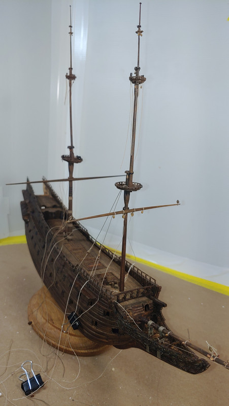

I started dressing out the masts and yards, the fore mast is just about complete with the martnet pendants still left to do. I used a 2.5mm block for the top rope, 2mm block for the main topgallant stay and 1.5mm blocks for the lifts. The fore tackle fiddle block is made up of 3mm and 2mm blocks, cut down some to reduce their size and the double block is a 3mm britannia metal block. Both masts are just set in place at the moment for a visual.

Hello!
Looks nice !
Did You left mast- top mast and gallant from plastic?
