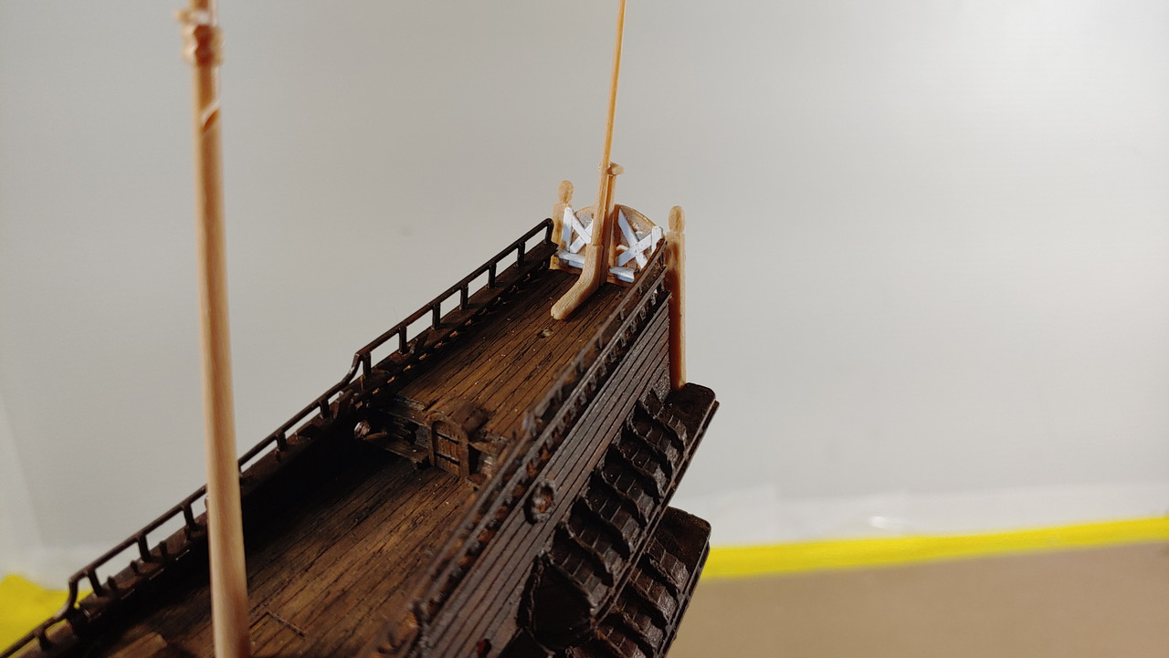

I finally completed all the decks with the gluing in of the poop deck, up next will the stern and modifying the rudder. As always thank you for stopping by and looking at my unorthodox build sequence.
Michael D.
Thank you Frank. In my efforts to try to modify the stern as close as possible to the real ship I overlooked the Ensign staff configuration, the kit supplied staff has a knee at the base and a corresponding cut out in the deck that the original does not have...arrrrgggg!. I contemplated doing some patch work to the deck and staff but decided to move forward with this arraignment, in the end it will look acceptable. I installed the main stay collar using .063mm line, the main stay will be .088mm line when I reach that point, I believe at scale this stay measures out to 135mm diameter which would put it at .093mm at 1/144 scale, the 1.0mm line just looked too big and I find it looks better visually when the line is slightly undersized.
I also added the sheaves to the insides of the bulwarks. Today's goal will be to finally glue in the stern.
Michael D.

The rudder is pretty done minus the ropes, trying to produce the gudgeons and pintles at this scale was a challenge, I used .030" rod, tape and 28g brass wire to create them and while not perfect they turned out ok.
Michael D.
Thank you Marc and Kirill. The rudder install is completed, it is fixed in place by pins inserted through the fake pintles/hinges on either of the rudder ropes and pinned into place. back to work on the masts and capstan.
Michael D.
