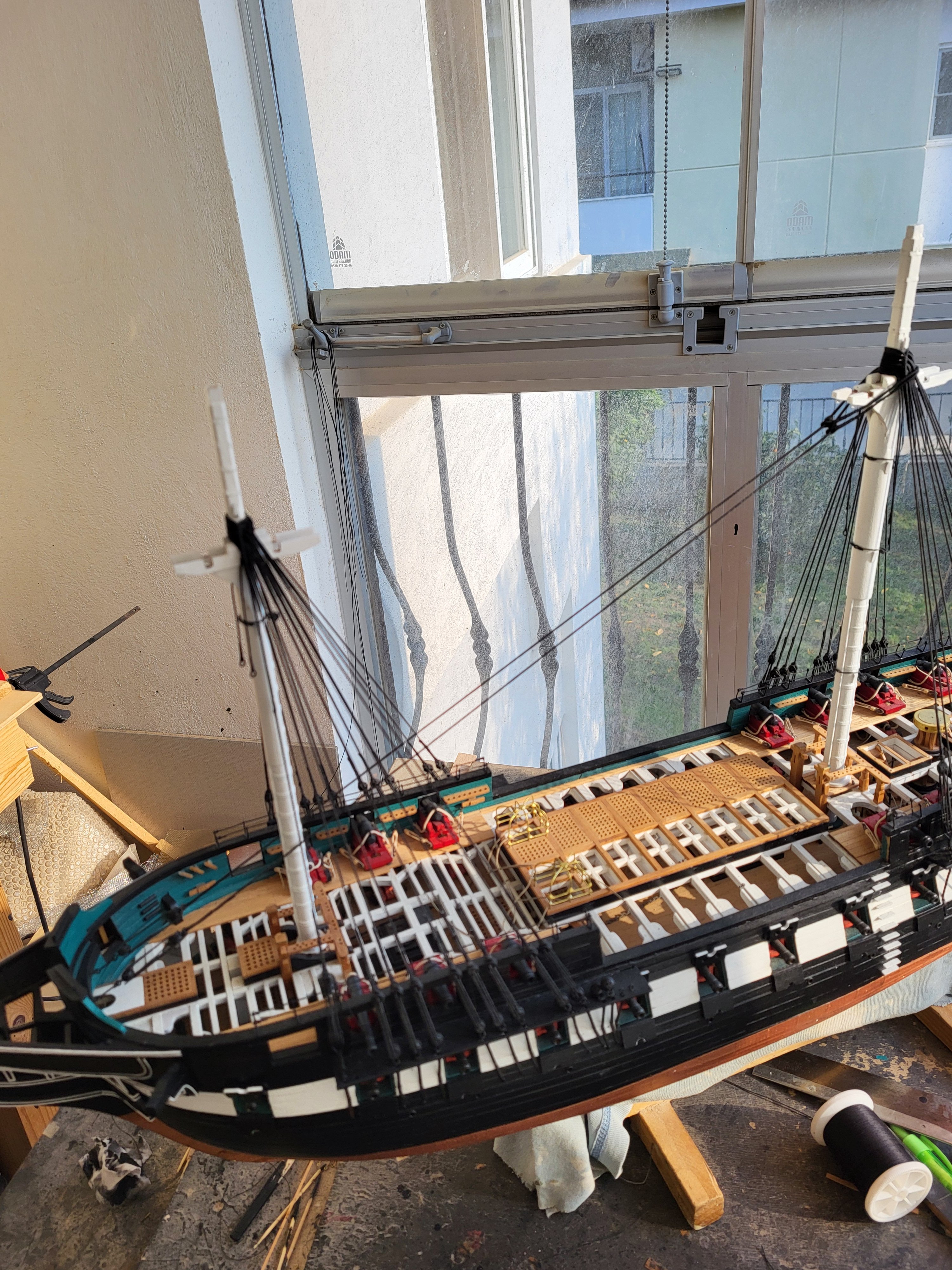

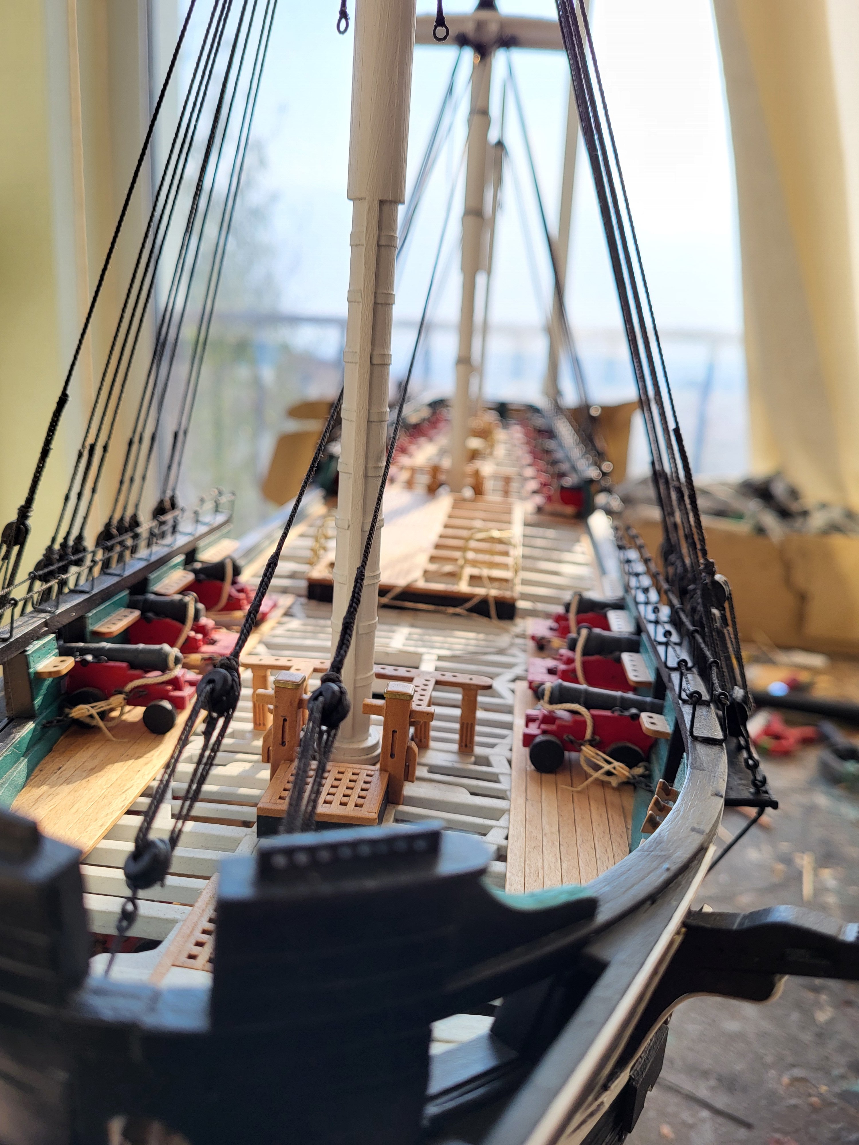

At first glance at your next to last photo, (post 985), you almost can't tell if you are looking at a model or the actual ship! Well done!!!!
Jon

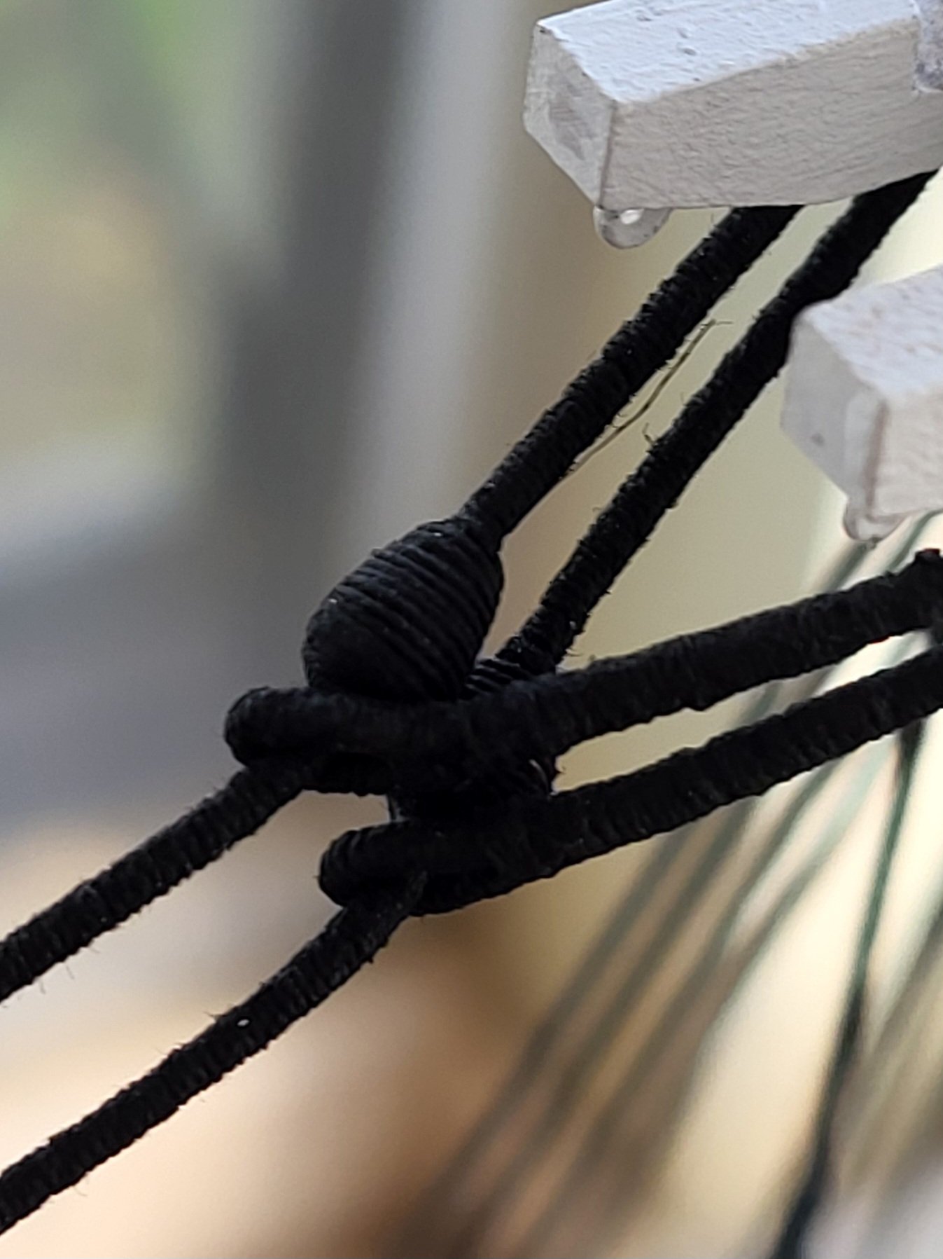

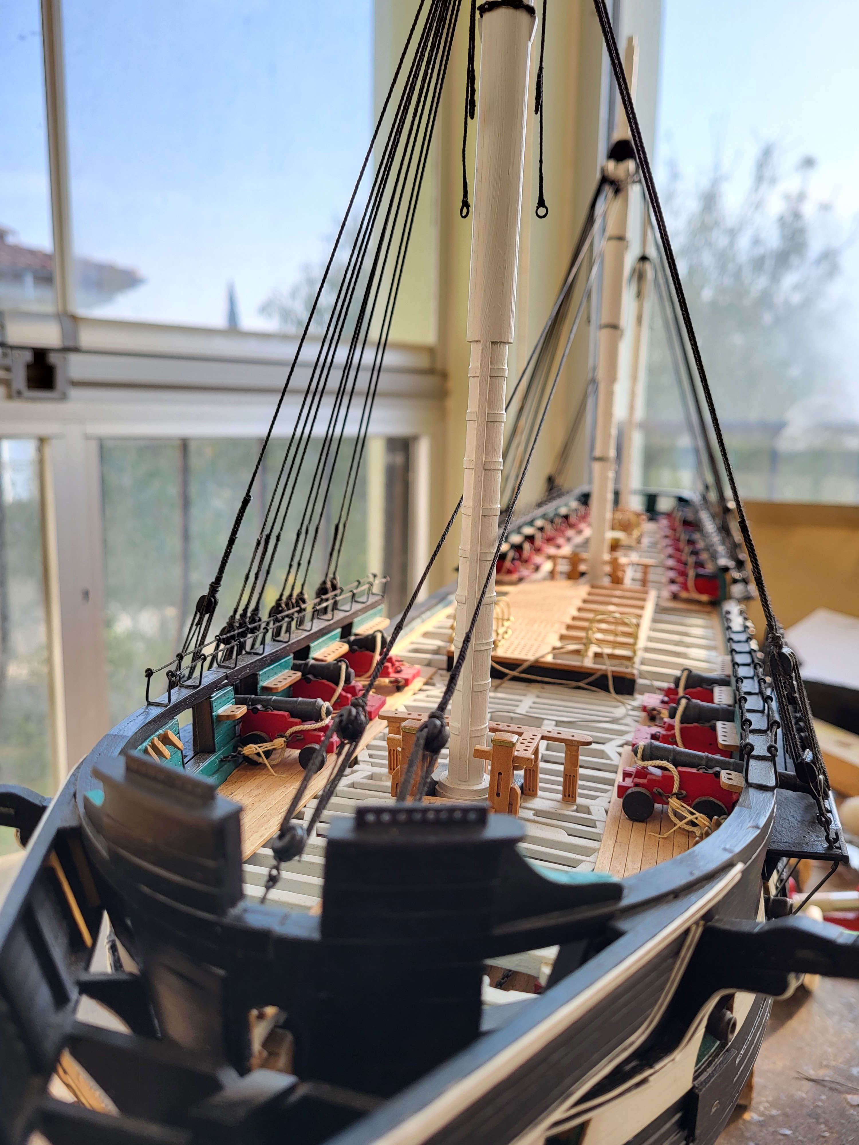

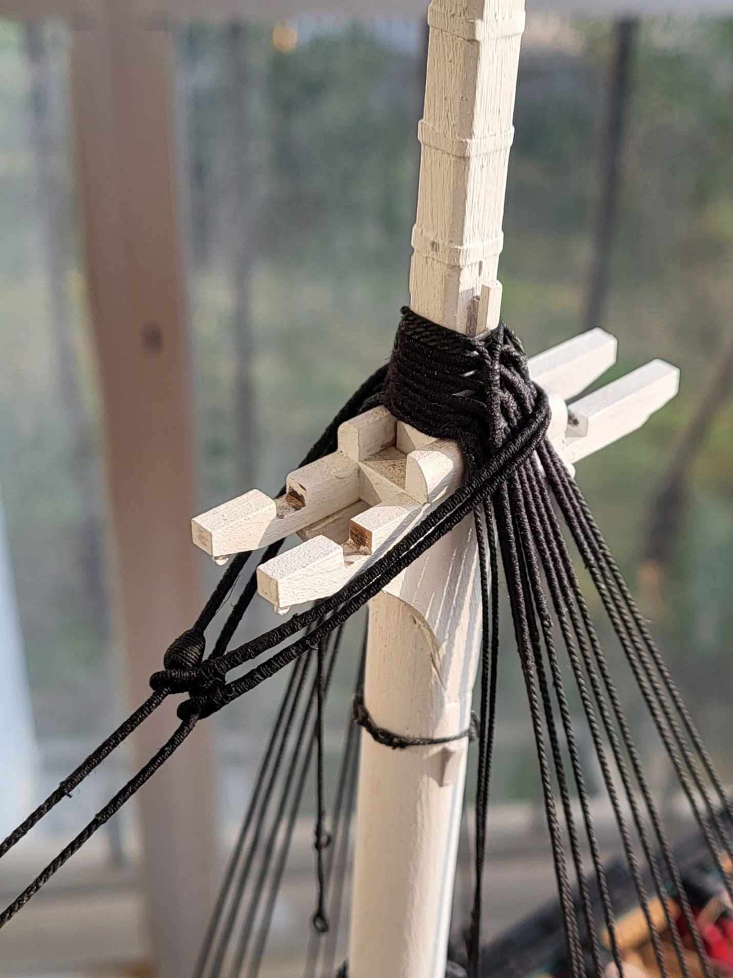

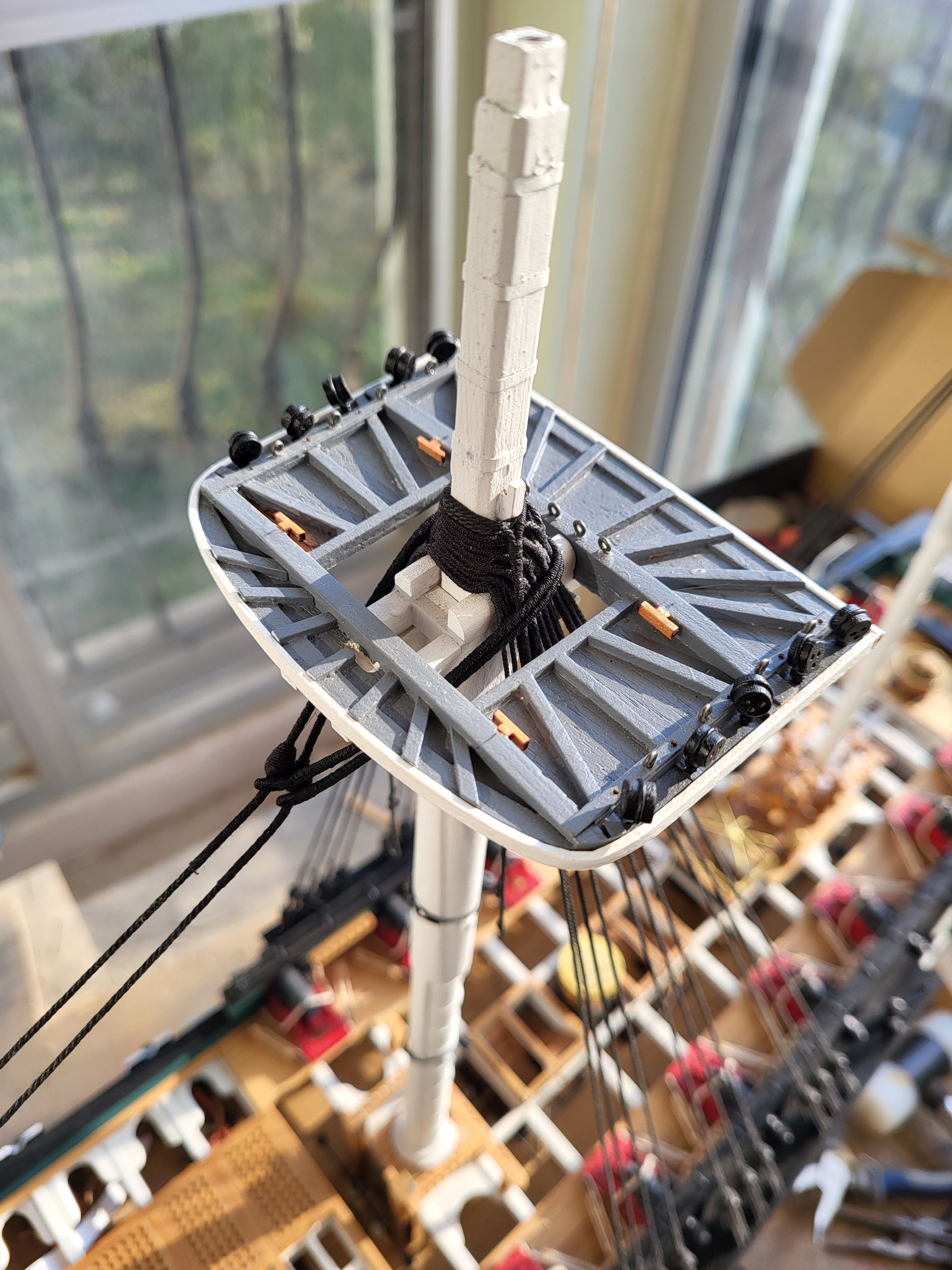

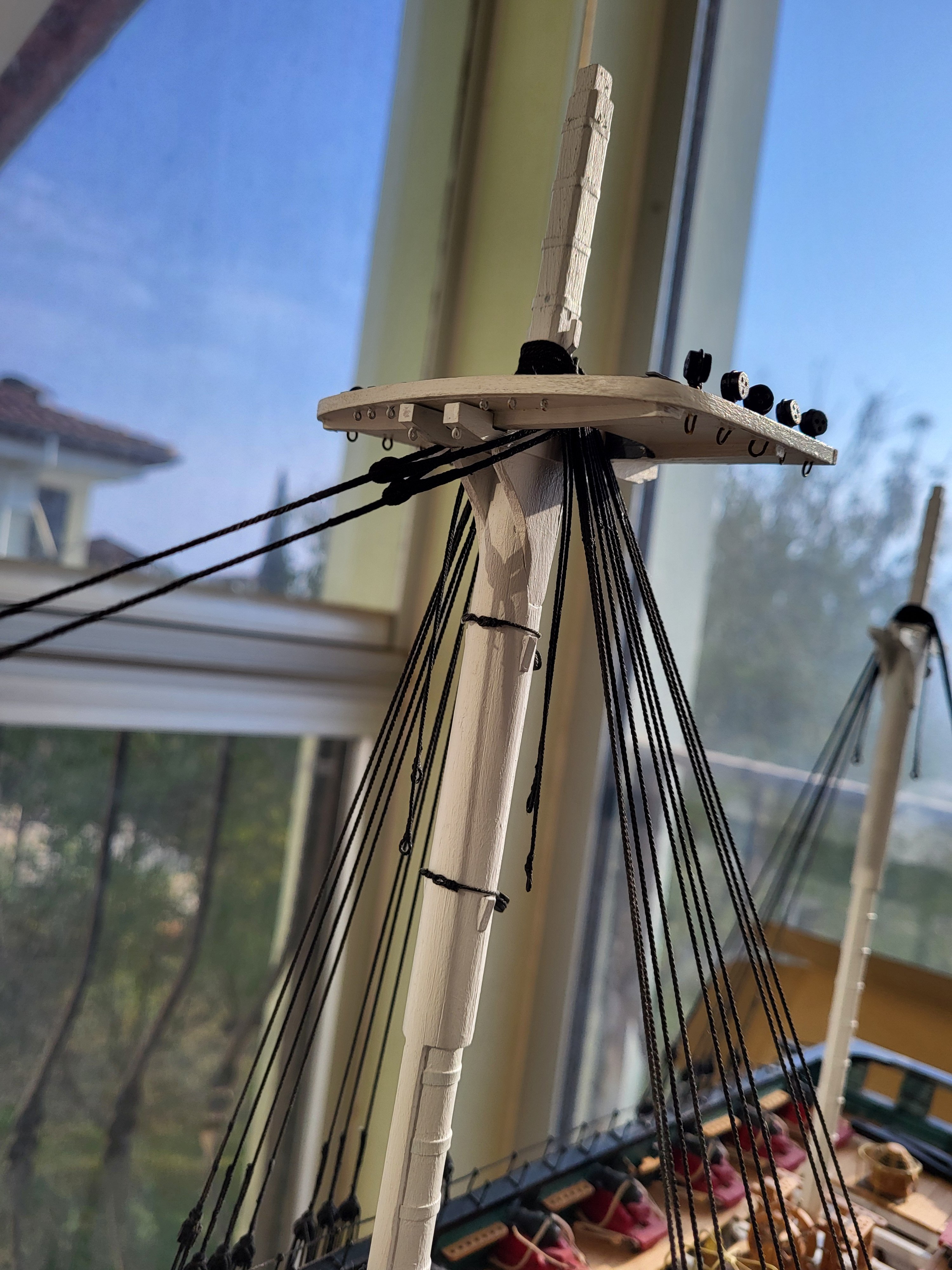

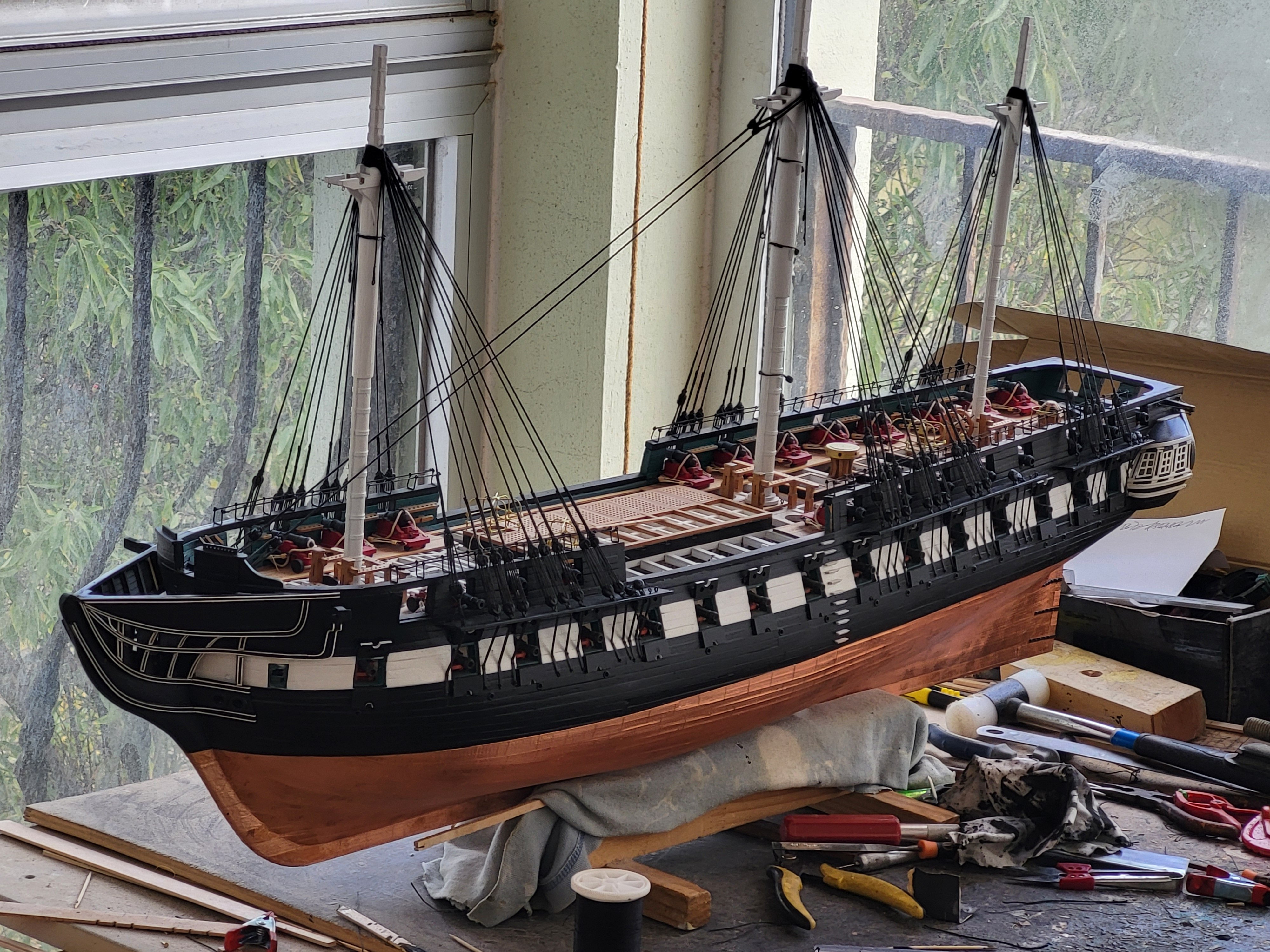

All the lower mast shrouds and mast tackles are complete. I used 1mm rope for the shrouds and 0.3mm rope for the lanyards. The next task will be making the main stays.

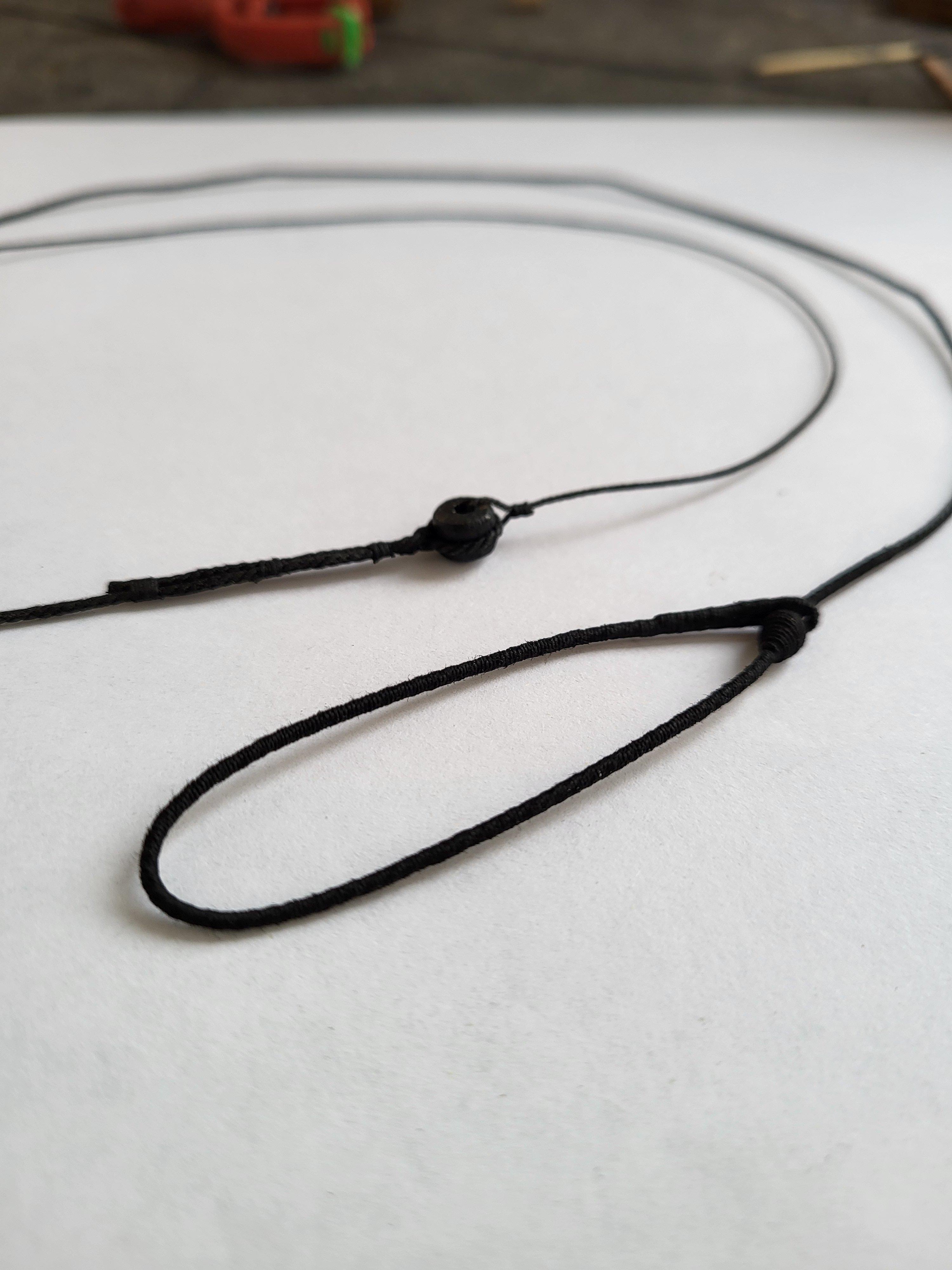

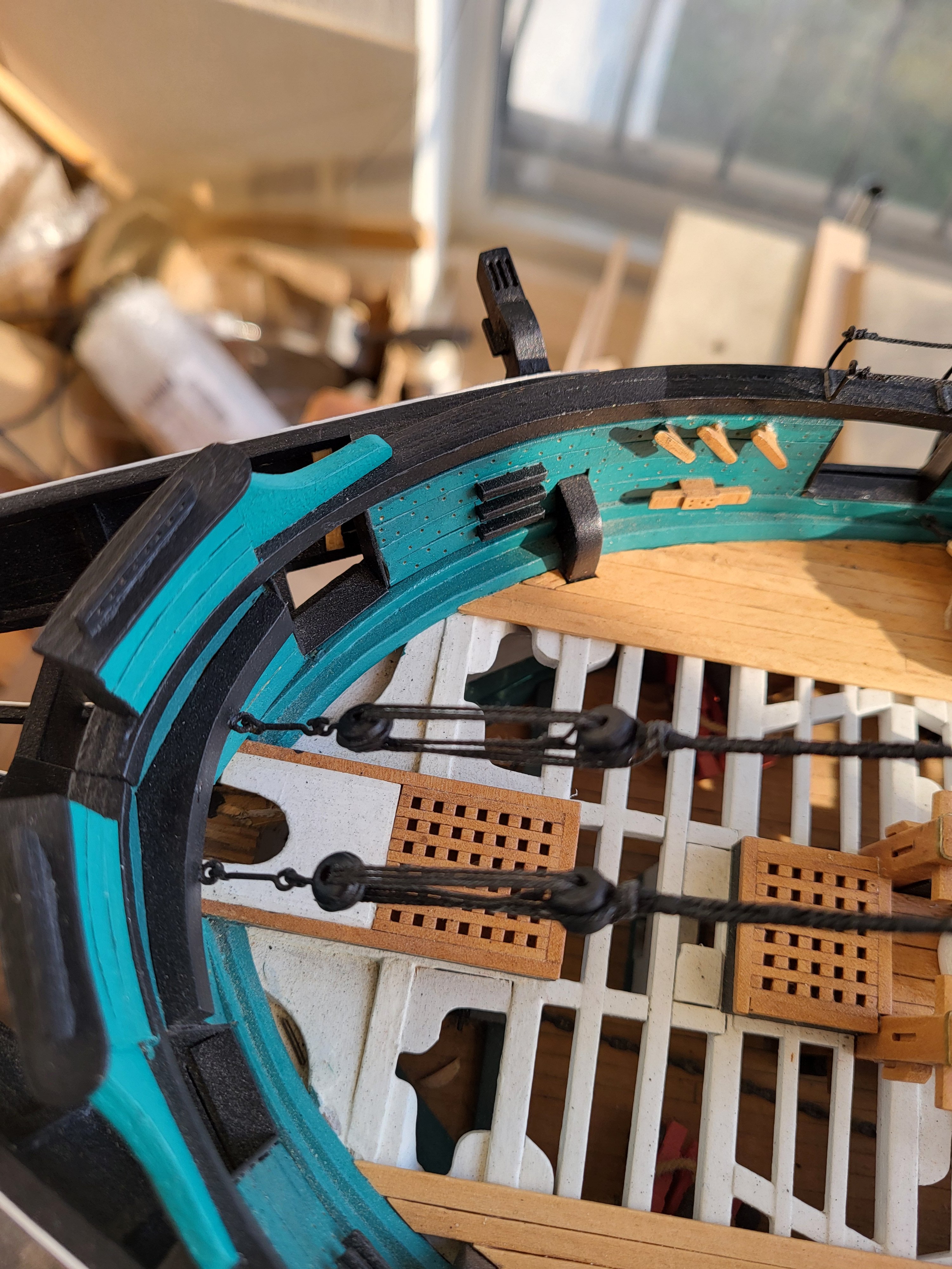

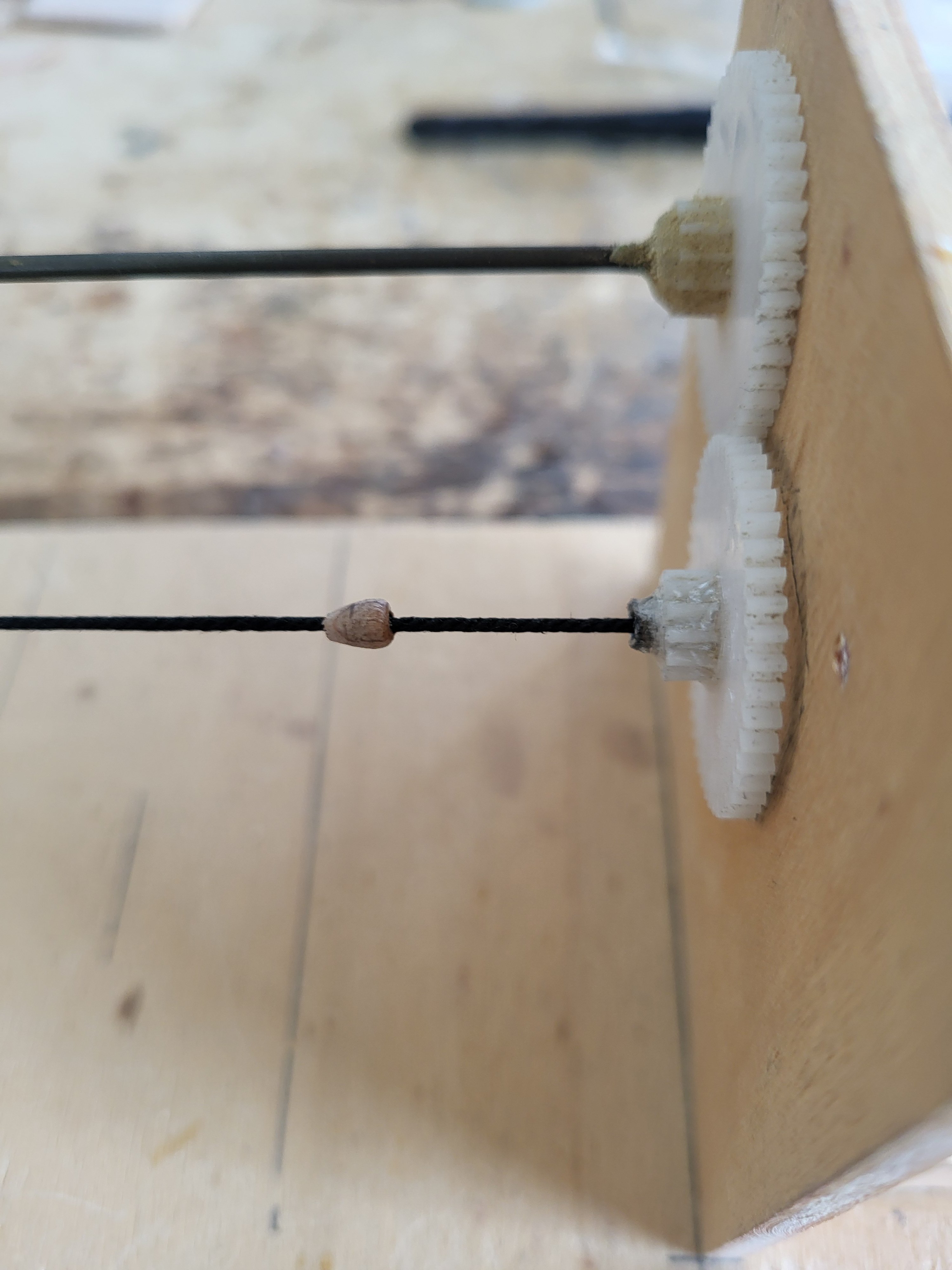

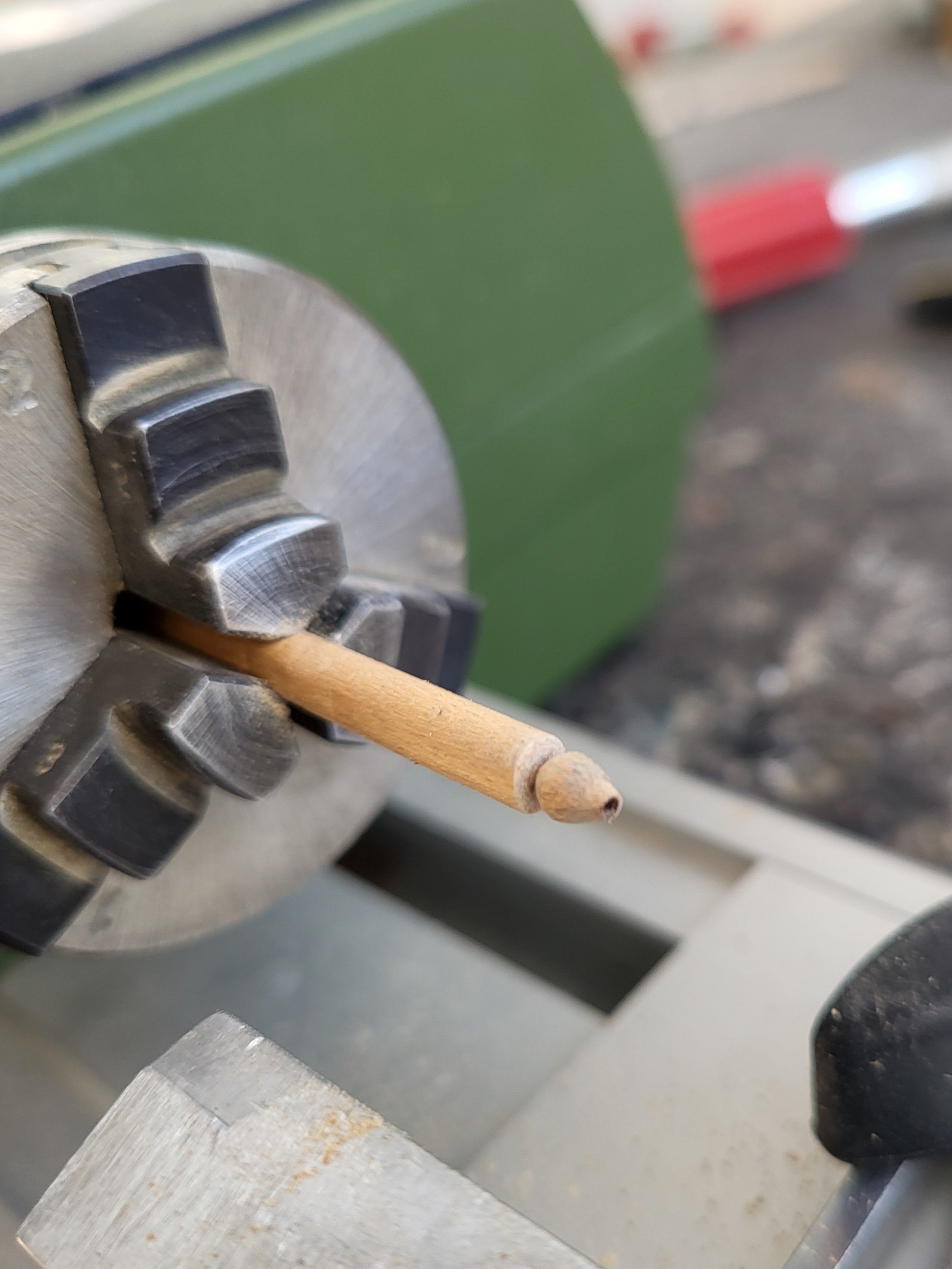

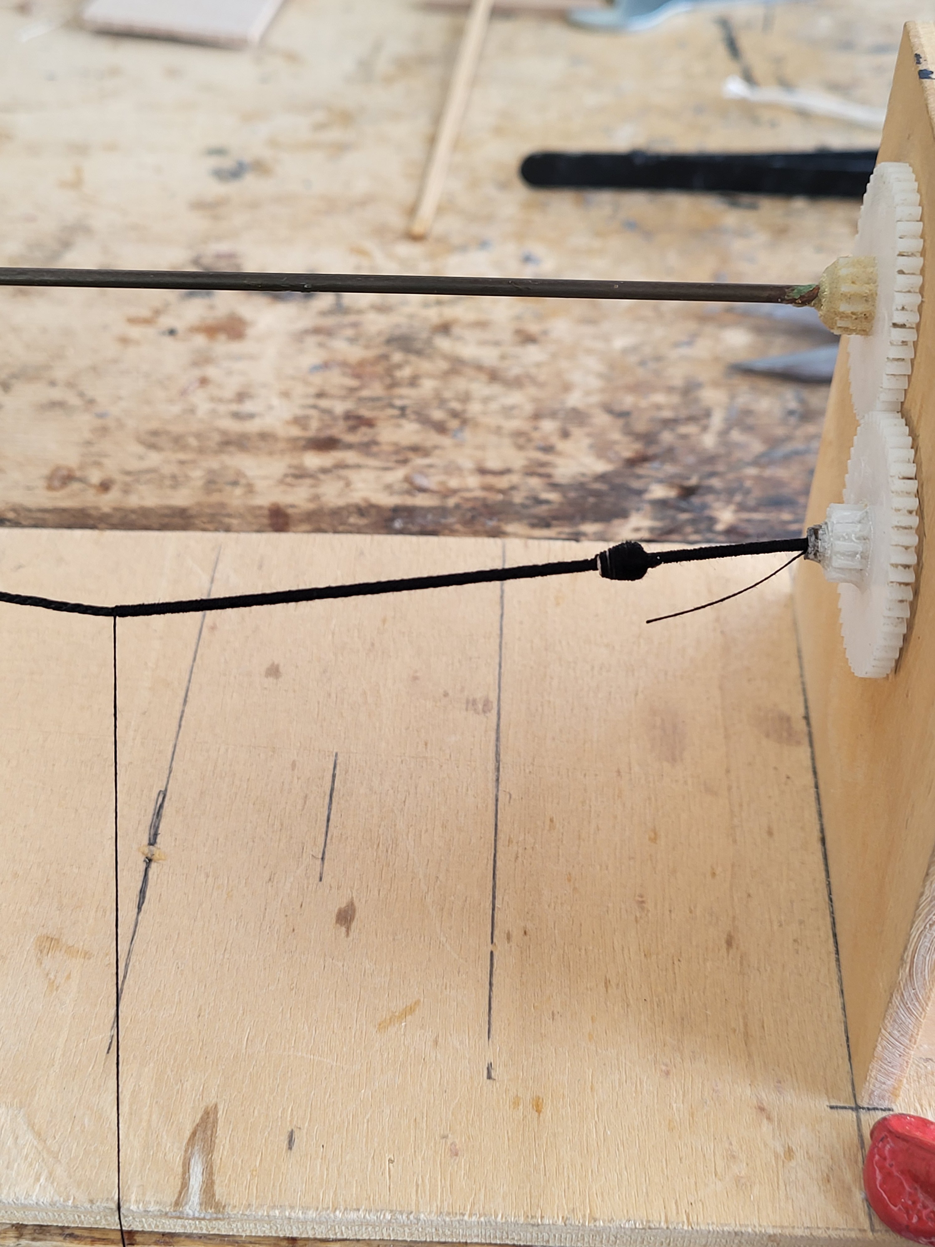

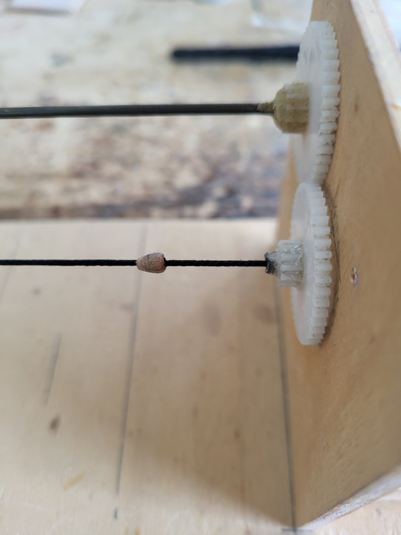

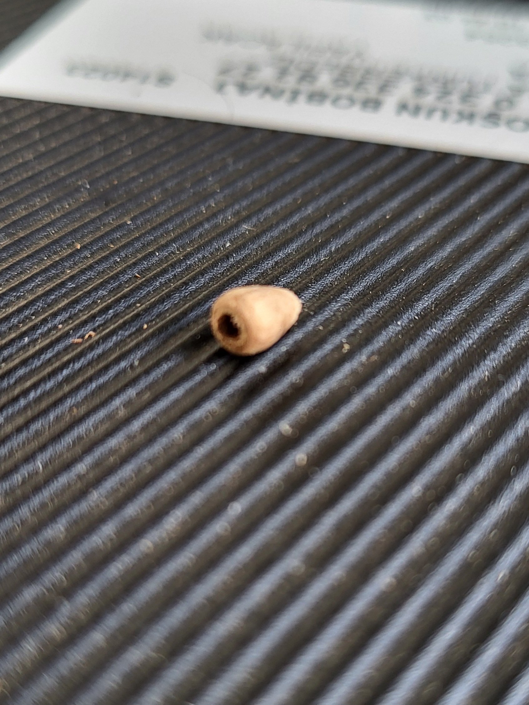

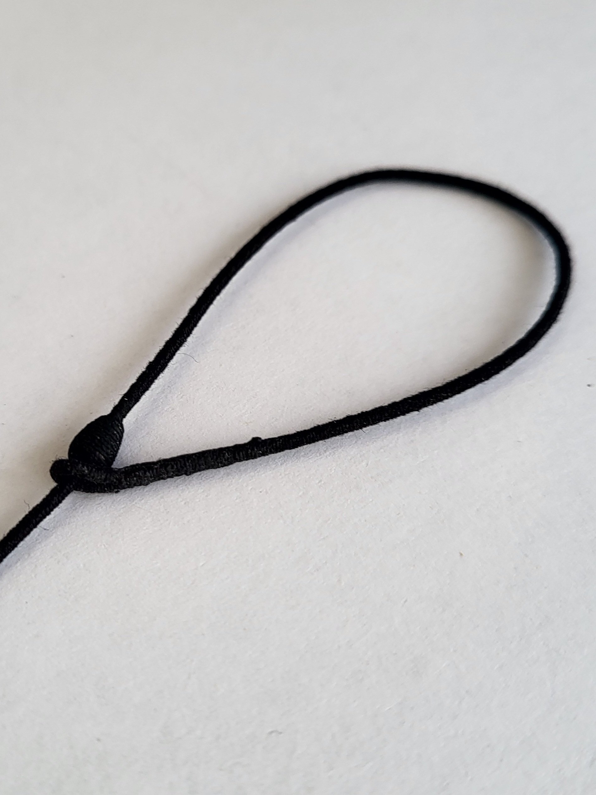

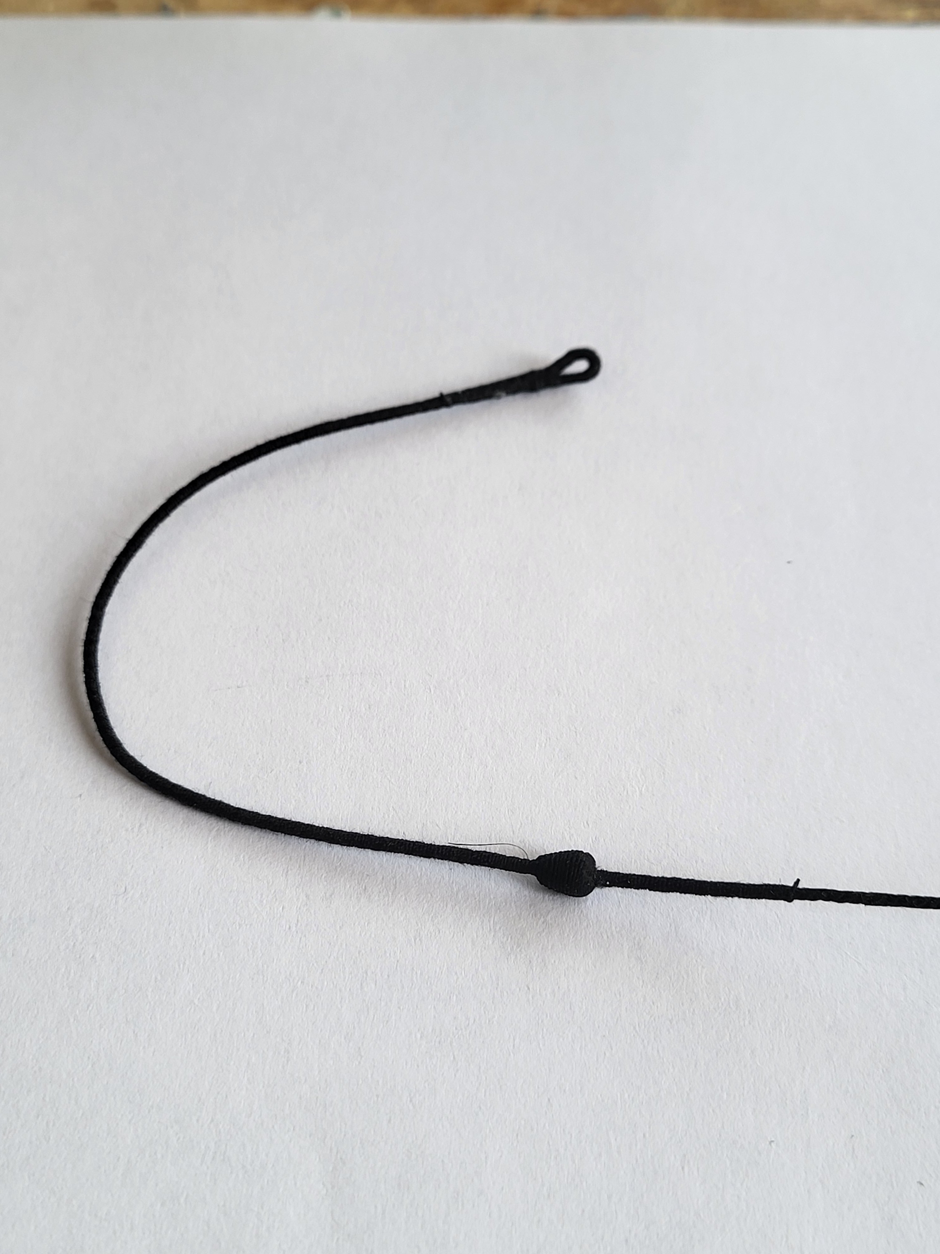

I prepared the main stays. To make the mice, I first drilled a 1.5 mm hole through the center of a 5 mm diameter dowel, then turned the dowel on my lathe. After that, I threaded a 1.2 mm rope through the hole in the mouse and seized it using my seizing machine. Next, I attached the 5mm bullseye I had made to the ends of the ropes and connected the lanyards to the bullseye.

Your rigging is really coming together nicely, Mustafa.  I love your mouse construction!  Another process I need to remember!
Gregg

They look beautiful! You didn't perhaps take pictures showing the sequence of steps you took to get the Bentinck shrouds into the state shown? Are the short shrouds sections coming off the the futtock stave, looping in the big ring or are they individually tied off at the ring? I understand your choice to omit some fine details due to scale; at full scale, there is an awful lot stuff crammed in there. But whatever you did, it look great.
Jon
Jon
Thank you, Jon. I initially tried to make it with all the details, but since I didn’t like the final appearance, I decided to simplify it. Unfortunately, I didn’t photograph the sequence of steps, but I hope the drawing below explains how I did it.
First, I secure rope no. 1 in its place with a hook. As indicated by the arrows, I first fix it to the futtock stave with CA glue, then pass it through the big ring, glue it again to the futtock stave with CA, and finally hang it back up to its position on the top using a hook. I repeat the same process for rope no. 2.
For rope no. 3, unlike the others, I first secure it to the futtock stave, then pass it through the big ring and finally hang it in its position on the top using a hook.

Continued great work on your rigging, Mustafa.  I, too, was having a bit of difficulty seeing exactly how your shrouds here were run and secured.  Your drawing defines it perfectly.  Thank you, sir!  Happy New Year!
Gregg
Thank you. You made a complicated rigging element look simple. Again, well done.
Jon
