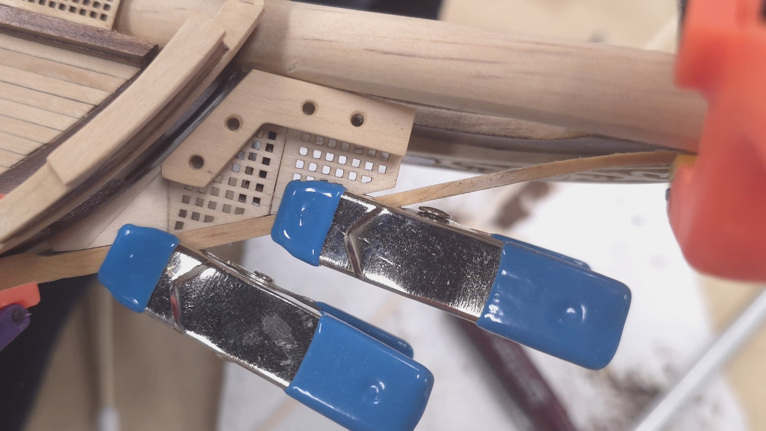

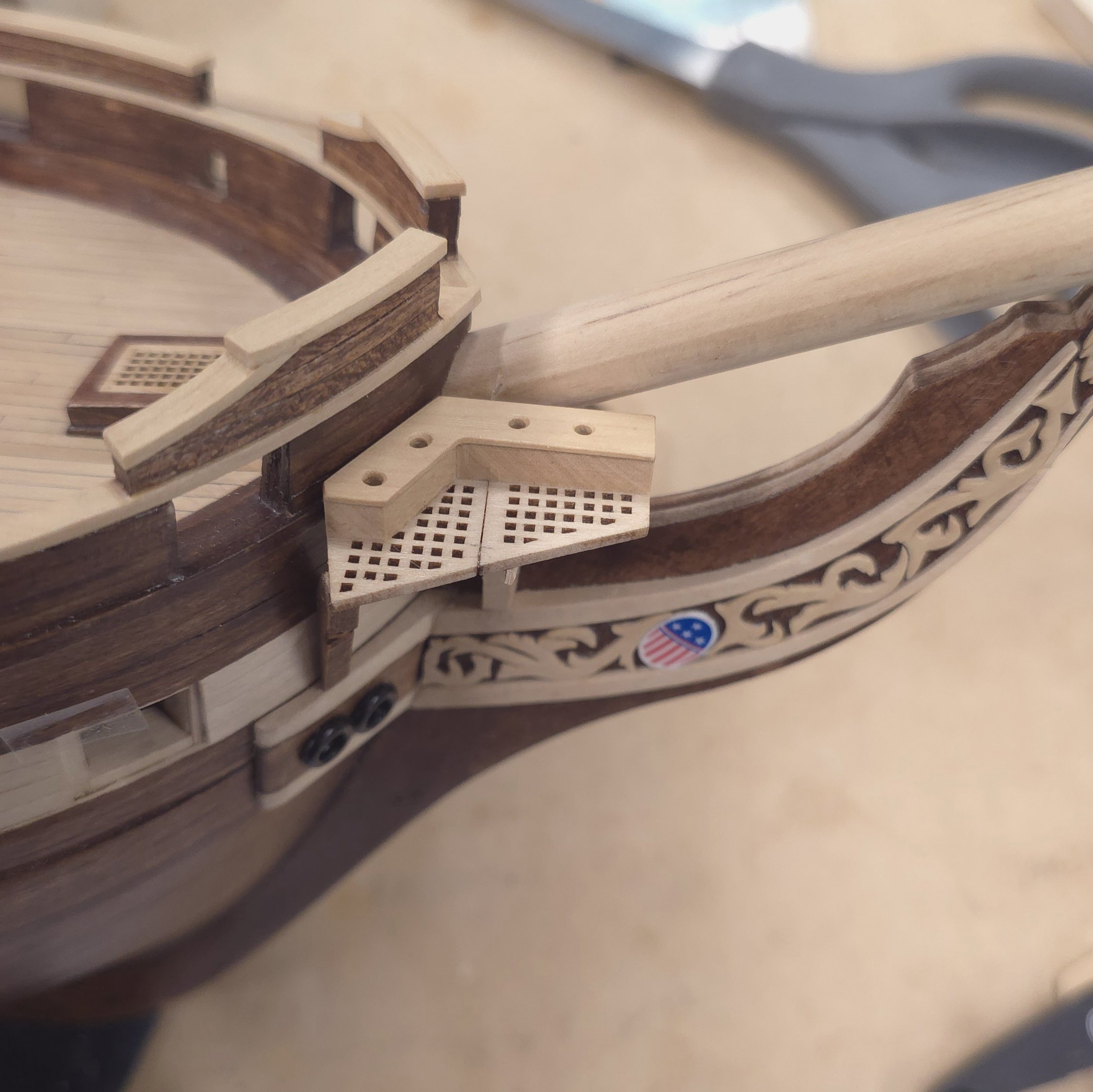

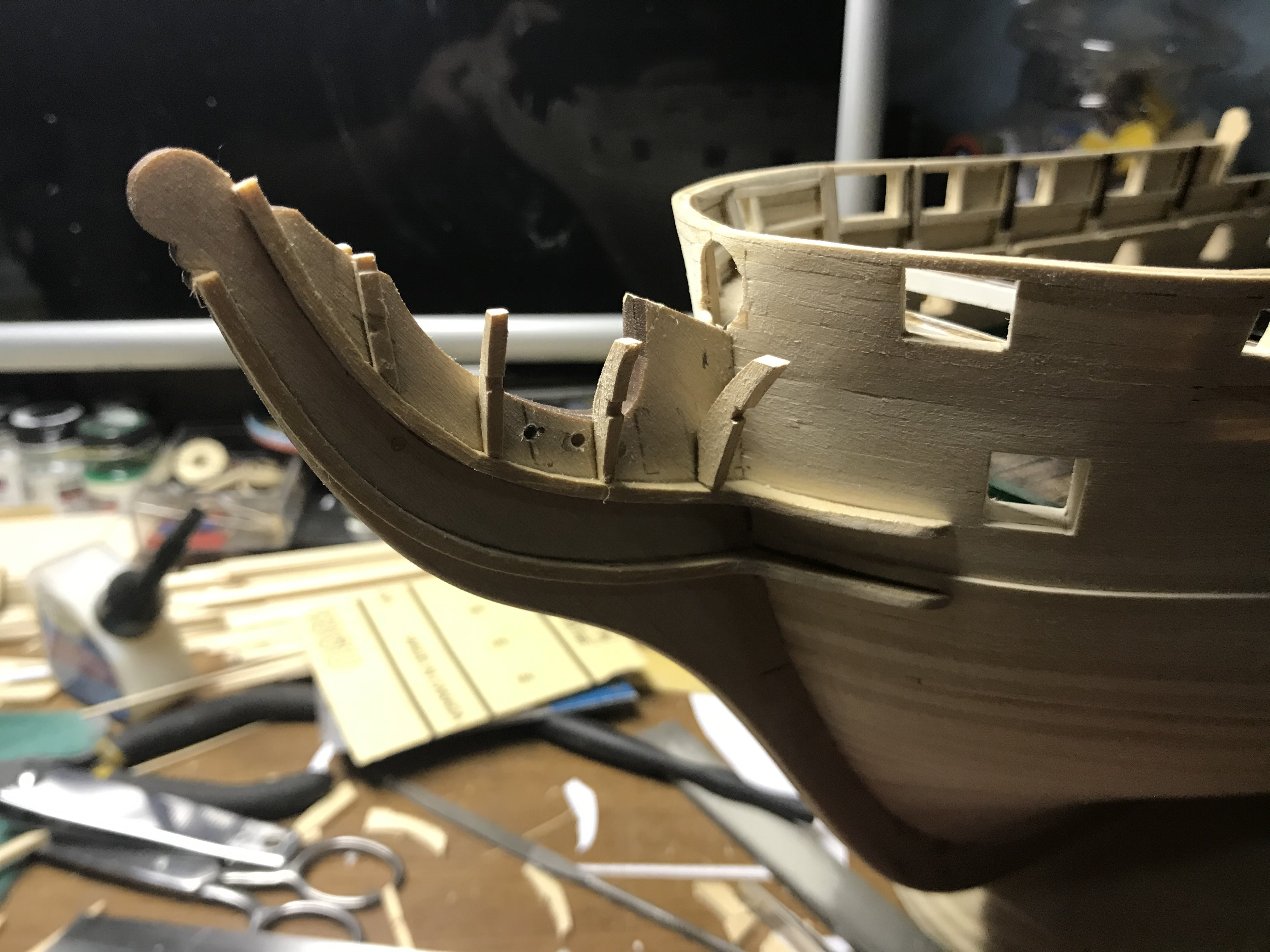

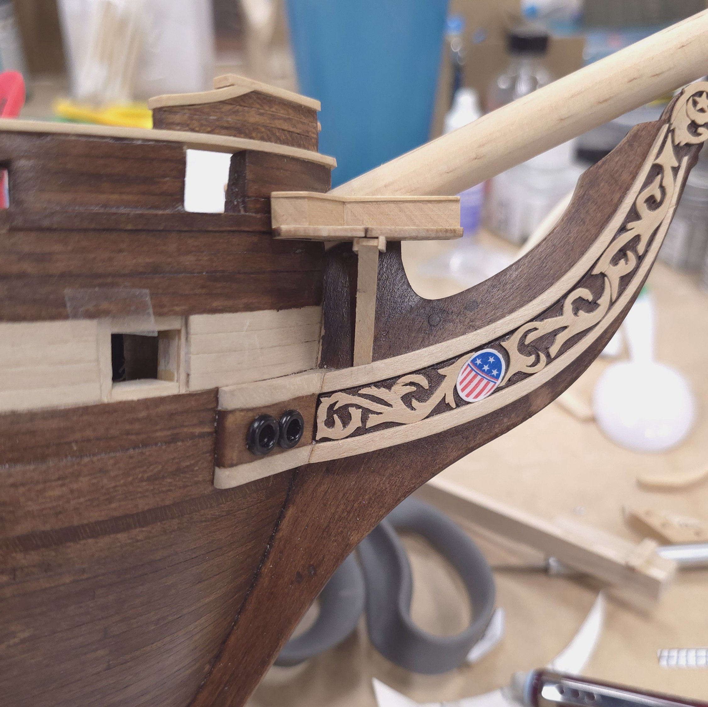

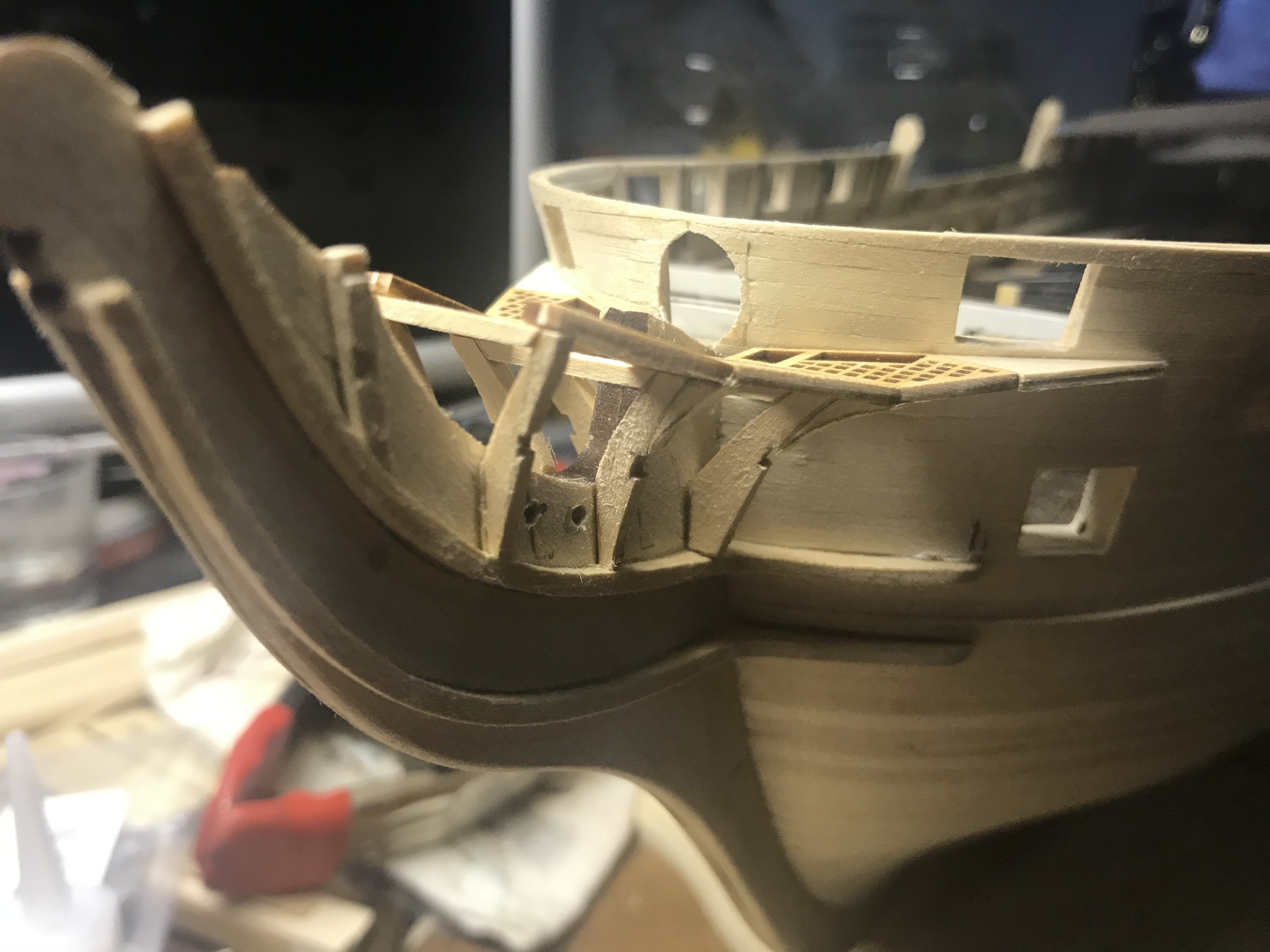

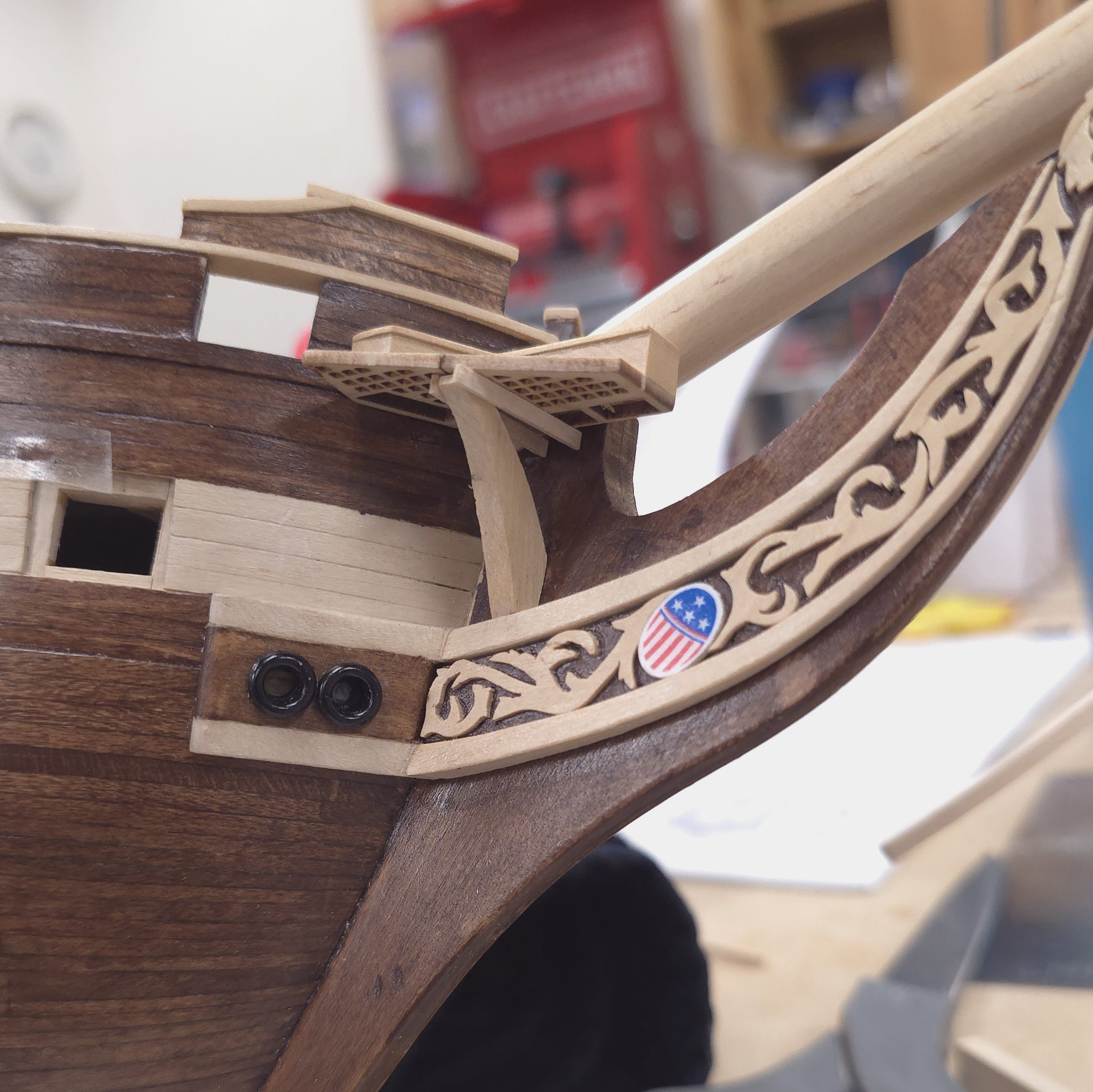

I'm beginning to see why people deal with the rails before they deal with the supports.
First a recap of construction efforts to date:
1.  Begin construction of the end of  rail 3 that fits below the cathead.
2.  First try at the forward portion of the rail.  (I'm hoping I can bend this to fit after tapering later).
3.  Construct support 5 and see how it fits.  First problem encountered.  Where do I trim to this support?  Outboard to match the knee and keep the distance from the hull of the notch (not yet cut out, just marked)?  Or on the inboard side, moving the mating areas for the rail inboard as well?
4.  Construct support 4 and see how this fits into the grand scheme of things.  More problems encountered.  If placed where the plans suggest, the angle is atrocious in proximity with support 5.   Or farther forward as done by several builders?
The latter doesn't really solve the odd angle problem.
20250429_131928.jpg      20250429_132316.thumb.jpg.8e252dd506a9ed5fce5b62df4b7e7d28.jpg
20250429_132854.thumb.jpg.23be5db4b09d3b37540a6f9618295b48.jpg      20250429_132251.thumb.jpg.133362d2b5f47dca1aae17047fe57431.jpg
5.  Bevel the end so that it fits at a 45 degree angle where the stem meets the hull? As done by yet others?
20250429_133157.thumb.jpg.95c3c4612421f7d37a3608c34f41bc9e.jpg     20250429_132228.thumb.jpg.06cd55c7b44ee28a50fff4bc45807e18.jpg
6.  Scratch my head and stare at the plan a little while longer hoping for inspiration?
Pour myself a double and call it a day?  😁   Yep!
Edited by Der Alte Rentner
Okay guys, you can look now..  *and you know who "you" are..

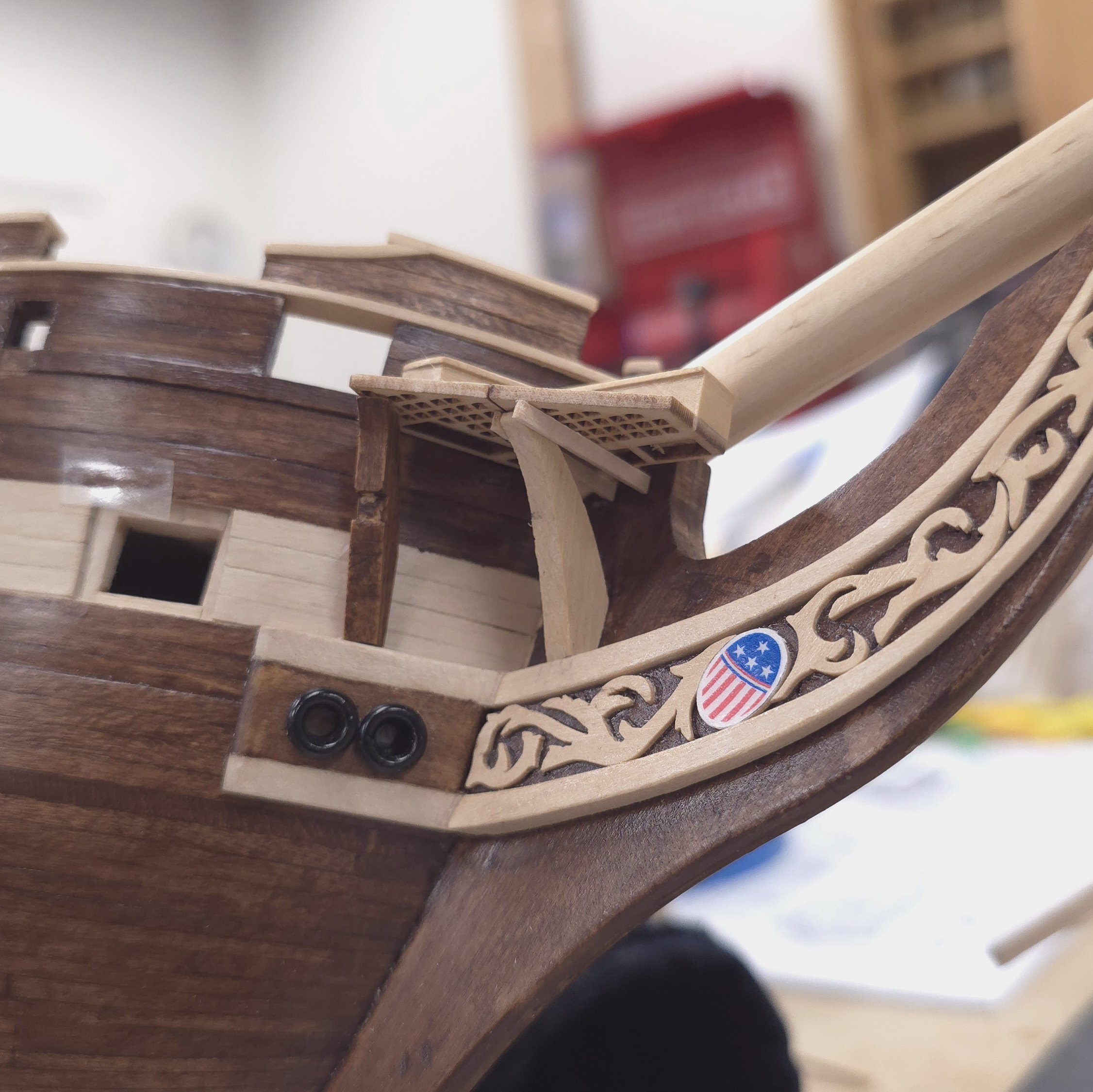

Still struggling to find the correct course, but I may be getting close to a support-first approach.  Support 3 needs to be a little taller, so the mating face for rail 2 is in the right place.  I think the key will be to get the slots for rail 3 correctly aligned.  From there it should be downhill, in theory.. 🤔

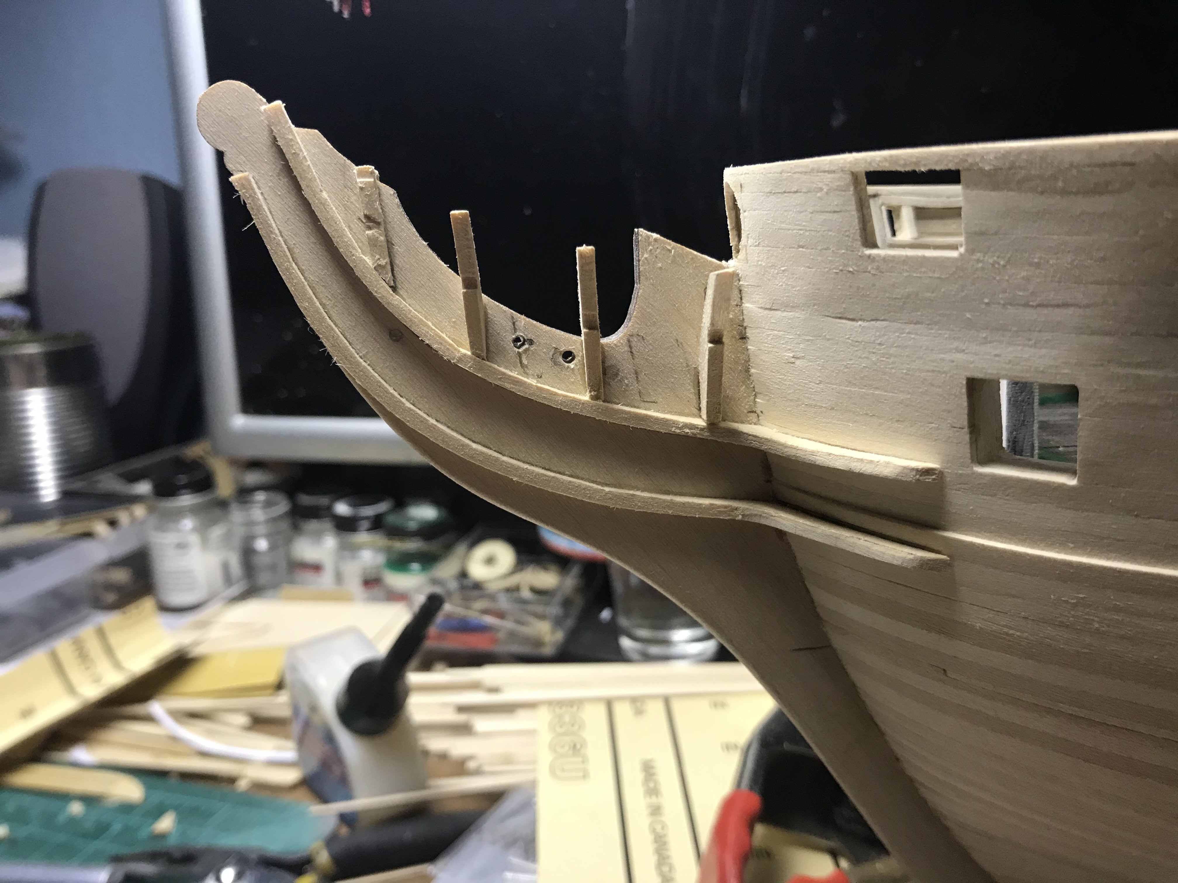

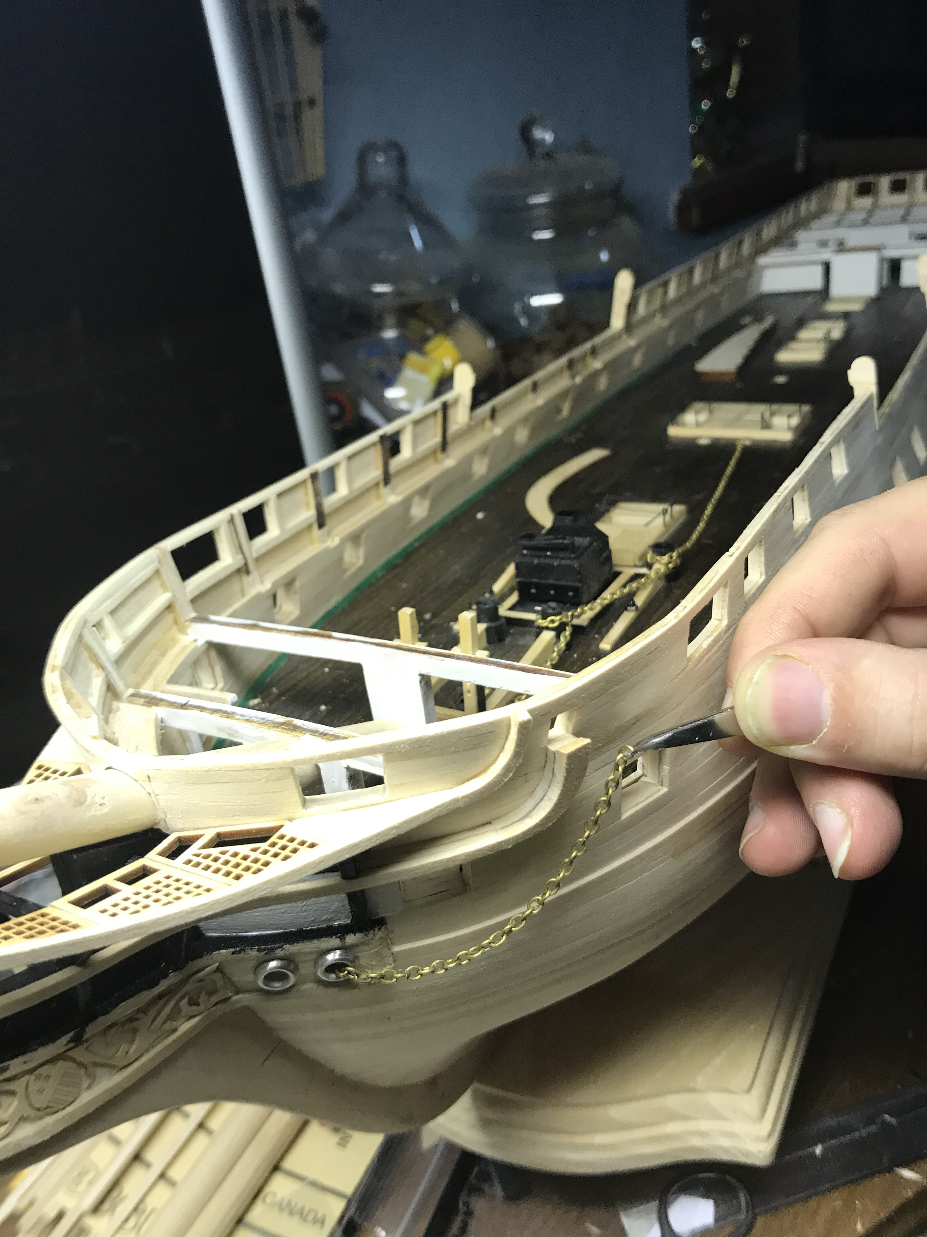

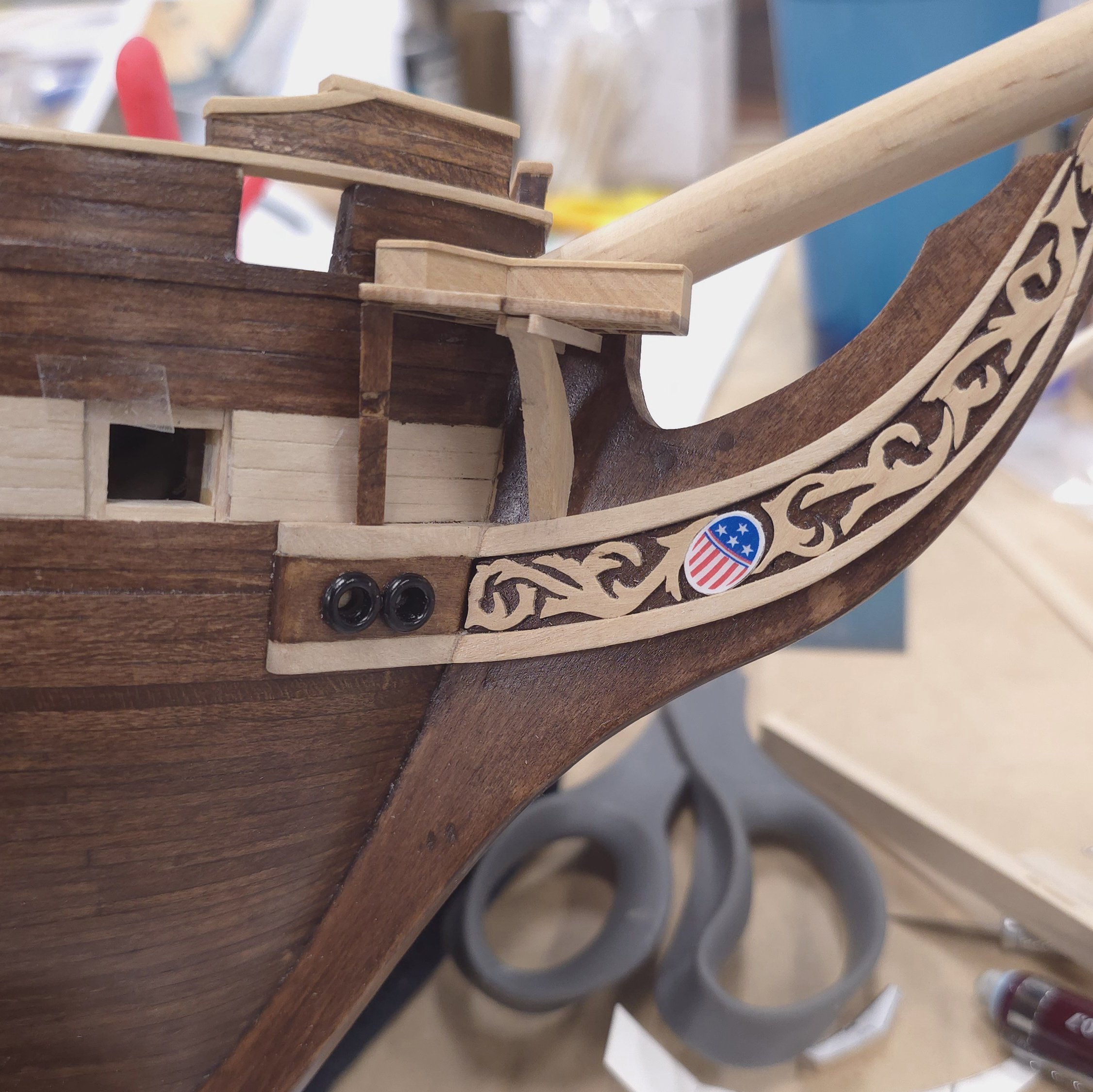

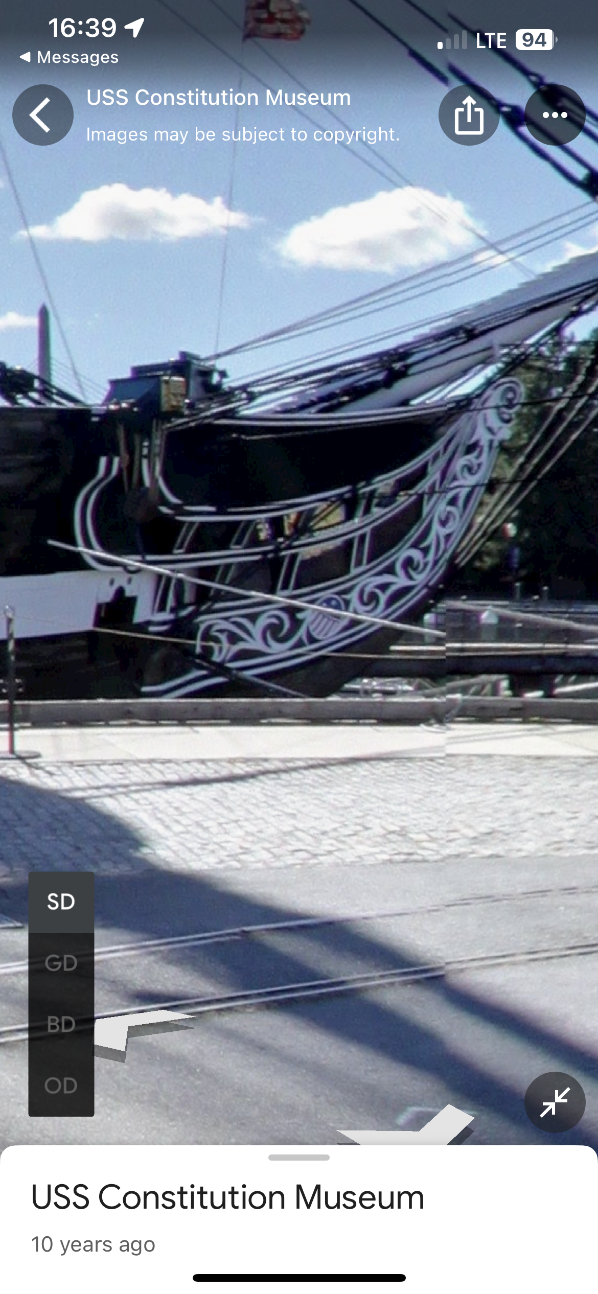

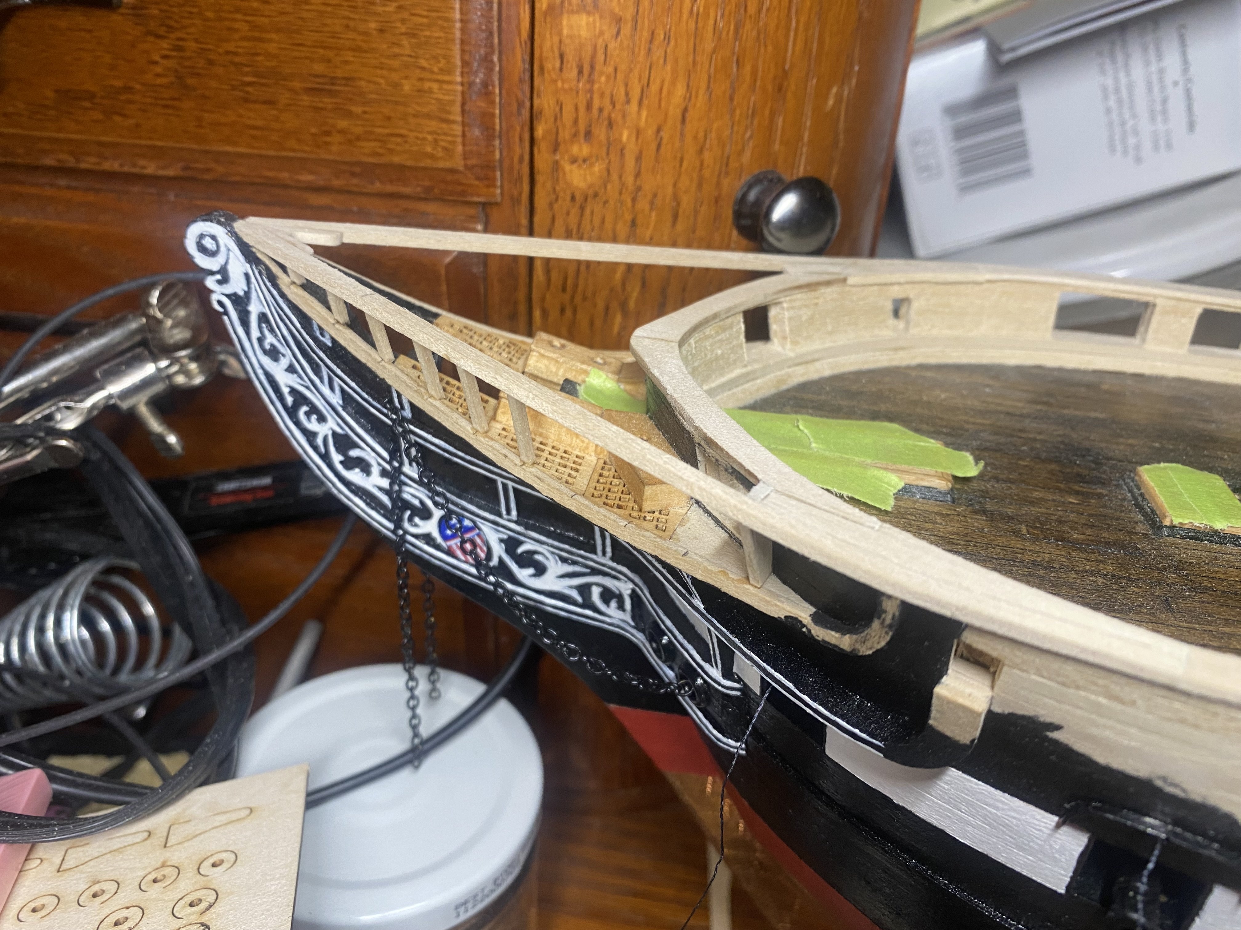

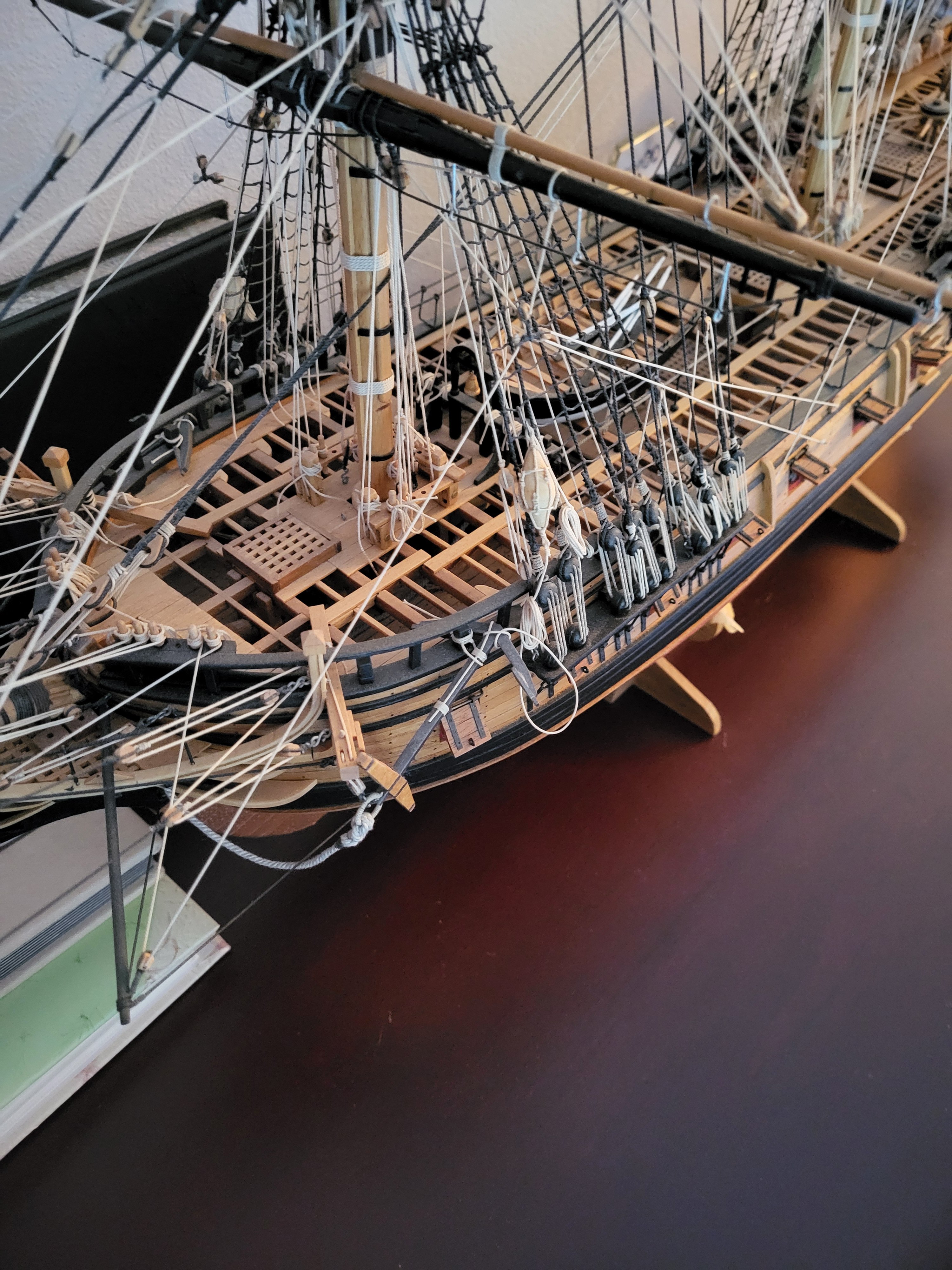

I went back in my phone and found you some more pictures if they’ll help. I seem to remember struggling with the supports a lot too!IMG_6446.thumb.jpeg.f798e0e5176fb99e3c3bbca23a37e96c.jpegIMG_6447.thumb.jpeg.03656c347823ecd531fff557f8766609.jpegIMG_6633.thumb.jpeg.4b413d3bdb757562000e78c13d18e7aa.jpegIMG_6634.thumb.jpeg.2b676e9cf4fb49eee28acacd6c8b0cfe.jpegIMG_6652.thumb.jpeg.2005e4a69386a56b497e801556c23f34.jpegIMG_6673.thumb.jpeg.3c0ba5167a99536f9734c2853edb3a0e.jpegIMG_4396.thumb.jpeg.da50662b64ec05513d9ffce3d7630ad6.jpegIMG_4654.thumb.jpeg.17db37ca5d33a1e296d949dac48a0e3f.jpeg4D9A7765-41C0-447A-92E4-B7C7B8DB91B0.thumb.jpeg.de5647850c05183ad805e812aafc624f.jpeg
I noticed that the 5th support didn't appear until after the rails were in place.  Also that 4th one was affixed to the stem, not in the corner, which seems to be the consensus view but contradictory to the plans, where 4 would be on the stem but touch the bow.
I've been trying to keep the spacing at the tops of those supports relatively even, hence my attempt to angle #4 at the bow.  I'll get continue to experiment with placement to find a solution that satisfies my aesthetic.

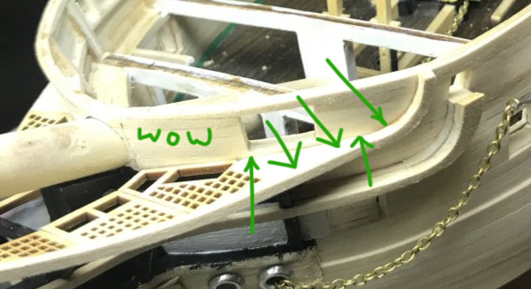

Thanks for the pictures, especially this one:    (Hmm, comparing yours again to mine, I think mine are too thick, perhaps adding to my difficulty).

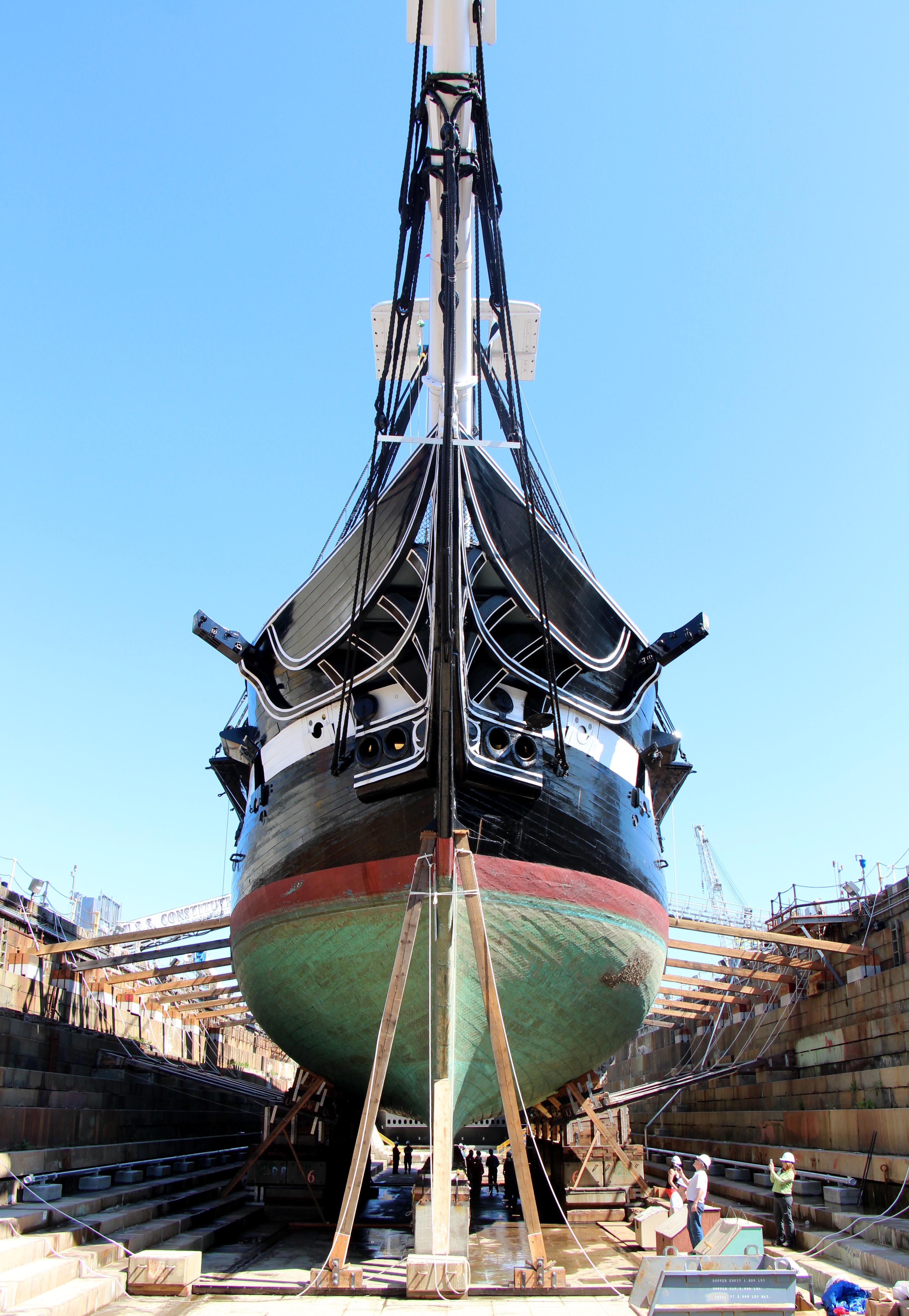

Hey, where are the fore tack bumpkins?  I checked your build log, and don't see it anywhere.   I checked the Practicum to see when Hunt installs them.  They supposedly  go between supports 3 and 4, but there's no evidence that Hunt installed them.
And these are noticeably absent in this photo, which, by the way, really shows off the supports!
This one is helpful in that it shows the relationship between the timbers (supports) and the grating.

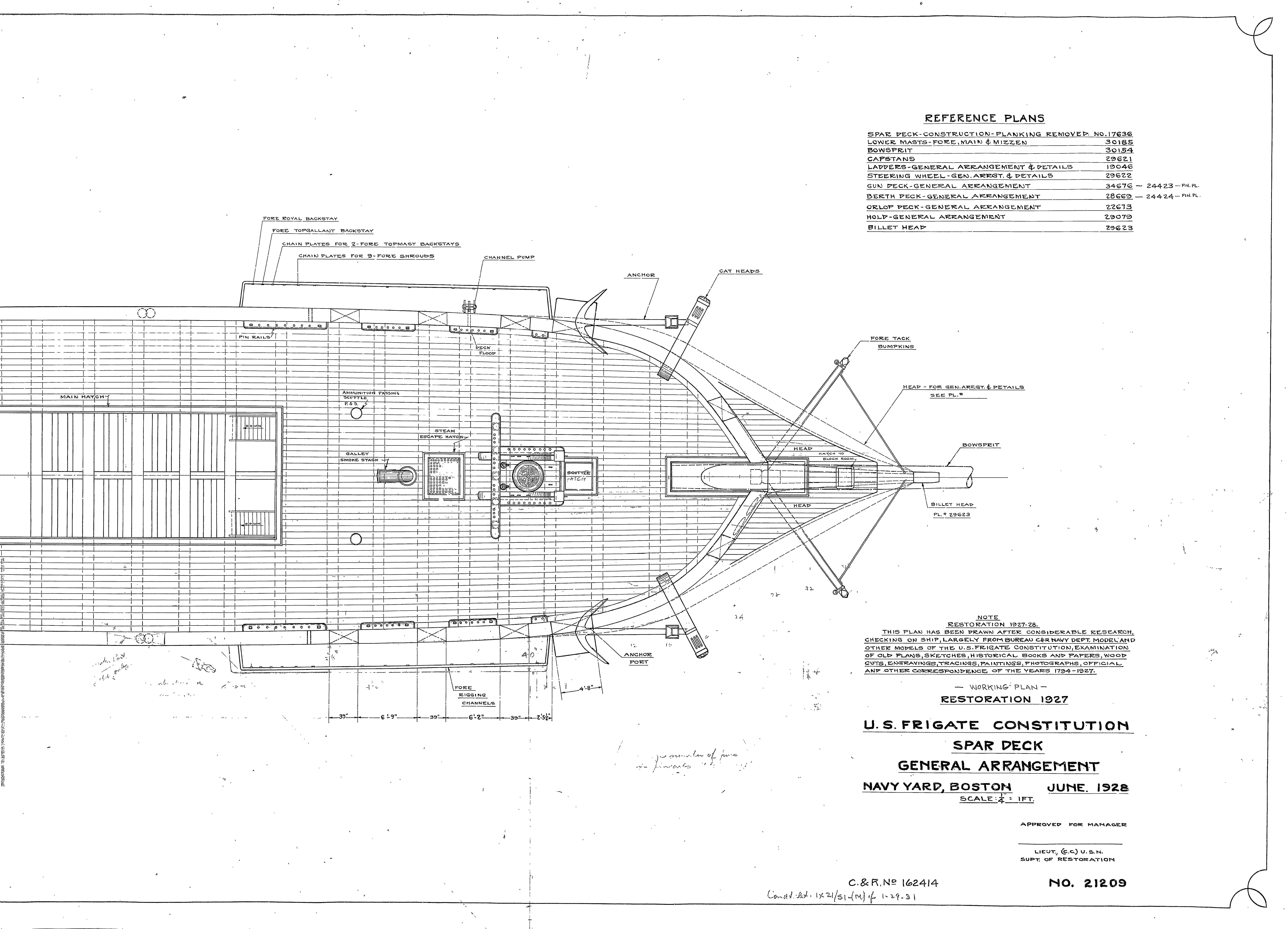

Turns out I have to agree with Hunt. The plans are wrong.  Using the top view as my reference, I found where the timbers need to align with the grates.  Those Timbers need to be forward of where the plan suggests they are in the broadside view.
I'll figure out where Timber five goes later.

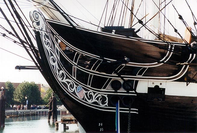

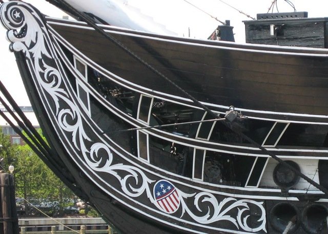

I left the bumpkins off on my model because at some point prior to 2015 they were removed. This may cause an issue for me later when it’s time to start my rigging. But, I’m hoping it I’ll be ok!IMG_8929.thumb.png.e659314641d5f31030ba1ca7c8d965e3.pngIMG_6425.thumb.png.1c65056ce5c85daf07b36dc6e1ca356d.pngIMG_7077.thumb.jpeg.076566a65c6e8e86319e469f66237cad.jpegIMG_6148.thumb.png.6dafd16f3048e24dcdf1fa49117be3a0.pngIMG_6348.jpeg.8090fd6fecc5645d30715e329df70ae5.jpegIMG_6680.jpeg.96774da1ab23f65a5bd4c60c4dc50b3b.jpegLooking at your bow and mine, I think my supports are too thin and yours are closer to the correct thickness.IMG_8930.thumb.png.4b8f5cfd0635ed1150794b29629a0f58.pngYou can also see in the instructions that there is a triangle peace of wood at the aft outboard edges of the grates on the bow. This is where I have my aft most support on my model. I believe you labeled that one #5. I also came to the same conclusion that #4,3,&2 line up with the gratings.
Here I thought the galleries were the most difficult part of this build to date.  I've been back and forth between the shipyard and my PC to try to formulate a plan.  I really would like to install the timbers/supports first so that shaping the rails is easier.  I'm still going over build logs.

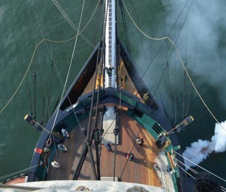

I think the fifth support, the stern-most one (Hunt numbered them 1 to 5 from the stem), is angled slightly to the stern.  My goal will be to try for even spacing along the upper ends where they meet rail 2.
I did fabricate a rail 2, out of 1/8" square stock, and using my trusty plank bending iron, managed that compound bend.  Unfortunately, it appears to sit too far inboard and doesn't leave enough room for the grating. Back to the drawing board to see what's what.  It'll have to wait until Monday though, as family obligations will occupy most of the rest of today and tomorrow.  Six years?  🤔
The more I look at the photos of your build, the more convinced I am that you nailed it in terms of the supports.
And this one helps me tremendously to visualize where the grating placement needs to be.
On the bumpkins:
I just checked page 7 of the plans, which shows the bulk of the rigging.  I see the bumpkins, but don't think anything is rigged to them.  That it didn't occur to me to look for them in the actual photos of the Constitution, is a clear sign I need to worry about early onset Alzheimer's.    😁
And for what it's worth,
I have a blowup of this view pinned up near my work bench a reference.
That's where I got the notion the spacing should be even between the supports.
I wish Conny wasn't painted black.  It would be so much easier to pick out details in photographs.
Oh well.
Thanks again, Unegawahya

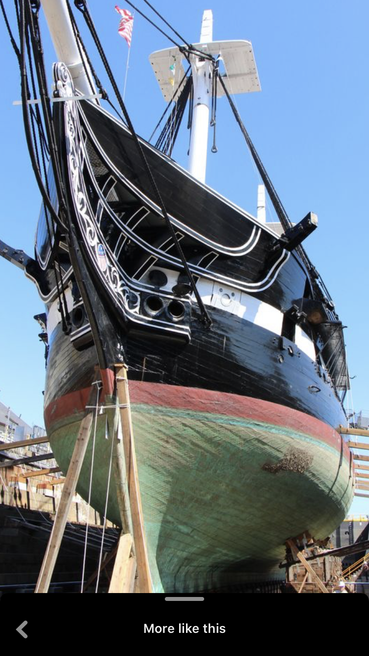

Here are a few images of the bumkins (boomkins?) and the 1927 plan of the bow clearly showing them, should elect to install them. I did on mine.
Jon
a-bow-view-of-the-historic-44-gun-sail-frigate-uss-constitution-moored-at-the-6c69ab-1600.jpg
32 minutes ago, JSGerson said:
bumkins (boomkins?)
I picked up the spelling (bumpkins) from the plans that came with the MS plans for Conny.
Even in the photos you supplied above, there doesn't appear to be any necessary rigging associated with them, so, I remain on the "I'll pass" side of the argument.  I'll leave it to you and Unegawahya to settle this hash..
By the way, I wonder if it's going to take me as long to memorize the spelling of Unegawahya's name as it will to finish this model..  🤔

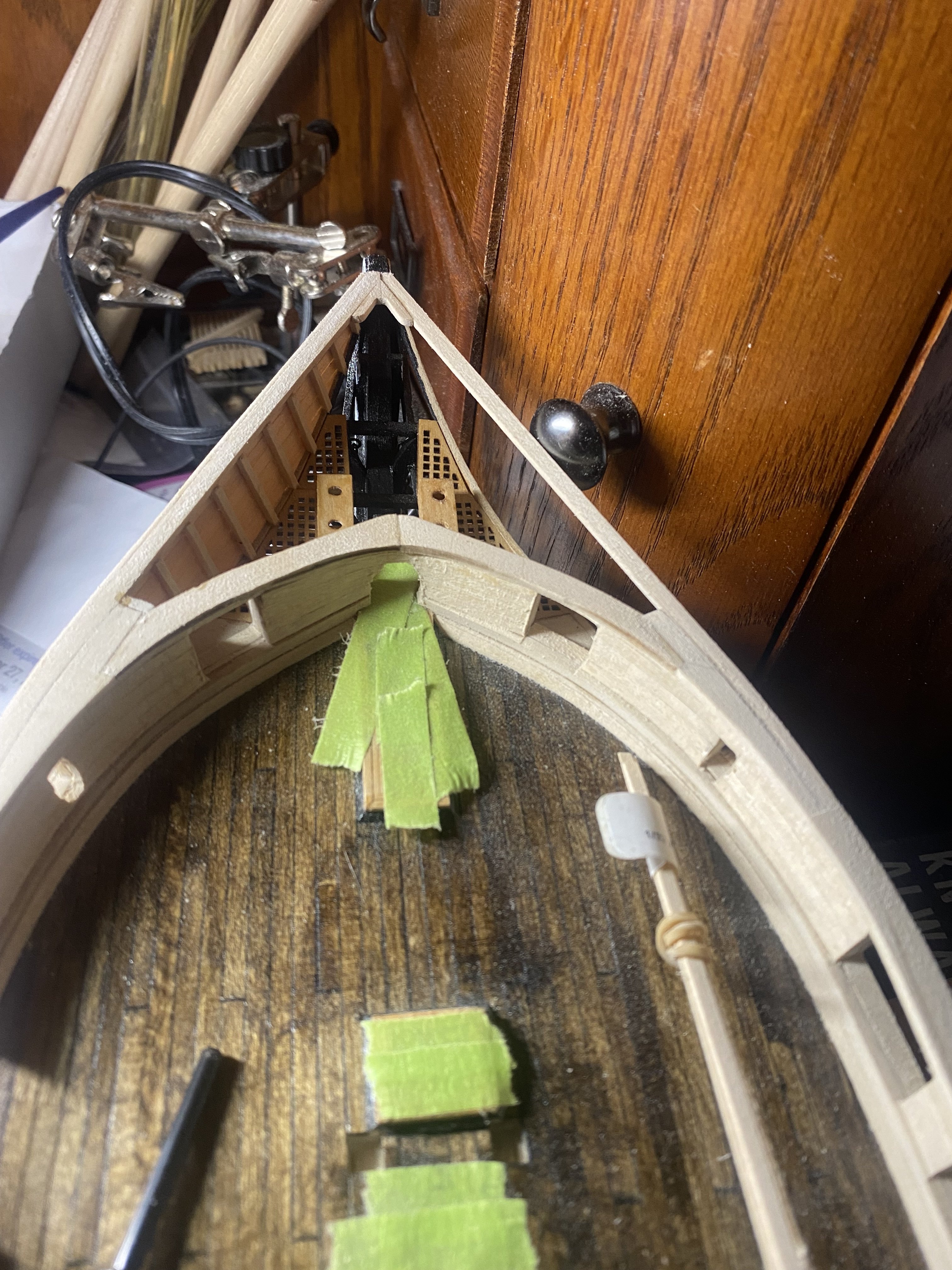

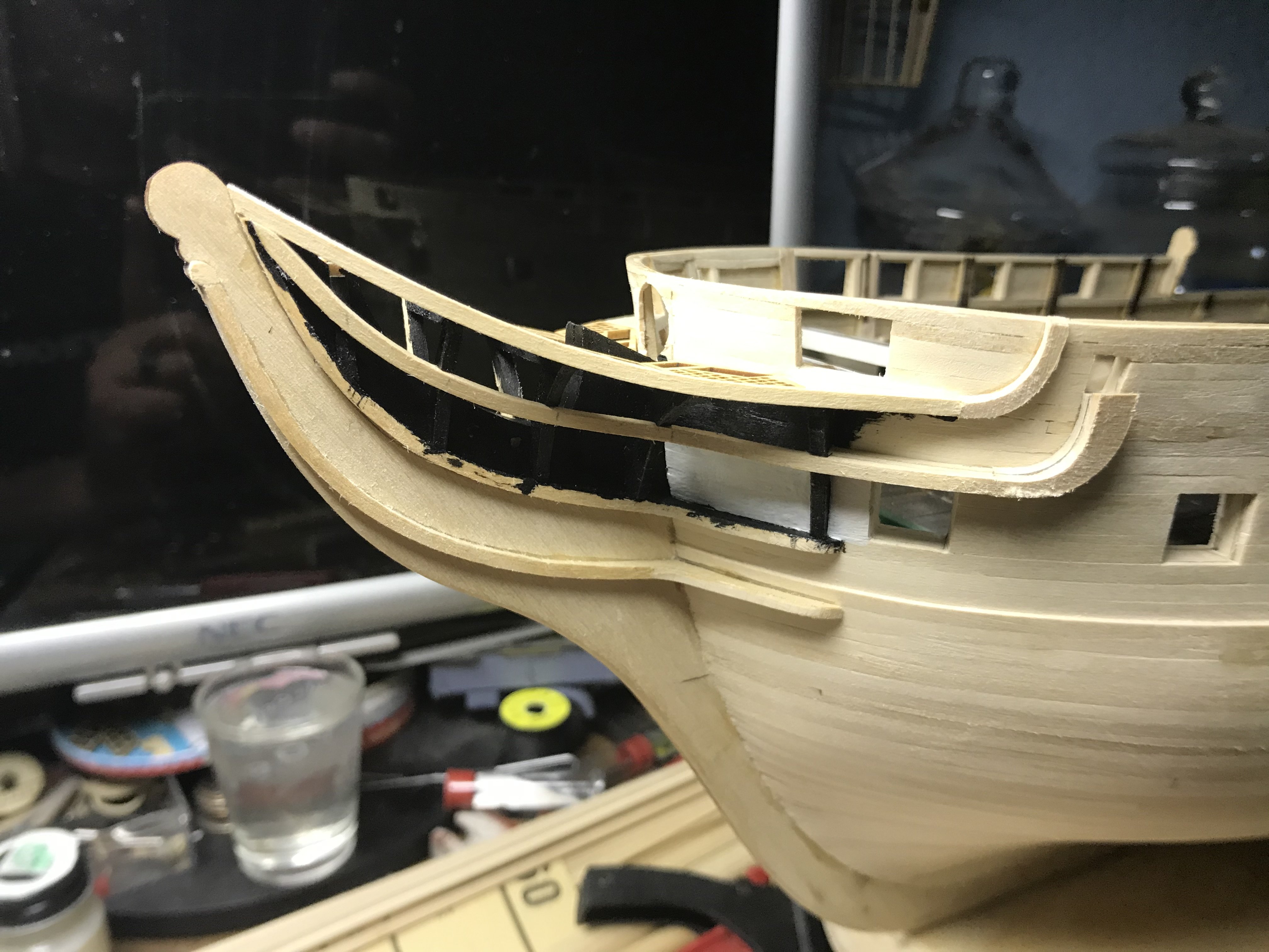

Okay, I did manage to sneak away for an hour. Here is the result of my latest round of head scratching..
I can't imagine that the "poop deck" 😁 would have been severely angled, so I'm assuming a more horizontal aspect, at least for the first two sections of the grating.
Shall I work the supports around the only solidly accurate portion of the plan?  The grating?

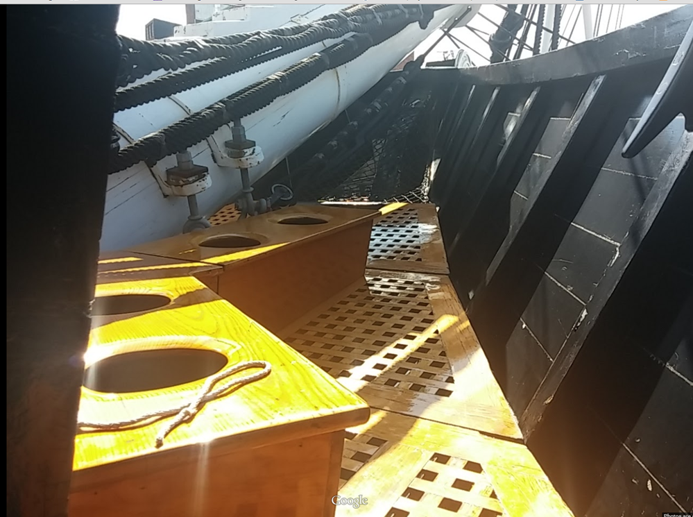

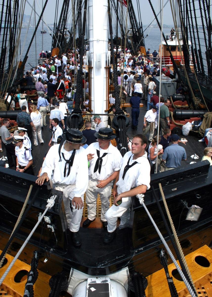

Jon, in your enormous library of photographs, do you have any that show the comfort station from let's say the bowsprit toward the head access in the hull?  I want to know if the grating is more or less parallel to the water line. Or if everything is tilted slightly upward from the hull toward the bowsprit.
This is all I could find on the subject..
This is where I'm at.

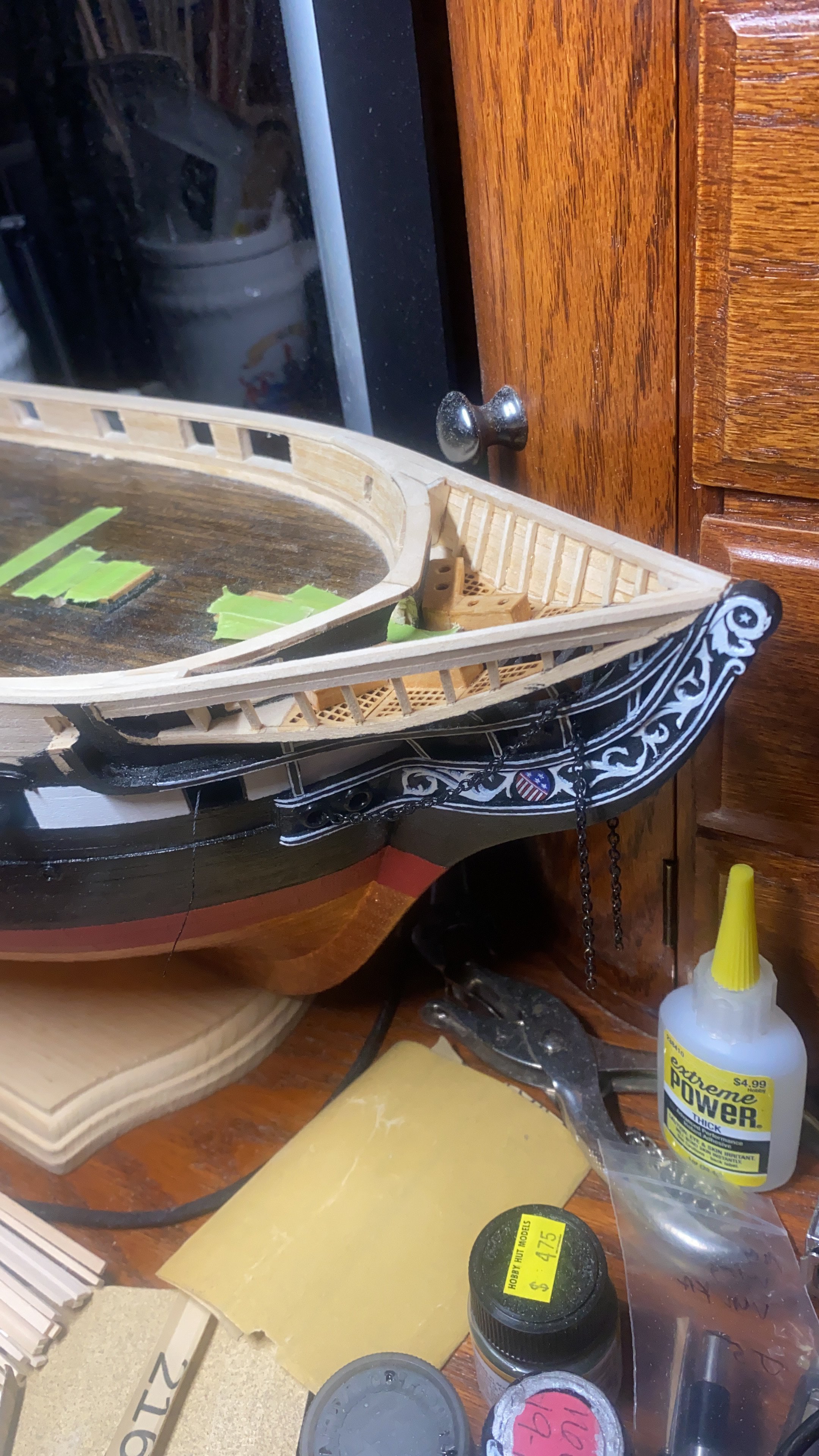

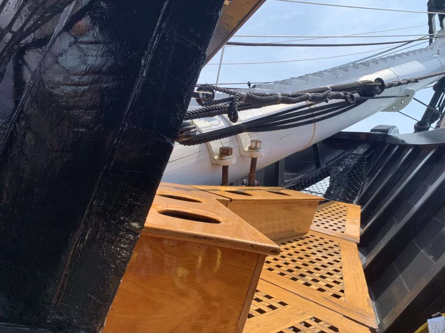

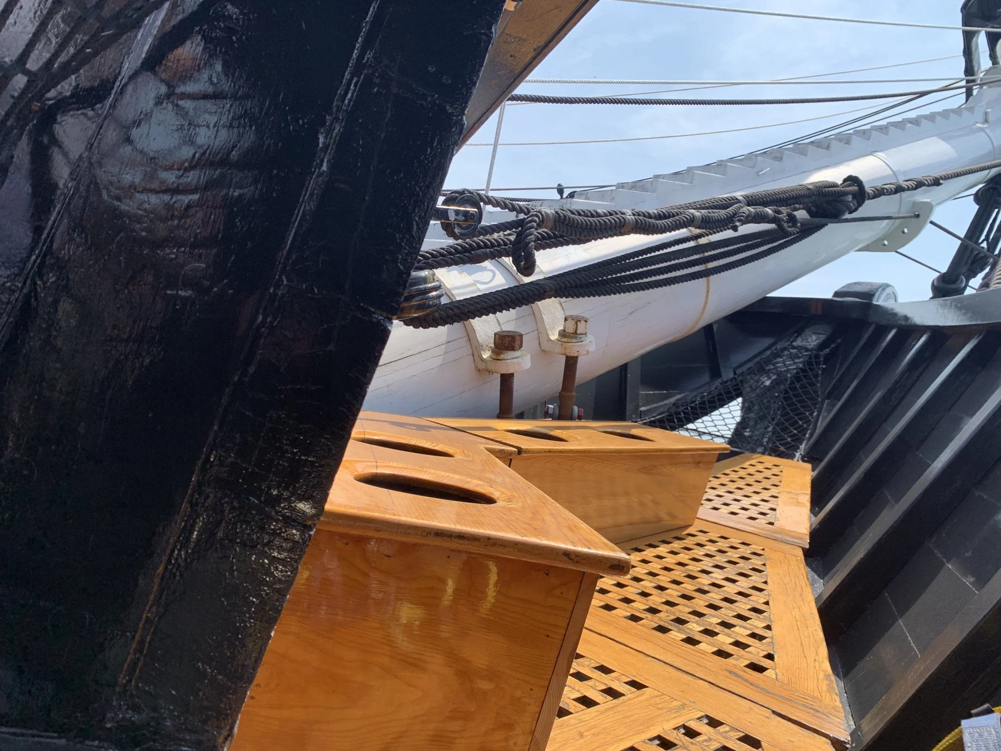

I found the picture that I saw a wile back! But, I’m not going to pay $40 for a digital picture from Alamy! This picture looks like it may of been taken at the same time as the overhead one. It’s from on top of the bowsprit looking aft at the salute!
USS Constitution bowsprit looking aft.IMG_8946.jpeg.a60a74ba3ea1627e4a3f053edc0e29c1.jpegIMG_8945.webp.c4c302fc0d4f6ae5bde63b3cfb591d5f.webpI was also able to find these different angles for you too!
It may be the way I was looking at the grates, but they look to be sloping up a little as the got forward. I’m also thinking that my gratings may slope up a little too much?
The Constitution's seats of ease are some of the hardest images to find. That's because that area is off limits to the general public and is block from direct view by the forward bulwarks. I know this, because I tried to take photos of it 2015. But over the years, I managed to accumulate a few passable but not great images.  My photo below is of the port side where the grating is covered, The images of the grating on the starboard side were taken by others.
Jon

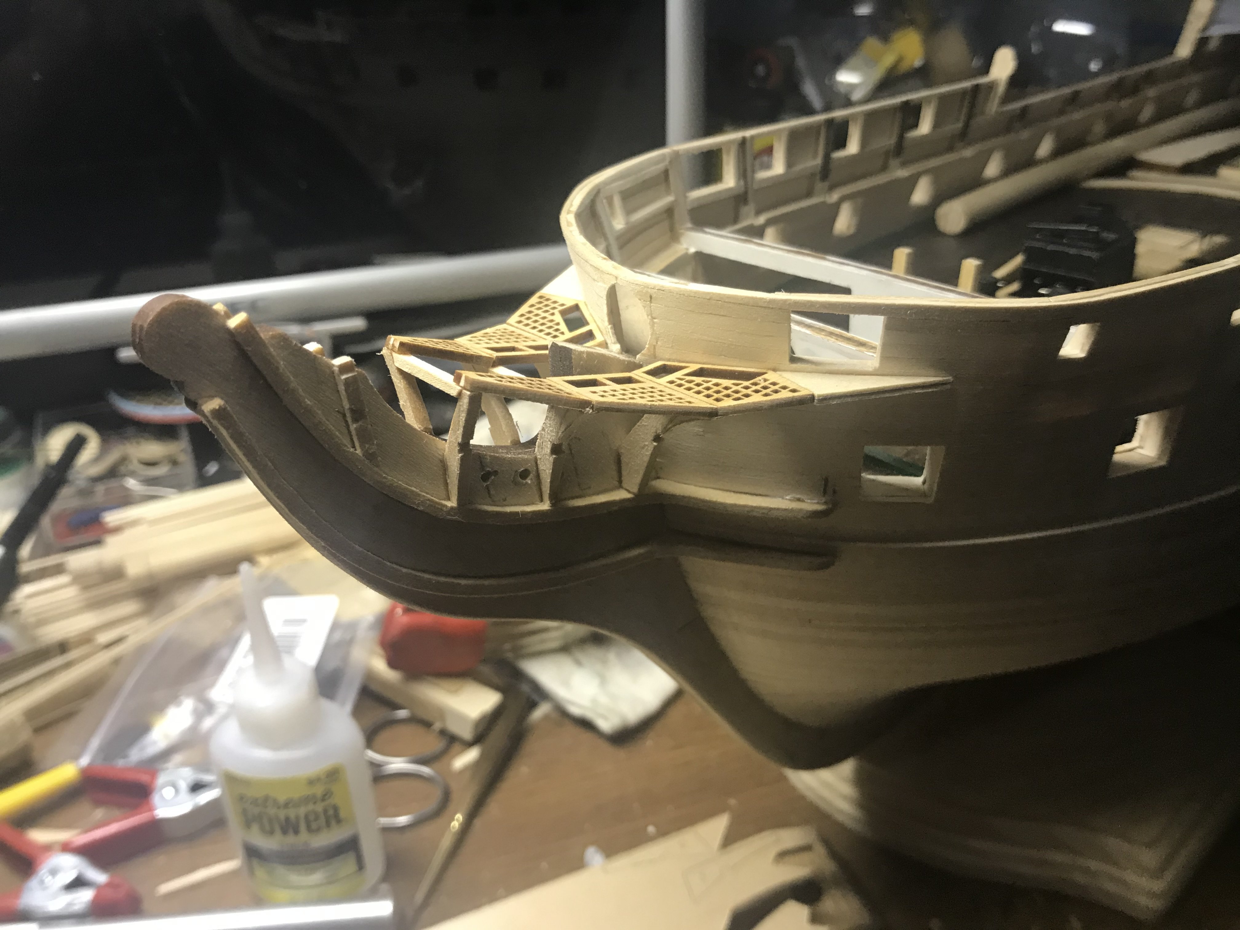

I found another hour or two of Shipyard time today.  (Trying to keep up with Mustafa..)
The experimentation continues. Nothing is glued together permanently yet, except for the head and two portions of the grating.
What I have discovered through this process is that the plans for the supports seem to be off as well. I had to shave quite a bit of material off the top of posts four and three. If I continue with this methodology, I will copy those shapes to boxwood before gluing anything permanently on the starboard side. This way I can come close to the right shapes as a starting point for the port side.
One difficulty for me will be that I've got to stain the supports before I glue them into place. So I'll have to be darned sure I'm happy with the configuration first.
And good luck with THAT🤷‍♀️🤣👍
Honestly, Peter, speaking as the odd man out from where all you guys are currently that I'm following on your respective Constitution builds, but...   your bow area has looked awesome to me.  Keep doing well, sir!  I'm anxious and excited to get anywhere near this point.  Carry on! 🏆
Gregg
Okay, I think I'm committed now. Or maybe I should be.. 😁
The supports will come before the rails.
Everything right now is just tacked in with the smallest dots of super glue.  Before I make anything permanent, I've got to shape, stain, and carve out the grooves for the rails.  I think once I get the grates attached to the supports and the cross beams, the entire structure shoukd be solid enough that I can tweak those grooves a bit as needed when I get to the rails.
P.S. to those who suggested that the cat heads would hold up to jostling once glued in, I beg to differ..
