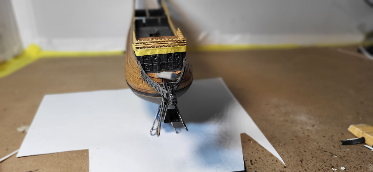

The next project is this vintage 60's Airfix kit # 1908-400, this looks to be one of the first releases molded in black. This model is void of any planking so I'm proceeding with scribing in some above the waterline only, I'm not too concerned with the remainder of the hull as it will just receive some texture using 80 grit and be finished with the tallow coating, also another area in question is whether or not I want to create the round tuck, but I still have time to make that decision . Thanks for looking.

Thanks for chiming in, I am indeed going with the round tuck as seen in these preliminary mock up pictures, I think I'm pretty close but not sure if the angled planking continues up into the gun port area? my thinking they are horizontal in that area.
Michael D.
With some of the railings needing work I started with the Qtr railing first, once again trying to bring it more in line with Paynes painting, with just a few cuts and moving it aft, a majority of the original railing will be used with just small section needing to be fabricated at the break of the Qtr deck area.
Michael D.
You are off to a smashing start, Michael.  How's the condition of the plastic?  Do you find that it is at all brittle or still pliable?  As for square vs. round tuck, I think it likely that she had a round tuck.  Your mock-up looks spot-on.  Planking across the aft-transom ports should be horizontal, though.  The tuck planking ends at the wing-transom.
