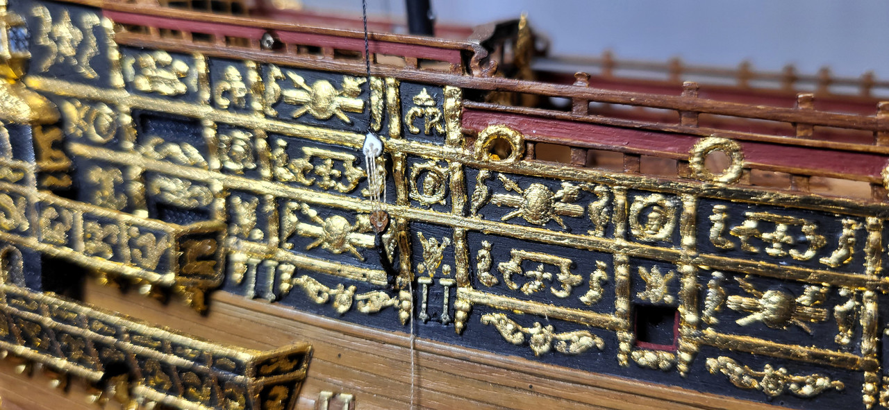

I haven't had much time for my S.O.S lately with home renovations going on but figured I'd post a small update, the catheads are finally completed and currently working on the starboard fore channels, the deadeyes measure out to just under 2mm and are stropped with thread, the chain plates are flattened 28g copper wire, the assembly process as follows, with the channels off the ship I'll glue the deadeyes into the notch and fold a short pigtail of the strop underneath and glue, next secure the channels to the hull and feed the chainplates for the tackles thru the channel from the top and secure with a length of copper wire to simulate the bolt/spike then cut somewhat flush with a cuticle cutter and lastly the deadeye chainplates with the bolt already attached will be fitted into the hull and the upper part will be glued into the remaining notch covering the deadeye strop. Thanks for your continued likes.

Slow going on the fore channel but happy with the results thus far. After the wire is flattened and the bolt glued on and trimmed, I set it in the hull and bend it up against the channel then mark the cut line with black paint, cut and test fit, then paint and install. Thanks for your continued observation and likes. I had mentioned in the last post the size of the dead eyes which equates to 13" in dimeter at scale.

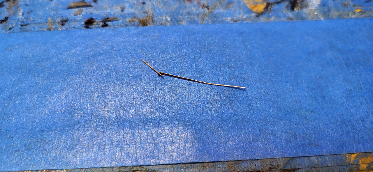

The installation process for the tackle chain plates are different, I gave an explanation earlier but here's a visual to go along with it, the chain plate is led through a slot in the channel from above and the bolt fed through the hole and glued, then feed the bolt into the hull, as with the other chain plates I find no need to glue into the hull as the hole is drilled in a upward angle, the bolt is usually 1/4" to 3/8", snip off the extra with a cuticle cutter and touch up.

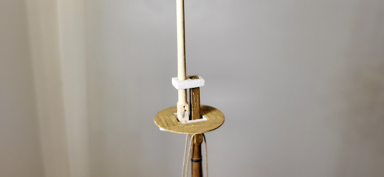

I've completed the fabrication of the topgallant and royal masts along with the associated top bases, these measurements are taken out of John McKay's book, this is all still in a very rough in stage at this point, fabricating the rest of the topgallant top will be especially challenging as the base only measures out to 8mm in dia = to approx. 4-1/2 ft at scale.

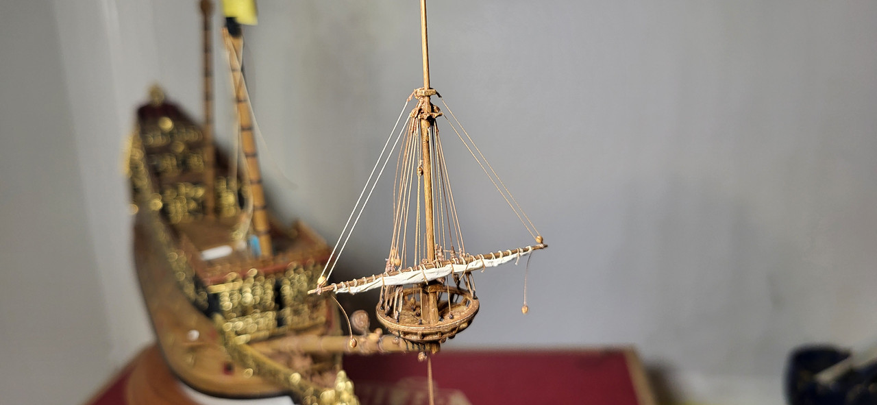

About 90% of the fore mast tops are complete with some detail sanding still left to do along with dead eyes, eye bolts and painting. On top of all this I still need to fabricate the trestle tree and flagpole, considering the scale I'm working at I think they look pretty good.
