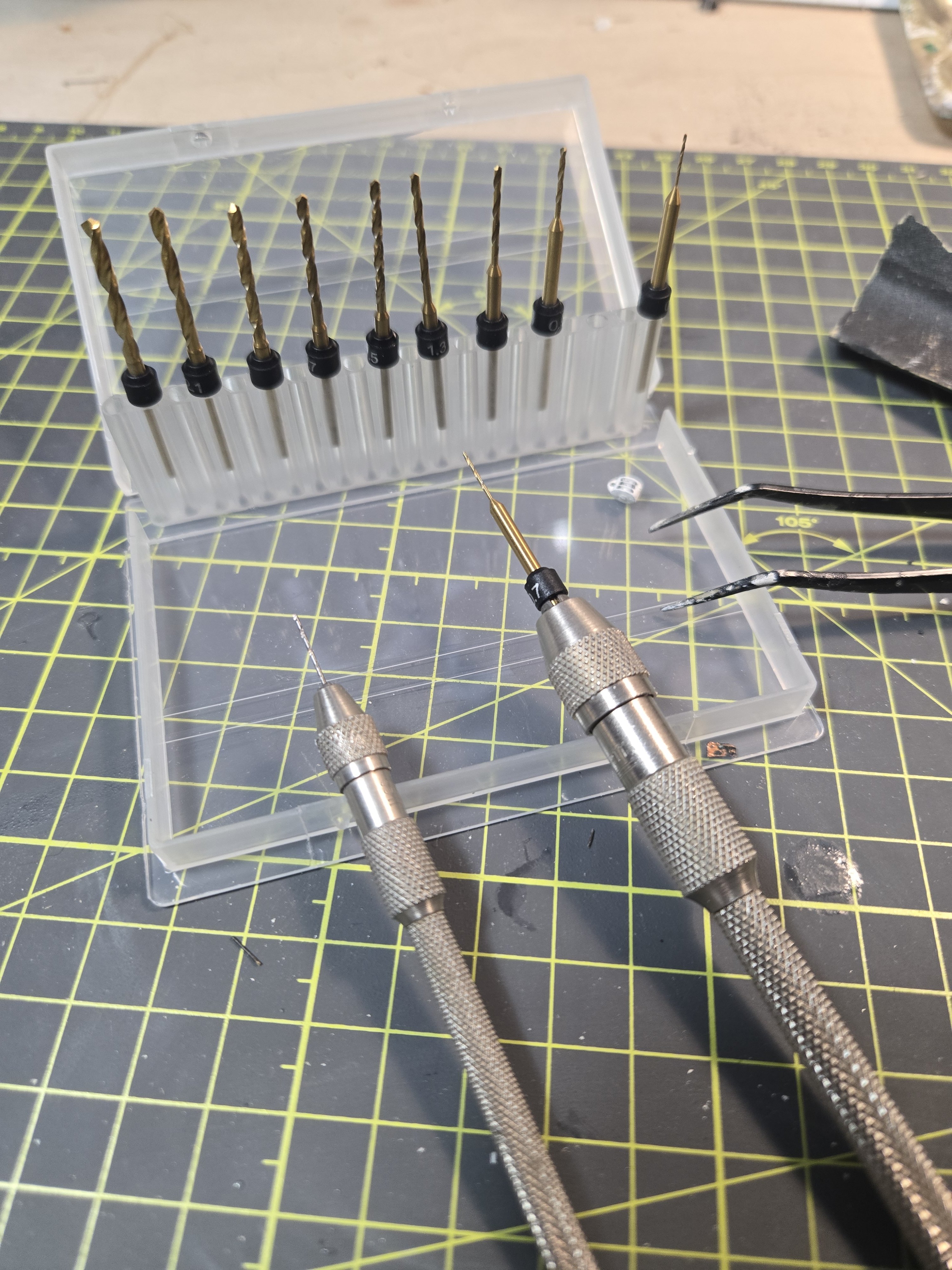

I use DSPIAE drill bits for must projects, very impressed with them. I'd also recommend their tools as well.
