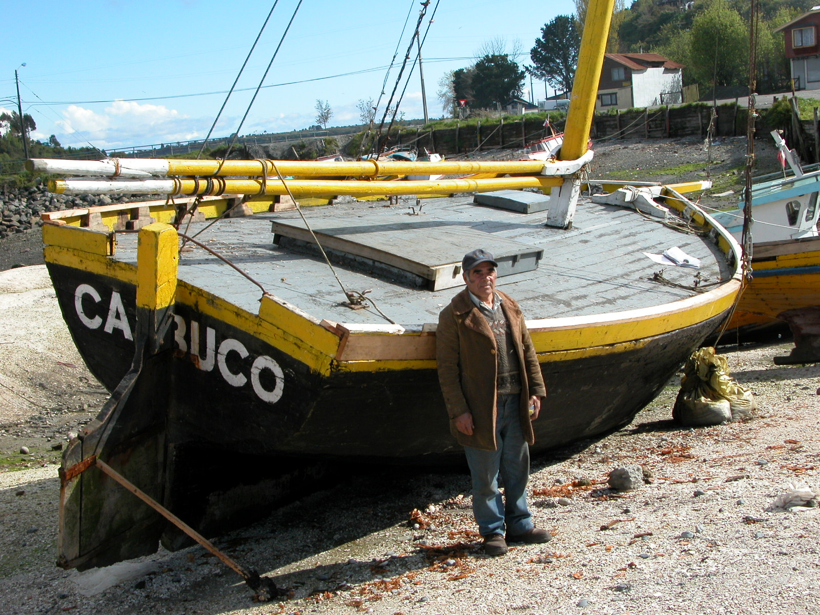

I'm continuing research on the lancha, and wanted to share an interesting site I saw several months ago, then lost the link to, and then found again today. Carlos Pedro Vairo, an Argentine maritime ethnographer, documented the lancha chilota for a 1986 article in Navegar. (Available online at: https://issuu.com/museomaritimoushuaia/docs/chiloe ) Not only is the article a useful source, but his website also includes a large number of color photos documenting the final years of the lancha. These will definitely be useful images going forward, showing a lot of details otherwise little documented. For instance, one image below shows the cramped quarters crammed in the bow (leaving most of the hull for cargo space) and the brazier that was almost always kept burning while under way to keep warm against the chill. (One wonders how many lanchas were lost to fire). Other images, like the second and third below, show details of the rigging. And still others show details of lanchas beached for loading and unloading, as in the last photo. The photos are fascinating and worth taking a look at.
Site Link:  https://www.carlosvairo.com/galeria-puerto-montt-lanchas-chilotas

Very nice photos Jacques. It’s always interesting to see how crews rigged their boats.
Best Regards……..Paul

Thanks, glad to hear I'm not the only one in this boat (so to speak). There's such a variety across small boats. The plans didn't look like too much camber on the page, but now seem a bit excessive. At the widest point in the hull, the model has a beam of about 12 ft 8 inches (4.75 inches at scale, and not counting hull planking), and a camber of about 7 inches (7/32 inch at scale). I'm considering whether I can just add a 1/16-inch shim at the edges of the bulkheads and not throw off the sheer line too much.
Thanks, definitely! There's clearly quite a bit of making do with what they had. For example, this photo shows some of the details on the shrouds, which the plans show as just attached with turnbuckles.
Source: https://www.carlosvairo.com/galeria-puerto-montt-lanchas-chilotas
Instead, the first two shrouds have turnbuckles down low, followed by, in one case, a length of wire that hooks onto what looks like a thicker wire for the shroud, and in the second case, what looks like a shorter loop of wire attached to the thicker wire. The last shroud doesn't seem to have a turnbuckle, just several lengths of wire hooked and looped together. It's also notable that the running rigging appears to be white and green.
Photos from earlier, like the one below from 1956, also show complex rigging arrangements.

From what I can tell, the foremost shroud has a turnbuckle low down, a big knot or something connecting it to what looks like length of multistrand twisted wire, then a big knot connecting that to what looks like a single deadeye or something similar (a heart?) that connects to either a wire or rope shroud. The second shroud, in contrast, has what looks like a big metal hook low down, with a shroud looped on to that.
Photos like these really highlight that these vessels were made and used by people with limited access to resources in remote areas. Rigging, and repairs to it, had to be made with whatever was available that could be made to work. When it comes time to rigging, I'll have to consider to what degree I want to follow this.

I also realized, based on photo evidence, that the bottom of the stem should be rounded rather than sharp (as shown in the plans). This was easily done by sanding.
I also started on the garboard strake, using chart tape to lay out its shape after determining that I would go with a maximum width of 1/4 inch. Determining its shape is quite challenging due to the 90-degree twist, especially aft where the deadwood complicates matters more.
I ended up adjusting the aft end further from the photo above. The fore end also was a bit tricky--I didn't want to make it rise too high, but the low fore end shown below turned out to be less than half the width of the widest point, so I had to slightly raise it.
The overall line seems all right now.
