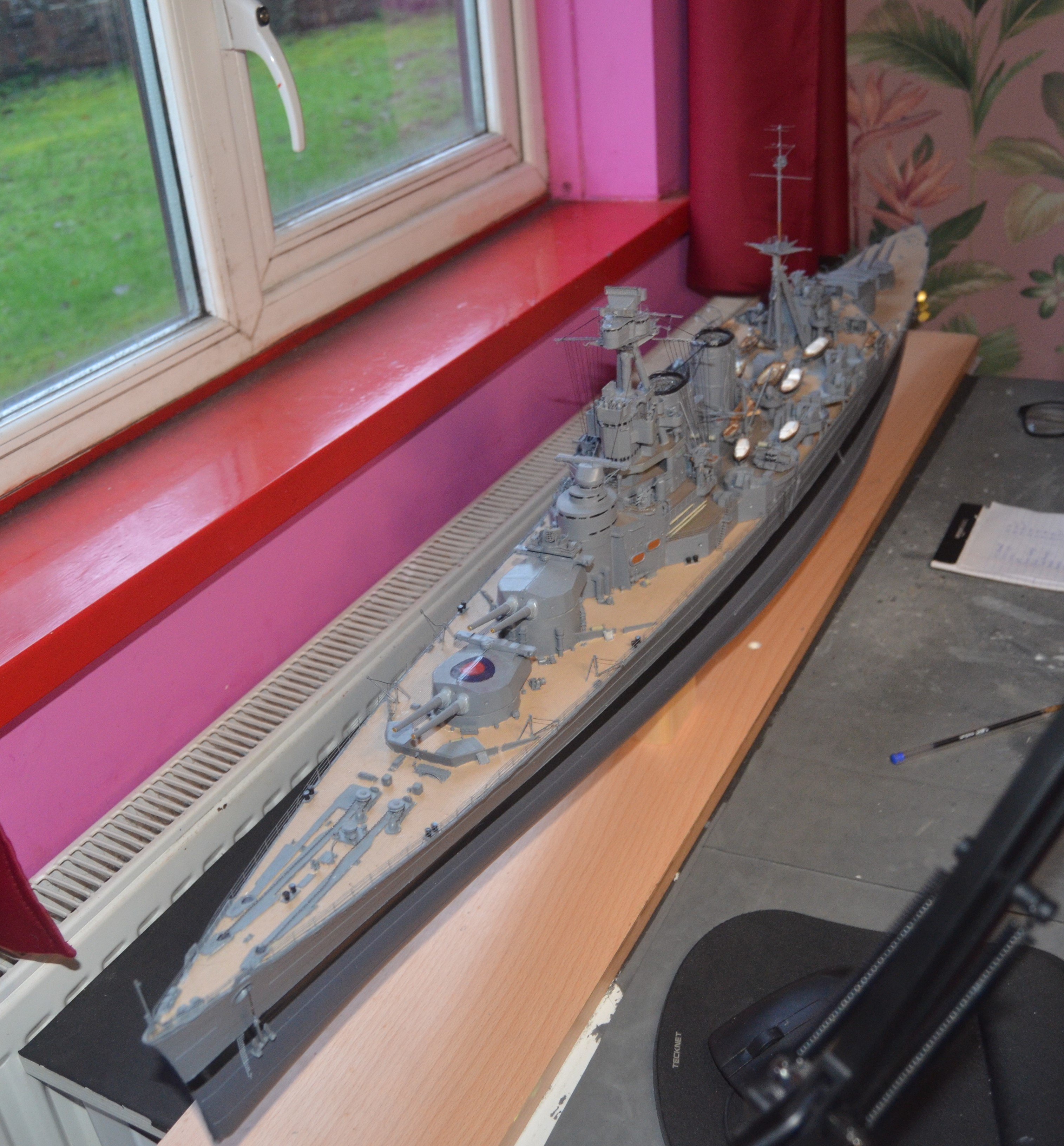

Working on the 4 inch guns. there are seven of these to make up. luckily there is one extra in the kit. Which is good as the first try was not very good. The problem was the PE walls. They touch the roof of the shield if not fitted exactly right. So I found it better to use the plastic walls that I've sanded down. This allows the gun barrels to be held in place correctly and they can be moved up and down. The PE walls are then installed and glued against them. there is quite a bit of PE I have not added simply because it is so tiny that it can not be seen once the gun is put together and painted. Cutting the plastic barrels off and adding the rolled metal ones was the most time consuming part. drilling the holes out in such a small piece requires a bit of patience because of how small and deep the holes need to be to except the rear of the barrels.
The pictures show the gun as built out of the box, which does not have any PE to add to it. The others show the PE to be added and how the gun looks with the extra bits added. And the plastic parts cleaned prepared and ready to be made up with the added PE for the final six guns. And how the model is looking at present. I thought there was something on the TV screen and was trying to clean it up before realising the camera had picked up a tiny bit of fluff on the tip of the gun. As always the parts look way better when viewed normally.

The guns look quite a challenge. Great work
alan
Thanks alan,they certainly are. Should look better as I go. If Iadded all the PE there would be around 40 extra parts to add. After these are the 3 pompoms and they look even more challenging.
As I've mentioned before, the next few kits will be out of the box builds using the kit PE rather than buying an upgrade kit. Even though it does lmprove the look so much better.
Paul

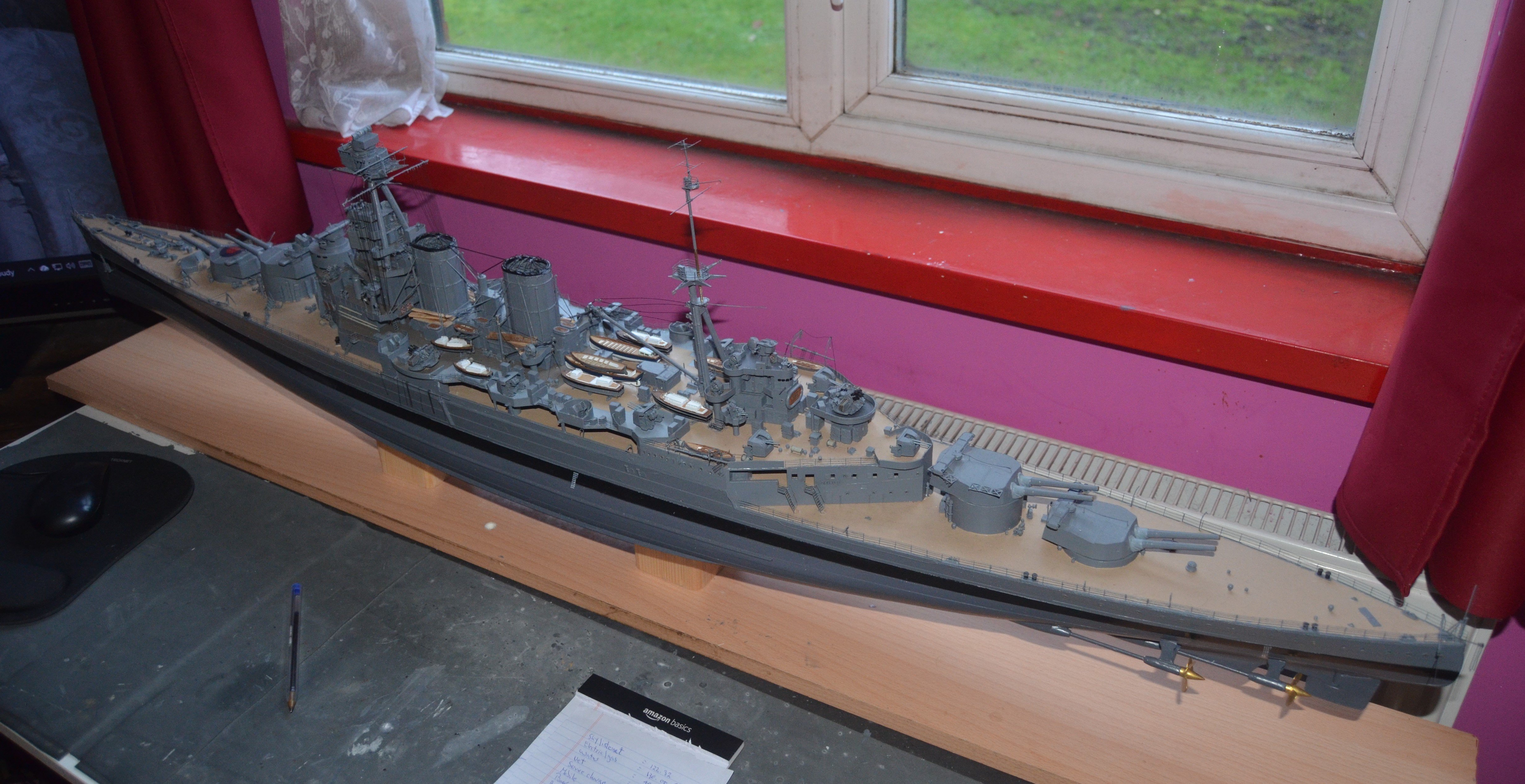

Have got all my models displayed in one place rather than randomly displayed around the flat. The right hand side will eventually have the Hood, Bismarck, Prinz Eugen and Prince of Wales on display.

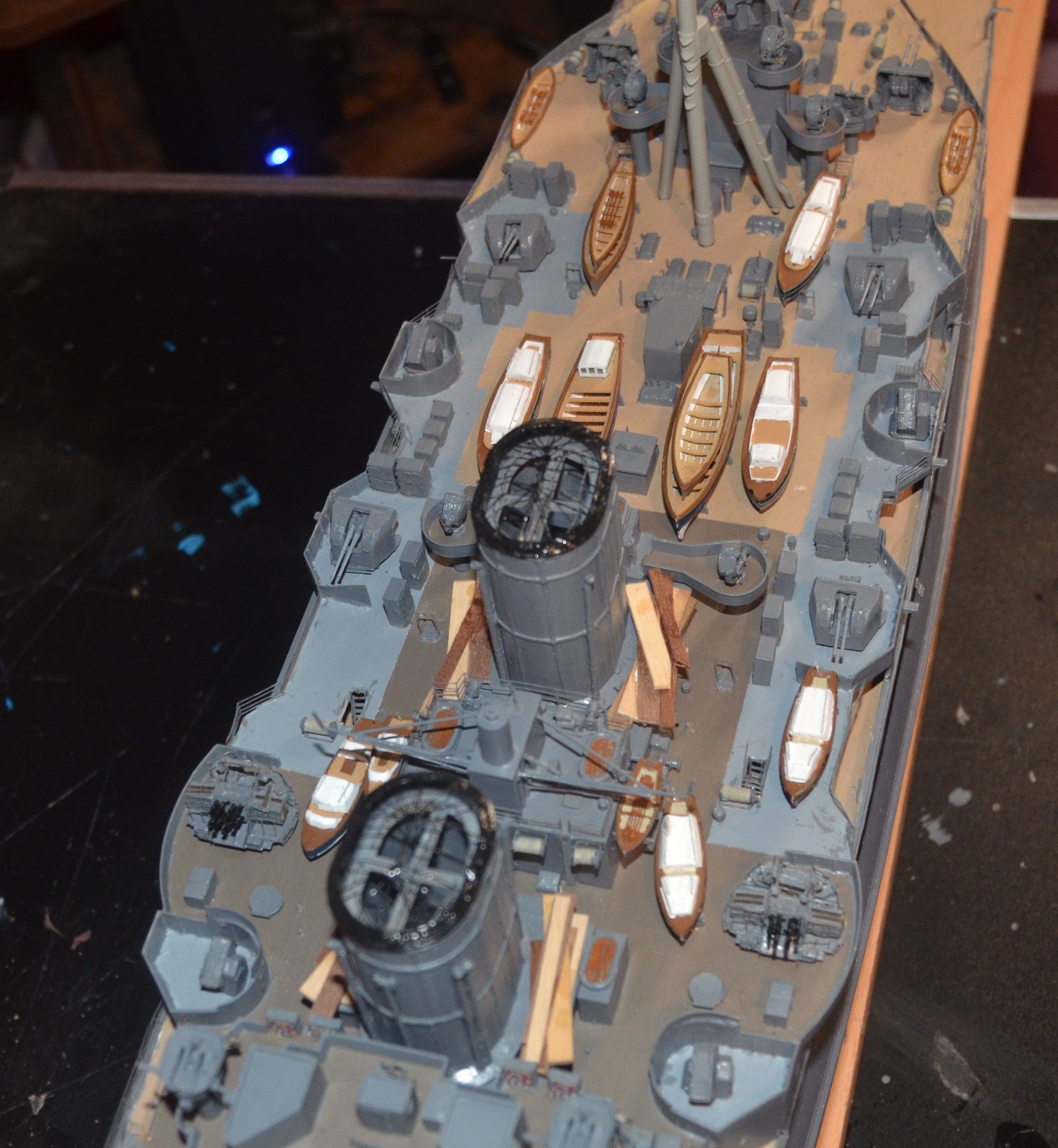

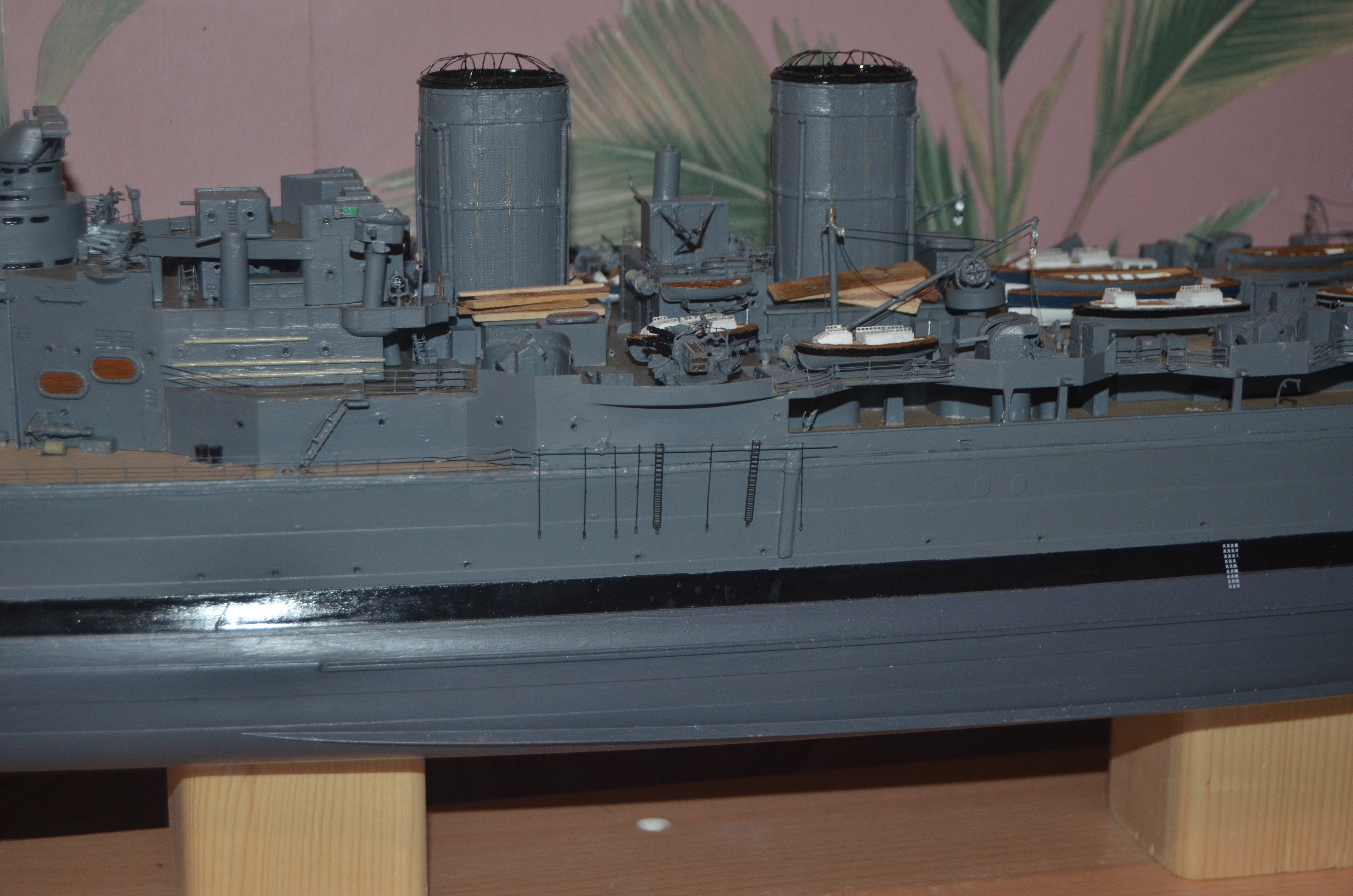

Double checking through the instructions and I had omitted one small detail. There are various ladders going down from the deck which I had fitted. For some reason I forgot to add the hand rails and have now added them. Luckily I managed to add them in the cramped space on the deck and only knocked one very small part off. I have also added the lumber to the funnel bases as suggested on the HMS Hood web site. Also have been adding various hand rails around the hull. All the guns and rocket launchers are in place. I am adding various details to the deck before starting on the ships boats then the bridge and masts.
I will also have to make a decision on the ladders going down the hull. They where dismantled and stored when at sea. And I have to admit I don't like them as they take away the sleek lines of the hull when the model is displayed. I may add them on the side that will not be seen once displayed and decide if I like them or not.

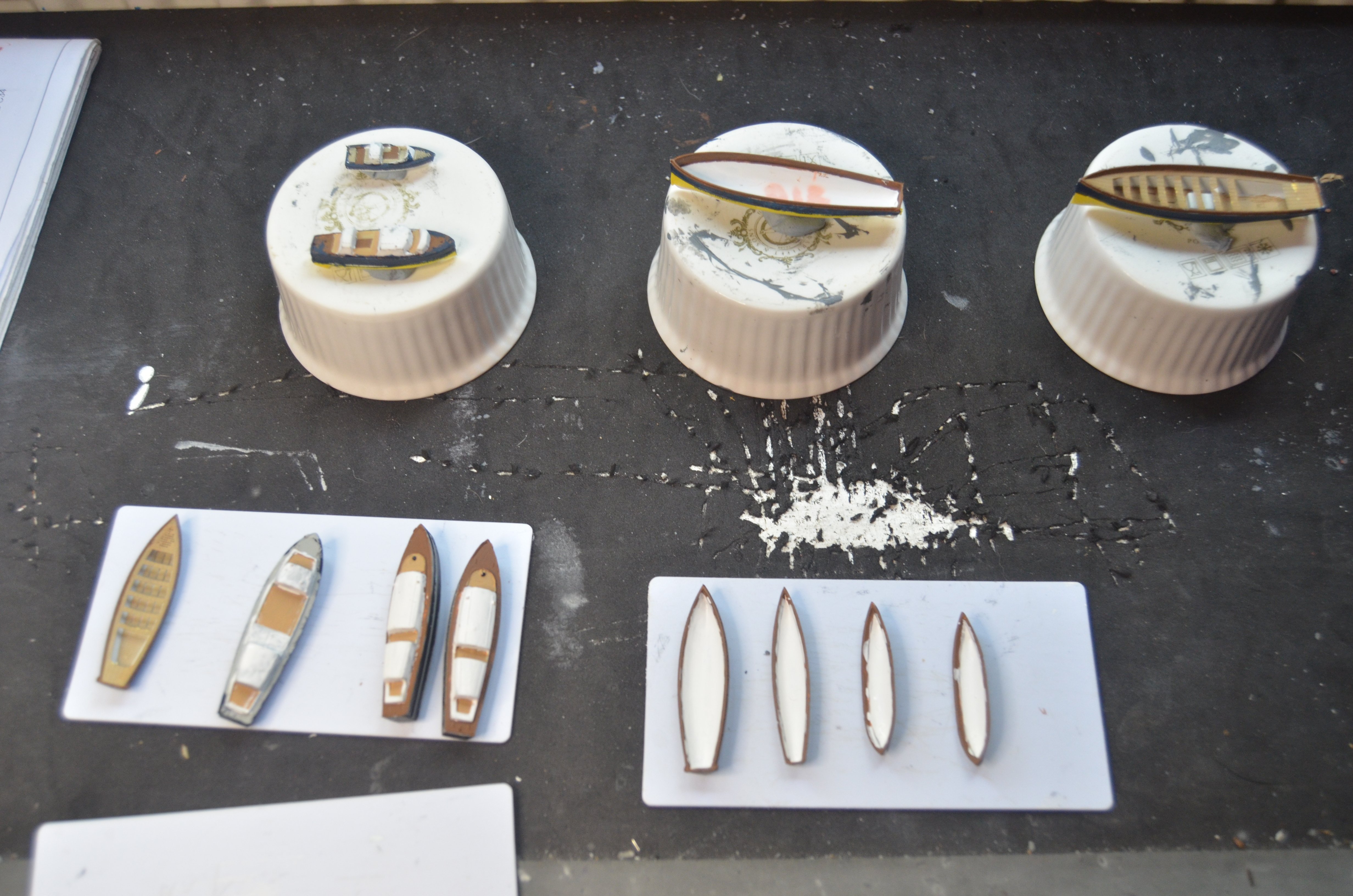

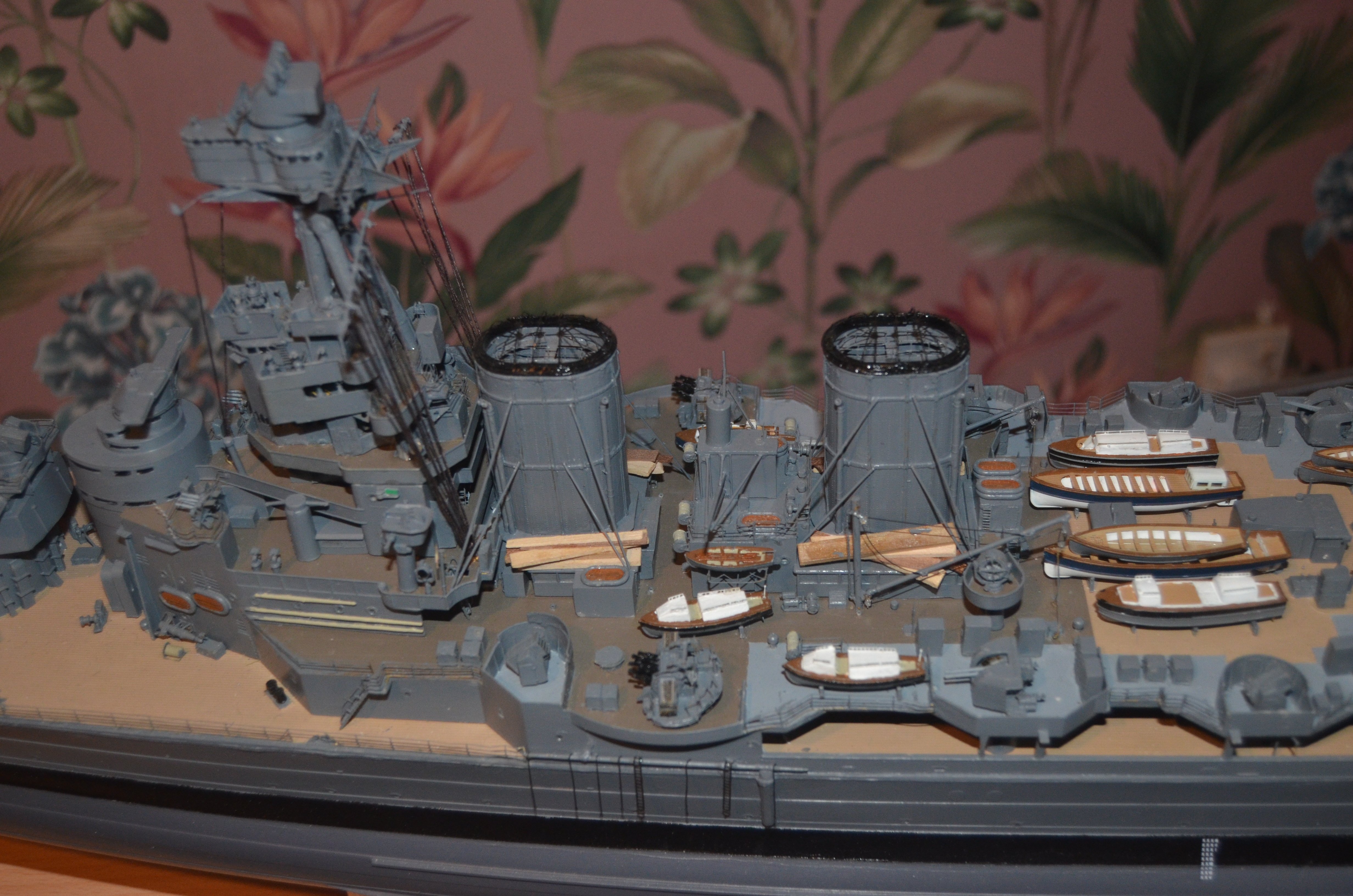

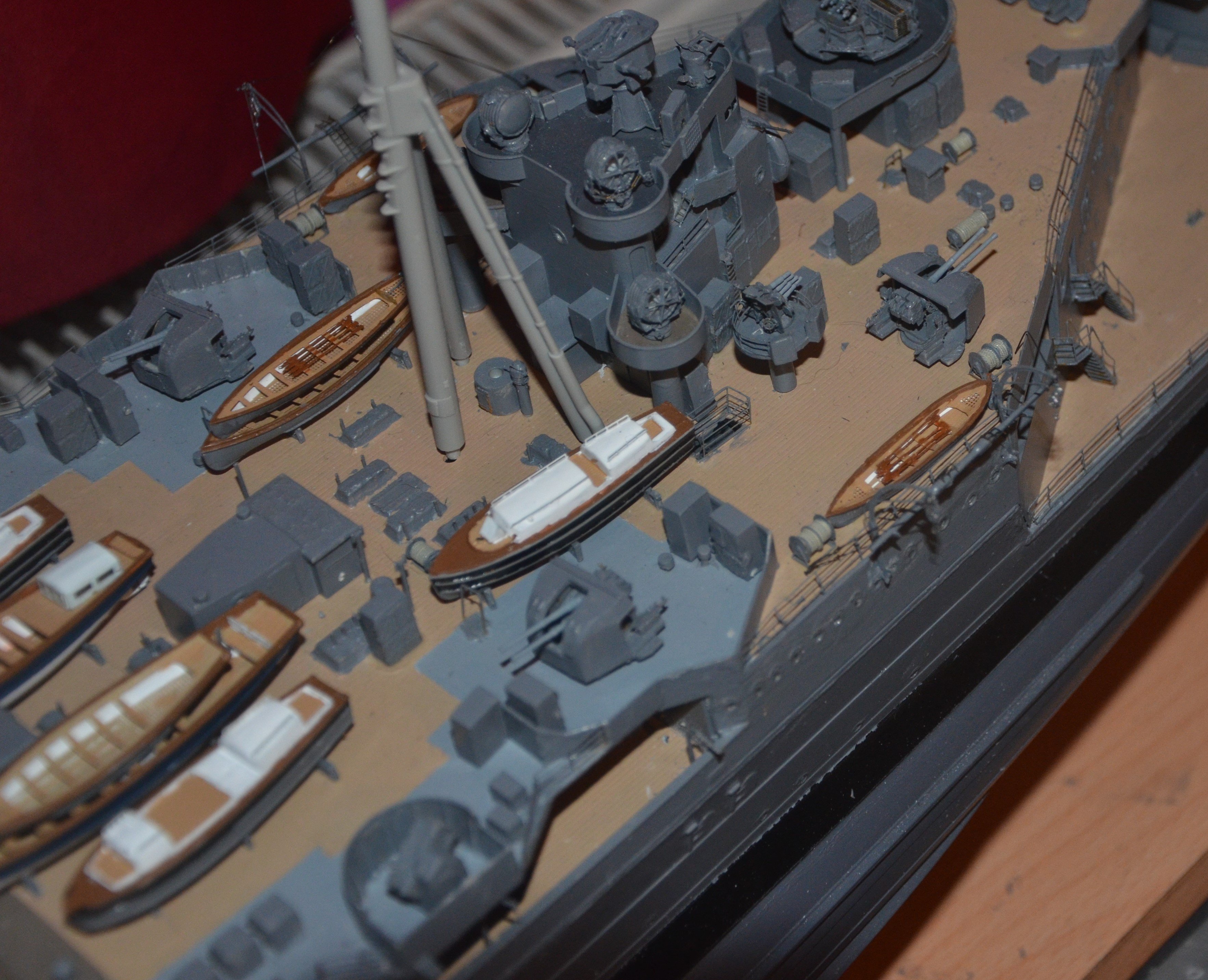

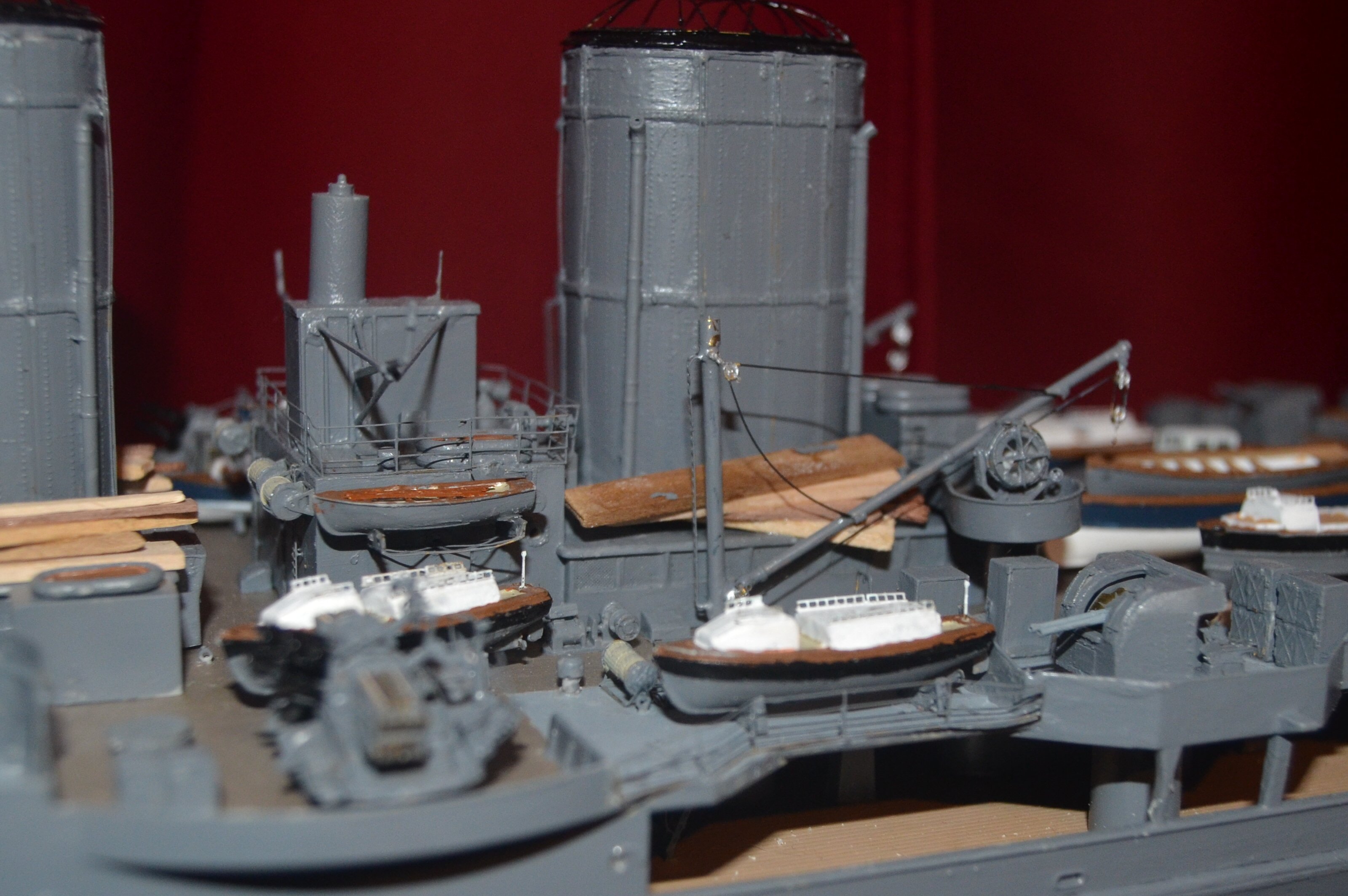

Woking on the ships boats. I am using some PE but mostly they look just fine built out of the box.
The one colour I was finding hard to source was the Navy Blue. I came across this one from Follkart. This is excellent paint. It has a very good constituency and covers really well. Will be looking at using this in a lot of my painting in future.

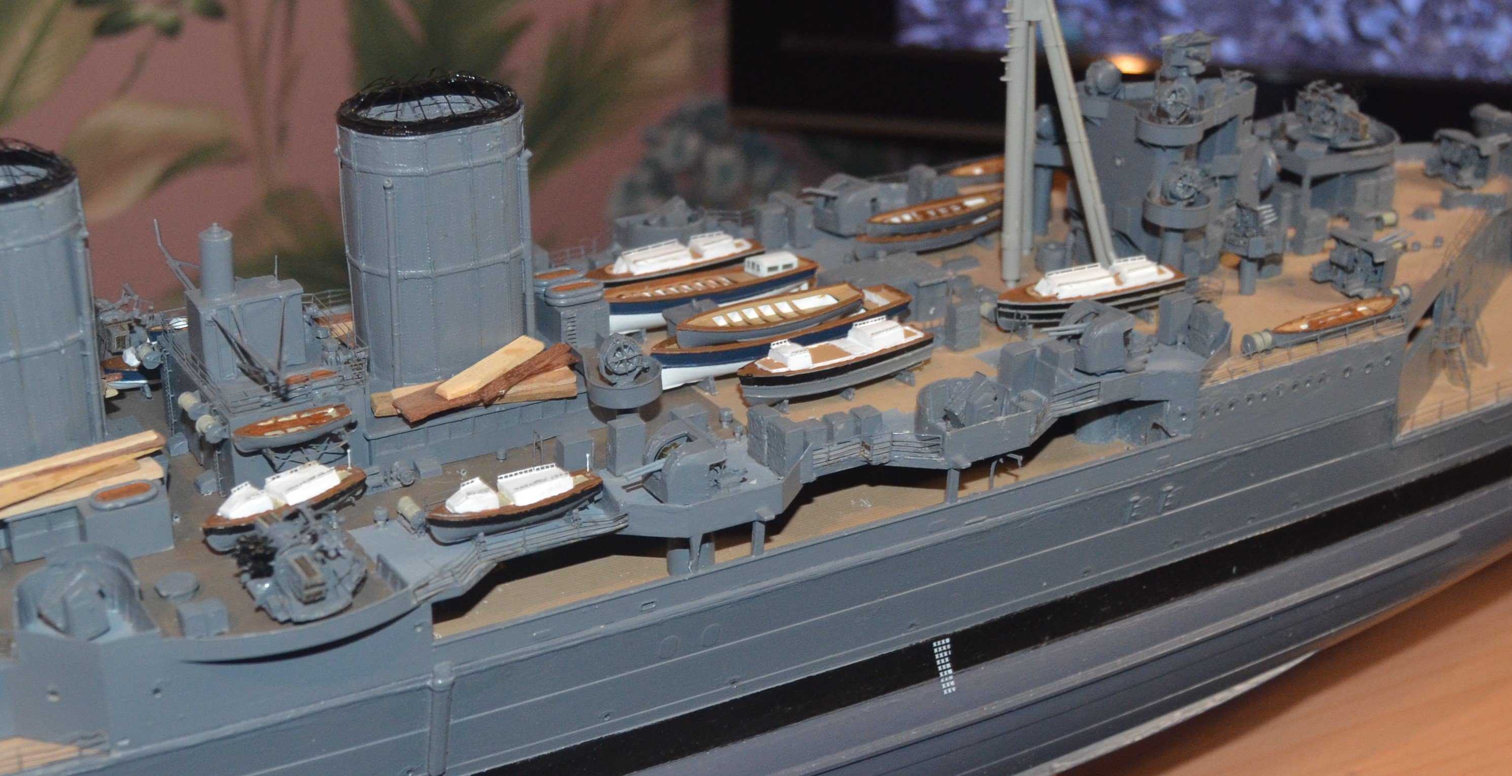

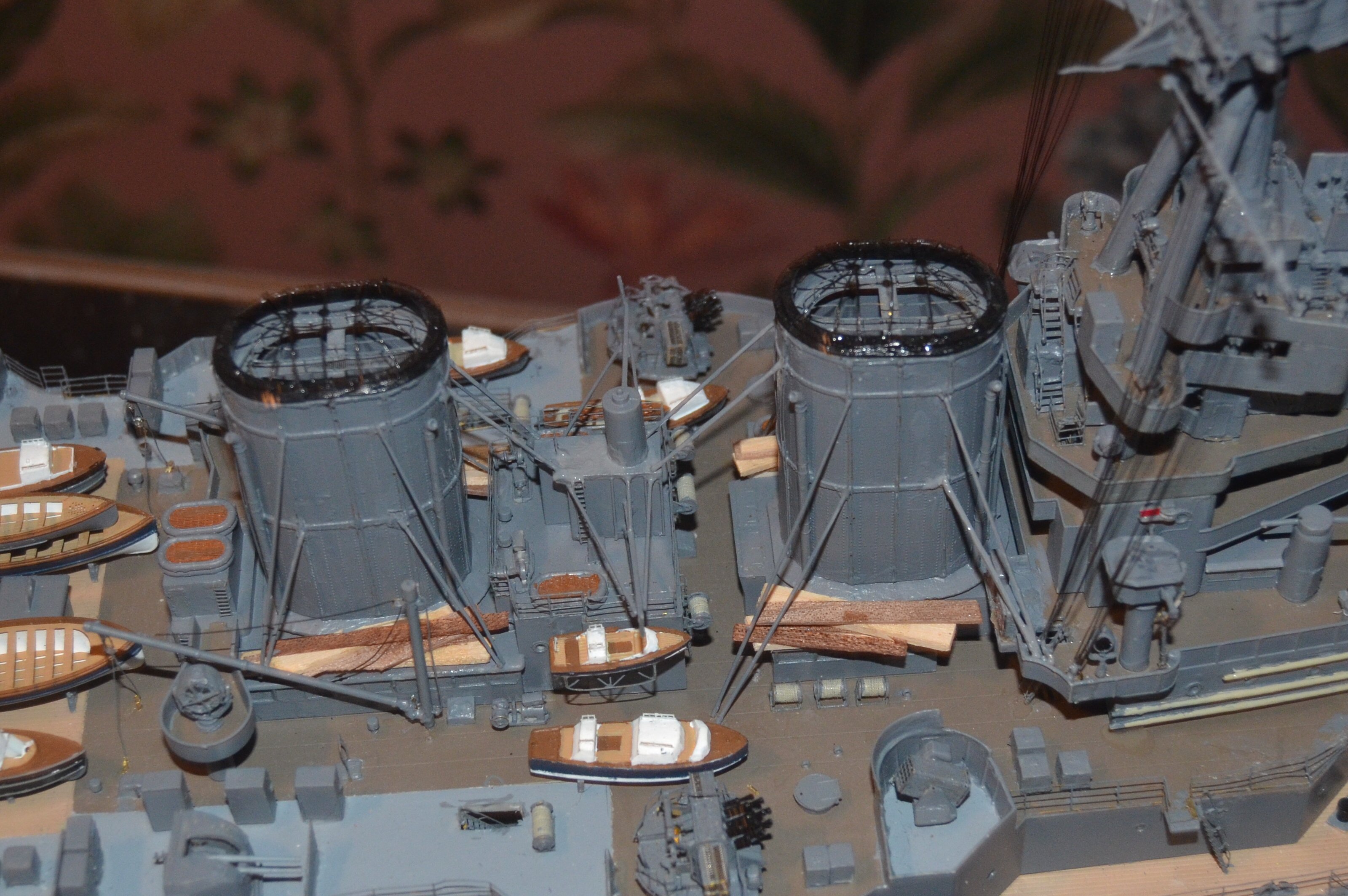

Ships boats completed and in place. These took far longer than they should have. The problem was every time I photographed them the paint job did not look perfect when viewed close up. So I kept repainting them. In the end I made the decision  that they look just fine and I am happy with the way they look.

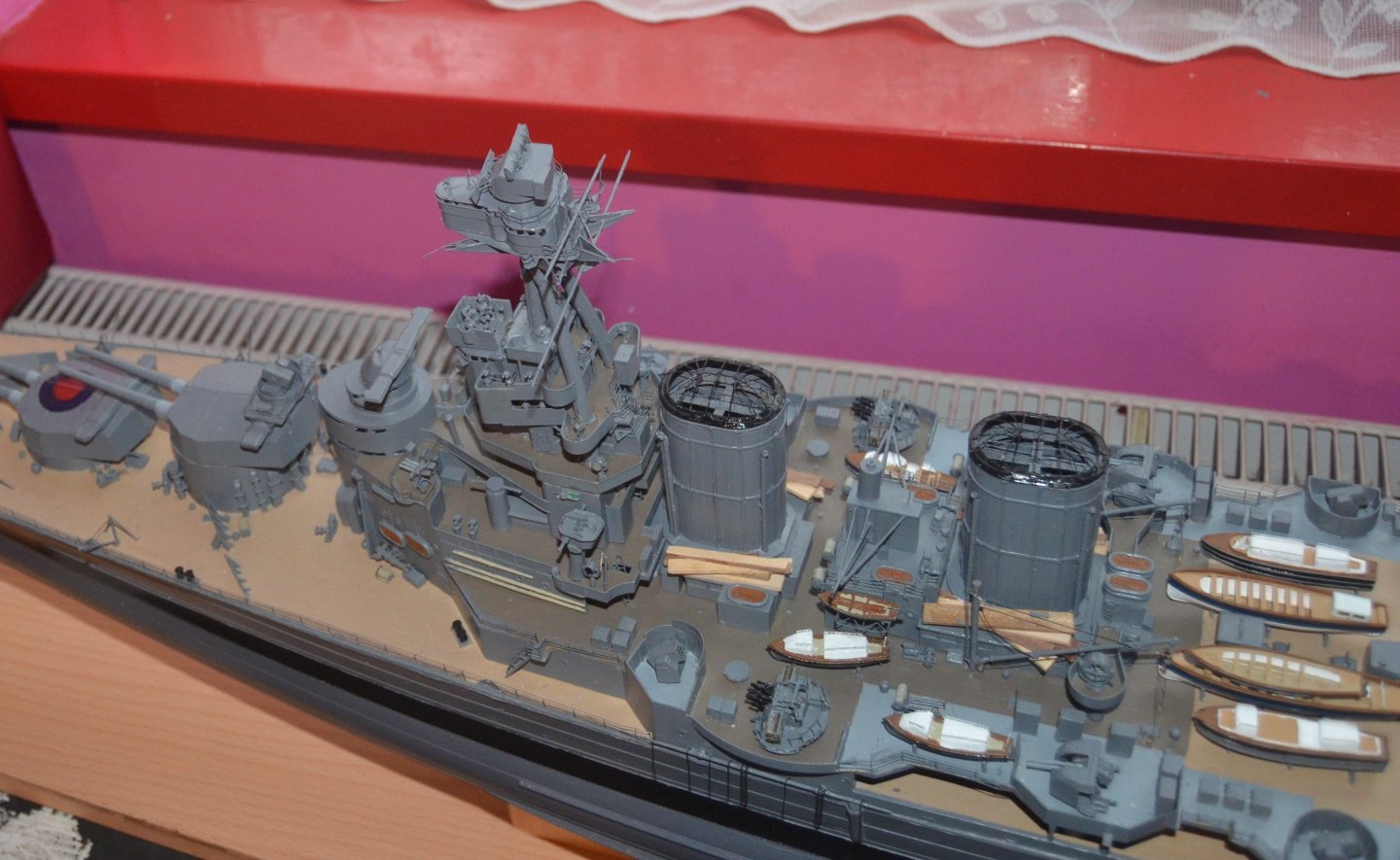

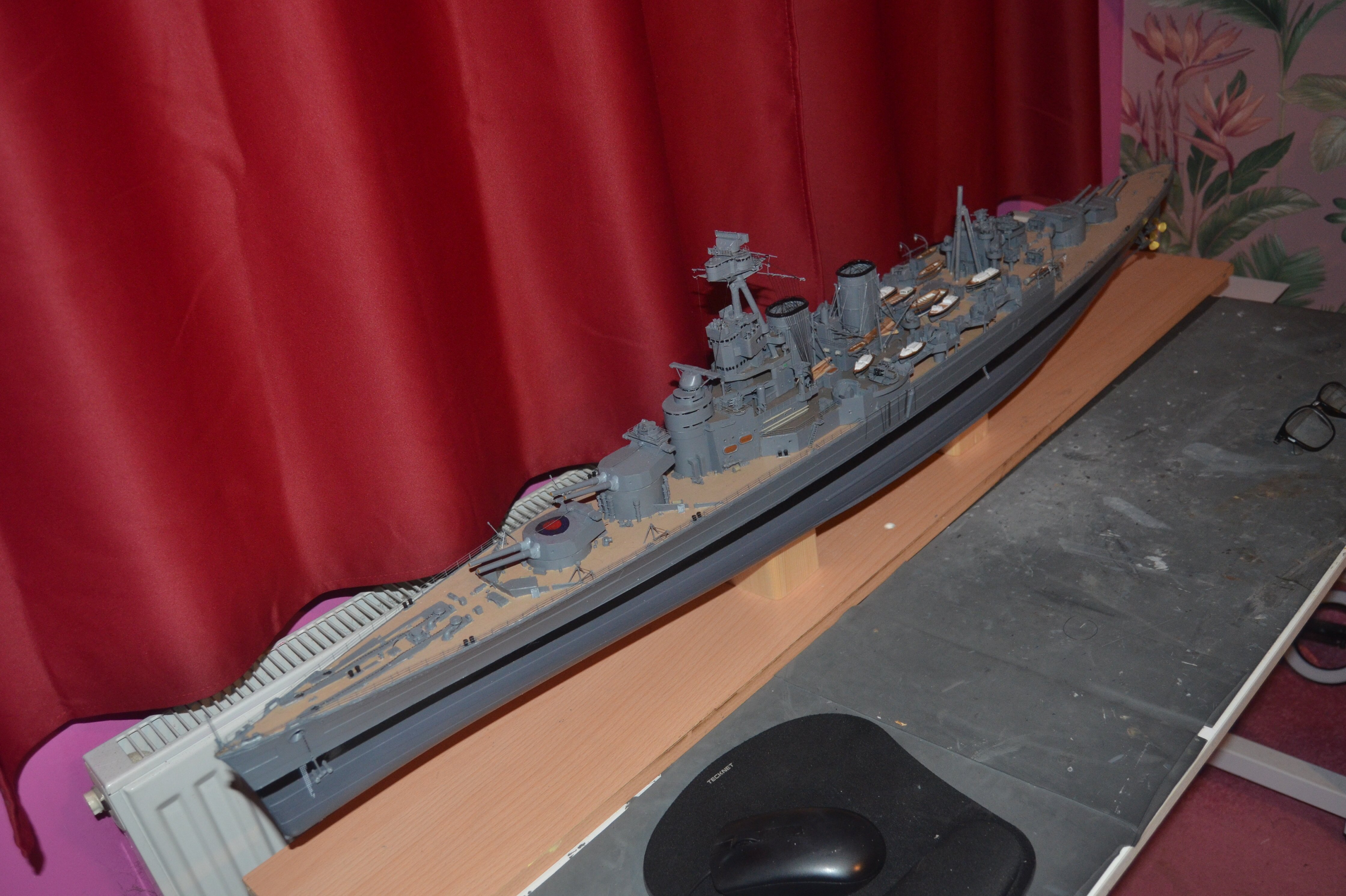

I have added over 50 more parts to the model. All of them using the MK1 upgrade kit. The two main derricks, the two davits for the sea boats, which have more PE if I want to hang them and the booms that went down the side of the hull. These are in their stored position but I have added the Jacobs ladders and Lizards which I believe where used to drag the paravanes along the side of the hull. I am now starting on the top part of the bridge. Once that is done and the two masts added  it will be all but finished.

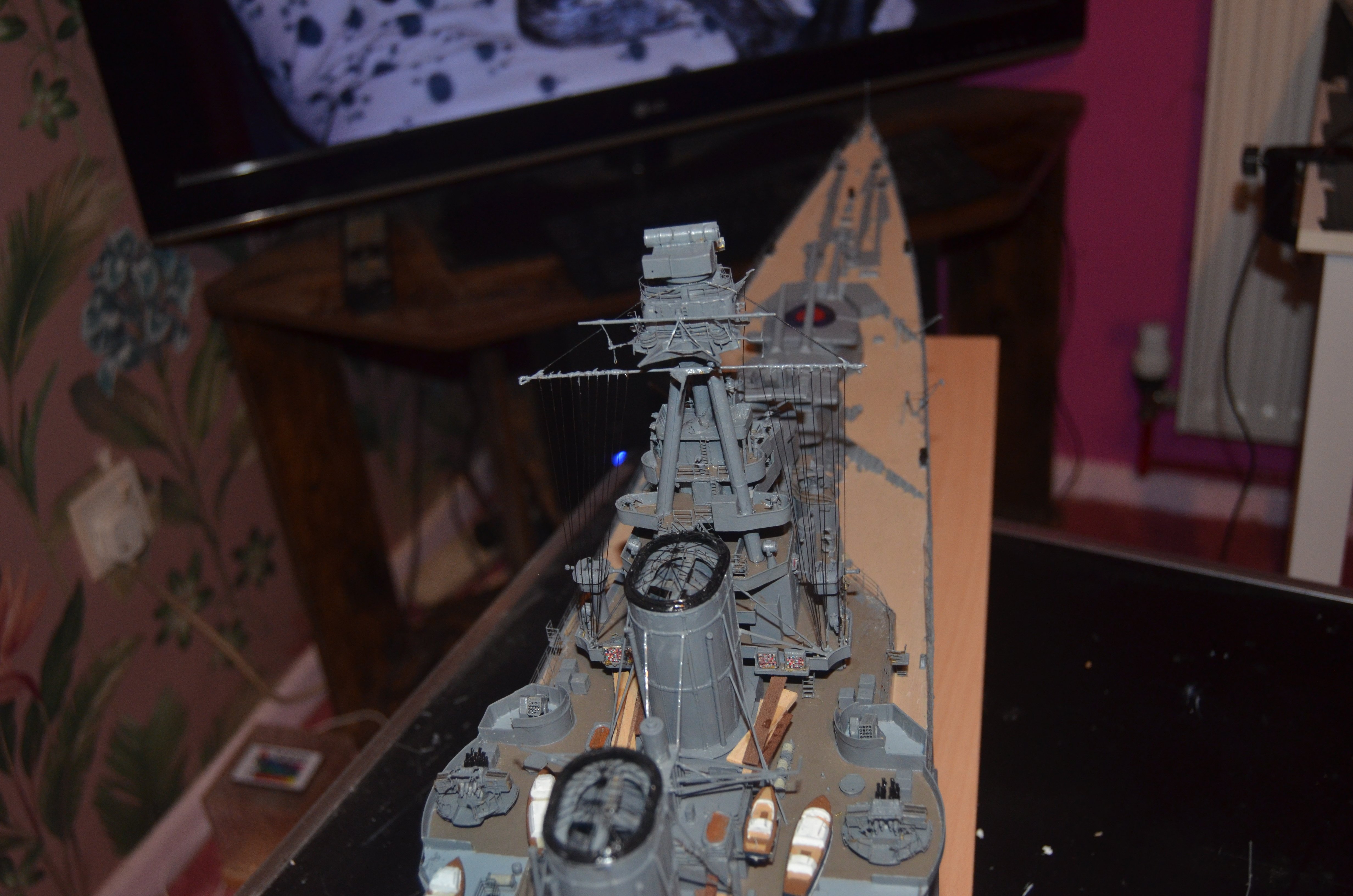

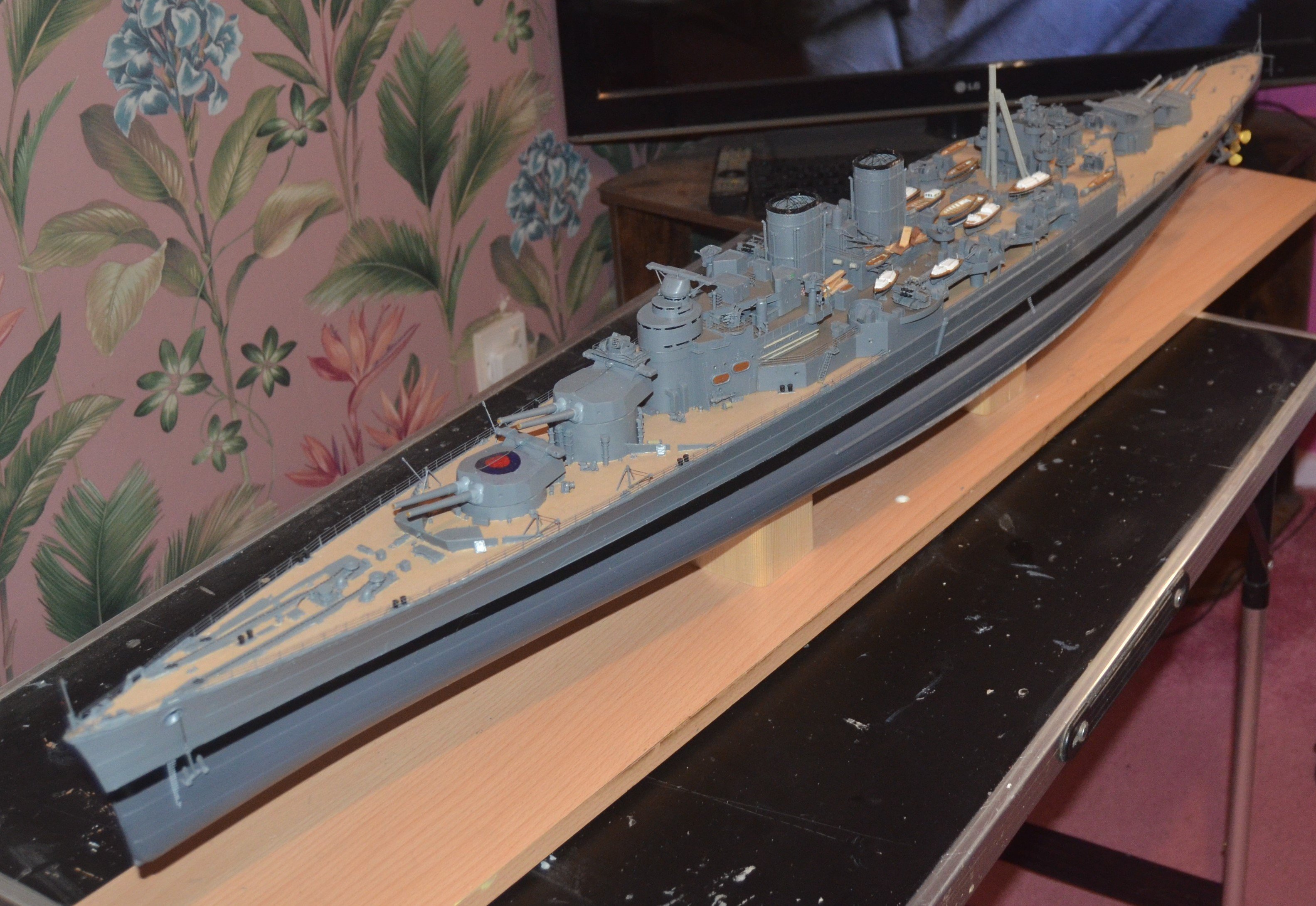

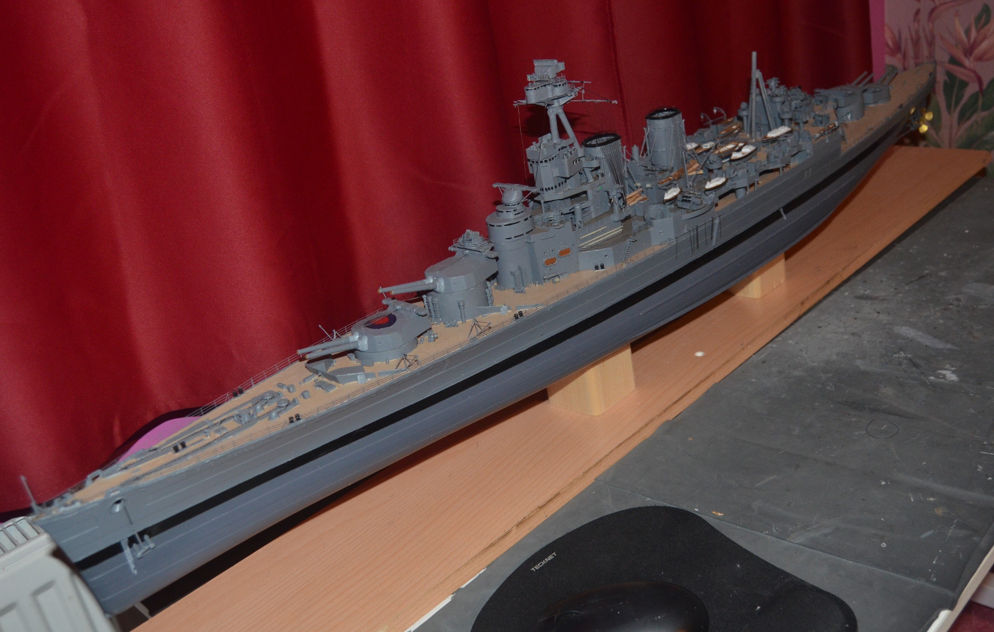

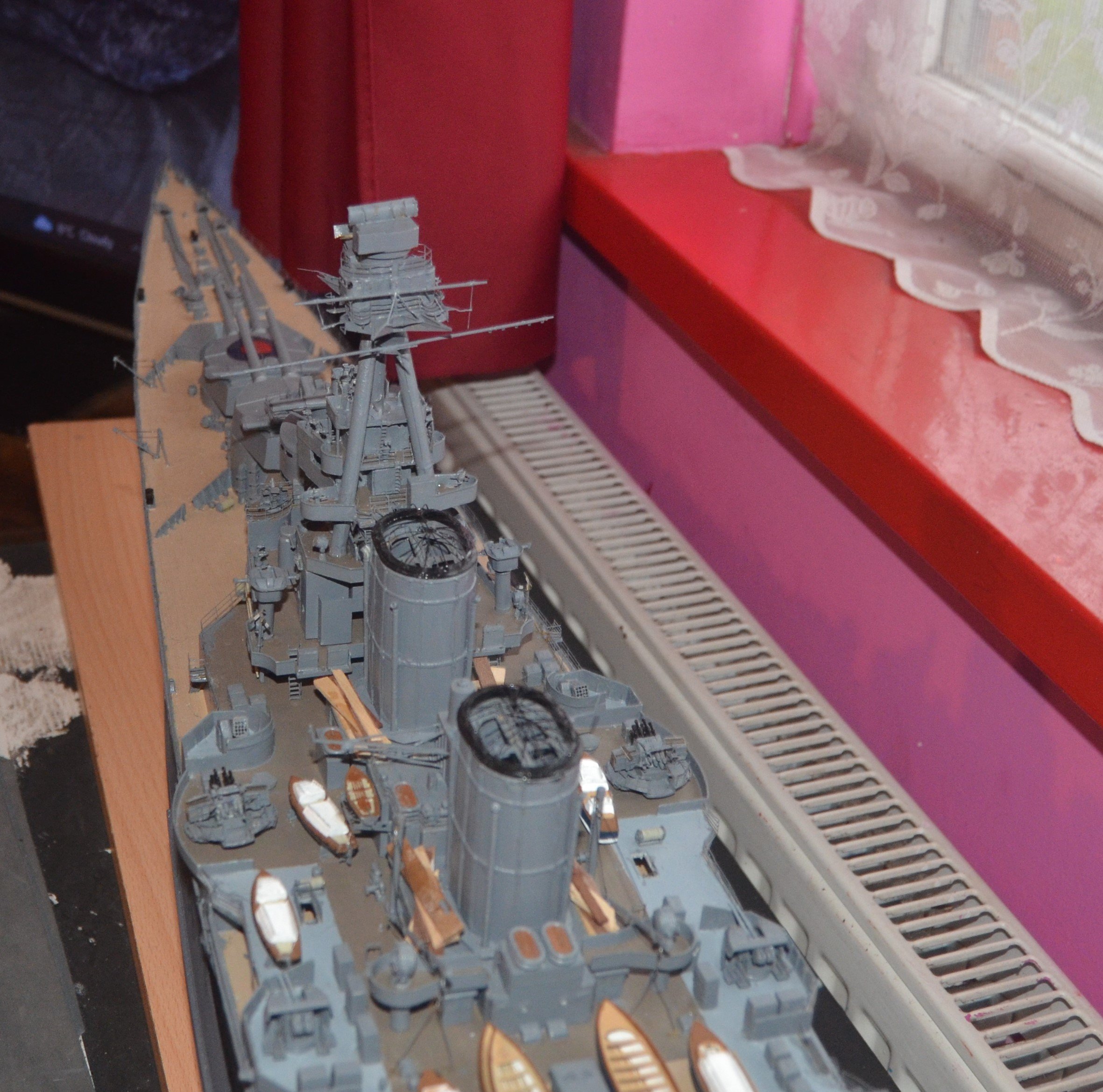

The top part of the bridge is finished ready for the masts to be added. There are so many ladders and hand rails in this one section. Half of which can't be seen. Could have looked better but it will do. I will remember in future not to build the complete section and then add the extras. I should have added a lot of the hand rails before gluing the various parts together.
I have made a few alterations as recommended on the HMS Hood web site. Mostly adding small parts such as columns and removing sections that where open on the ship. There are also quite a few added extras from the MK1 upgrade kit added to it.

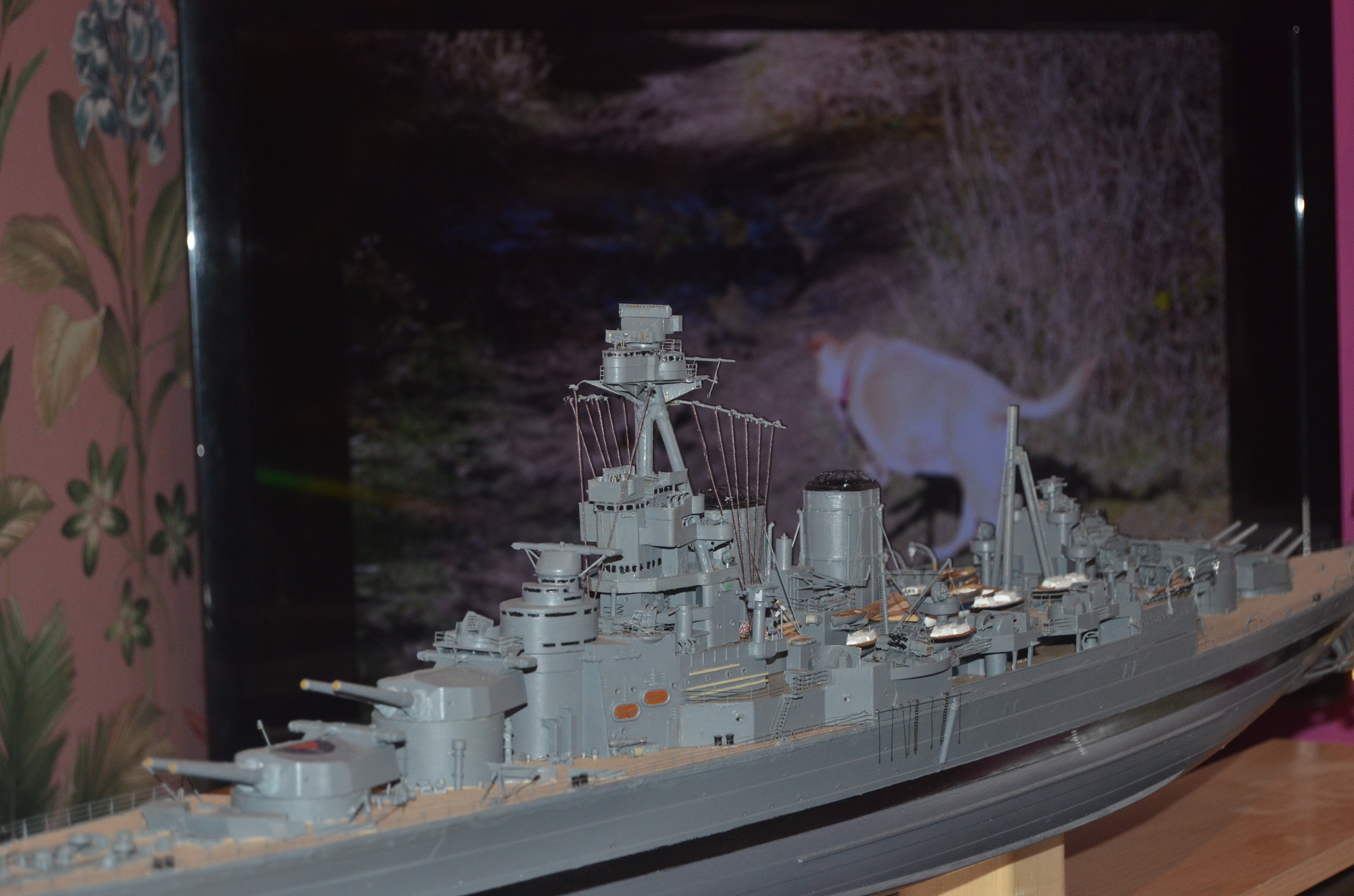

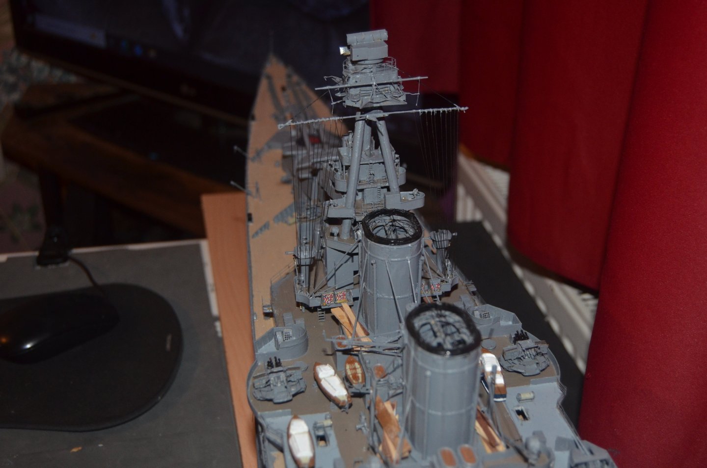

The bridge and masts completed and in place. This was a real problem because the masts fitted perfect when I dry fitted them. However once I added all the parts they would not hold in place with CA glue because of the tension in them. So I have glued them in place with Araldite. This has glued them in firmly. I then realised I had not added a part that goes below the starfish and holds the spar in place. So I have had to add half of it and luckily it does not show up to much. Just have to work out the rigging now and decide how much to add. My problem now as the Doctor is always telling me when I bring it up is the age related hand trembling. Tring to tie off rigging in close quarters makes it appear as if there is a earth tremor going on. I will also see is I can add some of the funnel stays. Although I should have done so before adding all the parts around the funnels.

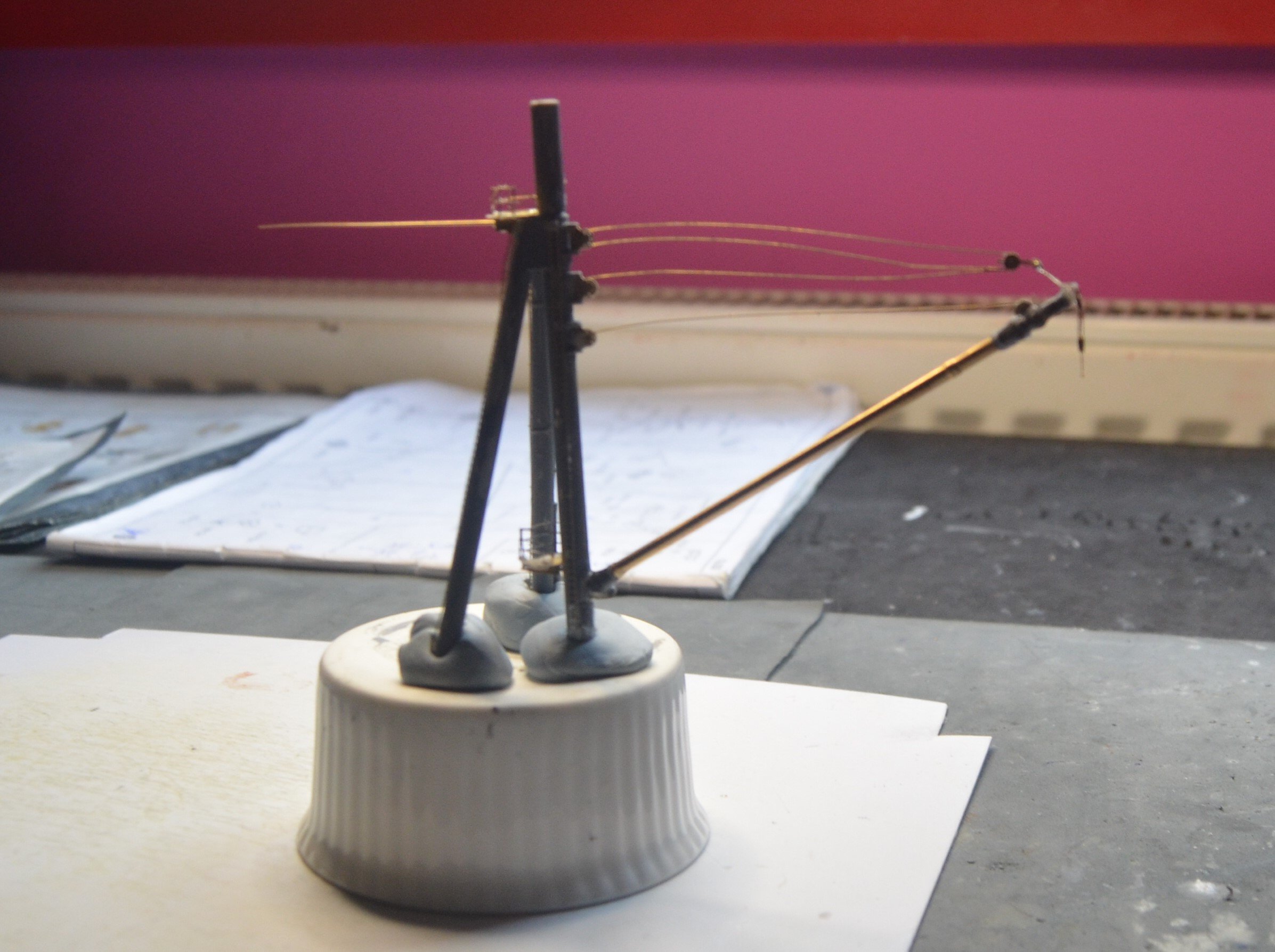

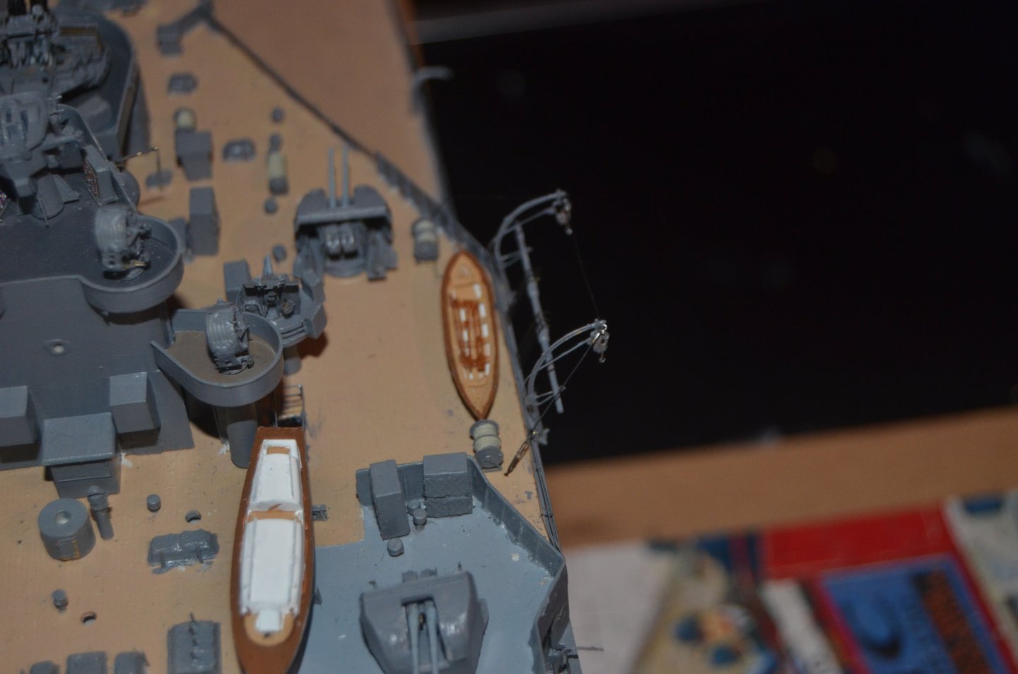

I've added the funnel stays and rigged the bottom spar. The biggest problem was not having smaller scale cord. So it is out of scale. And the tension has pulled one side down. It does not look as bad as the photo makes it look. But it is still not perfect. Will have to decide if I should pull it all apart and start again. The biggest problem as I mentioned previously is the shaking hands.

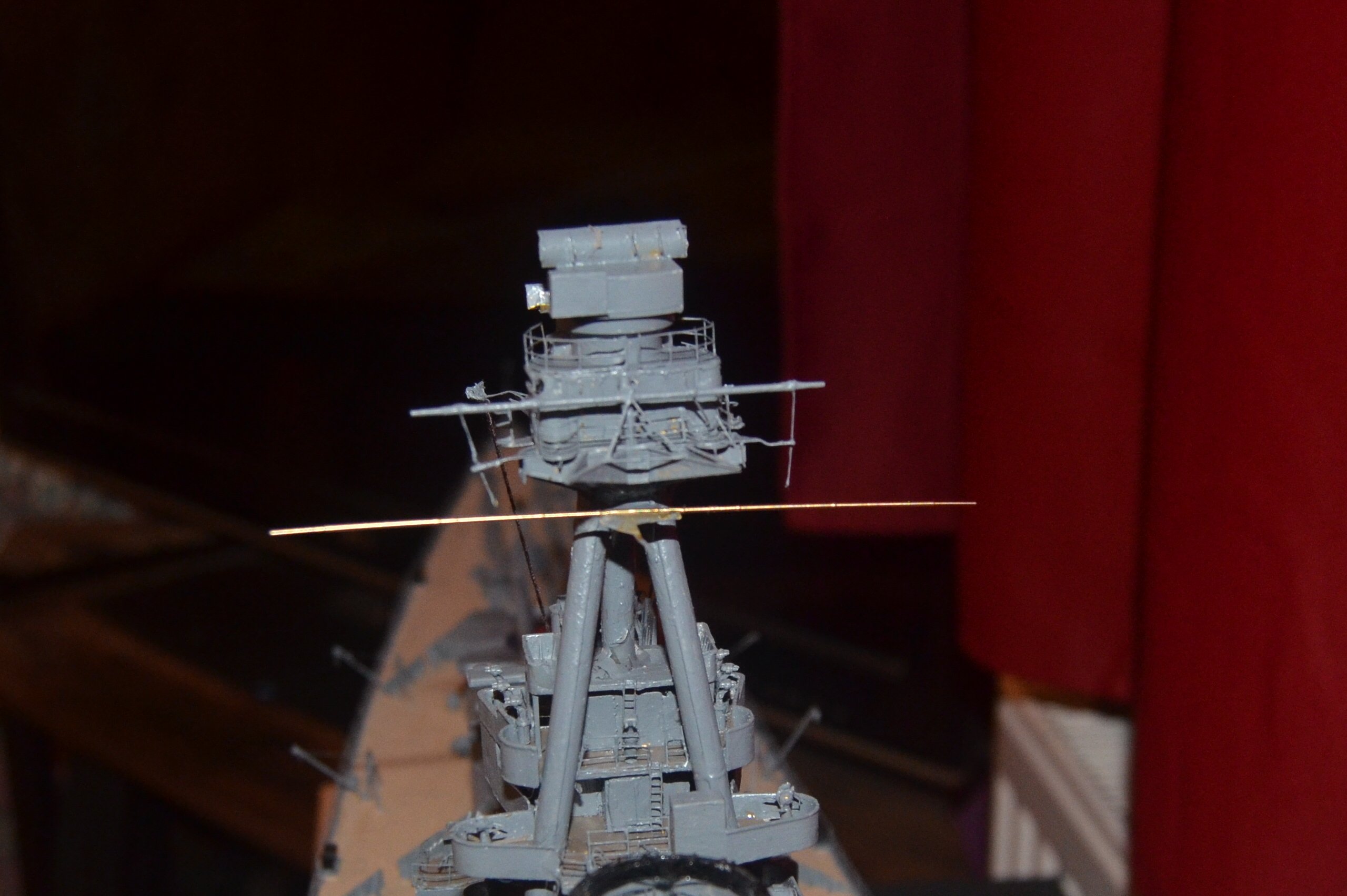

After much thinking about the yard I decided to change it. I did not like the way it bent down. Or that the cord was way out of scale and drew your attention to the rigging. So I have used the rolled brass yard from the MK1 kit. The only downside was how fragile it was. Even this would bend down with to much tension. So I added the line to give it more strength at each end of the yard. this has stopped it pulling down. There was very little surface for it to bond to either. So I left the centre part of the plastic mast in place to act as a brace and that has worked out fine. I also swapped the 0.4mm cord foe 0.2mm. It should be 5 double lines but that was way to finnicky to do. But it does look far better and more like how it looks on the ship. I have also added a few more stays to the funnels. Just the main mast to do and a few bits that will added to the hull and it will be finished.

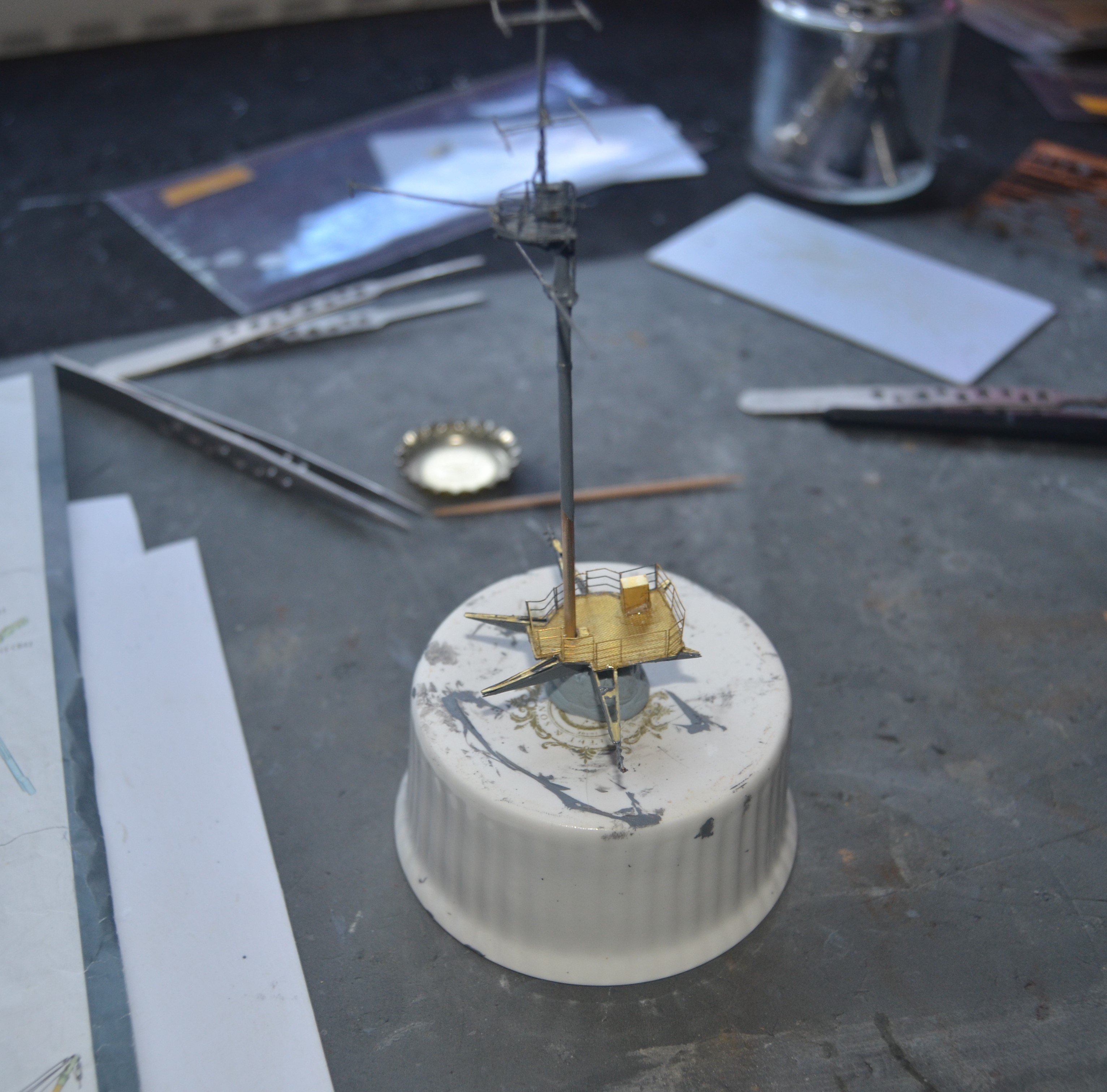

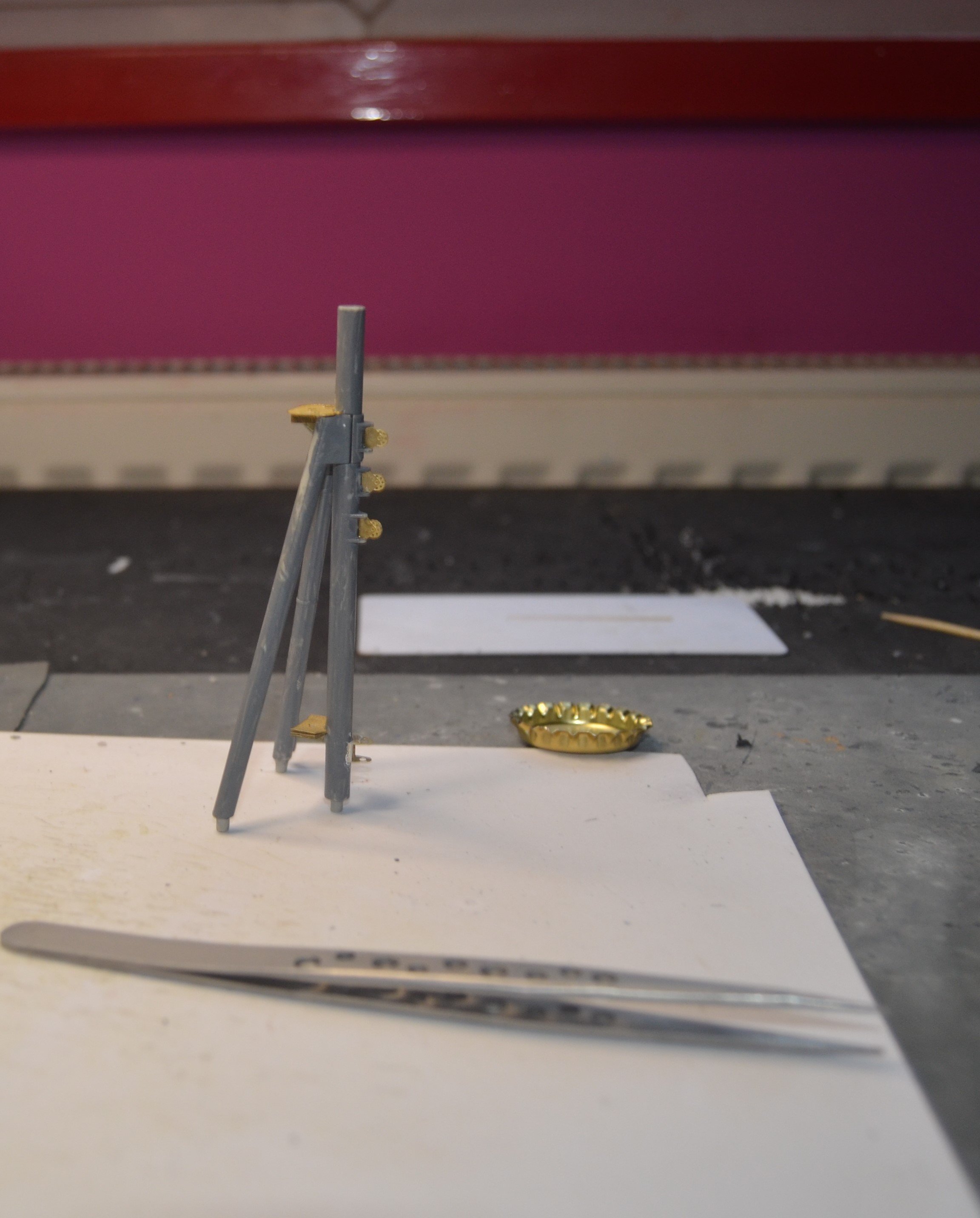

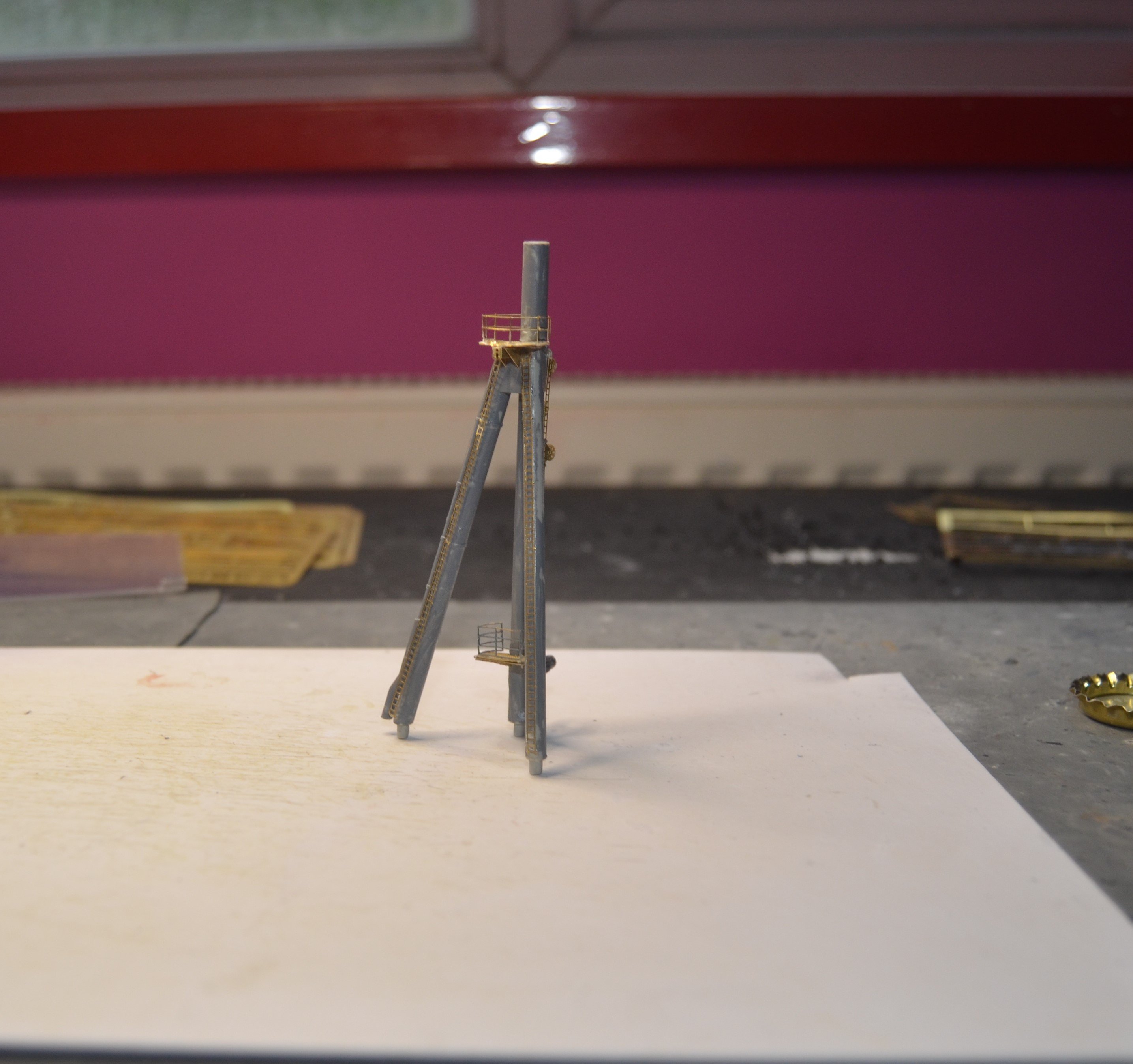

The top part of the main mast. This is made with the MK1 kit and replaces all of the Trumpeter parts. It is OK but I put the yard on the wrong side and am not going to take it apart to fix it. The hand rails are alright but the ends broke. As with these things it does look impressive when seen normally. Now onto the bottom part which will also have a lot of replacement and extra parts.

Wow, now that is tiny and amazing. Such a delicate job you have done!
I am now scared building the 1:350 scale version and having PE details added.
Respectfully
Thanks,I will admit it was a bit scary at first. But once you get used to working with the PE it comes out fine. I find it helps to spray on some CA glue activator which bonds it instantly.
You will be fine adding PE. It will just be a bit smaller that's all. My biggest problem as I have mentioned before is the shaking hands. The stage that will get me will be adding the rigging across the two masts . Good Luck when you start to build your version.
