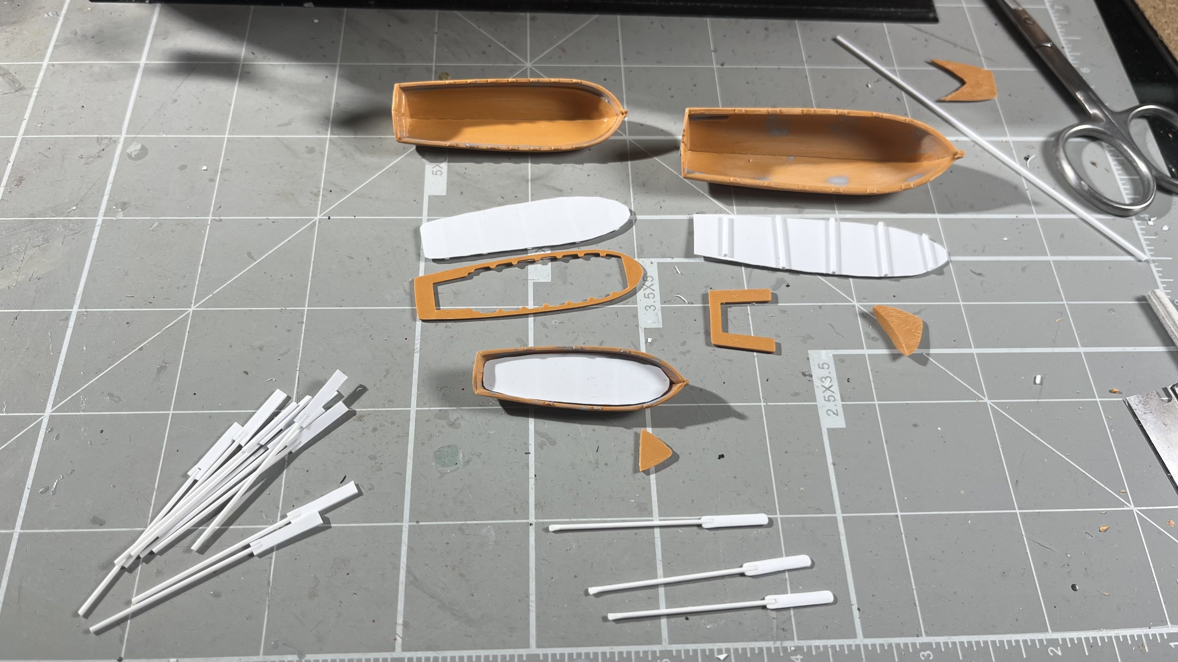

  • Ship boat storage: resting on boat booms across the waist, vs. sitting on the upper deck
    • If I decide to go down the diorama / Battle of the Nile idea, I assume these would be in tow anyway; not on-board the ship?

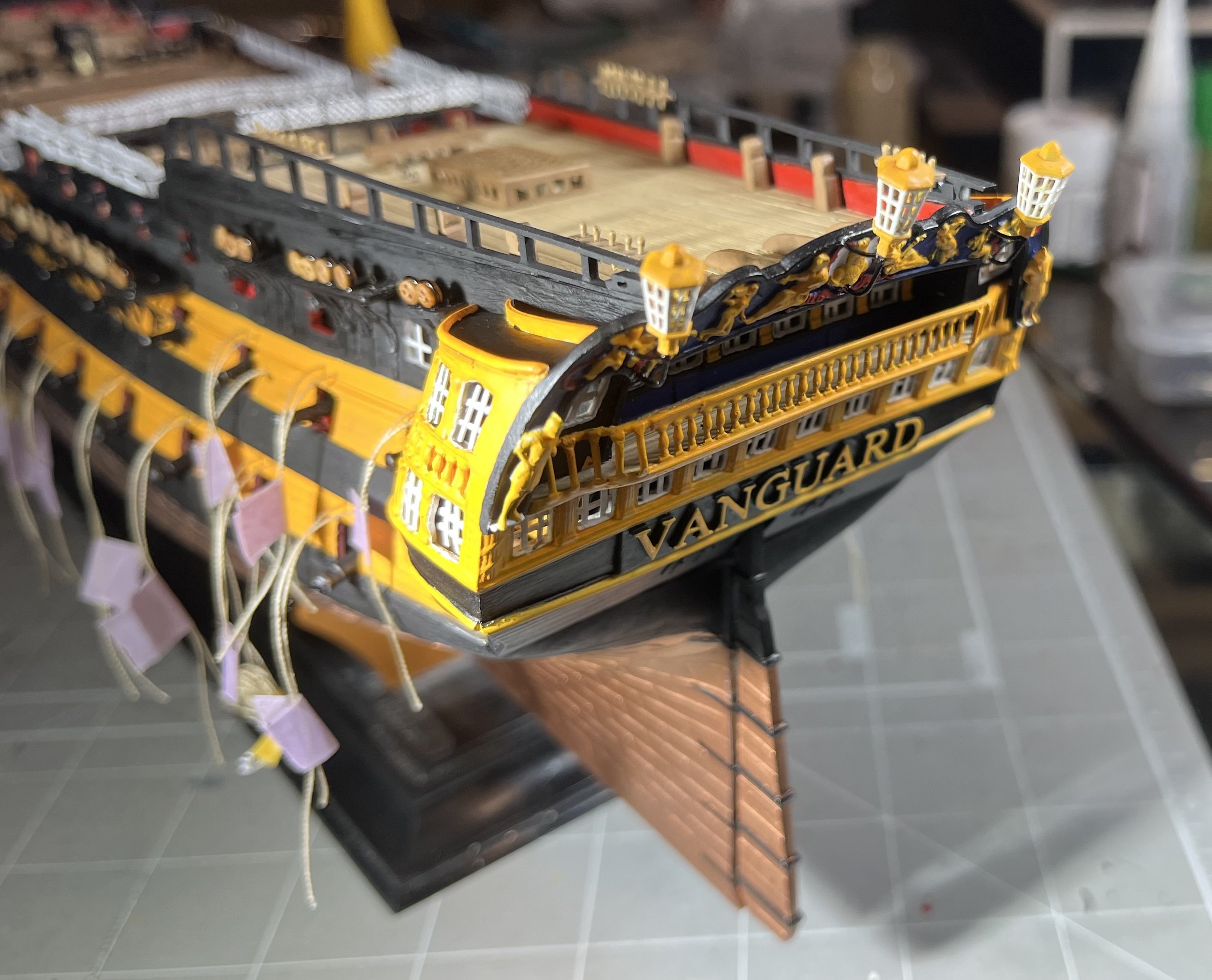

As expected, the stern turned out to be quite the project!   There are many similarities between Superbe and Vanguard: both have a semi-circular taffrail, a stern gallery with a walkway outside the captain's cabin, a stern gallery with windows only in the gun room, two chase gun ports, and both have quarter galleries.
There are also several differences: the name plaque is straight, not curved, on the Vanguard; the windows are nine panes, not four; the cabin walkway gallery is curved all the way around on the Superbe, whereas on the Vanguard it's only curved in the middle, and straight at the edges; and Vanguard's taffrail is ornamented.
The biggest difference however is the layout of the quarter gallery easements and the walkway outside the captain's cabin:
  • Le Superbe - walkway (green) runs the width of the ship, and easements (in quarter galleries; orange) are in front.
  • The Vanguard - walkway runs between the easements (orange) only.
Original out of the box (and Vanguard name plaque provided by Igorcap)
Cut off the original taffrail, and superglued on the one made by Igorcap (see Post #1) instead.  I cut off the ends of the original railing also, and built new endings of the railing from 22 gauge copper wire.  Note magnets at the bottom.
Stern, primed.  Glued on a strip of 1mm plasticard at the bottom, to create a straight bottom edge for the name plaque, and for the bottom of the stern itself.
Shortened the stern gallery walkway by cutting off the ends of the wall and the walkway itself, and added side walls instead.
Final walkway - made doors to quarter galleries also.  Note the black strip at the bottom of the hull (on gun deck); with magnets matching the position of those in the stern itself.  I'll add one or two magnets at the top also, so that entire stern and quarter galleries can be easily taken off.
Added floors inside the quarter galleries, and cut off/rebuilt the bottom (which had a big swirl on the Superbe).
Final (almost) inside of the stern.  Note addition of rear walls and windows in the quarter galleries.  Removed galleries at the top of the quarter galleries; the Vanguard had "flat" roofs, which I built out of 0.25mm plasticard.
Final quarter galleries.  Built new roofs and added astregals (thin strips of 0.25mm plasticard glued together with Tamiya Extra Thin Cement; I'm not super happy with how it came out, and I'd probably recommend using wire and CA instead) to make windows with nine panes.
(Compare with the Victory/Amati Vanguard stern, as built by gbarlow, here; and you can get a glimpse of the original out of the box Superbe design here, as built by Blue Ensign.)
Edited by PqLear

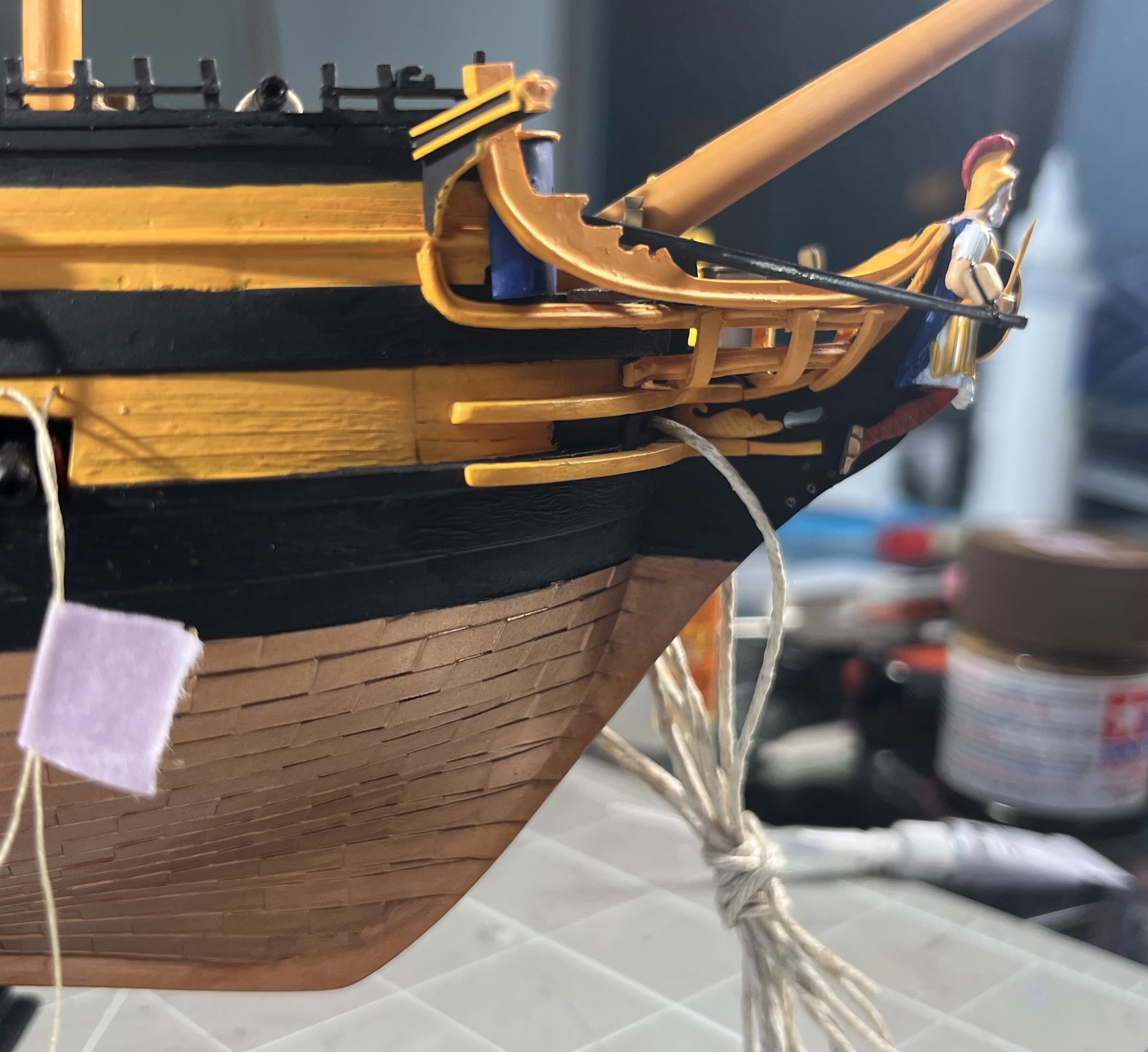

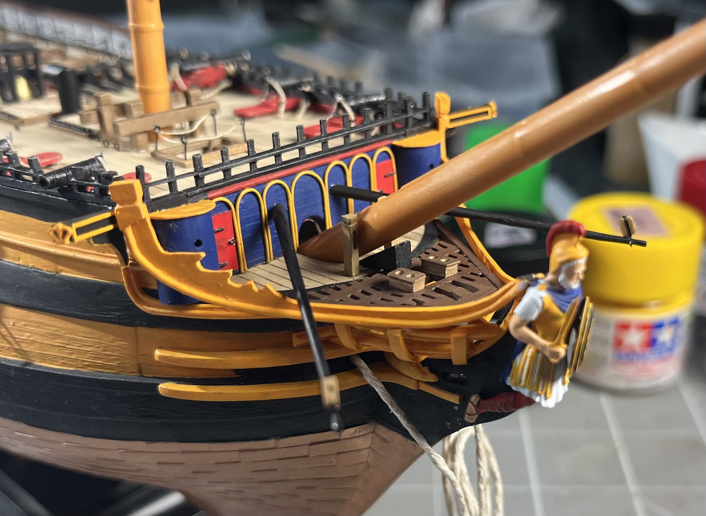

Worked on the head, incl the hair brackets, beakhead, and figurehead this week.  Out of ~30 pieces used in the final build, two came from the kit, the rest had to be built using plasticard and metal wire.
Original beakhead on sprue. Note bow chase ports, and the fife rail at the top of the railing, with stanchions.  I also re-used the original grating, was however curved so dipped it in boiling water to be able to flatten it.
Started with a sheet of 1mm plasticard to make main rails.
Cut out strips to make middle rails and cross pieces to form the rest of the hair bracket.
Beakhead and grating are only two pieces out of the box. Main rails assembled from four pieces of plasticard; the main shape, two extra pieces to form the stanchion, and a round profile (shaved to be half-round) to form the decorative lower edge.  Made rounded easements by cutting up a plasticard tube.
Hair bracket pieces glued in place using CA.
Painted.  Made new hole for bowsprit gammoning.
Beakhead bulkhead. Cut up and reassembled fife rail, closed chase ports, shaved down doors, and added easements.
Extended the fife rail to run the width of the forecastle. Made decorative molding (arches), door hinges and door handles out of 24 gauge wire. IMG_1650.thumb.jpg.183b5611d1eeaeb5362f5945839b37aa.jpg
Painted figurehead, 3D printed by igorcap.
Finally assembled and painted.
A few details remain to be added - heads, knee for the bowsprit, gammoning, etc. but overall quite happy with how this is coming along! IMG_1658.thumb.jpg.2abb44bcb82632c8faa40e624b206452.jpg
Thanks - again! - to gbarlow for inspiration!  I've used your images here and here as guides for design and paint scheme.

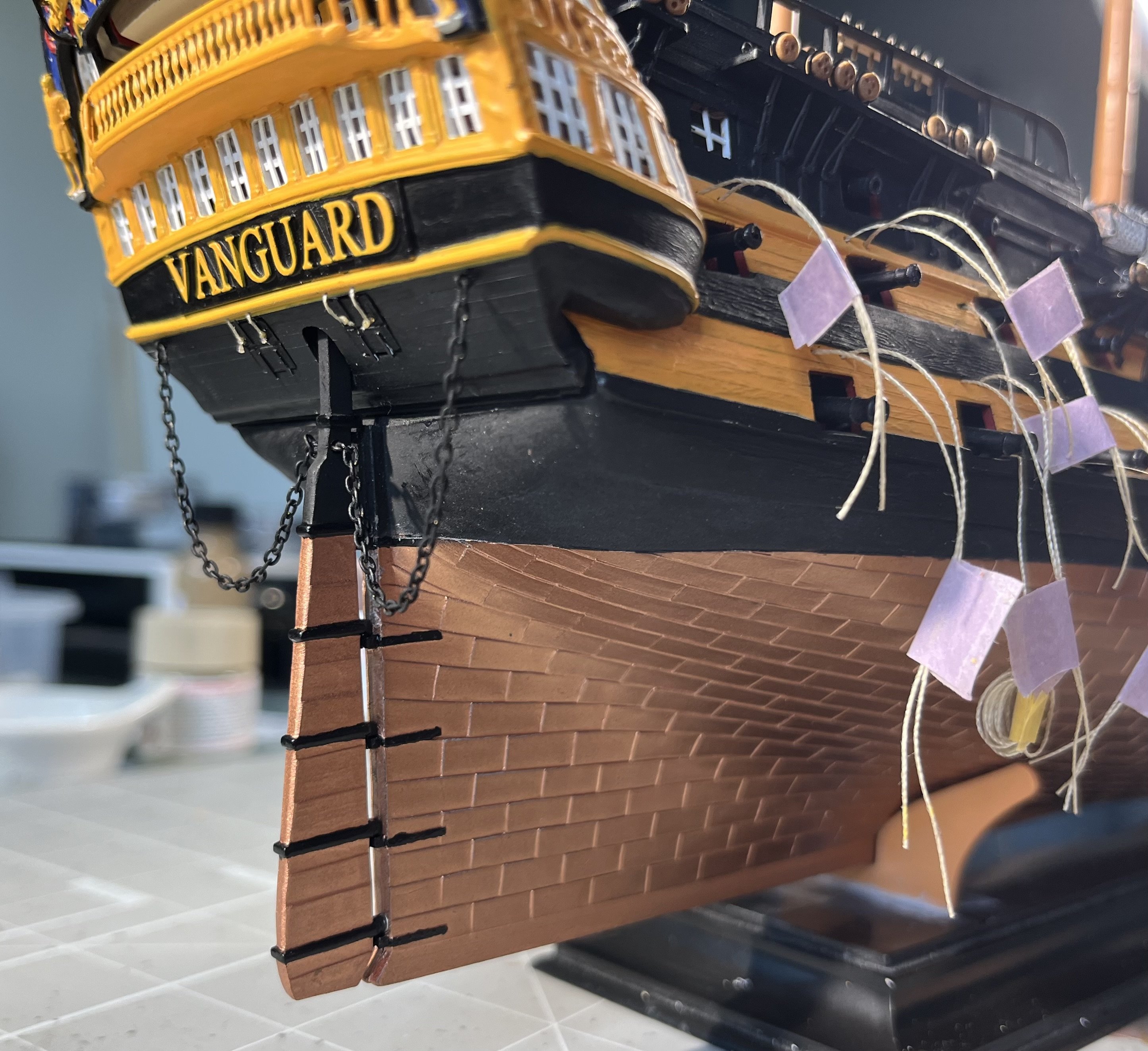

Okay, raise your hand if you've ever mounted the channels and drilled holes in them for the shrouds to line up nicely with the upper deck gun ports, to carefully avoid a 24-gunner blasting away the chains with the first broadside of the battle.  Great I see a lot of hands!  Now, keep your hand up if you realized a bit too late they ALSO need to take the 12-pounders on the fo'c'sle and quarterdeck into account...  ping me your nick and I'll send a membership card -- you're welcome to join my club!
I'm sad to report my Vanguard might have some issues with their main mast shrouds, after the quarter deck 12-pounders have shot away the 5-9th shrouds.  Oops.
Last week -- deadeyes (Amati), chains (28 gauge copper wire), and preventer plates (0.4mm plasticard).
Did Vanguard have 9- or 12-pounders, or even carronades, on quarterdeck & forecastle?
I tried a few different methods to loop the chain around the deadeye, and settled for a configuration with one short and one long end.  The white plasticard strip will become preventer plates.
An earlier attempt had both ends of the "chain" wire of equal length, but I ended up cutting one end about half-way down.
The loose ends of the wire meet "in the middle" of the chain, and when glued together with a small bead of CA, almost gives the appearance of two chains (which I believe the RN 74s had?)
The upper preventer bolt is a filed-down head of an embroidery pin, cut off to ~1.5mm length and glued in place into a hole drilled into the side of the hull, or the upper wale.
See what I mean about making sure the chains avoid getting in the way of the gun ports?
It appears Vanguard has one more shroud than the Superbe, nine rather than eight, on the fore mast, and the deadeyes/shoruds ended up being a bit crowded. Fo'c'sle 12-pounders should be fine, with one in the gap between shroud 4 and 5, and one further to the fore.
Preventer plates cut to size; punched a dent to create appearance of lower preventer bolt.
Starboard main channel, deadeyes, and chains. The quarter deck guns will struggle to fire between the deadeyes 😕
Final appearance when painted; quite happy with the look!
I believe I'll be able to bend some of the main mast deadeyes to create better gaps for the 12-pounders, or I may need to move them around and drill new holes in the channels, before proceeding with the port side.
Edited by PqLear

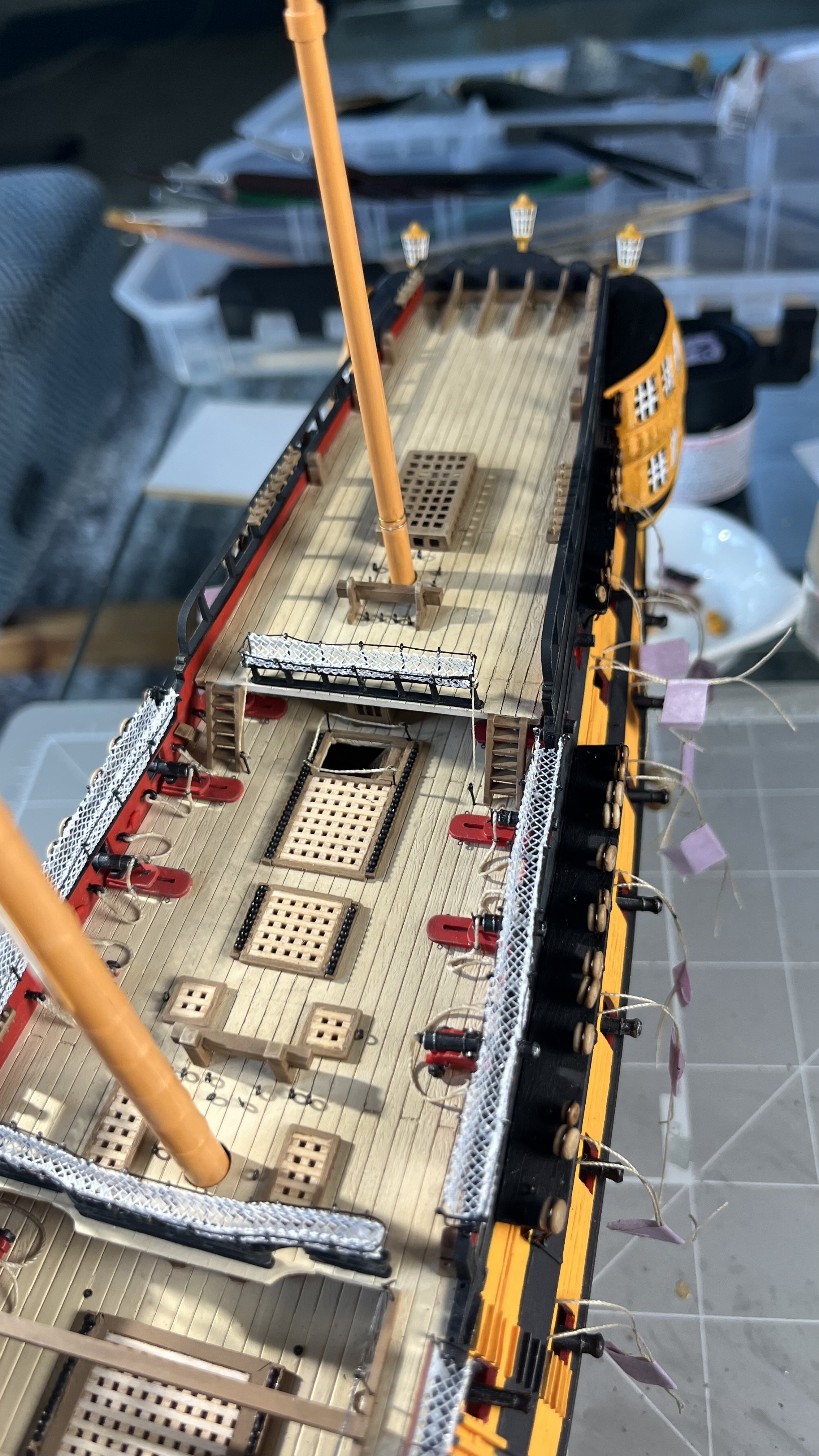

Gun deck half-way assembled.  Starboard battery, anchor cables, and pull strings for gun lids remain before upper deck can go on.
As mentioned above, I cut the upper deck in two pieces to be able to put it in place without breaking up the hull.  Even this approach is proving quite complicated -- wish me luck, I'll need it!   I started this part of the project by adding beams under the upper deck:
All in place, glued onto the larger part only...
... so that I can add the upper deck as a two-step process; first, the larger piece, then the starboard battery -- quite tricky to maneuver the guns and breeching lines in place between the beams, but hopefully it'll be okay -- and finally the smaller deck piece.  Unfortunately, this means I won't be able to take a picture of the entire gun deck fully assembled 😕

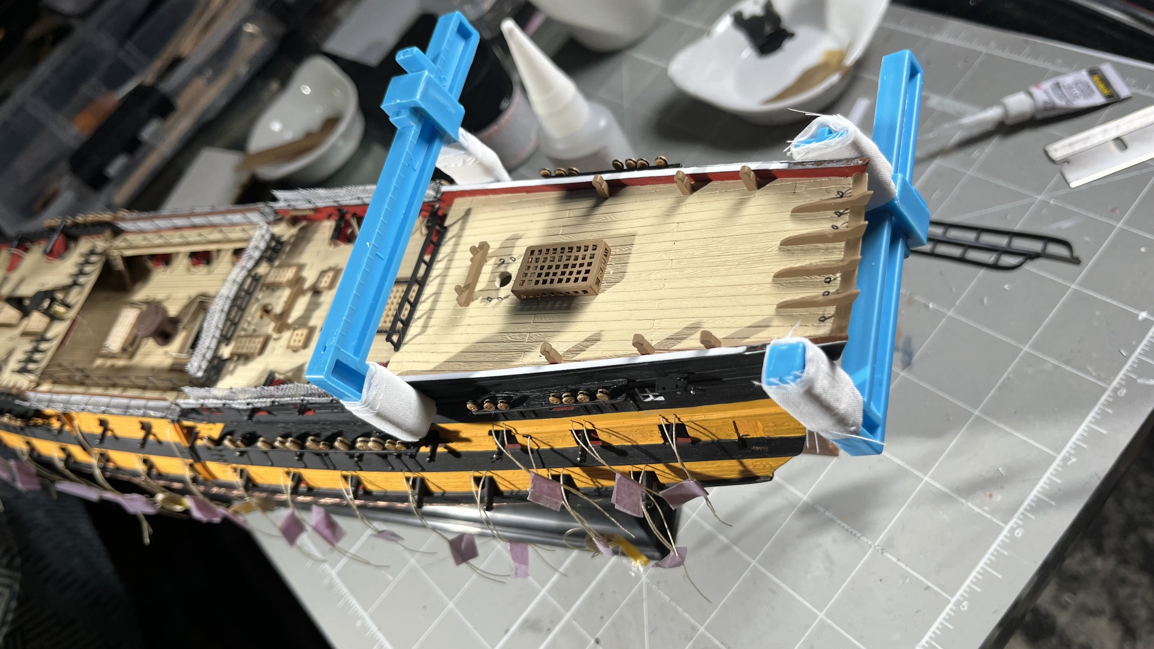

Started prepping the forecastle/quarter deck.  First, original piece (note new holes for masts, as described ^^)
Started by cutting/shaving everything down -- gratings, stairs, gun racks, placeholders for buckets, etc. -- to get a flat deck.  Filled resulting holes with squares of 2mm plasticard.

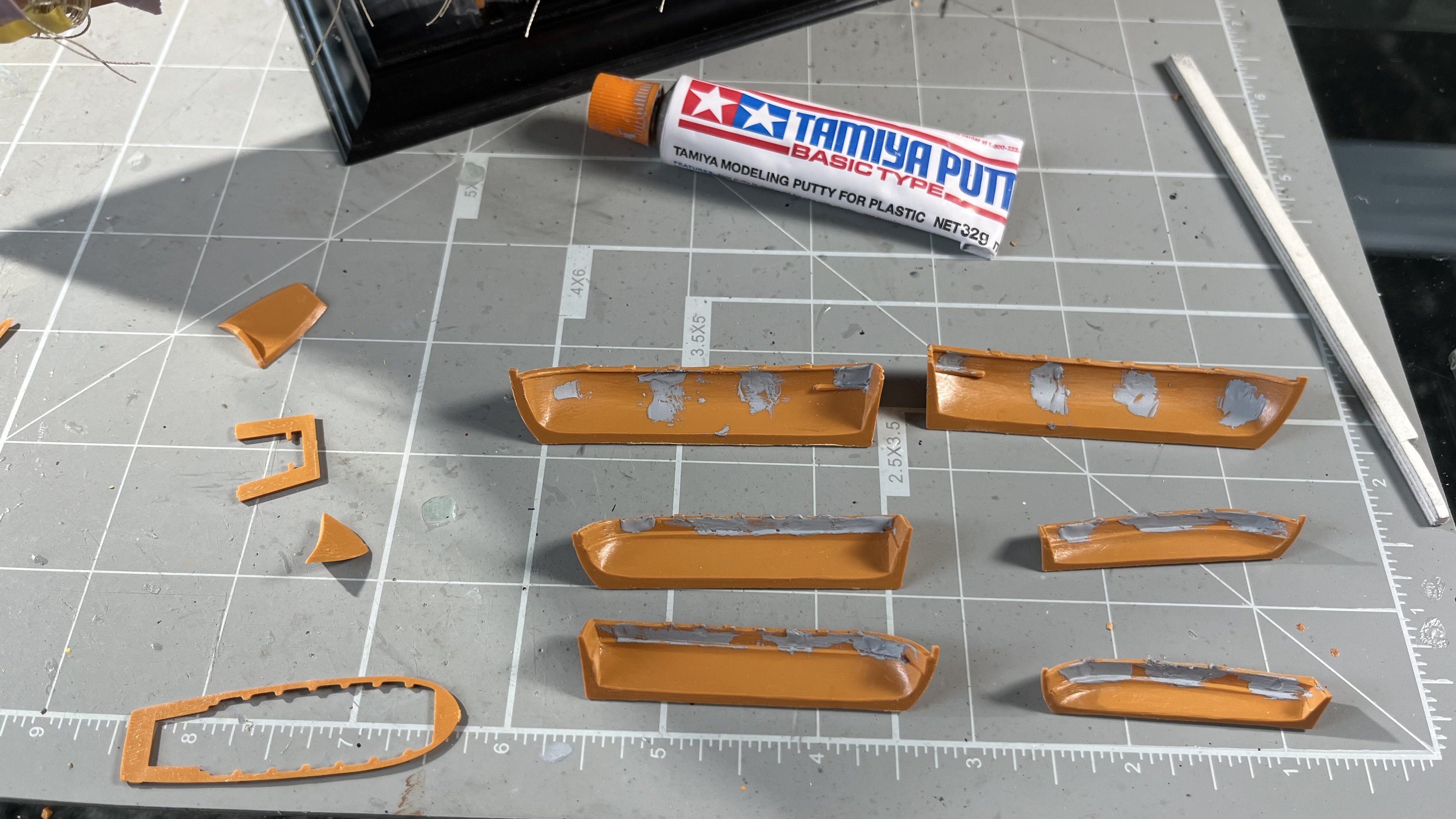

New location and different dimensions for the midships opening.  Narrower gangways.
Cut new opening and closed up resulting gap in forecastle.
Plenty of filler to close holes and cracks.  Note extended front of poop deck also.

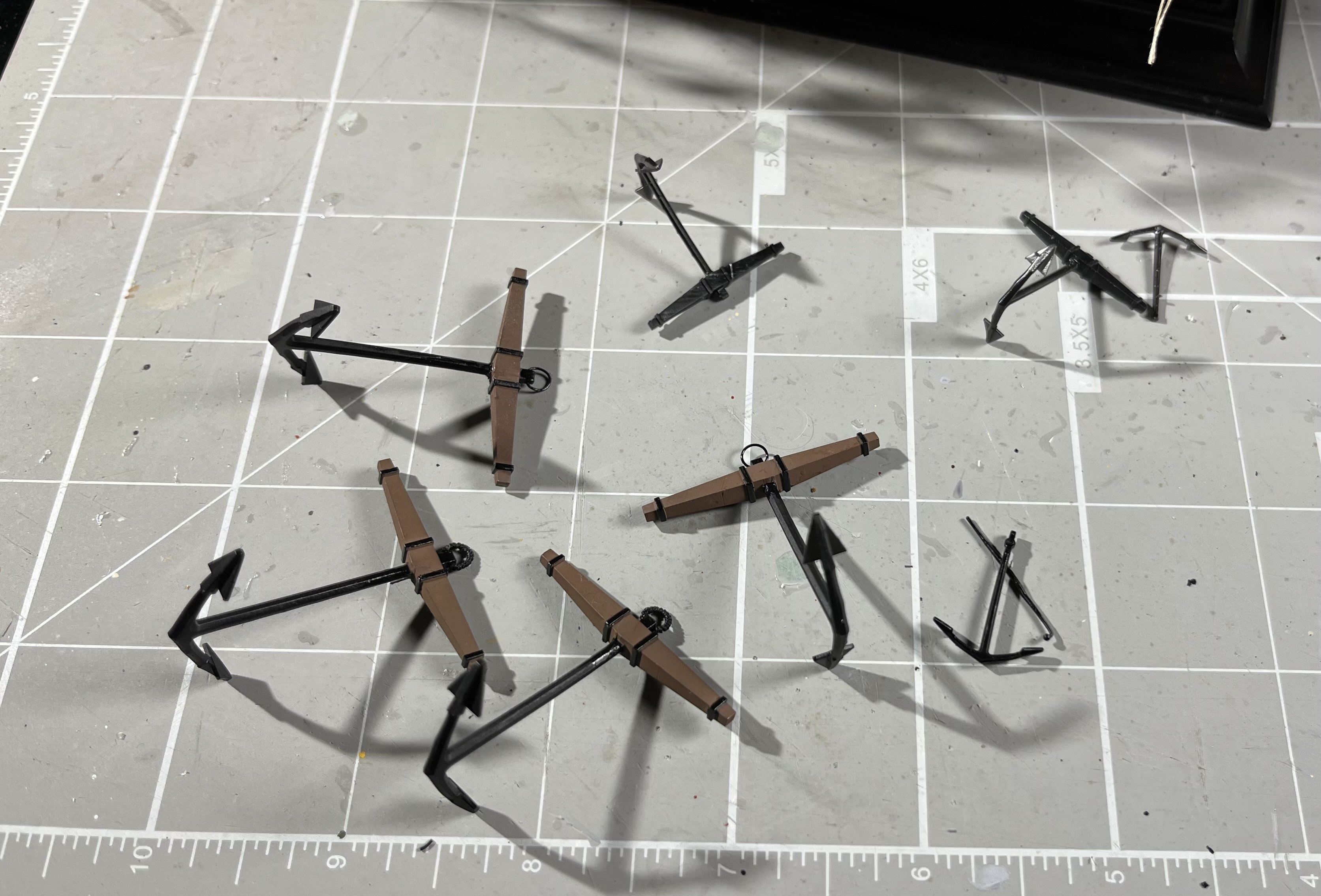

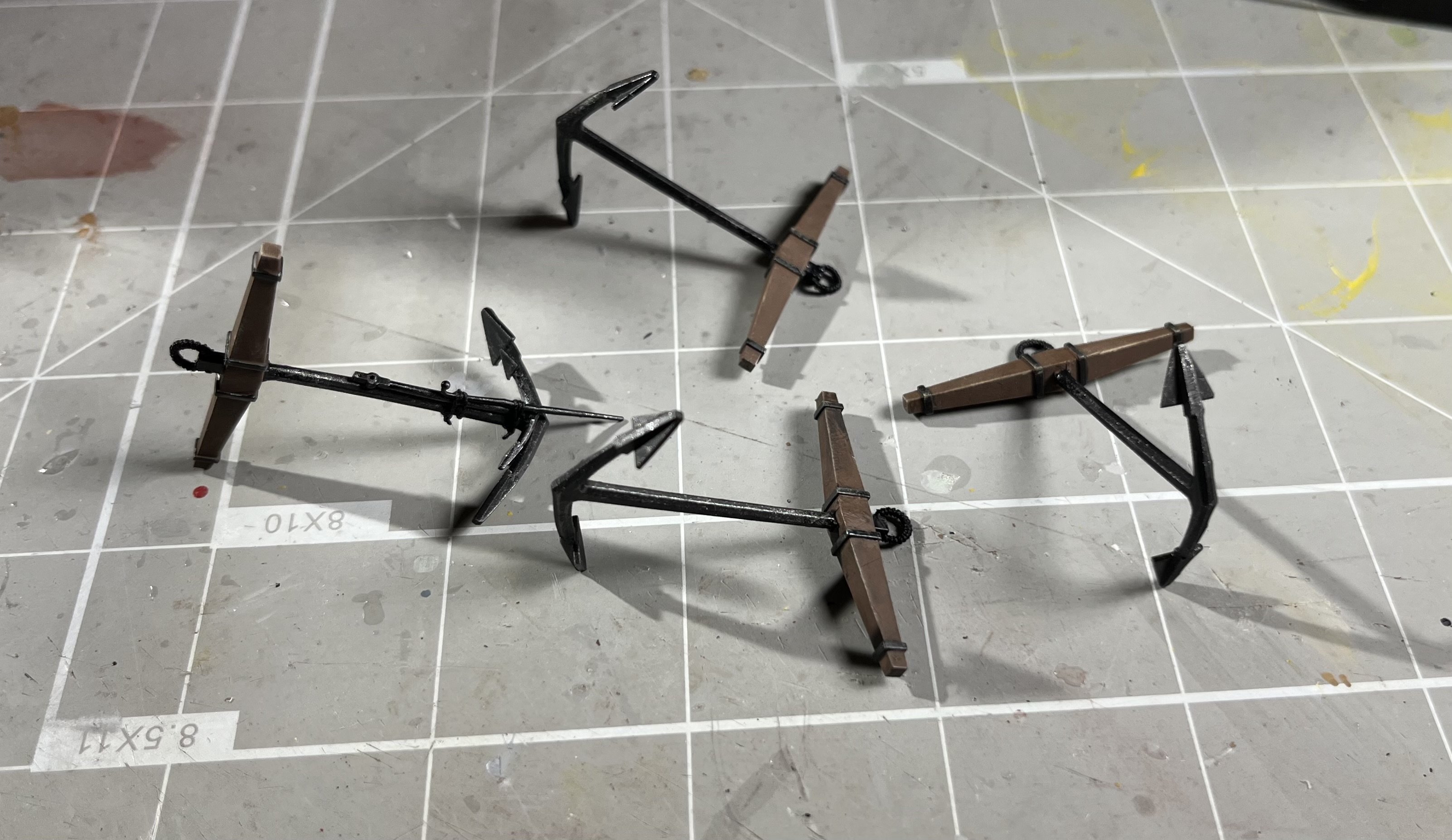

  • Finalize specs for a few other pieces to be 3D printed -- anchors, lanterns, admiral's barge, fire buckets, decorative trim pieces, etc.

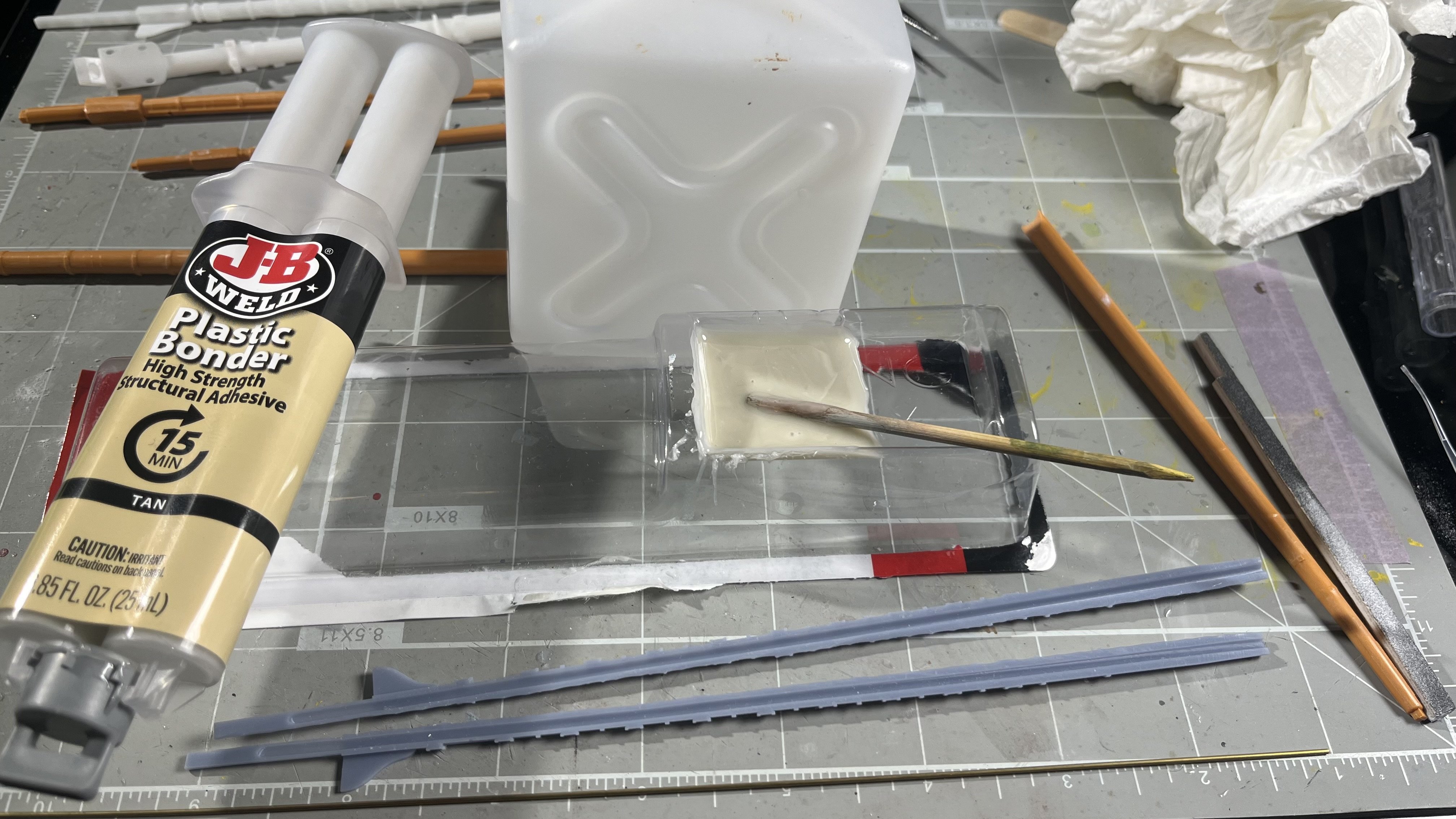

Finally, I’ve worked with @igorcap on a 3D-printed solution for the masts, using ABS plastic instead of resin.  More to come!

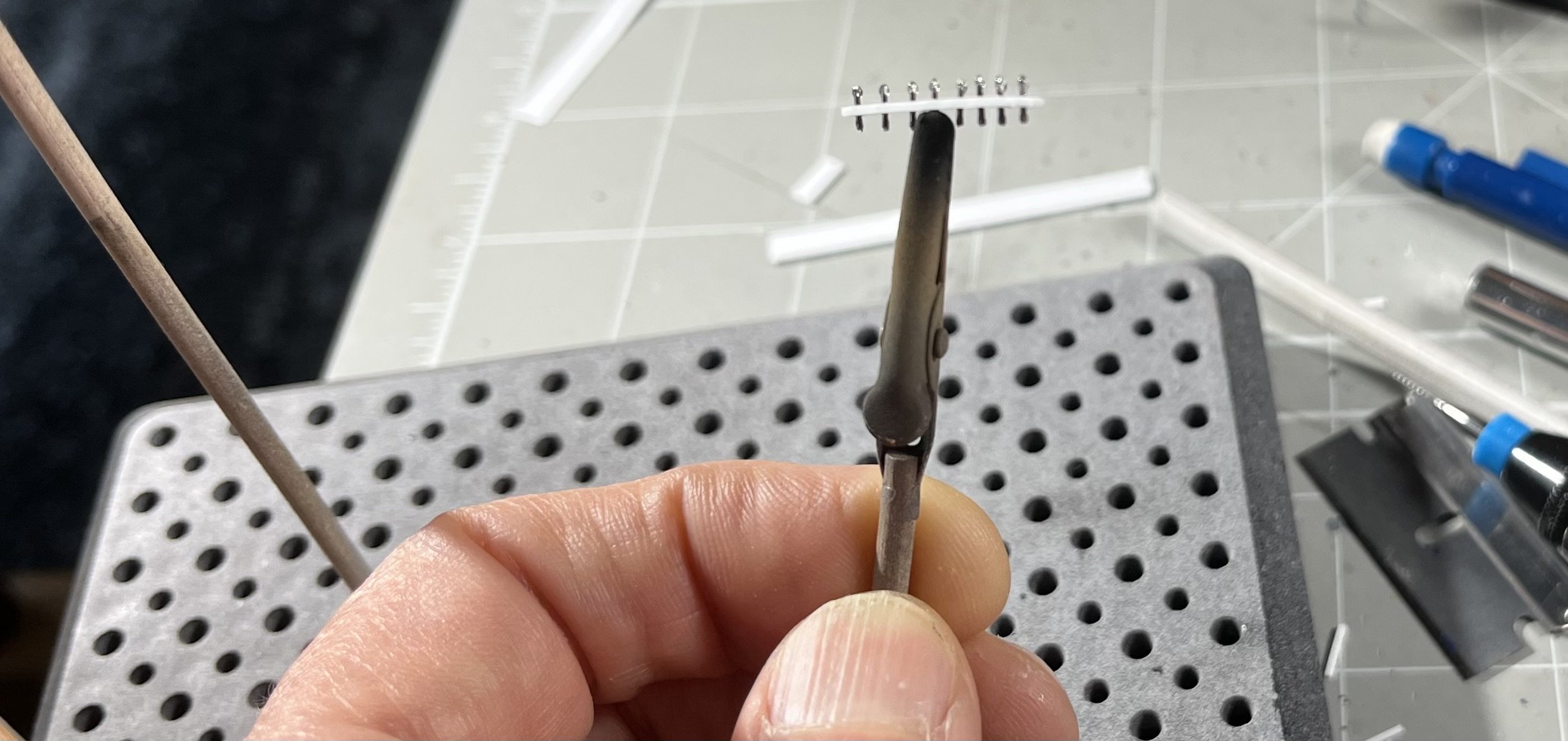

Forecastle railings from strips of Evergreen plasticard strips: railings 0.5mm x 1.5mm; timberheads 0.75x0.75mm.  Made cut-out for 24-pound gun between shroud 4 and 5, and cut-outs for carronades in front of shrouds.  Likely some creative license here as relates to exact size, placement and spacing, but I think the final result looks nice.  It works around the challenge with the crowded foremast shrouds (how to sort out the main mast shrouds is a different matter... 😕 ) and occupies some of the empty space in front of the foremast (due to the kit's/Superbe's) longer hull).

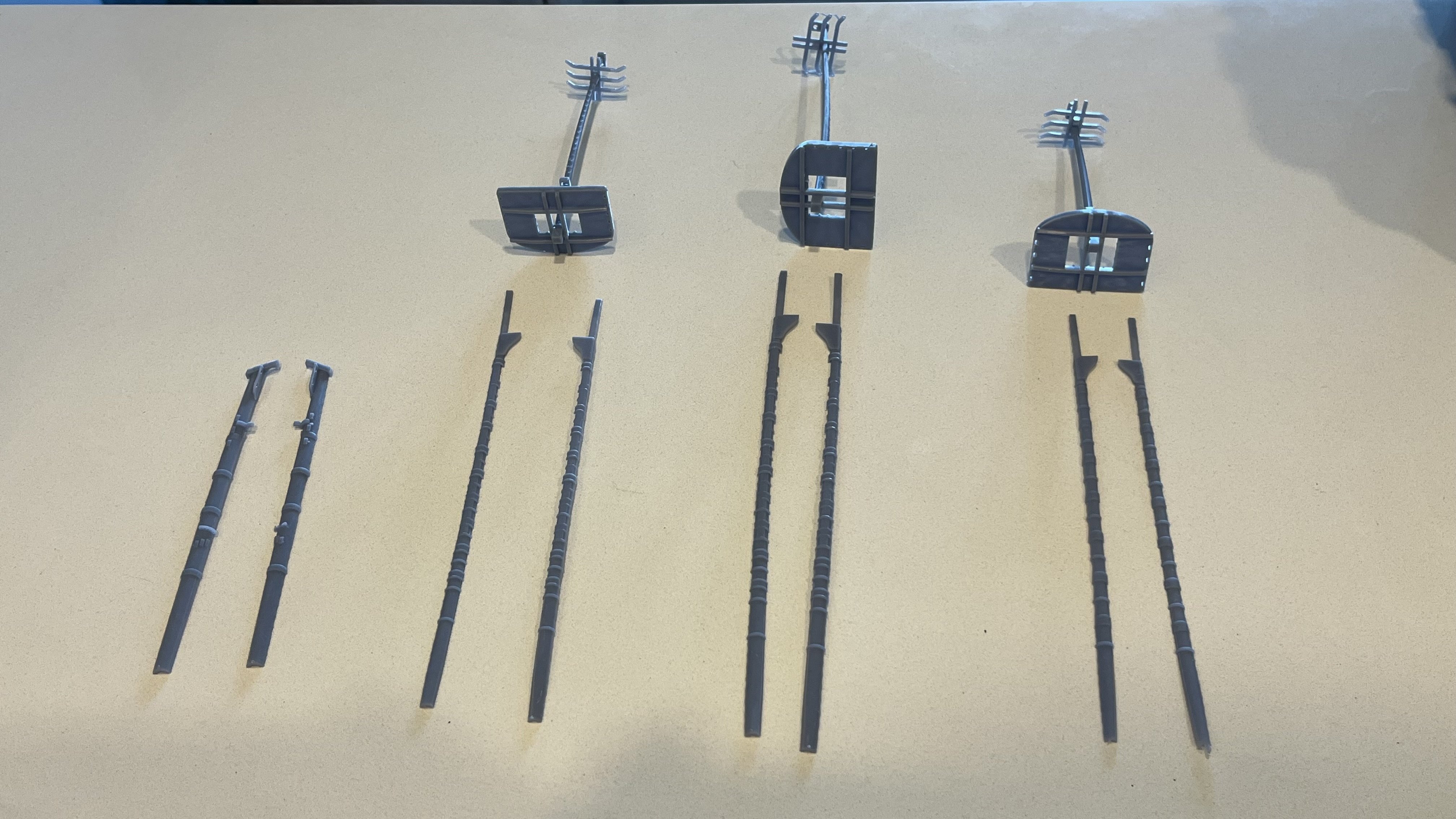

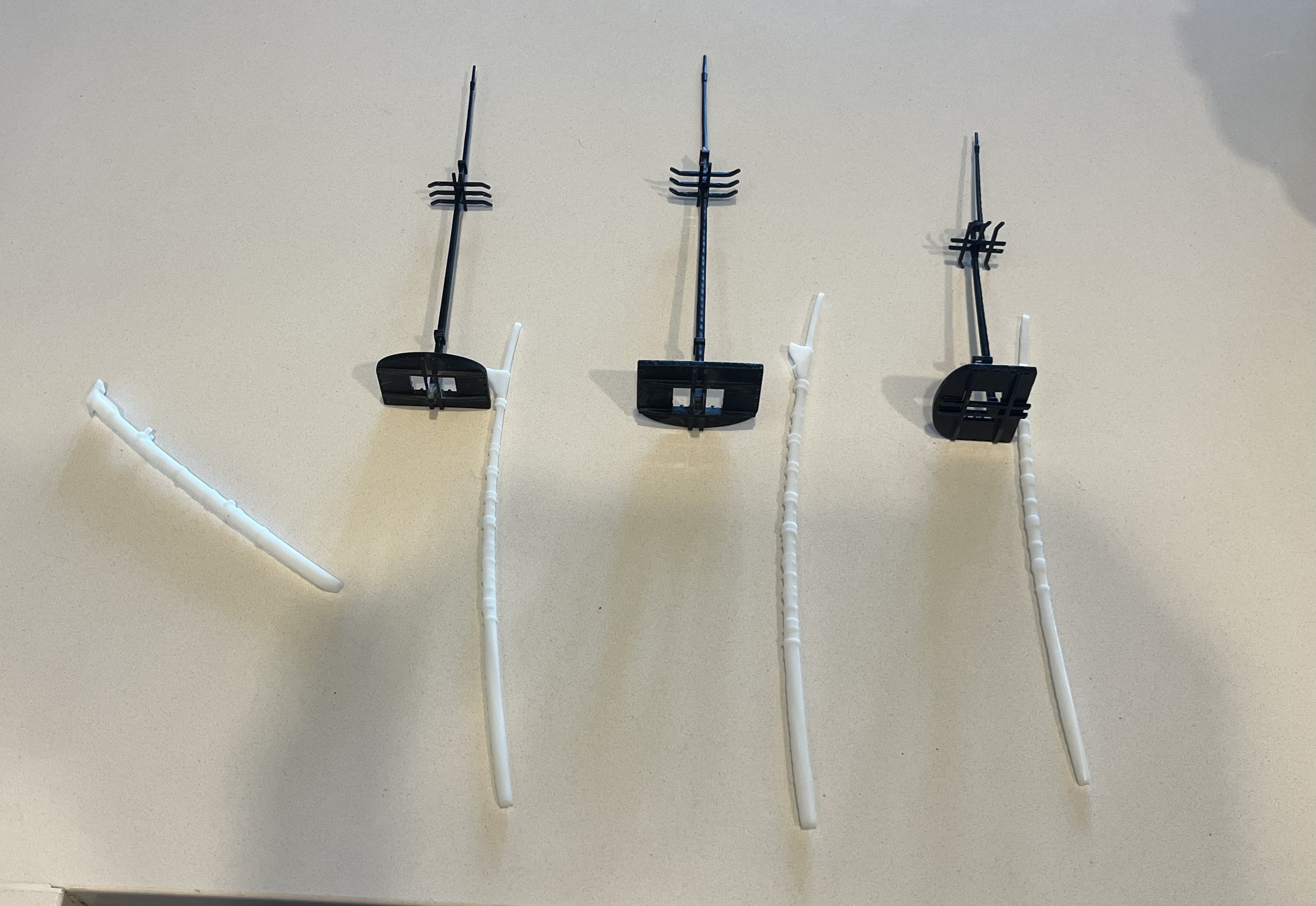

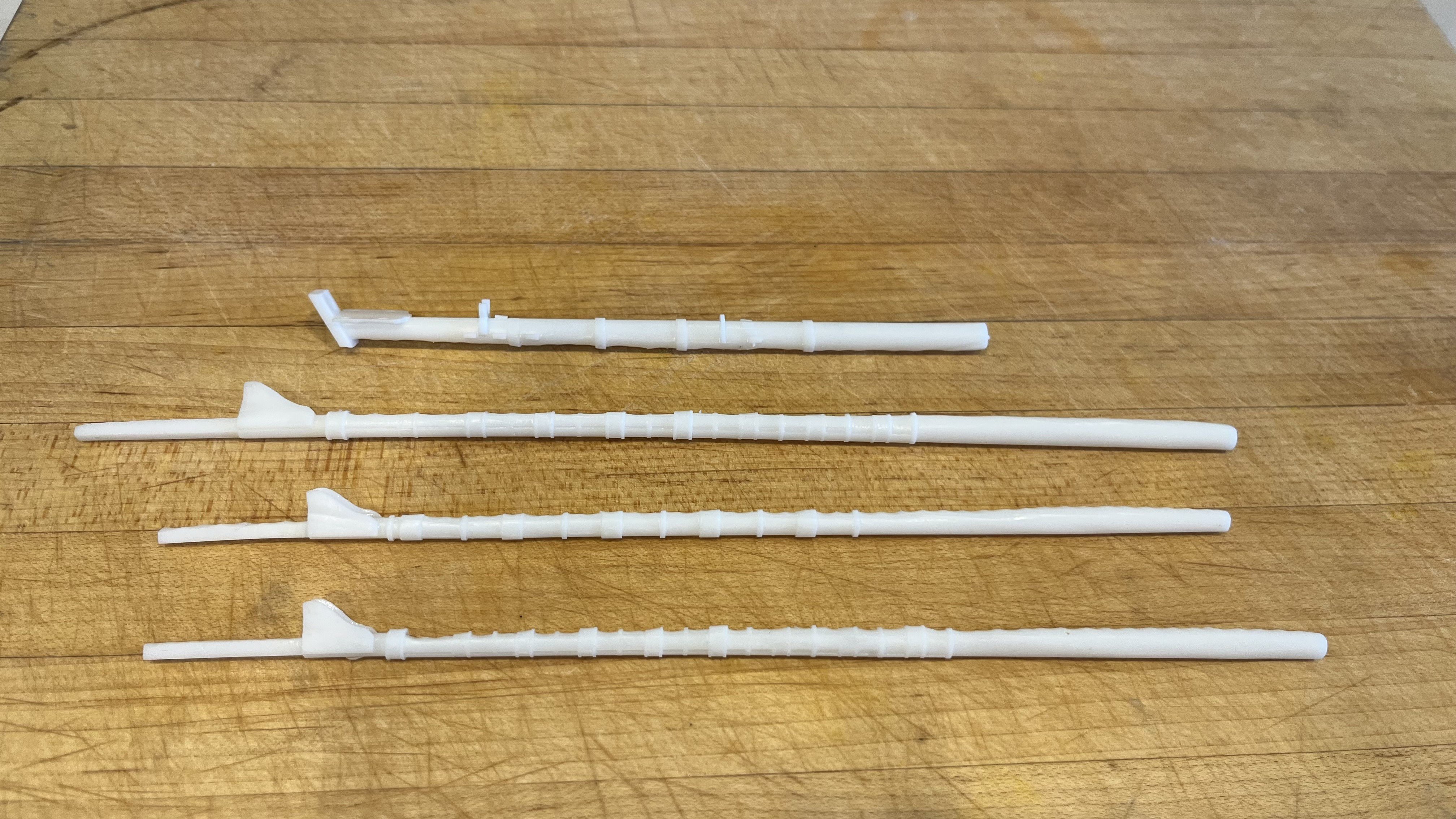

3D-printed masts and yards from @igorcap came out great!  Scale, shape and detail is vastly superior to what's in the kit.  The white resin material used for lower masts and bowsprit is quite rigid and way better than the material the kit uses, whereas the black ABS material used for top masts and topgallants (and yards) is slightly better.  We'll do some more testing and iteration to confirm warping/bending/integrity won't be an issue when under tension from rigging, but very encouraging first pass. IMG_2031.thumb.jpg.90831afb58cd744464ec682fb96e5bd0.jpgIMG_2032.thumb.jpg.78567b5f202a4029af74a4684bfce04c.jpg
Igor also helped provide some additional details, e.g. cat heads and stem decorations; 1:150 lanterns, anchors, fire buckets, etc. IMG_2033.jpg.7887113e8f7d1171be9797ec606bf0ad.jpg

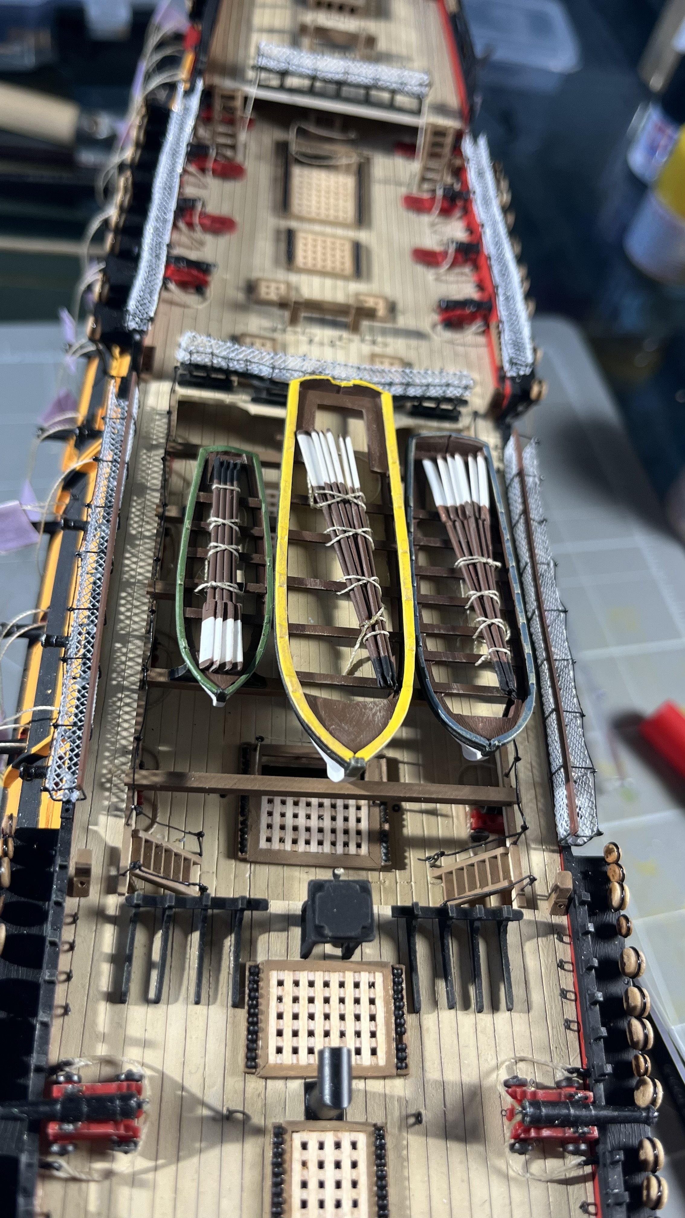

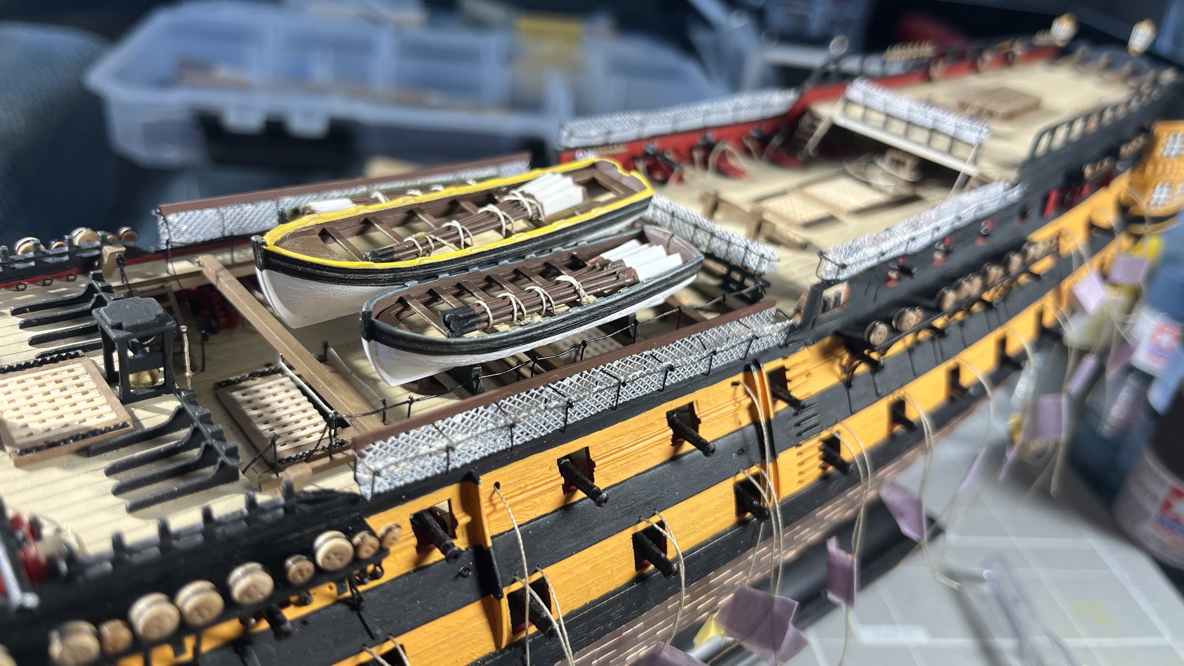

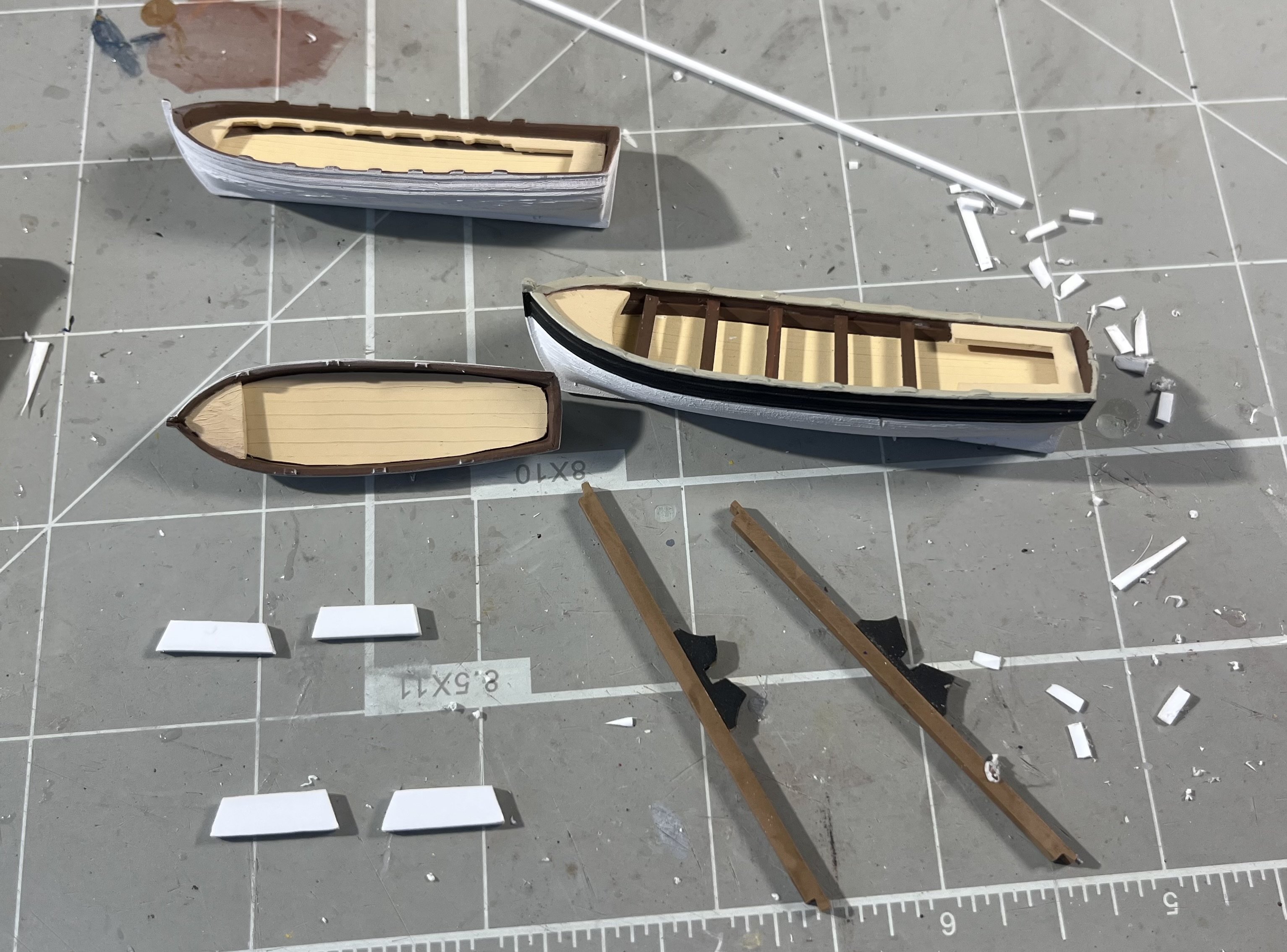

Referenced Lavery's Bellona to add five boat booms, resting on top of and held in place with brackets.

Work on quarterdeck, poop deck and waist fittings continued this week, the end of work on the hull is in sight!  Trying an alternative approach for masts, stay tuned for update.
Hammock nets for waist, incl. hand rail
Gun port lids for stern chase guns
Made skylight from 0.5mm plasticard.  Cut out the windows rather than try to build a mesh from separate strips.
Cut off the five standards in the kit piece and replaced with four from 1mm plasticard
Belaying kevels and mizzen bitt
Everything painted and assembled, added eye bolts.  Poop deck looks kinda empty without carronades, no?
WIP poop deck railings
Done!

Waist hammock nets and boat booms in place.  Experimented a little with making the hammocks themselves out of white styrofoam packing chips, will need to think of something else.

This week marked the four-month point of the build, and I'm a little over 500 hours in.  It was also the week when I completed the hull!  Well almost -- there are a few more eyebolts left to be attached to the hull (technically probably part of rigging?) and attaching the stun sail booms (also rigging, technically?) to the channels.  Anchors need prepping and mounting, I haven't started the ships boats (technically, probably not "hull" either), and I'll do the gun port lids last.  But other than this relatively short punch list, I'm really happy with the progress!

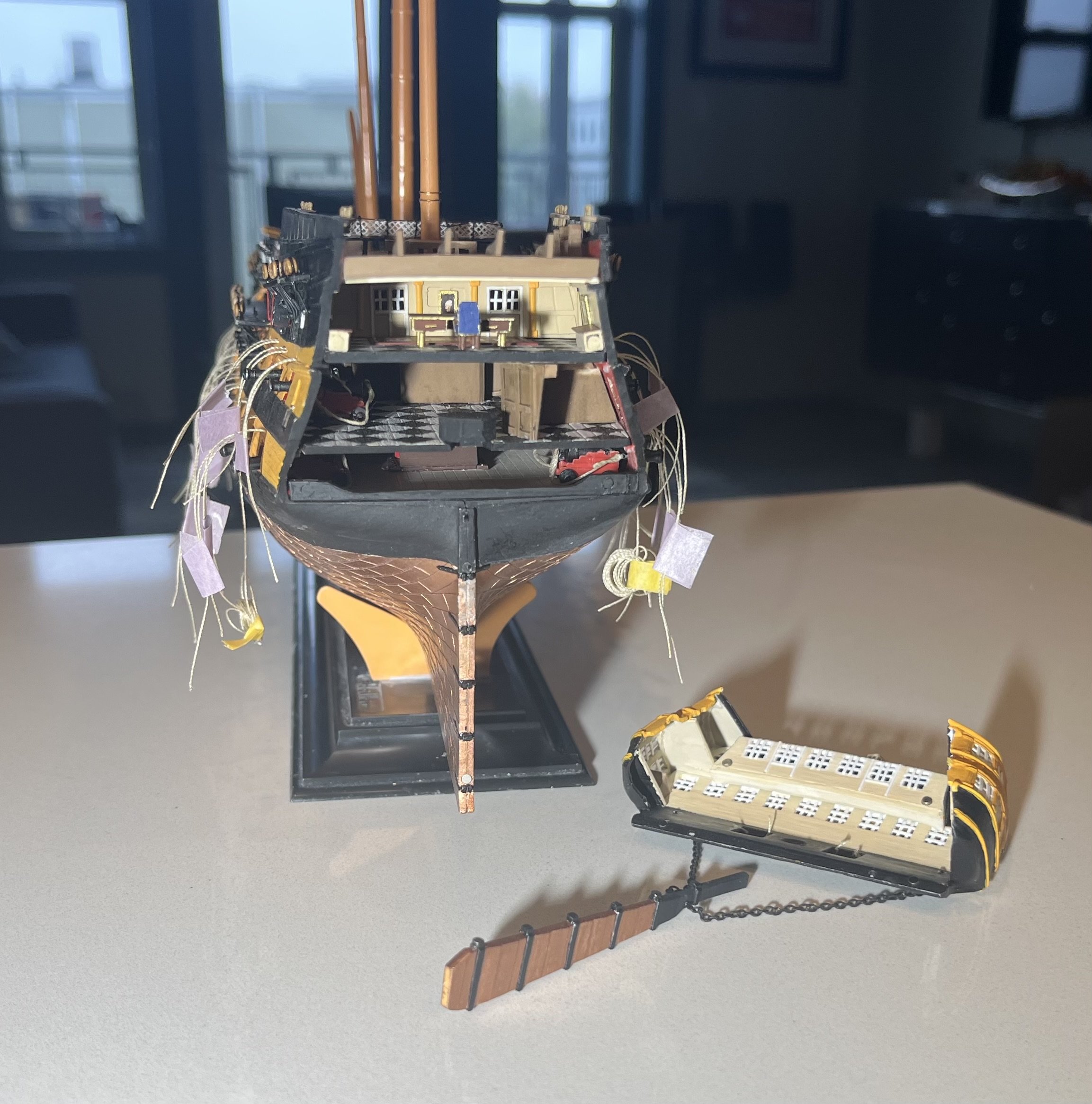

Week started with glueing the poop deck in place, forever hiding all the interior details of the quarter deck... I needed to shave down the poop deck railing (using a small hobby planer), possibly I could have taken off another mm or two?

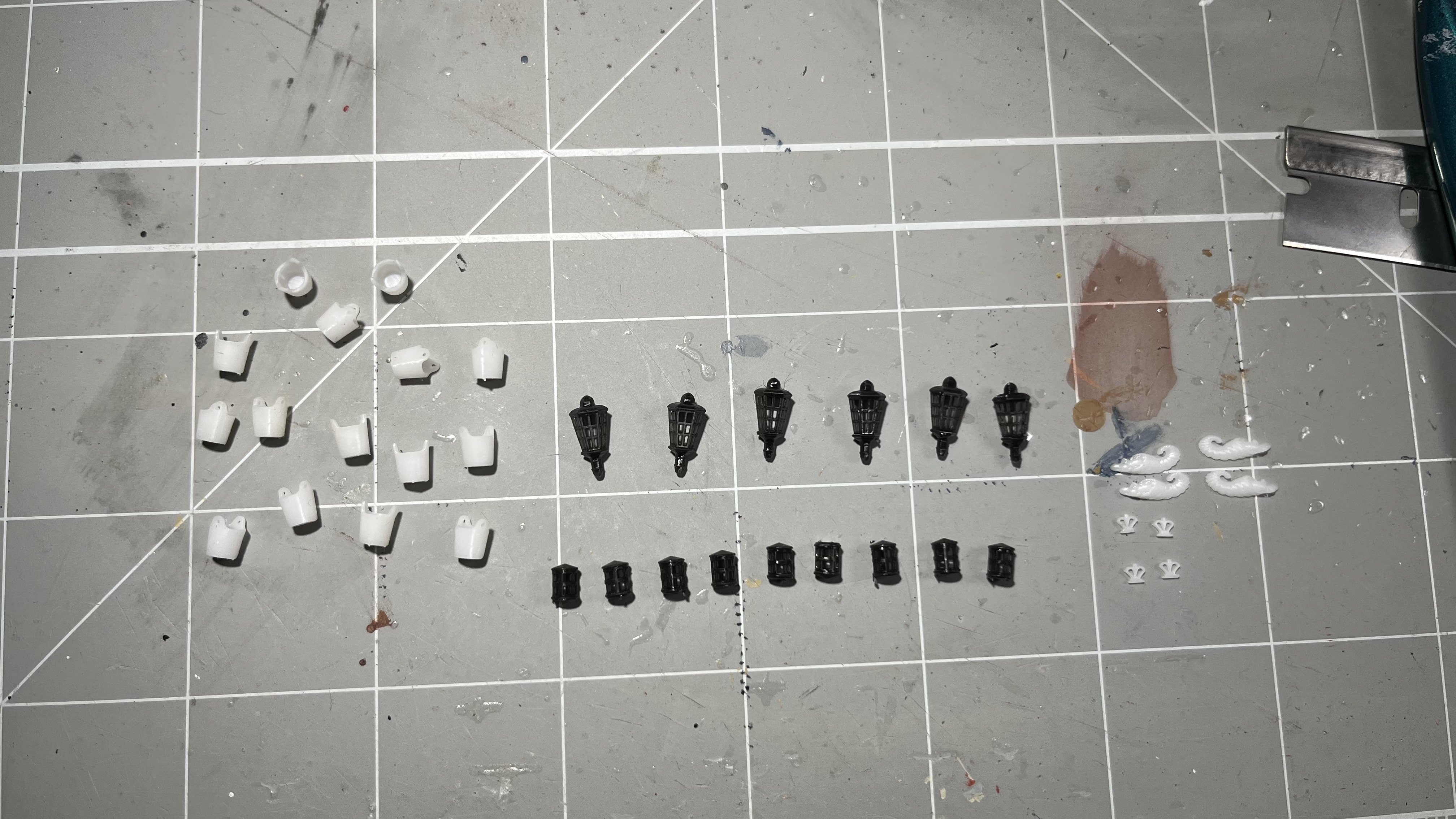

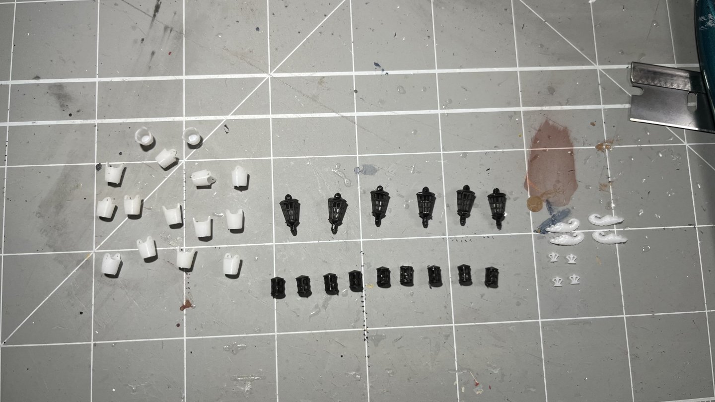

Lanterns, fire buckets, trail board and cat heads 3D printed by @igorcap thankfully, he provided a double set as they're fairly brittle + required a bit of customization/experimentation, so great to have a few spare pieces for experimentation.
On the quarterdeck, I used the belaying pins & rails from the kit, which didn't come out that great.  They're too small to use for rigging at this scale, required a lot of cleanup, and don't extend far enough out from under the hammock nets. For the poop deck railing, I decided to scratch build from plasticard and sewing pins; with a dab of CA to make the handle.
Lanterns painted and attached.  Experimented a bit with placing decorative trim on the roof of the quarter galleries, eventually decided against it.  May come back to this later.  Added the little "mini channels" for the mizzen backstays, and eyebolts on all other channels.  I spaced the stanchions for the handrails without making gaps for carronades, thought it would have looked weird and given her a "toothless" look with empty gun ports.  (Decision to skip poop deck carronade discussed elsewhere in this and other threads.)
Painted and attached the rudder chains, and topping lifts for the rear chase ports.  I assume none were needed for the lower half?  At some point, may get back to score the stern transom planking -- advice for others would be to do this before painting and assembling the hull...
Quarter- and poop deck finalized with wash and highlights, with kit's masts dry fitted. Removed the trim from roof of quarter galleries, added hammock net for rail at break of poop deck; ladders, and hand rails.

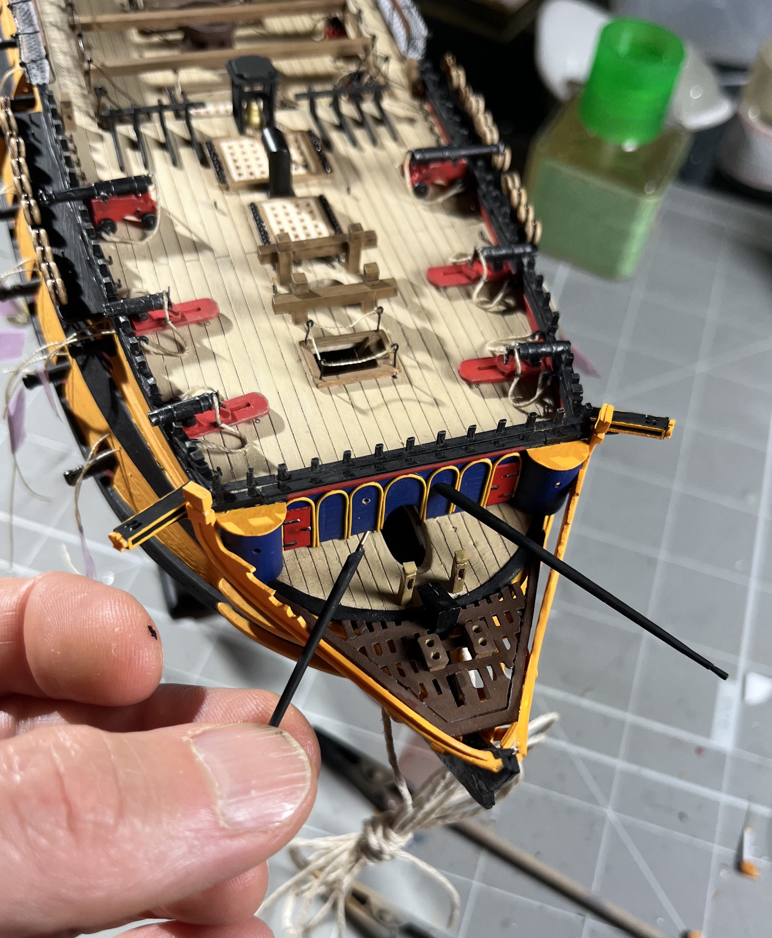

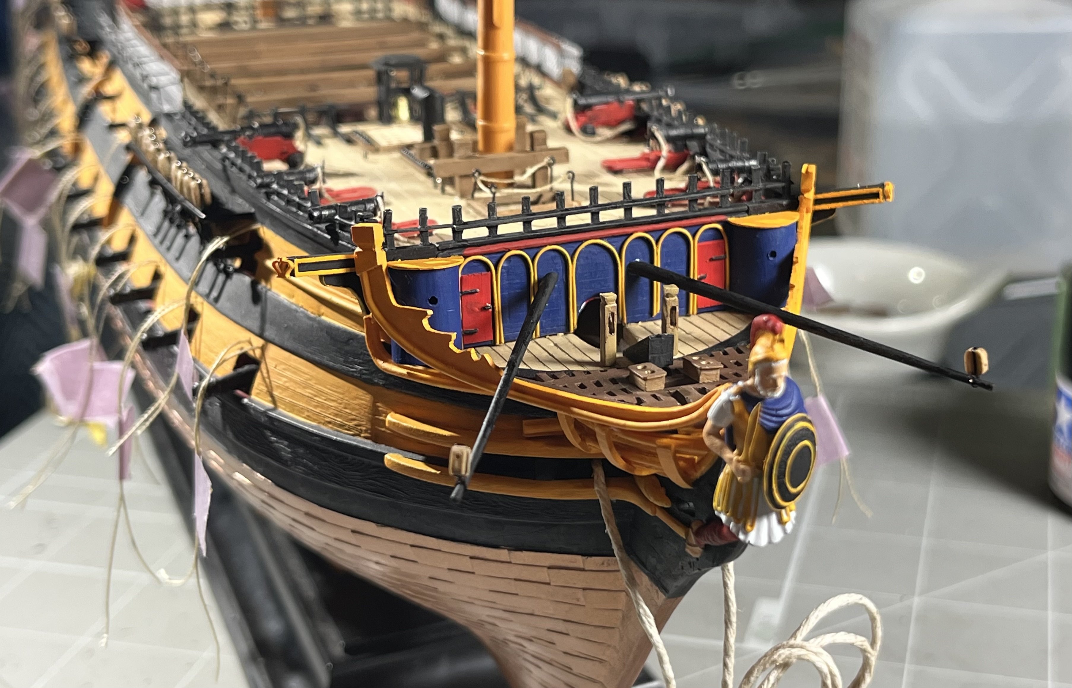

On other end of the ship, scratch built cat heads from a 2x2mm plasticard square profile, using 0.1mm x 0.2mm strips for decorative trim, and 3D printed crowns.  I used the kit's sprit topsail yard cut in half for boomkins.  Shaved off the tip to make a reverse cone shape, and inserted a piece of 24gauge copper wire in the other end for stability.
@igorcap's horn-of-plenty trail board snuck in snugly between the cheeks.  Figurehead and the kit's bowsprit dryfitted.  All will eventually get a wash/highlight, but I've decided against any additional paint in the hair bracket.
The single blocks at the tip of the boomkins were the smallest I could find from Amati, 1mm single blocks.  They still look a smidge too large, and a little too square/blocky -- suggestions?  Tumbler?  Knightheads look a bit skinny, may make new ones.
Still need to attach the boomkins stays, but my last 0.4mm drill bits broke so couldn't drill holes for the eyebolts 😕 I've gone through a total of ~50 of the 0.3-0.6mm drill bits now -- they break very easily when drilling through the kit's plastic.
The feature to attach the rudder and stern with hobby magnets worked great, four for the stern, and two for the rudder (can you see them all?)  It's possible to see along the entire length of the lower gun deck, but upper gun deck and quarter decks are blocked by bulkheads.IMG_23041.thumb.jpg.79e44a49056a392915c997a18803f139.jpg
Edited by PqLear
Worked on anchors and ship boats this week, just got the new set of 3D-printed masts also so will work on these next.
Anchors were 3D-printed by @igorcap, look great when painted, washed, and dry brushed.  Added loops wrapped with rope.
Kedge anchor attached to one of the anchors.
v1.0 set of 3D-printed masts looked great but warp/curve got worse over time. Thinner pieces -- yards and top masts -- worked great without warping.
In v2.0 set, masts are split in two halves and hollow, allowing for a stabilizing/straightening metal rod to be inserted.  IMG_2447.thumb.jpg.b240c9462c63cd8ef4fc0a6dcbef4d42.jpg
Using a 1mm brass rod for the masts, and a 2mm copper tube for the bow sprit.  Two-component, slow curing epoxy will expand to seal any gaps between two halves (I think/hope).
As per Lavery, the Vanguard left England with four boats but lost one in the storm May 12, 1798.  So, the three boats from the kit will have to suffice :)  Aside from the hulls, a few more pieces can be reused.  Started with prepping with plenty of filler for injection artifacts.
Made oars and decks from plasticard.
Assembled and painted, also made stands for the boat booms.
Final assembly, with a light coat of umber wash and light beige dry brush, tied down oars.
Still dry fitted, will wait with glueing anchors and boats in place until rigging is done.
