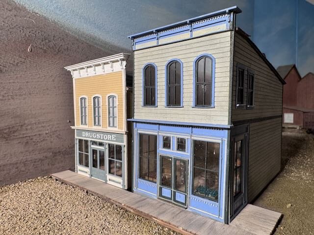

And here are three views of the finished building:
I like how this color scheme came out. Not too bright, distinct from its neighbor, but sharing a hint of the same color palette so they don't clash.
I gave this one a generic "drugstore" label. I hadn't found the Dimmitts photo when I lettered this, but even if I had, I wouldn't have used the name since I also found an exterior photo of the real Dimmitt's and it's a brick building. I might letter a more specific name up top, or just leave it be.

 The drugstore turned out great and the colors are perfect, Eric. 👍

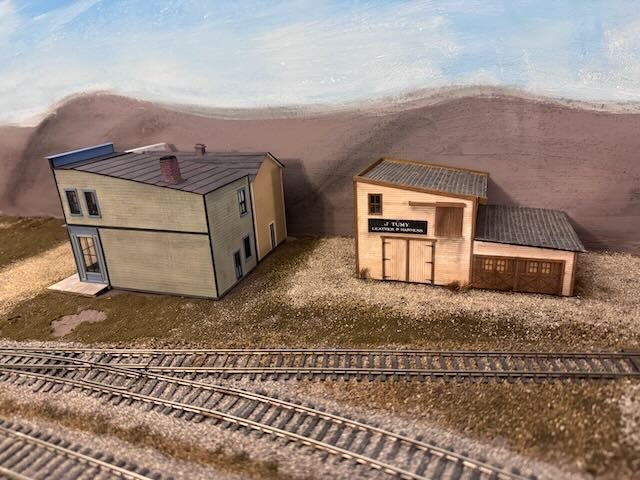

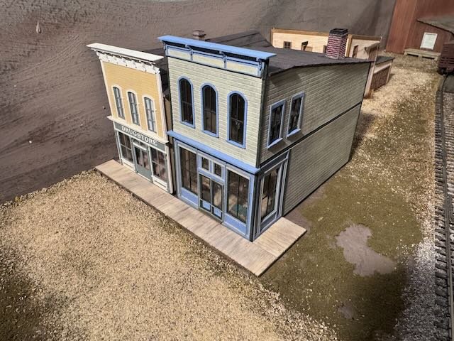

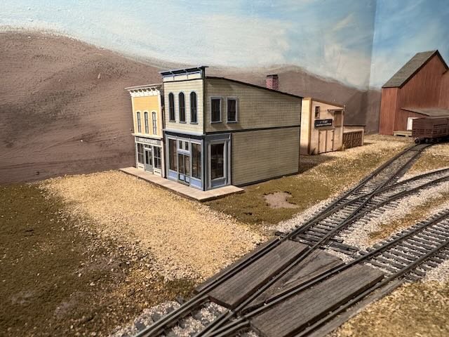

OK, here's this pair of buildings set loosely in place, with their wooden sidewalk. These aren't attached permanently and I haven't done any blending of scenery around them or the sidewalk, but this gives the visual context of their setting.
You can see how the drugstore building sort of hides behind the other one, but I want that other one in the foreground because of the larger windows. At least that's been my assumption. Two more views:
This shows how you can see enough of the interior to tell it's not an empty box:
And a view from the back, with a nice alley:
 They look great next to each other and the placement is perfect. Larger in the fore and smaller in the background giving a sense of visual diminishing scale. 👍
