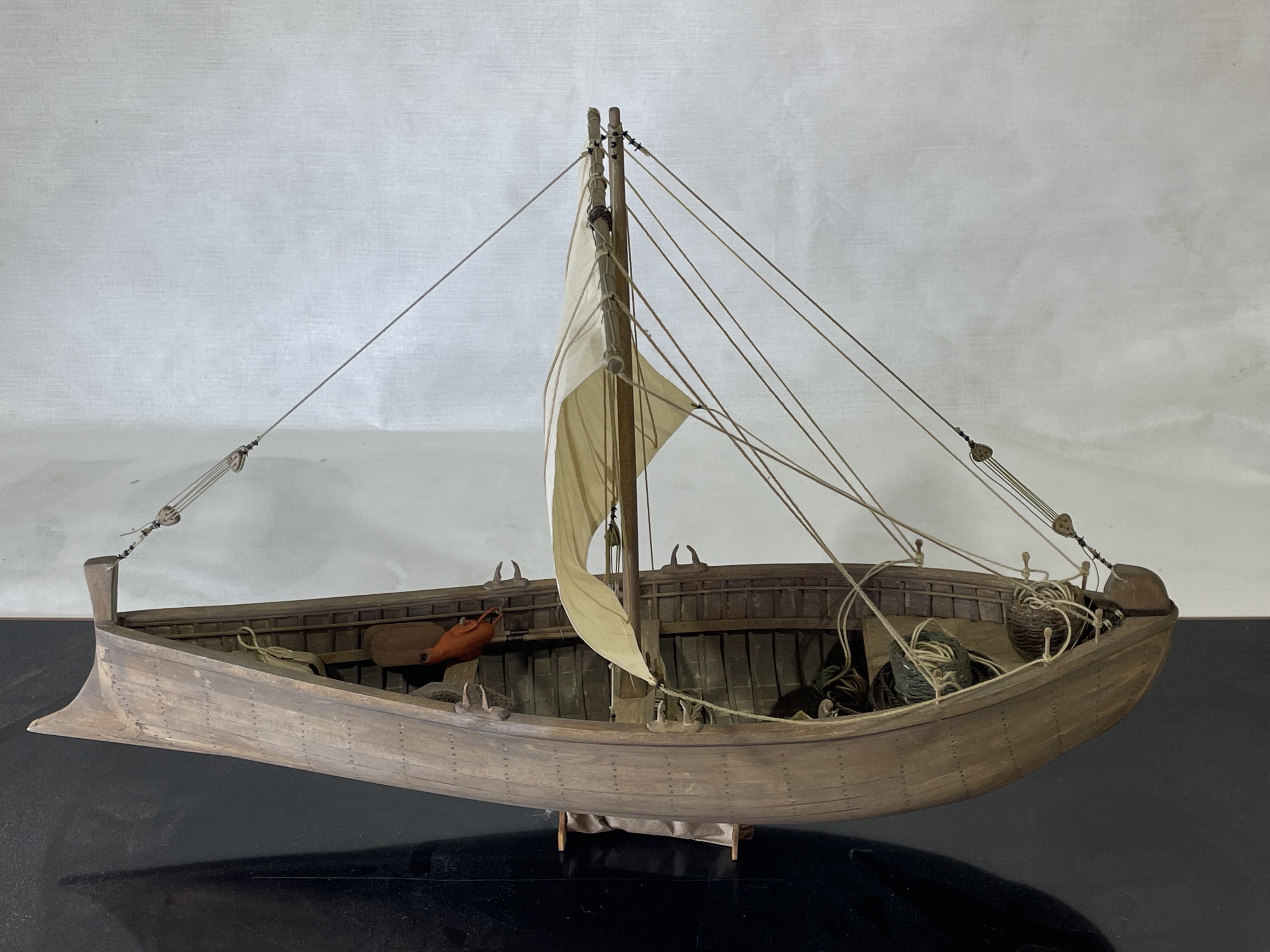

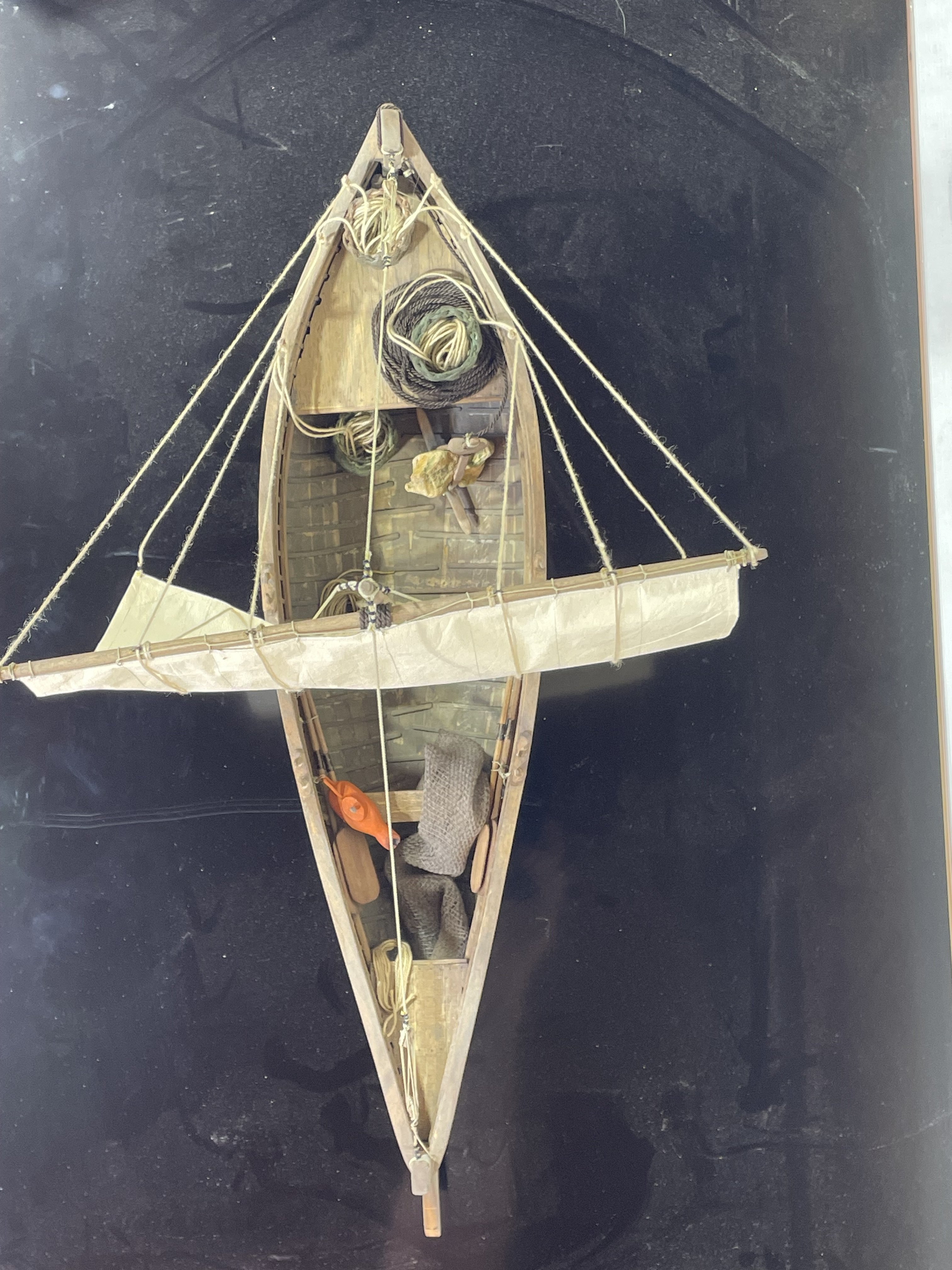

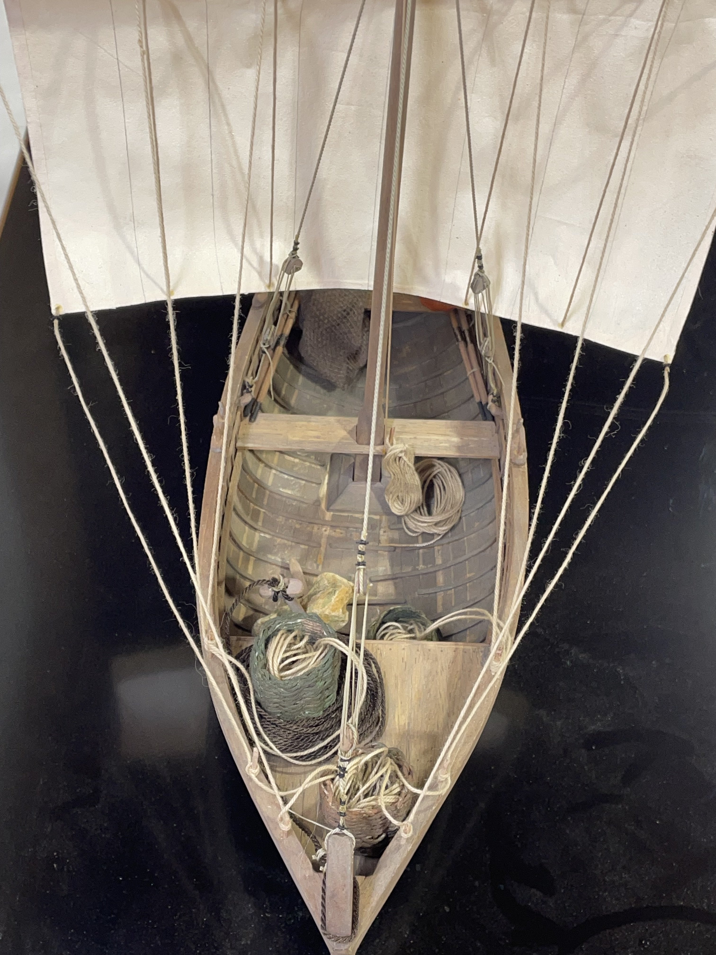

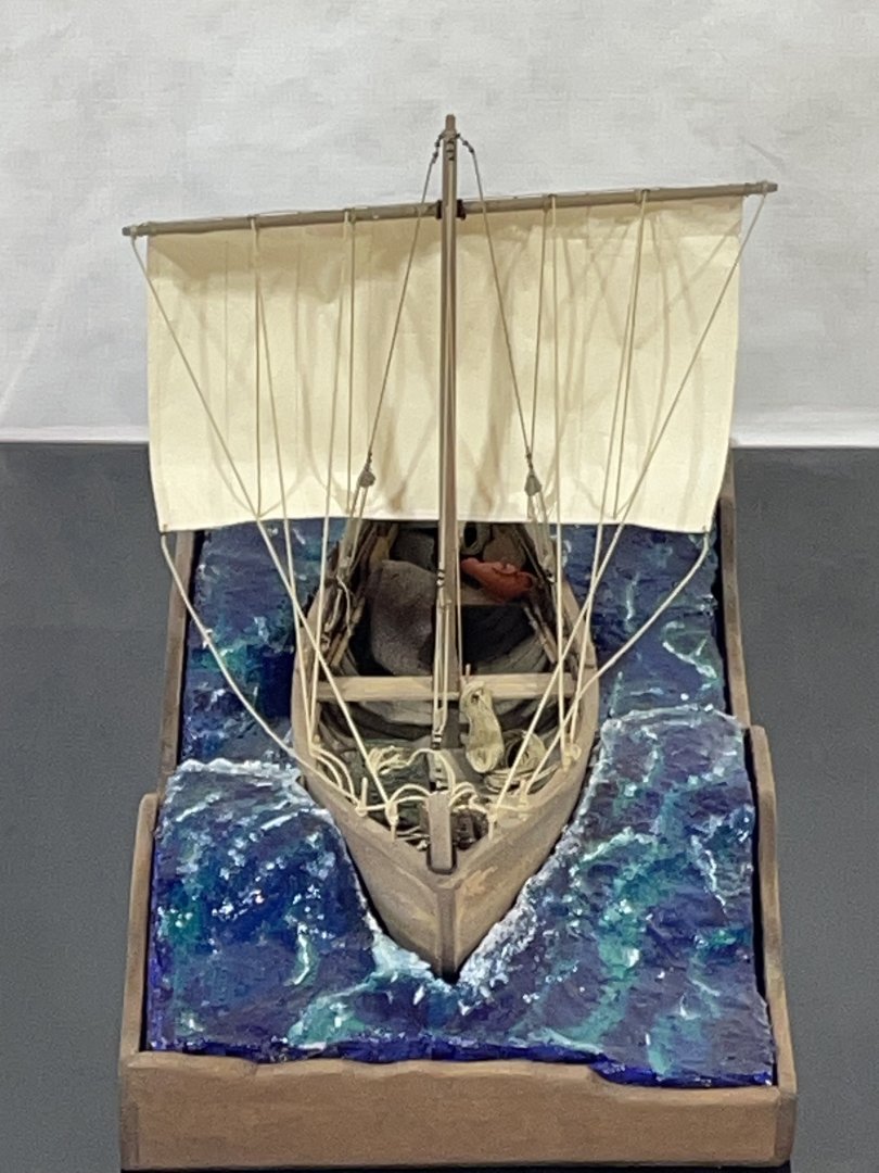

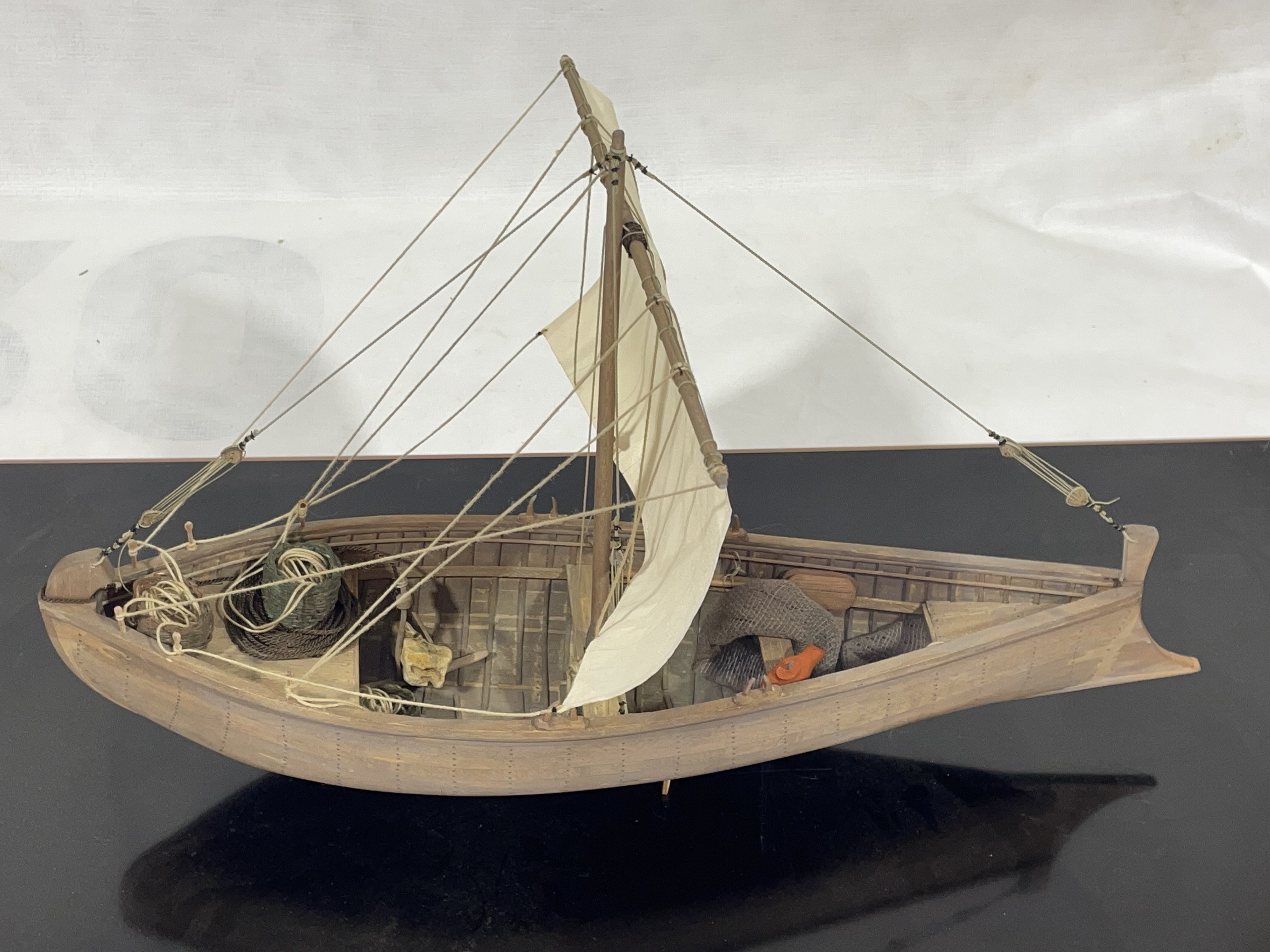

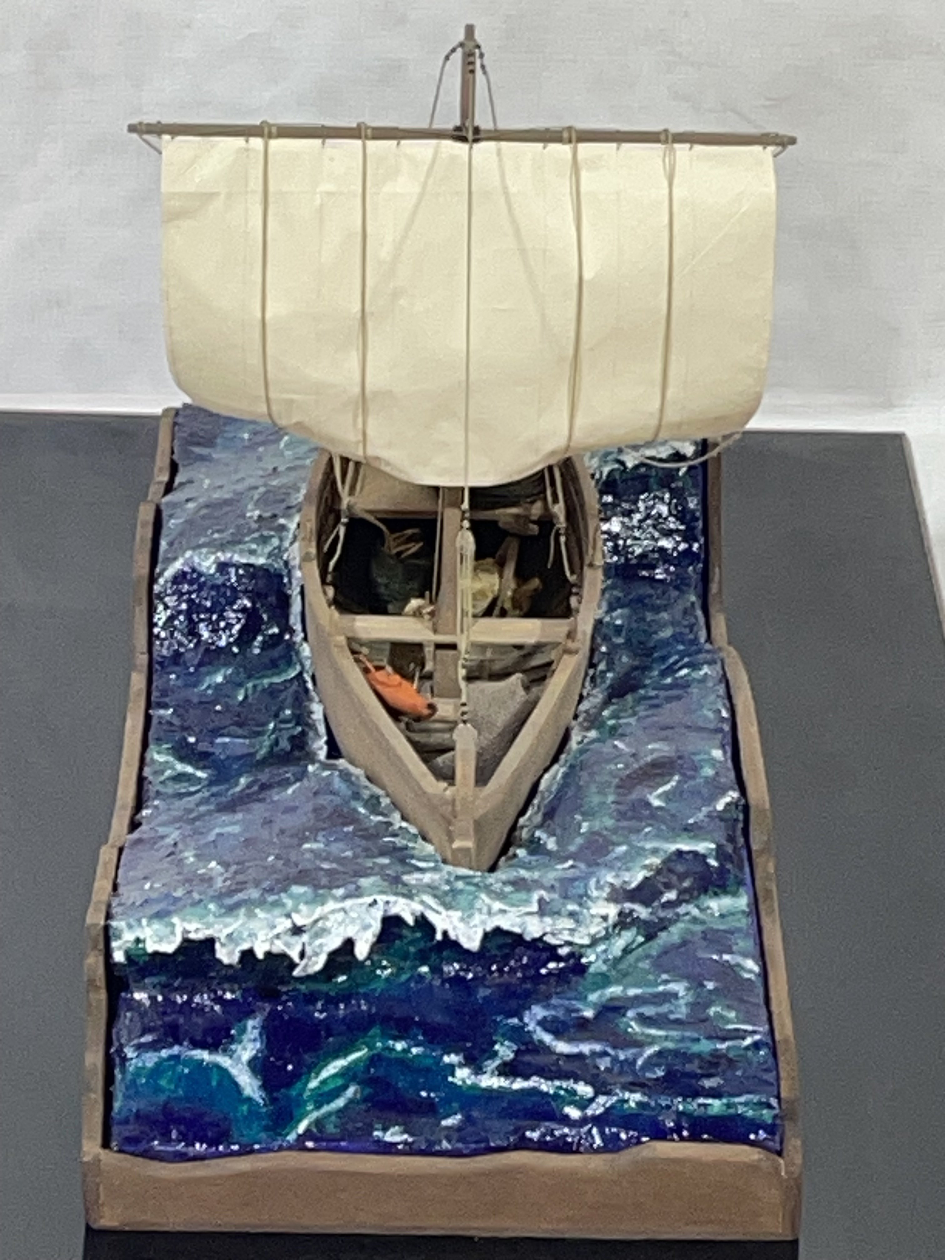

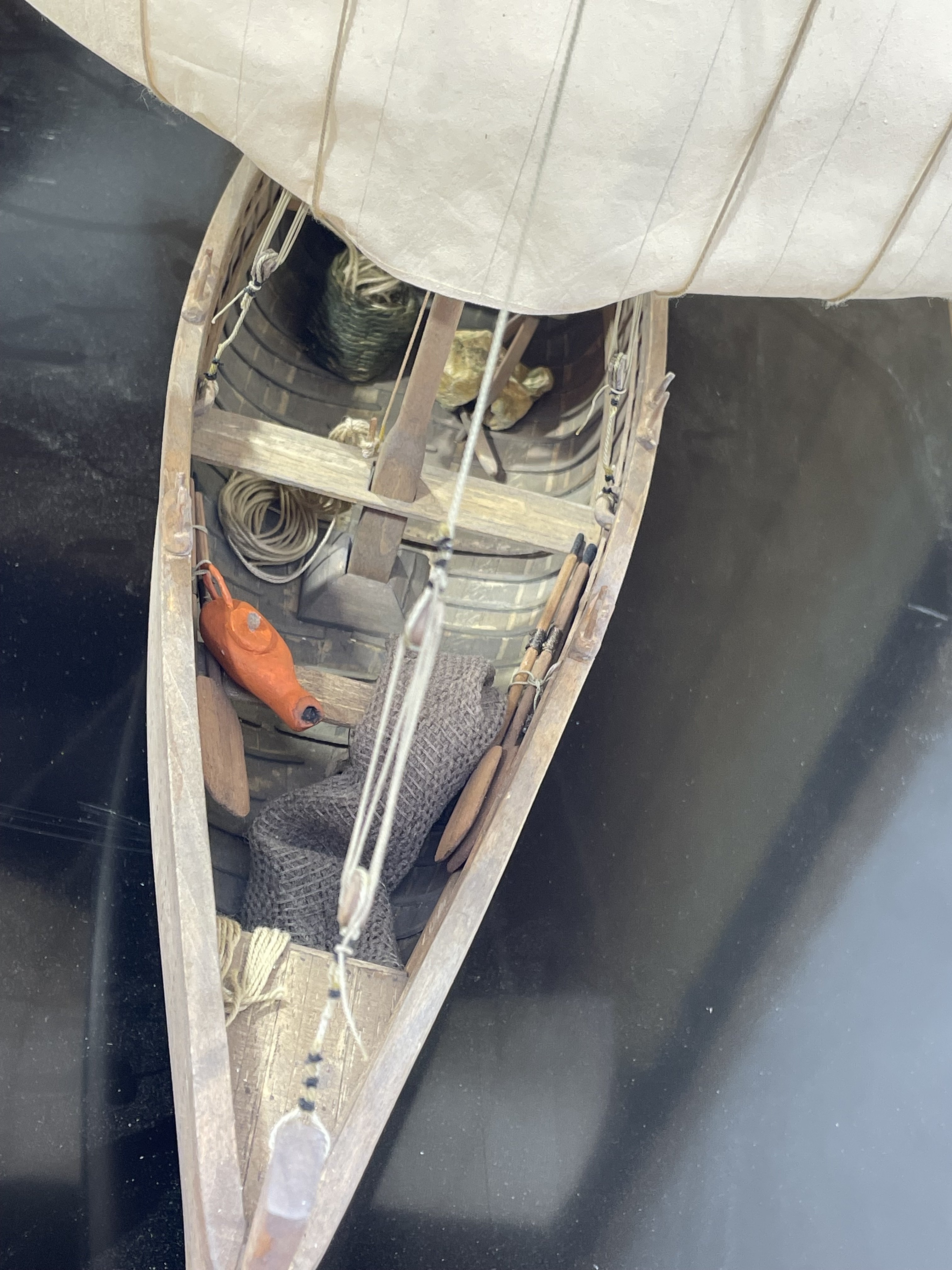

All good times must come to an end. The Kinneret is completed and sailing out of the shipyard this week. Here’s how she looked.

 Congratulations, Bryan. A great build of a simple boat.
Awesome work,  Congratulations  ,  Bryan.

Excellent model of an interesting subject. The morticed planking is a feature also found in much older vessels such as the Kyrenia ship (4th cent BC) and is also thought to have been the construction method that enabled long slender ships such as the fast Triremes of the 6th century BC to be built (effectively stopping the planks from sliding over one another and making the planking into an effective engineering shell able to withstand the high sheer stresses in such a vessel). (Ref The Athenian Trireme, Morrison and Coates)
Also interested to see that your rig has a similar system of brails as fitted to the Trireme reconstruction Olympias.
