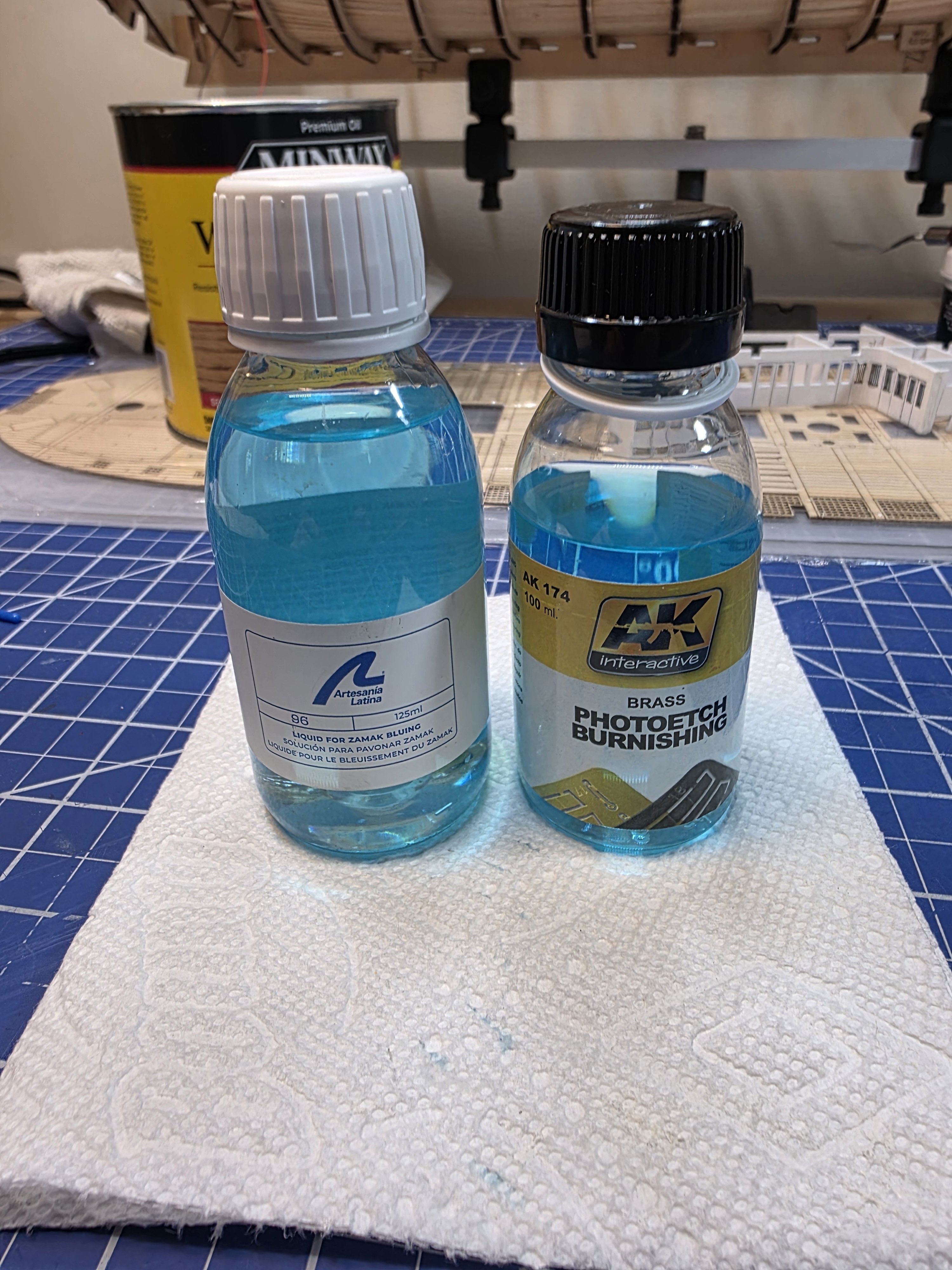

I ended up scrapping the brass black as it was just too messy.
I tried a couple of different ones including the Art Lat and AK versions. Both of these worked very well but I leaned toward the Art Lat version as my preference as it was the easiest to work with and produced very little residue.
And here is the completed structure. I really struggled with the hinges and door latches as they are very small. It was very difficult for me to see them and so there are a few not well placed. The door latches were so small that I couldn't clearly see how much of the part was the actual part versus the photoetch sheet attaching points. Thankfully most of this will not be seen at all. On to video 9.

I appreciate your view. Its really situational for me, Some I paint, some i blacken. I painted the smaller parts, hinges and door latches. One of the issues I run into is the paint flaking off from parts when there is a need to bend the part as with the windows. The primer stays on nicely but the paint layer wants to flake off when I bend the part.
With the blackener, I first soak the parts in alcohol for a little while. Then I treat in the blackening agent twice, cleaning in between the two treatments. no issues at all with the color coming off after that.

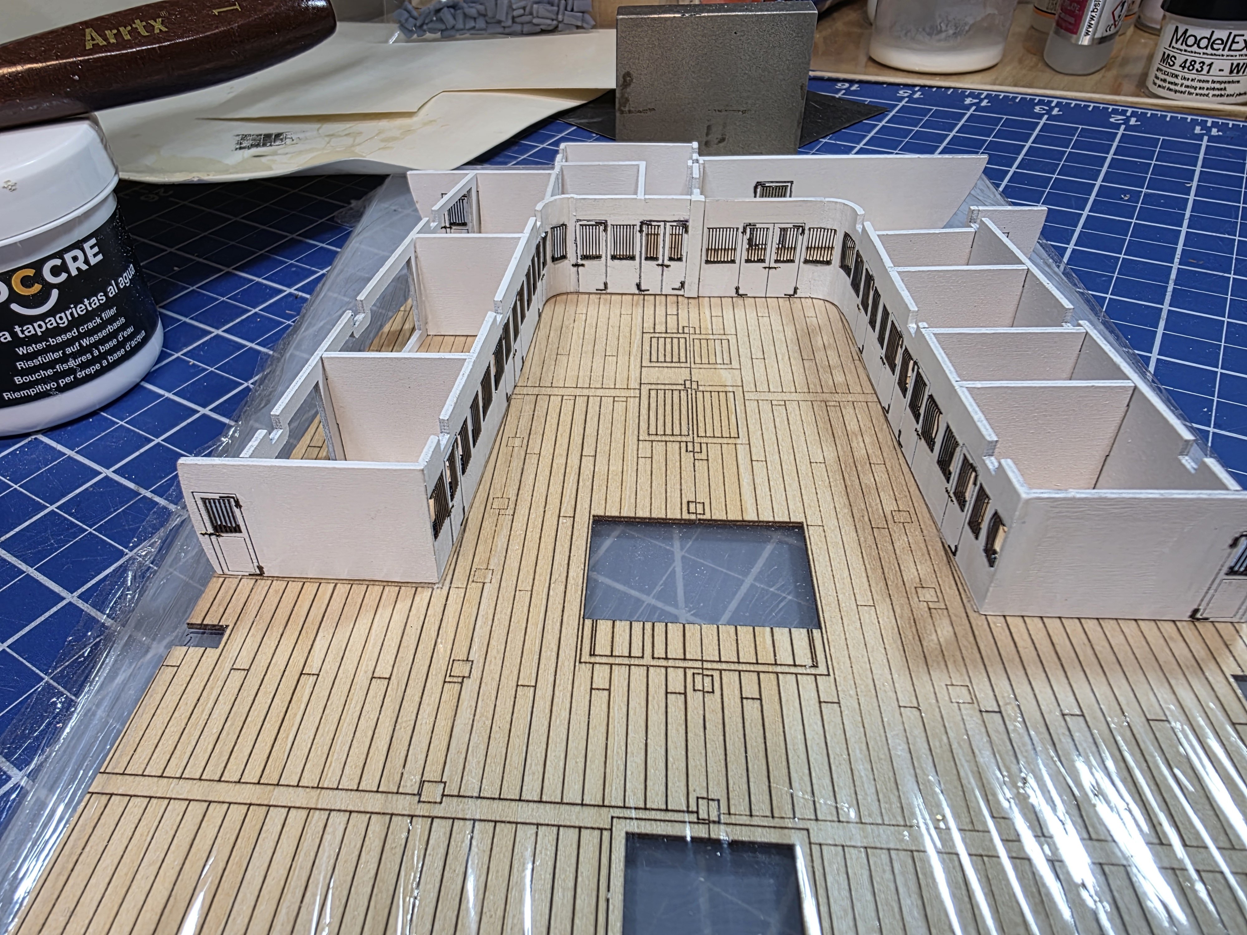

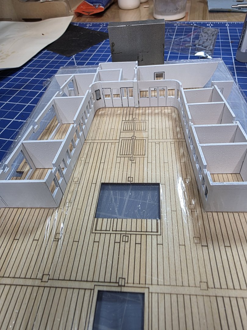

Video 9 is complete. This structure was a bit more challenging than the first one. I have it separated into 3 sections. I feel like it will be a bit troublesome to try and glue this thing down to the deck as one piece. There are a few areas I still need to touch up with white paint yet. Reality is that you can't see much of this other than the extreme right area of the picture below.
Moving on to video 10, there are a few more smaller structures to build for the orlop deck. The deck is glued into the model in this video. I'm not ready to do that yet.

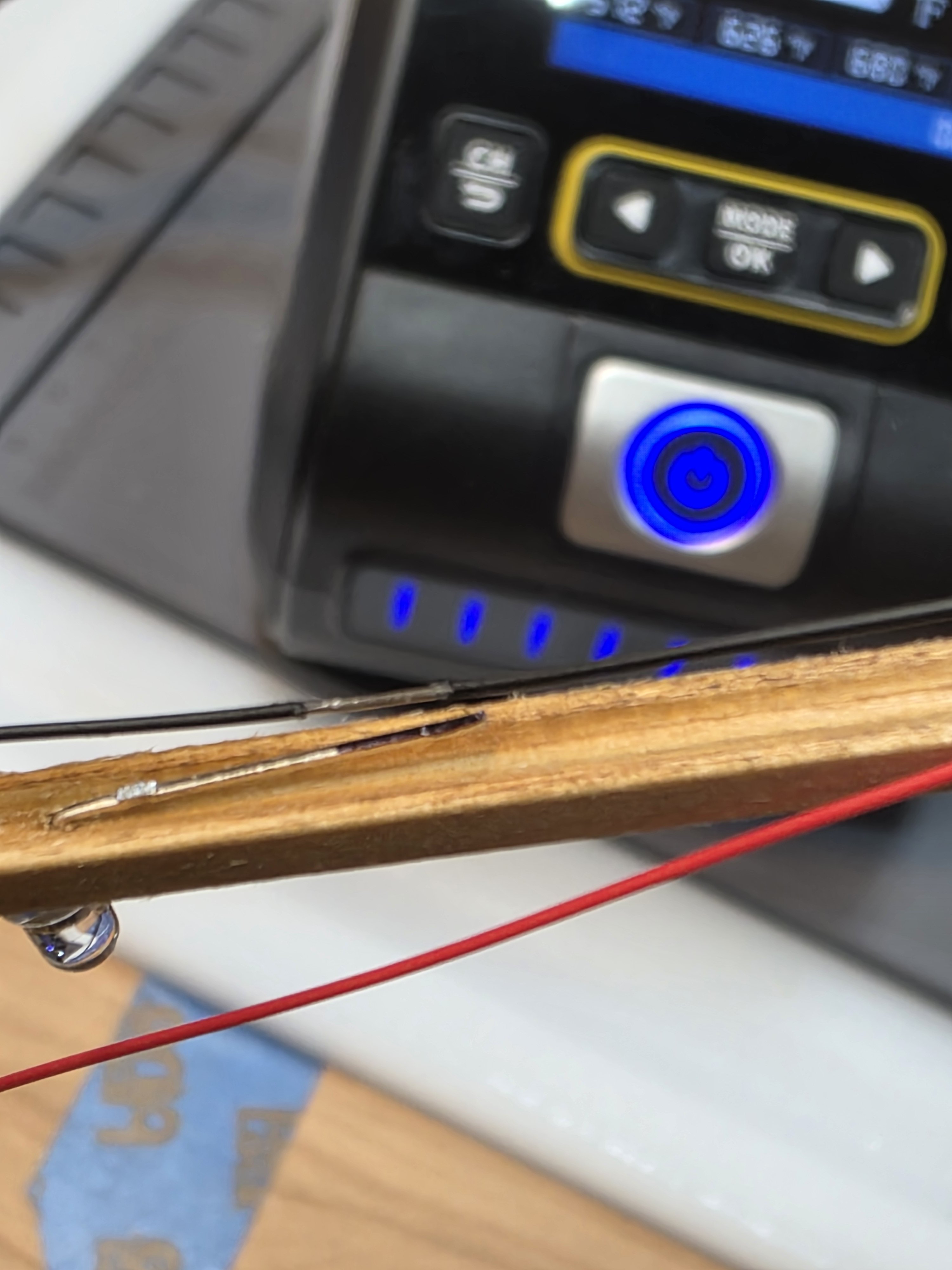

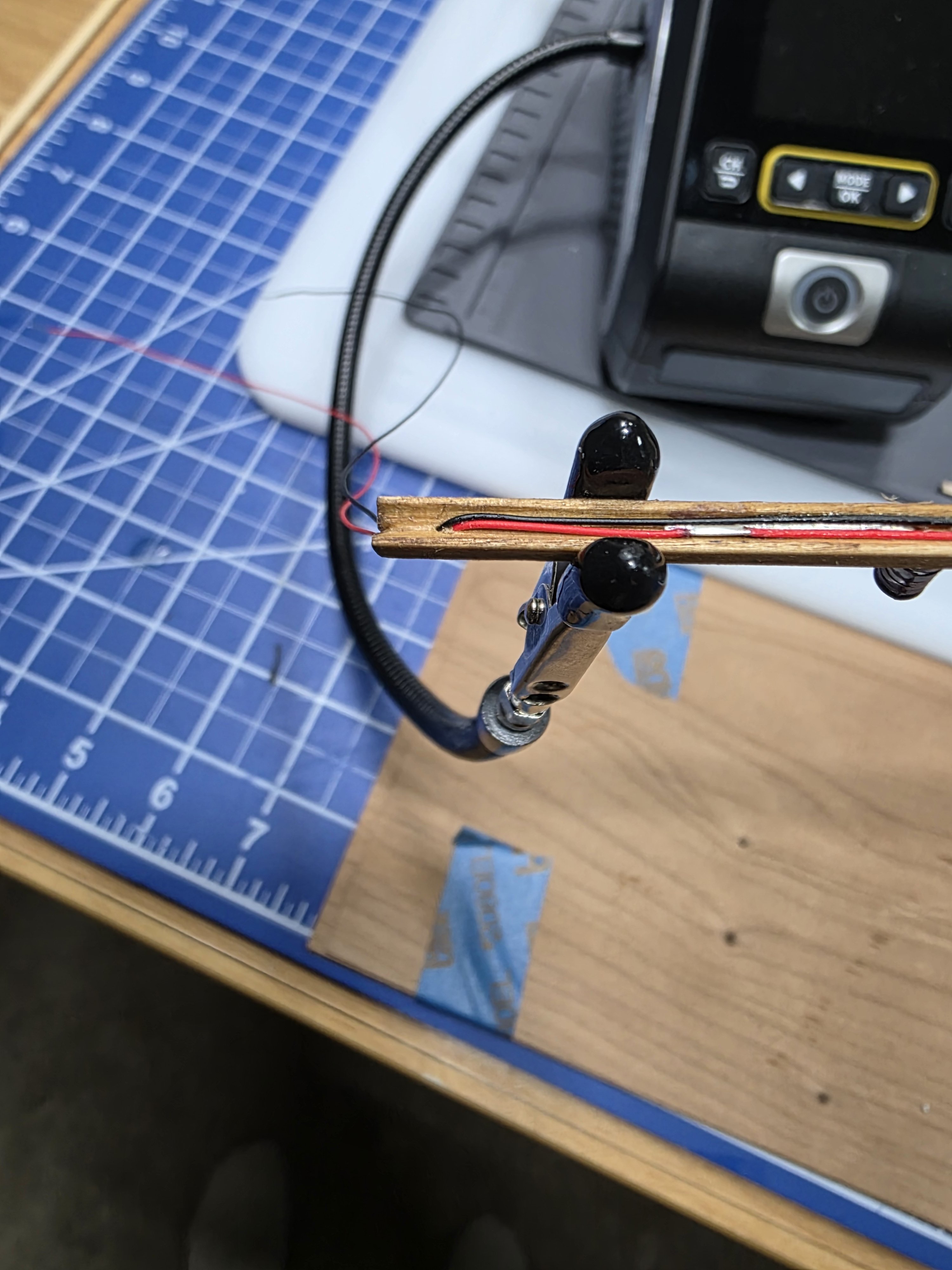

Its been a little while since my last update. I've been watching a lot of videos on soldering and getting a little practice at it. After much thought I have come up with a method of wiring the LEDs that works well for me.

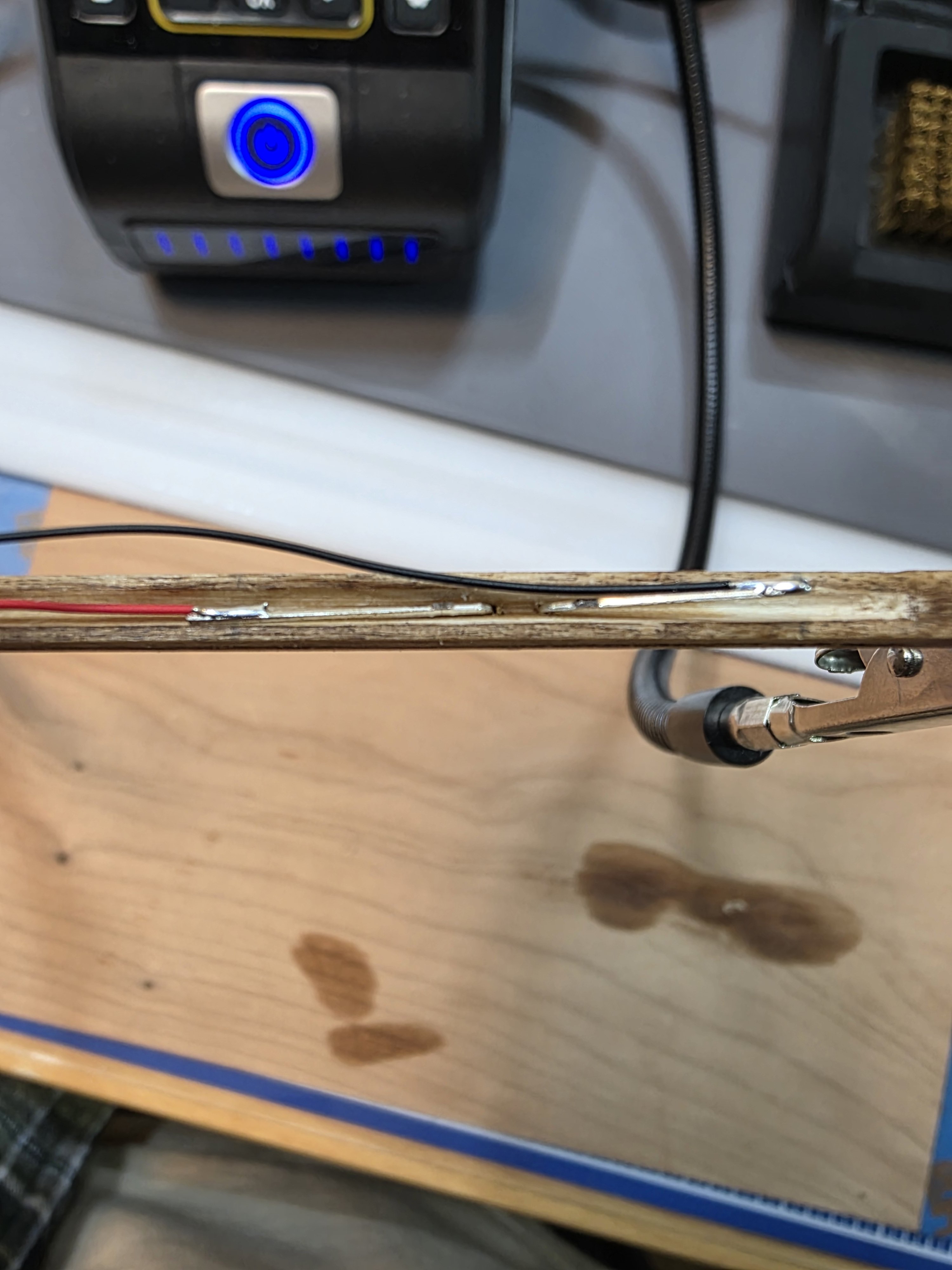

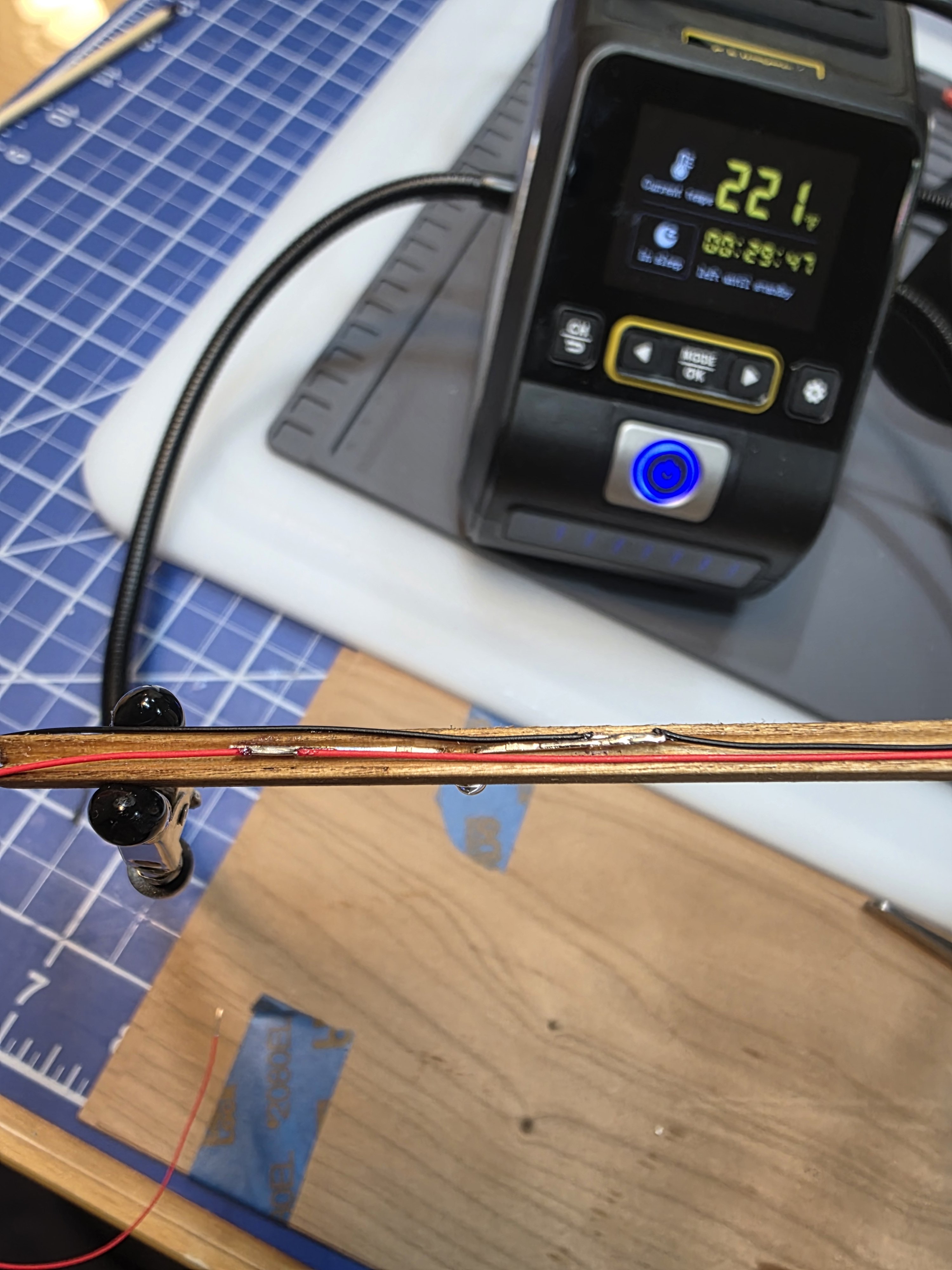

I'm using only two wires for each set of bulbs. The AL groove tool doesn't create a groove that is large enough to house the wires and bulb leads, so the groove needs to be widened and deepened.
The first thing I do is solder the wires to the starboard LED, trying to solder to the side of the lead.
Then, for each wire, I use the soldering iron to burn off some insulation from the wires at the spot where they will be soldered to the second LED bulb.
and them solder the wire to the LED.

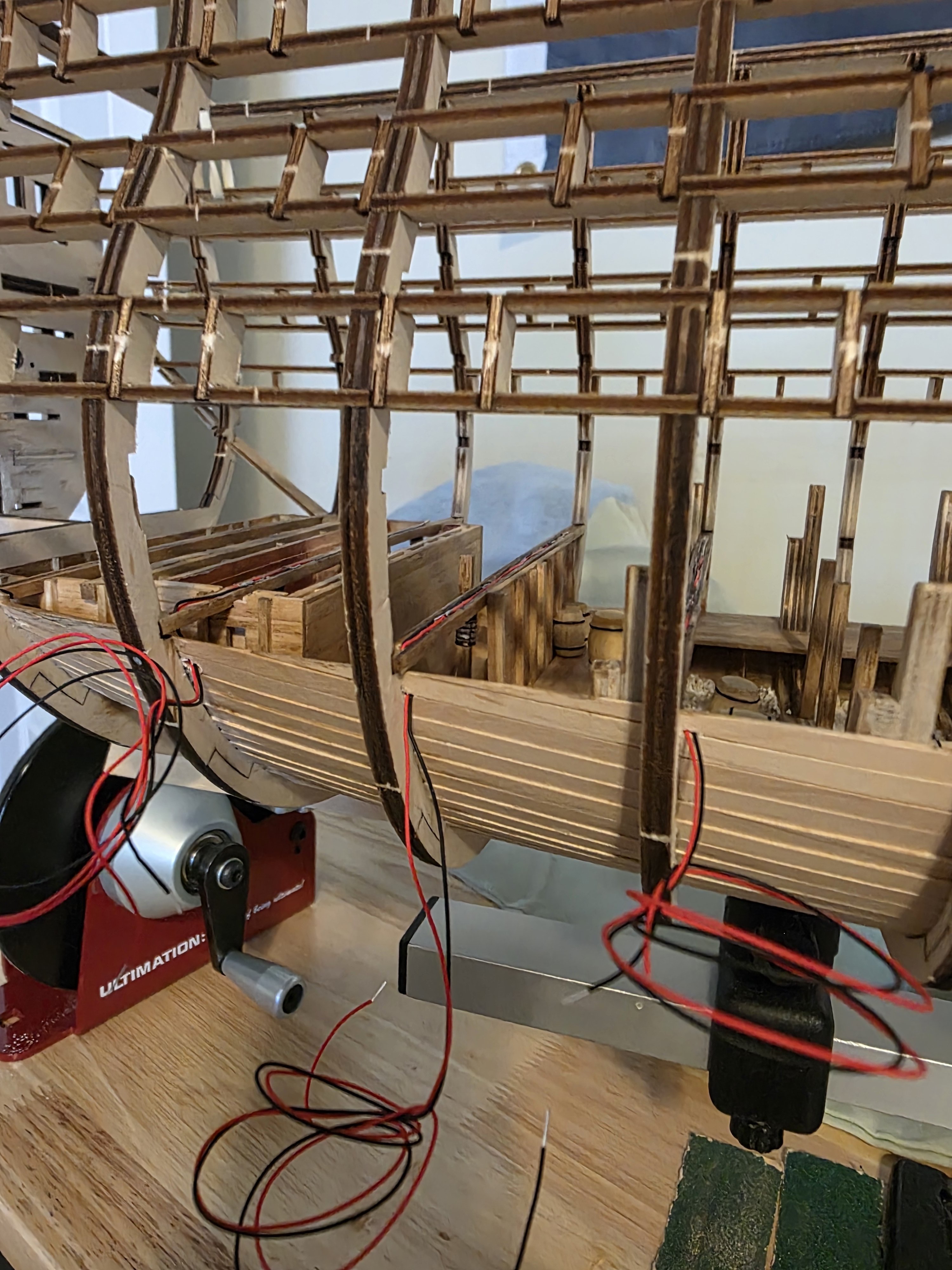

I drill a hole in the bottom of the beam to pass the wires through
and then pass the wires through the planking. The location of the wires will make them nearly impossible to see from the open side of the hull and no big holes in the frames. 3 down and a bunch to go.

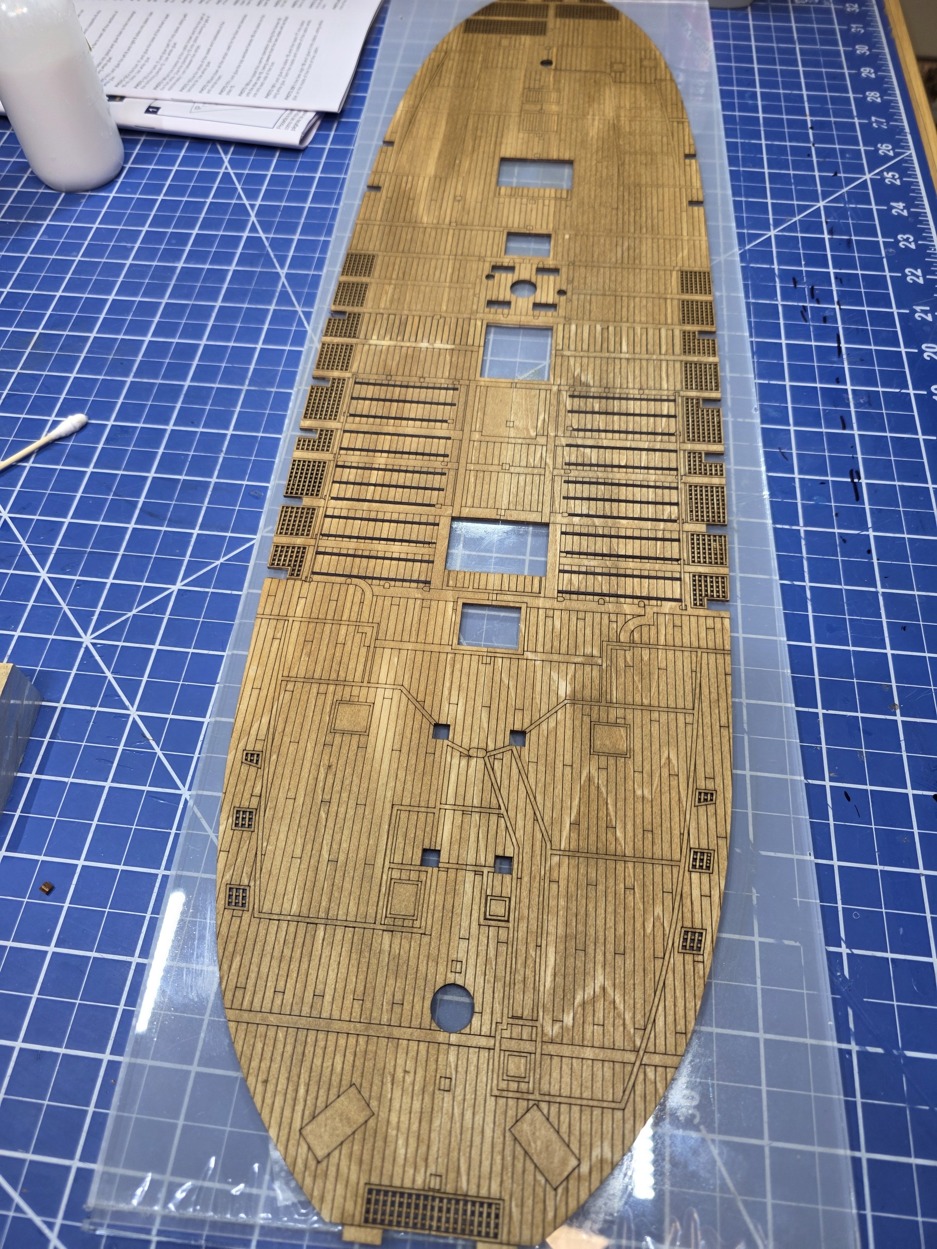

Pressing on with video 10. The orlop deck pieces are installed. The sections/openings all align with each other rather well and with the hold below. Quick mast check shows good alignment for the mast holes and other mounting areas below.
I wasn't thrilled with the way the fore and aft sections come together. These little tabs were very fragile. I think I broke at least half a dozen of these during the dry fit. It also took quite a bit of tweaking to get the fore and aft sections to fit together.
I ended up gluing some strips to the bottom of the forward deck sections so that the aft sections had something they could be glued to. Otherwise, there was no way to keep them together.
Even with that, they just don't go together very well and there are gaps and they don't really align well. The result is not a good look but it is what it is.
Other than that, the deck look good.
