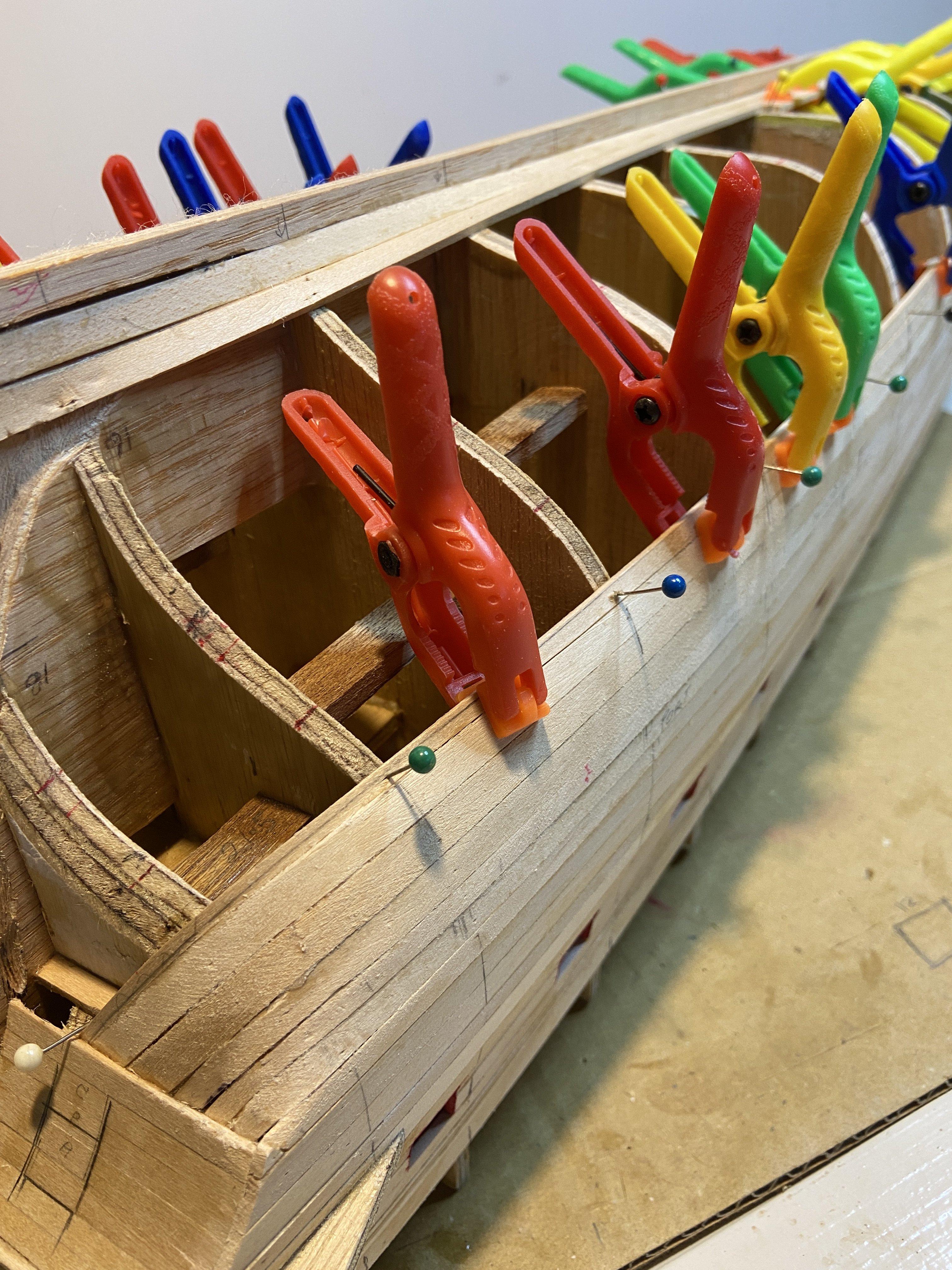

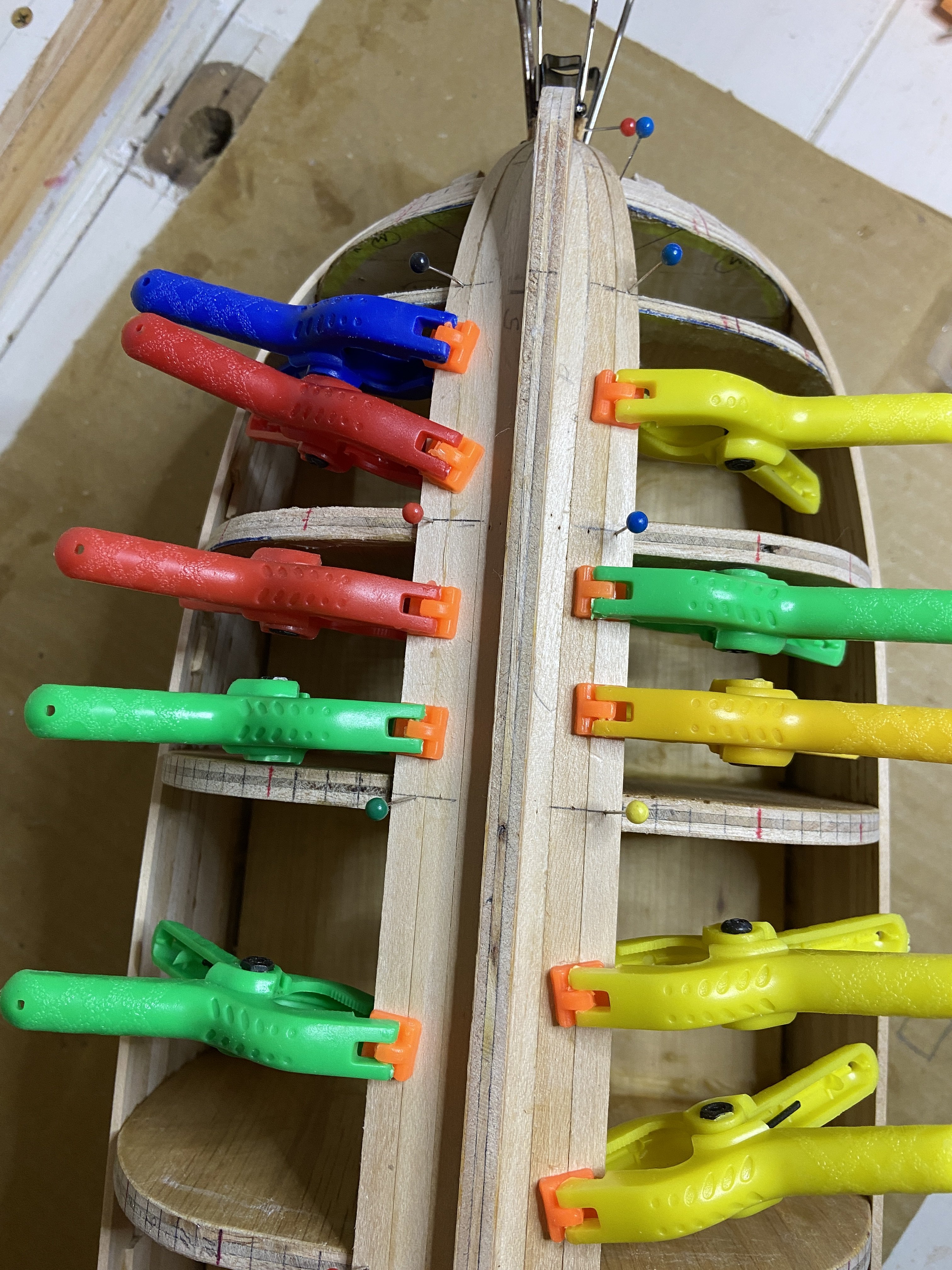

I've made a start on a few planks against the keel.
Also marked out the lines for the tapering of the planks(in groups of 6)
I'm using 6mm and 4mm wide planks.
4mm where the hull curves most, 6mm on the straighter sections.

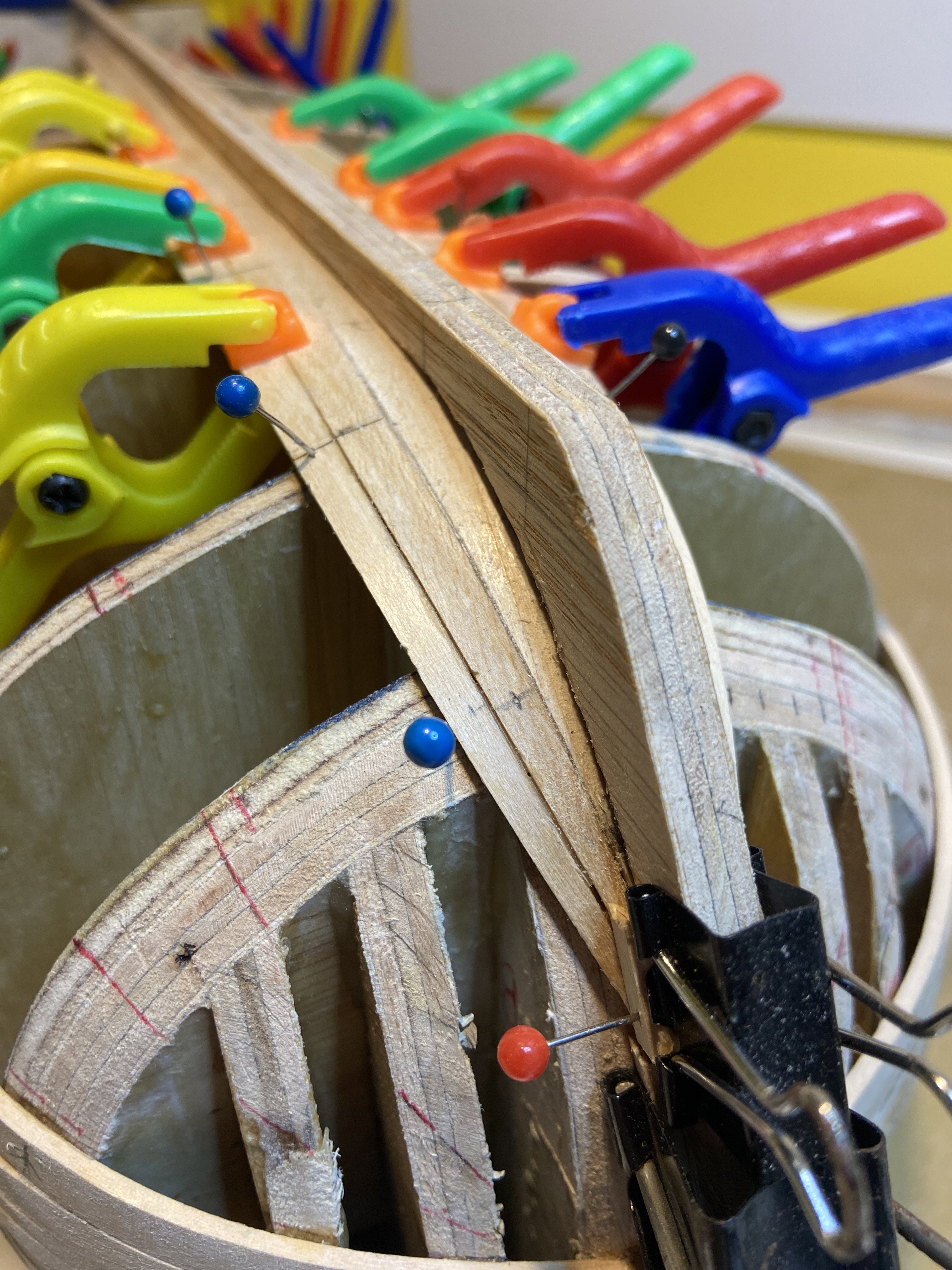

I usually pin each plank onto a frame and use plastic clamps, in hope to get the planks butted up neatly.
This doesn't always work, especially where planks are curving a lot. Sandpaper time then...

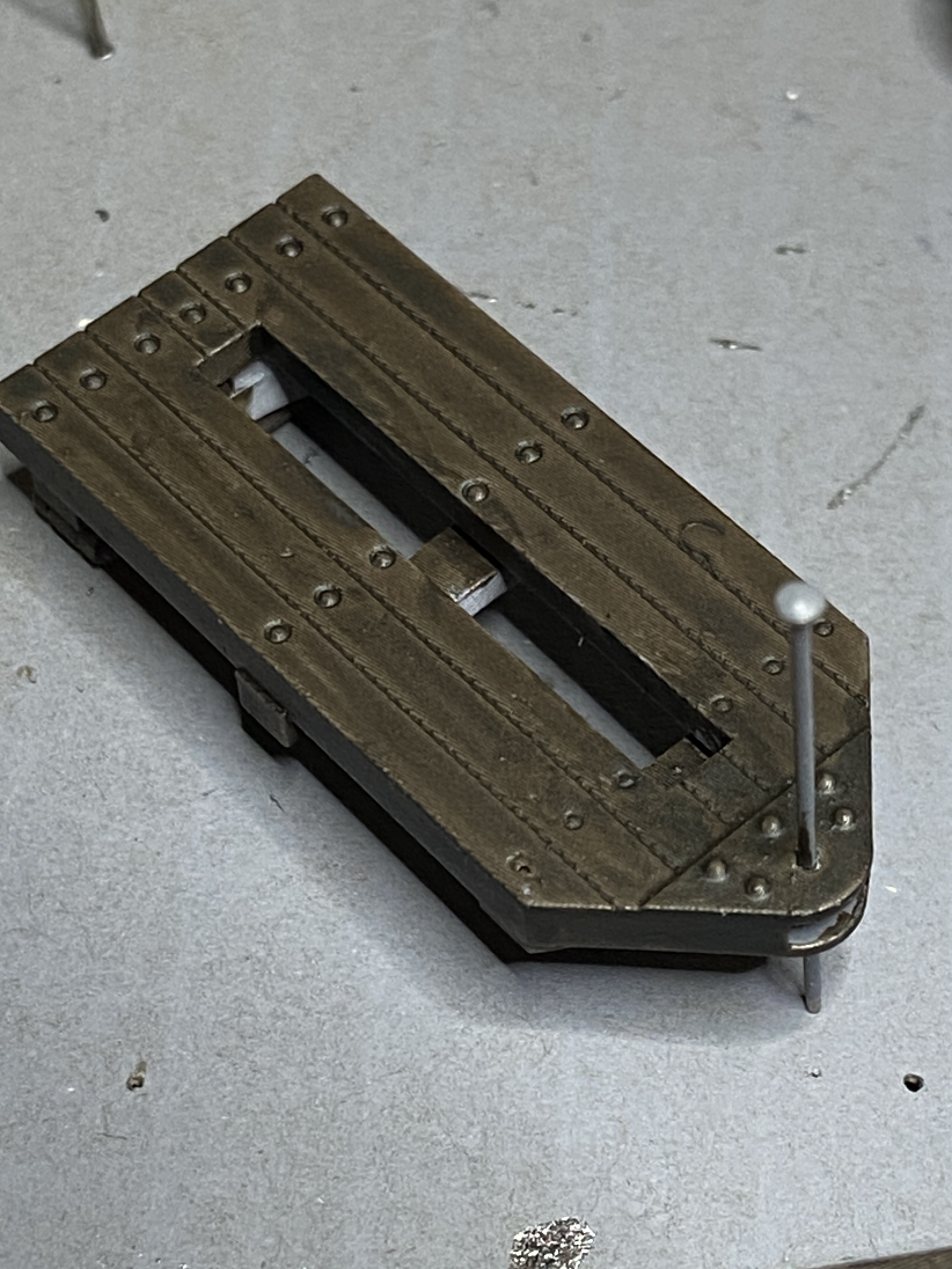

The next few pictures are some works in progress on creating 3D Models and Resin Printing.
I'm hopeful that with the right details and finishes, they will look presentable installed on the ship.

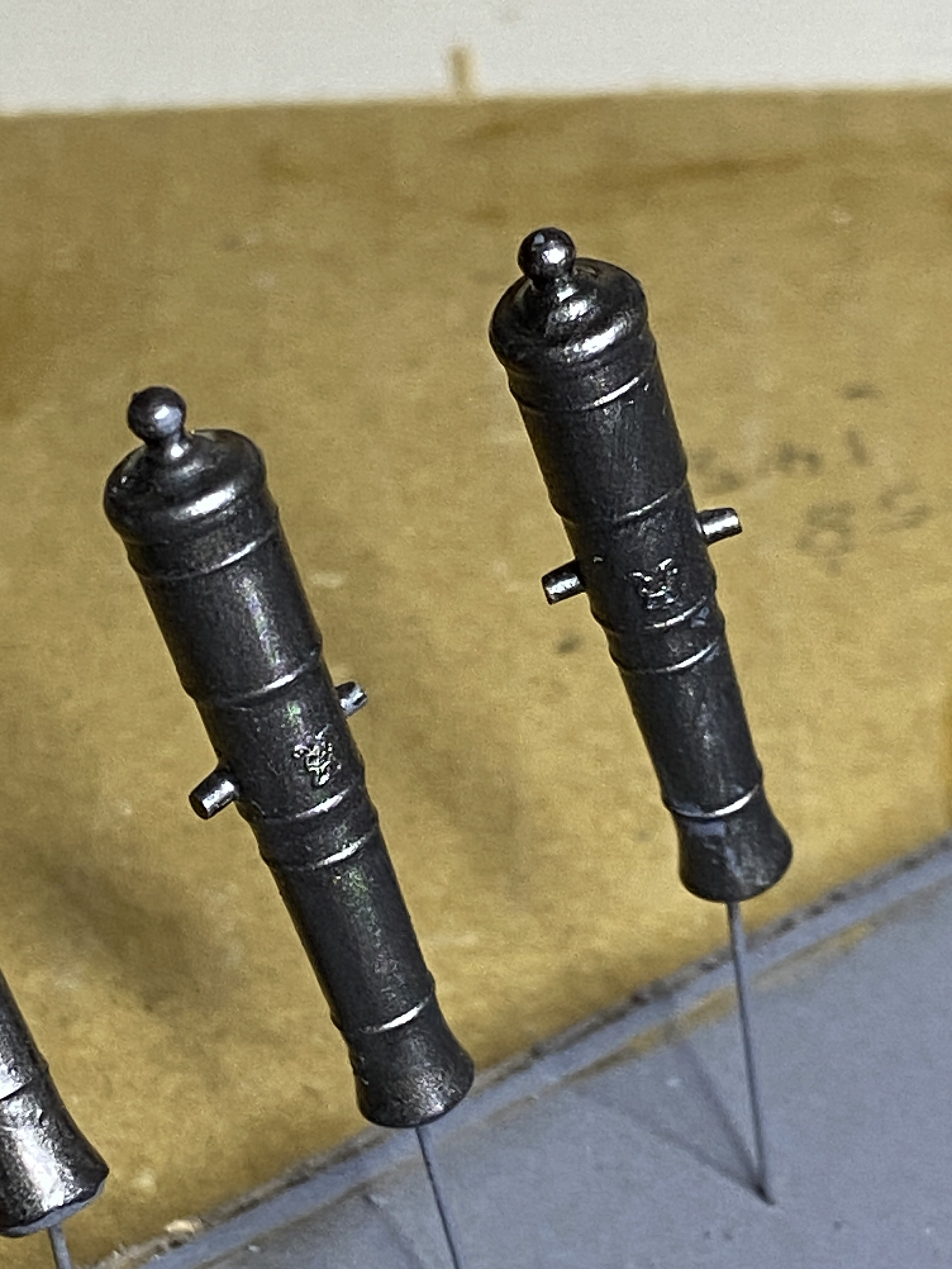

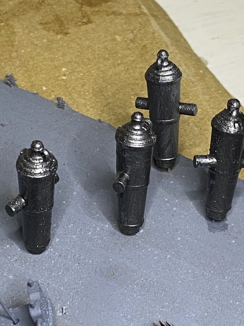

Also been testing some paint on the 18 pound Carronade Cannon Base.
Come up pretty good I reckon. Bit more touch up to do underneath(for the beady eyed)
Same for the 18 pound Carronade Barrels.
And the 6 pound Cannon barrels.

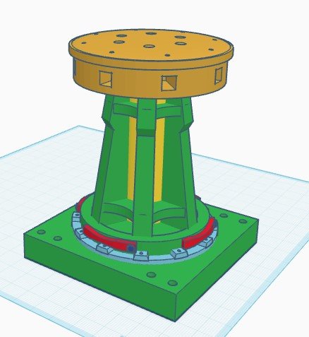

Have also developed a 3D Model for a Capstan to print & paint.
And before someone asks, it does not turn - yet !!
See how it turns out.

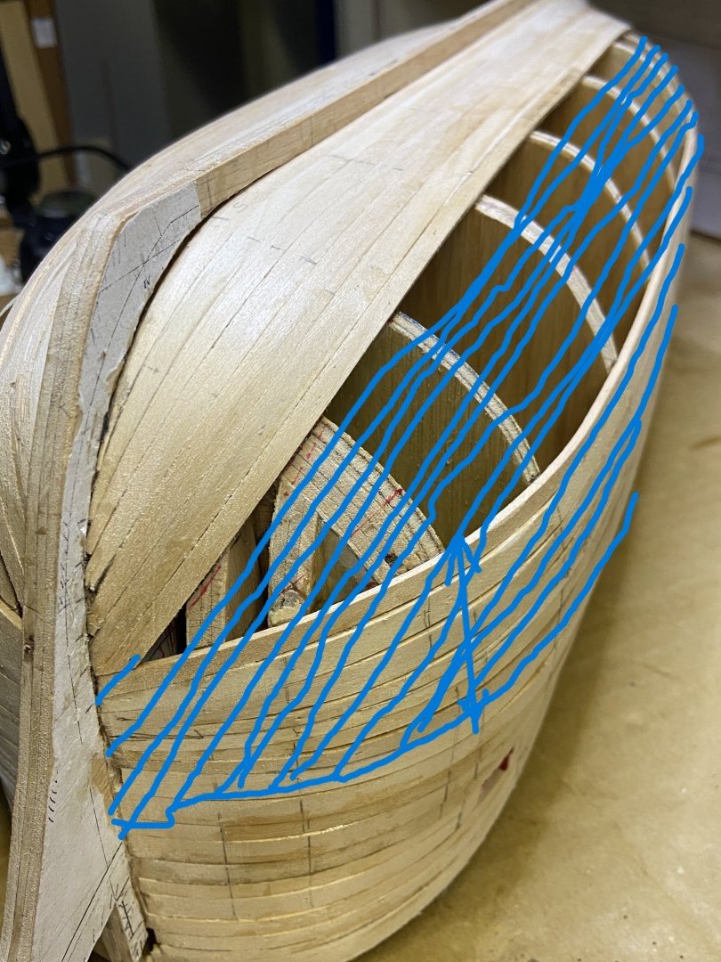

I hate to say it, but your garboard planks are unfortunately incorrect. They've climbed too high, which will cause plank congestion in the bow later. If you want to plank your ship correctly, remove the garboards now and remake them as shown in the photos. If your ship has a second layer planking, take this into consideration when making the second layer planking. Other than that, everything is going great so far.
Edited by mtbediz
Your correct.

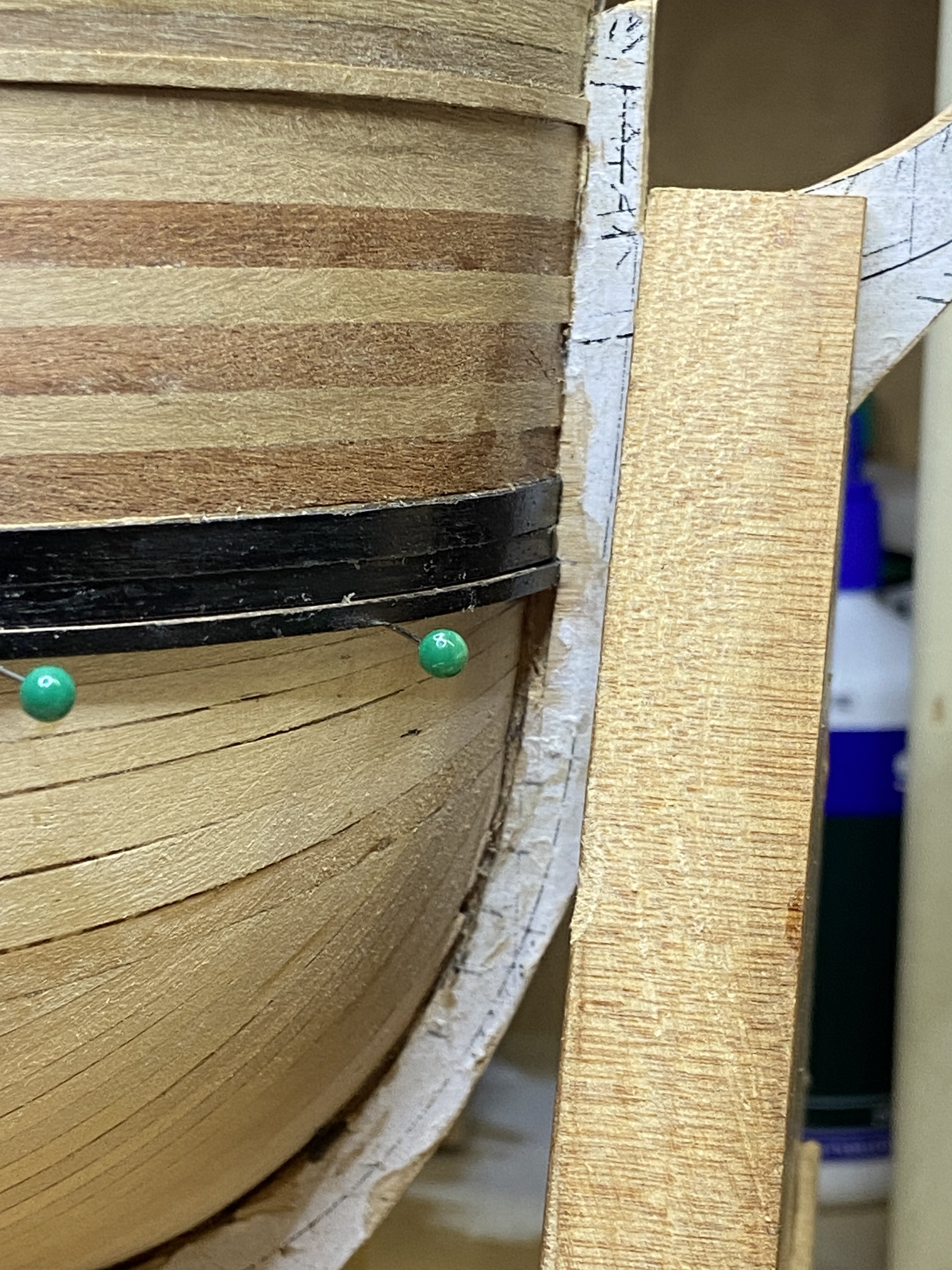

More progress from the Shipyard.
Slow progress on the 1st layer planking.
Another 3 planks added from the keel. All 6mm wide.
The first 4mm wide plank of 12 has been added, where they go over the curve section of the frame.
As I had not kept the garboard plank shorter, the rest have swung further down.
But being 1st planks, I have learn't.
I should point out.
The ship model in your pictures, has a finer entry bow.
The HMS Sirius is a Bluff Bow ship. Very similar to the "HMB Endeavour" I build a while ago.
I am trying to match the planking of the article below, which is the actual bluff bow "replica" of the Endeavour.
Even with the replica build; "the Garboard strake has been allowed to creep up the stem, and if this had been kept a little lower they may not have needed as
many dropped planks." (This was noted by a member of the Replica board)
Most of my planking to date on my model, follows the natural lay of a plank over the frames.

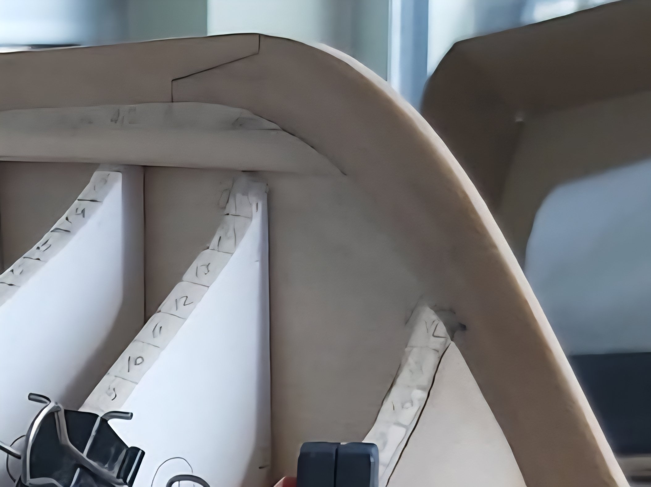

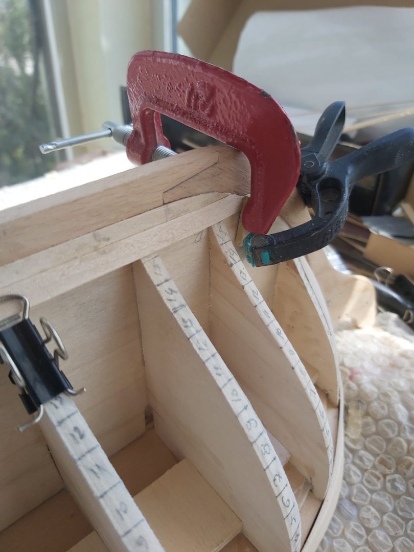

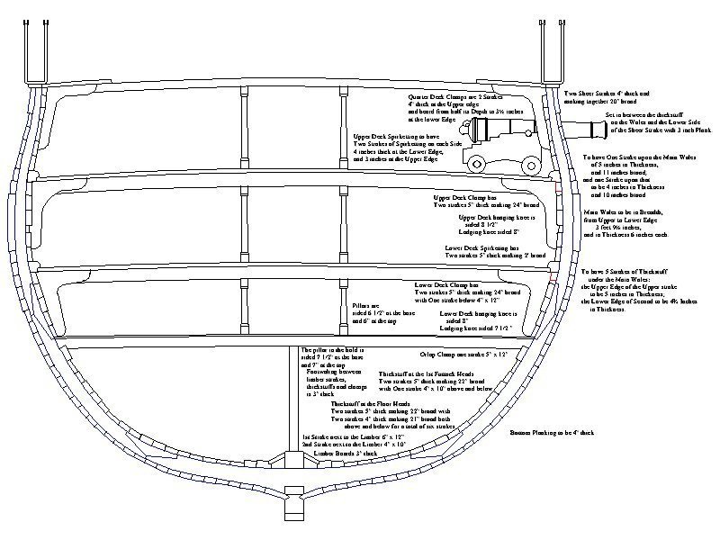

I noticed this too. Your ship has a Bluff bow. Making the garboard shorter seems difficult. To create a planking pattern that matches the photo you've attached, you can apply a planking pattern similar to the one I've tried to draw on your photo in the second layer. To do this, you could end the planking from the bulwark down to the lower end of the wales, then work your way up from the keel. Sorry, I am not good at drawing on the computer but I think you can understand what I wanted to show.
Edited by mtbediz
IMHO garboard plank should end much shorter, approx. where the red arrow points. From there the rest of the planks should run more or less like the red lines show (do precise spiling there).
(You might have to install a stealer or two, if necessary).
To plank completely correctly, spiling is required, particularly from the lower end of the wales to the keel. However, we don't know if the wood Dave will use for the second layer planking will allow for lateral bending.
Edited by mtbediz

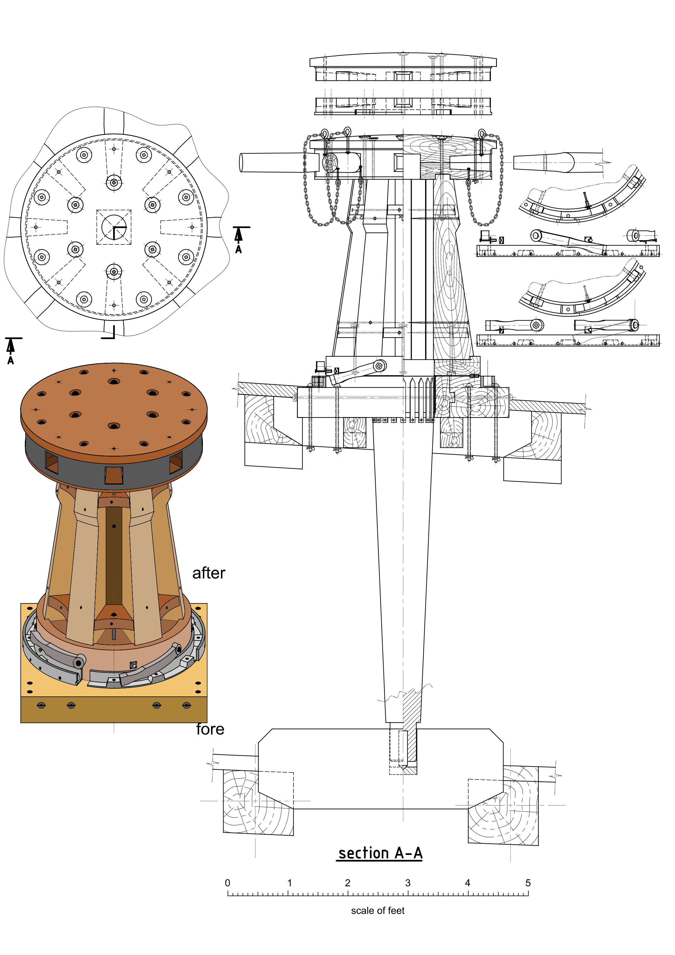

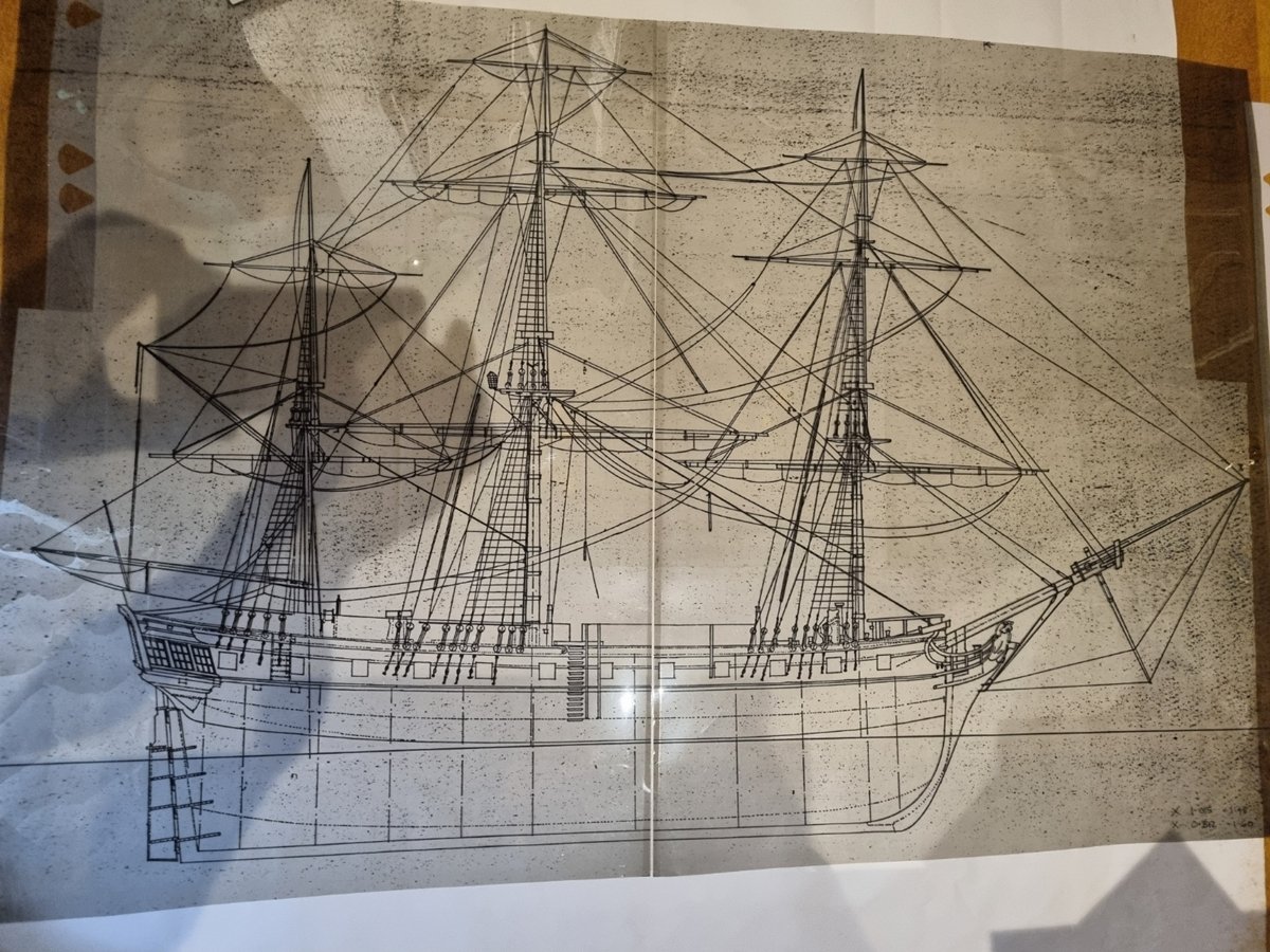

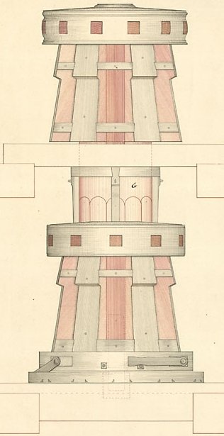

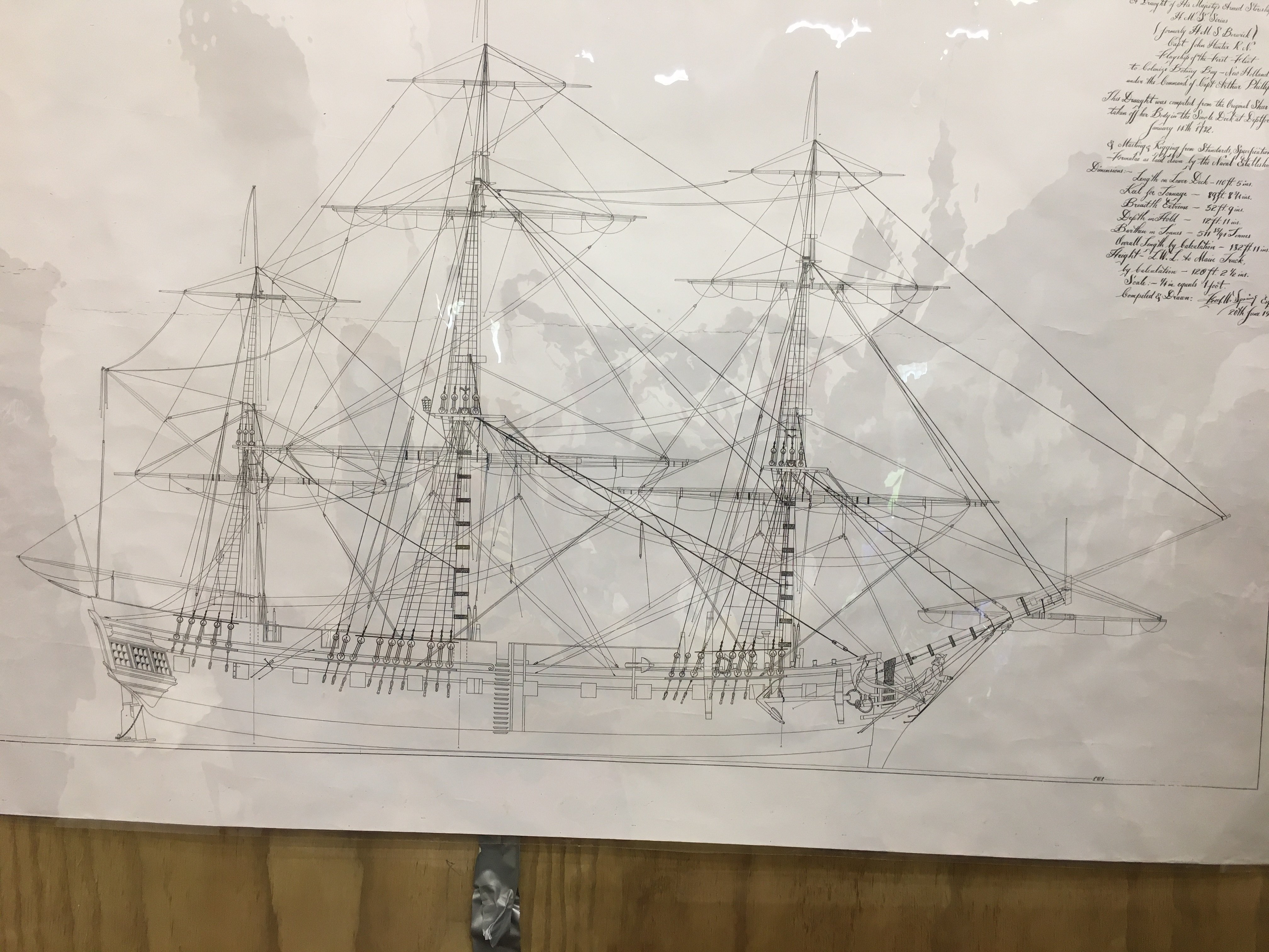

Hi Dave. Sirius had a capstan on both decks (same shaft). Unlike the capstan in my drawing. It probably had the pawls on the lower section. See pic. The pawls on your model need to be moved up so they drop into the ratchet more and probably on the lower section. I am not sure why the ratchet is not shown on the "Berwick" draught Note that they flip over 180deg to allow rotation in either direction.
Here also is G Rapers watercolour of Sirius. there is a lot of detail in it. Also a rigging plan that may be helpful.
Regards Allan.
Regards Allan.
Allancapstan1-1.thumb.png.687b35de01156ae0fb22ff5e5f20bcb6.pngmaincapstanpart.jpg.357049dccf5da16db674a917c207af86.jpgsirius30.jpg.08ebba5d4a07f038a8ae345f09ff1703.jpg20250725_131837.jpg.a703aa3e043bf2bb99da4134e046b432.jpgsirius_assyaa.thumb.jpg.5894bea157476cddfe224051940234e4.jpg
Excellent.
I did see the capstan was a double one.
I see now, the pawls are not shown on the "Berwick" draft.
I might just take the pawls off the 3D Capstan I made. possibly too much detail anyway.
Thanks for adding the rigging plan - I have similar >> below

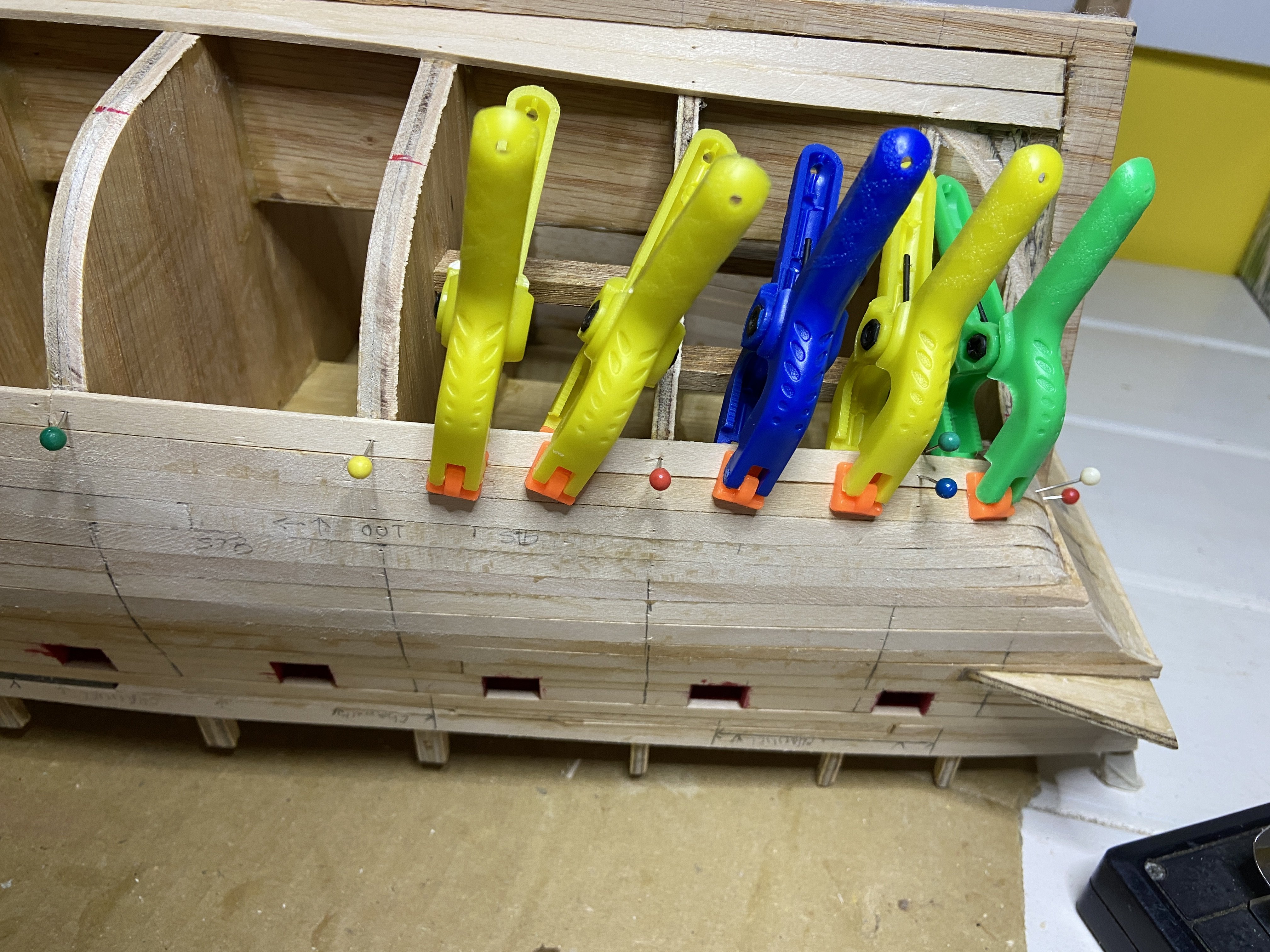

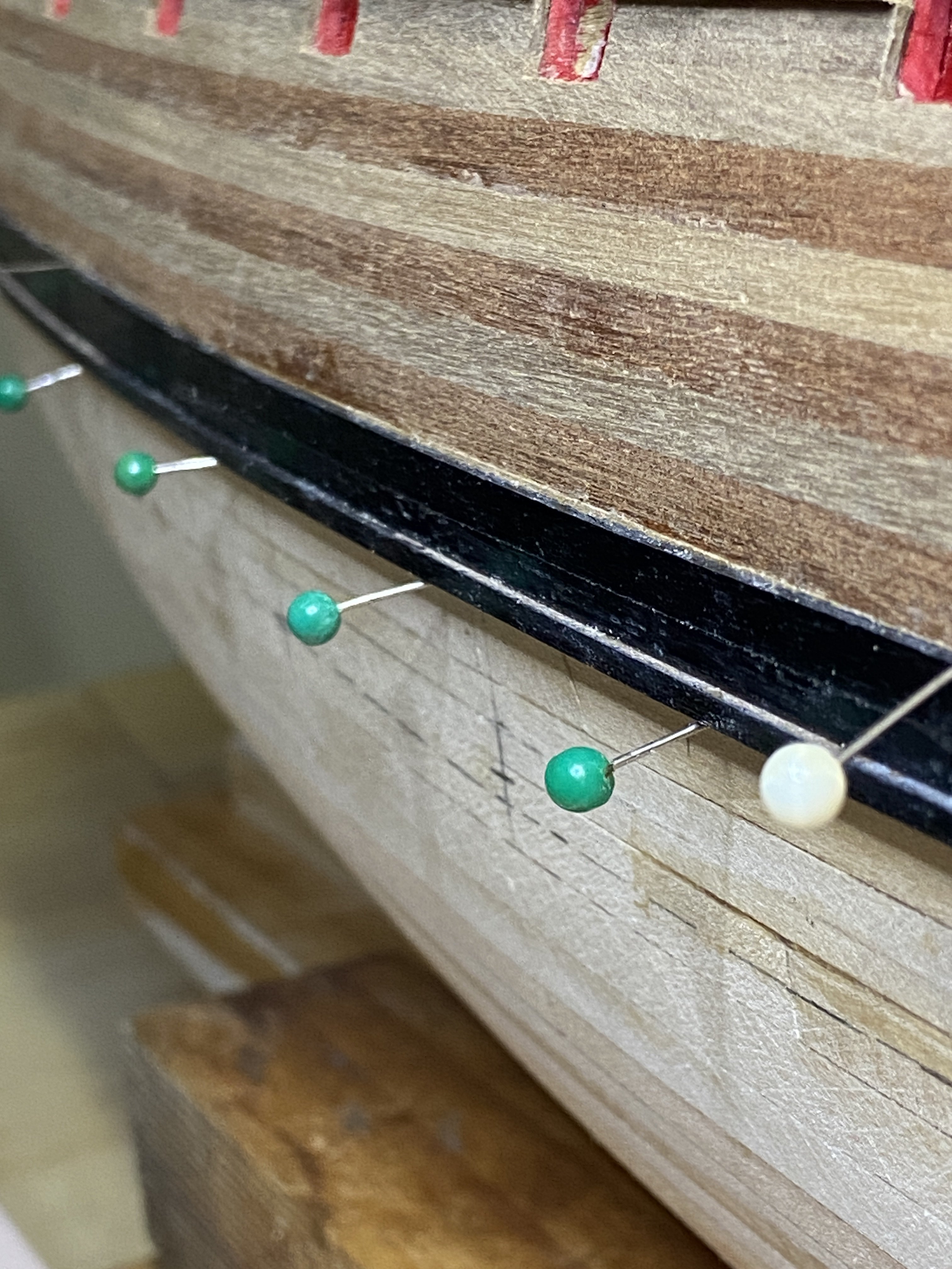

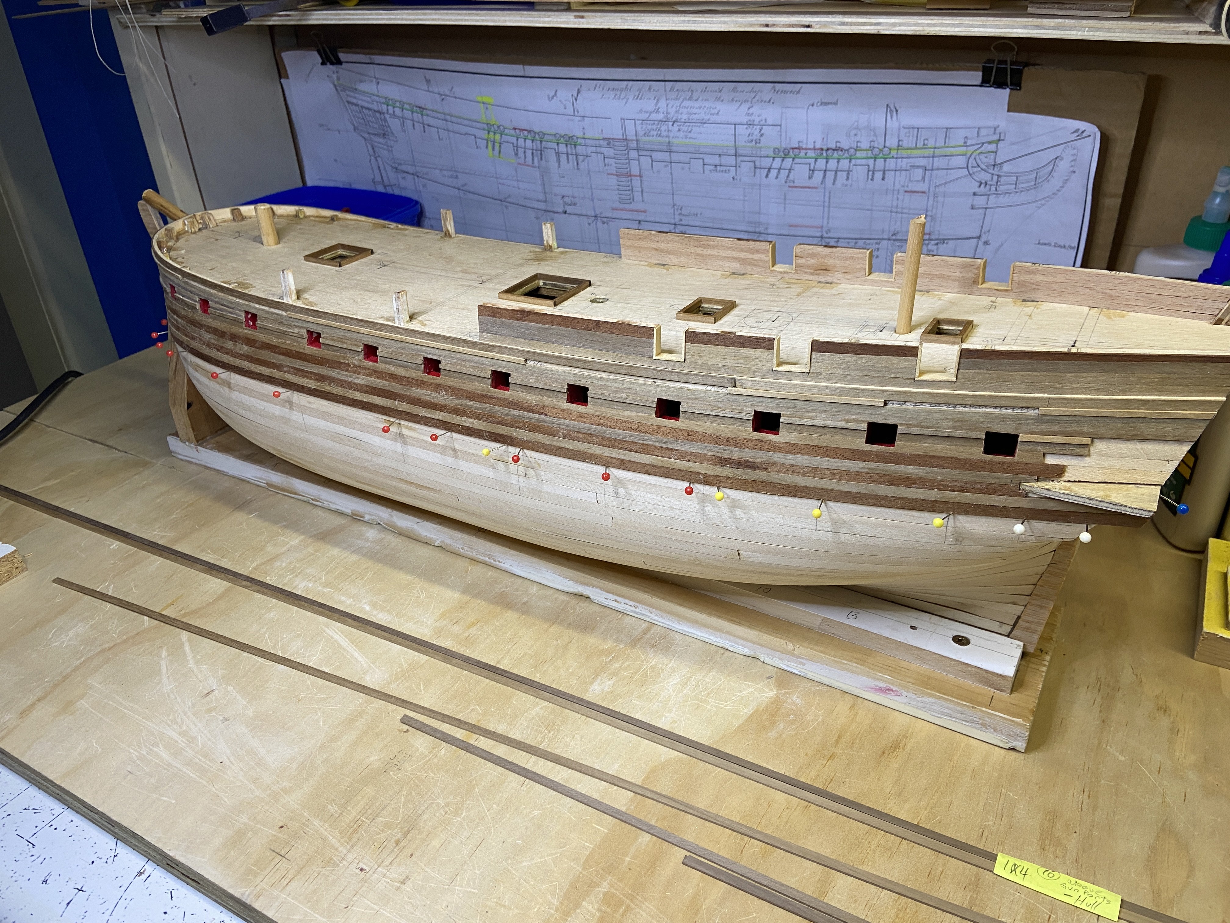

More progress from the Shipyard - Thursday 7th August 2025.
A bit of a push over last week to get all the 1st layer planks onto the hull has been reached.
I spent a few hours fairing(sanding) the planks today.
I did carry the upper planks too far down the side.
However, for the first layer it's been a good refresher on planking before the 2nd layer of planks.
I'm pretty happy with the outcome so far.
Port Bow
Port Stern_Side
Port Stern
Starboard Bow
Starboard Stern_Side
Starboard side
I'll be marking out the Wales & thickstuff's, Sheer Strake, and the Channels next

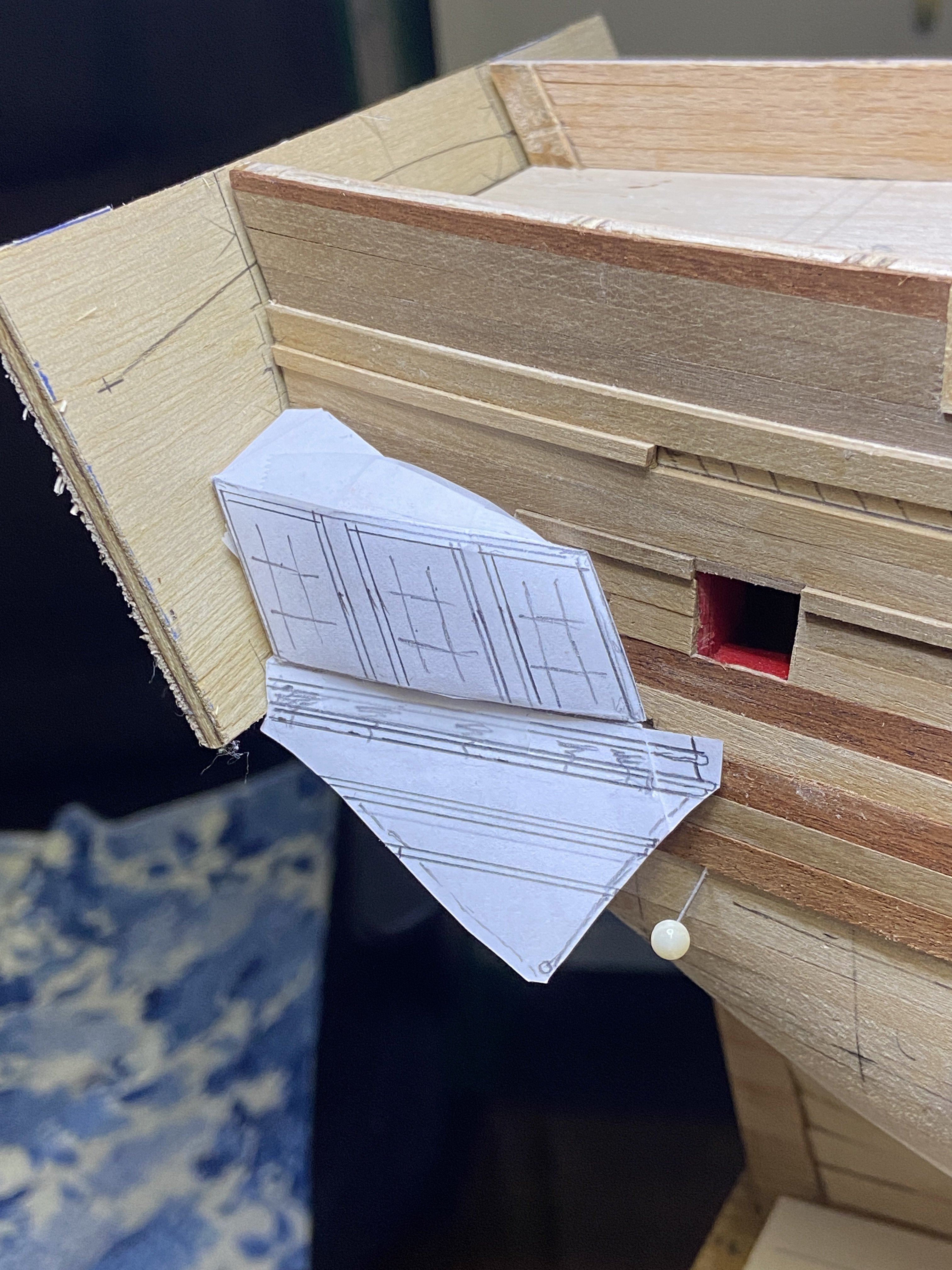

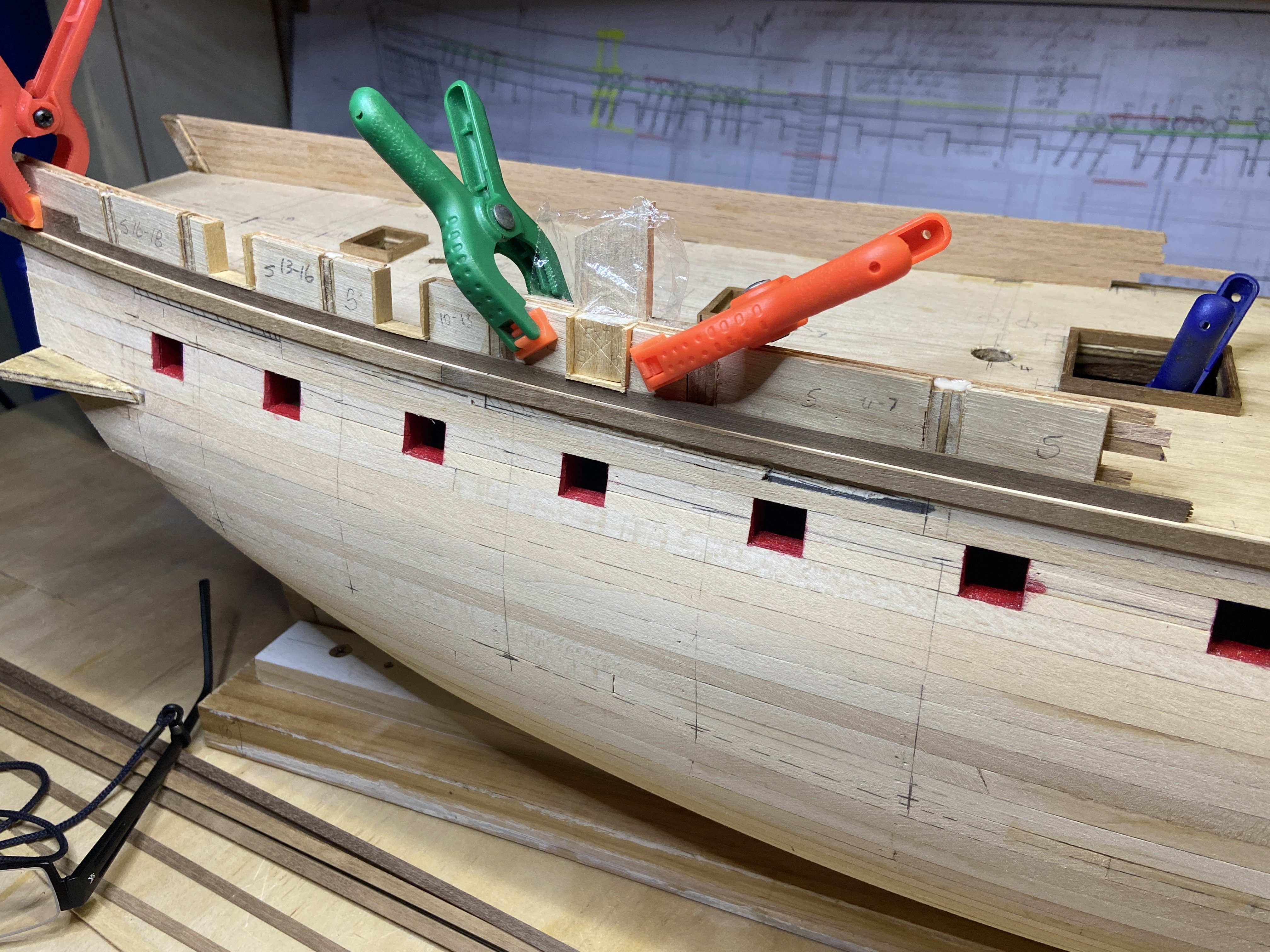

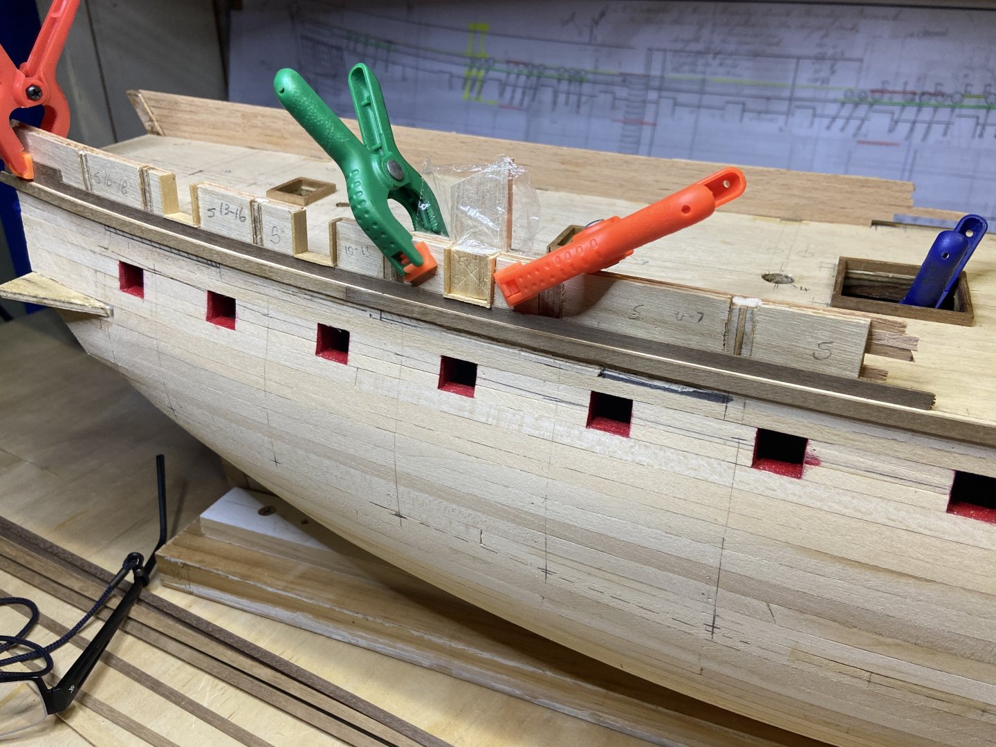

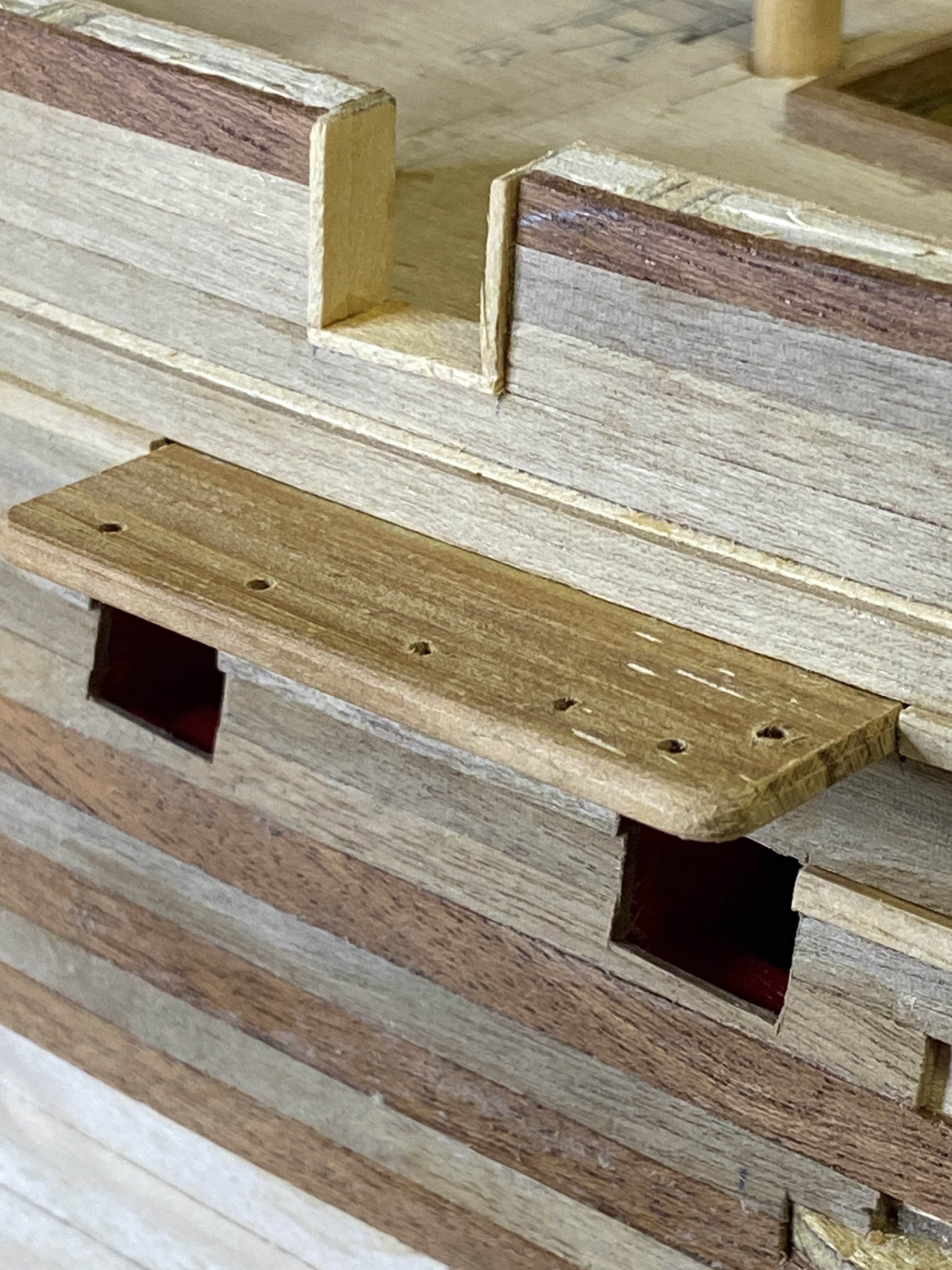

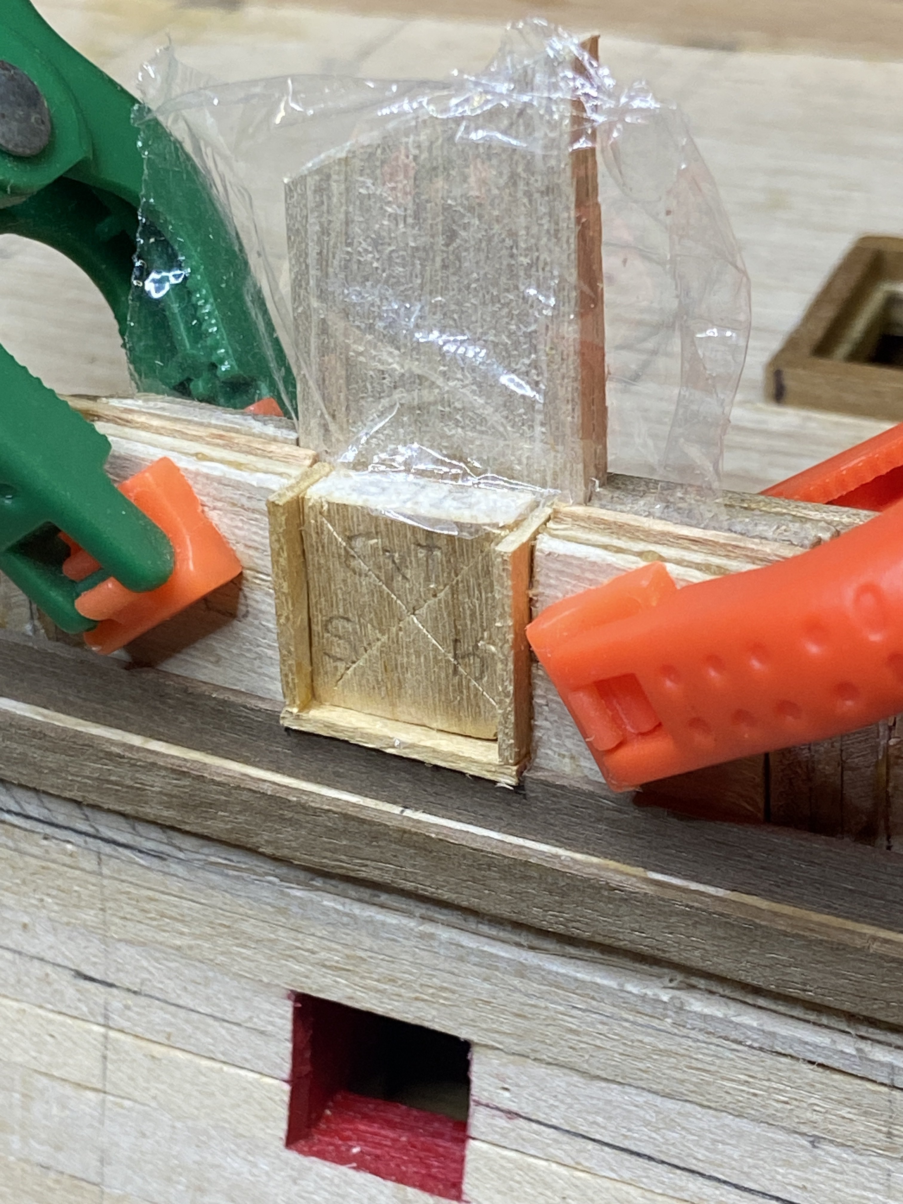

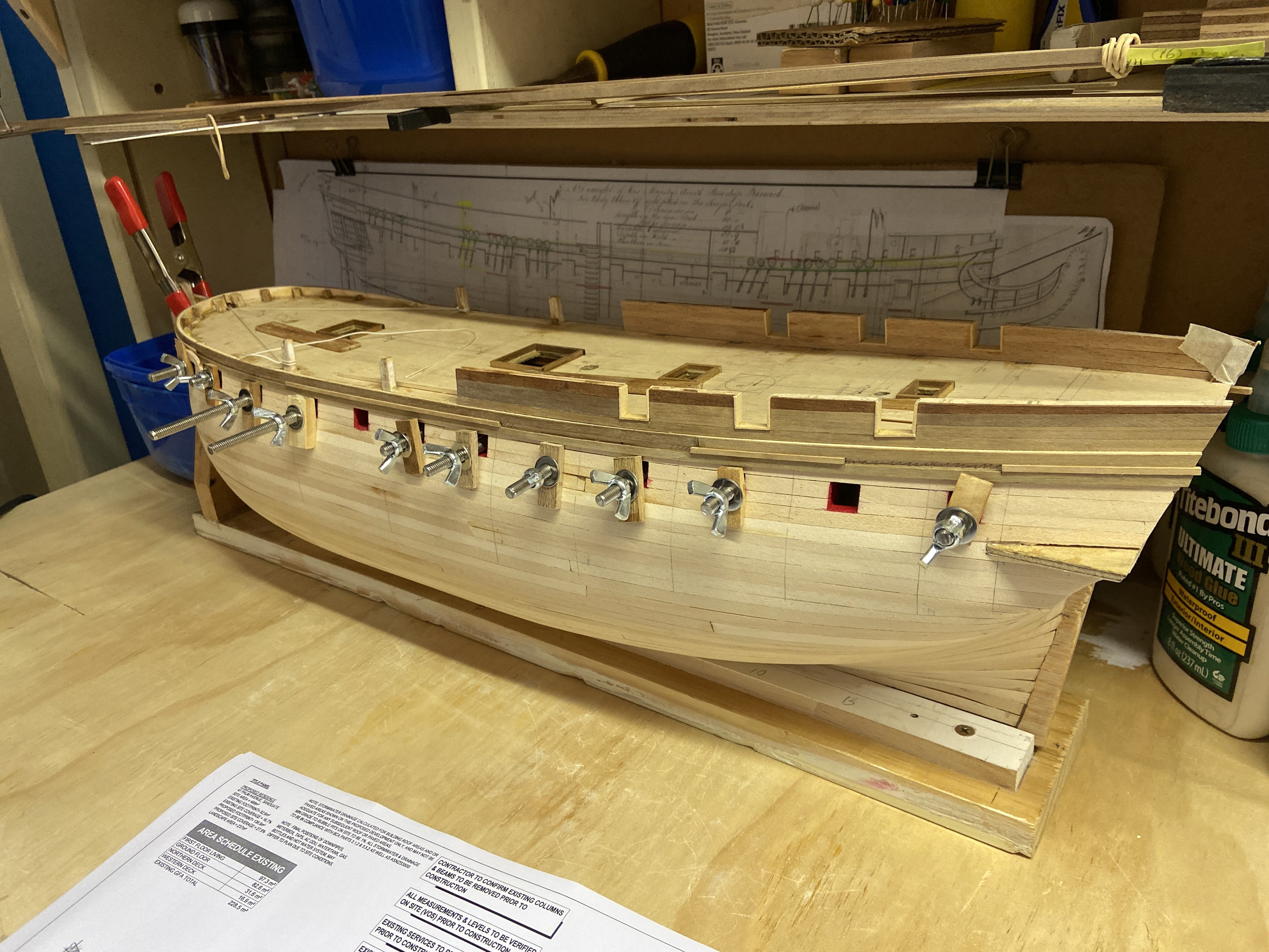

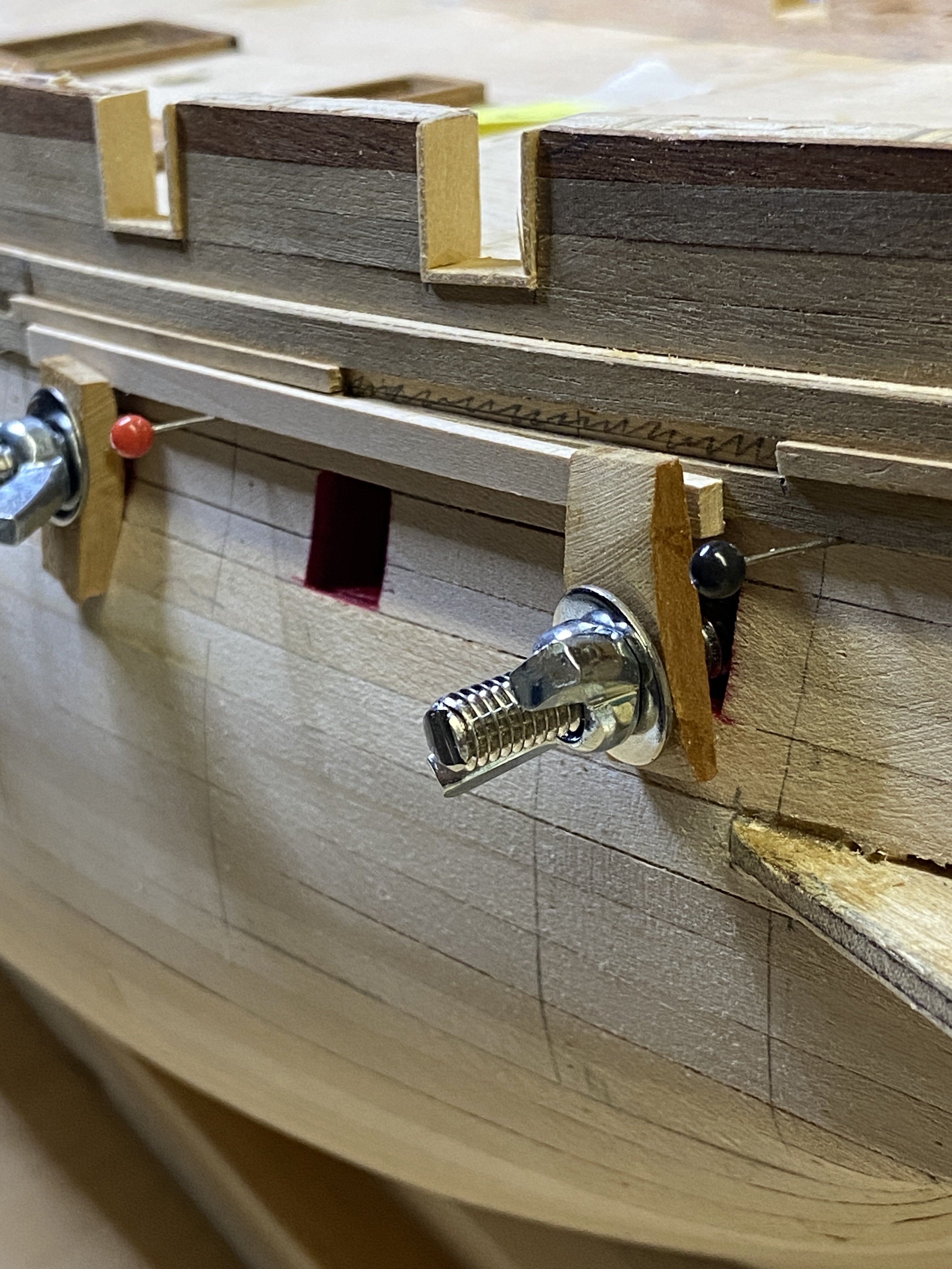

We decided to move onto the aft sides, top strake, boarded side rails with gun ports.
From the RMG Draft of the Sirius(previous Berwick); not much detail on the side rails other than the height.
Reviewing a number of colour paintings and the Sirius model in the Australian Powerhouse Museum(PM), I adoption the boarded side rails with 3 x Gunports per side.

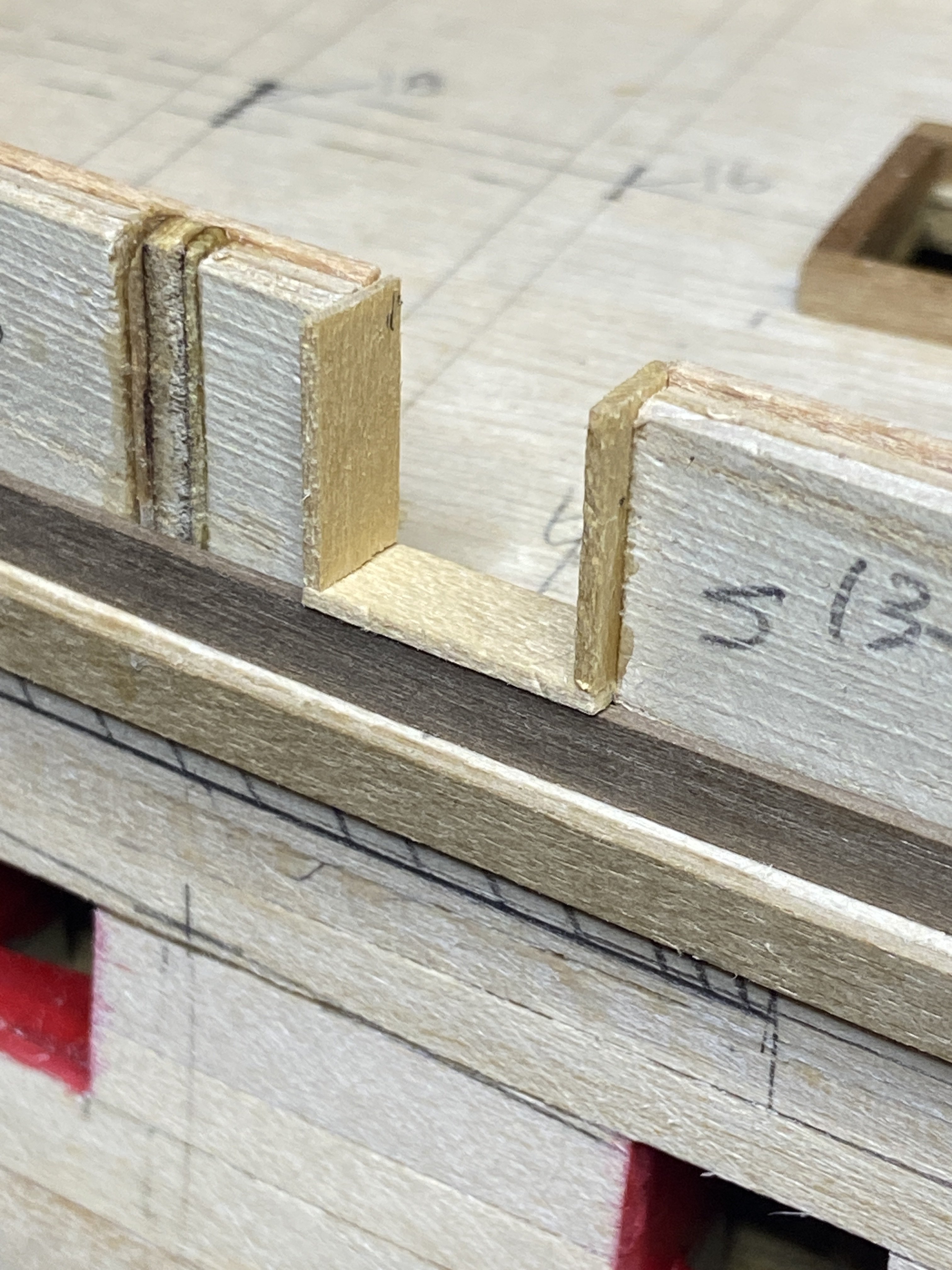

For me it makes sense the Sirius had solid side rails at the back for protection during the long arduous journey to the other side of the world.
I filled in between the "Long Top Timbers" with balsa wood to provide a solid base to glue the outer side rail boards onto.
I made a jig to hold the bottom & 2 sides of the Gun Ports to make sure all are the same.
Finished Gun Port, ready for the outer boards to go on.

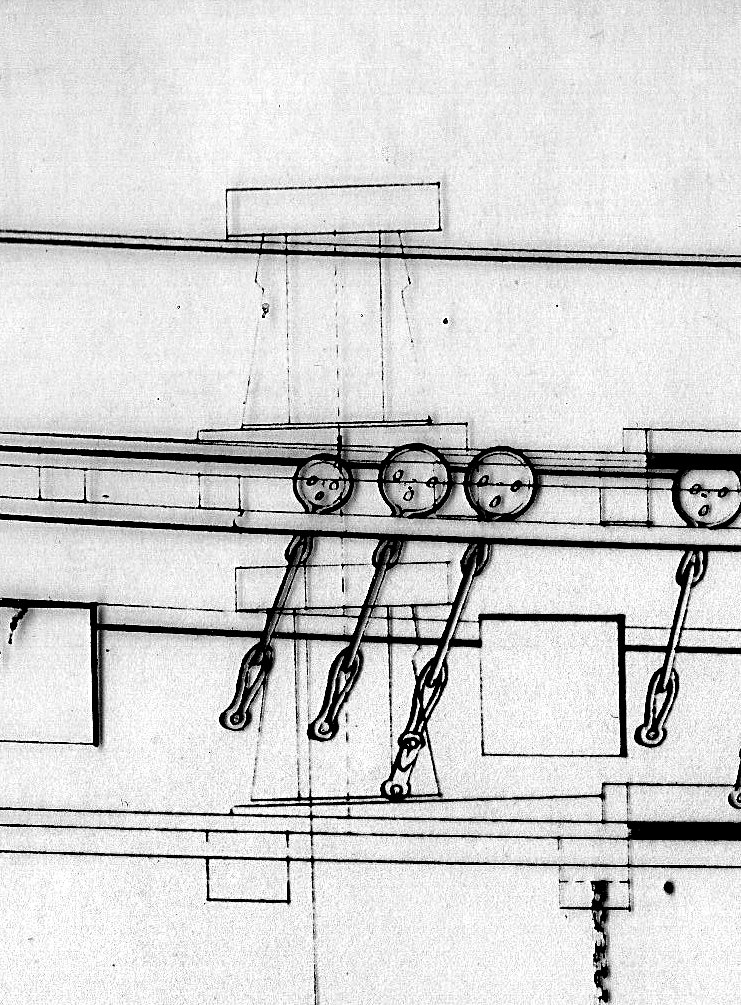

Great work so far Dave.
It was interesting to see in that watercolour that Allan posted a while ago, you can see that the bulwarks look open with netting and stowed hammocks on top, and the waist bulwark is also open with the hammocks.
Yet both the plans show closed bulwarks aft of the mainmast. I wonder which is correct, maybe just a change made before the voyage to Australia

Hi Steve,
Thanks for looking in on the progress.
Watercolours, paintings, sketches !!
I have several pictures/paintings of the Sirius. All "historical" representations I assume. Between them have 3 versions of bulwarks/rails.
It's similar for "how many guns did she carry on board".
By all references in the books I've read to date, All her "Berwick" guns were removed during the 1786 refit "Her commission stated that the Sirius 'would' be armed with four 6-pounder carriage guns, six 18-pounder carronades & eight swivel guns", a very light armament. "Then on 31 October orders were given to obtain: 10 more 6-pounders to be put on board....". But it was unsure how many actually made it on board as "with respect to the guns, camp equipment, tents etc that were ordered from the Tower,...he[Phillip] had not specified and quantity, therefore I cannot judge what room may remain[on the First Fleet ships]
Bulwarks or Rails !
So back to the rear.
I pondered for some time what to do back there.
I wondered if I was on board for that arduous journey, most of the time out in open waters, what would I prefer on either side whist on watch back on the aft deck area !
However, I wasn't, but went for the Bulwarks anyhow.

Started on the recess's in the Strake for the Mast Channels(3 per side).
I am making use of the Gun Ports to hold the strake @ planking in place -> as in photo.
More Planking:
I've had a bit more of time at home of late, after a bit minor surgery. Just a bit of preventative stuff.
So, plenty of time to add more planking to the hull.
Before you fellas get into me re: the fact of mixing timber species for the planks. As this is a scratch build, I'm using timbers left over from my previous Kit Build Endeavour.
I plan to stain the planks and "hopefully" blend the finish to a more "oldish look".
Planning Ahead:
And a bit of paper mock-up on the rear to see how the heck to build the window pop-outs.

The last few days have been onto the "Wales", which run Bow to Stern, at around the max breadth of the hull frames.
I'm basing the location & vertical depth from the RMG plan.
They will be added on by:
  • Two(2) strakes on top of the Main Wales. 11" & 10" broad(8.9mm @ 1:60).
  • They may have been up to 3-4" in thickness. At 1:60 equates to 1.3 to 1.7mm.
  • The Main Wales 3' 9" broad(1:60 equates to 19mm) and 6" thick(1:60 equates to 2.54mm)
  • The larger the ship, it may also have had a number of lower strakes below the Wales.
  • Visually, I'm going 1mm for the top Strakes and 2mm for the Wales.
The above cross-section is not the Sirius(Berwick). I've included this section for reference to the location of Strakes/Wales & thickness, depth of them.
The model Wales will be all up around 18mm in width/depth.
The aim is to taper them a bit towards the stern as well.
The top and bottom Wales are pre-painted black.
I've enlarged the bow Rabbet to hold the strake/Wale ends firmly.
All the above to strengthen a ship's hull structure.
They were the thickest timbers on the side of a wooden ship hull.
I've seen some discussion that Wales also prevented "hogging", when in heavy seas a ship may longitudinally bend up/down.

Since the last update, the Bow Gun Whales have appeared.
With the aid of 3mm balsa as a filler, this provided plenty of support for the run of the inner planks.
The Gun Wale was cut from 6 pieces of Rosewood, and used what I call a "scarf joint"(is that correct) on the side joins.
The picture shows the finished product.

The Sirius has been flipped/mounted on a new base for the 2nd layer of planking.
There are 25 - 5mm wide planks from the Wales to Keel. So some need to disappear, "dropped"
8 Planks have been run into the Bluff Bow of the Sirius. 3 to the Stern to date.
I'm using a Cada 4 - 3 planks between joints, staggered planking pattern, planks join every 4th frame(max. ~ 9.7 feet long).
Some join over 8 frames for convenience of the build. I groove every 4th joint though.
The shaping of each plank takes time to get them to lay as flat as possible. Especially around the Bluff Bow.
The planks ending at bow are "hooked" to allow the plank behind to end at a half width.
Well that's what I'm aiming for. Where talking in mm at the plank ends.
At the moment I'm getting away with pre-bending the plank ends and pinning the open plank edge to hold the planks whilst the glue dries.
A light sand and will/should result in a smooth finish.
The Garboard plank is glued in place.
If you look closely a Half Stealer was added in to the keel rabbit for the Garboard to lay naturally.
 Just to the left of the Red Pins, you'll see the first 2 dropped planks.
They'll be another 2 planks dropped in the next set of 4 planks.
A keen eye may see the gap above the Wales on the left. I need to cut a filler plank in "one day".
A few of the first planks have been pulled around to the Transom.
The 1mm Beech planks bent very well in this area.
A timber strip to be added at the intersection when all planks on.
