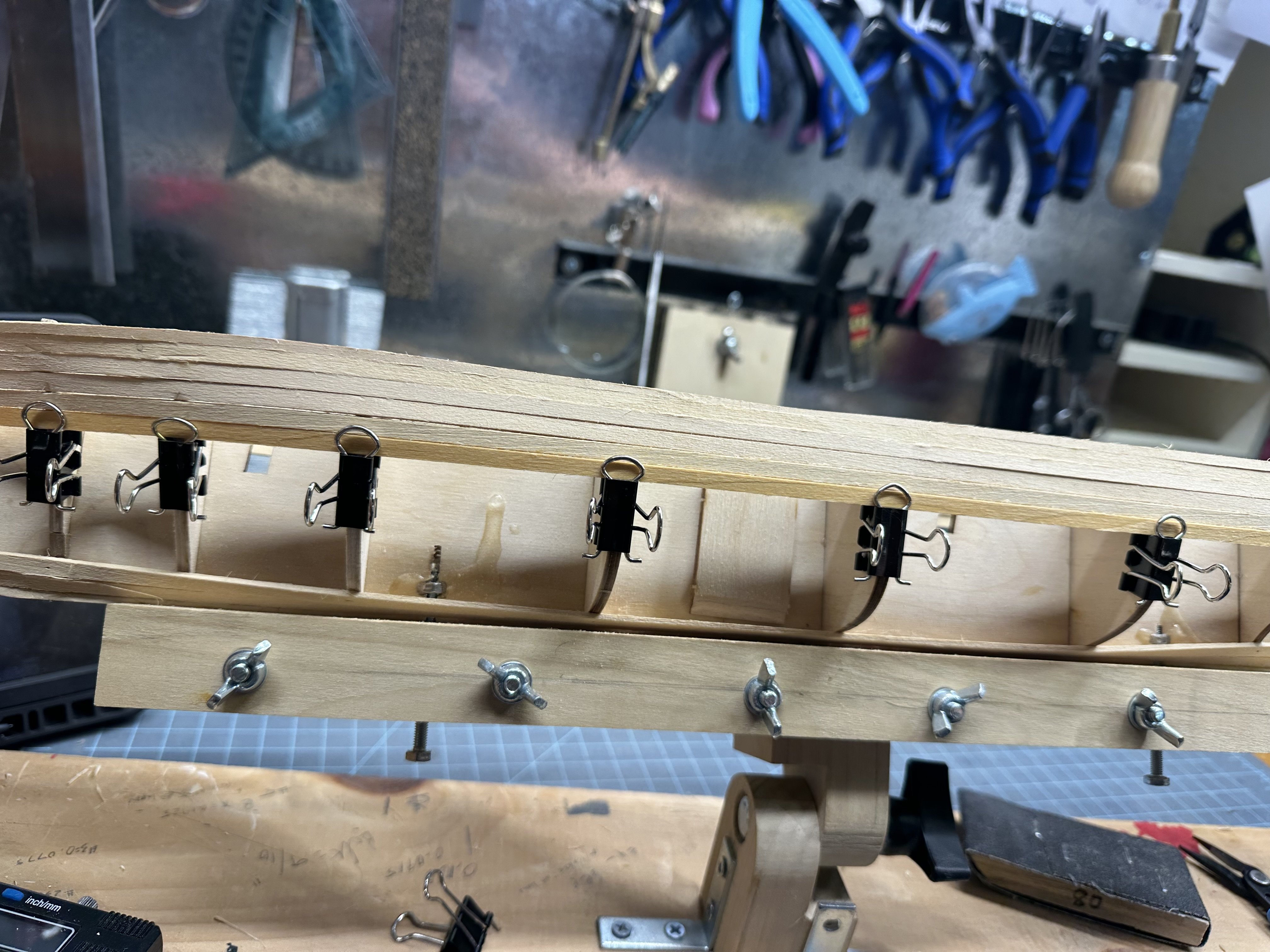

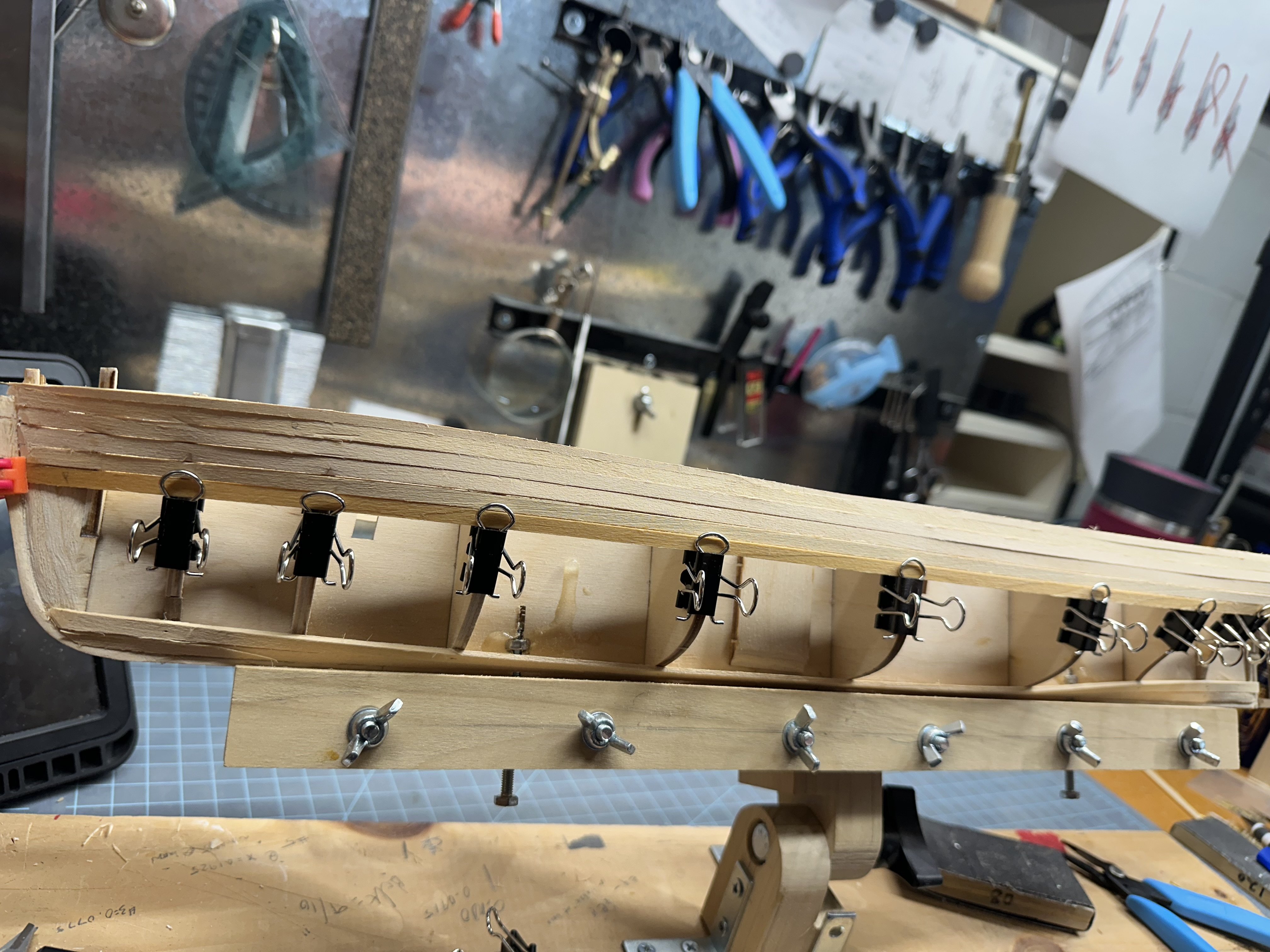

First plank of the first layer of planking is in place, this Mamoli kit is weird (to me at least) because I’ve always started with the wale as the first plank. They have you starting at a reference mark on the sides of the transom. The top of the plank runs flush along the very top of the bulkheads up to 6 and 5, which stick up higher.IMG_0472.thumb.jpeg.100cb034059b356db5a5ddedac2e3f69.jpegIMG_0471.thumb.jpeg.0b55599b21a4fcc11a37e17437b42bed.jpeg
The way the instructions look, the remainder of the first layer of planks run based on this first one. Referring to the Bowcock book, the hull is very sheer, no protruding wale plank below the gun ports.

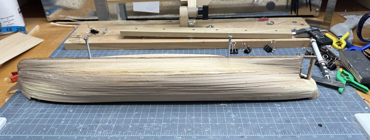

I realized quickly that when I tore the old hull down that I hadn’t replenished my wood strips to finish the first layer of planking, so I got new ones cut by the Lumberyard for Model Shipwrights (Link), which it turns out, is literally right down the road from me. David and Ev hooked me right up, and his wood supply is very impressive.
So I was back on track. The new wood was 0.5mm thicker than the OG, so I decided to restart everything, no worries. It’s summer so I get to the shop when I can, usually in snippets, enough at this point to lay on a few strakes. So it is slow going.
IMG_0732.thumb.jpeg.a25fdbd7965e65d1a102a9bf1fd80538.jpegIMG_0731.thumb.jpeg.23226df64670226ec817133d5e6fae2a.jpeg
I did make those cool binder clip clamps out of mini clips. And I’m very glad I pre-fitted the keel bottom with screws for brass pedestals as I have something sturdy for my keel clamp to bite onto (see the two screws poking out from the bottom of the clamp).
That’s it. After laying on the 1st layer, it’ll be a coat of Durham’s Rock Hard wood filler and sand sand sand. It’s early days, but it’s got the shape of a ship now.
You might consider a different filler as Durham's is usually much harder than the woods (such as bass) commonly supplied in kits.  I've used auto body filler (bondo) for decades.  It's the same relative hardness as basswood, so it sands and feathers well without scouring out the wood on either side of the patch.  In addition, as it is a polyester resin, it is an adhesive and locks the planks in place.  One water-based filler I've had success with is Famowood which I purchase online.  It is similar in hardness to basswood and sands well.

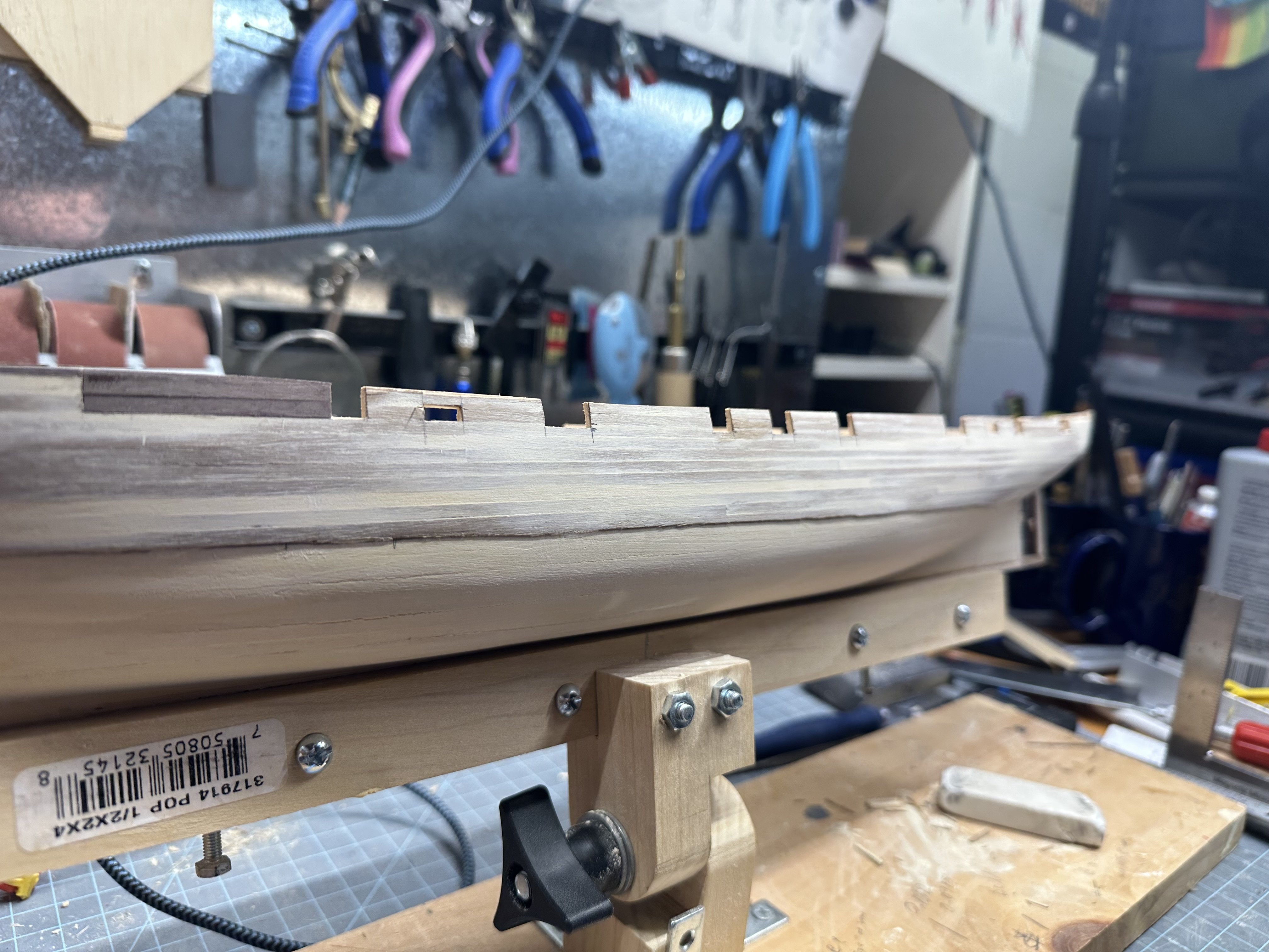

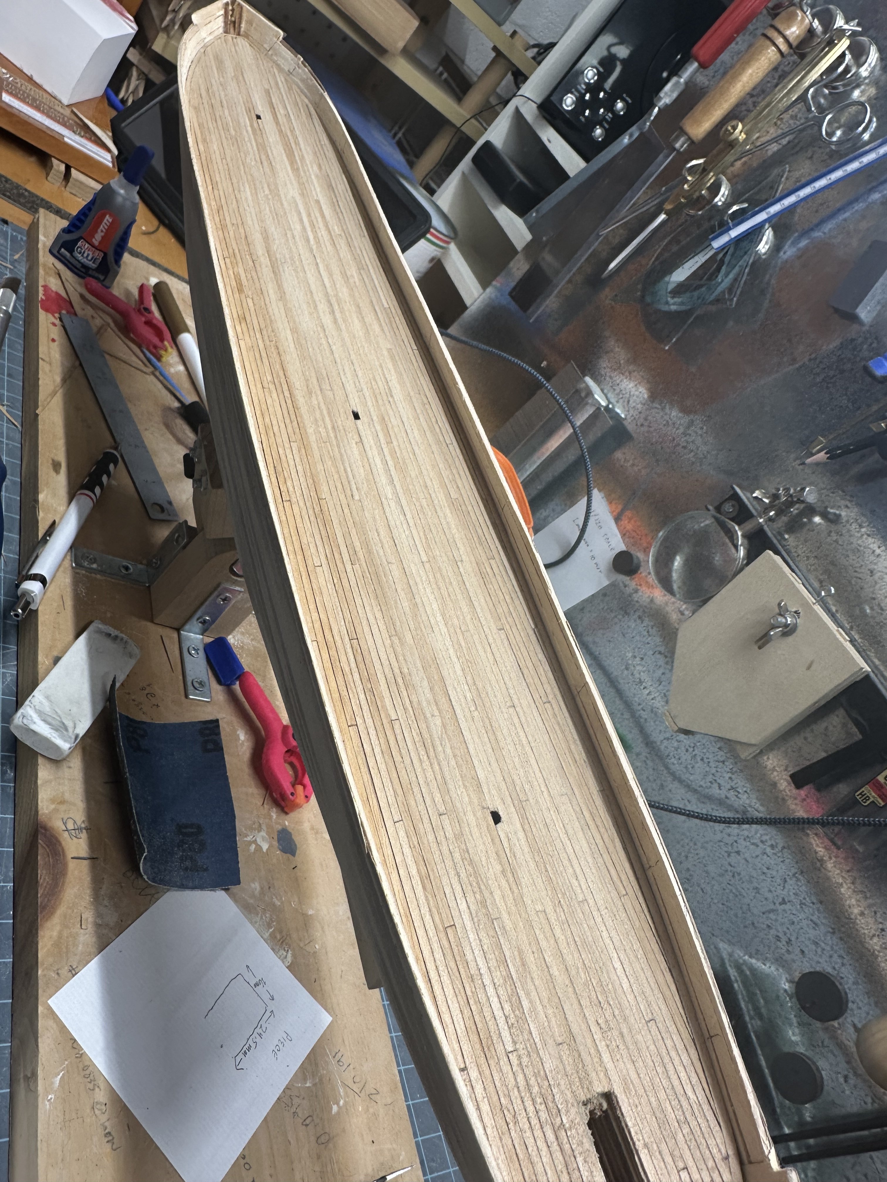

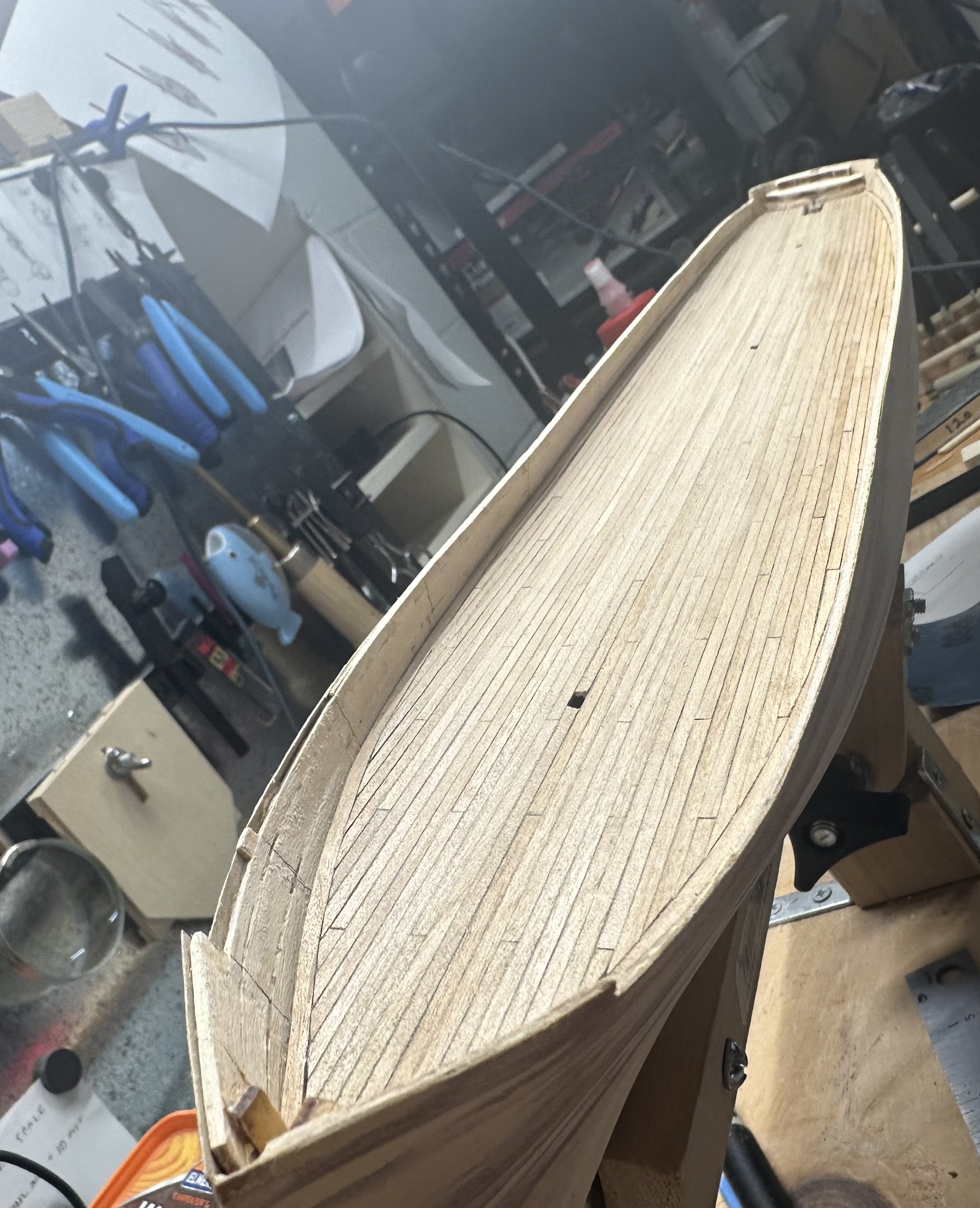

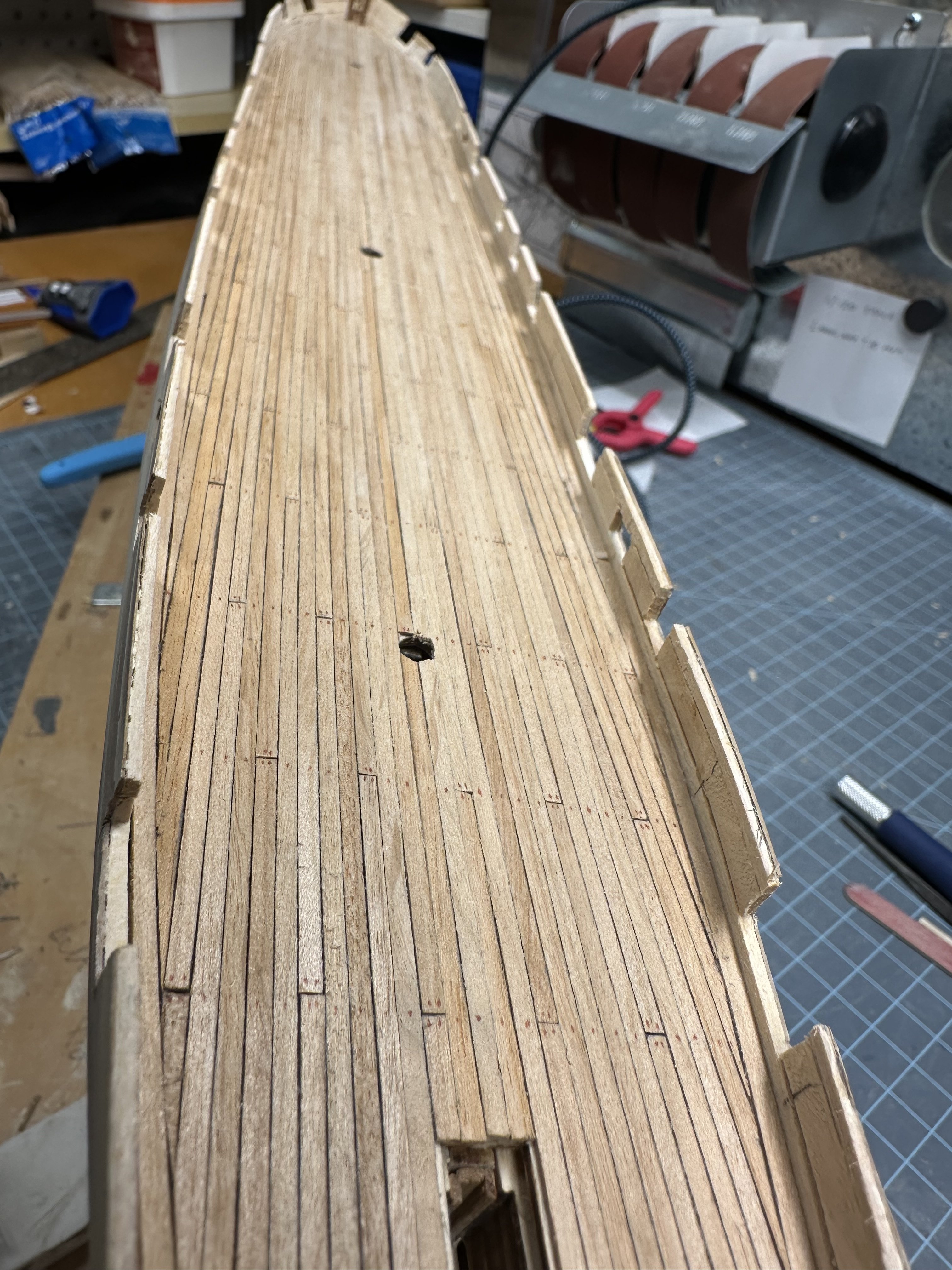

The last plank of the first planking layer was put in place…finally
I’ll start sanding down high spots and filling the gaps in with Elmers Wood Filler. The majority of the posts here say the Elmer’s works fine and is easy to sand. I’ve done some random spots on the hull already and I concur - MUCH easier to sand vs the Durhams filler. And since I happen to have a container of the Elmer's filler in my shop, money saved!
I’m very pleased how the hull in general has turned out so far and wished “2009 me” would’ve taken a pic of my first go-around with this hull I when I had less of a clue than I do now. I know I didn’t do half the things I’m doing this time around. Funny what just a few ship models do for one’s experience level.
 Your first planking looks great.
