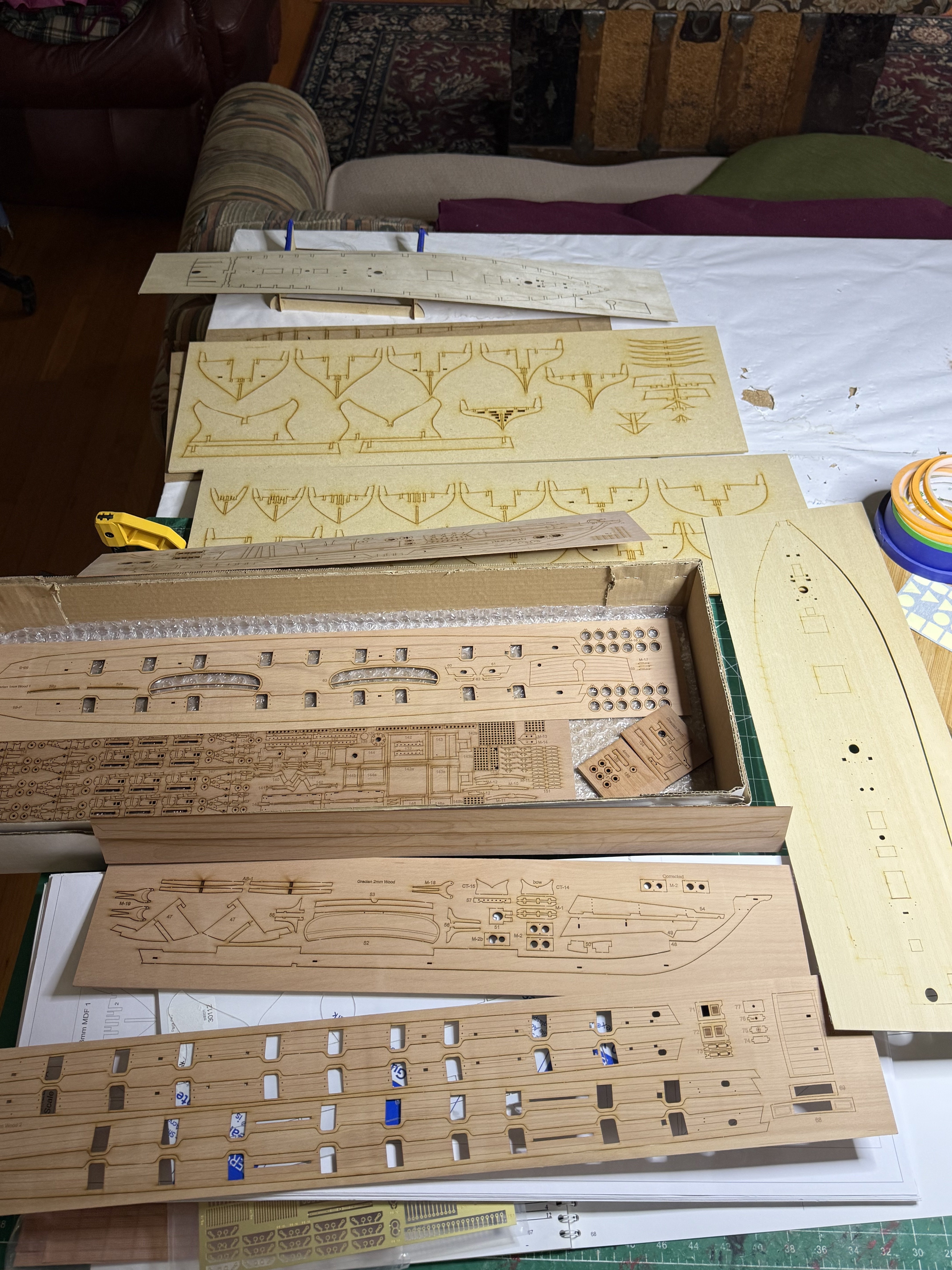

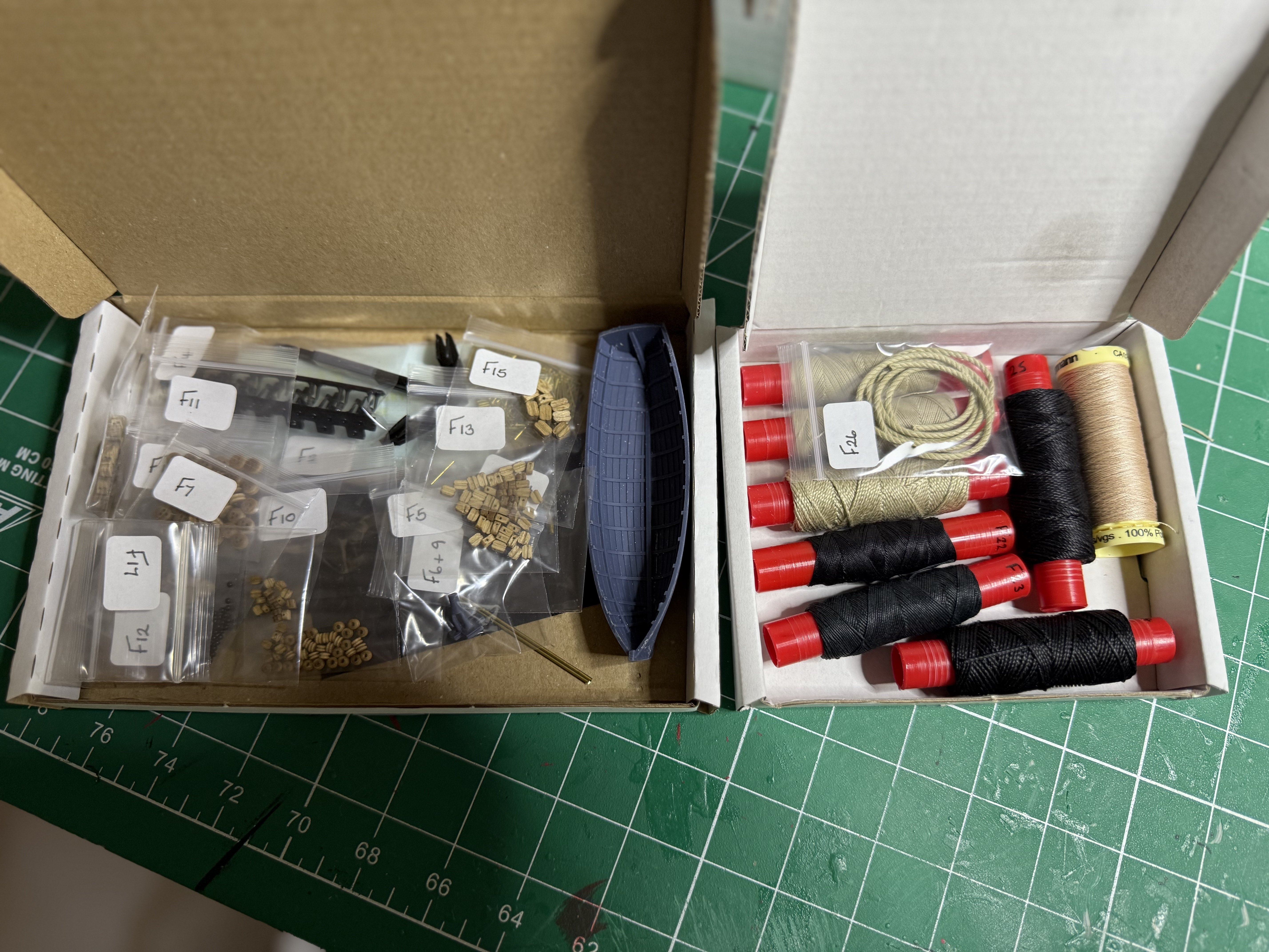

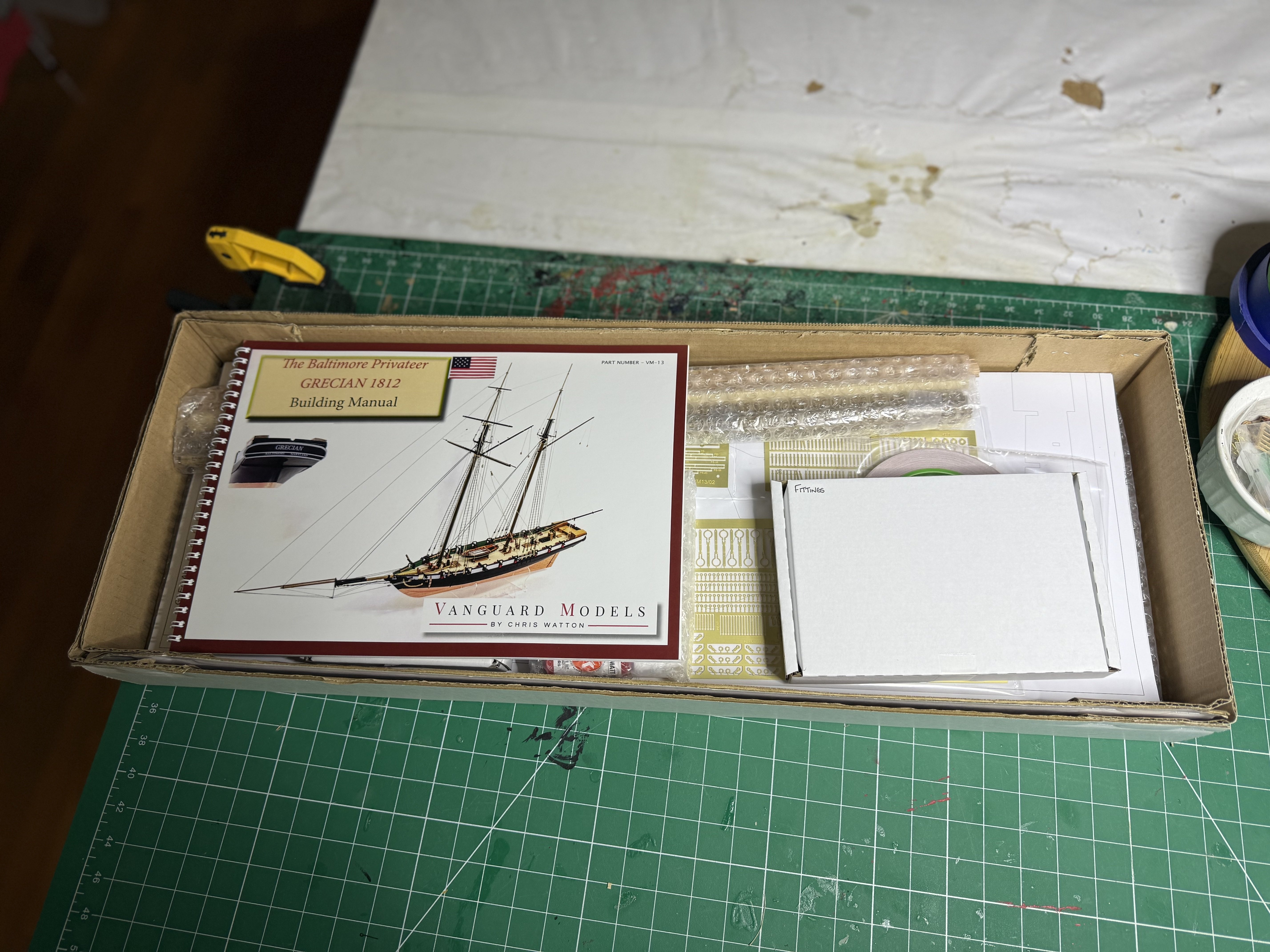

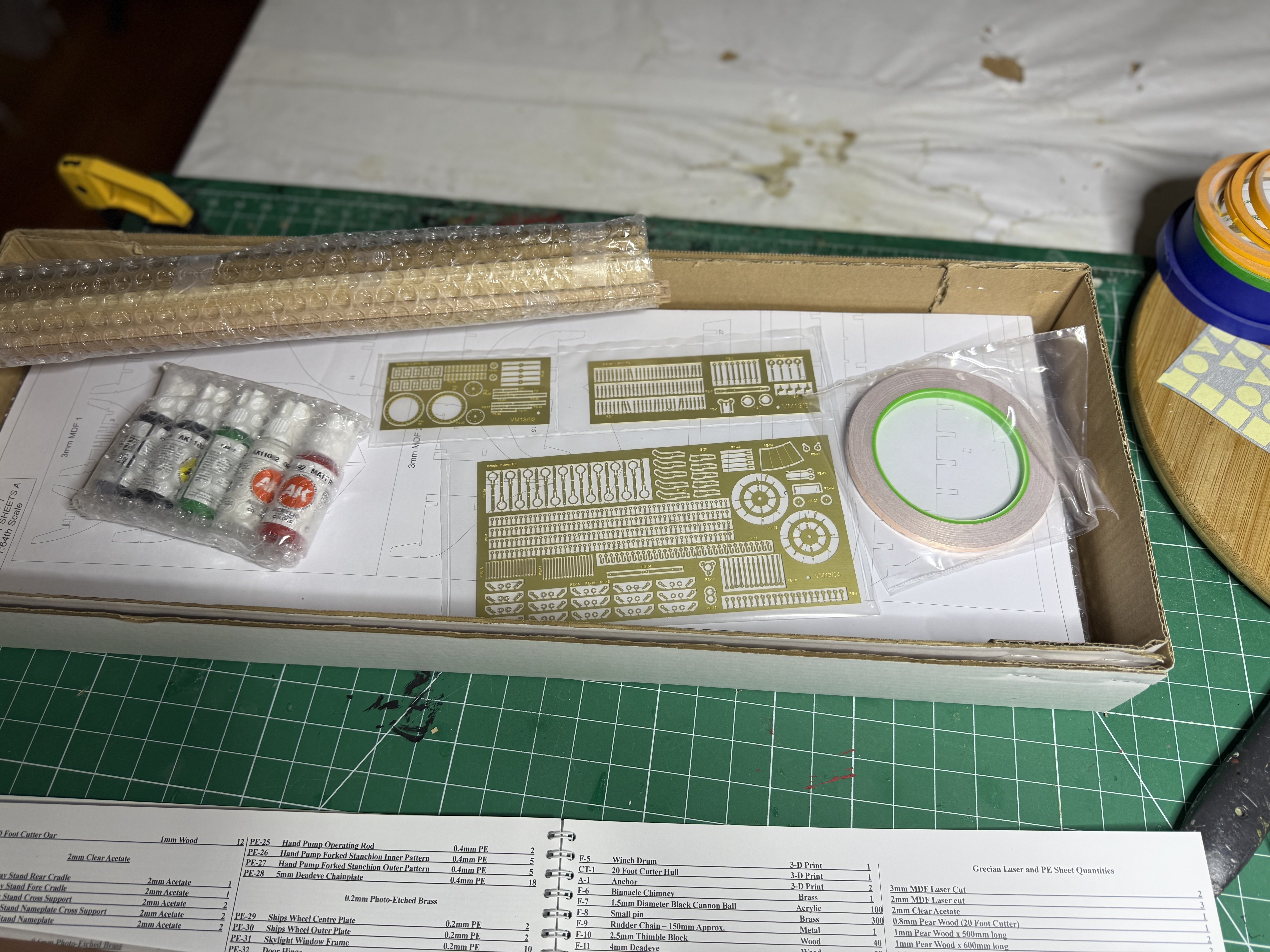

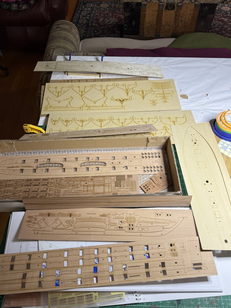

Having just finished a fun build with HMS Harpy, my next build will be another Vanguard offering, HMS Grecian although it is a dual citizen and could be USS Grecian.
So first the unwrapping:
IMG_0063copy.thumb.jpg.72affe2603308a0f156f7be9eabdcf42.jpgIMG_0064copy.thumb.jpg.ad36af44beabe00f398515bd37a6b540.jpgIMG_0065copy.thumb.jpg.610b22452ae7aea0555a6831da8b5d12.jpgIMG_0066copy.thumb.jpg.7260ad75e43bb03350ae933af1780592.jpg

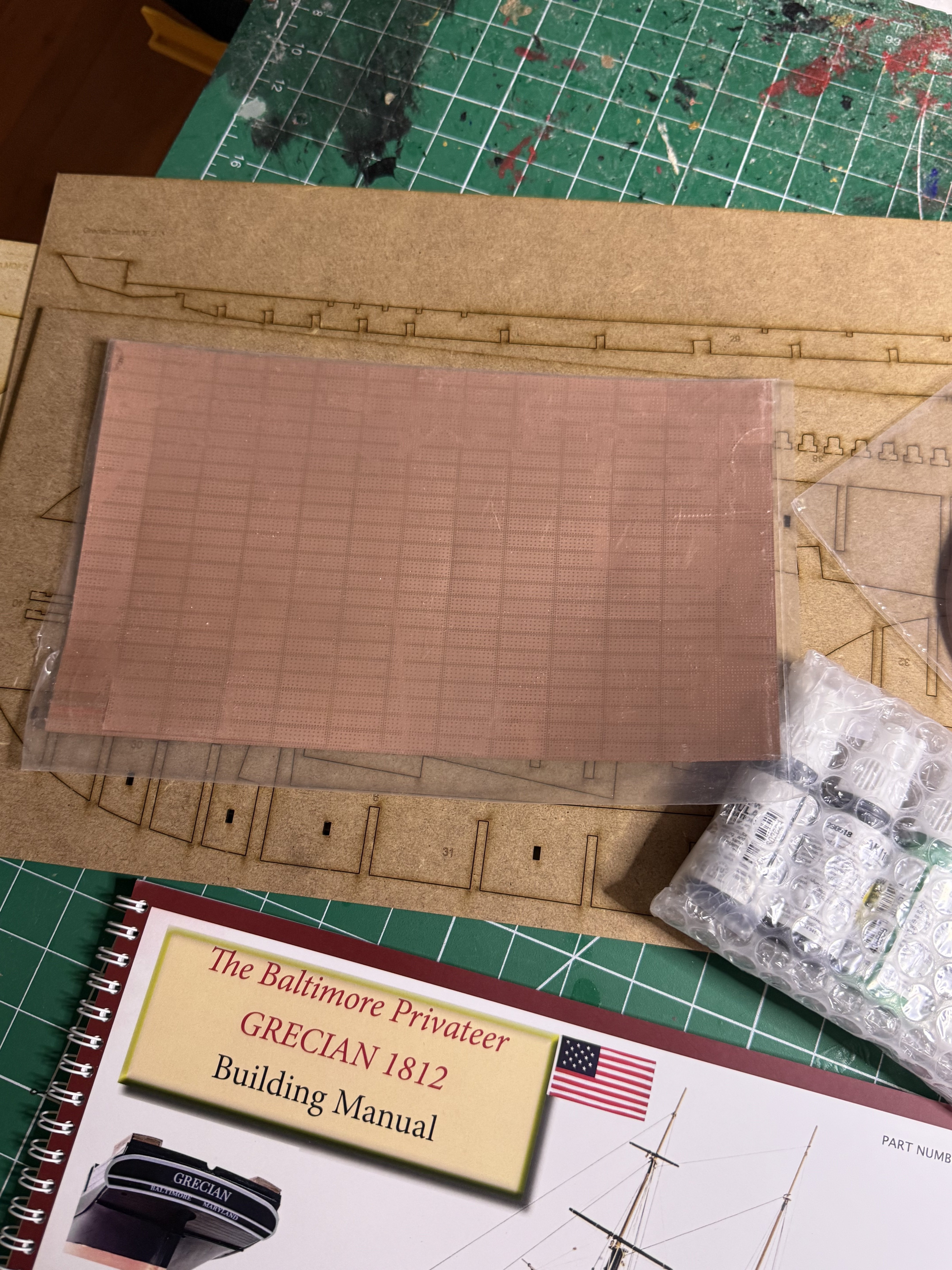

I also bought the paint with the kit. It also uses copper tape
IMG_0068.thumb.jpg.fb9d596558e69cd2995f838a70e1aa13.jpgIMG_0067copy.thumb.jpg.6c69440981baf5496b14ae322478a523.jpg
I think I have enough copper tiles (2 sheets) left over from Harpy and I think it should cover so will use them

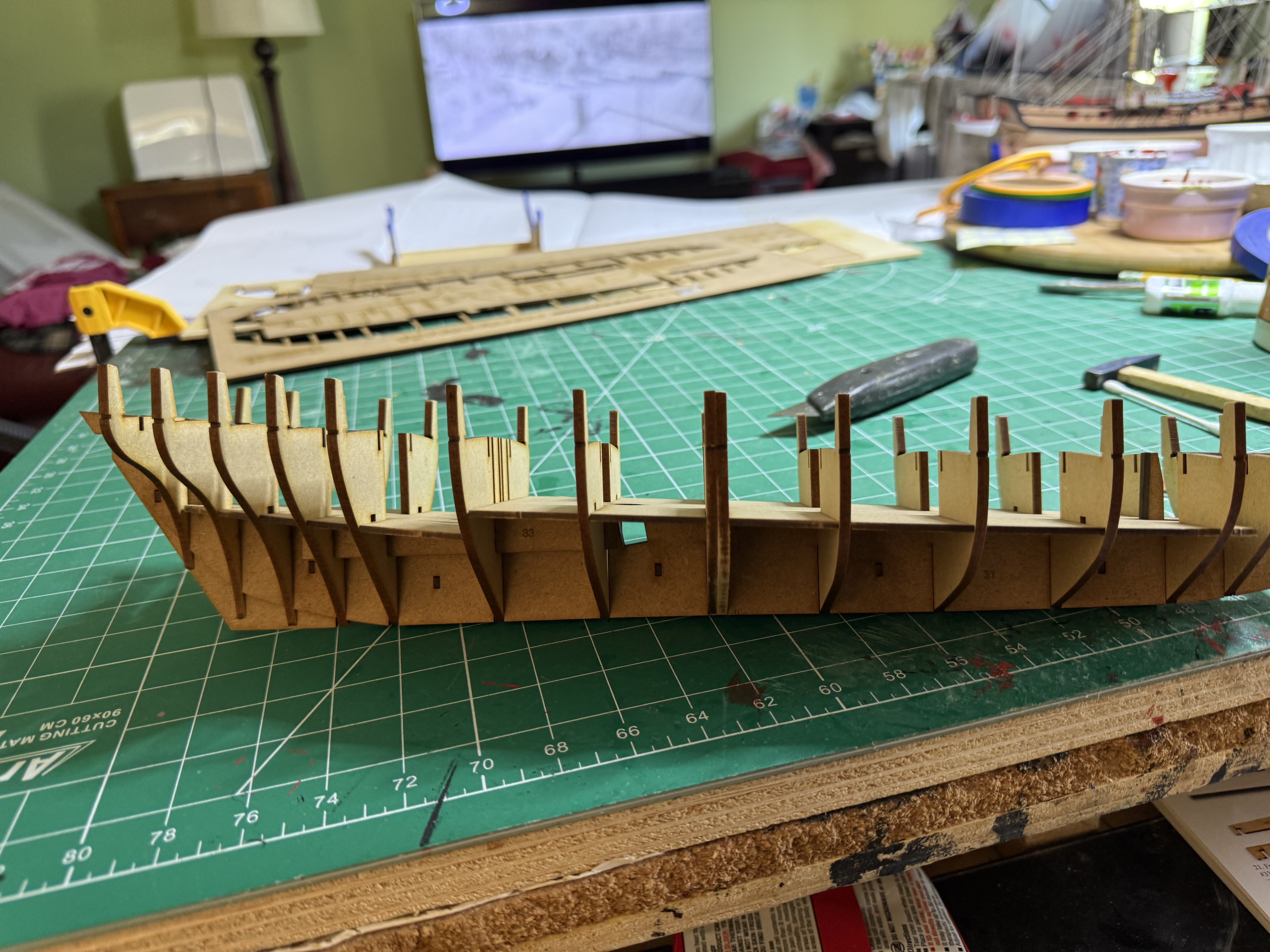

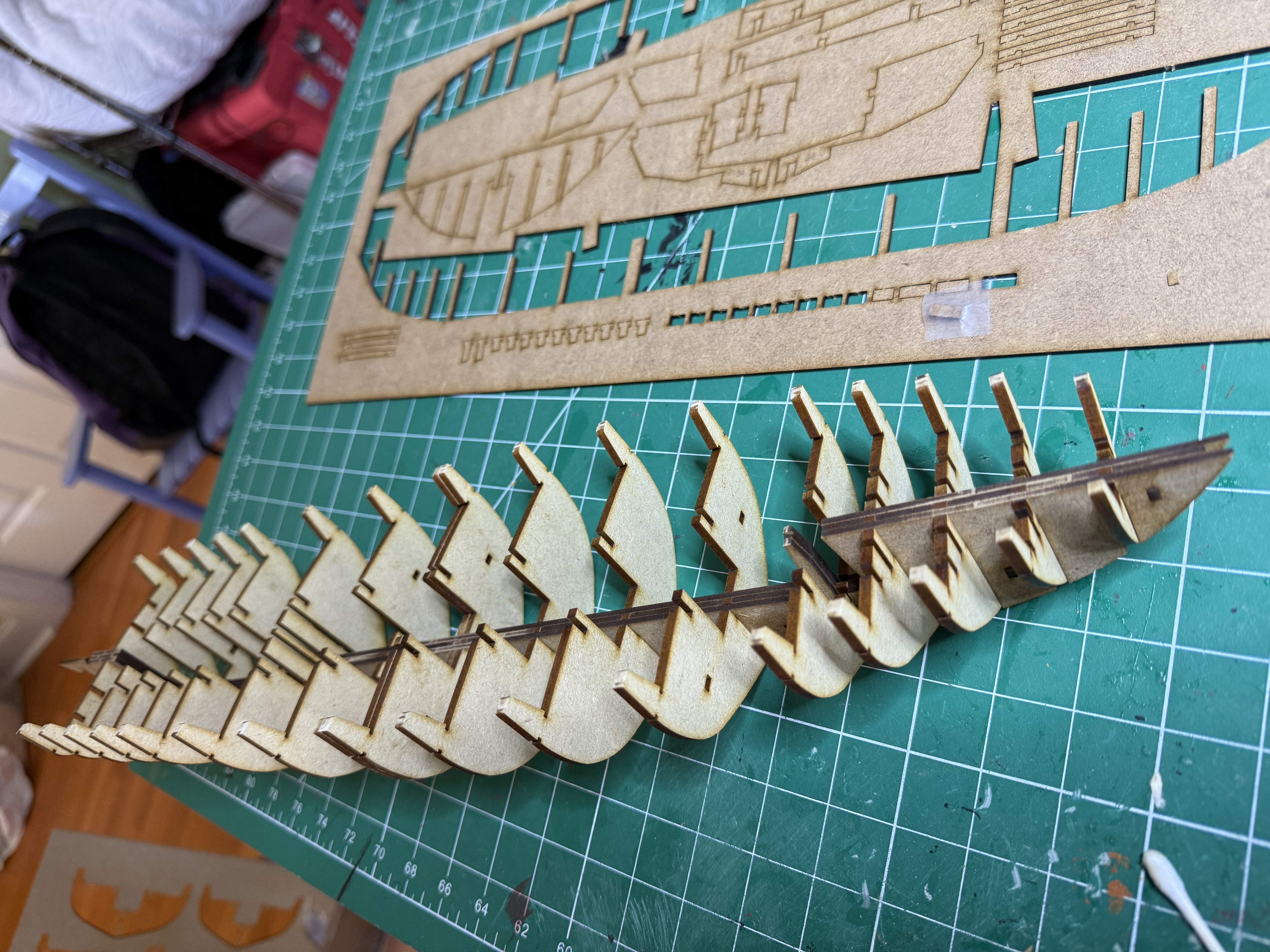

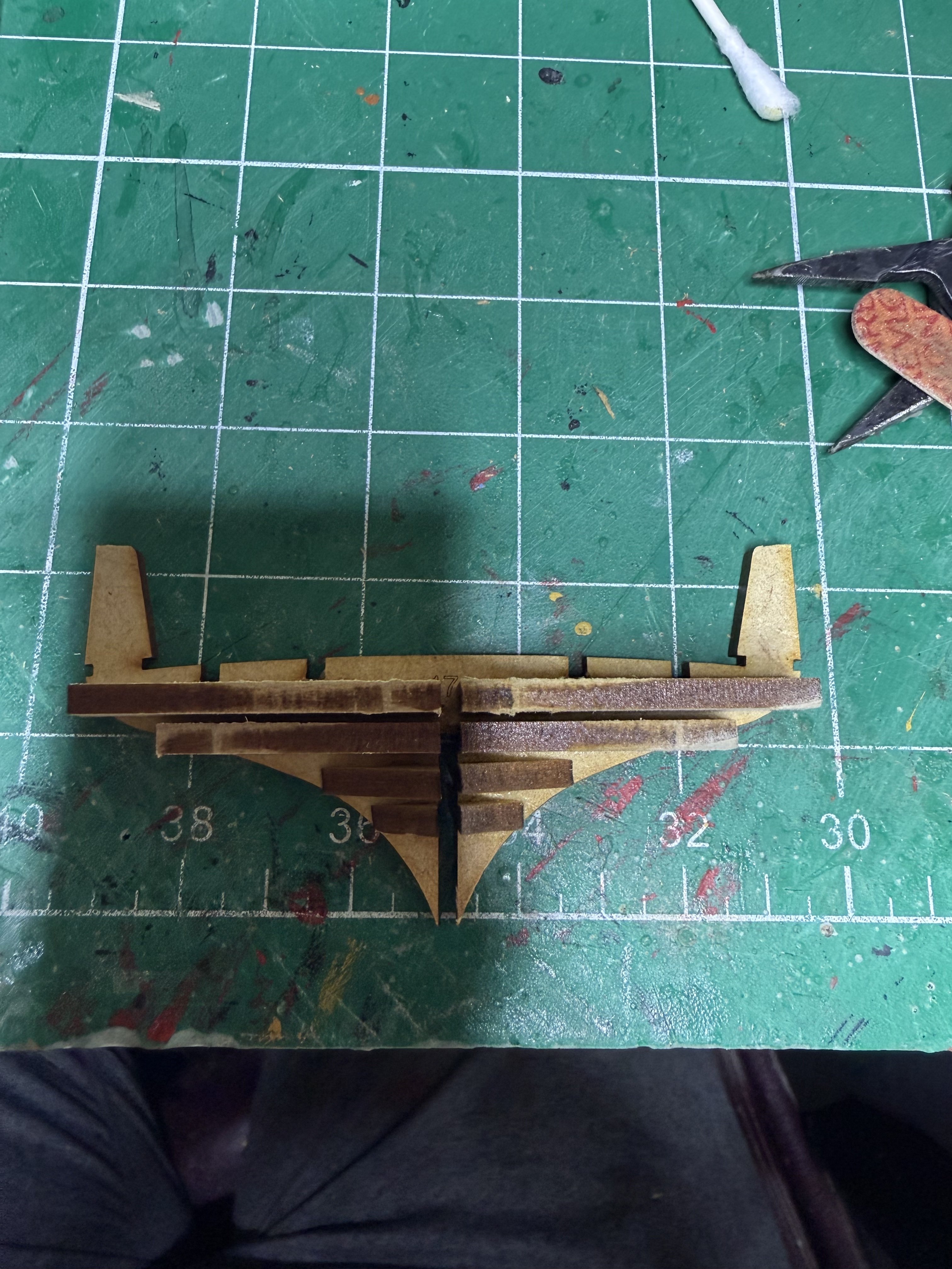

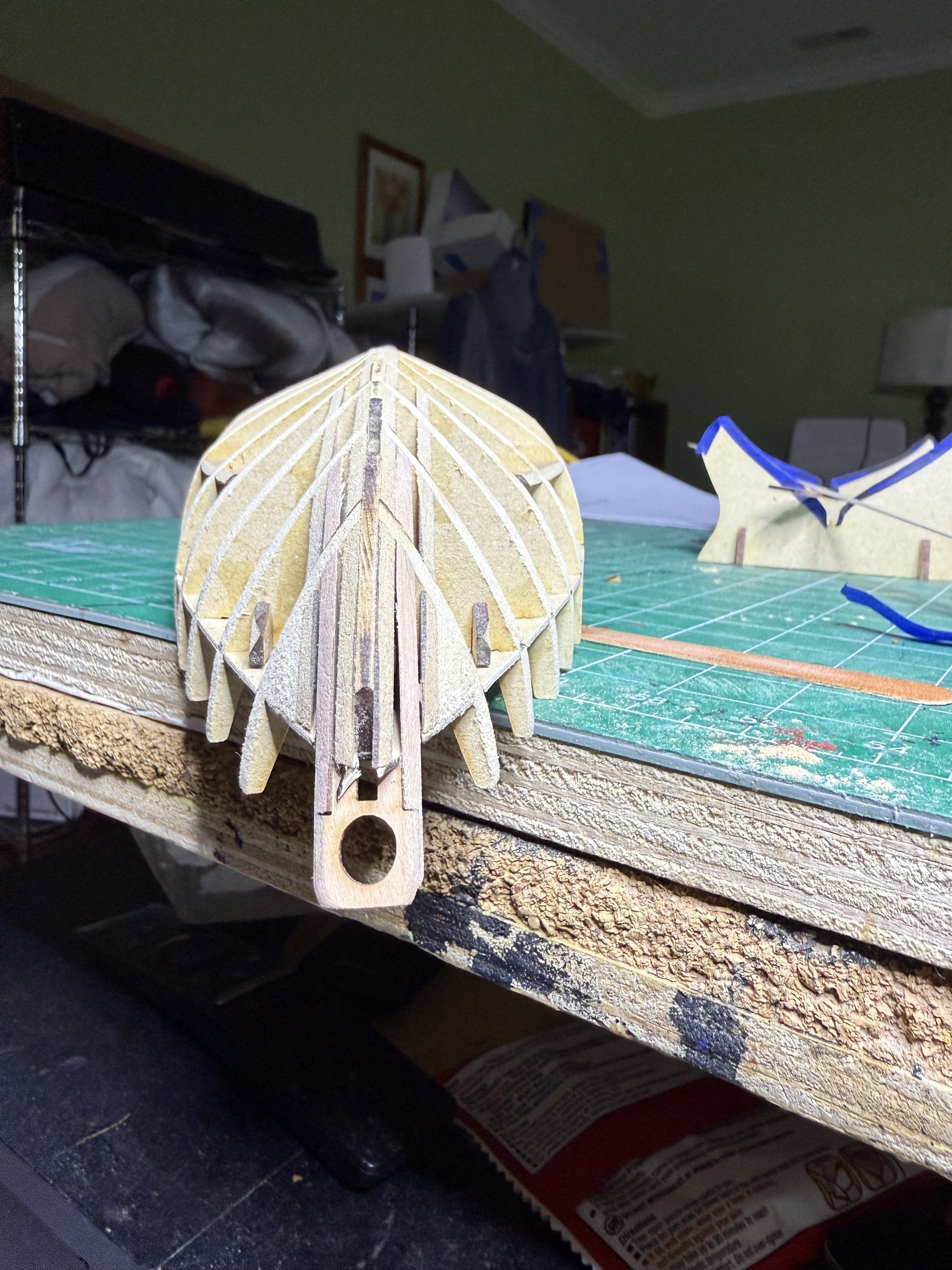

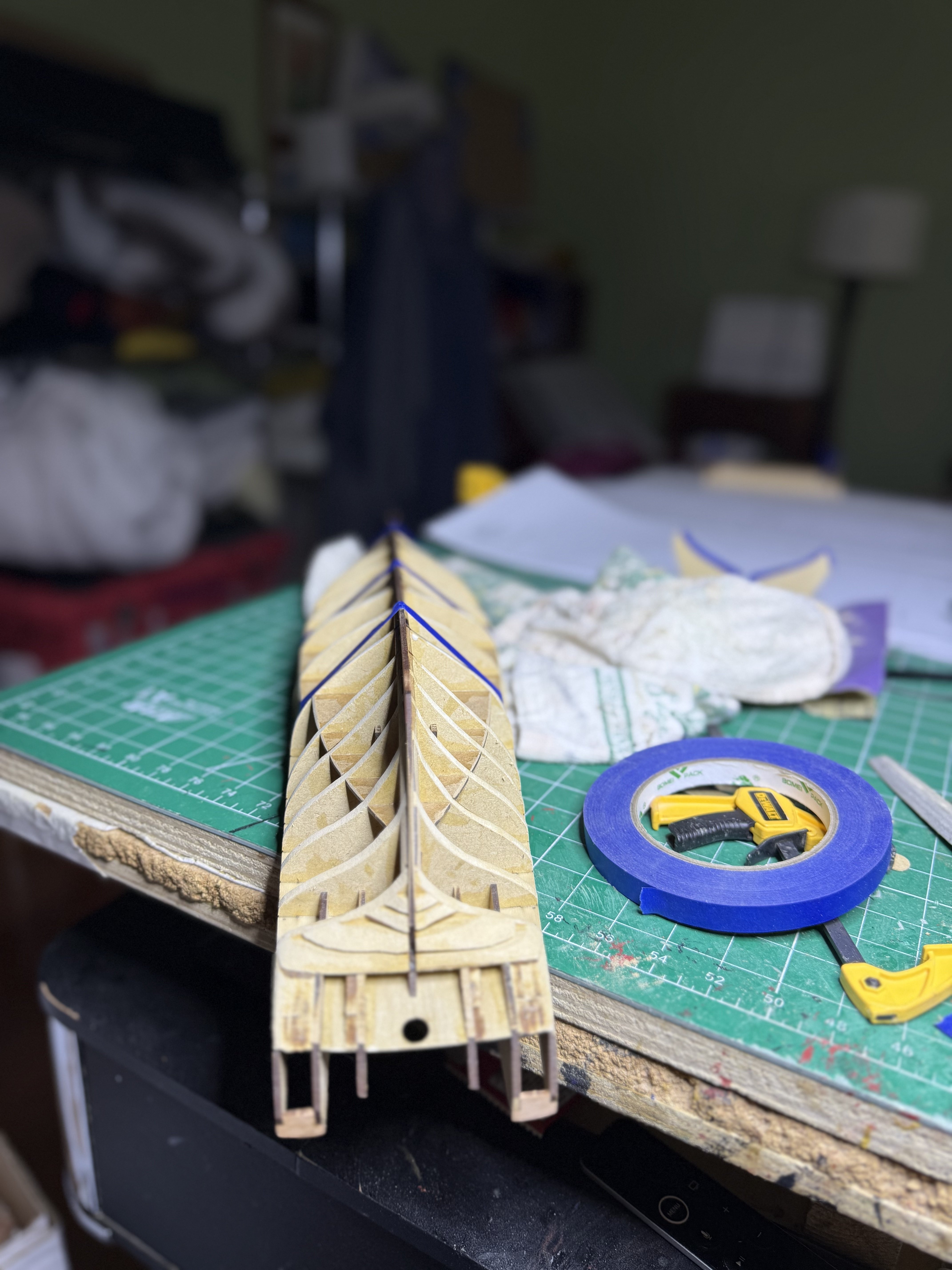

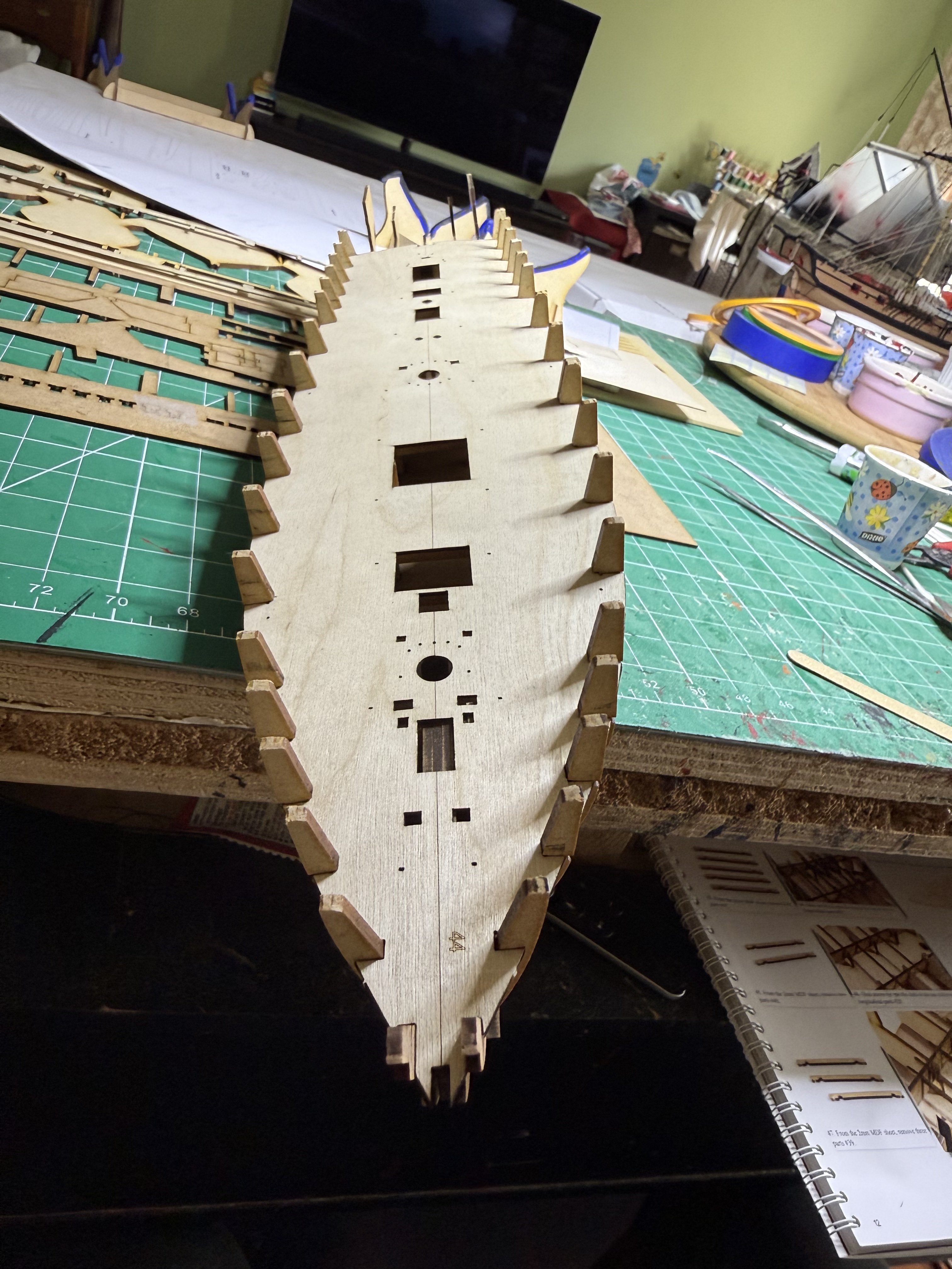

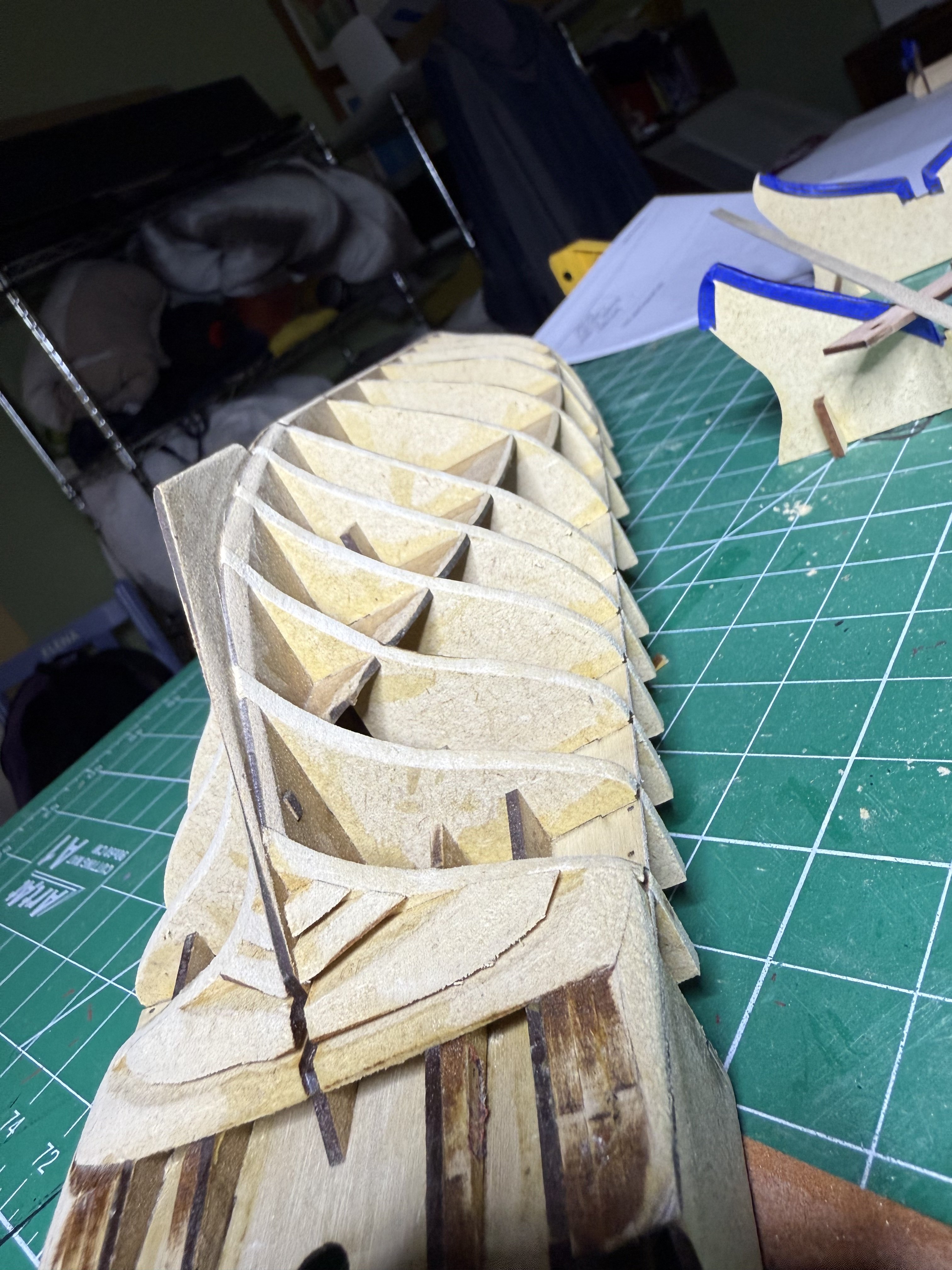

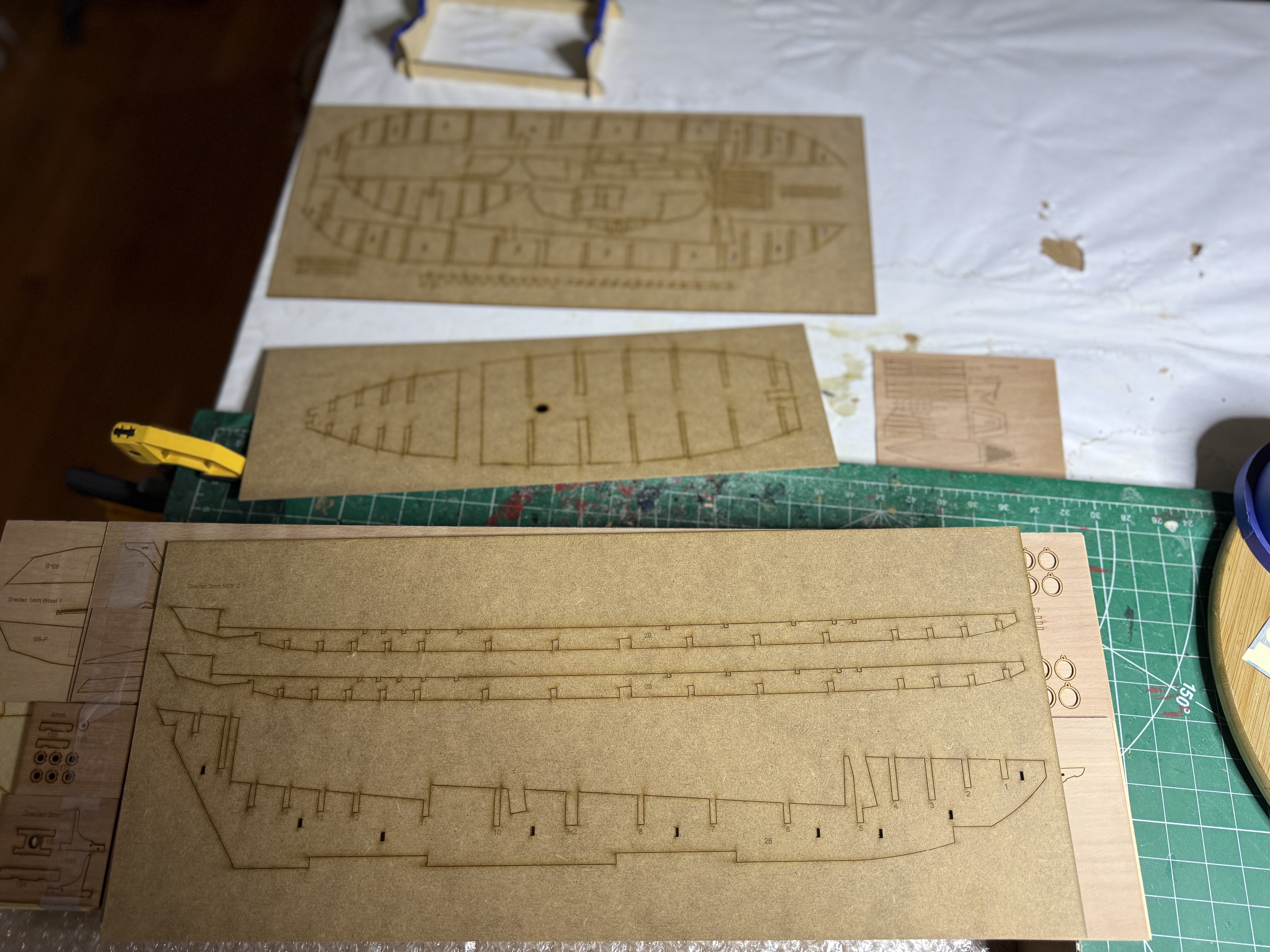

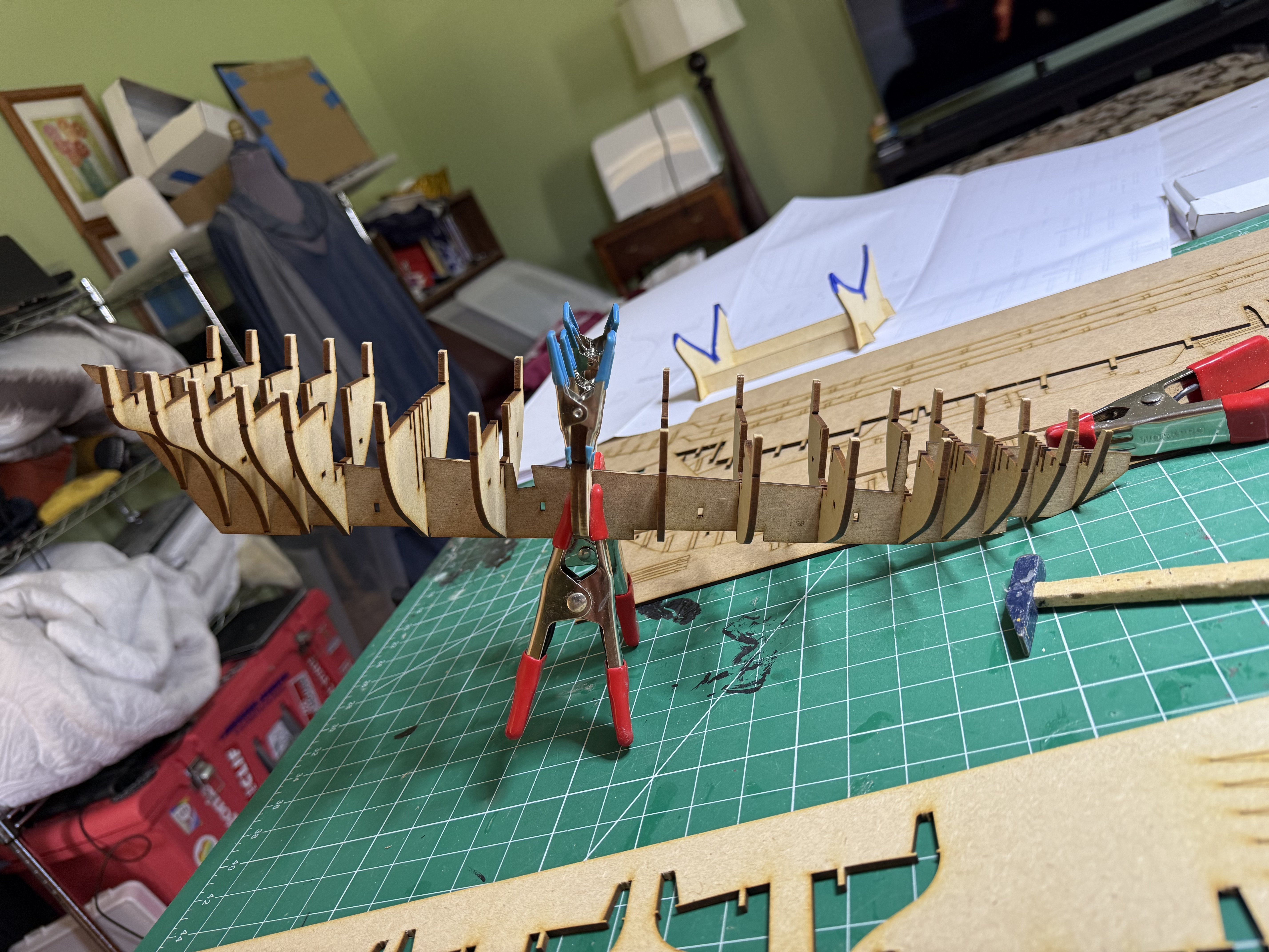

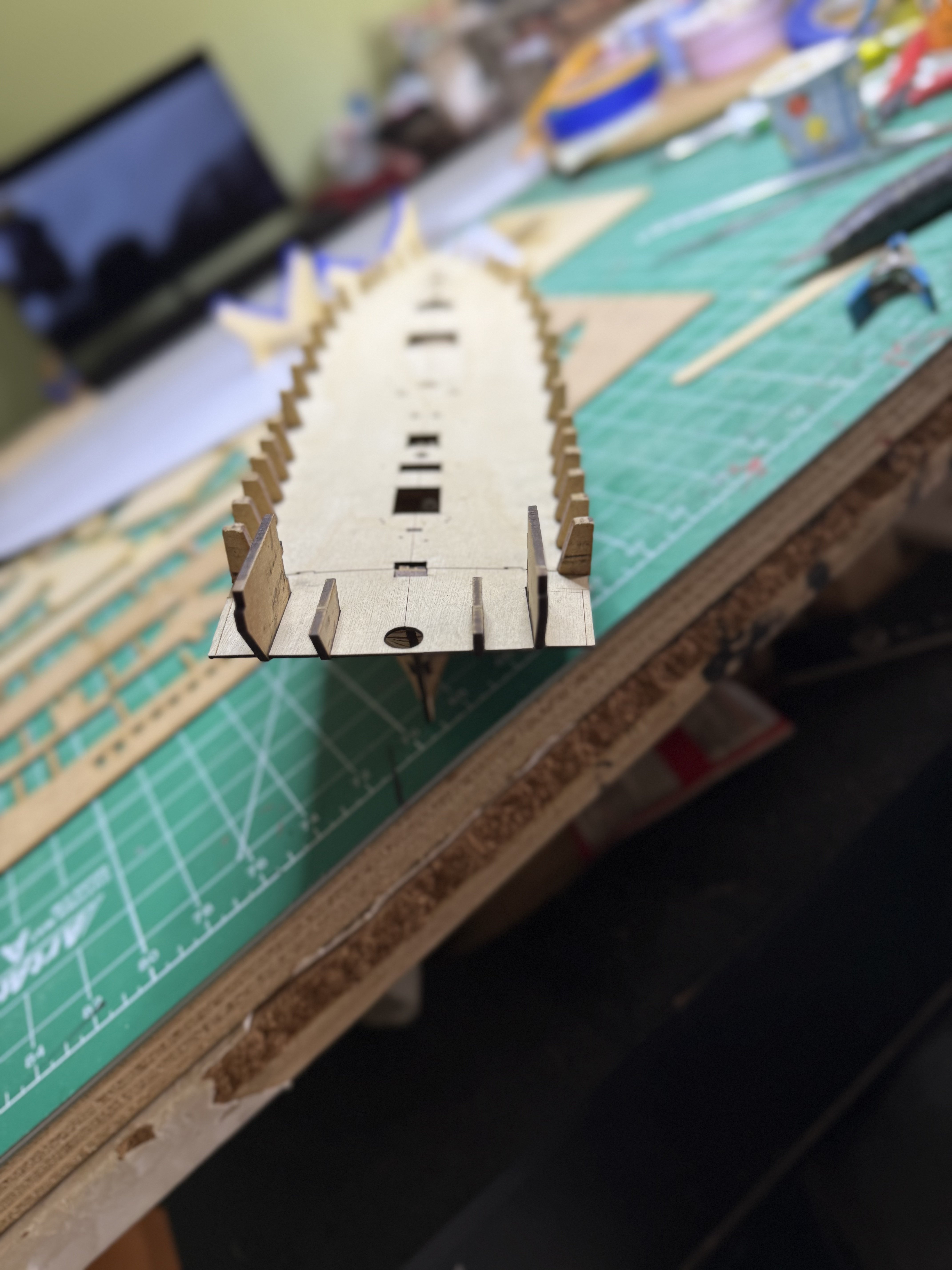

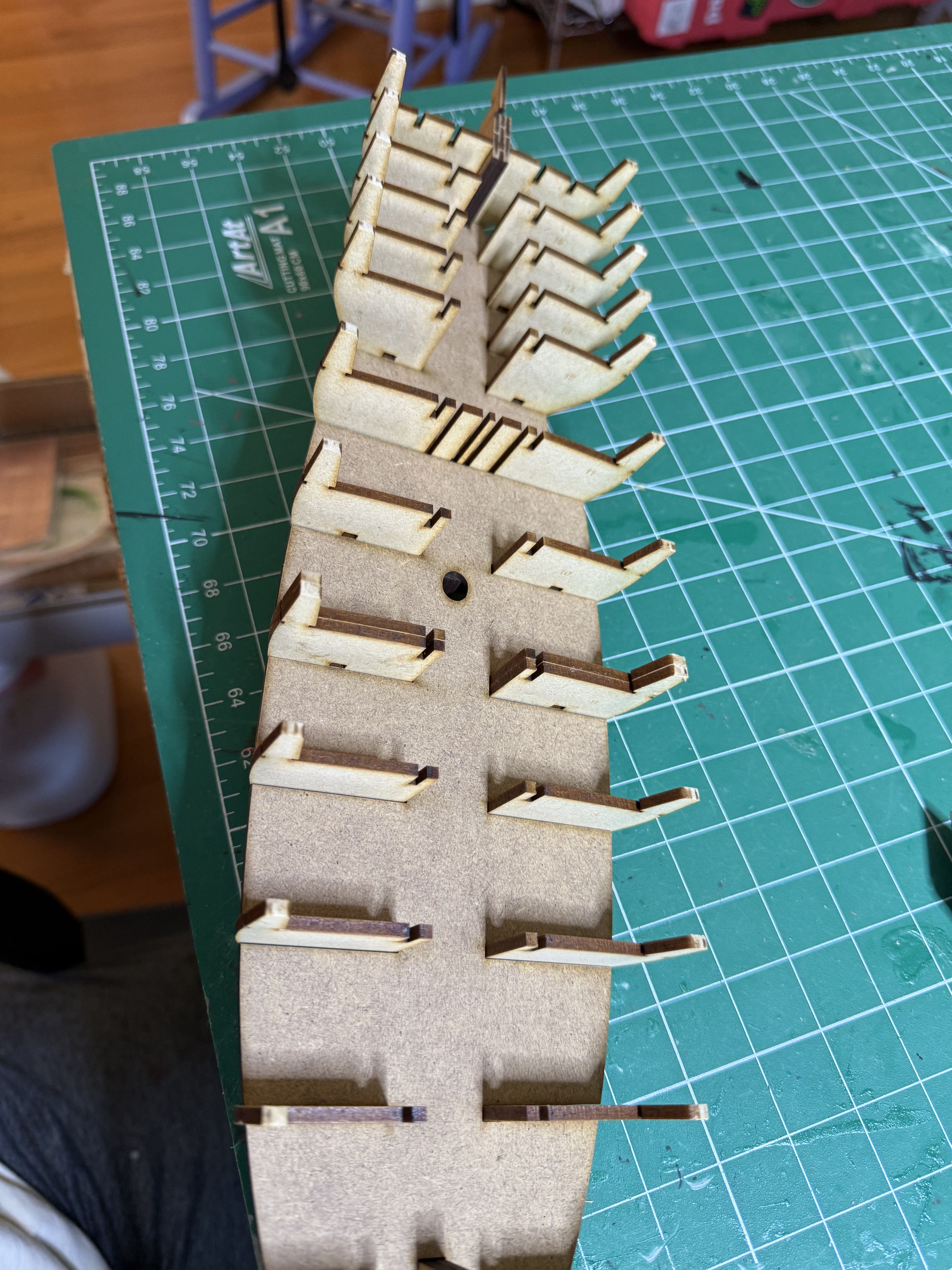

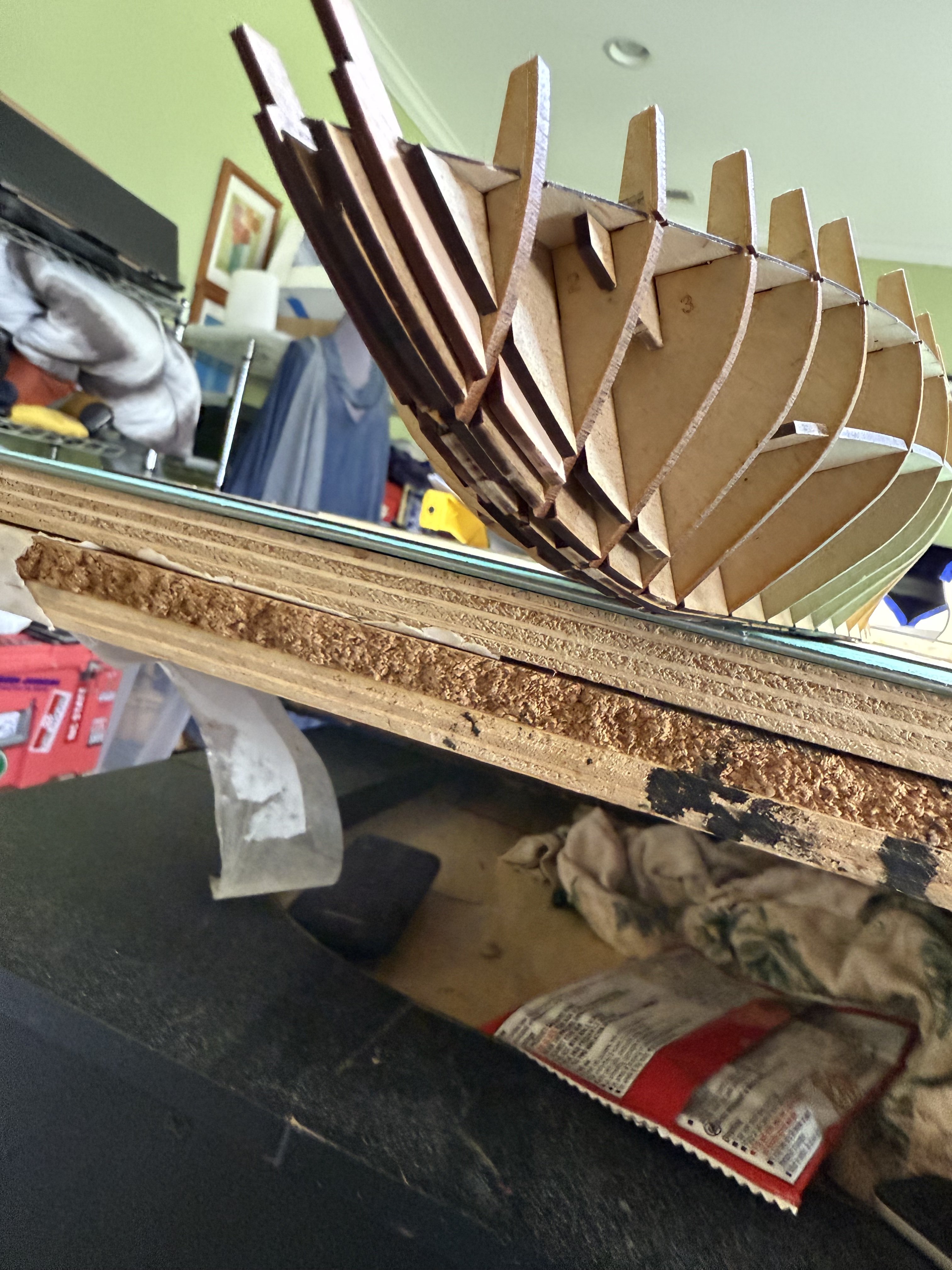

Like all vanguard kits, things slot together quickly and then wedges glued to keep together. Final gluing of all the seams occurs later.
IMG_0070.thumb.jpg.ef861df43860c5fa23ccc8b78319fb02.jpgIMG_0071.thumb.jpg.b805e551b014bb6e70d047e31a5bde7d.jpgIMG_0072.thumb.jpg.cccf6ca138eec46eb75ffaaddc3de485.jpgIMG_0073.thumb.jpg.b8e2610a18a9c9b9935ed8a2364cb205.jpg

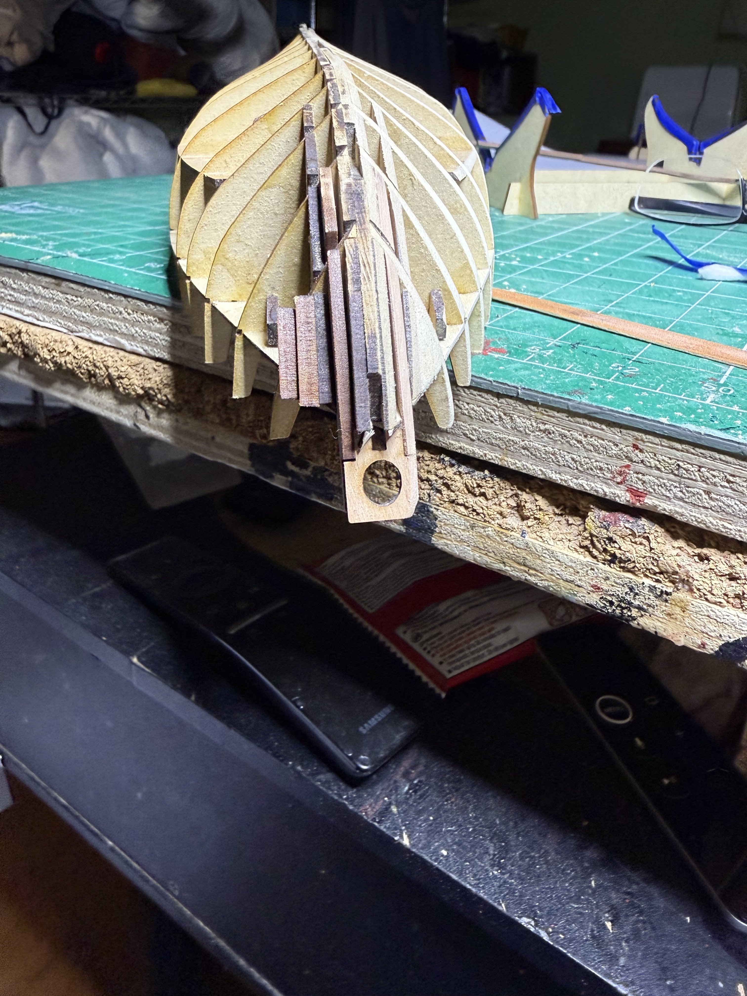

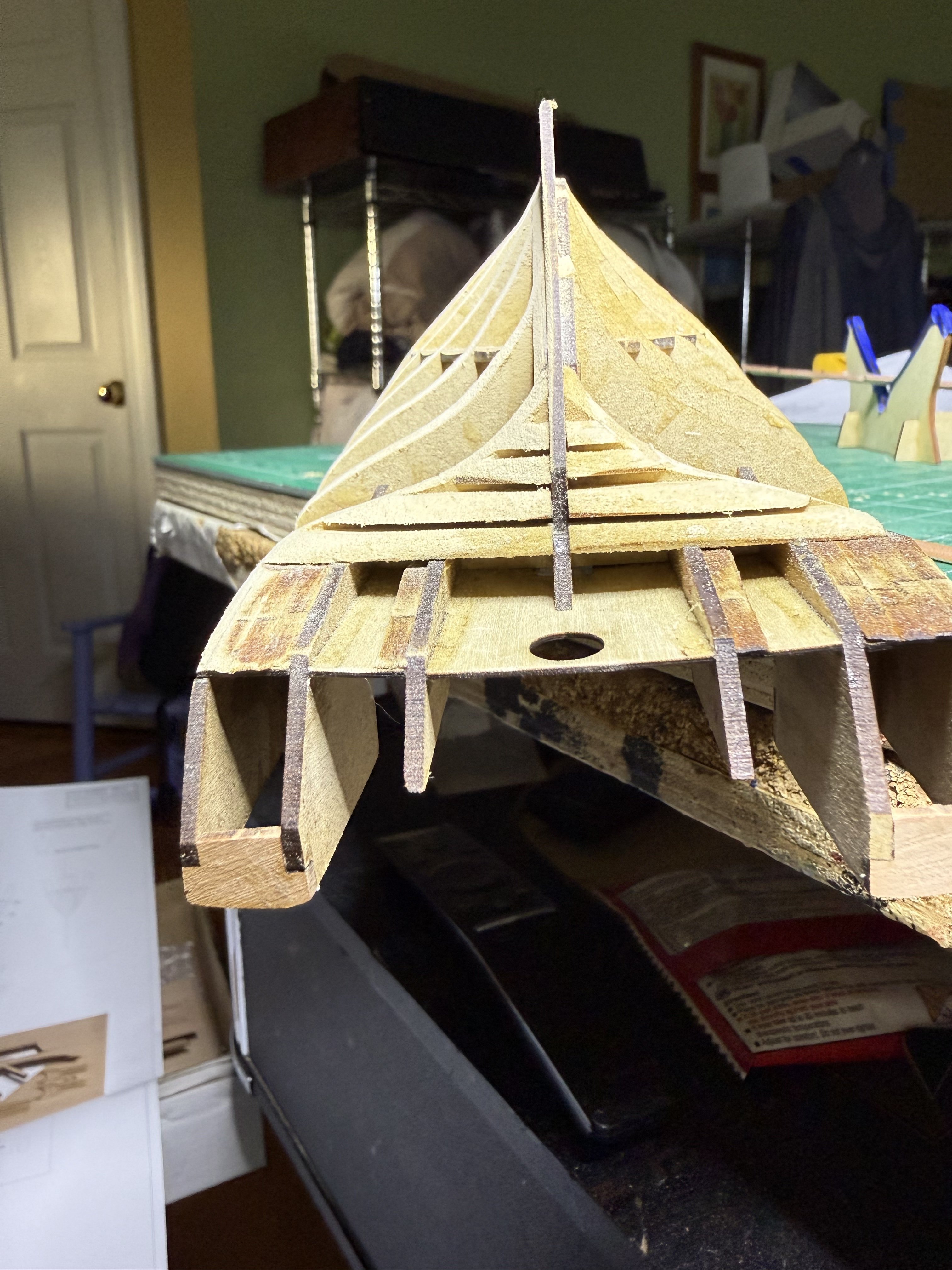

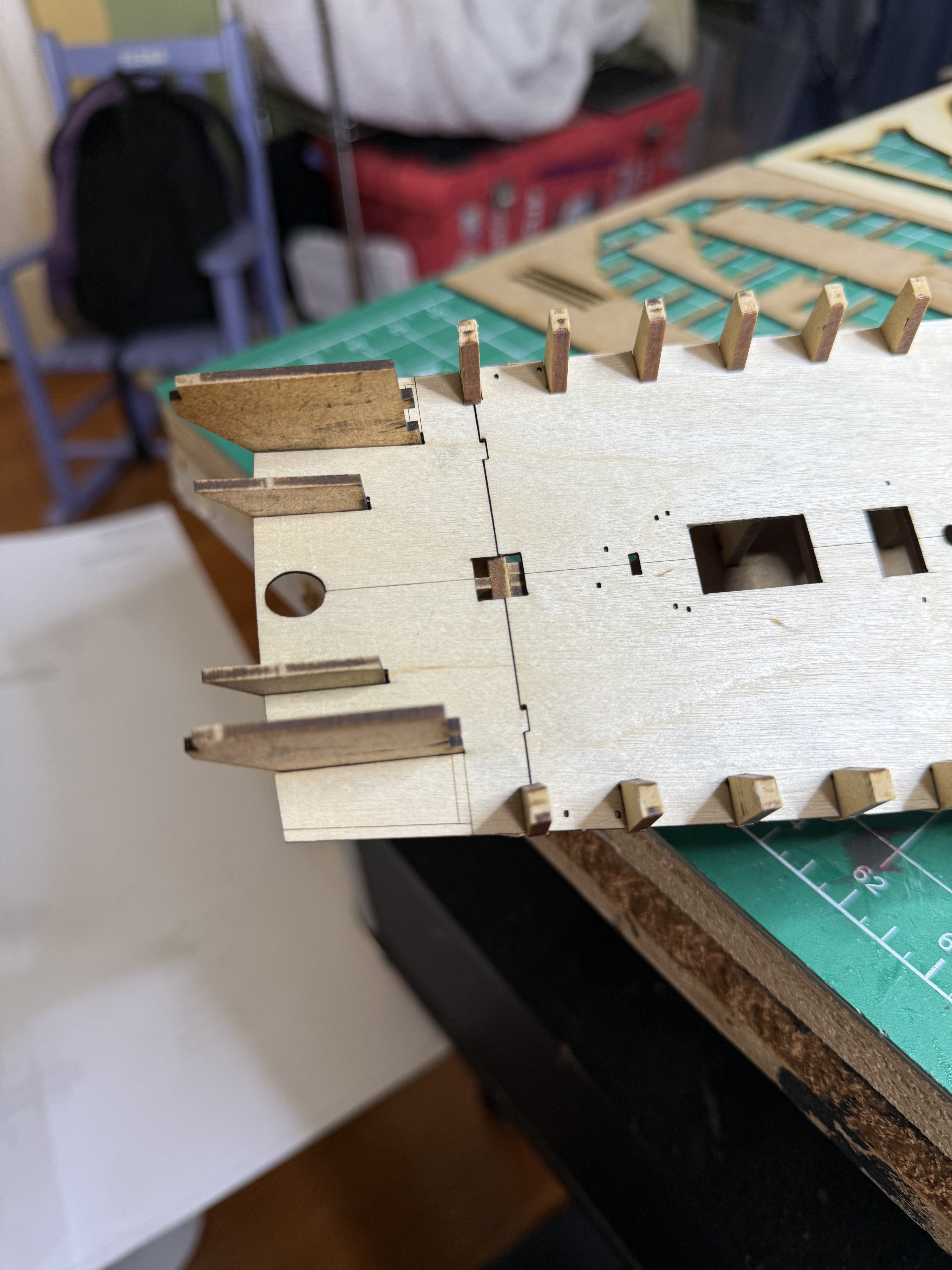

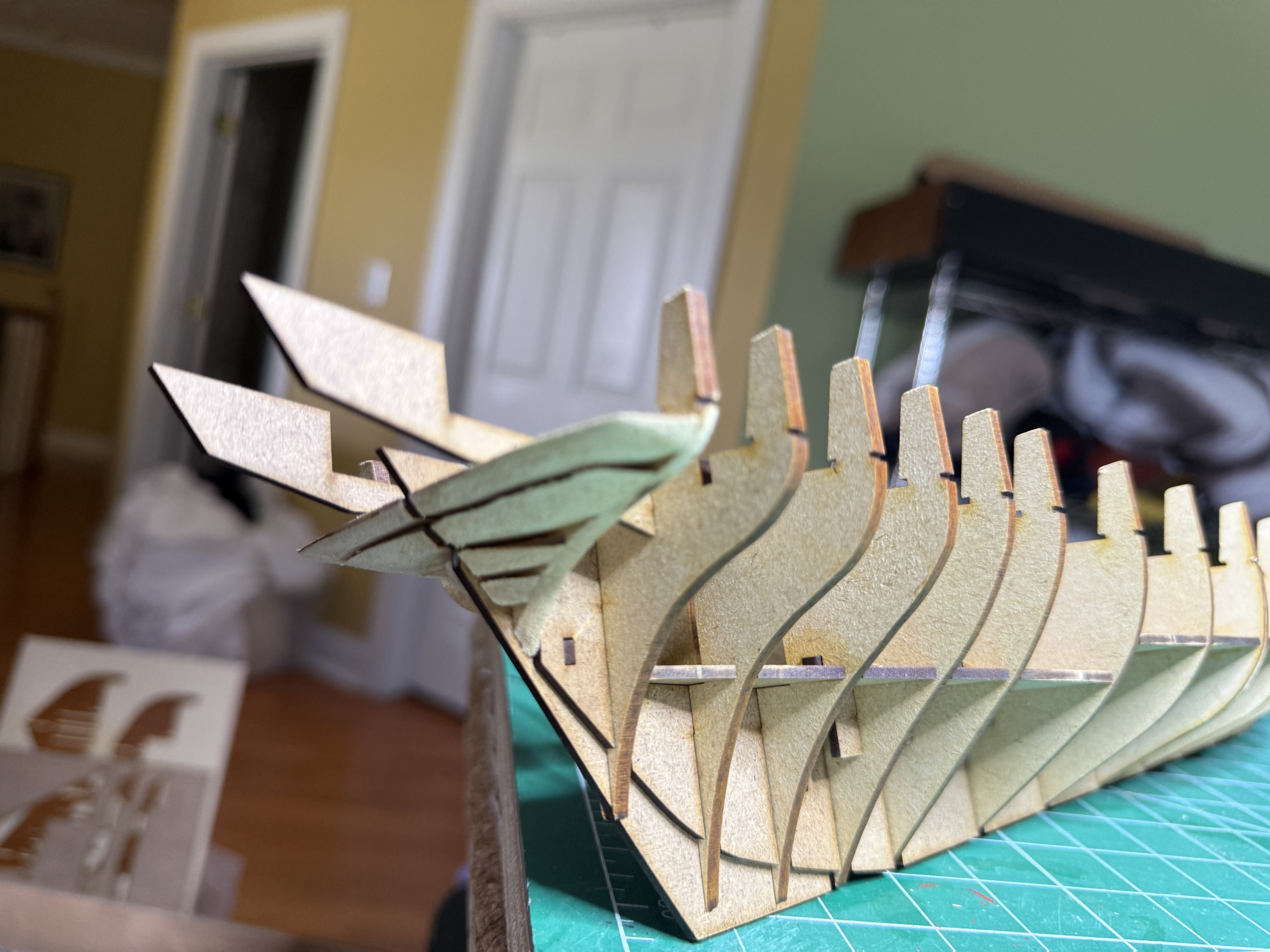

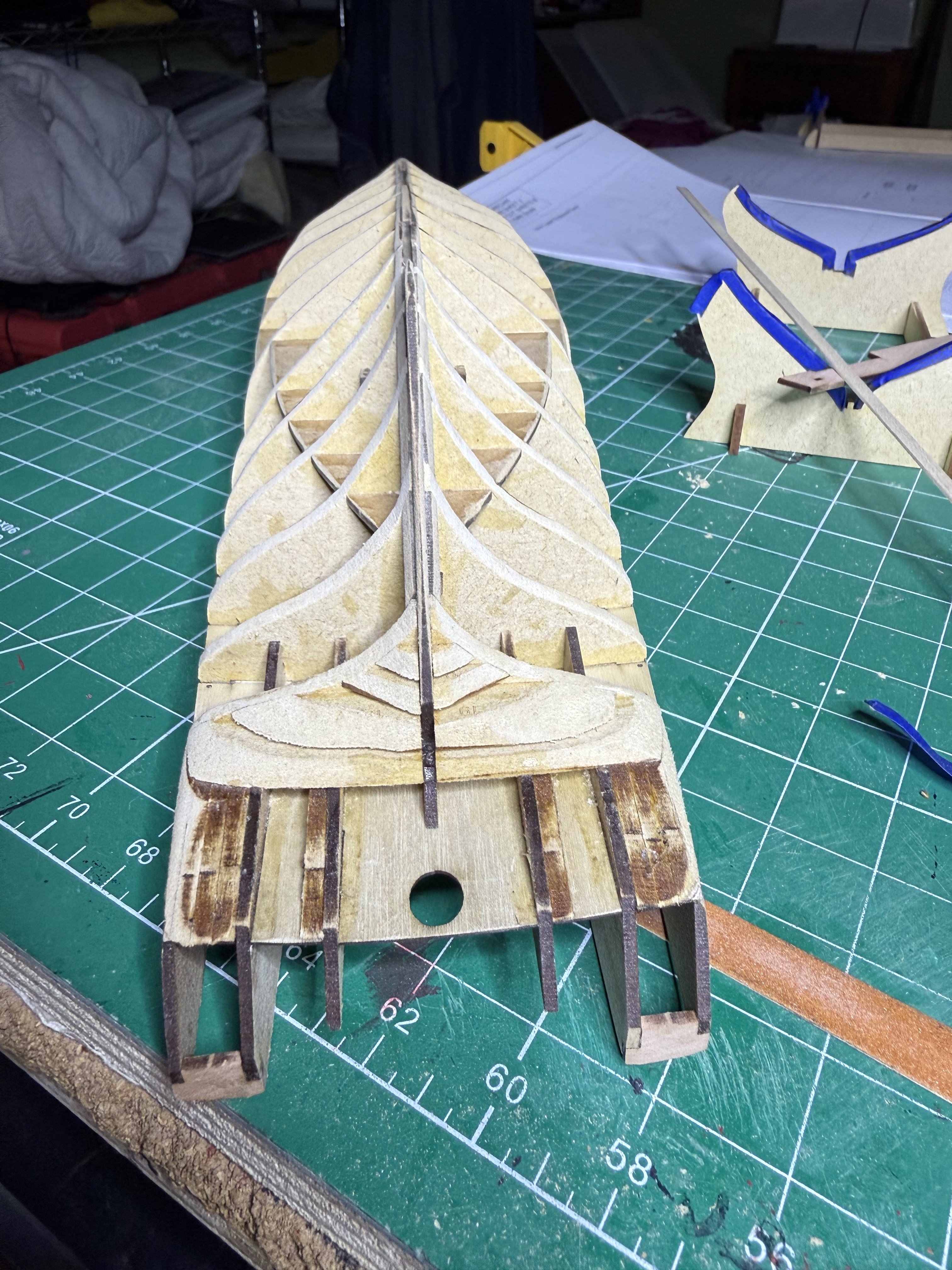

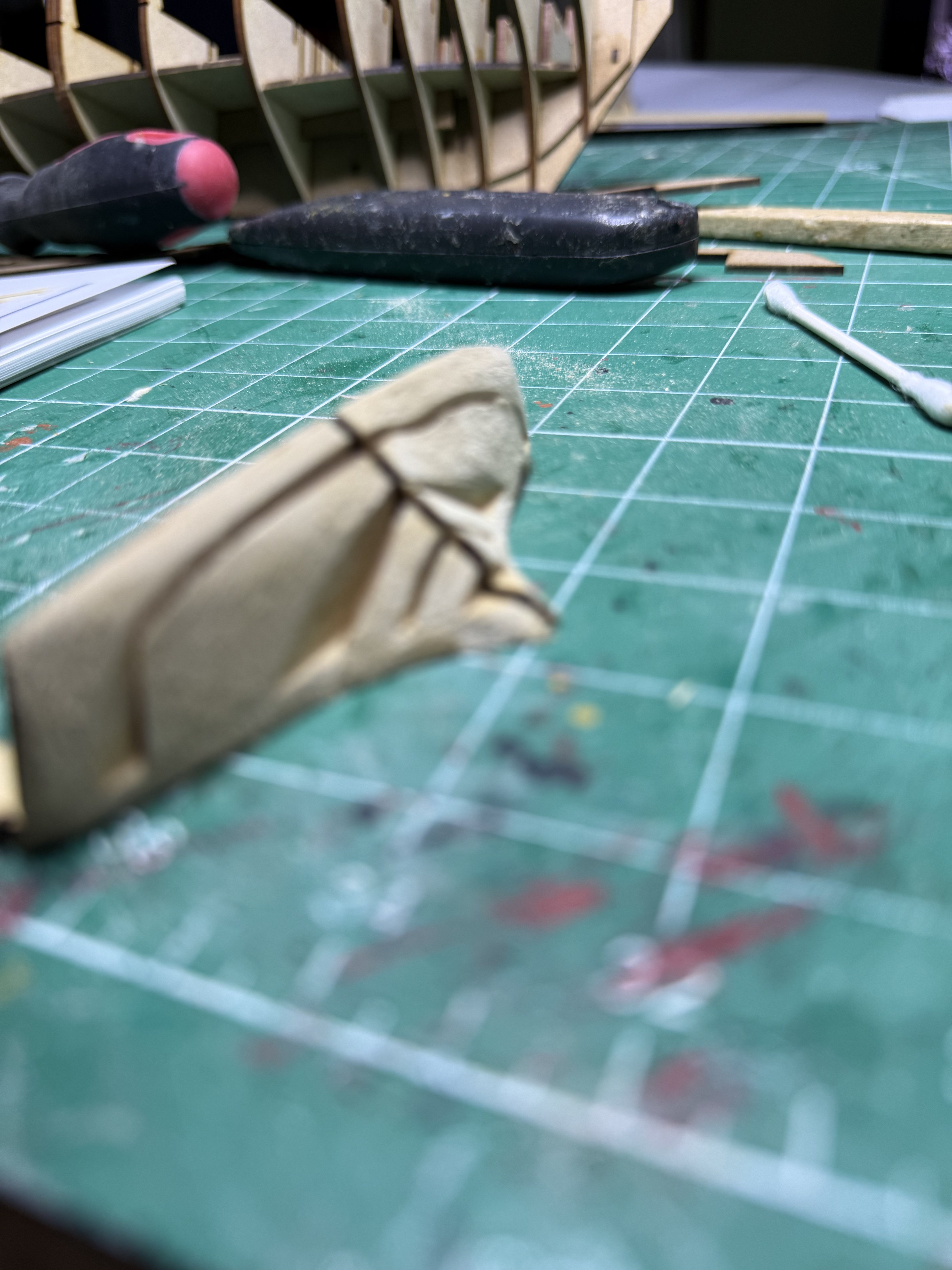

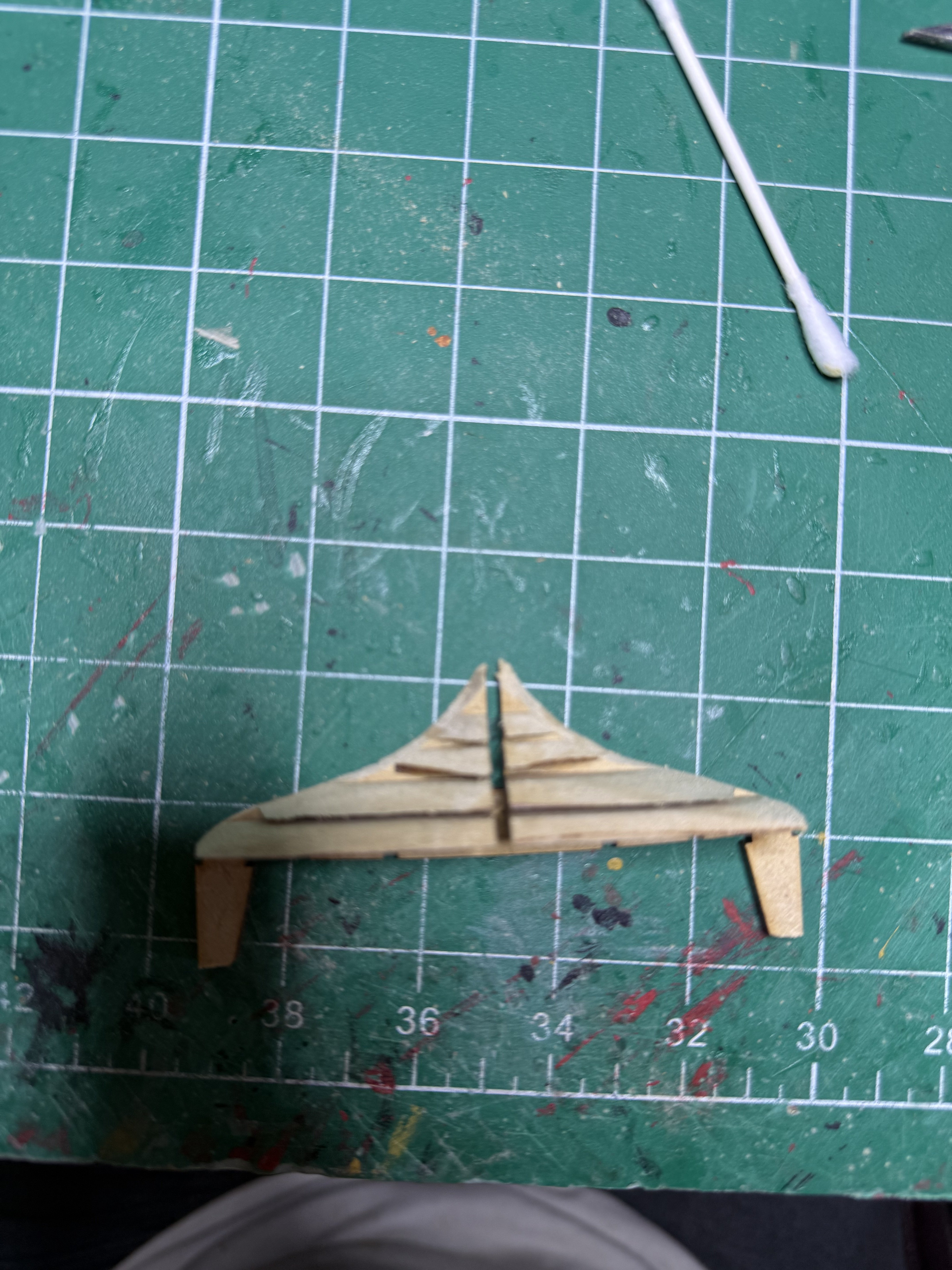

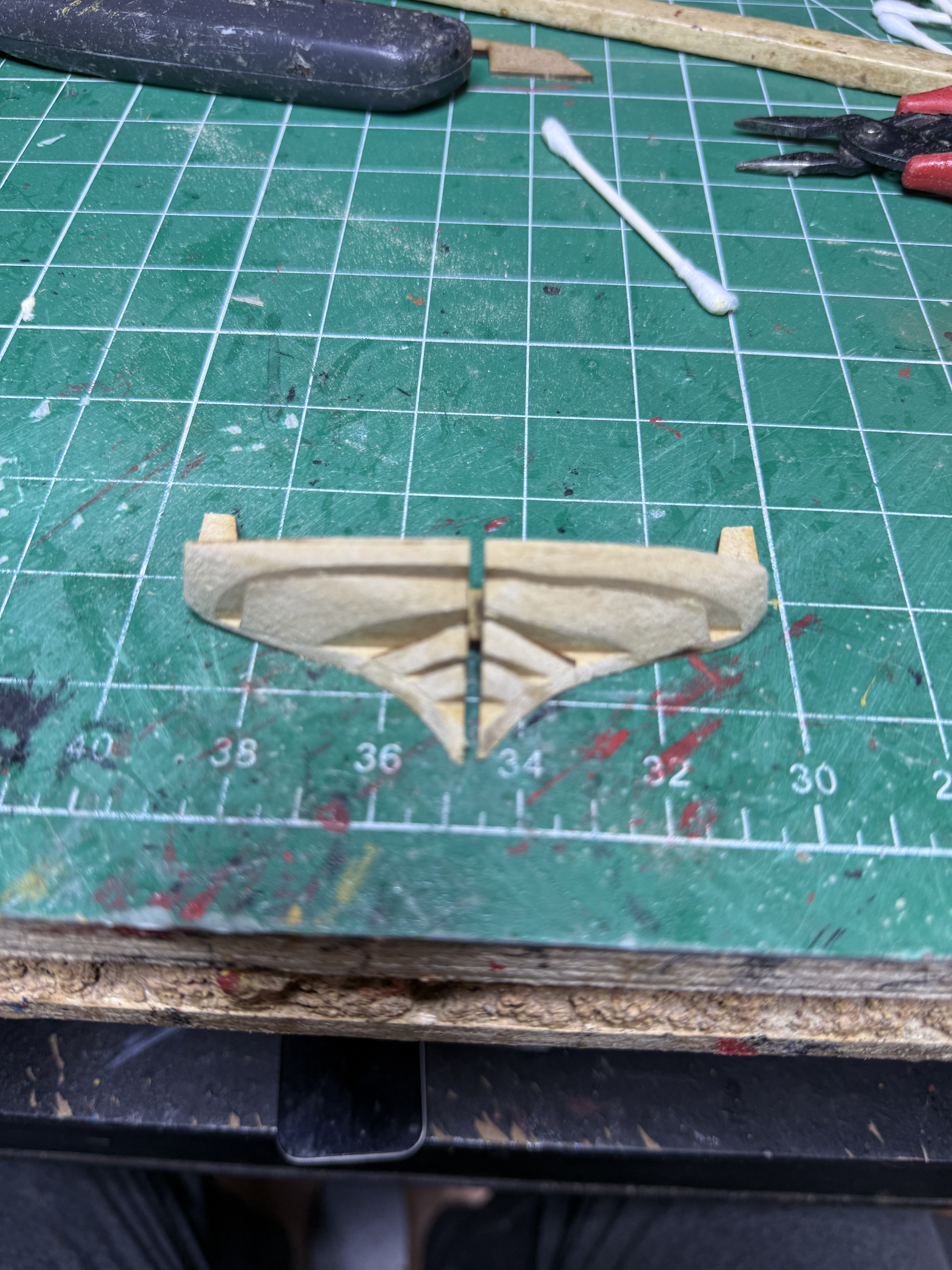

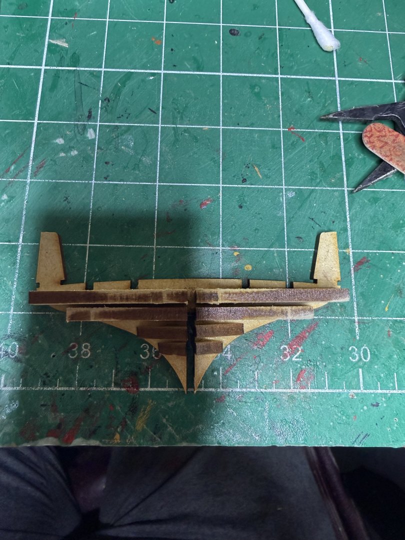

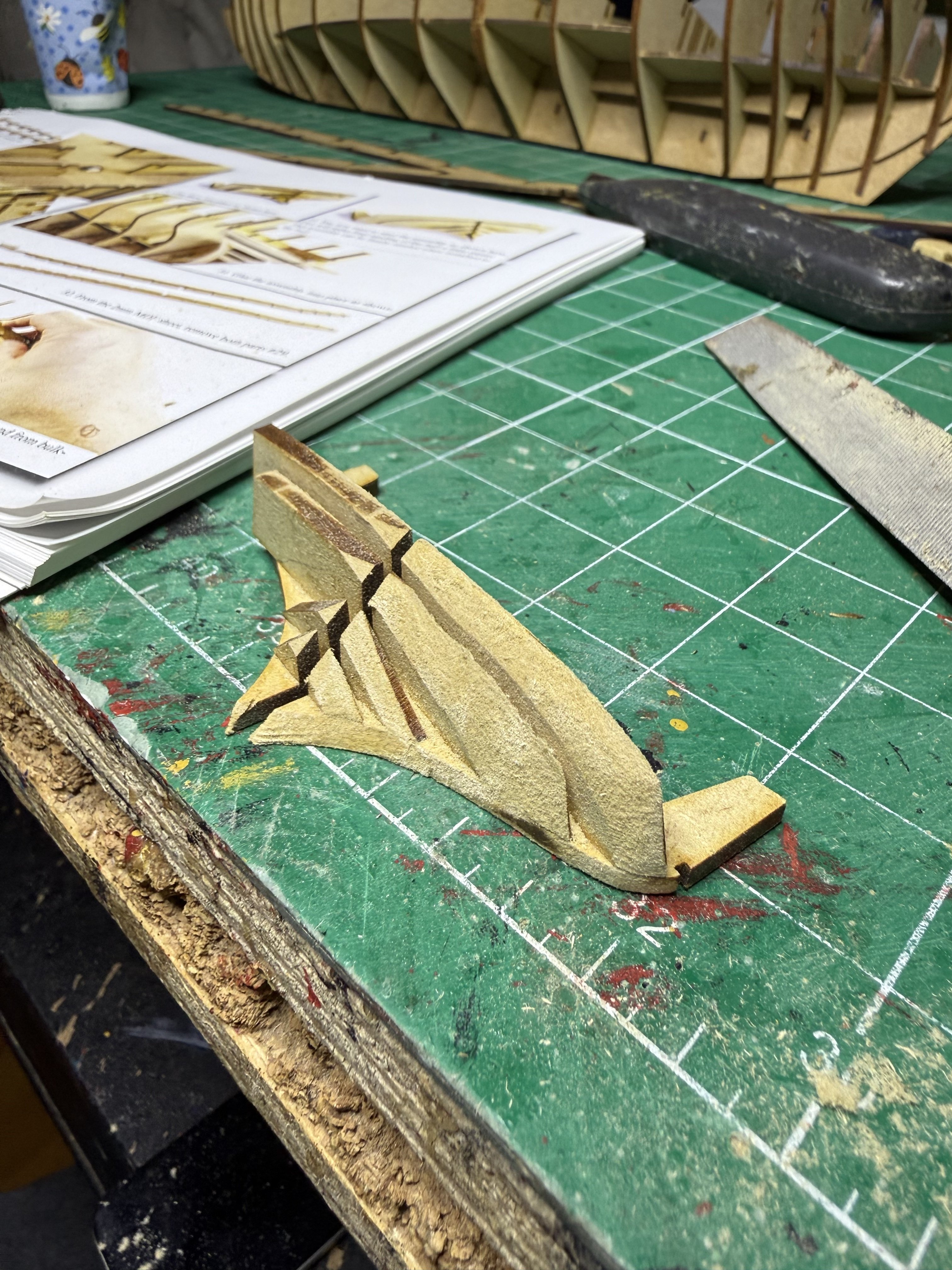

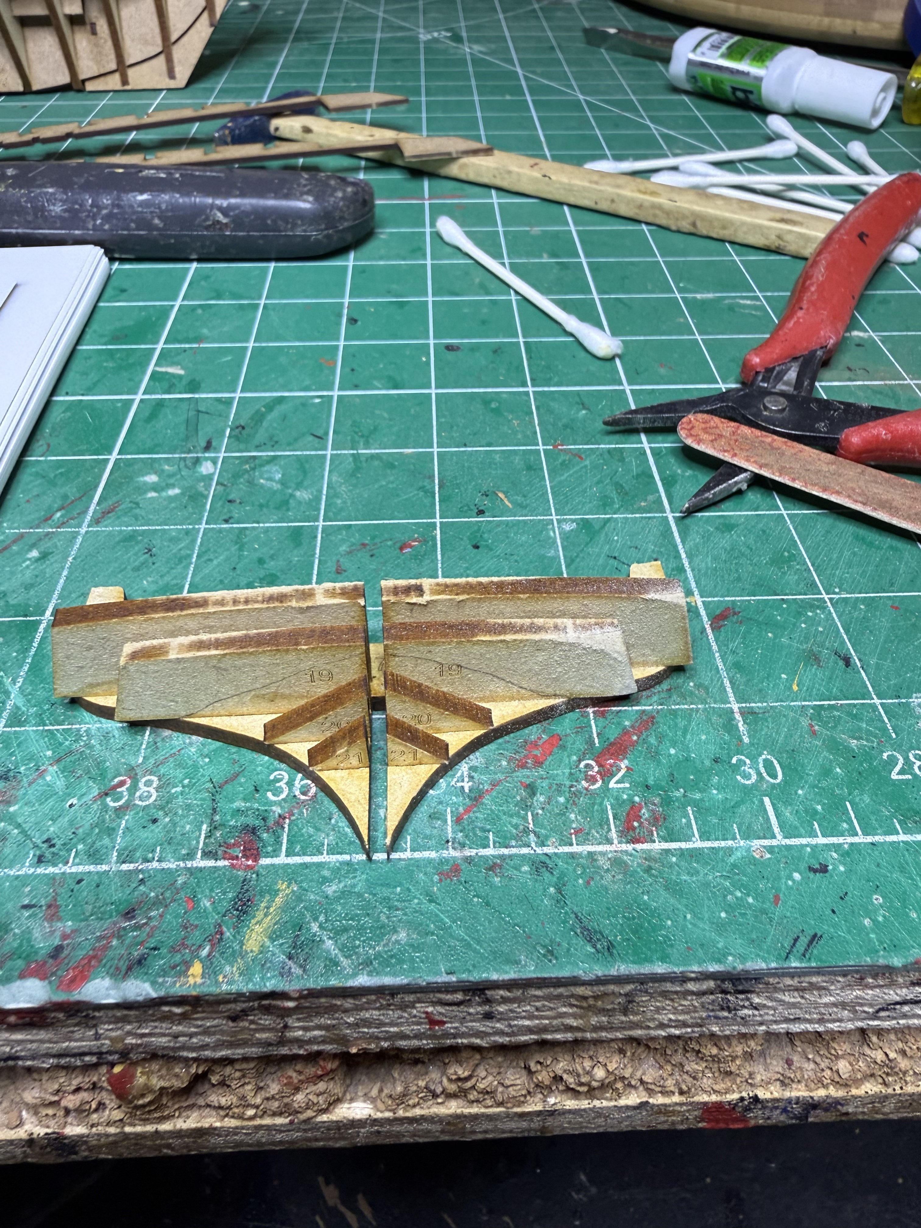

Stern area requires a bit of faring
IMG_0076.thumb.jpg.445bf3f0dcdae785b5b9be6e336b46b4.jpgIMG_0075.thumb.jpg.0a2074ac05952f12742e7bdaaa1d9248.jpgIMG_0078.thumb.jpg.132fdd1dac8446d0b8f063e4156ce08a.jpgIMG_0079.thumb.jpg.2e46c6972a1977bfc1dd9b979390ef32.jpgIMG_0080.thumb.jpg.6608407a1307978851431ca7fcf30a15.jpgIMG_0081.thumb.jpg.31d2d39a873d25de9b9ee5bf57b7701e.jpg
Then slotted into place

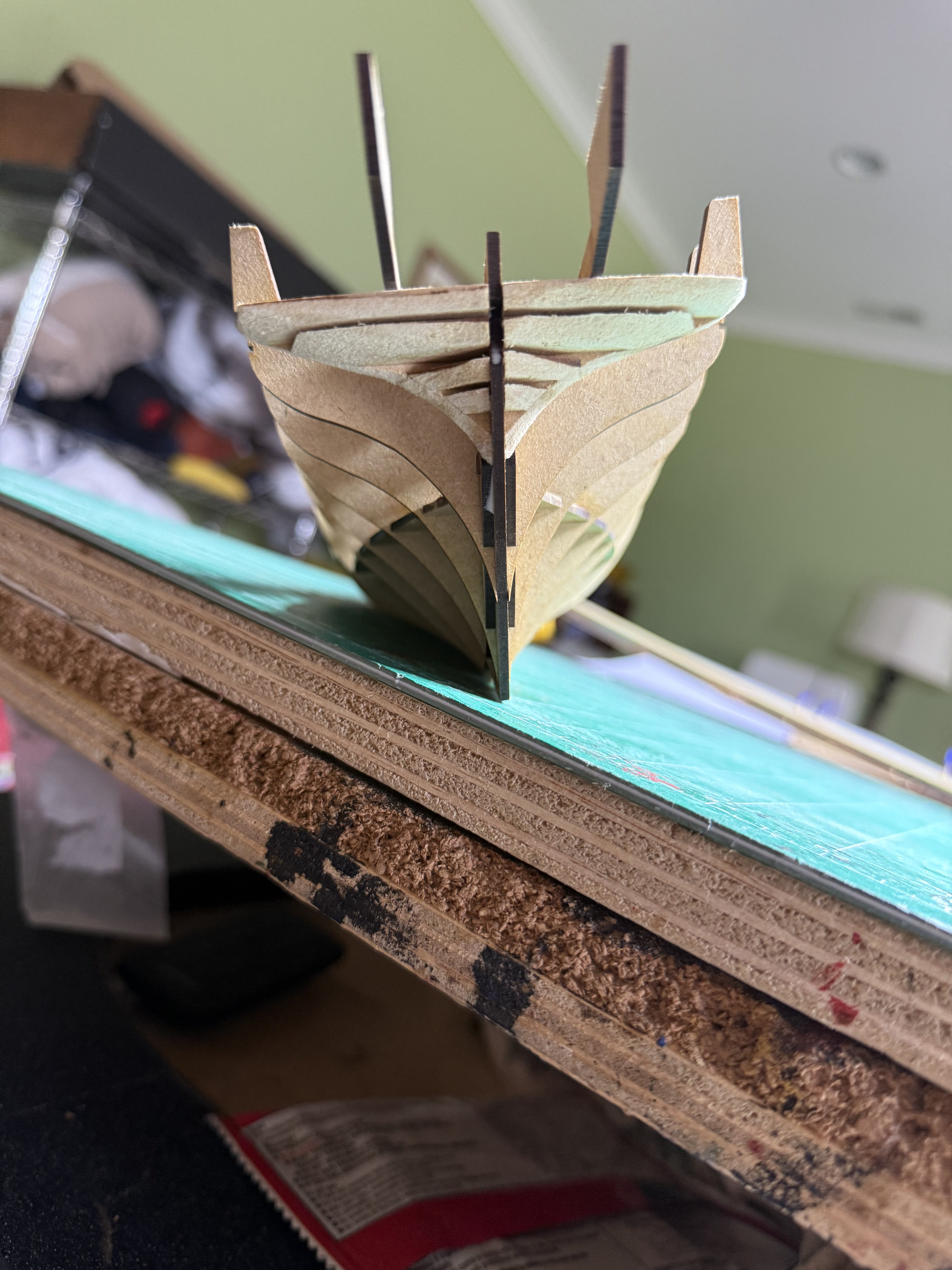

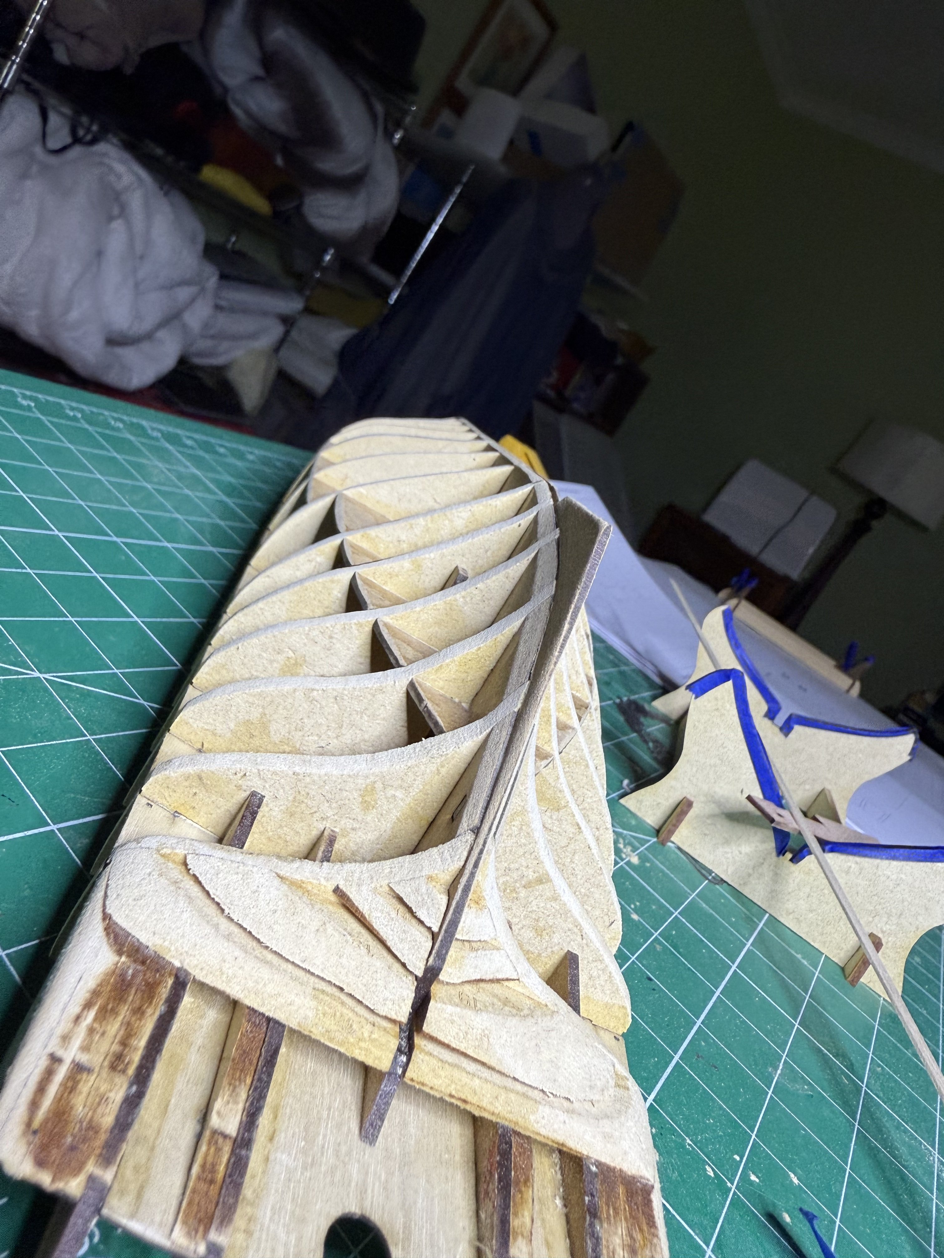

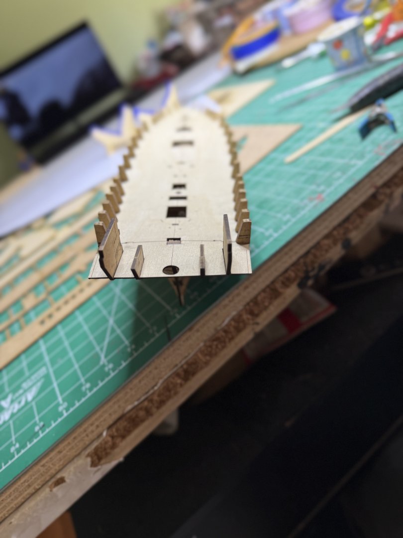

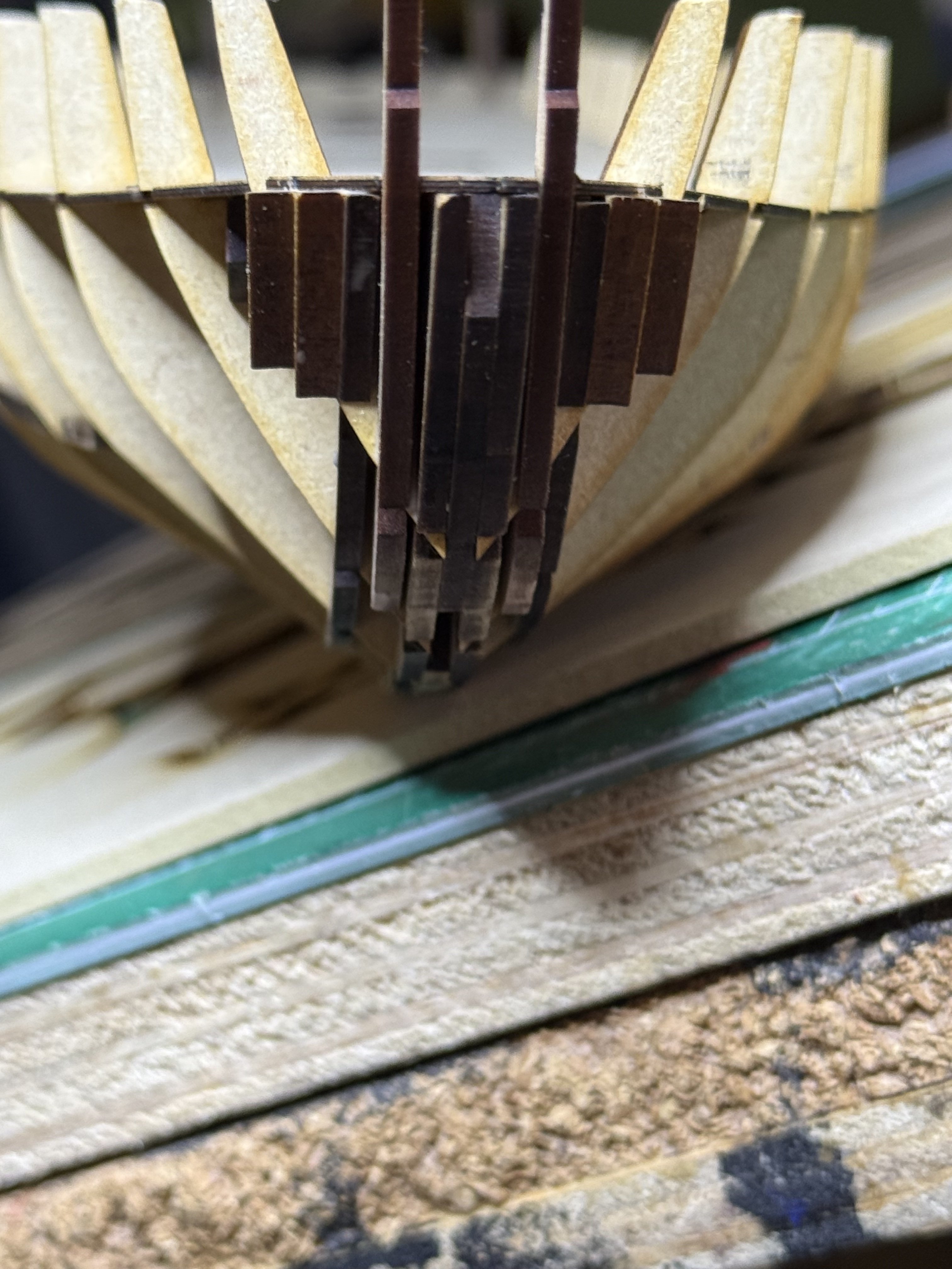

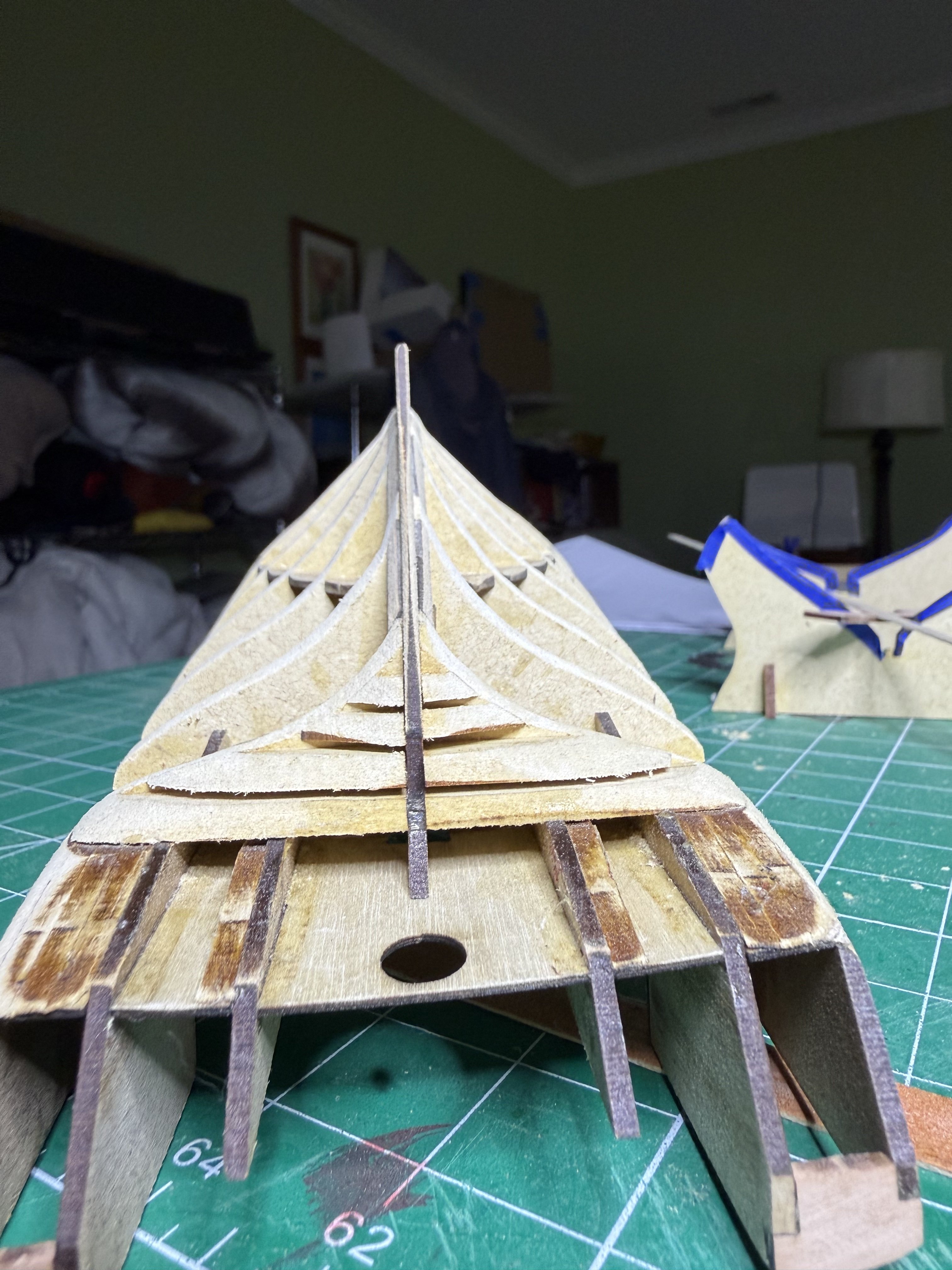

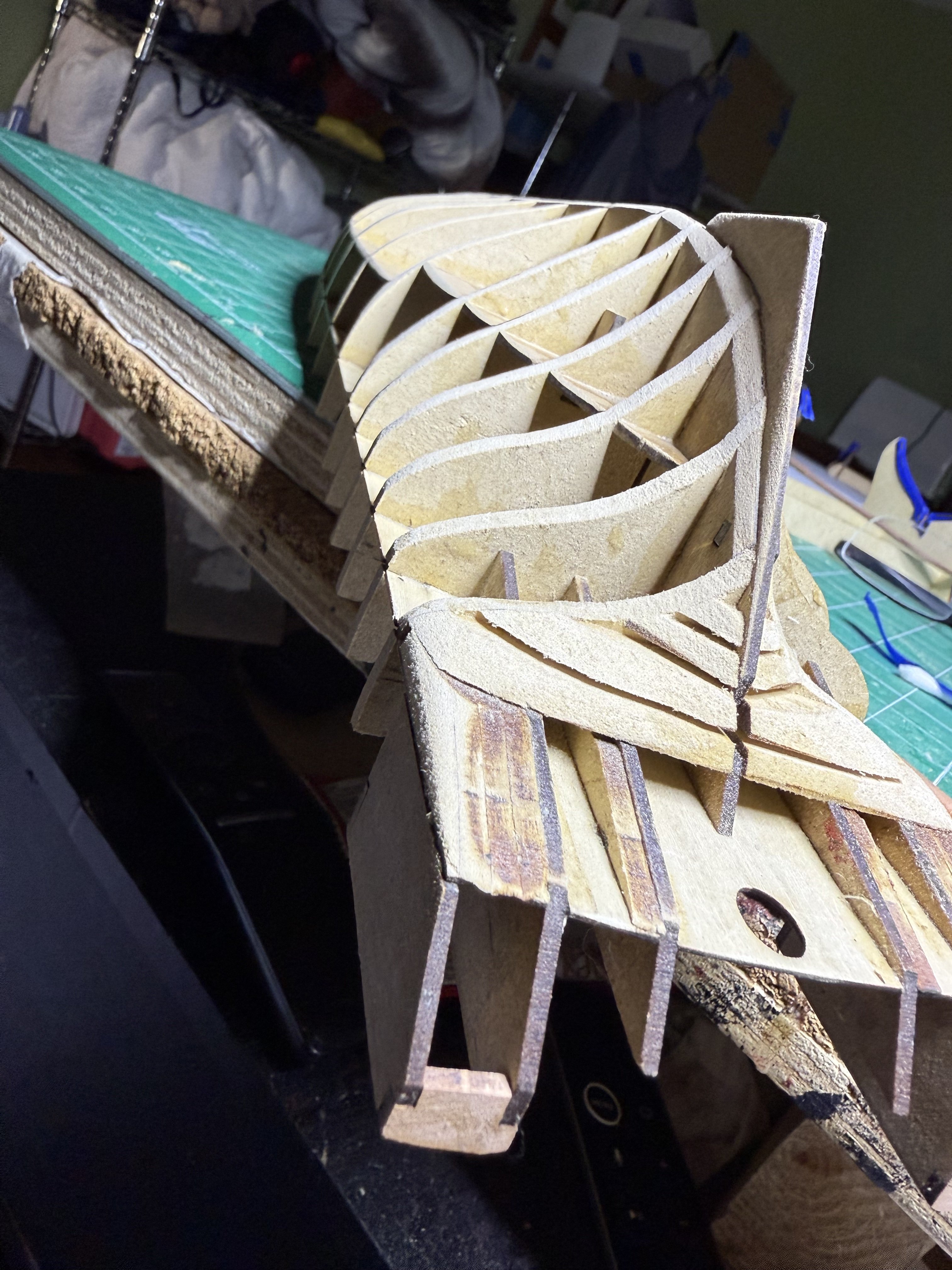

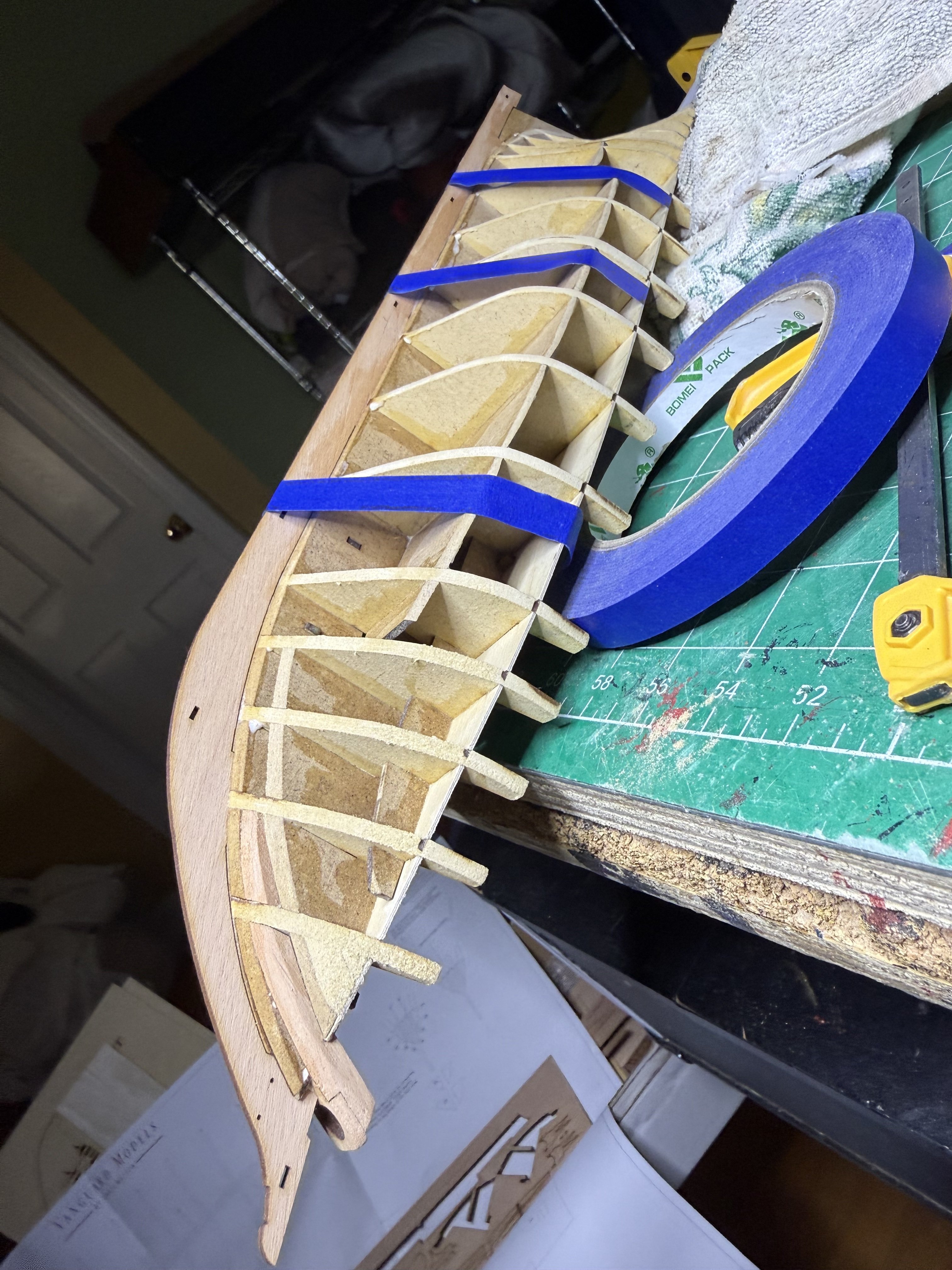

Next finishing adding the various bow pieces and then sub-deck snaps into place followed finally with gluing the seams
IMG_0090.thumb.jpg.bb49b27cd73daf89ea6f3d021a33fa01.jpgIMG_0089.thumb.jpg.59e6e5f639781b4974ca1d4d1e3453f8.jpgIMG_0084.thumb.jpg.0d99c9ee37d0f4017ee72a377d1d7b63.jpgIMG_0085.thumb.jpg.284db63851aec4652b4add0c0e0dda98.jpgIMG_0086.thumb.jpg.ccb11195a82d747ab4ecece6857add3e.jpgIMG_0088.thumb.jpg.8cdf39adfa68083629fcdc527080d416.jpgIMG_0087.thumb.jpg.86aea9fa901dbe420fb88ea4053b9a1f.jpg

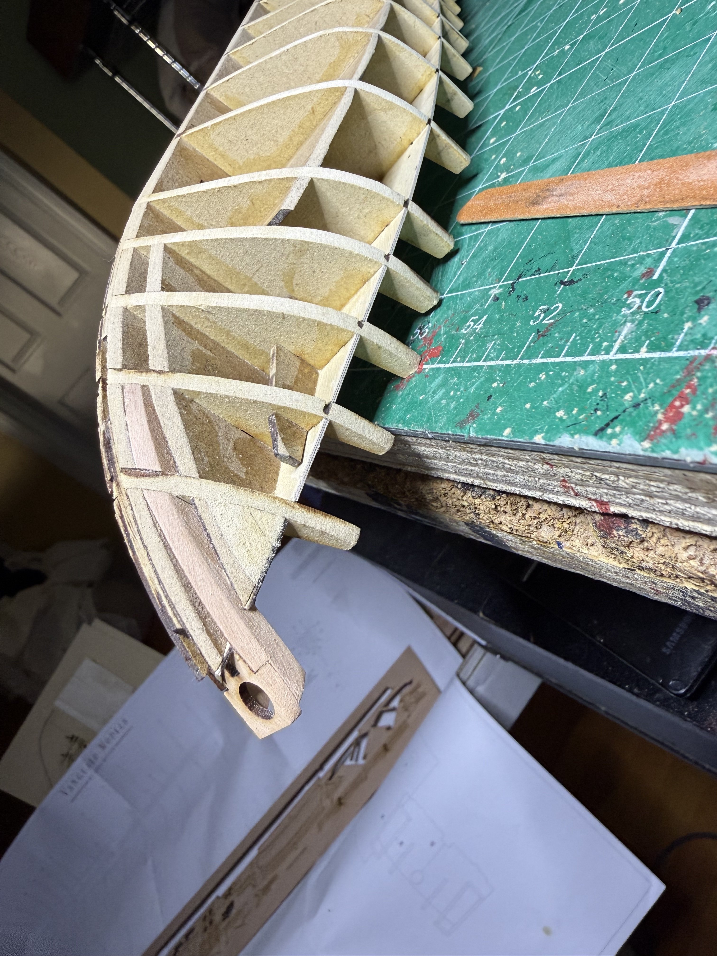

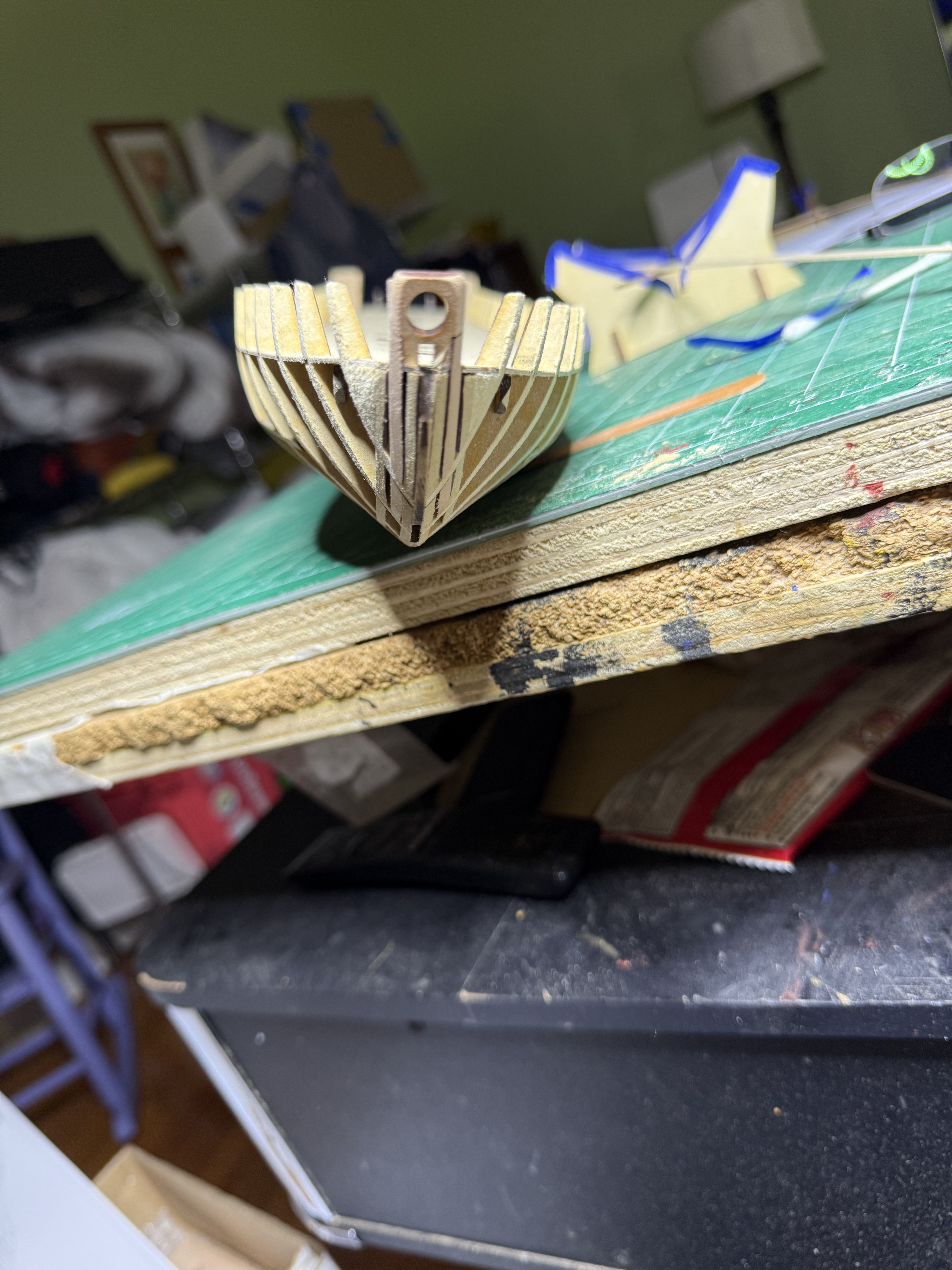

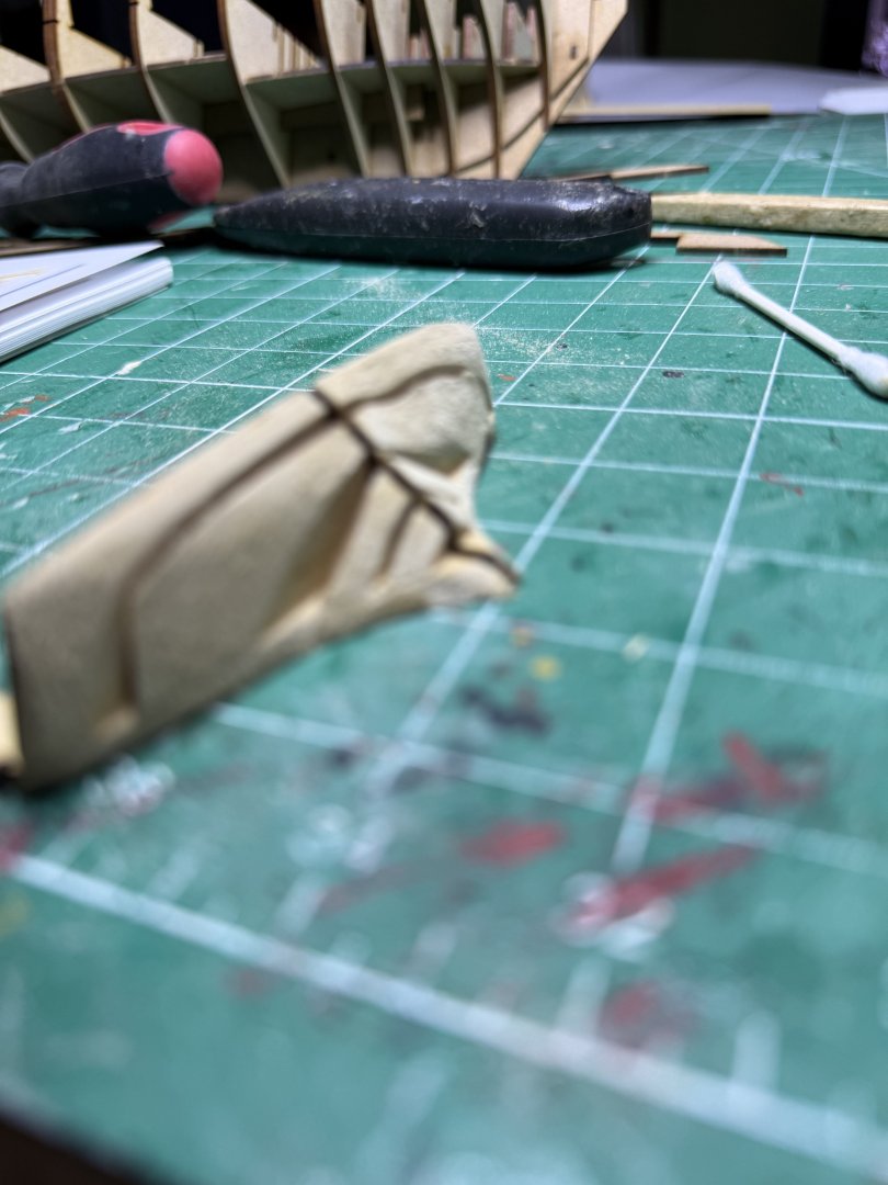

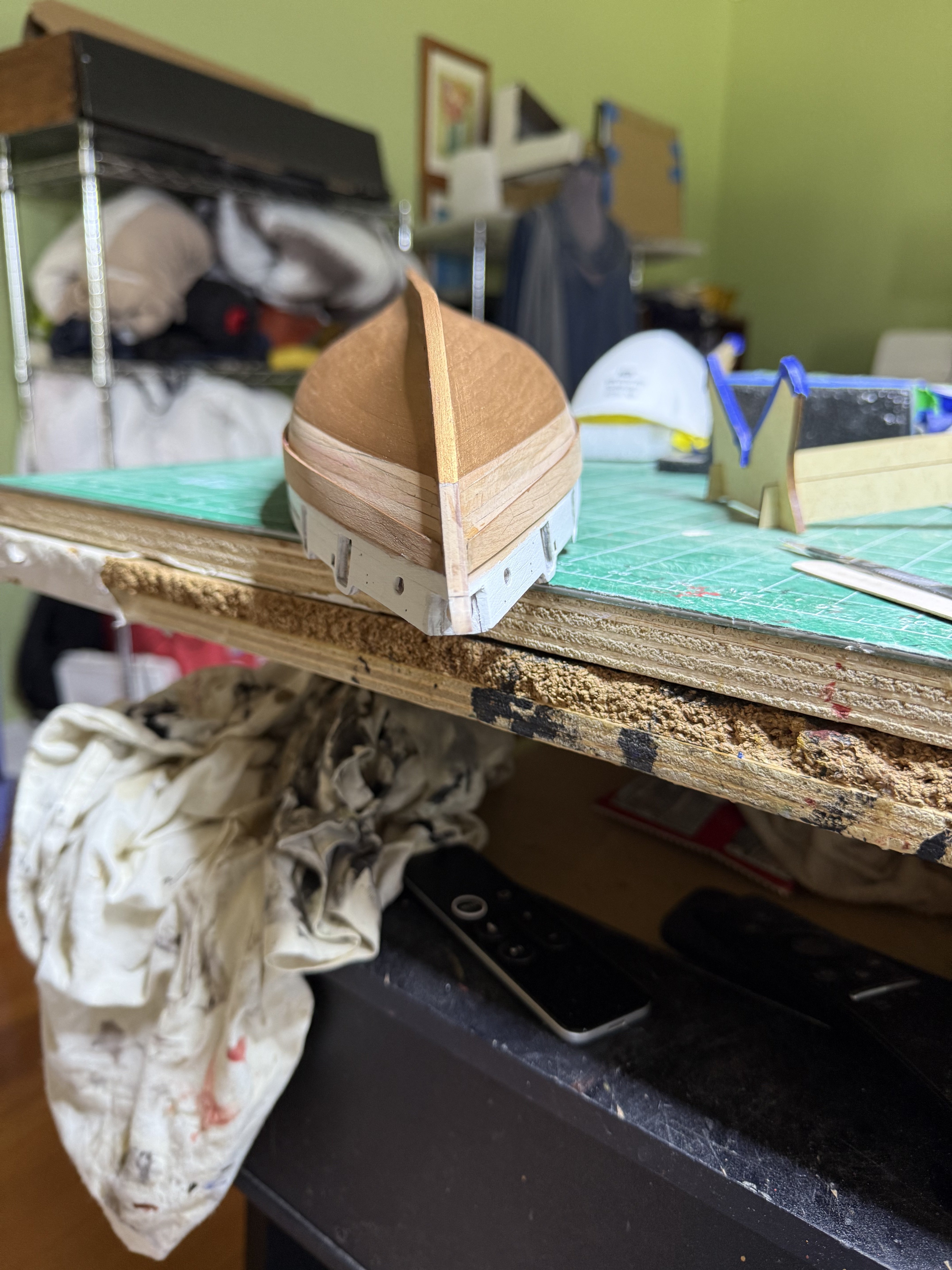

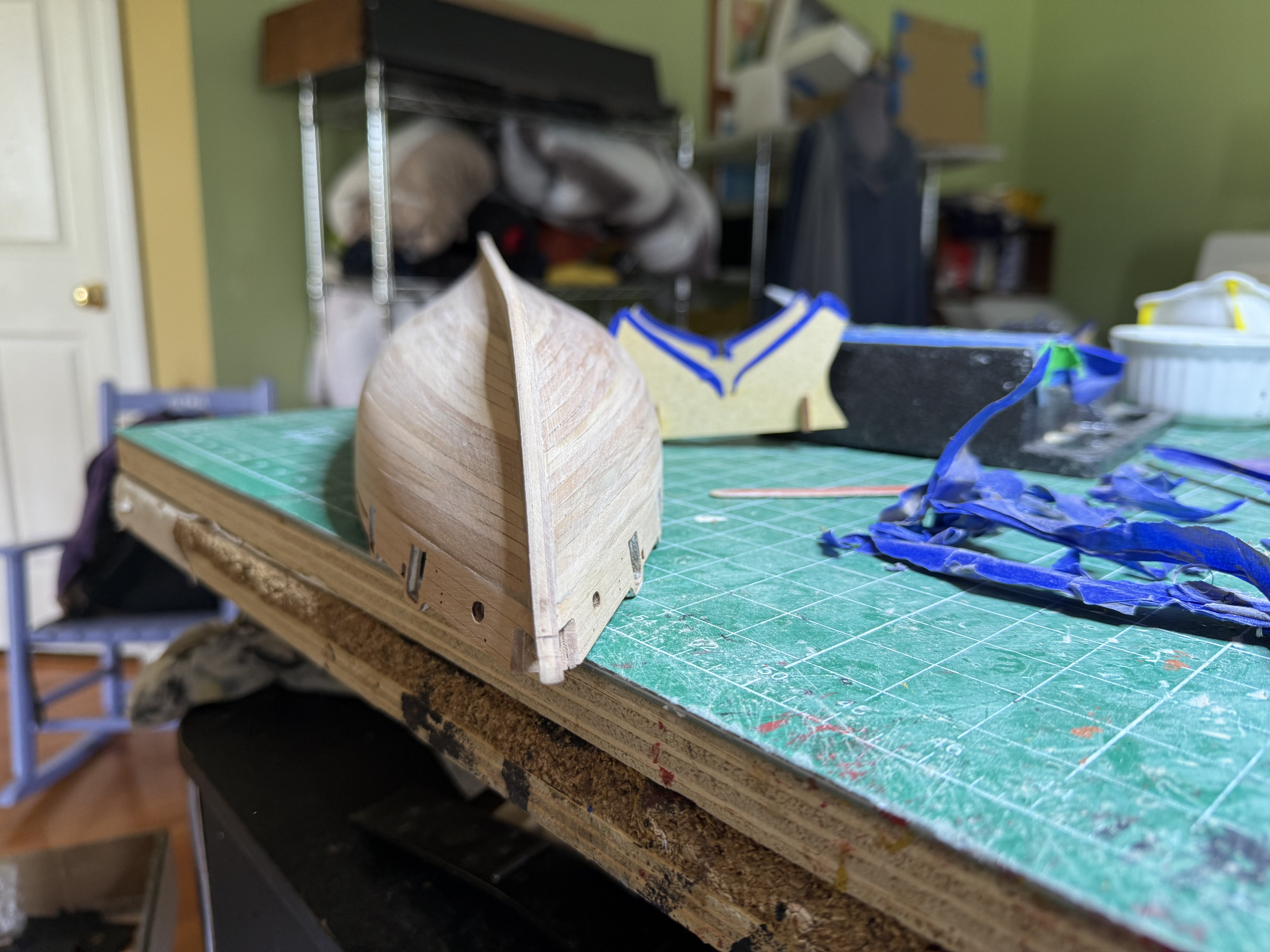

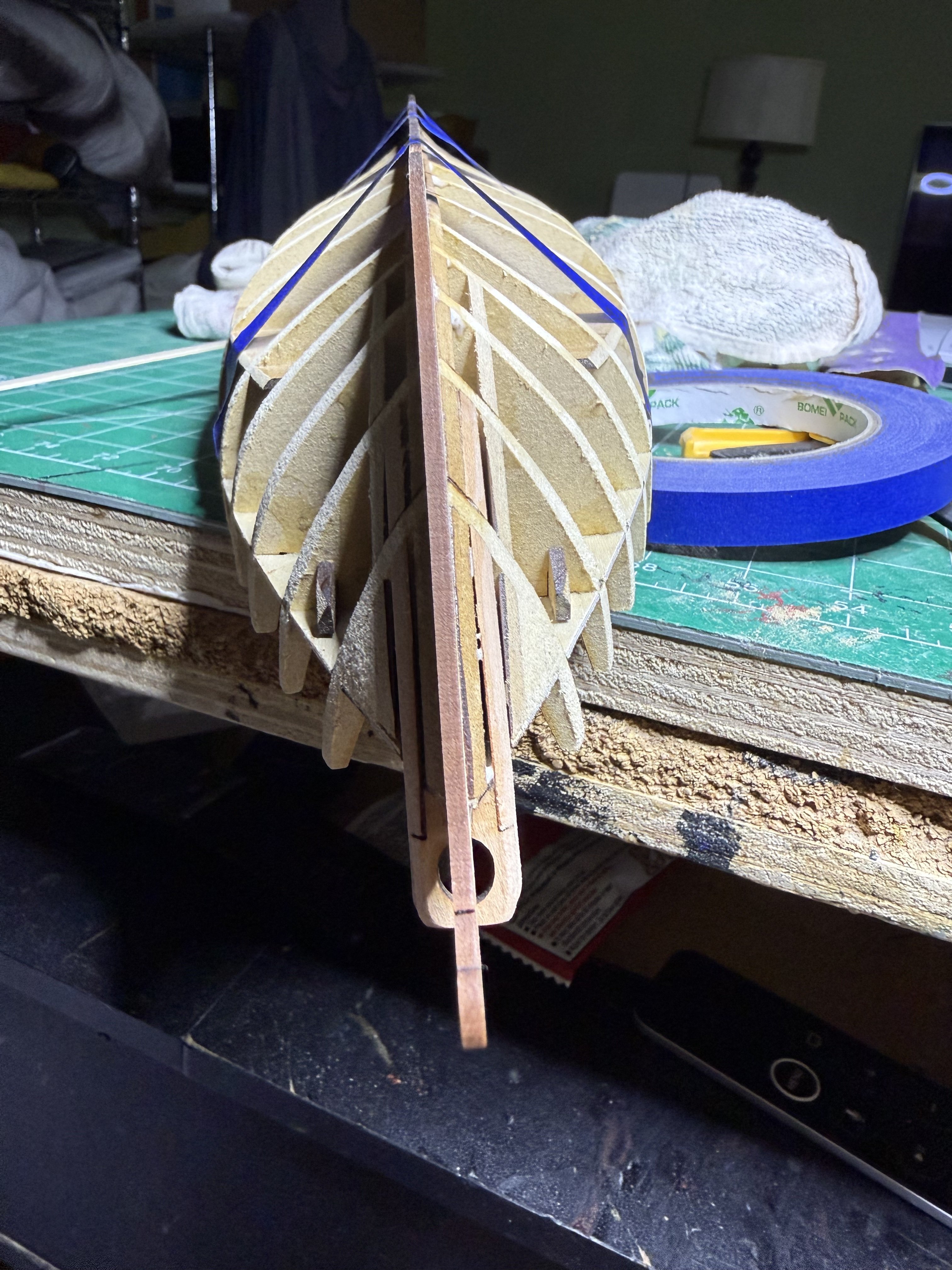

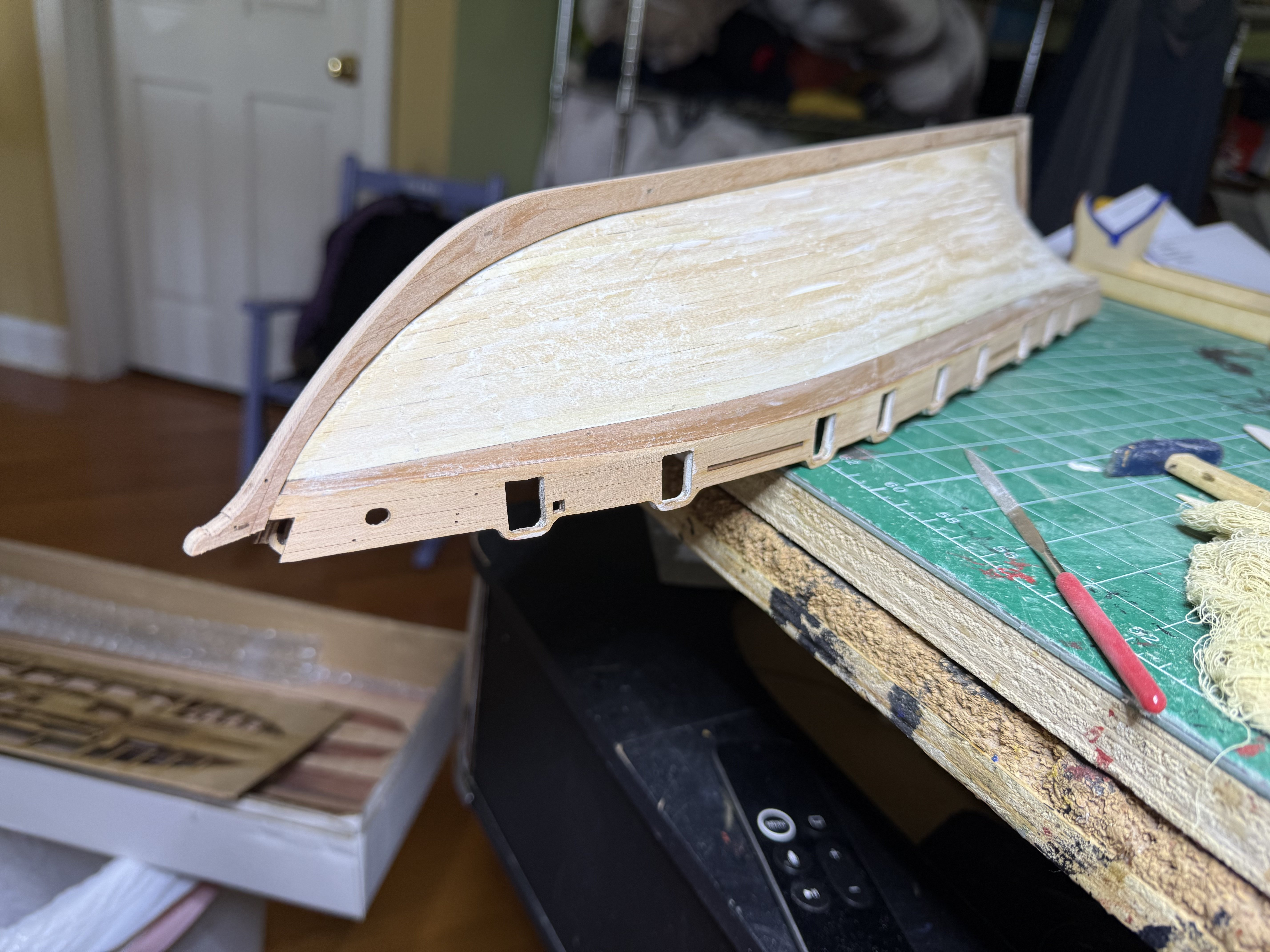

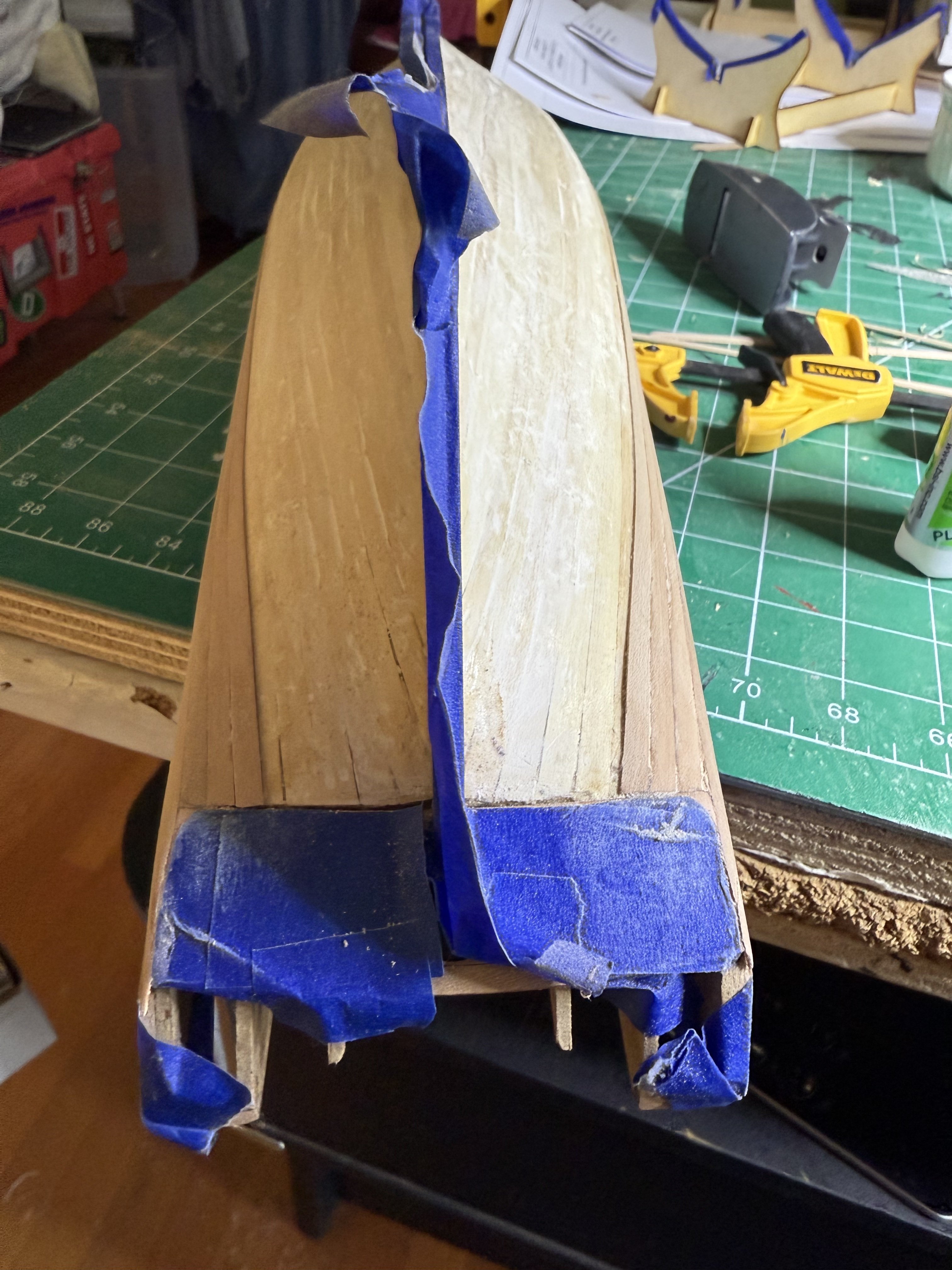

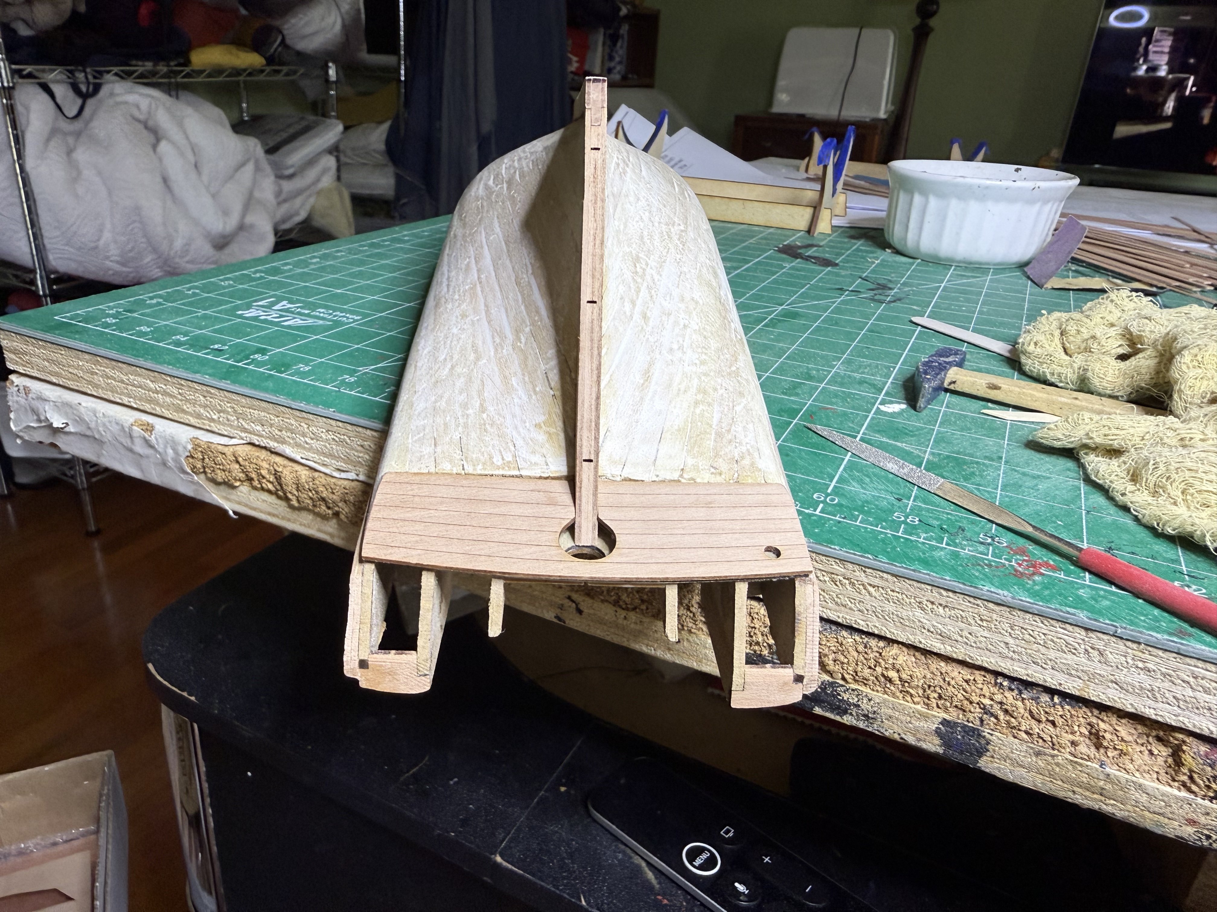

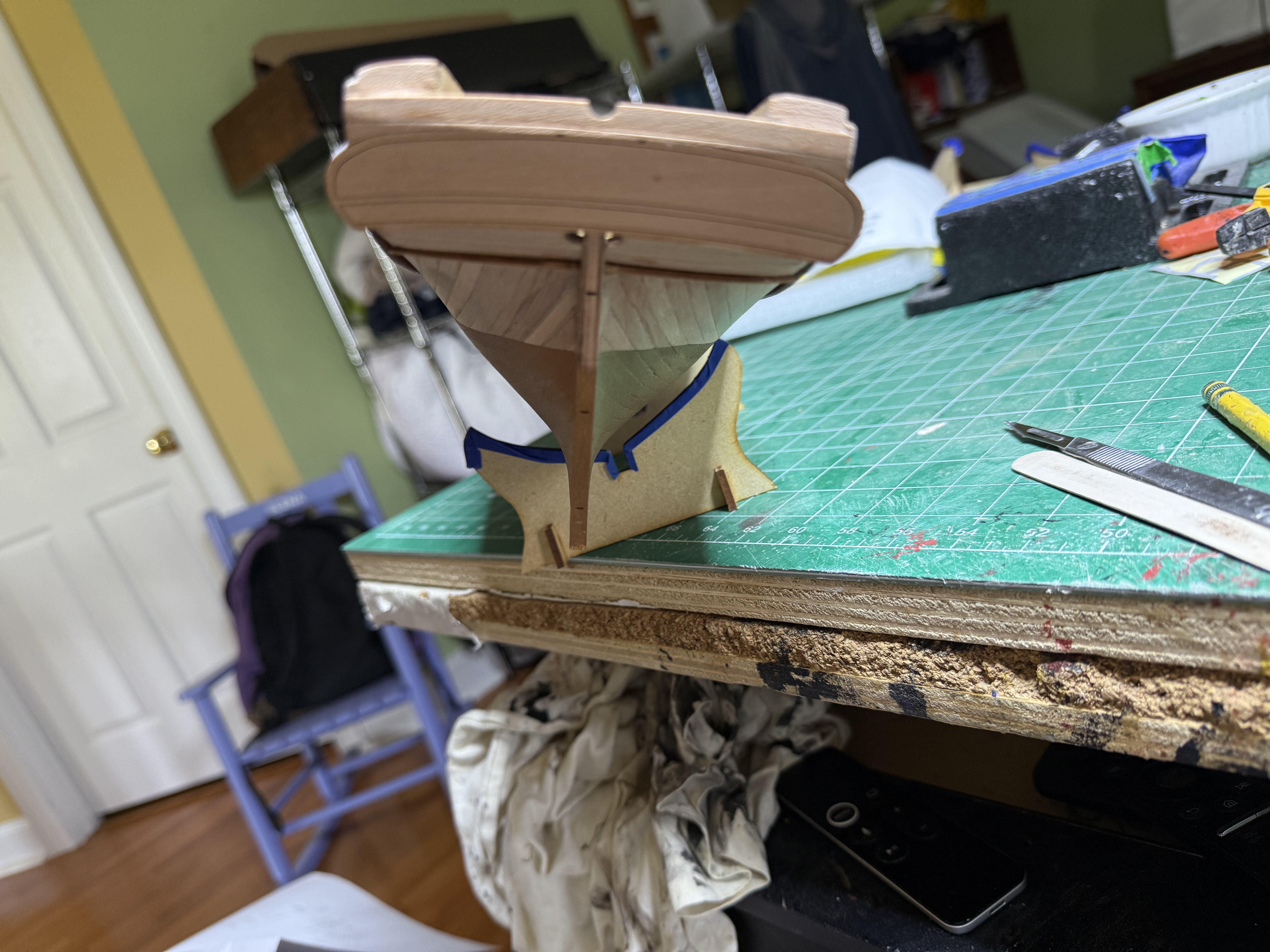

So today I had at it with a hand sander, sand paper and file to fair the hull. Below is one side done compared to the other. You can see the bow requires a lot of work
IMG_0091.thumb.jpg.11464a29f97d62385792ed1a91b2769a.jpgIMG_0092.thumb.jpg.0d062e8e977d902799c9318a047460dd.jpgIMG_0093.thumb.jpg.1a8d3b7c547b5d359b8d2666fcd4e88d.jpgIMG_0094.thumb.jpg.a515197e111948d4a8672f866aff2cbb.jpg
Now after both sides done
IMG_0095.thumb.jpg.2695df9588bd05e316f3d49387f0bb81.jpgIMG_0097.thumb.jpg.72231c75053664168047a18c379b901f.jpgIMG_0098.thumb.jpg.1c85c8893825da62aecf769bdf5f9e54.jpgIMG_0099.thumb.jpg.78ccce86f72b420898a70e4cffd80765.jpgIMG_0100.thumb.jpg.153e7d99c61663e7a57890e8527f5fb9.jpg

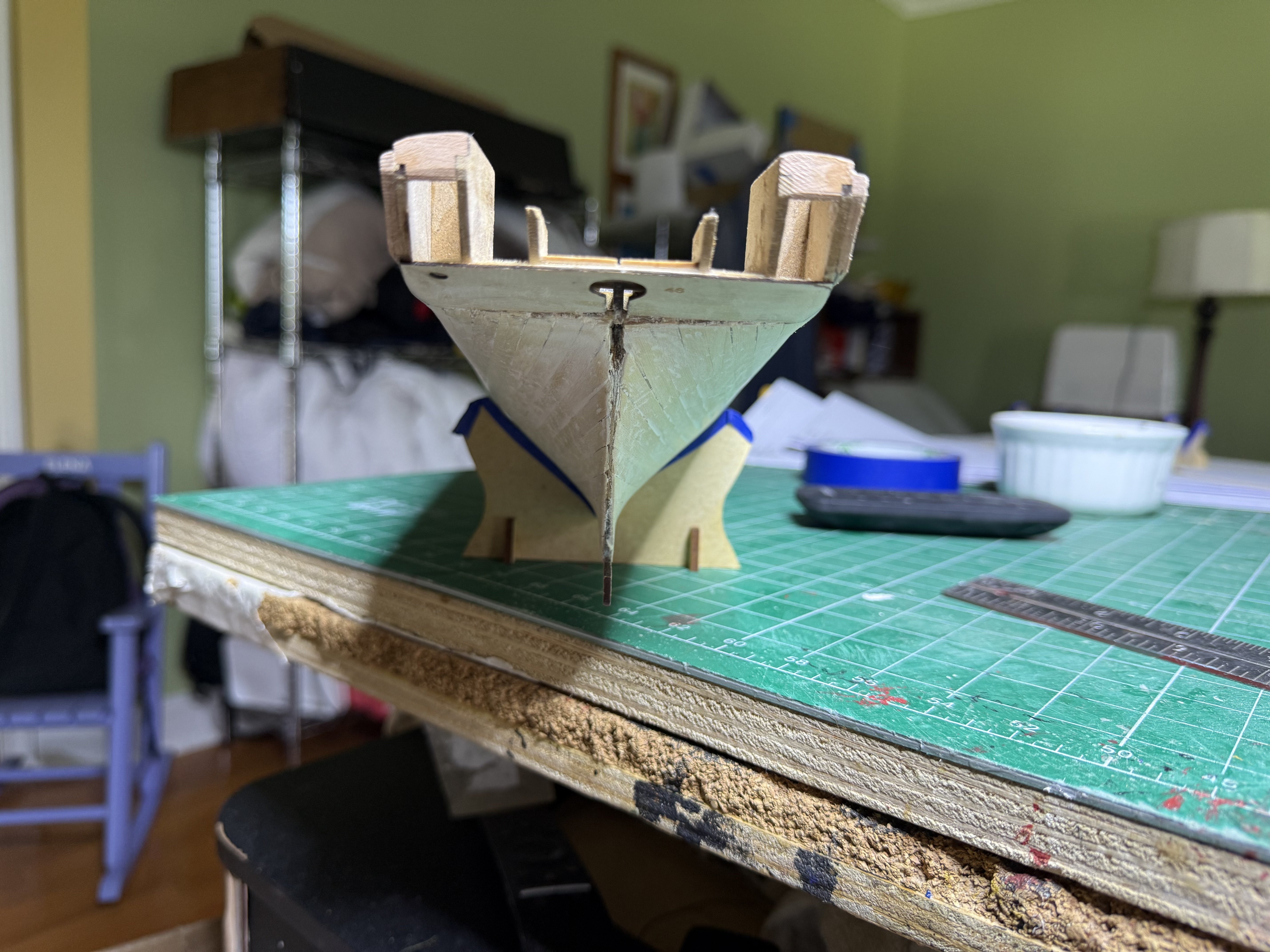

Lastly, the false keel added
IMG_0101.thumb.jpg.f385b310c0f09da7778f4d08f9e4a886.jpgIMG_0102.thumb.jpg.624d12bec8e2cc7ea5caefc55e6536ba.jpgIMG_0103.thumb.jpg.93063d24597cfb7db221805f68963289.jpg
Indeed she looks quite the thoroughbred.

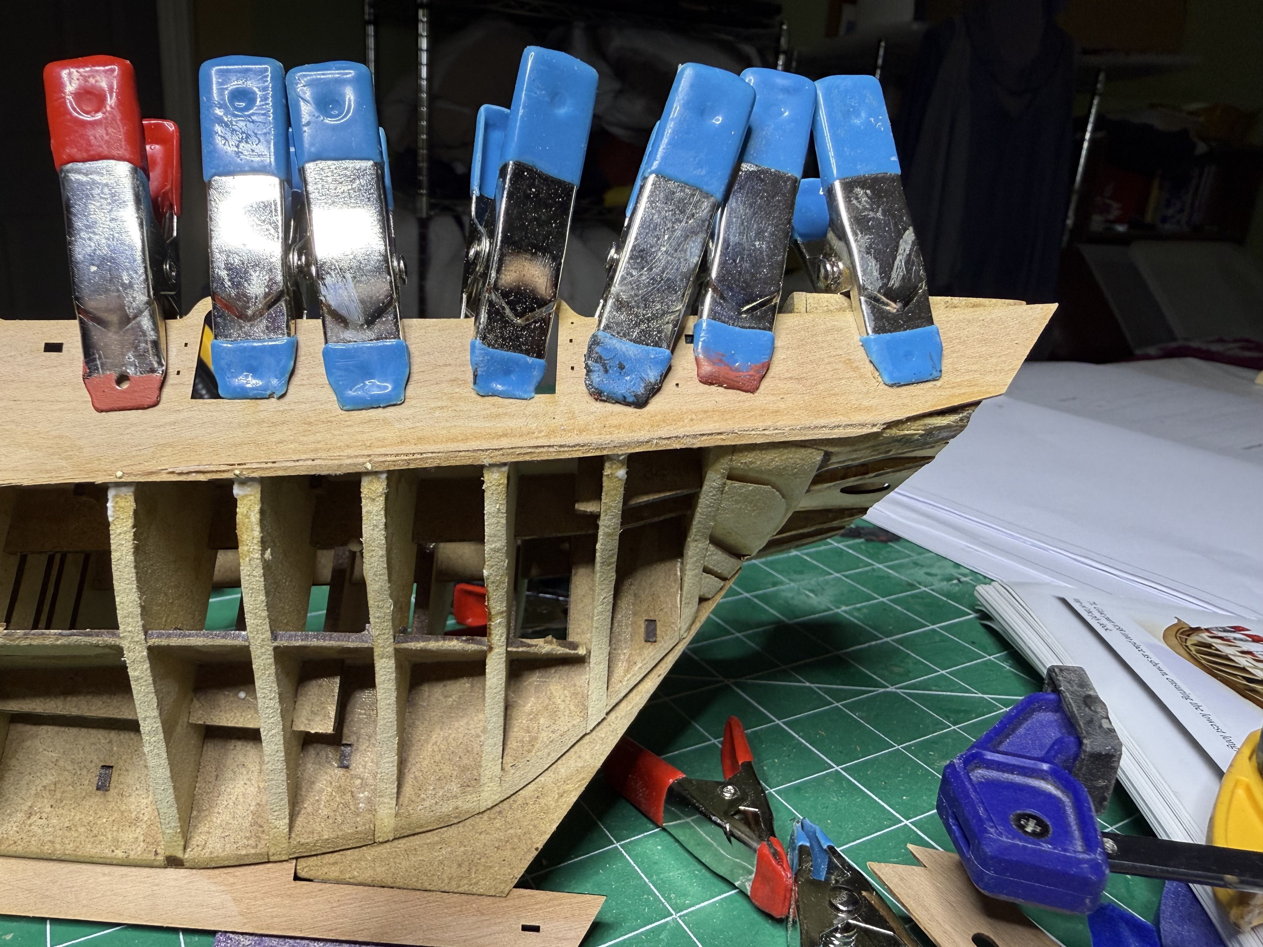

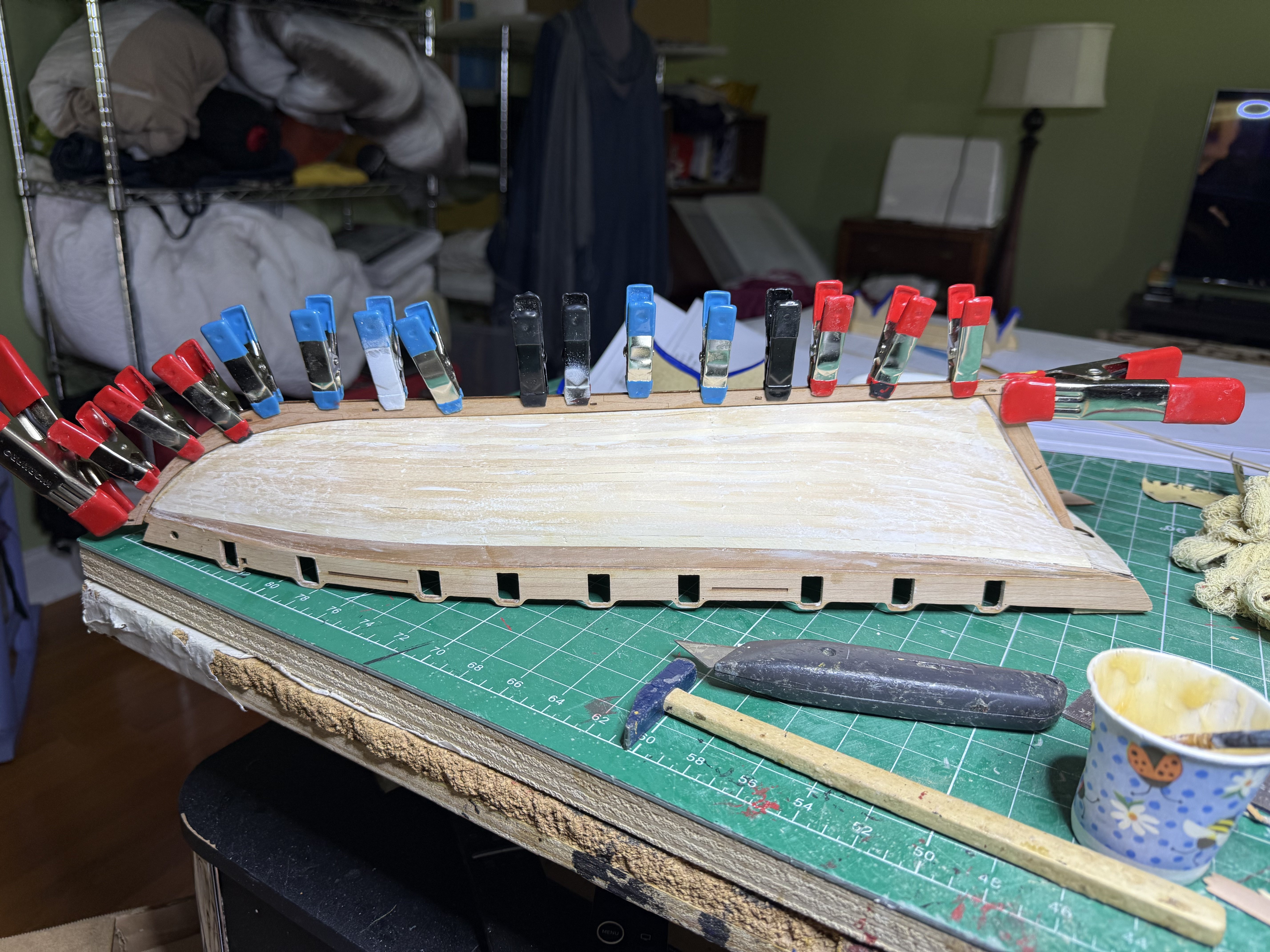

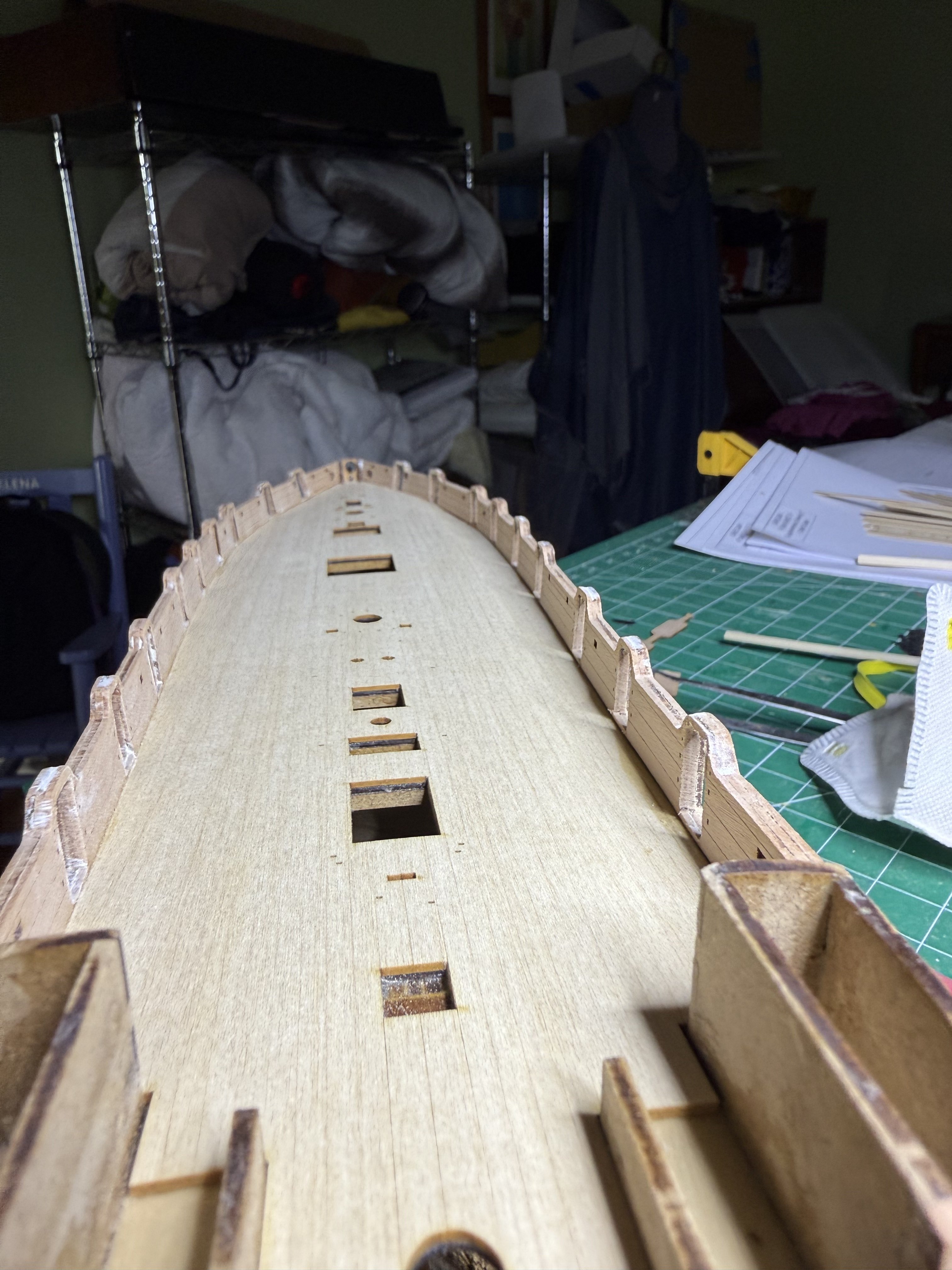

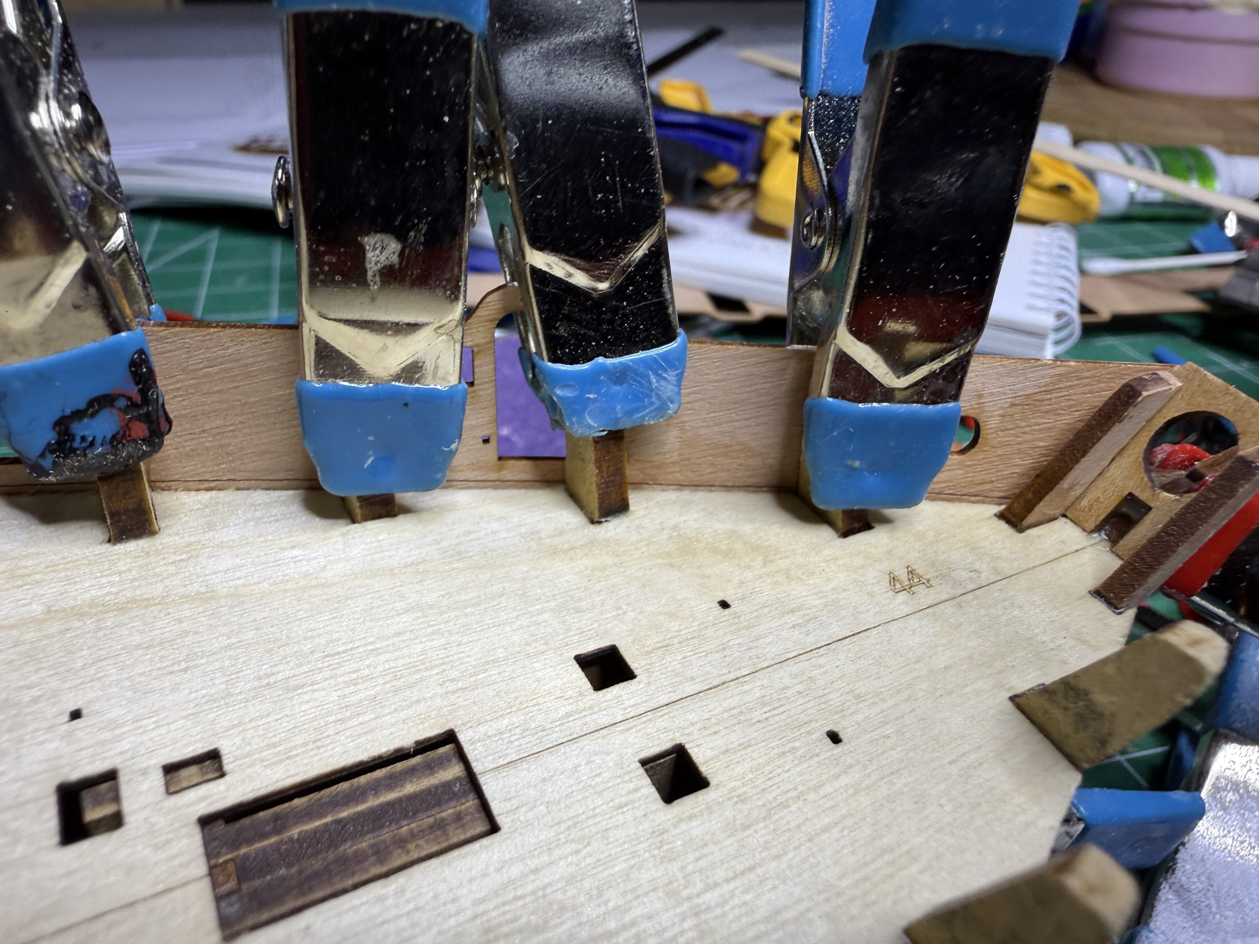

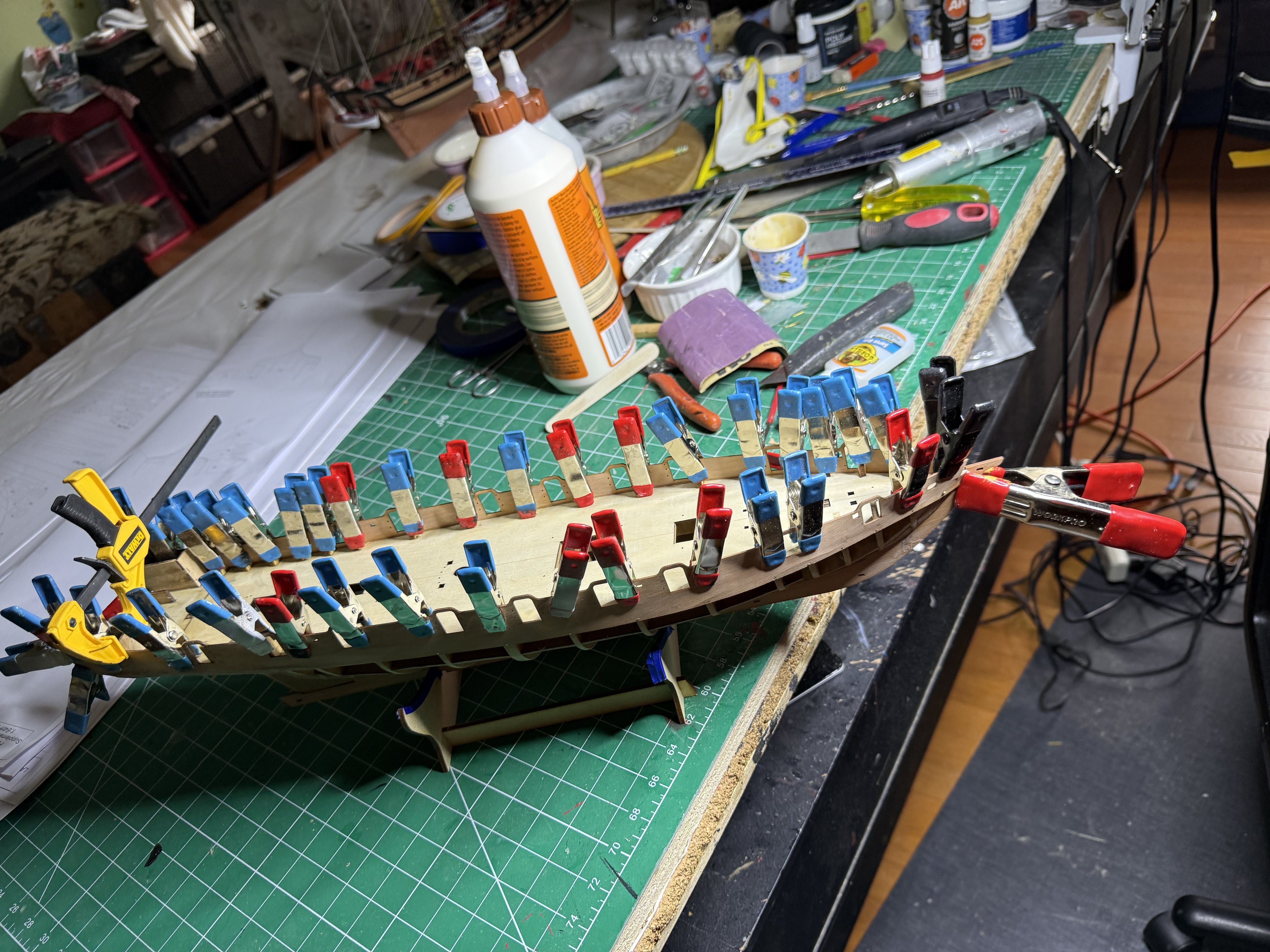

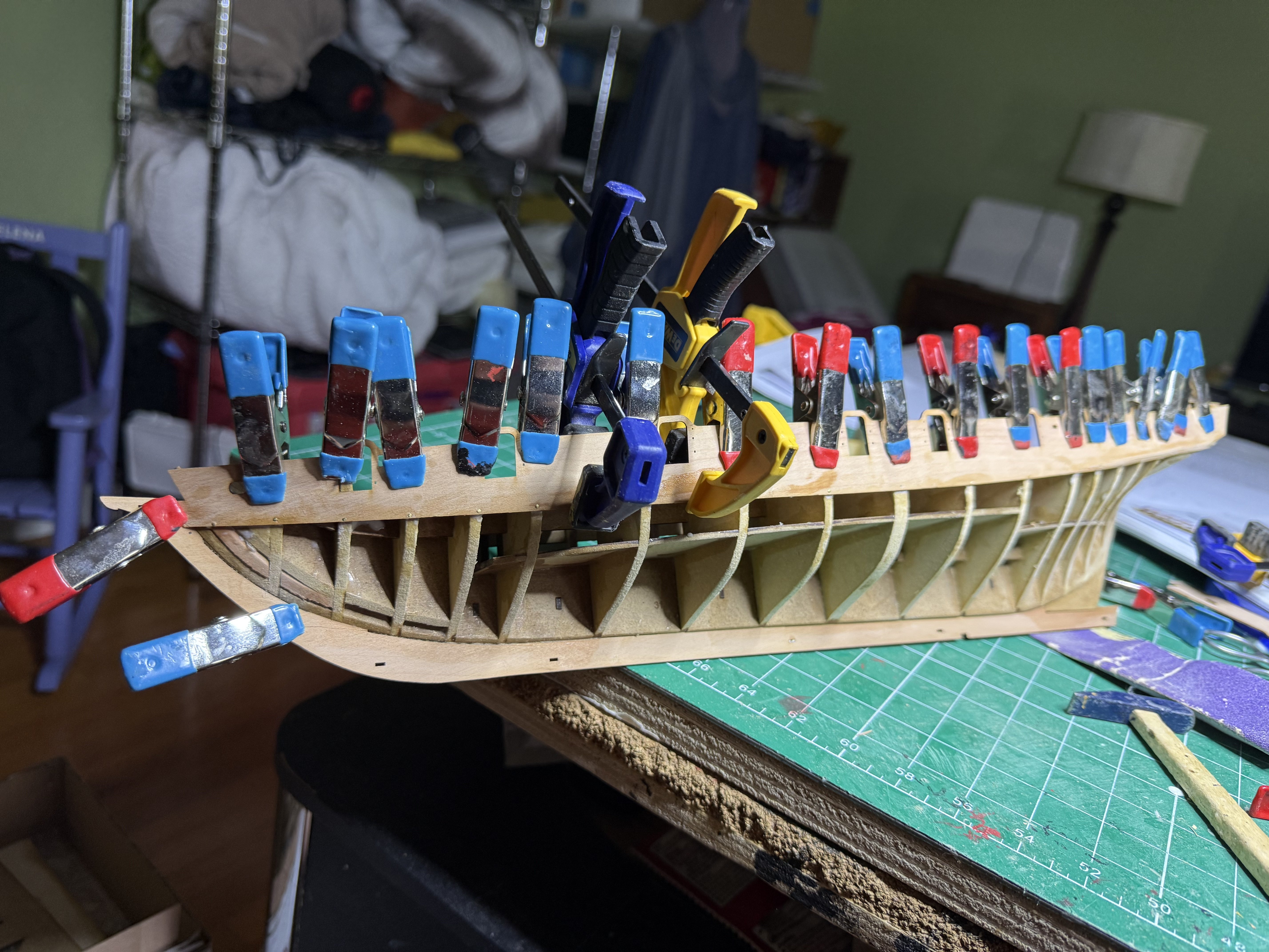

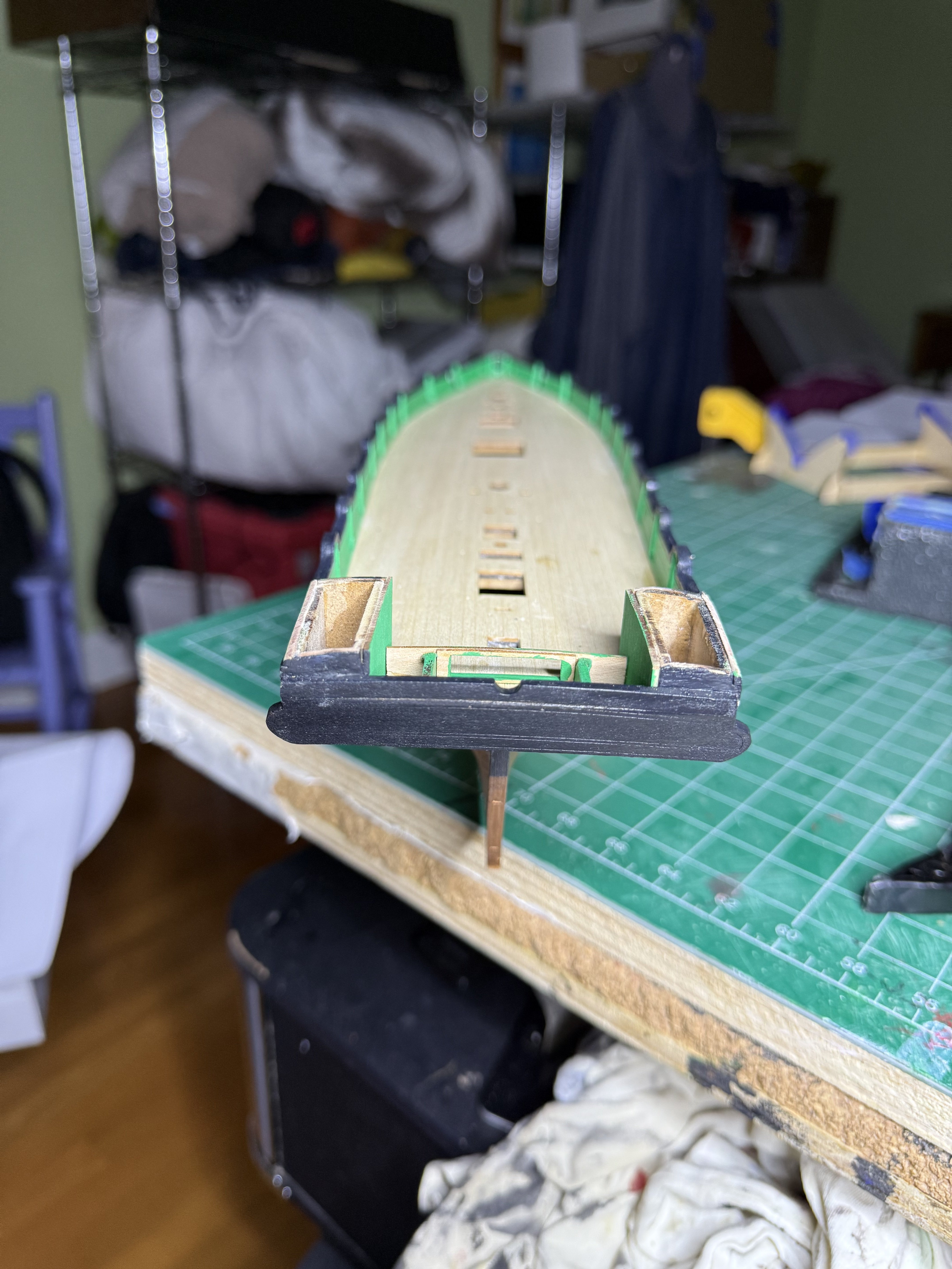

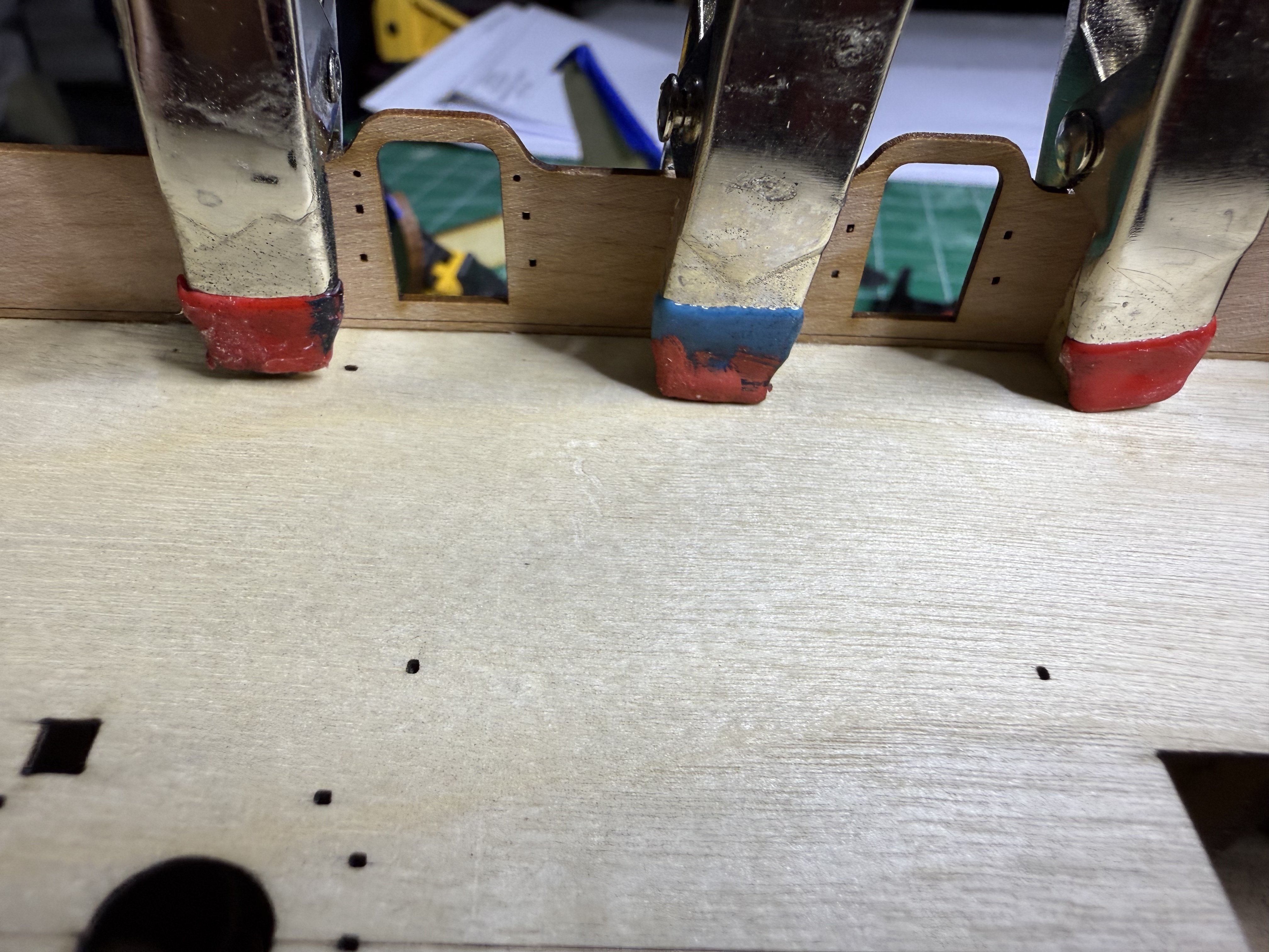

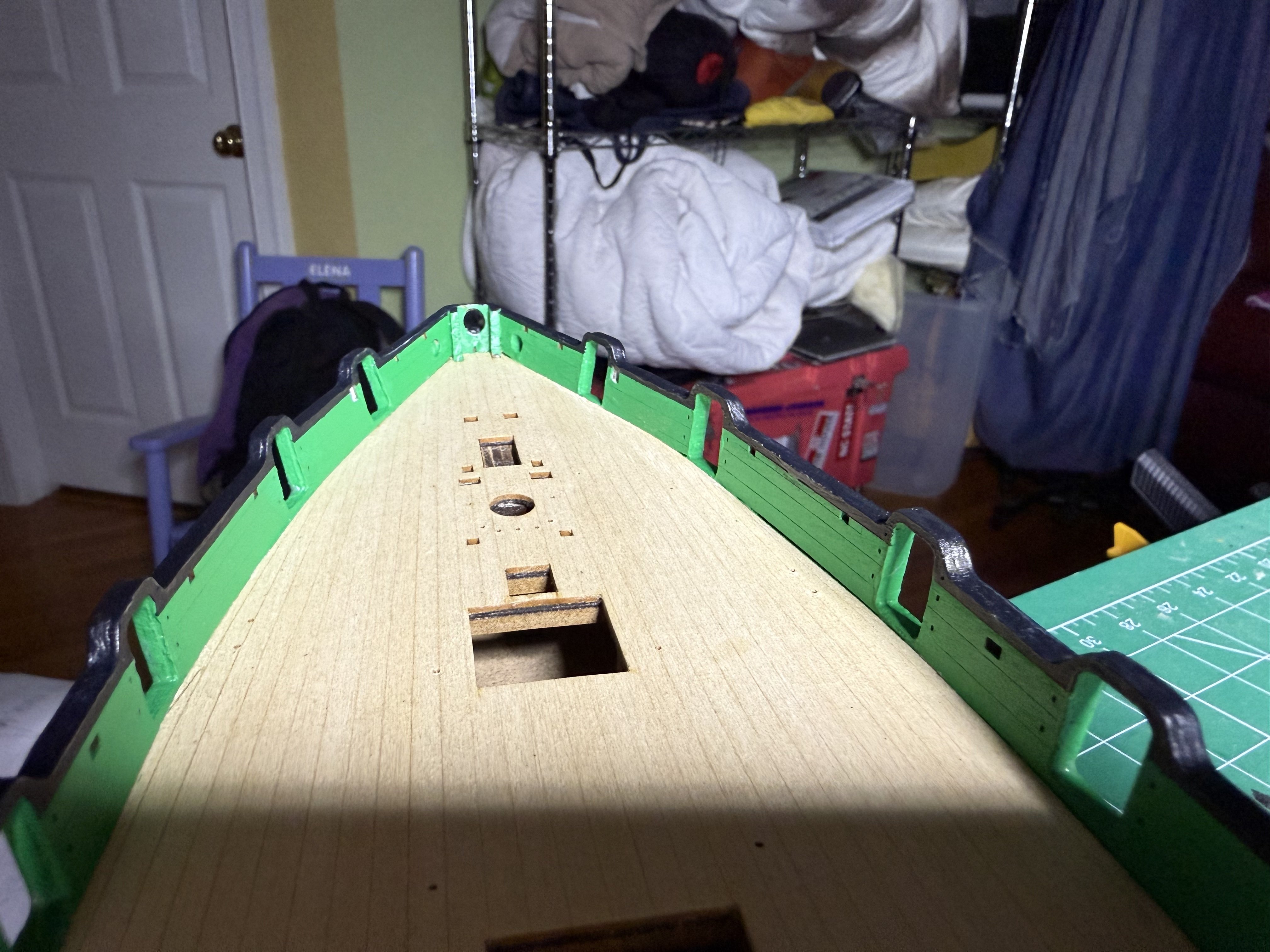

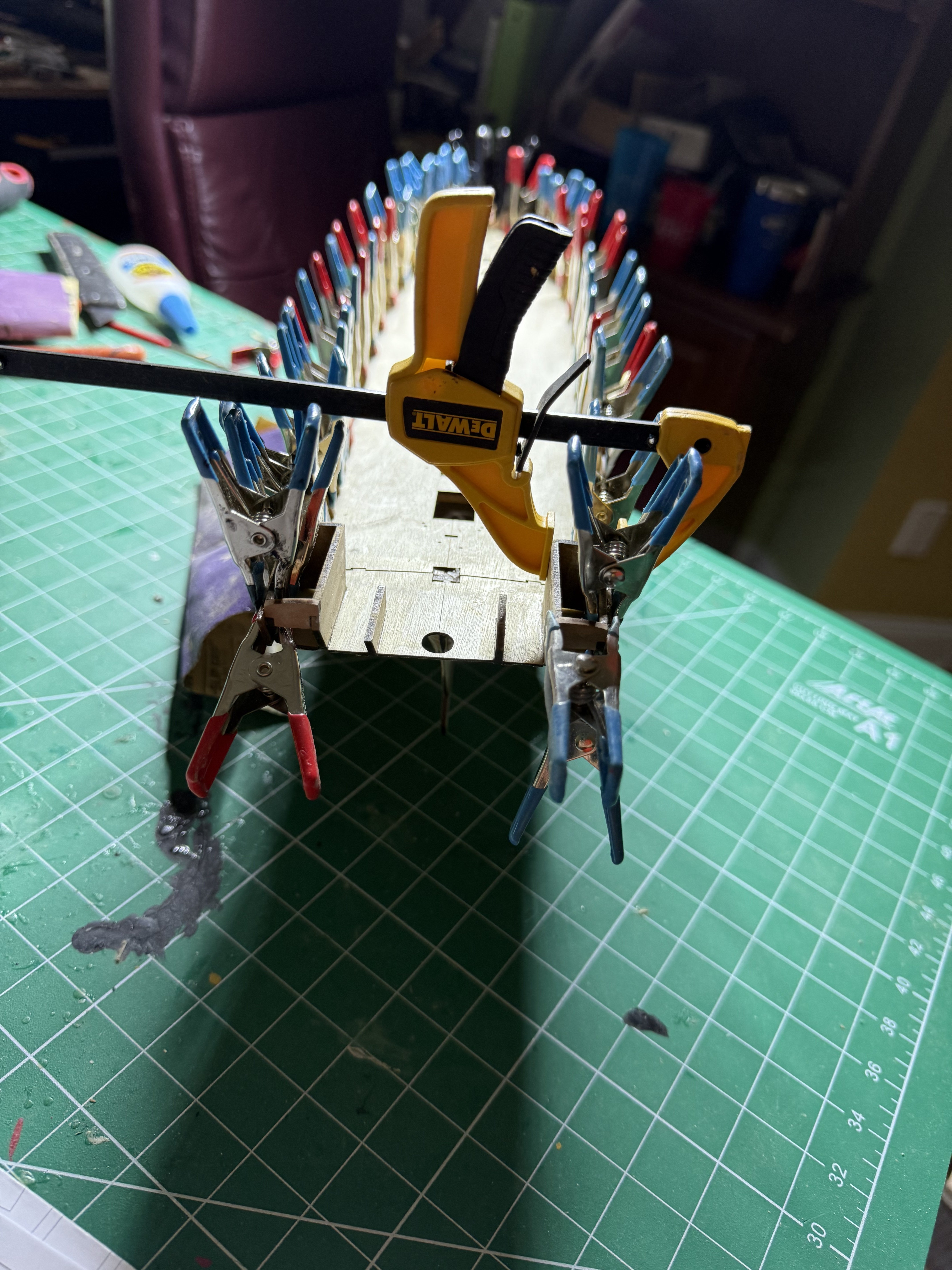

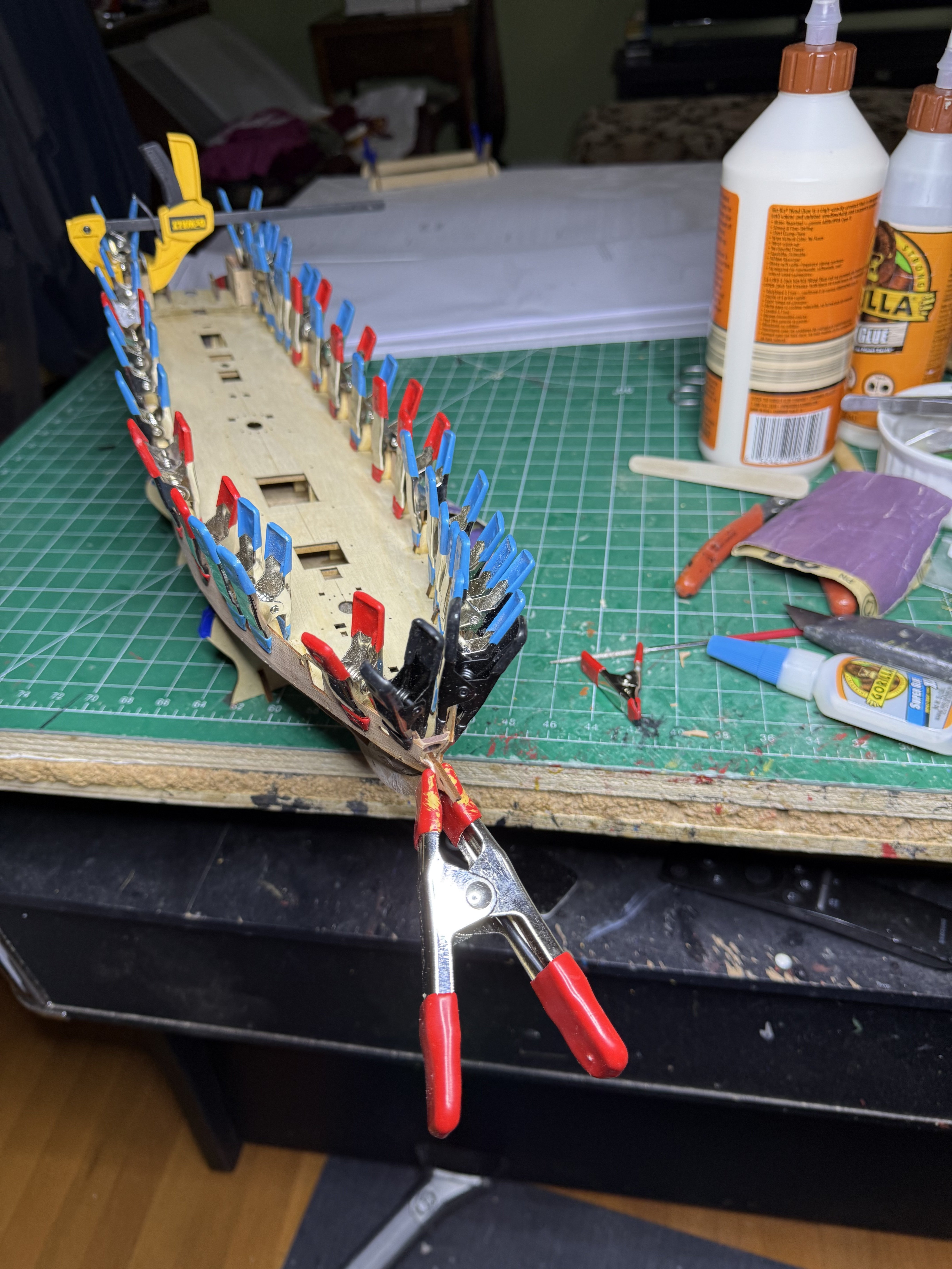

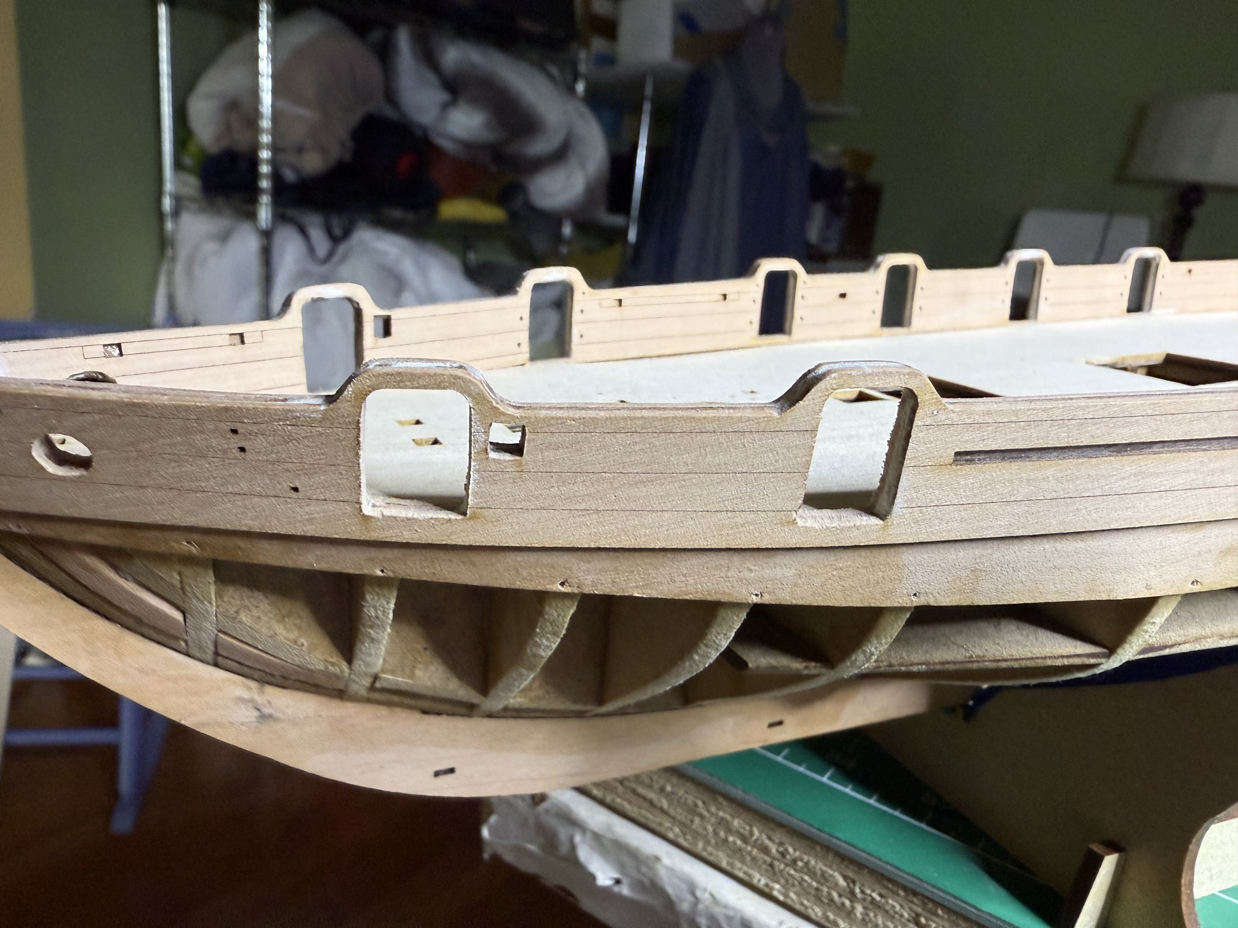

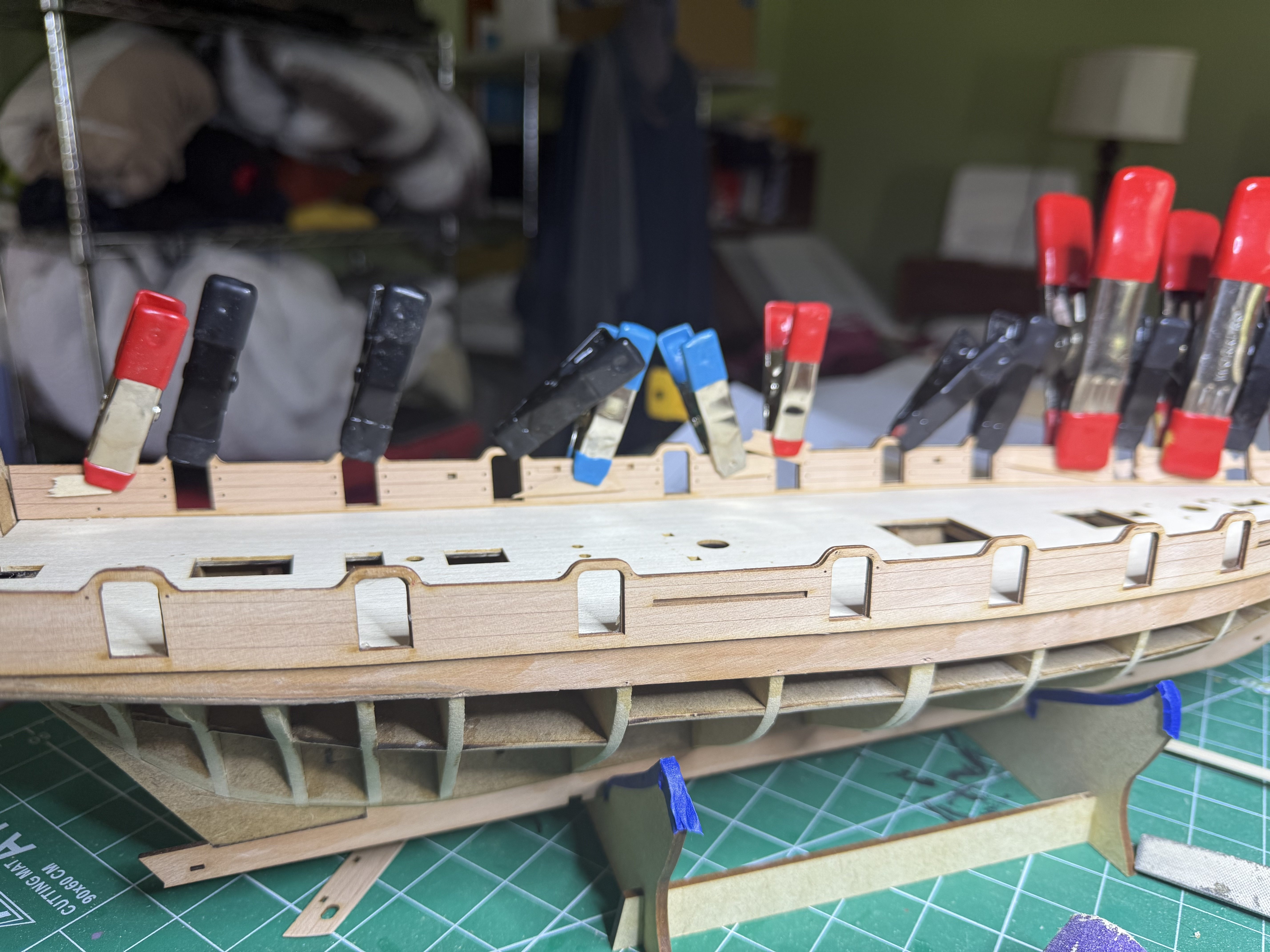

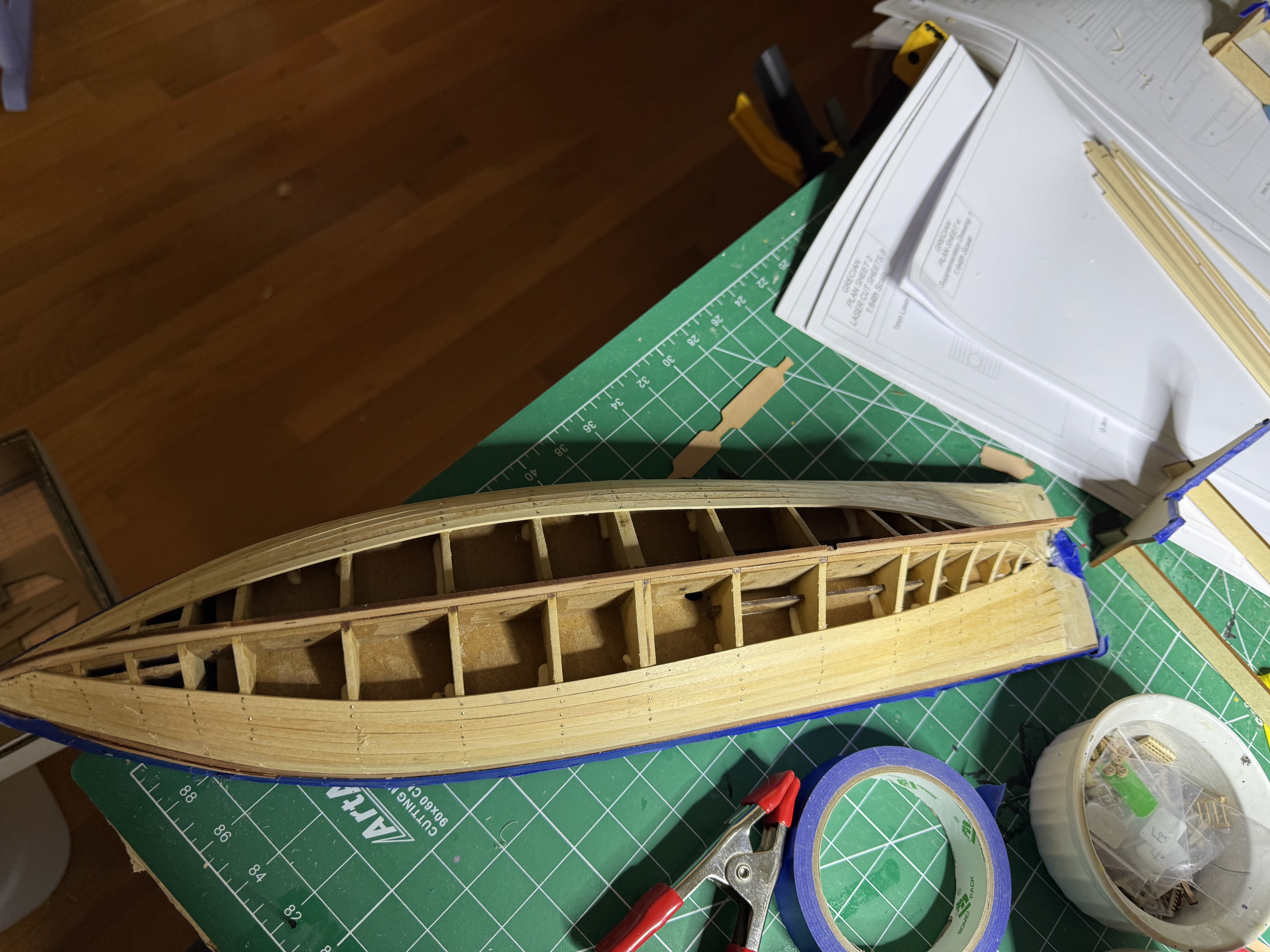

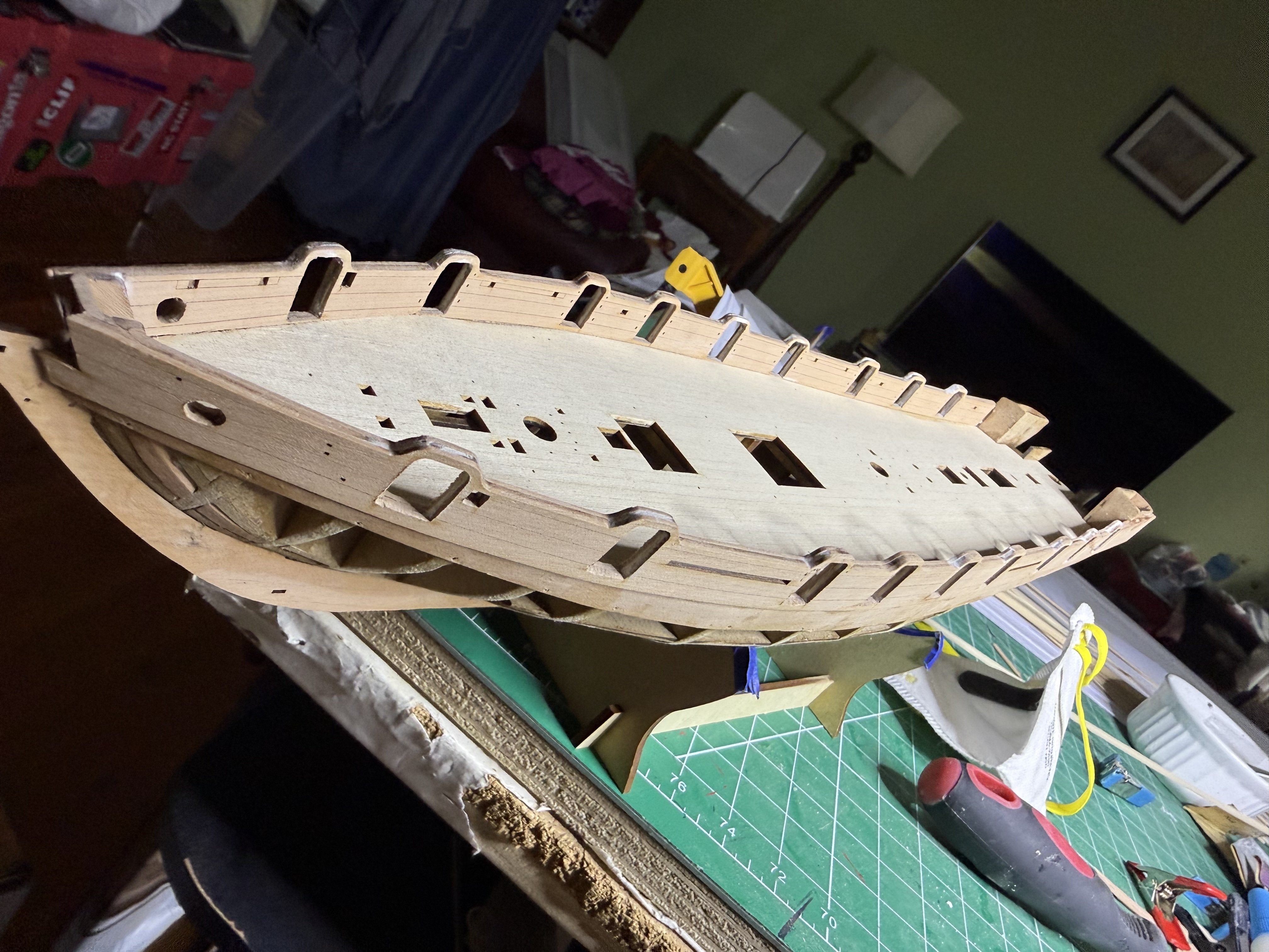

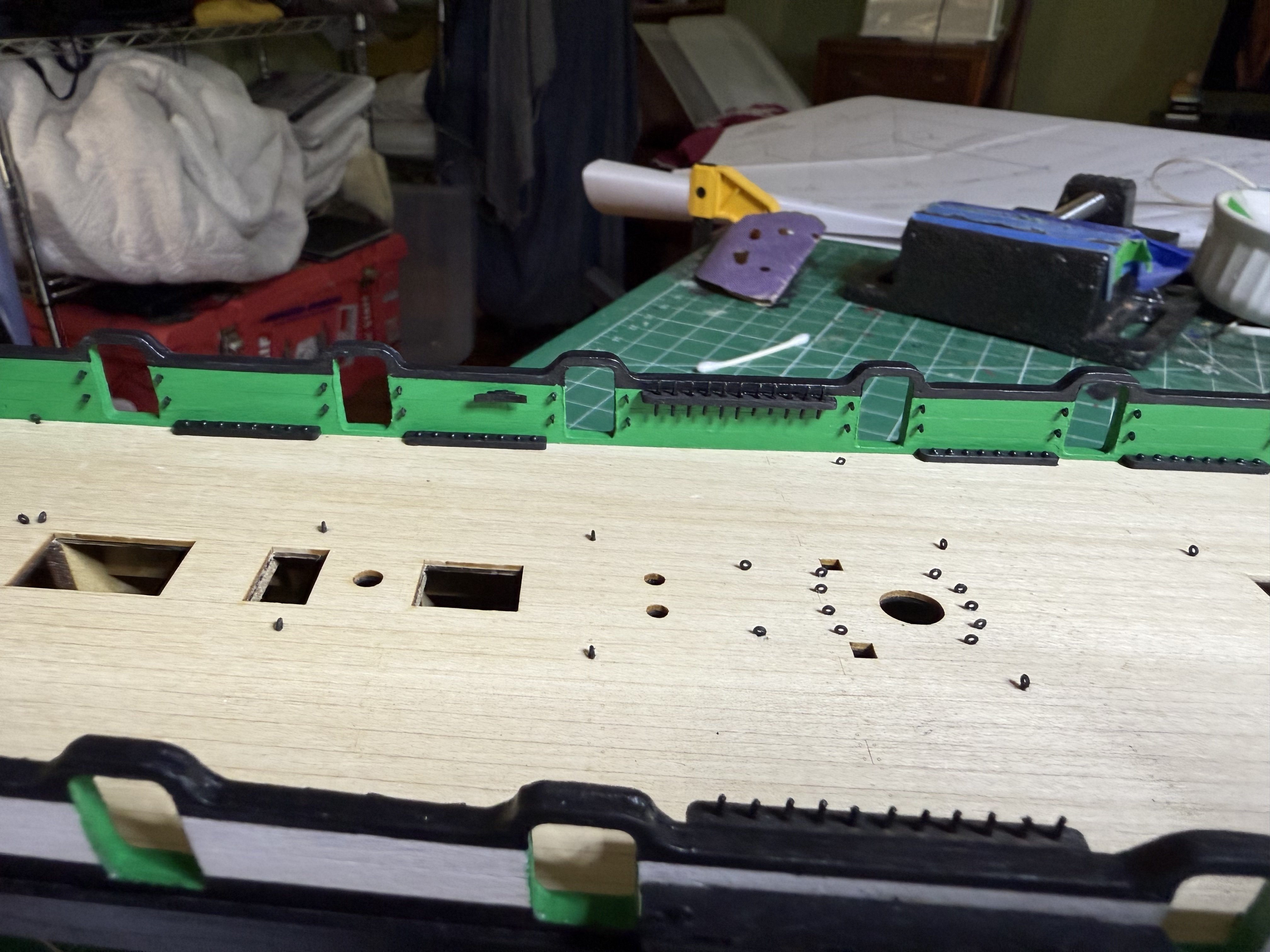

Next step is attaching the bulwark. The outer and inner sides will be covered with engraved pieces so this is the backbone so to speak.  It is important to glue keeping the edge of the deck along the lower of the two interior engraved lines.  Can never have to many clamps. You will also notice I temporarily pinned the lower edges to ensure a tight fit so the first plank will abut without gaps.  If you look closely at the instruction manual you can see James also used pinholes. IMG_0121.thumb.jpg.9db0ef518824fdf9261310752cdbb89a.jpgIMG_0120.thumb.jpg.1fa00a12a36e2a67ffd28dd9f3d195cc.jpgIMG_0119.thumb.jpg.2ac755c36bc154cd8e1a3cf6251dc140.jpgIMG_0118.thumb.jpg.571e0697ea2ac9c392f6177eba1b364a.jpg
The lower stern edge needs to be turnedinward. I scored it as the manual suggests. Later with filler and sanding it will be nice and rounded.
Lastly, it is important to make sure the end of the bulwark sits at the same height above the deckhouse at the stern.

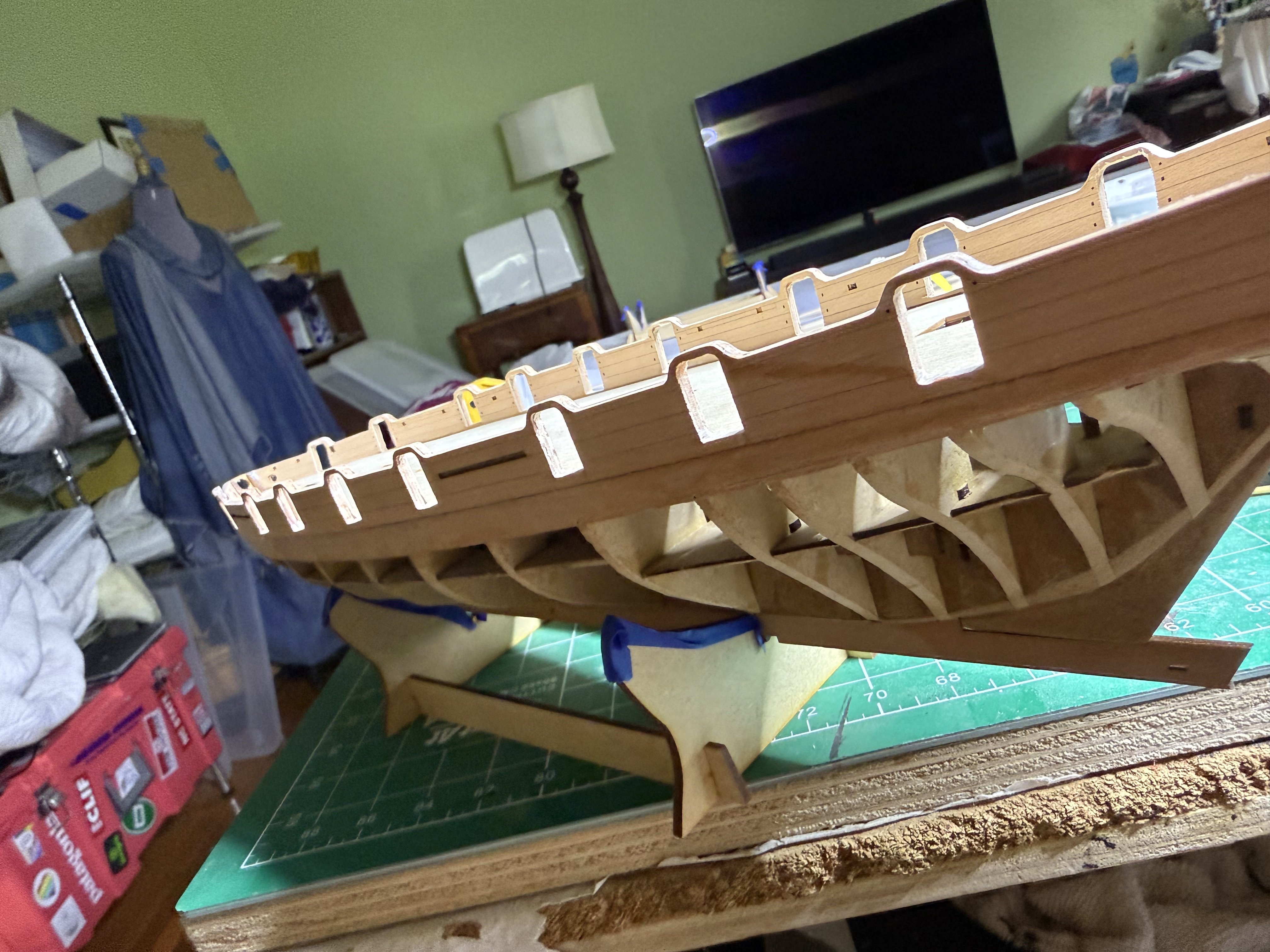

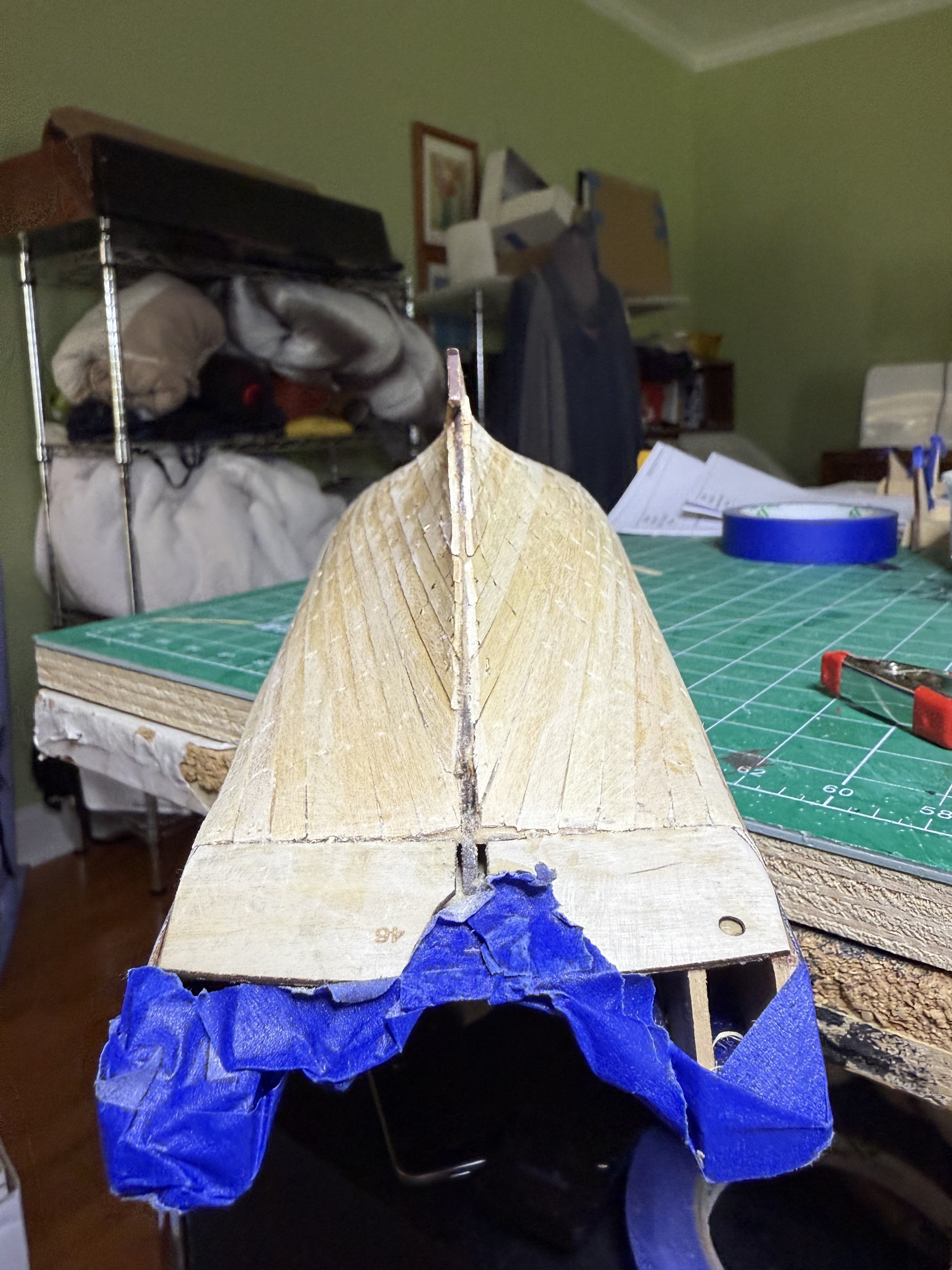

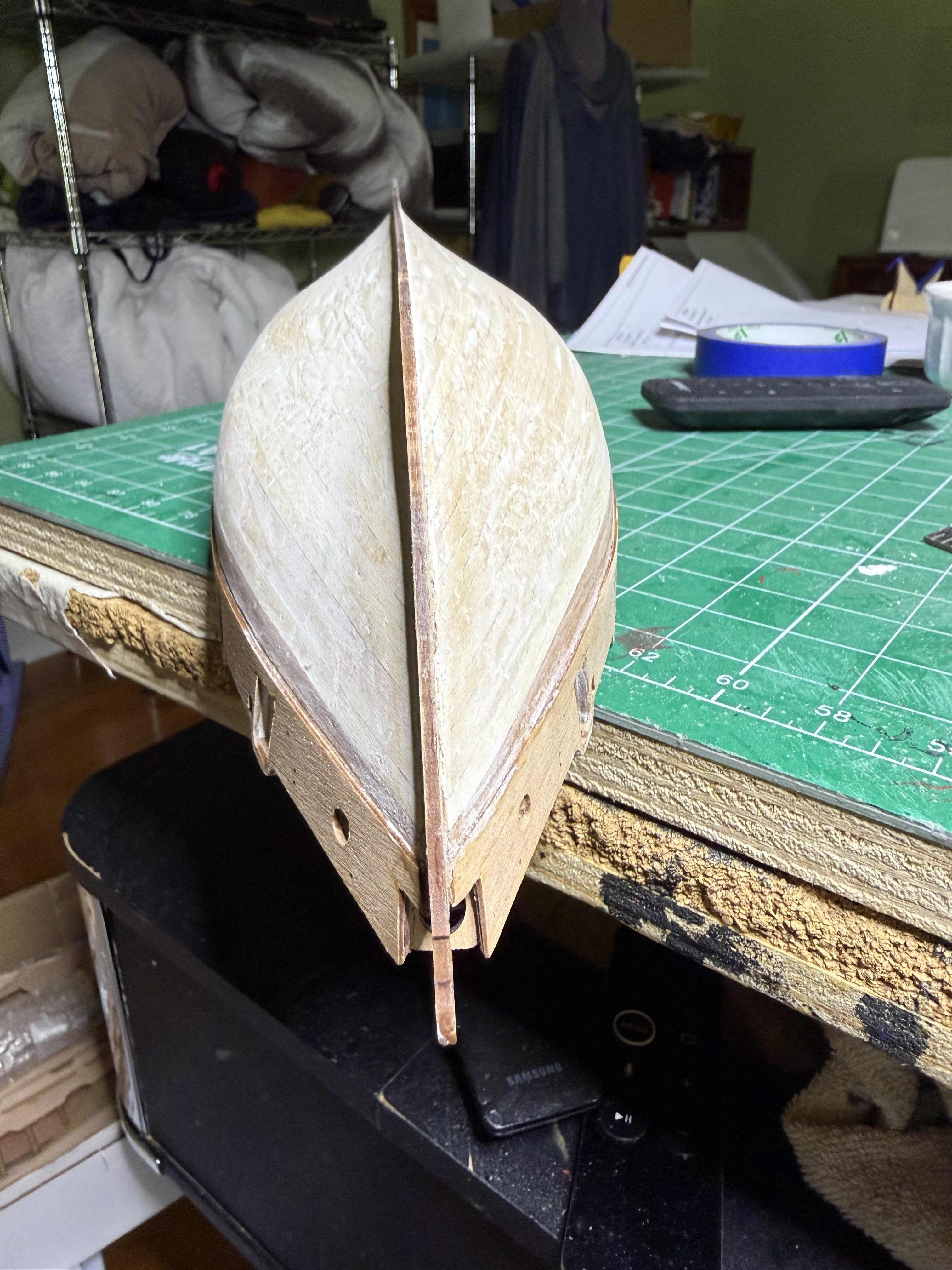

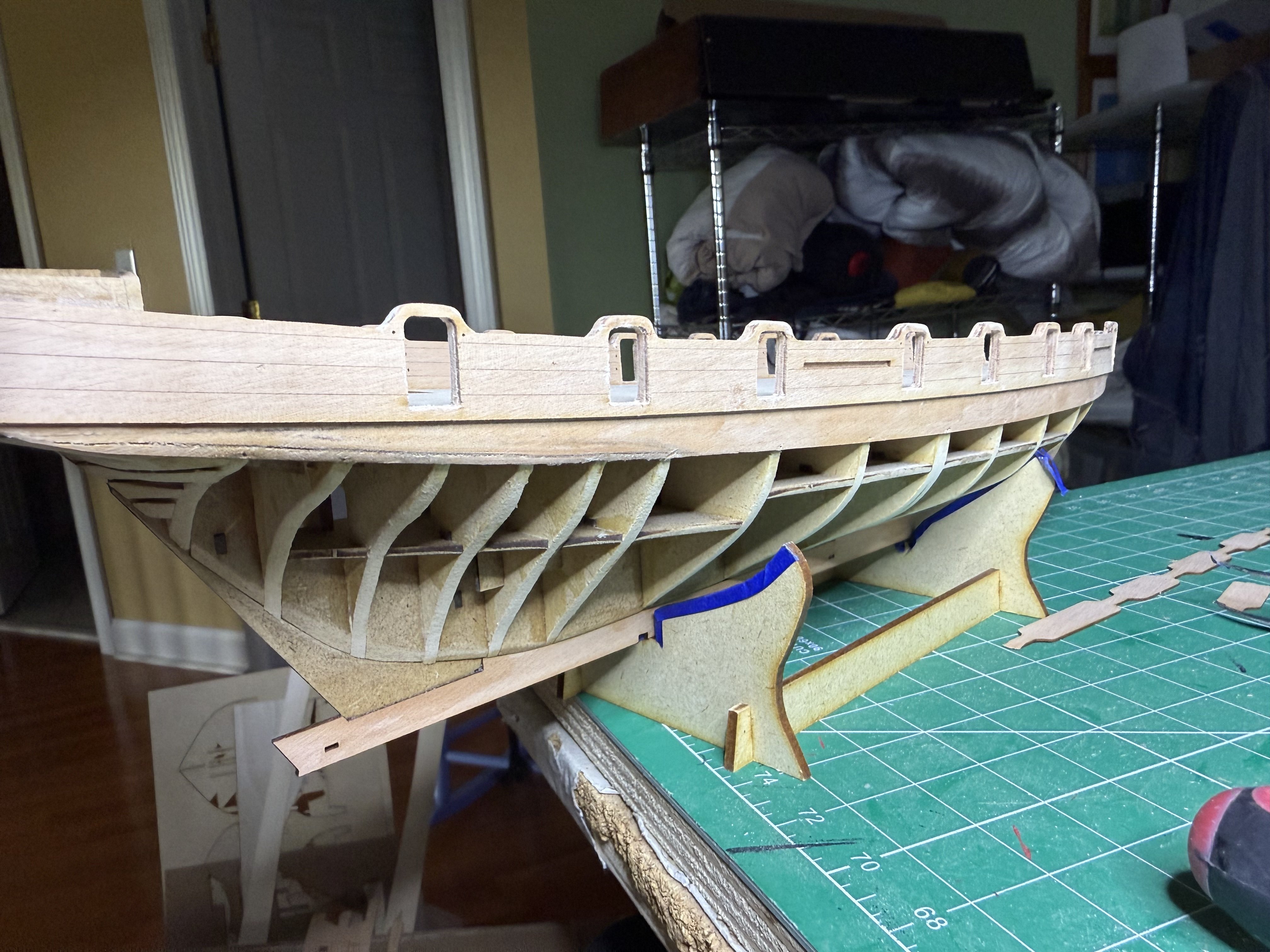

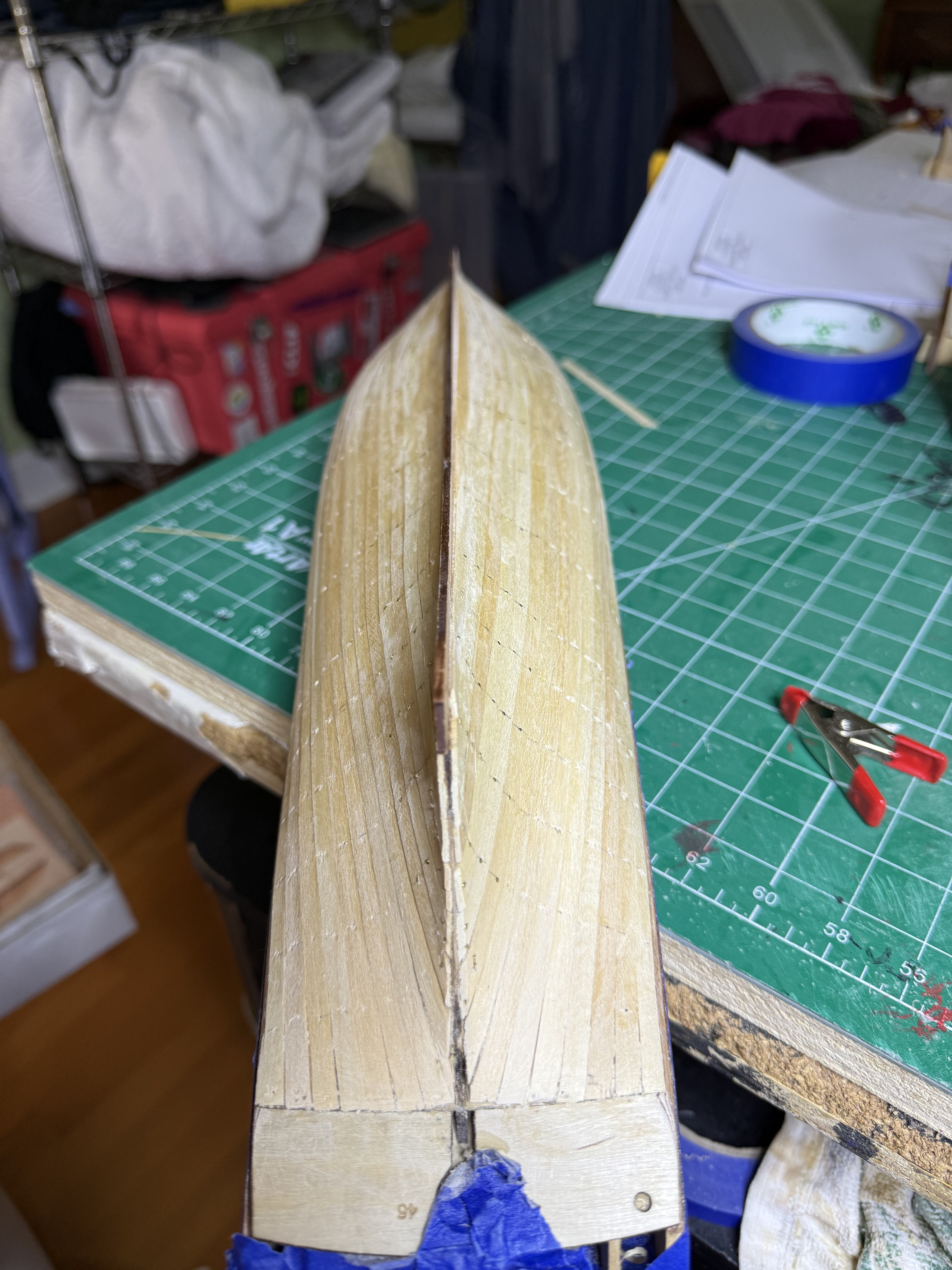

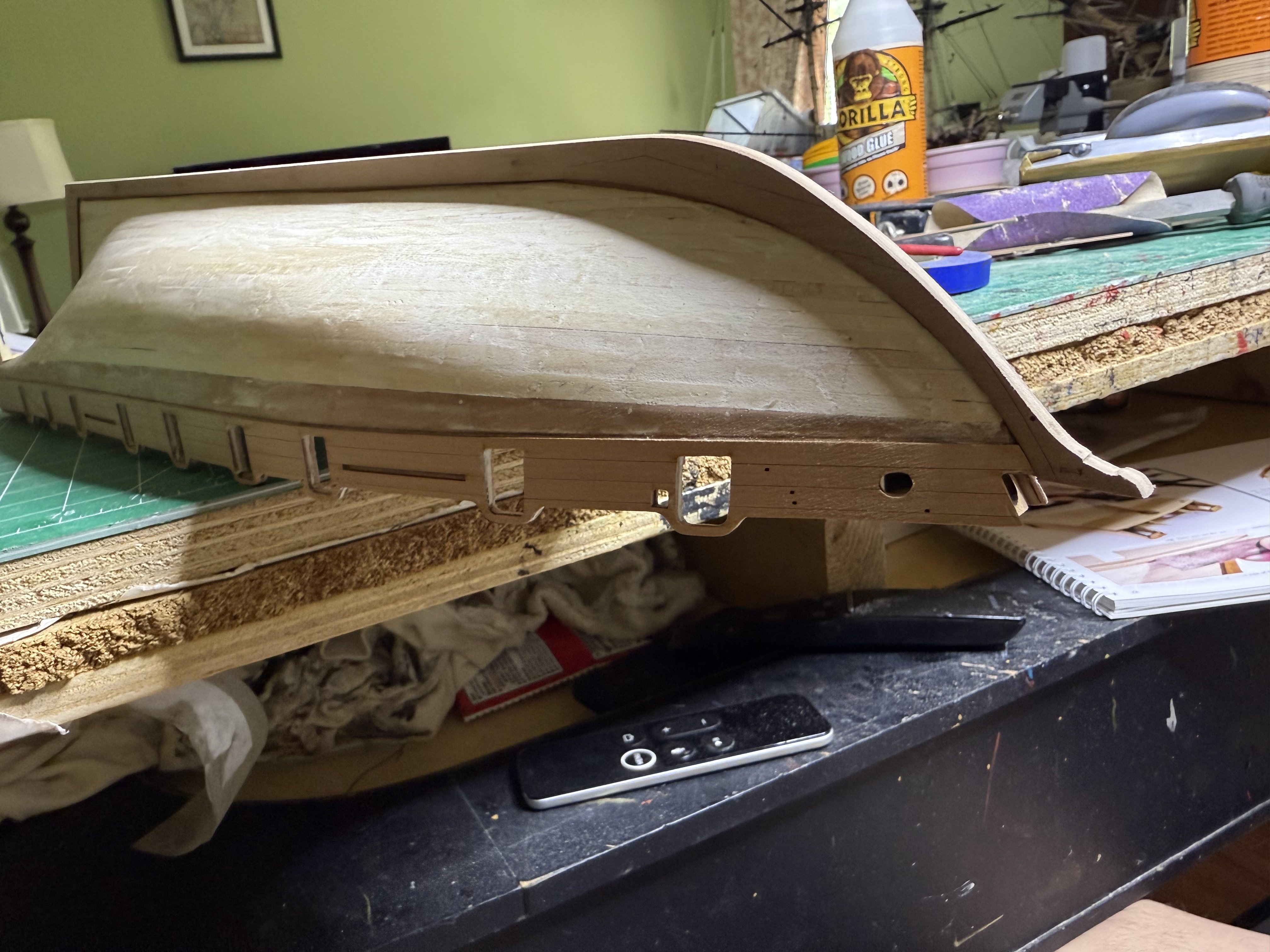

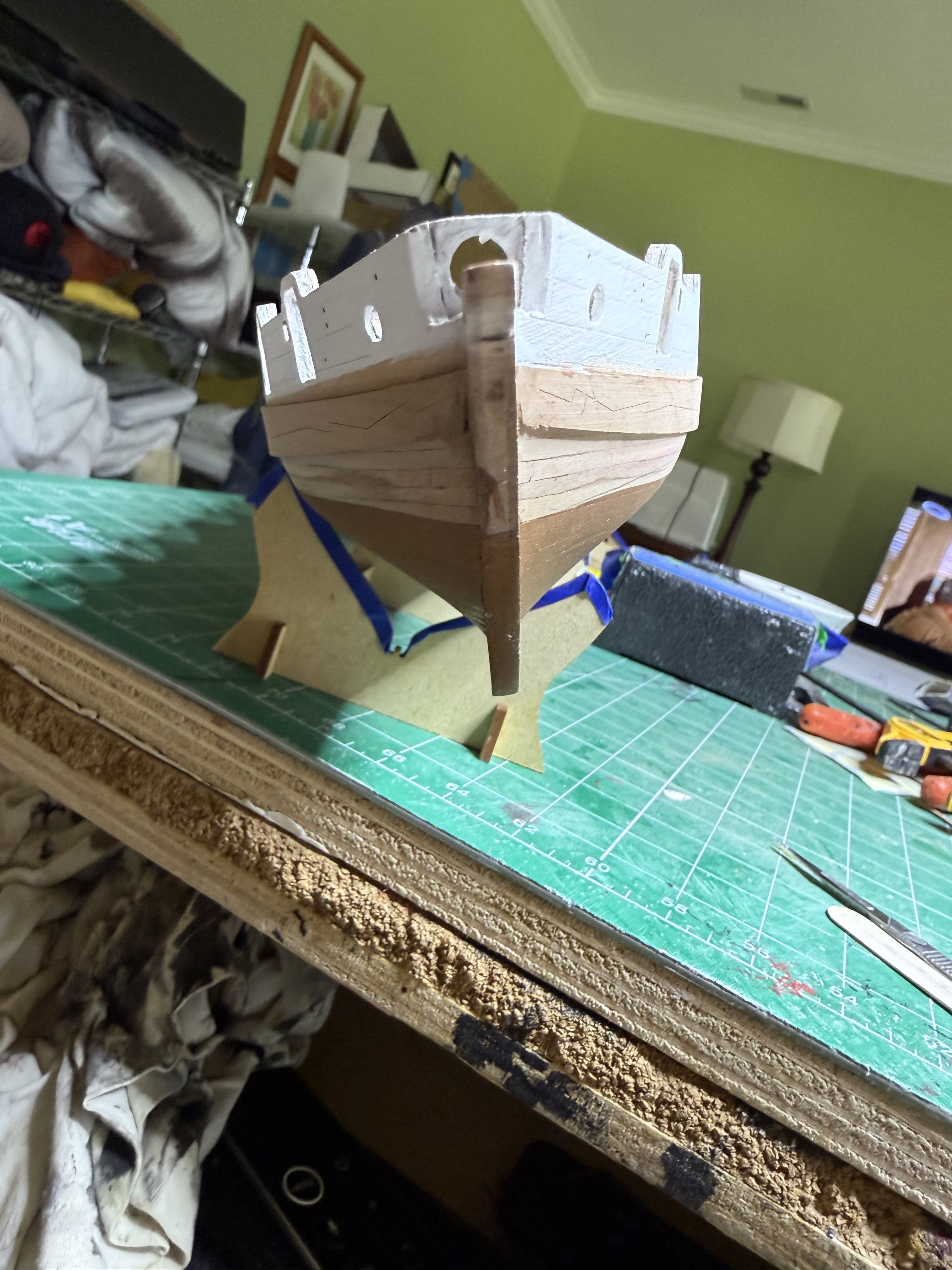

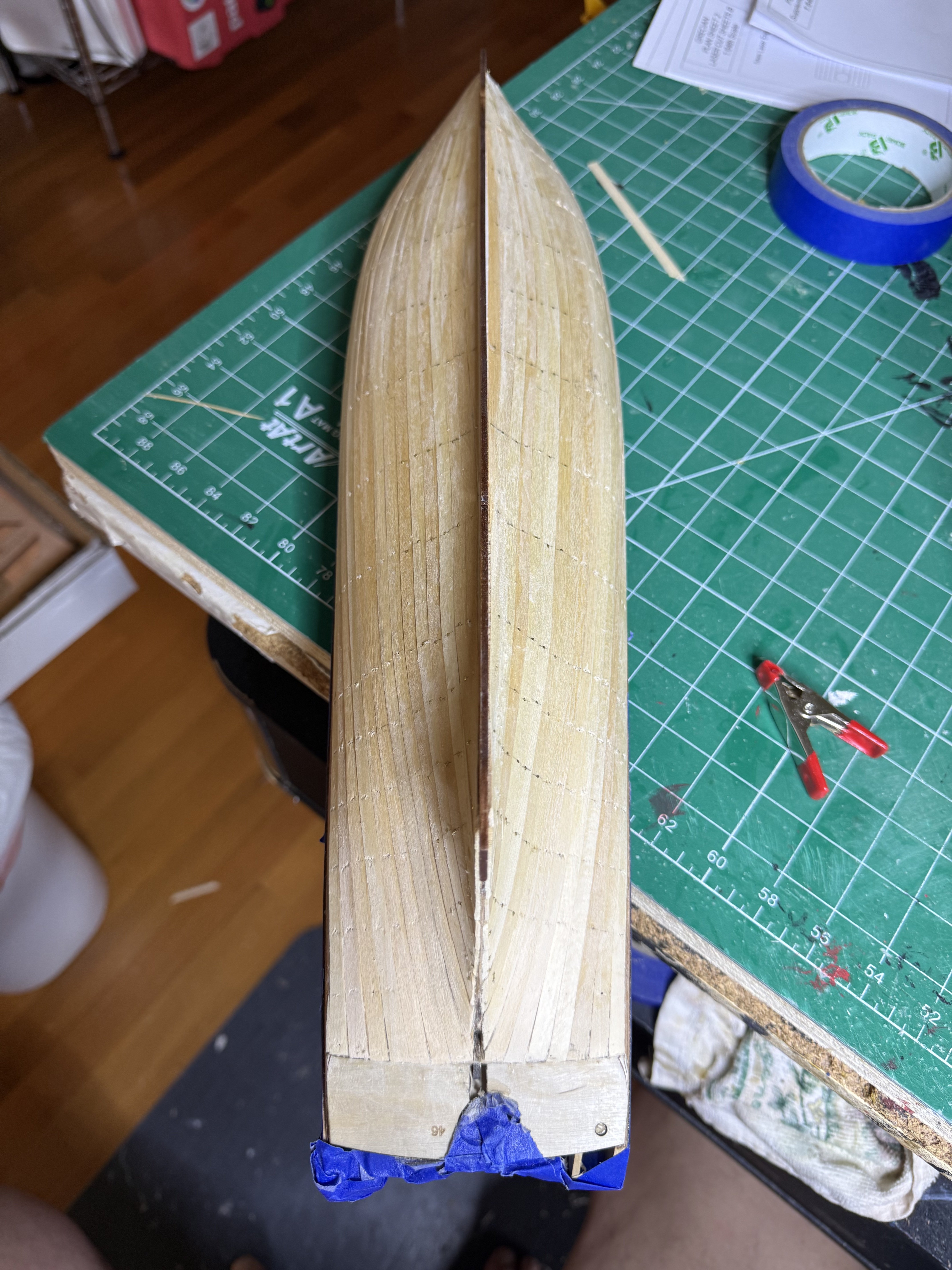

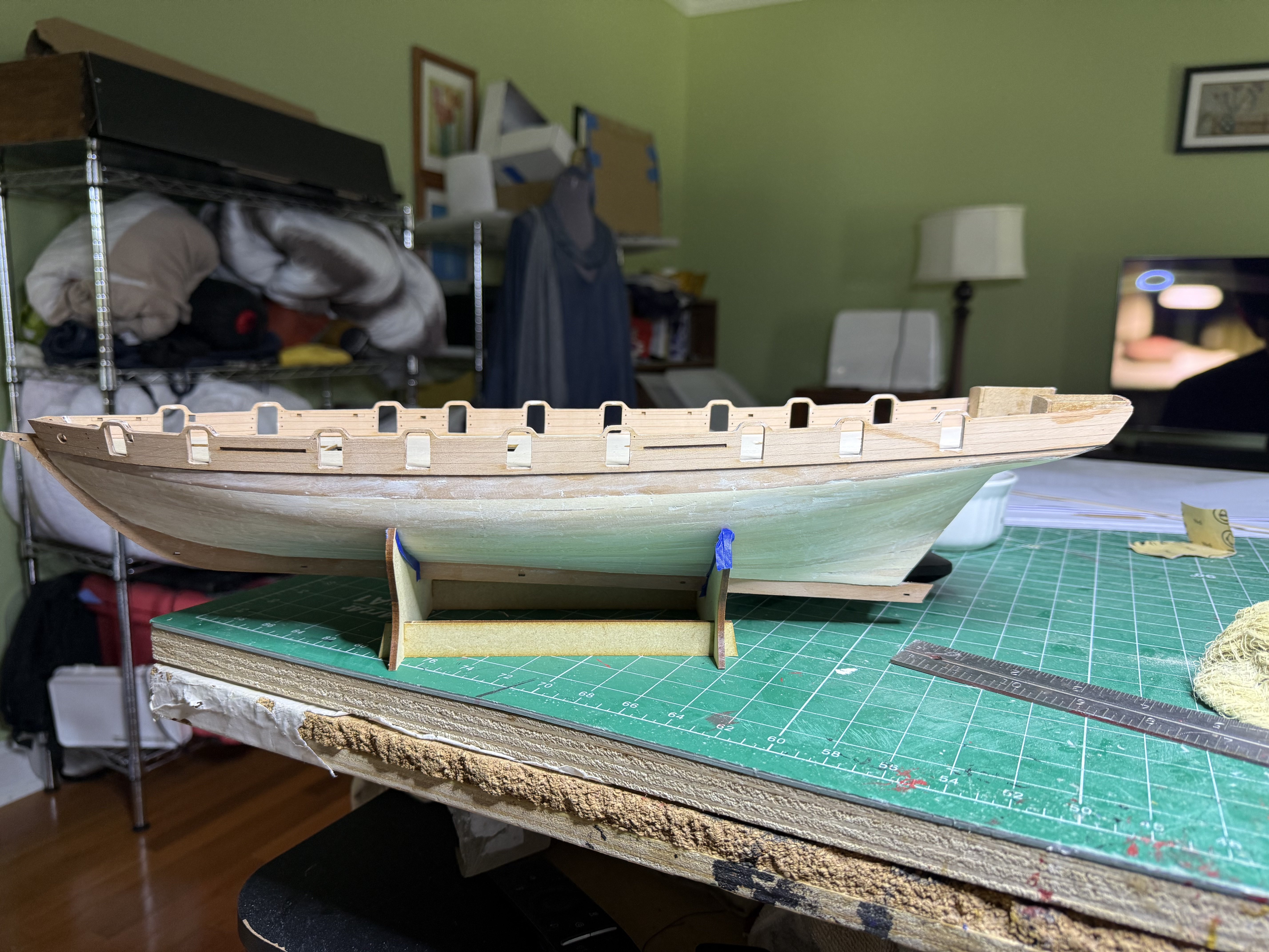

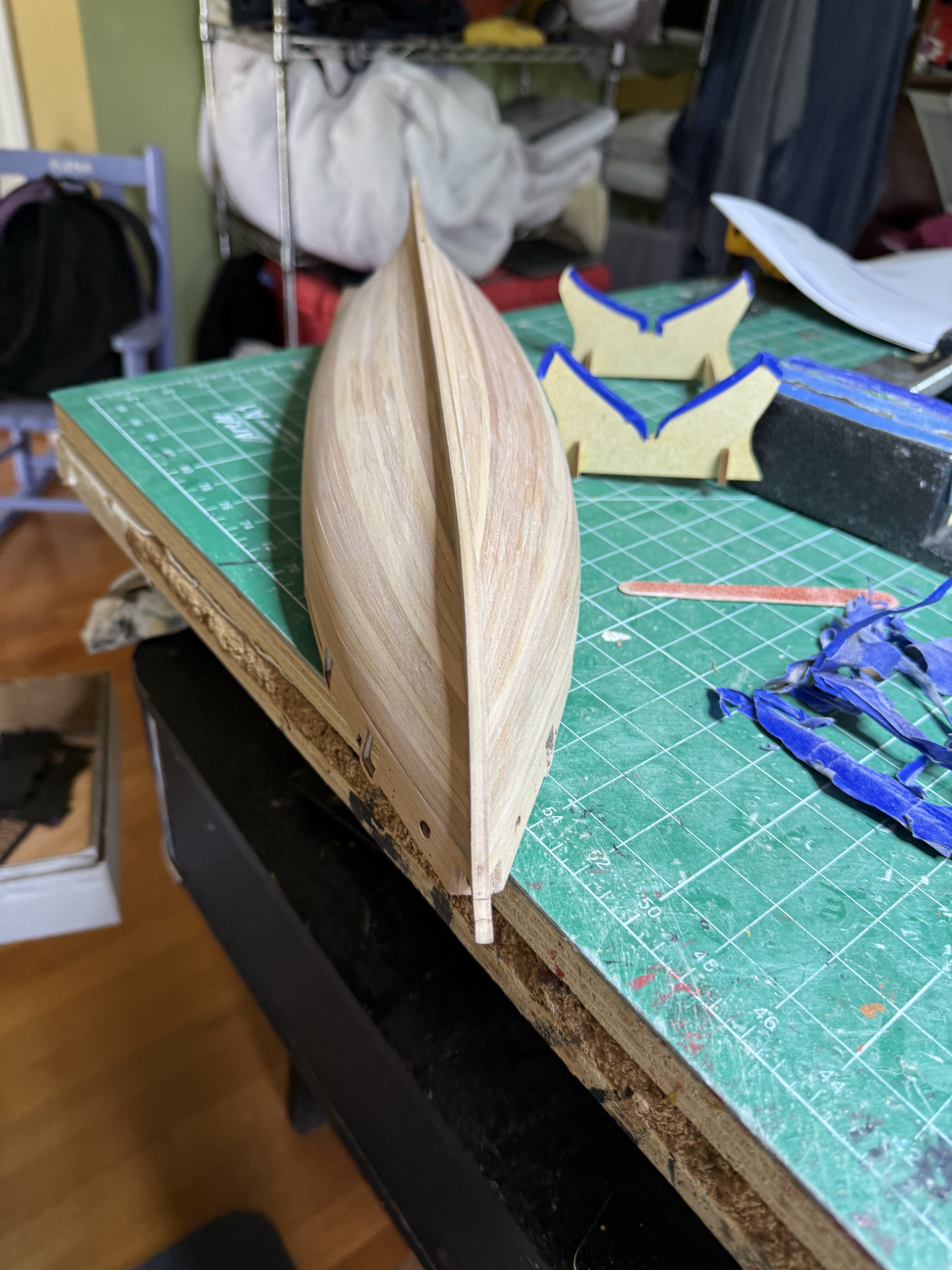

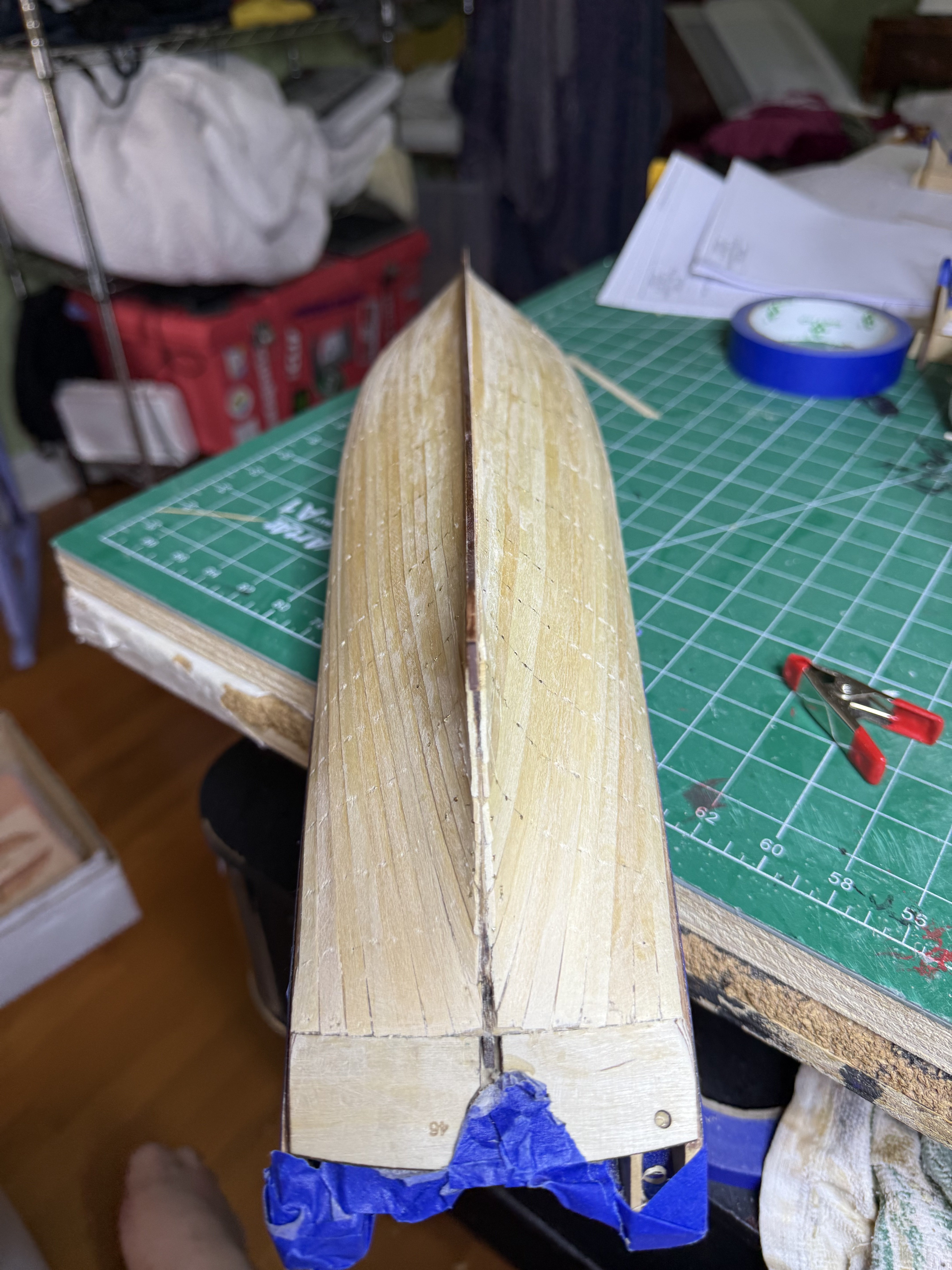

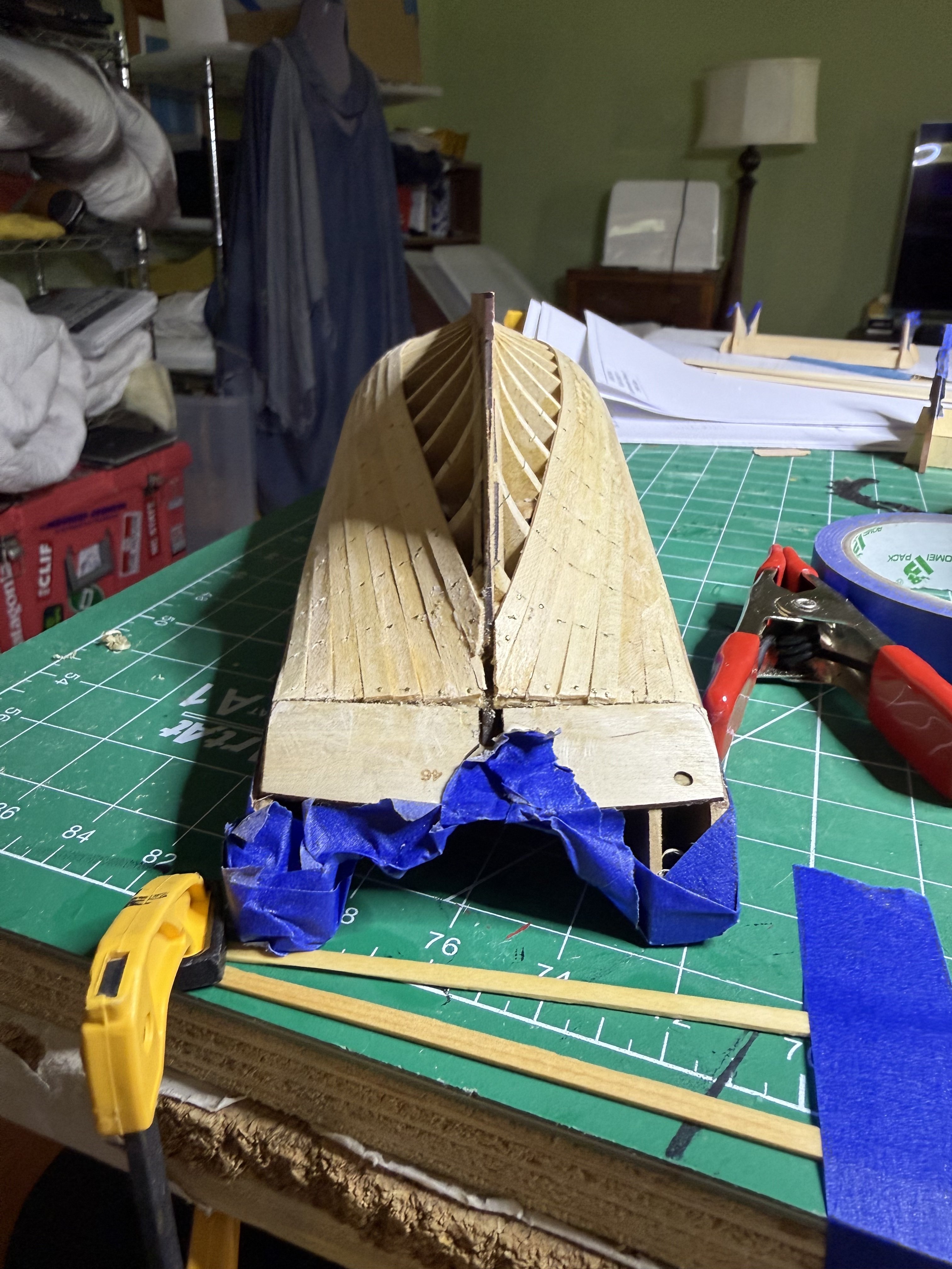

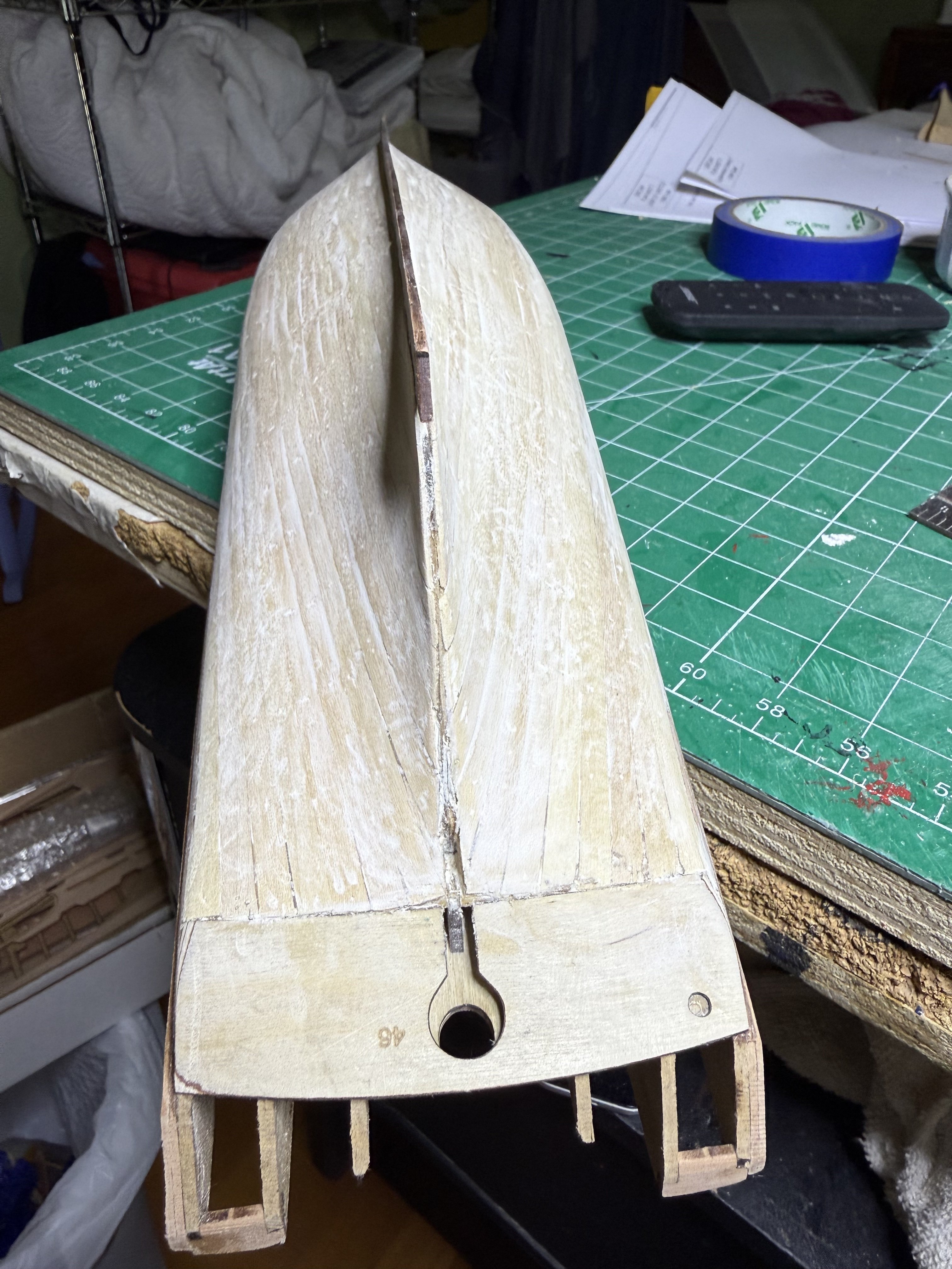

No first planking done, here pre-sanding/filling. Had 2 stealers in the stern
IMG_0151.thumb.jpg.cea9a094ad6f58746e53515763d1e45d.jpgIMG_0152.thumb.jpg.baad9e81aee094bb5dfe28ebea32d060.jpgIMG_0154.thumb.jpg.2d6fc8e75ec89dc34305597139e374d0.jpgIMG_0155.thumb.jpg.4decf2438b5fb7396e780575981c7660.jpgIMG_0156.thumb.jpg.0a85c3fe9a9864dd3cf10780e43f1c64.jpg

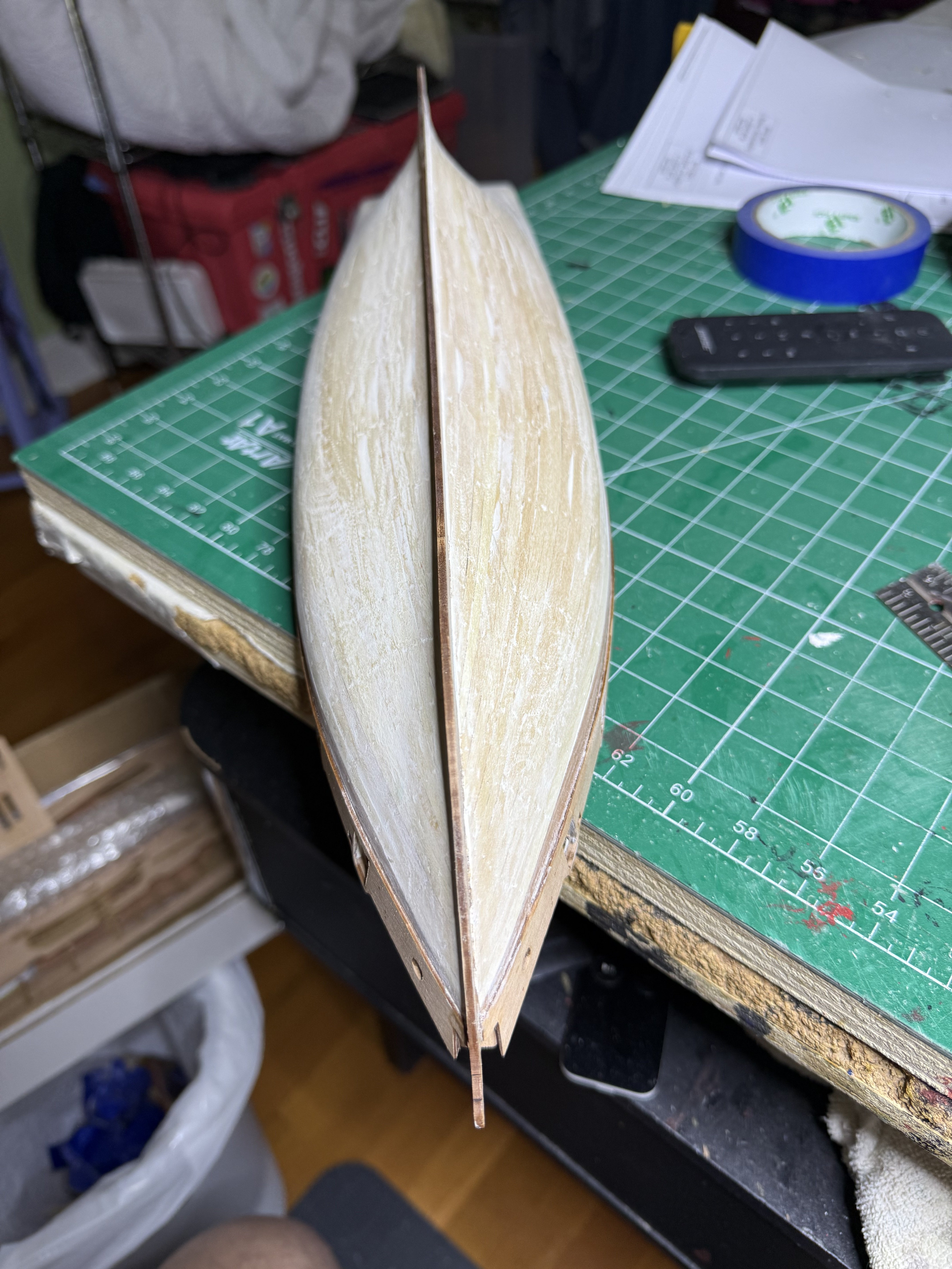

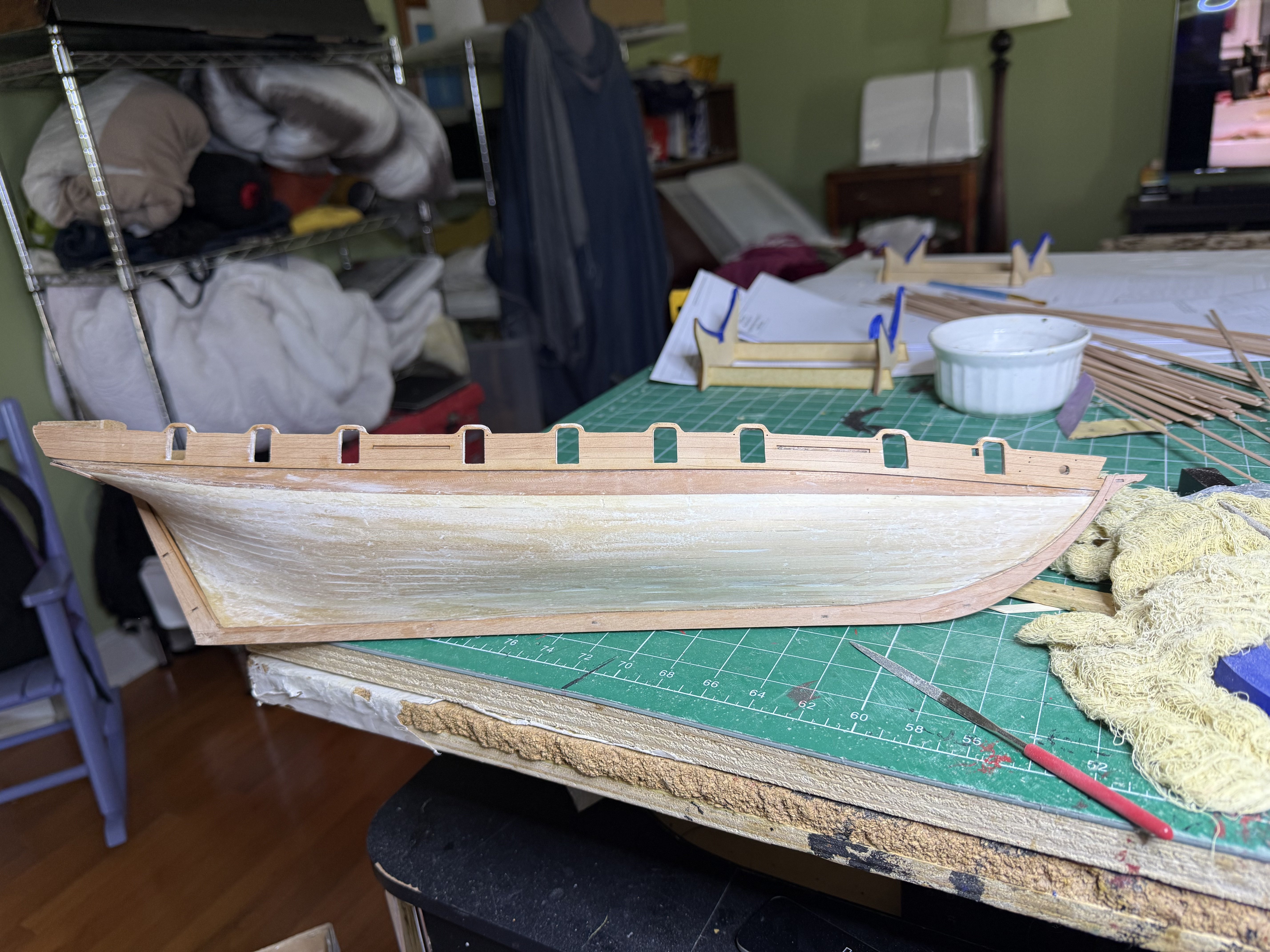

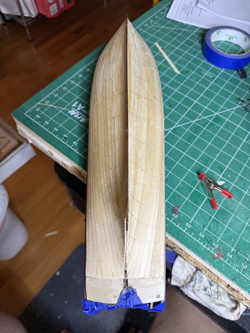

Now post sanding, filling and sanding
IMG_0161.thumb.jpg.114171e8e8a466ea03744f8efe6a215a.jpgIMG_0160.thumb.jpg.4773fa20c61896359f706061d98497f2.jpgIMG_0162.thumb.jpg.1c73217796dae1d09a3cdf98491121fe.jpgIMG_0164.thumb.jpg.4763a7f051b0306741494ac58e3dd6bb.jpg
IMG_0163.thumb.jpg.ef4053665b7c2c74a1e8c608e9517ace.jpgIMG_0165.thumb.jpg.f5046b34d7d34c088b26c780bf2428b2.jpg

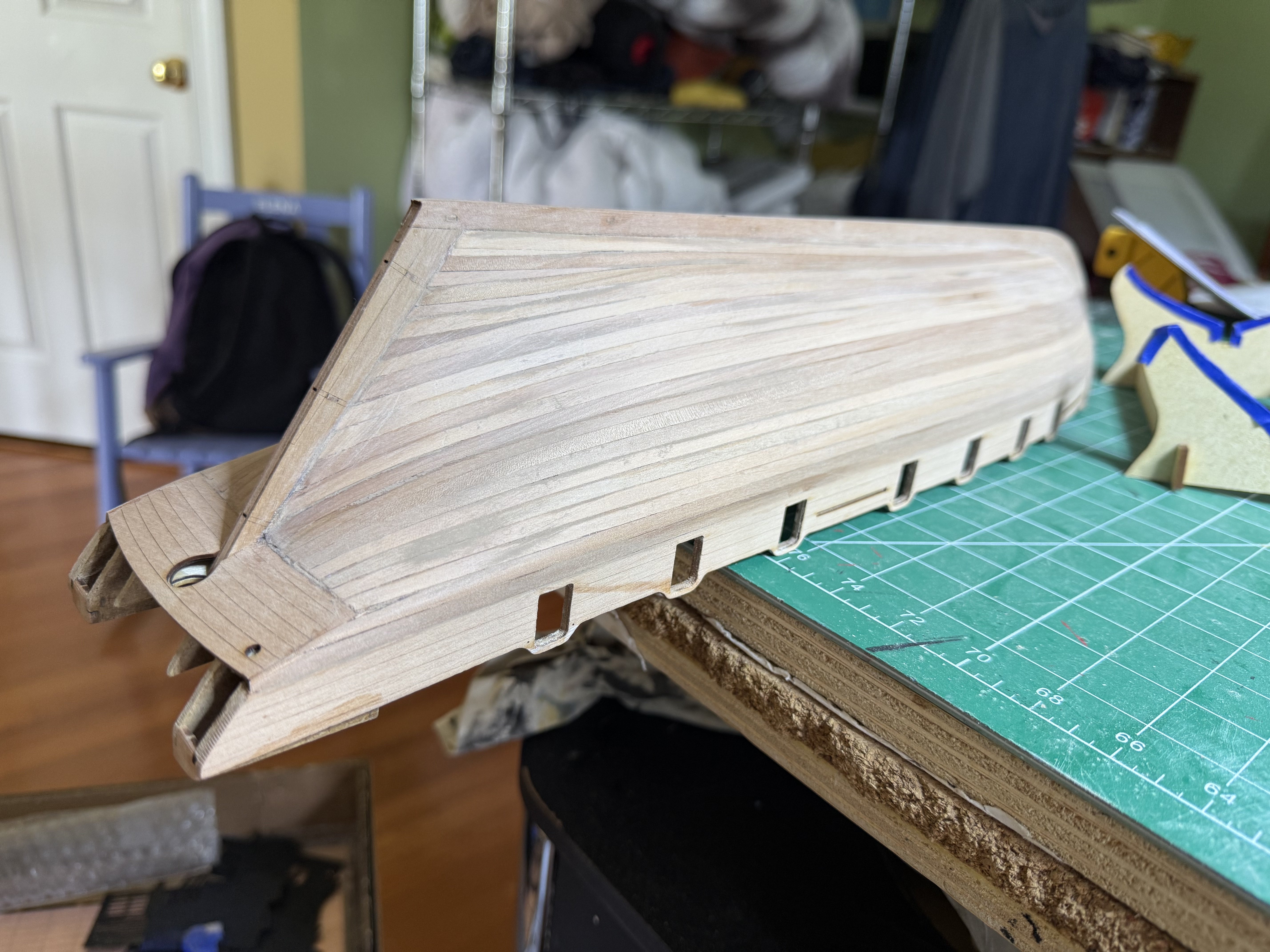

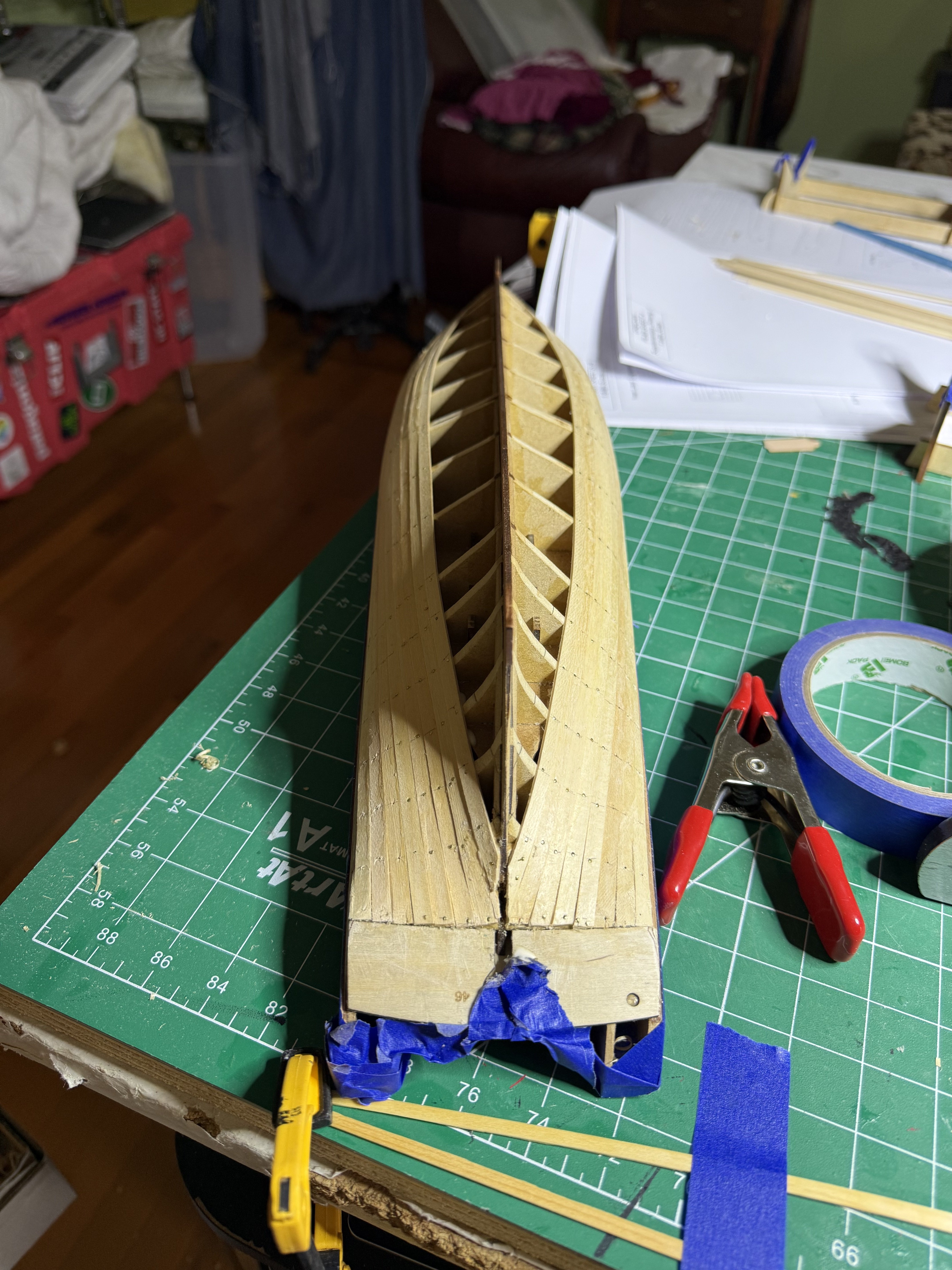

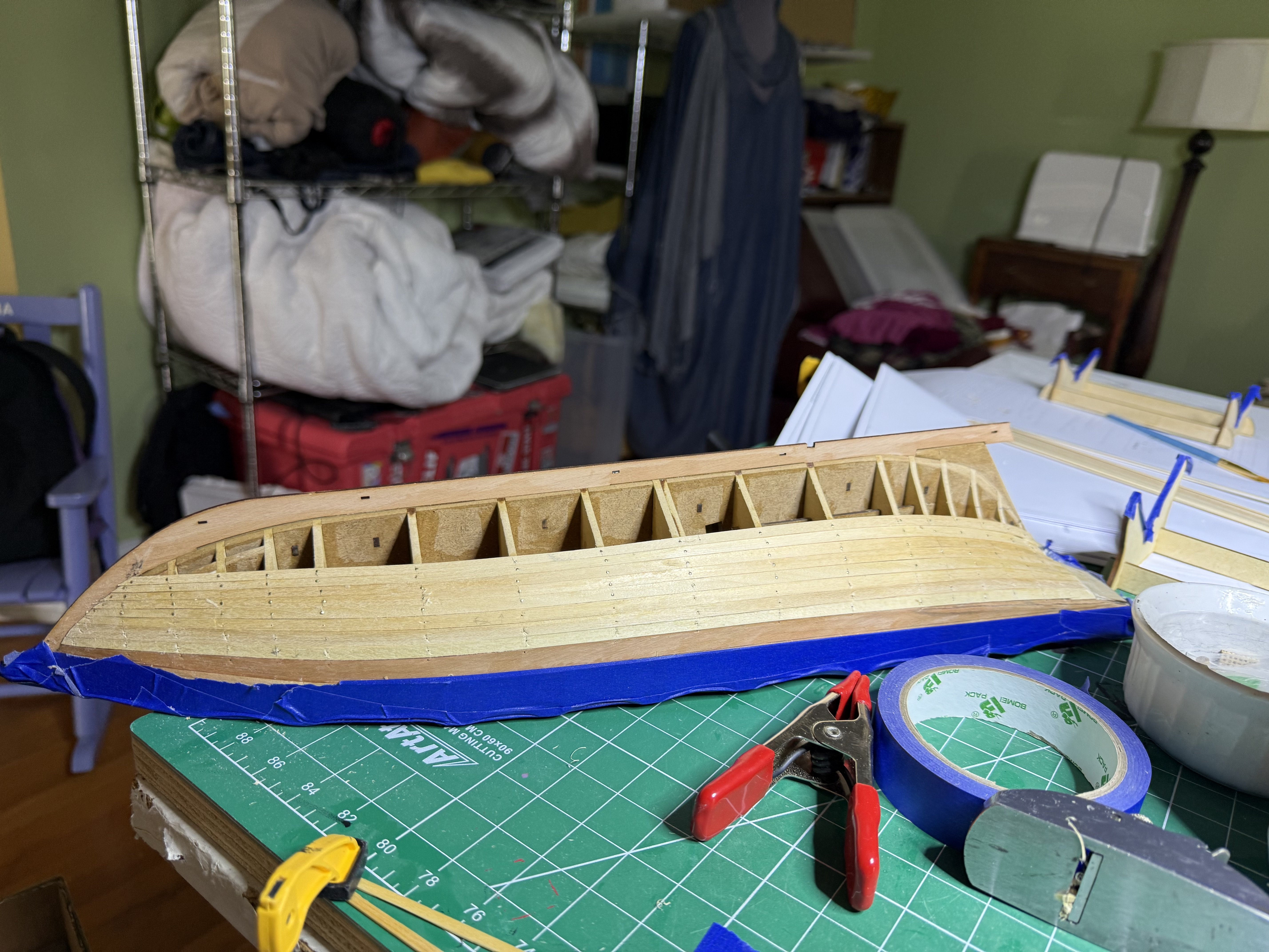

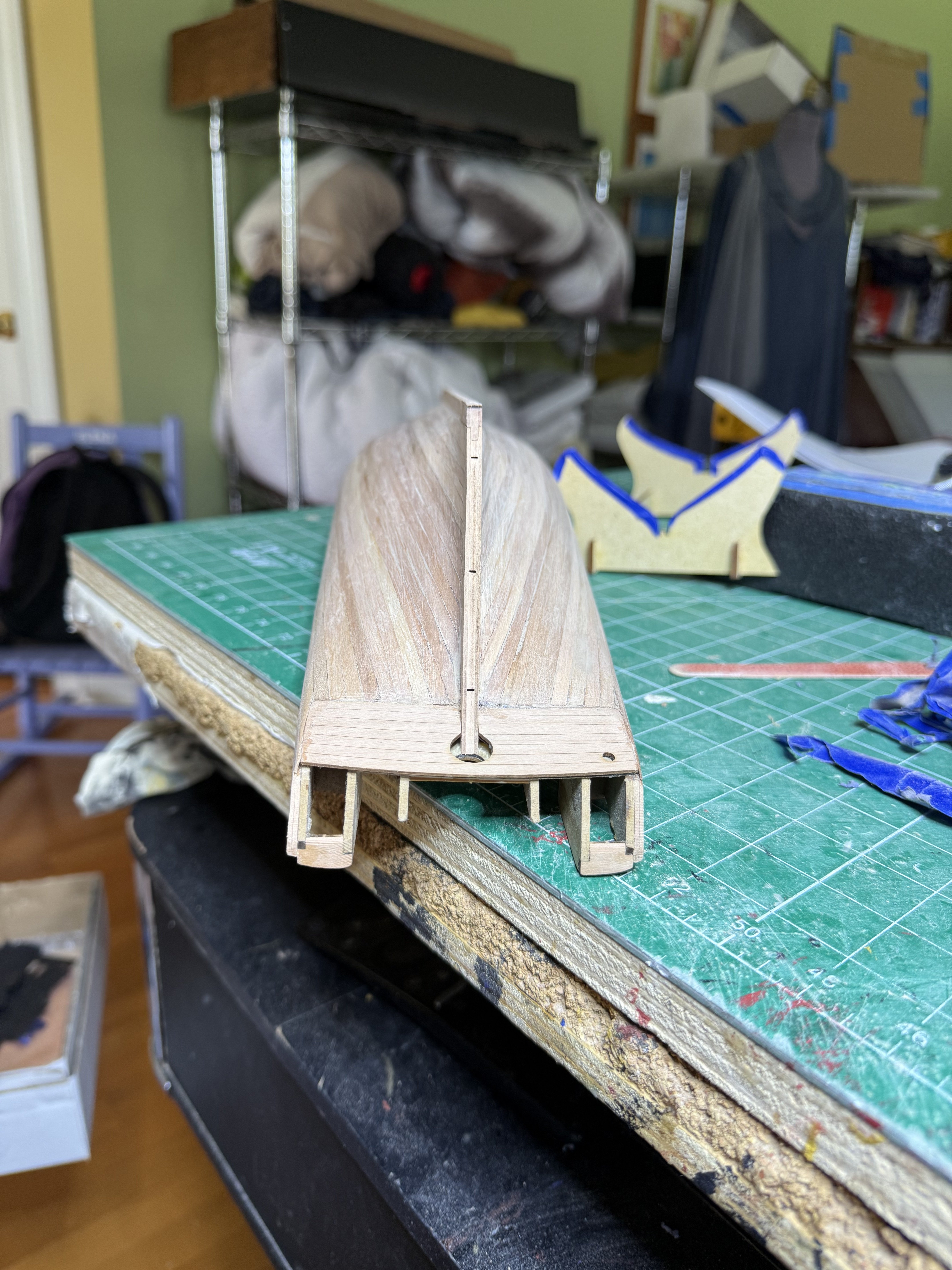

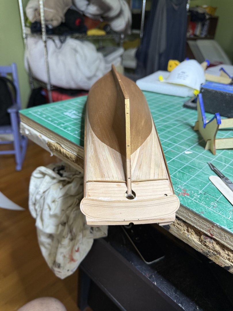

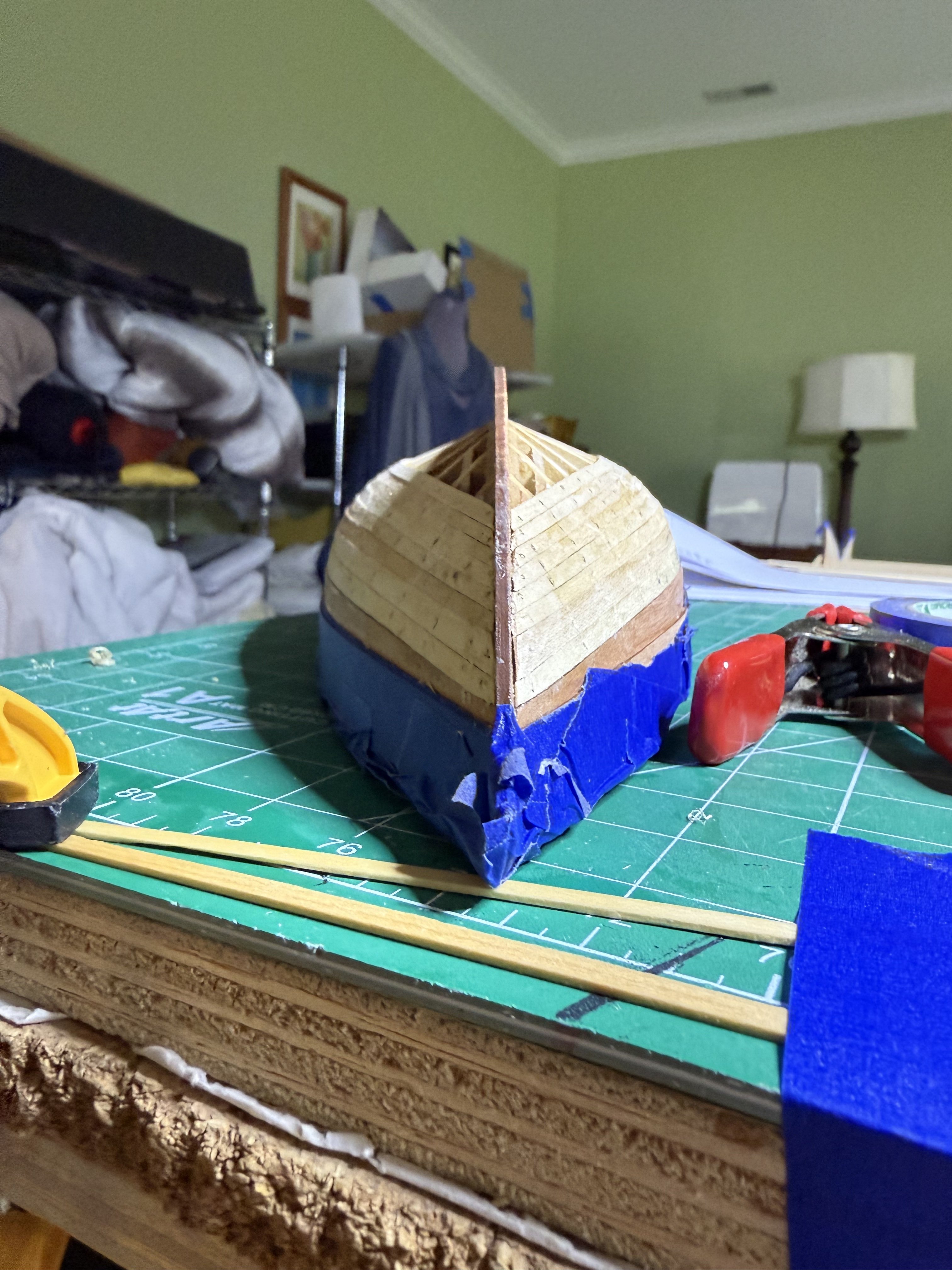

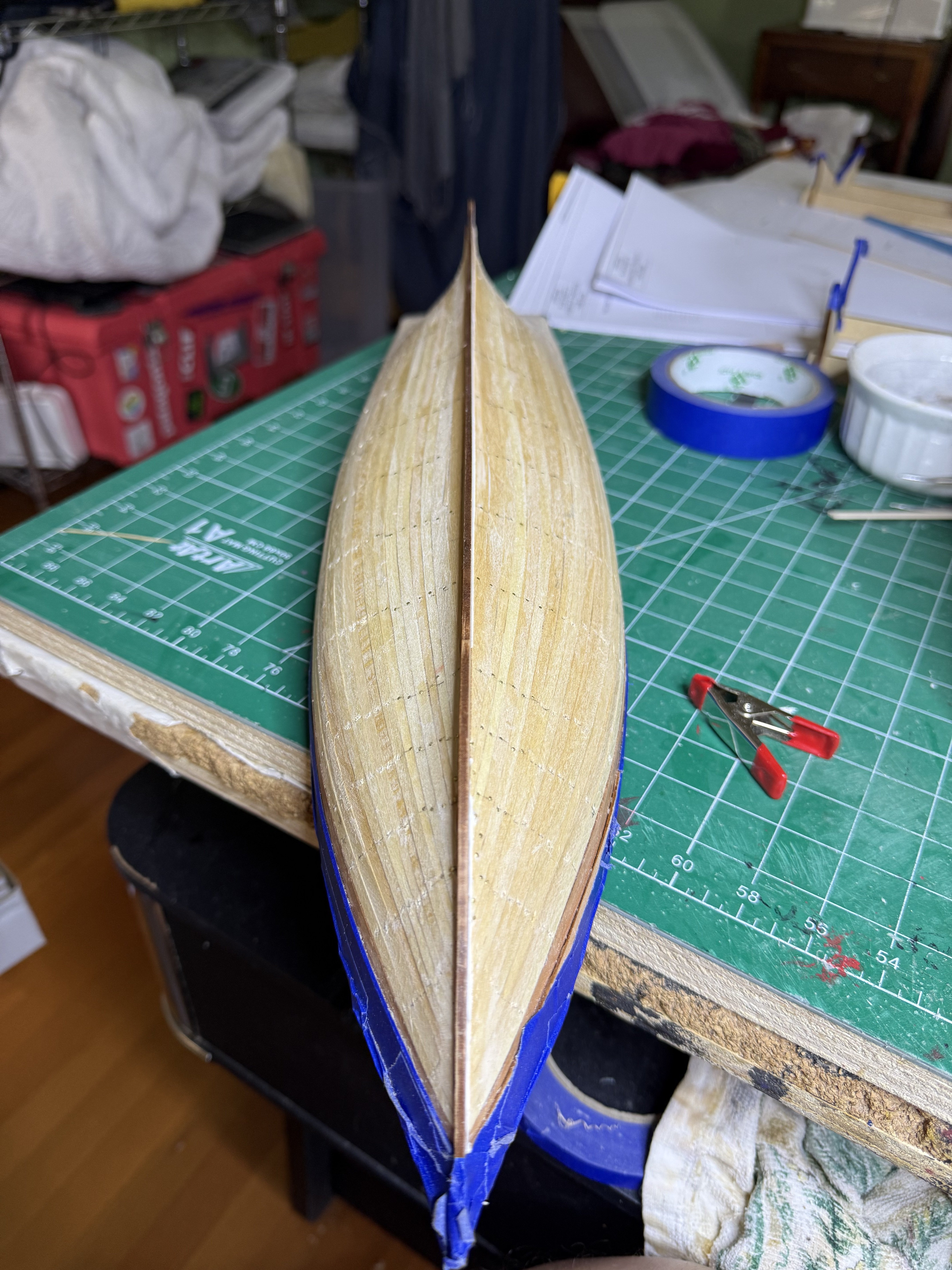

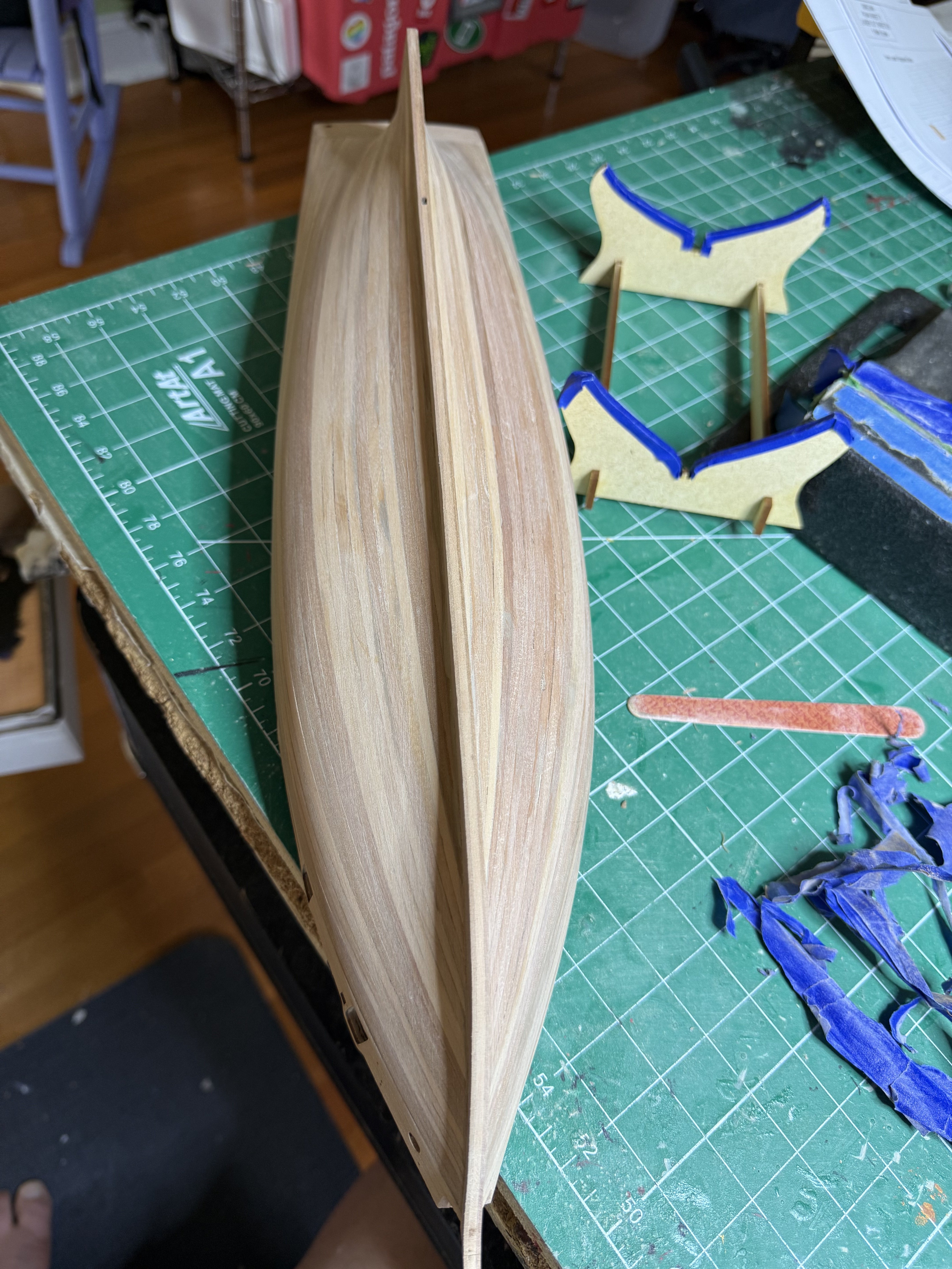

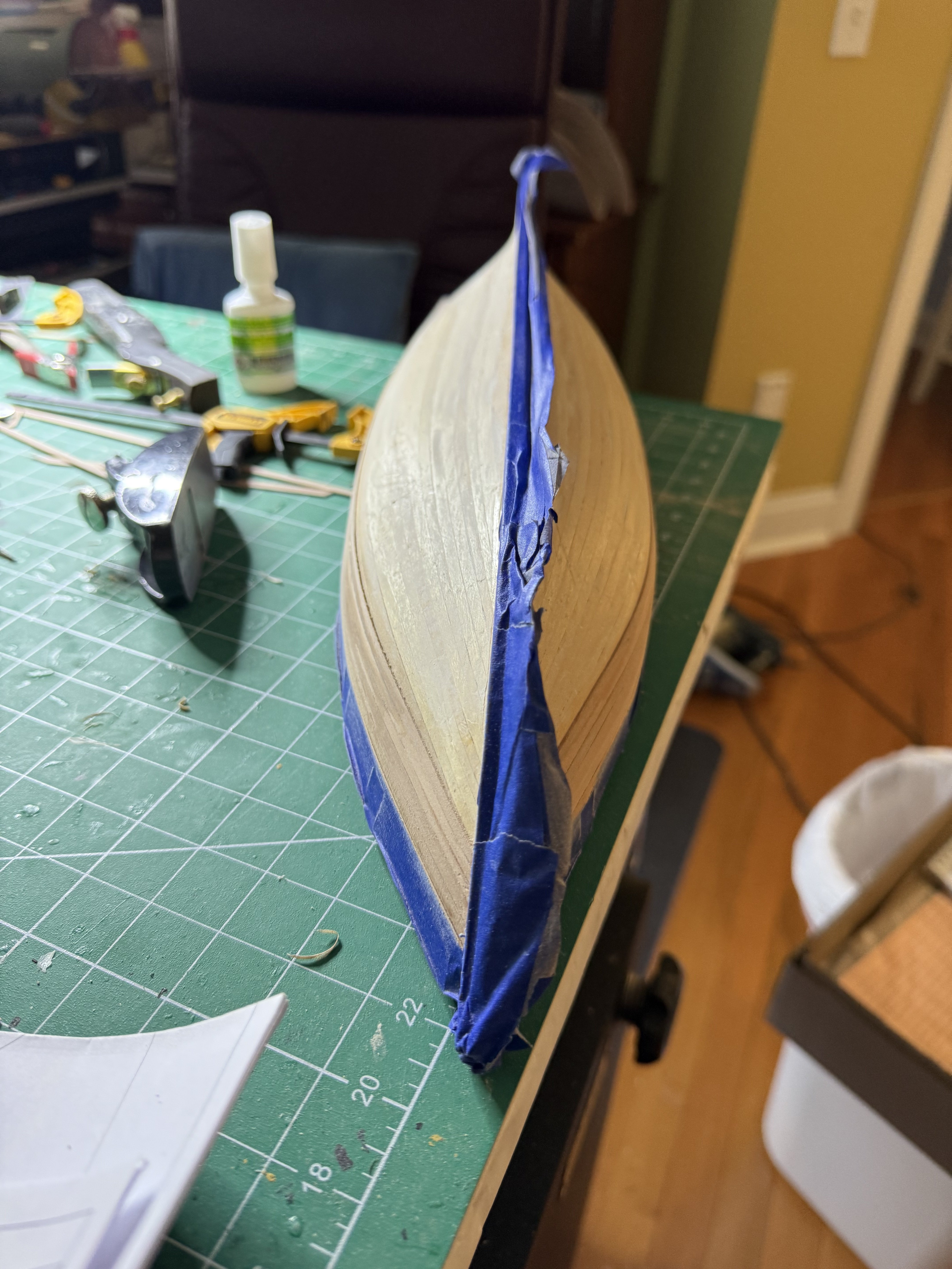

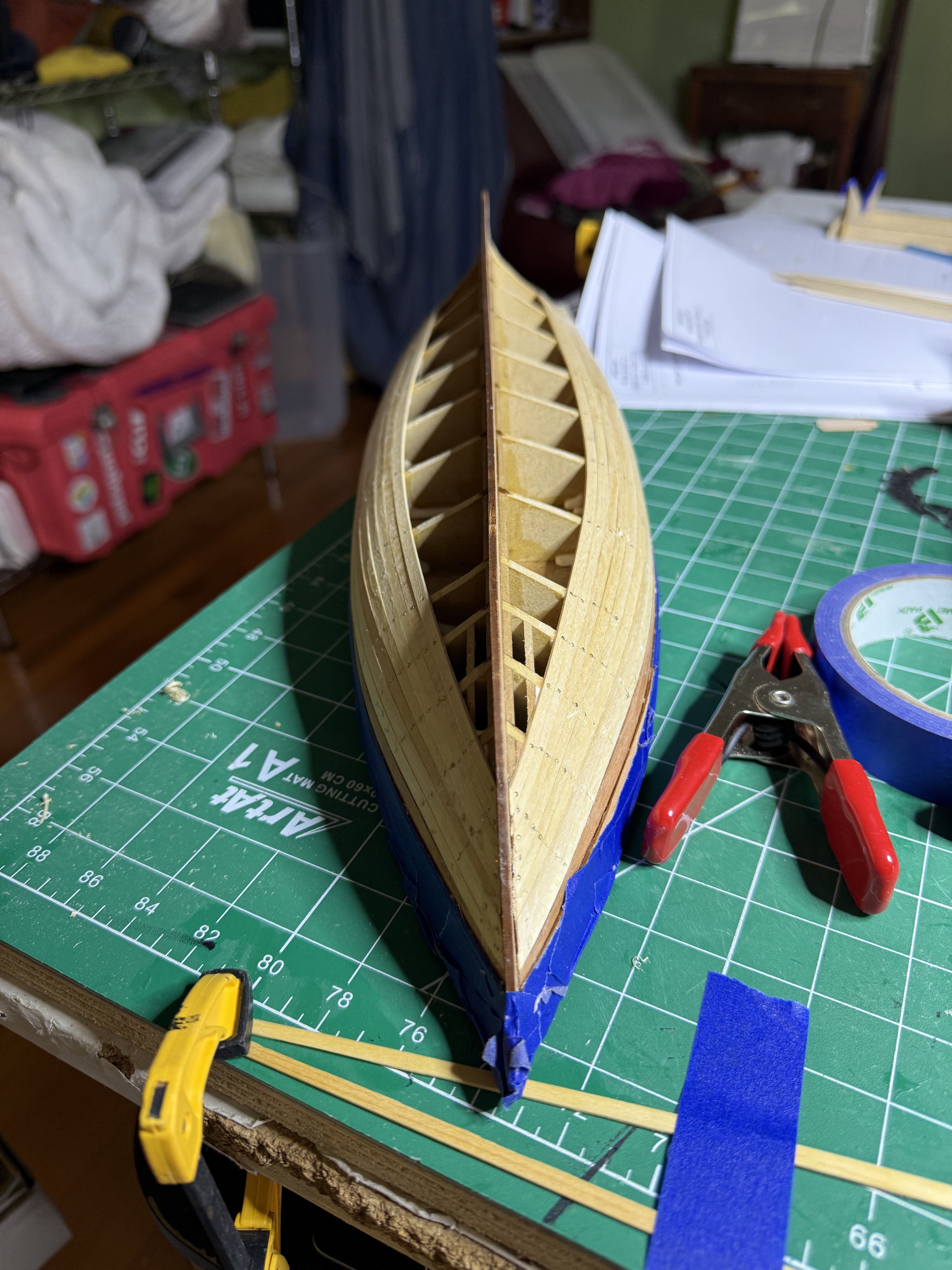

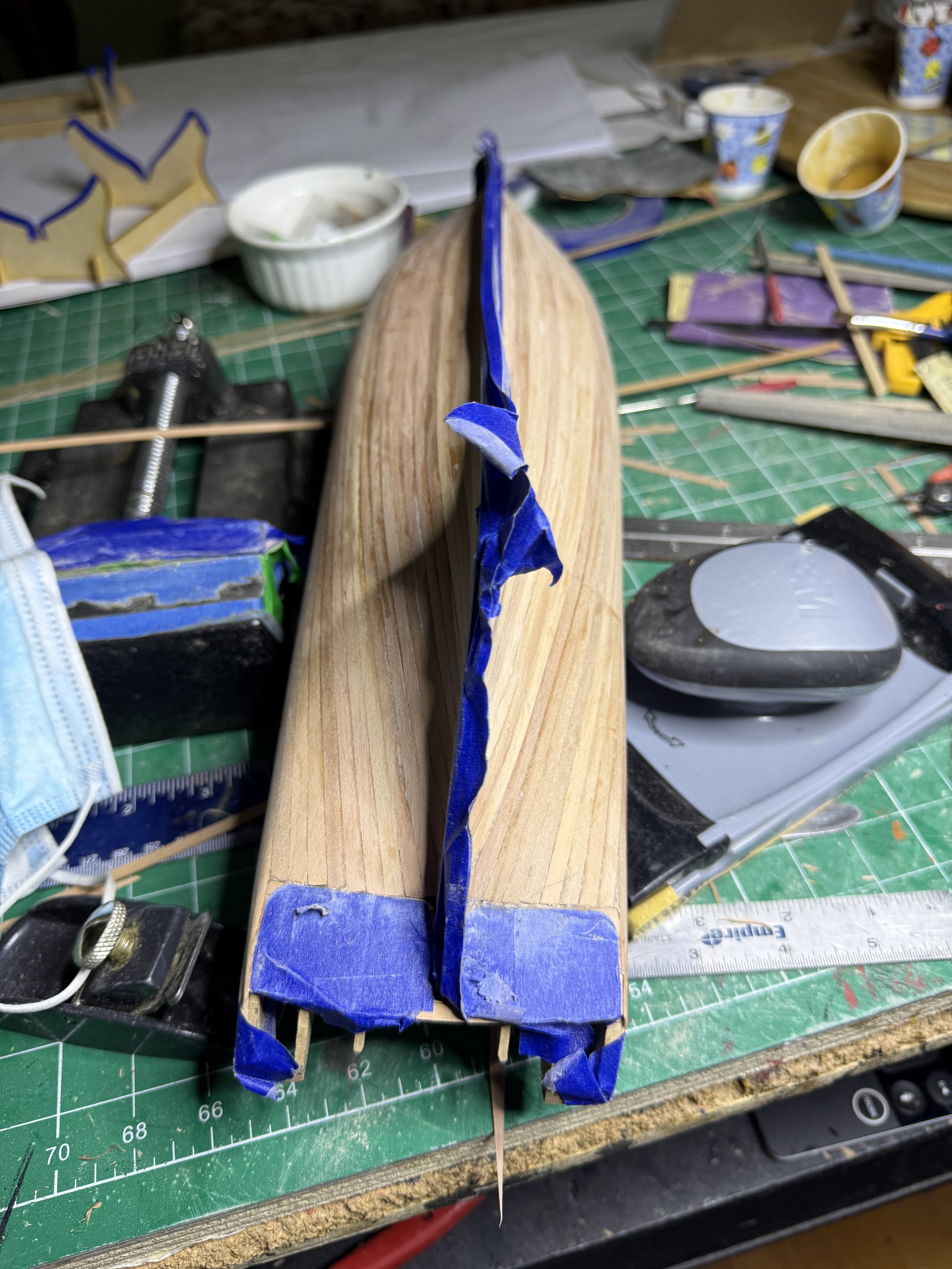

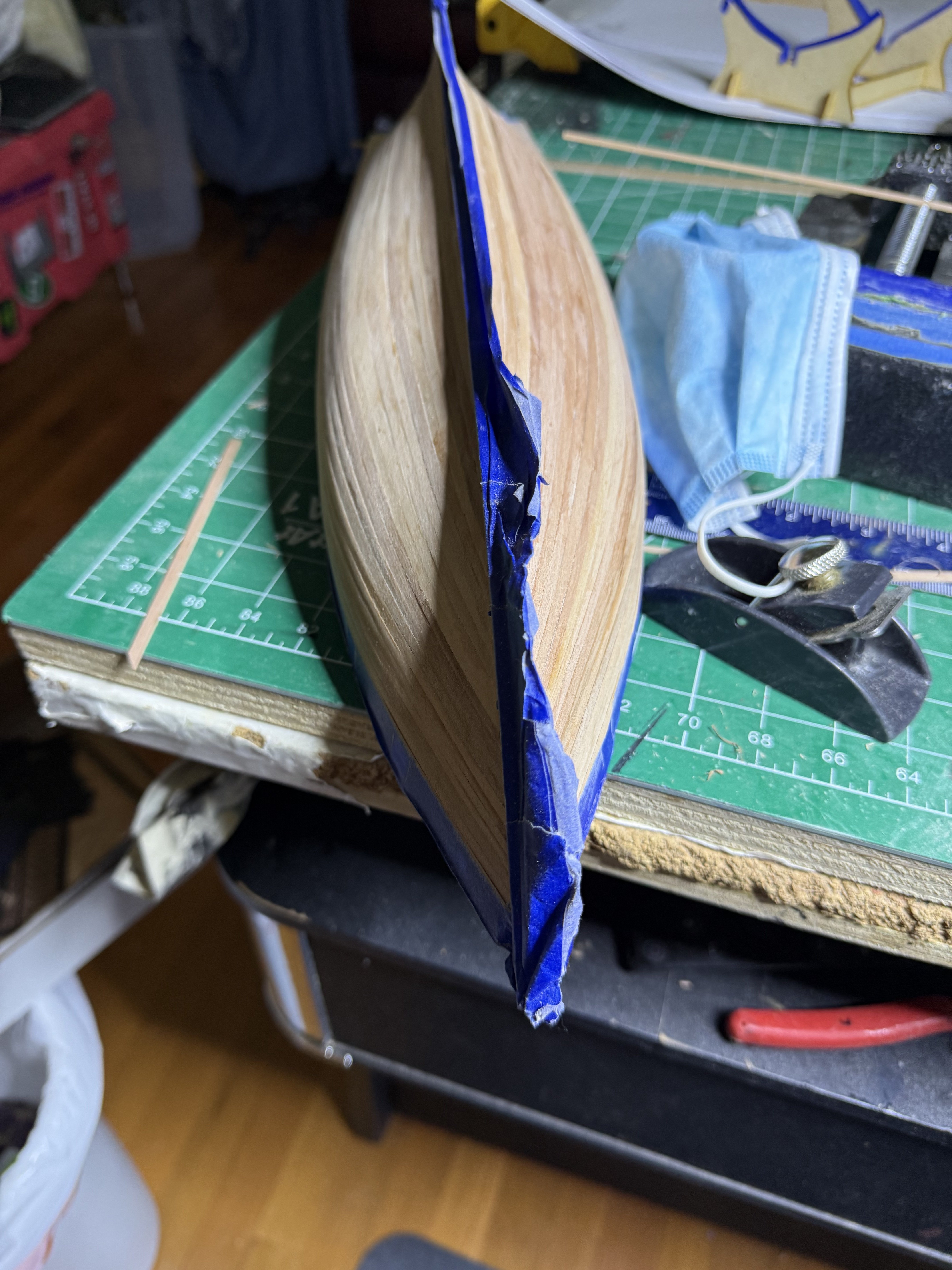

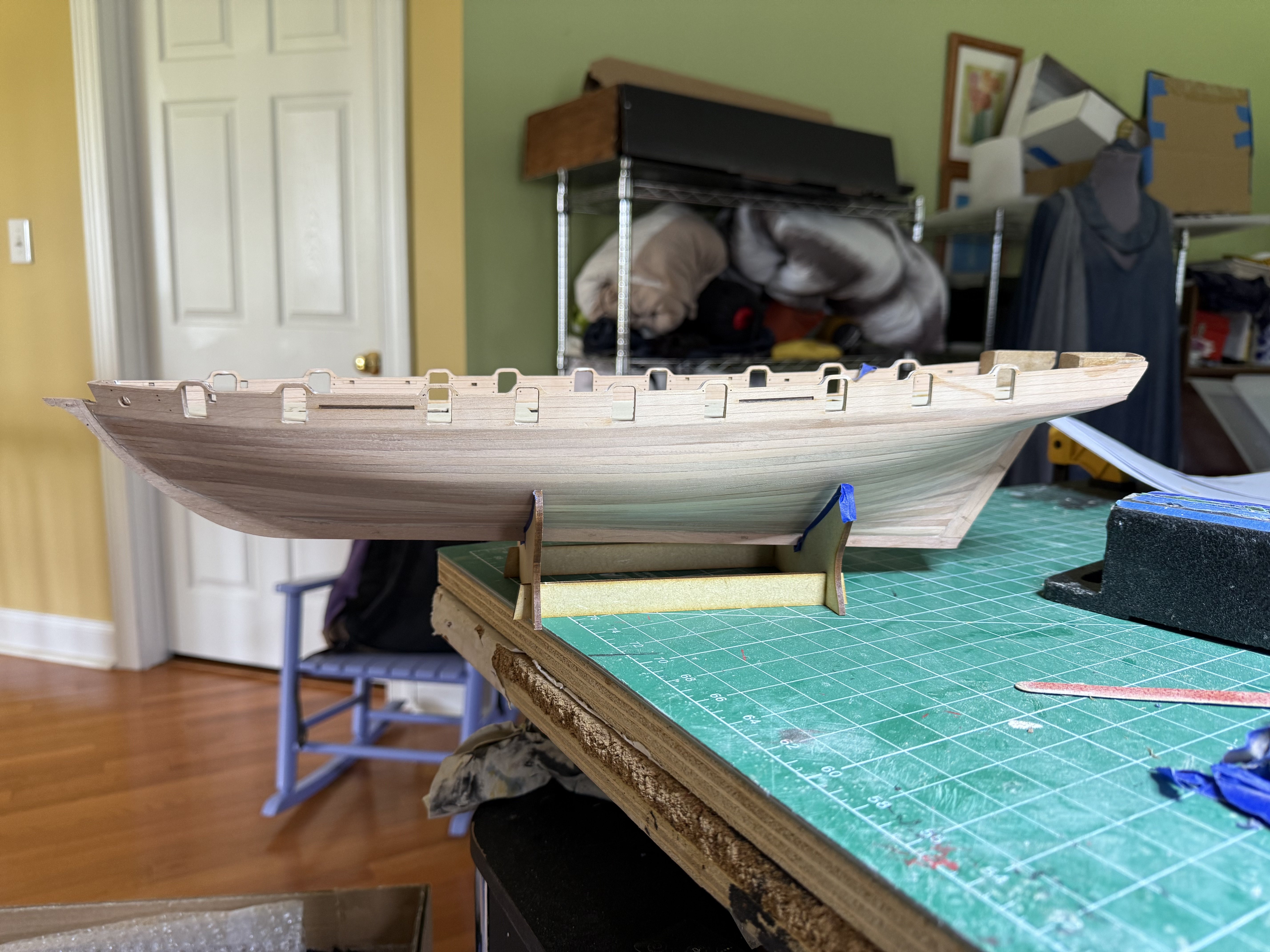

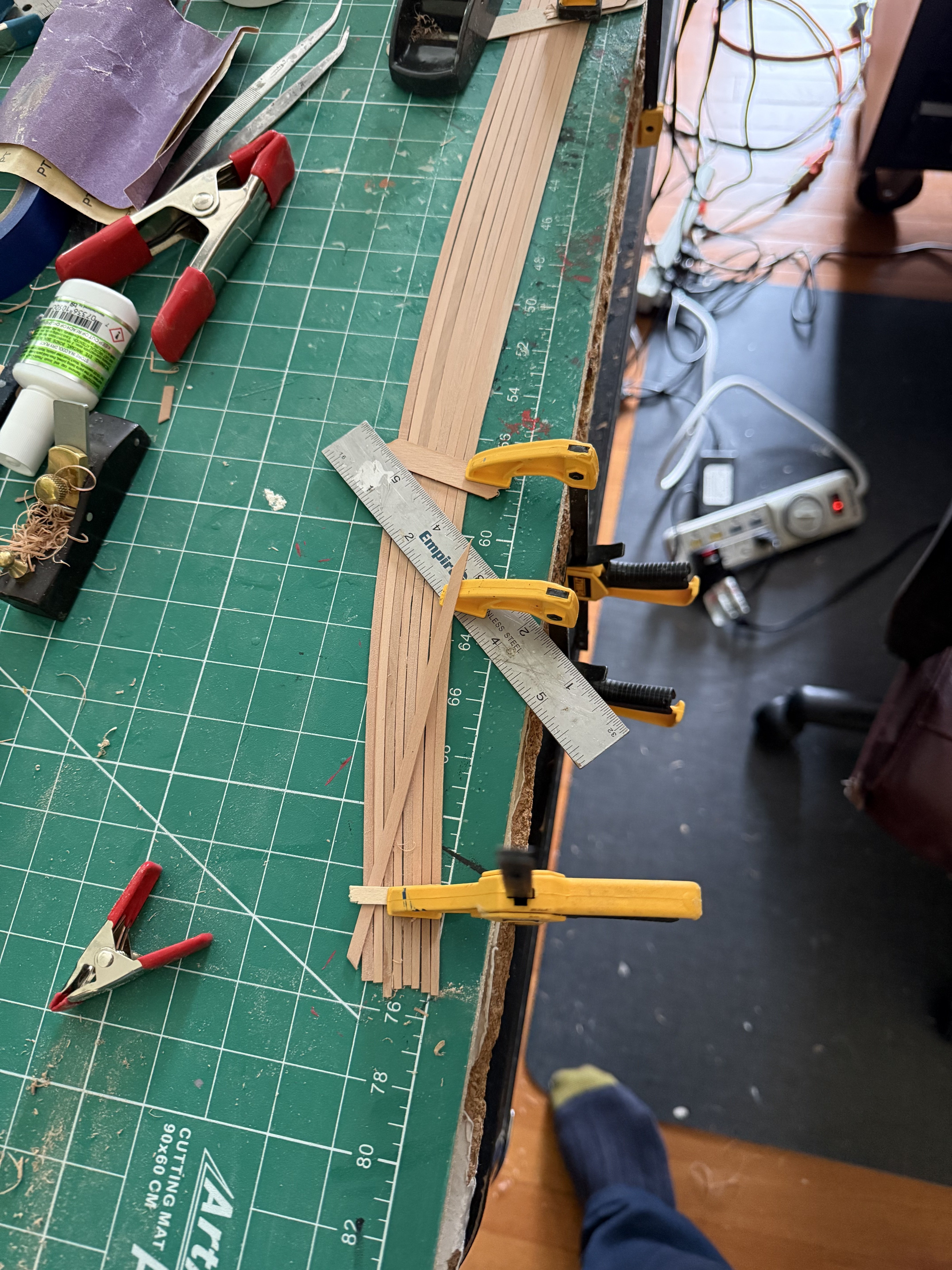

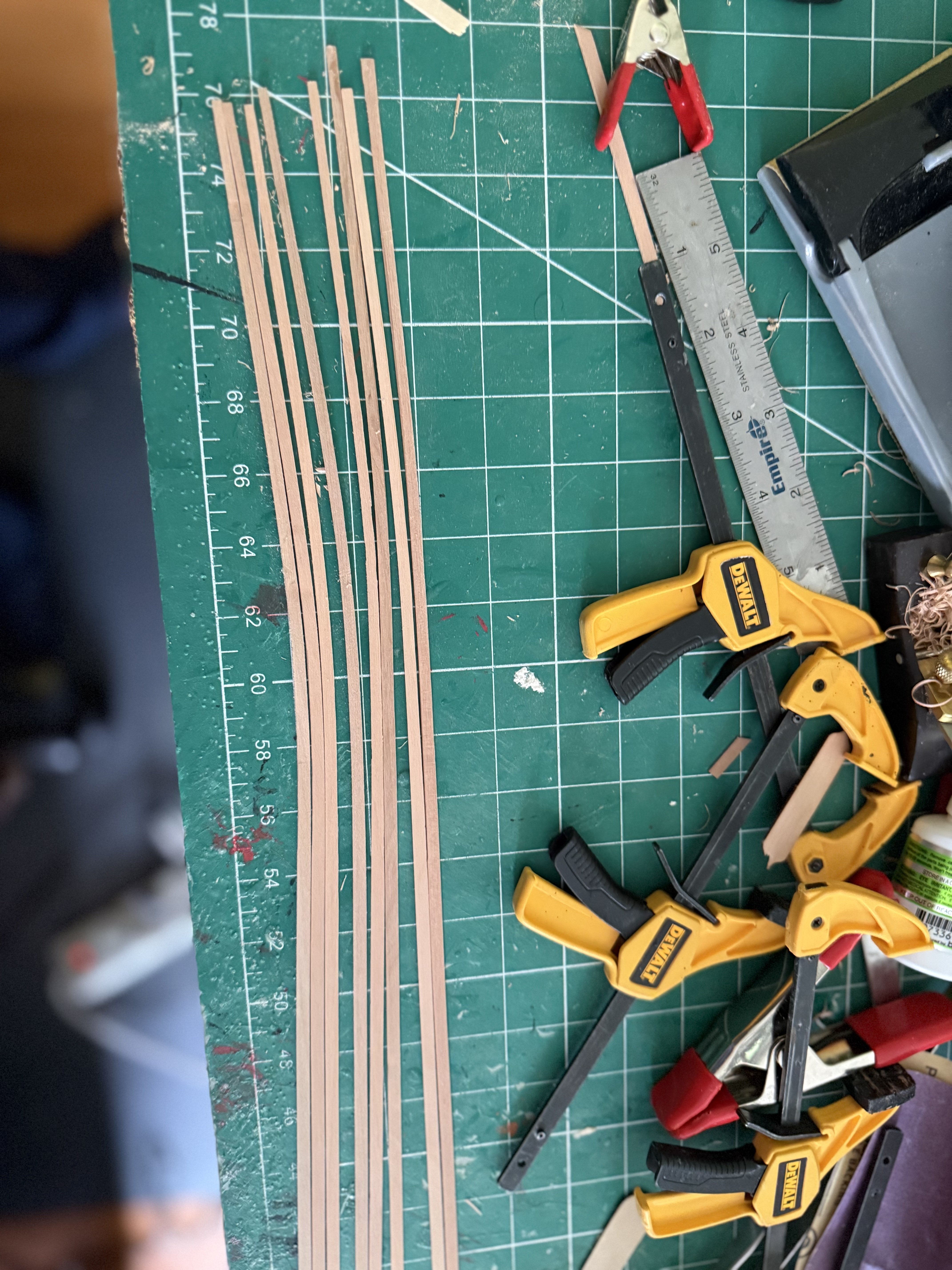

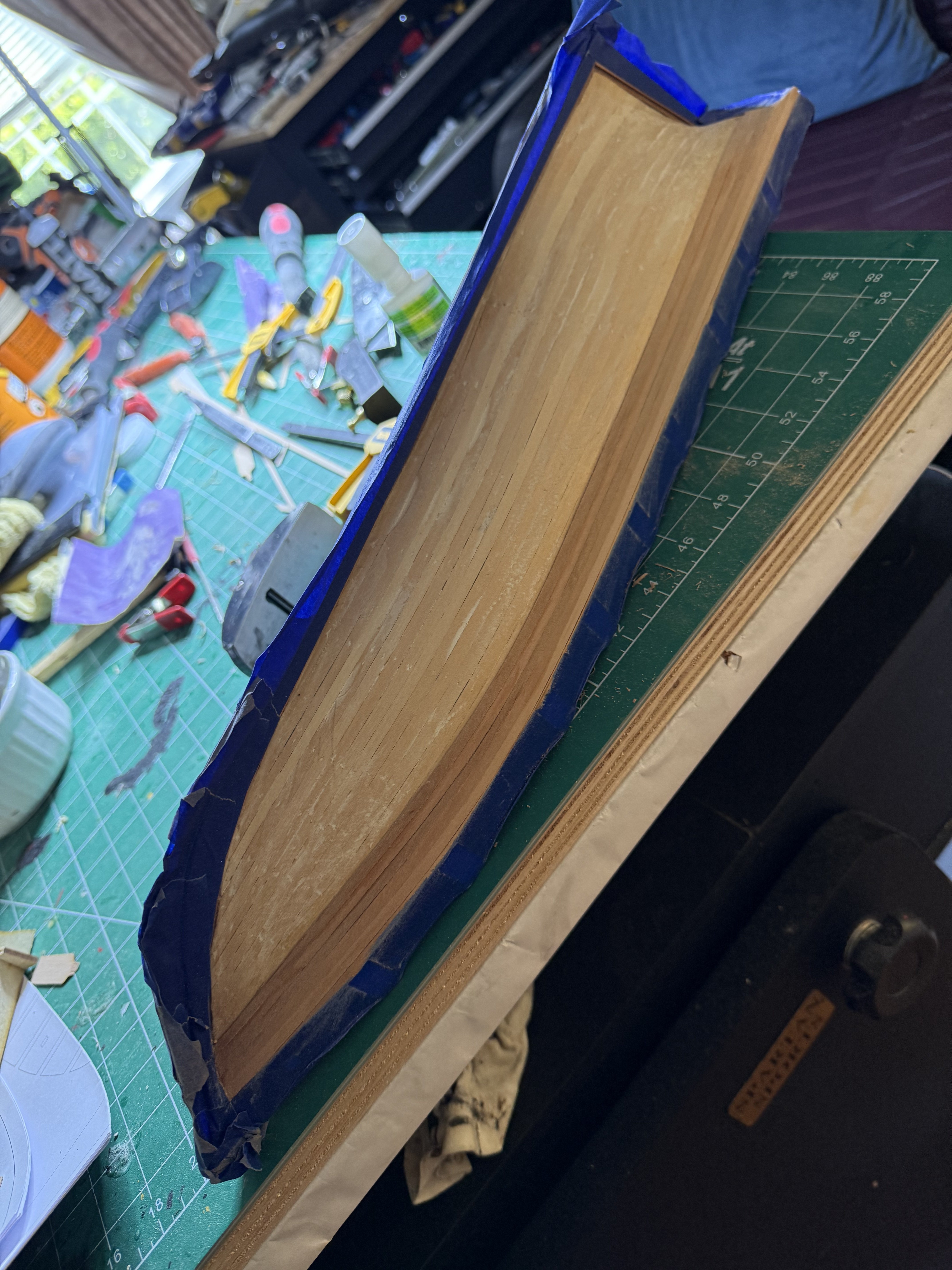

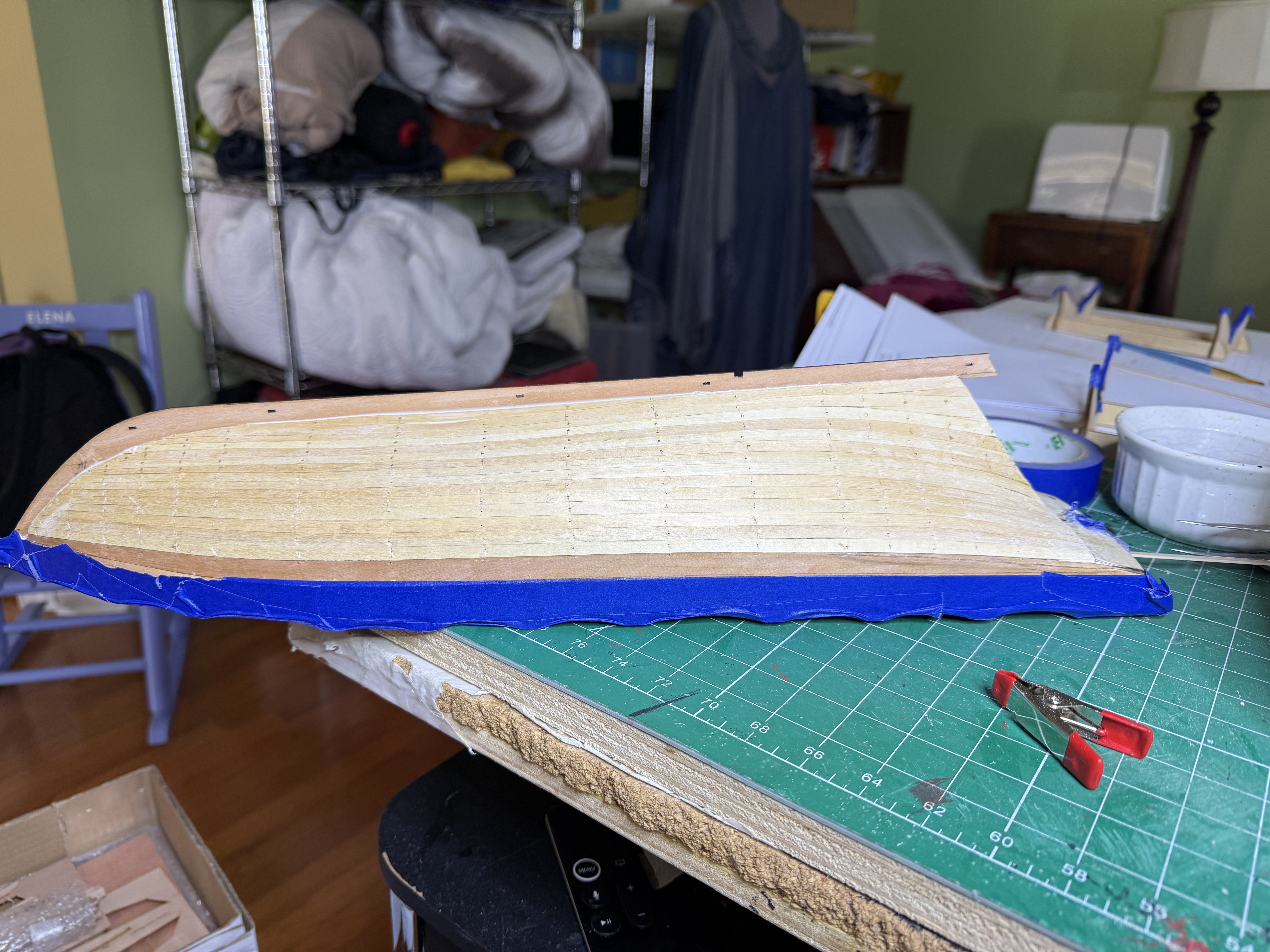

TO start the second planking I first soaked then tapered then laterally bent the planks
IMG_0172.thumb.jpg.11b53a474e67916b5d2c6457c08dc90a.jpgIMG_0173.thumb.jpg.f839d80cb03ff6807614a36bbf50572e.jpg

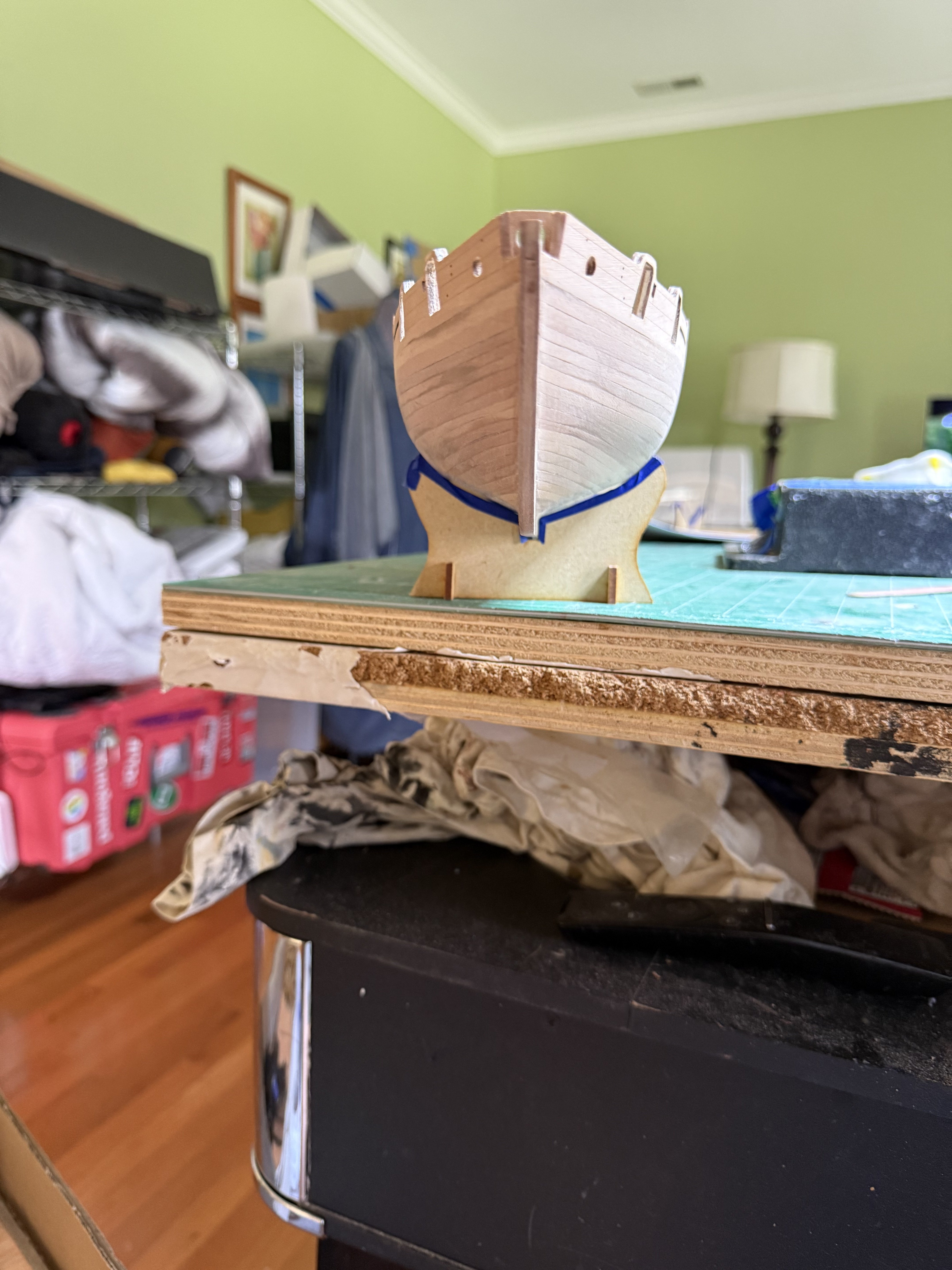

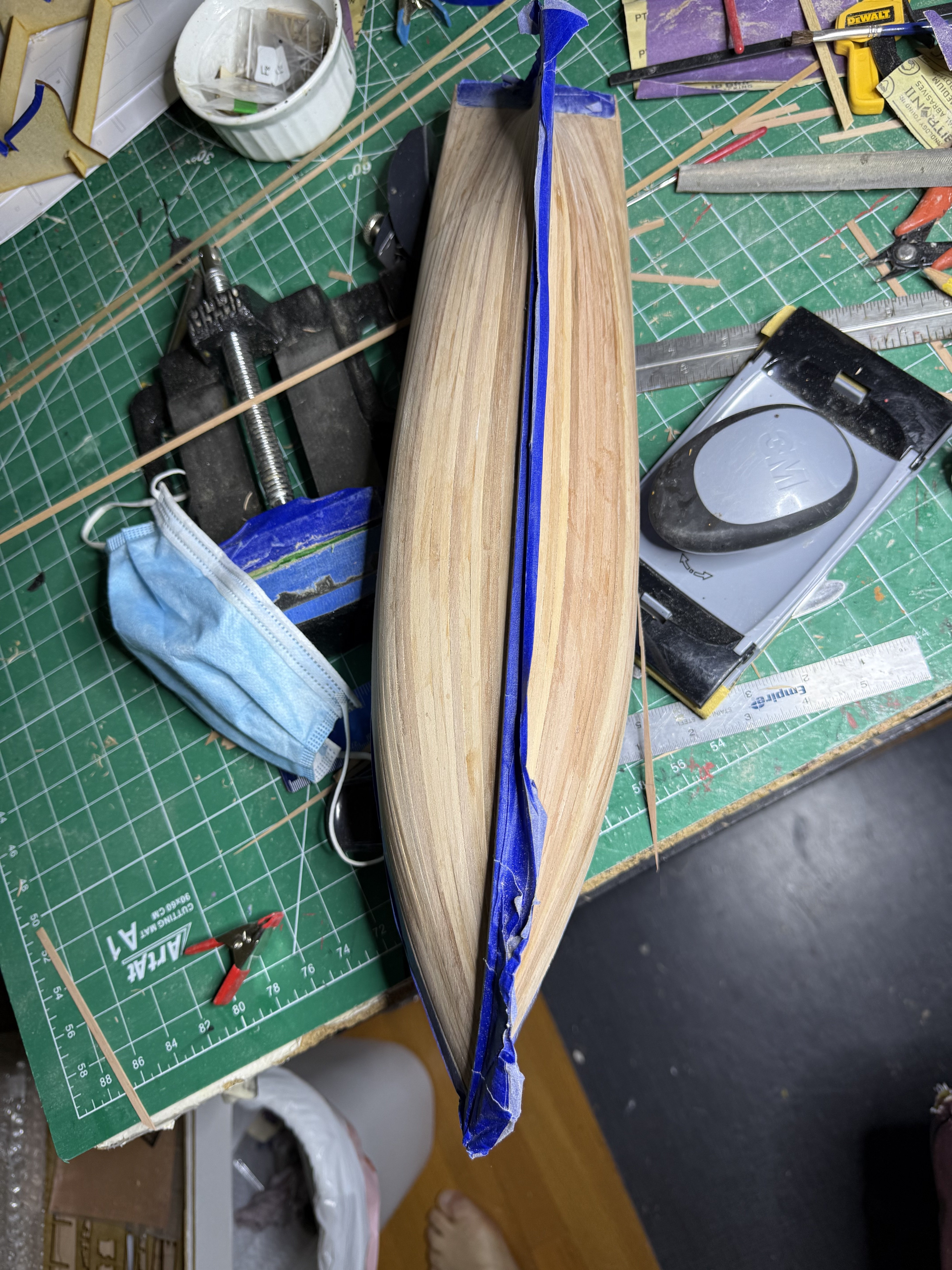

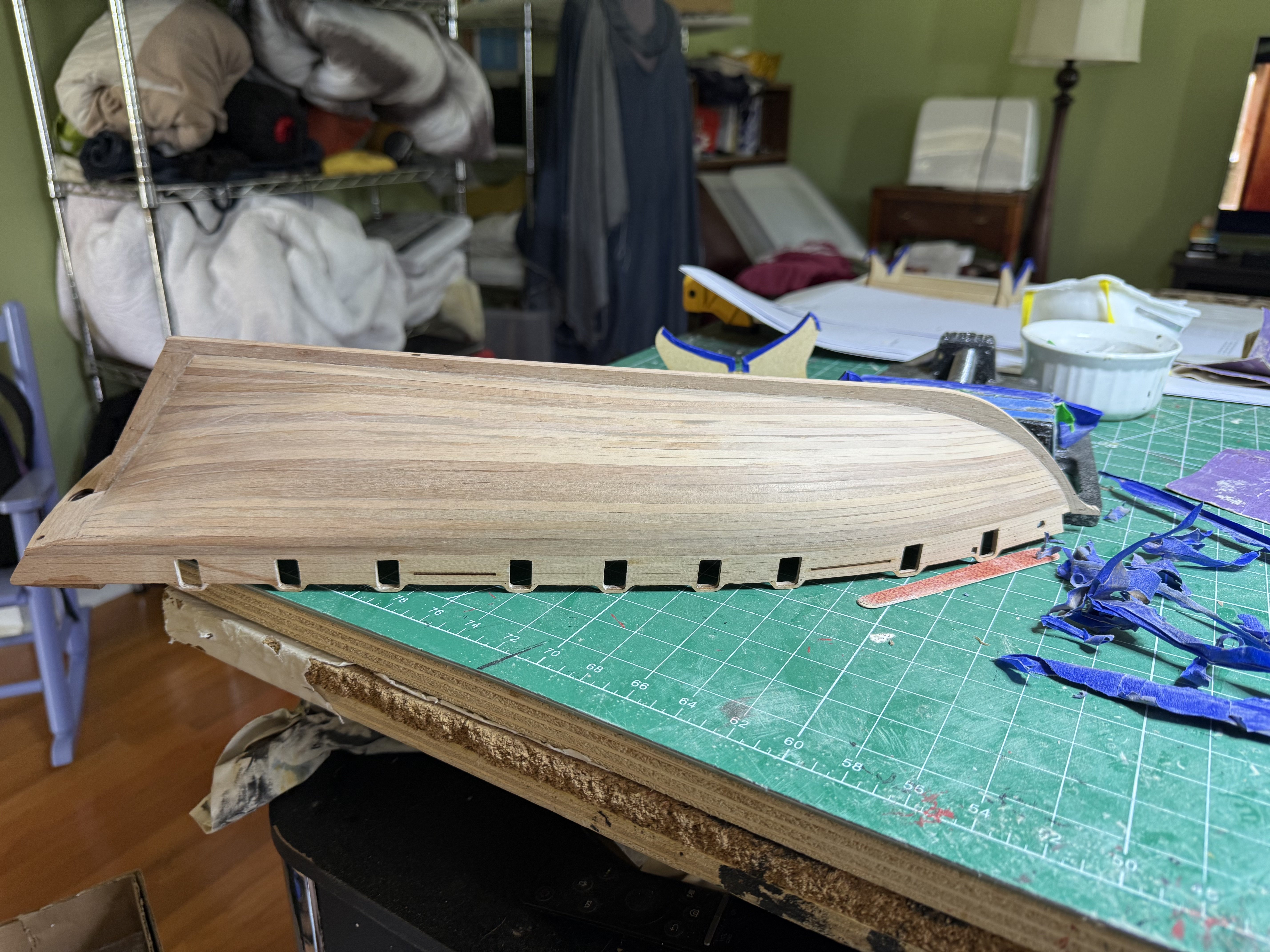

Now 5 rows into it, I do sand some after each row. I have taped up the veneers and gunports to prevent damage
IMG_0174.thumb.jpg.8edb999b482aed25faae7b145ef71738.jpgIMG_0175.thumb.jpg.4f703f926c173df7cffebfc6736479fe.jpgIMG_0176.thumb.jpg.717511f26cc74425c1535573e0c2e6ae.jpg
So far easier as the curve of the prow is minimal compared to the square rigged ships and so less twisting of the planks

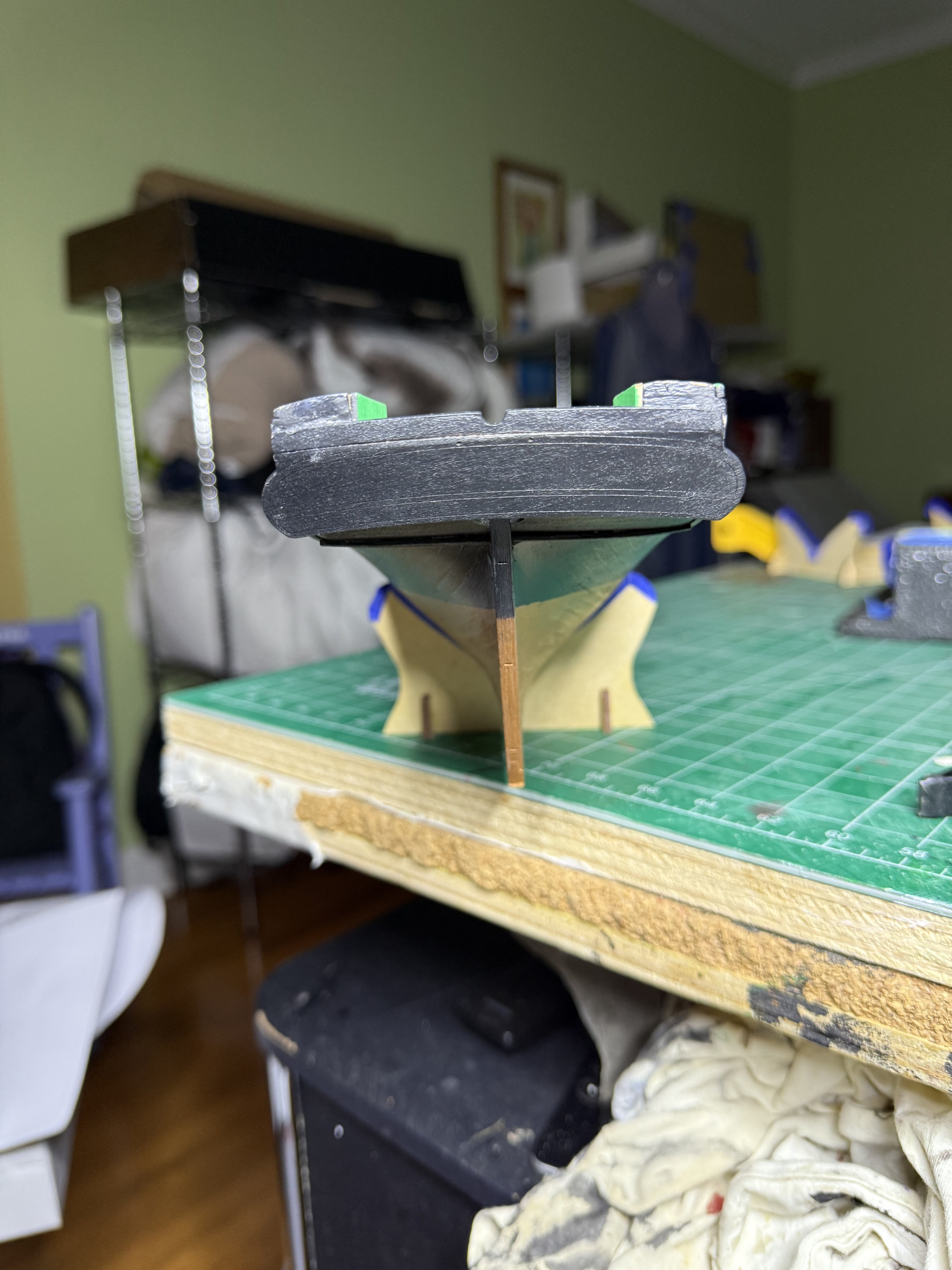

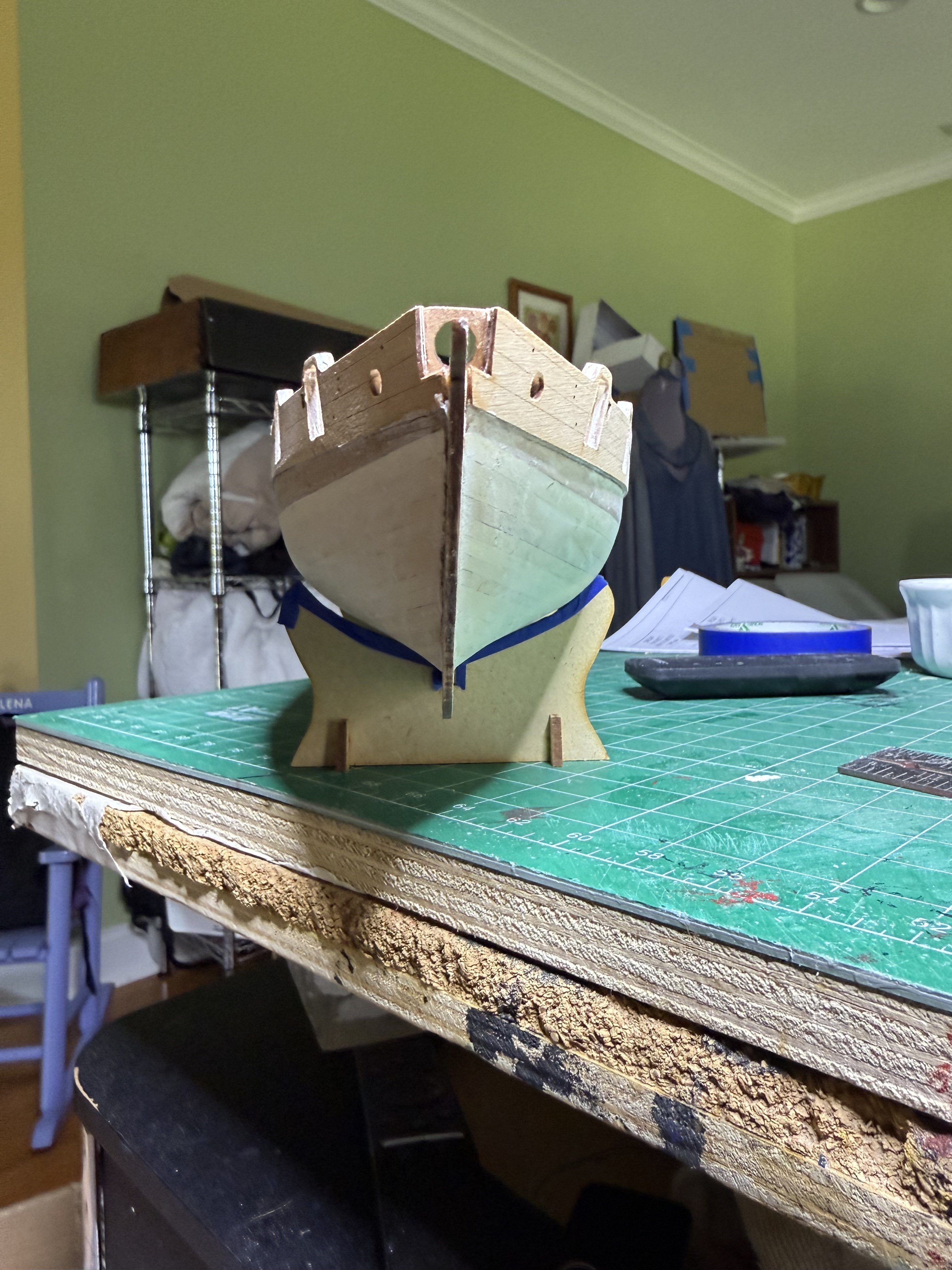

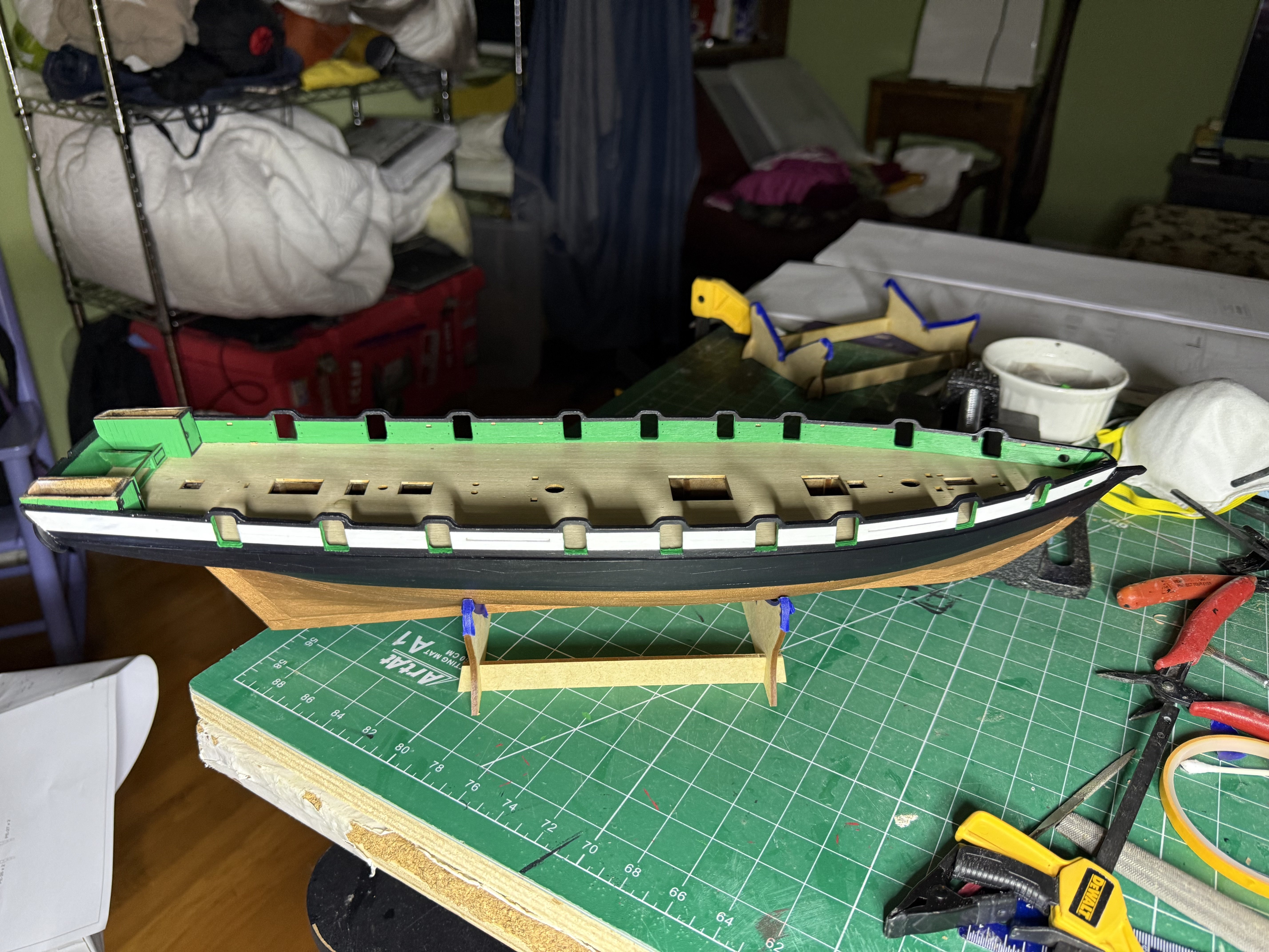

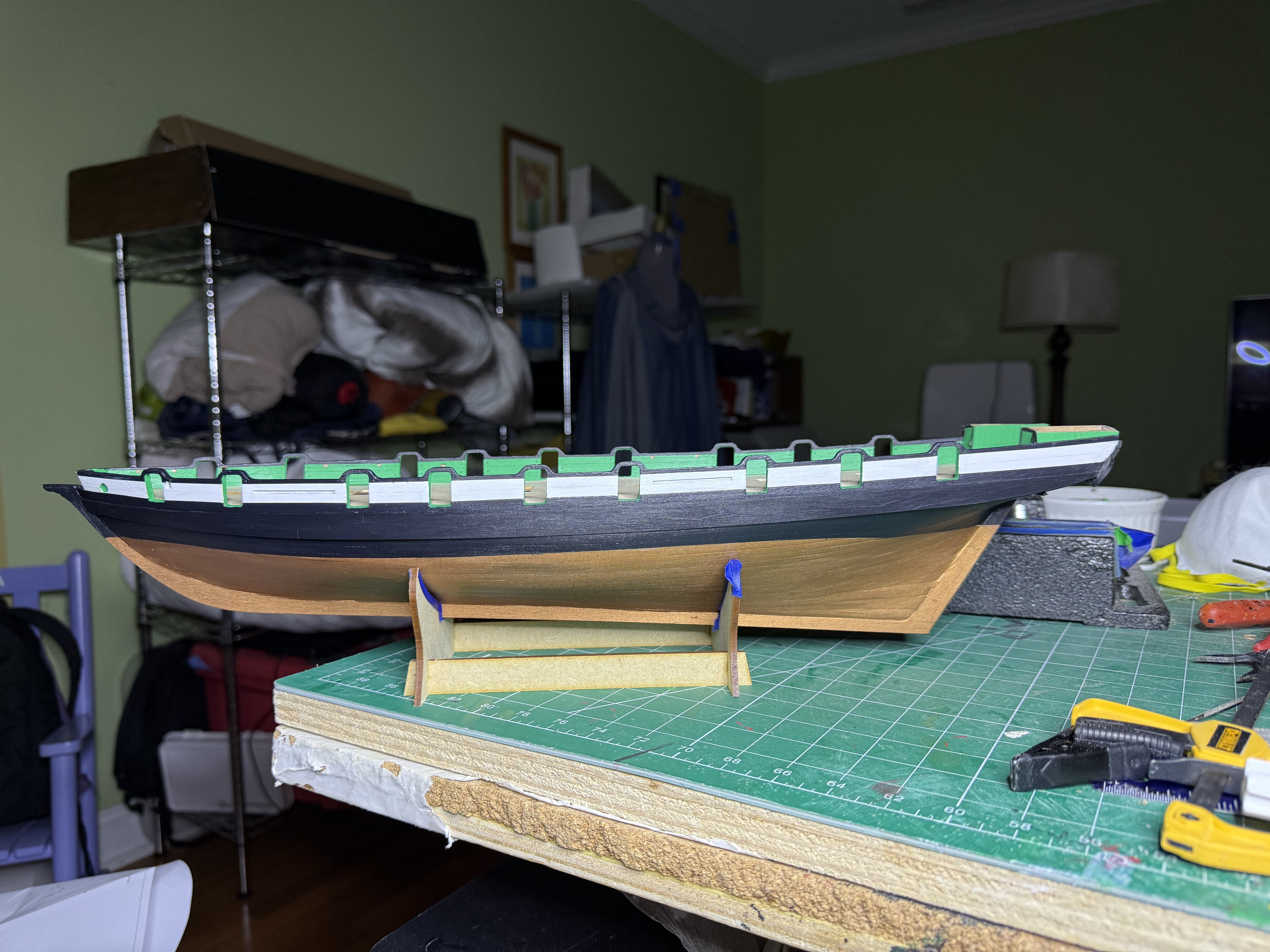

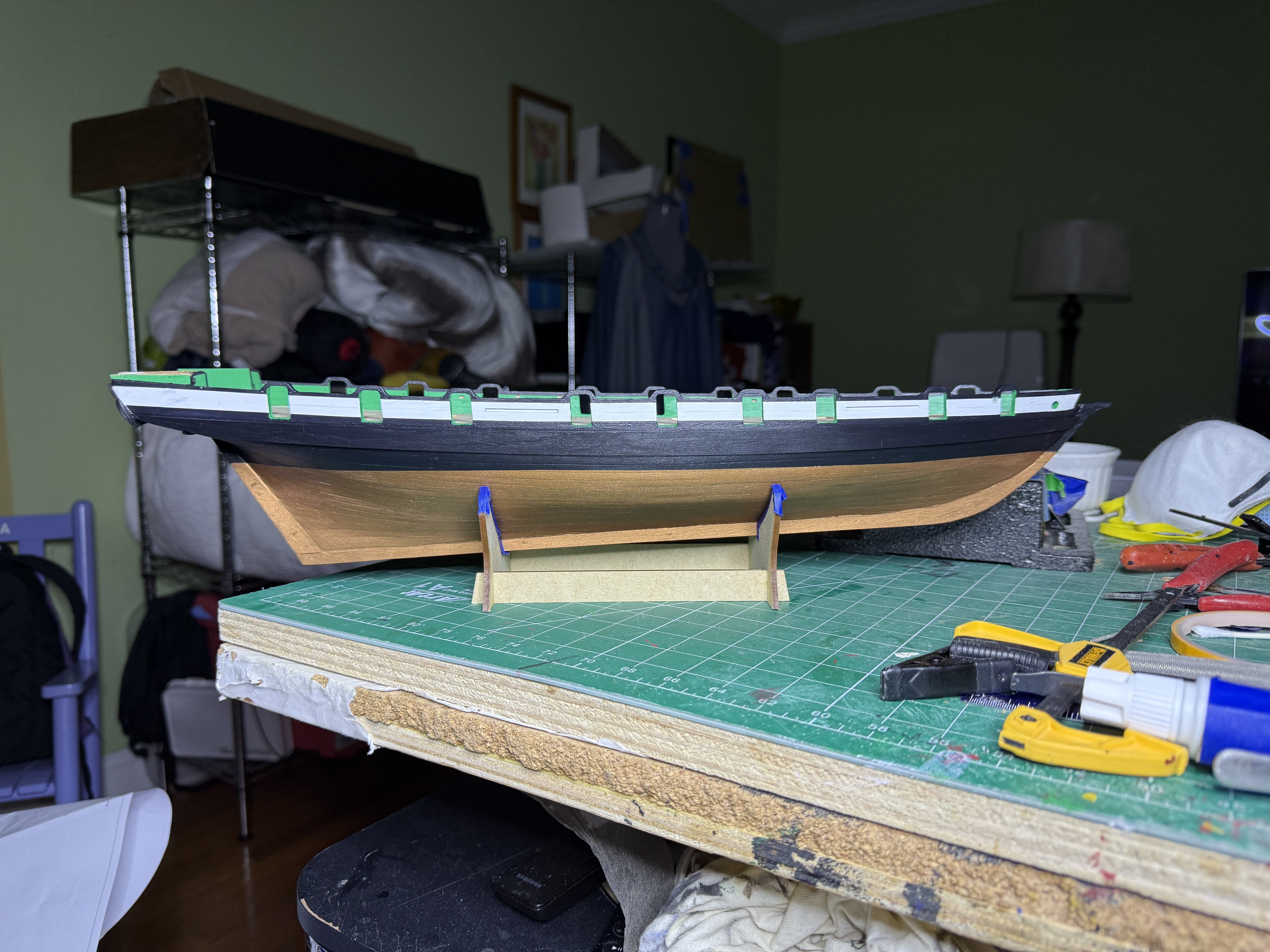

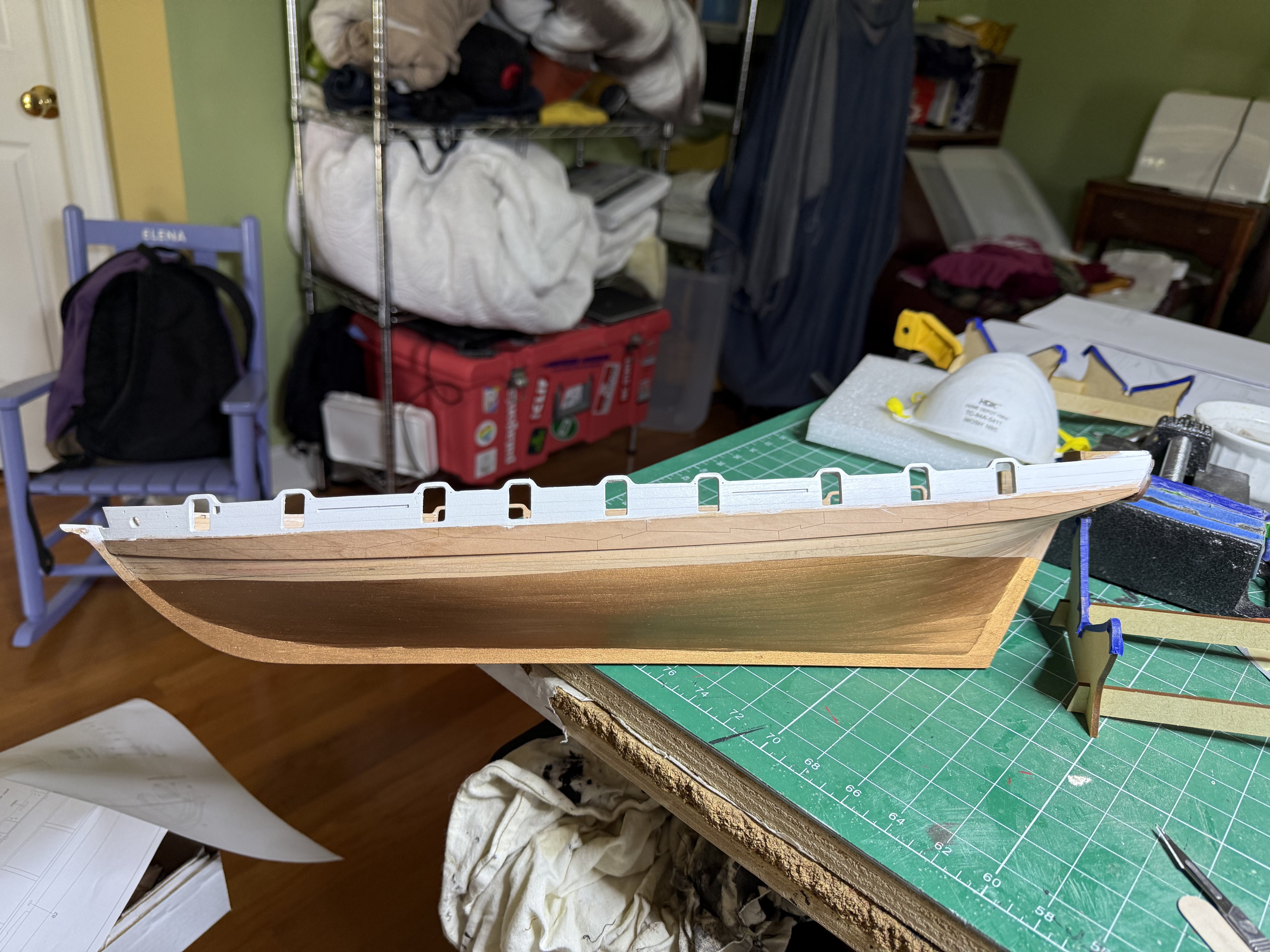

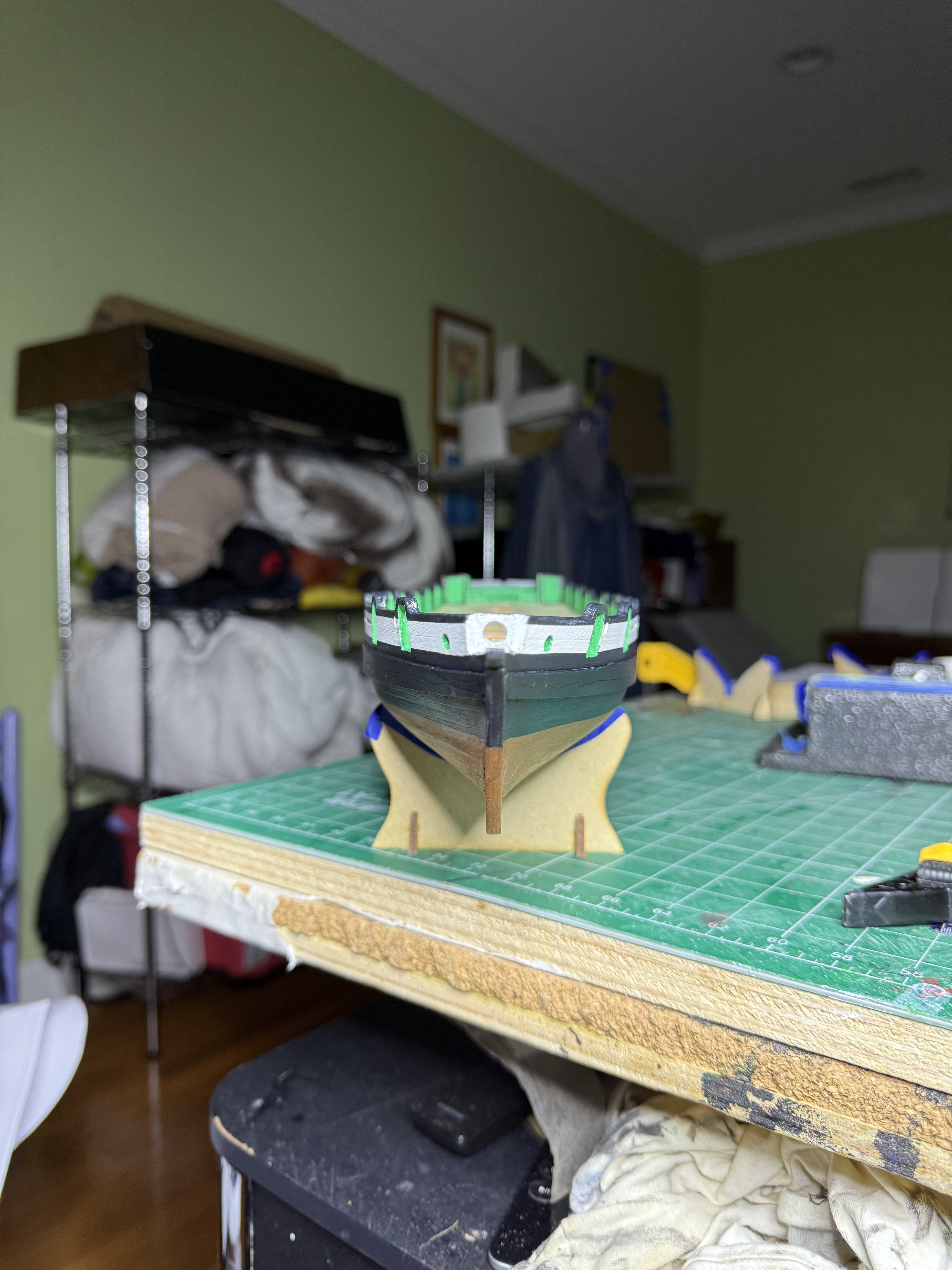

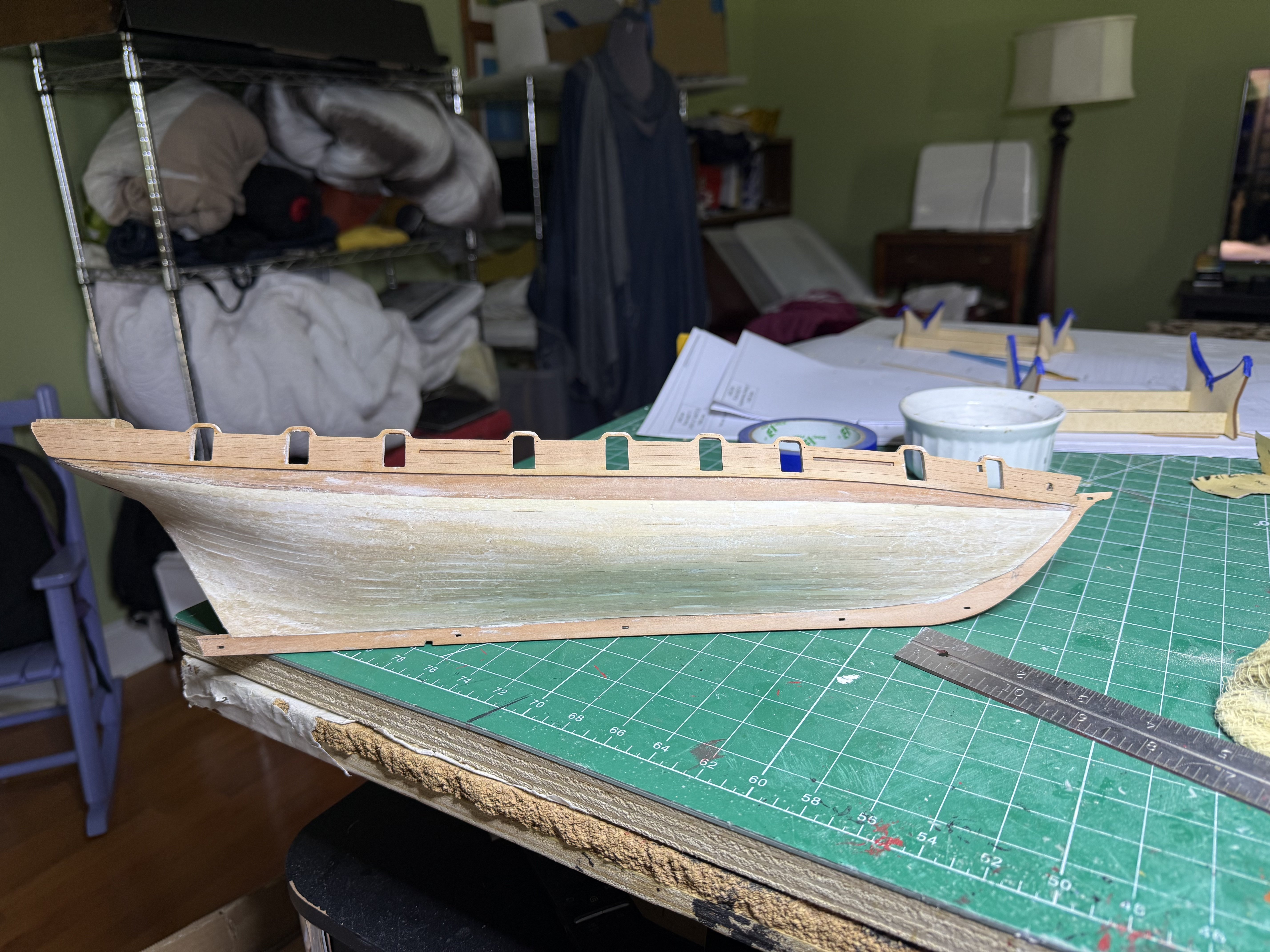

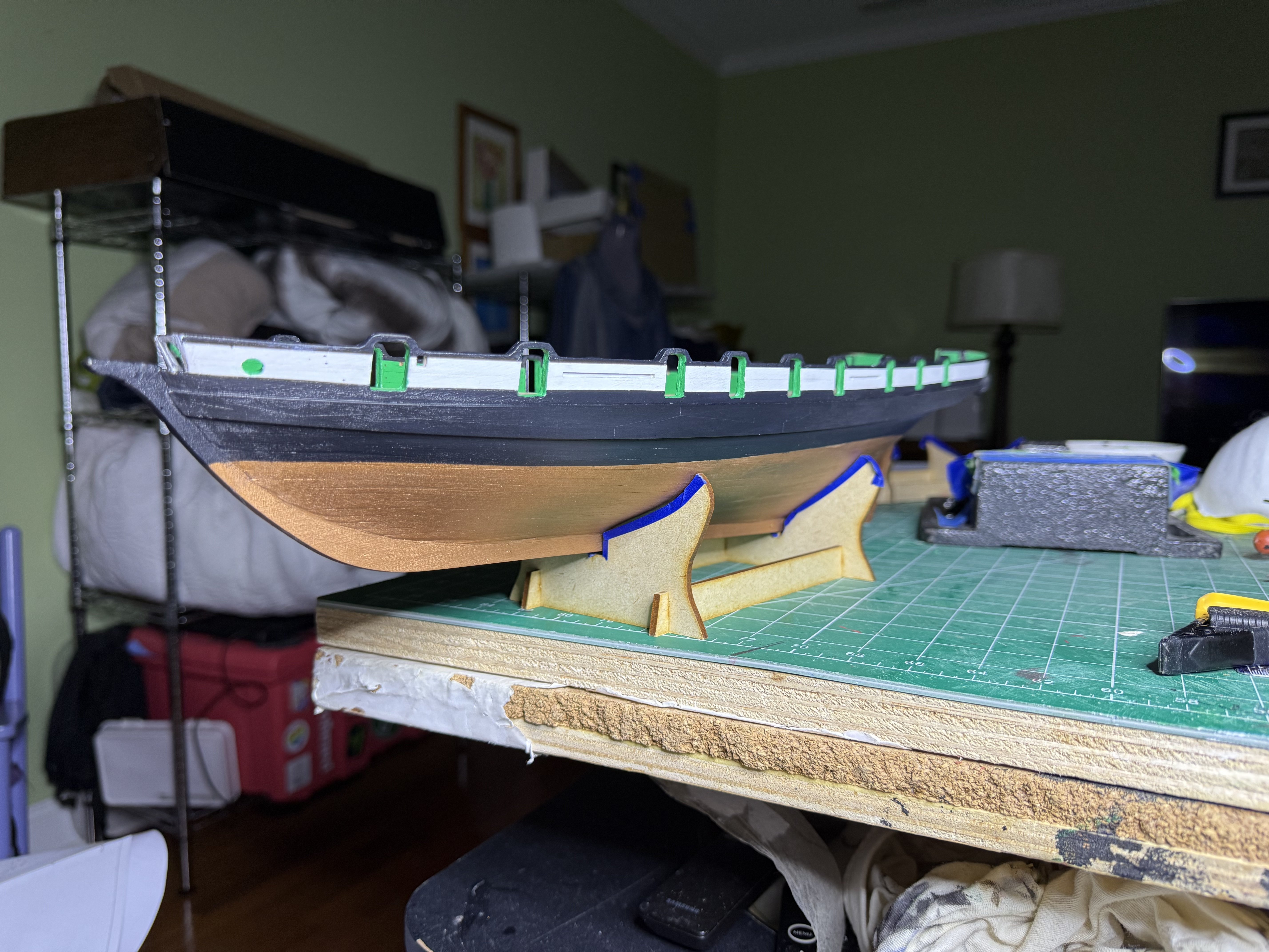

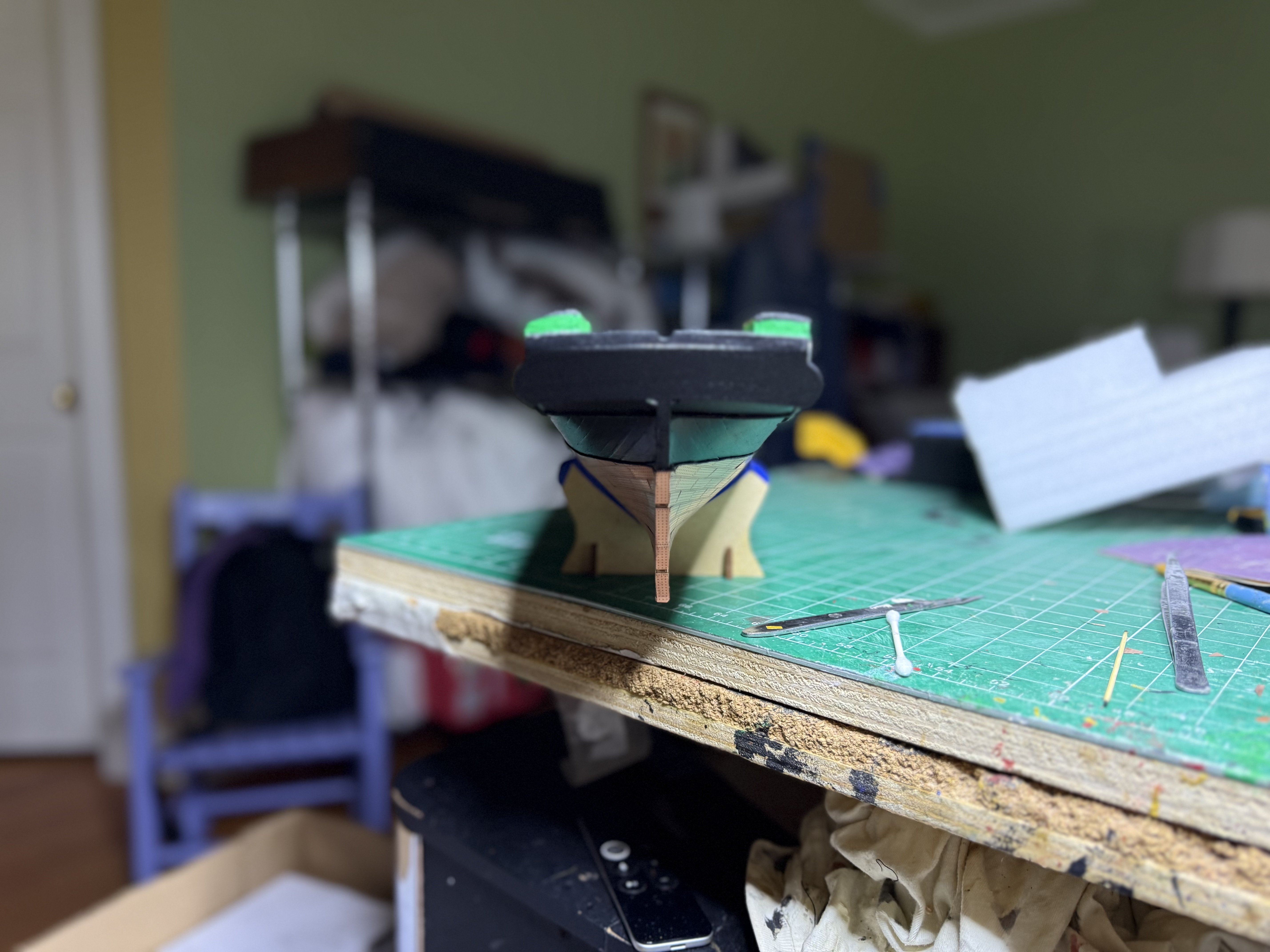

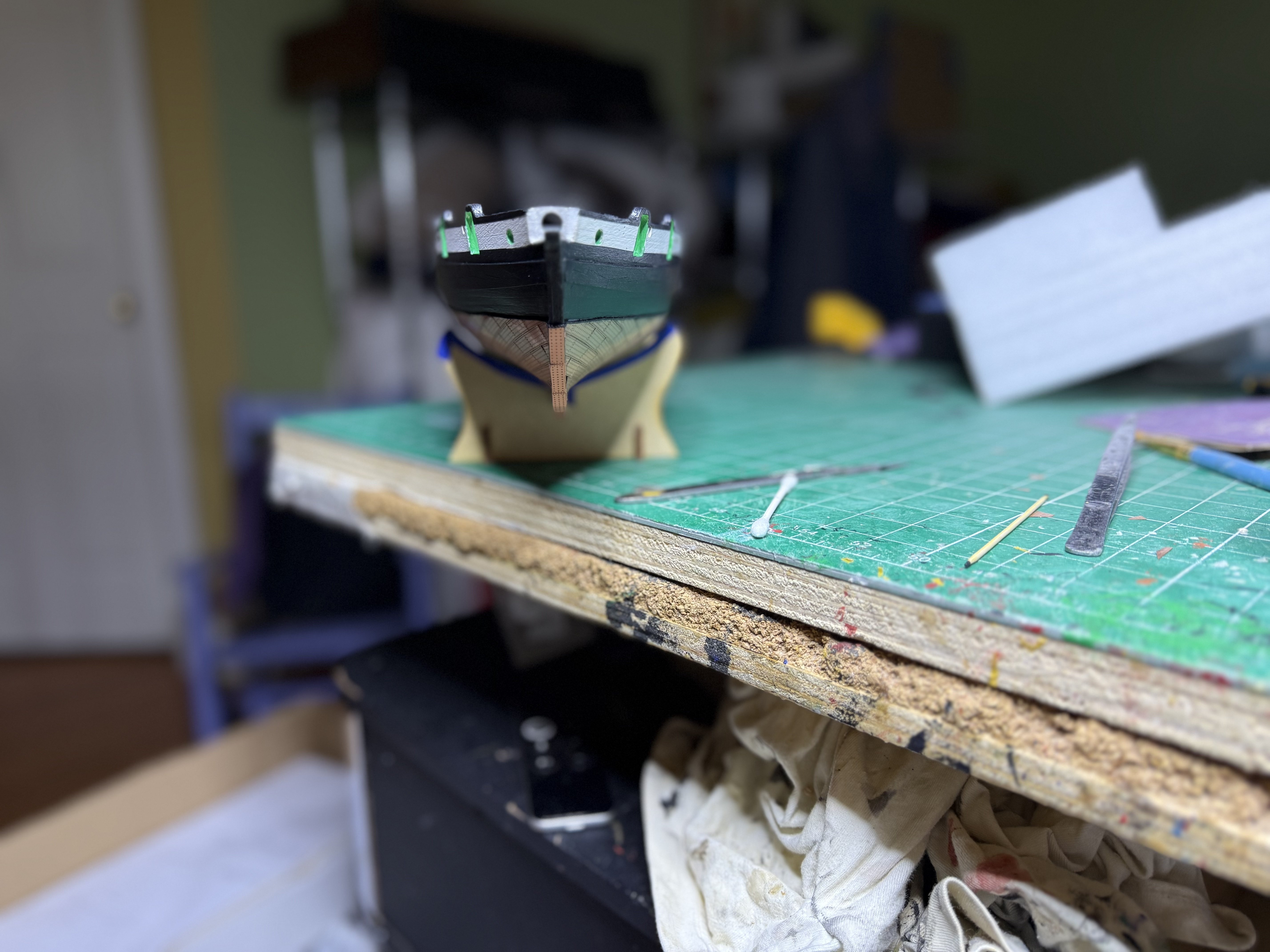

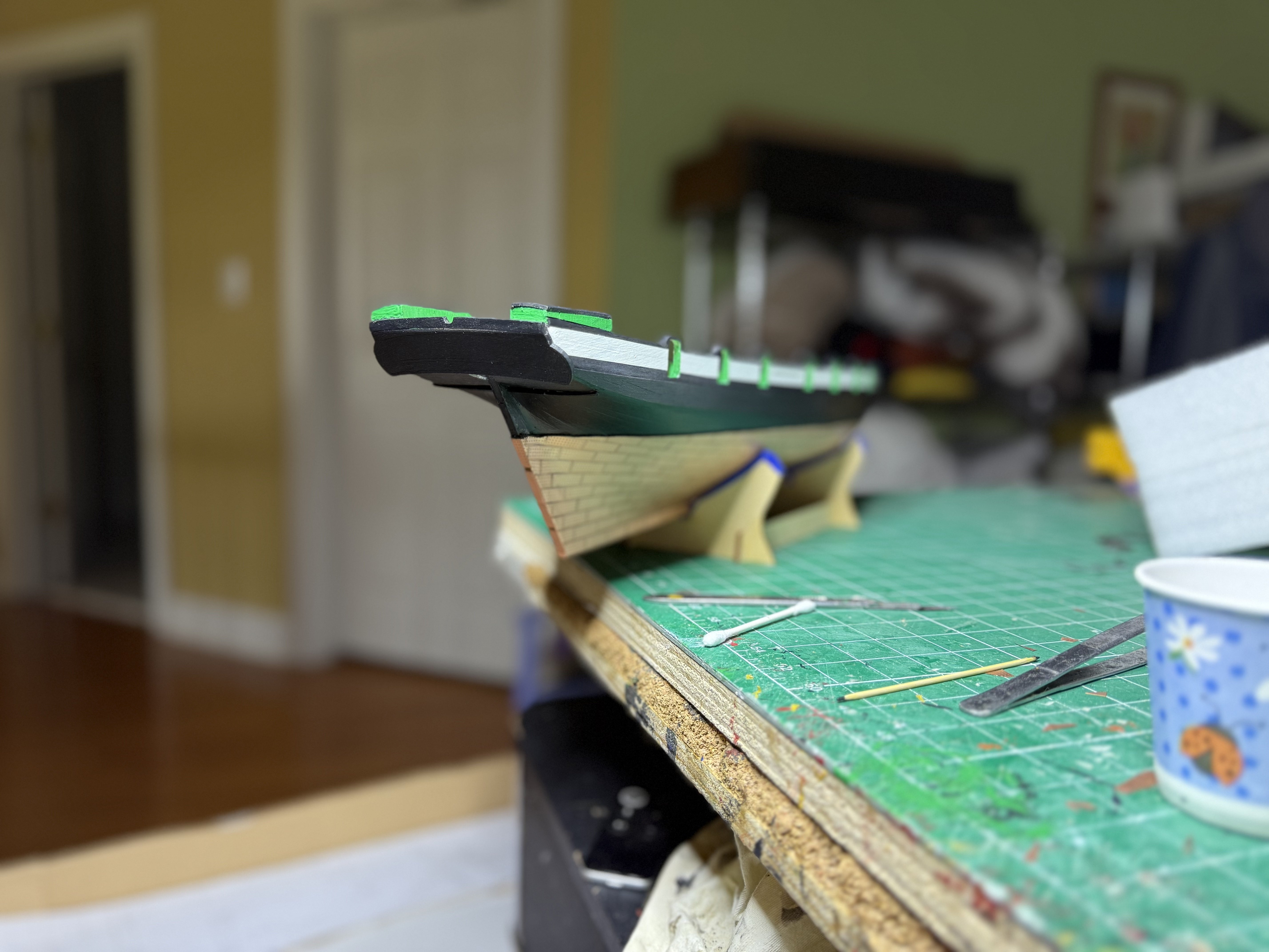

Started painting today. Lots of tape being used. I also drew the water line and painted the area below copper so when I do copper, any gaps will not be glaring. Have not added the cabin doors and siding yet although I did pre-fit them , sanding/filing so they fit.
IMG_0202.thumb.jpg.a51a245d7fe1e0103021eb7ca80f4fd1.jpgIMG_0198.thumb.jpg.2b609c9c8af0158417cbdbee97394328.jpgIMG_0197.thumb.jpg.9fca186b8e915ece0c53a2692350d58a.jpgIMG_0198.thumb.jpg.2b609c9c8af0158417cbdbee97394328.jpgIMG_0199.thumb.jpg.c21eb00f49bb069ebbbebb975a56753a.jpgIMG_0200.thumb.jpg.5dbf5812a0fb1c0ef53284a6dc4cd175.jpgIMG_0201.thumb.jpg.41f182d44e5ee7f4632f6d2e7c1b98c3.jpg

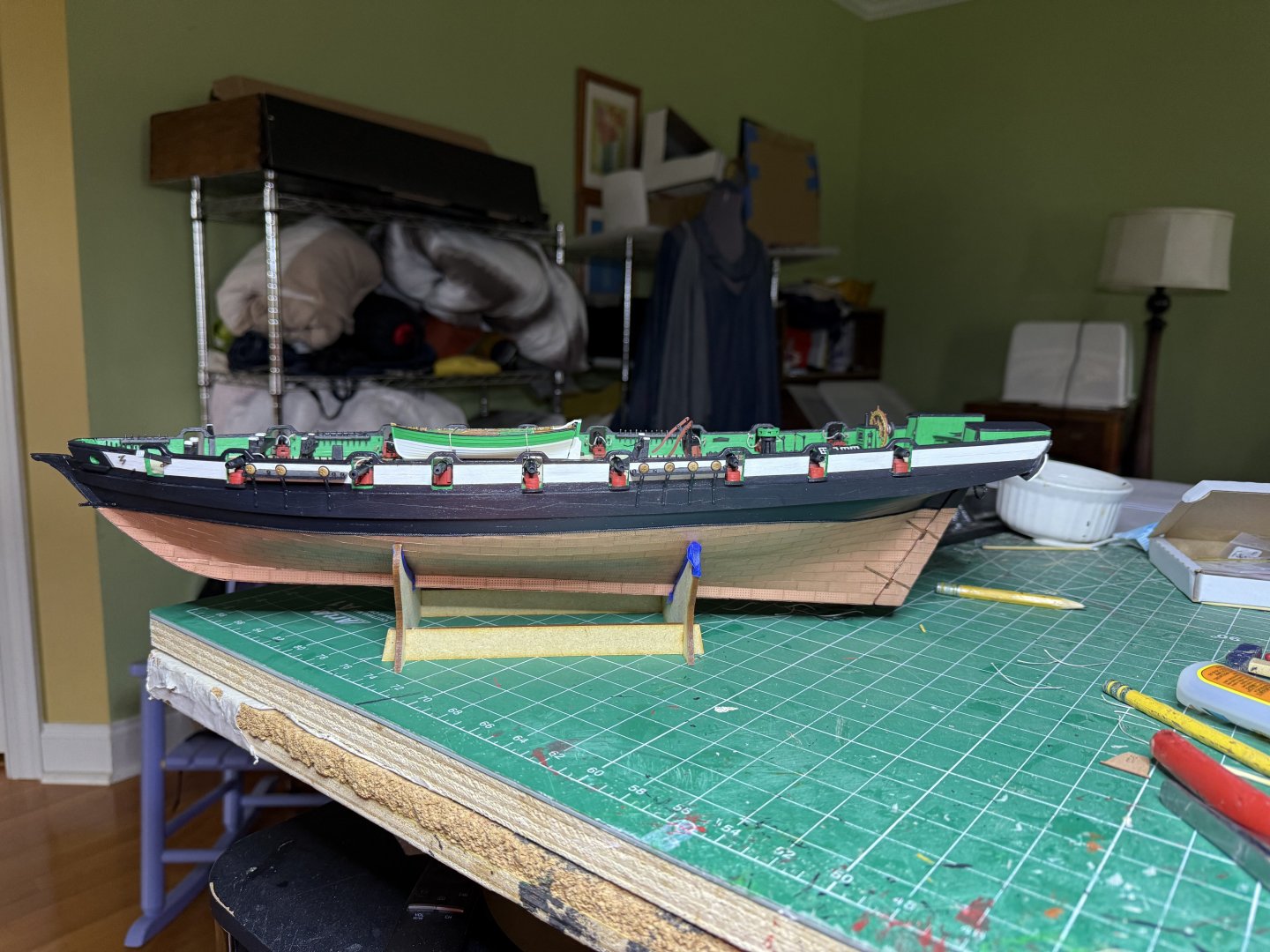

It seems to me that your water line (LWL) is a bit too low, especially at the stern. Not much, but a bit low. I am looking at Howard Chalelle's drawings of Grecian in The Search for Speed Under Sail (page 223). These "Baltimore clippers" had deep "V" shaped hulls that displaced much less water than the commercial vessels' "U" shaped hulls. This meant less buoyancy so the hulls sat deeper in the water. But it also meant they were very fast.
About even with the main mast the distance from the waterline to the wales was about 2/5 the height of the wales and maybe 1/3 the height of the bulwarks.
I made this same mistake on my topsail schooner build and had to go back and repaint the waterline a bit higher.
Phil

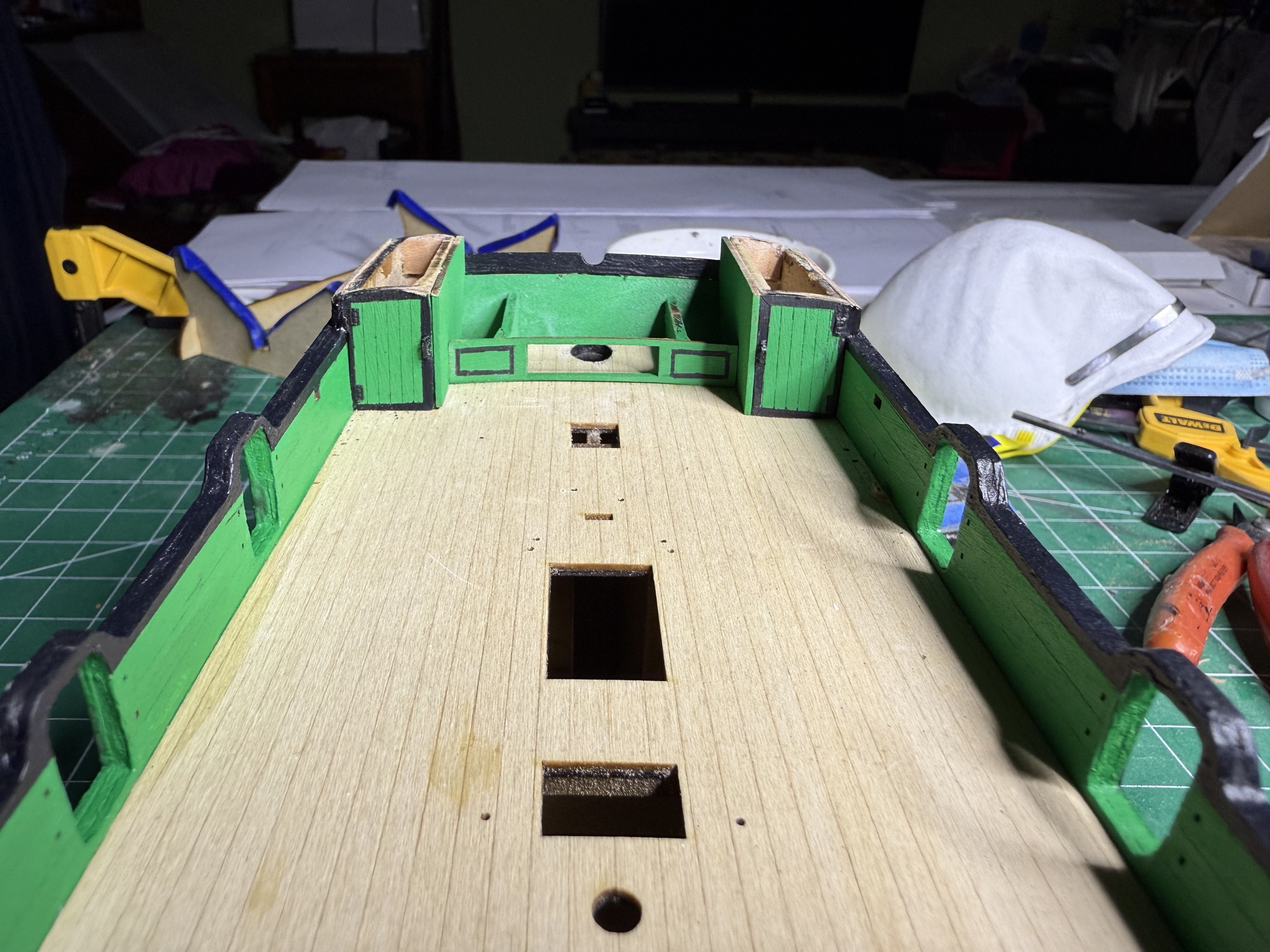

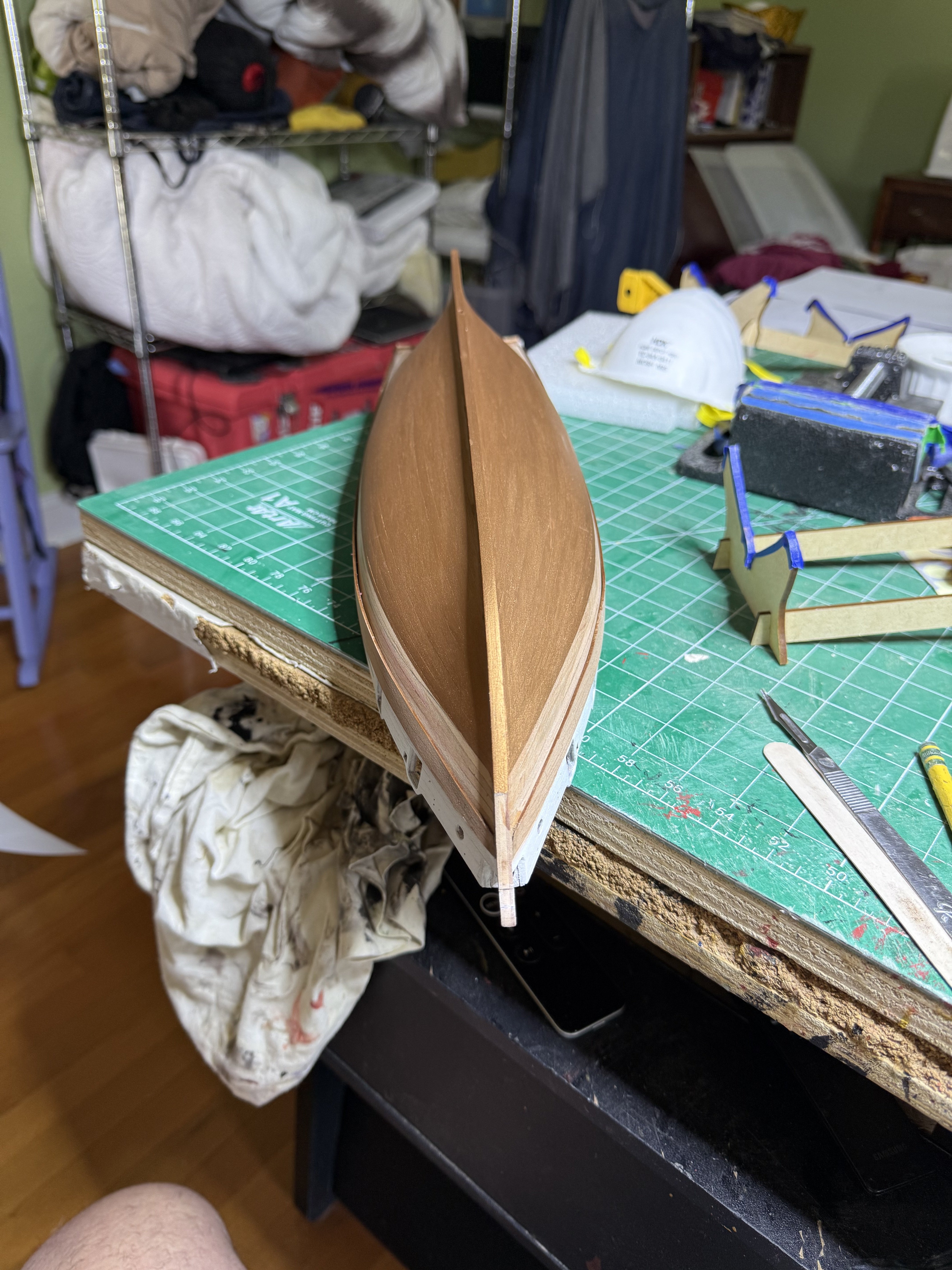

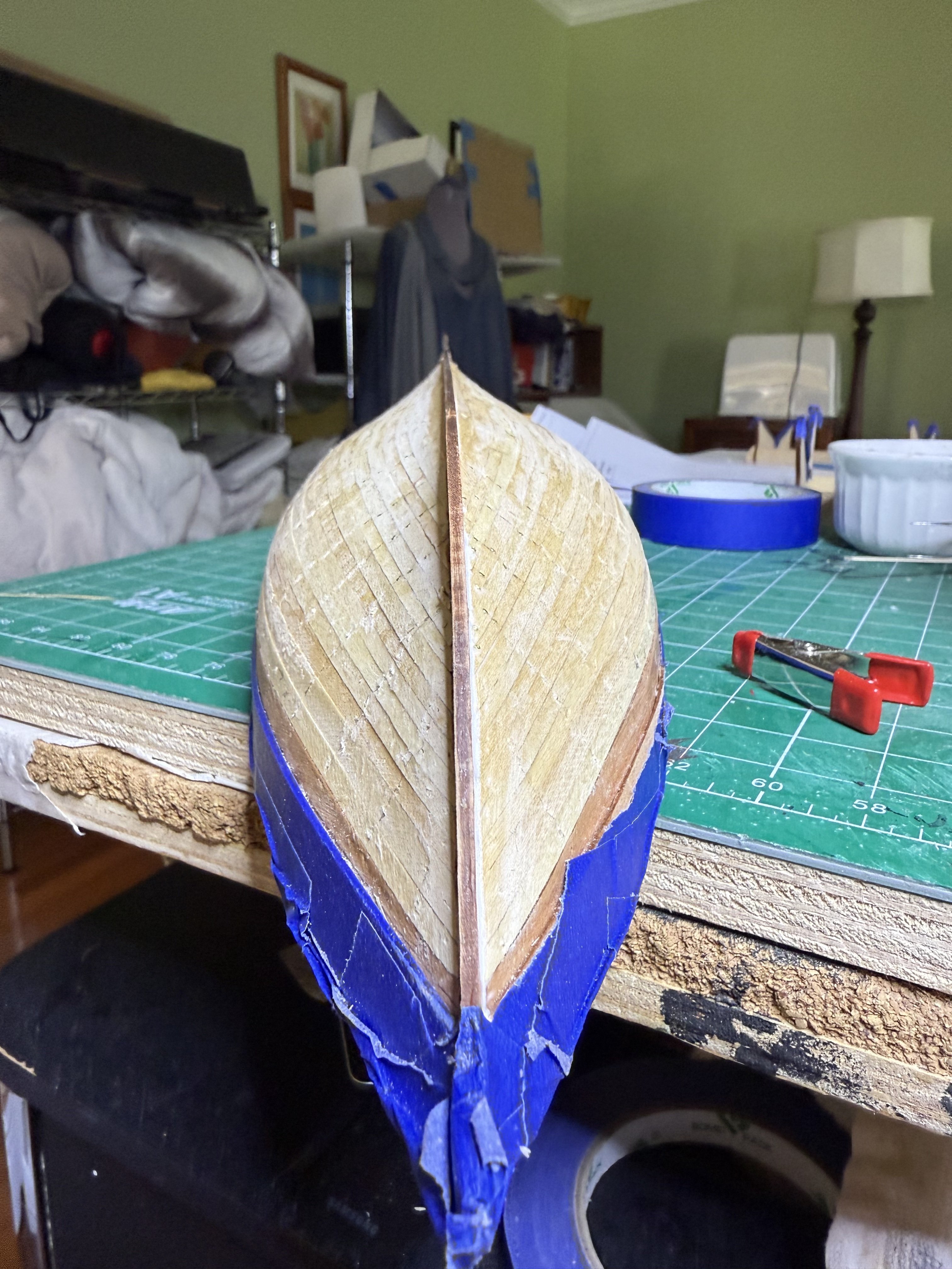

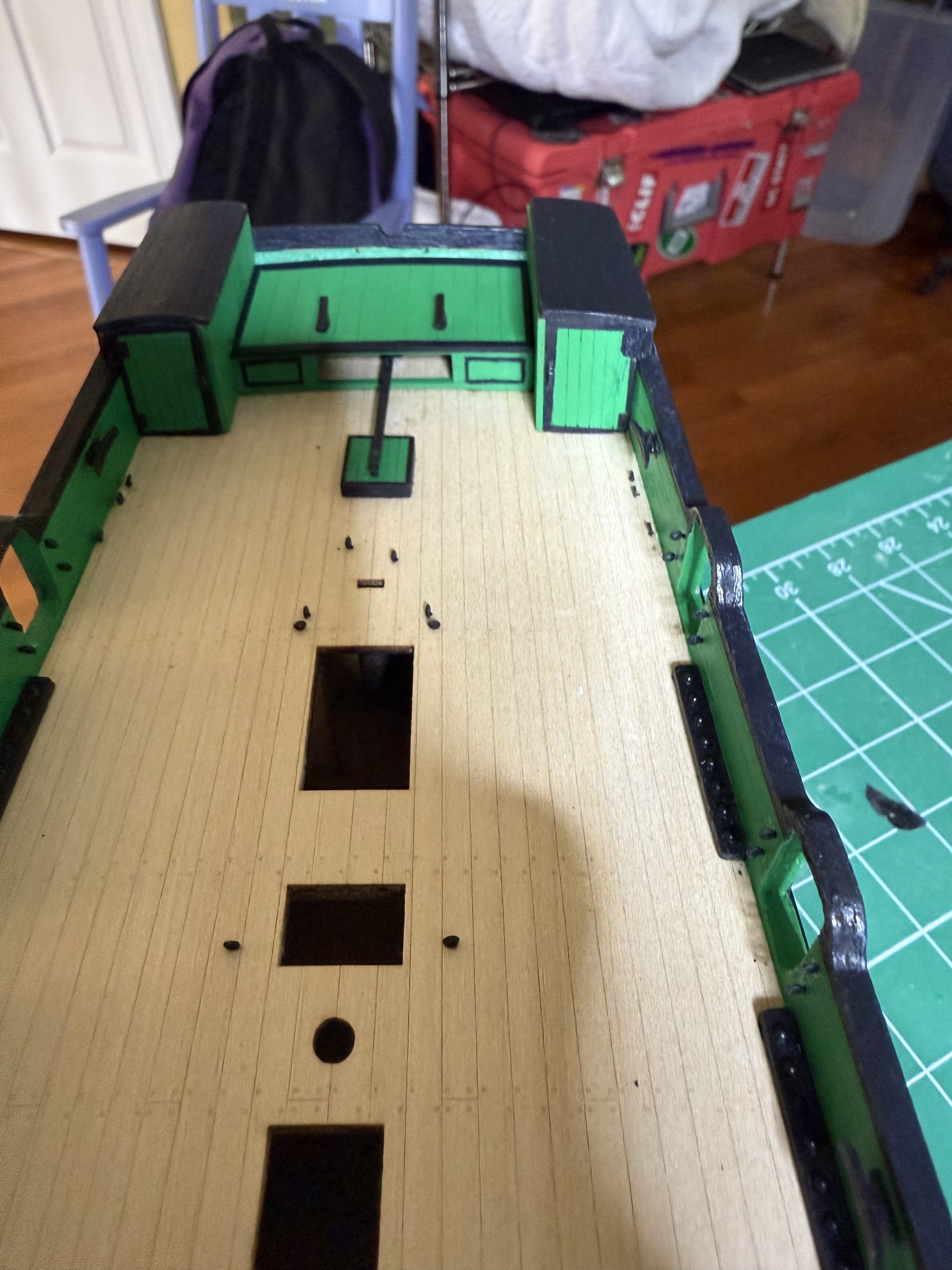

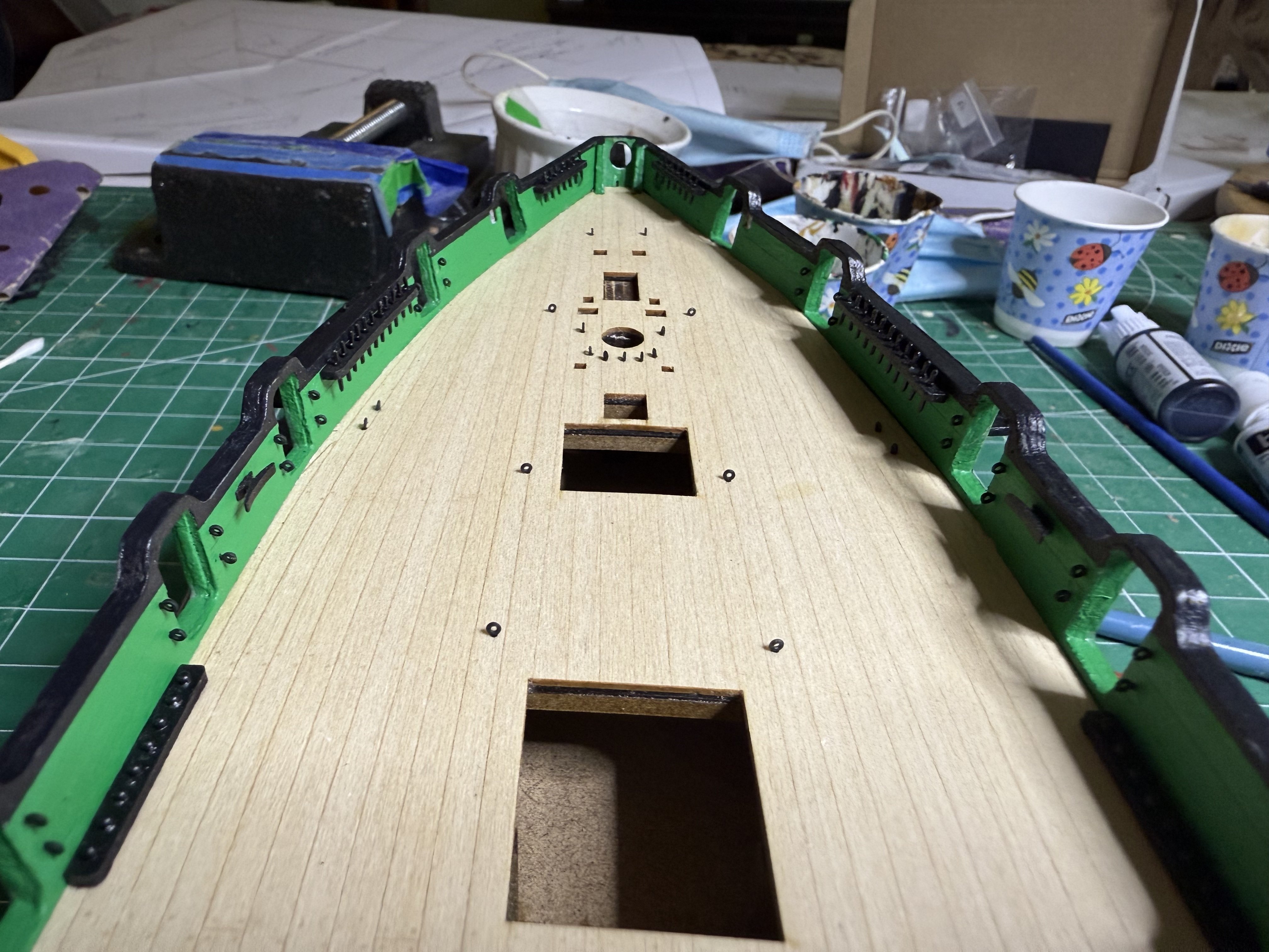

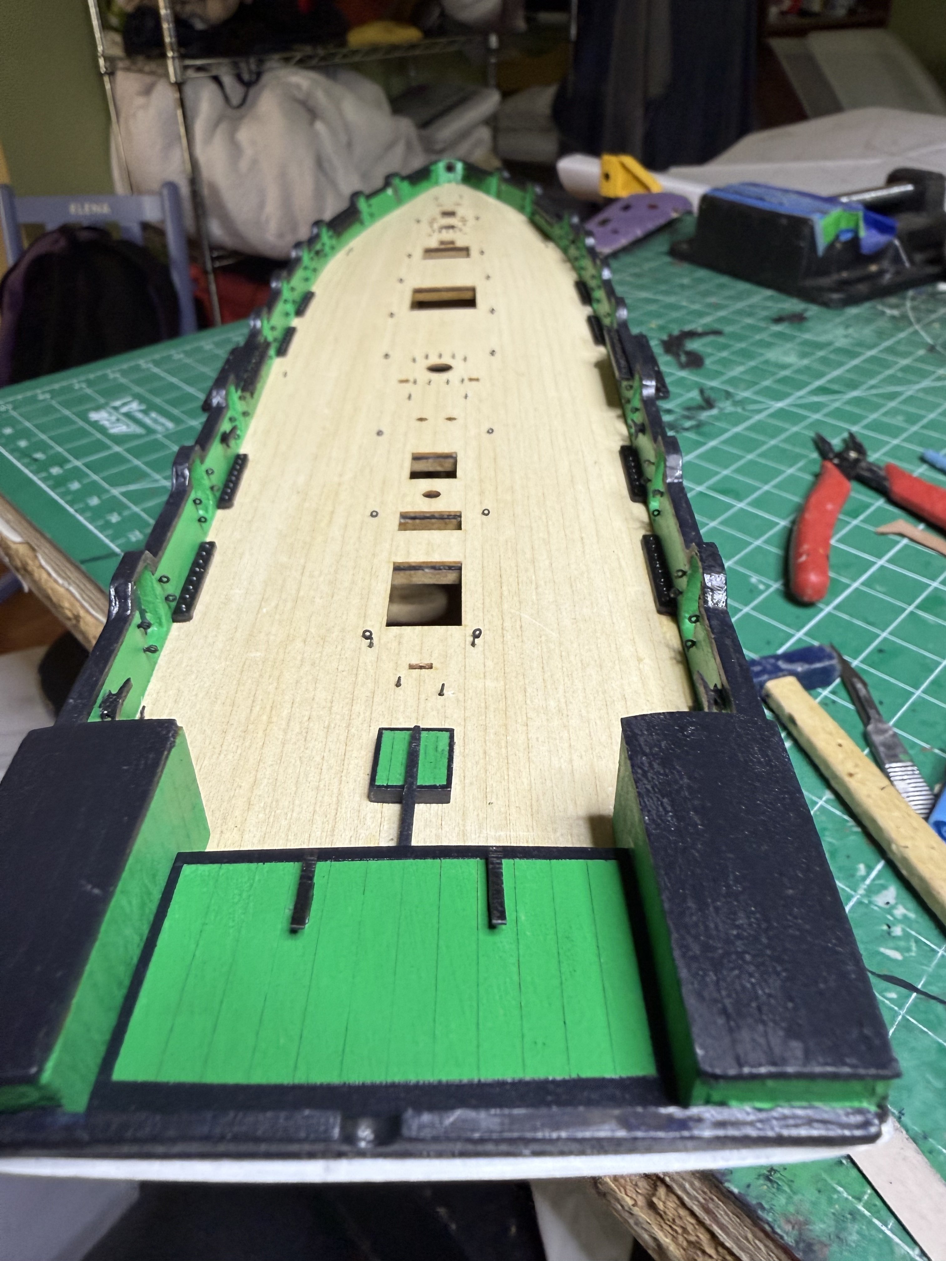

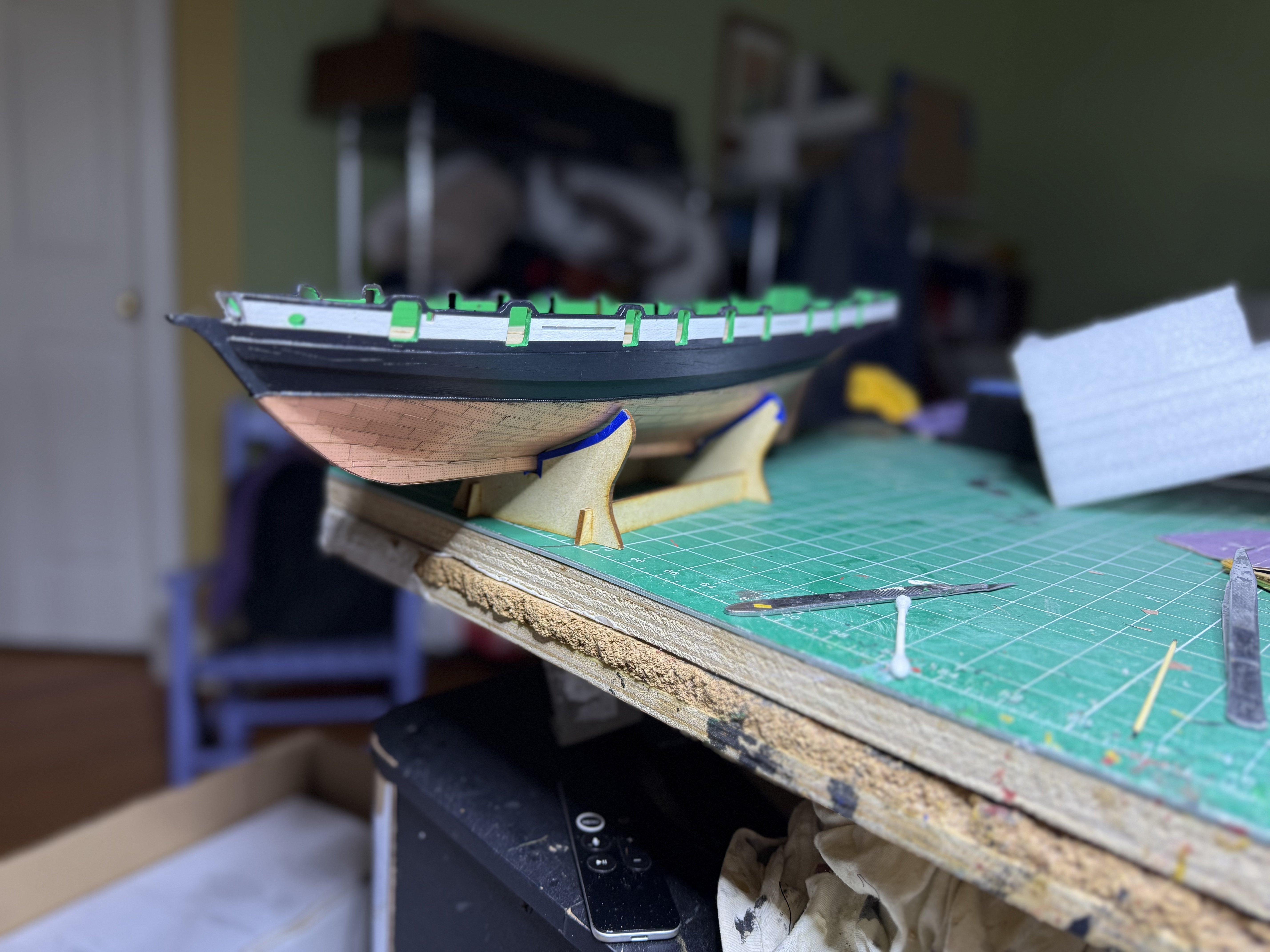

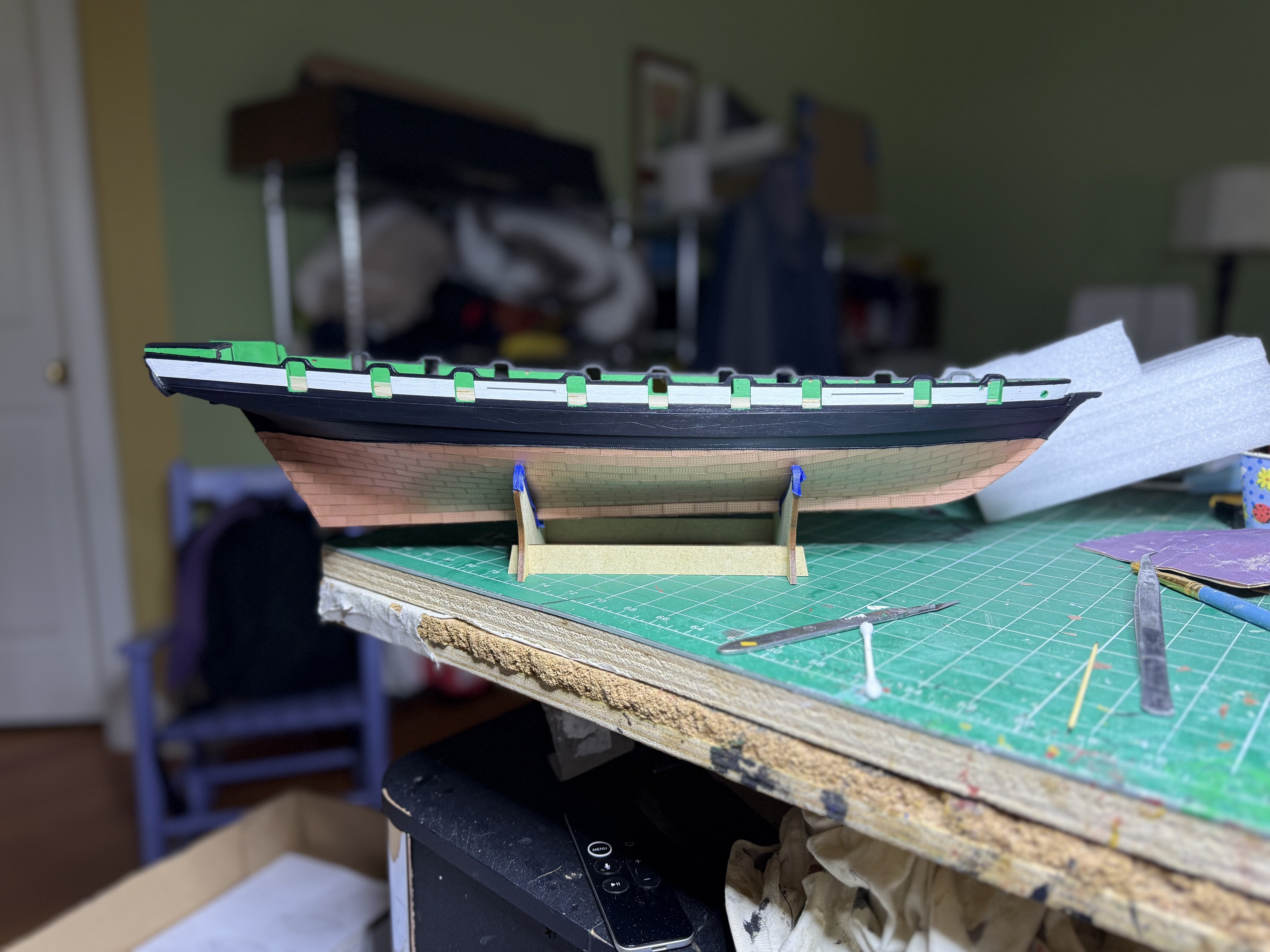

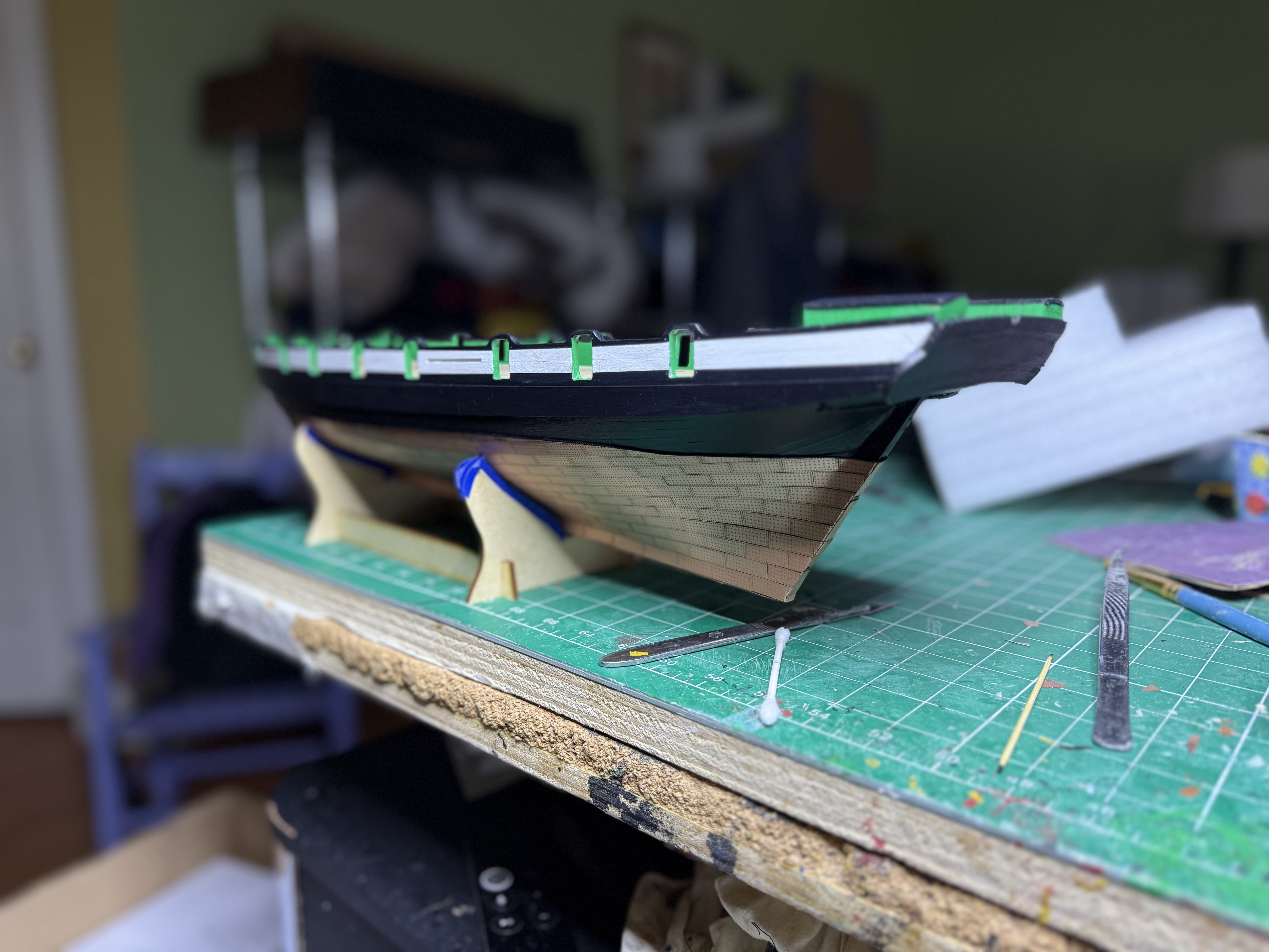

Spent the day finishing the painting and adding the stern cabin doors. I used door latches I had left from Harpy. The roofs are drying after soaking them to get the curve set overnight.  The copper paint looks pretty good to me  but I likely be starting coppering proper later this week.
IMG_0203.thumb.jpg.4868bbec6a08fe2369ad836806fce6b6.jpgIMG_0204.thumb.jpg.b87db408a7585e628bab8fb2216ce2ff.jpgIMG_0205.thumb.jpg.21c8d6154f0b4cb88891c47bd632daf1.jpgIMG_0206.thumb.jpg.ce8fca90544d2dcac31aa32ae4f0d6db.jpgIMG_0207.thumb.jpg.d6ff6a31f10380371698d960e79e4dea.jpgIMG_0208.thumb.jpg.81afb53aba024b98aa0b2f36068d97d6.jpgIMG_0209.thumb.jpg.cd84869b36226465dfe0a5e688f330e5.jpgIMG_0210.thumb.jpg.39e1064e2e472c89fd0fe87f14678bd1.jpgIMG_0211.thumb.jpg.4739e56254be7df82d6627144fa48edd.jpg

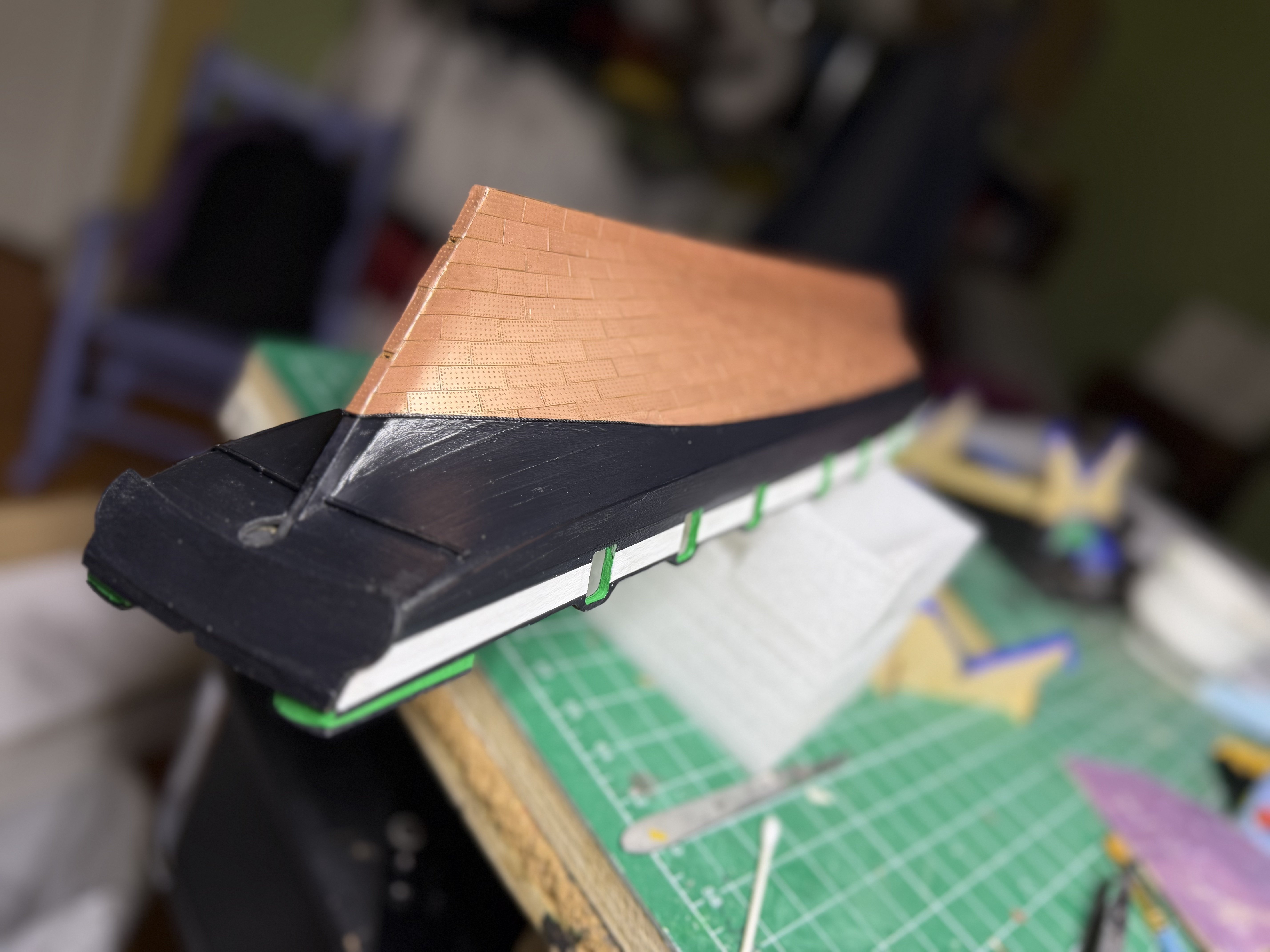

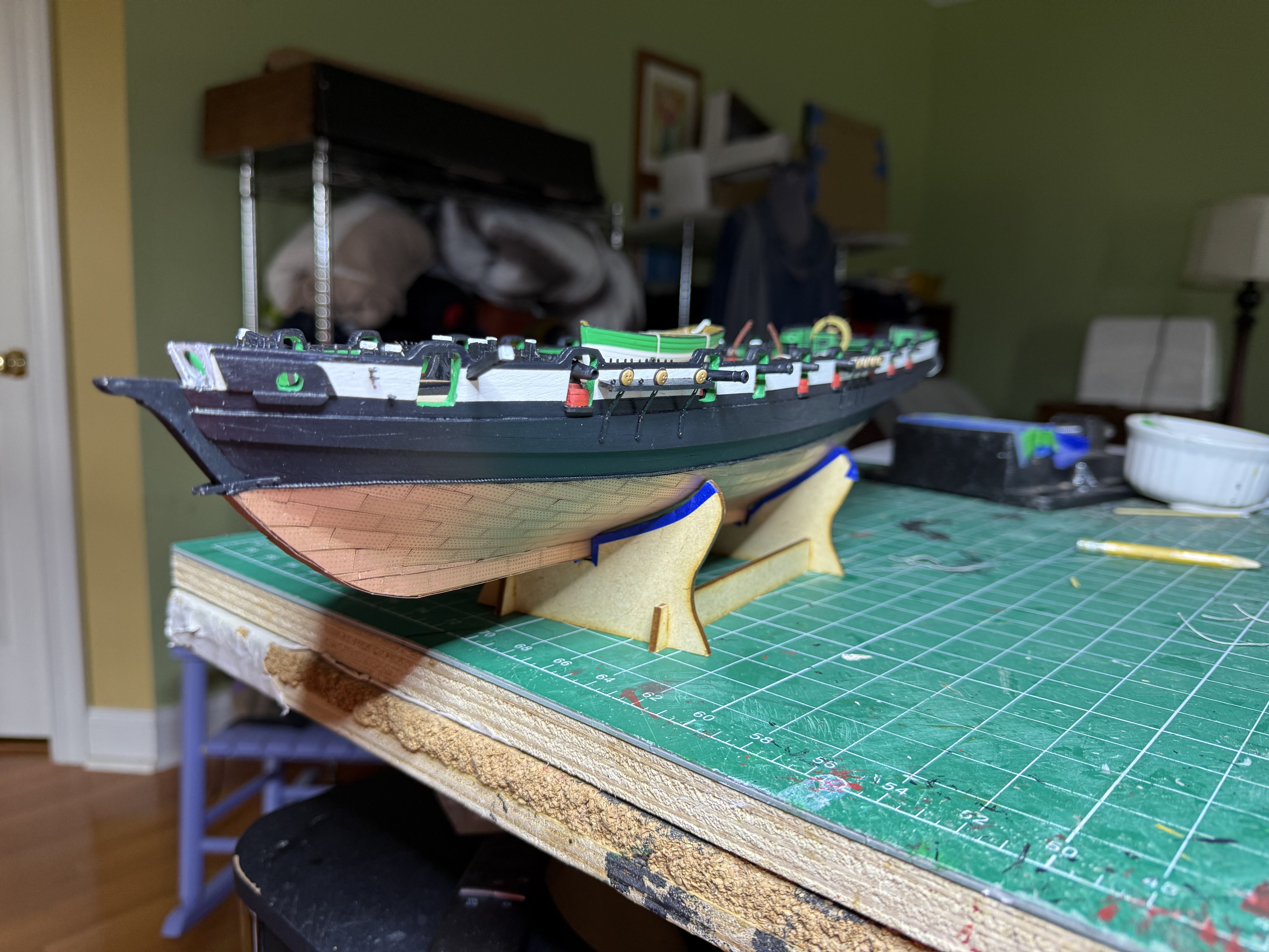

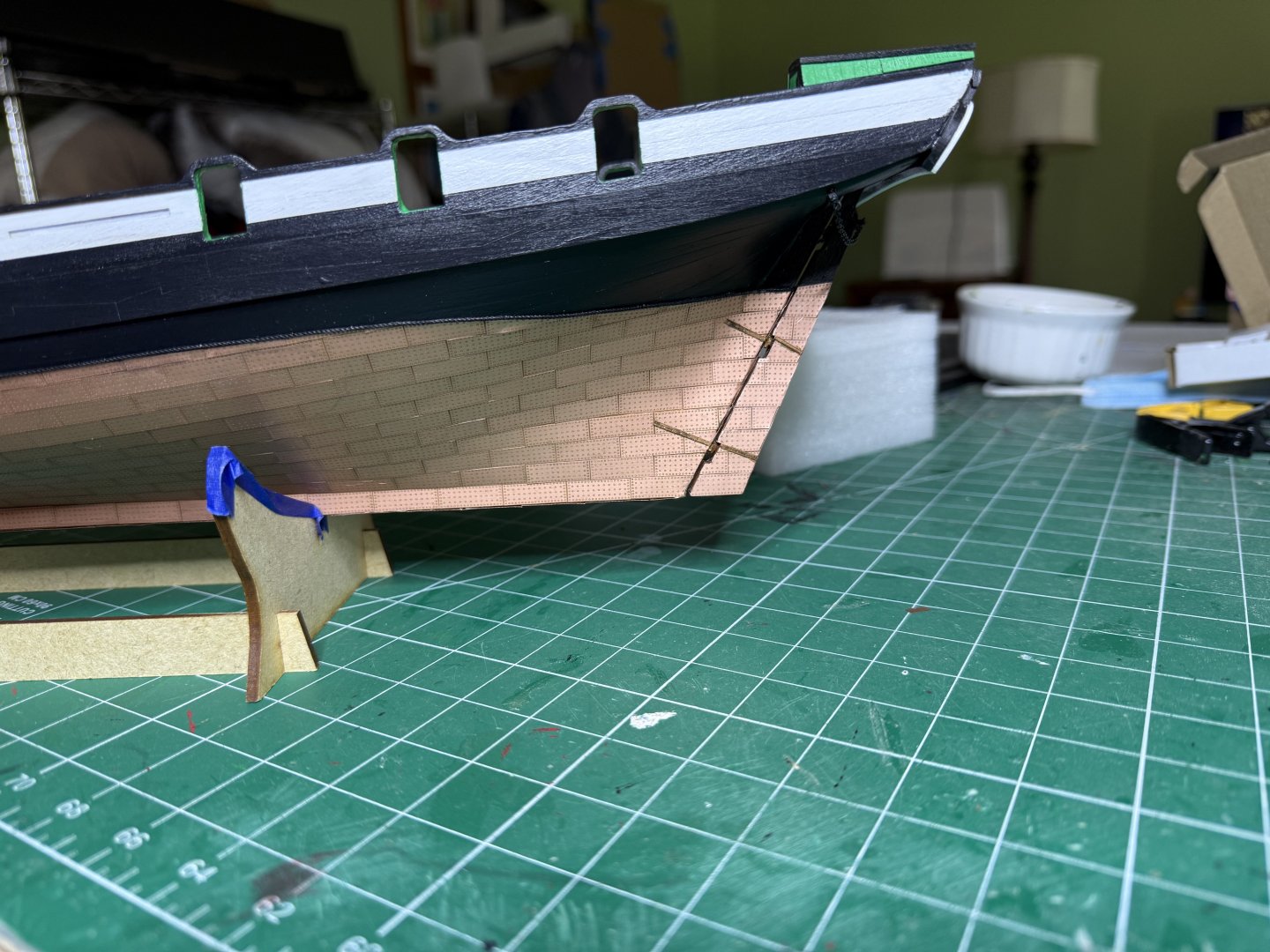

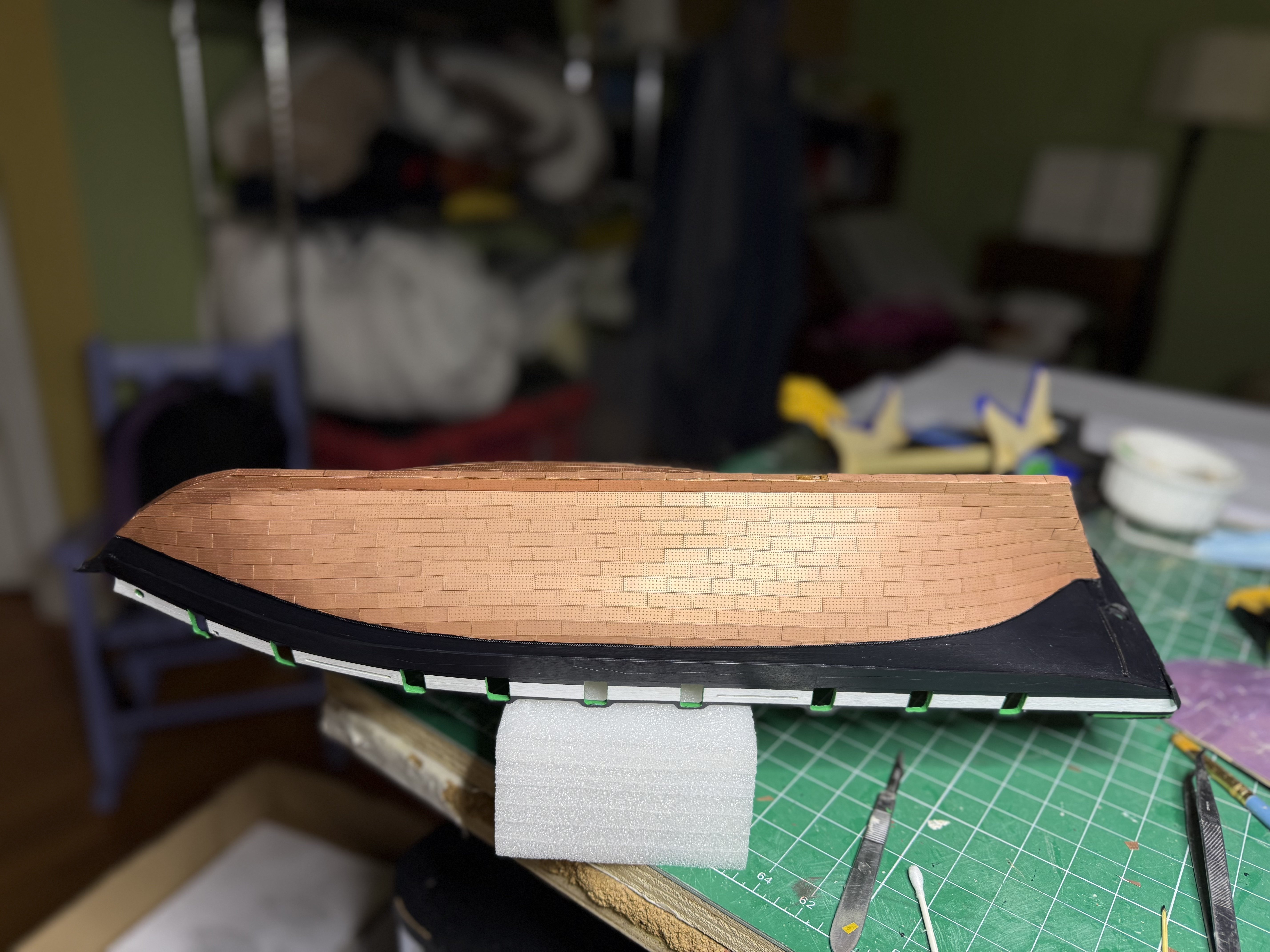

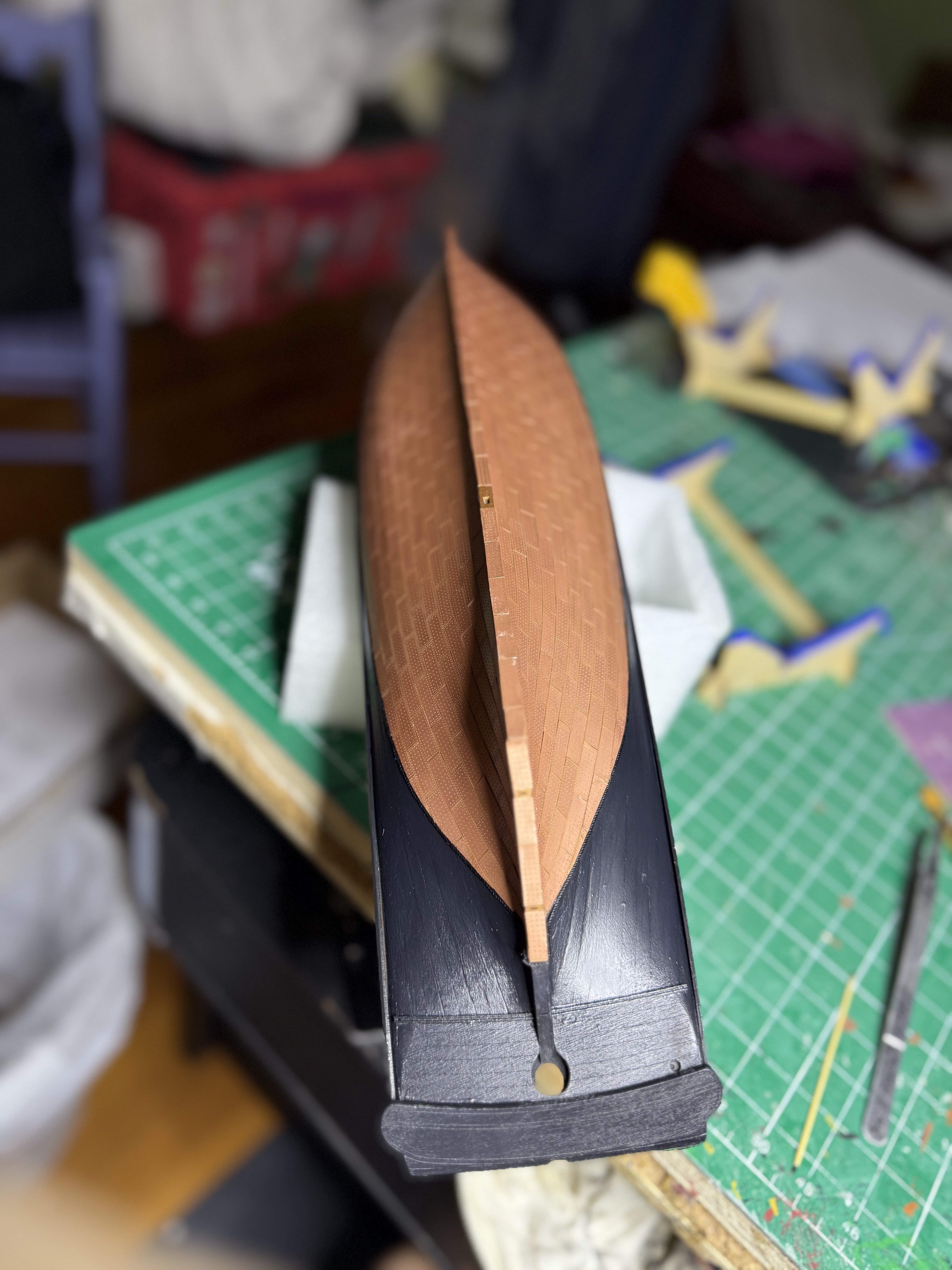

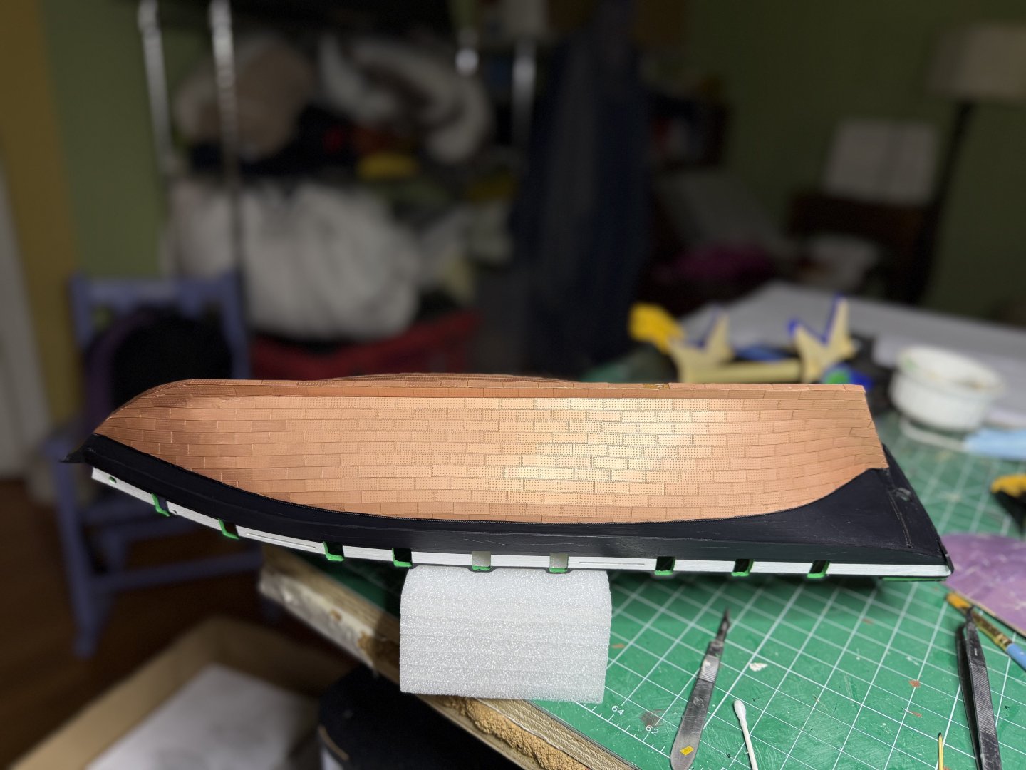

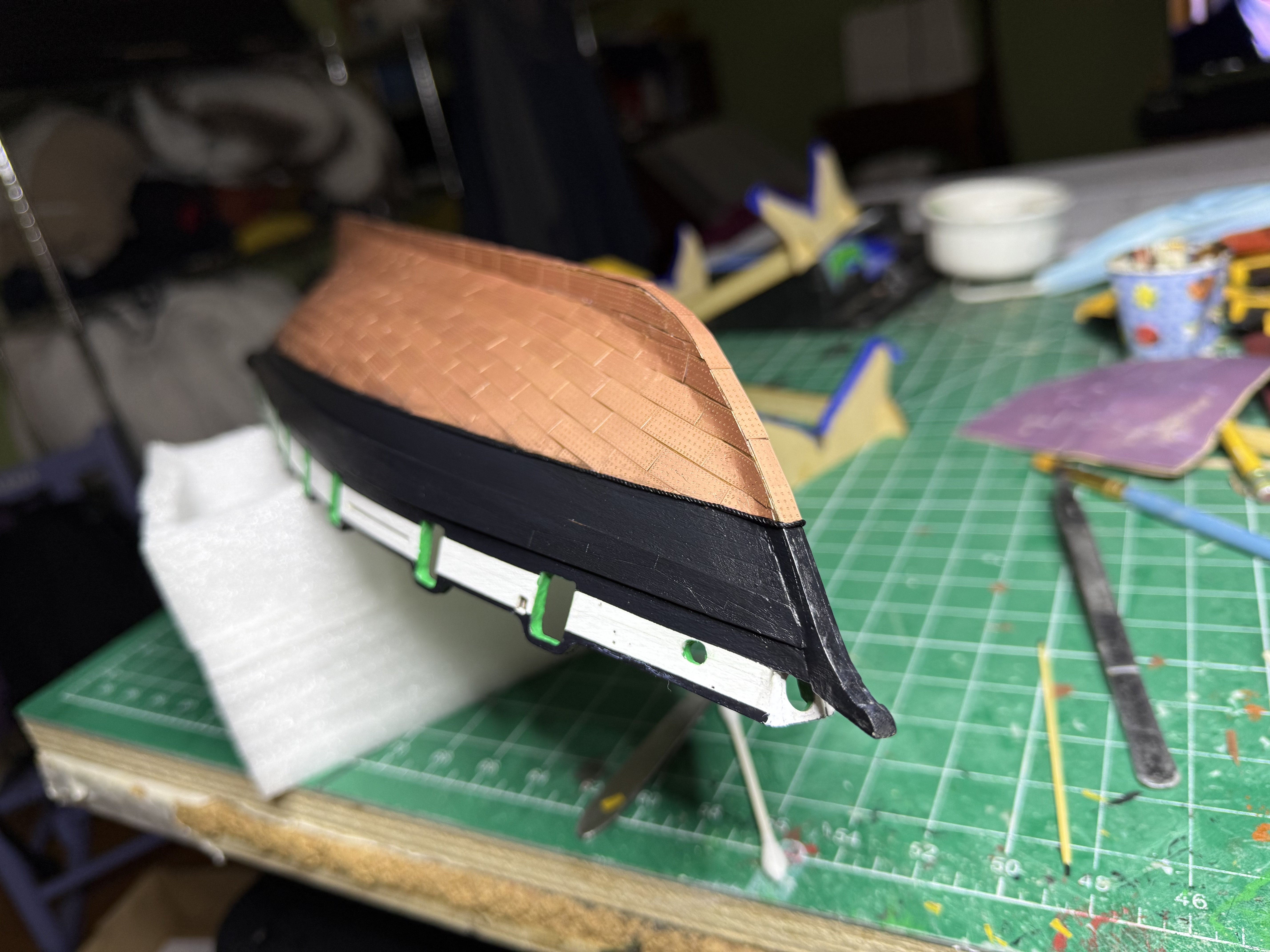

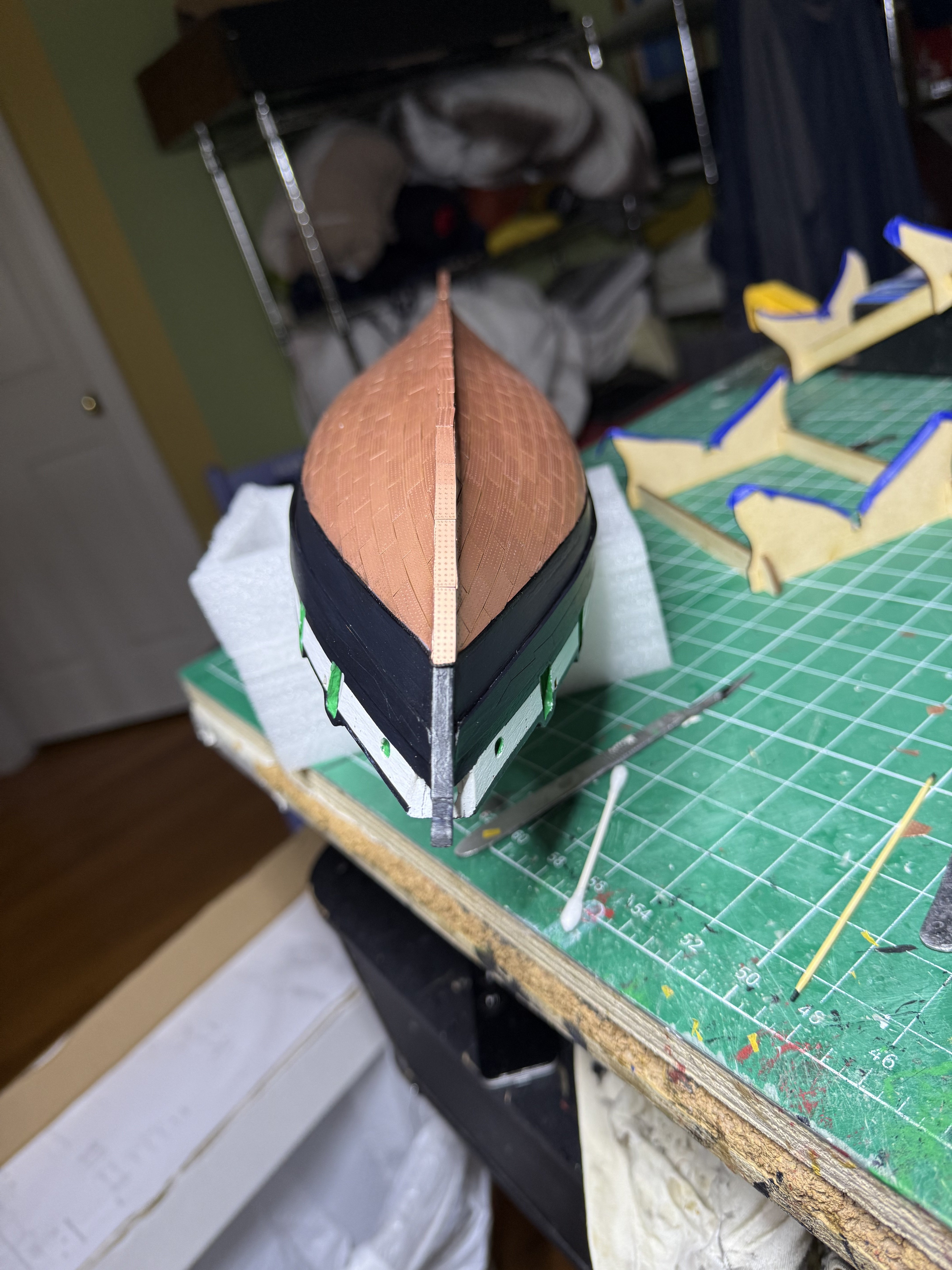

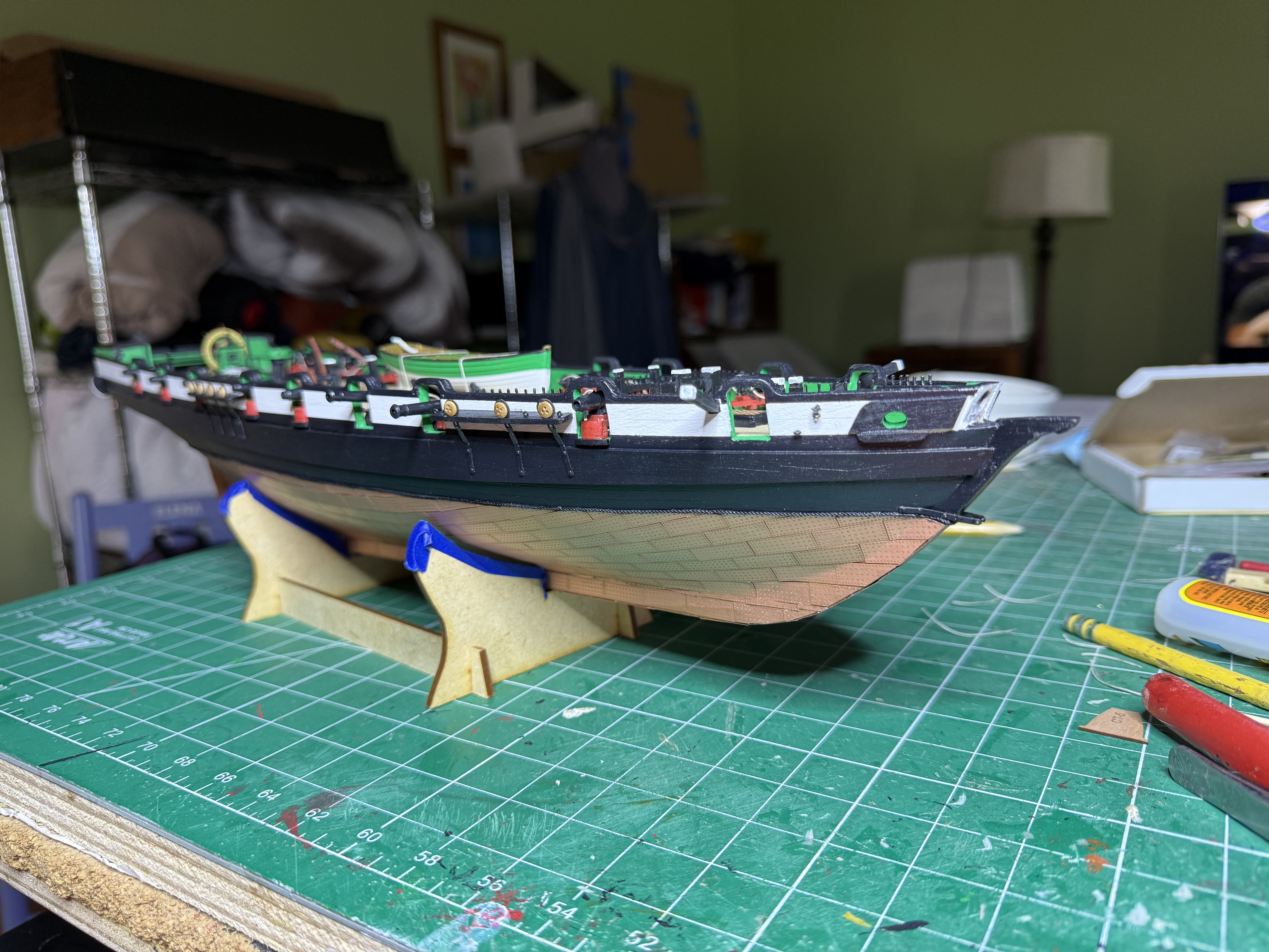

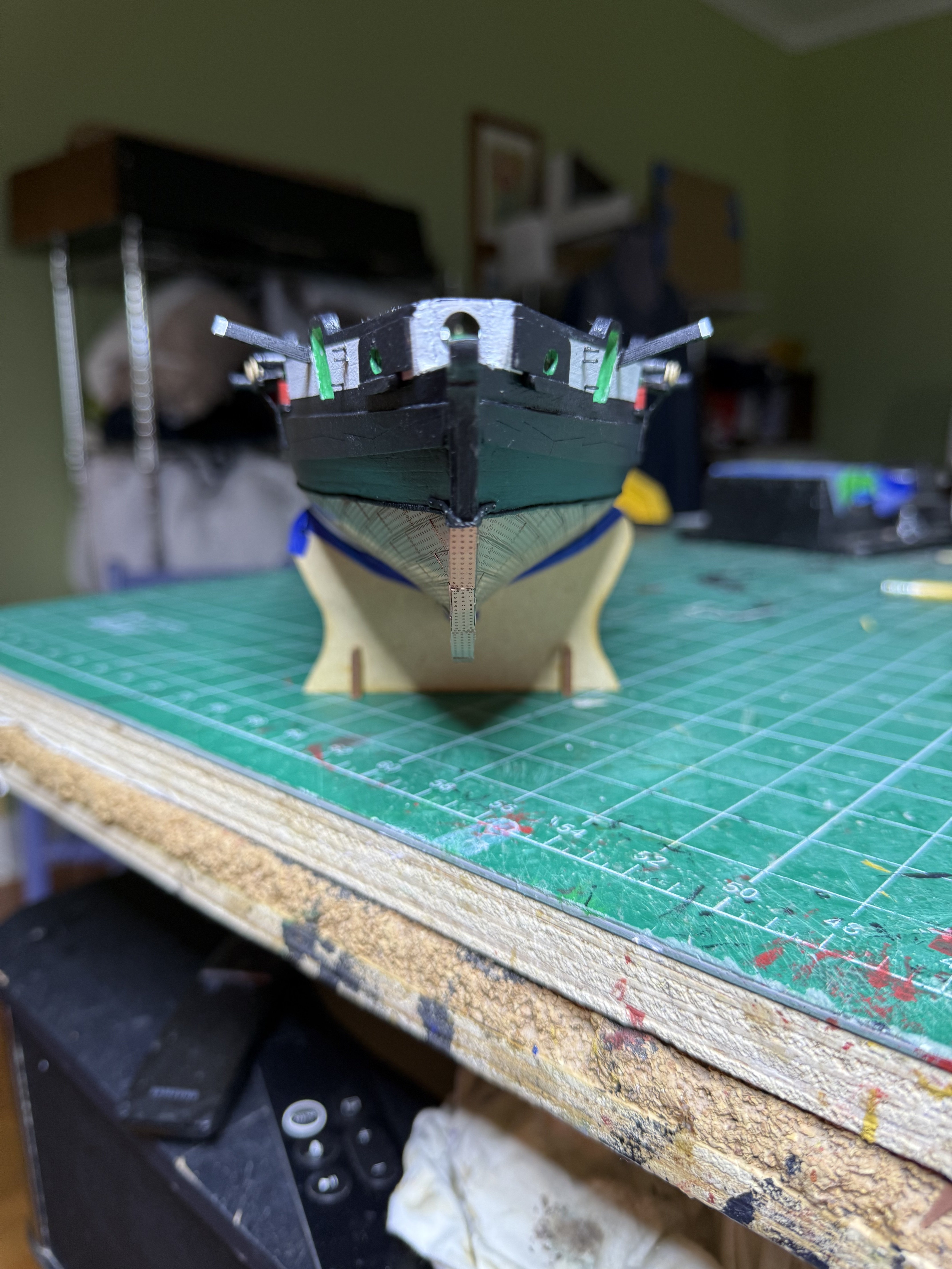

Several days of work and the coppering is done.
IMG_0222.thumb.jpg.5380966acf2c02b6998a5b3a48251344.jpgIMG_0223.thumb.jpg.f5783819f80f8ec2ccefa857439230be.jpgIMG_0218.thumb.jpg.7d03f51dbfb0ce76e6ba98fe802ae157.jpgIMG_0220.thumb.jpg.b71396f03324c7cf7006a392cfb28f20.jpgIMG_0221.thumb.jpg.3eccd0c2c4bbaa54bf25b29f1d9d3a41.jpgtIMG_0219.thumb.jpg.cbe838828bf68a4173bc22e94b09b72b.jpg

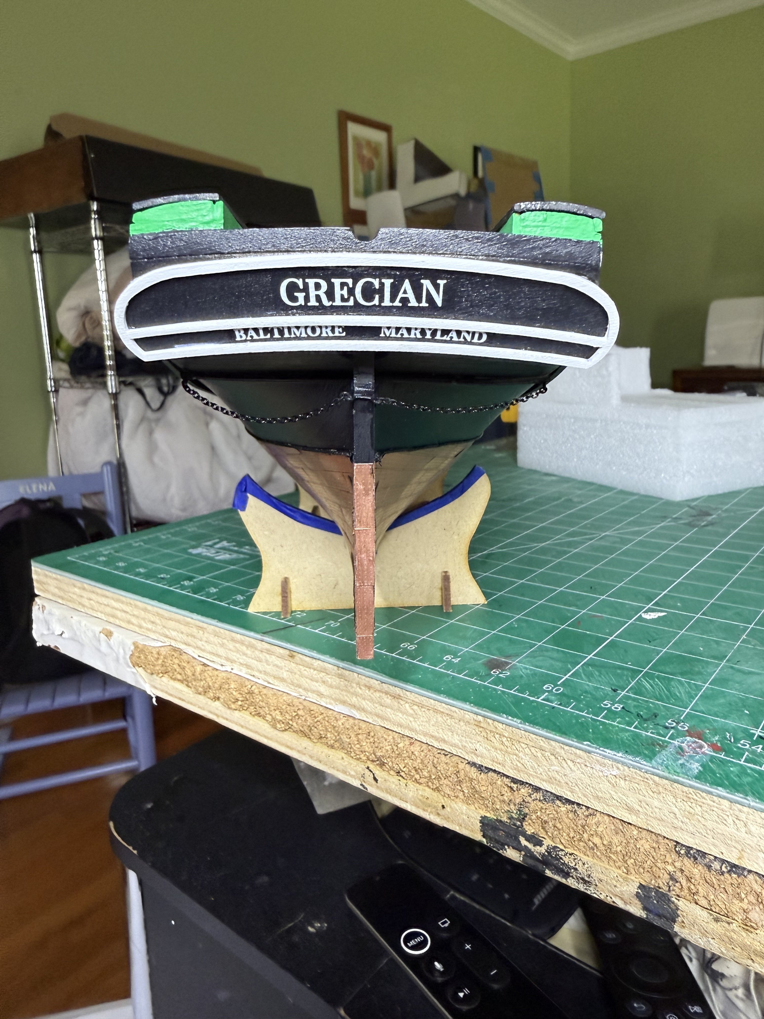

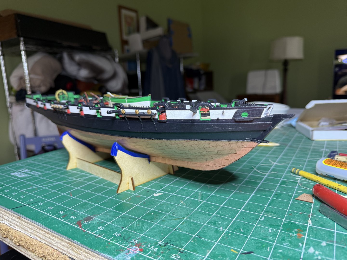

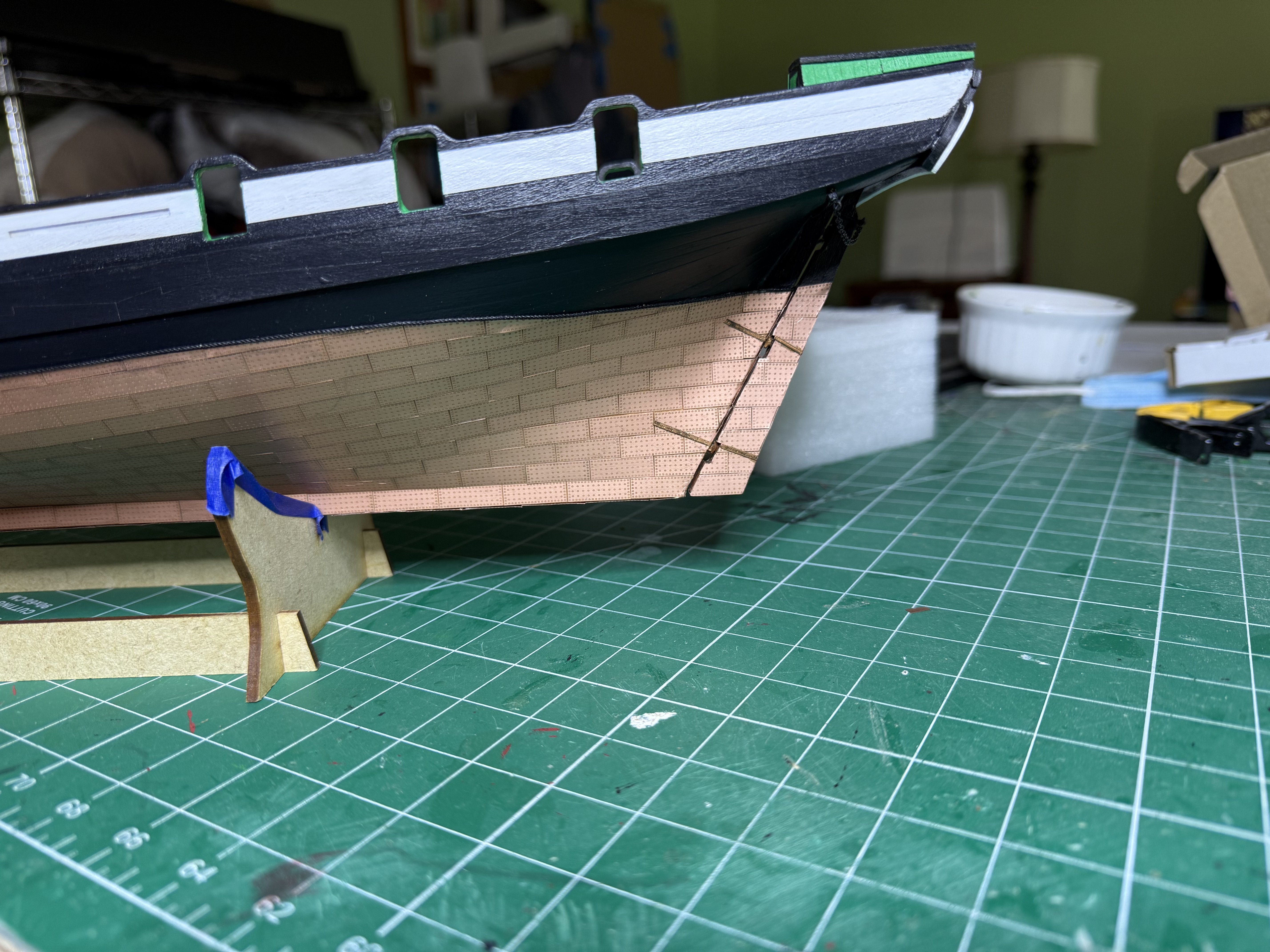

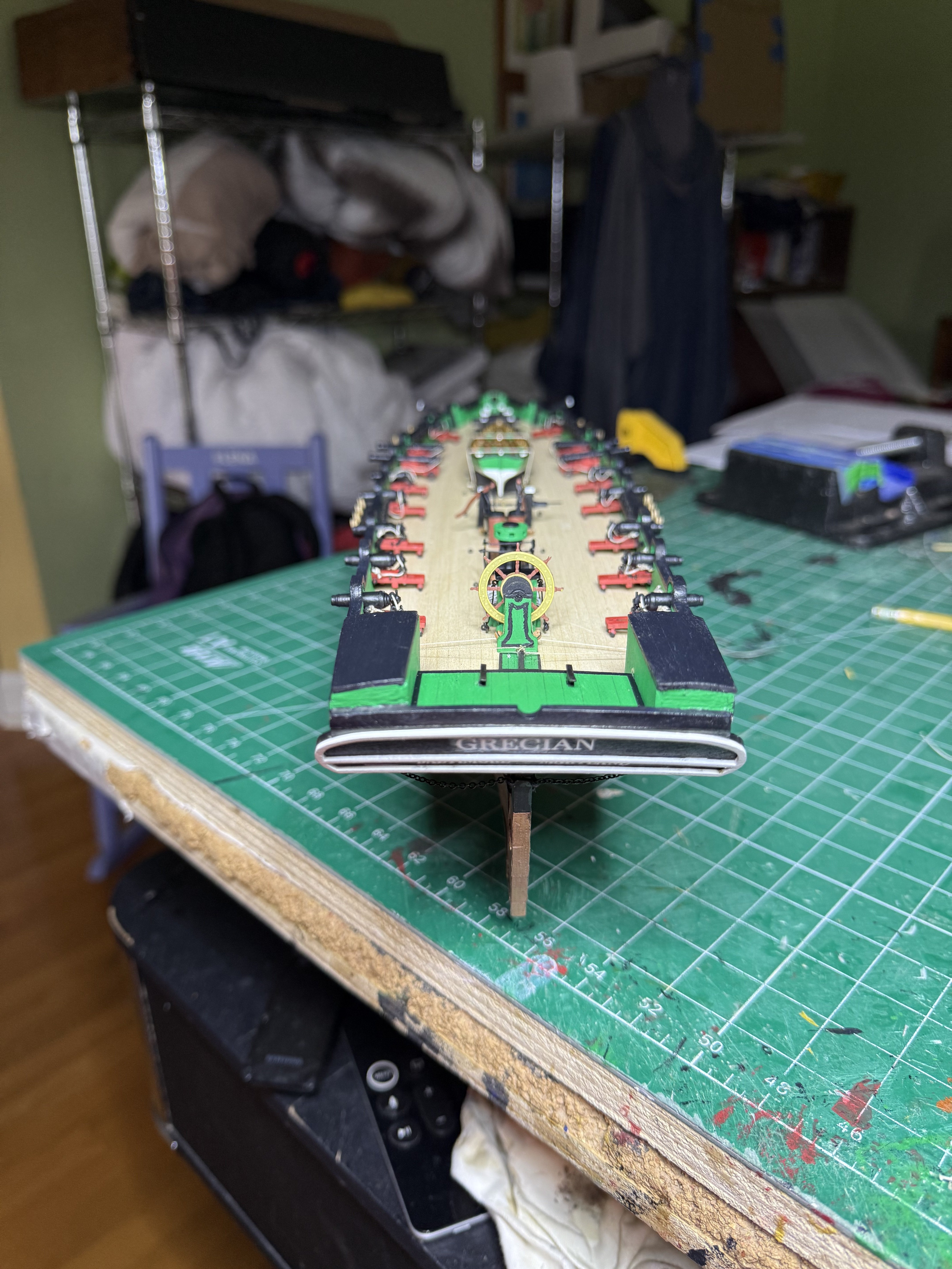

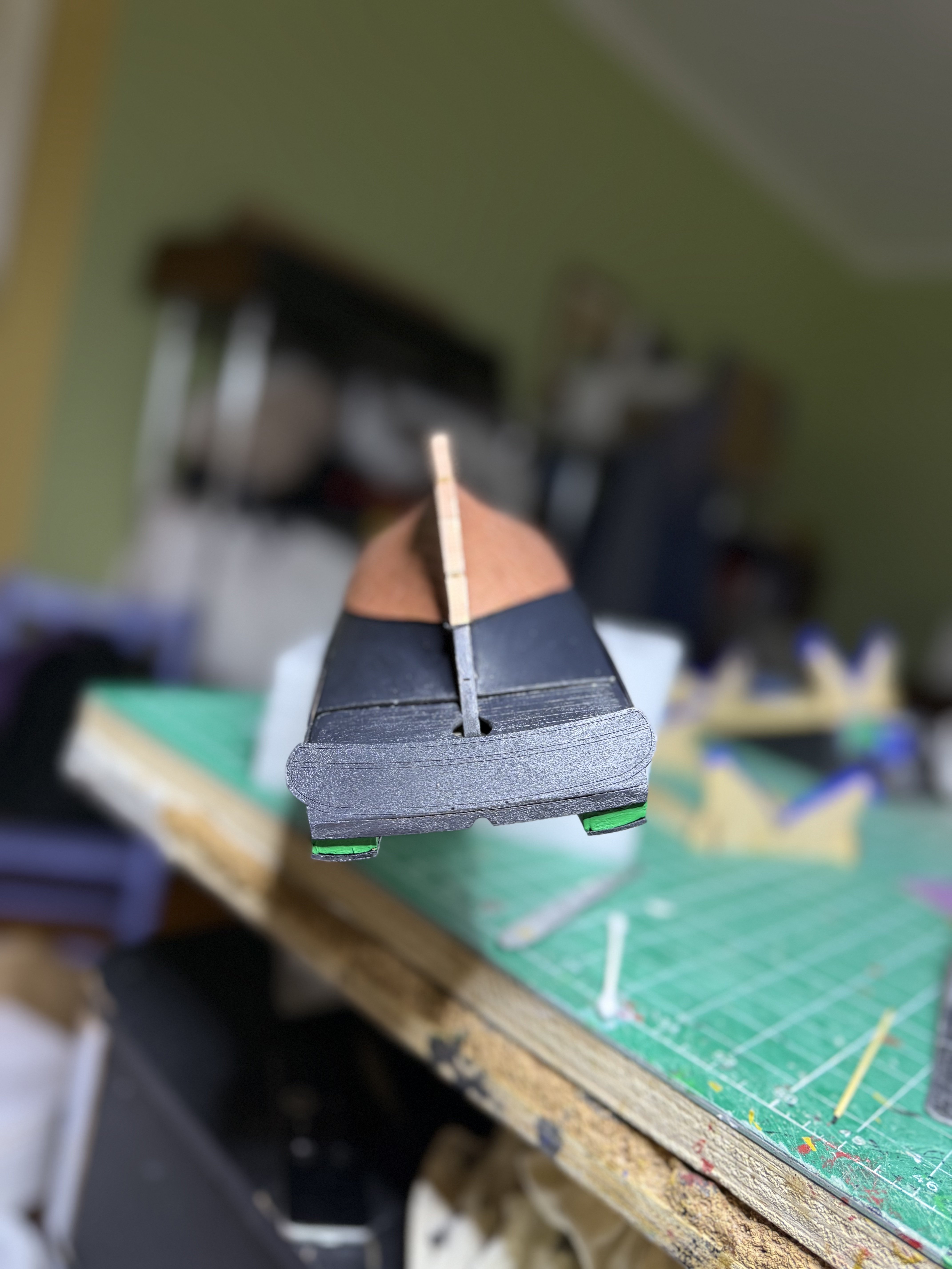

Took a morning to copper the rudder and mount it. The pintles are photo etched and much sturdier than the laser printed ones I used in Harpy. Also finished the stern.
IMG_0224.thumb.jpg.8d5edf626c7808db636090104cd6e470.jpgIMG_0225.thumb.jpg.6c667cea365349db94bffcfd3a01857a.jpgIMG_0226.thumb.jpg.673045fe600634eefb37f702e0413179.jpgIMG_0227.thumb.jpg.ca3a941973bddfae3e787ebb4e0f680d.jpgIMG_0219.thumb.jpg.cbe838828bf68a4173bc22e94b09b72b.jpgIMG_0230.thumb.jpg.85d282b600e926427849ff752539280f.jpgIMG_0232.thumb.jpg.a2858bd3a5f7f60040203417e78c1962.jpgIMG_0231.thumb.jpg.97a1e4cefa4b0950224826cbb9ad85e7.jpgIMG_0221.thumb.jpg.3eccd0c2c4bbaa54bf25b29f1d9d3a41.jpg
You are doing a superb job on Grecian, and I'm going to start following your build closely.  My kit arrived a couple of weeks ago, but it will be some time before I get started on it. I need to finish Shackleton's Endurance, and I also have the NRG's half hull project waiting.
One question I have . . . since you have painted and copper plated the hull, what purpose did your second planking serve? I asked the same question of others who were working on Endurance, didn't get a convincing response, and decided to forgo the second planking.  The first planking required a lot of filling and sanding (you did a good job of that on yours), but I was as happy with the painted result as I would have been had I done a second layer of planks. Maybe I'm just lazy . . .

Thanks all.  To me the second planking adds strength and shape to the hull, allows for gluing without nail holes and smooth the shape . Also with Chris' models, the outer bulwark transitions smoothly into the second planking.  You do not need to plank the outer bulwark. In other models the second planking, as it usually includes the outer bulwark strengthens it.

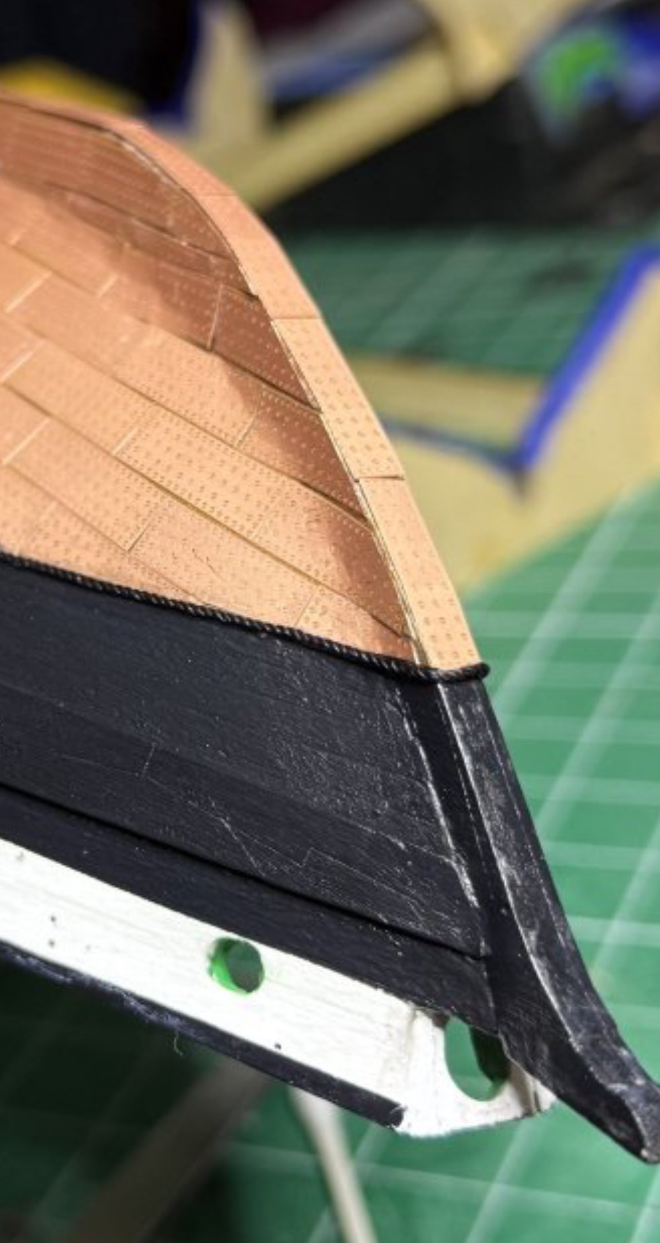

Is there something at the upper end of the trimmed copper plates where it reaches the black? Rope?
Yes . Blue Ensign used a batten which was apparently typical. I did the rope as easier to wrap and with real copper  it is now always easy to get a perfect edge. I believe it was a 1 mm black rigging line.

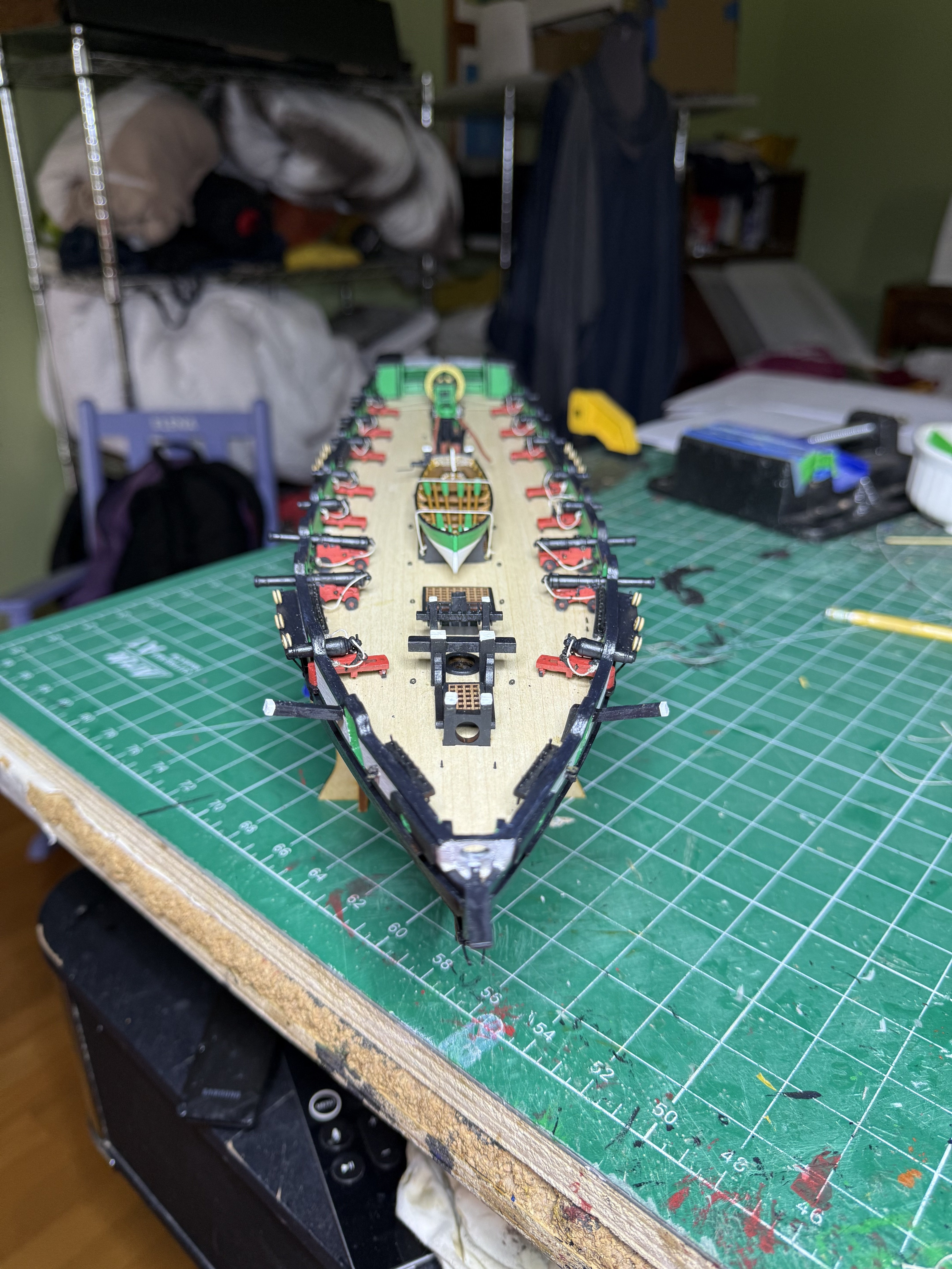

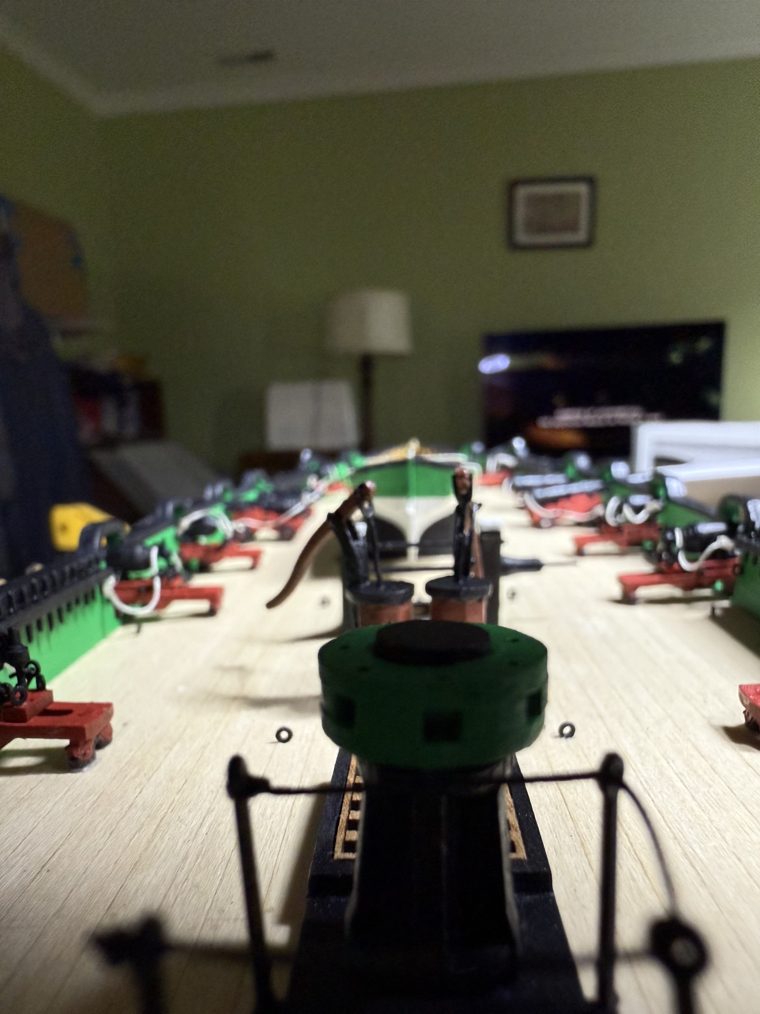

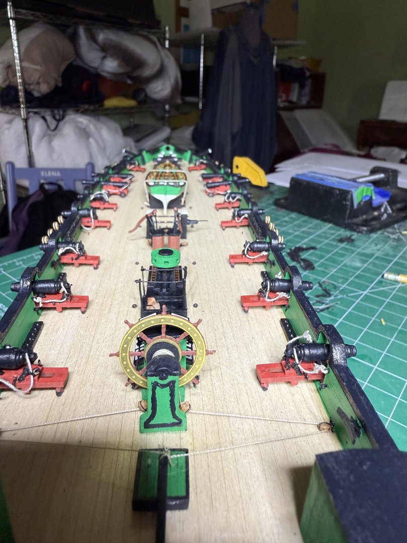

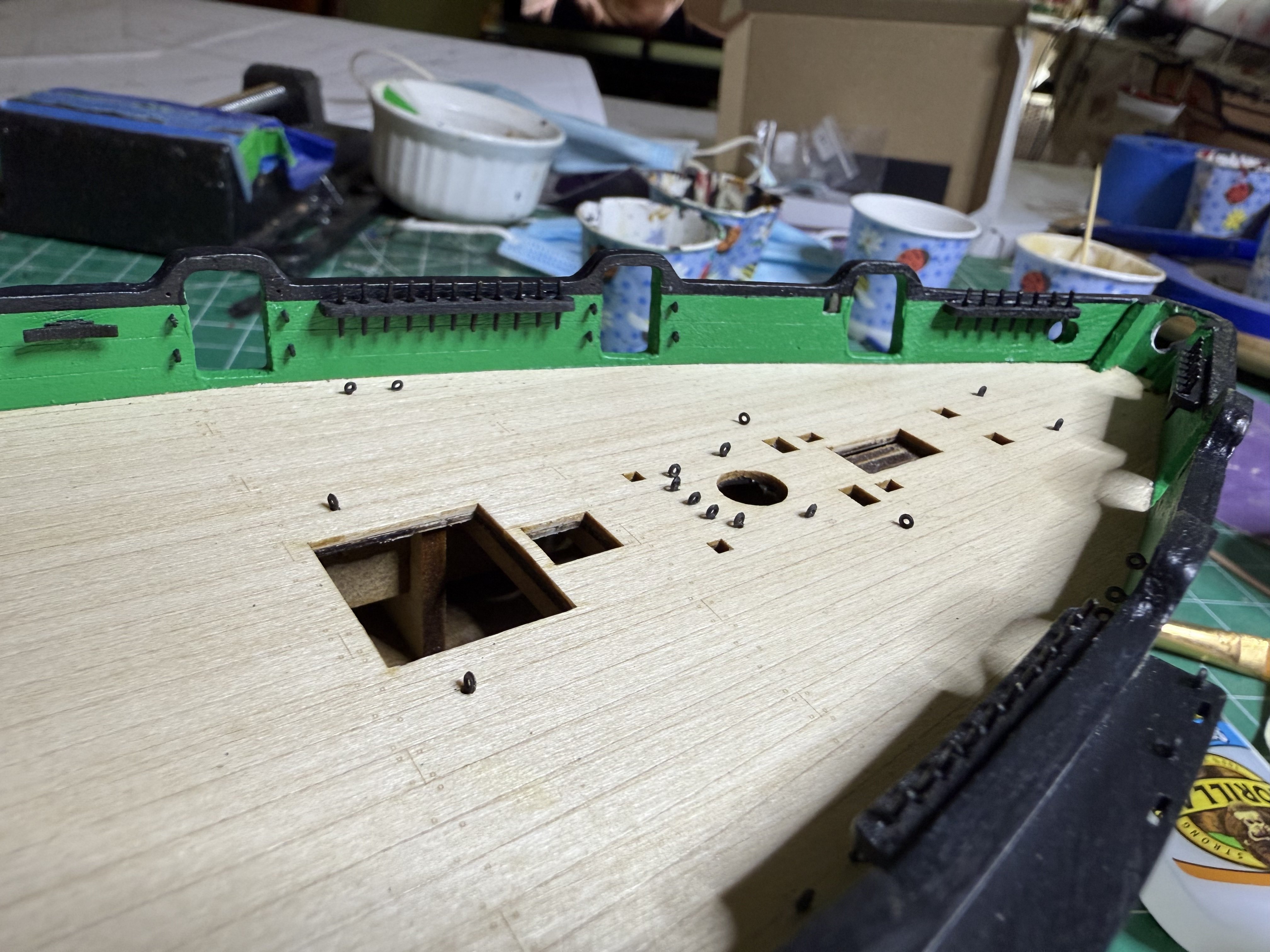

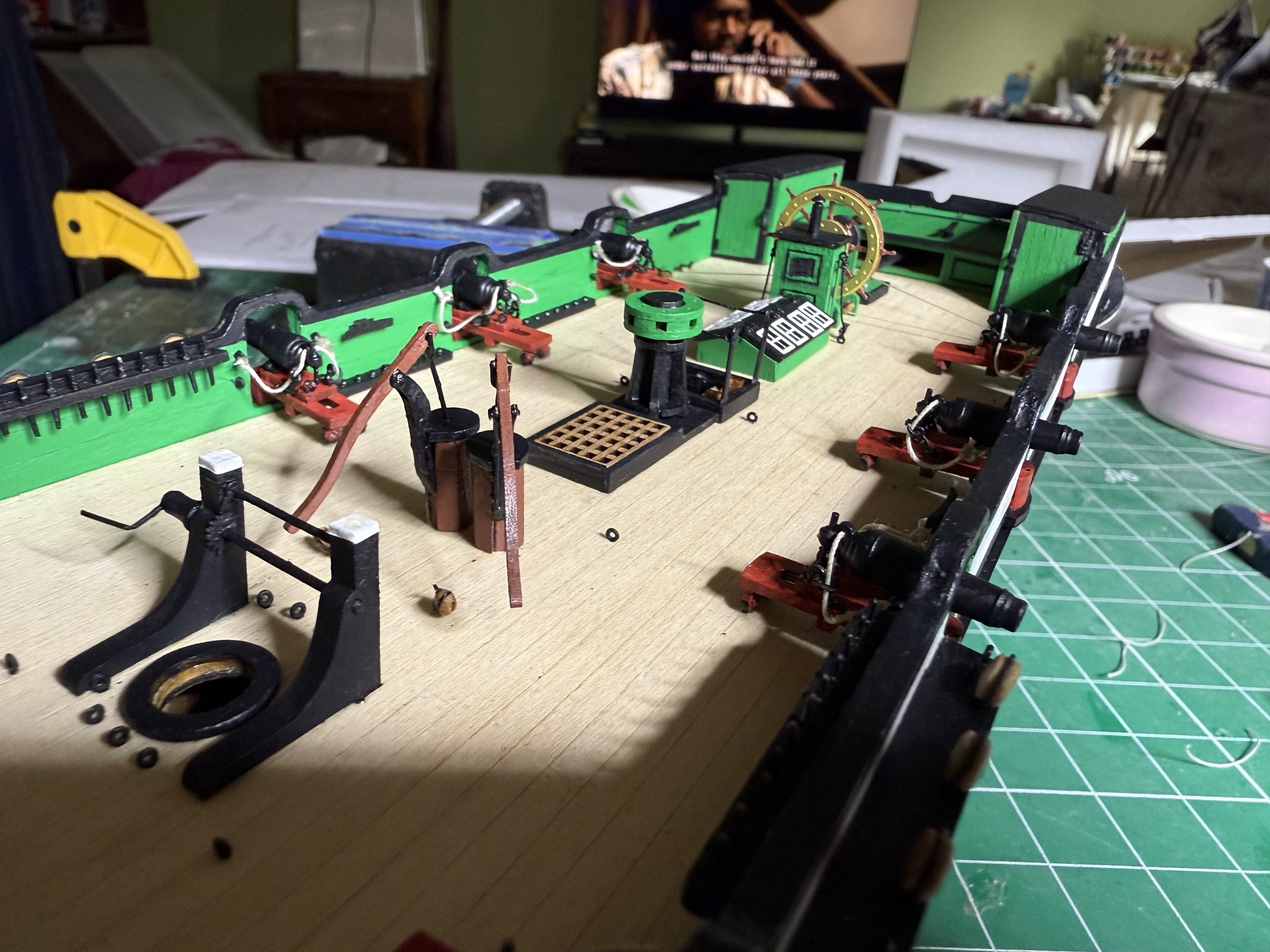

Completed fore and main masts. They are both canted  sternward quite a bit . The tops require angling to keep them level . Fortunately when the hounds are placed correctly they give you the angle to trim.
IMG_0295.thumb.jpg.18add59d627b718d11ea8f37ec64db93.jpgIMG_0297.thumb.jpg.cc13b9d66e7ef4fda5b17f2a8f5a8ecf.jpgIMG_0298.thumb.jpg.295686db1a48b92699b6e612789b1523.jpgIMG_0299.thumb.jpg.a0c6ff098bf100a123069b19bd3cd9fc.jpgIMG_0301.thumb.jpg.58f9e734bdf73fff389f473d9bec0748.jpgIMG_0302.thumb.jpg.2a2cfe5f2392a5ccffdec3a1ddabce40.jpg
