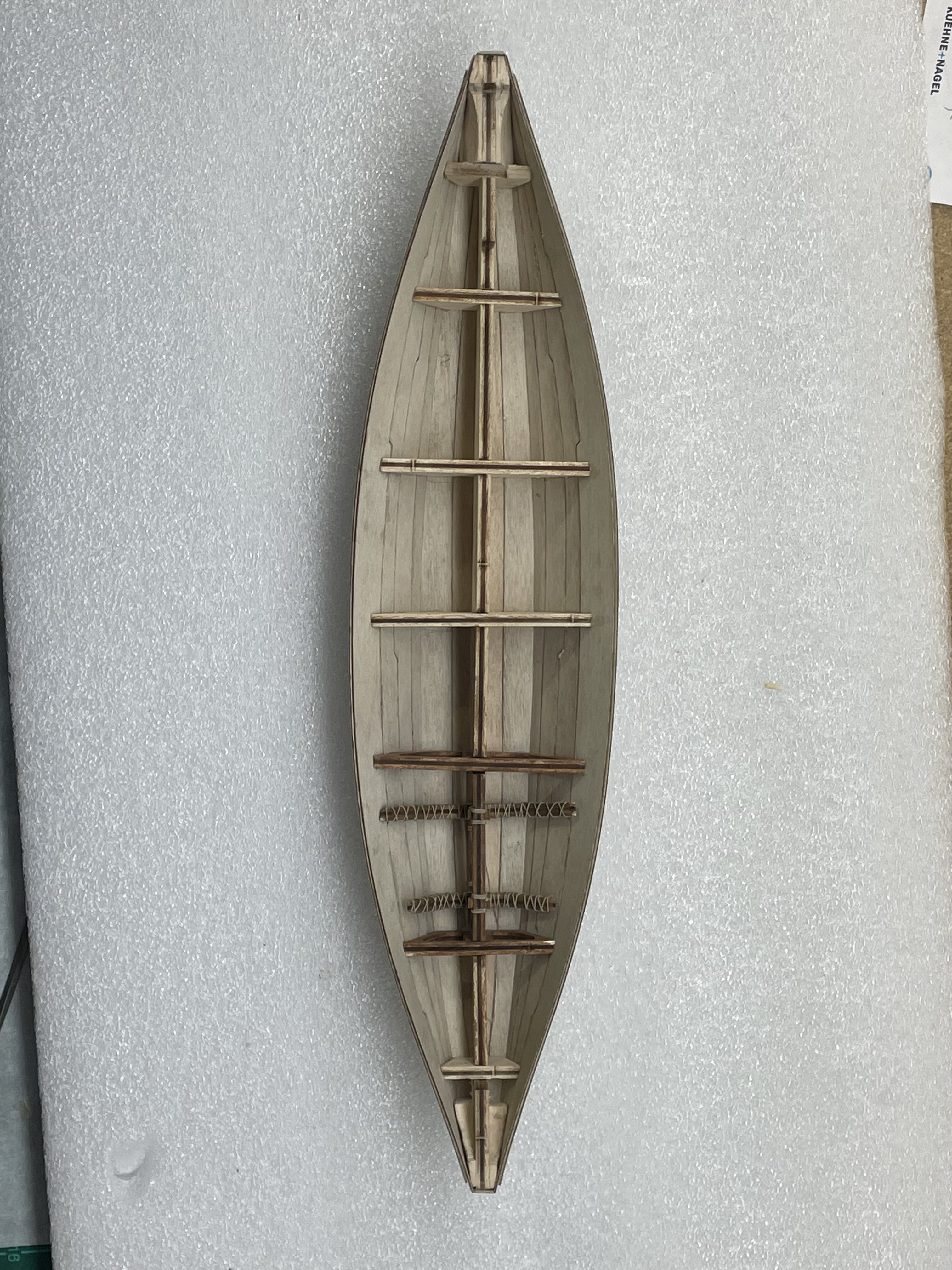

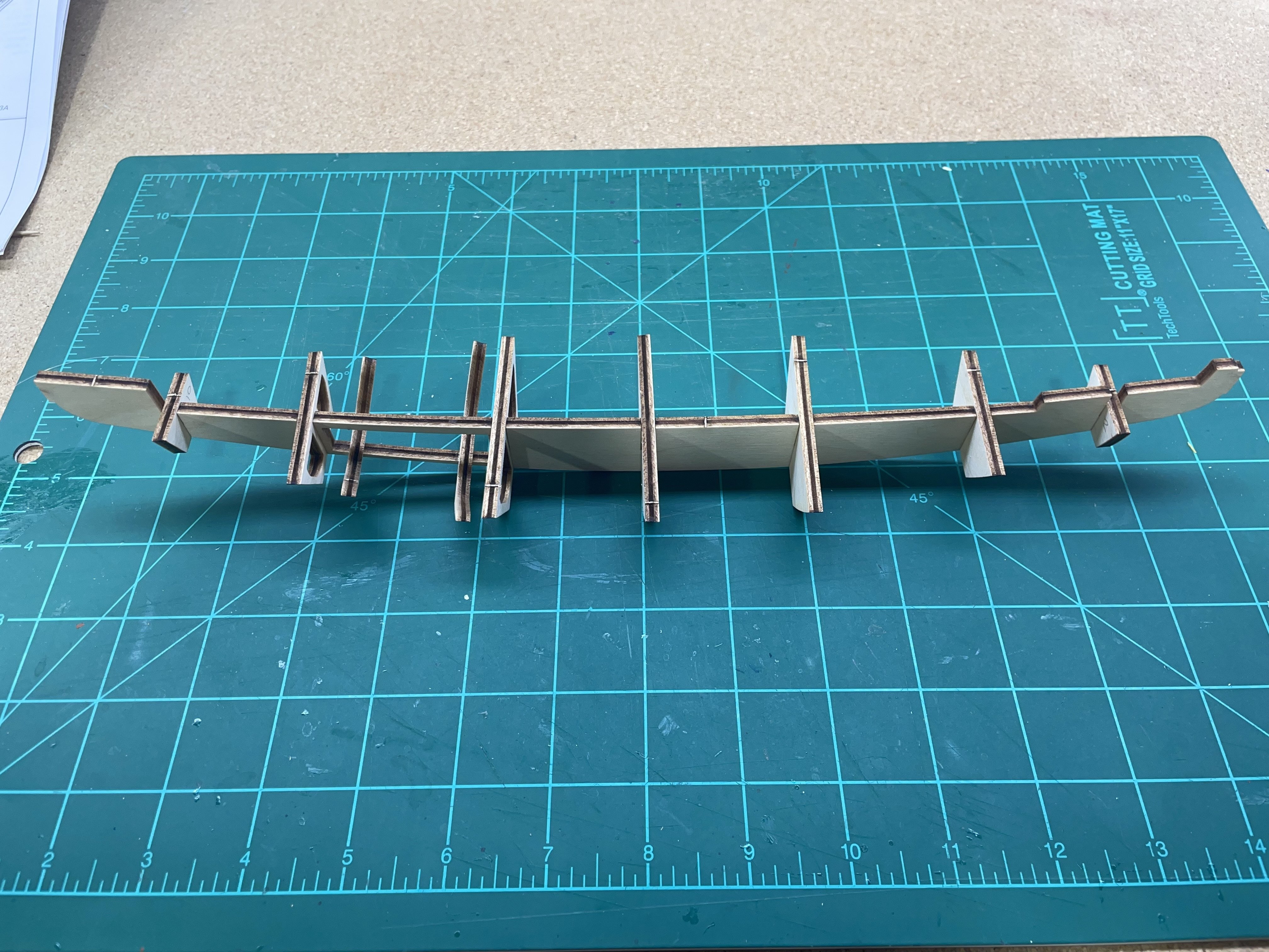

It started out pretty simple. I cut loose the spine and frames and dry fitted them.

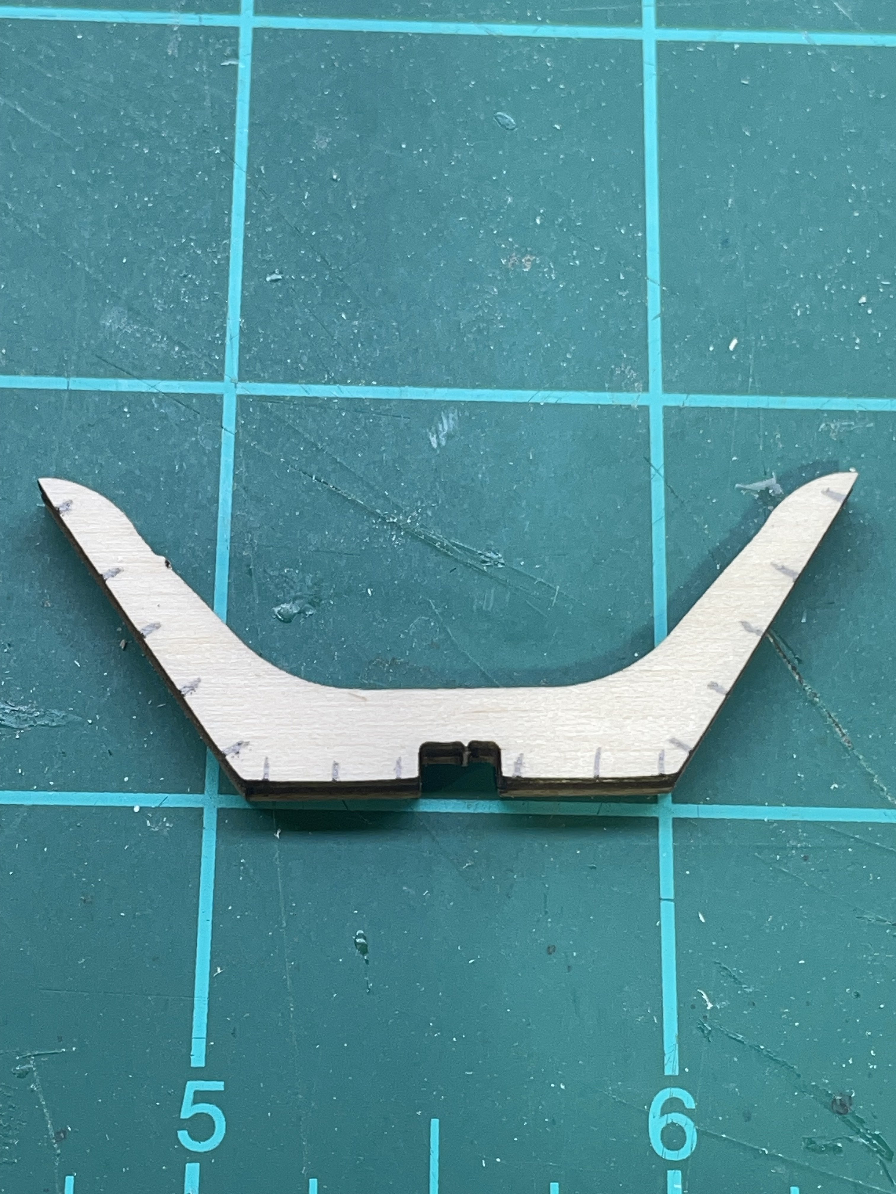

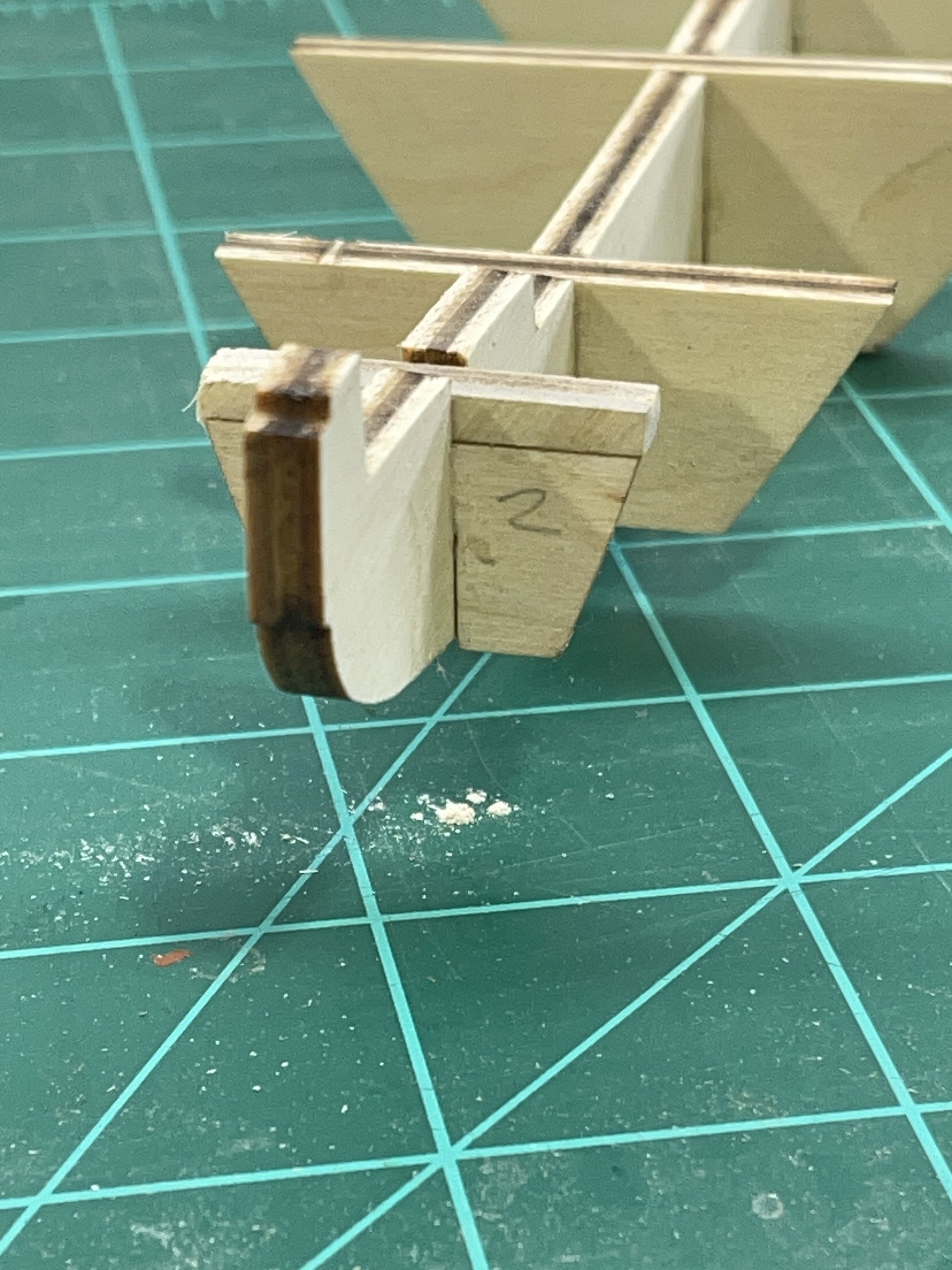

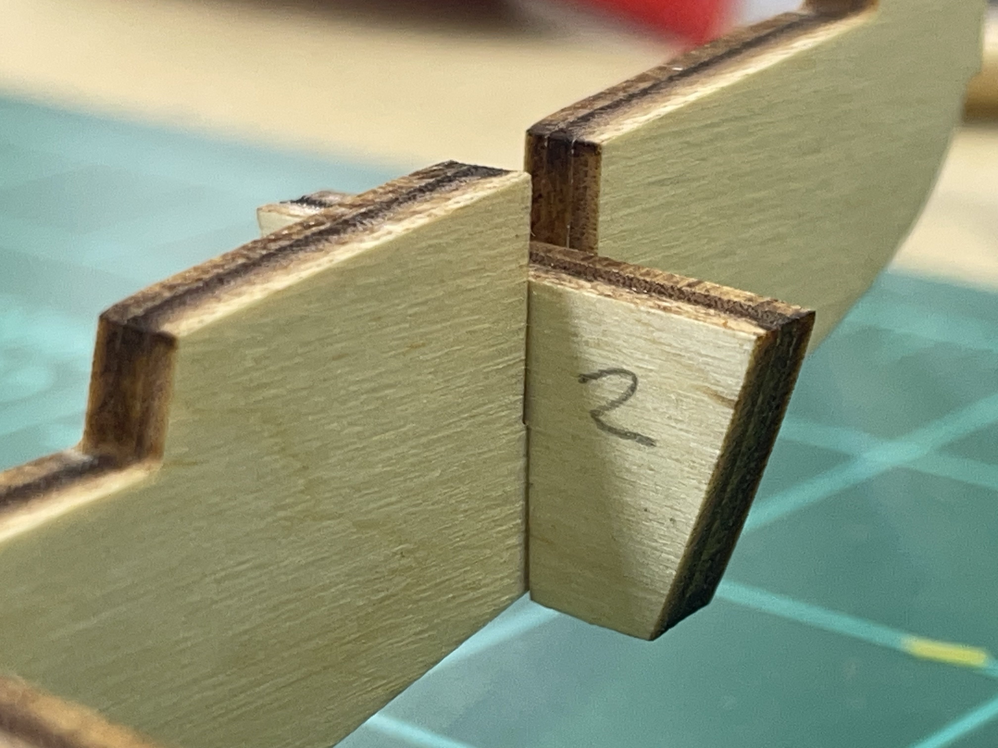

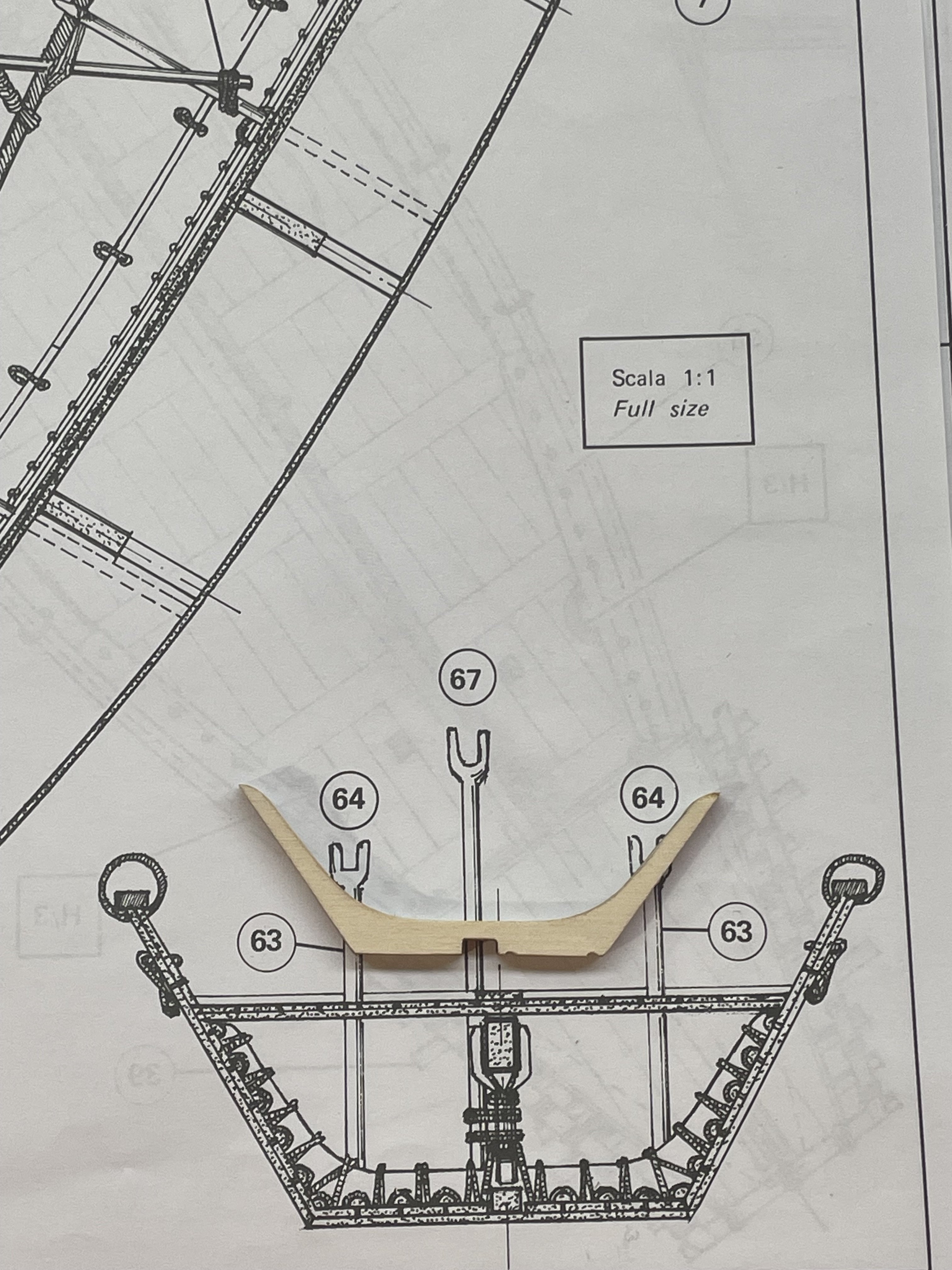

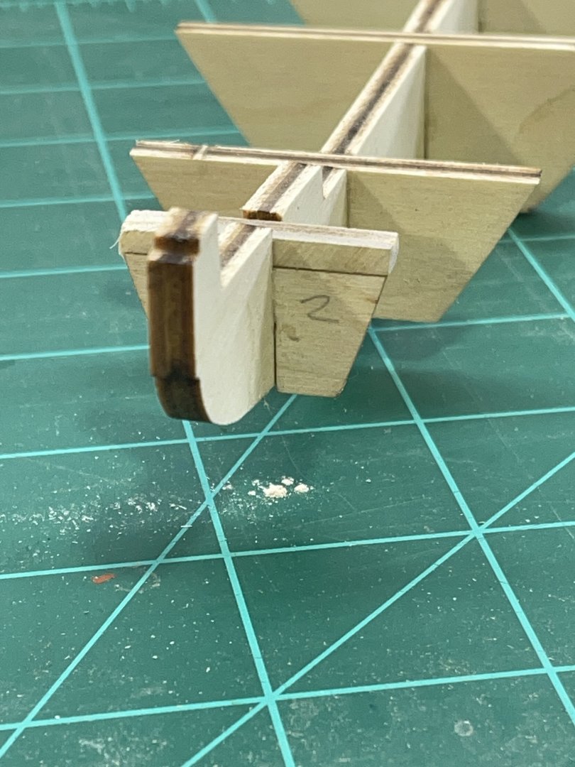

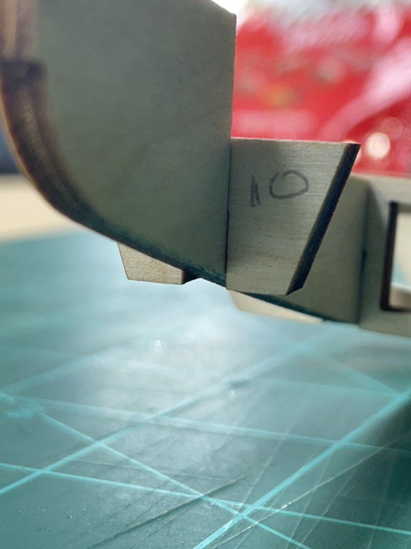

Frames #2 & #10 are close to the same size. The parts are not numbered. You must compare them by the plan. #2 was found lacking at the stern.
#10 fit better at the bow.
I cut off a piece of the carrier and glued it to the top of frame 2. It’s still lacking but I’ll be able to build it up before the deck goes on.
I started gluing the frames at the stern moving towards the bow until I got to #6. The next bay between the frames is exposed and shows the ropes that tie the hull together:-) There is quite a bit of things going on in this part and reading steps ahead I’ve decided to do some of them in a different order than what I have understand the instructions are telling me.

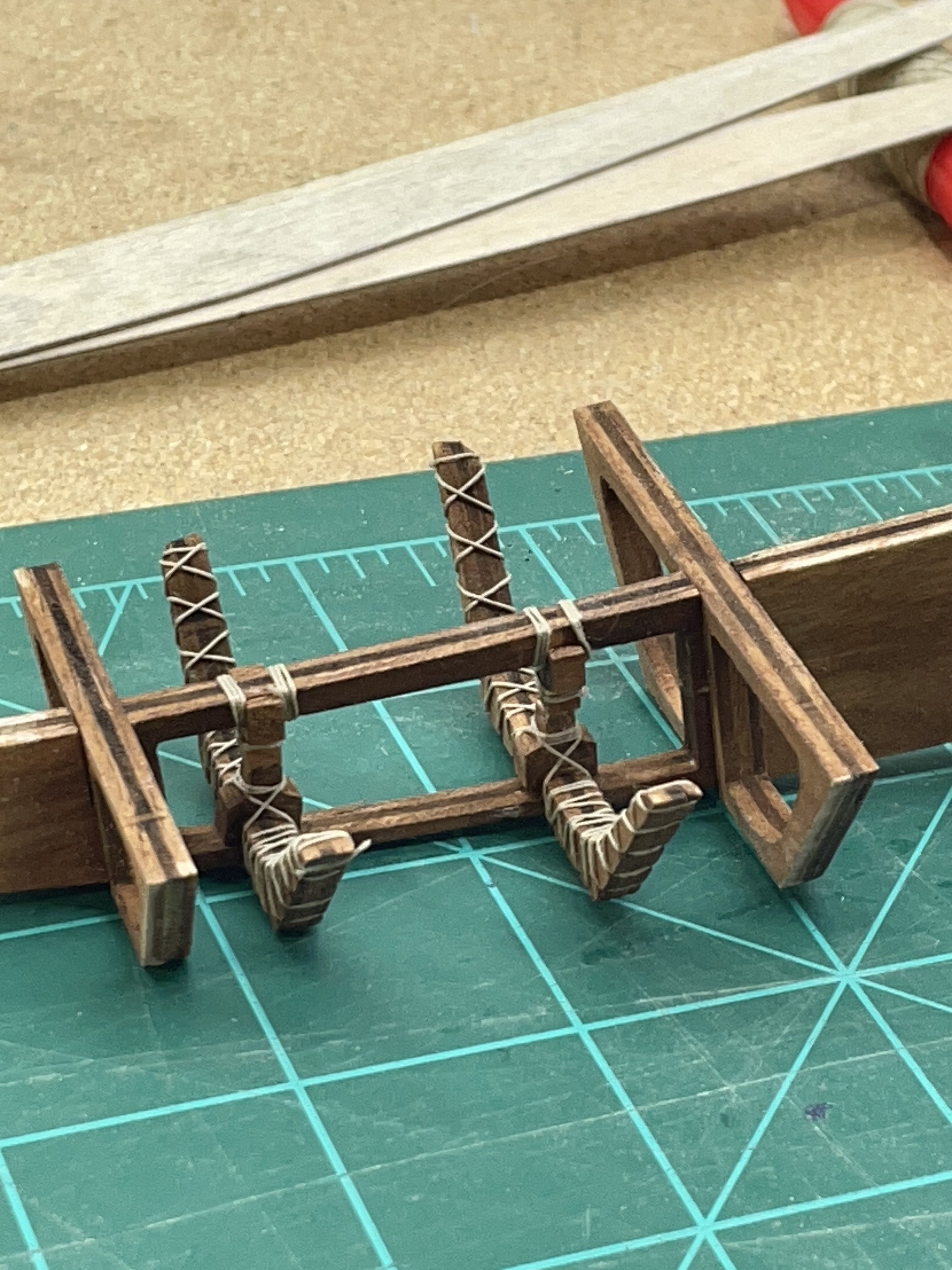

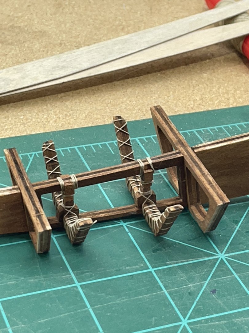

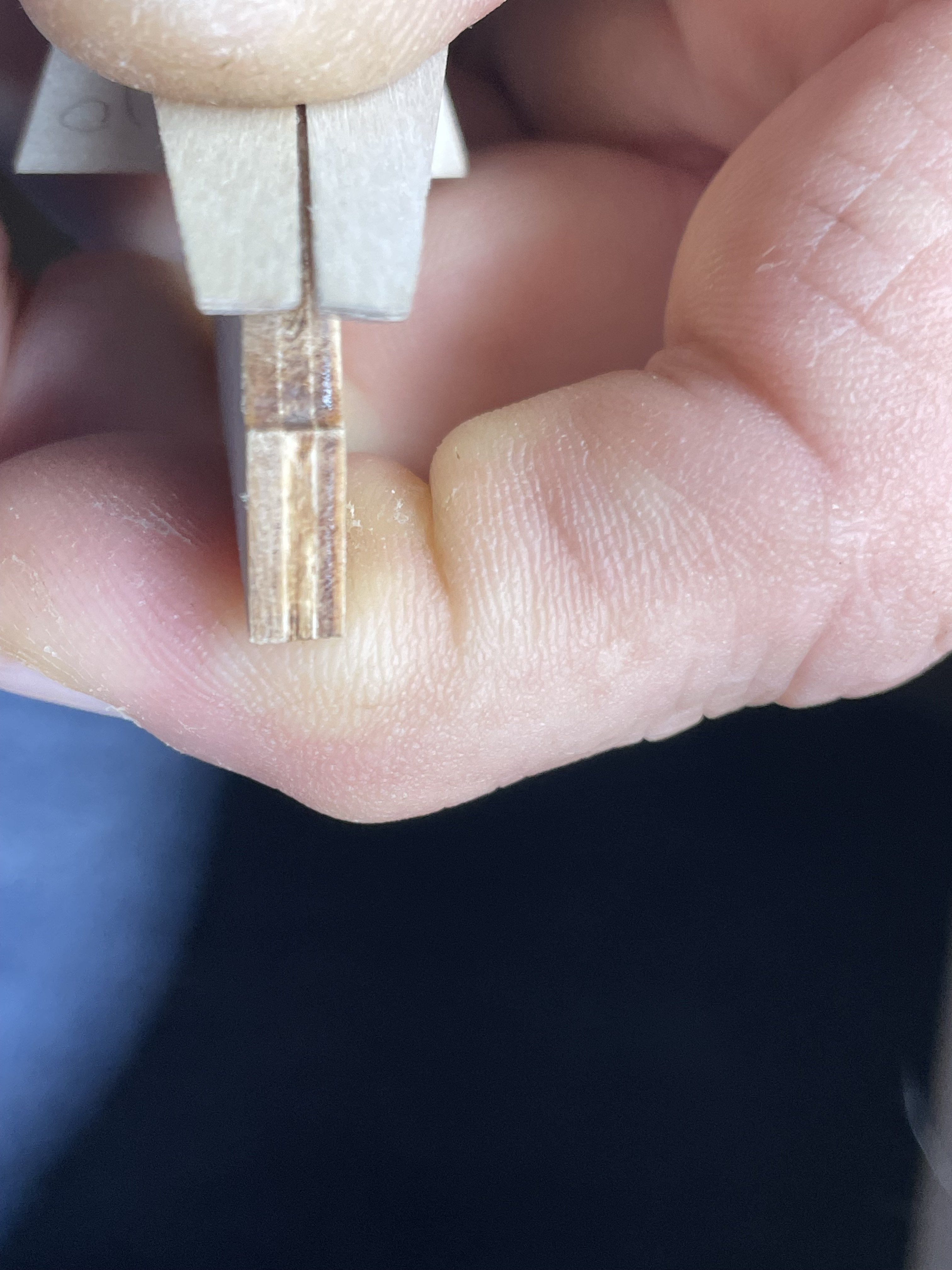

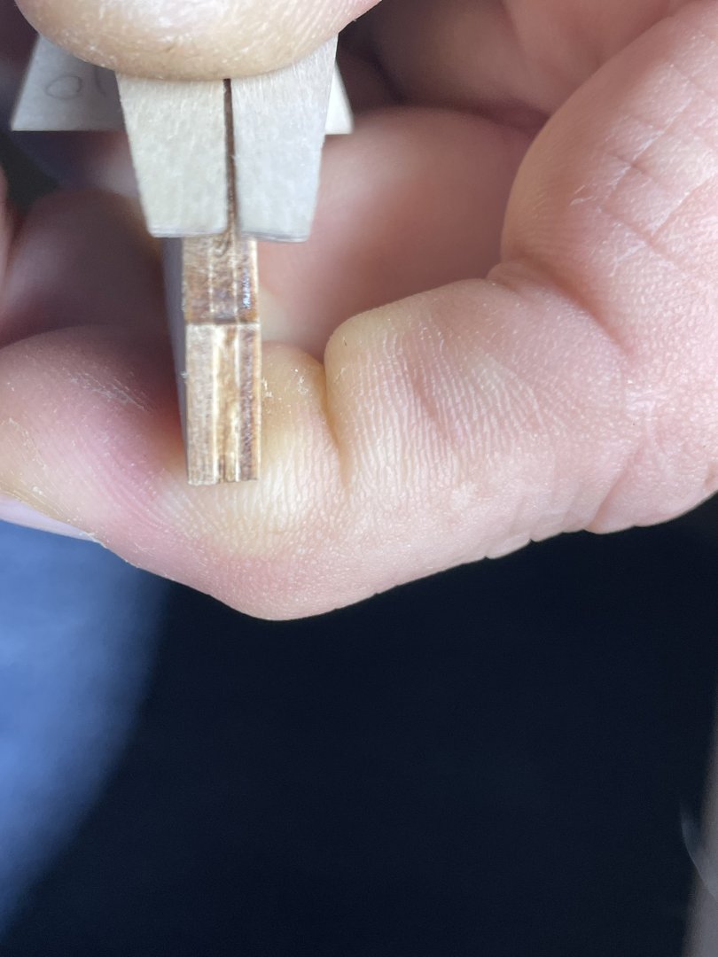

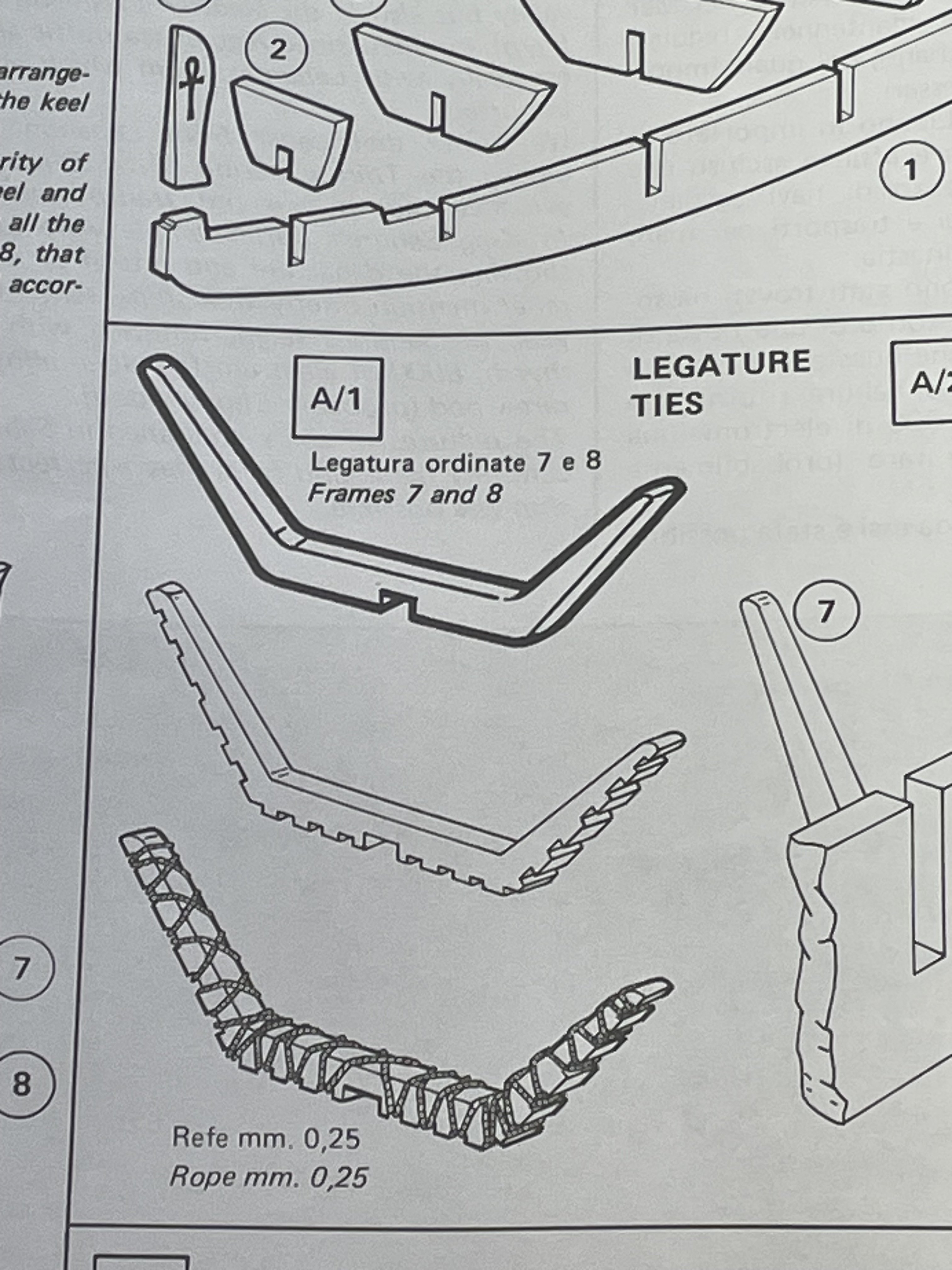

First there are two frames that ropes wrap around.

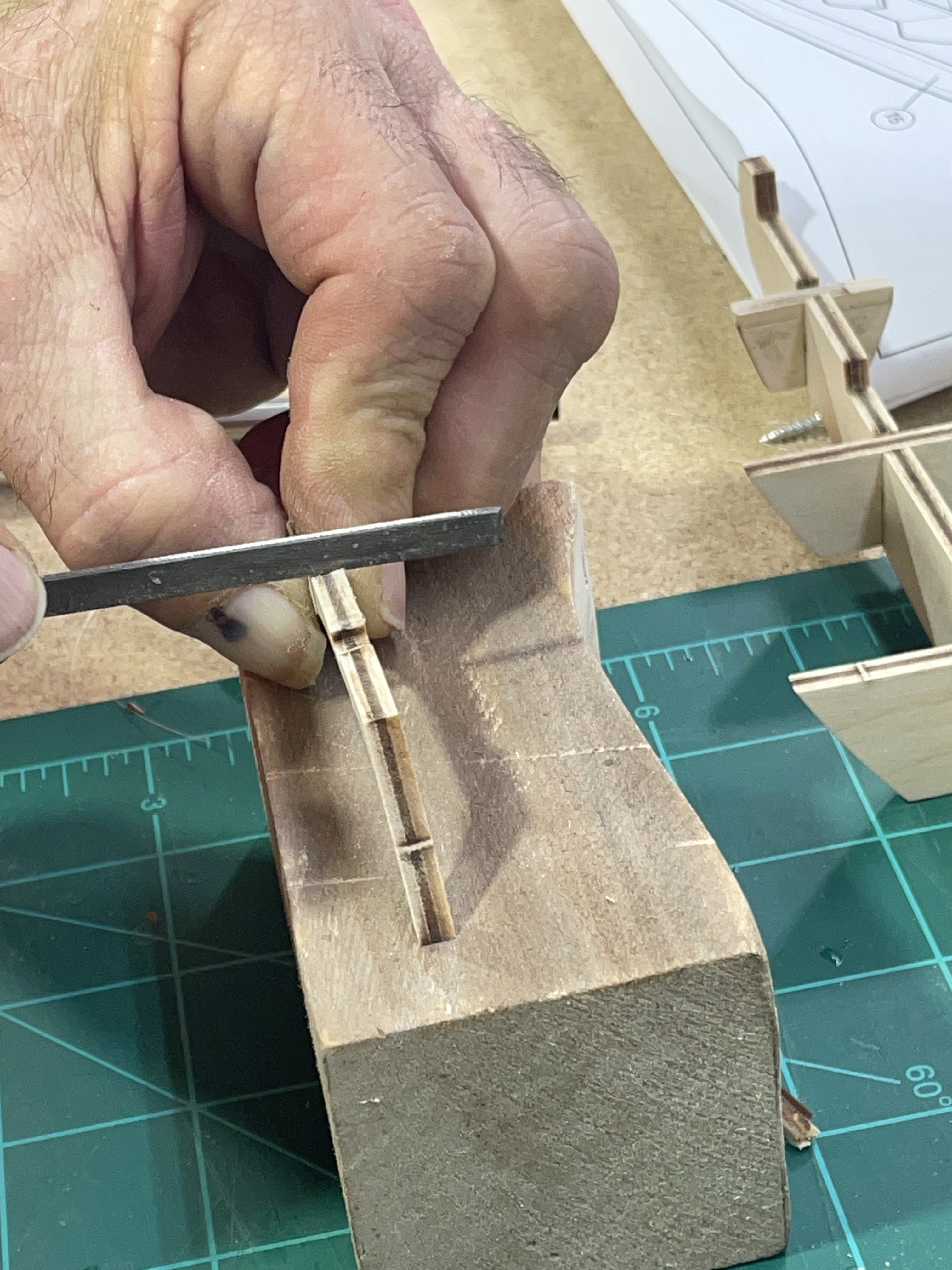

I first marked where the grooves are needed.
Then cut them with the edge of a flat file.

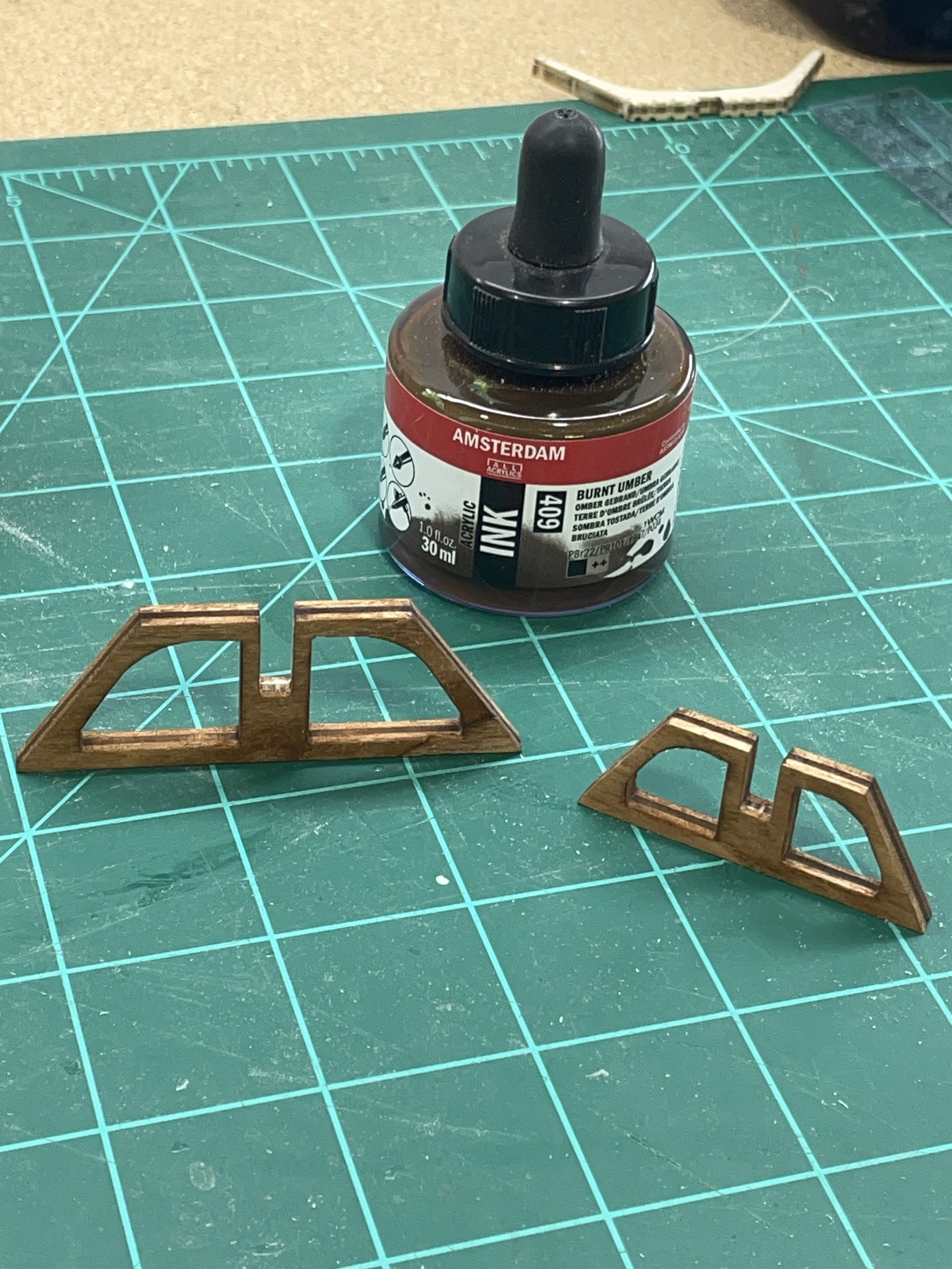

I want to paint as I go to keep from painting the ropes.

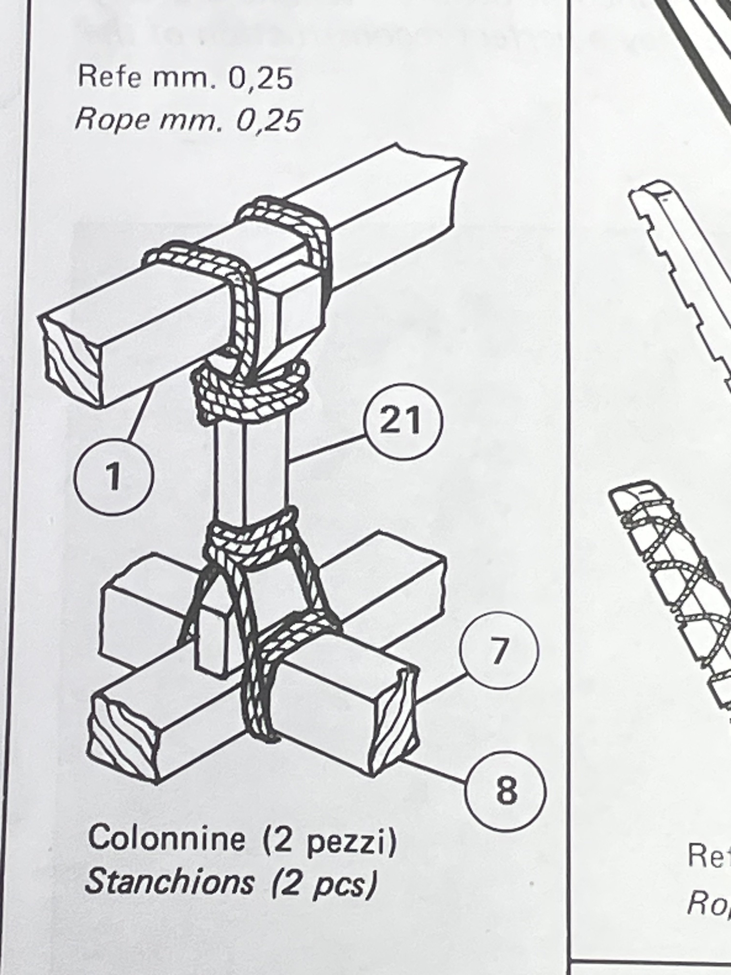

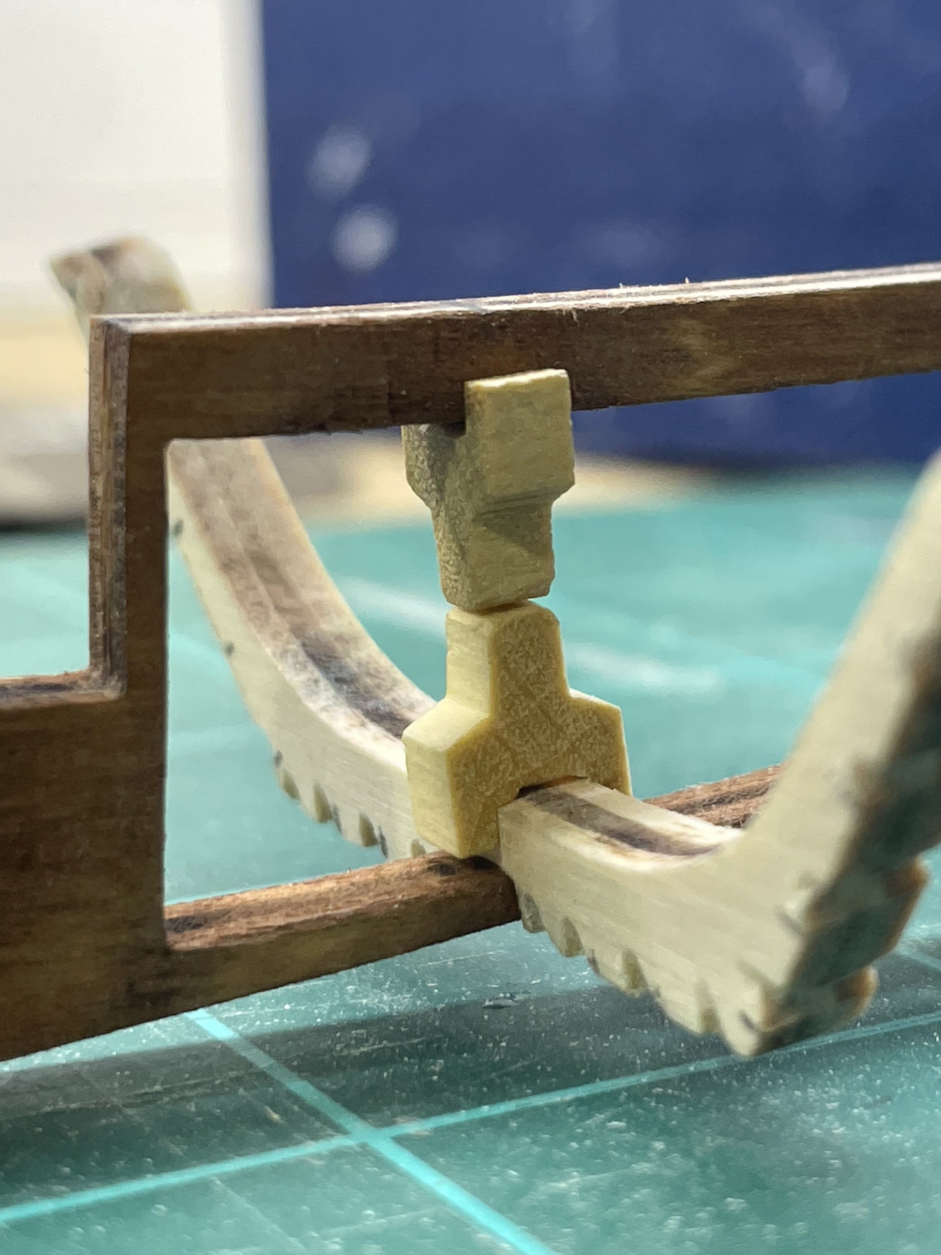

The next challenge comes several steps later but I’m going to deal with it much earlier. It has to exposed stanchions that are also wrapped with rope and are tiny and still to big.
Plus they set on top of the wrapped frames. The plans only show them wrapped separately. One of the frames is  considerably smaller than the other. but the stanchions are the same size:-) I had to file a groove in the top of the smaller frame to hopefully make it small enough. Here is the larger one dry fitted.
I’m thinking I’m going to glue the bottom part on the frame first. Then paint it then wrap it as a whole. I hope I can figure the symmetrical pattern they used when wrapping’’em up.

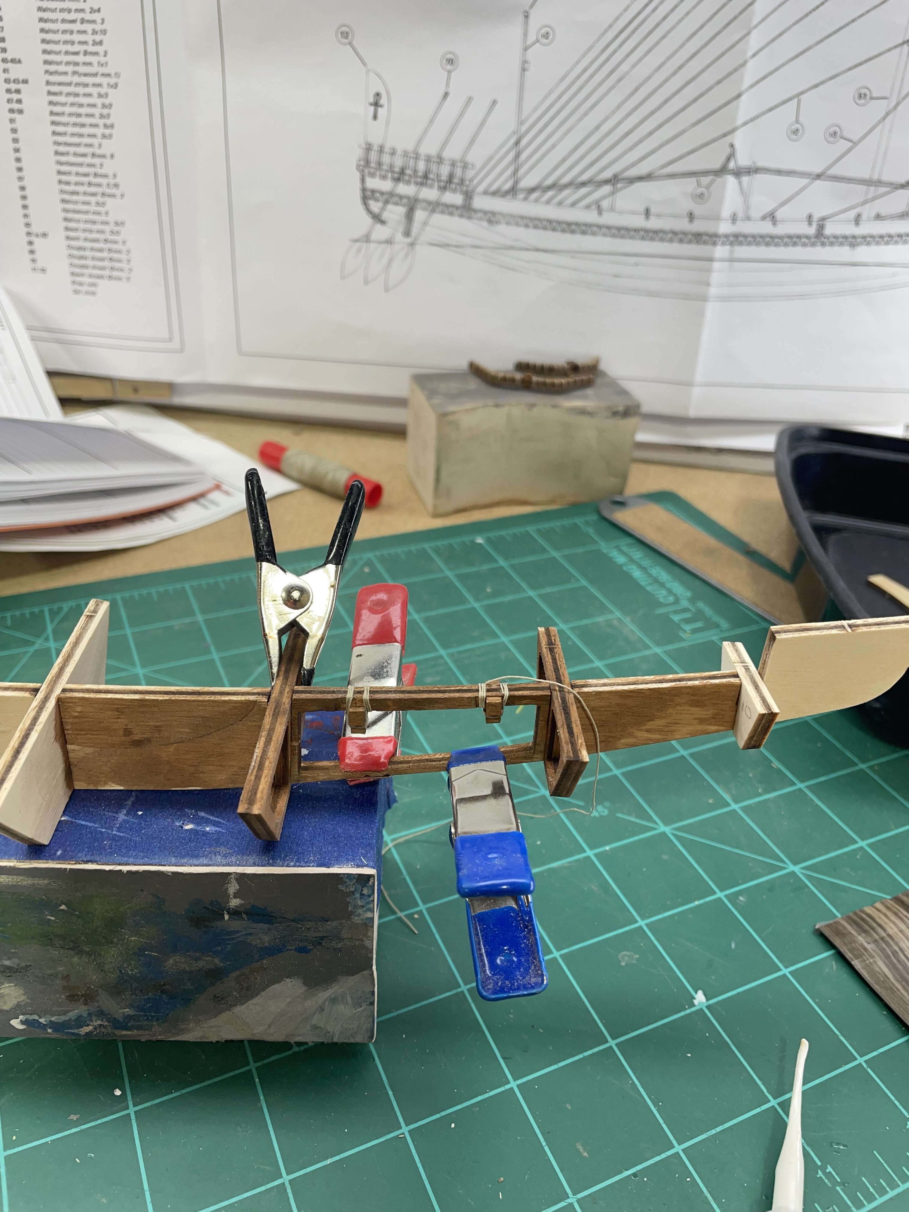

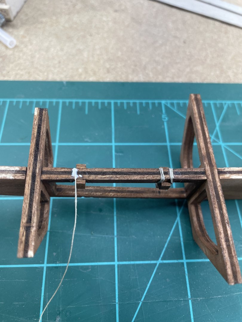

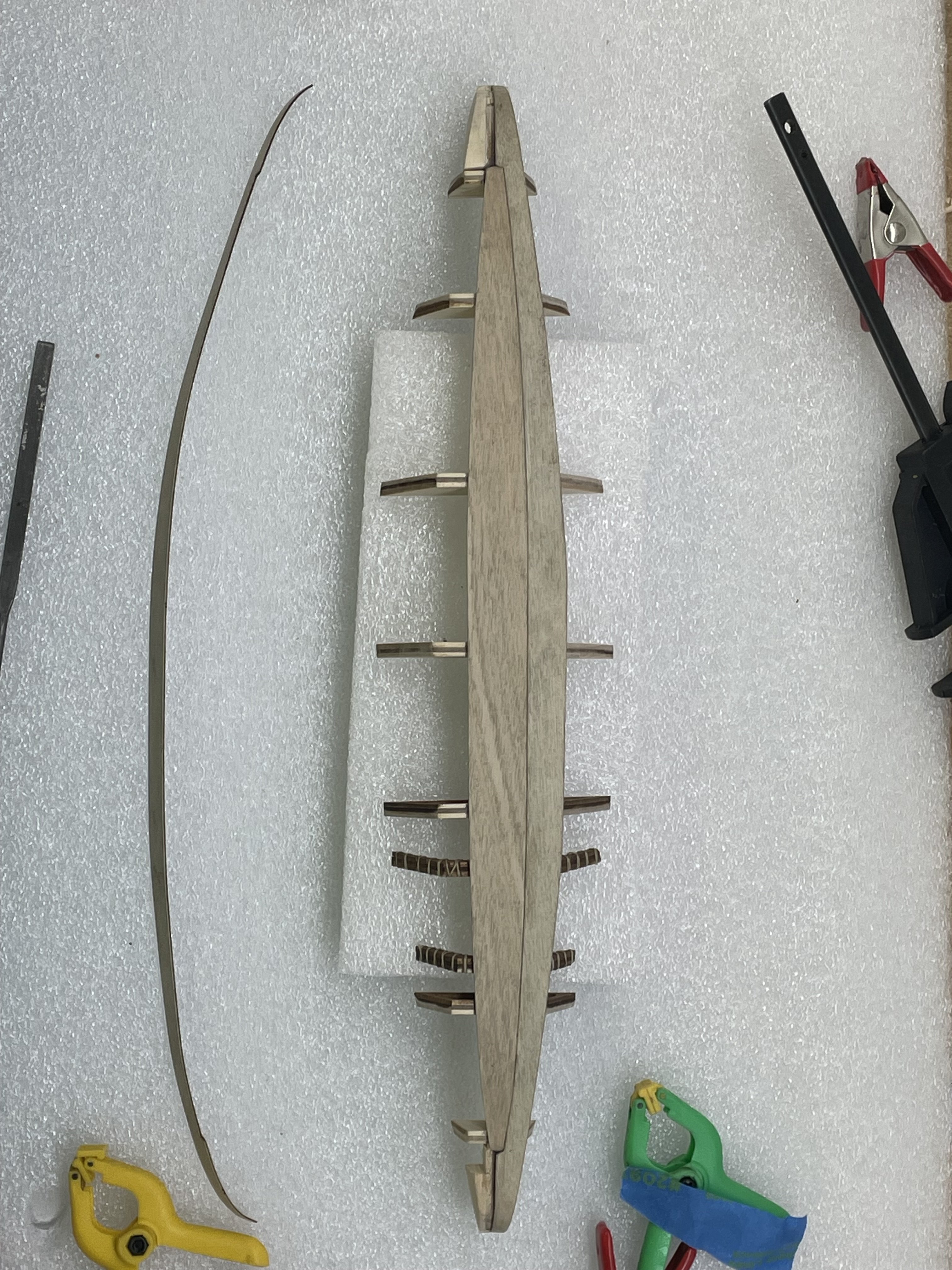

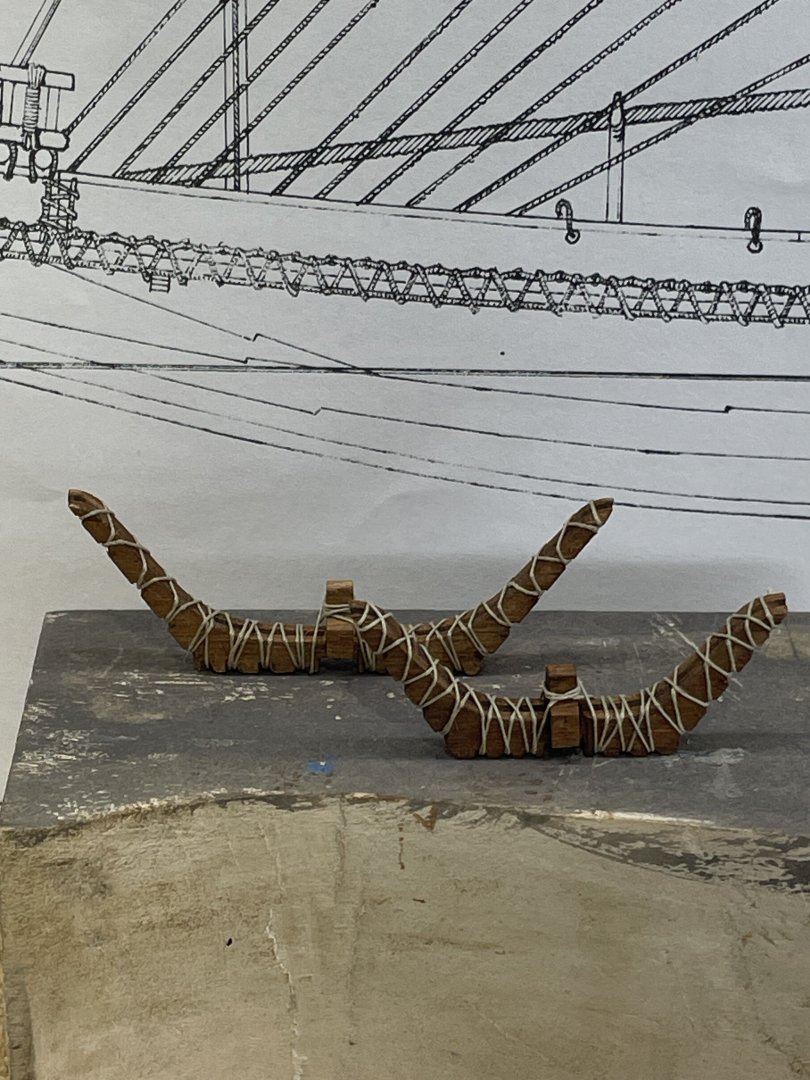

I got the two exposed frames ready and the other two halves of the stachions glued to the spine.

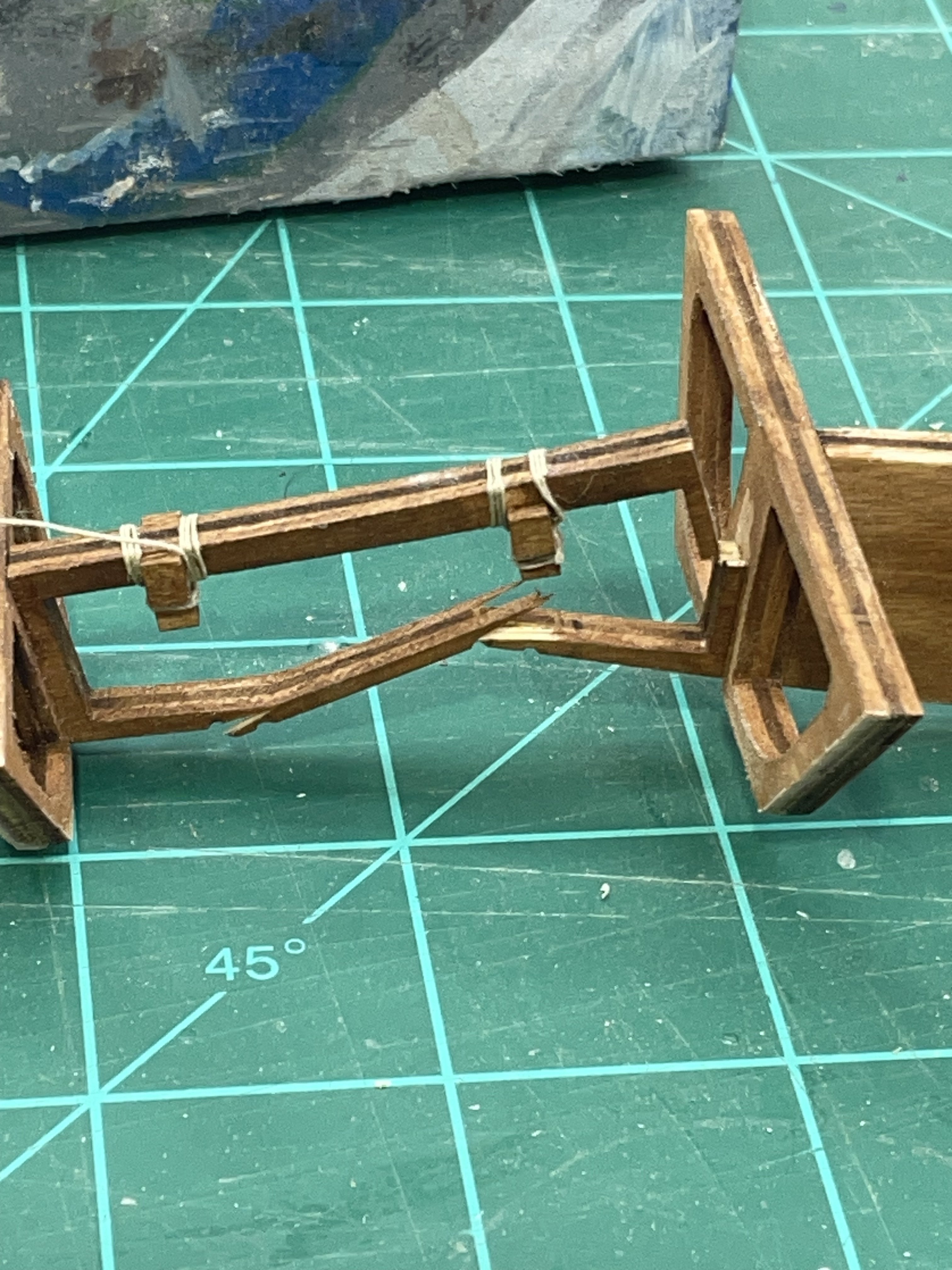

Next I need to fair the bottom of the hull. I’ll see how those planks fit before I install these two frames. I’m thinking I may break them off with it upside down.

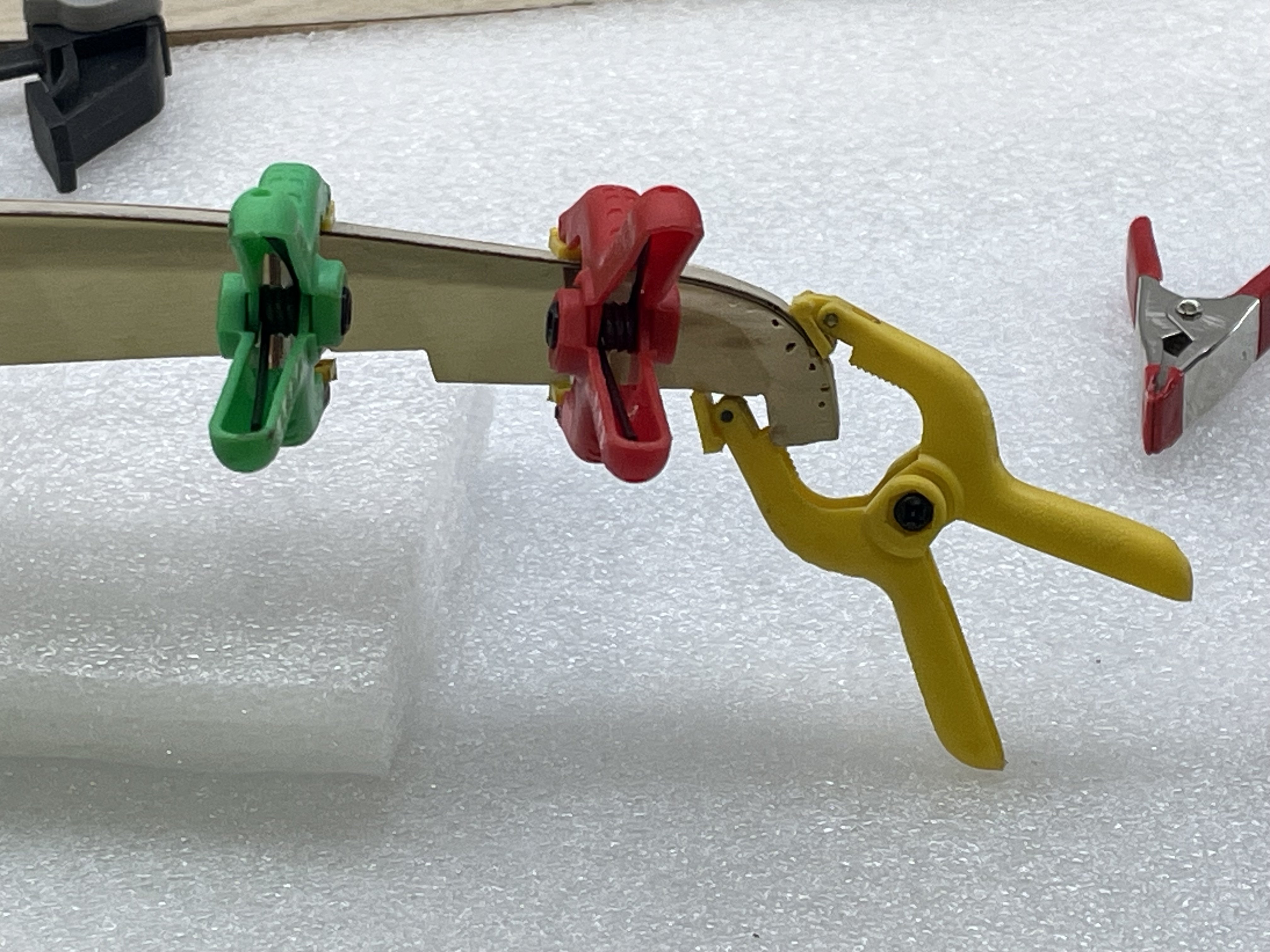

While I was seeing if those bottom planks fit before I install those other two frames:-/ I realized they may have wanted me to install them so that the spline won’t snap into while checking the planks.
I quickly jumped into first response mode and dabbed glue between the three breaks before they came apart.
Then grabbed clamps and all the excitement ended with relief:-)

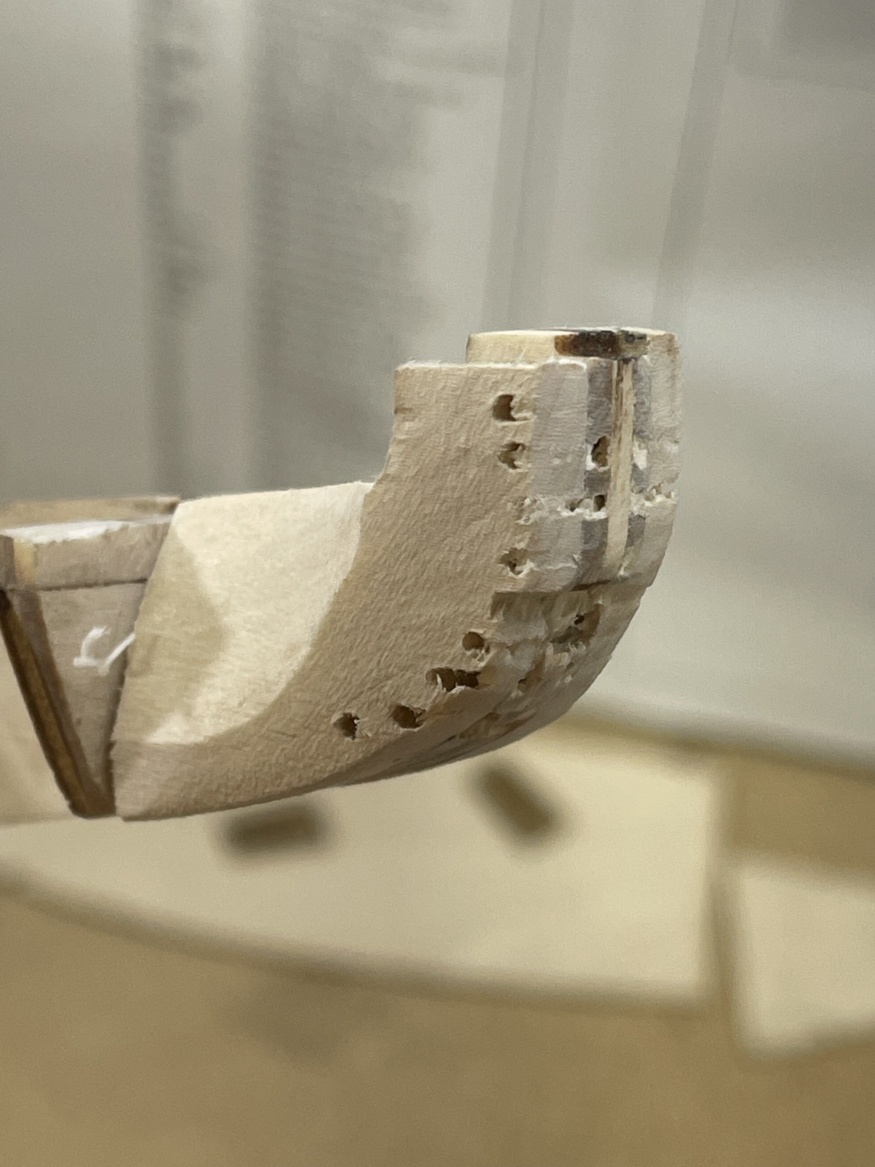

This build is definitely a thinker. I’ve tried to stay several steps ahead.  It seems every time I set down and think I discover more obstacles. Looking ahead at the holes to be drilled in both ends of the hull. They are supposed to get two 1mm ropes. That’s big holes. I tried the stern end starting with a  .5mm bit and went up to 1.7 mm. It wasn’t pretty.
I found a YouTube build that was French. He did a good job, even though I couldn’t understand what he was saying he used he’s hands enough I followed along. Well with part of it, there’s a bunch of hours to still be seen. He waited till the hull was completed then just drilled it while holding it with one hand, cordless drill in the other.
The bottom planks share the 2mm spine. I was looking forward to sticking them on.

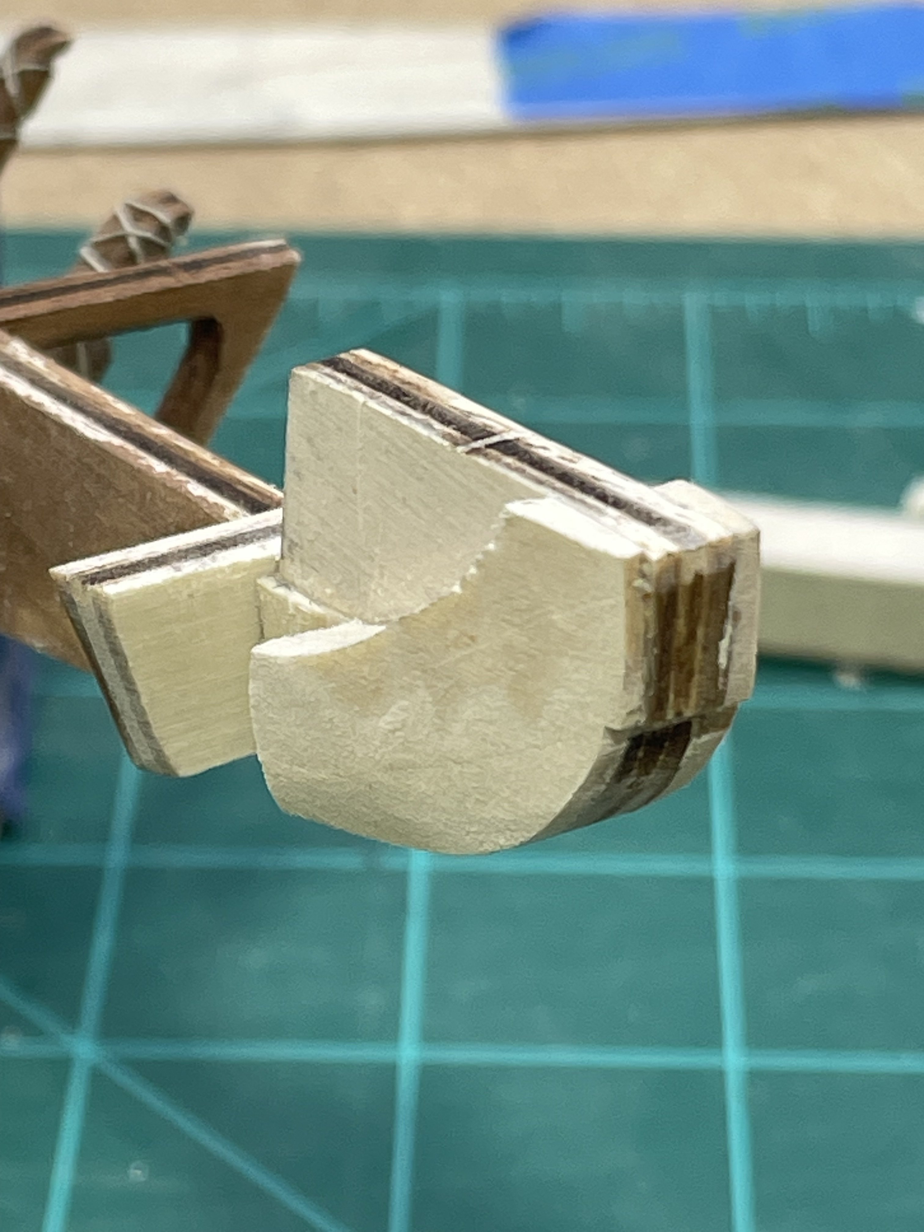

That caused me to make blocks at either end.

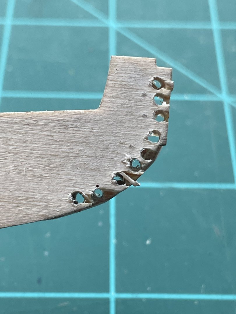

Here’s the stern that I drilled the plywood. It’s probably going to haunt me later. I’m going to wait and follow my leader on the bow.
The blocks may impede with the ropes that run down the sides, they may stop short, we’ll have to see. It’s going to make the planks easier and I probably can use PVA instead of CA.

Hey there Bryan,   may i suggest using a pin vice and hand drilling it - you'll have a lot more control and accuracy.   Good Luck,
Joshua
Joshua
Thanks Joshua, actually I did use a pin vice. But I’m still lacking on the control and accuracy:-)

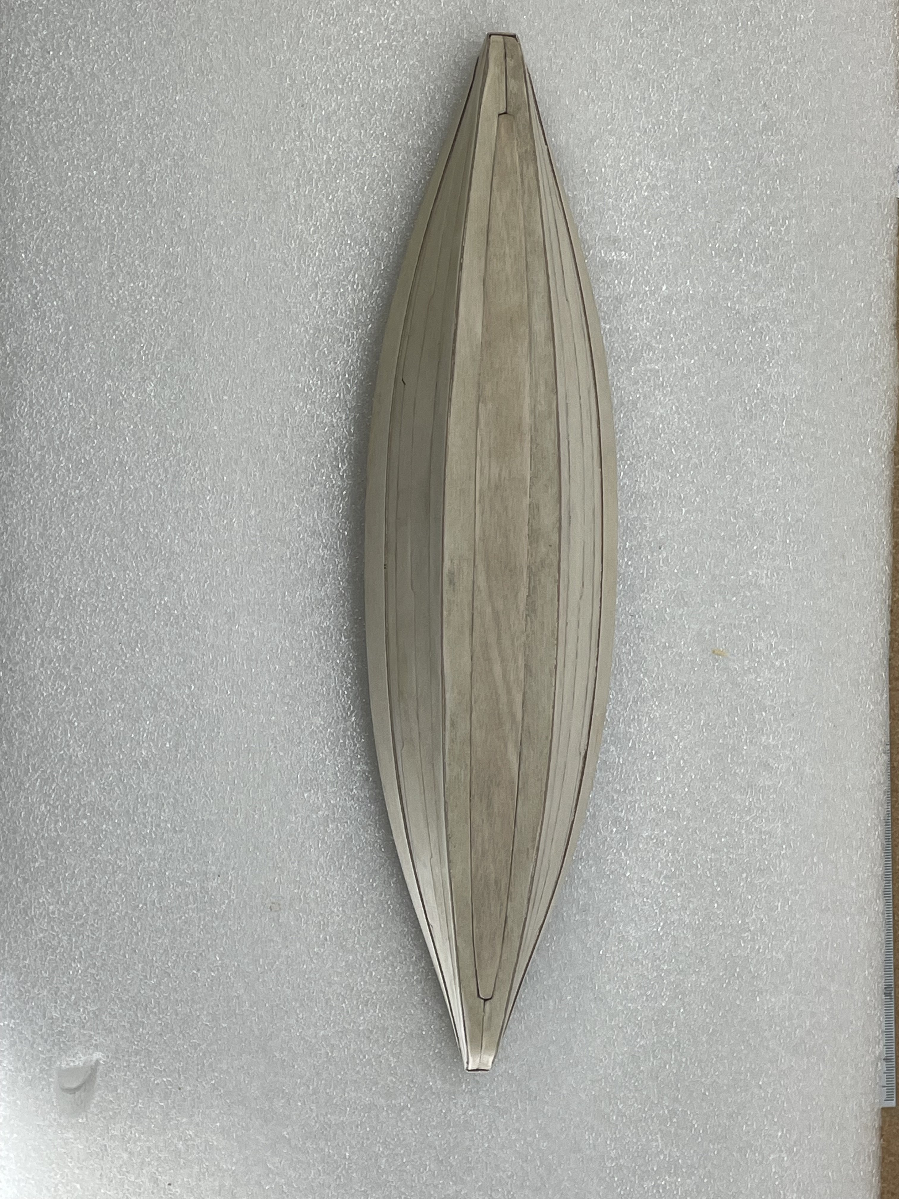

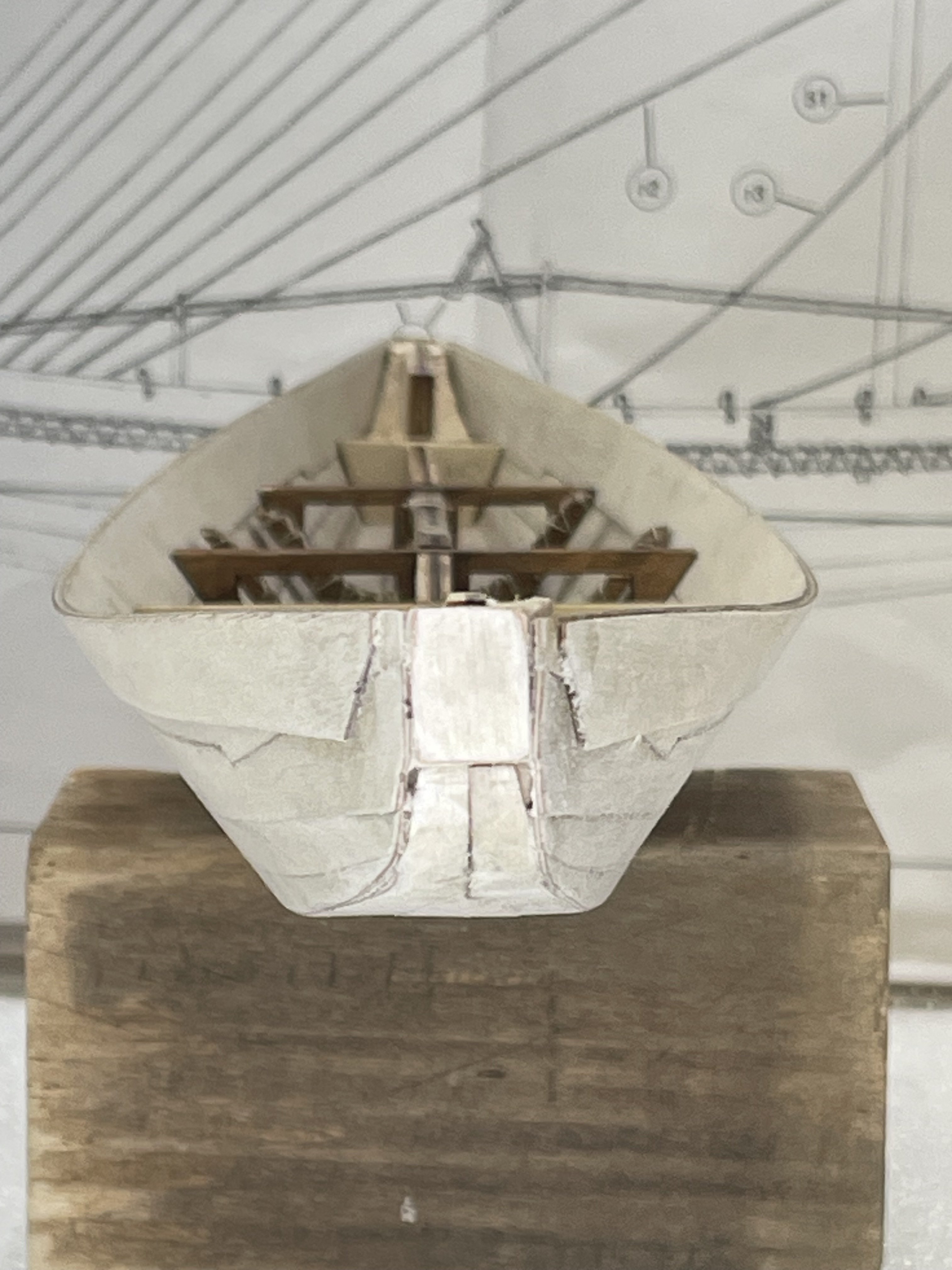

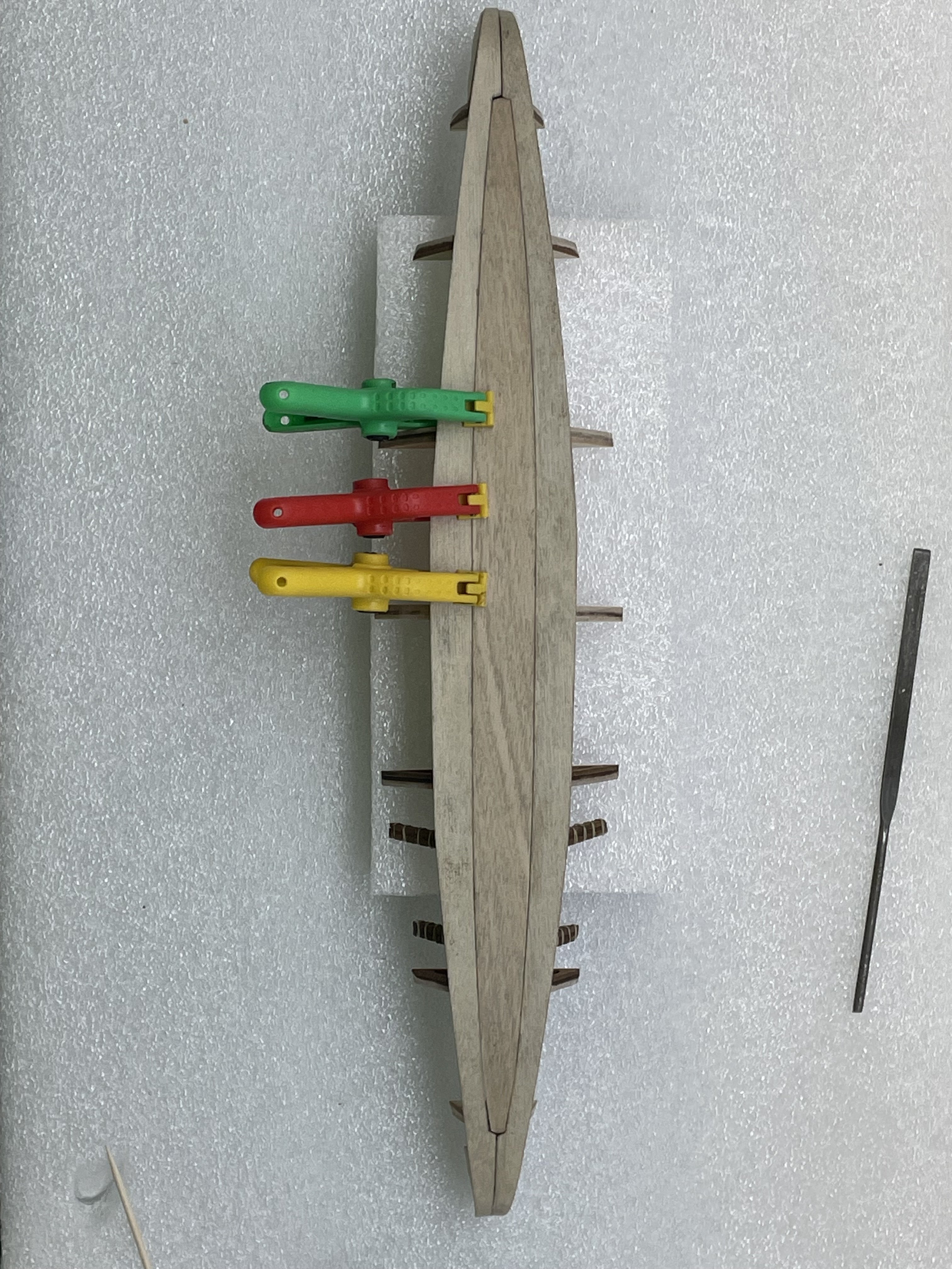

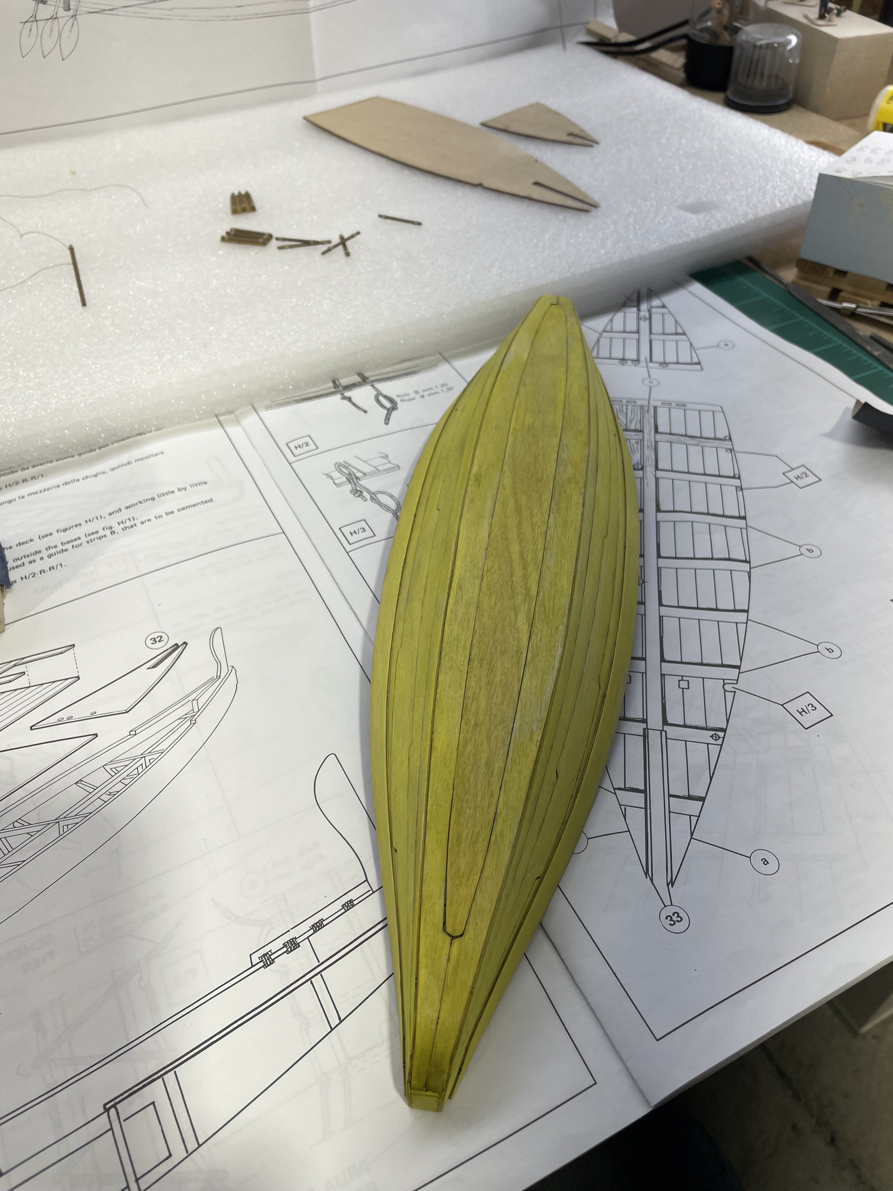

Putting the blocks on the stern and bow made the planks go smoothly. I used PVA glue and clamps, moving a few frames at a time.
The instructions has you glue both sides first and the middle last.  All three planks are wider than bottom of the hull. I chose to fit the middle tight against the side I glued first.
Then the other side.
Now I’ll need to sand the edges down even with the frames and I’ll be ready to install the rest of the planks.

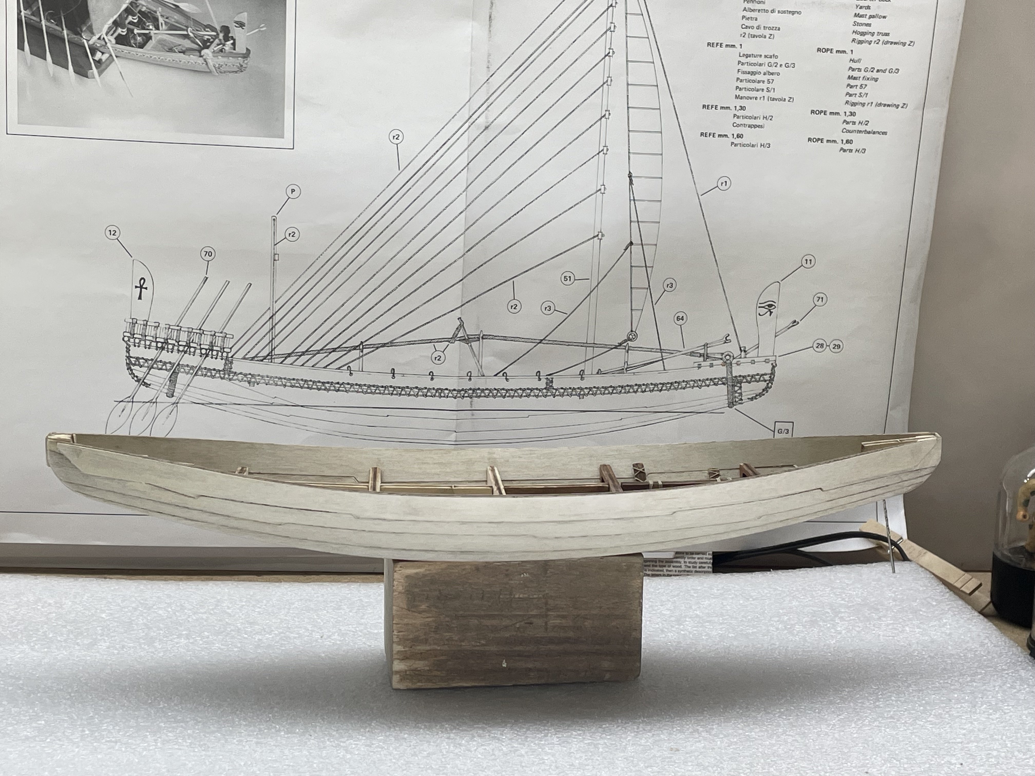

This morning I finished planking the hull.

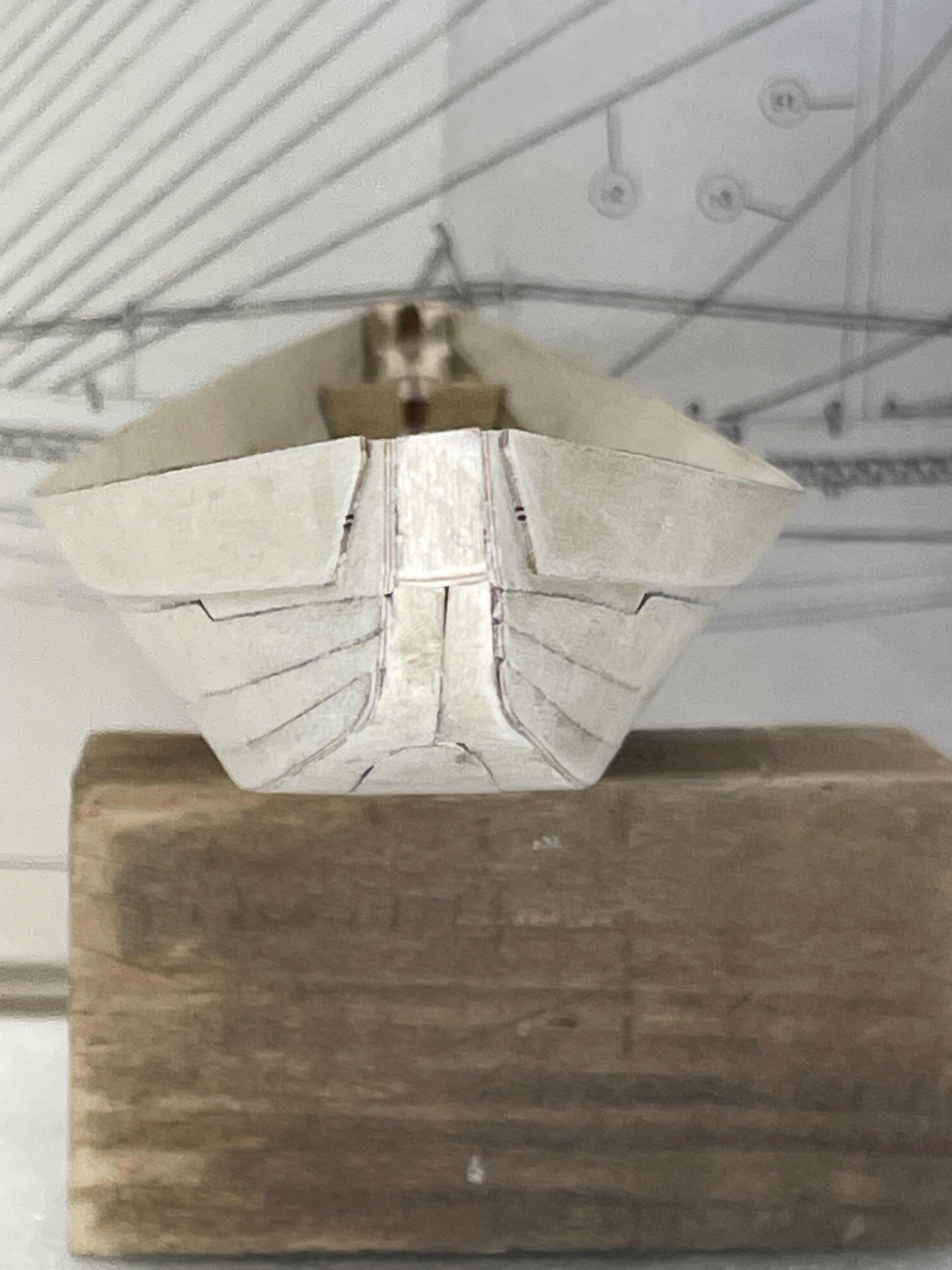

Bow
stern
I’m probably going to paint and finish the hull before I start drilling the holes in the hull for the ropes. It’s going to be very easy to cover myself up on this build, if I don’t look at everything that goes on the deck . All the way to the end of the build.

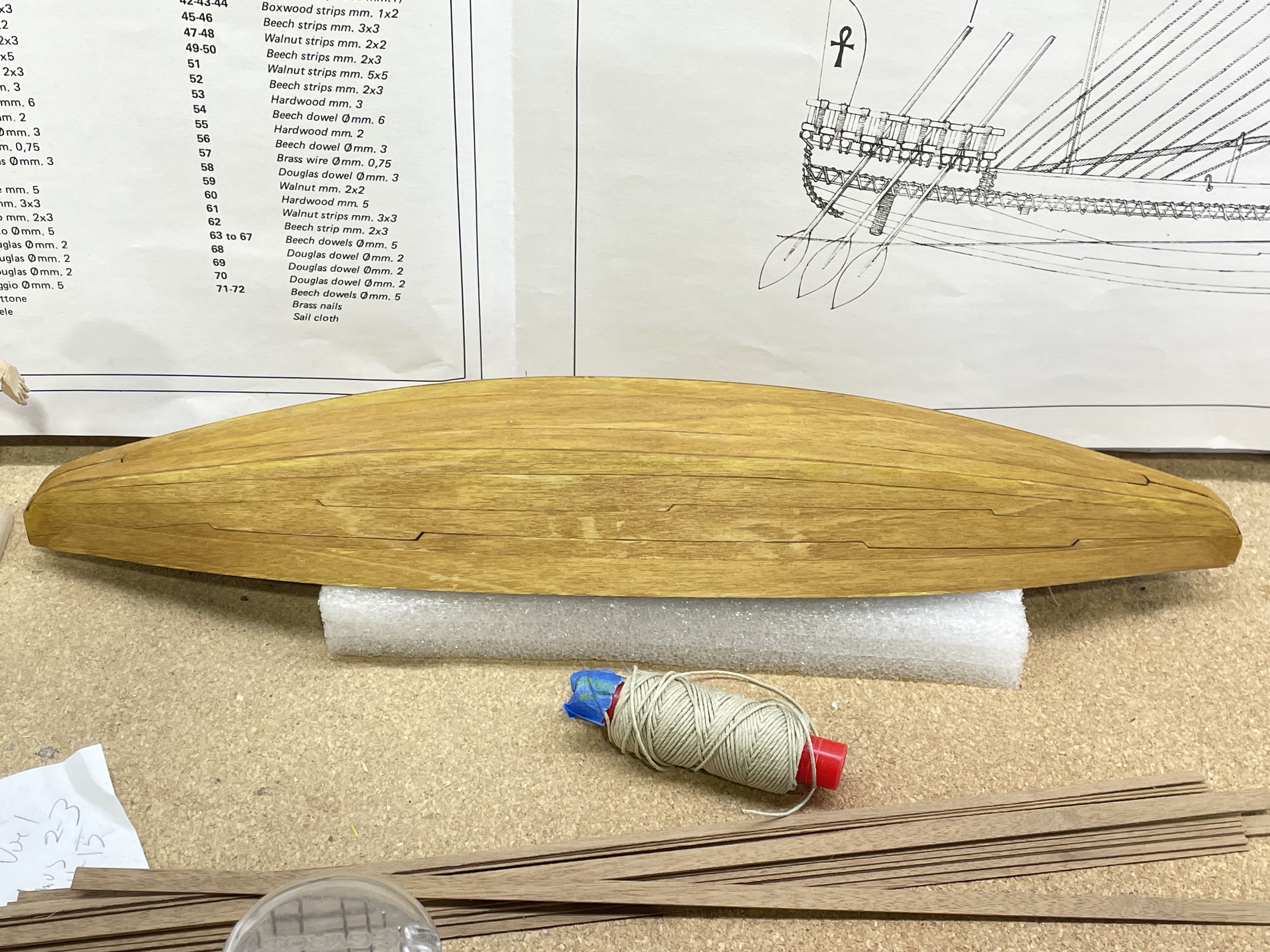

I got the hull painted. I just imagined the color of the original boat. I started with a yellow wash.
Then a burnt umber wash.

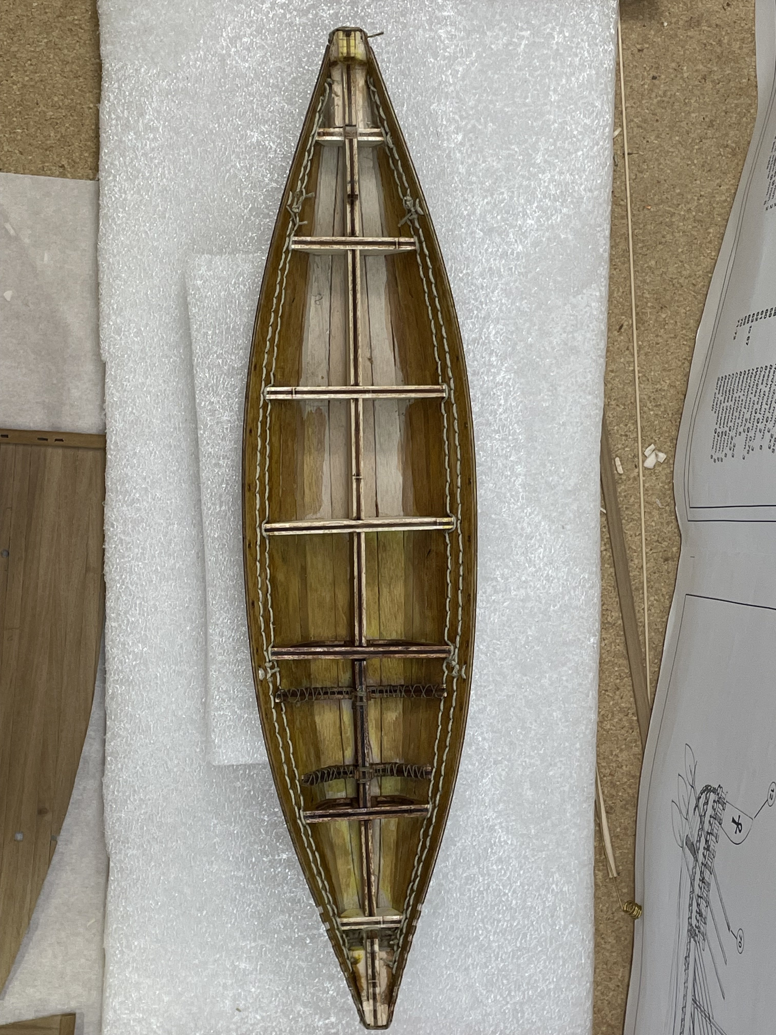

I’ve started planking the deck. Trying to figure out where all the holes go in it. I’m probably going to end up making the mast and all the other poles and things I need to have room for. The plans give very few dimensions, and just a few almost scaled details. The bow and stern blocks are in the way of the decks. I’ll have to carve out some of both.
The top rail supplied with the kit was 3 small pieces of plywood for each side:-/ So I got a piece of 1mm x3 mm walnut to match the rest. I didn’t know how easy it was going to be to edge bend it to fit the hull. But to my surprise it was pretty easy. I sprayed it once with water and ran it through my hair straightener. Then laid it on a curve that I had traced and pinned it down as needed.

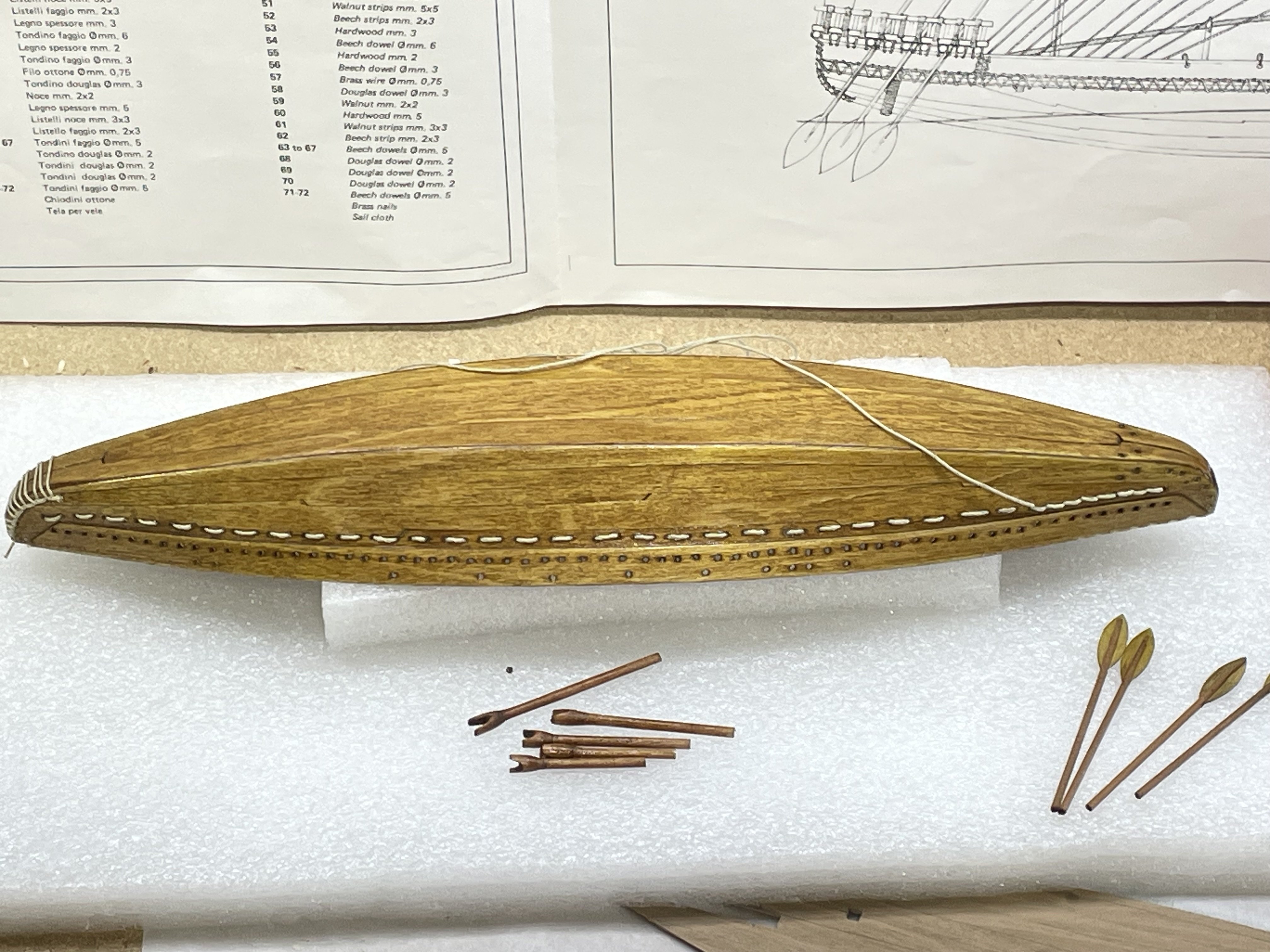

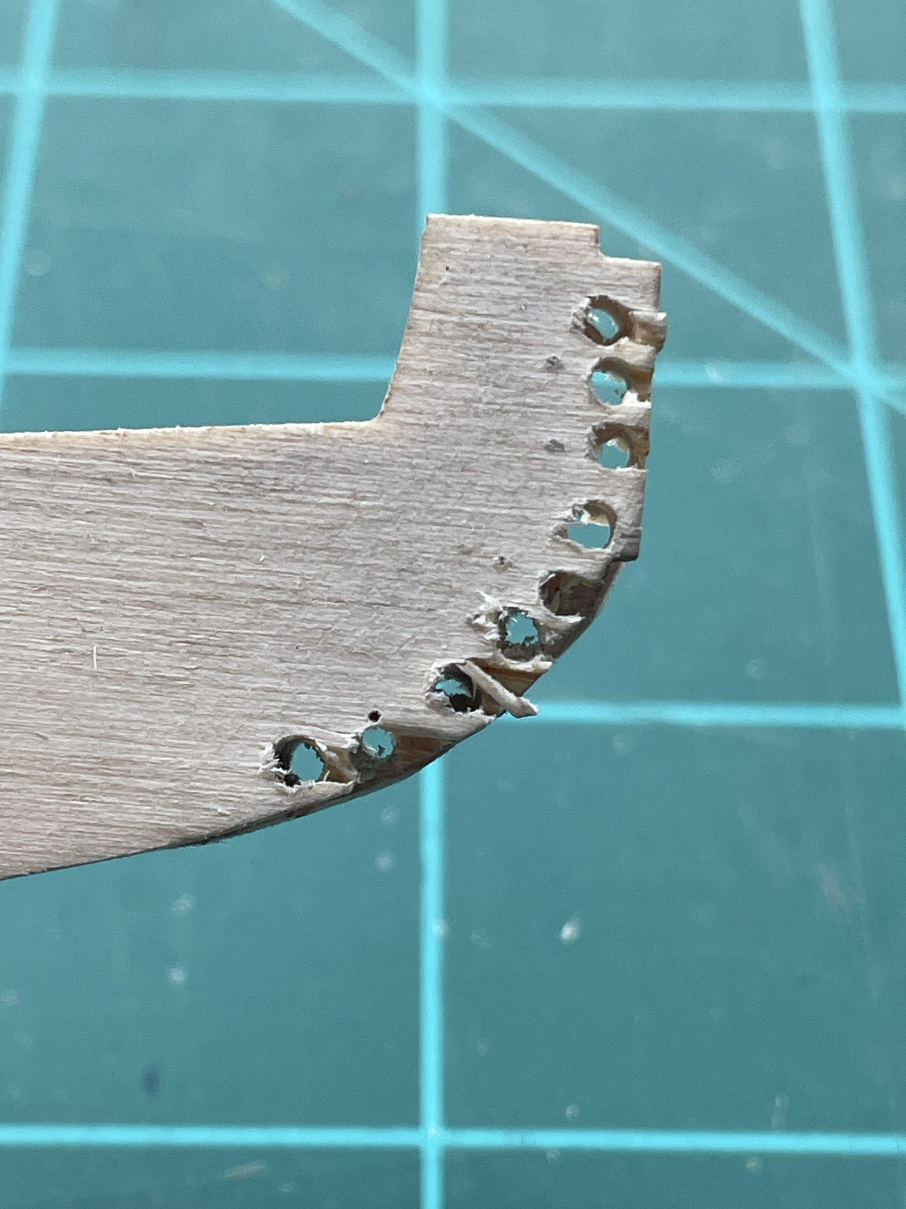

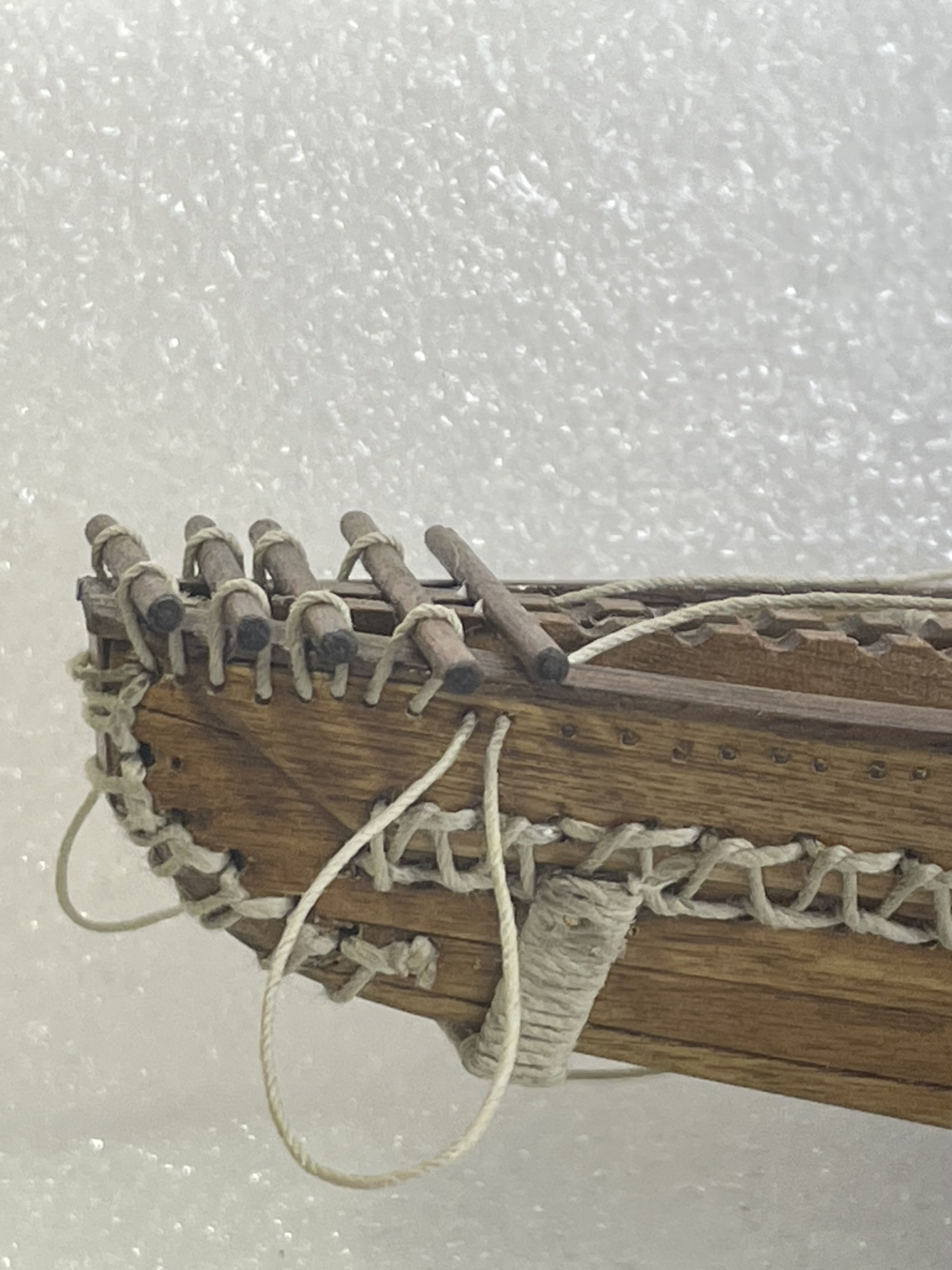

I realized I was just procrastinating on finding the location of all the holes running horizontally down the hull.  I used 4mm tape to mark both runs. The holes need to be 5mm apart, so I tried to just drill beside the tape. Plus the tape gums up the bit and that’s a pain to me. After punching a point I used a .8mm bit with a small cordless tool. Then used a 1.7 mm bit in my pin vice to enlarge them. ( that was the largest bit I had that fit in my pin vice)  The rope is 1mm and pretty much every hole gets two ropes.
After making a mock up of the needle work at double the scale. I saw there will be a few holes that has 3 and 4 ropes in one hole.
Also there are holes to drill that hold the deck on the stern and holes that hold the ropes, that hold the oars. Then the next challenge is estimating the length of rope needed to do the needle work.

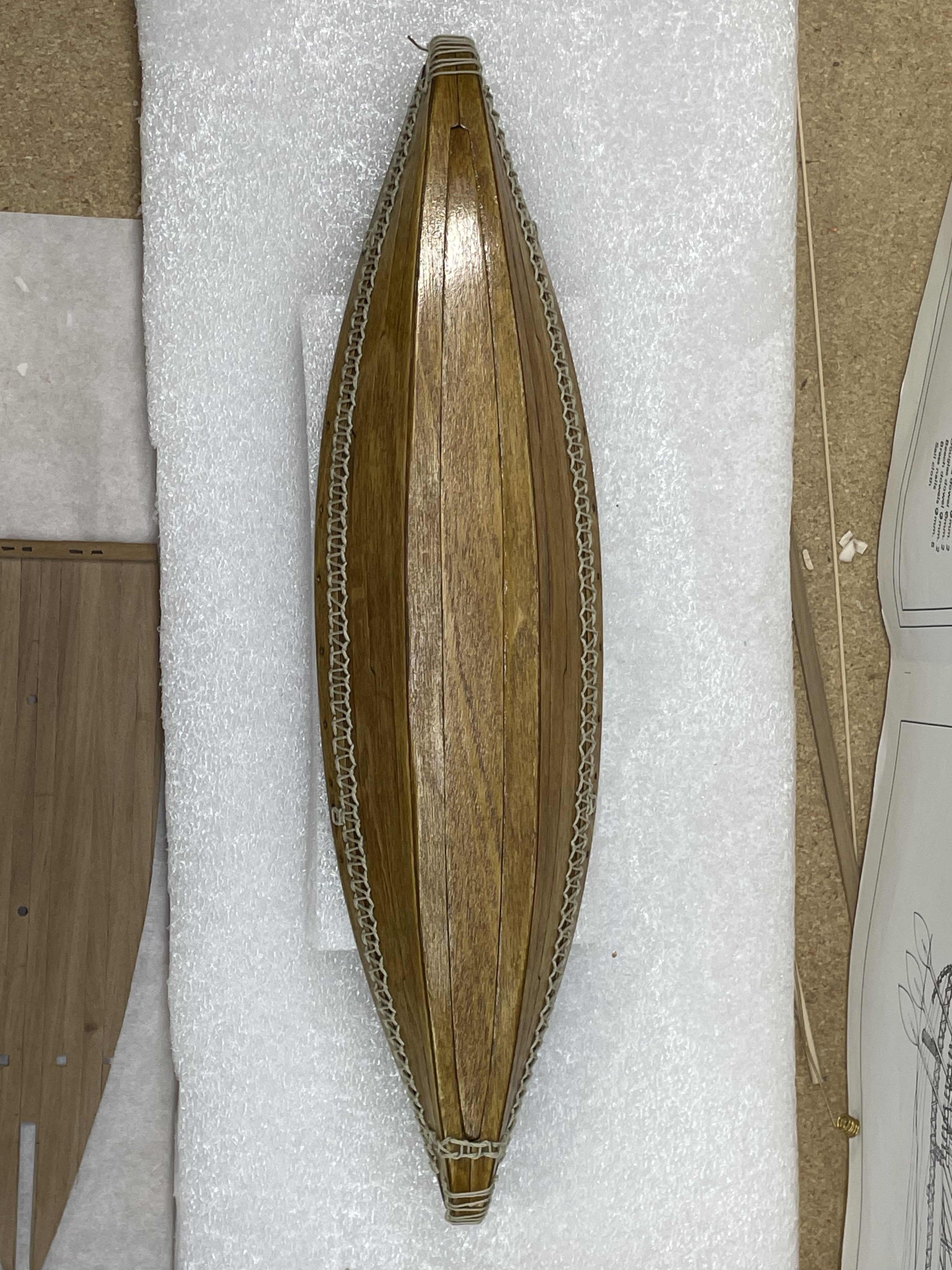

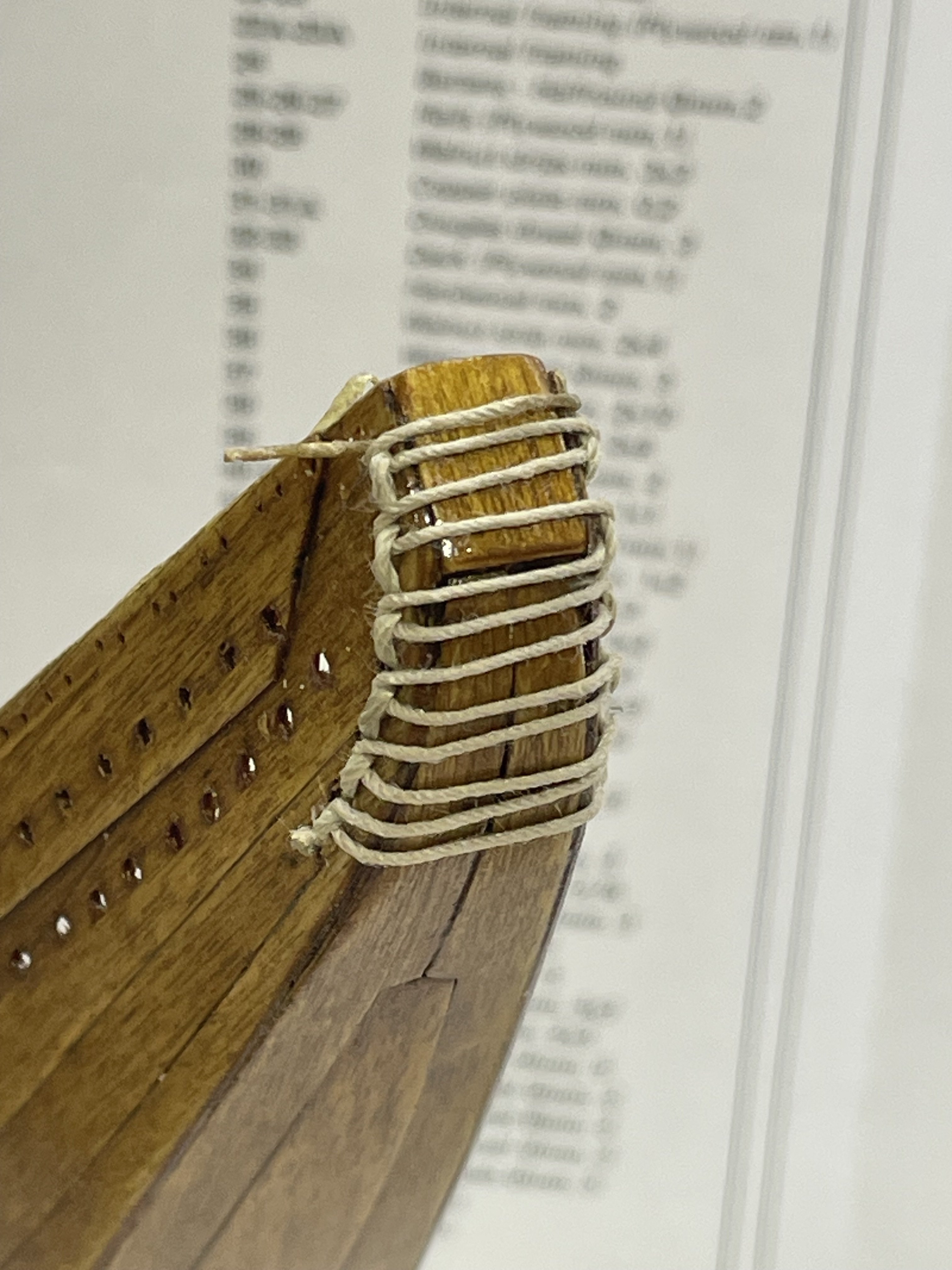

I got the finish on the hull, so that let me start the needle work. I started with the stern.
Then I tried going down the starboard side.

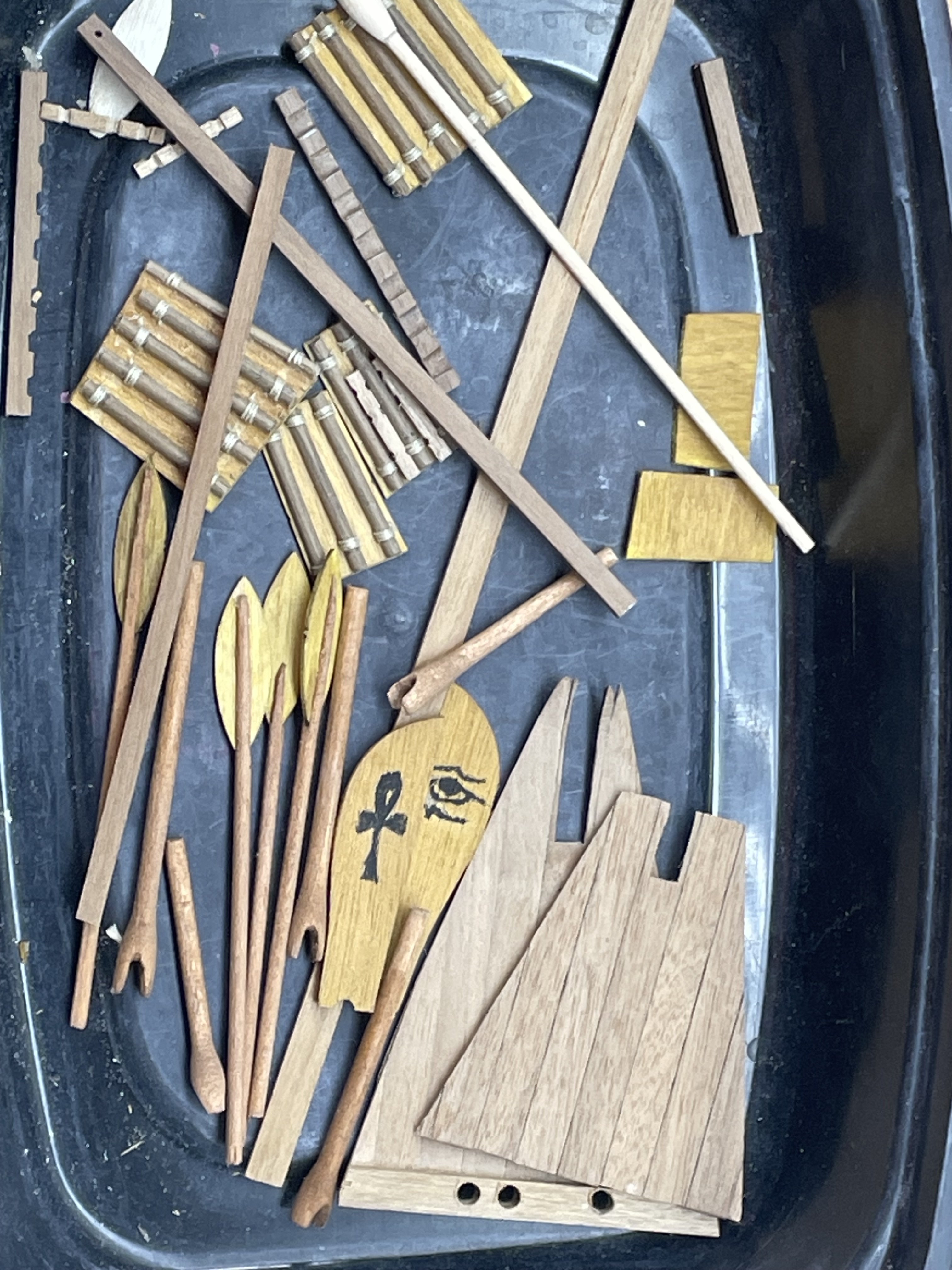

It was going smoothly but I had to stop to get ready to leave for the weekend. Next week should move the build quite a bit farther along. I’ve made a lot of the deck fittings.

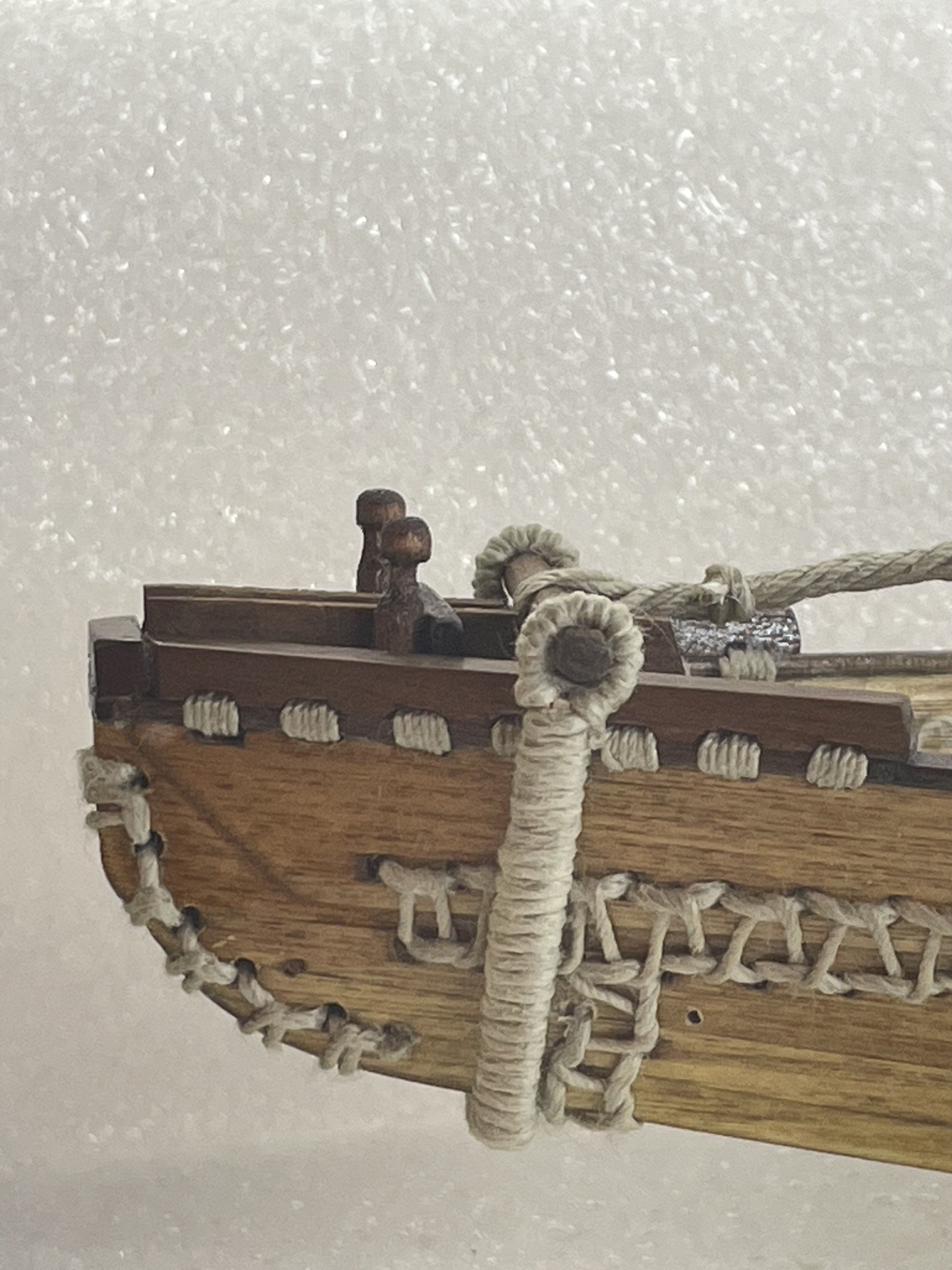

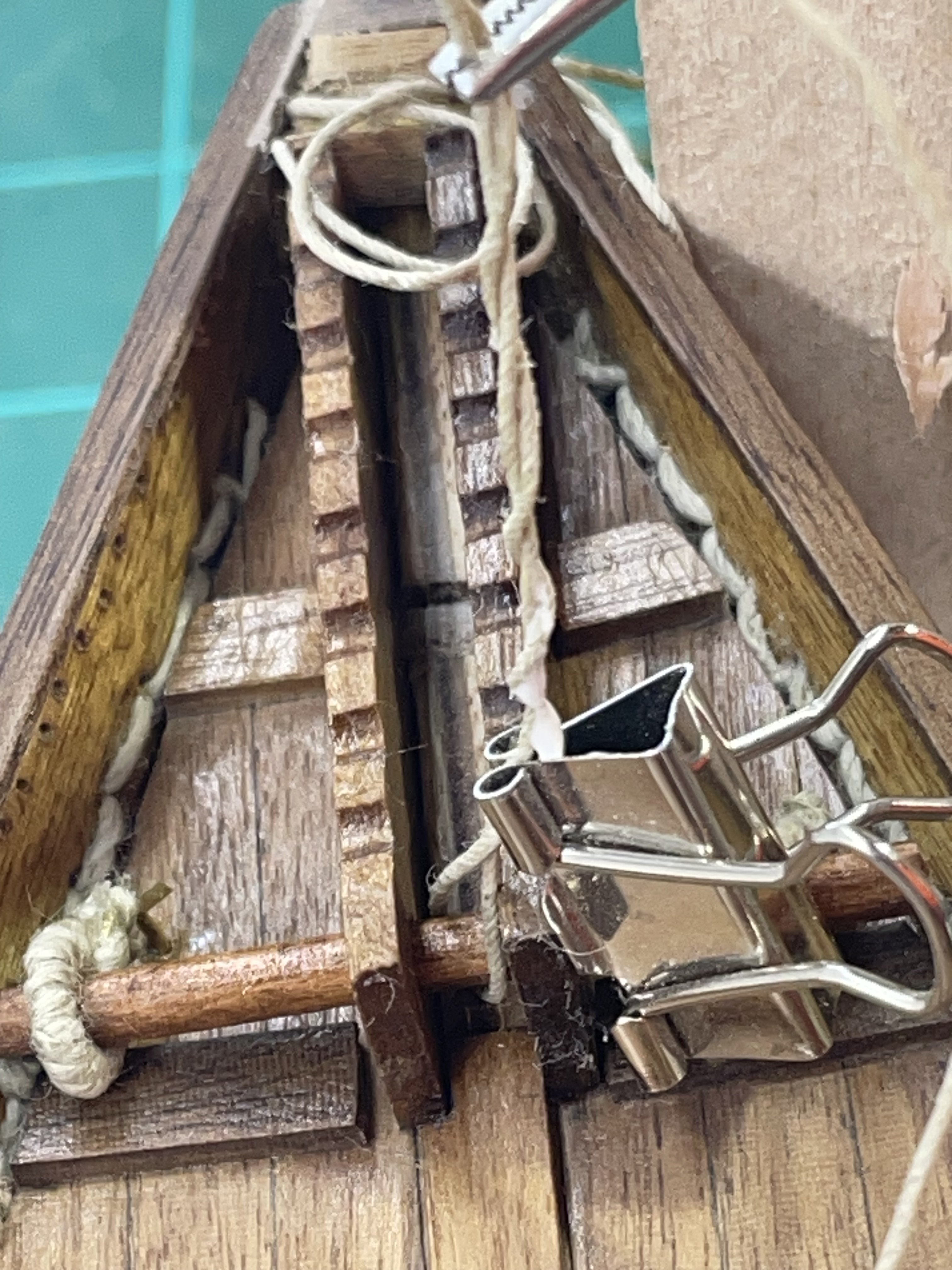

I got the cap rail on. The bow has a small piece on top with grooves that match the ones I filed in the hull. Loops of .5 mm thread went in these. The deck also has loops that needed to be put in before it was glue to the hull.
This is at the bow. I used a 2x2 to standardize all the loops.
Here’s a 1.3 rope at the stern.

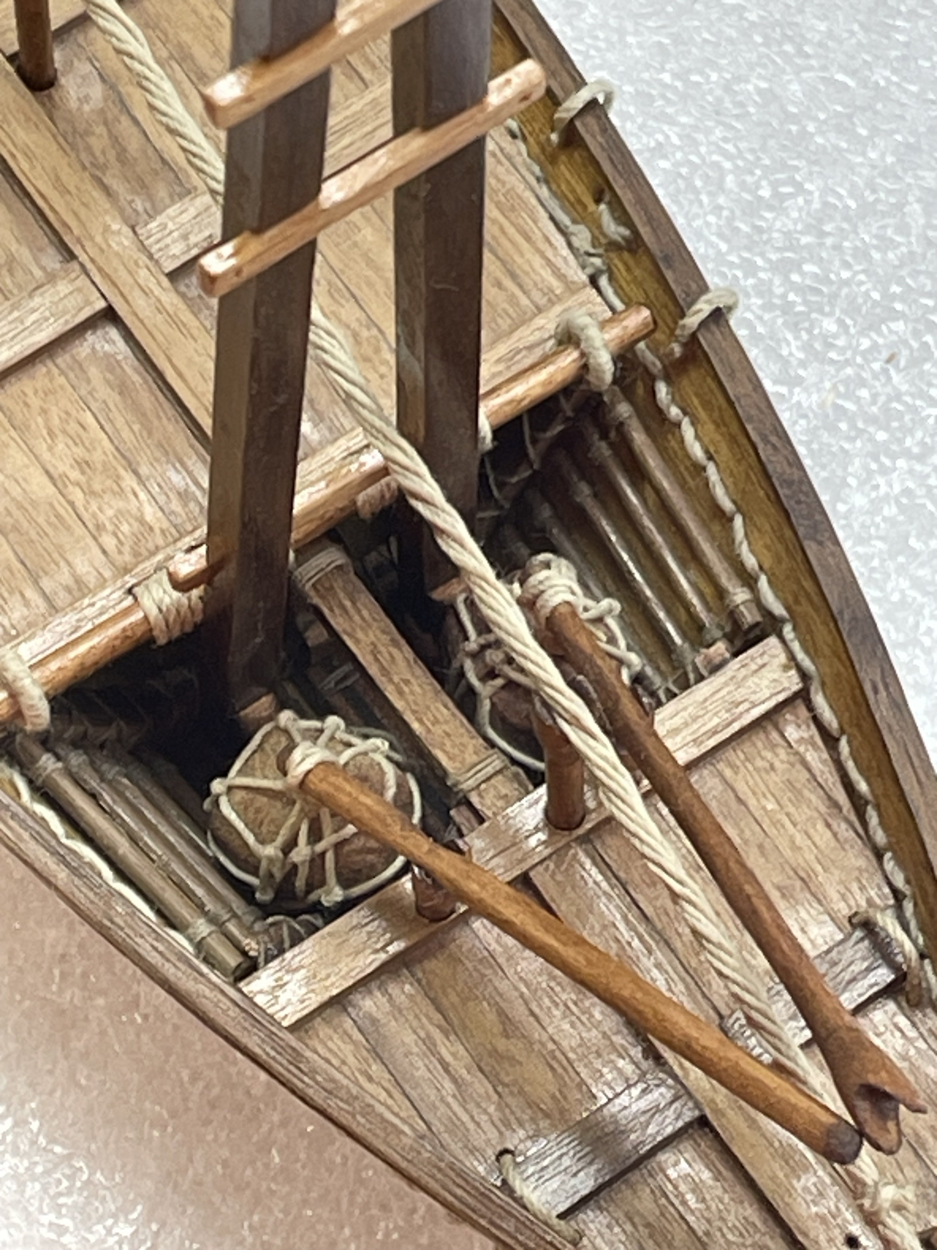

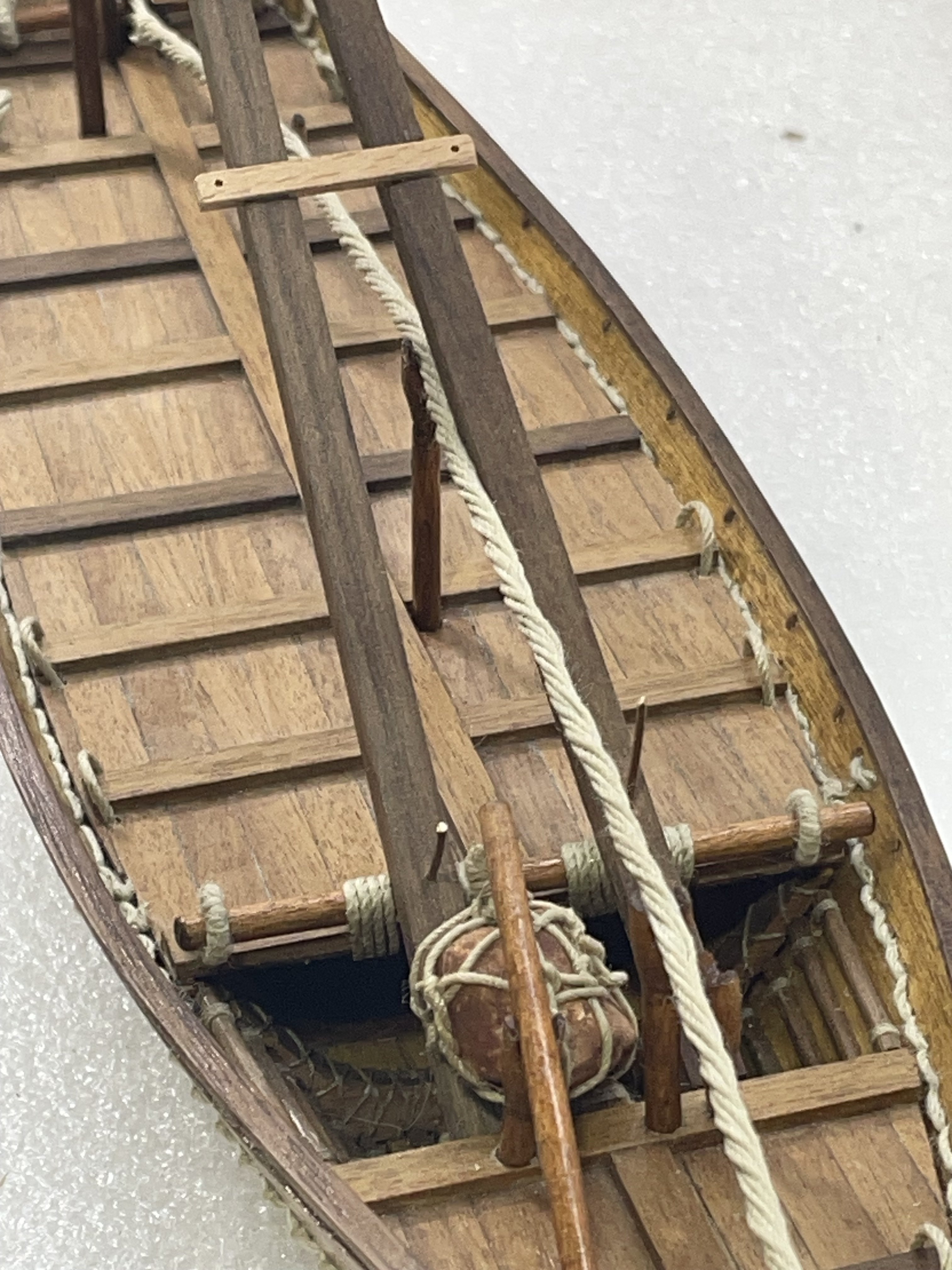

The mast is attached to a beam that will rotate to raise and lower it.
It also has two boulders that rest on the knees at the base. The weight counter balances, so it doesn’t slam down on all the slave rowers. I hope to mimic this action before I glue the mast on.

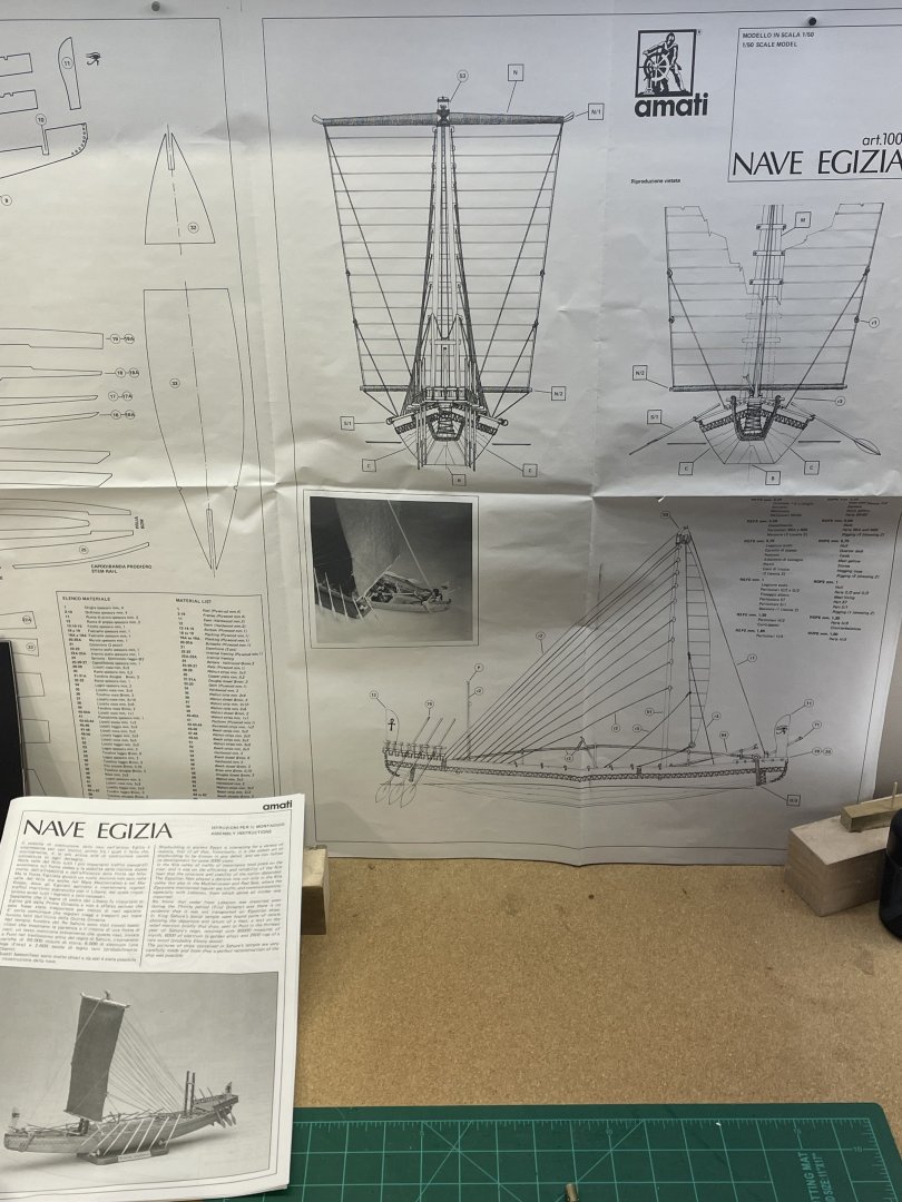

I have flipped back and forth through these instructions and much as I did a Sears and Robuck Christmas catalog:-)

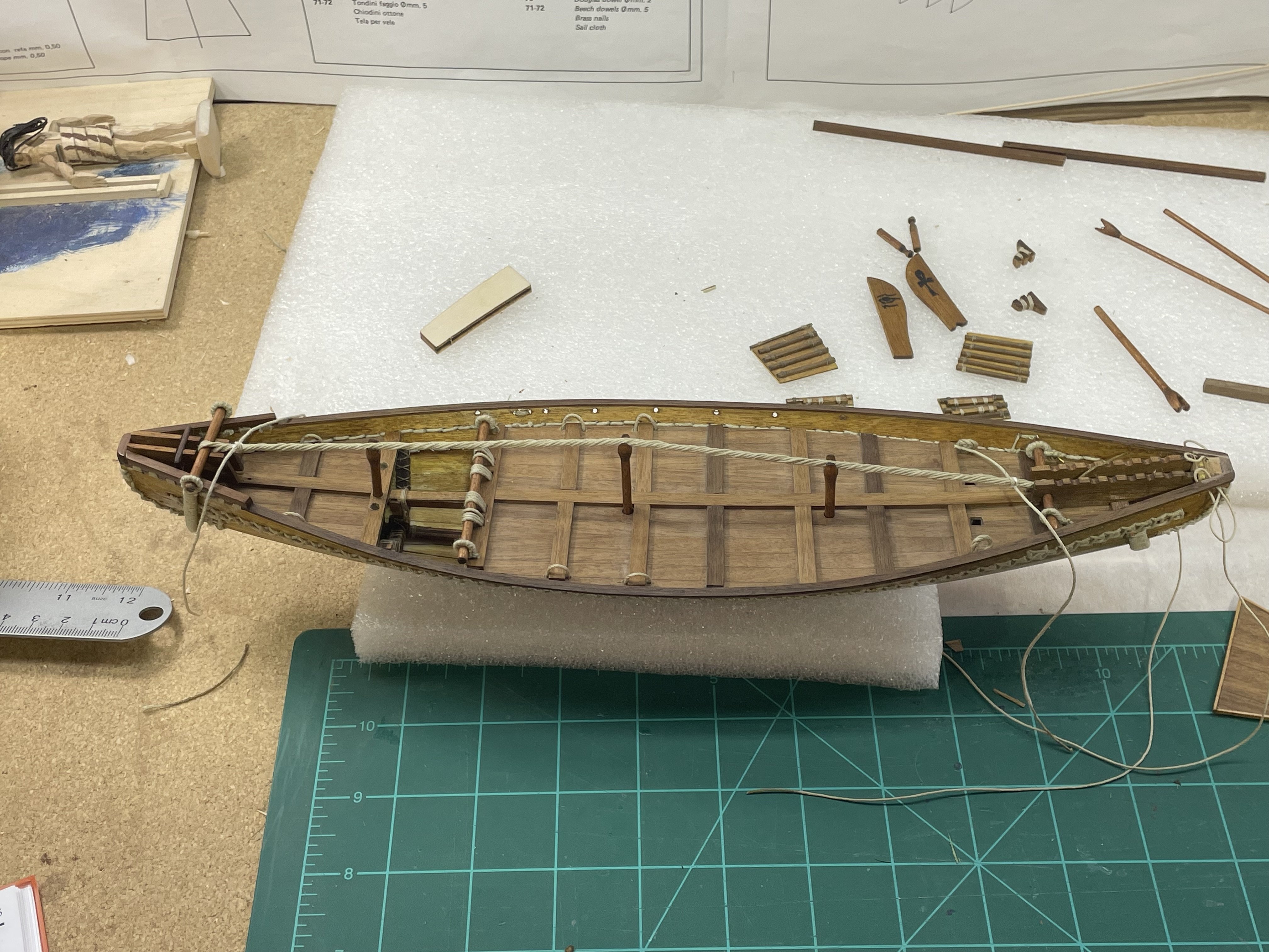

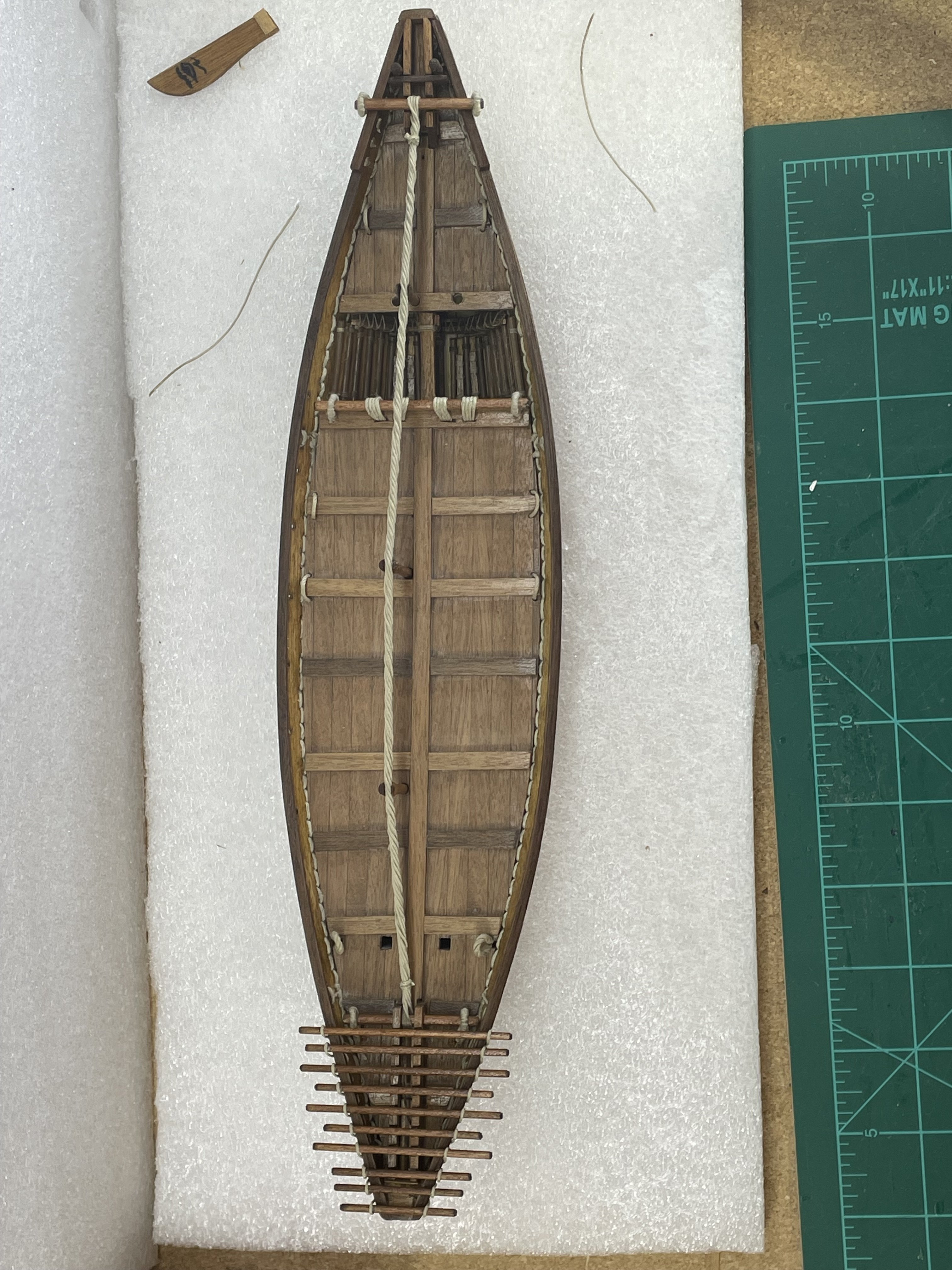

I’m still wondering if I’ve  overlooked something. So here’s where it stands with the deck glued on.
Edited by Bryan Woods
Work on the bow was next.

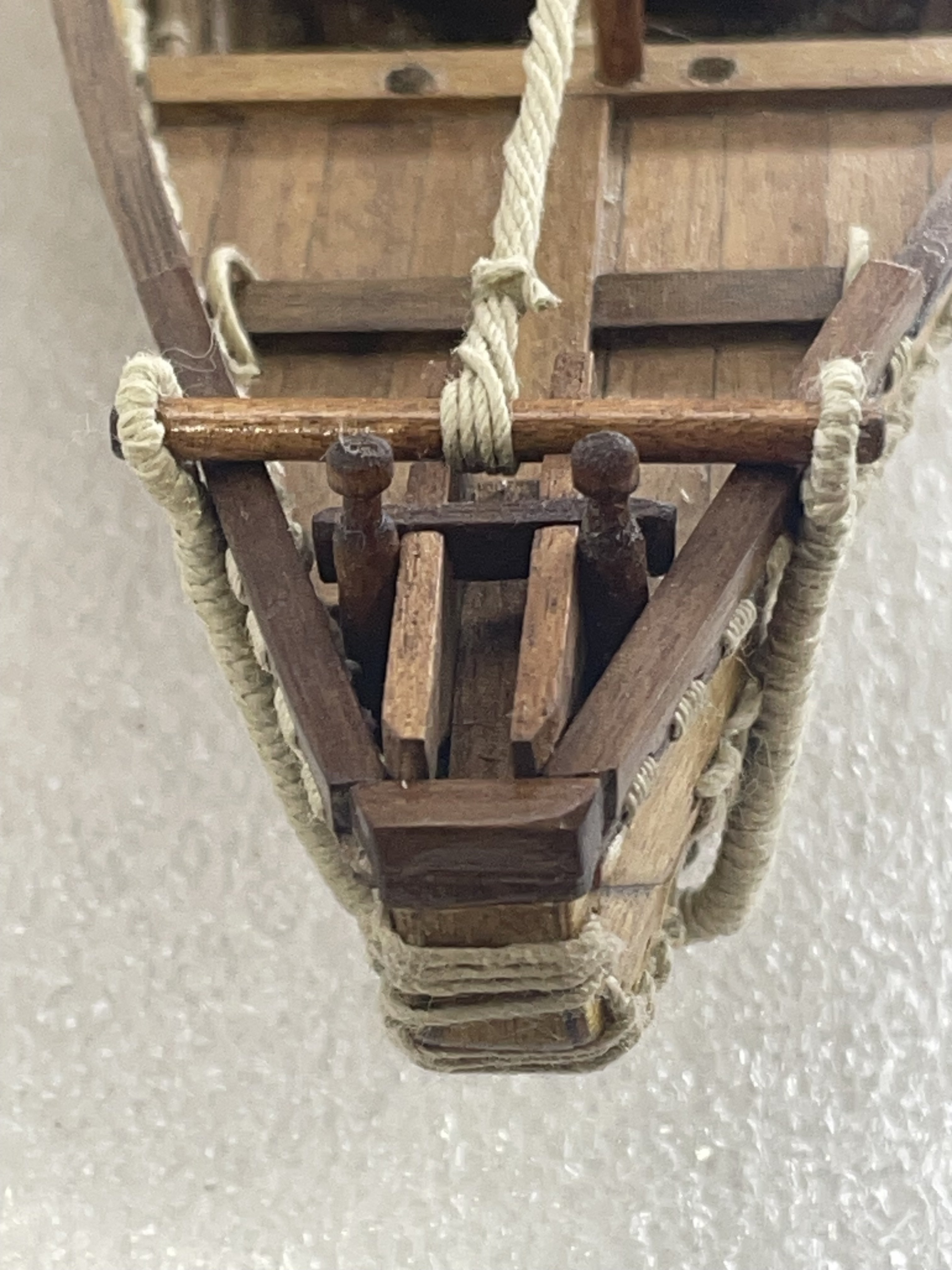

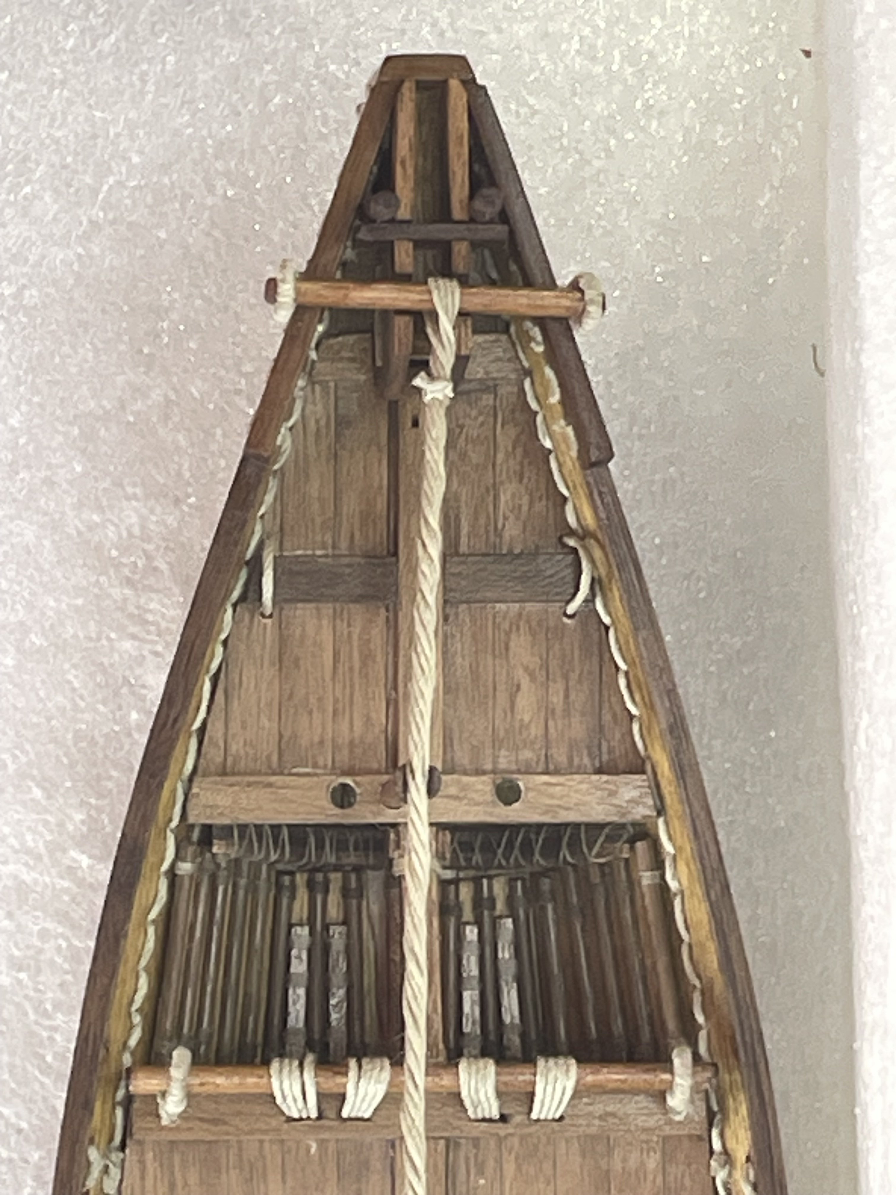

I started on the stern deck. It sits on poles with a railing around it. As I was finishing the poles and figuring out where I was going to start, I noticed that the deck was going to make it hard to place the rope truss ( instead of a keel)

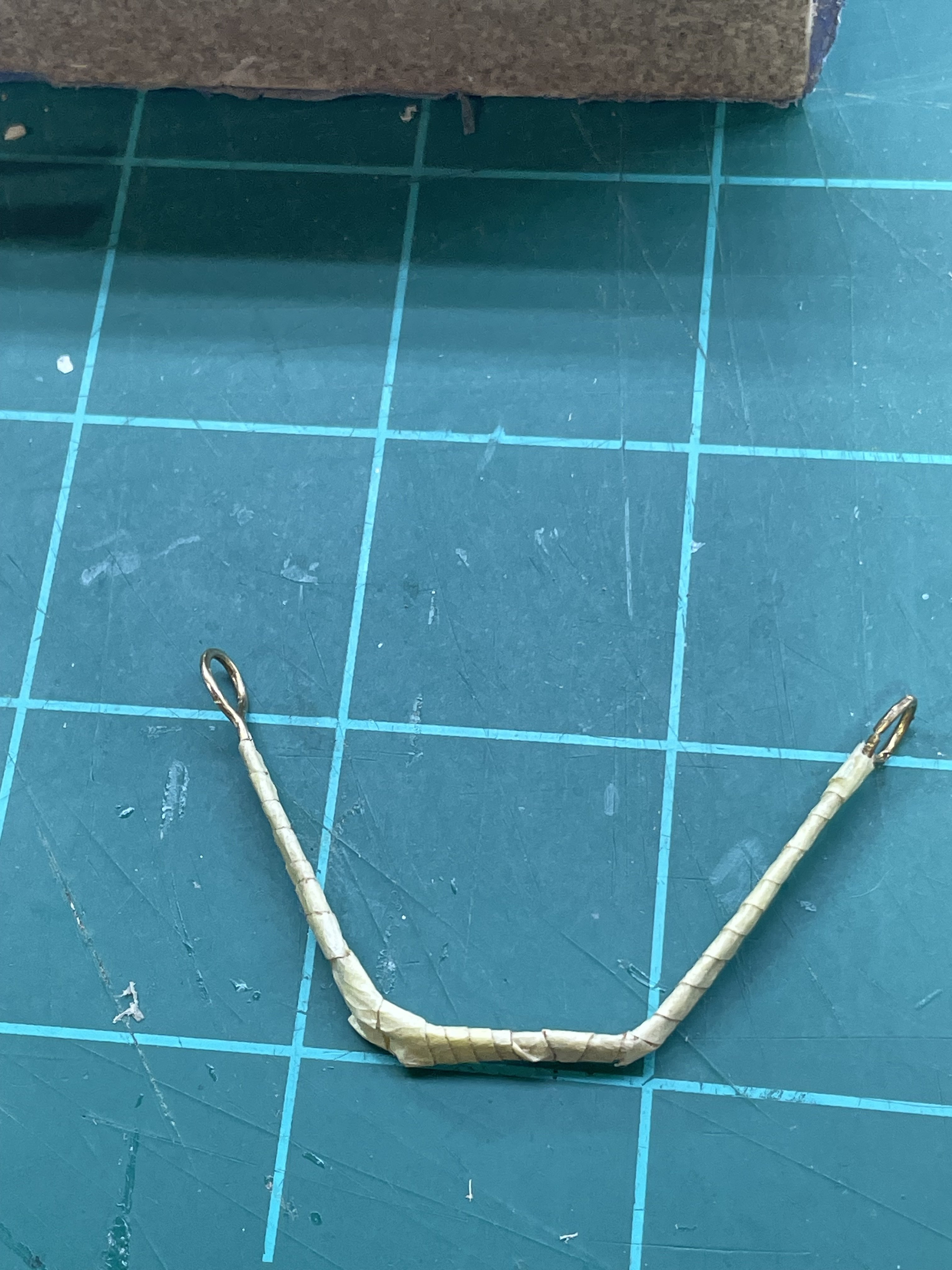

So I started with the truss. I just looped a .75mm tread around the dowel, twisted it several times and put a squeeze of PVA on it.
After that had set up a bit, I continued to loop the thread around both dowels.
The dowel at the bow is only held on by the clip made from wire then wrapped with thread.
I twisted the 8 strands till the length was right.
Now the stern deck.
This was quite challenging, but rewarding when finished:-)
There’s lots to do at the stern deck but I’m going to wait to finish it after I get the standing rigging done.

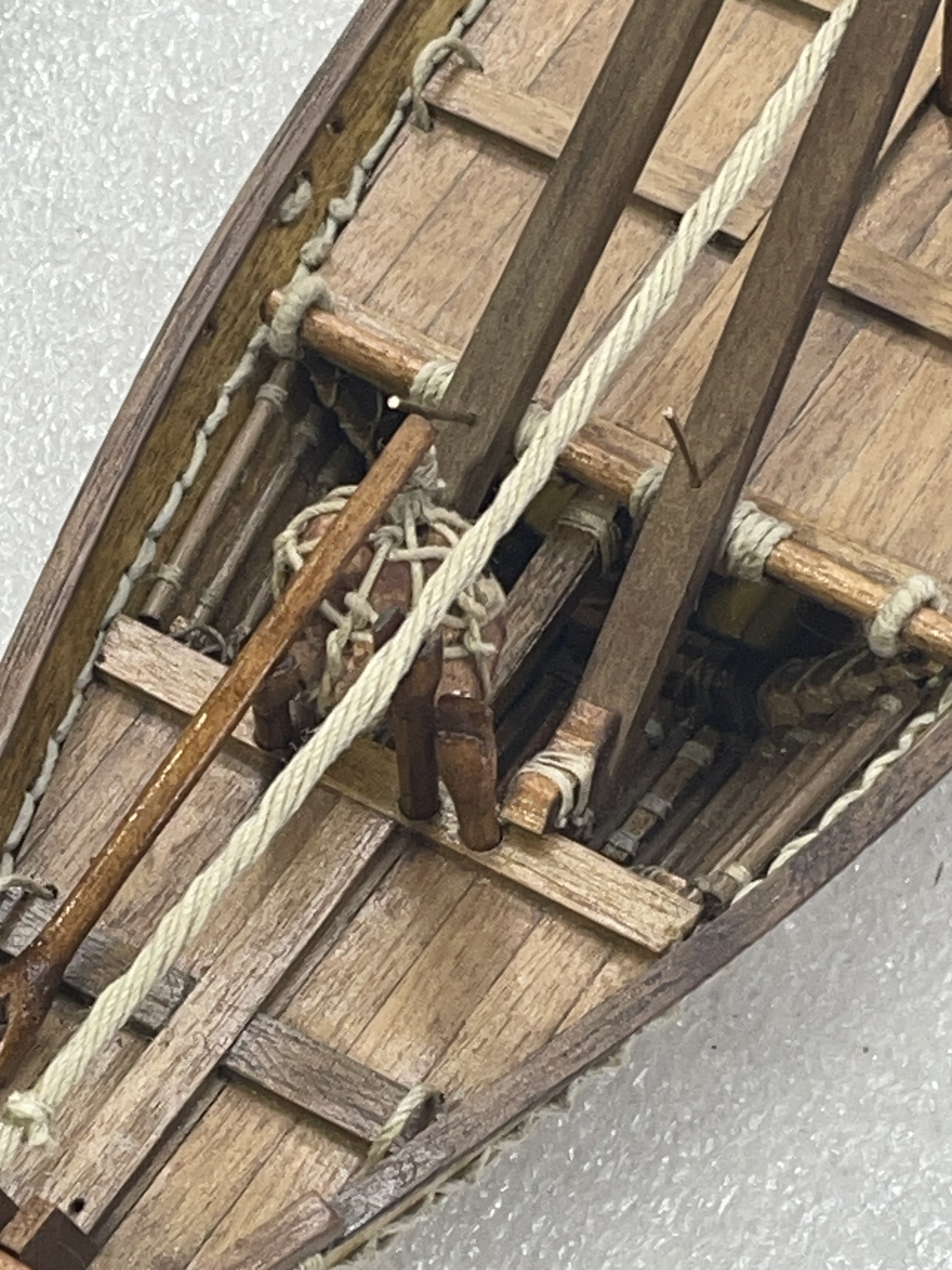

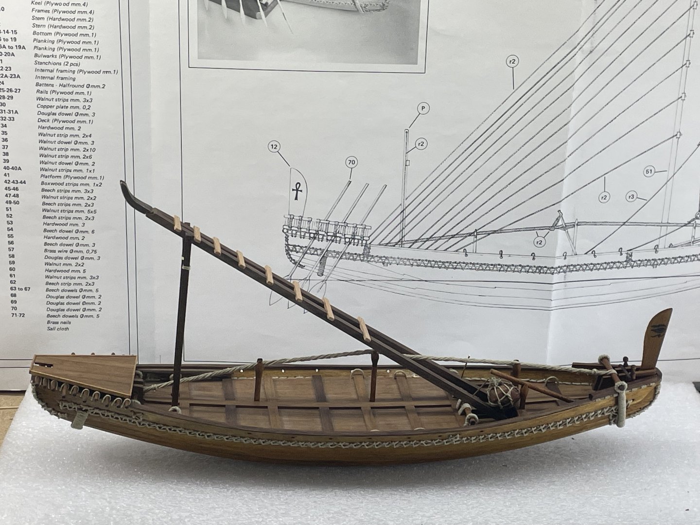

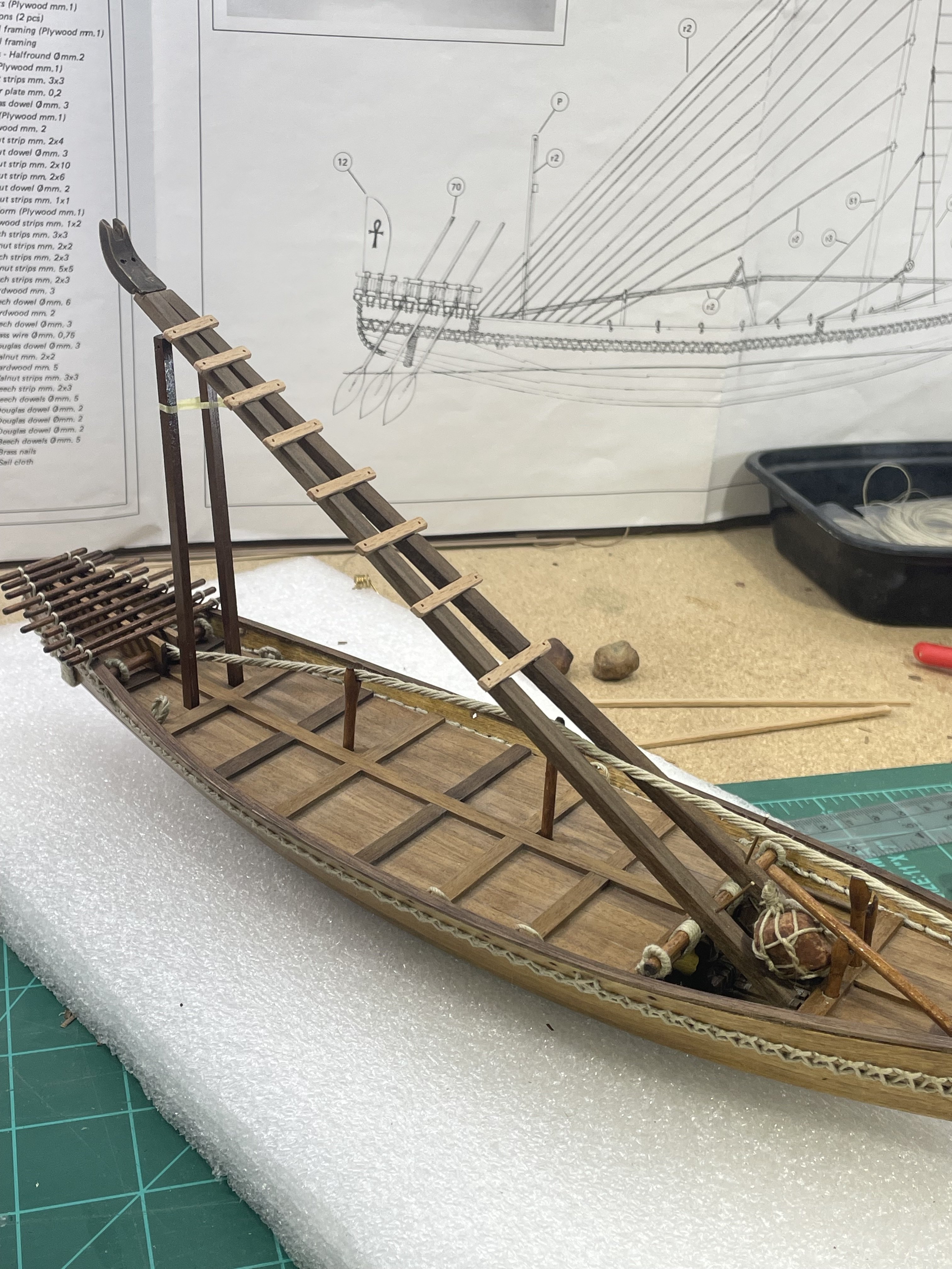

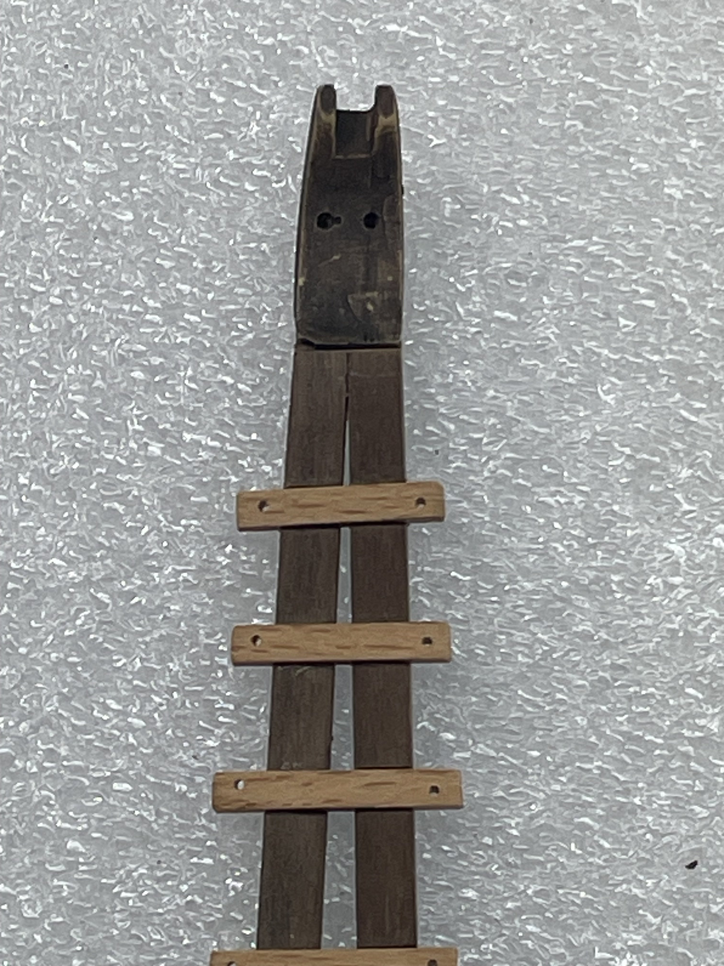

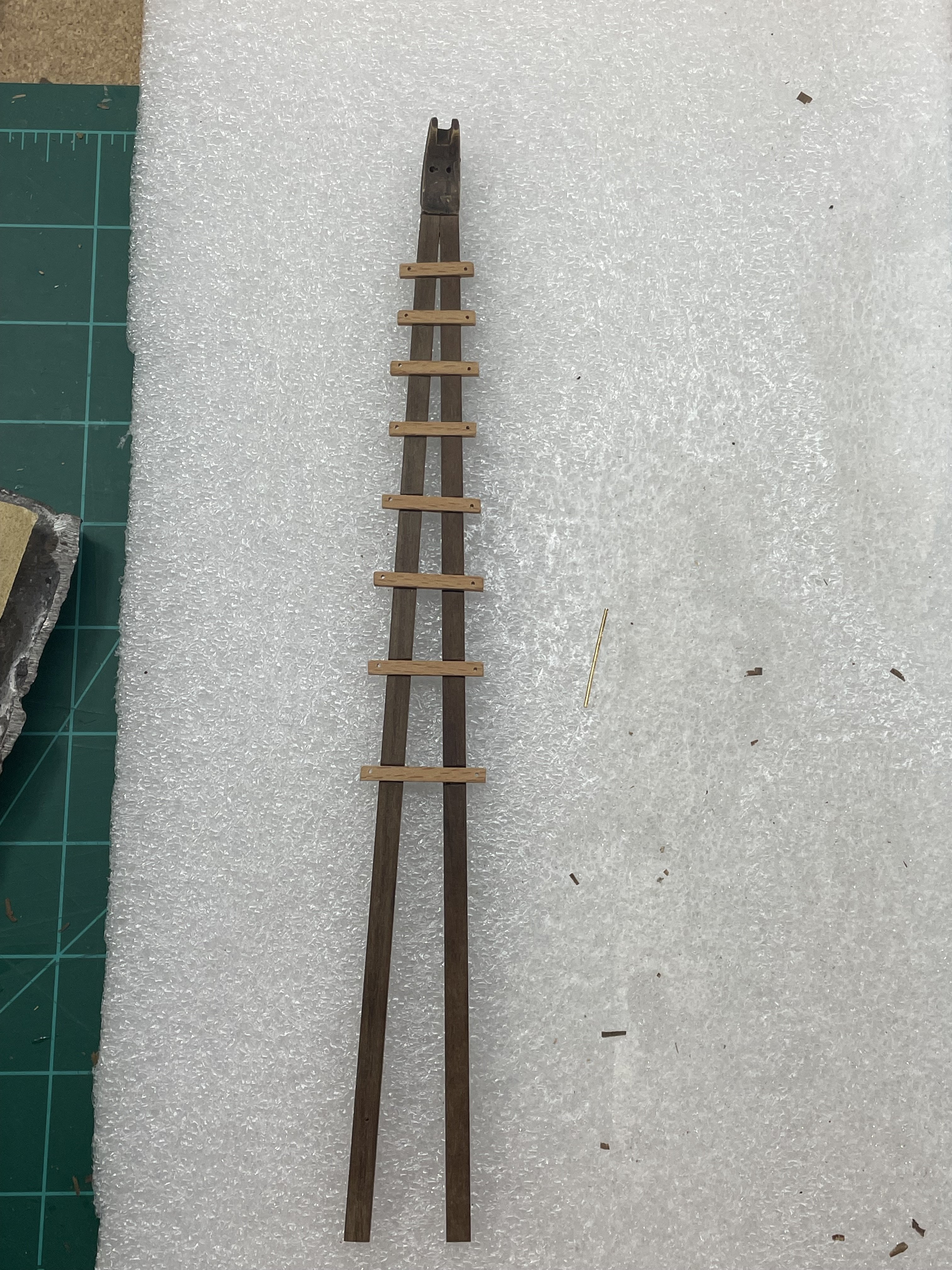

I’ve been working on the mast. I still have several things to do this  it. I’ve been trying to visualize how all the rigging works. Even though the mast head hasn’t been glued on yet I had to put it on the boat to see if it would lay down.
The mast head was plastic. I coated it with a thin coat of gesso and then painted it as close as I could to the wood.
Here is some temporary shots while I was playing:-) I only have one rock ready. And the rods will have to be made after I figure out how long they need to be.

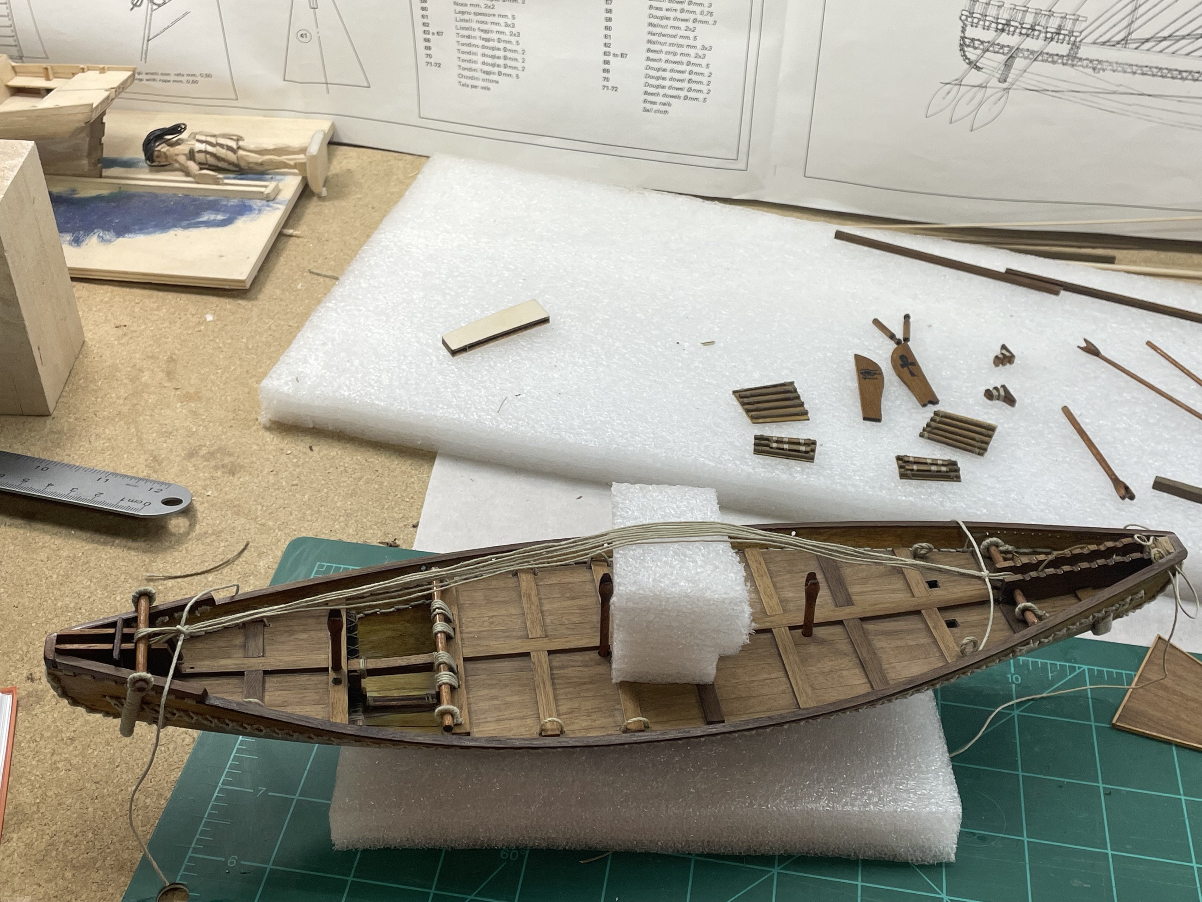

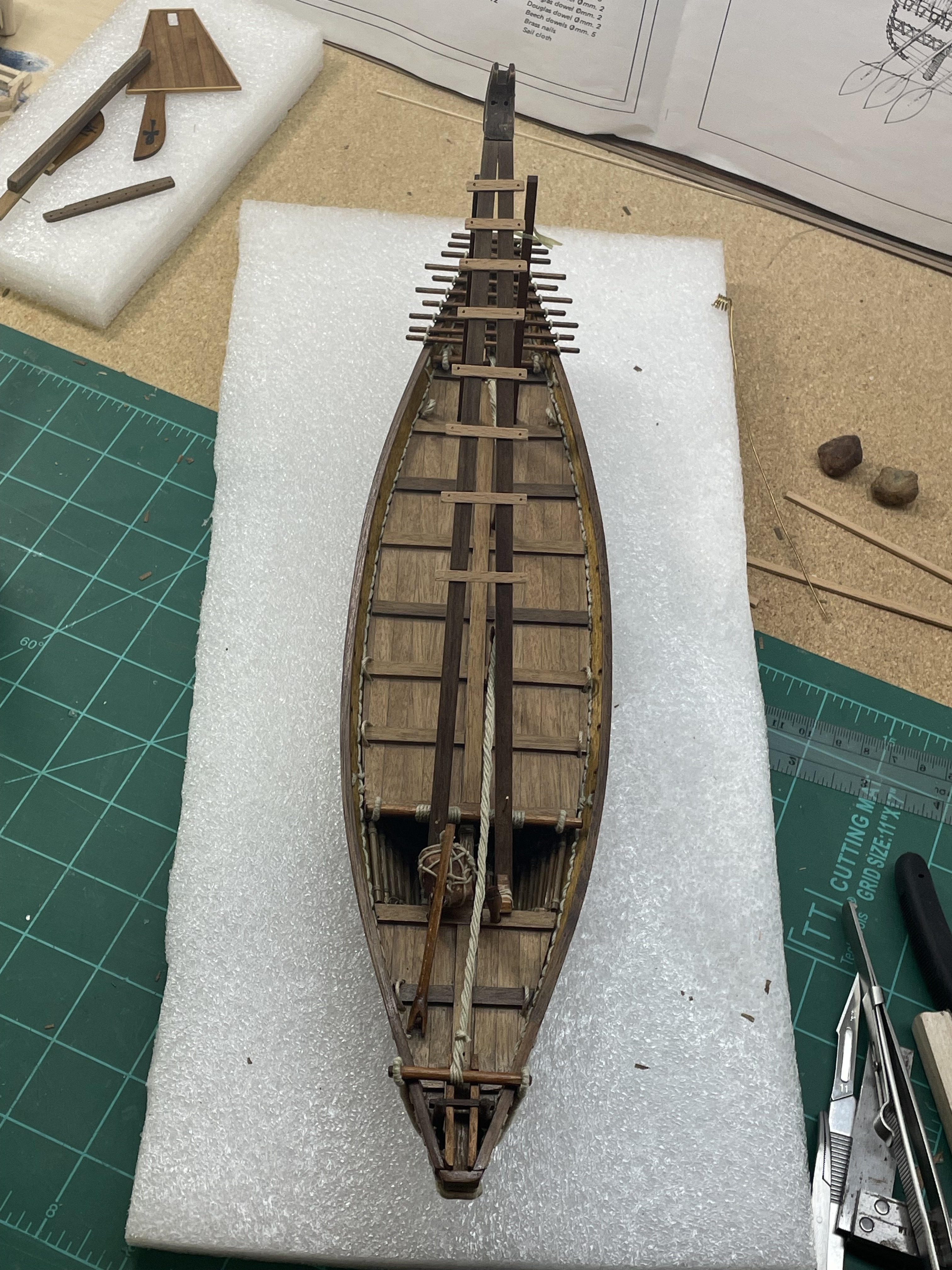

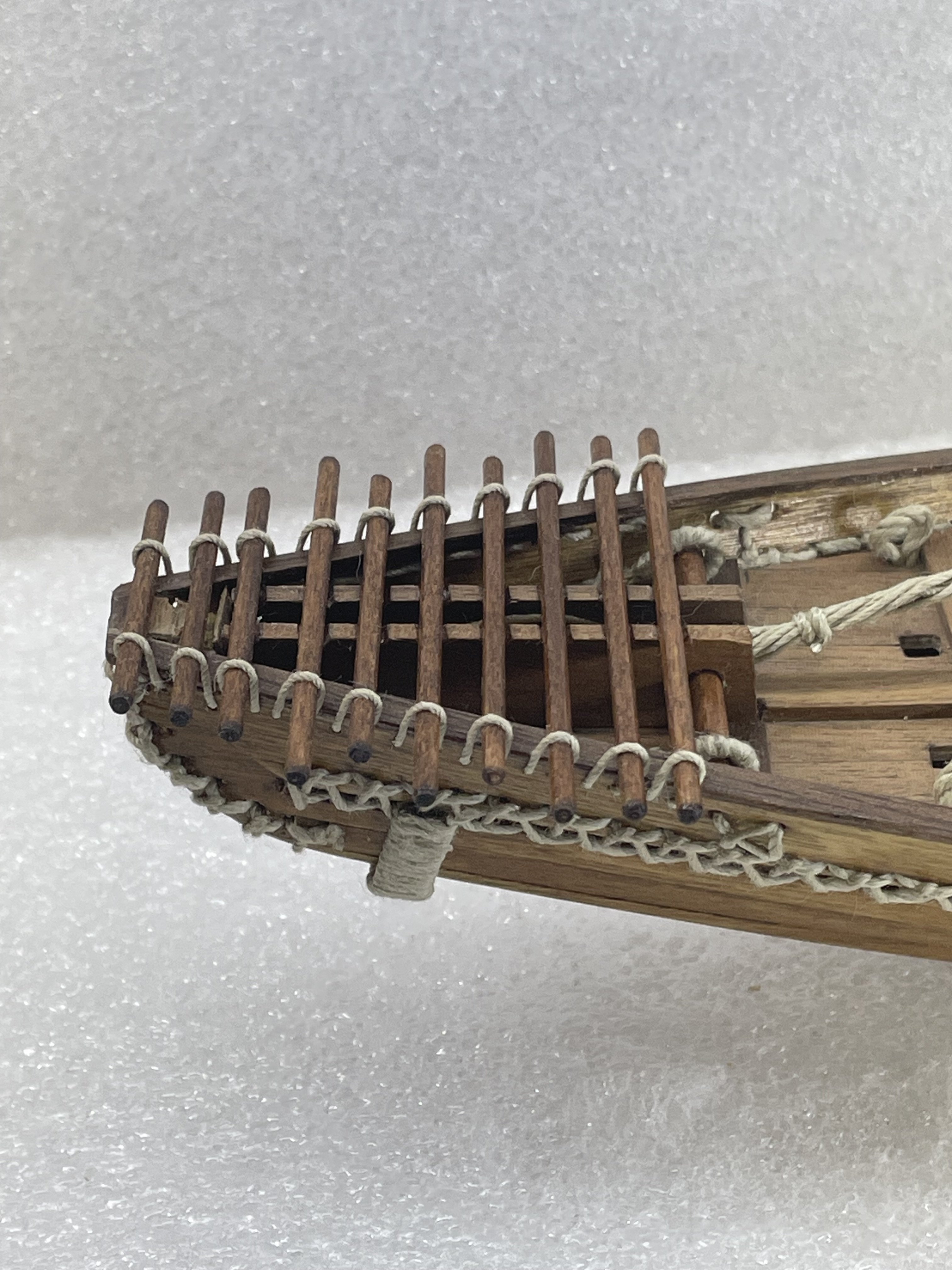

The next move on the build was the stern deck. Luckily we didn’t have anything going on all week, because I needed the time to figure this out. I started by setting four 3mm x 3mm blocks so I knew what I was gluing the deck to.
On the bottom member of the rail, I filled a groove to give me more gluing surface. Doing this caused most of the logs to break the glue joints at the spine, leaving them only held in place by the ropes in the hull :-/ Later it will present a problem. I assembled the sides of the rails on the table, to try and keep them square.

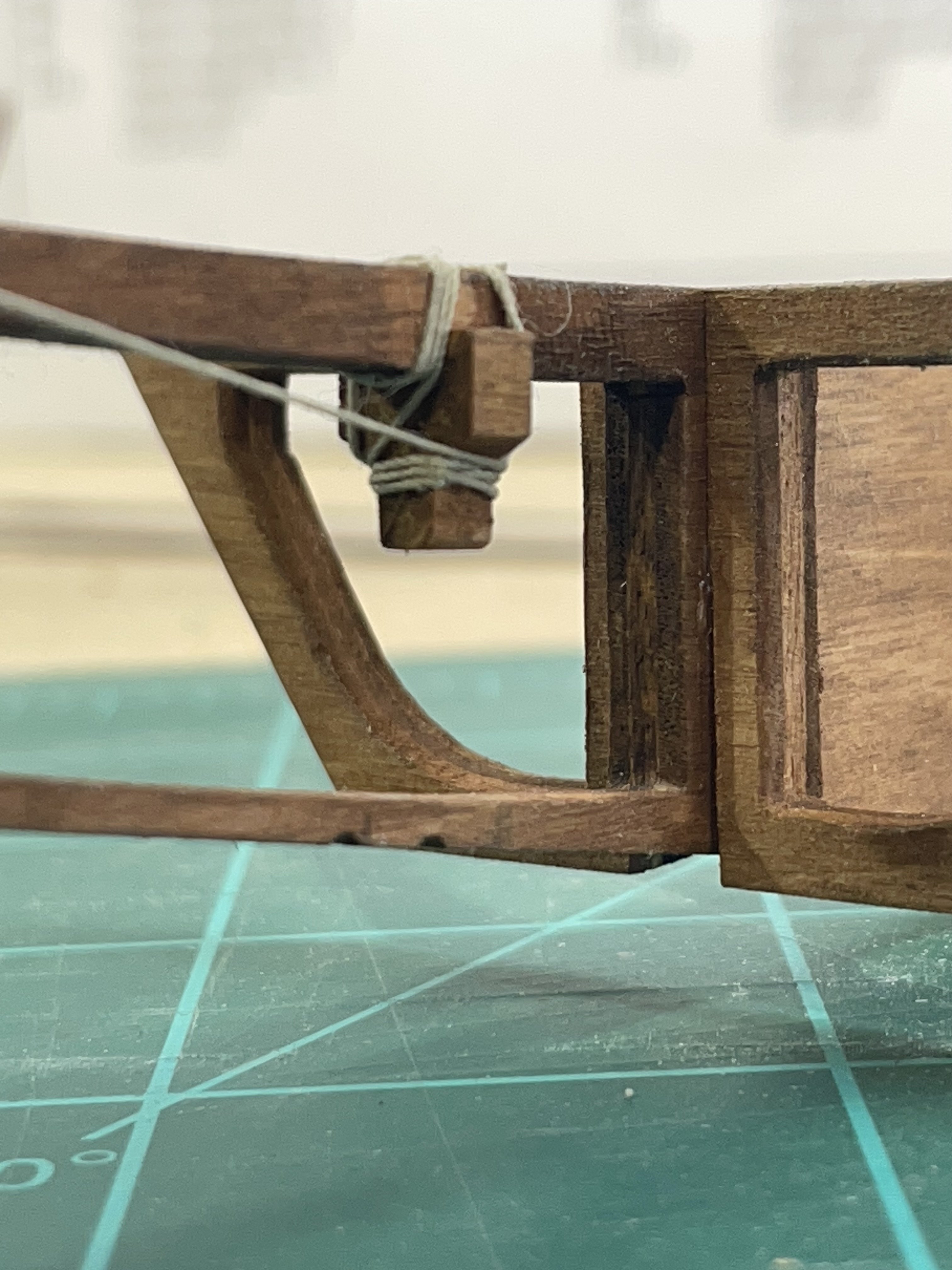

For the ropes cinching down the rail,  I glued one end at the bottom.
Because the grooves were on an angle, I drilled holes to run straight across. Plus I knew it was going to be hard enough to glue them on those logs, without a bunch of threads all in the way. I tried using PVA but the logs kept rolling and shifting the other side. I knew I was going to have to get them both put on at the same time using CA. I took a day to think about it while I was cleaning the PVA out of all the tiny spots. It all surprisingly worked out:-)
The back in wasn’t very square, but I was going to make it work.

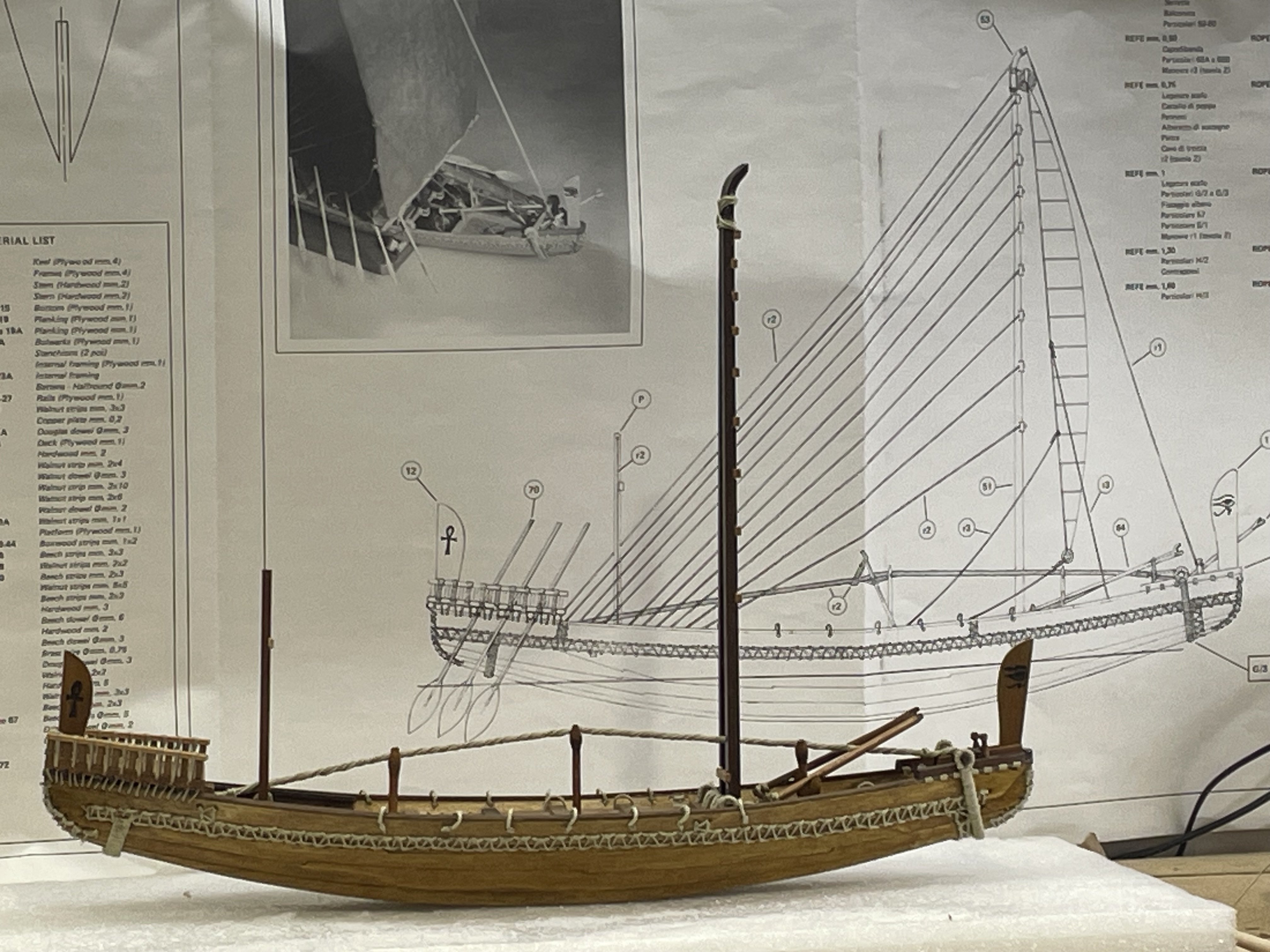

That part done will make installing the mast look easy:-)
This next week I plan on raising the mast.
