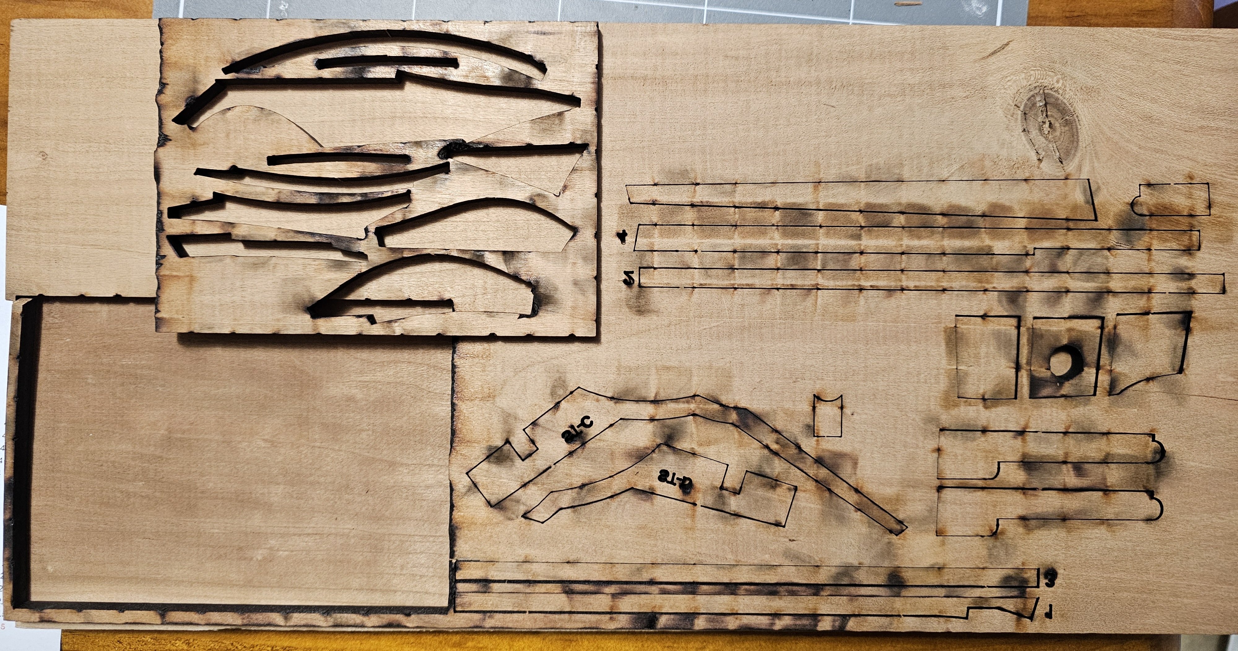

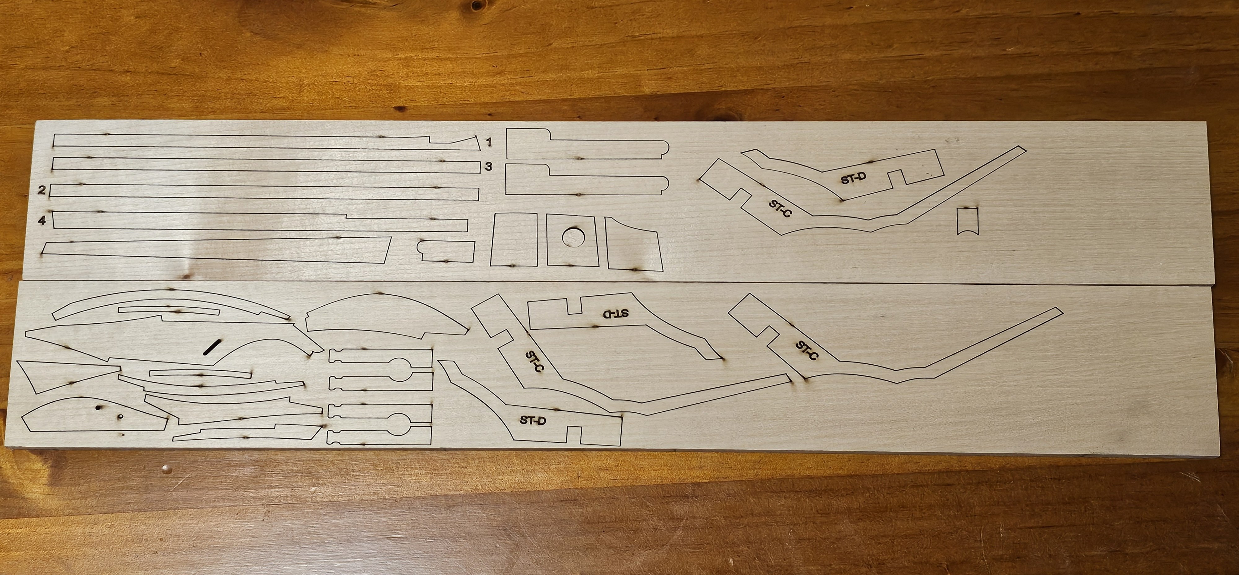

I spent some time gluing up the parts.

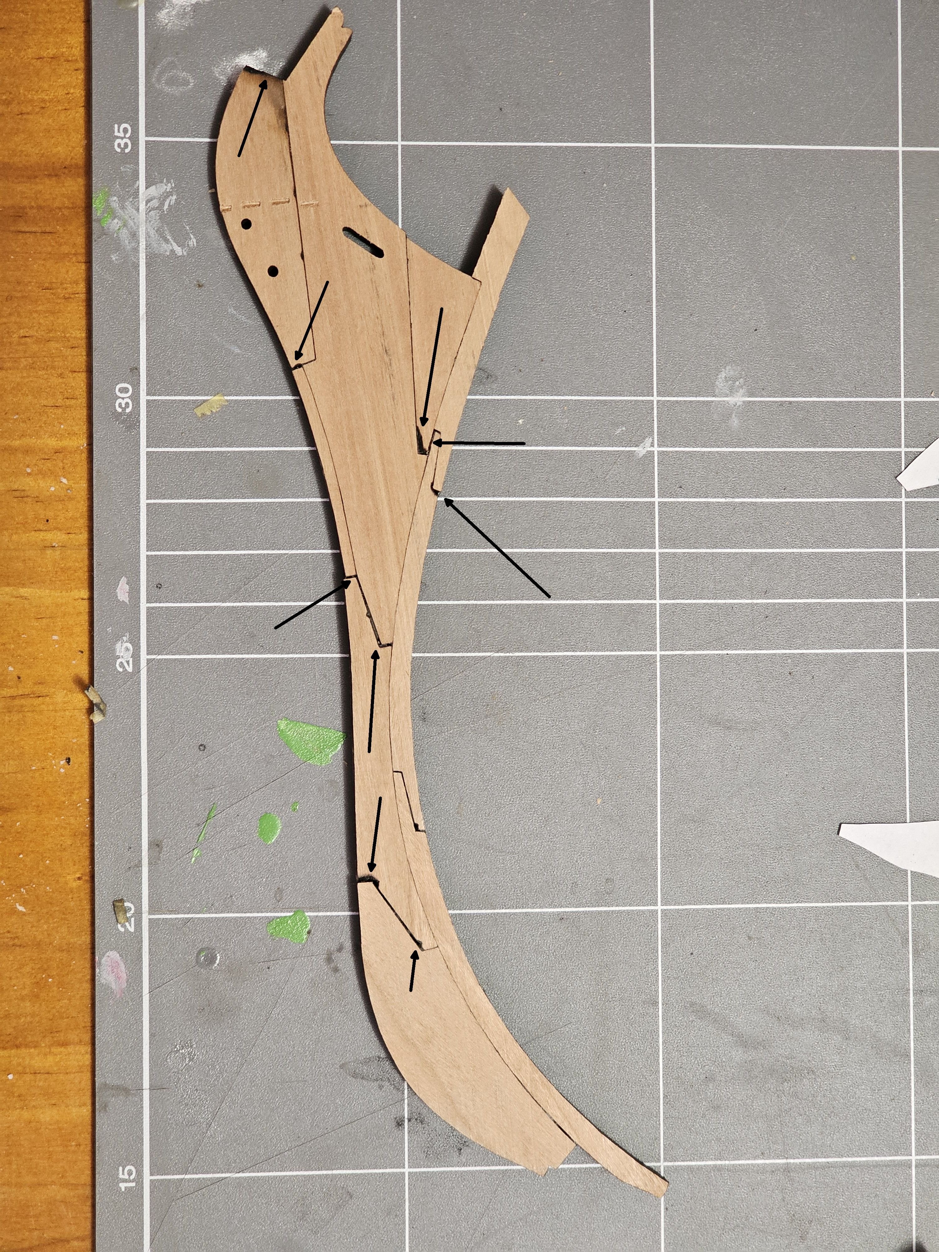

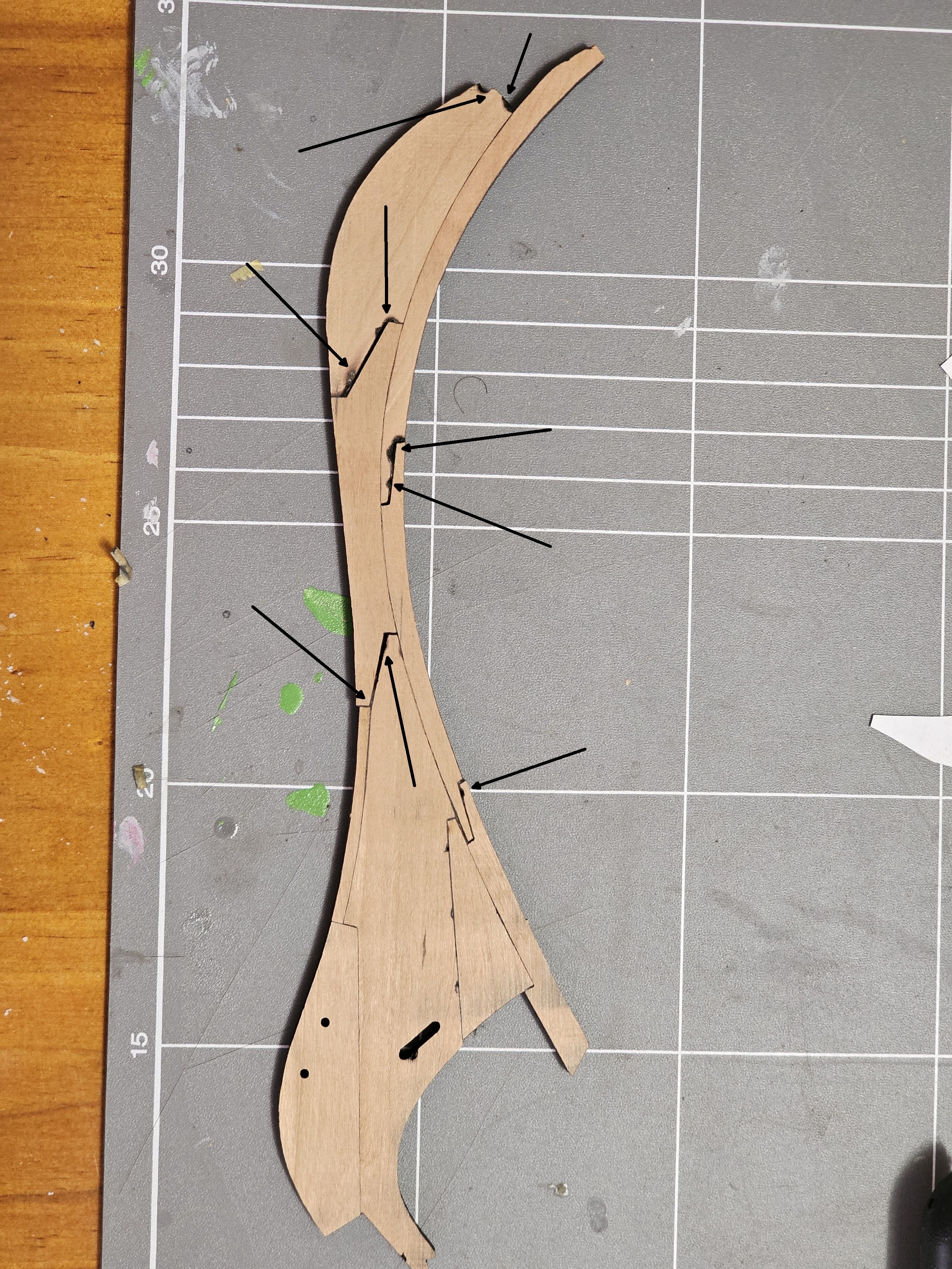

One thing I noticed whilst I was watching the laser cut was that around 2 thirds of the lines would cut with a single pass of the laser. These resulted in nice clean cuts. However, the remaining lines each had up to 10 or more passes which resulted in scorching and small holes from I assume reflections of the aluminium grid it was resting on as the beam repeatedly passed over the same path.
As can be seen in the two images, some of the joints are spot on. However, there were other joints where the wood had been scorched away from repeated passes of the laser. This resulted in gaps in some of the joints. I have highlighted problem areas in the two images. The scorch mark are obvious in the images I posted above. That is the top side view of the board. The underside was much worse. I suspect the person operating the laser (I wasn't inducted) did not know how to correctly setup for the cherry. I did not notice a setting in the software for wood except MDF or Plywood.
I shall be modifying my approach to this piece. I used 1 1/4" cherry and after cleaning the scorch marks and correcting a very slight bow I induced from the glueup, To glue up I will be using pins and a board to hold the pieces flat whilst drying. This attempt though I did not. (I used my Proxxon Planer then Thicknesser to flatten and clean up both sides.) I ended up with a flat stem at 210 thou instead of 250 thou.
It shall be remade and I am considering changing from Cherry to another wood that I can source in Australia. Poplar or Huon Pine.

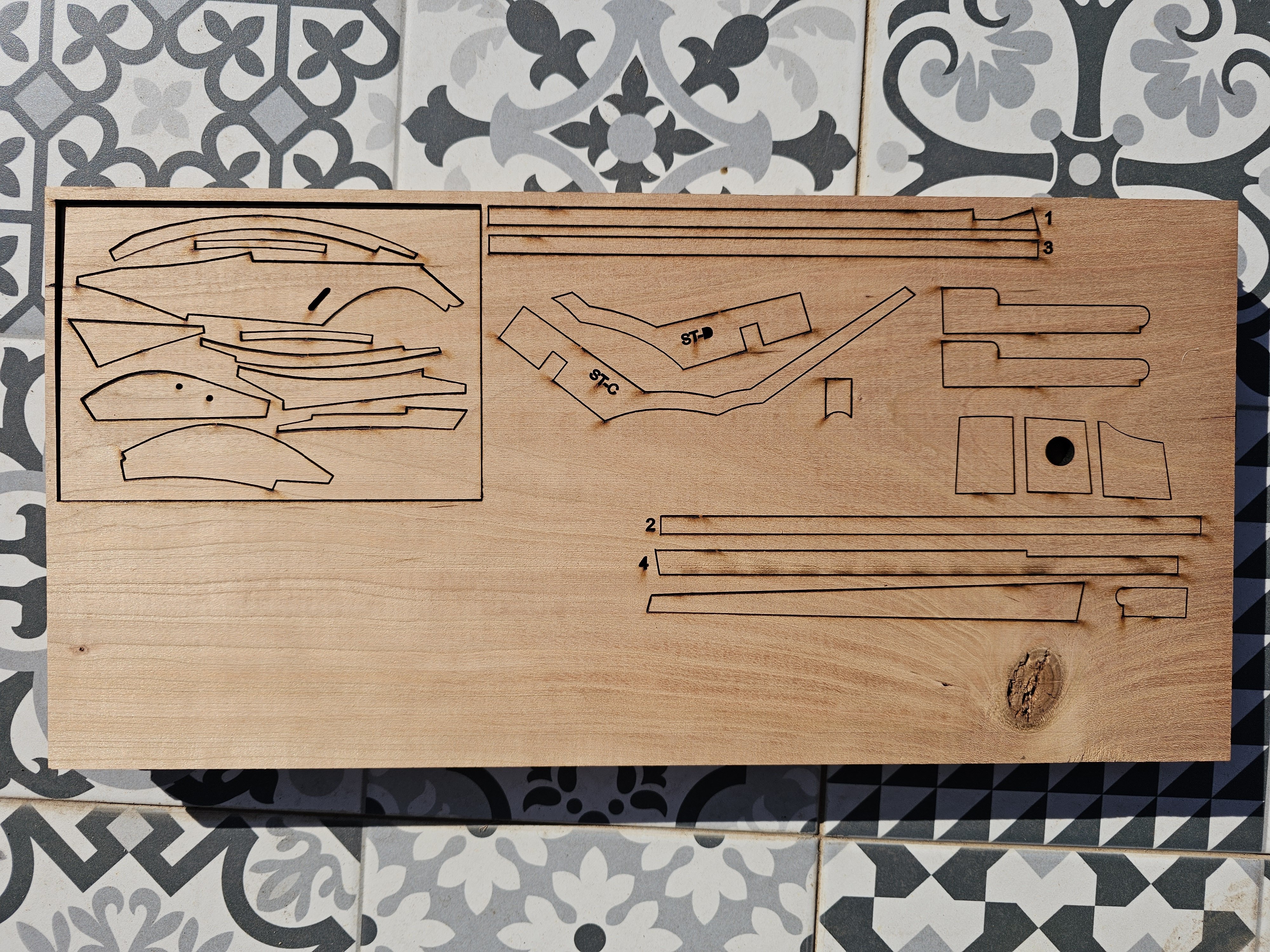

I have also attached an image of two other laser cuts I made on the same wood panel. This show the underside though with the scorching. Unfortunately I did not get an image of the stem panel underside.
Edited by John Murray
Added an image.

First of all welcome to the Winchelsea build group John. Very nice to see another Winchelsea being started!
Aren't you afraid that further down the line, things will not fit 100% when experimenting with letting your pieces cut by various laser cutting shops?
How much off are the two different sets of pieces you already have now compared to each other?
Apart from the few cut away corners you showed, are the pieces the same size and consistent in shape, etcetera?
I wish you lots success and most of all much fun building your Winchelsea!

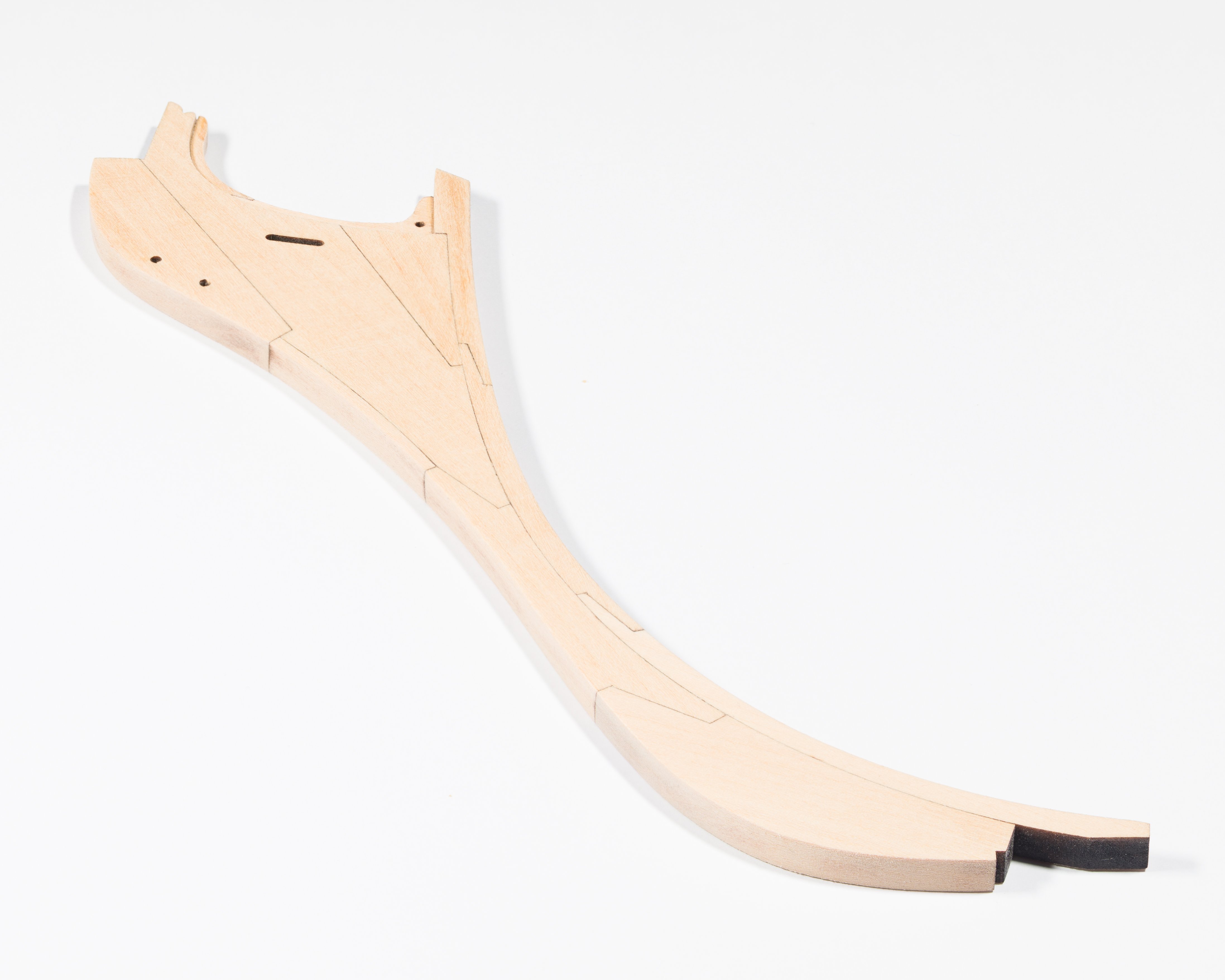

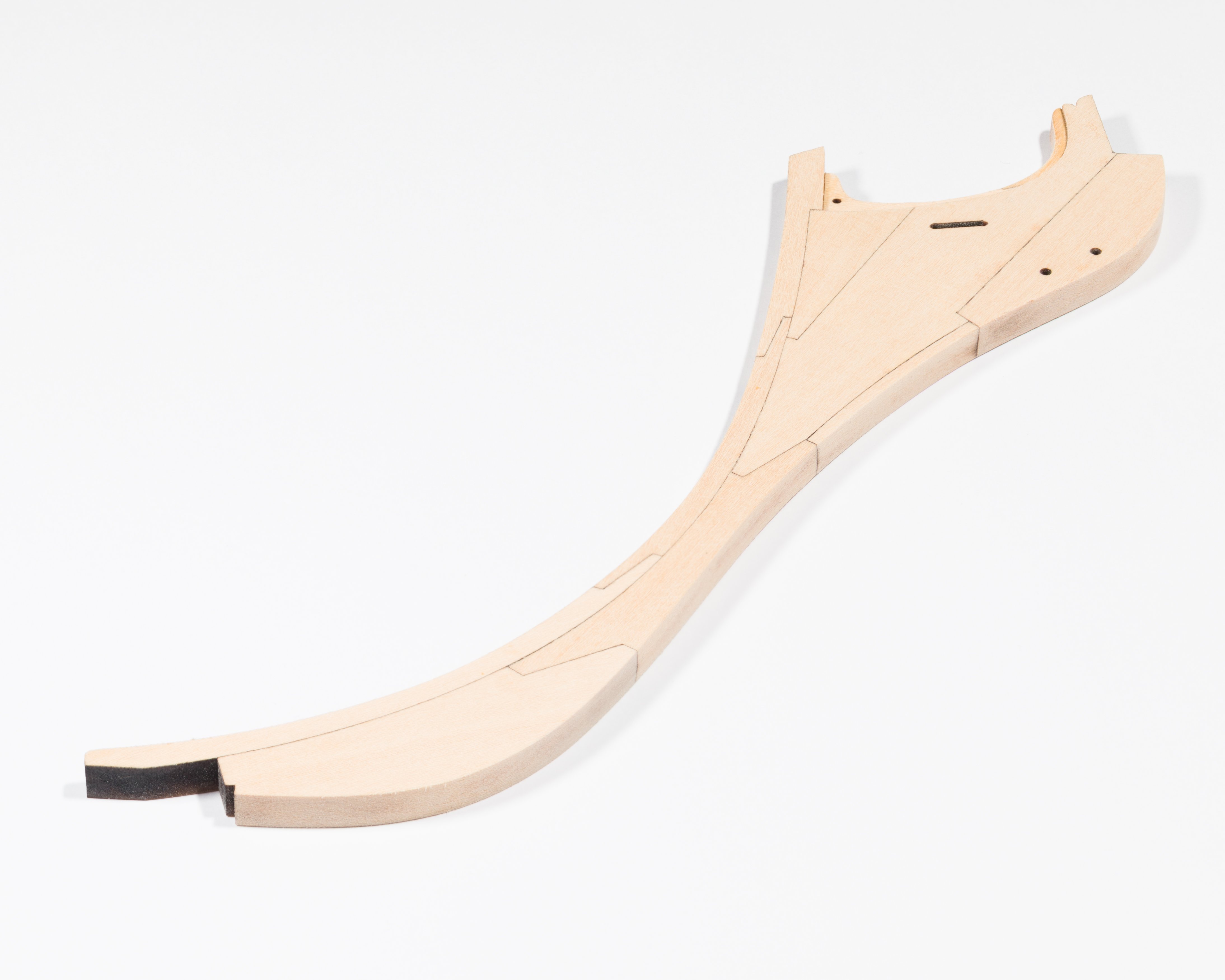

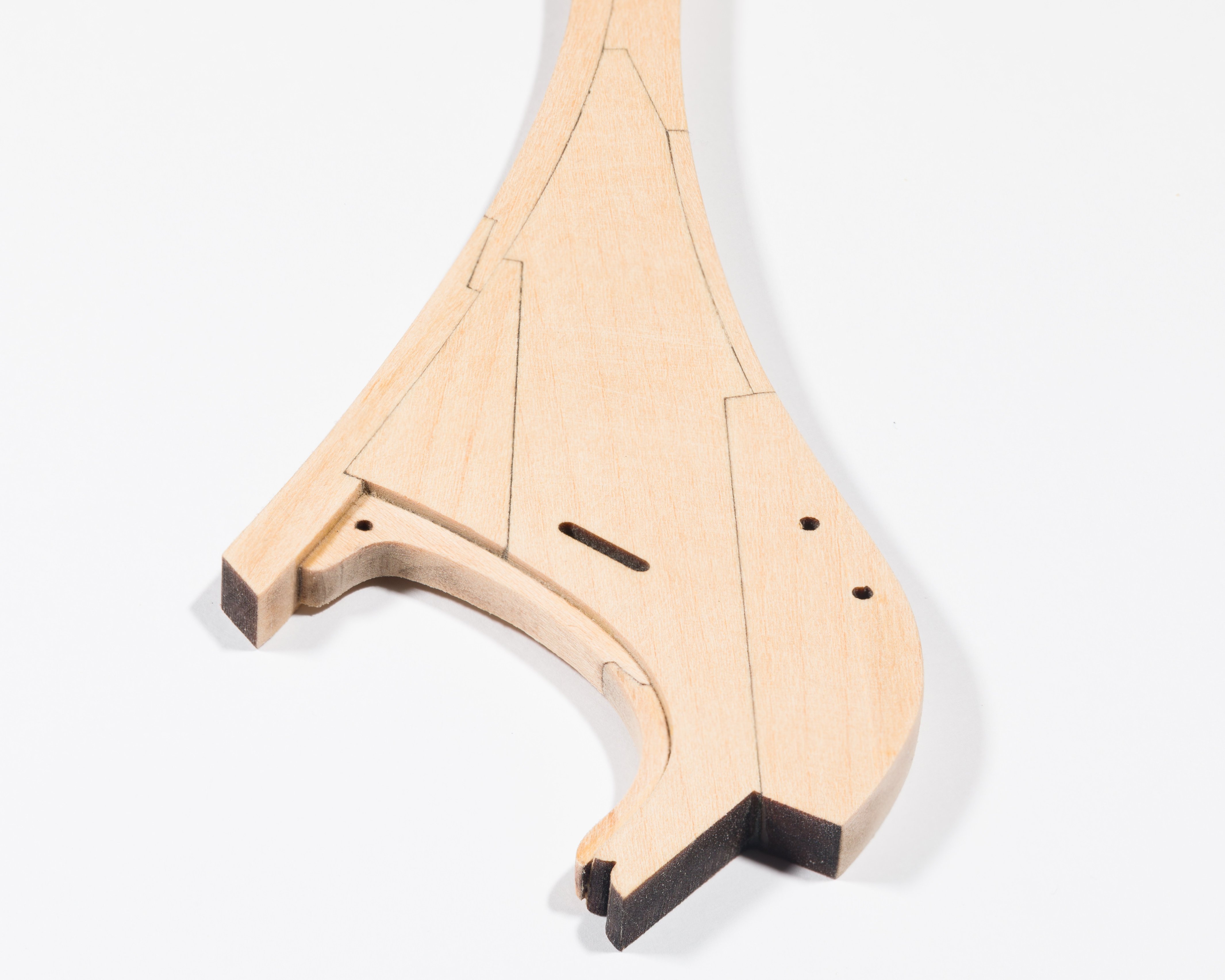

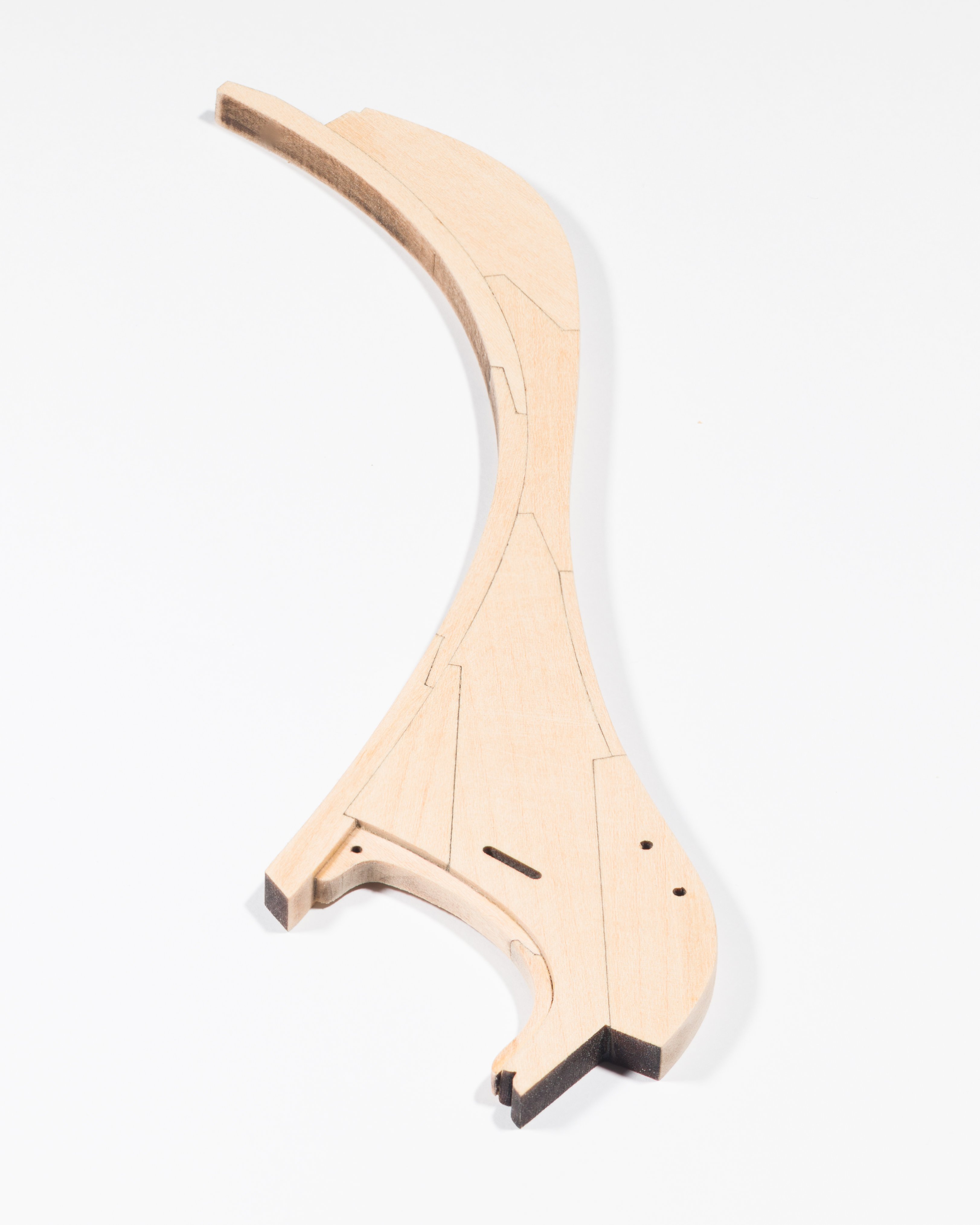

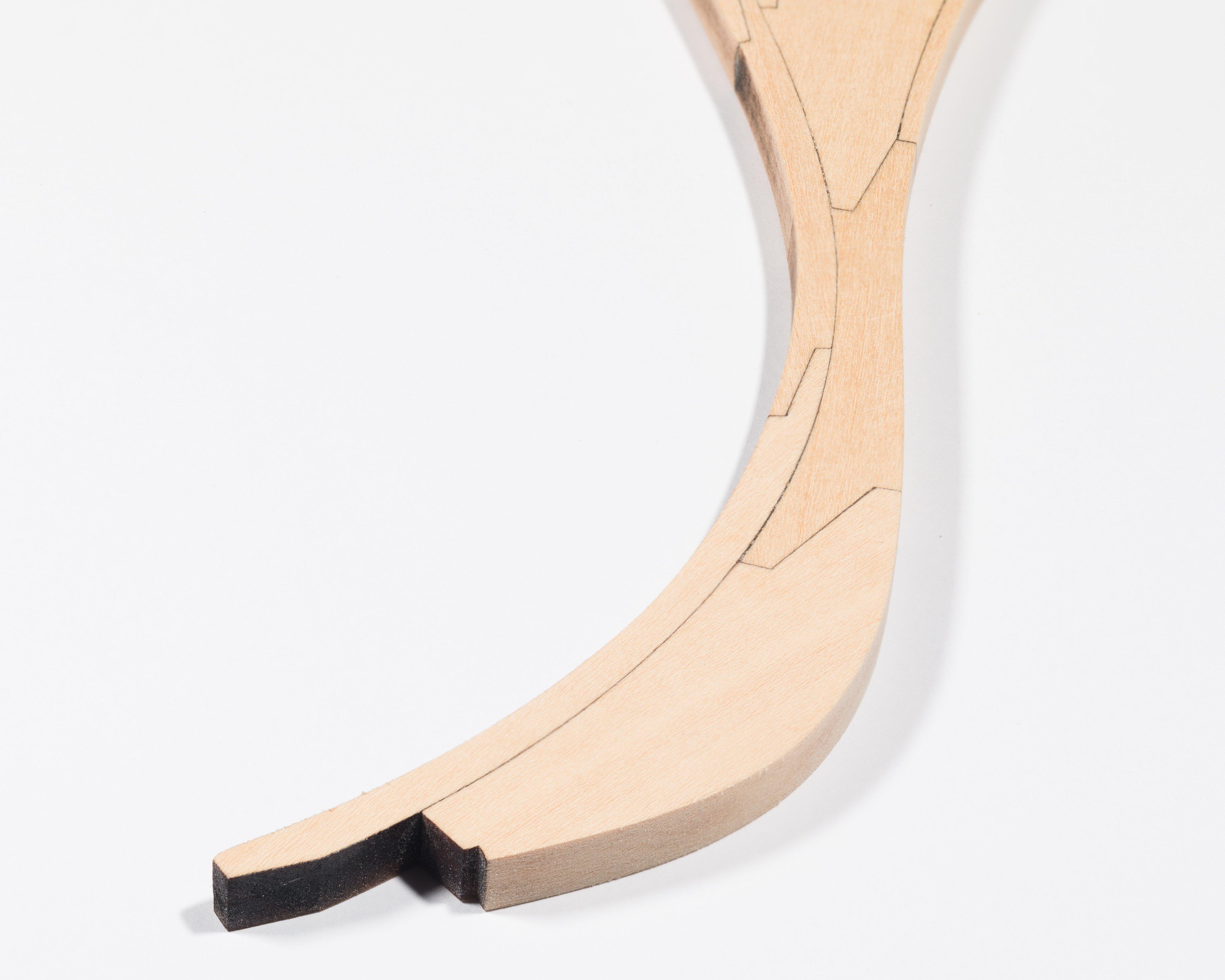

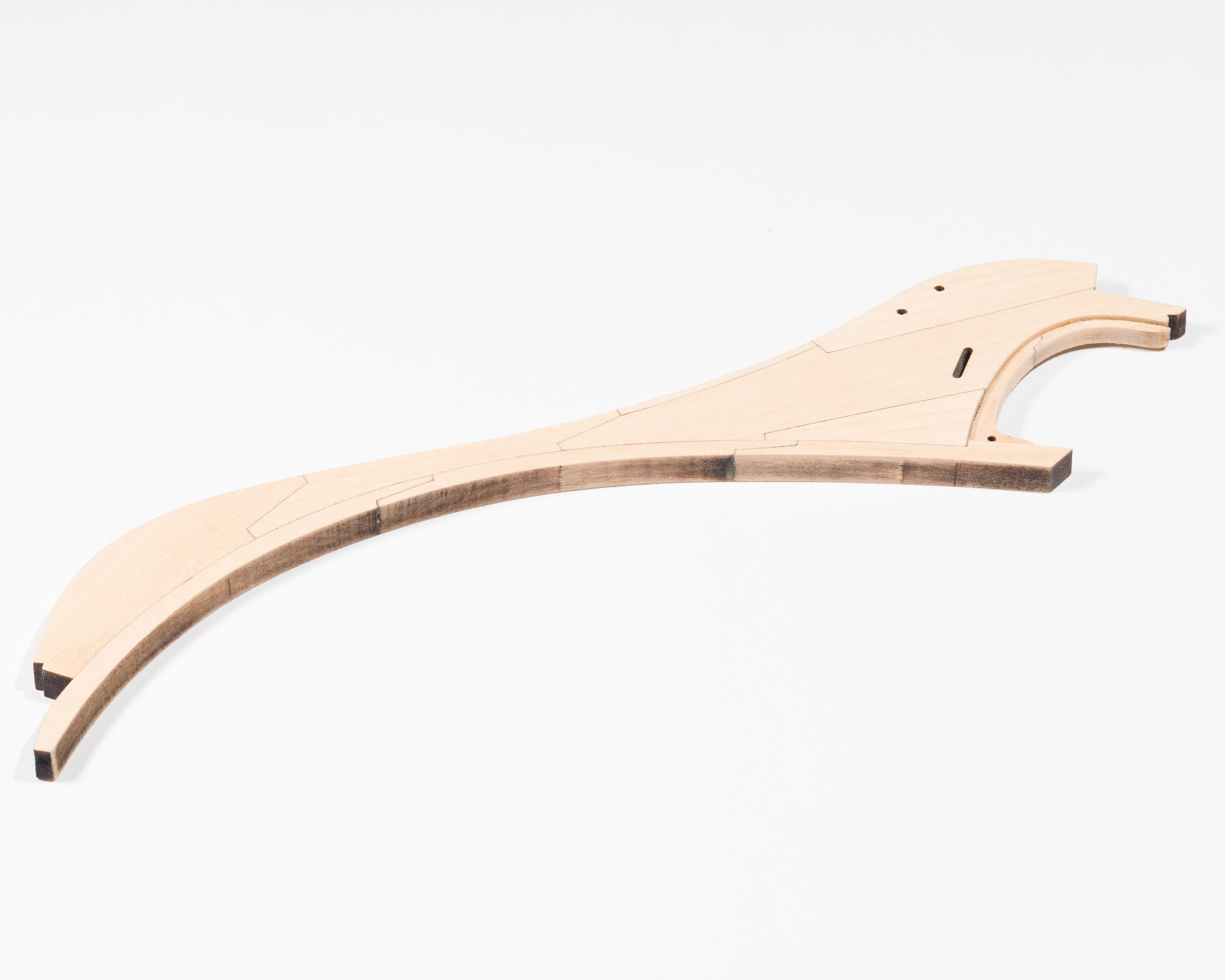

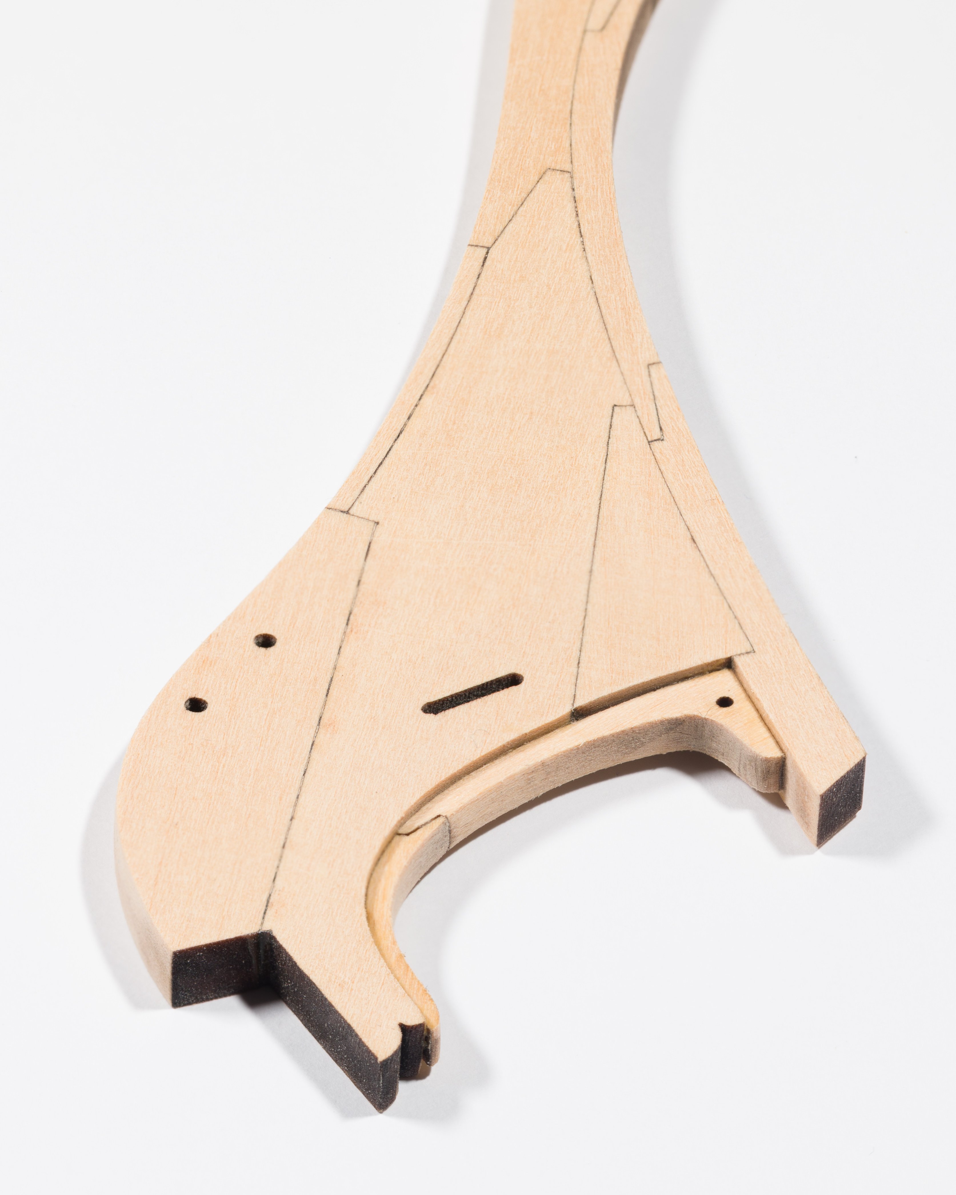

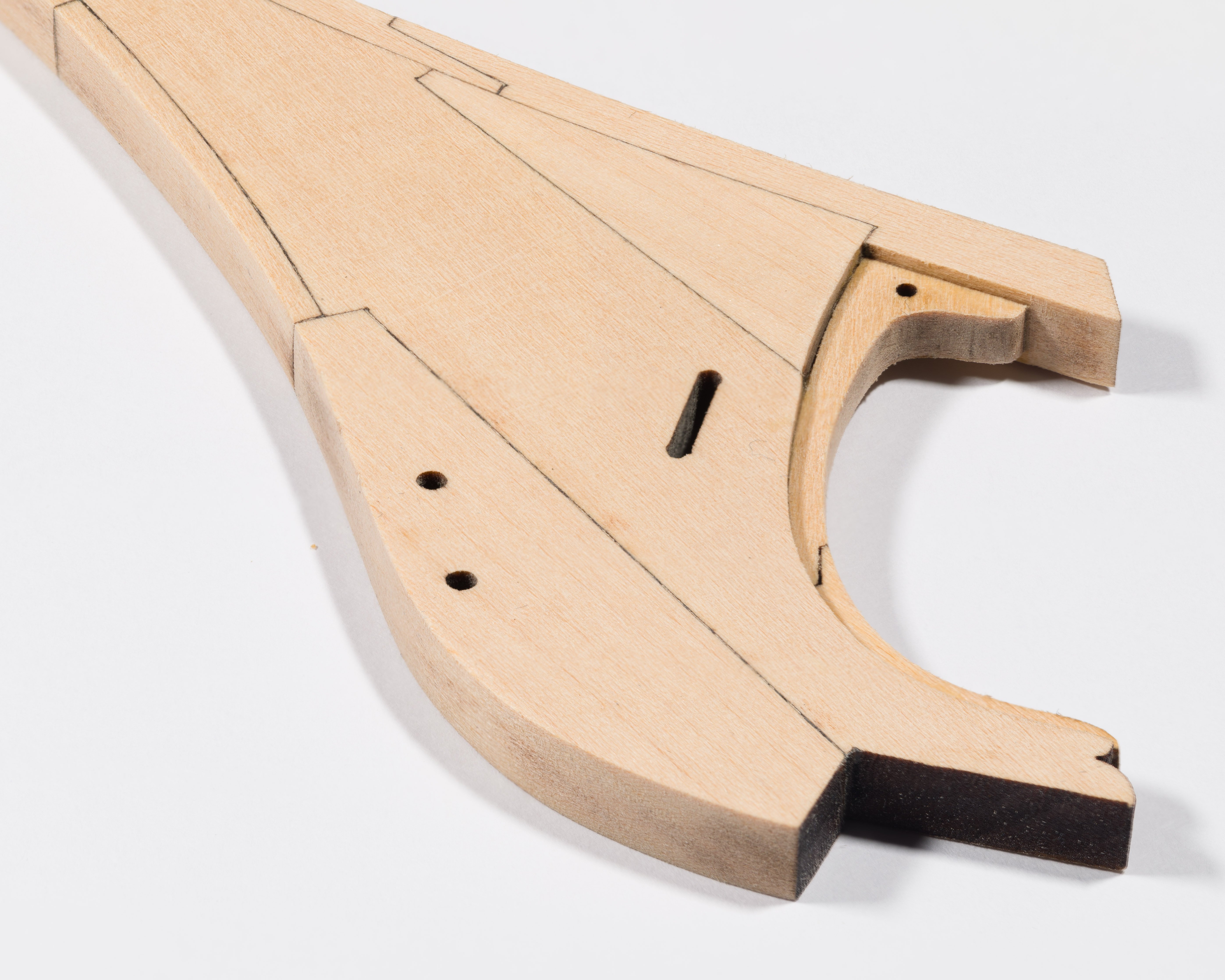

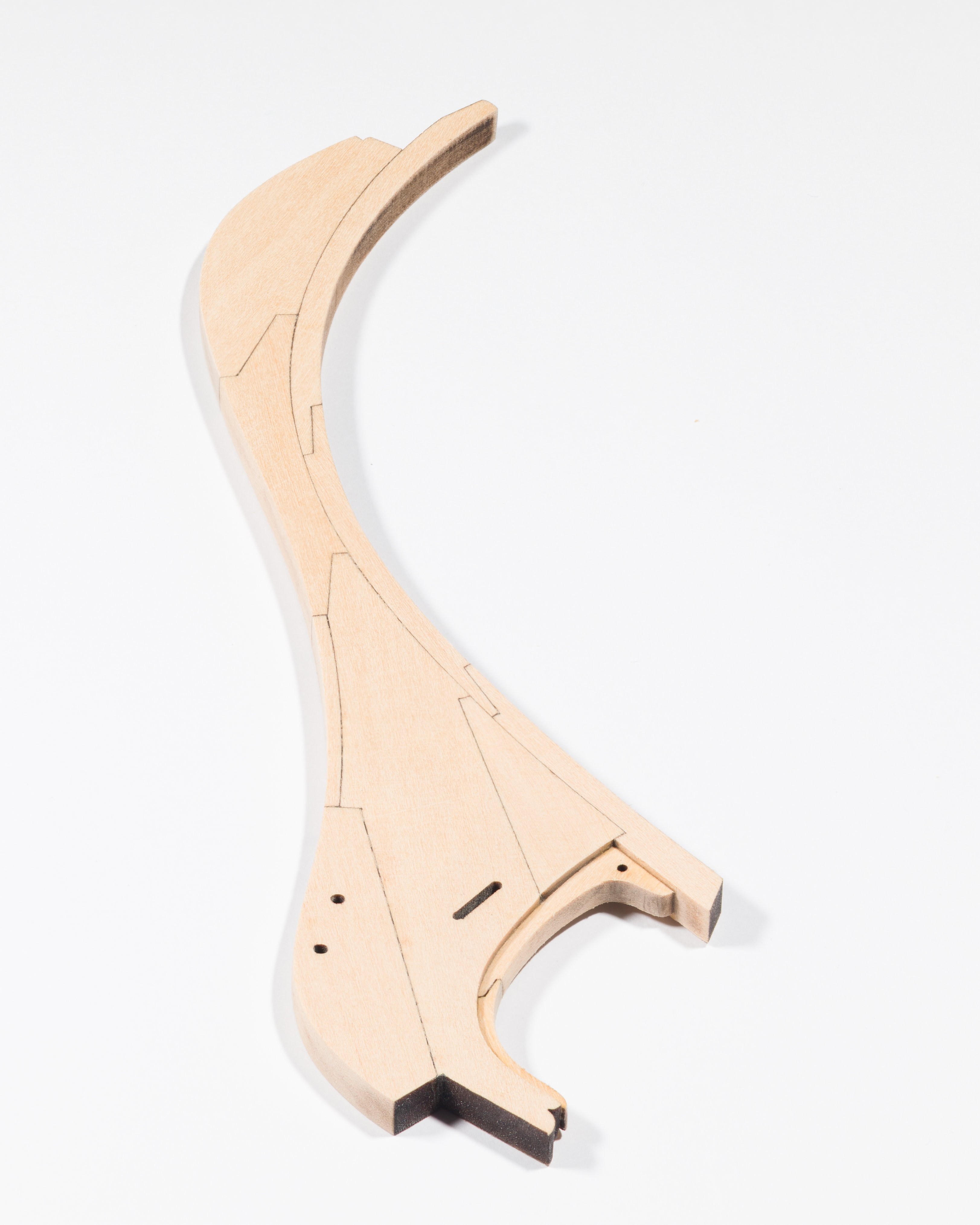

I have assembled my 3rd version of the stem after having issues with the laser using too much power.. I used some Sassafras that I had and thicknessed 3 300mm x 80mm x 6.35mm planks with my Proxxon DH40 thicknesser.
I used one plank to calibrate the lasers power to the material and then cut the pieces out on the 2 remaining planks. I had taken the original files and used acrobat and illustrator to make new cut files that would fit the plank sizes I had.
I may use this as the final version of the stem.

Wow!
That's looking suberb with superclean cust and crisp fitting!
Keep going, I'm curious how your build will progress if this is already so beautiful and clean!
And very good pictures by the way!
Frank.
Edited by FrankWouts

Thank you. 😊 I should be so lucky the rest of the build will be like this. A wood worker I am not. 🤣
Not all my photography is like this. I do have pro equipment but sometimes I find the Samsung phone does the job for in progress shots.

Yes, I think your build will be like that, for sure with such a clean lasercut you won't have to adjust and clean up so much.
That laser and its settings seem to cut at an exact 90 degrees angle judging from your photographs.
Or did you have to correct some joins that weren't exactly in a straight 90 degree angle?
Cannot wait to see more of it!
Frank.

All of the joins were as supplied in the files. I calibrated the cut power as best I could. I have not yet investigated the kerf or taper of the laser. The machine though apparently has a 0.15mm kerf.
The 11 pieces of the stem fit together snugly after cleaning the tabs that hold the pieces in place after cutting.
I am now in the process of assembling the keel and frames. I hope to have an update here soon. :)

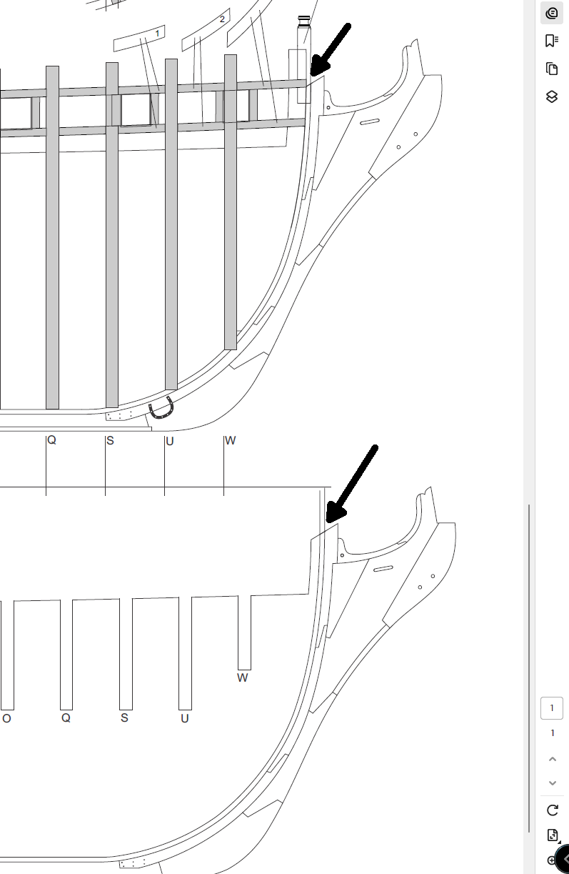

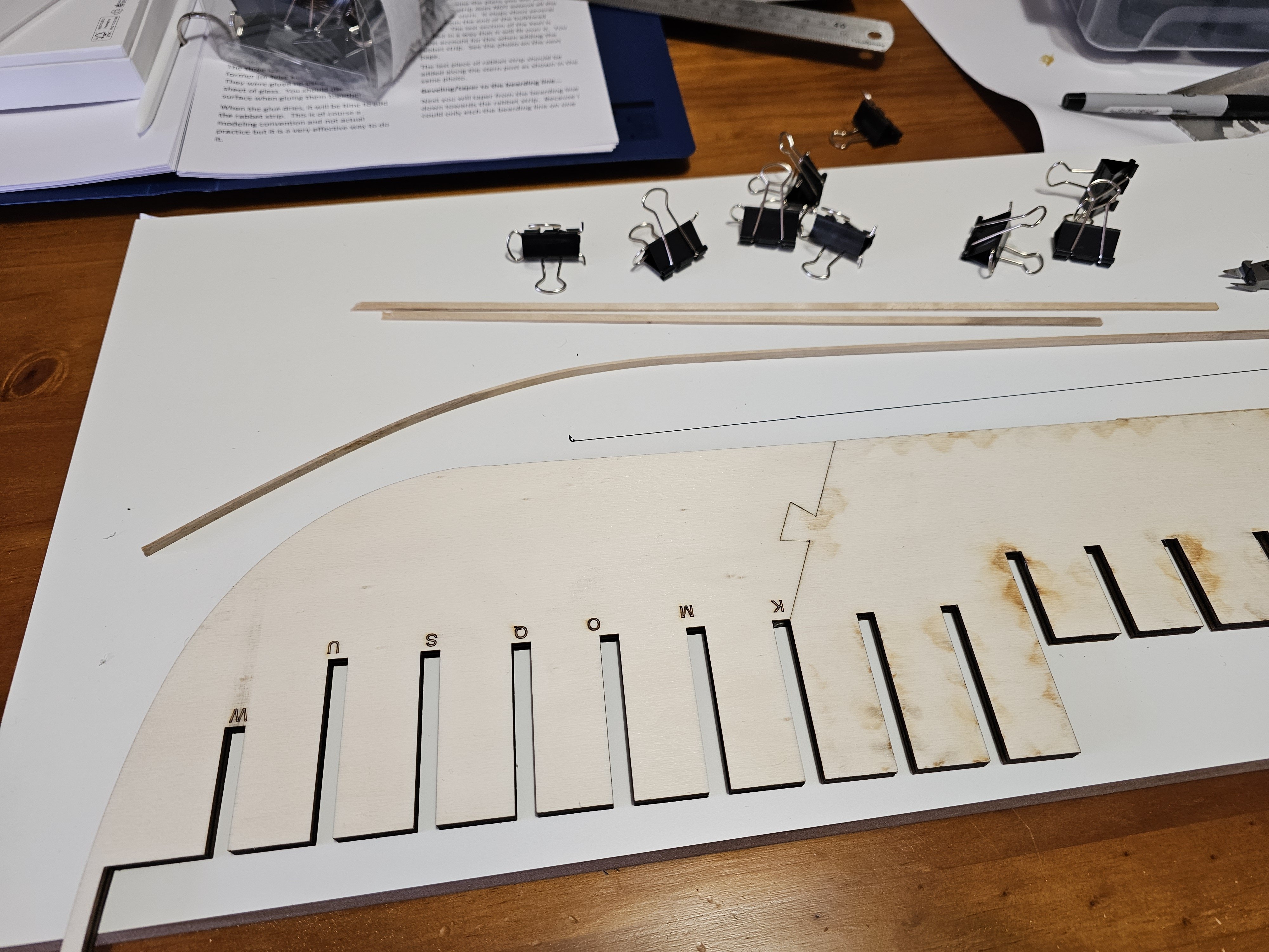

Morning all,

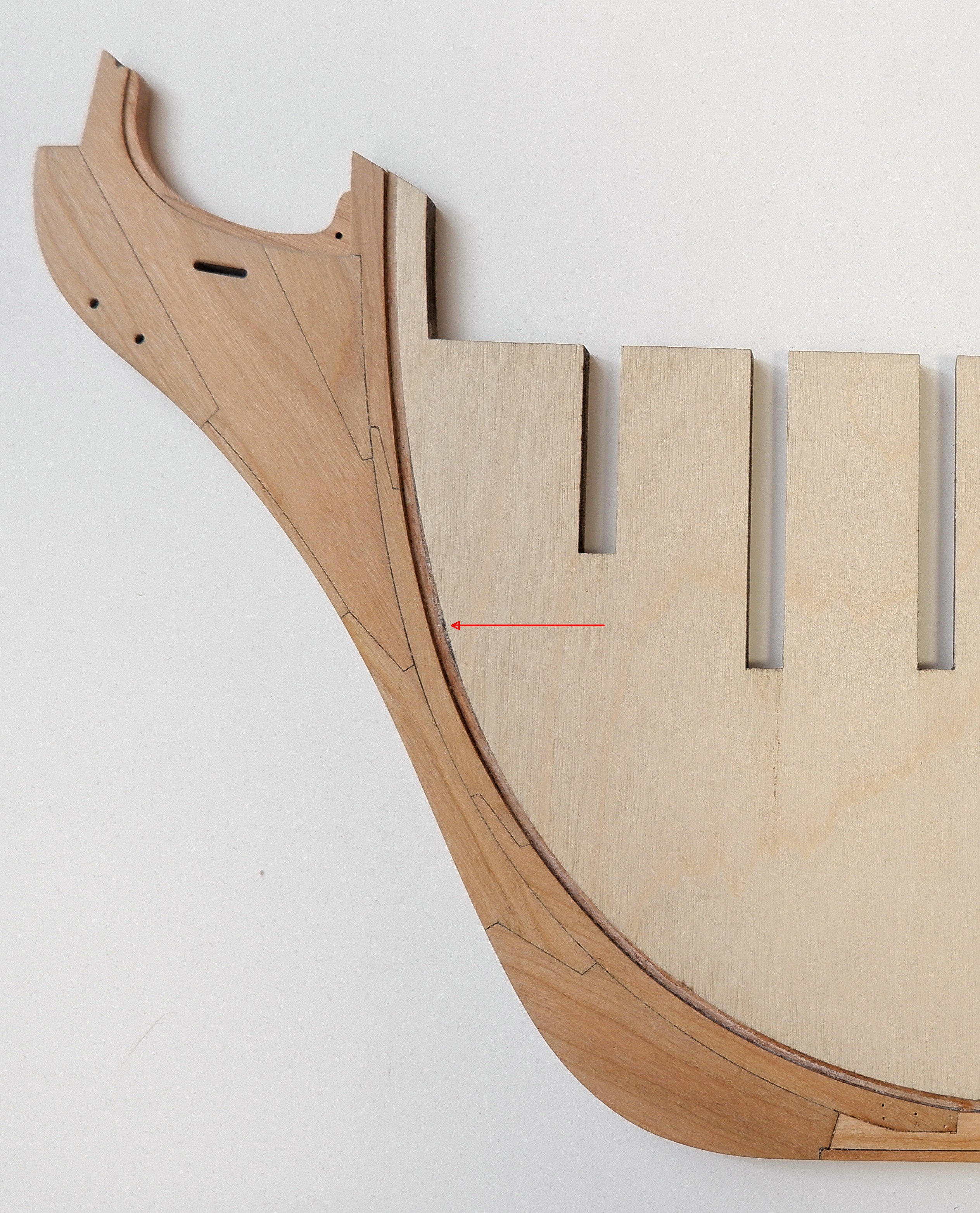

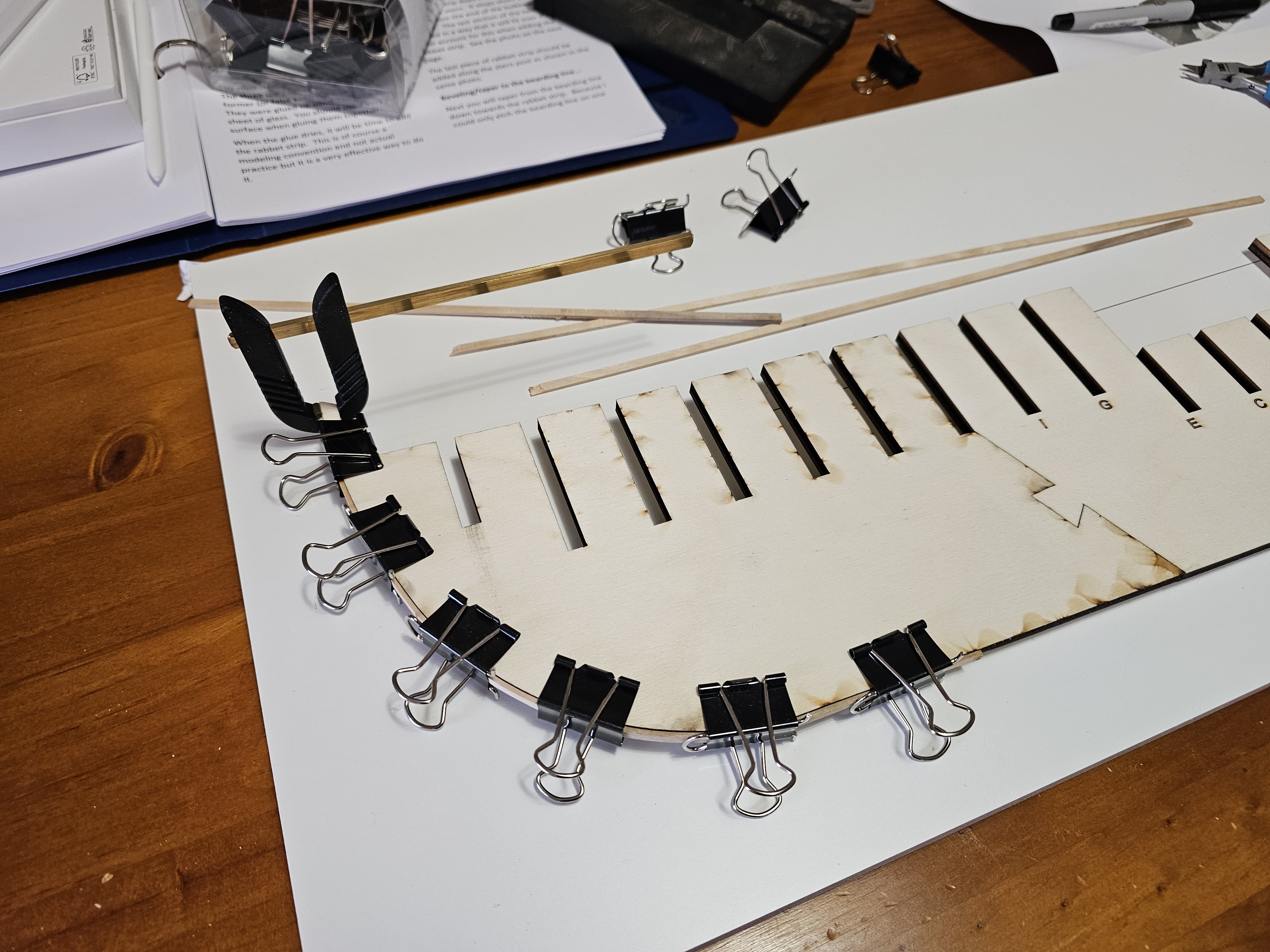

Work slowly progressed the last few days. I have gotten myself a melamine building board and have started to glue the rabbet onto the false keel. I used my Byrnes table saw and Proxxon thicknesser to make the 4mm x 1.56mm (5/32nd x 1/16th) strips for the rabbet. The rabbet eventually came out to 1.53mm thickness.
I used an Iron to heat the strip and clamped in place whilst it cooled and set with a curve.

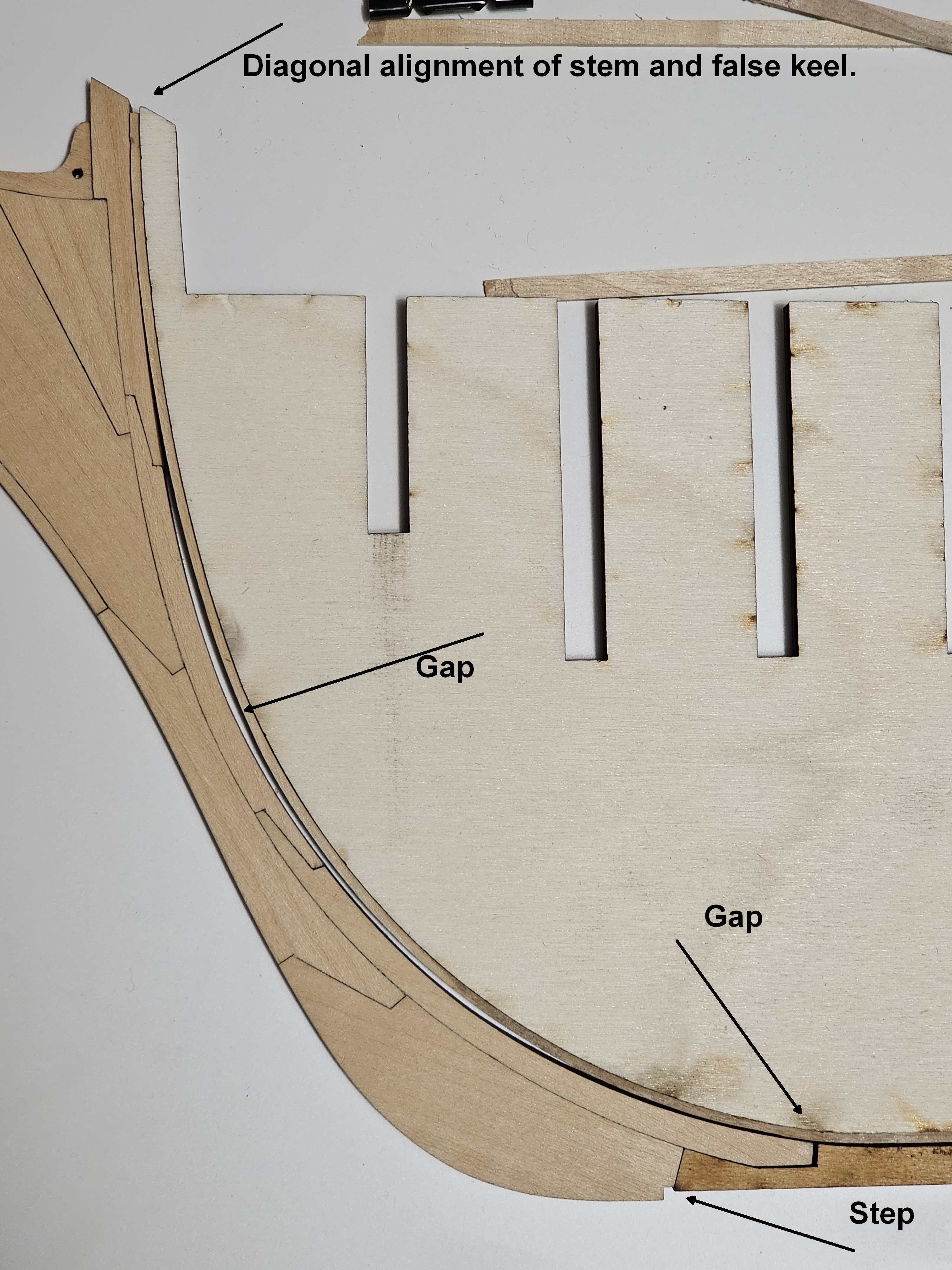

With the rabbet in place, I positioned the stem and the keel piece #1in position to check for fit. As can be seen in the 1st image, both ends of the stem are in contact but there is a roughly 0.8mm gap (perhaps more) in the centre. My question then is how to rectify this?
1) Do I remove wood from the top of the stem allowing the bottom to act as the pivot?
2) Do I remove equally from the top and bottom realising that this will affect the stem to Keel #1 piece. If you look carefully at the stem to keel #1 joint, you will see there is a flush fit everywhere bar the stern most vertical joint where there is a 0.8mm gap. Also note the false keel step on the stem and keel #1 piece joint.
Thoughts on how to proceed would be appreciated.

Can’t help you with the different woods you mention, but for the looks, my taste would dictate me to use the same wood as the one you made the keel and bow wood of.
For the gaps you describe along the curve of the rabbit at the bow, I would just fill them with some extra strip of the same with and sand/check/sand/check, etcetera…until it fits in the curve of the already constructed bow wood.
The rabbit may not be of a constant width at the bow, but when you’ll be finally planking the hull, when you leave a very, very light tension on the planks so that they push very light against the curve of your already constructed bow wood, my guess is that you will be allright.

John, the Assembling the Knee of the Head is very nice.
Looking forward to the continuation!
As for the gap, I had too, although maybe a smaller one.
I shaped the rabbet strip according to the stem knee,
So the gap was between the strip and the bulkhead former.
I filled it with glue.
If you have already glued the strip, then I would do what Frank suggests.
I would add the material.
I certainly wouldn't sand off the stem.
Also, there is some flex in the assembled knee at that particular point.
So maybe partially fill the gap with material and partially press it together when gluing.
I hope this makes sense — I can't explain it any better
Dusan
Frank.
Yes, that makes sense. :)
Dusan, Thank you for that. The picture does help. :) I am glad to see this issue isn't just me. :)
I will add more to the rabbet and then thin and adjust until the stem fits correctly. :)
I had the same gap, I imagine we all did. This will be the alignment of your forward planks, best not to let it go. I simply, and very carefully, sanded the curve of the stem until it matched the frame and rabbet. Think it out where and where not to sand, and it doesn’t take much to get it right. I went slow, repeatedly test fitting.
 So I guess conflicting advice from prior builders, all who were successful with their solution. Have fun😁

I have been busy with life but have been pottering along on the Winchelsea.  Over the last several months I have added the Rabbet, the Keel, and the False Keel. Various small issues were encountered but I tackled them one at a time. After a long layoff, I was eager to get going and screwed up when removing some of the bulkhead former at the stern to allow planks to lay correctly. I did not angle the thinning, i gave no thought and took it down evenly. 😒Some filling will be required.
After that, the keel and false keel were added.  After cleaning the joins and surface up, attention turned to my building board.
In Lightburn, I designed some 6mm MDF supports that needed to be cut by the laser as well as 4 strips of MDF that are straight edges.
Yesterday, I used the laser cutter at Adelaide Makerspace to cut a load of sub assemblies from the 6mm MDF.
The were assembled into braces that hold the bulkhead former, and the keel straight.
A couple of hrs later and I had the building board, supports, and the bulkhead former completed and in place.
I then glued in the bulkheads making sure the orientation was correct for the numbered and lettered bulkheads.
I then turned my attention to the 3/64th inch pieces for the window spacers, the BF-1 spacer shims and the rear transom. I got 3  veneers, 1 . My Proxxon machines cut to a width of 80mm max. So, how to get a sheet or two of that size (I use mm, so it is 1.2mm sheets needed.) I visited a local specialist timber supplier who had various veneers of different thicknesses. I got 3 pieces of 750mm x 190mm x 0.5mm thick Rock Maple. I cut two of them into 4 pieces just over 300mm long. I then used Titebond II to glue two together giving me 2 final pieces at 300mm x 190mm x 1mm thick. The glue layer will add a touch of thickness I hope. I have them both under a weight of books to keep them flat until fully cured overnight.
I will then go into the maker space and use the laser to cut these shapes out.
Hopefully my next update won't take as long.

I visited a local specialist timber supplier who had various veneers of different thicknesses. I got 3 pieces of 750mm x 190mm x 0.5mm thick Rock Maple. I cut two of them into 4 pieces just over 300mm long. I then used Titebond II to glue two together giving me 2 final pieces at 300mm x 190mm x 1mm thick. The glue layer will add a touch of thickness I hope. I have them both under a weight of books to keep them flat until fully cured overnight. Checking them this morning I found the veneers had corrugated due to uneven glue thickness when applying it. Bugger. I know why though so that issue won't crop up in future.
So, today I went into the makerspace and used the laser to cut 6 of the spacers (I only need 4) from the 0.5mm veneer I had. I glued two of the spacers together which gave me 1.15mm thickness which is close enough. I clamped the two of them between two planks of flat wood for two hrs. Releasing them, I found the laminations were flat, not corrugated.
These two final pieces are BF-1. There are two pieces BF-2, and a further two pieces BF-3.
2 stacks comprising in order, BF-1, BF-2, and BF-3 were glued together and placed into the bow of the ship and glued into place.
Now they are cured, It is time to start fairing the hull. I anticipate a few days to do this as I am house sitting a dog in their house for the next 10 days.
After that, I start assembling the gun ports.

Today I spent some time using corner brackets and foldable clips to protect the bulkhead extensions as suggested in the chapter 1 instructions.
Naturally, after placing the last one, I snapped off one of the rear extensions after a slight bump whilst placing it into the building board after making adjustments.
Luckily, the broken piece fitted into one place only so was easy to glue into the correct place with Titebond II. It has a bracket to align it vertically and two foldable clips to keep pressure on it whilst the glue cures.
This demonstrated to me how much care will be needed fairing the hull.

I started to sand the bulkheads on my model of HMS Winchelsea today. It will be a long, slow process doing this.
I made a video to show the process to my friends and family.
https://youtu.be/JrVObBMVb4c?si=fpDXILDY2NxrL-Ev
