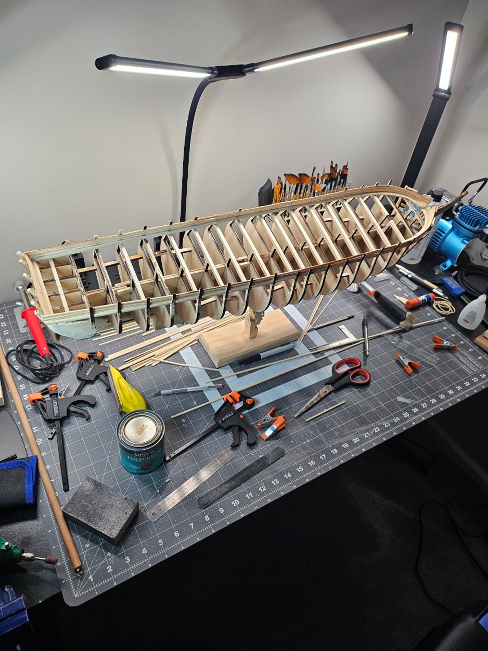

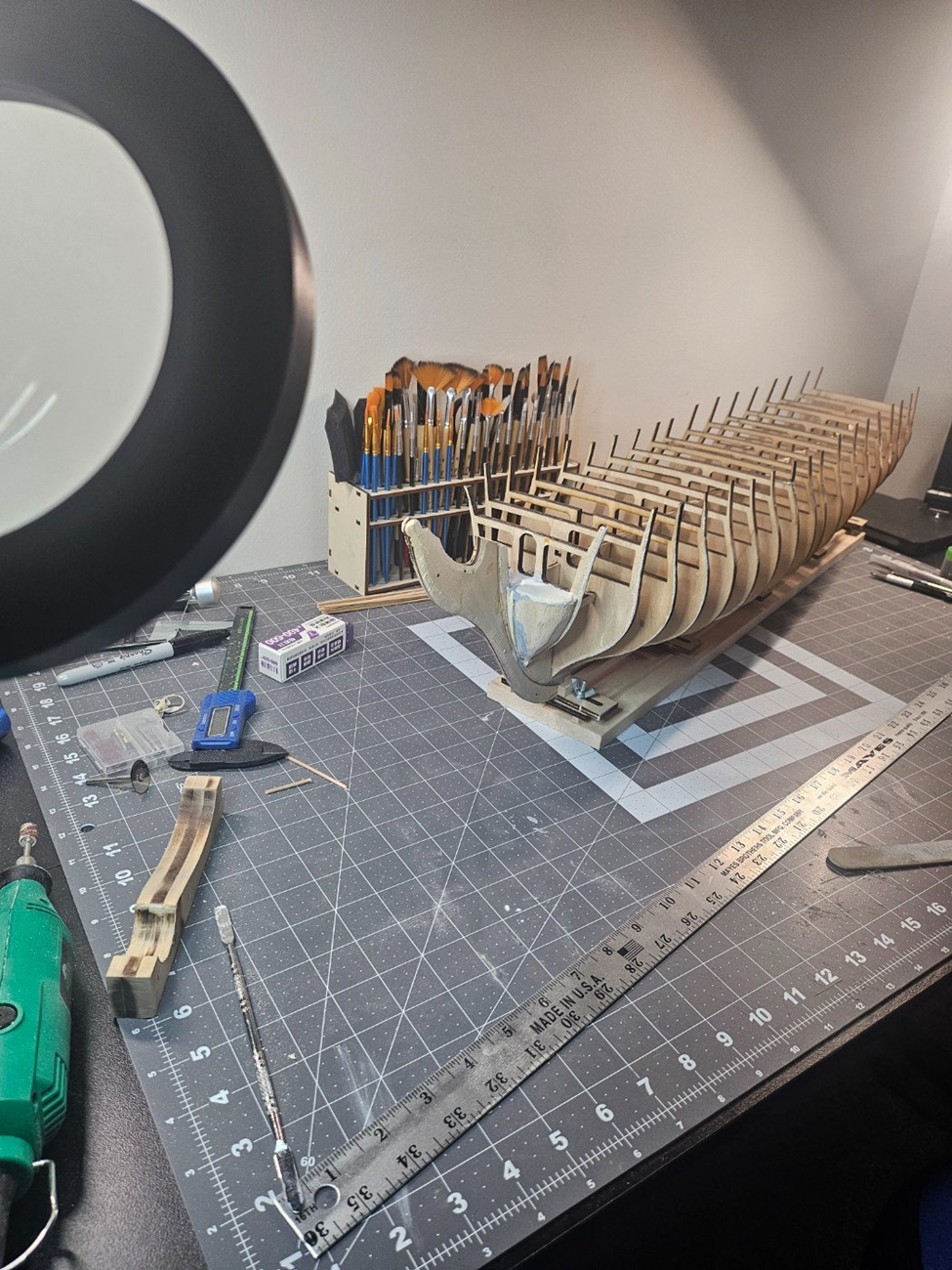

***All - I just joined the forum and I'm also a member of Ships of Scale (SoS).  Below is my build log from SoS.  I omitted any conversations with other members at SoS and kept it mainly to my comments to streamline this log as I add it into this section.  Feel free to provide any constructive feedback and/or comments if you wish.  This is an entirely new learning experience for me.****

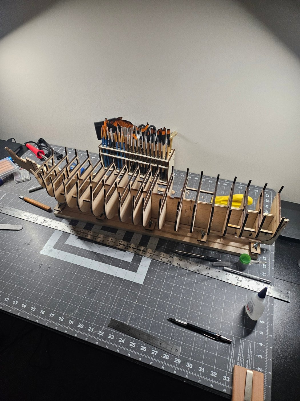

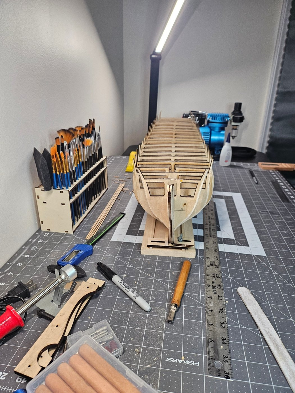

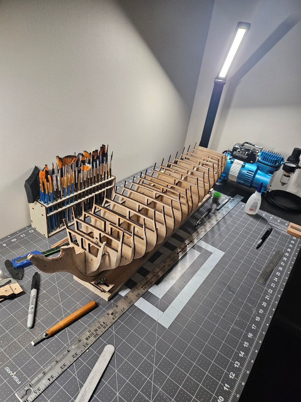

Ok, this is my first build log ever and I started with the USS Constitution (MS2040 1/76, 48 inches, Model Expo). It was definitely an ambitious move to undertake after realizing that this is one of the more challenging builds. As I promised in my intro, I am adding pictures of what I've done so far prior to joining this forum. I seem to be doing ok and at each stage of reading the build plans, I would research online as well to make sure I was doing things correctly. Everything I've done has been by hand and I use my Dremel for shaping and sanding along with chisels.
So far, everything lines up based on the build plans and the manual. I took my time after exploring online what others have done, or how they did it. After I carved out the Rabbett and the Bearding Lines, after tracing the pattern, I was worried I would mess it up, but it turns out that it worked out and followed the reference line pretty well. For the bow and stern areas where there are tapers, I will be sanding those down smoother to look nicer because hand carving is not perfect and I'm surprised I didn't break anything because going down from 1/4 to 1/8 leave you with a very thin piece of wood before gluing on the stern and keel, etc. I will admit, some folks did some amazing jobs from start to finish of this particular ship model. I'll just take my time, so it turns out great. Again, I like the challenge even though I underestimated the skill level of this build, lol...but I think I can handle it and I'm open to all constructive feedback regarding this build and the pictures associated with them.
 ordered the Sophmore course and the masting and rigging courses as well. I'm fascinated by this project even though it is the most challenging I've ever undertaken because I've been a plastic model builder most of my life. But, I've come to learn so far that the researching and reading the plans carefully does make a huge difference after I understand it and let it sink in. There's quite a lot of new terminology as well that I never knew existed. But, I don't regret it one bit...a challenge is a challenge and I don't think I've ever turned down any unreasonable challenge.
I have slowed down a bit the couple of weeks because of a death in the family. I did acquire Bob Hunt's practicum for the Constitution build and the practicum for the mast and rigging. I'm cleaning up the bow filler blocks and debating whether to knock out the bow framing and knight head, or getting the stern filler blocks and structure knocked out...either way, they'll get done.
So this is a current update of what I've done so far after I came back from bereavement leave. Don't worry, this keeps my mind occupied and I've always found it relaxing building models. Anyway, this was my first attempt at bow fillers. Yes, the first time you do it by hand and no machines, it is kind if tough if you've never done this before. So, everything seemed fine until I realized I was off on the by a a couple millimeters and that the port side was sanded down too much, I don't know how I got the measurements wrong, but I glued on 1/8" and sanded it down to correct that. Then I used model putty to reshape the area in question and sanded them down. That's how I corrected them. They look ugly, but it works. I have Bob Hunts practicum for the build and rigging. So, after going through his filler section realized the mistakes I made, 1) I did not use the templates correctly and the proper way to do them. 2) I glued them on BHD A and the centerline instead of doing a good sanity check on the size and location so that the rabbet lined up. Now that I have Bob's practicum, I feel more confident in this build. His layout made me think about a lot of things and a plan how to do them without rushing. The best advice I got after buying the practicum was to look at these projects front a 3D point of view from top to bottom, right and left, and front and back. This philosophy helped me a lot when it came to the stern and counter filler blocks.So this is a current update of what I've done so far after I came back from bereavement leave. Don't worry, this keeps my mind occupied and I've always found it relaxing building models. Anyway, this was my first attempt at bow fillers. Yes, the first time you do it by hand and no machines, it is kind if tough if you've never done this before. So, everything seemed fine until I realized I was off on the by a a couple millimeters and that the port side was sanded down too much, I don't know how I got the measurements wrong, but I glued on 1/8" and sanded it down to correct that. Then I used model putty to reshape the area in question and sanded them down. That's how I corrected them. They look ugly, but it works. I have Bob Hunts practicum for the build and rigging. So, after going through his filler section realized the mistakes I made, 1) I did not use the templates correctly and the proper way to do them. 2) I glued them on BHD A and the centerline instead of doing a good sanity check on the size and location so that the rabbet lined up. Now that I have Bob's practicum, I feel more confident in this build. His layout made me think about a lot of things and a plan how to do them without rushing. The best advice I got after buying the practicum was to look at these projects front a 3D point of view from top to bottom, right and left, and front and back. This philosophy helped me a lot when it came to the stern and counter filler blocks.

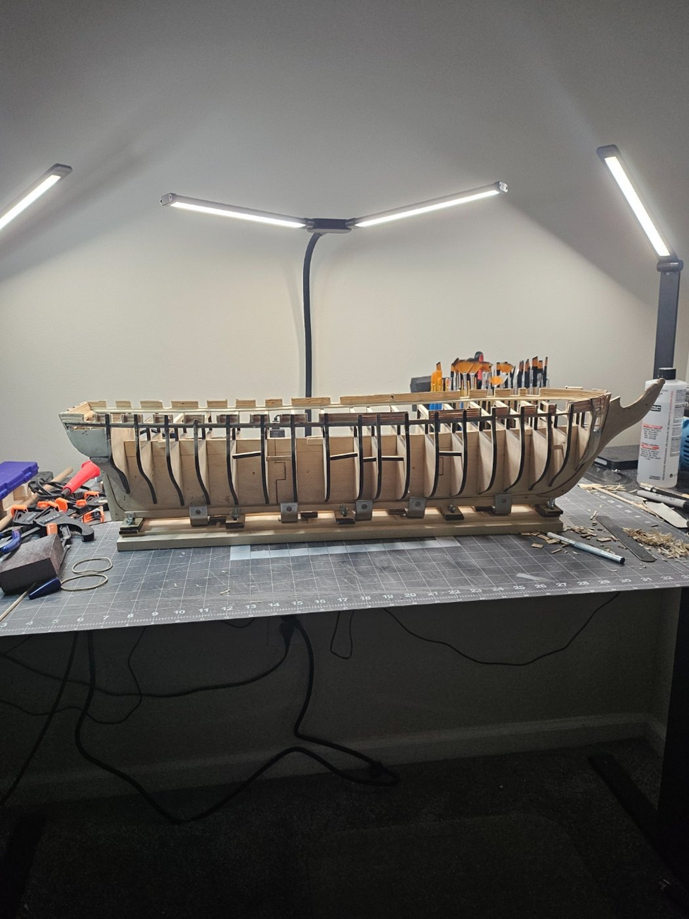

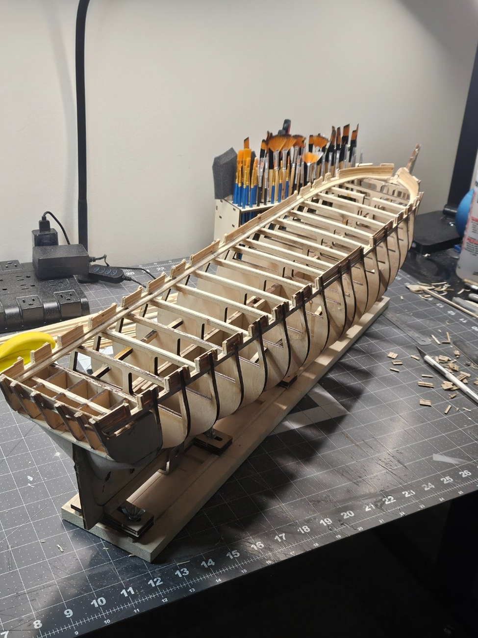

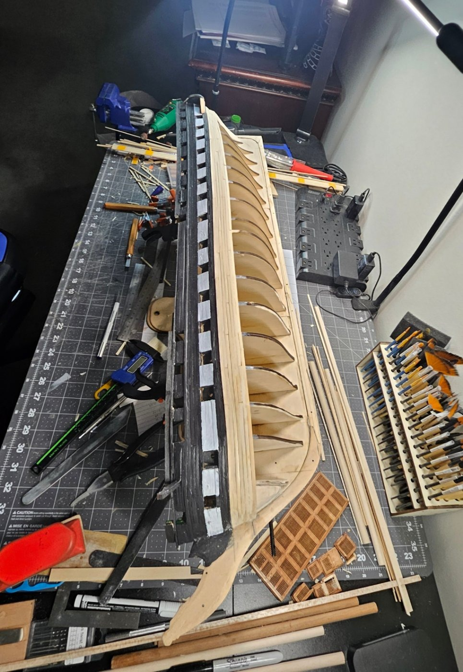

I'm waiting for tools I ordered. I sent onto the counter block and used Bob Hunts practicum. I did this by hand with a pull saw, chisel, and sandpaper. I've never created so much sawdust, wood shavings, etc. From that small block of wood. Anyway, I was very surprised that I built that counter block by hand. I don't think I would have been able to do this without the practicum. I had used the card stock templates and it made sense. When I glued it on, the practicum stated there should only be 1 inch from the top of BHD R to the top of the counter-block. Sure enough it was 1 inch and those clips cover exactly 1 inch when pushed all the way down. And the rudder was centered in the hole. I started the stern filler blocks and let me tell ya, by hand it's not so fun so far, but I'll press along and then next update will be after i finish the stern filler blocks.

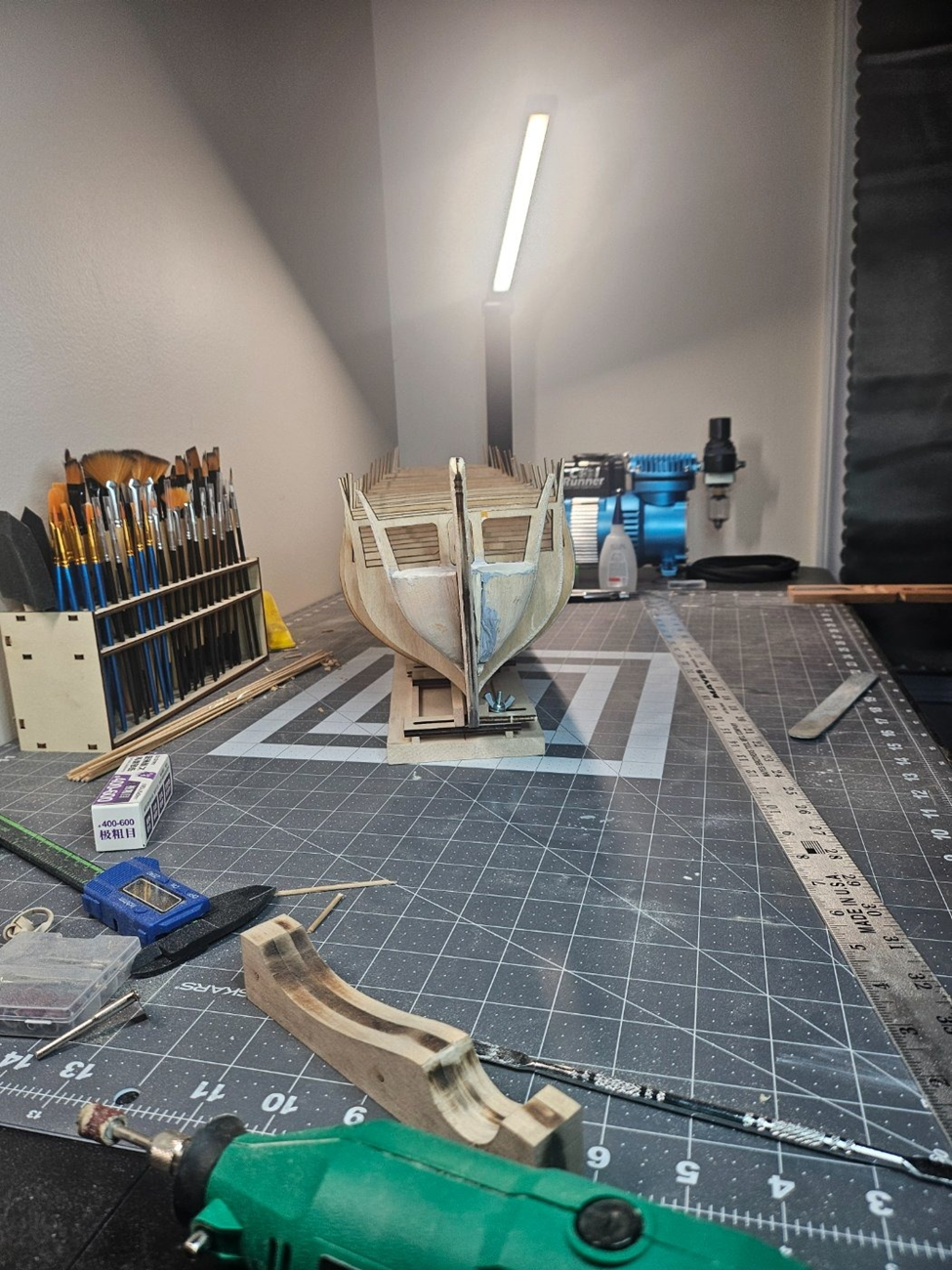

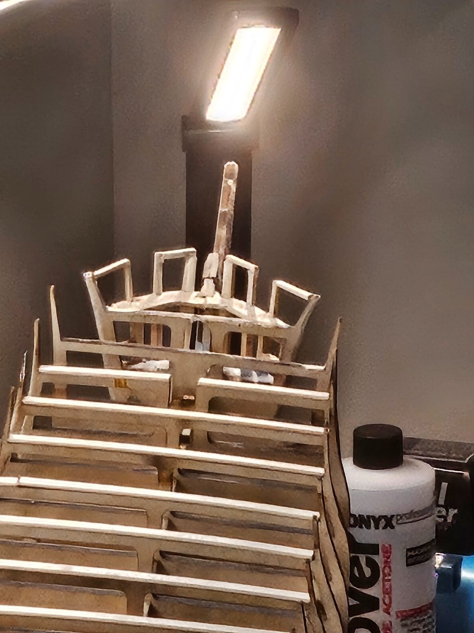

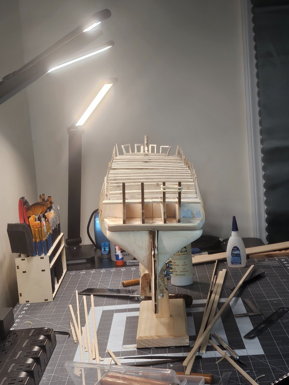

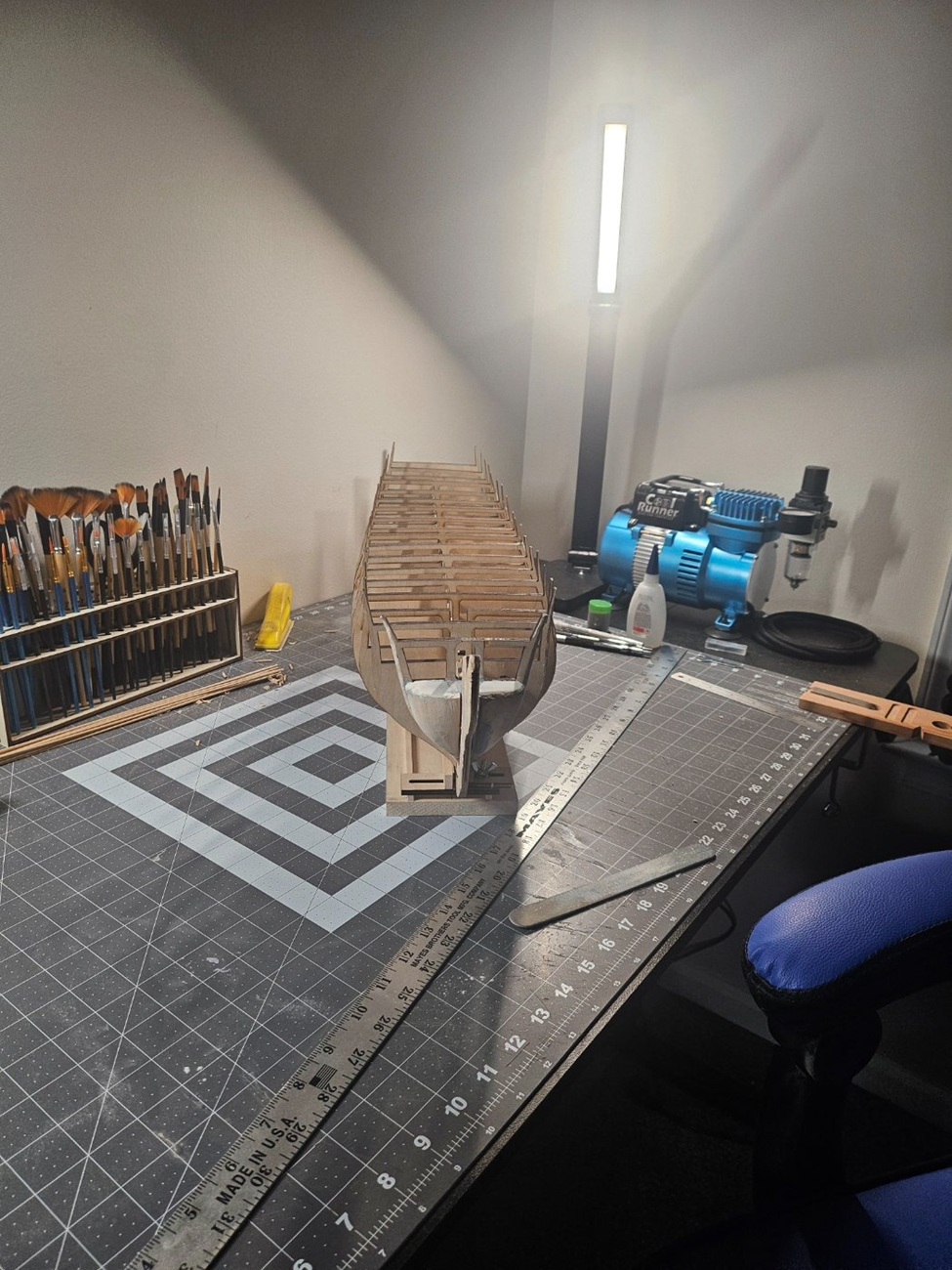

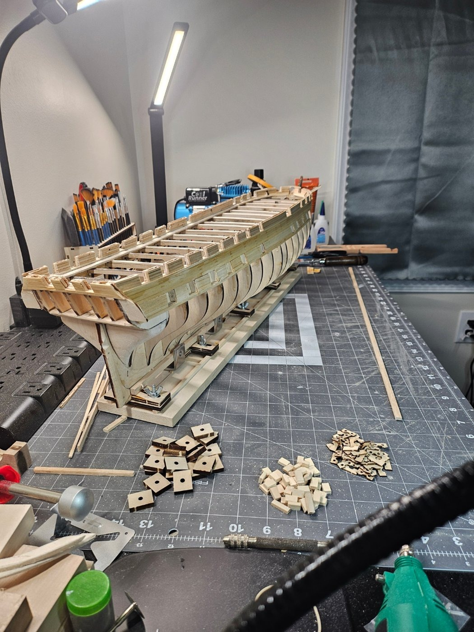

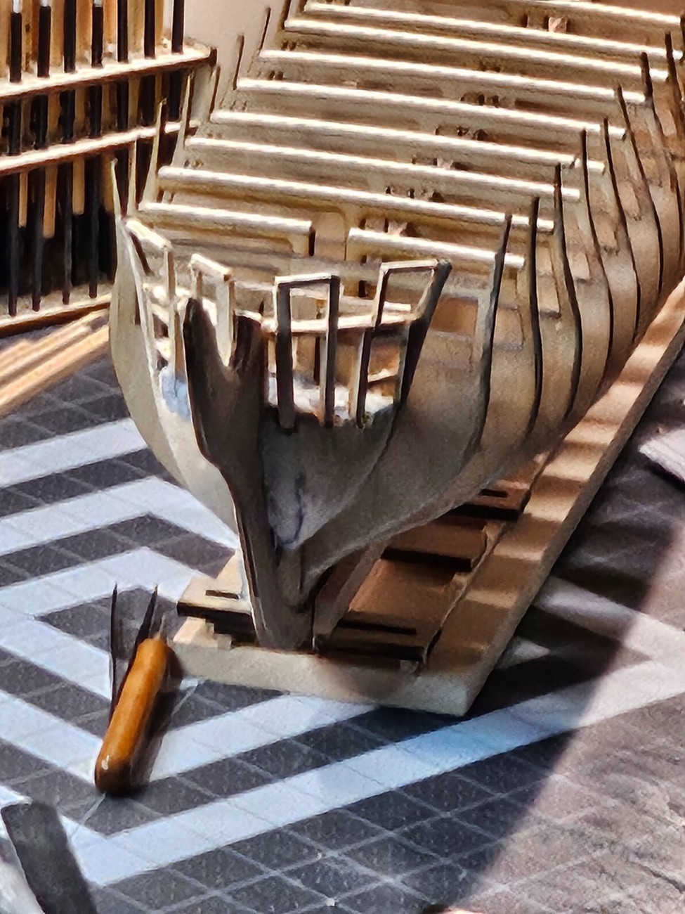

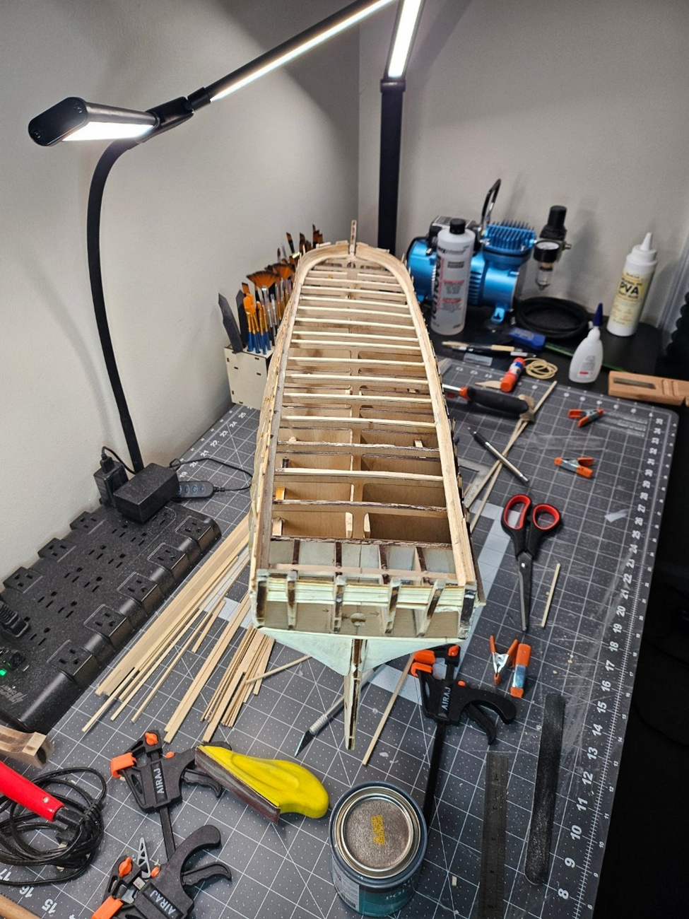

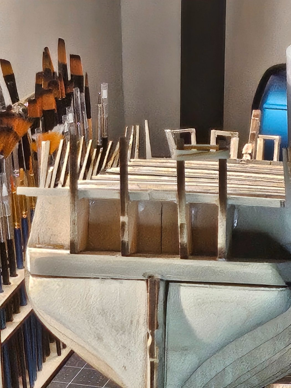

I decided to do the stern filler blocks. The tools I order, of course came after the fact. So, I took the leap of faith knowing that this was going to be painful doing it by hand from sawing the blocks of wood, using the templates and a chisel and lots of sanding until my hands fell off. I never thought I could pull this off and it took me roughly four hours to shape each block. I split this task in two days. I split the block of wood using a pull saw, which wasn't too bad compared to a standard wood saw. Anyway, I made the templates and traced it out on the wood while making sure they were oriented in the right spot. Because there was a lot of wood, I used the pull saw to cut the wood at different angles so that I was left with a piece of wood that was square and fit BHD R and the stern wall. You can see how I destroyed those blocks and left with the scraps seen in the picture. The amount of wood shavings and sawdust was baffling, almost inhuman and I never thought this was possible, but I cleaned up after myself periodically. I was pleasantly surprised that I actually pulled this off by hand because I have ever handled wood this way. They fit well under the counter, BHD R, and the stern wall which I was thrilled to see because I thought I was going to totally mess it up, and there is no way I want to go through doing this by hand.
I'm not sure why the text got separated between the pictures...I'll move onto the bow and stern framework which seem a little intimidating, especially after reading the practicum that gave not a lot, but tons of detailed information which went in one ear and out the other. I'm old and slow and like pictures. Being a former Navy flyer, we like pictures...like a lot. I will attack this in chunks and keeping my fingers crossed that everything lines up and the planks actually fit.
It's funny that the one thing I remember since joining this forum, is when someone said that the ship will look ugly until you get to planking. Boy were they right about that. I've made several cosmetic changes since the bow filler blocks while waiting for other tools to come in, so doing it all by hand is not so fun if there are machines and precision in play. Even when I take my time, I still make adjustments around adjustments I already made and it remains ugly...but when the measurements are where they need to be, not only does it baffle me, but also helps me remain confident that I can pull this off without eating too many crayons.I took my time the last few days battling the bow framework and was able to start work on the transom and get at least the main framework set up. With the gray filler putty I used on the back of BHD R to fill in imperfections after I had to reset the counter will make you go cross-eyed because it's almost like an optical illusion where it all looks off, yet the measurements line up like they should. Perhaps I should have gotten some spray primer to keep the color of everything uniform and cleaner like some of the previous Constitution modelers had done...it does look much better.

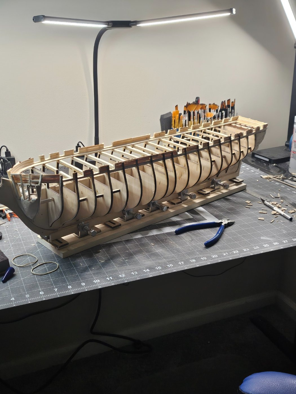

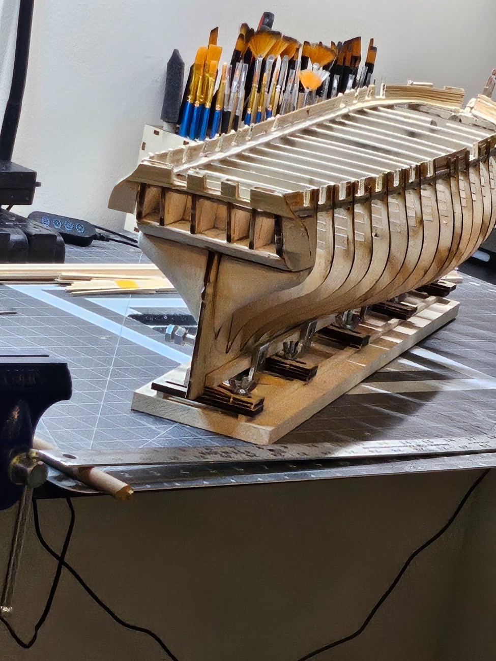

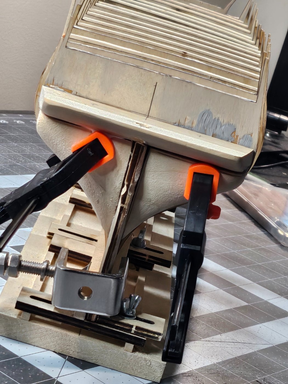

I swapped out the vice fo holding the ship since my other one was stationary. So, I'm sure it adds to the distortion of my pictures taken with sheer precision, lol. Anyway, I should have the initial transom build complete. I've been following along Hunts practicum and I had to take a break because it got confusing following along what Bob is trying to say. After I made a couple mistakes, then I understood exactly what he was talking about...funny how that happens, plus the added bonus of lots of new nautical terms other than the ones I learned the past 30 years in the Navy before retiring. Well, that's it for now until I continue possibly tomorrow with the transom.
Thanks for the insight. Believe it or not, I suck at selfies and photos, lol. I did lay a long straight edge across the bulkheads and everything is level. I almost had to start all over again a couple weeks and actually get new bulkheads and keel assembly because when I laid down my straight edge, it was off. When I looked closer, all of the bulkheads looked higher in the middle of the part. I went back to Model Expo and put in a parts request because I thought I had to redo everything. They came back to me and said to lay the straight edge straight and not on an angle because the bulkheads were designed with the middle being slightly higher. So, I rechecked and sure enough, everything lines up as long as I keep the straight edge across the bulkheads in the same direction and not diagonal in any way. I've made minor adjustments because it appears some slight warping that I'm keeping up with, plus I live like right on the water. I can see in the picture the bulkhead in question, and I will investigate. I may need to shore up the bulkhead to equalize the measurements from one side to the other. But I've been fooled by the lighting because I have six different lights around the table for good visibility. Unfortunately, at different angles and shadows cast out there, I would panic and then when I got right up on the model, everything was normal and realized the illusion caused by lighting and taking pictures at an angle. I will however, recheck that bulkhead because I want the model to come out good and not like a banana.

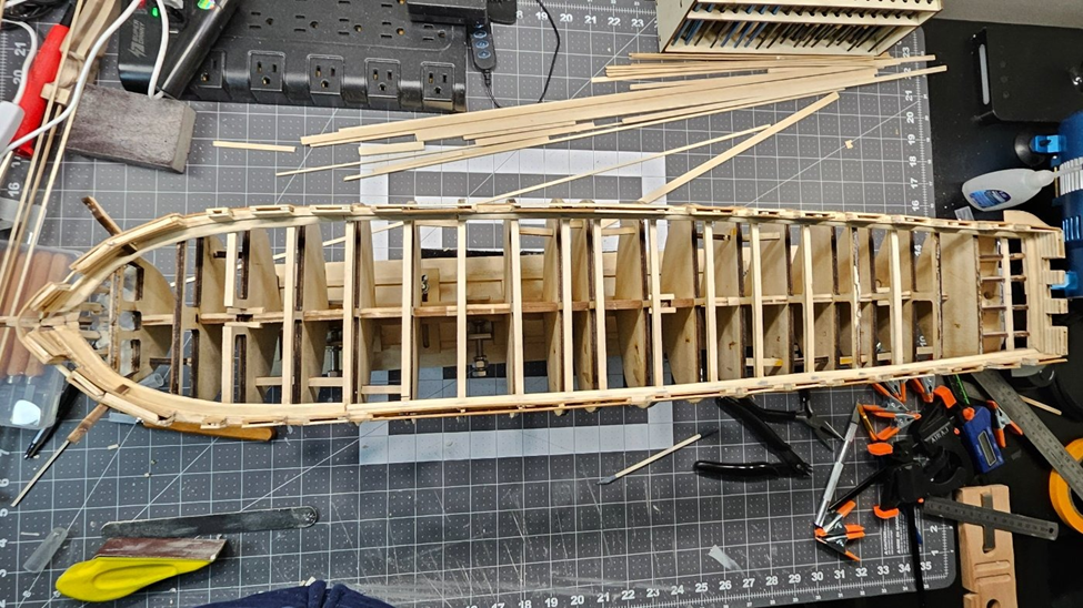

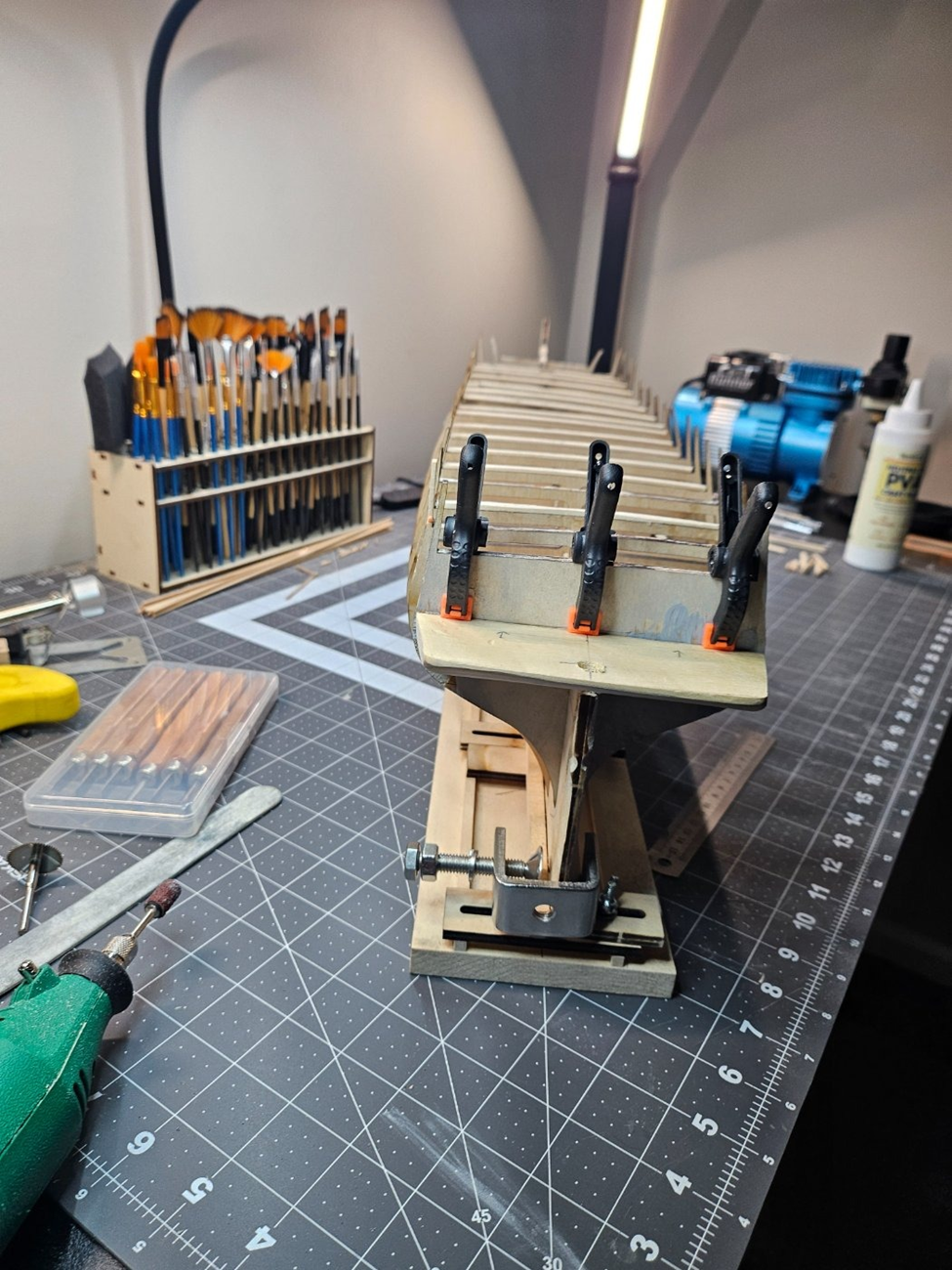

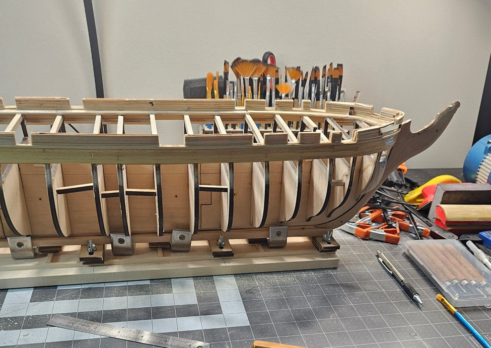

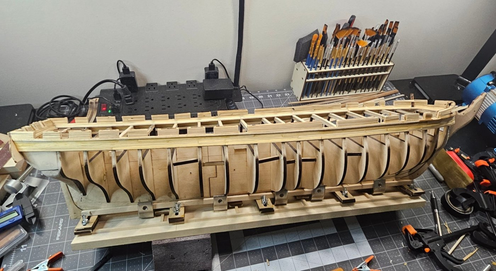

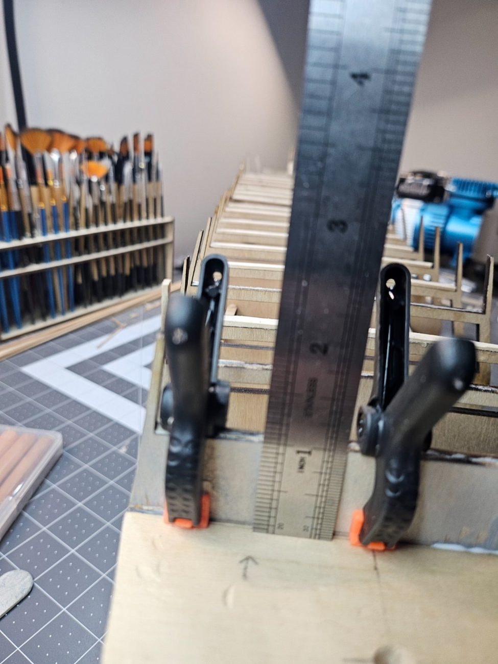

I took a look last night at the bulkheads and they all measured the same on both port and starboard. I rechecked the shoring that I placed between the bulkheads to ensure everything aligned. I really do need take better pictures at proper angles and especially with the lighting. That bulkhead in question is darker from the laser cut than the other bulkheads and that seems to exacerbate what we are looking at. Anyway, I'll make better adjustments when taking the pics.

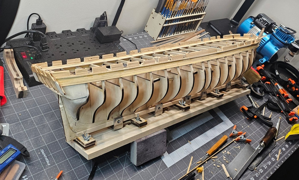

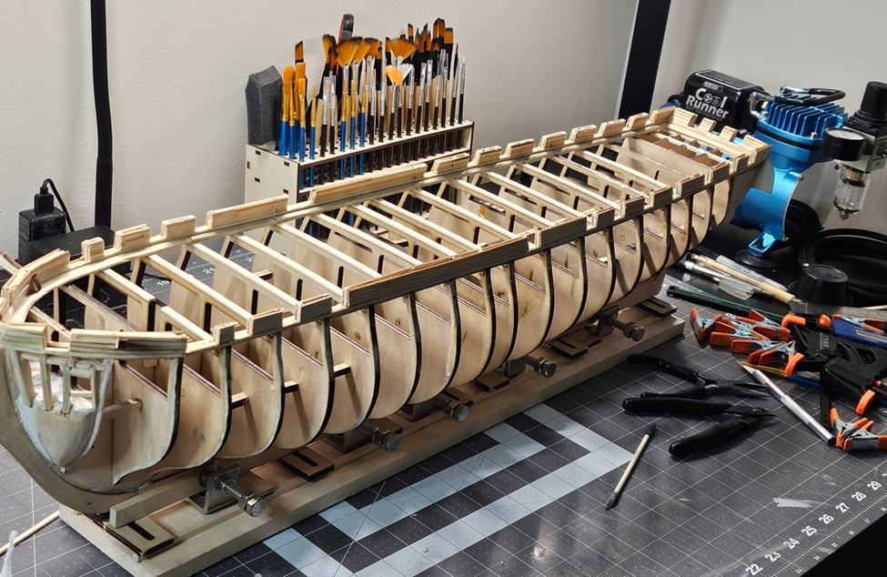

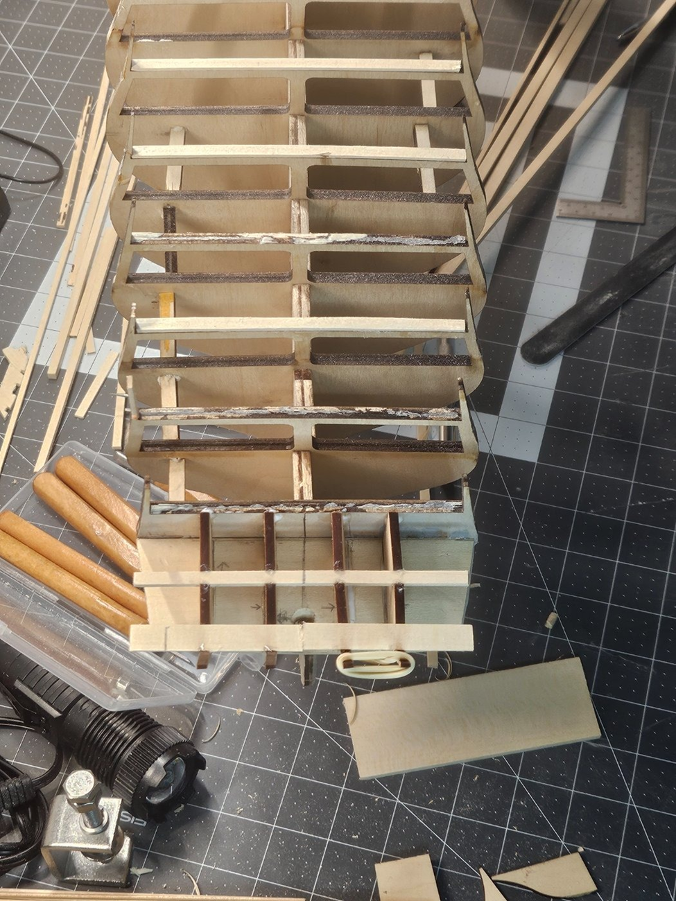

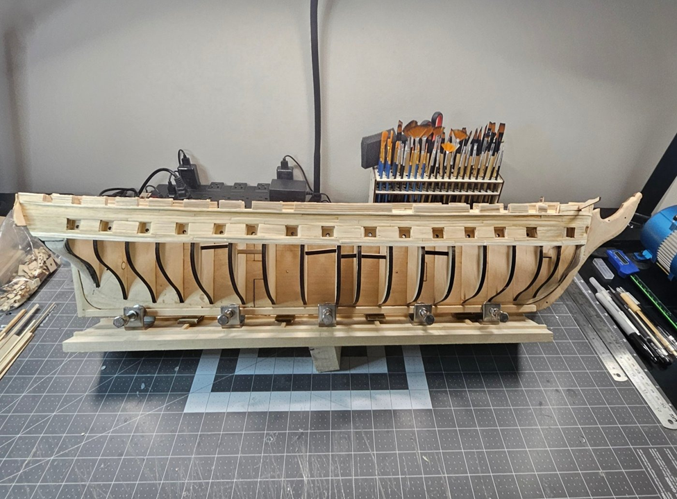

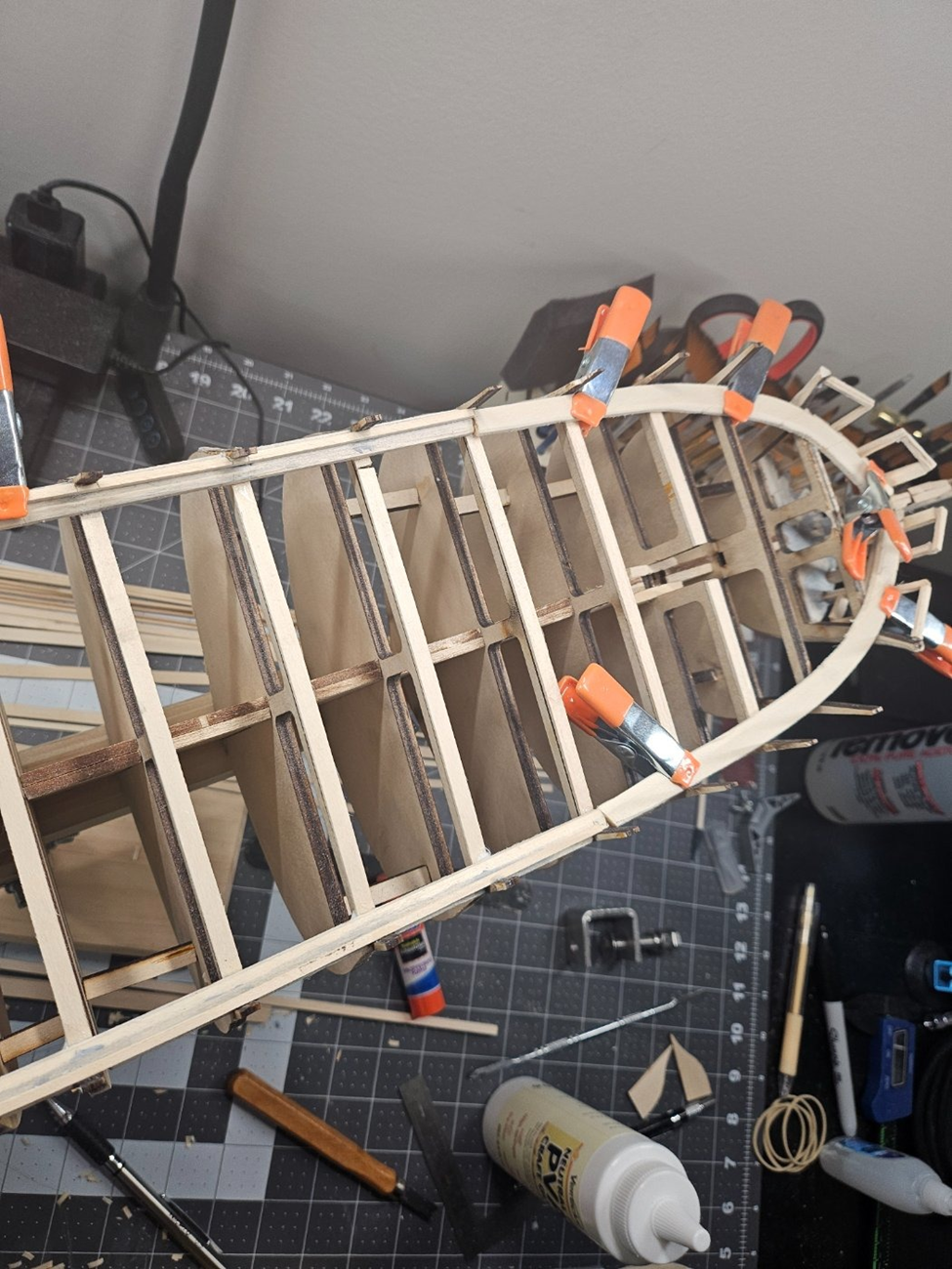

I'll be getting ready to create and install the waterways. I've been reading a lot from the modelers that went through this. However, there is one that stood out and I'm at a crossroads on which approach to take with the waterways. Going through Rob Hunt's practicum, before shaping the waterways, the wood needs to be beveled so that it fits neatly and flat to the side and top of each bulkhead. From the transom to BHD E it's relatively consistent and then BHD A, B, C, and D each have their own measurements. Another modeler, and an experienced one, took a different approach. Rather than physically beveling the wood, he instead measured the distance between each bulkhead and cut notches throughout that piece of wood, so that it fit perfectly into the bulkhead. The other side was the only side beveled, and even then, the bevel was pretty even because it did not need to equalize of compensate for the opposite side. I personally thought that it was not only ingenious but also look really good and professional and believe that his technique was brilliant. Before I make my decision, I wanted to get anyone's take on which approach I should take. Both ways require time with the exception of taking all of the measurements so each notch fits all of the bulkhead extension throughout the ship, which I will say I've broken many along the way and saved by the superglue.

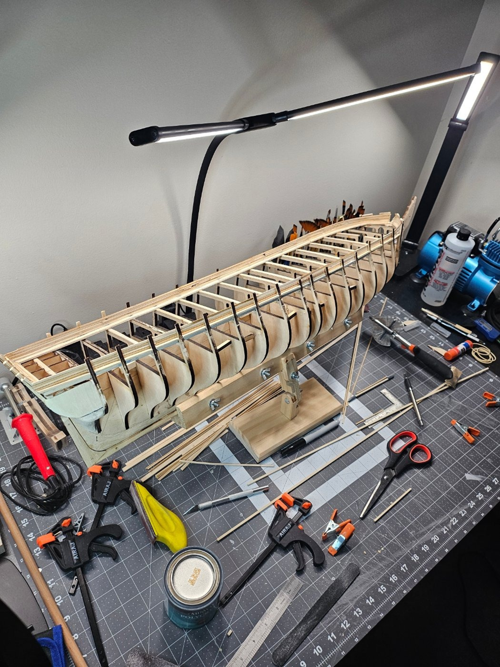

I just finished the waterway and planksheer. I did it over a 3 day period. It was challenging to say the least, but I'm very pleasantly surprised that it came out better than I expected. As with different phases before this, there was always something I had to redo or clean up the cosmetics, let alone my inability to take a good photograph. If I suck at selfies, than I suck at taking pictures of inanimate objects, lol. After several hours trying to synthesize what Hunts Practicum says about the waterway and planksheer, I actually found it a bit confusing to follow because you really have to do it in chunks. Also, it was hard to see some of the pictures so I could get a good view of what it should look like. I looked at what other modelers did and saw there were two ways to do this.
Again, my pictures aren't perfect and most of the time probably not perfectly straight. Call it art; call it what you may. It stated the waterway from BHD E to the bow is slightly wider. Hunts Practicum shows to cut two piece for each side of the bow. Unfortunately, there were no sketches in the plans to make a template. The closest I got was on the 2nd page of the plan where I traced from BHD E to the bow and used the thickness depicted in the plans. So I had a good starting point, and instead of doing this in multiple pieces, I cut them out of basswood sheets I had extra on the side so I have enough wood for building the more challenging part like this, plus I didn't have to soak the wood in the water since I had cut out the shape. But I will say this much. It took me a handful of times to cut it out correctly without breaking it, like the 5 times I did.eventuall I prevailed. The port and starboard sides would involve a 5/16 wide strip of wood and the practicum had you bevel the side facing the decking. And then a bevel on the other side because each bulwark extension were very slightly different in size, so bevel a little then line it up and keep beveling knowing that from BHD E thru the bow had different beveling specs, but low and behold, one of the Constitution modelers had an interesting way of installing the waterways without beveling, and instead cutting out small notches so that it fit almost around the bulwark extensions. I thought how clever, especially with the waterway this was not only genius, but looked very professional. So I went that route and in the end, came out better than I had expected and no misalignments, at least from my perspective and view from the sides and top. Lighting angles can be misleading and I look a little harder. This worked out well, and the planksheer was a piece of cake and fit perfectly with the bulwark extensions and the waterway. I did ask a few days ago in this posting for anyone's thoughts about beveling or cutting notches. I didn't see a response, so I chose and took a chance...I'm glad I did.
Thanks for your insight and encouragement. I have wondered how many modelers did more work-arounds than exactly what the instruction stated. When it came to the bow fillers, the biggest pain I thought were cutting out the notches so the bow framing would sit in it. I saw another modeler not cut the notched out and shortened the framing by 1/8 achieving the same results and possibly better because you have better control in aligning the framework and not worrying about completely aligning with notches cut into the bow fillers. I went the original route and cut notches and that was painful and that's why you can see putty and clay around the filler to compensate for what I messed up and rebuild it into something that works. Personally, I think the ship plans need to be updated because it doesn't seem organized with having to jump around pages just to accomplish a small task. The manual is a nice read, but horrible for giving instructions. The practicum could use an update like better picture resolution and even additional pictures to explain what is being done and what it should look like instead of relying on a page of instructions that a very technical and takes a while to process in the brain. Some details are great, but some I find myself staring at the instructions until I burn holes in the paper, but in the end, I saw some really good pics of other modeler's Conny builds and that's where I've began to use some of their techniques. You can easily pick out the experienced modelers because they would make minor adjustments and/or tweaks that are not covered anywhere in the instructions and plans that comes with the kit. I know this is one of the hardest builds for a first timer using wood to build a wooden ship, but I don't mind the challenge. I've been so used to plastic models since I was a kid. A plastic Conny is nowhere the same as a wooden Conny regardless of size.

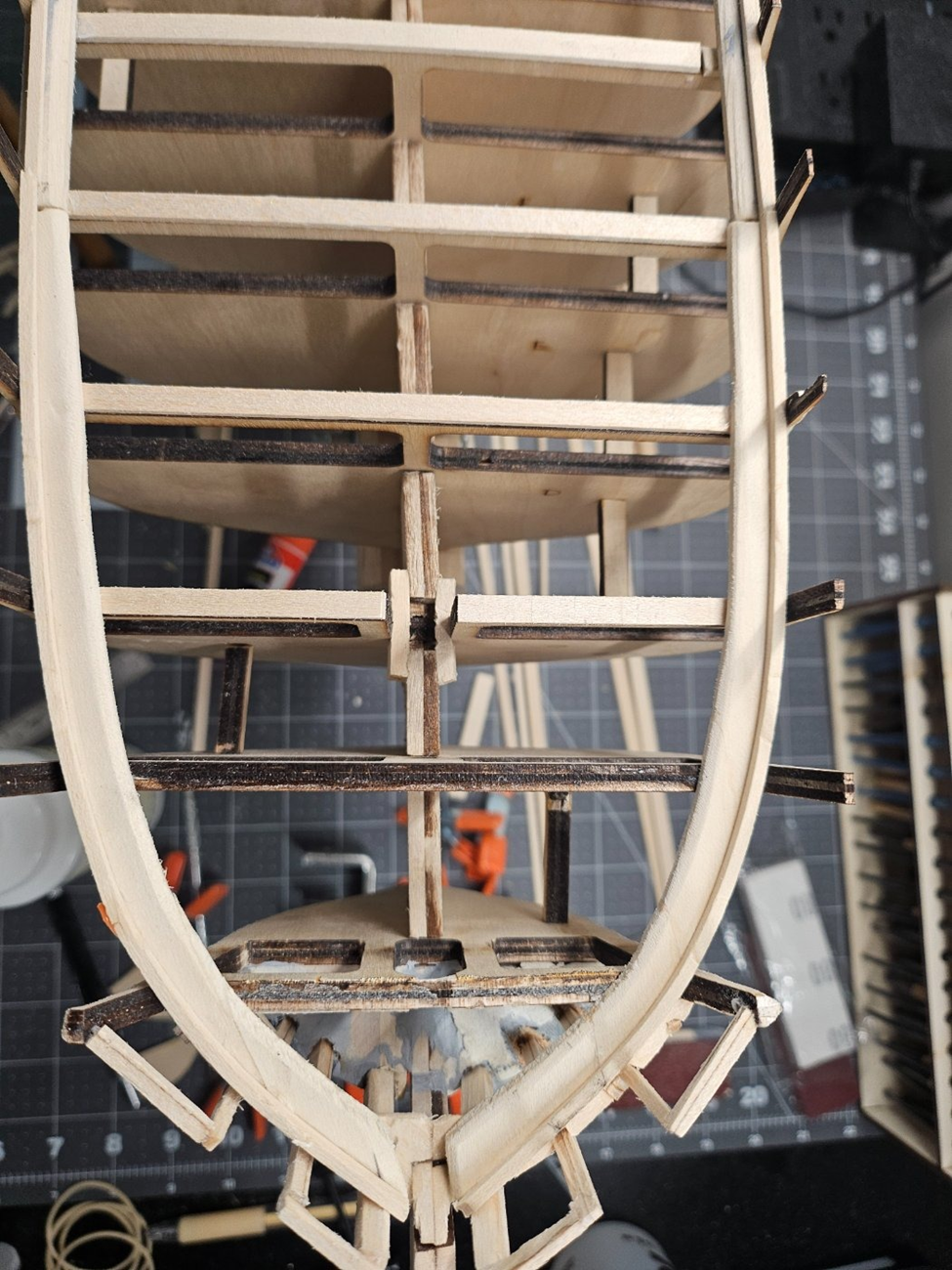

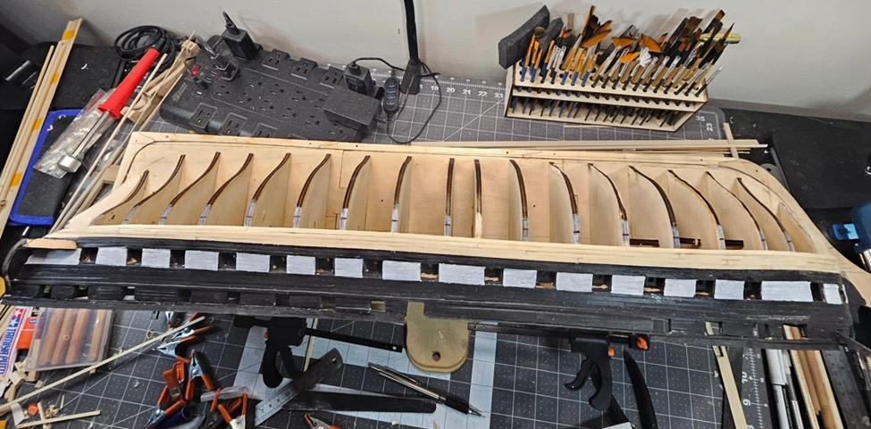

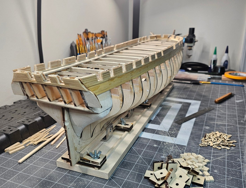

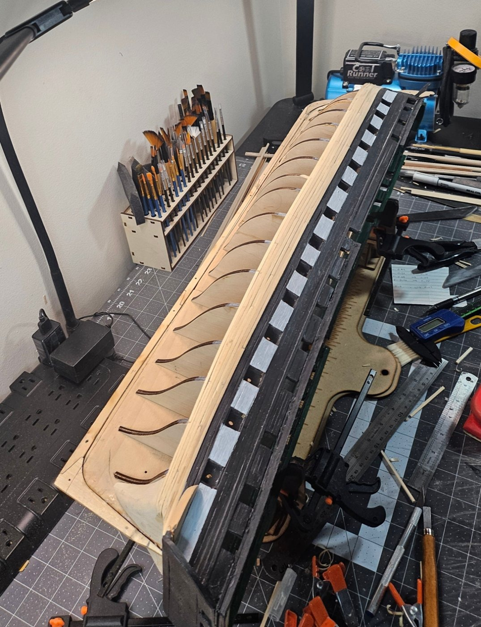

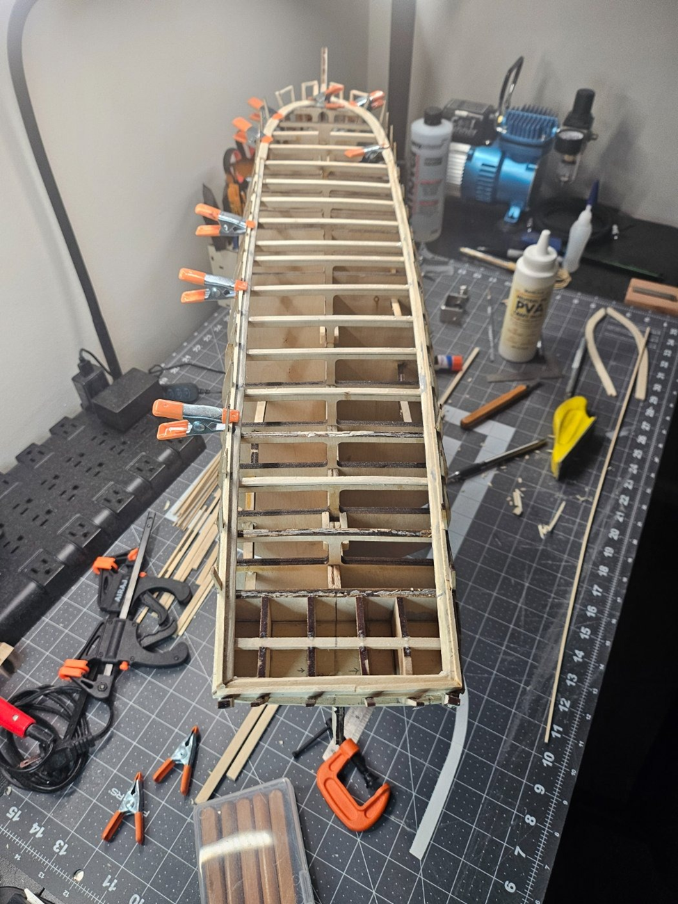

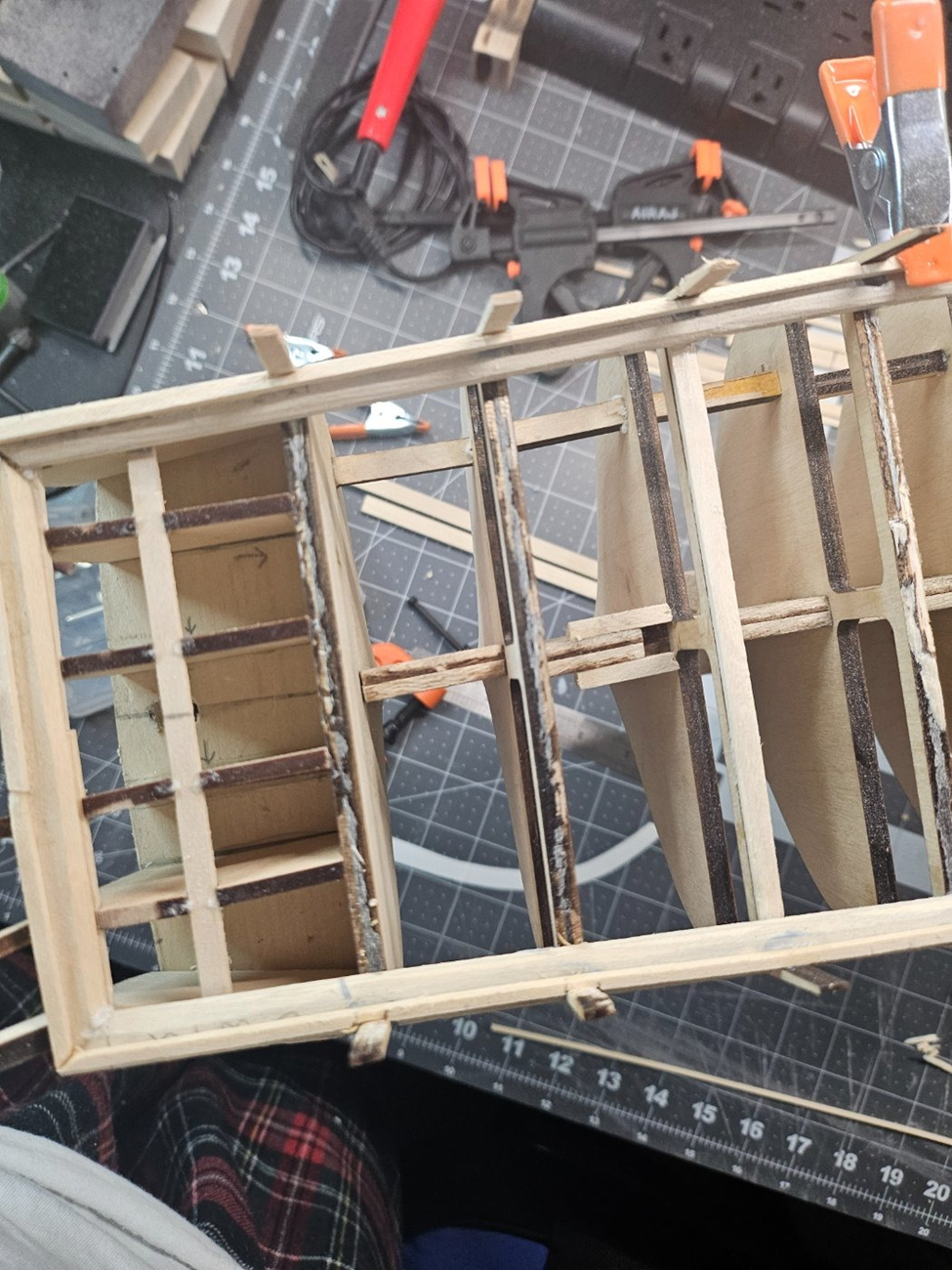

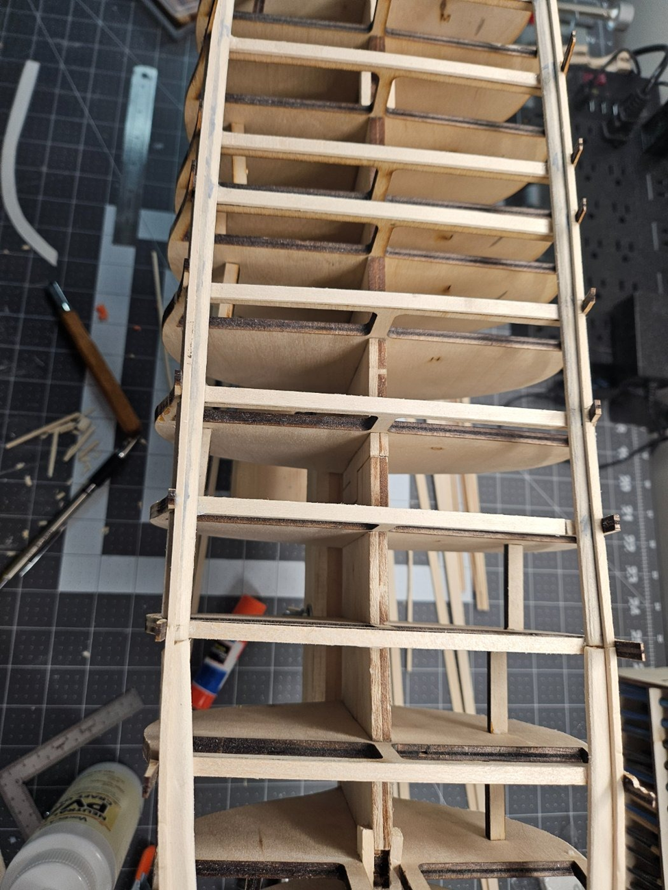

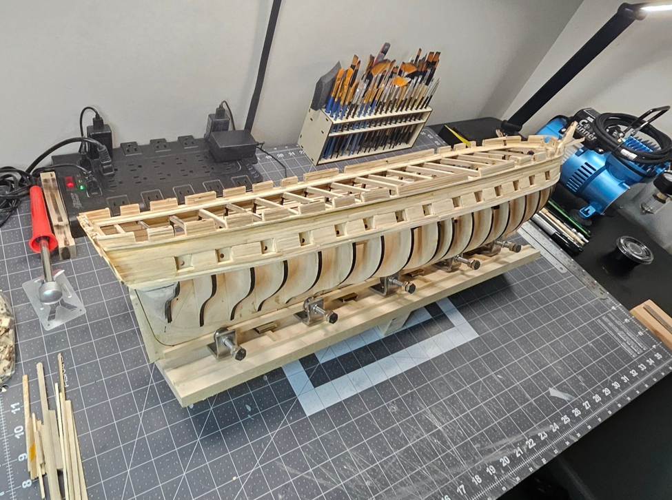

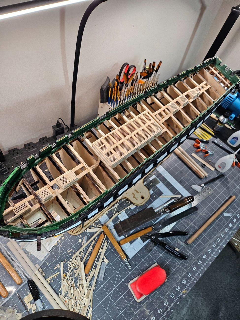

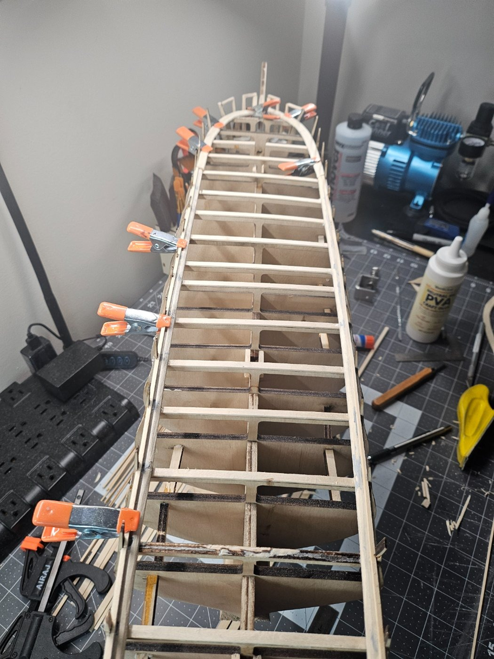

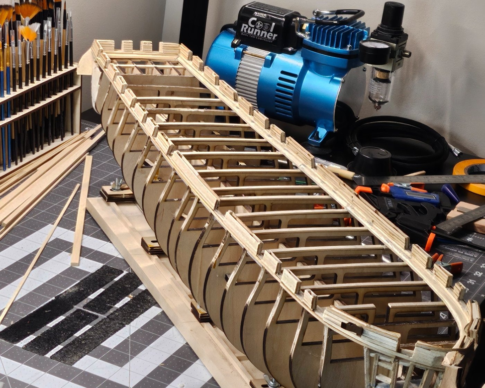

I spent the last few days cutting and gluing the planksheer fillers across the hull of the ship. At the same time, I was following Bob's Practicum and his recommendation of putting a coat of Minwax PolyCrylic on the inside of the covering the waterway, planksheer and the 4 rows of planks on top of the planksheer and then sanding them down. I had to do this 4 times with the sandpaper starting at 100 grit all the way up to 400 grit. This was the precursor for setting up the top gunports and upper planks which would then prepare everything for the lower gunports and planking to include the transom. The last picture below this narrative, is off a pit. I didn't position myself properly to so that it would be nice and straight, because it does look pretty good compared to the snapshot I took. Anyway, I'm slowly progressing, but really beginning to notice that each step takes time and cannot be rushed, even if its just gluing one single plank, lol. Following the practicum has it's own challenge because it takes a while to process tons of details in one paragraph and then look at the plans, and then look back in the forums to get a better visual and then the light bulb turns on with the ah ha moment.

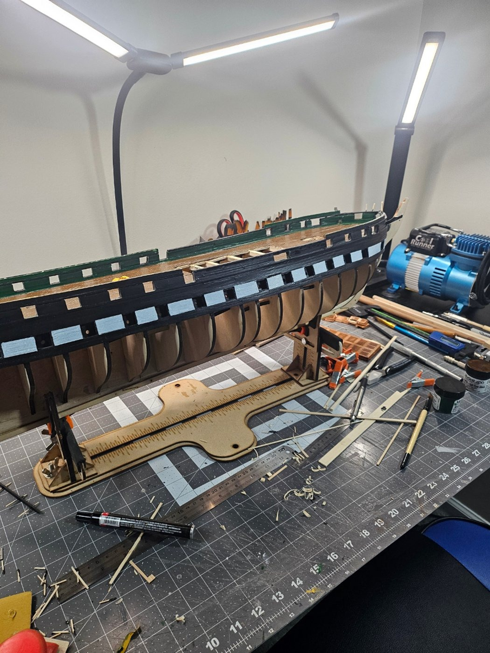

I'm slowly getting to the next stage with prepping the gun deck. It was more time consuming than I expected. The practicum gives instructions on how to cut the the hatches, but then I came across an easier way to cut them out. I used a cutting wrench like the ones that are used for cutting wires. Once I built the frames and the glue dried. I used the wire cutters and cut the left side next to the frame and then the right side. Then you could easily pull off the planks and use the #11 exacto knife to trim down any leftover wood inside the frame. The transom wasn't too bad, but I did find myself making some minor adjustments or make corrections so the gunports would properly line up.
The transom was a little intimidating. But I was happy it worked out and began looking pretty good and probably where it should be. I began prepping for the exterior planks and should have that finished in a couple days.

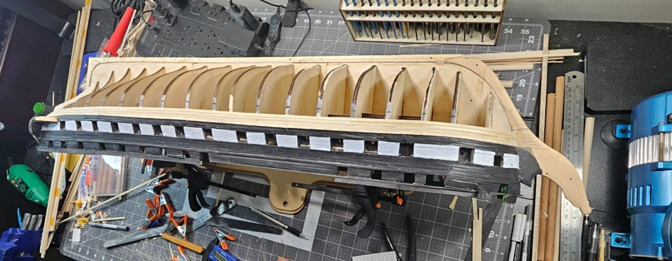

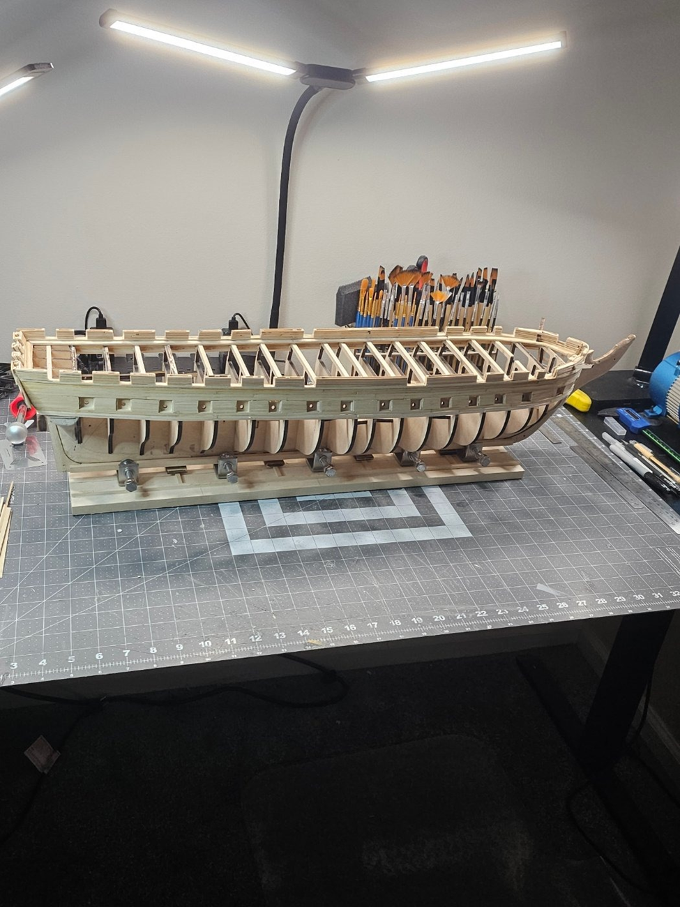

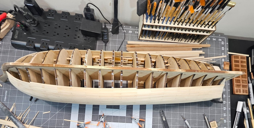

Well, I managed to complete the exterior planking of the upper gun deck. The port and starboard sides where pretty cut and dry. The bow on the other hand, was a bit more painful. I had to hput the bowsprit in temmporarily so that I could work around it and make sure the planks were not obstructing the area located at the bowsprit. I did experiment with the planks since It got really tedious and had seen what a couple modelers did. One was to cut four strips of wood, line them up in parallel, then tape them together and glue them so they make one single piece and then install them to the exterior of the upper gun deck. The other was outlined in the practicum where Bob preferred laying the planks and glueing them as you went along. I tried both and found the latter to be quicker, while the first way was a cleaner look. Either one works. Just a matter of preference.now it'll be time to read up and start the lower gunports. I'll probably end up fairing the hull again because I figure overtime the humidity changed. So it's likely to there could be some slight warping and I want the planking of the hull to be smooth...

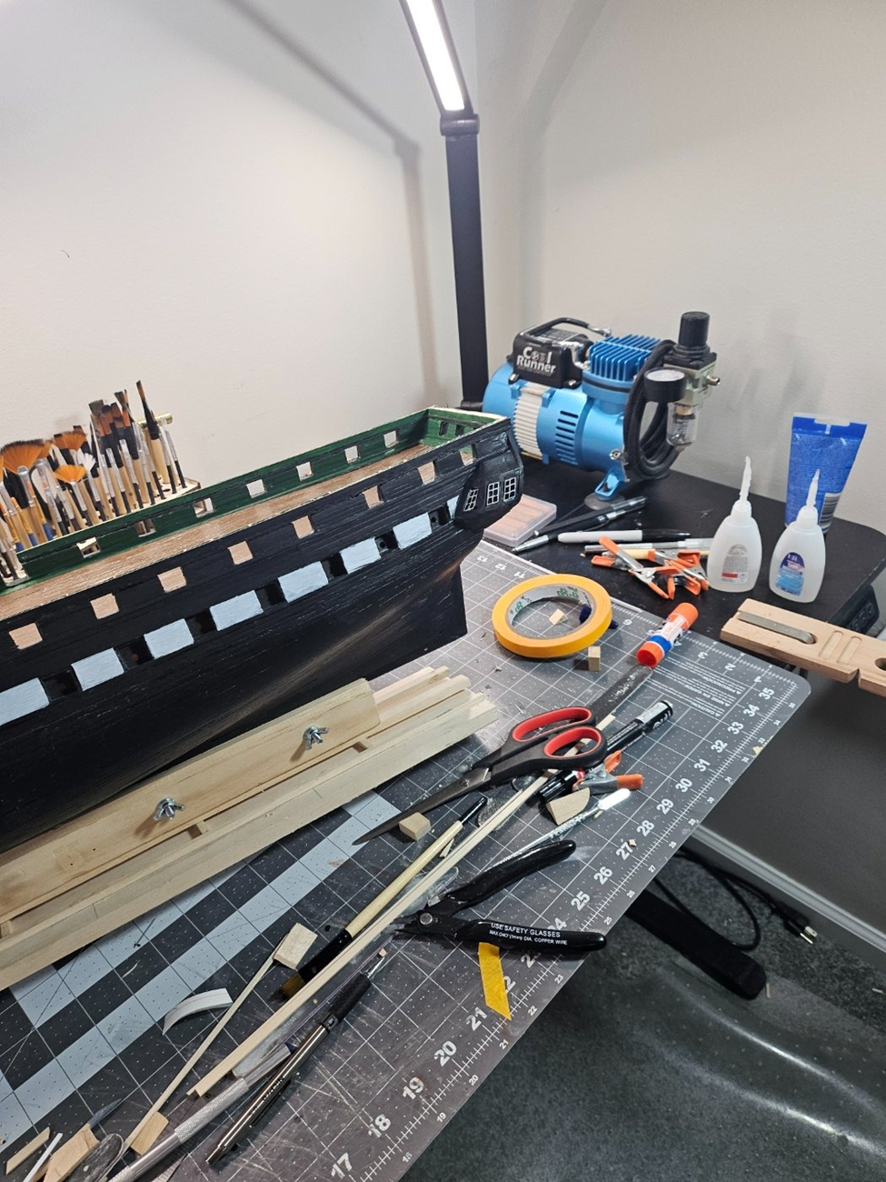

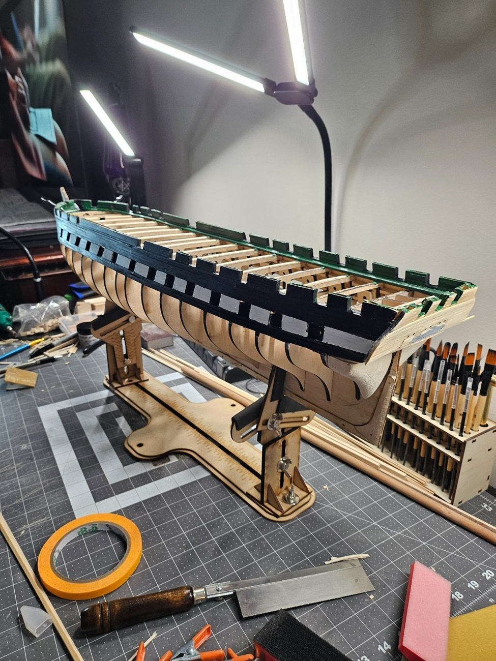

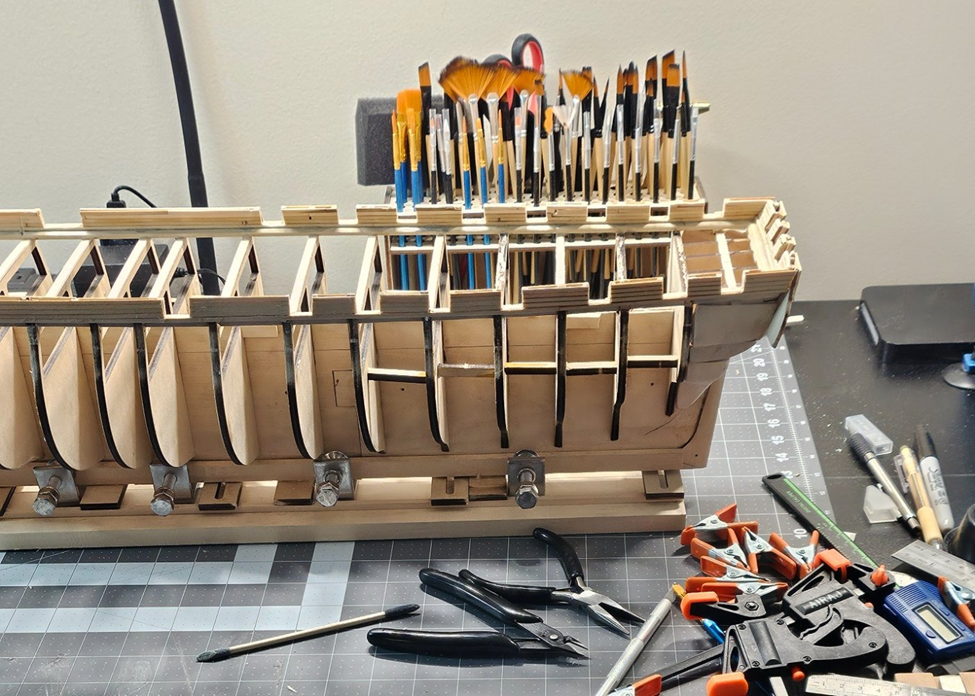

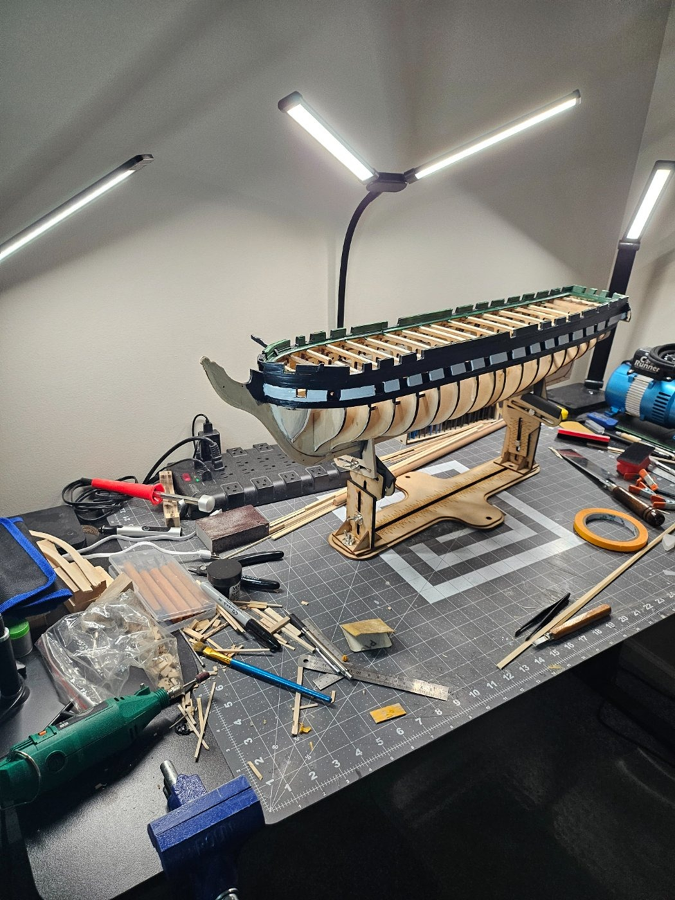

It's starting to look like a ship...kind of scary, lol! I began the prep for the gunports. Adding the four rows of planks was good practice into getting across the bow into the rabbet. Now I fully understand why these planks need to soak in the water, being the new guy on the block in the realm of wooden ship models after years of building plastic models since I was a kid. This was good practice being able to manipulate and work around the bow to get to the rabbet. I was surprised how challenging it can be following the contours of the ship in parallel with the previous plank you just added. I was expecting may be bending the wood in one direction, but realized it's more like slightly up or down and around not perfectly flat and then around, etc. Most of these changes are very minor, but I went on a clamping frenzy every couple of inches to keep the wood in place while drying and forming its shape as it dries and then again while gluing them onto the bulkheads. This definitely test patience as well. It was very tedious, but at the end of the day and seeing progress is fulfilling.
I was able to finish the starboard side, but that took me about a week. I had no idea of the many tweaks I had to make, although I had initially thought it was going to be easy. I did make a booboo halfway through because I had misunderstood what was written in the practicum. I had to remove some of the planks to install gunports that should have been there in the first place. I'm glad I caught it halfway, otherwise I would have been sucking a lot of eggs fixing it all over again. I did have to use some filler for planks that seemed to have sunk or bent inwards, but the filler does a good job fixing it. The toughest part was getting to the rabbet because the bridle port was part of the equation and with the planks bending in more than one direction, it was enough for me to grow extra hair on my chest. But, so far, think it's looking good considering I did most of it by and not machine, although I have some of the mini power tools. It does feel good having a sense of accomplishment at building something by hand like this. Anyway, I'll start the port side and hopefully have it done this weekend.

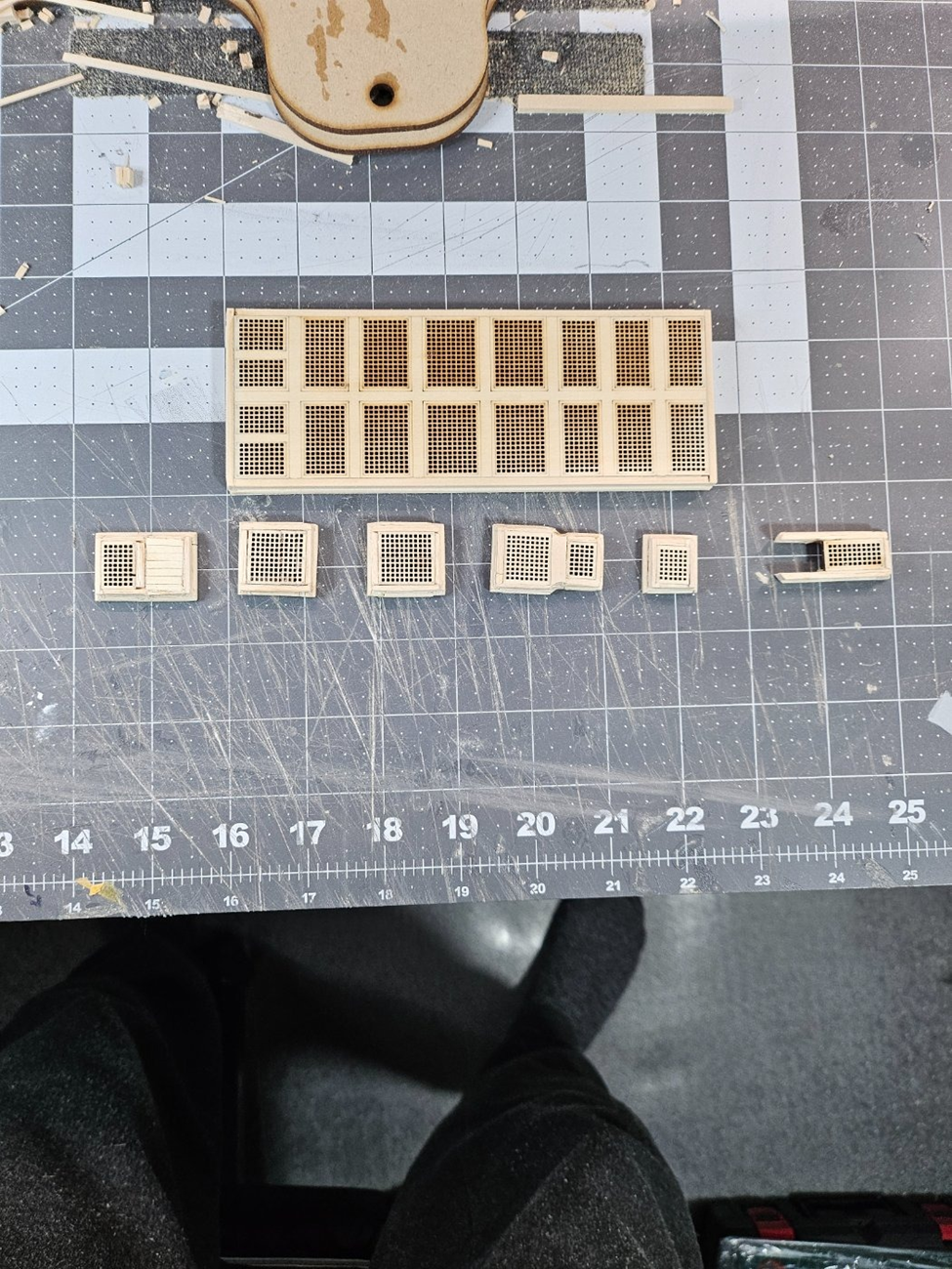

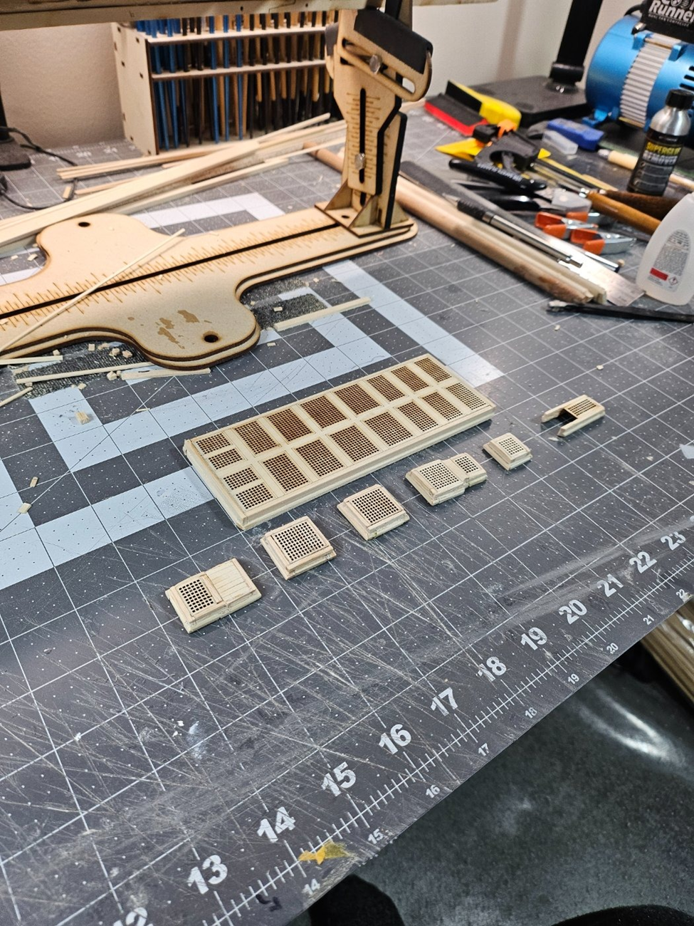

And a quick update...I'll be posting pictures soon. I was very busy building the hatch comings which I thought was going to be easy, boy was I wrong. First the scale except for the large structure in the mid-centerline of the ship is definitely easy than compared to the rest of them. The smaller the hatches got, the tougher it got. The construction was not so much the problem as was the substandard wood I did not realize I had. Initially I had run out of the 3/32 x 1/4 strips for whatever reason like shoring up the bulkheads, or perhaps I did not have enough to begin with. I went to the hobby shop and pick up some strips and the balsa wood was the only available. Well, let me tell you that balsa wood strips in this size suck for building the hatch comings. They are very soft, perhaps the batch I had was just too soft maybe by too much humidity or something. I realized that each time I tried to cut out the corners for lapping the pieces together, tiny chunks of the strips would go along with it leaving me either to refabricate the entire thing or use a wood filler to make up for filling up these imperfections caused by wither sanding or trimming the wood strip. Either way, it sucked for lack of a better term. It's enough that having to glue 1/16x3/32 strip to each side of the 3/32x1/4 strip and then a 1/16 strip on top of one of the 3/32 sides on top of that to form the rabbet needed for the hatch to lay in. So, I definitely ordered some basswood in place of this that should be in any day now so that I do not have to struggle to keep fixing imperfections caused by balsa wood. Is all balsa wood like this, or much softer than anticipated, I don't know and imagine it probably is not. I probably got a bad bunch that was probably sitting in the wood bin at the hobby store for a long time. Anyway, I'm almost done with the hatch coming that includes the galley stack and then finish with the largest mid-centerline hatch coming. To date, this was probably the toughest piece I've had to work on since I started the model a few months ago. I sometimes took me several hours just to get one competed because of this issue. I will admit, it is a little challenging when you try to make the wood lap each other when the hatches get really small. Otherwise, I probably would have had this done days ago, lol!

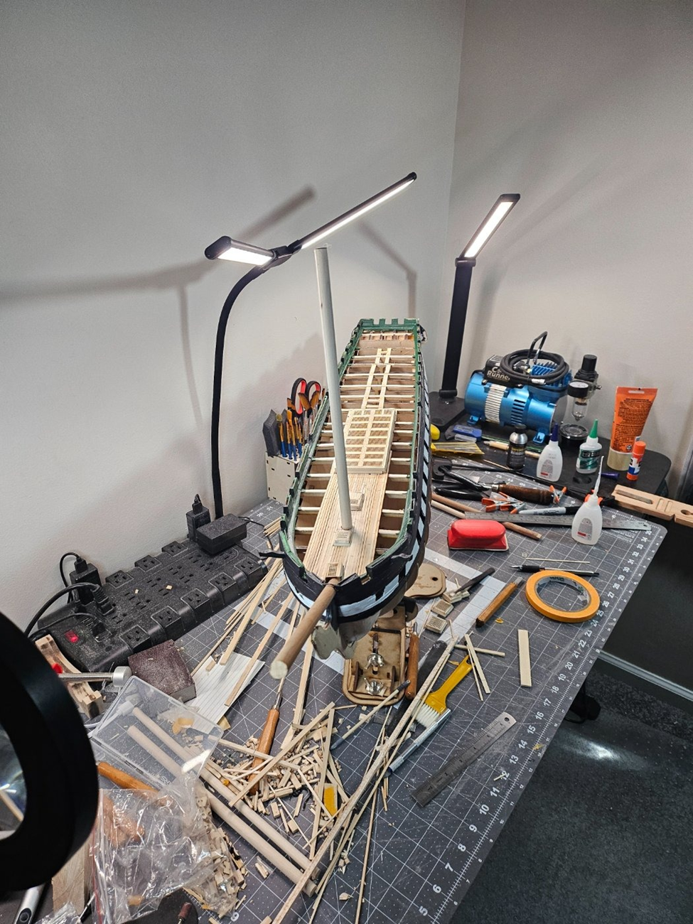

As promised, hard to believe how small it was to make these except for the large main one, plus that was a different size frame and wood altogether.

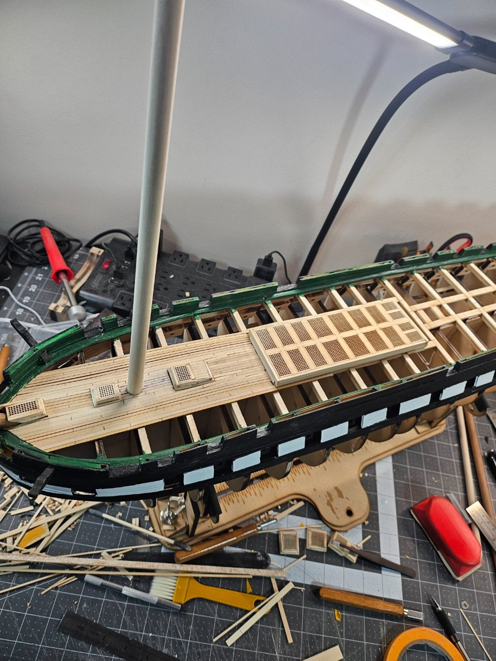

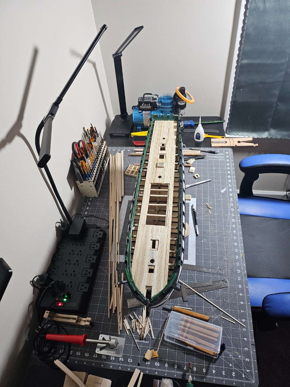

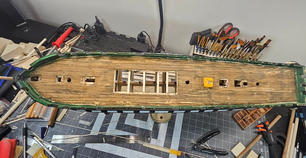

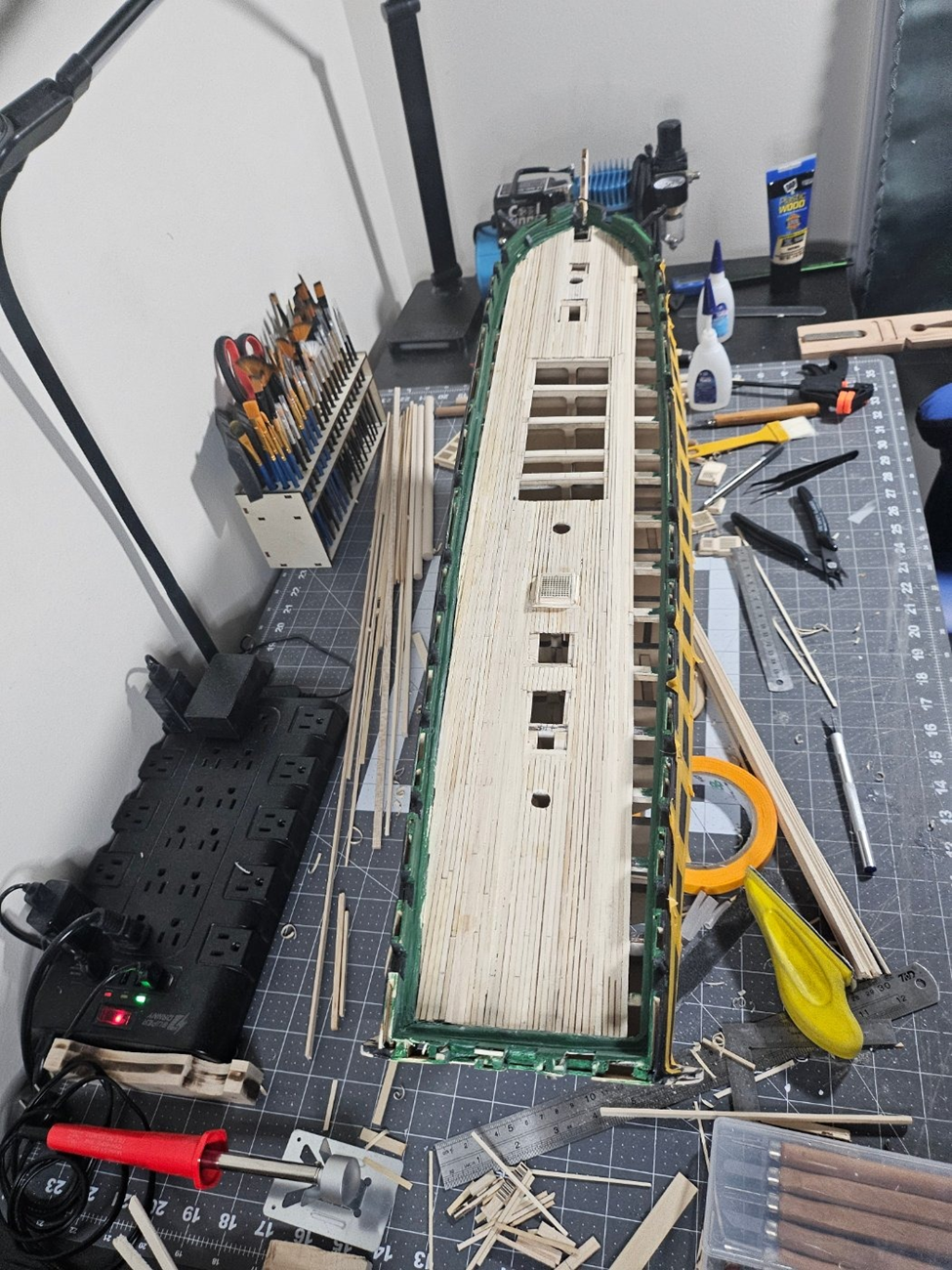

Started the deck planking work. Had the hatch comings in place, but not glued in just yet. While it looks easy, to me this has been a nightmare because I had to make many tweaks along the way and following the practicum, I realized there were a lot of inaccuracies in the practicum because it's based on Bob Hunts exact model size and and variances in the wood for the deck planking. There doesn't appear to be enough wood for the deck, or at least the 1/16x3/32 strips. There are two similar sizes in the kit and one has dark edges as if it were a pure laser cut and the other like any other strip of wood. Bob claims that a slightly large strip in the kit is acceptable and could be used as is, or shaved slightly down to the. I'm still debating this while I ordered some wood from a hobby shop. The strips of wood have very minute variances in width that it isn't apparent until you've laid many. There is tapering, but no where near the level Bob explains based on the strips size we're recommended to use. I found my self constantly measuring from the centerline throughout because I would need to add some type of filler to make up for the extra space. The number of planks from the centerline to the waterways by the transom is supposed to be a total of 25, but I found this not to be true at all. Having 24 on either side of the centerline in this area is not even close. Anything outside of those planks are what gets tapered, but nothing more. Although I'm almost finished with laying the planks, it still takes an eternity so everything looks remotely correct. I think many builders got creat8ve to make the deck look good like a deck, but not perfectly in numbers and sizes as you would think. Anyway, I'm patiently waiting so I can start sanding and staining the deck and get that piece over with and then touch up what I've already painted and then some. Until next time...
Started the deck planking work. Had the hatch comings in place, but not glued in just yet. While it looks easy, to me this has been a nightmare because I had to make many tweaks along the way and following the practicum, I realized there were a lot of inaccuracies in the practicum because it's based on Bob Hunts exact model size and variances in the wood for the deck planking. There doesn't appear to be enough wood for the deck, or at least the 1/16x3/32 strips. There are two similar sizes in the kit and one has dark edges as if it were a pure laser cut and the other like any other strip of wood. Bob claims that a slightly large strip in the kit is acceptable and could be used as is, or shaved slightly down to the. I'm still debating this while I ordered some wood from a hobby shop. The strips of wood have very minute variances in width that it isn't apparent until you've laid many. There is tapering, but nowhere near the level Bob explains based on the strips size we're recommended to use. I found myself constantly measuring from the centerline throughout because I would need to add some type of filler to make up for the extra space. The number of planks from the centerline to the waterways by the transom is supposed to be a total of 25, but I found this not to be true at all. Having 24 on either side of the centerline in this area is not even close. Anything outside of those planks are what gets tapered, but nothing more. Although I'm almost finished with laying the planks, it still takes an eternity so everything looks remotely correct. I think many builders got creat8ve to make the deck look good like a deck, but not perfectly in numbers and sizes as you would think. Anyway, I'm patiently waiting so I can start sanding and staining the deck and get that piece over with and then touch up what I've already painted and then some. Until next time...

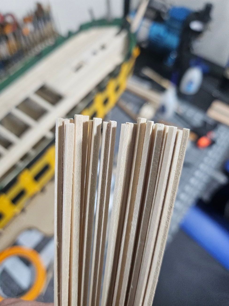

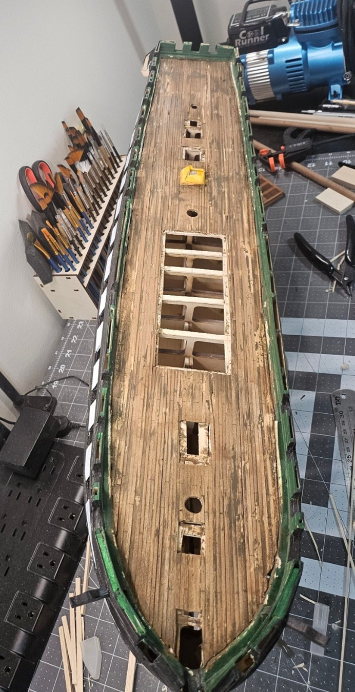

And...the deck planks are getting there...unfortunately I had to order more strips of wood, 1/16 x 3/32. As I mentioned earlier, there were two types with of wood strips in this size in the kit. It appeared to be a mix of balsa and bass woods, so there is a mild variance in size when I measure what's from the centerline to port and from the centerline to starboard. The practicum recommended using 1/16 x 5/32 if I'm corrected if the modeler prefers it and using them mainly in the midships area where the most tapering is required. I chose to just buy some more wood instead to keep things uniform. The practicum also discusses the 25 strips in the center starting from the after part of the main hatch coming, which would be tapered between 1/16 and 1/32 ending at the transom. I feel this is somewhat negligible, especially with variances in the width of the strips already in the kit. I personally do not think it is necessary to taper the center when it appears to be required in the midships area towards the transom. The strips are very thin in the first place, unless they absolutely need to be tapered. The plan sheet also is not very clear regarding the width of the planks and appear slightly wider with no taper in the center group of 25 planks. Anyway, should I redo this part of the deck, or let it go and flow into the build?
Well, my wood strips finally made it. I will say this though, these are 1/16 x 3/32 fresh cut out of basswood. The wood in the actual kit does not compare, and each strip in the kit had a minute variation, that it changes the actual number of planks that the practicum states there are. However, at the end of the day, I'm not going to tear up the deck and redo it unless something is completely off. It still looks good, and no one is going to count how many planks there are from the centerline to port or starboard...maybe unless you're submitting it in a competition, or someone like Rain Man, lol. I will be sanding my butt off when the planks are in because of the slight difference in the height of thickness of the planks. Once the deck is sanded, then it will be stained based on the recommendation in the practicum, which looked awesome in the pictures, but mine whack at it will probably be like a 5-year-old trying to draw inside the lines with crayon.

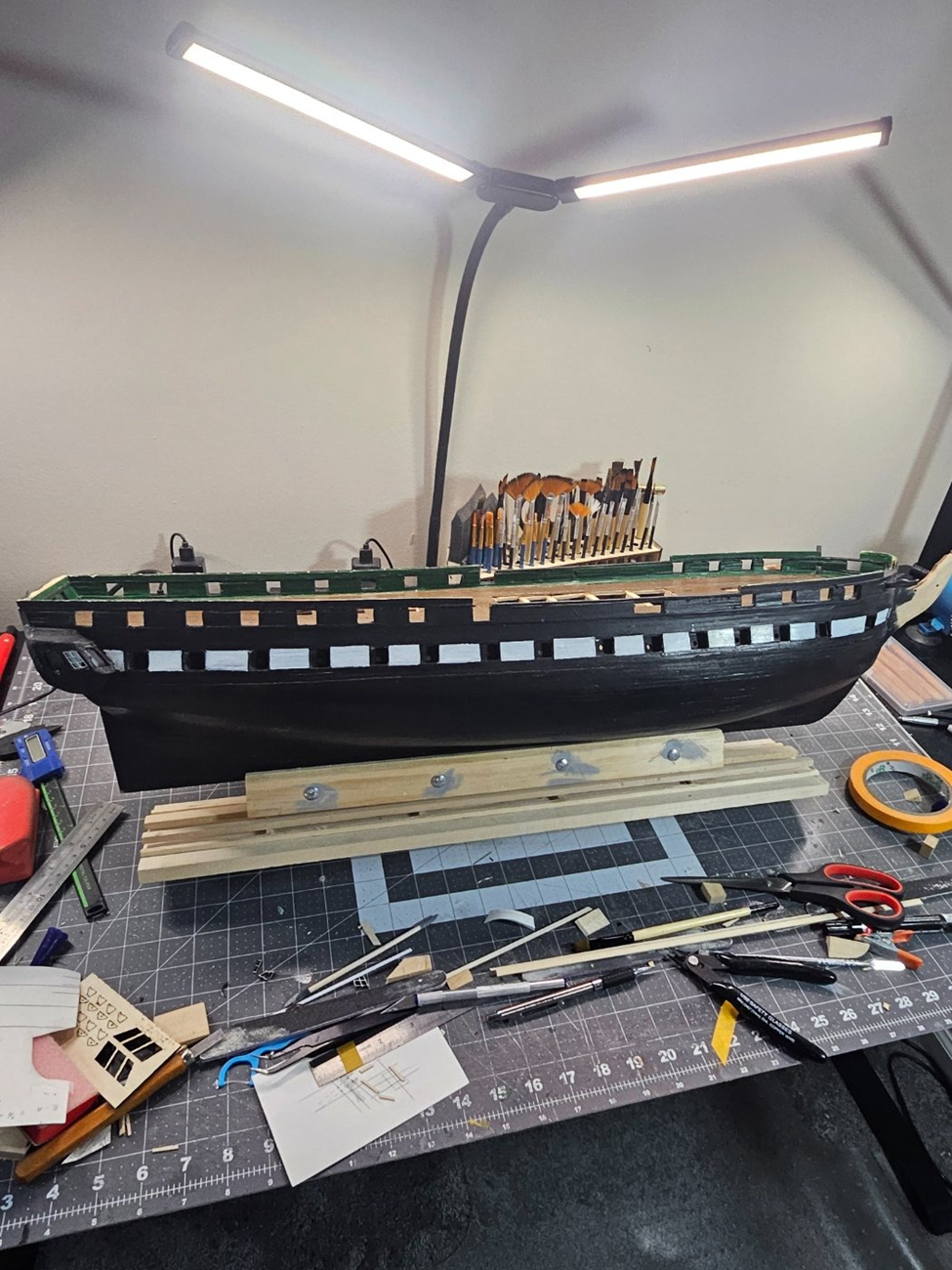

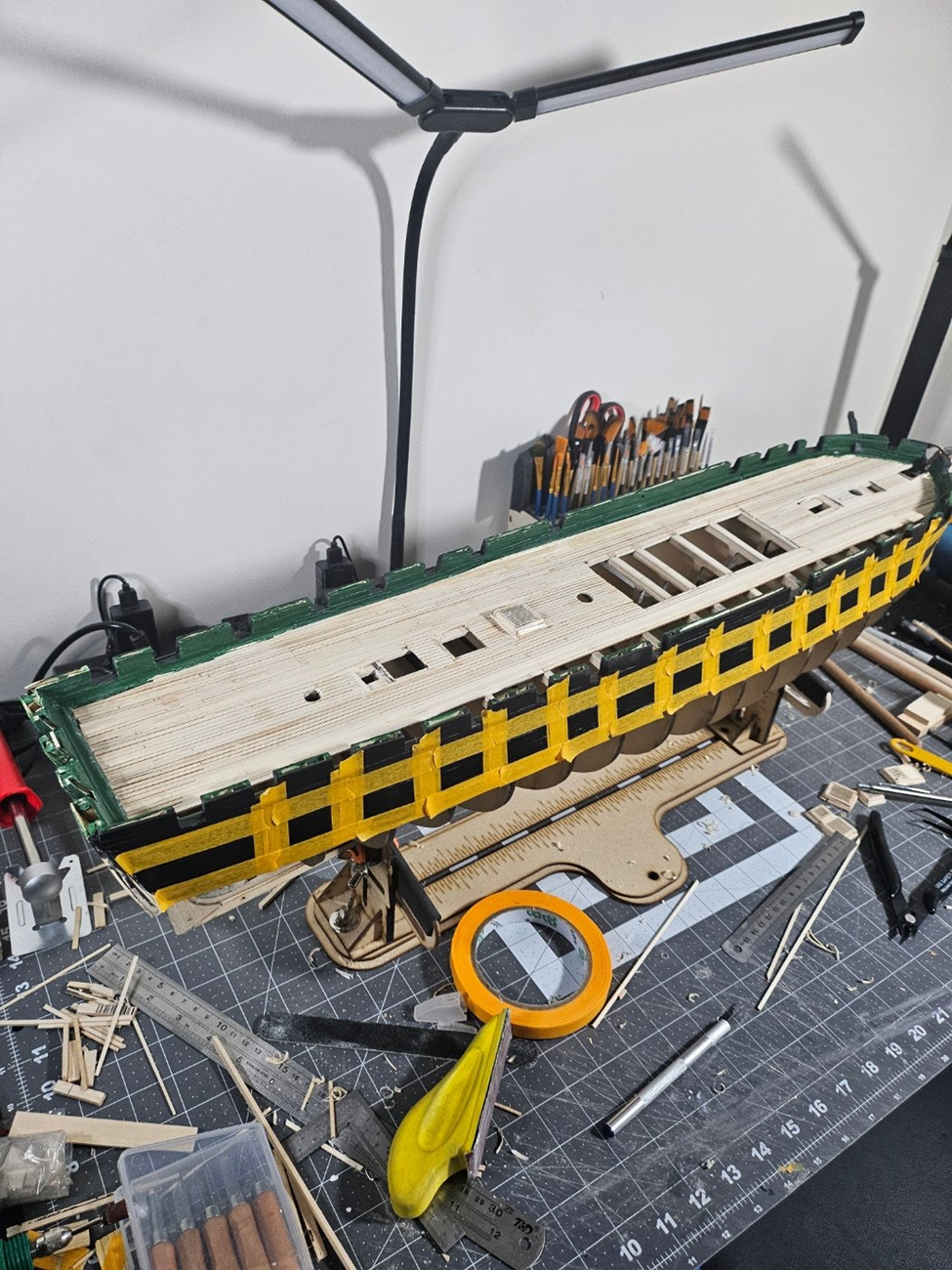

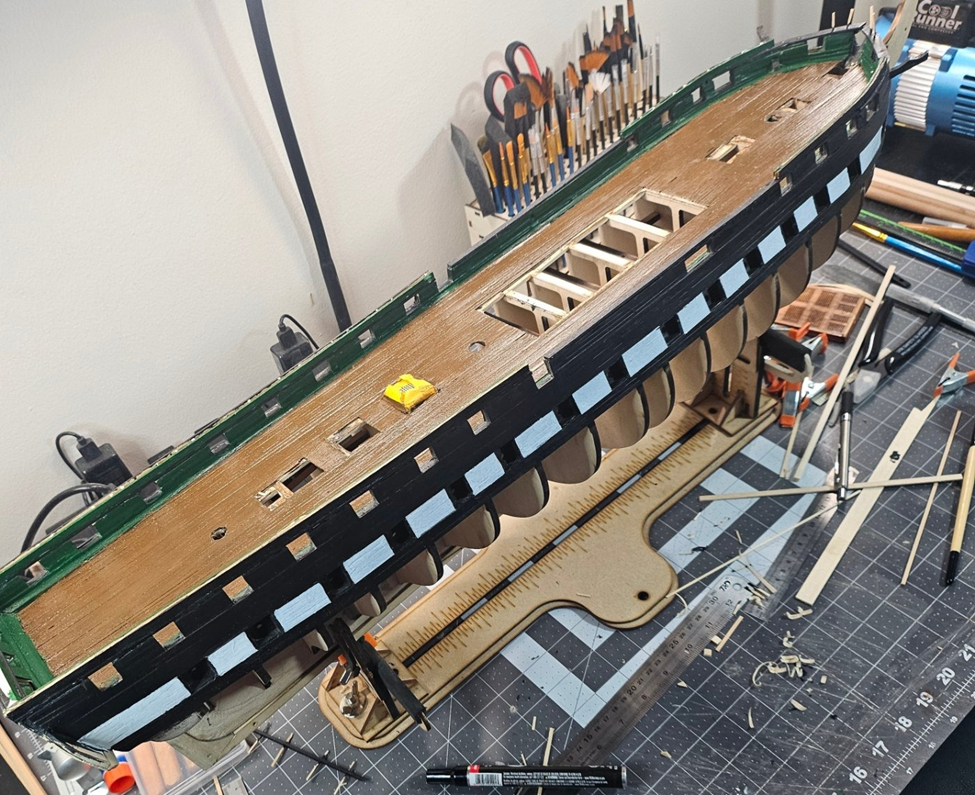

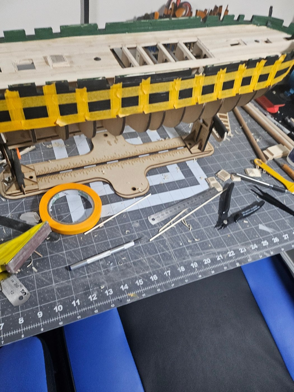

Next you will notice that I've taped off the upper hull at the gunports which is typically painted in some matte white version. I chose to paint over the white and redo this. When using a brush on a taped off area on a wooden ship, I did not like the bleed-over even though my model paint tape is very good. so, to correct this, I decided to tape off each individual gunport and instead of brushing it on, I will airbrush it on because airbrushing from a distance can be controlled and likely retain a much better rectangular shape without the bleeding. Also, it's applied in layers that dry faster. Brushes on the other hand put the paints on in globs and easily causes the bleed over. Using a polyurethane after sanding is hit and miss and I did not see a major difference. It's supposed to help make the paint go on easier when applying it to the surface, but I see that as more of a preference. I do want to make at least the outside of the hull look more professional that a toddler going to town in a coloring book. I know purists might argue using hand printing versus airbrushing. If it is a good solution to a problem, then that's what I will do. This is probably the only area of the ship that I'll airbrush and no other spot.

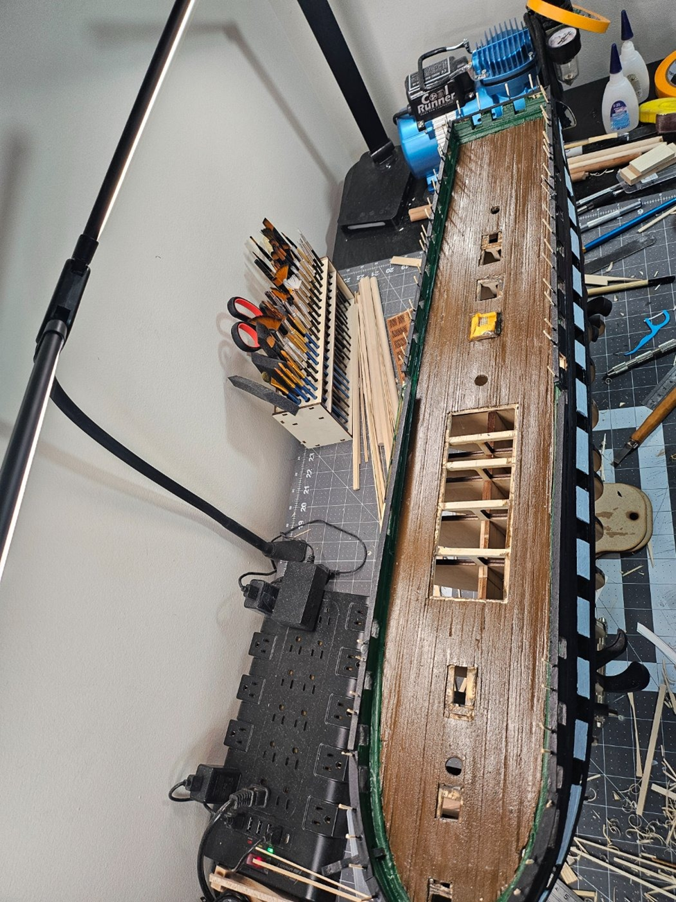

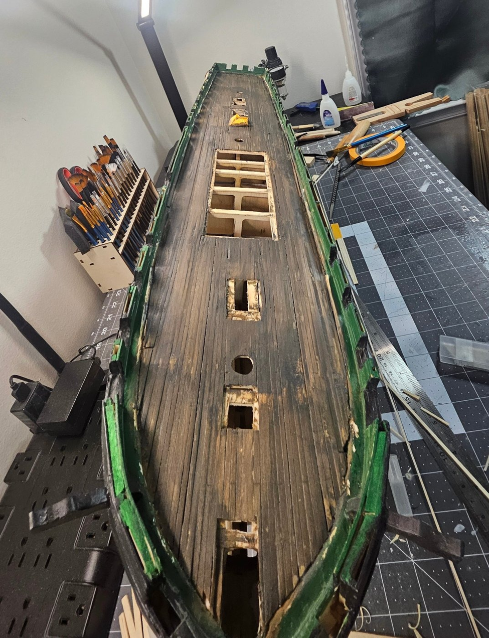

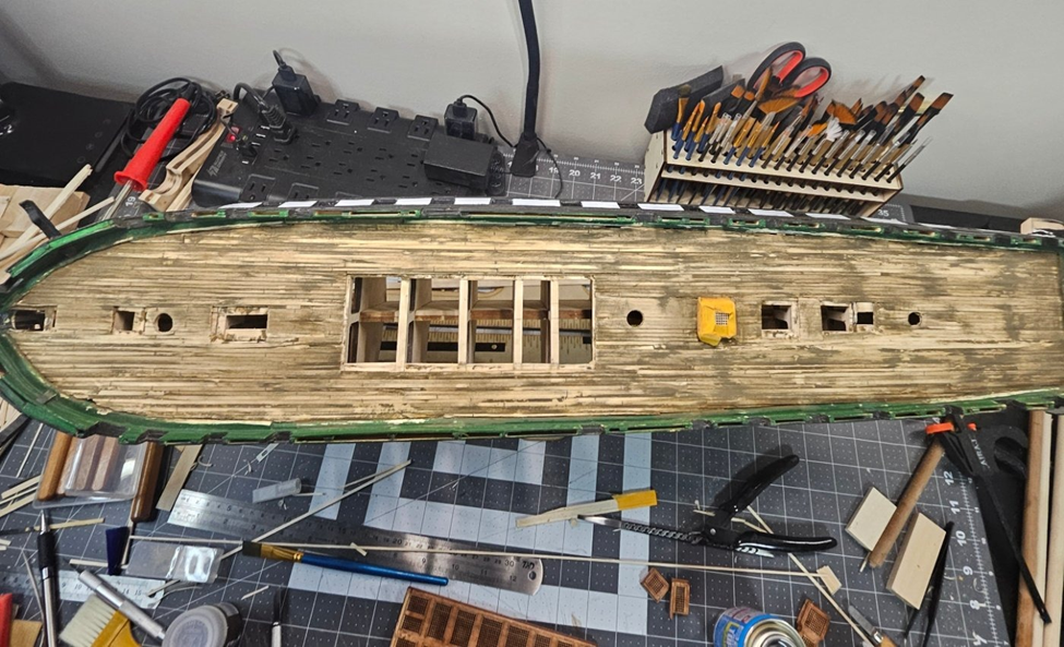

Finally. I had no warning that as you get close to finishing planking the deck, it gets friggin tough because there's little space to work in and you're tapering the wood strip to fit in there like a glove. It's enough that the top center of each bulkhead on the ship is slightly higher than the rest of the bulkheads, so adding shims to different parts of the bulkheads so the planks stay as leveled horizontally as possible. I did find out that the three type of CA glue do different things. I bought a set that had thin, medium, end thick. The medium was by far my favorite and the thick although I glued my digits several times because I never learn the first time. The one that kick me right in the bum was the thin on. I had no idea that when it saif thin, they meant watery, and it dries super-fast. So fast indeed that I accidentally glued all of my fingers from my left hand all at once instantly because I accidentally tips over the bottle. I had my hand soaking in acetone for like 5 minutes before I could pry them off of each other. But I also learned it can be your friend. When you need to glue a tight spot, of several planks together when you need to join them together, one drop would get absorbed into the wood quickly and spreads easily as well. If you do it too long, it will spread to the other planks or whatever wood nearby and like...welds them together. Alright, once I get the deck stained then I'll send more pictures, and then it's rivet time on the inside of the waterway. I don't know how many rivets are required, but I did buy 1,000 of them because there are also rivets on the hull as well. So, this will take a while and feel like an endless funeral. I didn't realize the practicum has the rivet piece in there considering having read several the narrative from several builds debating, "To rivet or not to rivet...that is the question." I'm choosing to do it because it really does look good and great for covering up flaws and mistakes.

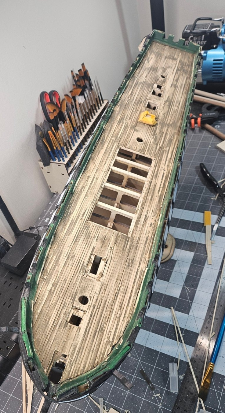

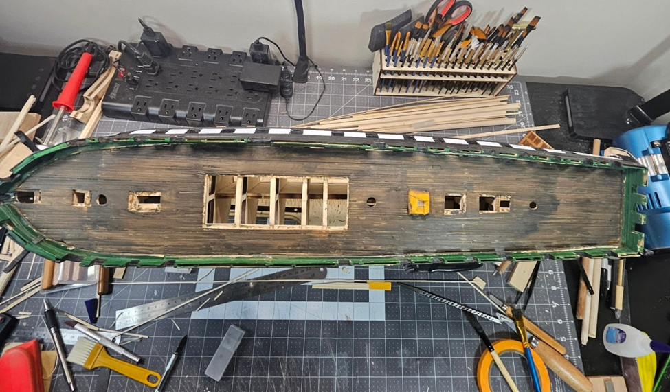

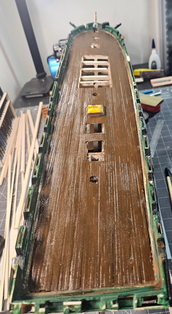

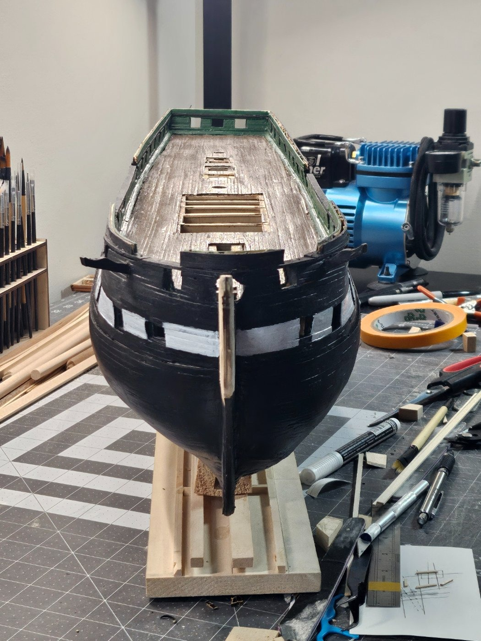

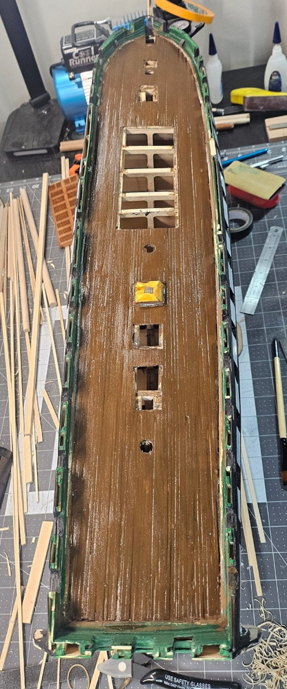

Going into prepping the deck to give it that nice, weathered look, I had to improvise a bit with the recommended paints for the deck offered in the practicum. Unfortunately, some of the paints do not exist anymore and cross-over lists may not be available for all model paint manufacturers. Floquil paint looks like they are no longer in the model paint business, so finding roofers brown and grimy black to mix, it could be a challenge even though their names make it sound easier says than done. I decided as a substitute to use Flat Earth from Vallejo and Grimy Black, or at least that's what the bottle said. Either way, I think it worked. The instruction was to mix equal parts of both paints and apply them like a stain, brush on and wipe off immediately. The first set of pictures is the first wave where you do the first brush and wipe, followed by scraping everything off with a blade because depending on how you sanded with deck, if it was not with the grain, you may see several scratched areas that are not consistent throughout the entire deck. Once everything is scraped, then it is recommended to sand it again and then reapply the to the deck and then do another coat but using only the grimy black to give that weathered look.
The practicum recommended not to paint the bulwarks until after the deck was stained. I chose to paint it green anyway. I'm waiting for the rivets to arrive, so I have to paint everything to green anyway, but I'll likely tape off the deck, so I keep it nice and clean. I was pleasantly surprised that this this worked better than I expected. If anything throws me off is the fact that in the practicum, the picture of the completed deck is perfectly uniform and even. Although, it looks amazing, I don't feel it represented a true worn and weathered deck. A deck that is uniform and perfect means you're probably on a new ship, lol. For the first time, I feel like I have the upper hand on this because my deck might look a little ugly, but when you think of a deck that is weathered with traffic moving out and about, I think my deck represents this facet much better...and this is my opinion only because this is my first wooden ship model, so I cannot compete with anyone who has one or completed under their belt, but I'm always looking for advice and improvements.
Although the hatch coamings will go one later, I decided to stain those and varnish them. Many photos show the wood color on the lighter side and varnished. I decided to go a little darker into the Oak realm and then varnish them. If the deck was going to be this dark, then I felt going light was too light, but getting it to a slightly dark brown hue would be a more compatible match...yes, my opinion too, lol. I'll likely add the picture when I send my next update, or between updates because I have lots of rivets to make friendship bracelets out of. I know rivets are not a requirement, but I like the challenge and frankly, each picture I've seen from modelers that have done this, really makes the ship somewhat stand apart in detail, even though in real life, you wouldn't see this detail because of distance and scale, unless you have a bionic eye which would be cool, but this is it for now.
I totally agree with you as the deck is maintained today by the Navy. This model is based on the Navy plans of 1927, nearly 100 years ago, so the deck was likely not as uniform as it is today. Now in 1797 when the ship was commissioned that would have been an entirely different looking deck as well as a ships' company most likely wasn't as disciplined as today with a work hard, play hard attitude.The Navy did a great job on other ships over the years when teakwood was common on the main deck and even the bridge. So, would the deck look different treating the mixed paint as a stain as instructed in the practicum versus just using a stain straight up? If I had to do it again without brushing and wiping paint across the deck, I would have either used a stain across the deck evenly, or the mixed paint thinned out and laying it down without wiping it off. I also noticed that the wood straps in the kit are also inconsistent, plus I had to get more wood after running out. The new wood was excellent and had that wood been laid across the entire deck, then that is the only way to achieve that perfect and even look that's pictured in the practicum. If I was a seasoned wooden ship modeler, I probably would have picked up on this sooner, although I was at a crossroads whether to follow or deviate what the deck looked like either 100 years ago, or a ship 230 years old.
Again, I followed what was recommended in the practicum, however; I've seen several variations over the years. I've seen the earthy brown and grimy black version that I used to a more grayish look to it in some versions caused by weathering, to a very dark deck or subdued deck color when I went aboard a few years ago. You are right about the paint. I think that is the key reason the practicum had us mix the roofers brown with the grimy black, but wiping it off like a stain was a first for me because I've only done that with a stain. I was thinking of sanding it down a little and adding more of a gray wash to it like some of the pictures I attached. At the end of the day, which color really represents the deck color today, I couldn't say or 230 years ago.
I could do a couple things....1. I could sand it down to lighten it up and then apply a possible gray wash to offset it, 2. I can keep as is and put the rivets in the inner bulkheads and tape it off and paint to green and see how it contrasts with the deck, 3. I could paint it without treating it like a stain and skip the wiping, or 4. sand it down so I can get it as light as possible without going through the deck, lol...and apply a gray weathered stain possibly with a mahogany mixed stain...Looks like I'll have to experiment, especially with the last one on a separate piece of wood I have.
I think the varnish made it look great. I almost did the same thing, but for some reason the voice in my head said to go darker and maybe because in Bob's Practicum he went dark using the roofers brown and grimy black paints mixed and wiping it down and treating it like a stain. Because it looked really good being that dark, that's probably the catalyst for my decision. I think I'll do something tonight because I'm still waiting for the rivets to come in.
So, I finally decided to take some advice from the experienced folks, and glad that I did. I sanded everything down and then applied the earth brown, which was medium in color, not light, but not too dark. Then I applied a gray wash to it and that made a huge difference and pretty much exactly what I wanted. Then I sealed it with Minwax Polycrylic that was recommended in Hunt's Practicum. Together it brought out the definition of the deck with the weathered look as well. I am very pleased with how it turned out. Afterwards, I taped off the area and painted the interior bulkheads with green and now it looks even better. I did not take photos with the green touched up but will include them in the next batch. I decided to forego the rivets. I followed the directions and just had a difficult time getting them in. First, these rivets are super tiny. Second, after a while, my hands are not steady enough for manipulating something that tiny. Last night I started the main rails. I also had to order more planks 3/64 x 3/32 after running out, once again proof that the kit does not have enough wood for certain areas. Model Expo will send me a batch, and I also ordered some online because Model Expo can take up to a couple weeks and I don't want to wait that long, but at least I'll have extra. The wood should be here tomorrow, so in the meantime, I've been building the entire rail from the transom to the bow. The practicum skips over a lot in this section with the understanding that the modeler has enough knowledge and experience at this point to finish the rest on their own. I'm ok with this, if you can build the portion that is in the practicum, then you should be able to finish the rest of it. Otherwise, it's likely redundant anyway...
Oh, before I forget, I am reworking the hatch coamings. I originally stained them in a mahogany color, but I think it's too dark and too close to the color of the deck, so I will keep those light and varnish them. In most pictures they are all light and some have the tops light and the sides like a dark mahogany. Keeping them, light will better contrast the coamings and the deck.

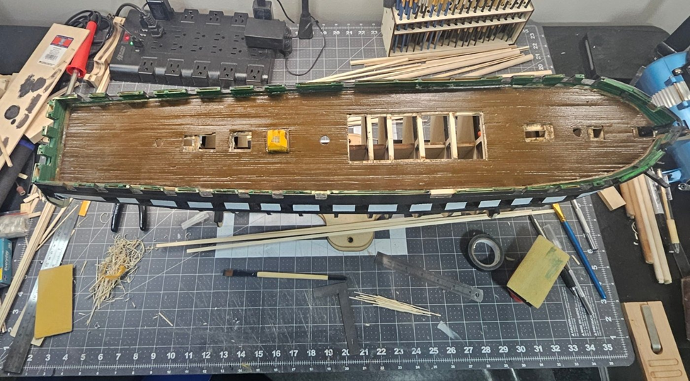

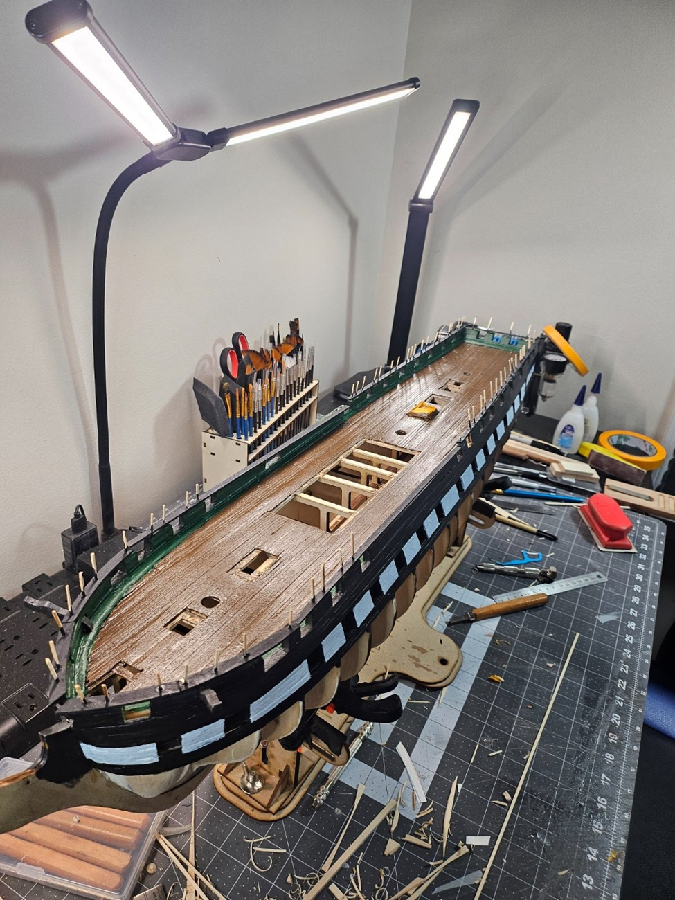

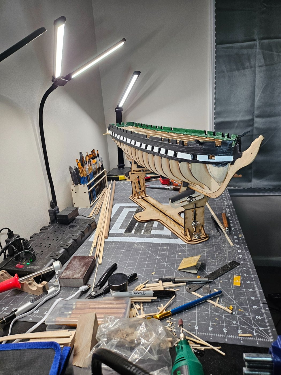

As promised, the pics showing the deck being done and the green bulkheads cleaned up. I'm happy with how it turned out. You can slap see I started the main rail and the prep work foe the extended bulkheads around the ship. My wood for the bulkheads comes in today after being delayed, so I did several steps ahead and only need to add the planks. After I finish painting, then this chapter in the practicum will be complete...finally. OBTW, no one seems to sell square toothpicks anymore to meet the size prescribed in the practicum of 0.42. I ended up using my scraps and carving them out of the scraps. I mean it works...and just support for the planks going on top of the main rail and then the lips get popped off like the bulwarks earlier in the build.
Finally, I installed the rails. The wood size used for the main rail imo seems too narrow. This is an issue I've been seeing in my kit to the point that I've ordered wood online and the quality and amount seem much better. I don't know how often each kit is reviewed for updated or upgrades, but I think the wood really needs to be evaluated and updated. Anyway, I found a shortcut to the main rail and part of that is driven by the fact that the toothpicks used are not square. Many retailers have the standard round and if the square were 0.42 recommended for the rail in the practicum, I started trimming them down and then felt it was more of a pain to deal with. What I started to do was after installing the rail, I could edge glue two sets of planks, one painted black and the other green. I then trimmed them to the size needed and soaked some if they needed to be bent. I used a wood strip that was 1/32 x 3/32 and glued that instead in between each plank strip and then I would glue it in the center of the rail and that created the 1/32 lip on each side that you could actually see. This was way better than using toothpicks in between. So, I ended up cutting off the toothpicks and did it the new way and it met the 1/32 spacing prescribed by the practicum for each side of the rail.

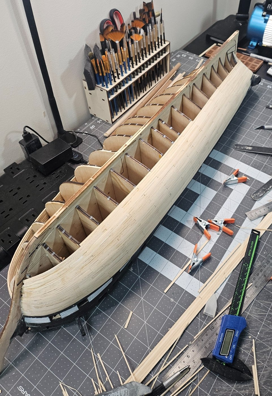

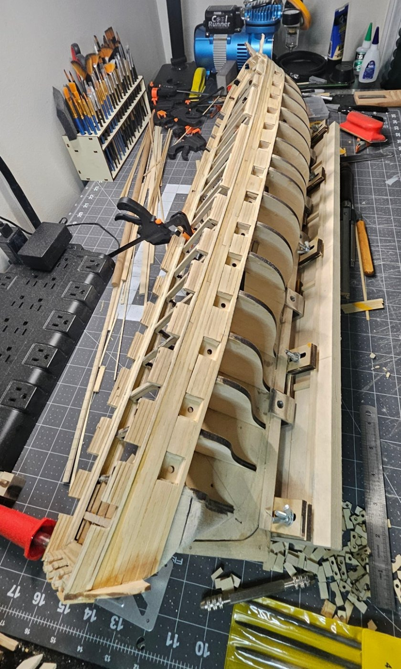

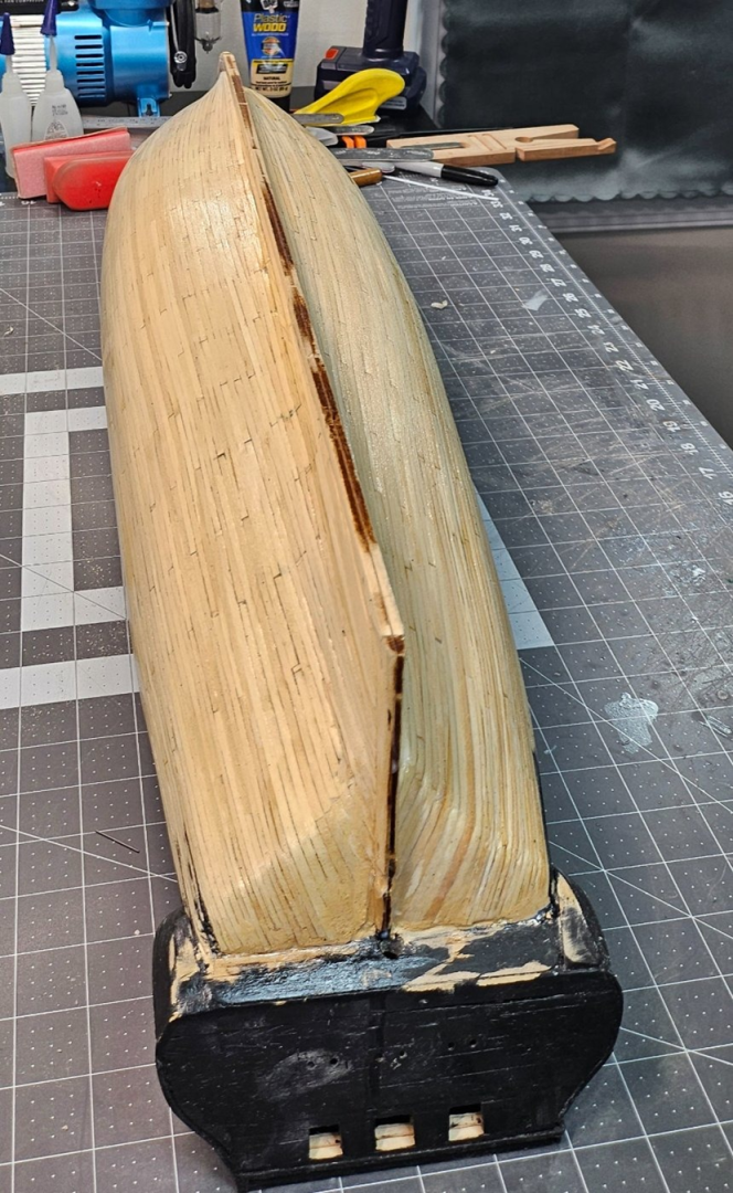

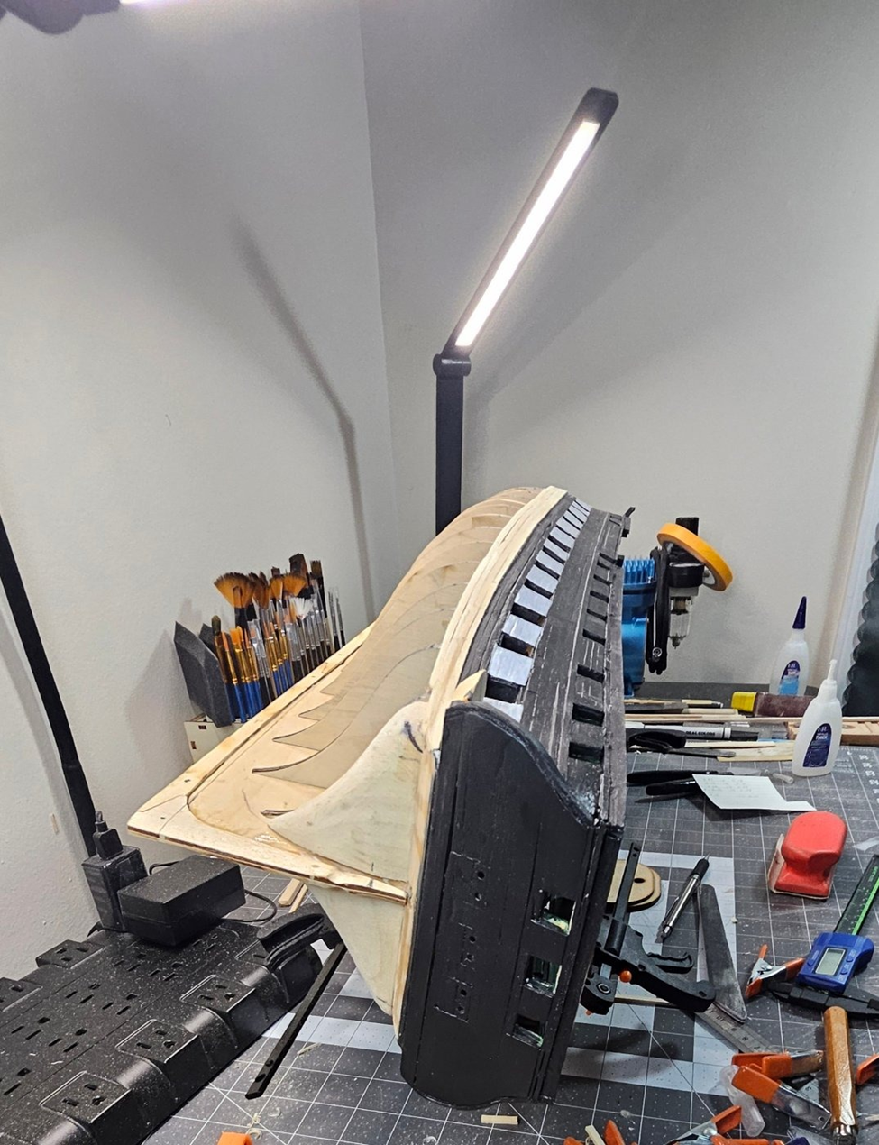

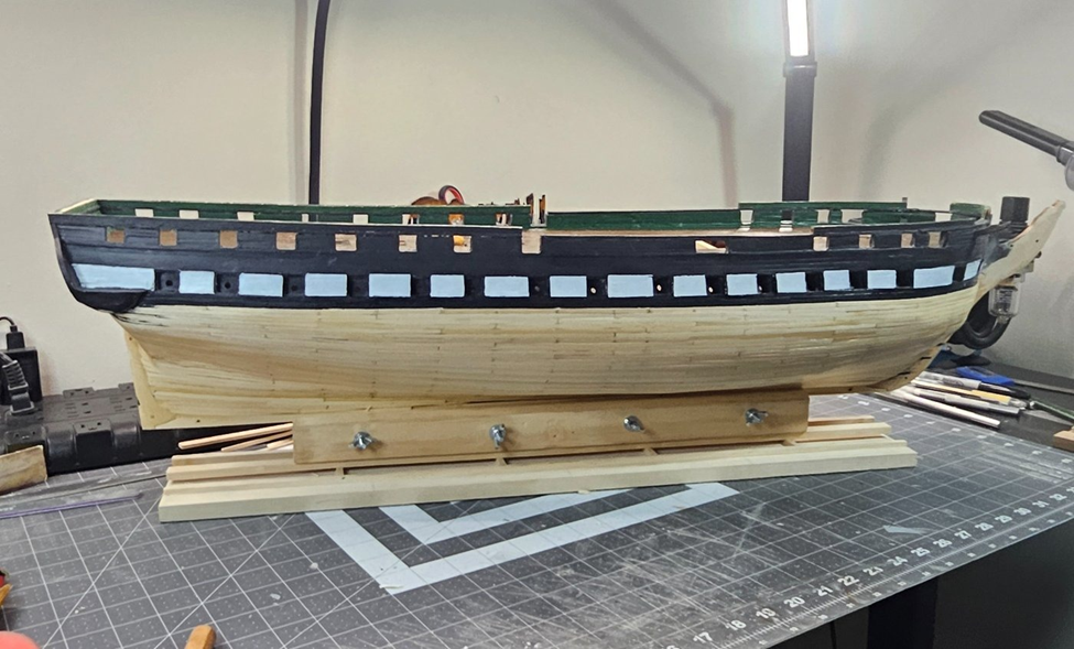

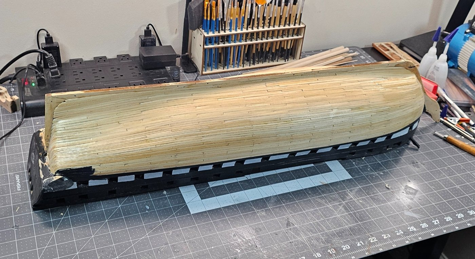

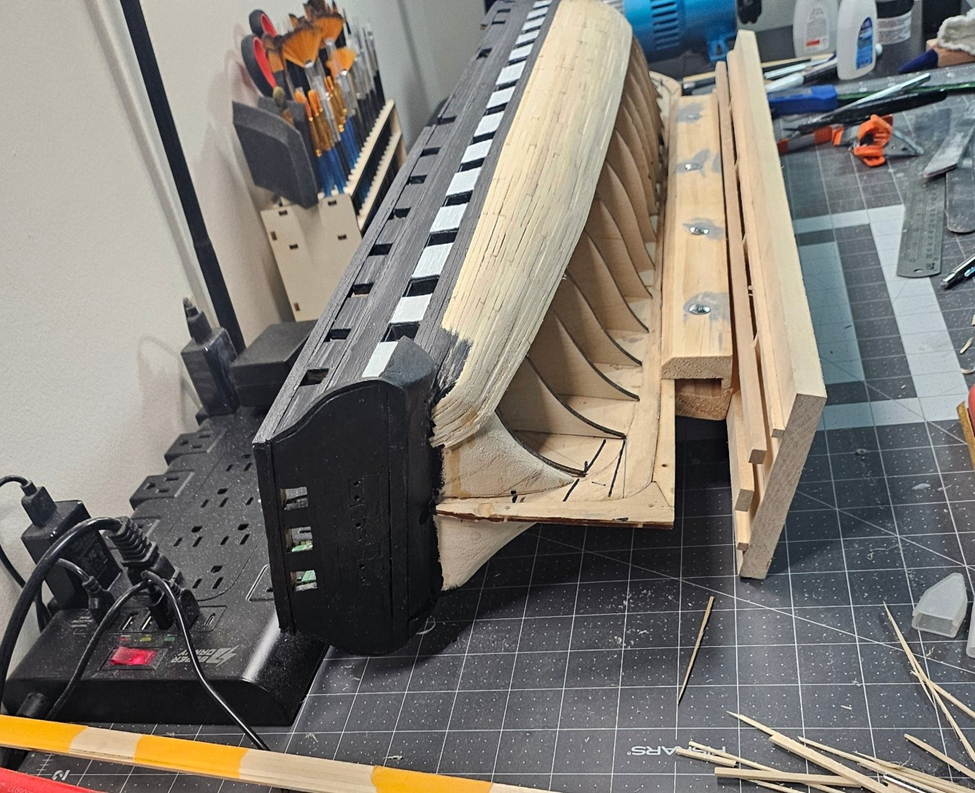

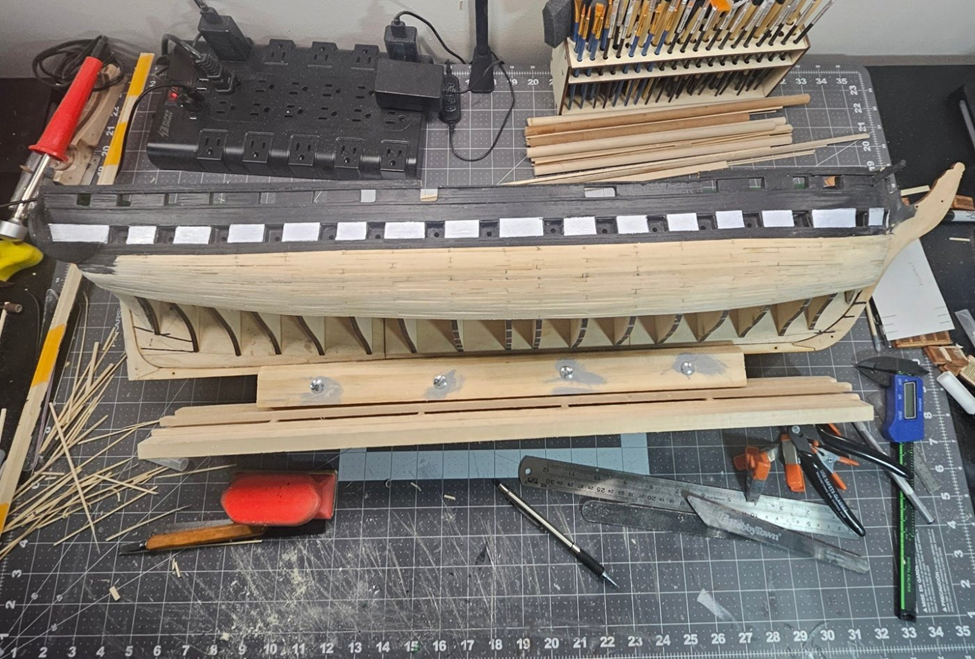

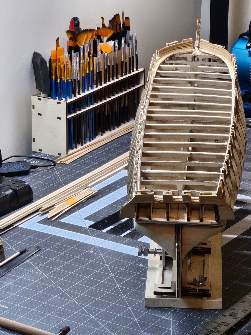

I finally made it to planking the hull...well, until I realized how time consuming it really is, lol. I finished the wales and the gallery bottom blocks on the port side. It took several hours, more than I had anticipated. It was also a bit challenging because the size of the gallery blocks in the plans are slightly off, because the forward tip of the gallery starts at the 1/8 mark from the corner of the closest gunport...but nothing a filler couldn't fix. In fact, Bob had to do this as well that he noted in the practicum. I'll be continuing planking the hull the next few days before I send the next update. I did have to read the practicum like 7 times before I finally understood what Bob was saying about the planking. It was somewhat of an overkill, but this was one of the tougher areas to understand because he tended to jump back and forth between relationships for planking, the transom, and the gallery. Either way, once everything clicked, it wasn't boring because there's a lot of trimming and cutting the planks to meet the rules of planking and butting them and following the rules. I think I covered what I did...it seems like there's always something I find that I need to tweak or adjust.
The hull planking is coming along and I'm very satisfied with the gallery floor and the block underneath. As I'm glueing the planks, I would start sanding the other planks when the ones that were glued on are drying which I think just makes it easier and more efficient because I'm not a huge fan of sanding excessively at the very end. Doing it in chunks doesn't make it as painful.
Then, I realized something, actually a funny observation. Some of the experienced folks submitting their build logs really have some spectacular pictures showing every step, up close shots, etc. ...magazine quality shots. Sure, my pictures capture the before and after shots of each major section when following the practicum, but my pictures look nearly the same and in the same pattern...just simple overall shots, nothing fancy. I figure I explain in my narrative what is going on and the mistakes I made and how I adjusted to them with some type of solution is likely enough for anyone to get the idea of what is going on in the pictures, but again I find it funny that I'm shooting the same pictures but at different stages. Simplicity is good; maybe I should add some music and video to them for full effects, lol. My cat takes better selfies that I do...

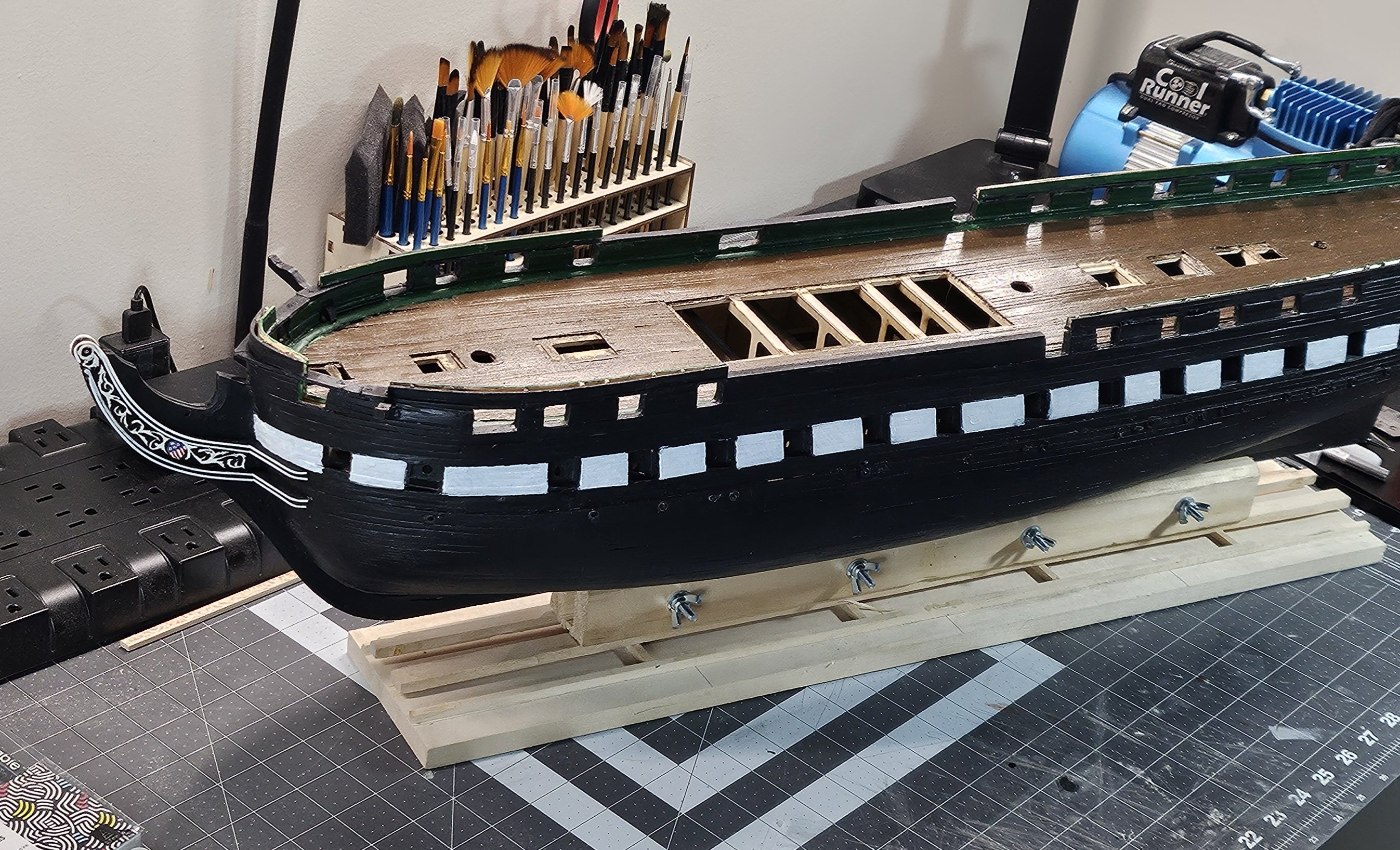

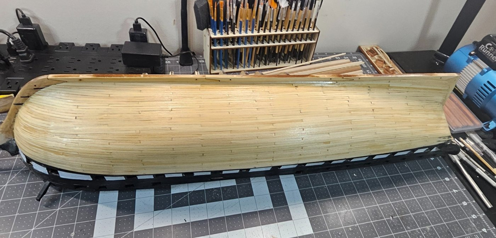

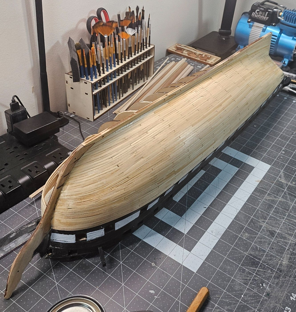

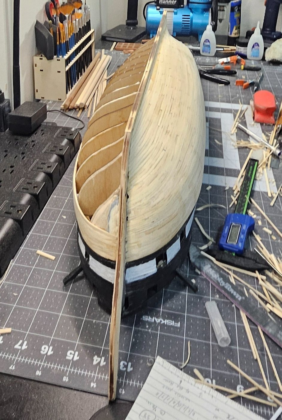

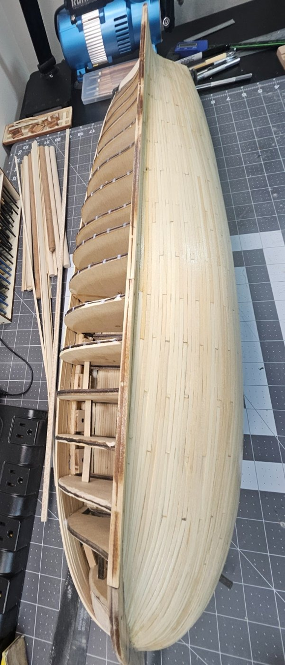

This is how far I've made it so far in planking the hull. After completing the wales on both sides, I started with the planking on the starboard side. I was sanding along the way while other planks were drying. While everything is smooth to the touch, it is an illusion in the light that you would think there are planks that are off, but really its mostly discoloration that makes it look like there is something wrong, lol. Having to taper planks at the bow and stern is the grueling part, especially with the stern having sharp turns. It does look messy, but I will fix that and clean up the stern area last. The practicum states this as well that the planks at the end of the stern were going to look messy and it was best to fix that last. The bow to me is also painful because it's not as easy to make it look nice because at least 15+ planks are 1/16, so while they bend up slightly indicates it is being done correctly. I already knew my bow filler block was sanded down a hair too much, so I've had to play around with the getting the plank into the rabbet and making that bend over the bow filler and bulkhead. Bob Hunt stated that there was no real need to soak the planks to bend from the bow, however; I have to disagree because I've had to bend pretty much all of the planks coming from the stem, otherwise my plank would break or crack each time. Anyway, this is definitely a very tedious and time-consuming task for the ship. As I go through this gauntlet, I became more satisfied as time progressed because it really started looking like a ship, plus being surprised that I made it this far, lol. I know I'm not the only one, but I am enjoying this new and humbling experience.
Continued with the starboard side hull planking. Very slow indeed with really measuring and bending planks at the bow and stern that took up the most time because of lots of trimming and sanding down the planks to fit properly.
I'm not overly concerned over areas that I've already painted because it's easy to repaint those areas. Once I finished the starboard side hull planks, I sanded everything down well and then added filler to fill in any tiny cracks or gaps. Ì didn't notice any unevenness across the hull which surprised me and everything appeared to feel nice and smooth sure I could pull this off being so new to assembling a model wooden ship, especially the Conny after the fact several experienced folks told me I picked one of the most challenging ships to build which I was completely unaware re of because I failed to do more adequate research. However, at this point, I've come to the realization that I do not regret my decision and pleasantly surprised that I'm still moving along in my journey and enjoying what the forum and comradery has to offer.
I cleaned everything thing up and sealed it with polycrylic real well and I must say, it looks way better than I expected with the planks I guess you can say in the right direction and pattern. The polycrylic makes it pop out nice with a very clean look, so it's no longer ugly as it once was, especially when I compare it to a scratch builder that makes everything pristine. I'm definitely very happy with it and move on to the port side. Once that is sealed then I'll repaint what was already painted and the paint the rest of the hull. I'm waiting for my copper plated to come in as well, so in the meantime, they should be in this week just as I'm finishing the hull.
I was very surprised after the sanding and sealing that it didn't look like a worn-out broken toy, lol... It took about 5 days, at least 4 hours a day and that's just one side. I had about 36 rows and some change, but I also had some minor anomalies towards the end where the current planks were too thick and I used the thinner 1/8 planks, the same ones used for the transom, and that worked perfectly in one or two small areas near the bottom of the hull.

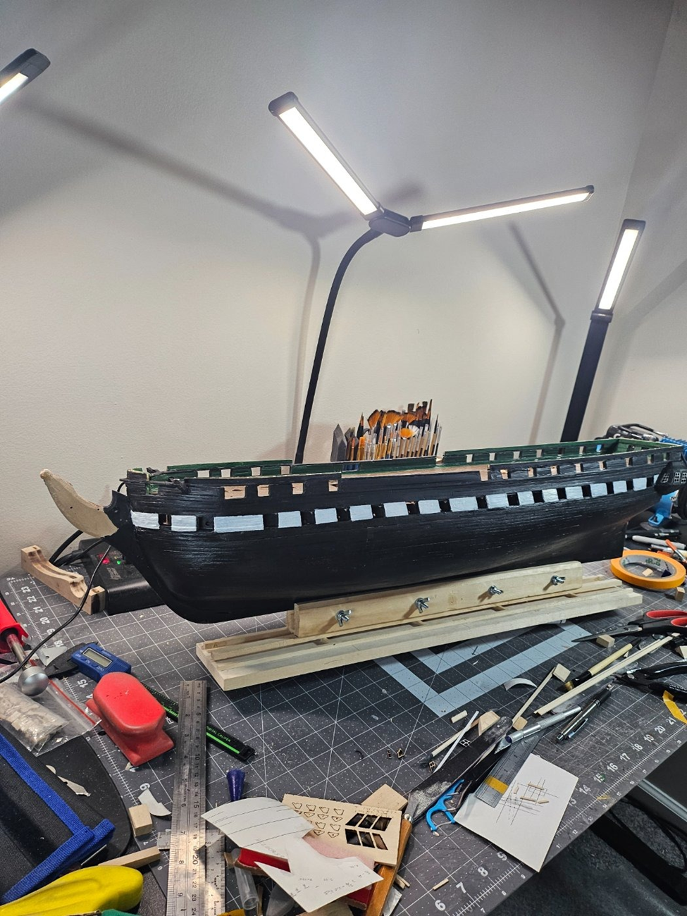

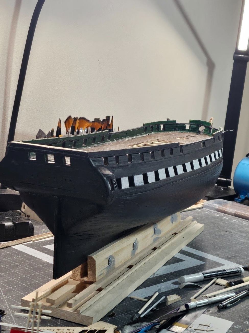

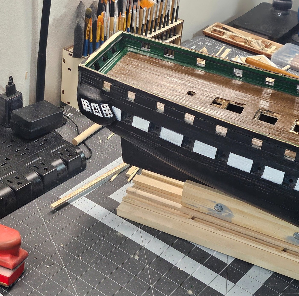

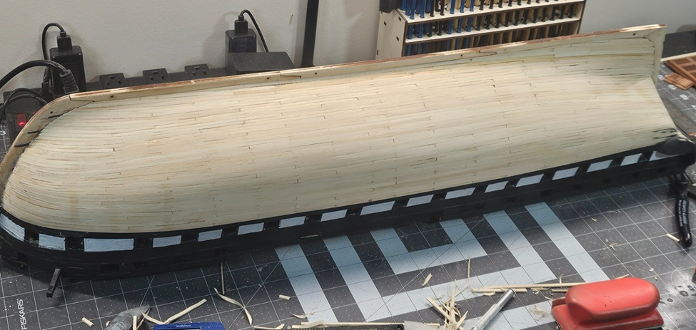

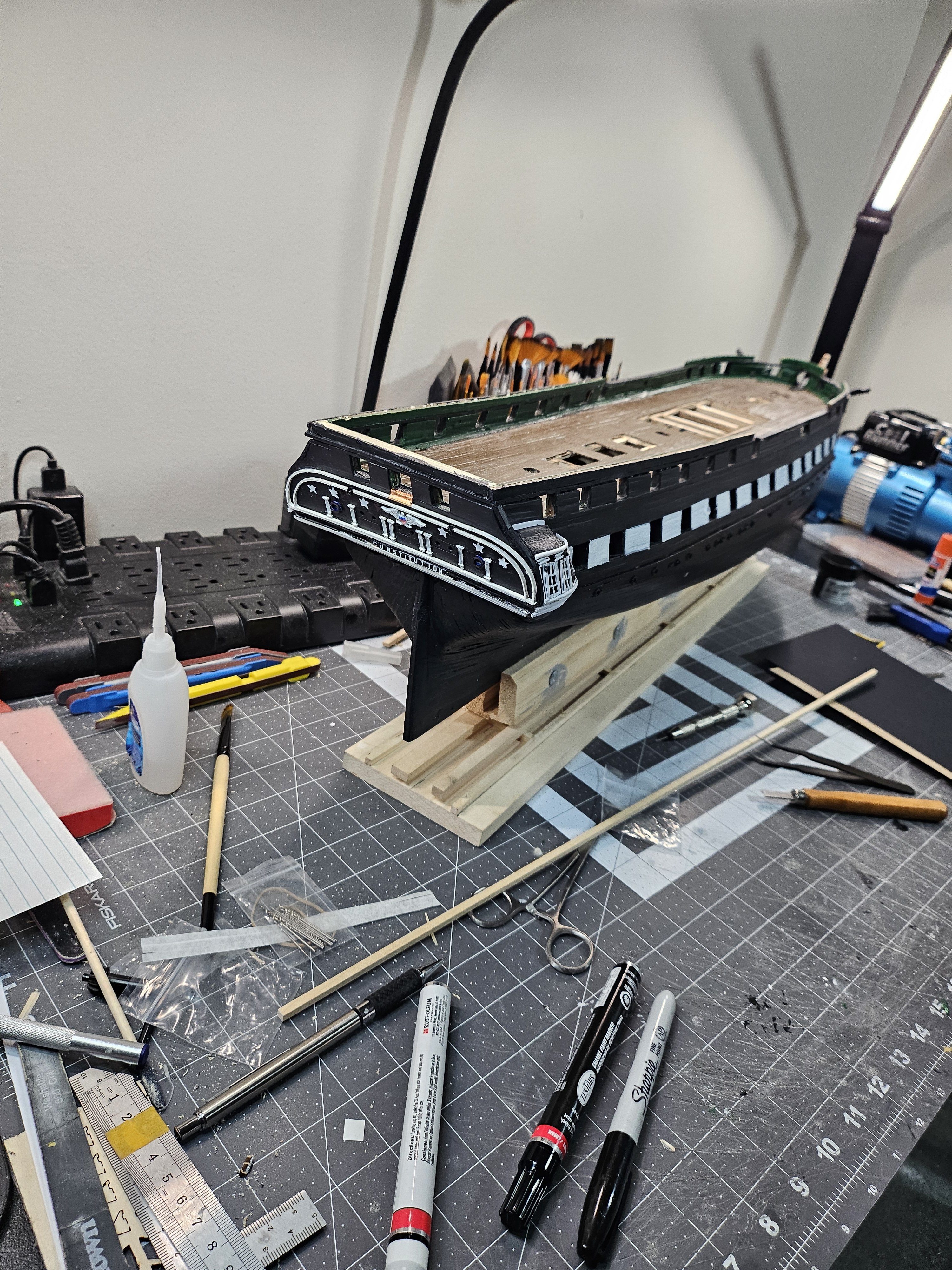

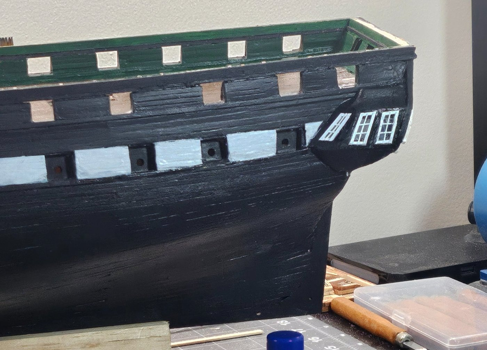

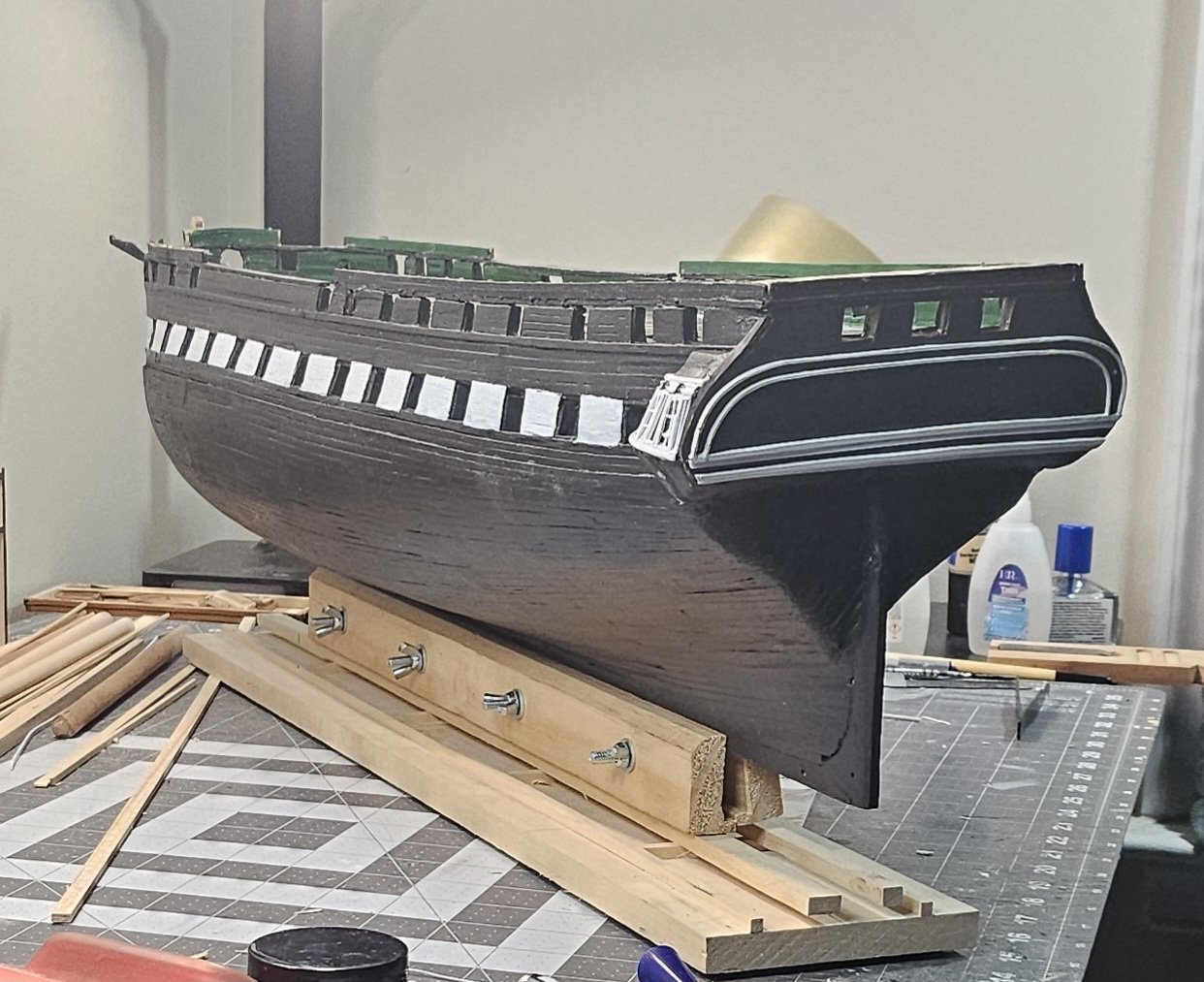

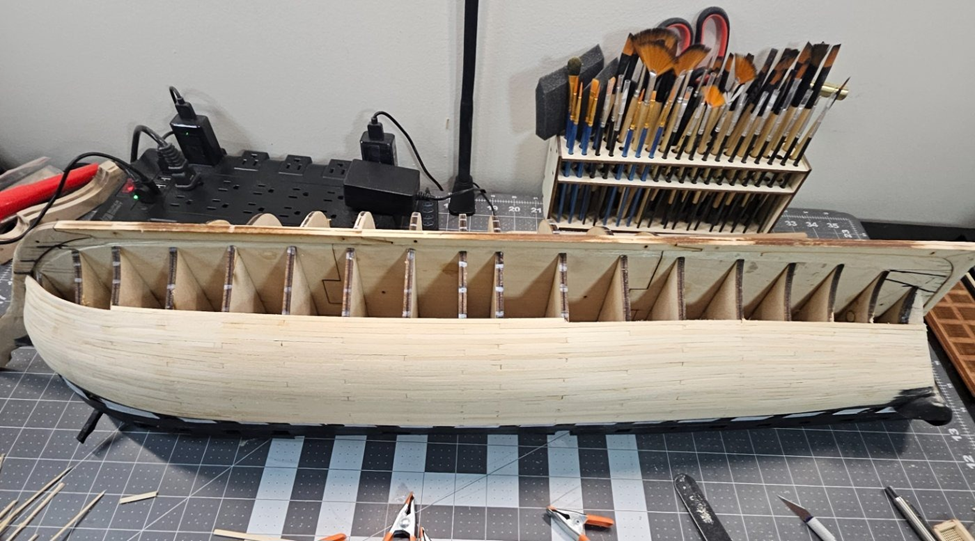

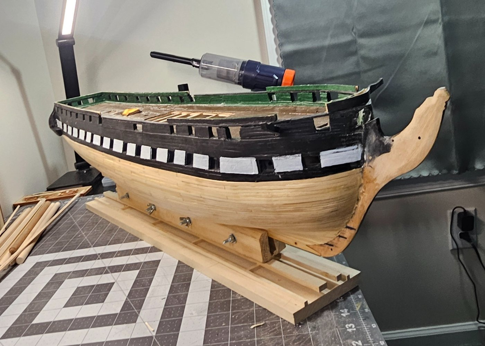

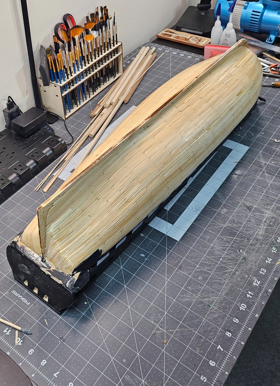

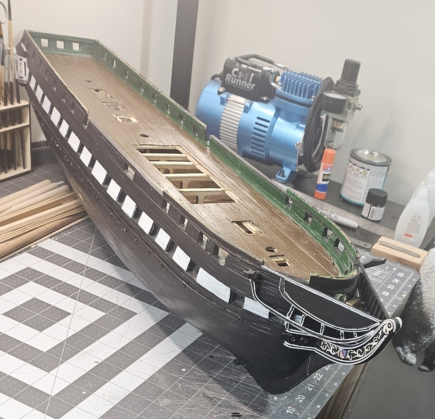

I finally finished planking the hull and definitely a test of patience and will. Did some minor wood fill and sanded everything down. Anything painted black already like the transom, but this is ok, it will be repainted anyway while I'm painting the rest of the hull. Again, as before, I'm more than satisfied that it turned out better than expected considering it was tougher than I thought including super gluing my digits more times than I probably wanted. So, the polycrylic is drying and I'll paint the hull afterwards before starting the next chapter in the practicum.

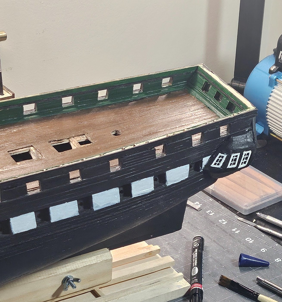

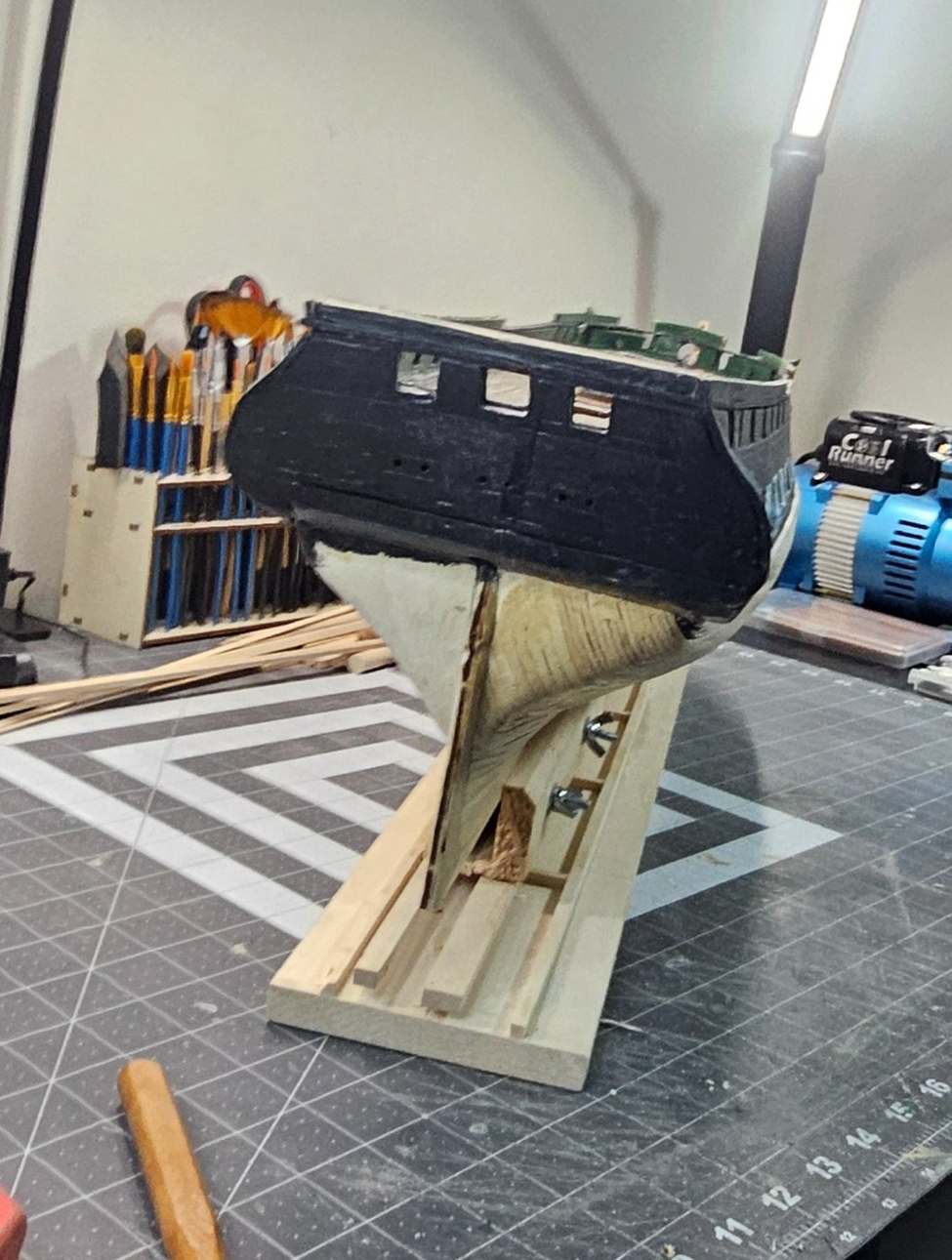

Finally got into some painting of the hull. About 3 coats after sealing with the polycrylic. I got to the port and starboard galleries which are somewhat of a nightmare. So, there are two choices based on the practicum, use the laser cut windows provided in the kit or build your window frames from polystyrene strips from a recommend list and purchase them. For one thing, wood working at this level when the parts you are creating are so tiny that it can take an eternity when using that magnifying glass to try to glue everything together....that was not fun. The reason also for.those two choices is the fact that for many folks, work at the transom seem to differ for everyone because there is measurement difference and the plans and the manual say or show two different versions of the gallery. But really, everyone is going to add a filler to the gallery because it's off technically by 1/8 of an inch, everything I had to do at this point is tweak everything to make the gallery presentable. My biggest issue right now is that I used the windows in the kit and it went well for the port side. The starboard side is another story. Two of my windows broke, essentially disintegrated because the wood is extremely thin. Because I'm waiting for the styrene strips to come in, I took thin wood stock something like 1/32 x 1/32 and attempted to build out the frames of the windows so that looked uniform. Only one kit window was OK for the starboard side, however I need to fix this and get all windows to be the same. The other issue I have is that the paint is not particularly the greatest for something this tiny. Finding a white paint that would make the frames pop would be great. The next couple pictures show how the port side looks decent, and the starboard side looks demented because it's a mix of thicker frames versus thinner from the kit on one side and definitely need to fix it.

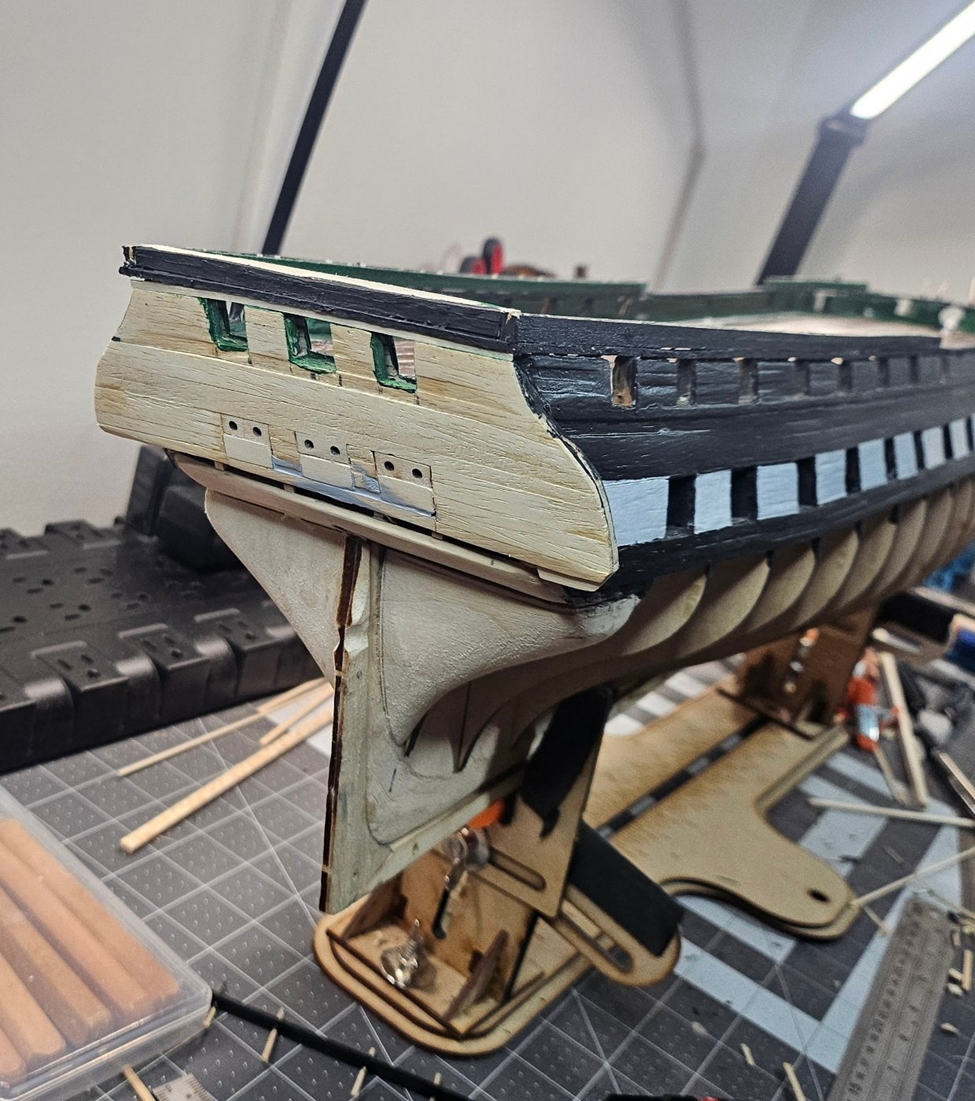

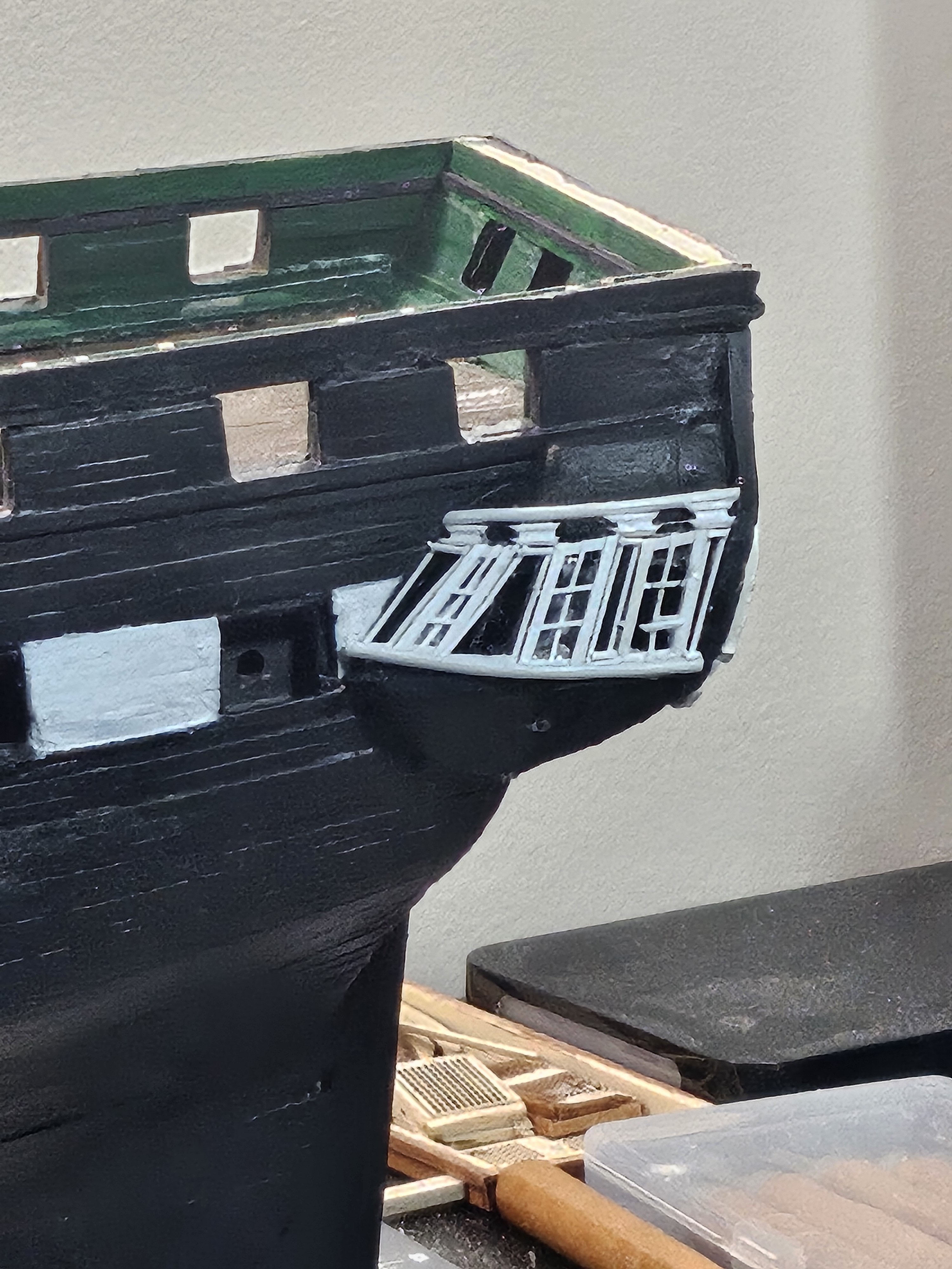

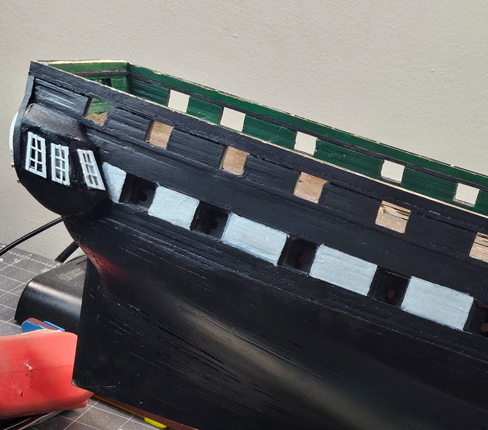

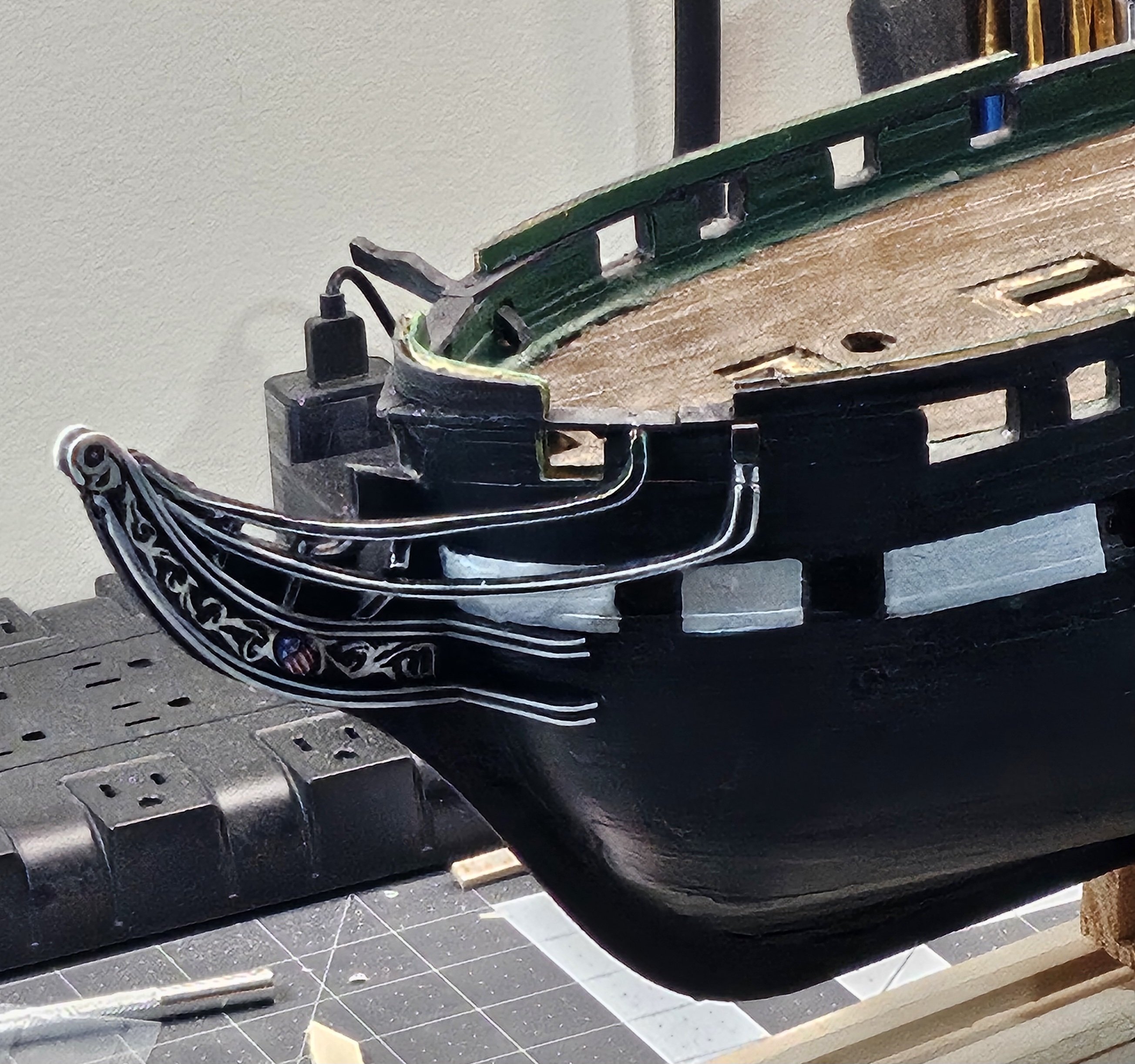

Yep, here are the unidentical galleries, lol. The polystyrene strips should make this better once I glue them correctly and make the measurements match.
Ok, so I finally fixed the gallery windows on both port and starboard sides. The polystyrene strips dod their magic as the practicum indicated. I am relieved now...

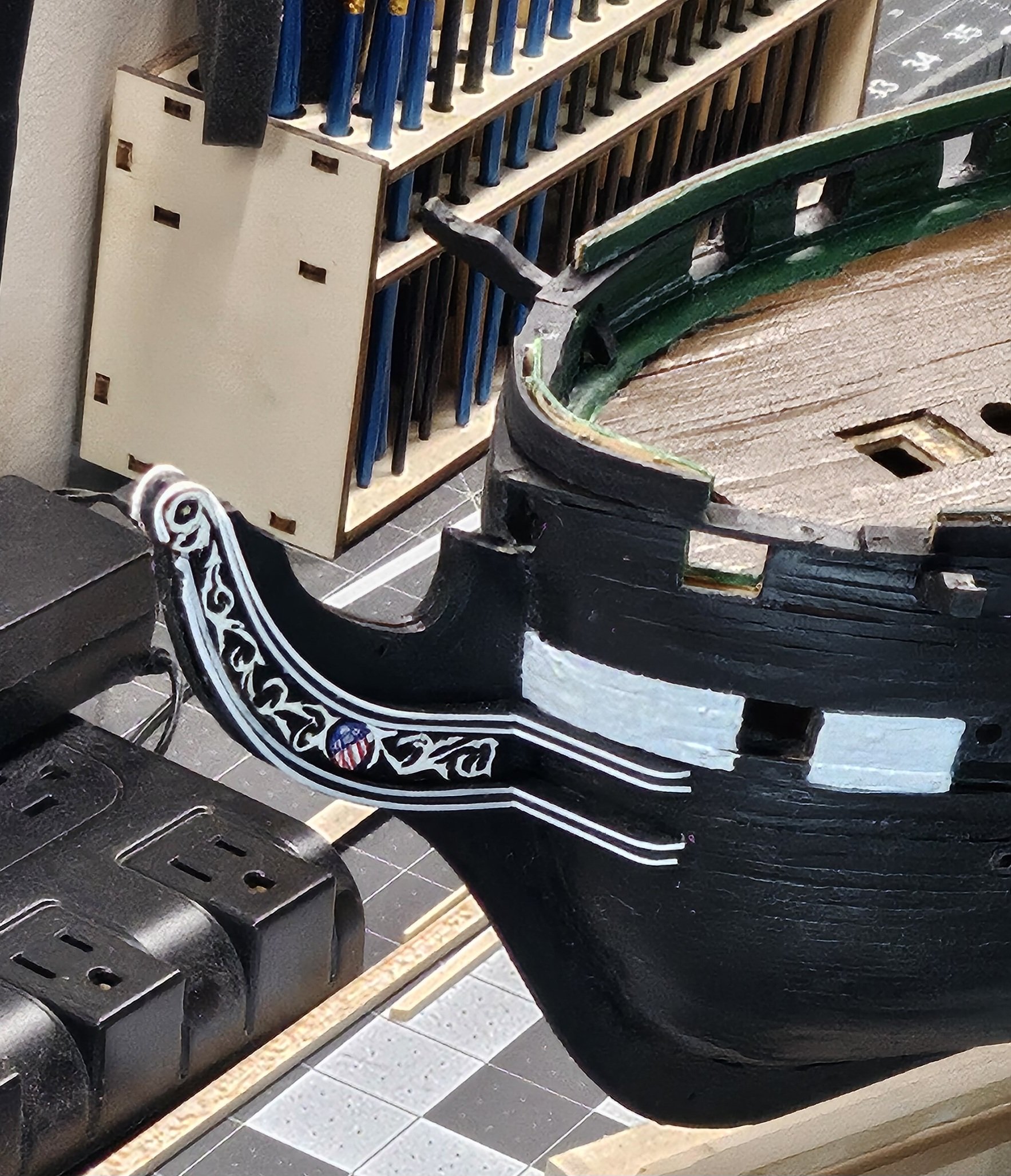

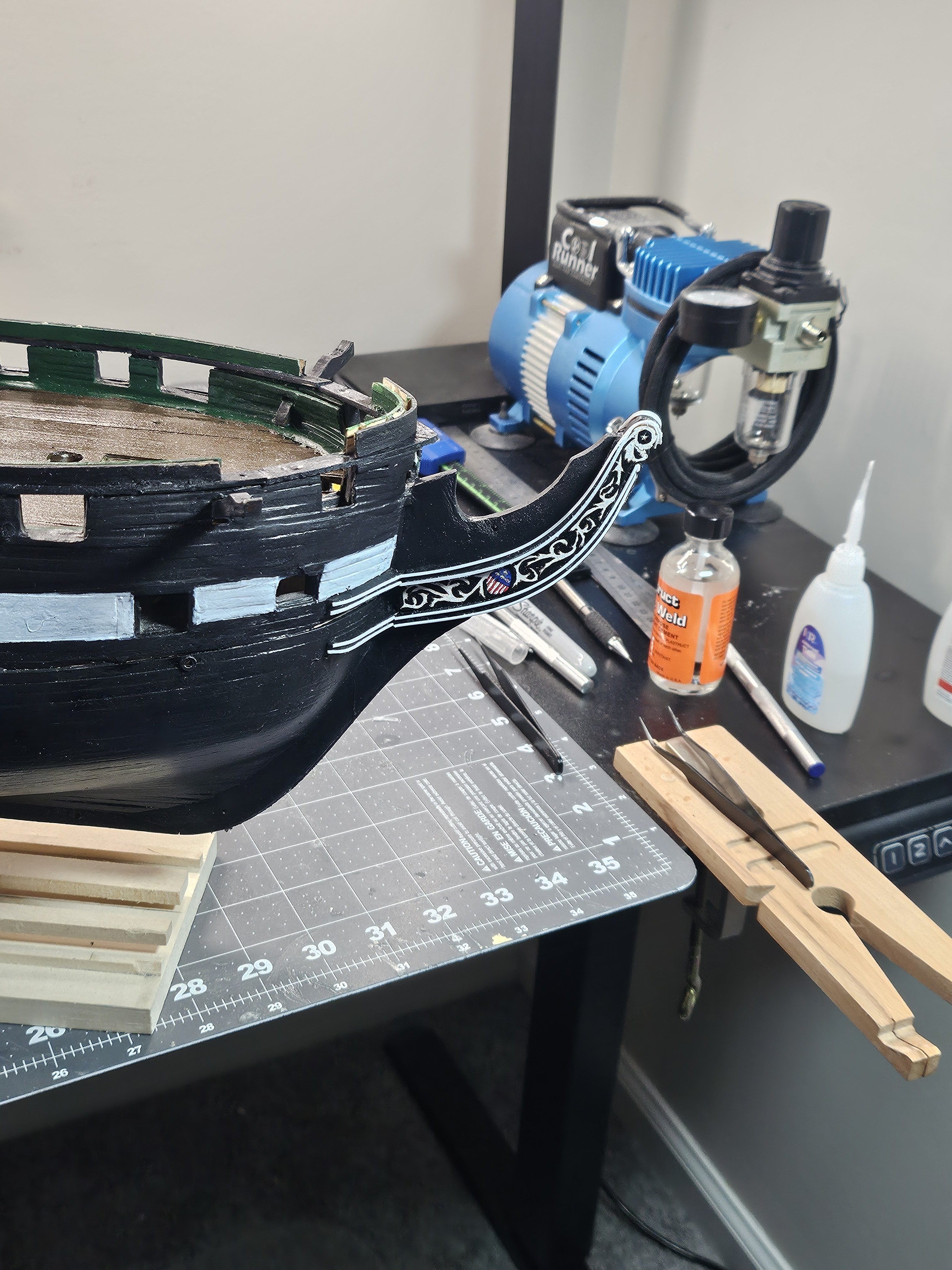

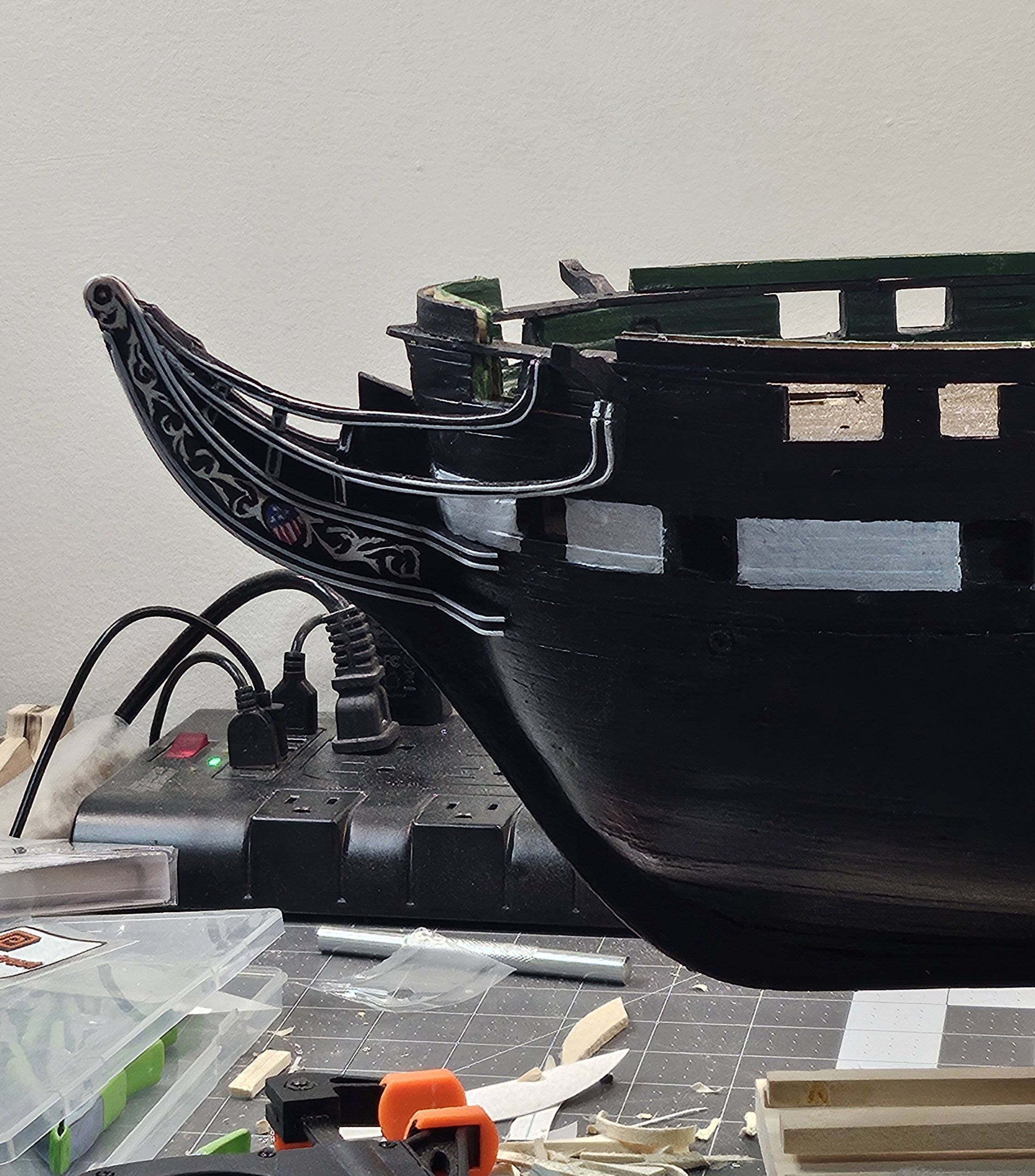

Finally finished the transom ornamentation painfully. Still getting used to working with very tiny pats with very tiny details. It's definitely not impossible, but time consuming if you haven't done is before. Now I'm going to do battle with the bow and stem ornamentation with the fancy cheek knees and rails...looking forward to re-reading the practicum as the pictures to me are not clear enough and have to read ahead to understand what it is supposed to look like. I'll have to go through the forums to see what others have done, or if they provide enough detail for me to fully understand.
Transom1.thumb.jpg.e9d78caf98afd7ad2186cd6f80e71f0e.jpgTransom2.thumb.jpg.1c0354918a43e2136eda59a5510142d6.jpgTransom3.jpg.d2fbf165316ecf94c91d4bda26f022c0.jpg

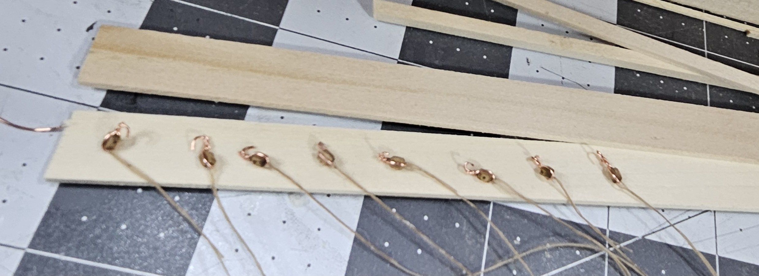

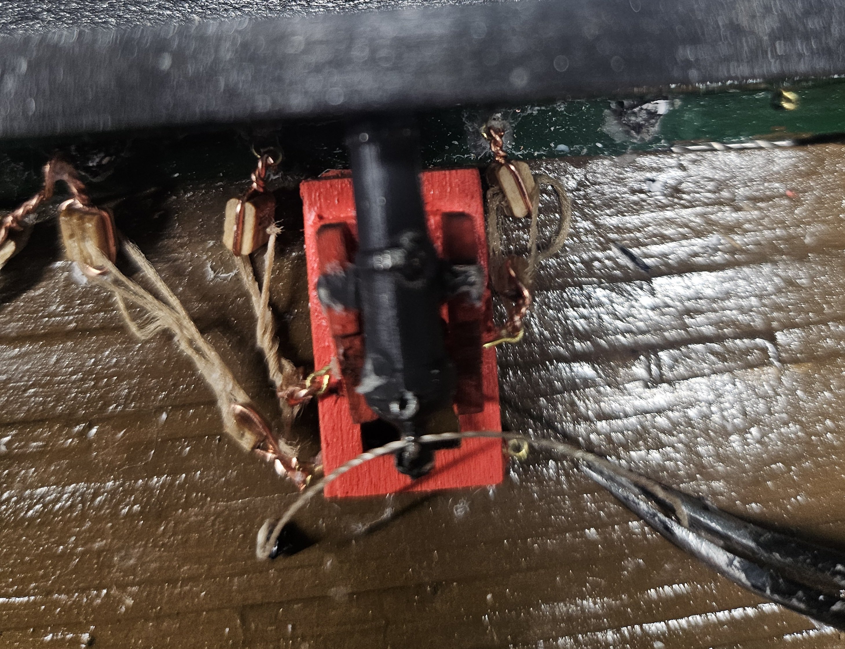

Well then, I'm beginning to realize that the practicum is incomplete and inconsistent when it comes to the cheek knees and rails. The pattern to follow is certainly not the top right corner, but halfway down the page. The top right is only to see what it should look like. I followed those dimensions and realized it is not the correct size, so I've been experimenting with the 1/8 sheets, the 5/32 and the 1/4 inch. The 5/32 and 1/8 are nearly the same exact size, so it would be easier to used your 1/8 sheet to cut the curve and length with its knee separately. I dont think I agree with using the 1/4 sheet or doubling up on the 1/8 because the 1/4 will be trimmed down anyway and when your done it's back down or narrowed down to 1/8 or 5/32 anyway, so I'm not sure why Bob Hunt would do this because you can do this all on the 1/8 sheet for the rails. The 5/32×5/32 strips do well for the knees though. So. I cut out a 1/8 template of the trackboard and soaking four, 5 1/4 in 5/32 strips overnight so i can used my templatethe clamp to strips on it and clamp them down to conform to the right curves with the trailboard and the correct length because my original cuts were too short because I followed the practicum on this. Hunt even started the lesson with a pattern he drew and cut thats not even on the plans, so you're left guessing on the actual size. Ill continue pressing on, but i wish an update would be made with more detailed instructions at each step because the rails are considered the most difficult  or most challenging at this stage of the build...so, I'll continue studying the 3-4 folks that have completed the Conny.20250720_193224.thumb.jpg.72575b7d06ea616c6df2ae2c21b2a80e.jpg20250720_193224.thumb.jpg.72575b7d06ea616c6df2ae2c21b2a80e.jpg

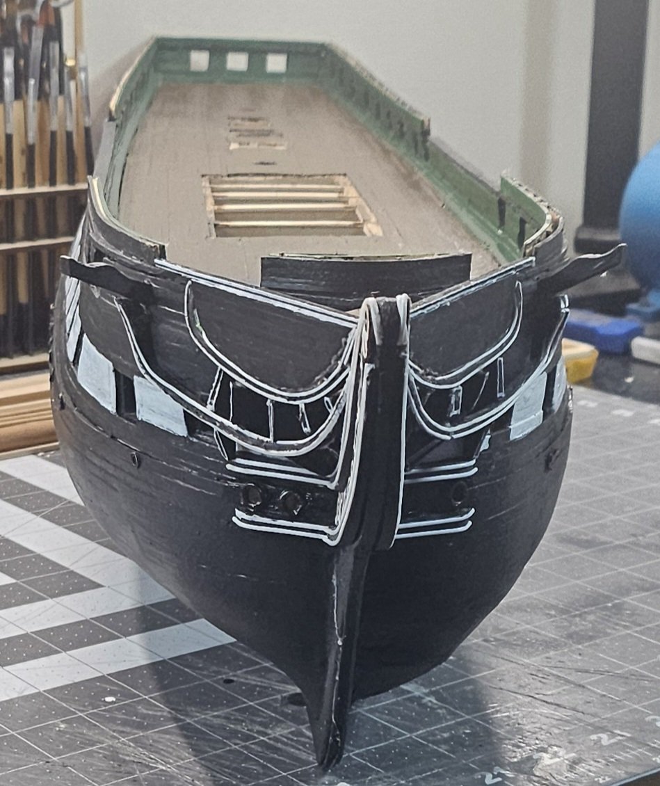

My disappointment with the cheek knees and rails grows each day as I realize how flawed the plans and practicum are.  Anything remotely close to being a template you can use for cutting the rails from woods are utterly useless and do not match in size and dimensions.  It might be close, but not close enough...for sure... So, my strategy is using sheets of wood and drawing the design using a flexible measurement tape to measure the angles on the hull of my Conny and check them against the plans.  I am following the builders that finished their builds and what their pieces look and then if they did it in multiple pieces then I will follow that because they all look good and a matter of preference for the technique used.  If I have any disappointments on my journey so far, it will have to be the unclear and ambiguous instructions in the practicum related to the rails and the measurement inaccuracies when bounced against the plans.  The rails on the plans are so narrowly cut that it is impossible to get the white striping with the .40 half round polystyrene strips or even using wire to do it because there is no room on the rail.  A part of me is compelled to possibly build a thread for just this part of the Conny build from Model Shipways MS2040 kit.  Getting the builders that survived this piece and having them add their advice and pictures, which most would be cut, and paste would be very helpful and beneficial with a one-stop-shop for tackling this nightmare for future builders on the forum.

It's frustrating, I know. All I can tell you is to review as many other builds out there and try to follow one that you like best. I don't think anyone has done the rails and trailboards the same way twice.
Just a forewarning, you are going to have just as must "fun" or more with the quarter galley windows. The laser cut window frames supplied with the kit are useless as they are the foreshortened shape shown in the plan elevation view and don't reflect their actual shapes. And no, neither the kit nor any other sources I checked, shows their actual shapes. But if were easy, it would be so much fun!😆
Jon

emeblers on the forum about using fine tip paint markers/pens. I took my time and it actually came out better than expected. What helped was the laser cut carving of the design that helped keep the paint between the lines. The printout of the flag to cut and paste onto the trailboard didn't work as advertised practicum. I took my time and managed to paint the flags on the trailboard...I can't remember the last time I had a steady hand to pull something like this off, lol. Anyway, the cheek knees worked out and along with the white striping using 0.80 half round polystyrene. It wasn't as painful as I initially thought, but nevertheless it worked out and feel it actually looks pretty good. Now it's off to the next set of rails.

I guess I now understand fully why the cheeks knees and rails are painful for everyone. In Hunt's practicum, Bob states that although the plans show how the rails should or could be constructed with the timbers, they were found not be accurate and likely because everyone's bow may not be the same exact size or dimensions when compared to other Conny modeler/assembler. Personally, I found that I've had to make my timbers larger than what are in the plans and went through lots of pieces of wood to try to make the right fit in all dimensions for the 2nd and 3rd rails and the timbers. I'm finishing up timbers 4 and 5 on the port side and one I so that, then I'll complete the starboard side. I had made near duplicates of the timbers from the port side to closely match for the starboard side. I also made them larger that way I can trim it to that side because everyone will have variances in curvature of the rails. This has also been very time consuming because of trying to make a nice fit with the timbers because the "head" area with the grates and box like setup have to properly fit down the centerline on both sides on top of the timers on the inside of the rails. I did something different regarding the molding you find on the timbers. The practicum only offer that polystyrene is cut to border the shape like the rails themselves. I found an easier way instead of making a mess with the glue when building the 3rd and 2nd rail, by actually painting lines bordering the timbers. I recently found fine and ultra fine tip white paint pens. If you run the tip nice and easy, if you have a steady hand, it looks like you had used molding instead. You might see timbers 1,2, and 3 with the white lines painted on them. I found it much easier to do this without the mess and having black fine tip paint markers work well if you have to touchup a spot because you got out of the lines you were creating. I just about swear by these fine tip paint markers. That's how I was able to do all the fancy scroll work on the stem...

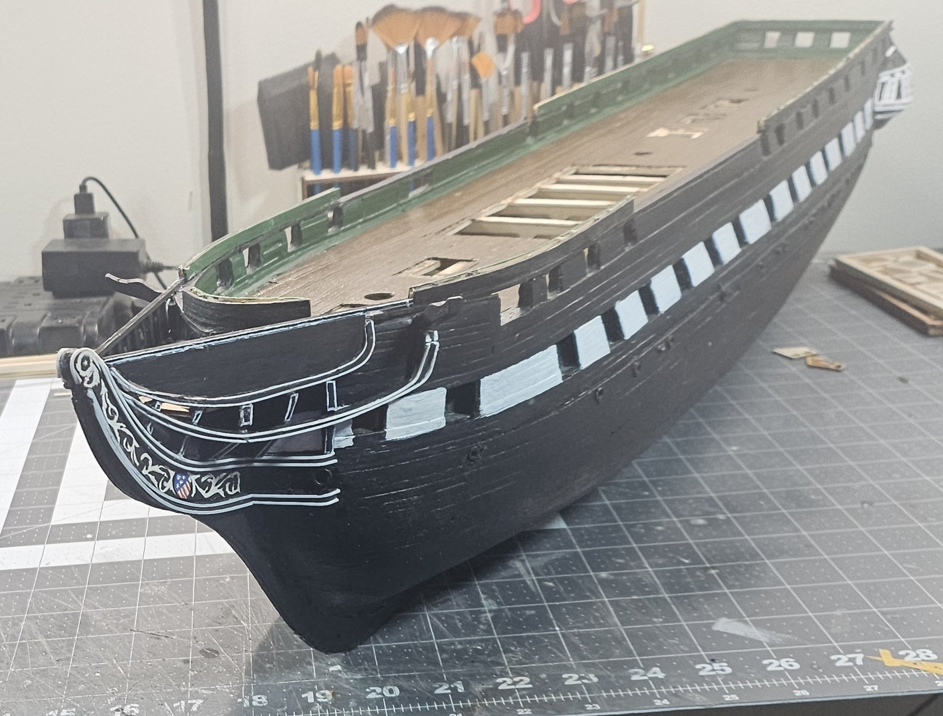

Finally finished the cheek knees, rails, head rails, crew head, and planking the main head rail to the 2nd rail. Once again, the fine pen paint marks were extremely useful. I painted the head rail on the side all white and then after it dried, I used a small metal ruler and put it on the edge using the planks for support and uaes the fine pen black marker and ran the line straight down, and it not only looked straight, but actually looked good. Again, I think using fine tip marker paint pens are the way to go instead of the sticky glue and finger mess trying to get extremely small half round white polystyrene strips. Now I'm cleaning everything with a damp cloth and preparing to copper the hull and choo;20250802_073221.thumb.jpg.2fa254862011b58e08095152c6508753.jpg20250802_073221.thumb.jpg.2fa254862011b58e08095152c6508753.jpgse not to use t tape. In my opinion, there are only a few assemblers and builders that can make the ,, mm I tape look great but hands down the plates look much better and they come with a rivet scheme that is consistent for port and starboard side. I am adding polycrylic to the hull which will help with the adhesion of the copper plates. This past of the build may take me a couple weeks because there are a lot of copper plates. And last, but not least, the hawse pipes. I did notice that some folks cut little boards and glued them inside of the cheek knees and then drilled holes to insert the hawse pipes.

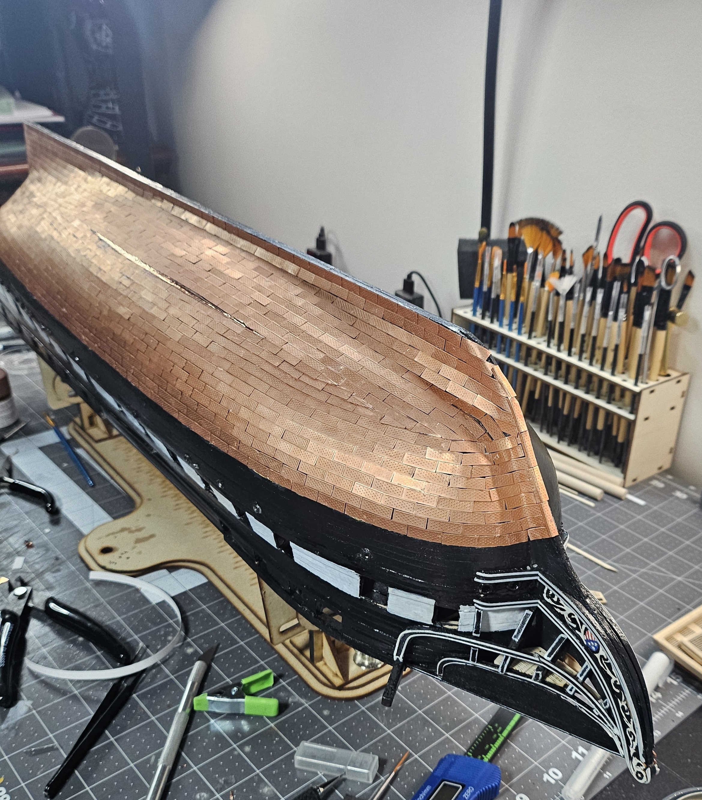

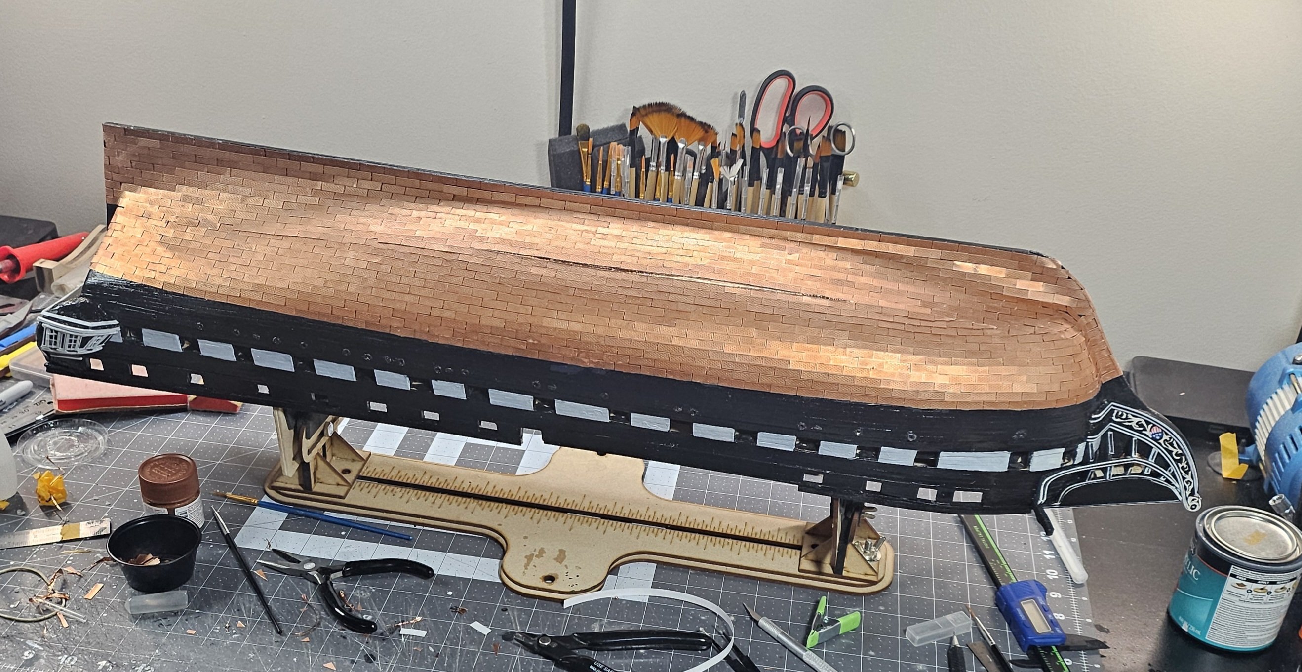

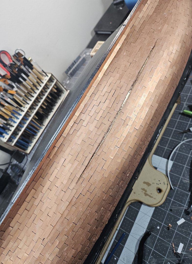

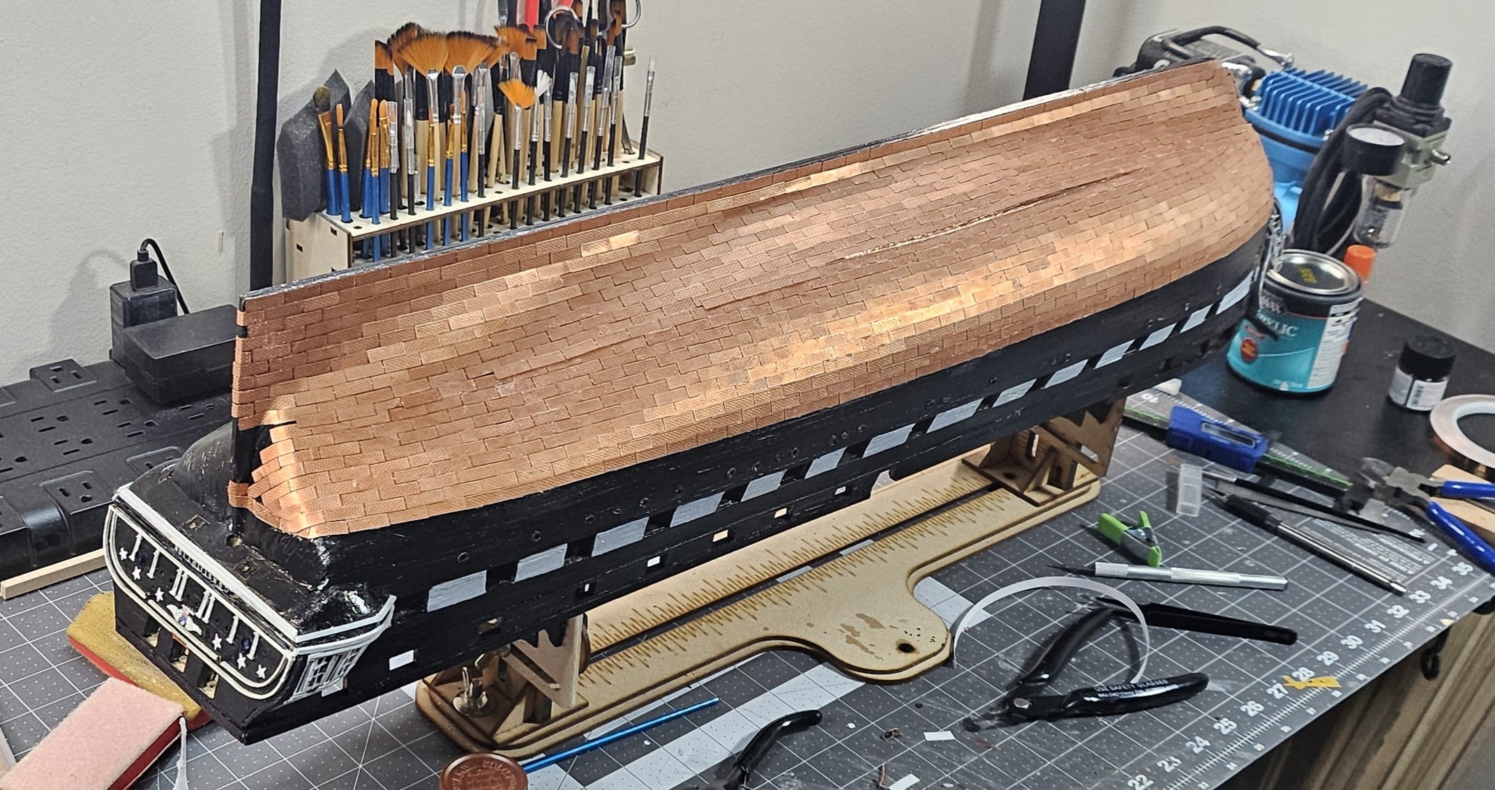

Copper plating the hull was a lot more challenging than expected because I chose the plates over the copper tape.  Several builders had choices, and from what I saw, did a pretty nice job with both choices, as well as dealing with size variations between copper tape, and different copper plates with sizes either on scale or very close to it.  I found this to be very tedious as well, and learned soon that when cutting the plates, which is each individual plate, that you have to go back to each individual and make sure any existing left-over metal on each side has to be trimmed or cut off, otherwise you might be left with tiny gaps that are noticeable up close.  When it came to the bow and stern, I found that to be quite the challenge because it is not like bending planks.  I found myself having to cut or trim the copper plate to get into making my way to the bow and stern.  I also had a chance to do a little experiment as well.  I started with Hunt's Practicum and then followed what my gut told me halfway through.  Going back to the variations in your choice of hull coppering material, one cannot be sure that if you follow the pattern in the practicum that it would work for all of the copper materials which I found out to be true.  Because everyone's Conny might vary slightly after they had planked the ship, or based on the different copper plating sizes, etc. I was left with a very small gap that I would need to fill in. I could trim the plates to use them as if it were a filler like we did during planking, but I found that to be tough because if you cannot cut it the correct size, it will not look good and you might waste plates and not have enough to complete each side and each side takes ~1,024 plates for total of 2,048.  You should be left with a very small amount of left-over plates. You may need to use plates to overlap the left-over areas to be covered so that it looks decent.  If done correctly, any gaps you have should be towards the underside of the boat and there will be some at the bow and stern mainly because of the sharp turns. For copper tape users, it's easier to cut to fit. Ok, back to the experiment...what I did was initially try to cut the plates to try to fit inside the gap.  I found that to be too hard because the plates are hard, and you need a knife or something to cut and trimming can be tougher because you now need to work with something much smaller.  Anyway, I laid the tape over the area with the gap and then pressed it nice and hard where the rivets from the other plates could be seen through the copper tape.  I then let it sit for an hour and then trimmed copper tape with an Exacto knife inside the gap. This actually worked out nice and made it look very neat and clean.  Since the plates are not shiny, the copper tape is, so you can see a shiny line halfway under the hull.  Now I'm debating whether to get a matte polyacrylic which would dull out the line to match it next to the copper plates around it, or a semi-gloss polyacrylic and apply it to the hull where the copper plating is which can act as a protectant on the plates as it did on the rest of the wooden parts of the ship.  Does anyone know if brushing polyacrylic on the copper is a good or bad idea after the hull is complete?  The pictures show that the portside is almost complete and progress thus far, and let folks know I'm still alive, lol.                                                                                                                                                                              https://us-east-2-029060369-view.menlosecurity.com/c/0/i/aHR0cHM6Ly9zaGlwc29mc2NhbGUuY29tL3Nvc2ZvcnVtcy9hdHRhY2htZW50cy8yMDI1MDgwN18wNjEwNDYtMS1qcGcuNTM2NTcwLz9oYXNoPWFkZDY2ZWU3NTFmNGNjZjBjNDhkMWRlM2FiMmQ4NDAzhttps://us-east-2-029060369-view.menlosecurity.com/c/0/i/aHR0cHM6Ly9zaGlwc29mc2NhbGUuY29tL3Nvc2ZvcnVtcy9hdHRhY2htZW50cy8yMDI1MDgwN18wNjEwNTctMS1qcGcuNTM2NTcxLz9oYXNoPWFkZDY2ZWU3NTFmNGNjZjBjNDhkMWRlM2FiMmQ4NDAzhttps://us-east-2-029060369-view.menlosecurity.com/c/0/i/aHR0cHM6Ly9zaGlwc29mc2NhbGUuY29tL3Nvc2ZvcnVtcy9hdHRhY2htZW50cy8yMDI1MDgwN18wNjExMTItMS1qcGcuNTM2NTcyLz9oYXNoPWFkZDY2ZWU3NTFmNGNjZjBjNDhkMWRlM2FiMmQ4NDAz

Moving along with the cannons, gunports, and outer hull and deck work.  Cannons, curtains, and lower gunport doors were easy to work with, although it felt somewhat time consuming because you are working with 30 gunports.  The pain really is dealing with the upper gunports because you have to create a micro miniature rope-like object connecting the upper gunport after you drill 2 holes using a #77 drill bit which is super tiny in itself and very easy to break.  I'm on my fourth one now.  My kit came with black annealed wire to simulate what would have been rope connected to the upper gun port to its respective top curtain. You definitely want to make sure that hole in the curtain is free and clear because that is one of three areas connecting the door.  The two holes you drilled in the gunport door are the other two areas.  As much as I enjoy seeing how nicely this is created in the practicum, creating something this tiny and trying to bend the wire into the holes is not so easy and certainly not as perfect in the pictures.  In fact, it is so small that you never really see it unless you're right up staring at the gunports near your face.  I finished slightly over half of them on the port side and touched up the white paint on the gun port doors as well.

While I'm working on the channels, deadeyes, and eye chains, etc.  There are definitely some things I wish I knew before this part of the build.  The practicum seems somewhat incomplete, but I think Bob Hunt expected us to figure this out based on what we've learned thus far throughout the course of the practicum. I read a lot, but if the reading gets very complicated to understand, if you show me a picture what it should look like, it will click in, and I can certainly get it done that way.  The ship's plans also get complicated because some things seem to be off or missing altogether.
Most builders can solder well or make a mess doing it.  I can for the most part do well because before I became a Navy Officer, I started off Enlisted and flew as an Aircrewman and Rescue Swimmer, but also an Aviation Electrician's Mate.  So, we fixed what we flew.  Some areas that would have helped before I started, but I'm hoping new assembler/builder would know about this particular Conny kit, so they can make their own decision on what approach they want to take.
For starters, choosing brass wire for the deadeyes was clearly not a very good idea, particularly the gauge of the wire.  The wire does not twist well and breaks very easily.  It does not conduct the soldering iron temperature very well and you find yourself taking forever to heat it up, let alone soldering the strip which is also bass.  In other words, the choice of this to include in the kit totally sucks and was a poor choice.  The wire is kept breaking on me as I tried to twist it onto the eyebolt.  Solder does not adhere to brass very well at all, so trying to solder the brass wire around the eyebolt to the brass strip was a complete waste of time.  My solution was to get some copper wire that was a slight gauge thicker than the brass.  The copper wire was perfectly strong and easier to twist on and keep it there and finish it off with a pair of needle nose pliers to tighten it up against the deadeye and none of them broke.  To solder the deadeye to the eyebolt strips, I used my magnifying stand that had clips and arms to hold each piece separately.  you can tin each piece before soldering them together, however, tinning the strip being brass was just a waste of time and copper took to it immediately.  The easiest way and the fastest way without making a mess and using as little of the surface area was to position the brass strip on top of the deadeye copper wire that was trimmed down to 3/32 and then place the soldering iron needle under the copper wire and use the flux core solder from the top.  it would be instantaneous and no waiting to hear up like the brass wire.  Doing it this way makes the smallest possible amount of solder to adhere to joining both pieces quickly because the solder immediately goes to the copper wire first and enough to cover it, and the strip of brass gets caught in the melting action and when you remove the soldering iron you'll find that the strip did connect and notice it isn't globby from the solder.  This makes it ideal to fit in the grooves you created in the channel.
This then leads into the channel portion and the grooves you created for the eyebolts and deadeyes, these need to at least 1/16 wide and deep for the copper wire and strip to sit in the groove comfortably before using the 1/16x1/16strip of wood across the channel over the eyebolts covering the soldered areas and enclose nicely.  I recommend getting the eyebolts on the channel, closing it up and then painting them before gluing the channel onto the hull.
Bob had given measurements for each of the eyebolt strips, and I found those as really unnecessary.  Everything seemed to be the same distance and more even than making a couple of them vary in length.  I also am not sure how those rivets even fit inside the eyebolt because it is just ridiculously tiny, and my hand is certainly not steady to try to go through the strips into the hull.  I end up simulating to bolt top with globs of paint, however, even if I used the rivets and survived that ordeal, you can barely notice them unless you have your face up to the hull.  It seems a bit unrealistic with .035 rivets to fit in like that.  simulating them much easier, but barely noticeable to the naked eye.  This is my take on this specific part of the build.  I'll include pictures later today of at least one side that was completed.  so, preparing the deadeyes and soldering them to the eyebolt strip began as like 2-3 per hour to 10-12 per hour...major difference here.

Bob's practicum is a wonderful guide and I wouldn't have started the Constitution without it, but it does leaves something to be desired. If you  check, he did not even come close to finishing his model. He only did enough to show you how he did certain things. I am using Mr. Hunt's practicum, but only as a guide. I learned to do that after I followed his practicum for the Rattlesnake. At first, I followed it verbatim, slowly I noticed some minor omissions and errors. I learned to follow other builders' logs and compare what they did versus what Bob did in his practicum and then chose the most appropriate path for my skills and goals.
As for the soldering, what method are you using? When I solder brass or copper, I use silver solder (both paste & "wire") and a torch as oppose to electrical solder and soldering iron/gun. I haven't had too many problems provided I made a proper jig to hold the pieces to be soldered in place.
Pictures would help to illustrate the problems you are having.

Alright, Chapter 10 ia now complete with all of the hull work. It was more detail than I expected and eventually made it through that milestone, but also getting used to constantly fabricating parts for the Conny. I'm not sure if it is like this with most wooden ship model kits. Fabricating tiny pieces is certainly a test of one sanity for sure. It took me a while to do the davits at the stern of the ship. Drilling like a million holes to cover rigging, several eyeballs, 5 wooden pieces per each of the 4 davits. Anyway, I was relieved when that was over and finished up the top gallant rail and a part of the main rail at the bow with a couple pieces in the front. Maybe I'm losing my mind, but I don't recall seeing any instructions in the practicum on that, and went through the practicum again and it talks about them, but then it would be followed up by Bob stating we'll worry about that later. We'll that later never came, lol...but I went back into the plans, and then looked at pictures in the forum and finished them that way. Now I get to go back to the deck and build that out before entering into the realm of rigging.

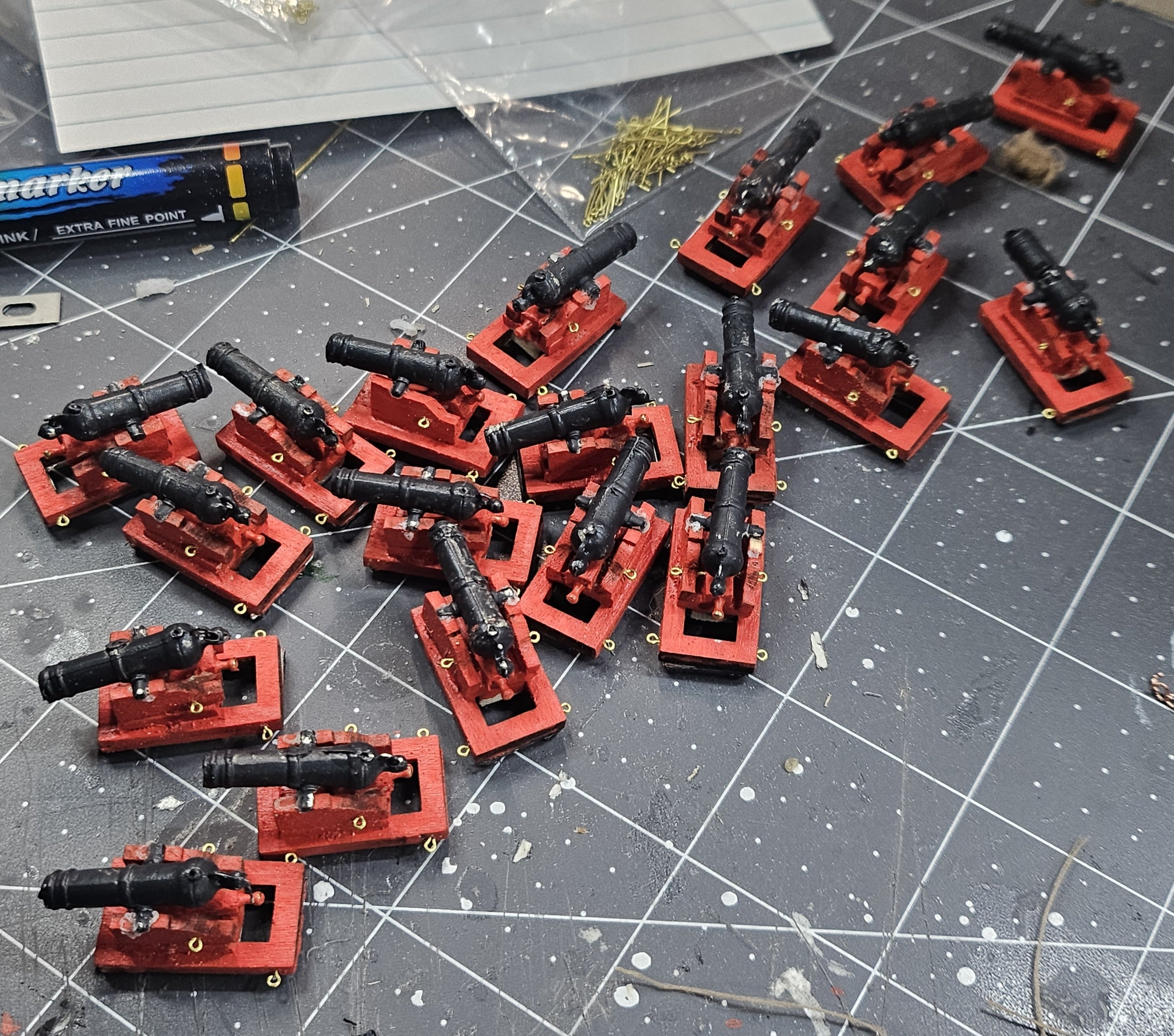

This is just a quick update that is being broken up in chunks because it involves manufacturing several wooden parts that are time consuming which is really an understatement, lol. I would have thought that the ship's wheel and capstan and initial deck work would have been the most challenging but turns out that those turned out pretty well. But I spoke too soon and then found out the hard way that the carronades and rigging, more so the rigging to me is more of a nightmare than I expected, not that it is hard to do, but because of the tiny scale you have to work with along with inadequate size/type of tan thread given in the kit, so I've had to improvise building the 80 to 160 blocks with hooks and seized rope. So, here is what I've had to deal with and I'm almost sure I'm not the only one to have any of the similar issues to solve.
So, I built the carronades and put them in the "Cannon Coral." Altogether you have 20 carronades each one is made up of 15 parts. this took several days to make because of the need to paint them and work with parts that require the assistance of fleas to help, 20250831_063240.thumb.jpg.d27604466ea11a09569d154a87f7679c.jpg20250831_063218.thumb.jpg.54fcf030cf9b3445ad38bdf3cf197c43.jpg20250831_063208.thumb.jpg.b313bdcd71658b32f2517e29afa033cf.jpg20250831_063143.thumb.jpg.9cac803238a1e6af137da3d818b145b6.jpg20250831_064250.thumb.jpg.39922c499e8a230d0d9083edad93ac4f.jpg20250831_064531.thumb.jpg.80cab11ce90b69de707bf4ca1ce677e3.jpg20250912_062432.thumb.jpg.d150fcdb52835e9a52ba07fd8057f498.jpgThese blocks are the smallest in the kit and the most painful to deal with. I put four of these at 3/32 inside of a 1-inch square on my mat. Yes, these are very tiny and required a hook and thread be added. The 1/8 double block is easier to work with and small but only required the hook.

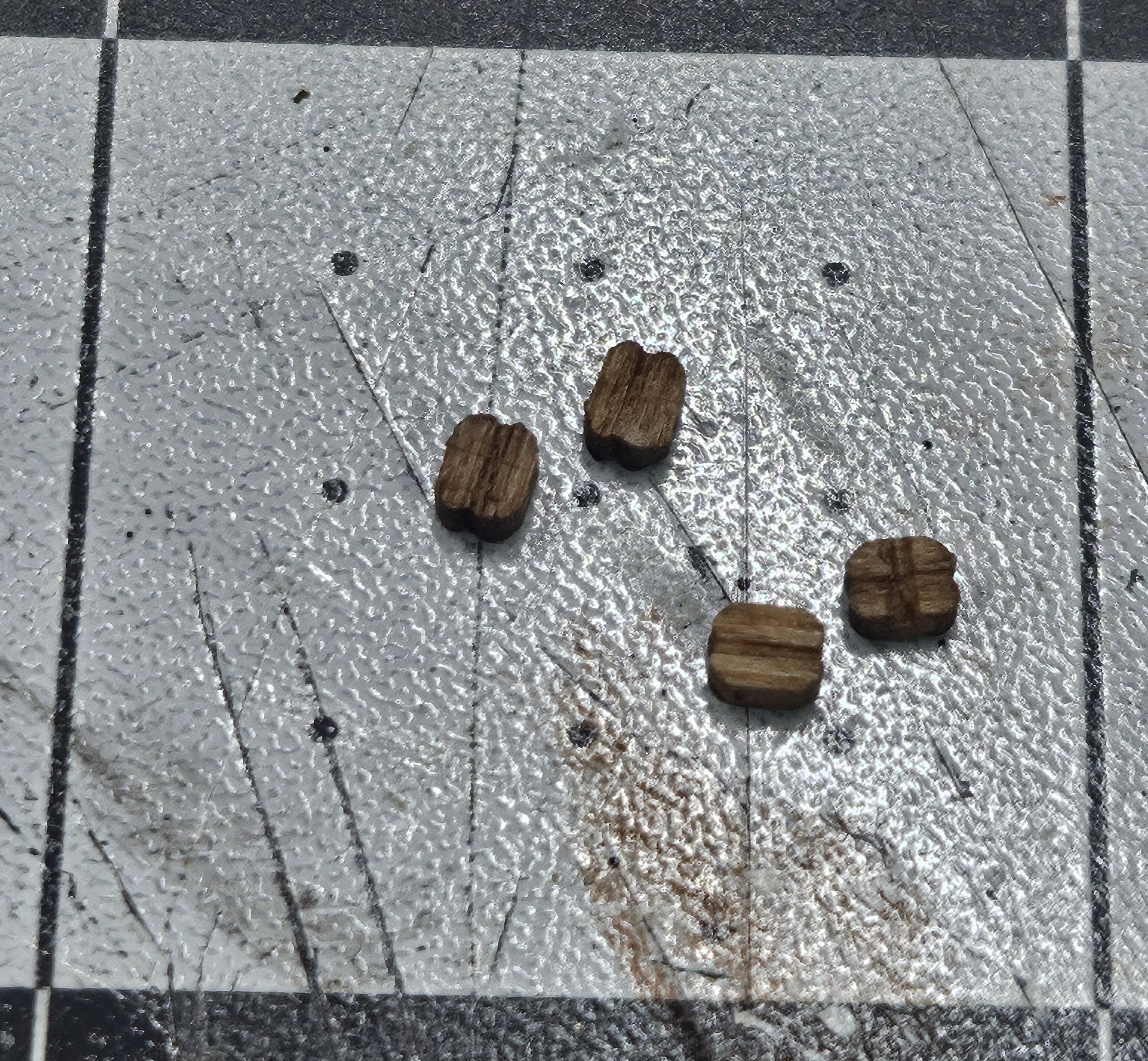

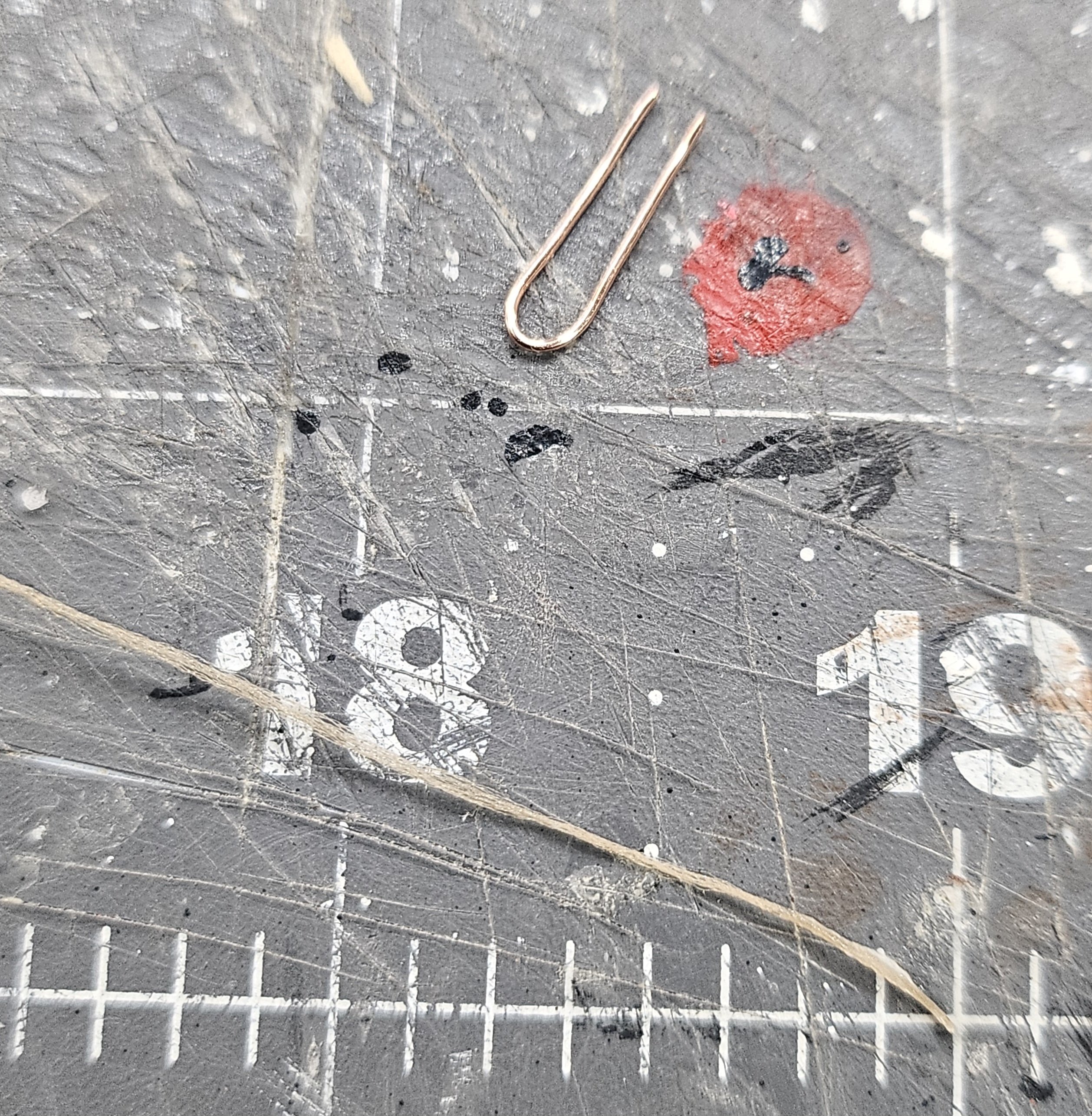

In the practicum, Bob mentioned that he originally started with hooks and blocks he ordered from a hobby shop and then realized there wasn't enough to cover half of the carronades, so he switched over to the materials provided in the kit. This required building a hook by wrapping what I think is 36-gauge silver wire around the side with the groove and bending the end for the hook. He does not use the thread in the kit because it was inadequate in size and not made out of nylon. He uses his own line or thread from other ships he has built, so of course when seizing a line, it's not bad because the thread will fall into place and not curl up backwards on you. Yes, he recommends buying a specific wire and thread, but I improvised here because I have wire close enough to the gauge used and ended up using the thread in the kit that was not fun to work with because it truly is inadequate and frays very easily. It was difficult to control and nearly impossible to seize it properly without it fraying, trying to keep the lines in place held together by hand of a clip of some kind.

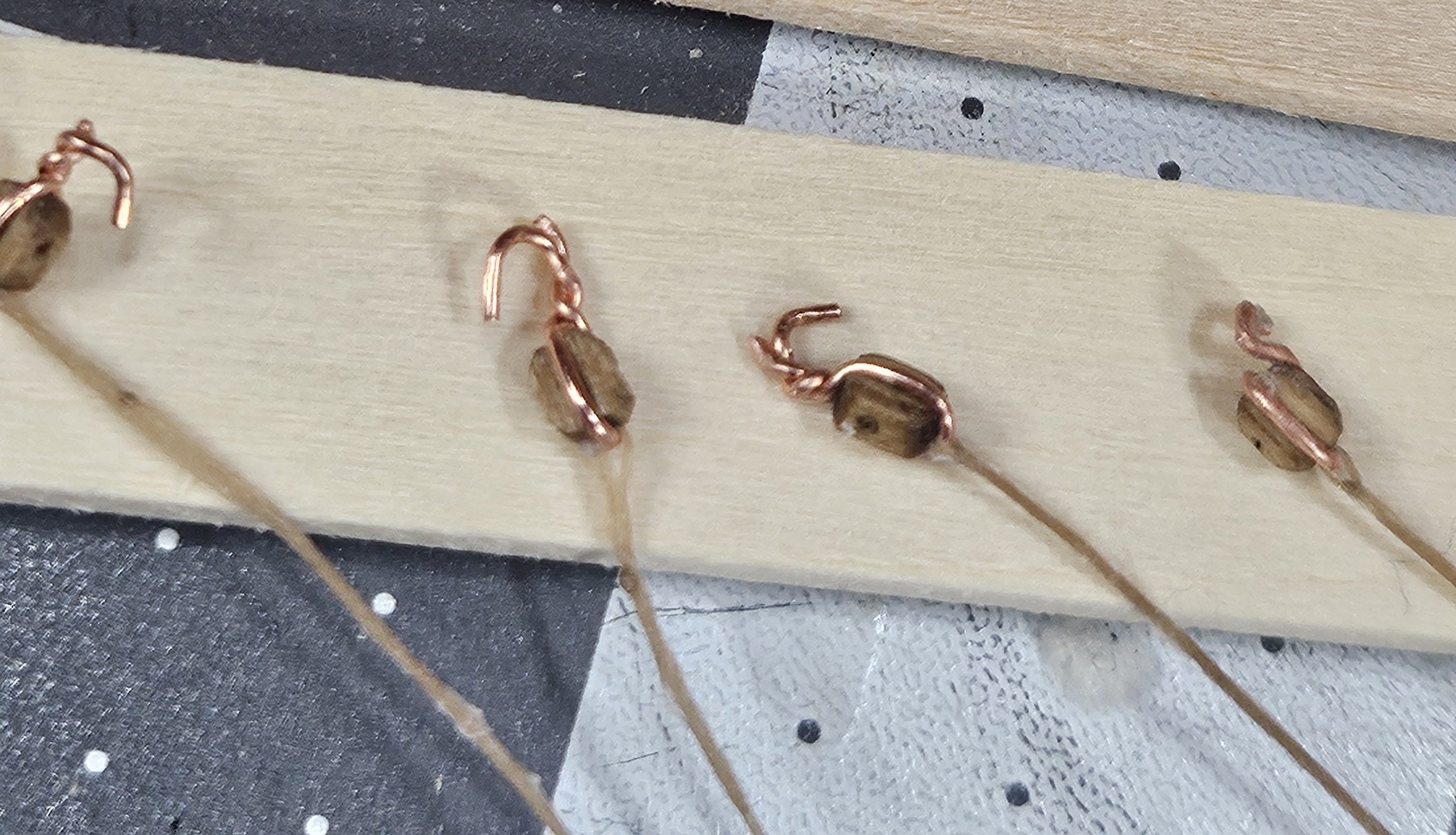

The copper wire I had used before in the kit is what I used for the hooks and of course it can be painted black just like the silver ones. I had disintegrated several of the tiny, microscopic single block trying to get the copper wire and the thread onto it. Doing this 80 times is probably like solitary confinement in prison. So, to improvise the seizing, I would rub CA glue on both ends of the thread to minimize fraying on the ends and most of them were about 4 inches long to give enough slack to wrap around the double block to attach to the ship and the carronades for the rigging.
I did this by cutting the copper wire into 1-inch pieces and then folding them in half creating a small semi-loop so I could get the tiny block inside with the groove on top and bottom to capture the copper wire. I would take one end of the thread and tie it around the copper wire with one knot to hold it in place with about an inch of slack to later on simulate a seized line. Whether you seize it or do it the way I did it, you can barely notice any difference because the seizing is primarily on the inside of the line. Once I tied on the thread, I would get my tweezers and move the tiny block right in between the copper loop and thread and squeeze hard to hold everything together and use the needle nose pliers to twist the wire on a couple turns, then trim and curl the tip which was roughly 1/16. I later started using forceps clamps like scissors then to hold everything because my fingertips started killing me because of the death grip I had to put onto the block, the thread, and the wire which turned out to make things a bit easier.one I trimmed the hook, I would spin the end with the hook and the thread several time and spread out about an inch and then use the CA glue and run it up and down that one inch piece and it would not only stay together, but also was flexible to do work like a real rope. The double thread twisted together gives the same appearance as though the thread was seized. Had we been given the correct thread in the kit, sure I would have seized it, but why waste time and money doing the same thing a different way...? It took me about a week to make the first 40 and I still have 40 more to go, plus 80 hooks on the double block, not to mention at least 40 eyebolts, 40 double holed fitting you have to cut from polystyrene, and another 20 polystyrene fitting, and all of this has to be attached to the ship before rigging all of the lines to the carronades. I can only imagine when I get to the actual masting and rigging of the ship, that that will be more traumatizing...this is just a taste, lol.
