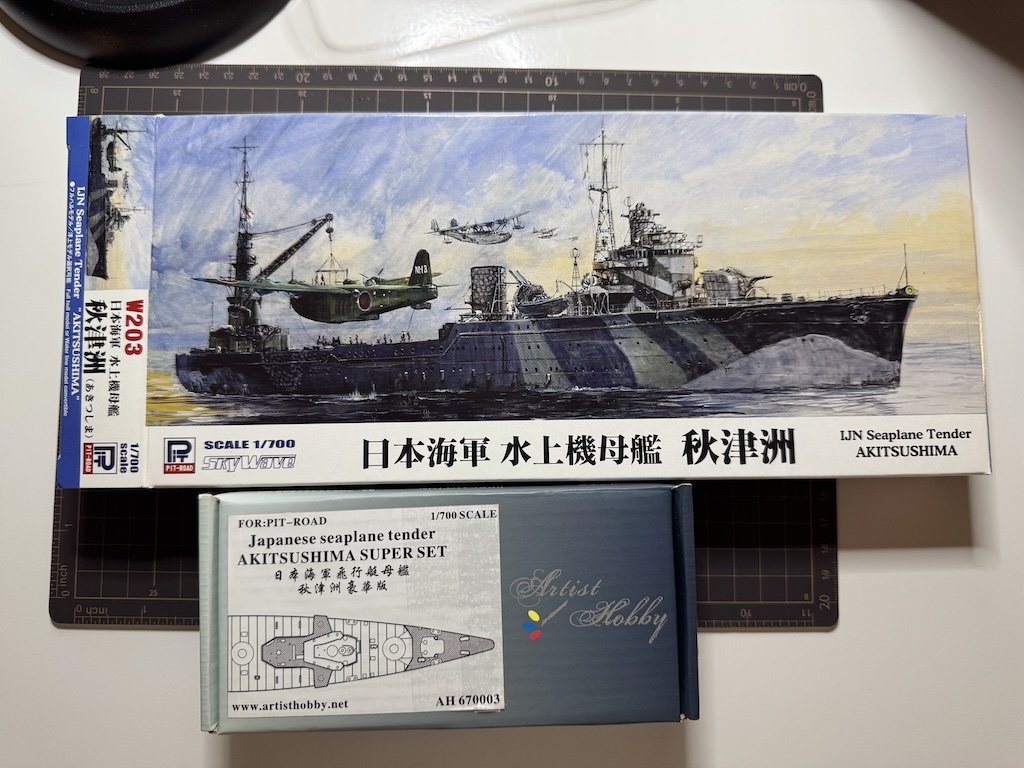

I'm building the ship using the Pit Road kit, along with the Artist Hobby super set.  The kit is very nice, but the Artist Hobby set really will take this kit to the next level:
The Artist Hobby set not only gives you five PE frets, but also resin binoculars and bollards, brass barrels for two of the guns, and resin parts for the Type 89 127mm AA gun.  In addition, it gives you a set of masks, one pair of which provides a template for you to drill the port holes:

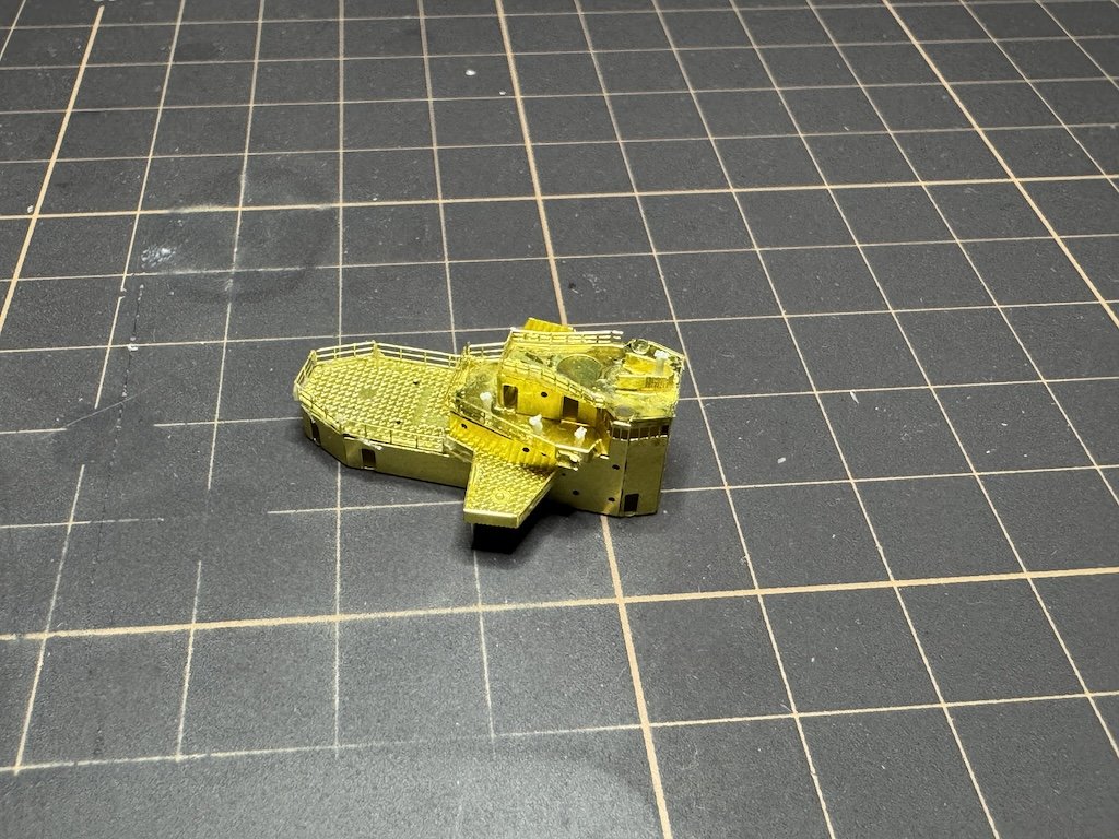

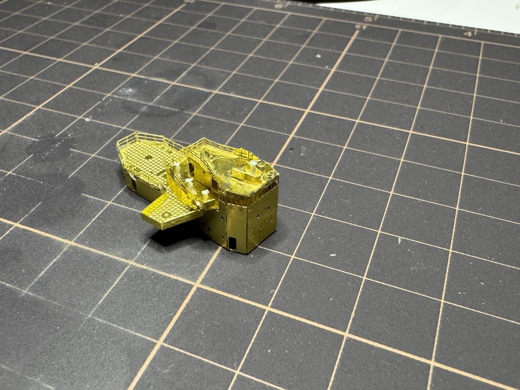

While at the hotel, I actually managed to get quite a bit done.  I built up the bridge which is composed of four primary platforms, where three of the platforms are inserted into the main platform.  This will replace the kit bridge:

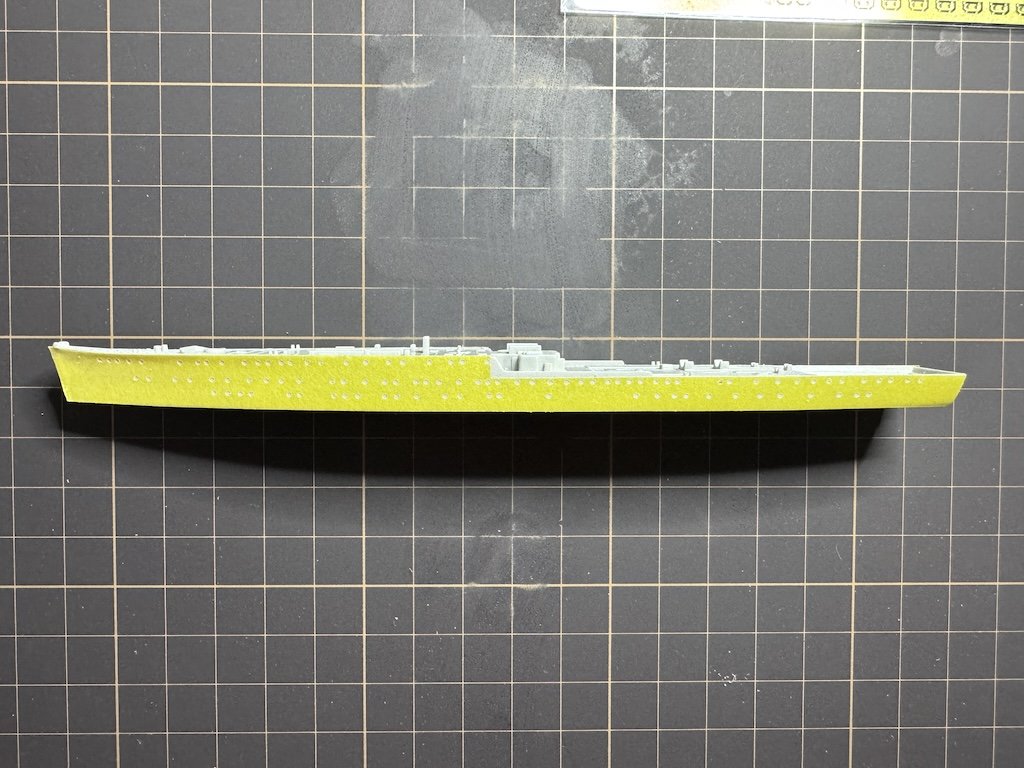

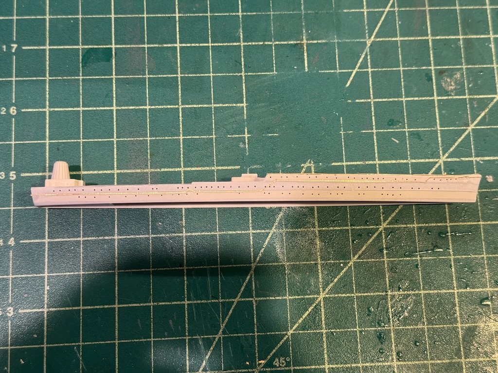

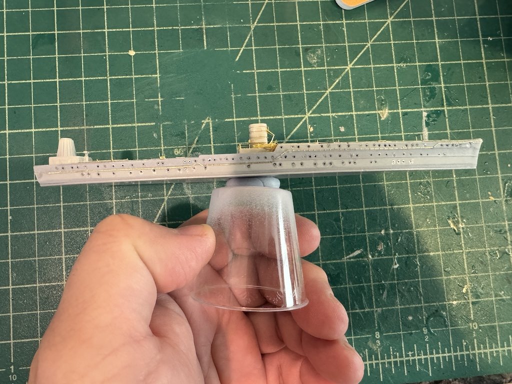

I also had time to work on the hull.  I removed most of the deck details as they are replaced by PE from the Artist Hobby set.  I also started working on the port holes.  The kit is missing a lot of the port holes, and some were deep while others were very faint.  So, I filled and sanded the sides of the hull and attached the two mask templates.  I drilled most of the port holes on one side using a 0.5mm bit, but dropped it on the table and it broke.  Of course, I only had one so I turned towards other parts of the build.

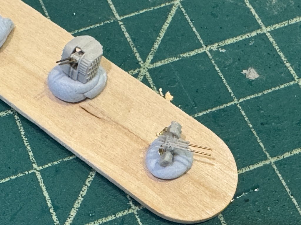

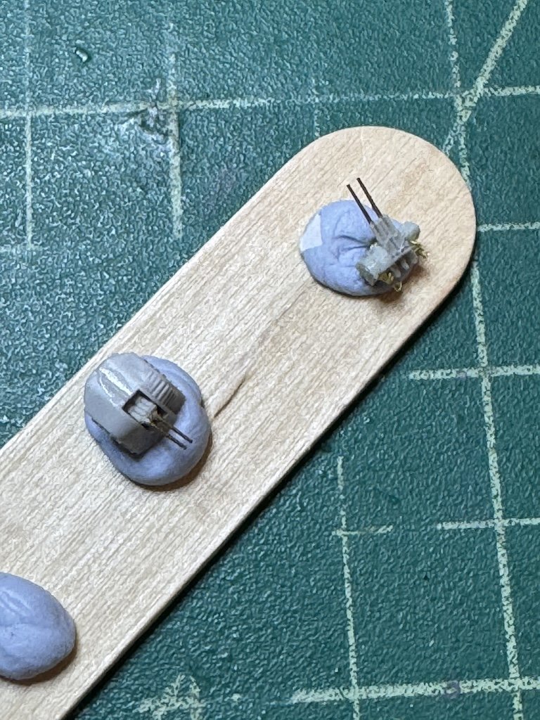

Built the two different types of 12.7cm twin AA guns.  The Artist Hobby set gives you the parts and barrels for the right one, and gives you the barrels to add to the kit part for the left one.  There's a 25mm twin gun to add as well, but I probably will use an aftermarket gun rather than build it out of PE to avoid the hassle and have more of a 3D look for the barrels.

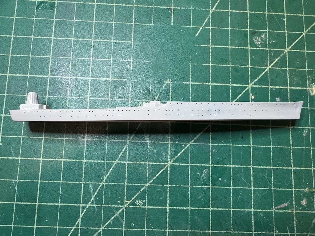

Made some good progress on the Akitsushima past few days.  Using the Artist Hobby supplied template mask, I drilled the port holes out with a 0.5mm drill.  Having the micromotor really helped to not only drill them quickly, but also fairly cleanly:

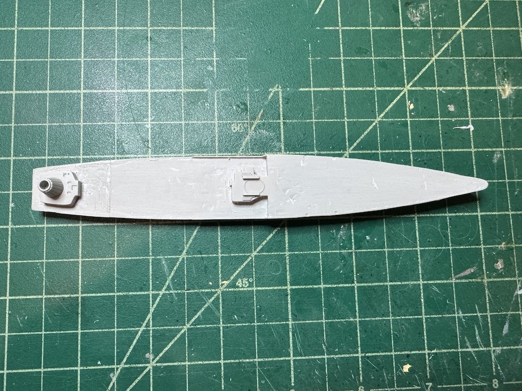

Removed all deck details which will be replaced by the Artist Hobby set:

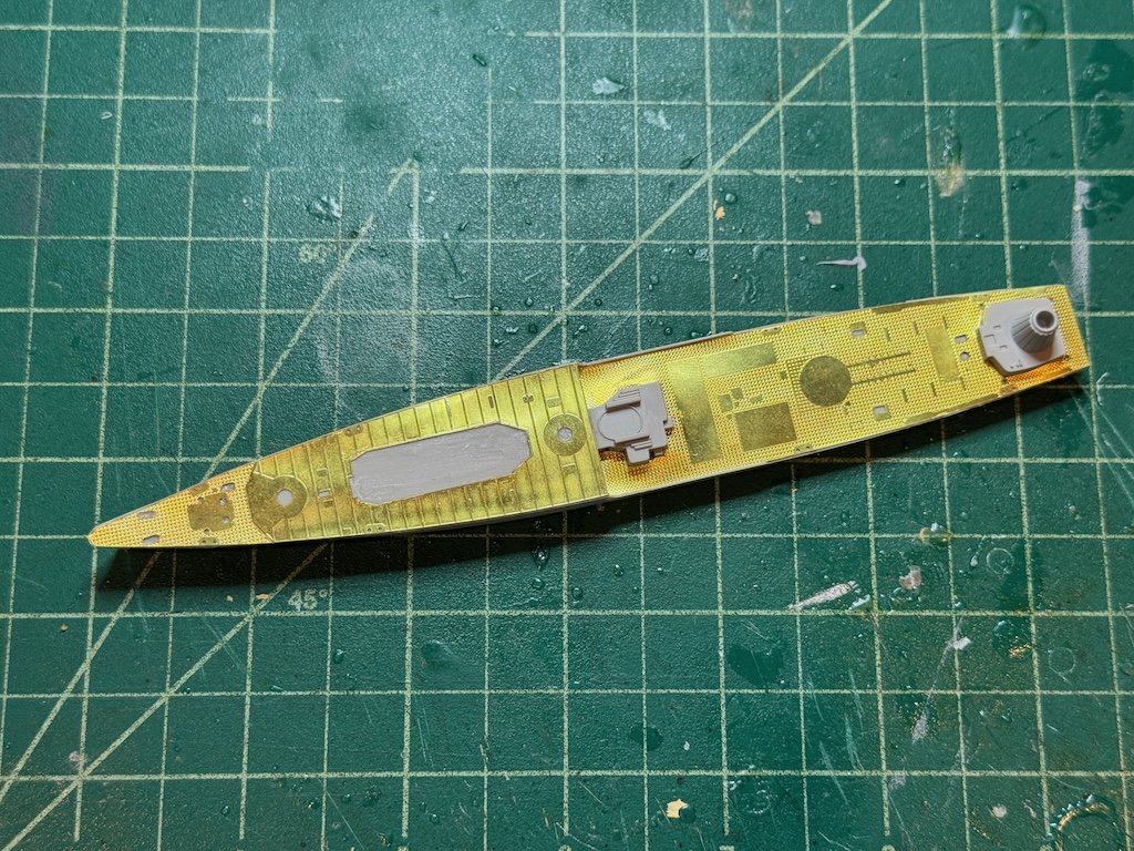

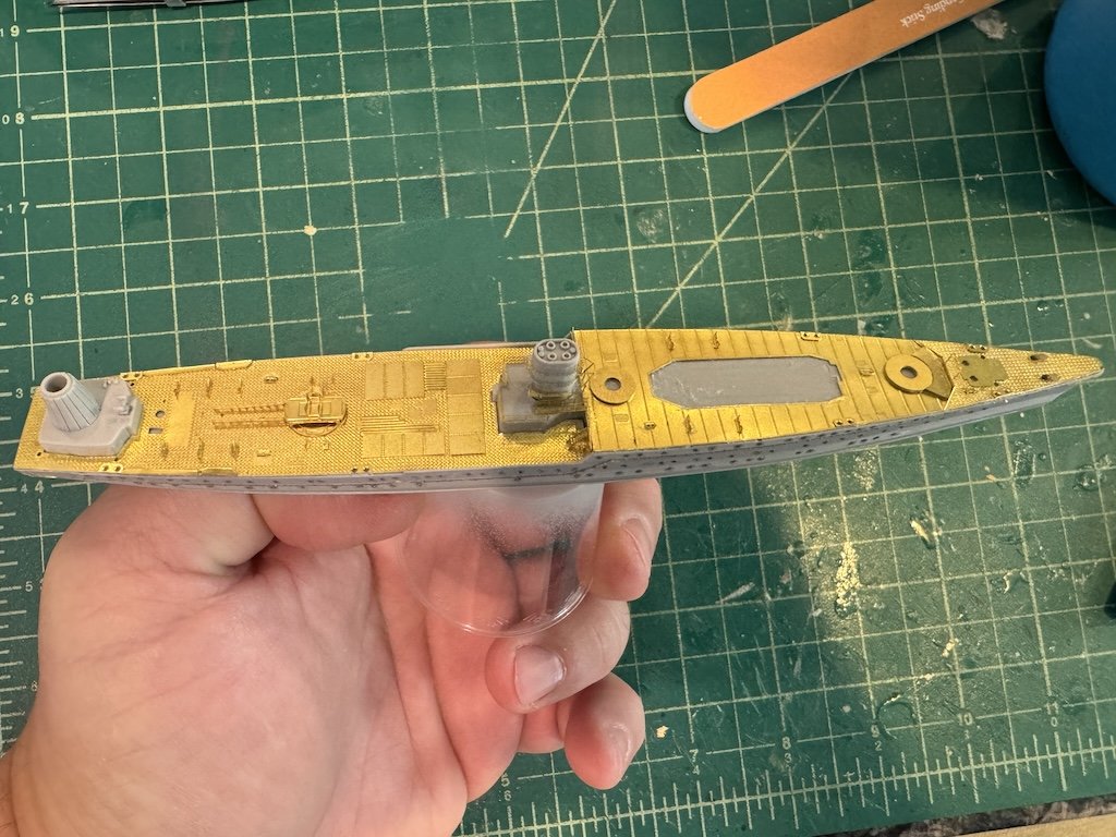

Added the Artist Hobby PE decks.  The fit was perfect on these pieces, really well done by Artist Hobby.

To simulate the hull plating lines, I taped alternating rows using Tamiya flexible tape and then sprayed a fairly medium-heavy coat of Mr. Surfacer 500.  Once you remove the tape, you have nice simulated plating lines.

I didn't add the bottom half yet to the hull in part because I'm still deciding what to do (at 1/700, a full hull isn't very deep) and because having the open bottom allowed me to drill holes from underneath to help get glue between the PE deck and the plastic hull.  There were a couple of places the PE deck were not sitting flush, so a hole or two drilled underneath allowed me to get more glue in that spot and with a little pressure, got the deck to fit flush.
Why the young Lad is smarter than I have been giving him credit for.....good idea.:D

Cannons built up:

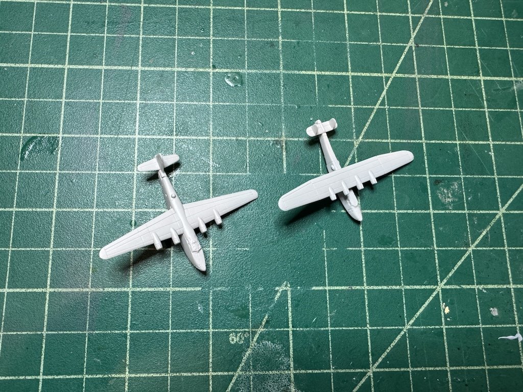

The kit comes with two seaplanes - a Kawanishi H6K Type 97 (Mavis) and a Kawanishi H8K Type 2 (Emily).  I plan on putting one on the deck and one in the water.  Need to decide which goes where as I'll add spinning props to the one in the water to show a water landing.  There's not much room on the deck so I might include the smaller one on there.  I might actually try to model it hoisted on the crane rather than on the deck turntable.  Just need to figure out how to it was done and make sure whatever line holding it is of material that can support the weight.

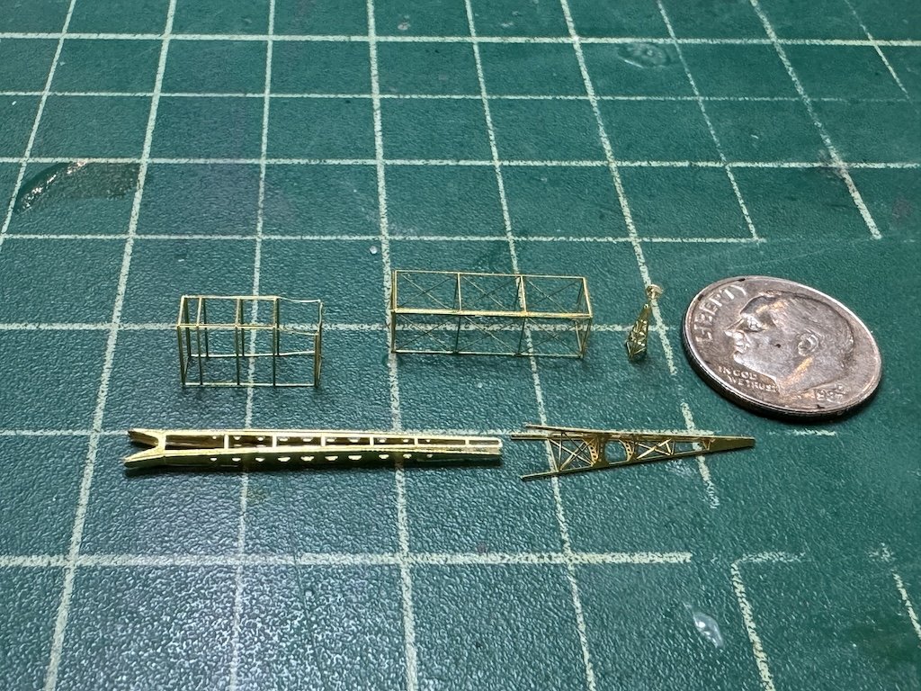

Here are some detail pieces.  I think at this point the main detail piece I need to complete is the rear crane tower.  I already have the crane section built up, but need to figure out how to do the tower which is a little complicated:
