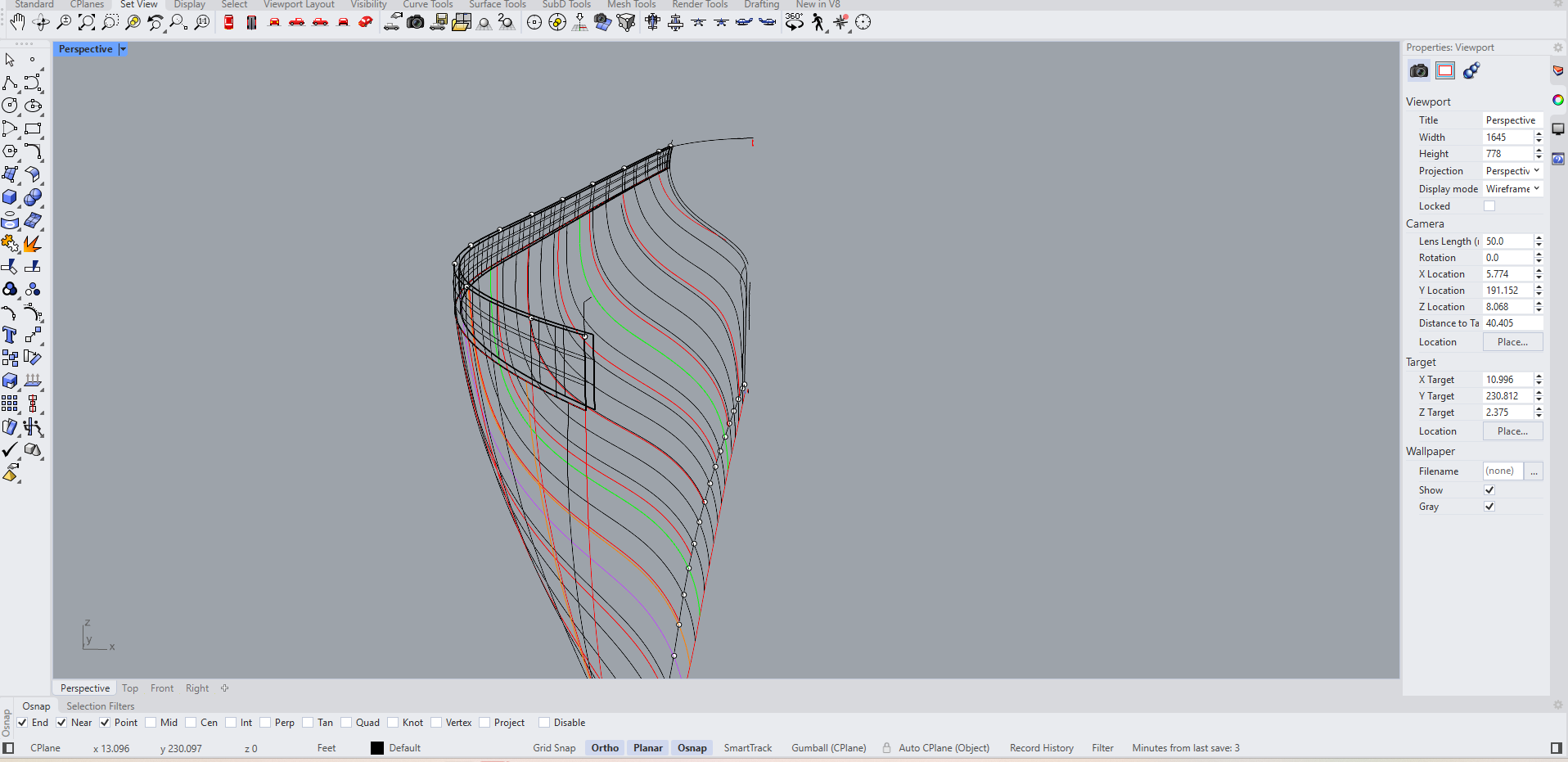

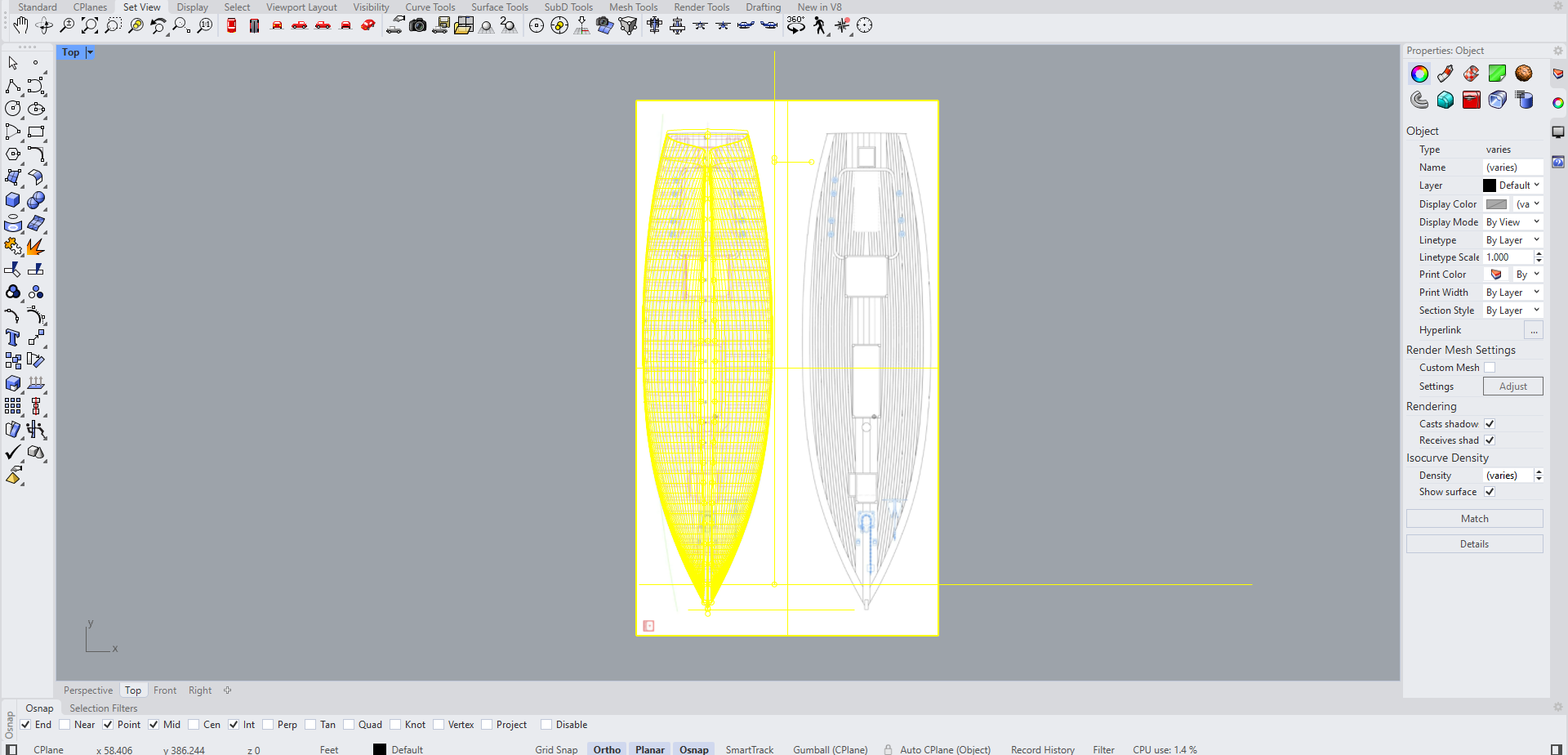

Ok, so lets do a quick follow up post with the first thoughts on this.

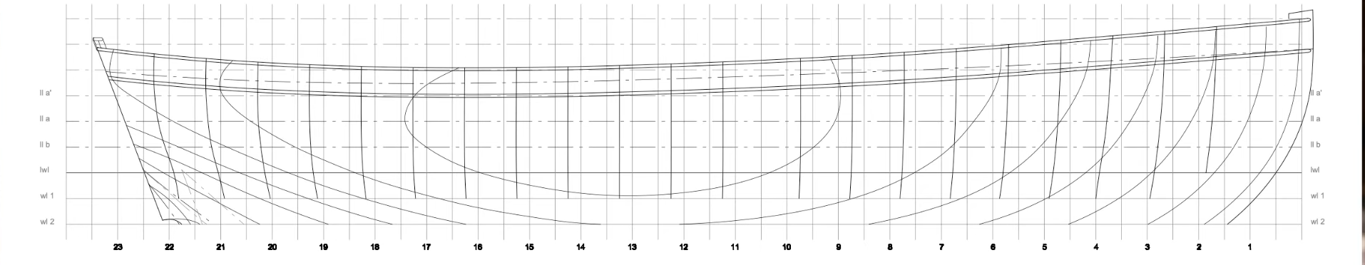

To start with, the plans do not seem to be as comprehensive. There are the lines and some drafts of the keel and a table of offsets but something feels not quite right. Then again, Leo managed to loft the boat so everything should be there.
I checked the plans and the lines are not really straight, or vertical. This is common however, paper distorts over time and CAD is really very unforgiving to plans drafted 115 years ago. These lines will be ok to start but serious lofting will be needed. Still, this seems a much easier boat to loft than Hercules
I imported the plans to Rhino and scaled them to the actual boat size. I need to dive more into these but it seems that the distances as measured from the lines plan are not the same as in the table of offsets.
I am not sure where the stem/start of sheer should be or where the Transom sits.
To make things worse, the plans I received do not seem to have been scanned very well. Most of the text in the table of offsets was missing but I managed to recreate it by watching Leo's videos - he had the same plans and they can be seen in a video, so I was able to read almost all of the missing text.
A part of the lines plan has not been scanned well and another small area at the bow is missing - apparently permanently damaged as it is missing from Leo's plans as well
However, the same lines are easily found on the internet, clearly copied before the damage occurs so I scaled this to size and used it to fill the gaps - kind off.

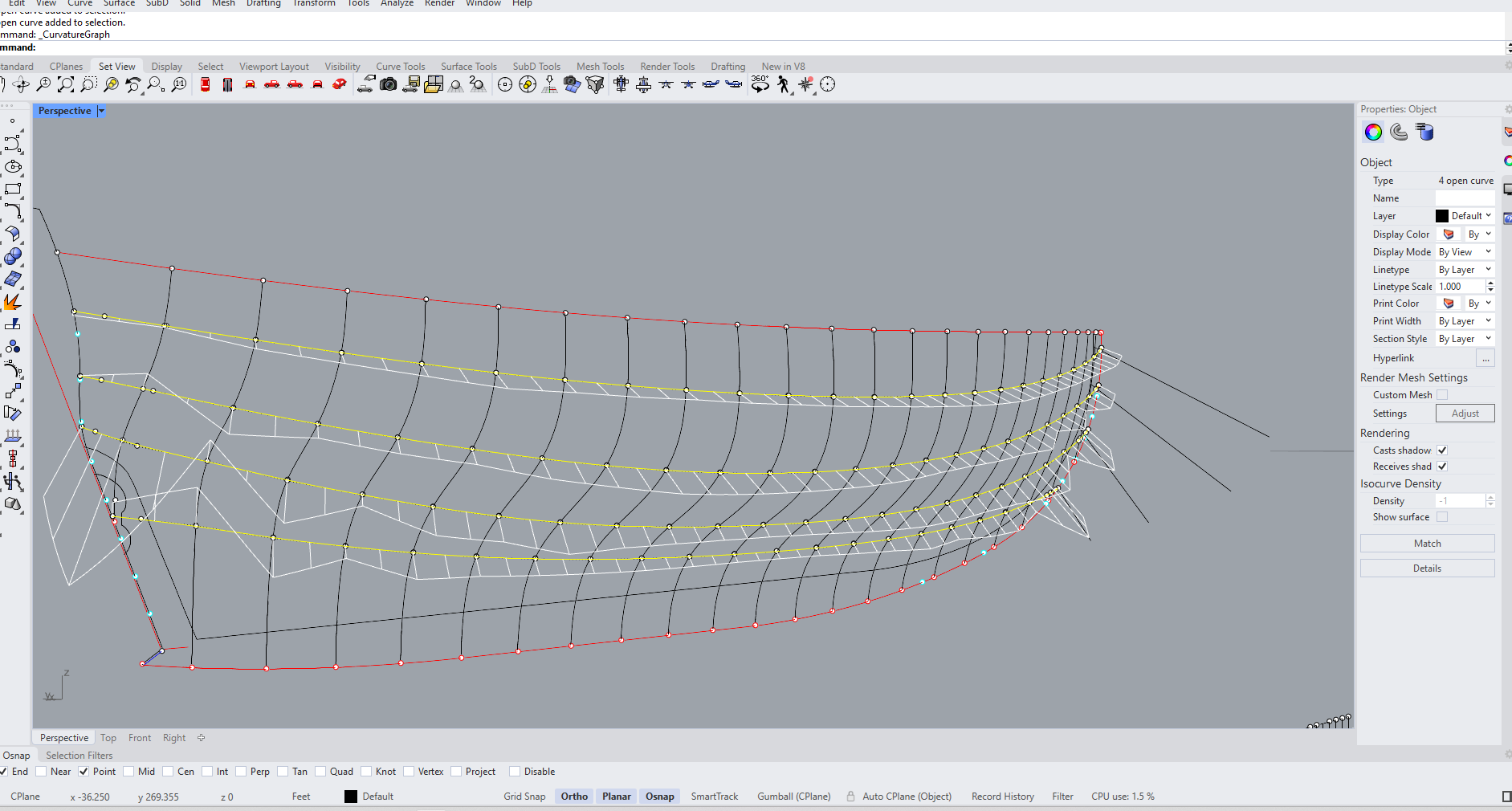

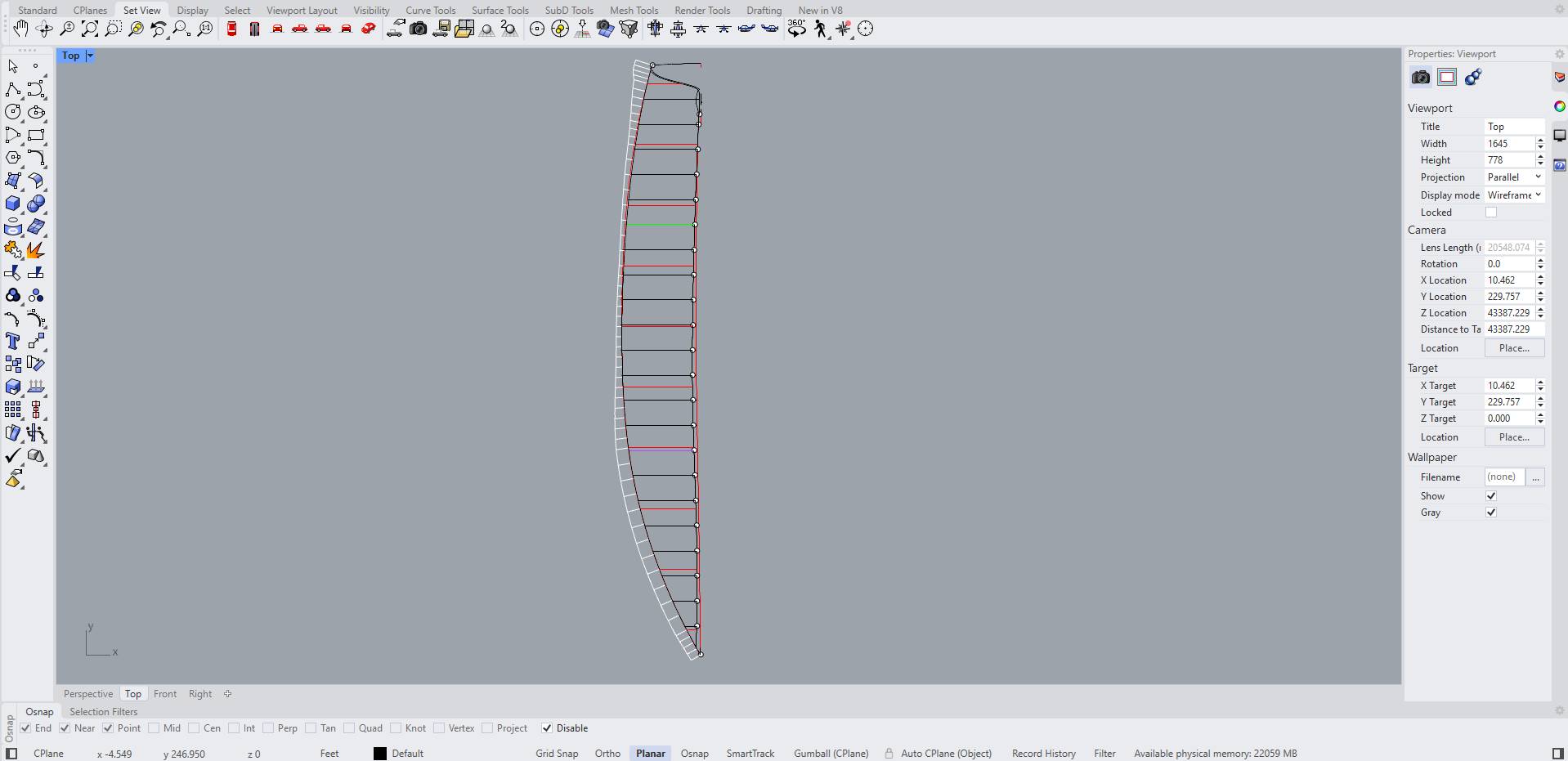

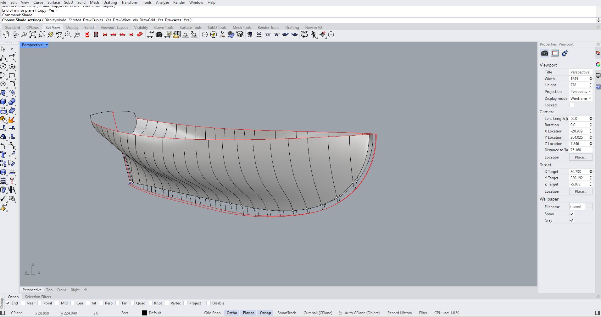

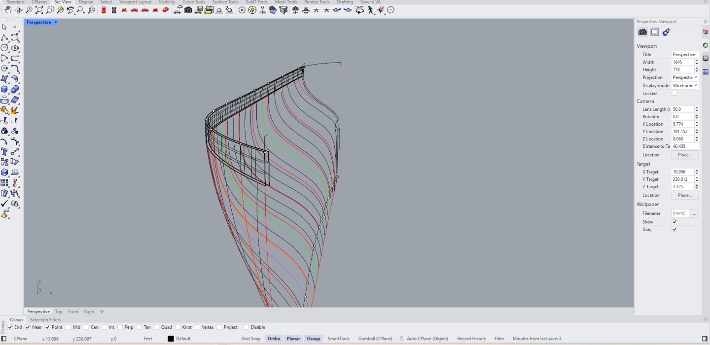

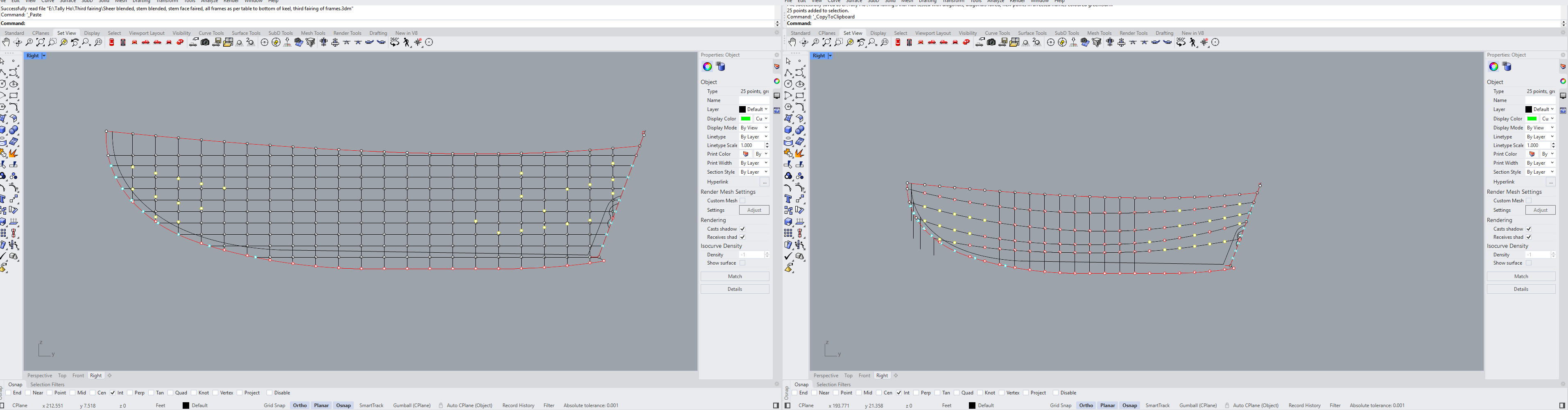

So I blended all together and came up with a sheer plan view
Then added the profile view and created the sheer from these
Adding the other half, shows a bit of the boat shape
Now this is just a study of the plans as I am not really sure where the sheer begins and ends, but it's a start.

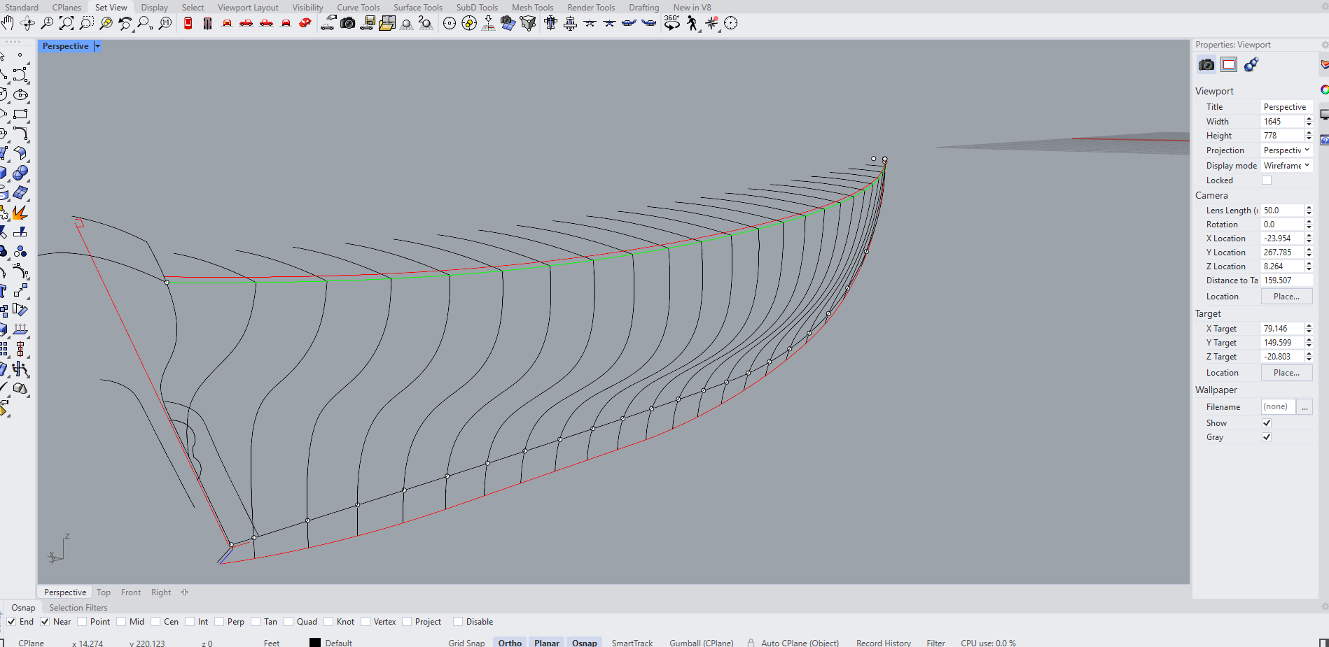

So lets discuss Tally Ho's plans.  There is no doubt that there are issues with the plans in the archives of the Albert Strange Association.
Tally Ho is a bit different to all the other boats I have lofted. The curvature of the hull does not stop at the rabet but continues at the stem, sternpost and all the way to the bottom of the keel.
I think I remember Leo in one of his videos mentioning that there were missing data from the plans, specifically the offsets for the stem and sternpost. This is indeed one of the issues I am facing. Furthermore, the paper has been distorted over the years, there seems to be a bit of damage but also, my copy of the plans has not been scanned very well so there are some gaps with the lines and the text. Also, CAD is very unforgiving and I am picking up all sorts of issues with the plans - Leo must have seen this but to a lesser degree, as he did not use CAD for his lofting.

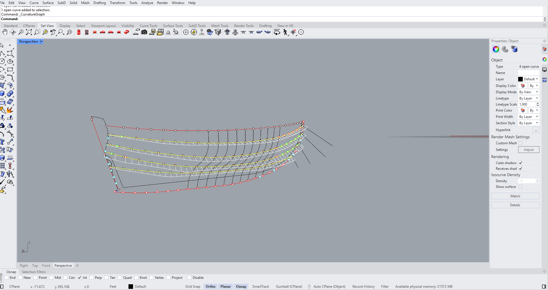

Ok, so lets get a bit more technical - This may be boring but may also help some people with their lofting (and lofting of Tally Ho in particular).
For me, the first step in lofting a boat is to find the edges of the hull surface. These are the sheer at the top, the rabet/bottom of keel at the bottom, the sternpost/transom aft and the stem with its rabet at the front. Most but not all of this info is in the table of offsets but again there are issues.
The table of offsets does not seem to correspond to the dimensions as measured using the plan lines. I initially created the sheer using the numbers from the table, however the position of the stem and transom, which define the start and finish of the sheer, must be taken from the lines - also the width of the stem. Combining all these does not really work. Using just the lines again does not work - the boat comes out short by half foot and generally things do not work well, the lines are not fair and there are issues with the keel.
So I decided to ignore the table of offsets - I only used the half breadths for the bottom of the keel.

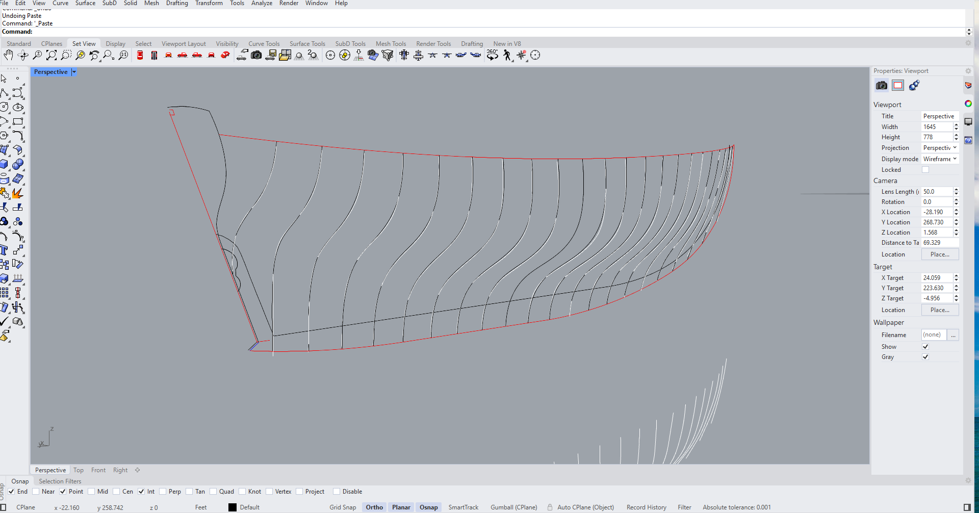

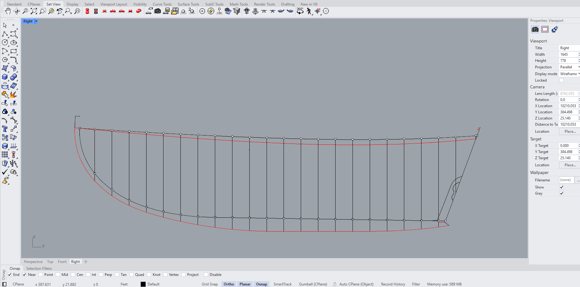

I traced all the frames (except frame 13 which is missing) and positioned them in their stations (2 feet apart) using the same reference point to make sure they were aligned. I added some diagonals of my own - Leo was right, this boat is much easier to loft using diagonals. I then added the sheer, keel, sternpost/Transom and stem. Again it did not work!

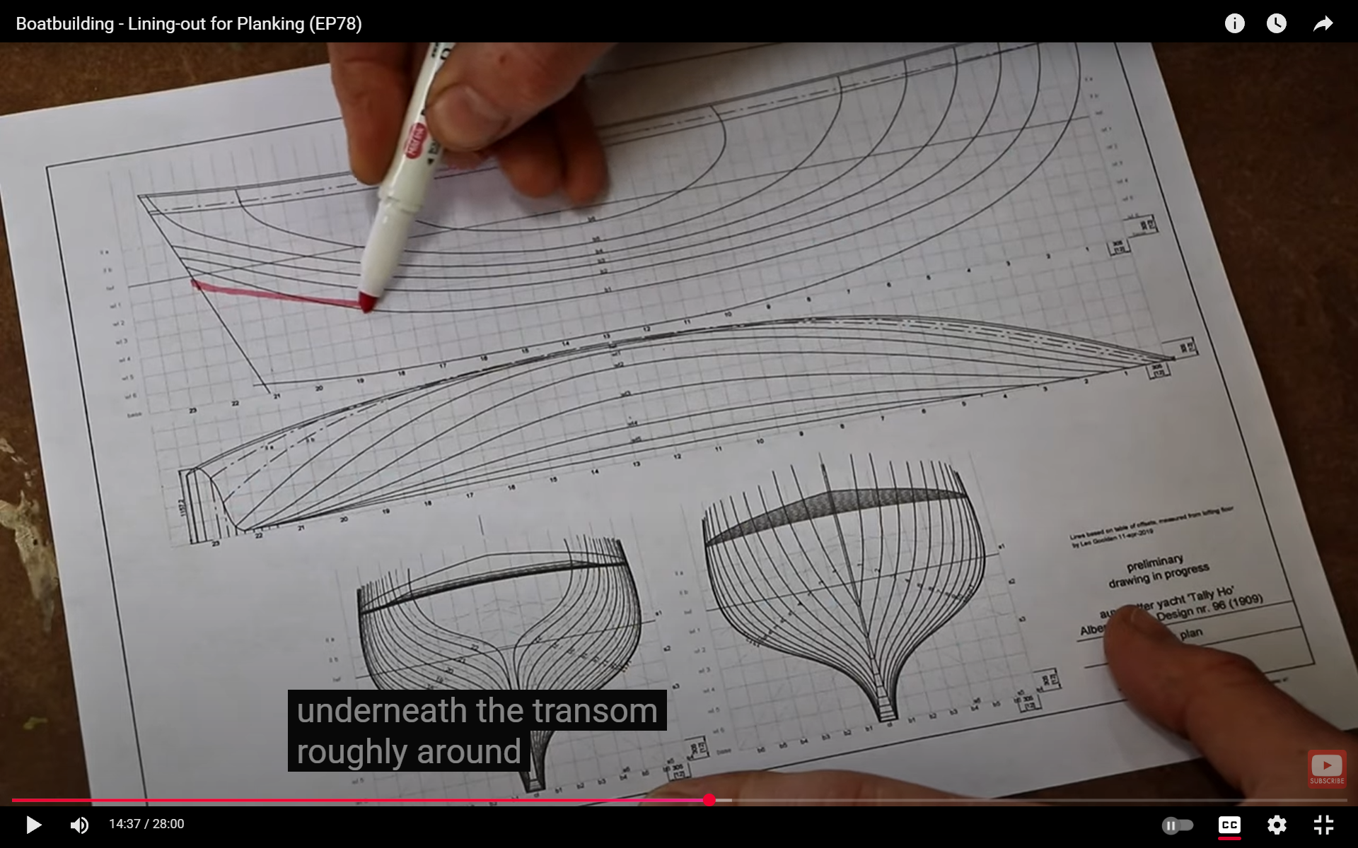

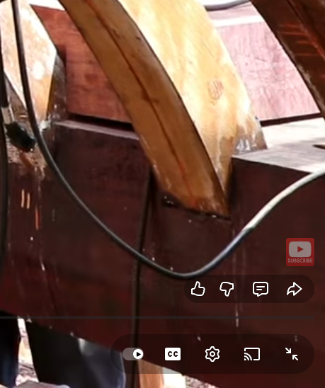

So I went back to watching the You Tube videos and the solution was there. You see, Leo had the same plans as I do but he also had the boat!
He mentions that the sternpost face is 4 inches wide - excellent. But he also showed this drawing:
This shows that the stem is 7 inches wide (although he chose 8 inches to give more support the the hood ends of the planks. The lines show the stem less thick at 6 inches. Mine was 10.6 inches so clearly wrong. The face of the stem is only 1.25 inches and the rabet 6.75" from the stem face.
This was very useful. I also measured the distances of the stem from station 6 at all waterlines, to get its shape
I used all these to draw a new stem with a new shape at a new position. I then created a new sheer from the top of the frames I had traced. Combining all worked beautifully!
The boat is now 47.5' long and the stem just over 7" wide!
The drawing bellow is the same as Leos. The yellow line is the contact surface of the planks with the stem. The arrow shows the half thickness of the stem. The blue line is the sheer.

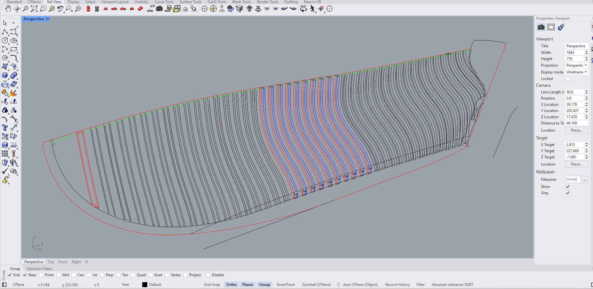

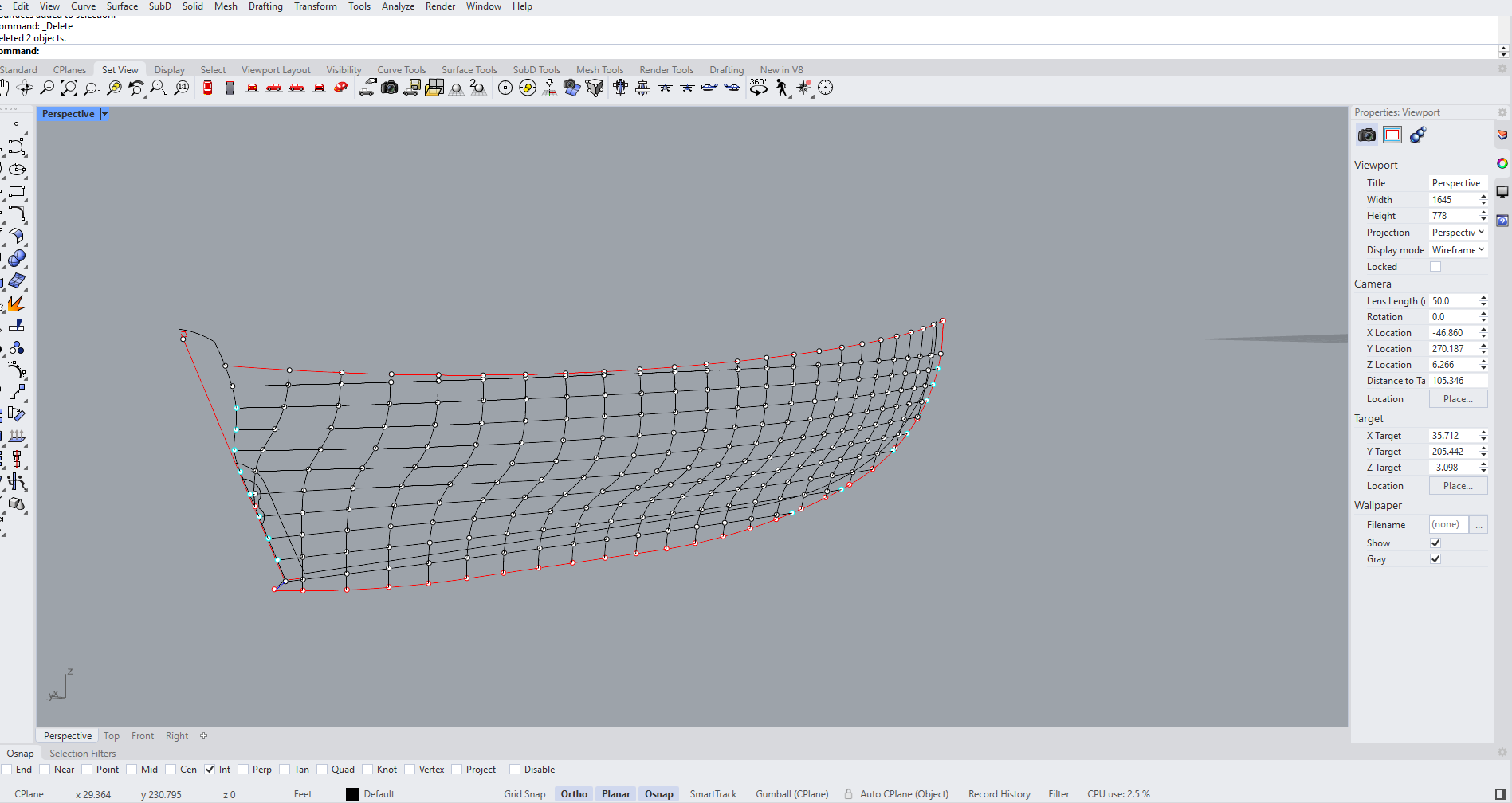

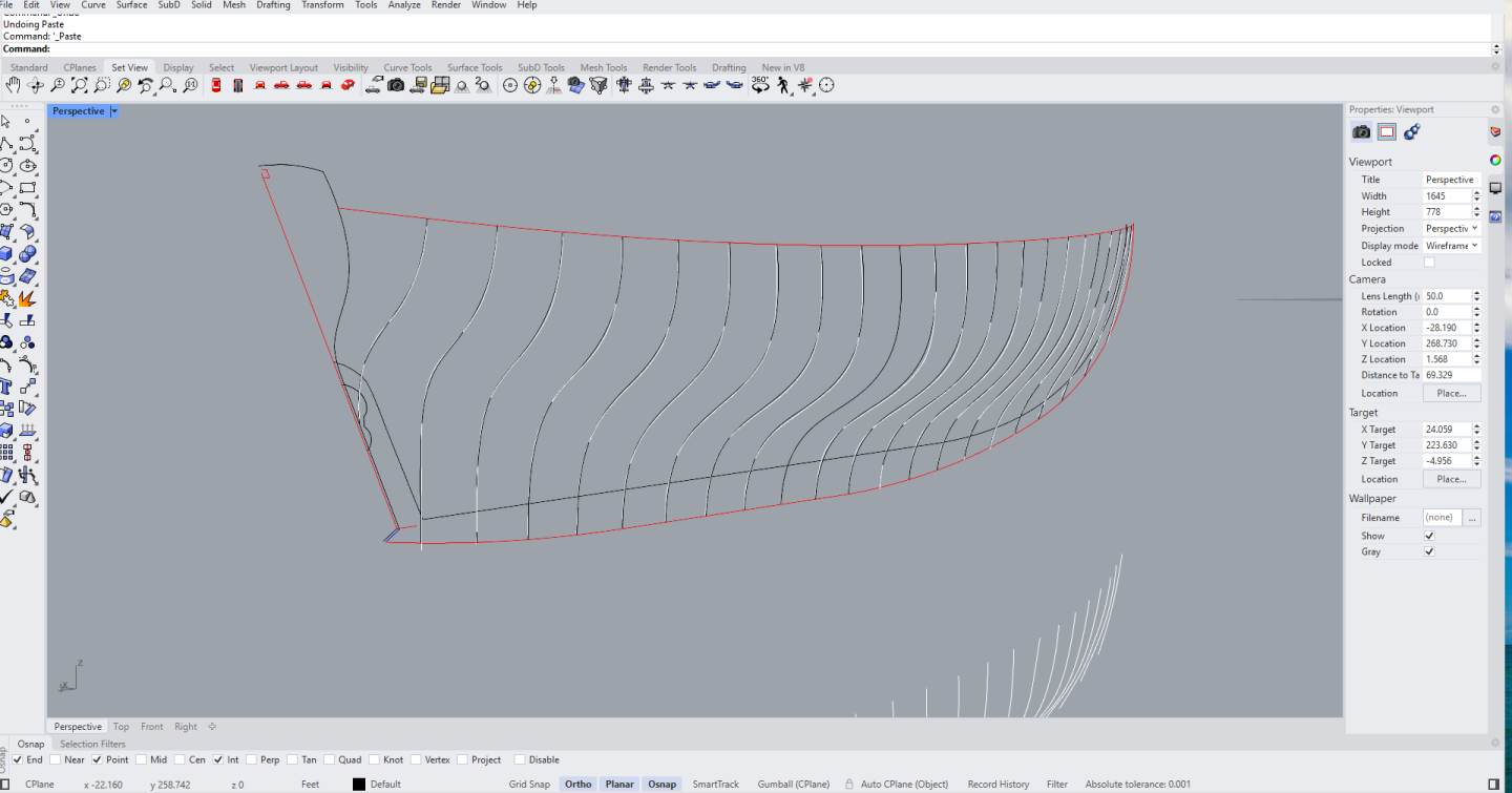

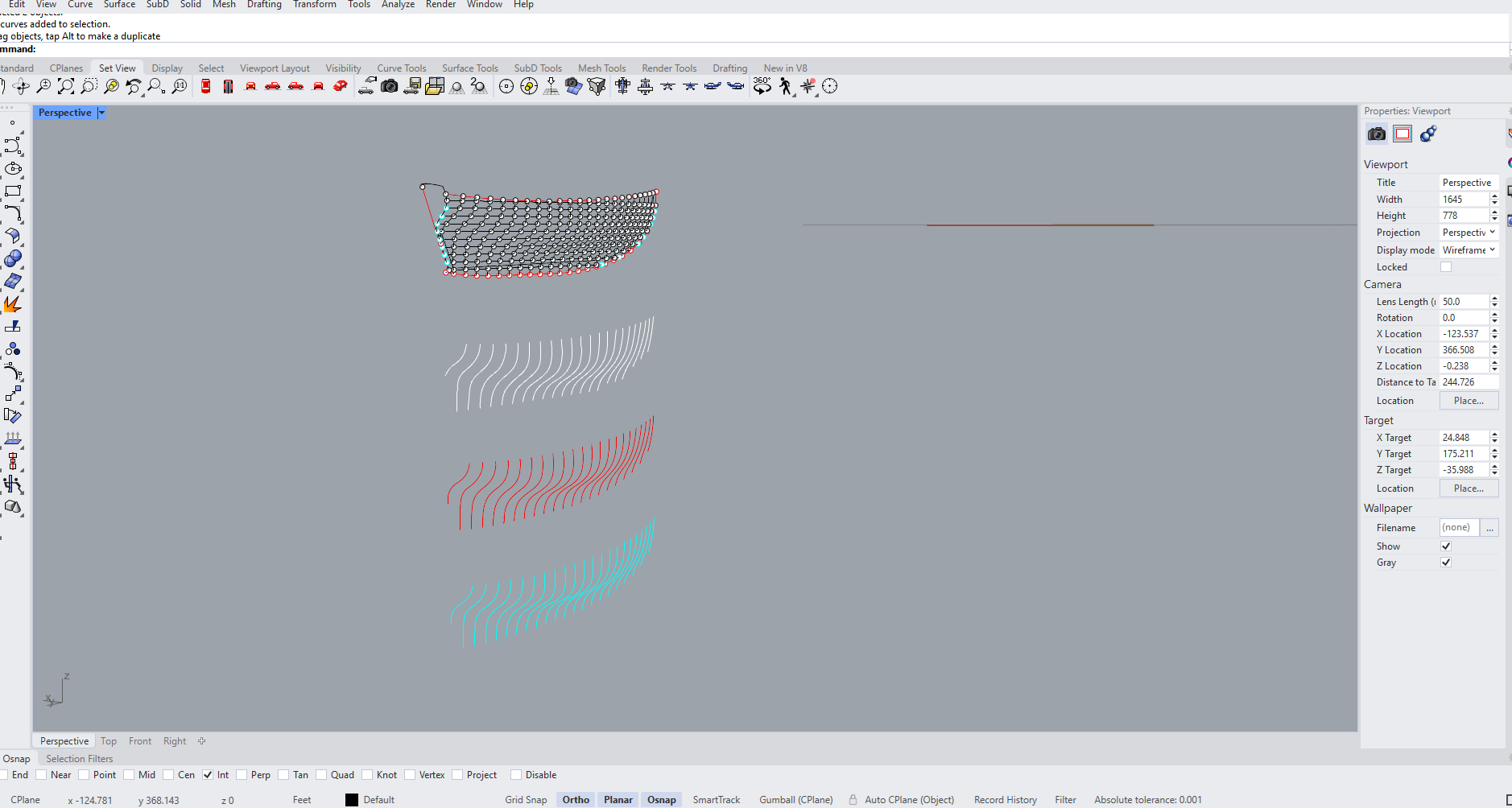

So now with all boundaries defined, it was time to start lofting. Some work was done to get the half breadths at the bottom of the keel correct.
I traced all the diagonals, waterlines and buttocks. They were of course all over the place:
Fairing this line produces a much more satisfying curve.

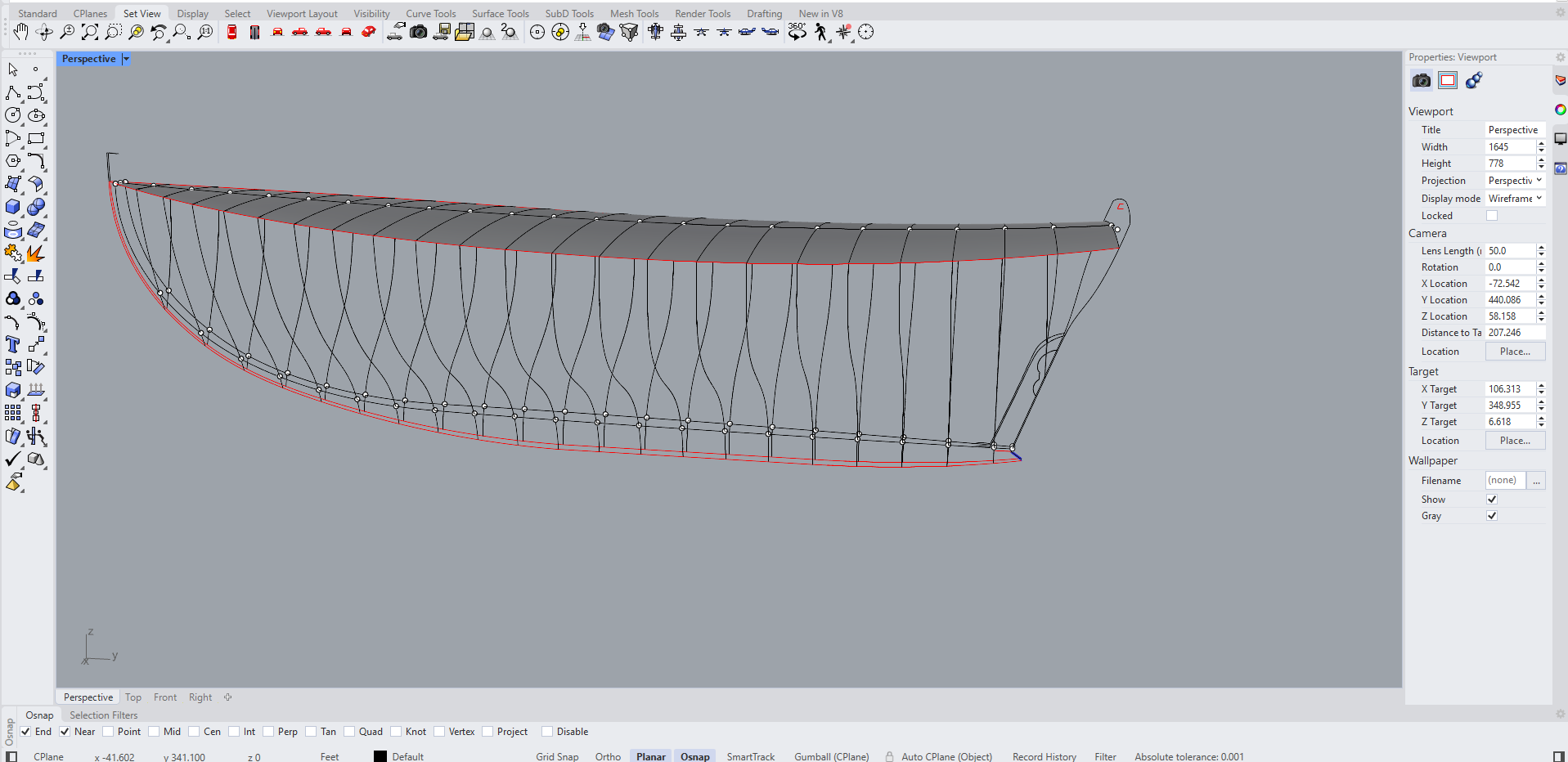

After all the lines had been drawn and faired, new frames were produced - using only the diagonals.
All new frames drawn and faired. I noticed that there was very little deviation from the original contact points with the diagonals. The last frame aft is a different colour because it did not really cooperate. This needs more work.

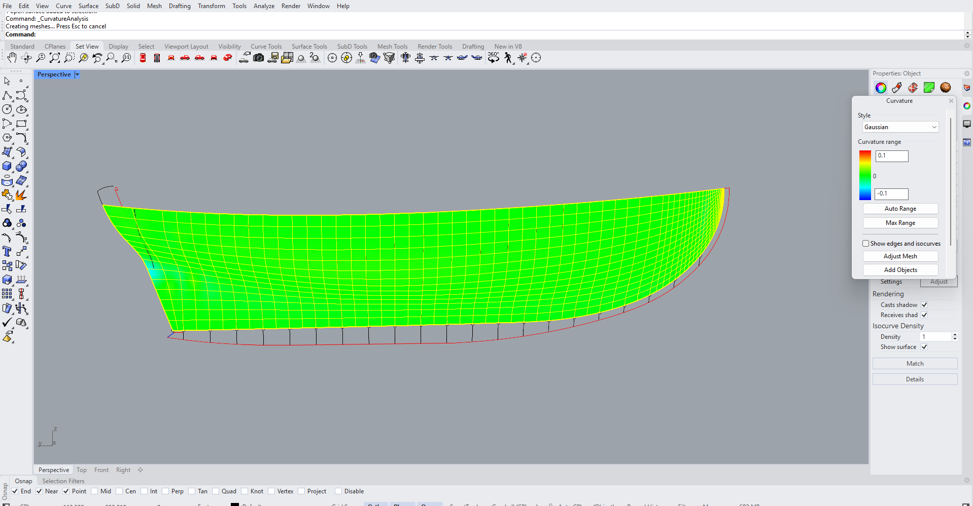

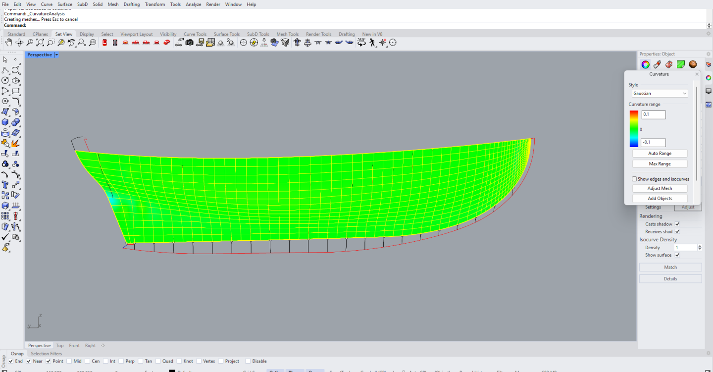

This is just the first cycle of lofting but I tried to make a surface and I was half surprised how well it worked. I knew the lines where not that far off but I did not expect this:
The hull is already reasonable and the areas where usually I have issues, at the bow and stern, look mostly ok.
The boat needs at least one more lofting cycle but it looks promising.
Take care all

Dear all
I was too fast congratulating myself! Not only I have no progress to show in this short update but actually I ve gone backwards. Still, my understanding of this hull has grown.

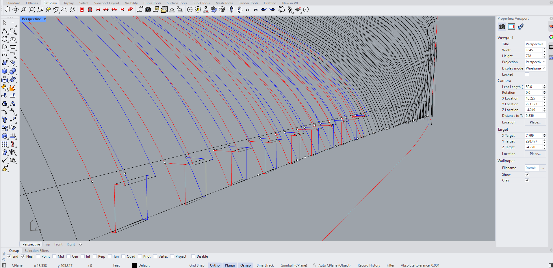

Now, this is going again to be a bit technical which means quite boring!
When I went to do the second round of fairing, I noticed that the frame No2 had acquired an S shape. I am sensitive to No 2 frames - consistently in my boats they creates issues. Looking deeper, I did not like it. So I scrapped everything and started again, this time using the table of offsets. But I again run into problems as things did not add up.
These are the issues I have encountered so far with these plans:

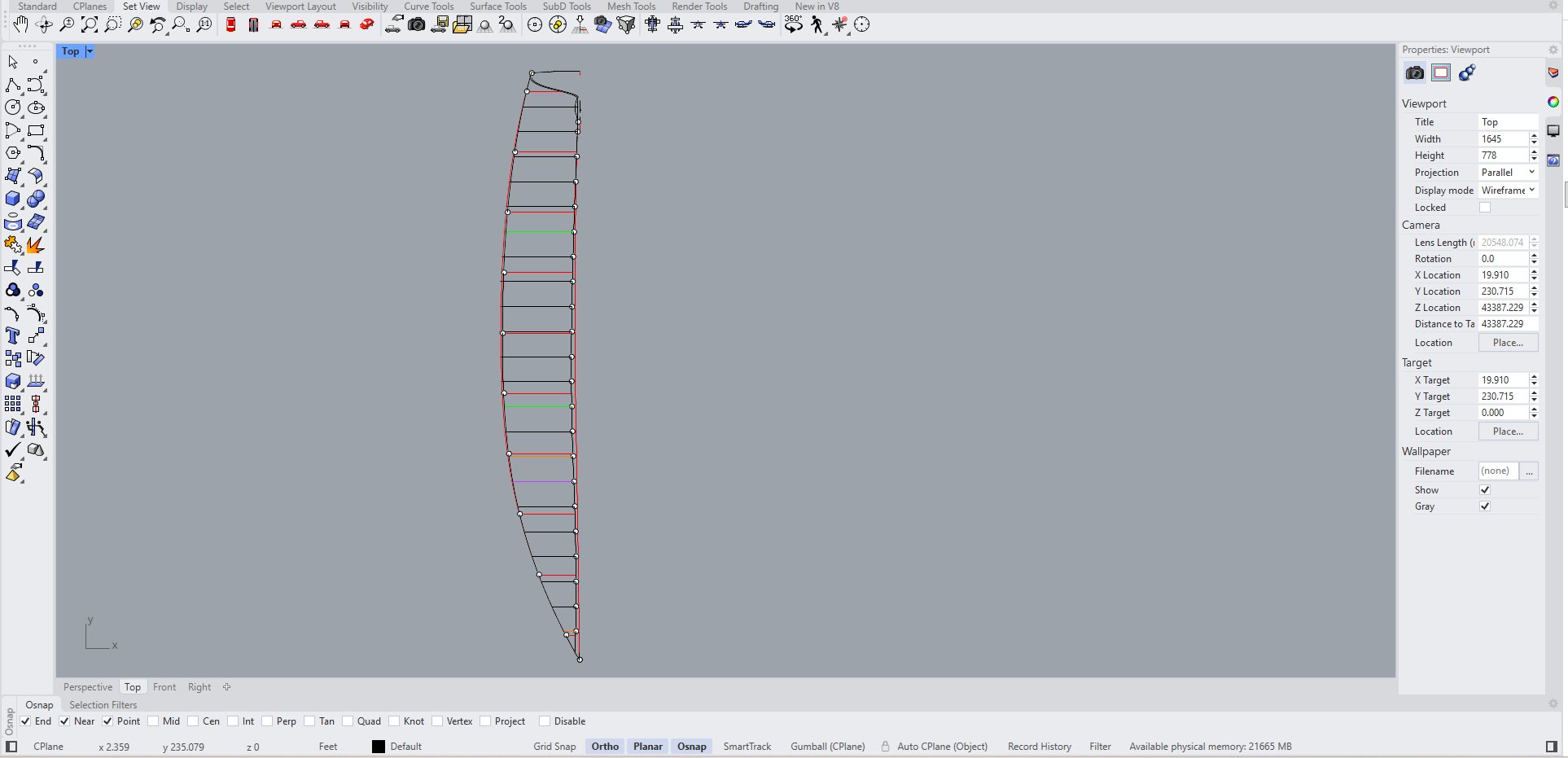

1. The sheer is difficult to define
The start and finish of the sheer, which are at the face of the stem and at the back face of the transom, are not given in the table of offsets. These can be measured from the lines drawing but it does not work very well.
Furthermore, the sheer in the lines drawing is far from fair and the half breadths and depths in the table of offsets also do not produce a fair sheer and do not work at all well with all the other information given in the various sheets of the plans.
It took a lot of head scratching but finally, combining all sources, I managed to produce a sheer that I feel is half descend.
2. The shape and position of the stem is difficult to define.
This information is given in three places. In the table of offsets, in a separate sheet in the plans where distances are give from the baseline and the forward end of the sheer (the latter is NOT given though in the table of offsets!), and also can be defined by the plan drawings. These three sources provide three different stems! The difference is not huge but still significant. Again, by blending everything I think I have a reasonable stem
4. The width of the face of the stem after tapering from the rabet is a bit of a quizz
Now, this face progressively widens from the top of the stem finally reaching the full width of the keel. These widths are given at various heights but still fairing of the lateral edge of the face is needed so that this transition is smooth.
Screenshot(57).thumb.png.e980ebaec8e723a80c488ce883572582.pngScreenshot(56).thumb.png.b0d85a1234e324f35ba5e8c652b47883.png
I finally managed to do this, which of course changed some of the dimensions given in the table of offsets, but, whereas Leo starts this face at 1.25" wide, in the lines drawings it is much wider, almost 2" or more. (This information is not written anywhere else). In 1:12 scale this face will be 2.5 mm so maybe a bit too narrow. In my CAD drawings I ve followed Leo and did it 1.25" but may need to revisit this to make it wider - this will unfortunately mean that I will need to redo the sheer. We will see.
5. The sternpost and transom dimensions are not given
I traced the lines drawings to get this. The width of the sternpost is not given either but luckily Leo mentions it is 4" wide - which looks about right.

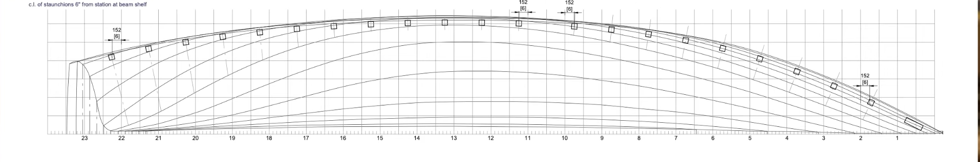

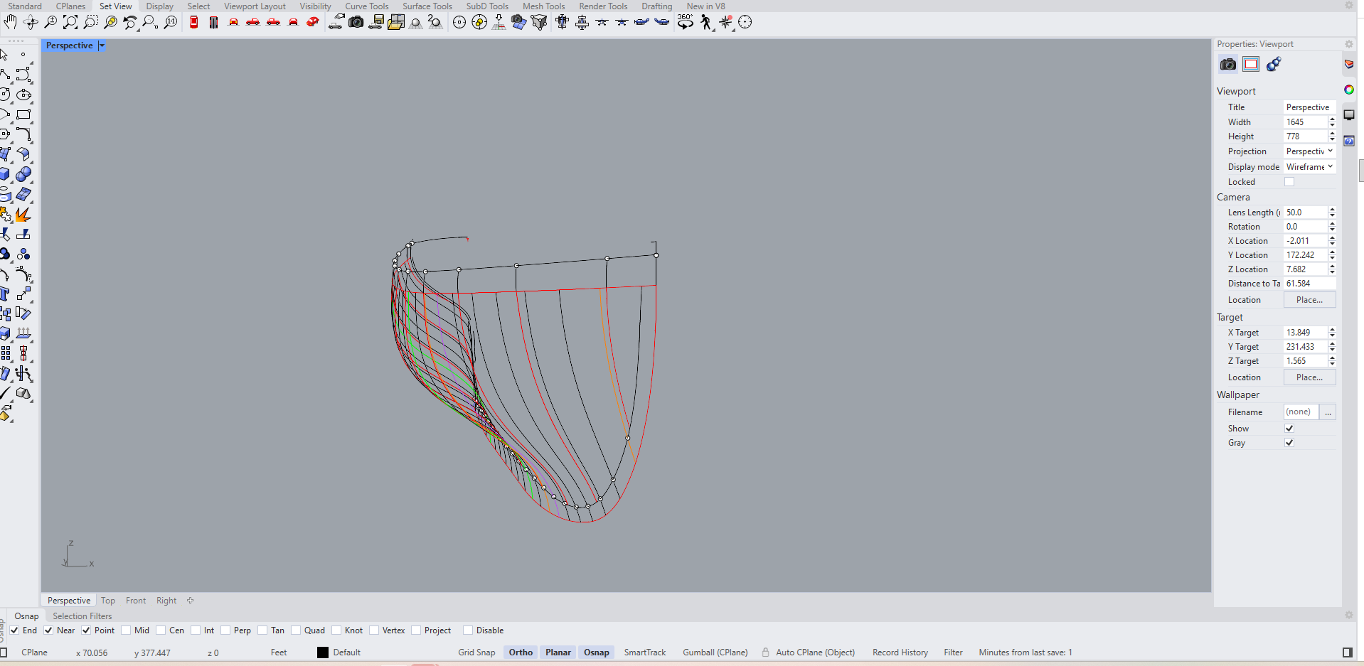

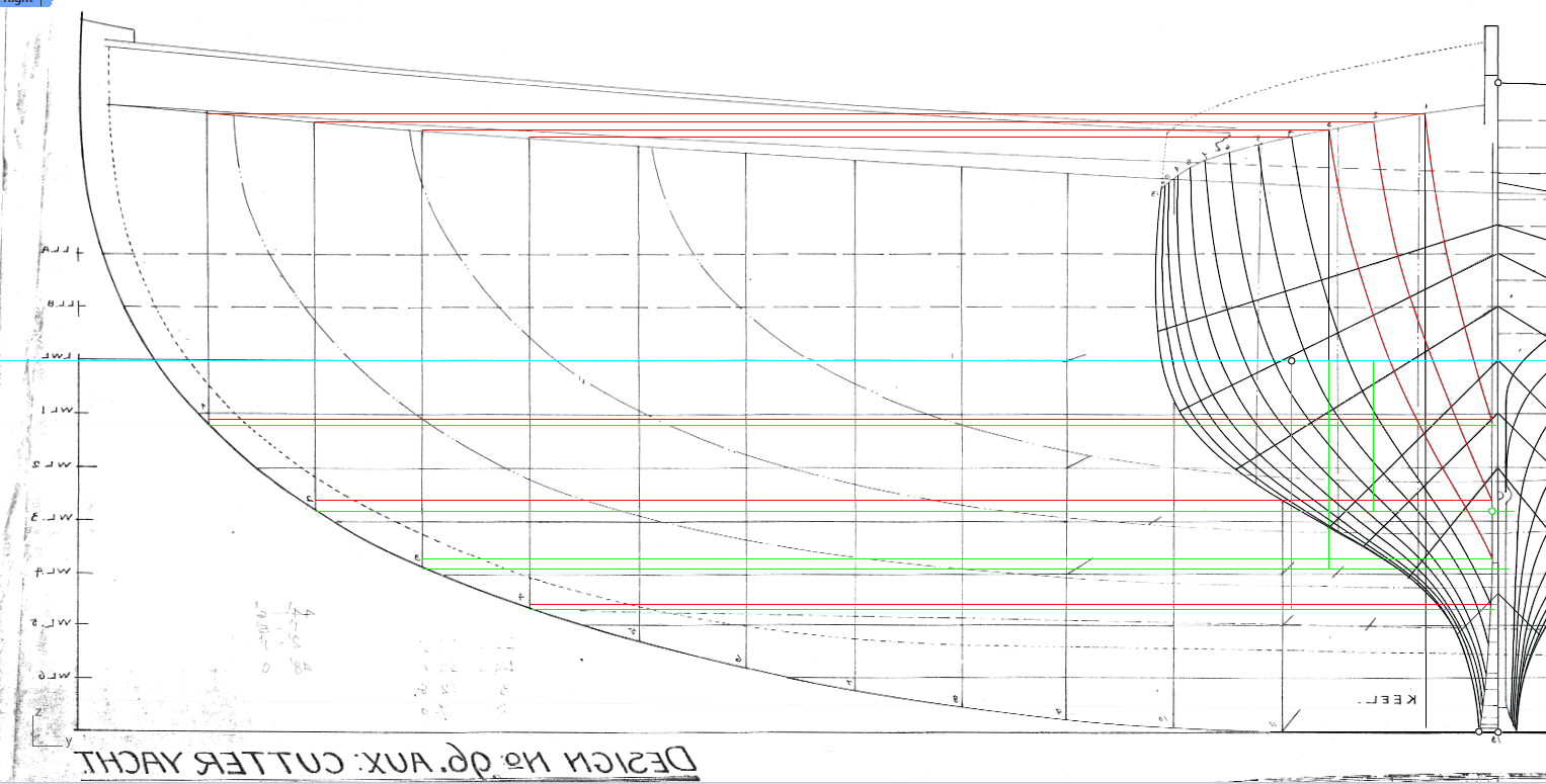

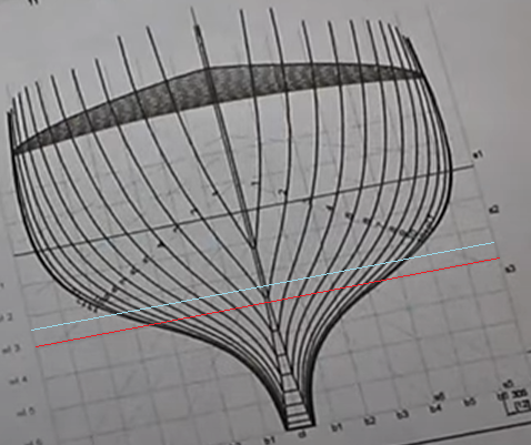

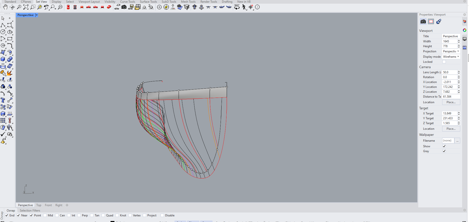

6. There seems to be a problem with the body plan
Now, this is important.
The plans contain a table of offsets and also the lines in profile view and body view. Now, these do match, with the exception of the bottom end of the frames. (All of the frames)
In the following photo, the waterline is the blue line.
Note what is happening with frames 1 and 2.
The top ends of the frames indeed meet the sheer where they should in the profile plan.
The green lines show where the frames should finish according to the table of offsets. These heights are correct in the profile plan but not in the body plan. The frames seem to reach the keel quite a bit higher. This is the case for all frames. (Apologies, for frame No4 both lines are green but the upper one should be red)
I really tried to figure this out but cannot find an explanation. Interestingly, Leo in his own lofting seem to have positioned the bottom end of frame No 2 in the position given in the table of offsets - about 3/4 of the way down between the 2 waterlines
Screenshot(54).thumb.png.f543d8b2eb7bb39df87235a43371d0bb.pngScreenshot(54)edited.png.6f8b13919616cdad61a0a38ef98bf755.png
Frame No 2 in his plans appear to be ever so slightly S shaped - which is what I think it should be.
Now, I ve been fighting this a few weeks now and am a bit broken, I need to recover a bit before I continue.
If any of the wise elders can provide any advice on the discrepancy between the body and profile plans, I really would be grateful!
Take care all
Vaddoc
Edited by vaddoc

Dear all
I think I did it!
But first my deepest thank you to all that visited, hit the like button or replied - much appreciated!
How right you all are:
On 10/12/2025 at 10:54 PM, druxey said:
An important step to take to 'prove' a hull fair is by proof diagonals, which you can think of as angled waterlines.
Now David, I had forgotten all about the diagonals! Silly as my first efforts to loft the boat were actually using the diagonals, which is what Leo did. Thanks! Diagonals coming up bellow.
23 hours ago, Mark Pearse said:
I would likely prioritise the hull shape & allow the stem profile to adjust
I did exactly this Mark! Still, this led to a stem just short of 9 inches wide, whereas Leo ended up with a 7 inch stem. No matter how much I tried I could not match this without drastically altering the shape of the sheer or having a stem clearly wrong and too far off the plans.
Its precision can make it look like the situation is worse than it really is
Absolutely. After the hull was pretty much shaped, I realised that what appeared as large unfairness in the CAD lines was in reality just a difference of 3-4 mm, and this in the full size boat.
20 hours ago, dvm27 said:
have you every tried to contact Leo
I most certainly will Greg and I also plan to visit Tally Ho (if possible) when Leo gets back home. All in good time!

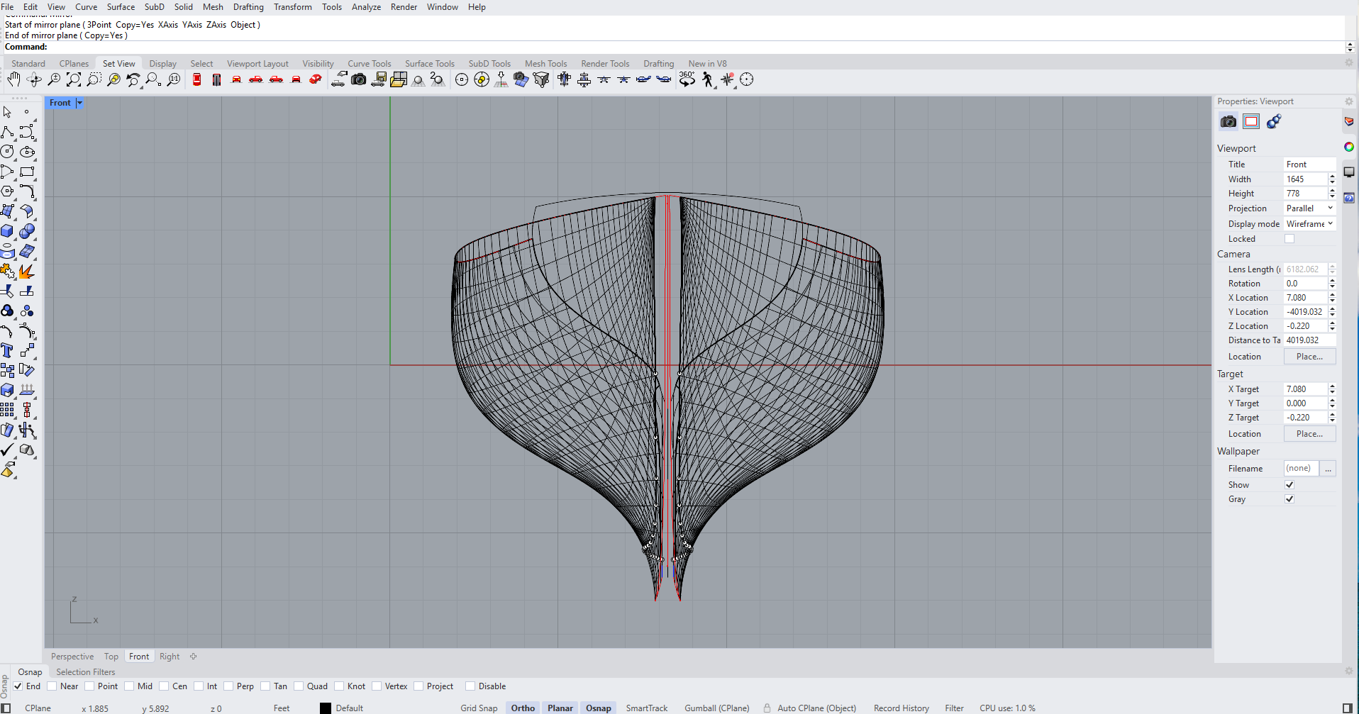

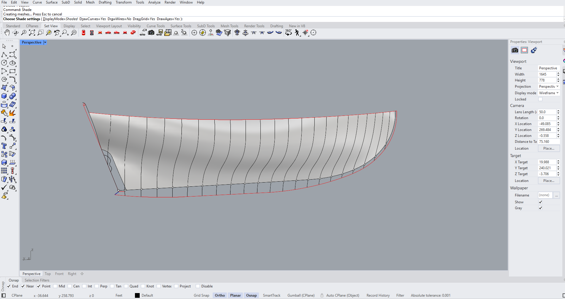

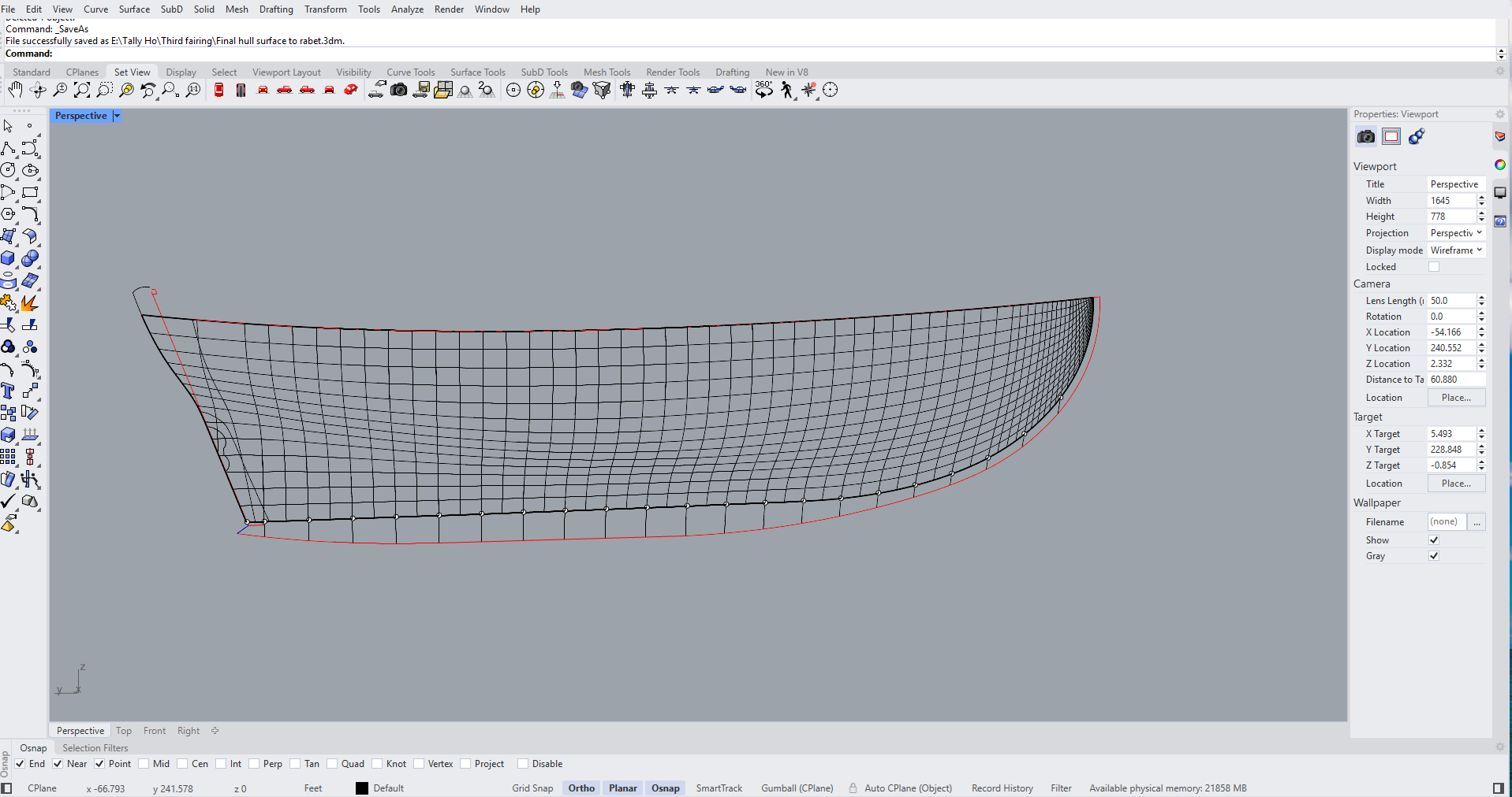

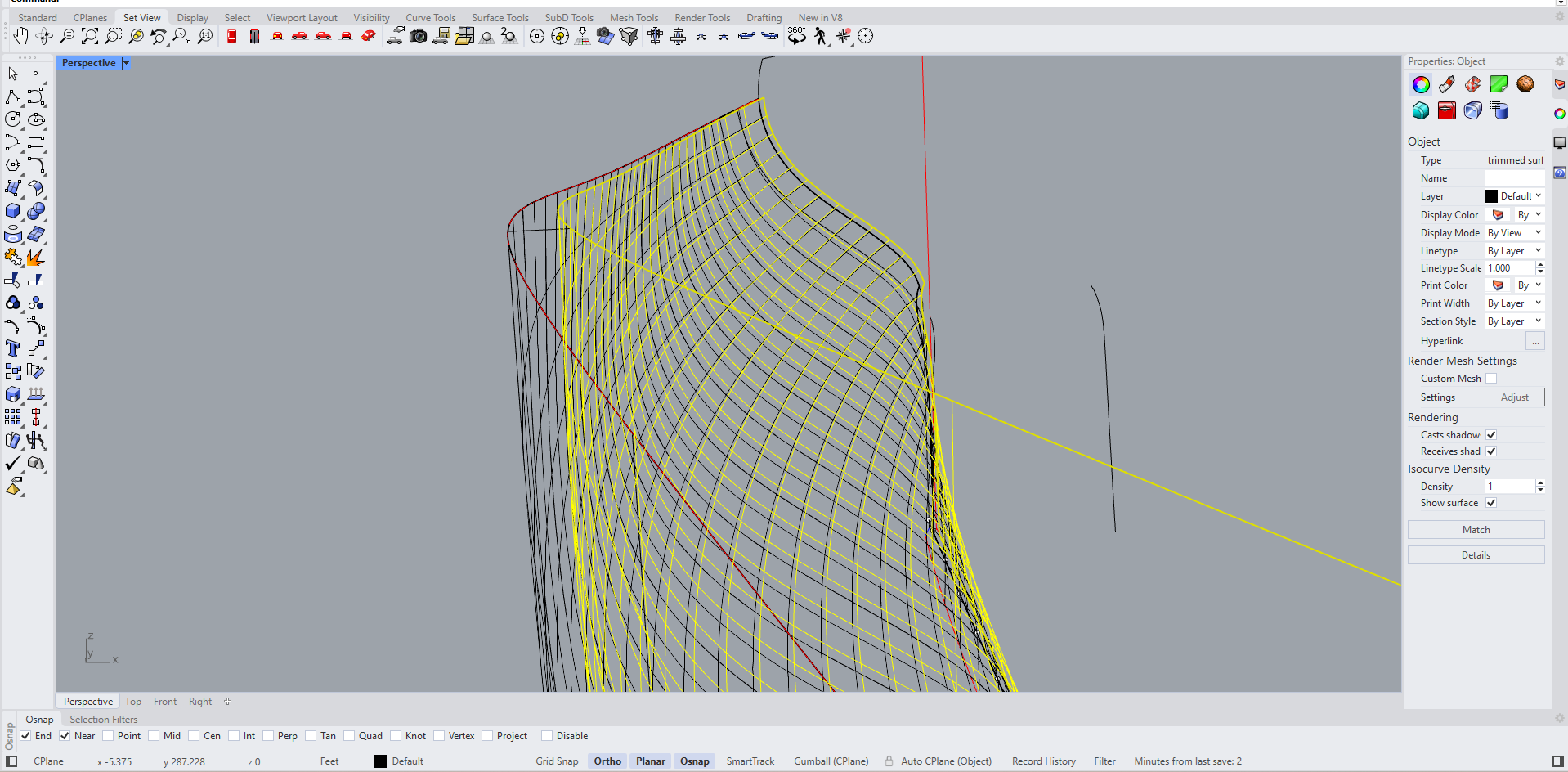

Ok, so now let me share the progress made - I must admit I am pretty happy, unless some eagled eyed people find a huge error somewhere!
So blending all data sources I found a happy medium for the sheer, the stem, the sternpost, transom, face of stem and keel. I accepted that frame no 2 will be a bit S-shaped (not much). I then went through three lofting cycles. Suddenly, all fell into place! All lines were fair and the frames and waterlines were either touching or just a few mm apart:

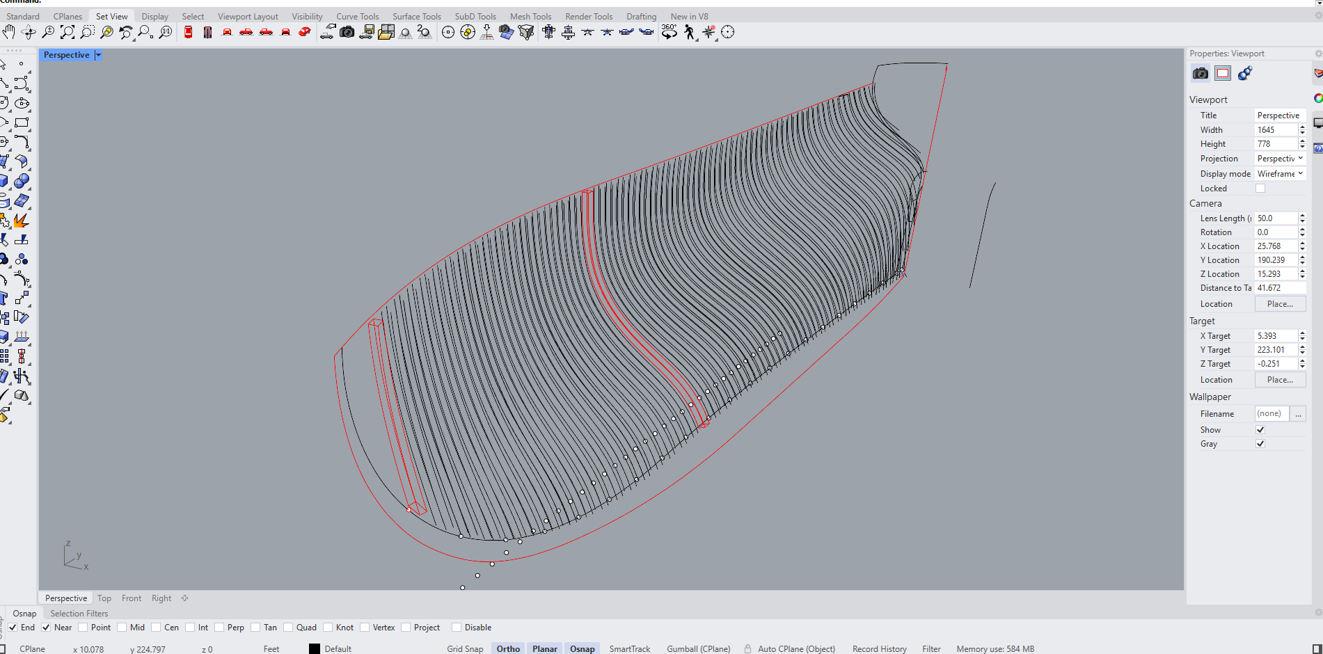

These are the sets of frames after each cycle - the white frames are the traced ones from Mr Strange's drawings.

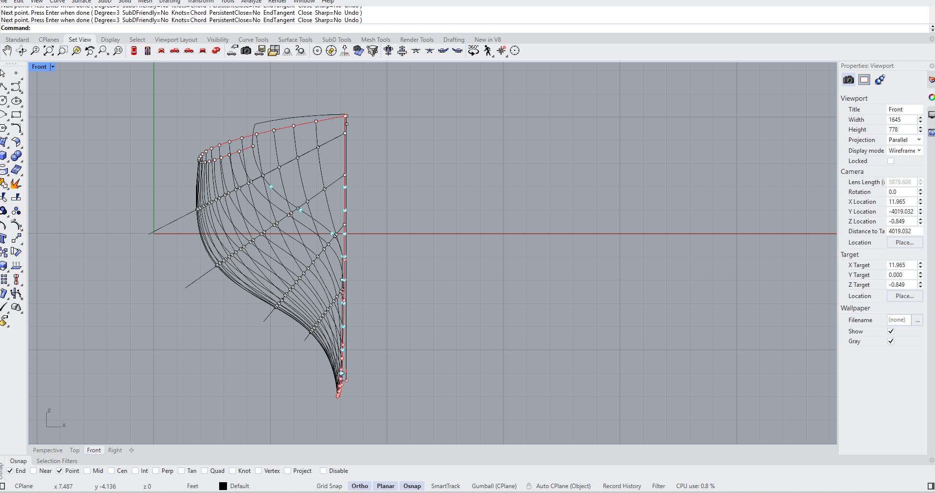

But is the hull really fair? Enter diagonals!
Screenshot(93).thumb.png.a1ed705a563a2e97fde8eaff41e7e735.pngScreenshot(95).thumb.png.41d161f27e8cc5e8a3312b8c27e7d45f.png
It is actually ok!
The unfairness at the stern is because I used the last frame to create the lines - without it the top three diagonals become completely fair. I will actually not be using this last frame so all good. The bottom diagonal is a bit wonky but the distance to fairness in that aft point in reality is just 2 mm in the full scale boat - meaningless.
At the bow, again the adjustments to make the diagonals fair are tiny.
In any case, I thought I d give it a try. So I faired the diagonals...
......produced the new contact points with the frames and transferred these points over to the finished hull to redraw these frames...
....and then I gave up. It was meaningless, the difference was just a few mm. In the actual boat it would not make a difference, even Leo accepted 1/8 inch tolerance. In 1/12 scale, this tolerance becomes less than 0.5mm.
The next photo shows my frames compared the the traced ones - they are pretty close.

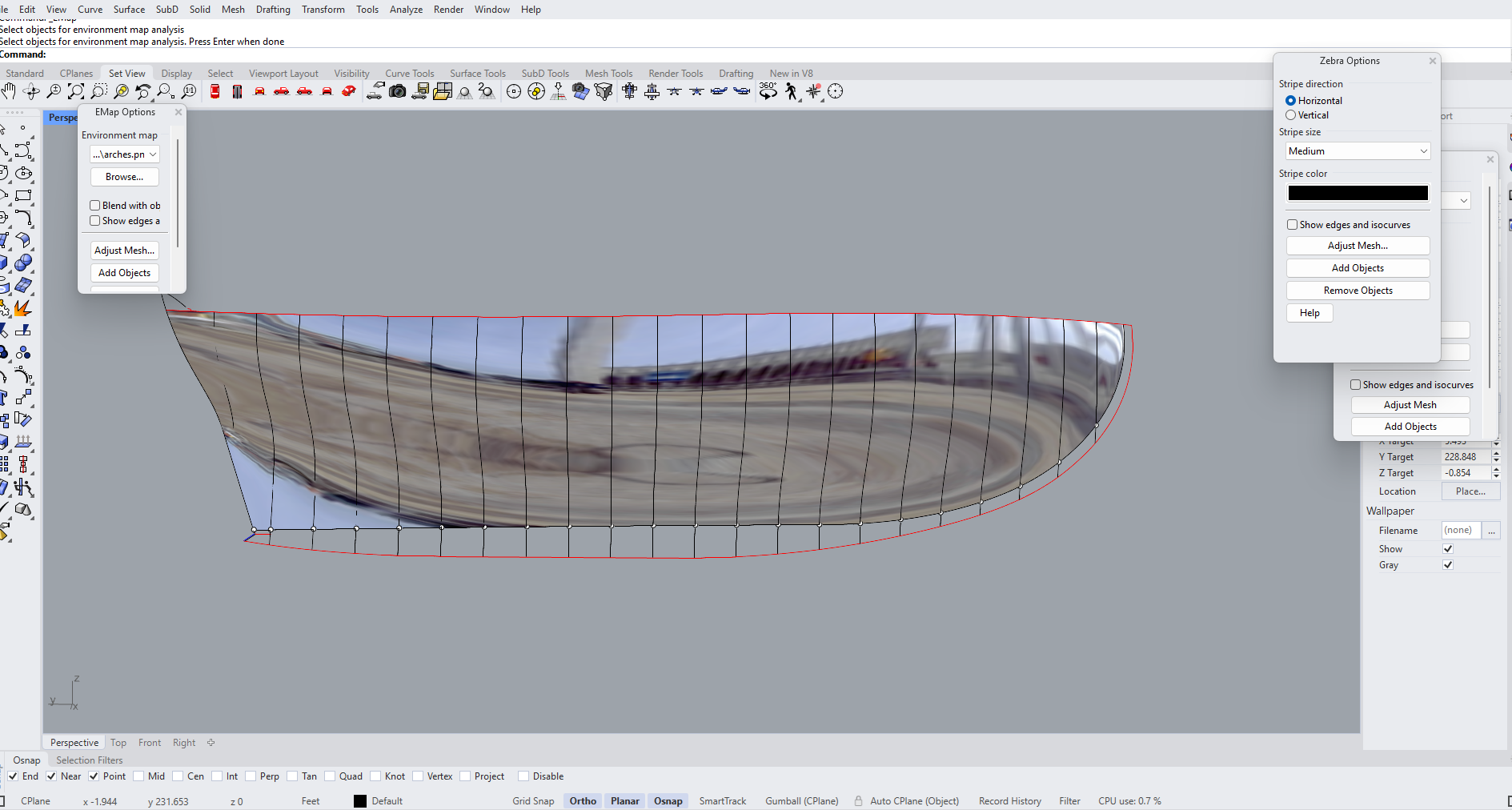

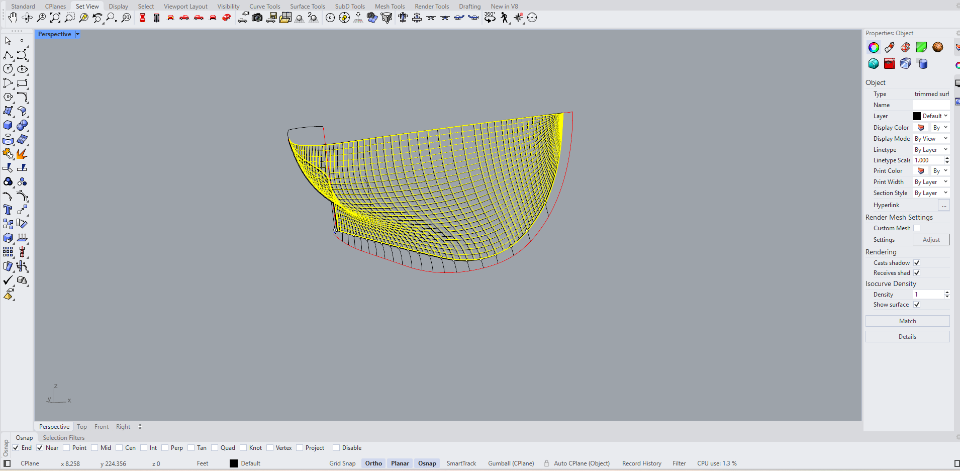

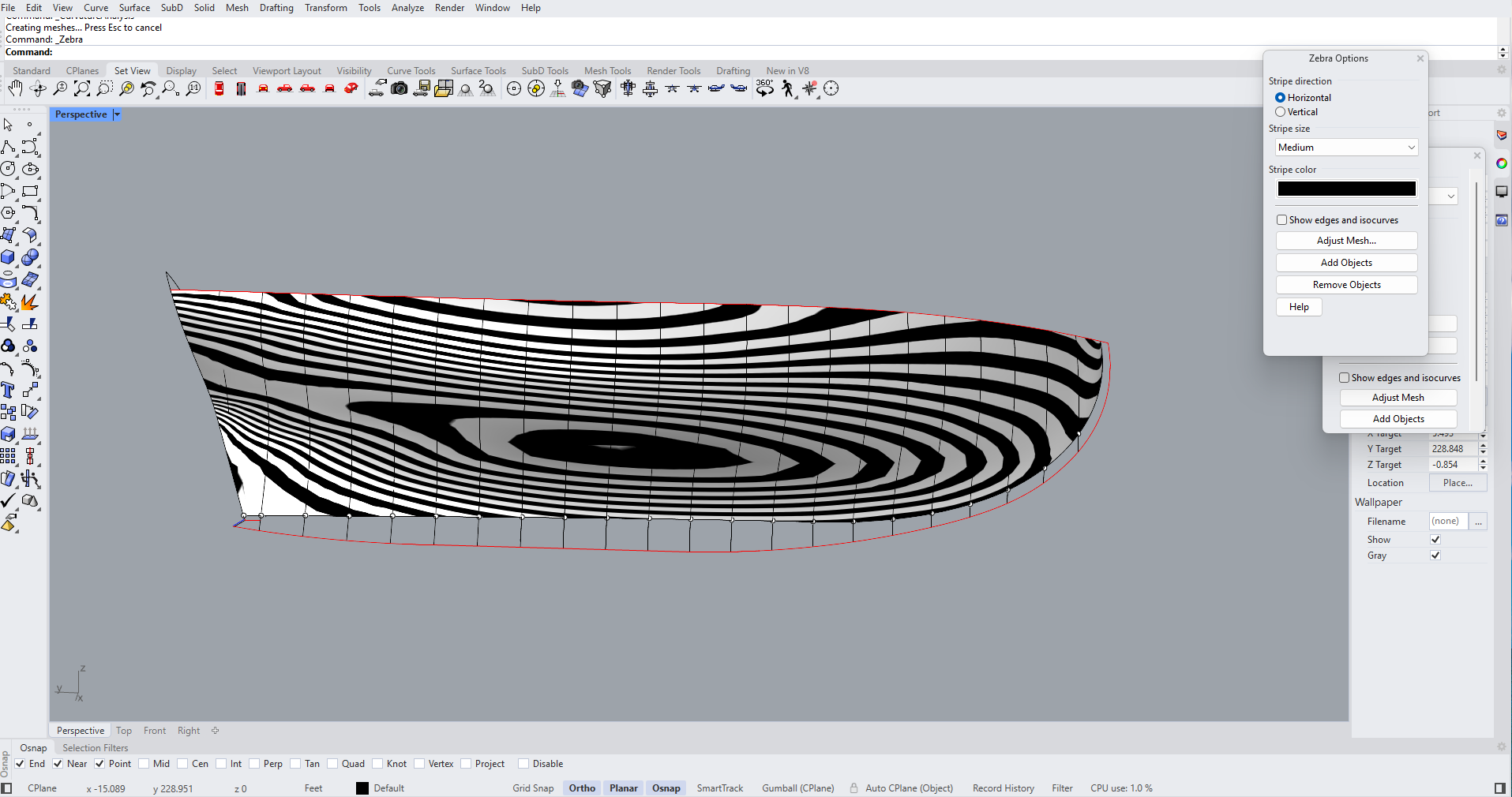

So lets see the hull!

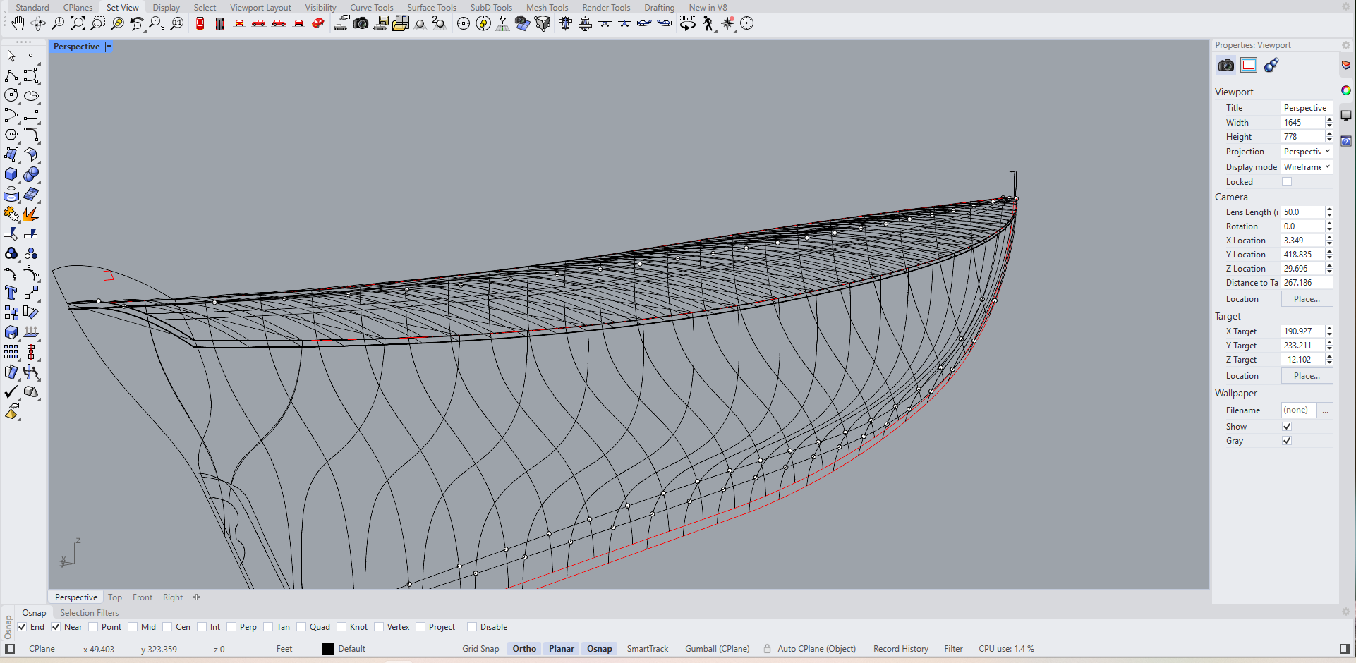

Now, this looks pretty fair. More bellow

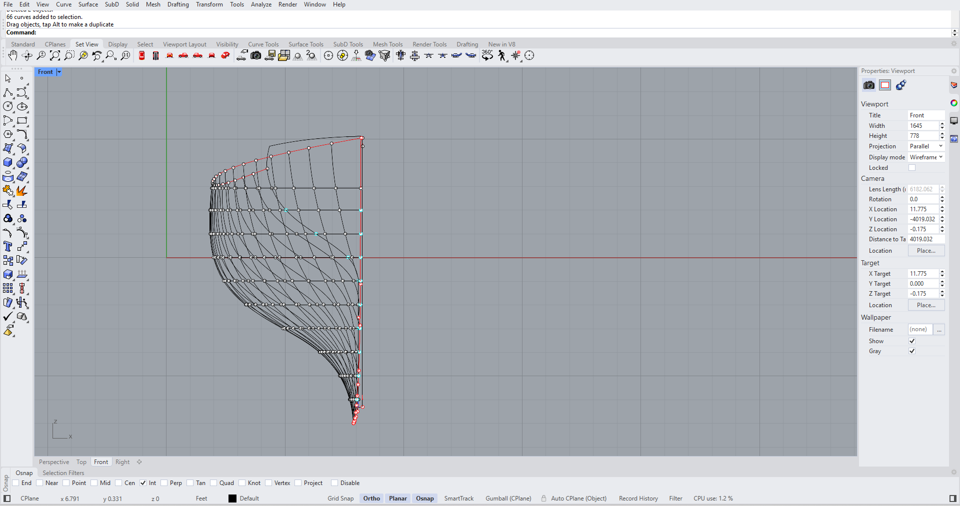

Adding the rest of rabet at the stern
And a couple of photos of the complete hull.
I think it is adequate to start the project and the wood will correct any imperfections.

I ‘ve been studying Leo’s videos and they are a treasure of information. He posted this picture of the lines of the boat. I compared it to my lines and they are not far off.
His bow is a bit more narrow, this is why his stem is 7 inches wide and mine is 8.8”. I do not know how he did it – I absolutely could not make it work without deviating too much from the plans Perhaps I followed more closely the table of offsets, whereas he seems to have followed more the lines drawing – but he had the boat!
Up to this part, it would have actually been easier to use batons to fair the curves. But from now on, CAD really shines.
So, up to now, we have the lines of the hull, the keel, stem, sternpost and transom to the OUTSIDE of the hull. We now need however to define the INNER surface of the hull, where the frames will touch. This is extremely easy with CAD, just a command to offset the surface. The thickness of the planking is 1”3/8 to ½” but I made it 3mm to help with the build.
Now, using the inner skin, we can define the actual width and shape of the transom, as the initial shape included the thickness of the planking.

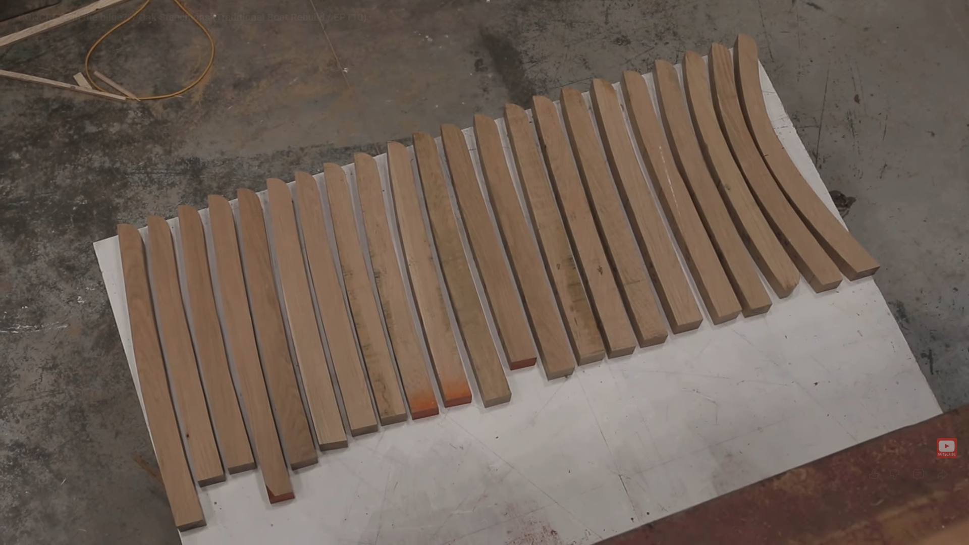

Now, we need the frames. Leo changed the thickness and made them all double frames. Projecting vertical lines on the inner skin gives us all the frames with all the outer bevels. We can then offset the inner skin even further to the thickness of the frames and do the same so now we have the inner surface of the frames with all bevels ready.
I started work on finalizing the frames. They rest on the top of the keel but also there is a pocket on the side of the keel where they slot in.
So I decided to do the same. Leo mentions there is 1 degree slope to the keel but mine is dead flat. The pockets will also be parallel to the midline, they will not follow the curvature of the hull
However, after a few frames I stopped. To define the upper end of the frames, the deck had to be made which means I had to decide the camper, that is the amount of lateral curvature of the deck.
This needed a bit of head scratching. My experience has been that the camper is fixed and applying it along the sheer, gives us a curvature that gently transitions from zero fore and aft to maximum in the middle. However, Leo did not do this. He very usefully has posted this photo.
There is still camper even at the transom. So I shamelessly copied the curvature of his deck form the profile view and asked CAD to create a surface.
Now, this was offset to account for the thickness of the deck planking and that gave us the inner skin of the deck
It should not be difficult to find the shape of the beams later on.
So now there is a new sheer to account for the thickness of deck, this will also be used to trim the top of the frames
But now, it is time to deal with the bulwarks and the stanchions. Leo seems to have spend some time on this and it has been on my mind but it went very smoothly.
So the stanchions are additional pieces of wood that extend above the deck, hold planks and create the sides.
Again, Leo very usefully has posted a drawing of the “sheer” of his bulwarks.
This is a very interesting part of the boat. The bulwarks from the profile view follow the actual sheer. From the top view however, their "sheer" crosses the boat sheer again and again. I am not sure how exactly it is defined and what implications the different angles have but again I copied Leo's . It looks ok and I do not think I am far off
So, now that this “sheer” is defined, it is easy to ask the computer to create the surface and offset this to get the inner skin. The stanchions can easily be created in the same way as the frames.
There is an interesting element where the bulwarks meet the transom. This will be a particularly tricky area especially when the toprail will go on.
Ok, so far all is going well. Next the bow timbers will need to be defined, I will try and follow Leo’s arrangement. Then will be the sternpost. Then to finish all the frames, arrange the transom timbers and then the beam shelf and all beams.
Regarding the beams, Leo has followed exactly Mr Strange’s arrangement except for an area in the bow, there was a wide companionway but he reduced the opening and put in an additional beam.
Regarding wood: I think it will be pear for keel, frames beams etc, maple or pear for planks, boxwood for deck, perhaps mahogany for deck structures.
Leo used Teak for the covering boards, I may use cherry or pear for this and also for the stanchions, bulwarks and toprail. I think some suppliers provide iroko which has similar colour to teak, I have no idea if it is any good for modeling.

Ok, so here is what happened.
I was happy with things but then I started work on the sternpost and this is when I realised that my hull was wrong.
The sternpost is a solid piece of timber with a set thickness. The inner skin of the hull needs to meet it in a certain way so that the frames, which follow the inner skin, can be bolted onto the sternpost. The way my hull was lofted was too wide at the top so that it did not meet the sternpost, but also too narrow near the bottom so that the frames would need to be positioned too high to be bolted on to the sternpost.
So, it was clear that I had to reloft the boat but first roughly arrange the sternpost.
So, back to Leos videos. Using this (and others) image, where all lines are shown, I was able to recreate his sternpost.
Then I relofted the boat. This time I did 4 cycles, for modelling purposes I do not think I needed to do any more. I also decided to keep the 1 degree slope of the keel.
Screenshot(156).thumb.png.8d65c49f89bdb291c493eeca57764fce.pngHull1.thumb.png.a55cd83d5b666ef8f2b60a751fa118f6.png
Hull2.thumb.png.2d025fd2f81211c8b5f987478daad3bb.pngHull3.thumb.png.9172367177df5424718615b700f46986.png
Hull4.thumb.png.bf221526381ebad32713b496703cba04.pngHull5.thumb.png.53b03c13440ffbec71c05c3d1b4695ec.png
And with the rabet and transom
Compared to Leo's hull, it looks pretty close - of course the shape will be a bit different but not by much
How about the sternpost? It actually is fine.
The next photo shows the hull somewhere in the early stages of lofting. The shape of the sternpost can be seen, the lower line is where the outer skin meets the hull, the upper one where the inner skin meets it. Obviously it looks wrong
This is how it looks on the finished hull - much nicer, lots of timber for the frames to notch, I can also change the shape of the sternpost a bit.
But a boat has two ends - what about the bow? This also has a set dimension along its length. The hull is lofted to the face of the stem but the planks will end at the rabet which is vertical along the side of the stem, but its projection to the side of the hull is not. It's ok though because this difference is very small.
I started work on the stem assembly, again following Leo's arrangement
Screenshot(121).thumb.png.2022d7cd7acc28faf8ac0ffcc442d1a3.pngScreenshot(144).thumb.png.314bf6ffa2beb75b4937d8dd3995a54c.png
But I could not make it work, the rabet would not transition smoothly from the stem to the keel. I struggled for a few days until I realised that my rabet was all wrong. When I fixed it, it all came together.
If you are lofting this boat, the rabet must pass through the point where the underside of stem meets the upper surface of the keel.
Still, my stem arrangement is not correct - it is not thick enough. In station No1 there is a frame and from there aft a frame every foot. My stem is not thick enough for the frames to be bolted on.
This is easily corrected.
One last issue was at the stern, I had the impression that in the plans there is one additional frame. The next photo shows why this is not the case - there is simply no space for it.
