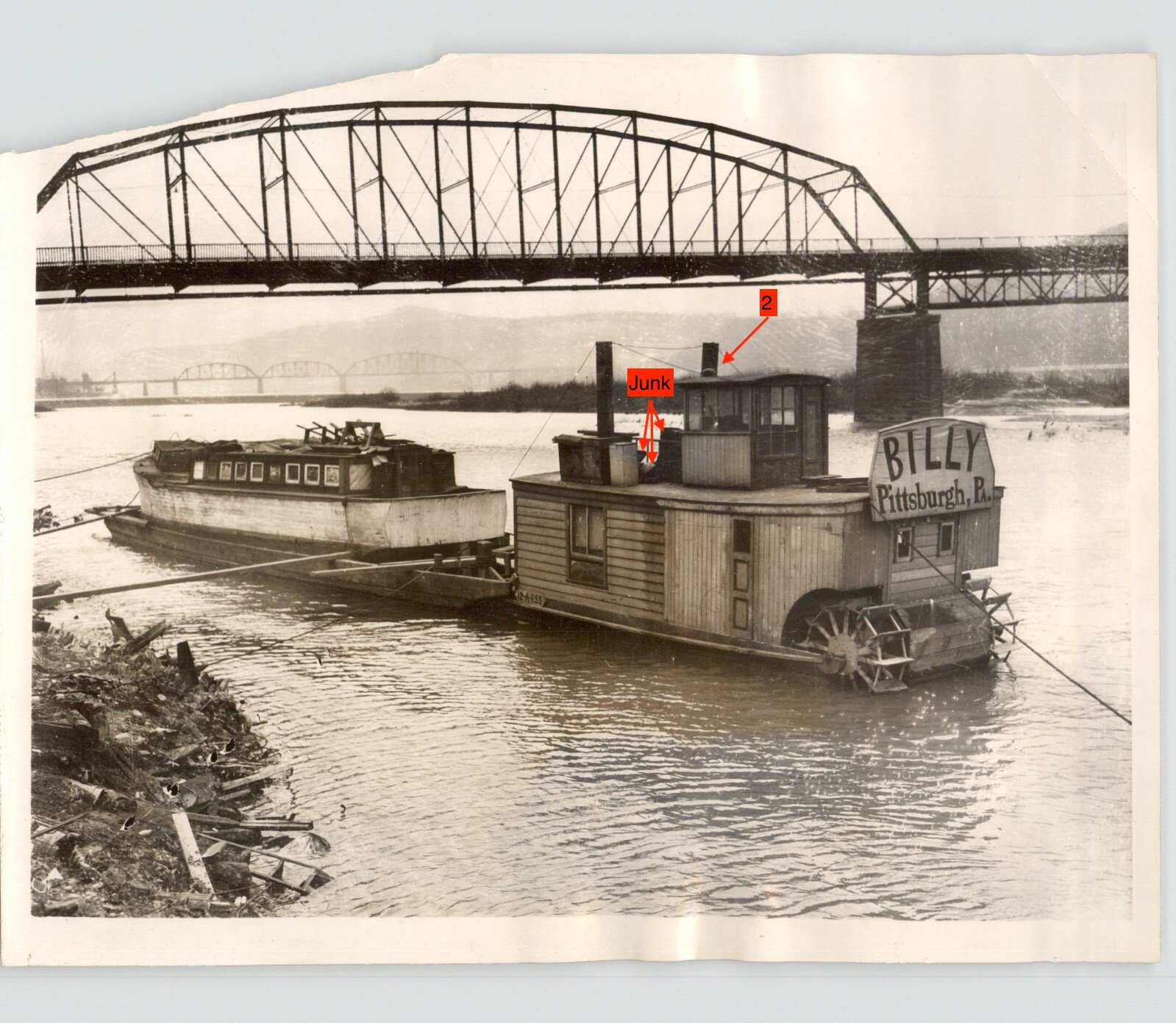

Something 'else' just caught my eye on this curious boat. What could 'this' be? The angle of its projection suggests that it's not just a 'wooden' feature nor a photographic anomaly, but rather something like a bent 'pipe' running forward out of the pilot house. Could this have anything to do with the indoor 'bar'? LOL
 When John enlarged the image I noticed that. If real, it appears to be a garden spigot with unknown reason for being.  I know, I know, we are talking Billy here and reason seems at times sketchy. Due to the small size and not knowing the why of it I'm ignoring it and not including it in the build.

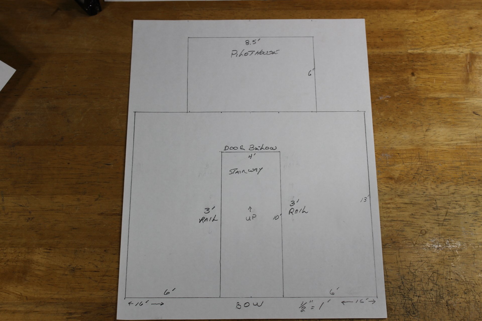

 Eric, I hope the below drawings answer your questions.

 Eric and Tom, is this the center stairway configuration you had in mind?
 If so it doesn't make sense to me because it cuts out so much of the deck structure below the pilothouse plus construction is much more complicated.
 Where I have the door marked doesn't work because you can't get around the stairs, duh. We have a similar door configuration in our house where access to the main stairway from the original kitchen has a door (the door is still there but is blocked on the other side of the door) with a step up to the main stairway. if it was a center stairway the door configuration could have been on either side at the bottom of th stairs.

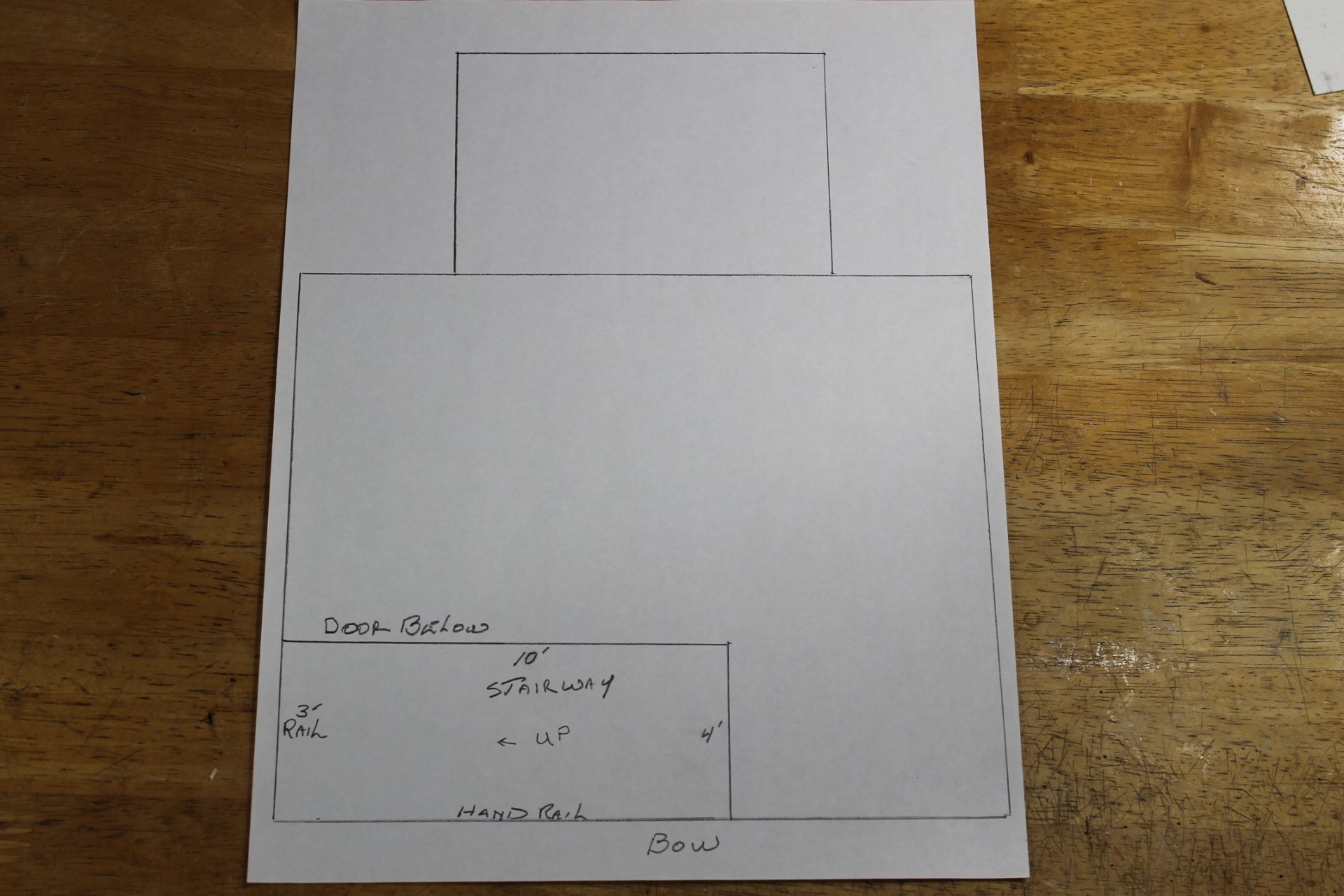

 This is my thinking except the foot of the stairs are on the starboard side running up toward the center and the main deck structure door is on the 4 foot wall underneath the stairs.
 This allows more usable space in the main deck forward structure and construction is much easier.

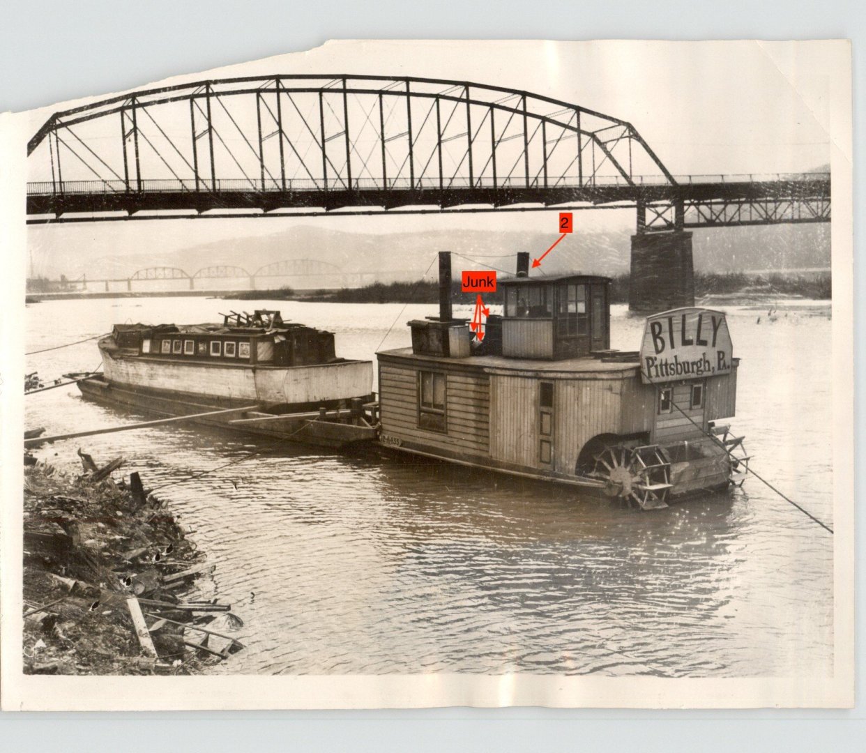

Regarding note 2 in the first photo, the reason the starboard stack leans is because the stairs being where they are don't allow the structural integrity as that for the port side stack.
 The only reason any of this matters is because it influences hull construction and deck planking layout. I can model it either way, I just need to know which way.

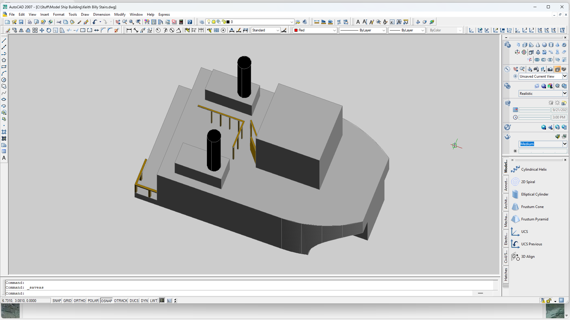

I don't mean to be telling you what to do, but this is what I see. Here's a drawing to illustrate how my mind reconstructs that image, right or wrong.

As for the junk, it looks to me like it's on either side of the proposed stairwell opening.
 To my eye it looks like it's in the center of the pilot house. *see Keith shrug
25 minutes ago, Cathead said:
As for the stacks, my eye says they both lean outward at about the same angle. In an earlier discussion, I believe we decided that they were entirely decorative, explaining why they weren't straight. Also, based on the trend of the left-hand stack, it appears it comes down to the boiler deck at least 6-8 feet after of the forward end of that deck, since you can see 3-4 feet of "shack" forward of the left stack, then another 3-4 feet of deck forward of that shack's wall. So the right-hand stack would be placed well aft of your proposed starboard-descending staircase, meaning that both stacks have equal support (or lack therefore) because they don't interact with either staircase, which also fits why (to me) they both lean outward at similar angles.
 The port side stack is much more straight than the starboard side, IMHO. I pointed out early on that they were decorative but that maybe the port side stack was functional for a wood stove. There is only 2 to 3 feet of space between the forward edge of the box that surrounds the stack and the forward boiler deck edge. If my thinking where correct the stairway opening on the starboard side would cut into the amount of surrounding box structure/ support for the starboard stack.
 Eric, my friend, I don't feel you're telling me what to do. You're sharing you thoughts on how you see things which is EXACTLY what I want you to do. Thank you for taking the time to make the drawing and for sharing your thoughts.

 I'm continuing work on the hull. As I studied Billy's image the arrow points to an item I kept thinking looked familiar but I couldn't place it till this morning when I had one of those aha moments.
 It appears to be a tractor's rear axle gear oil pan. It makes sense that Engel would rig up something like that because he wouldn't have had access to oiling the outside shaft bearings. The inside shaft bearings were reachable from the engine compartment.
