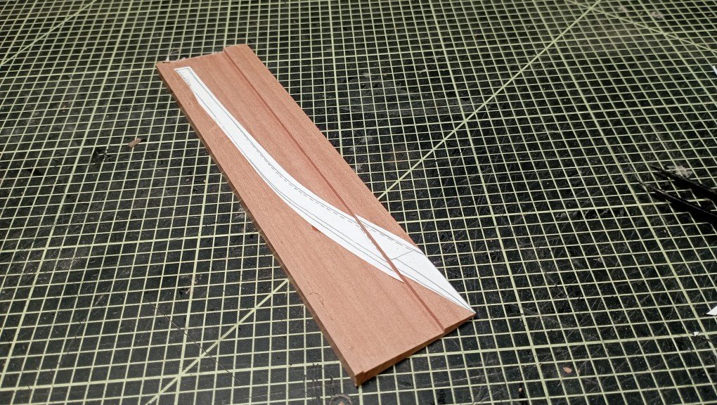

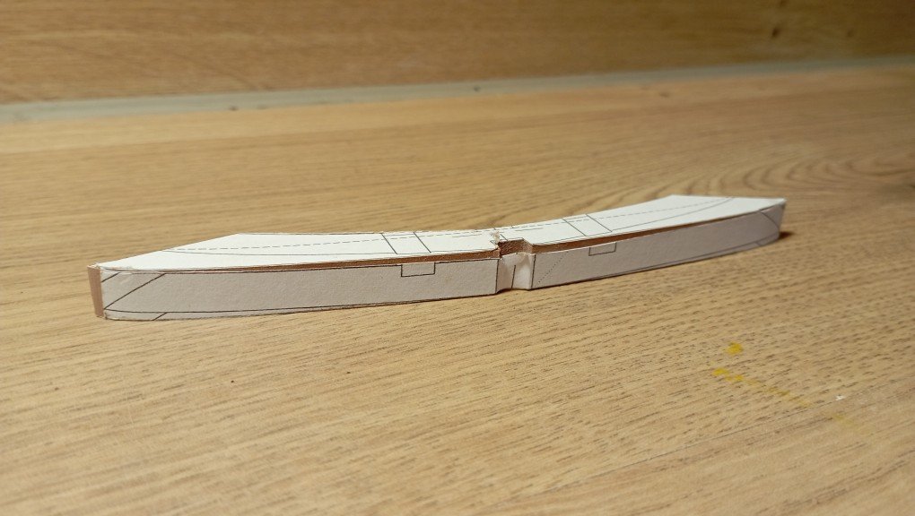

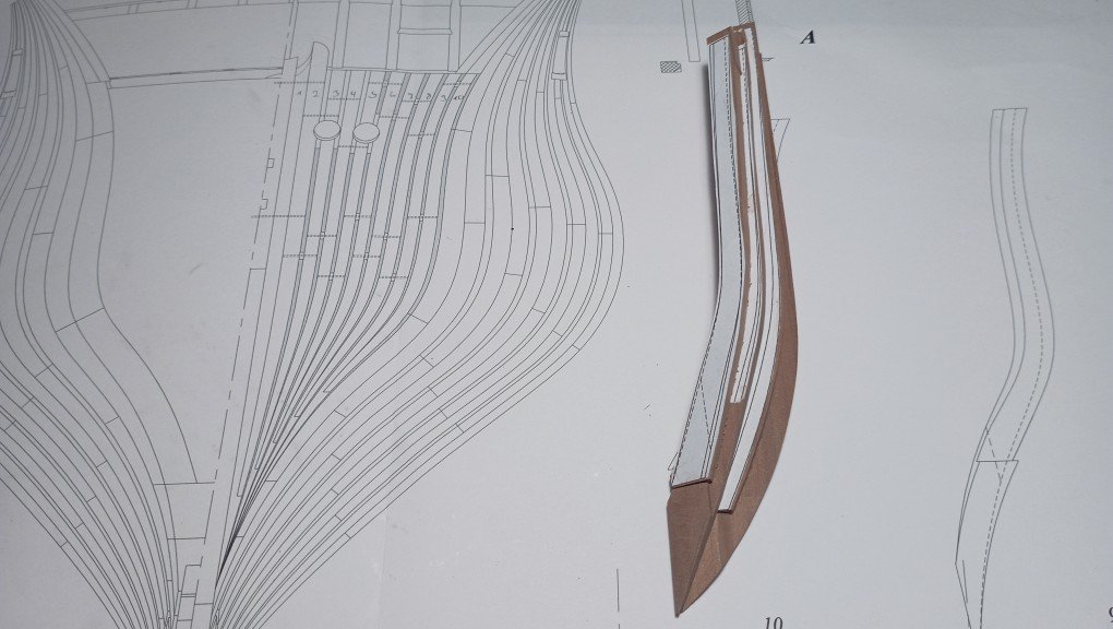

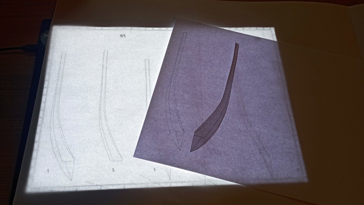

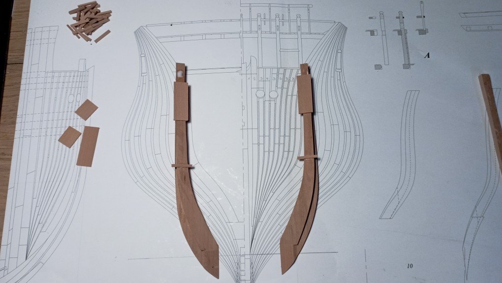

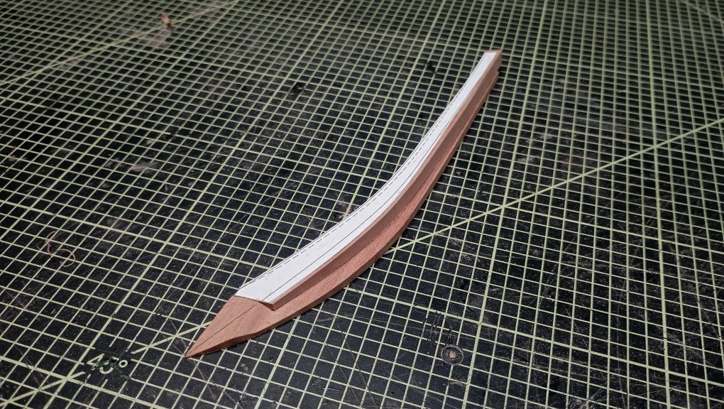

Work has continued on the counter keel, the sternpost with its false sternpost, and the fillet chord with the upper transom. The rabbet joint has been cut and milled. Further work will then be done on the frames.
Here is a size comparison to the Venus model at a scale of 1:72.

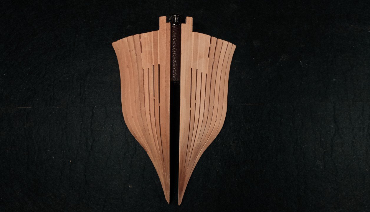

Hello everyone!
Thank you so much for your positive Feedback:)

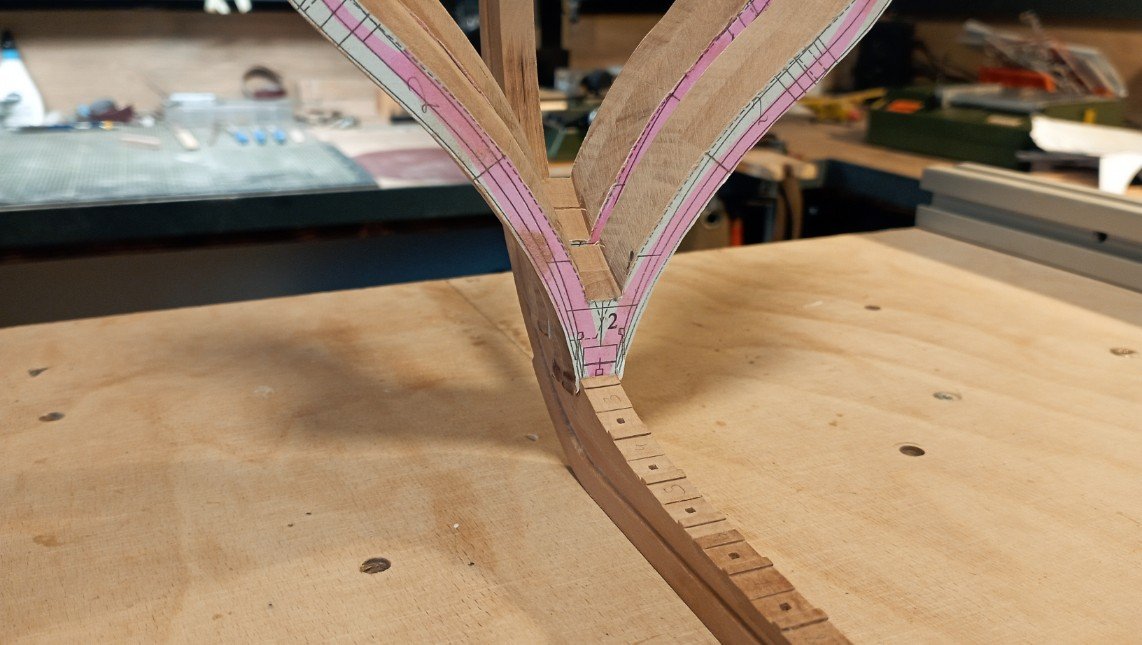

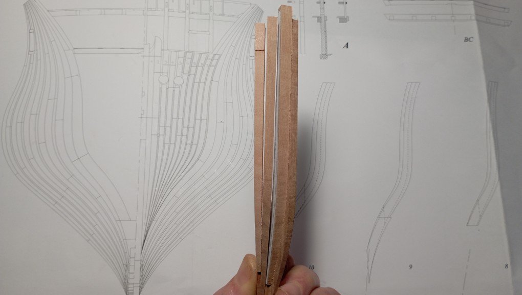

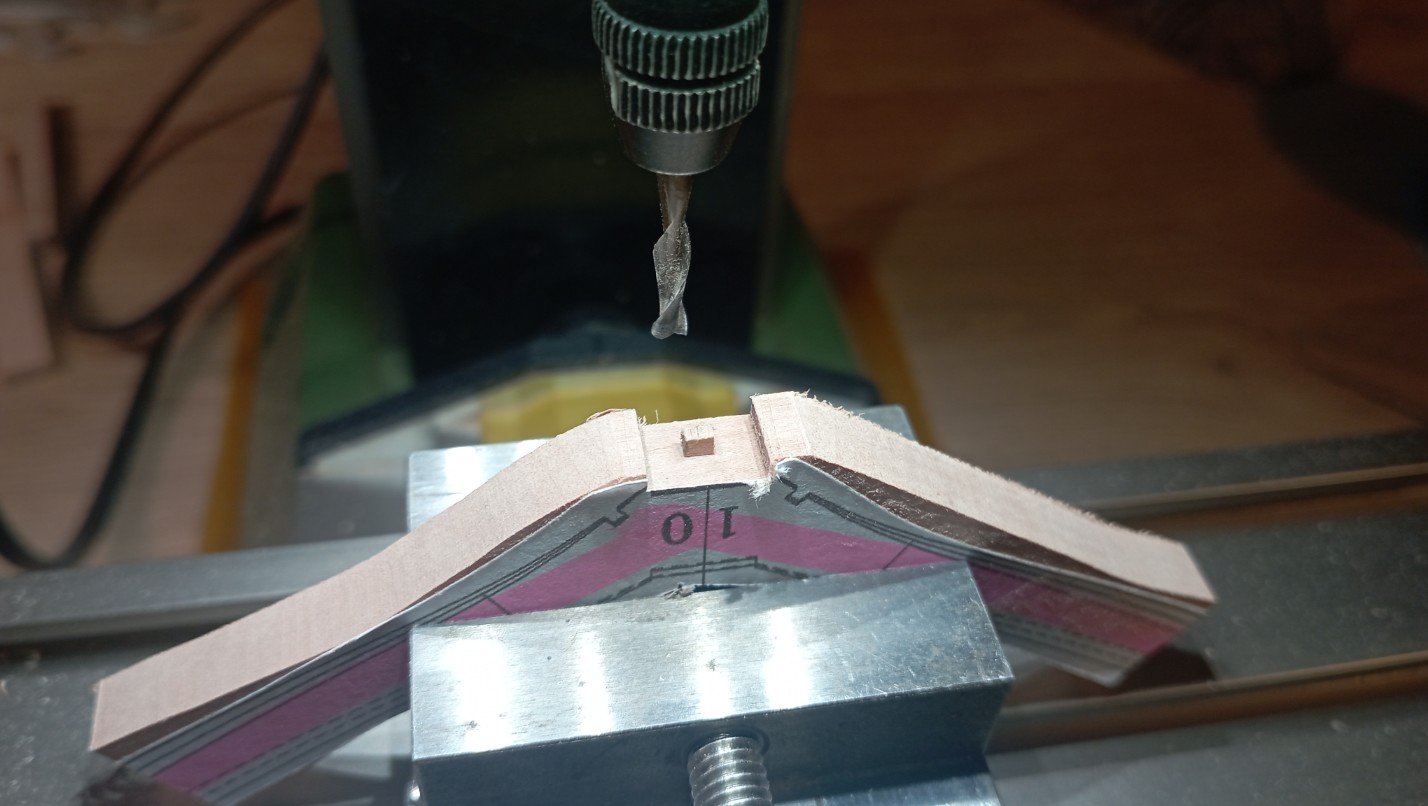

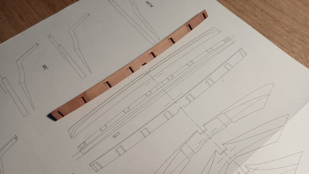

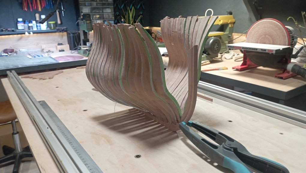

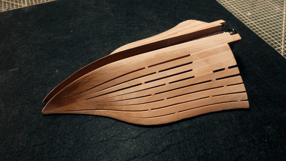

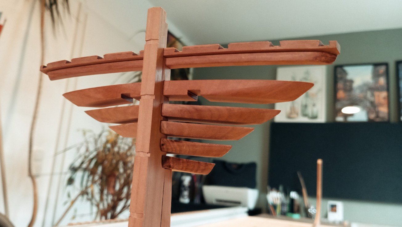

The eight forward double frames have been completed. Before I continue with the frames, I want to finish the bow section and attach the sternpost. So, it's time for the cleats. This is my first time doing this; let's see if I can manage it properly.

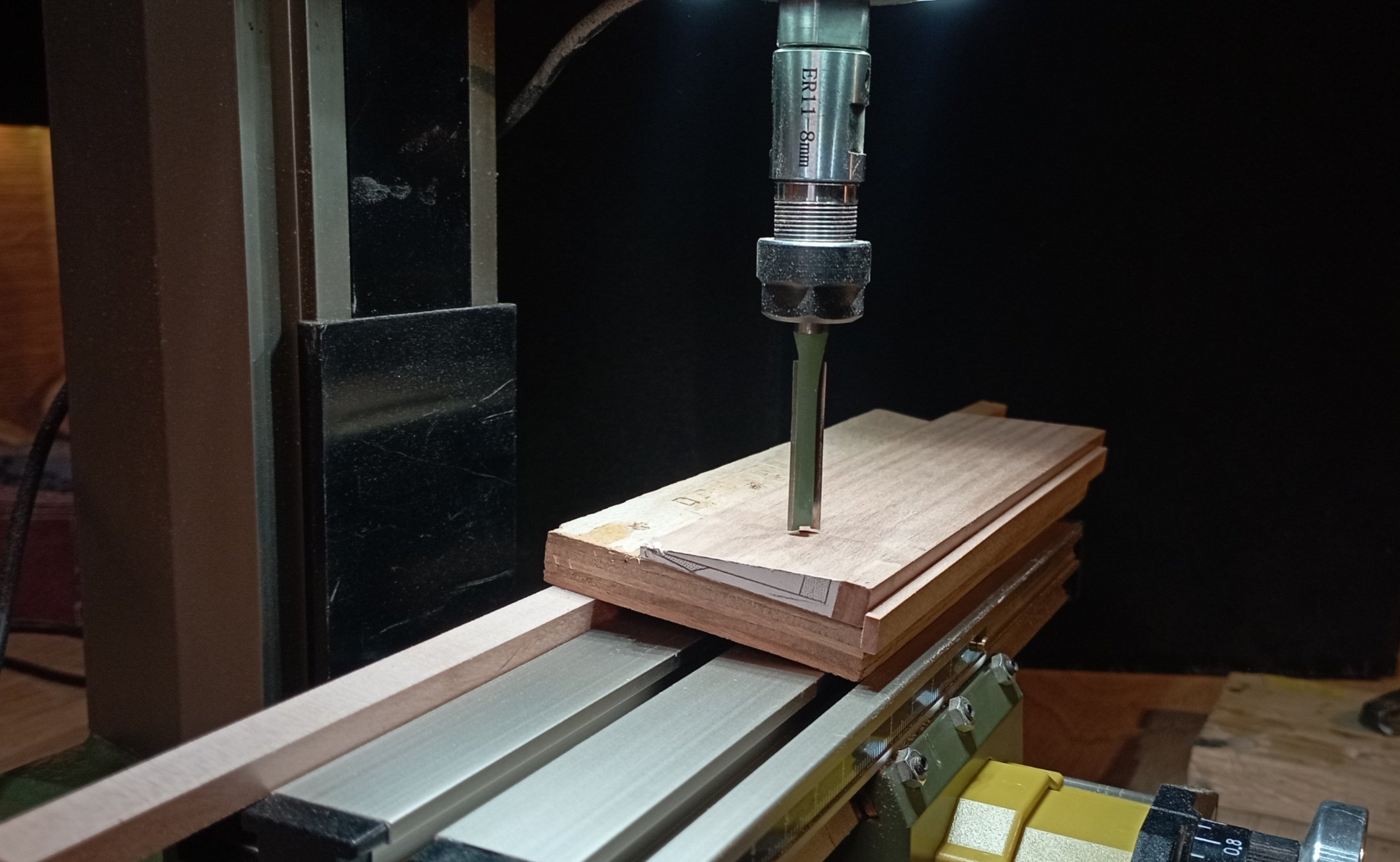

Hello everyone!
First of all, thank you so much for your likes and interest. Chris, thank you for your motivation. I found your work on this excellent, as well as your entire build log.
Continuing with the cleats, which are now finished. For a first attempt, I'm very happy with the result. The finishing touches will be done during sanding with the frame.

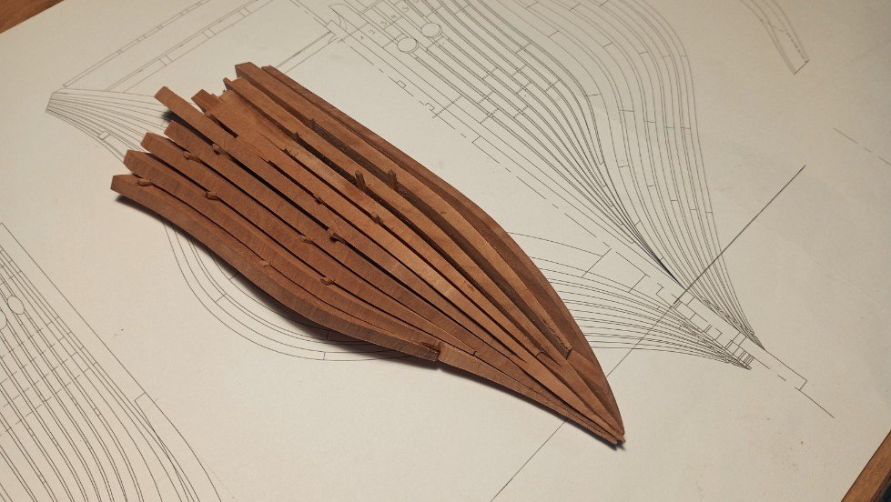

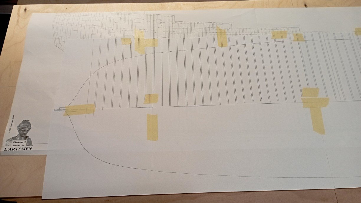

Hello everyone!

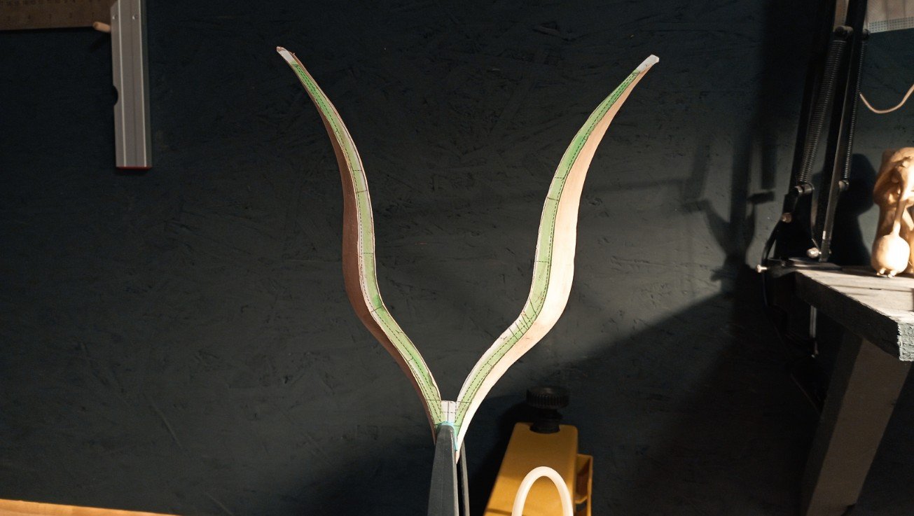

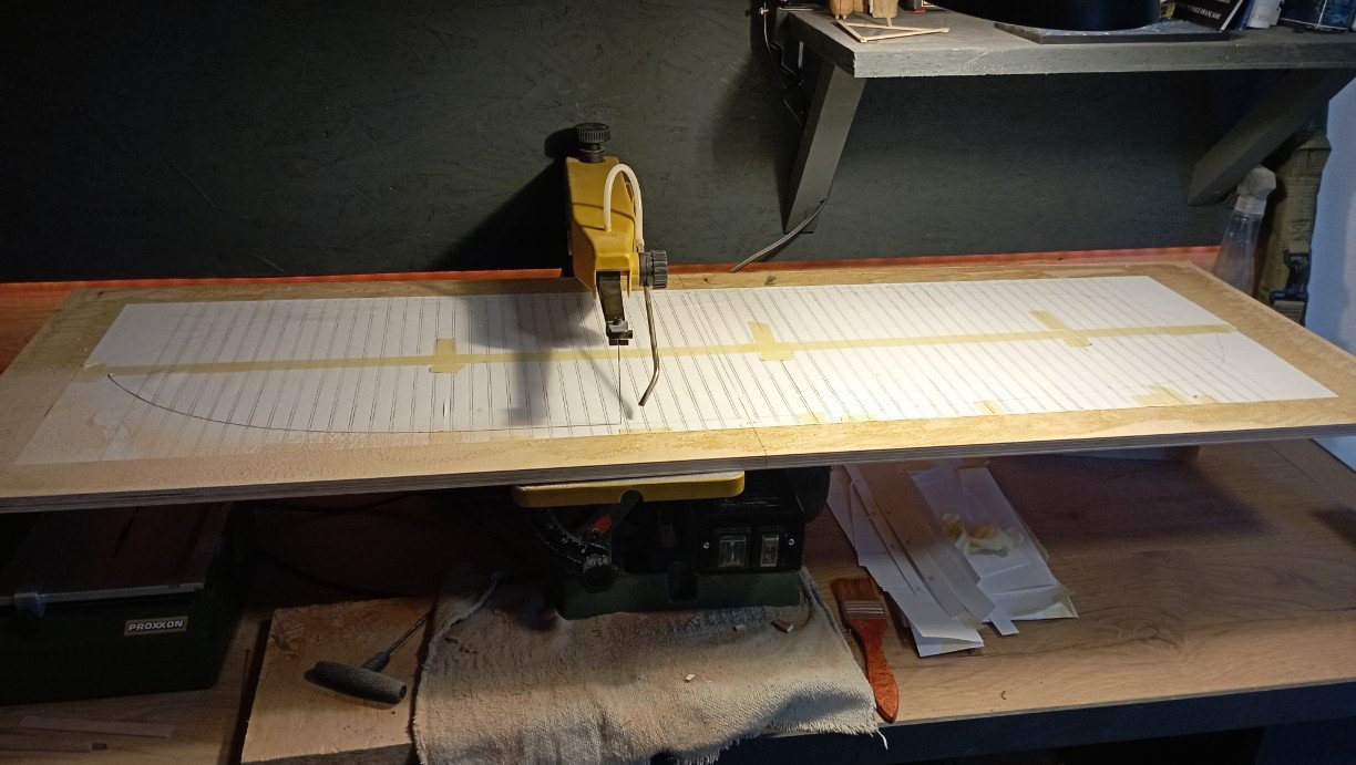

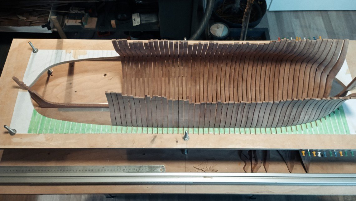

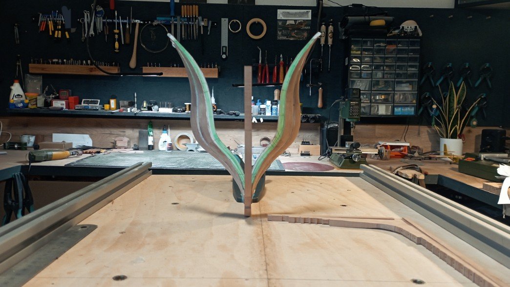

Thank you so much for your kind comments, I'm very pleased and motivated! I've continued transferring the waterline plan. The frames have also been transferred to it, the sheer board has been cut out, and everything has been aligned. This (hopefully) provides a good foundation for setting the frames.

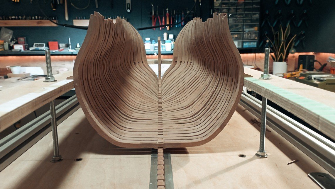

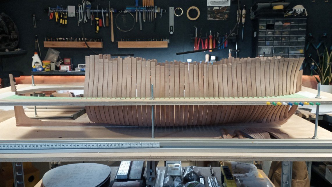

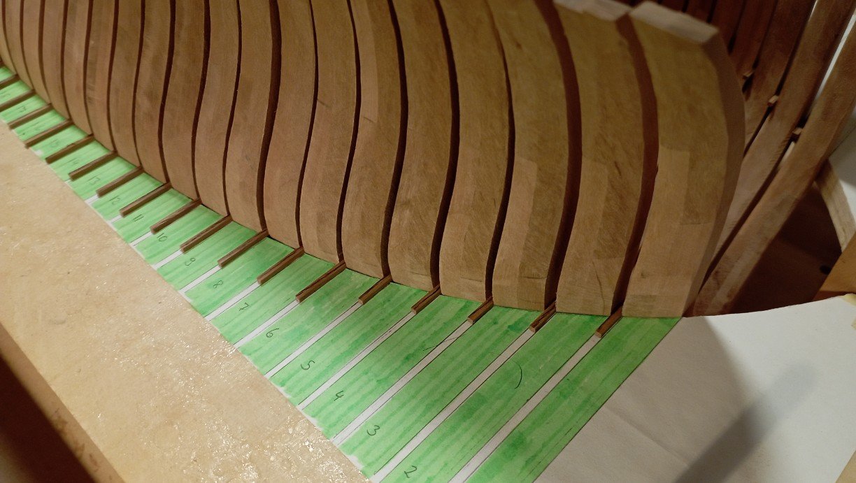

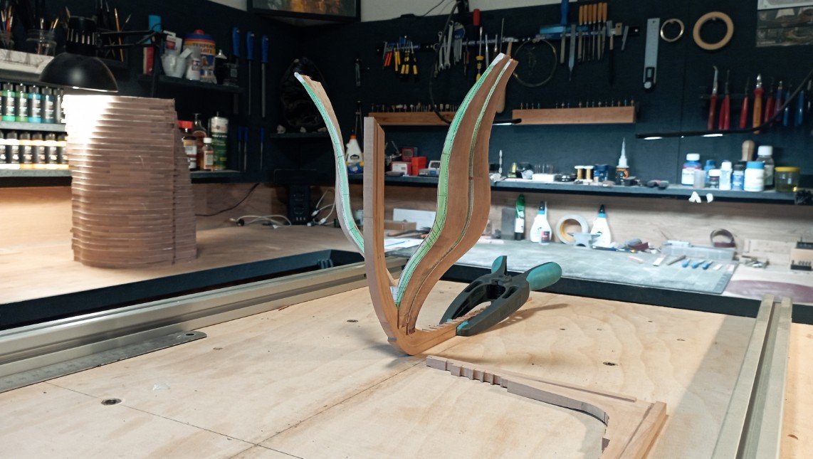

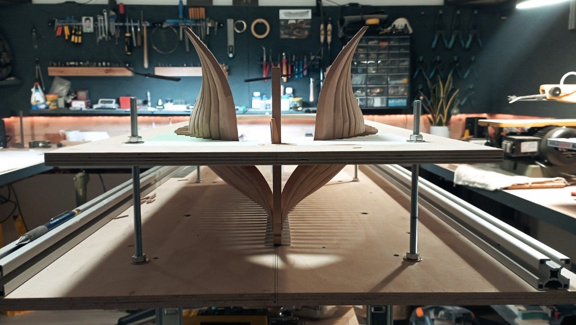

Hello everyone!
Thank you so much for your kind words and interest. 😉

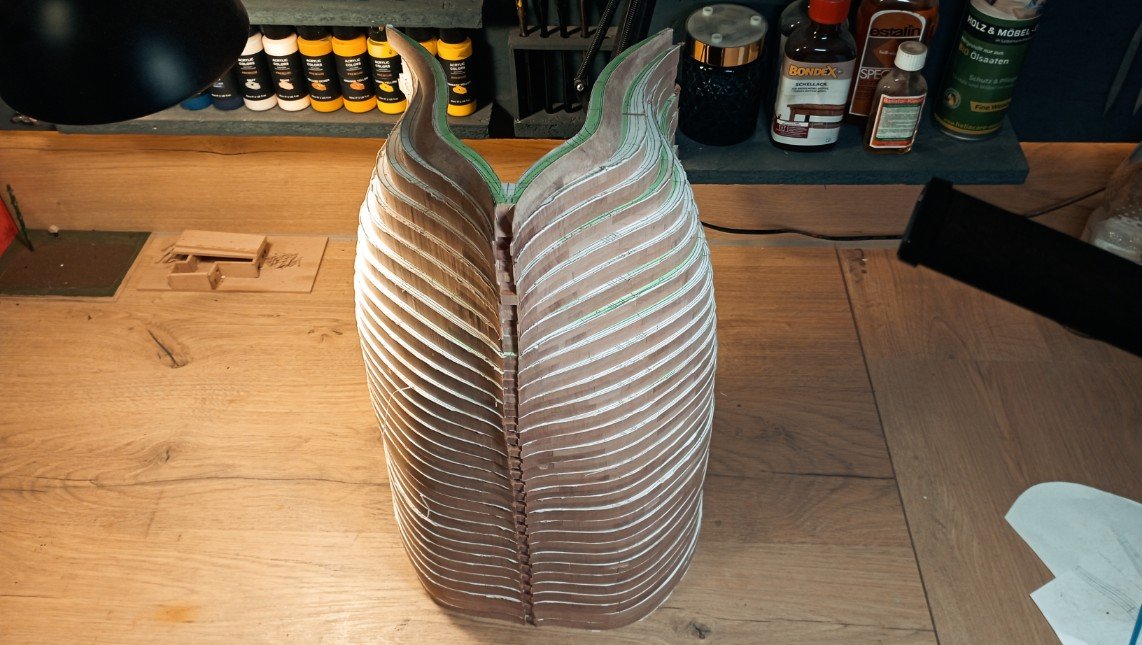

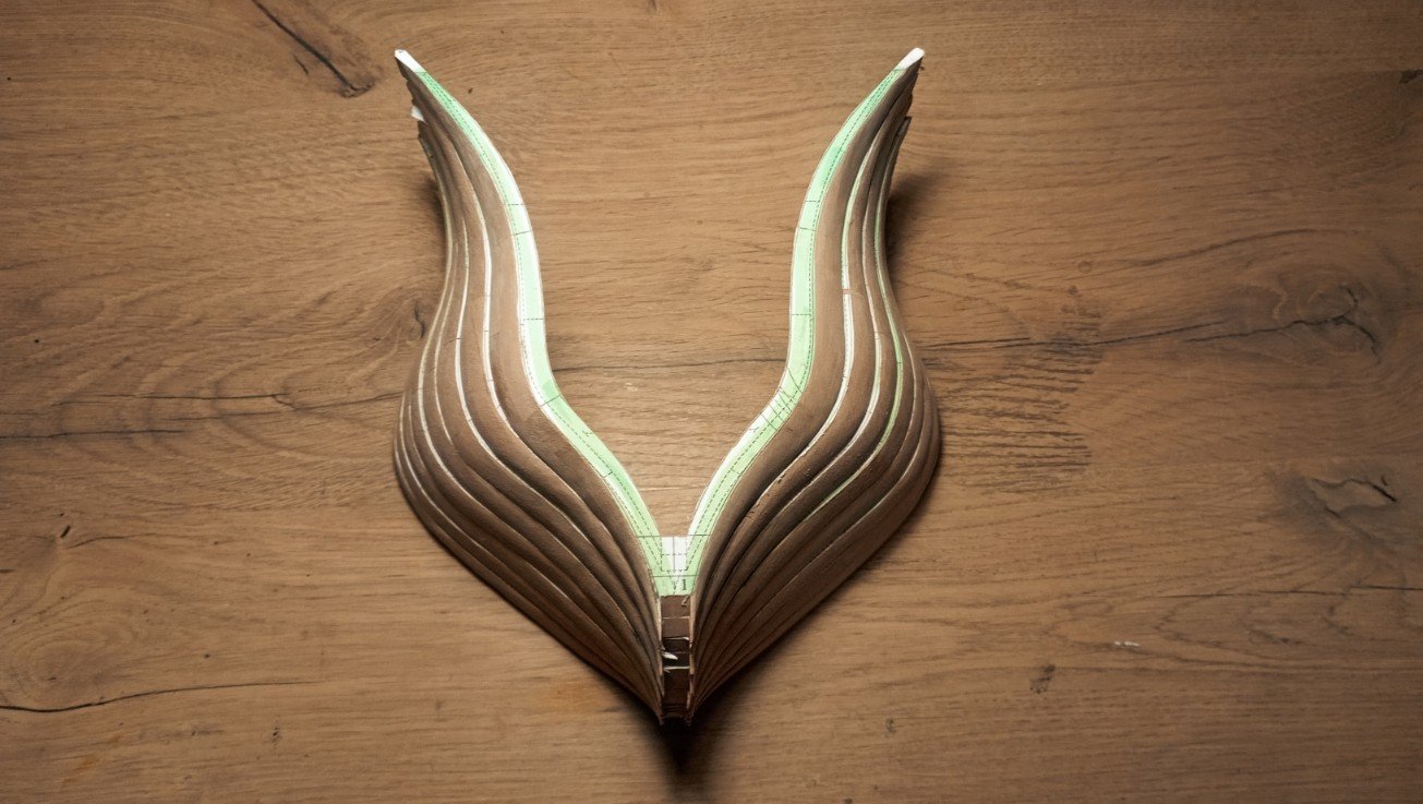

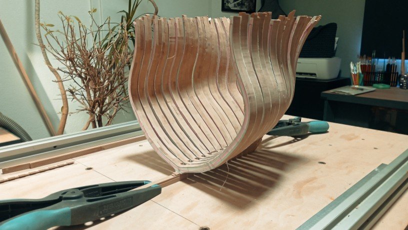

The construction of the frames is progressing well.
I have a quick question for everyone. It concerns the infill pieces between the frames that have a drainage groove. These positions aren't marked on the plans. However, I assume the A'rtésien also had them. Is there a specific arrangement or position for these drainage grooves?
Source: La Vaisseau de 74 Canons J. Boudriot
