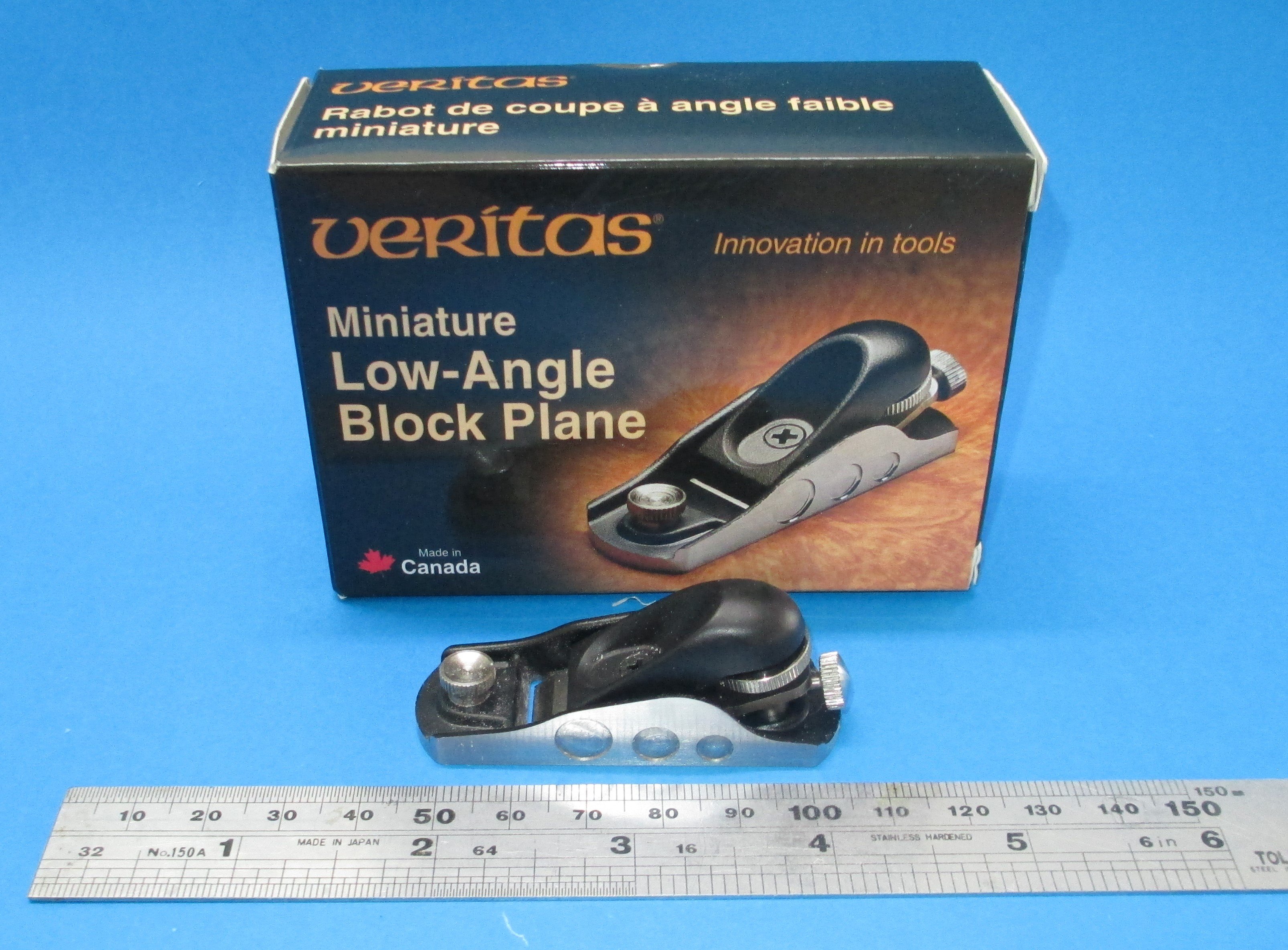

And Ian has a good point, that miniature Veritas block plane is another go-to tool involved in most of the operations :)

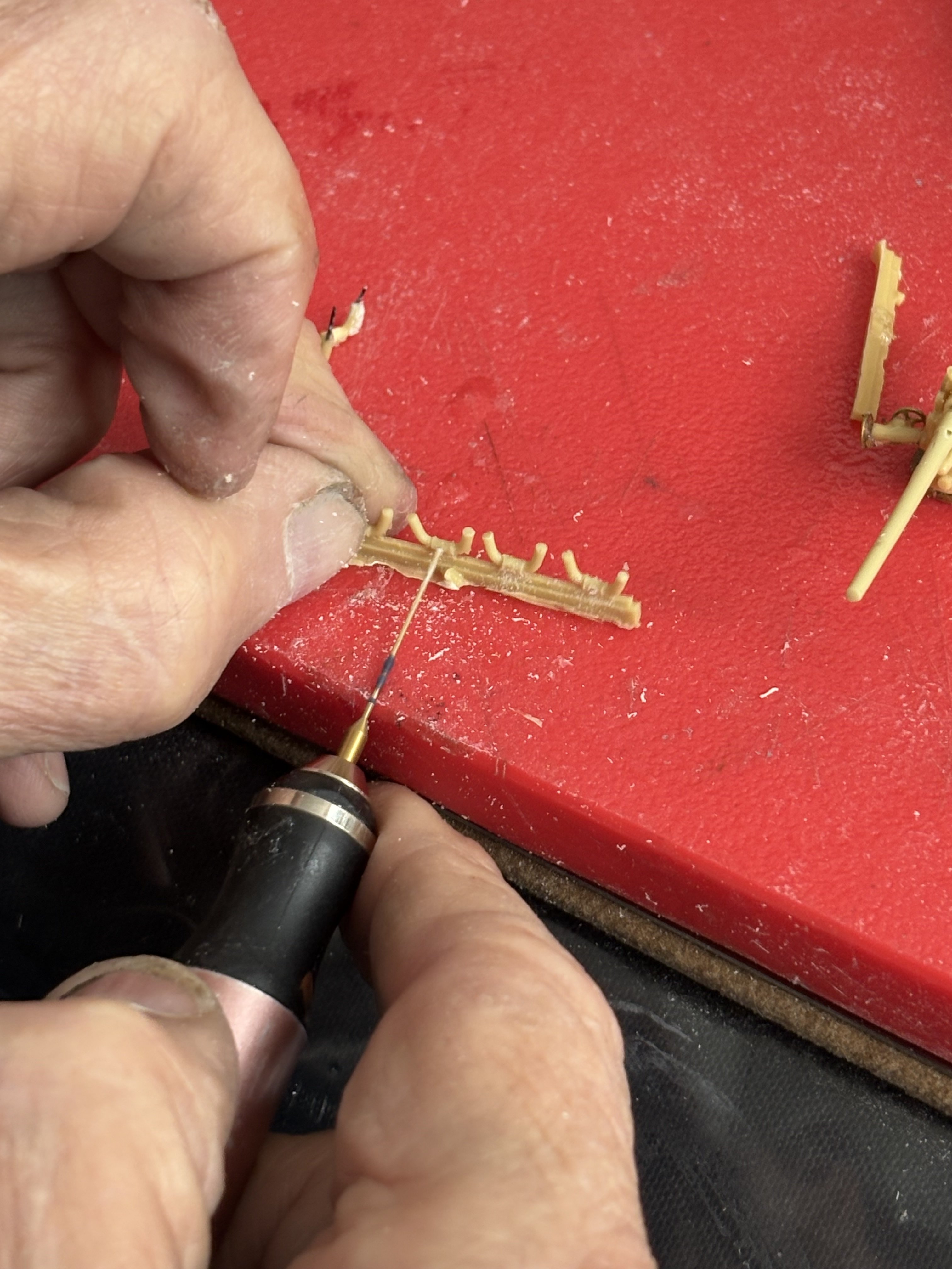

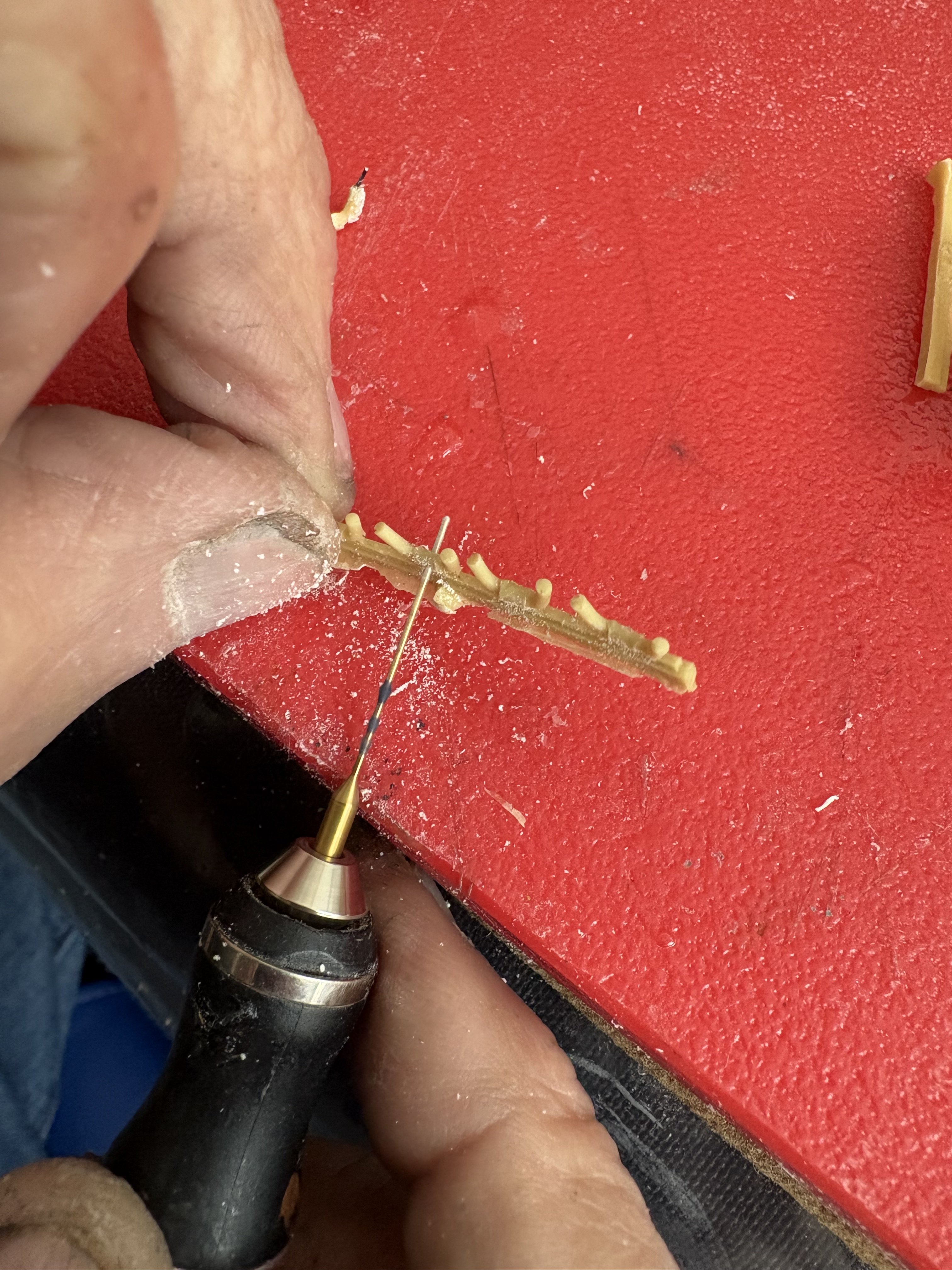

If you are looking at a Proxxon table saw very pricey. The Micromark Microlux is the same table saw only cheaper. I got mine on eBay used for $130 and it works fine. The tool I use the most is the engraving drill pen which sells for about $19 on eBay and comes with micro drills and about 15 diamond bits for shaping etc. When I was assembling the guns for U-47 I drilled parts to pin that were smaller than 1mm on diameter and the drill performed fine. Mine is 4 years old and still works great. IMG_4353.thumb.jpeg.1ebd79482dfb2a9dd57ac2ee148b3aec.jpeg
