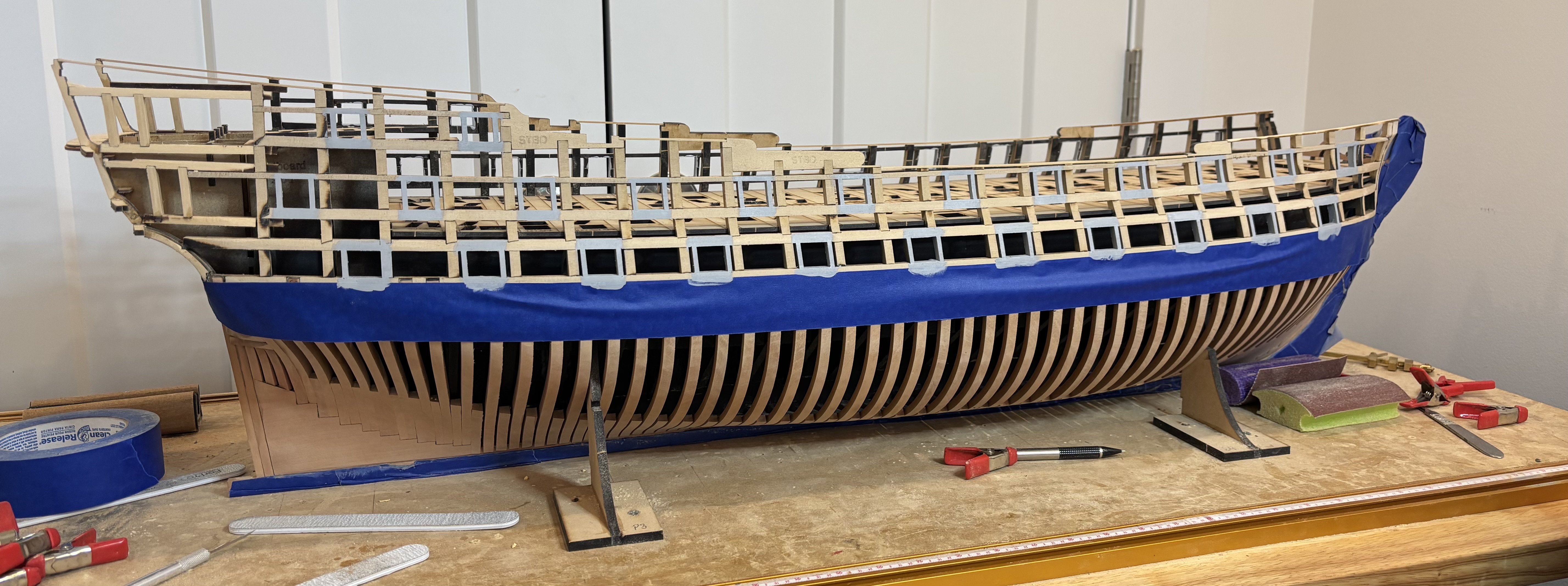

Upper hull sanding and fairing has been completed so I masked off and starting prepping the gunports for paint.
First any little gaps in and around the ports were filled with filler and then sanded gently back and then two coats of Tamiya surface primer was applied, next up will be painting the ports in red ochre, then fitting the frieze panels and finally to complete the lower hull sanding.
