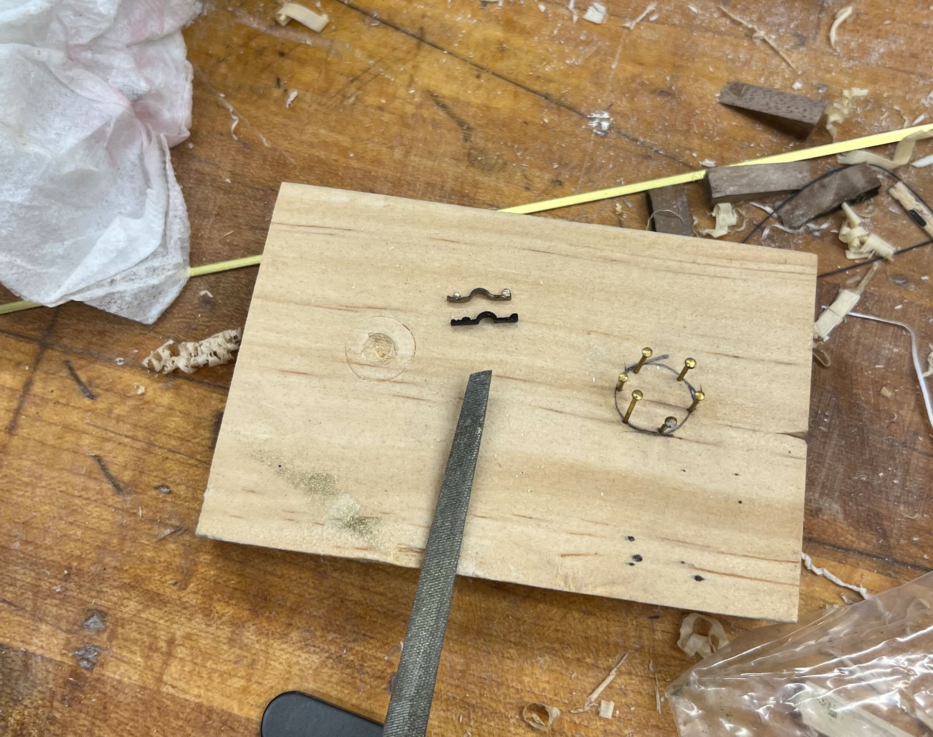

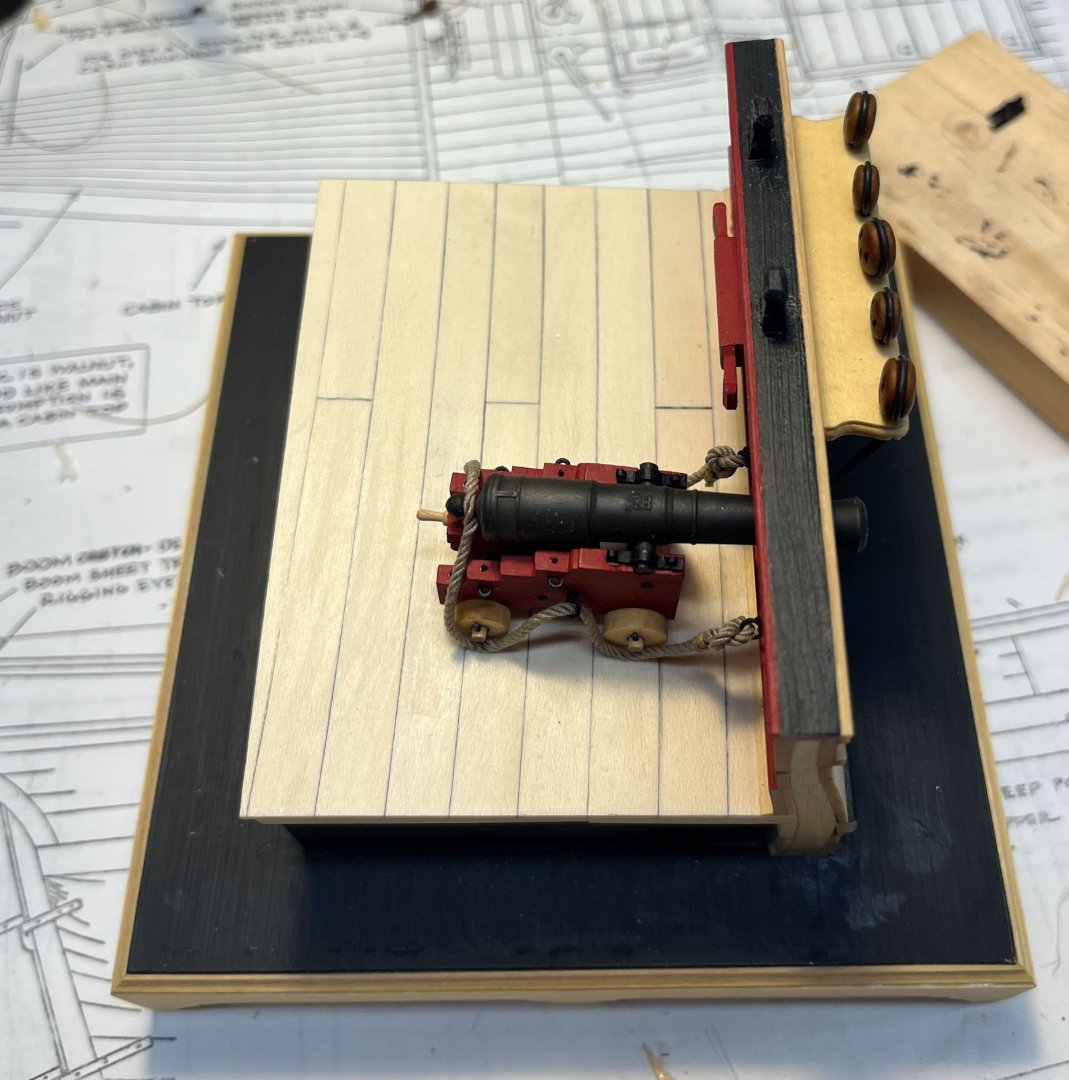

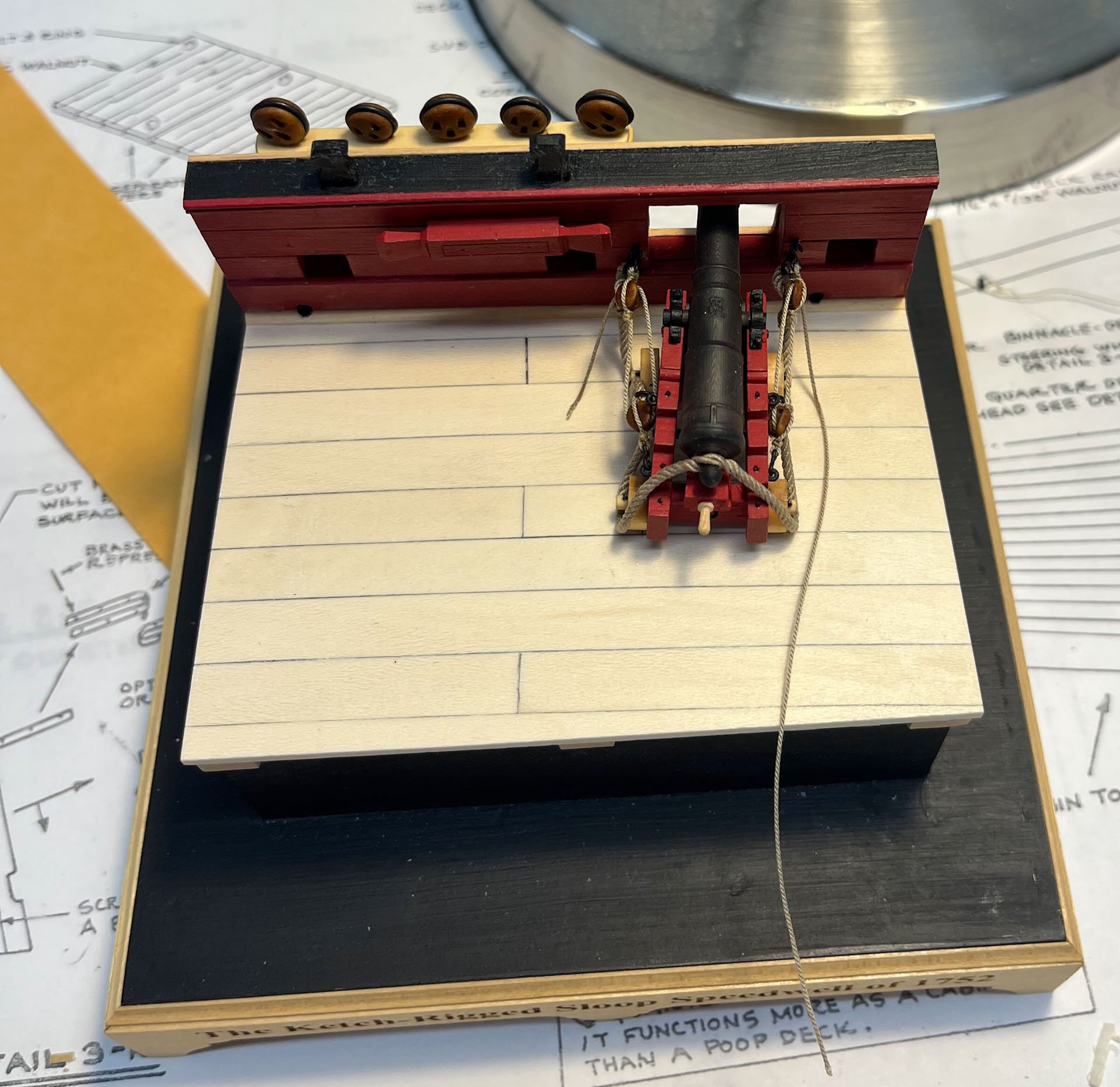

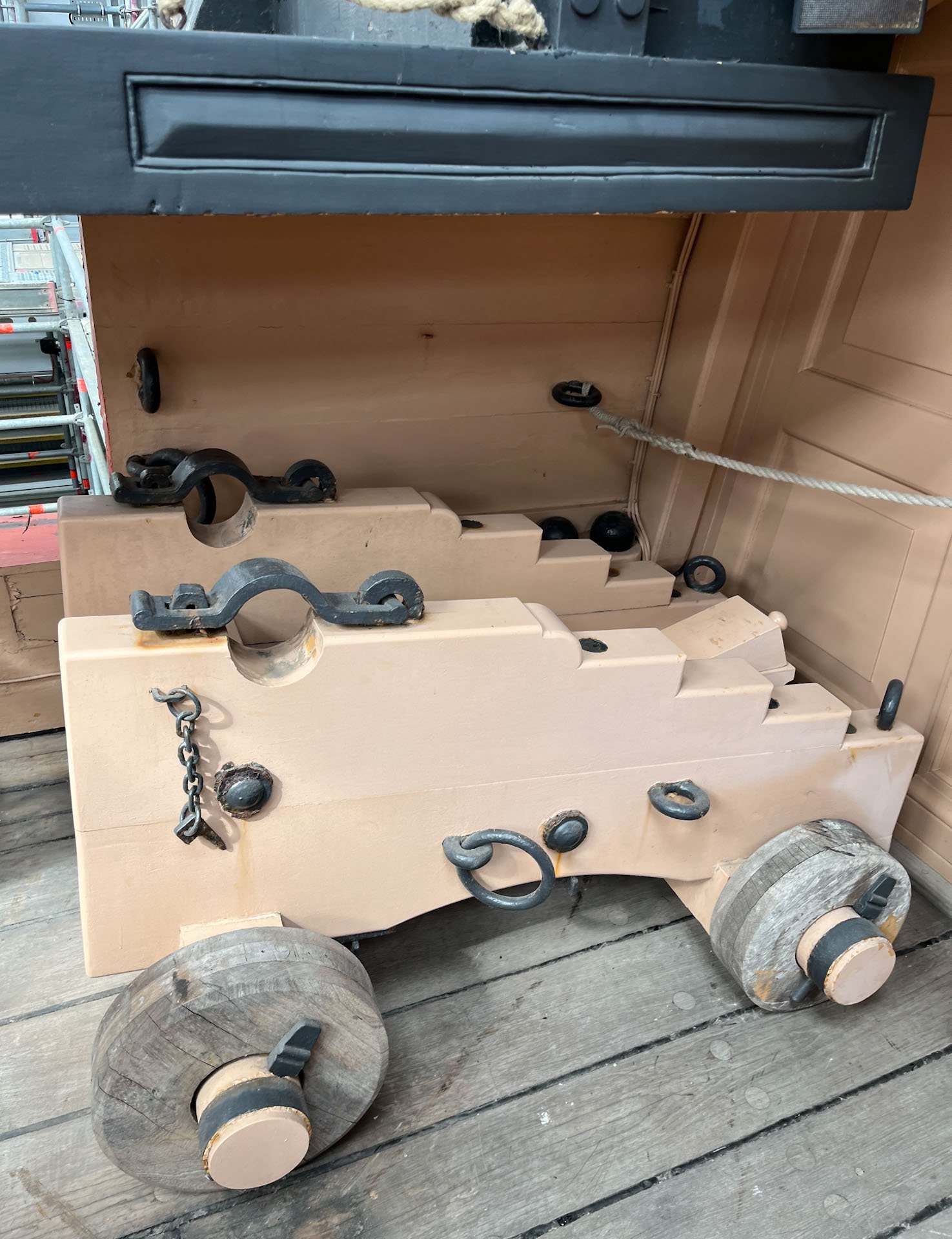

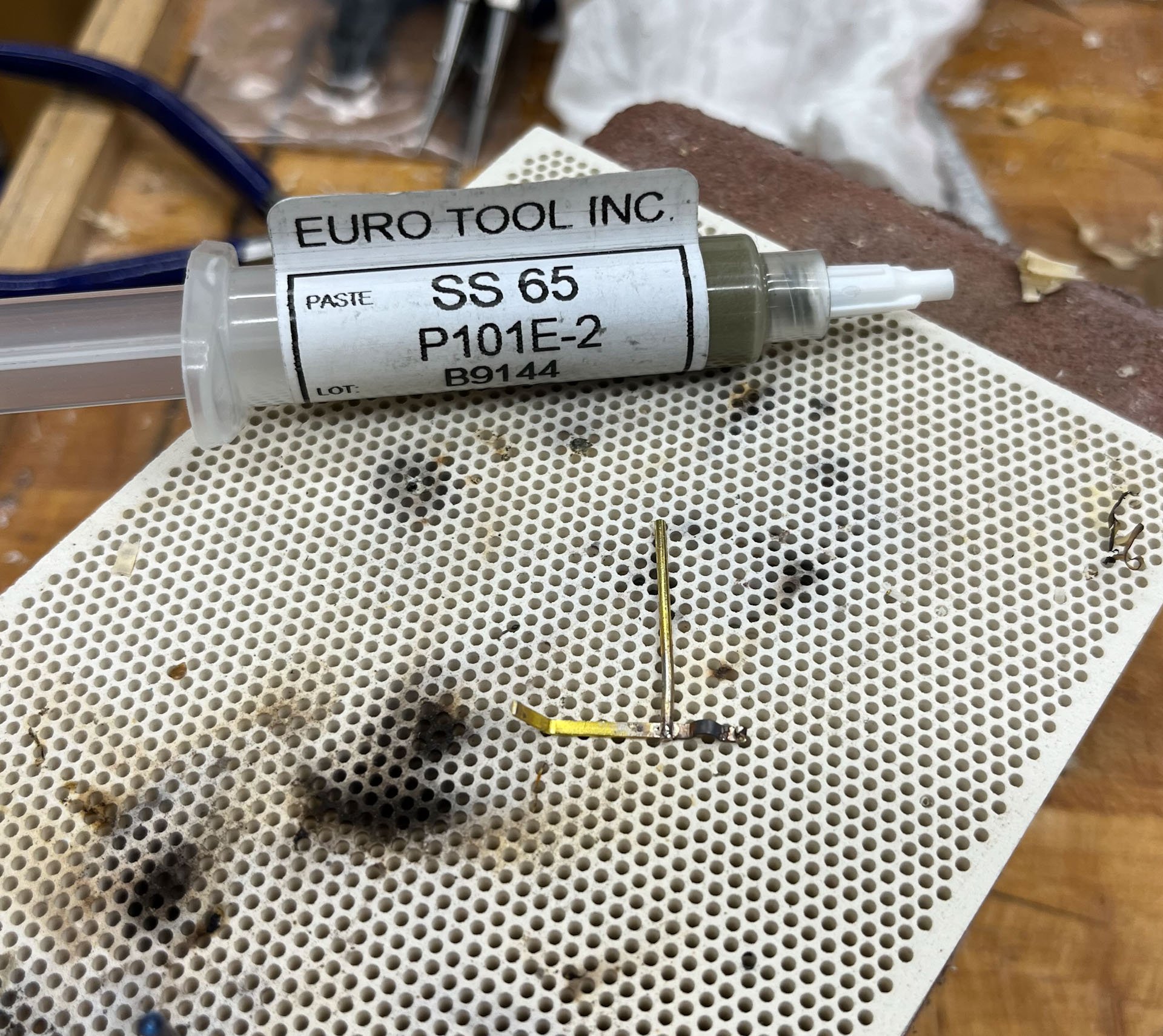

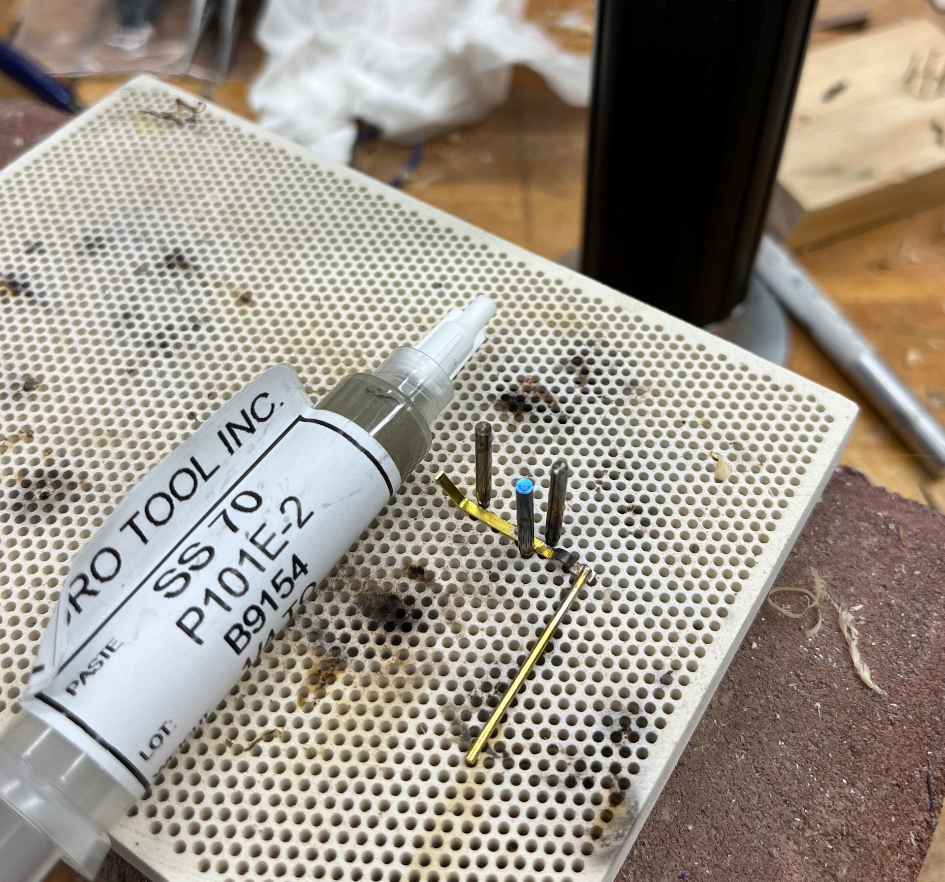

Good afternoon; Today's post is about Capsquares. The kit comes with a sheet of laser-cut ones which look amazingly good and I was going to use them. But I had bedded my cannon trunions to shallow so they stuck up too high and the kit capsquares wouldn't seat. I had already glued the cannon into the carriage, which was also already glued to the decking. Thus I decided to make my own capsquares. I had the below pic from my visit to Victory in August I started out with some strip brass which was hard to find. Thank goodness for model railroader supply sites. I bent it around a drill bit sized a little smaller than the trunions. This was a great time to try using 2 different temp silver solders. And amazingly it worked. I was shocked. First I soldered the hinge part using the higher-temp solder SS70. This was trimmed flush, then the locking part of the capsquare soldered with the lower temp solder, SS65. You have to watch for the flash as the solder melts and take away flame immediately. I couldn't believe it worked. I used the same size brass rod and filed both down to the approximate shapes. As usual its almost impossible to see details in a part this small once its painted black but I thought it looked good. Below is a comparison- the kit plastic capsquare is below my homemade one at the top. Pretty close. and here they are superglued to the carriage. Next up I attached the blocks and ropes and prepared to make separate rope coils. I superglued the rope ends to the deck and I think they're too far outwards. I plan to reglue them closer to the carriage so the blocks aren't twisted horizontal, and try to make the lines a little tighter. Except my son came downstairs and was examining my extra rope which was ready to become coils, and now the rope is gone. I have looked everywhere and no luck. So I ordered more from Chuck yesterday - its tan 0.018" if anyone has a similar experience. Here is a shot of the 2 suspects in the disappearance: Both look guilty to me. Next up is trying my hand at painting the figure that comes with the kit. And awaiting the mail from NJ. thanks for reading Cisco

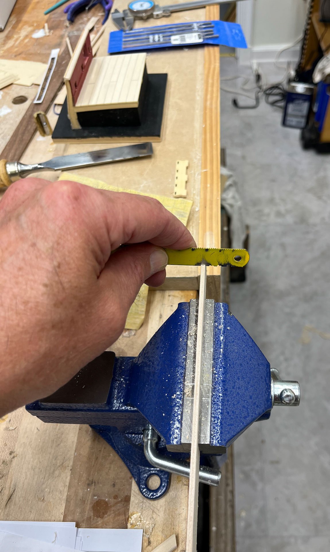

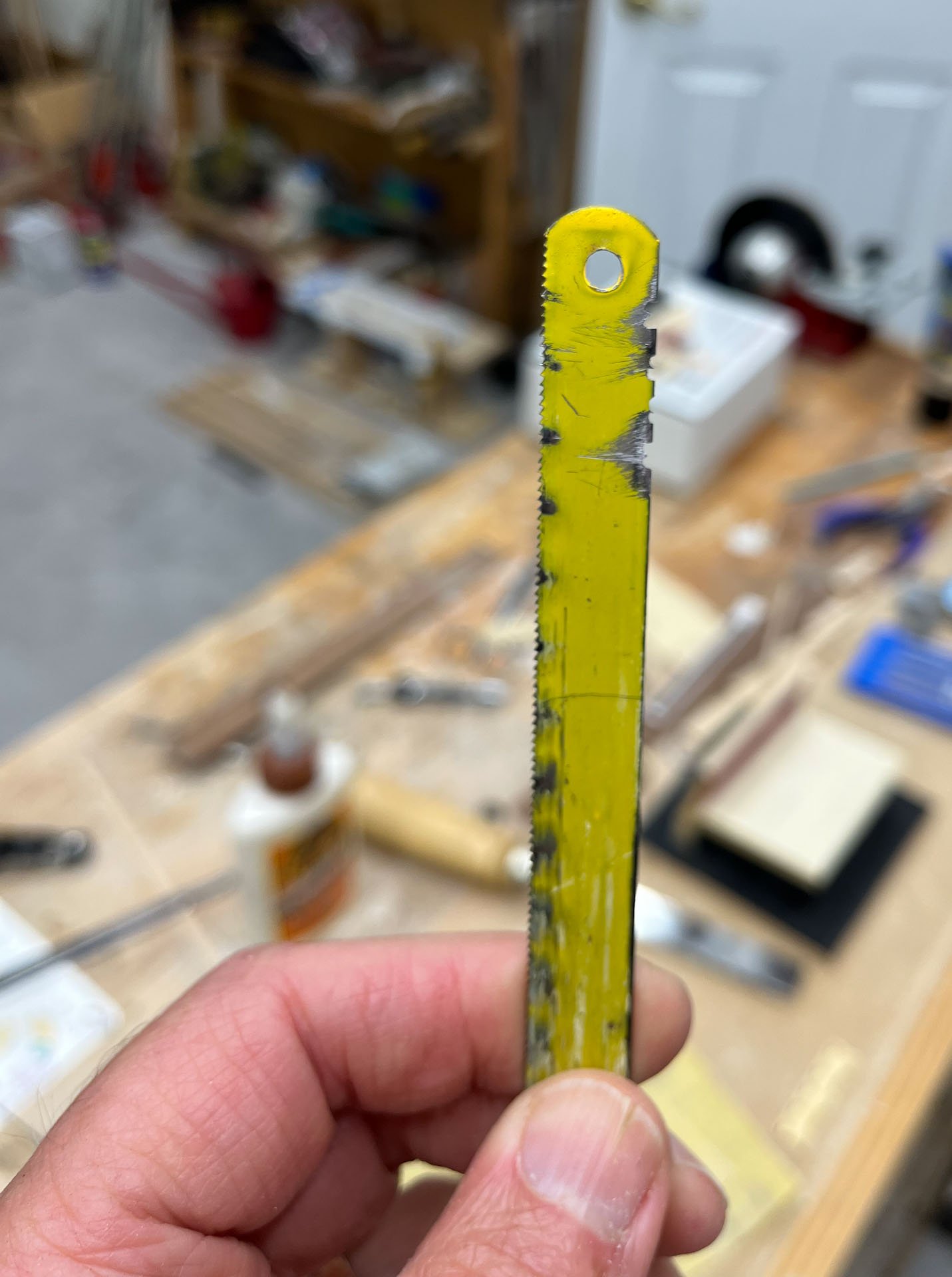

how did you shape your scraper? in the past i have used a dremel wheel and fine files. its easy to (or hard not to) make the concave sections too big
