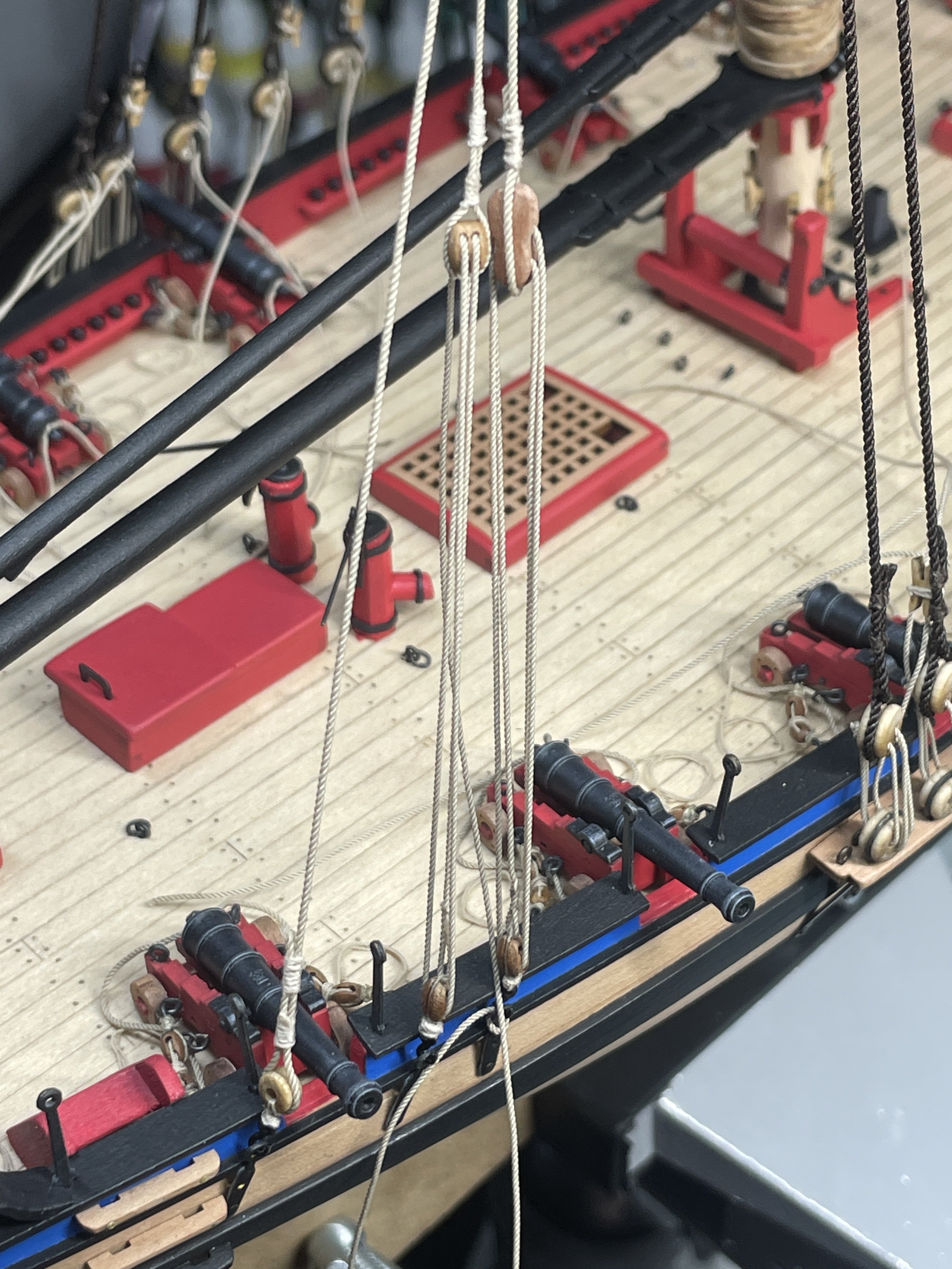

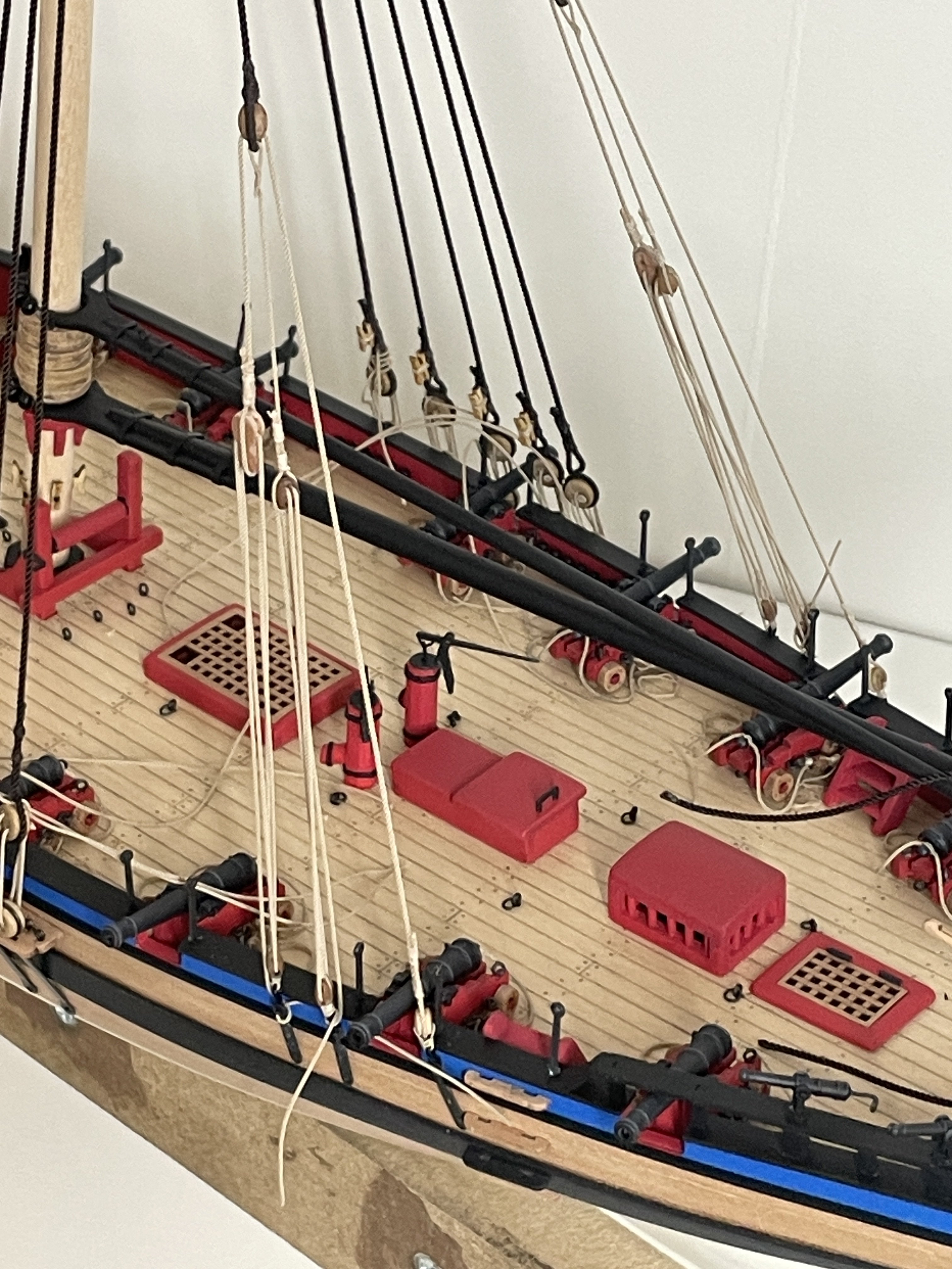

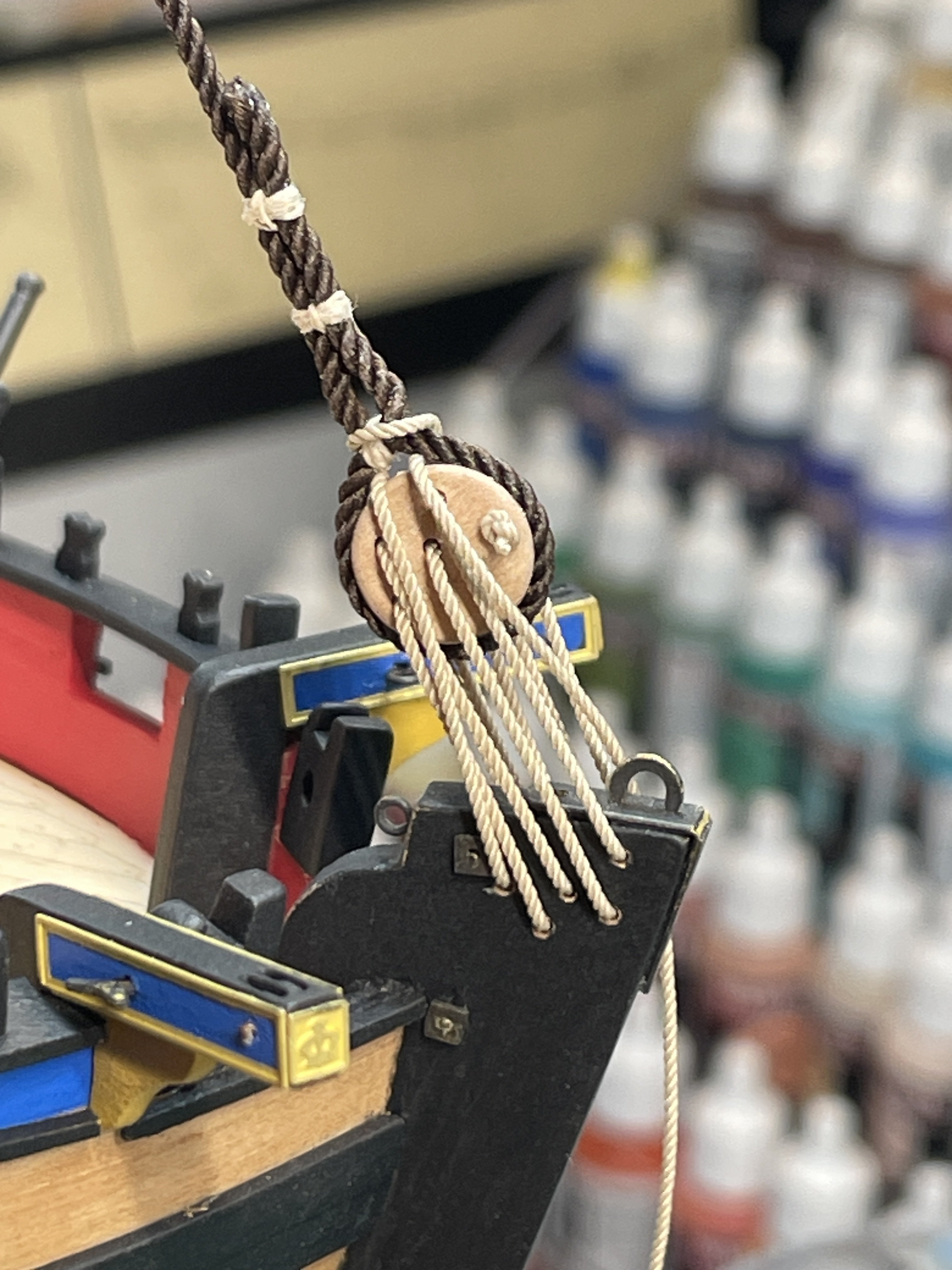

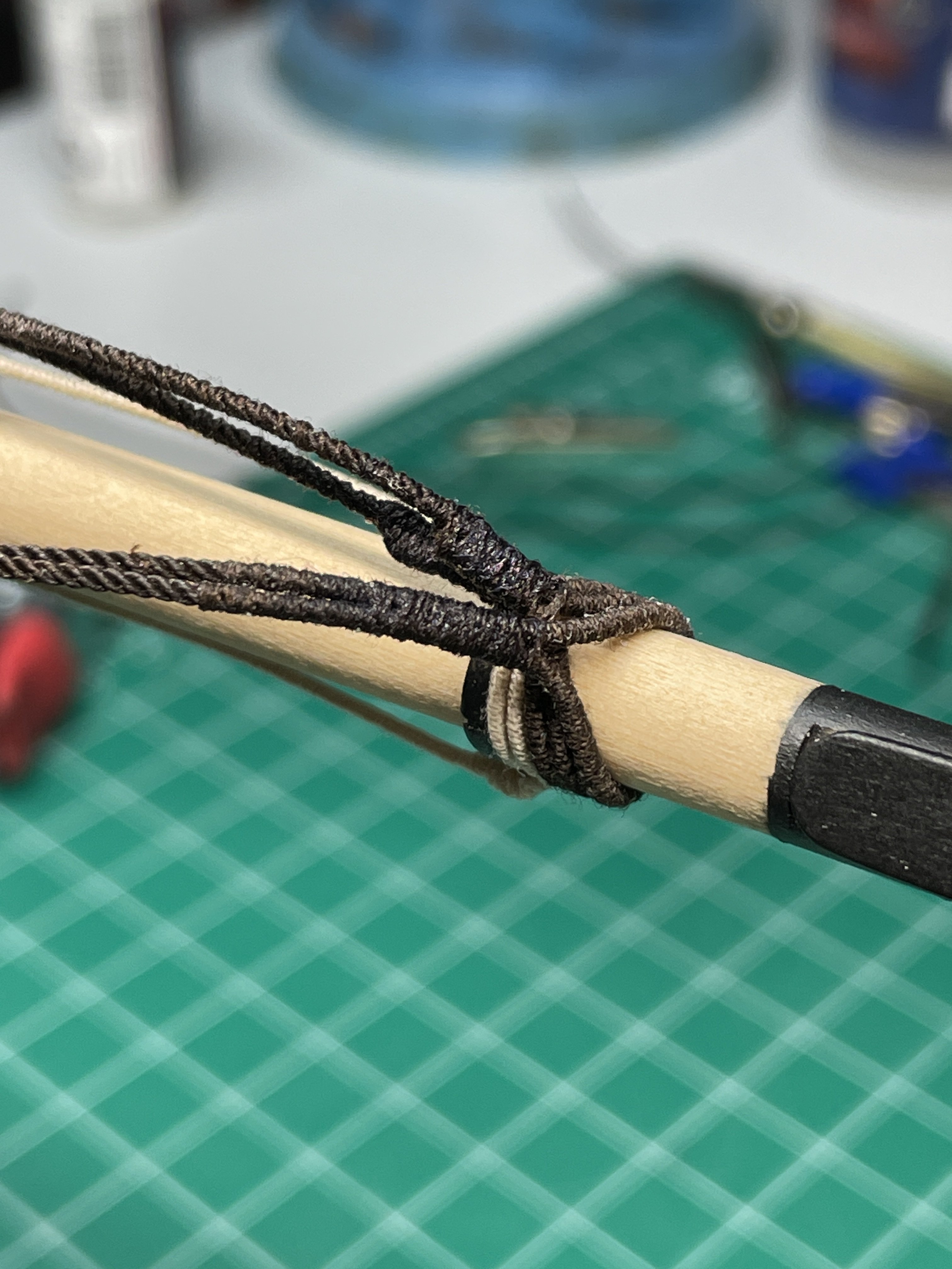

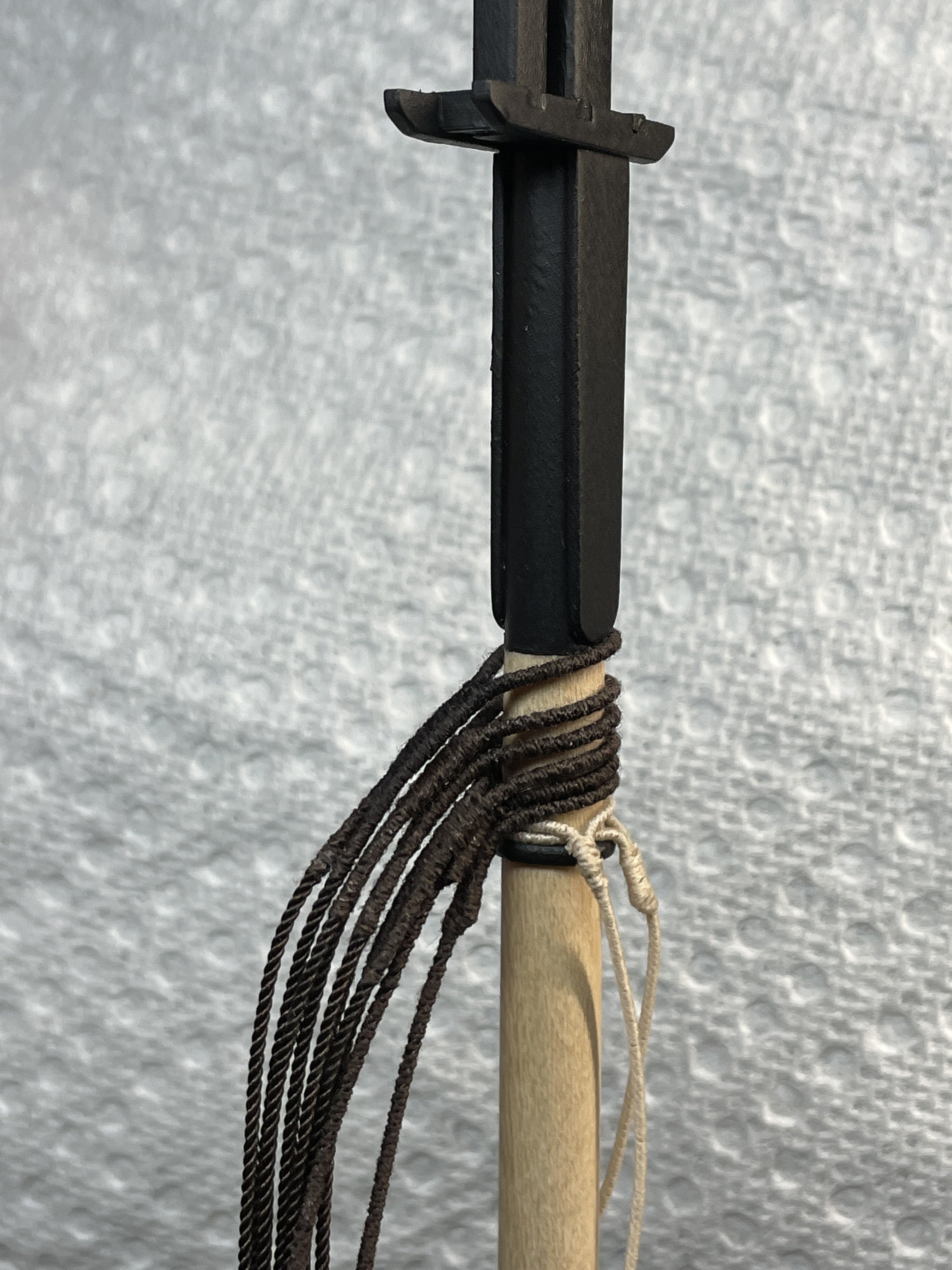

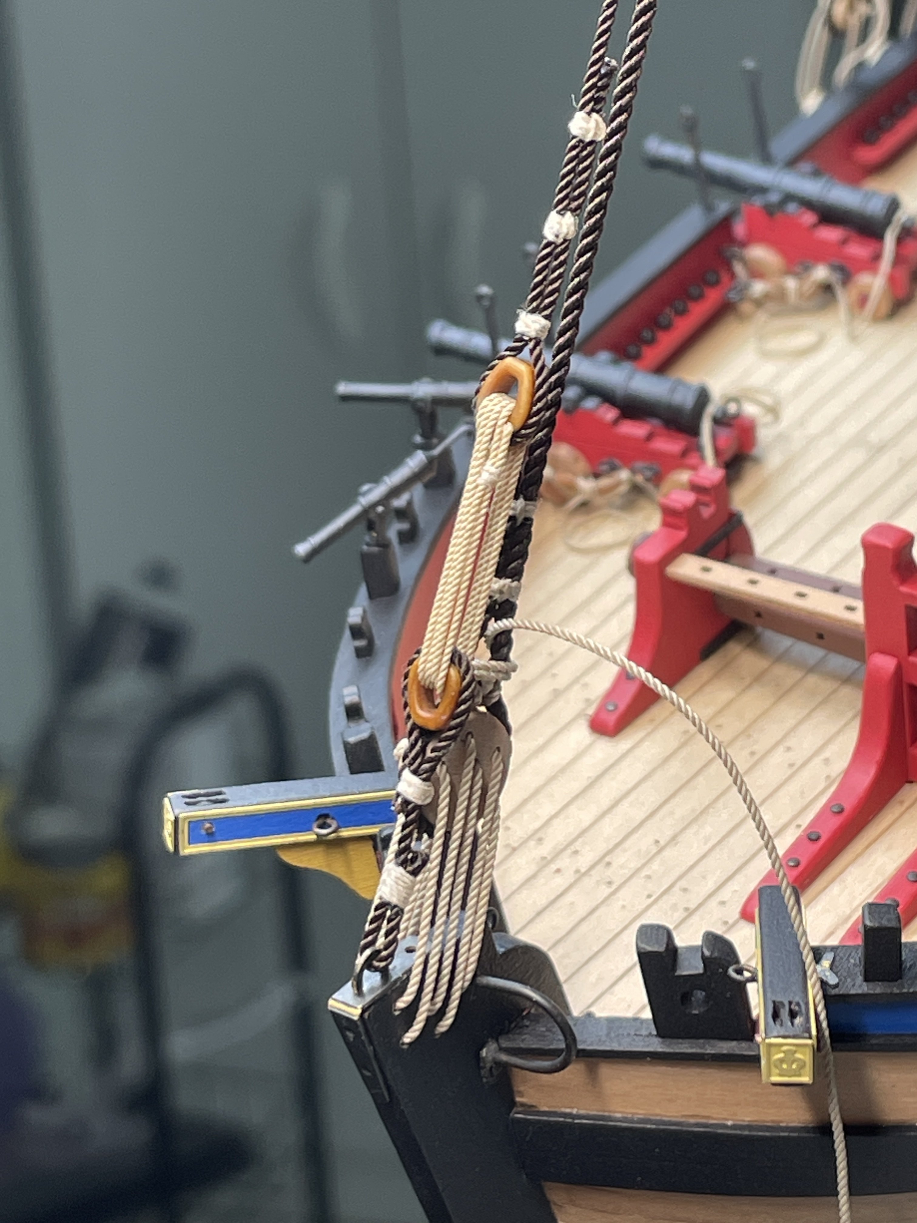

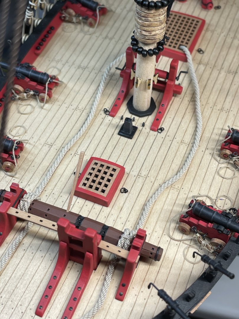

It’s been a minute since I’ve updated. Work has progressed. I’ve now finished up the rigging and I’ve working on ideas for how to display it. So let’s get everyone caught up with some photos! Here I’m working on the backstays. Along with bringing the gaff into the fun. Getting the shrouds tightened up. I didn’t use any jig while rigging the deadeyes. I did on Alert, but I decided to just eyeball this one. They are a tiny bit off but I think I was able to get them all lined up while tensioning the shrouds. Starting to get the bowsprit sorted. This one made me a laugh and cry and everything in between. Generally I’m quite careful, I move around the ship methodically and rarely break anything. I swear to whatever is holy in boat building…. I think I reattached that bowsprit no less than six time due to me knocking it off!! The traveler.. I put the clip on there and then went over the ropes with matt medium to hold them straight so they look like they’re under some tension. It worked ok for a while but I think as I continued to futz with the rigging I kind of “broke” the finish on the rope so I probably should redo that. Now it time for my nemesis. Rope hanks….DUM dum. I’ve tried several methods I’ve found on here and youtube and they pretty much ended up looking one step above dog doo. Doing more research to give them another try I saw/learned an idea. That was that the there’s really no reason that the loop at the top needed to be the same piece of rope as the hank. That was always my problem area. So I tried a few things and came up with this jig and these hanks. I’d love to hear your opinions. This method makes the hanks all the same size. I’m not sure it that good. I know they should be uniform but should they be identical? I tried a few sizes of rope for the anchor and settled on this. I think it’s .8mm Shaping up the oars… I decided I would paint the oars so I used the kit versions and didn’t bother making them from boxwood. I’m again emulating @BobF’s build log in the manner that he displayed the oars. After one false start, some new flux and solder I finally got a design I like. So that’s the latest. Next up is the cherry base and acrylic cover and I think we’ll be calling her complete. Thanks for stopping by! Chris

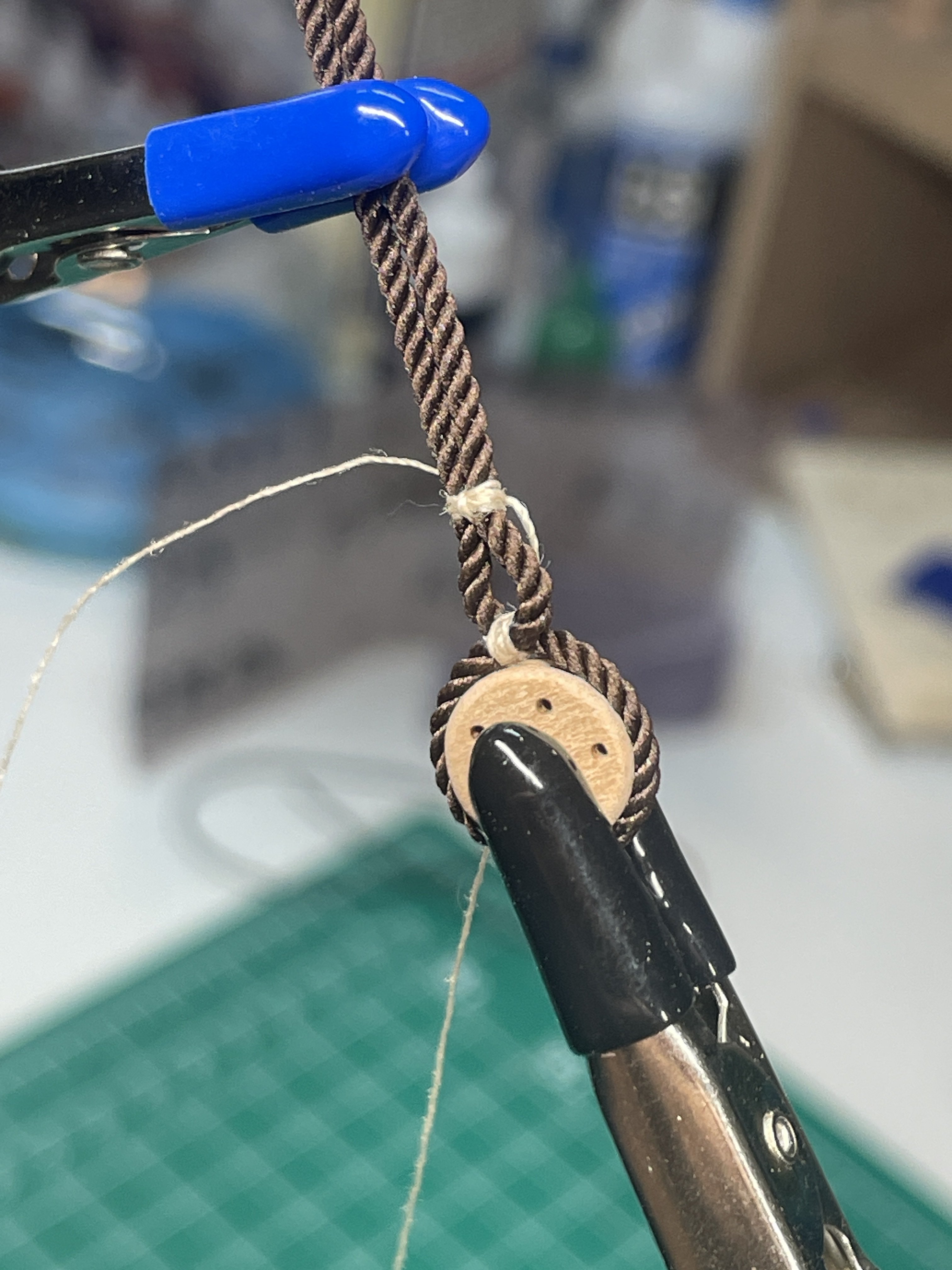

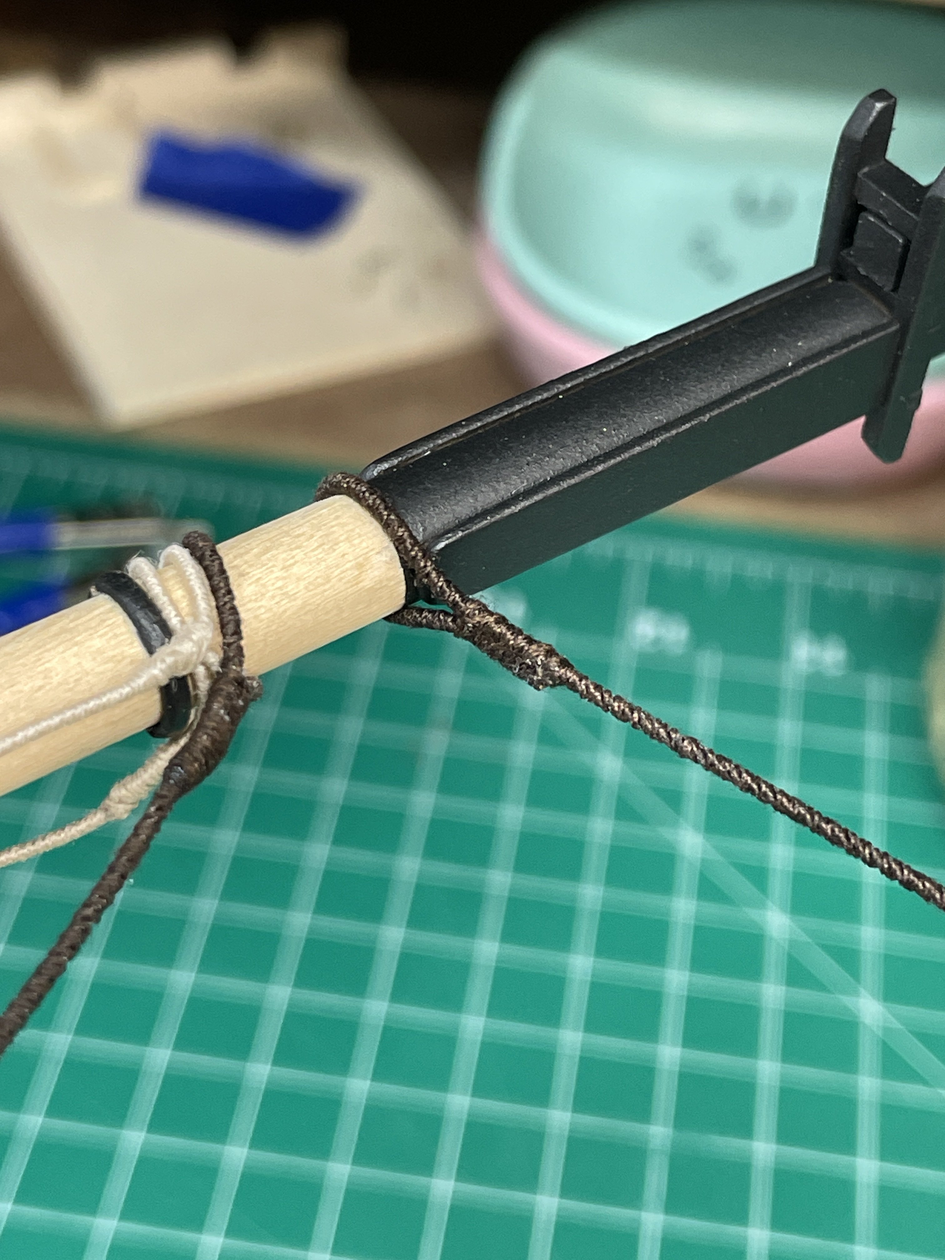

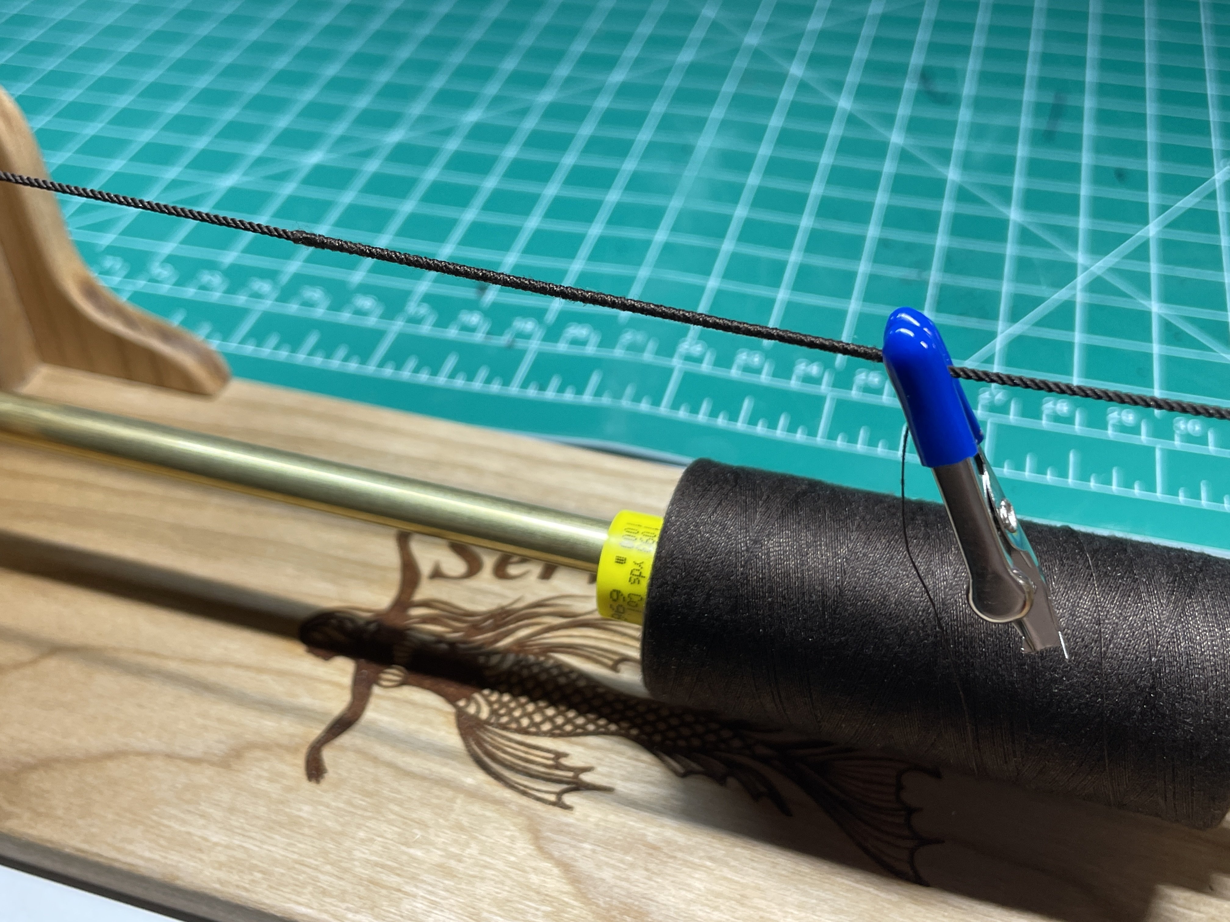

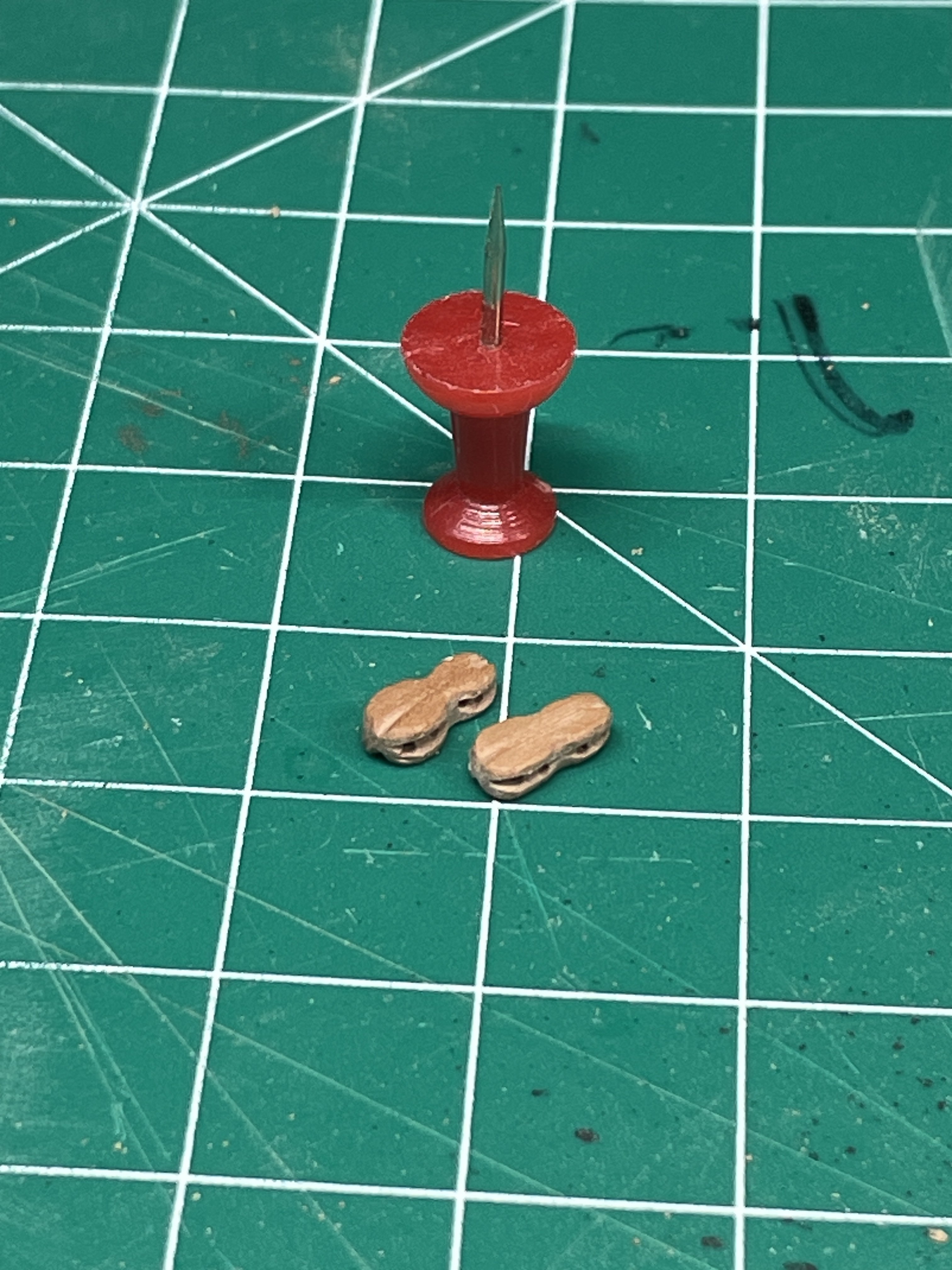

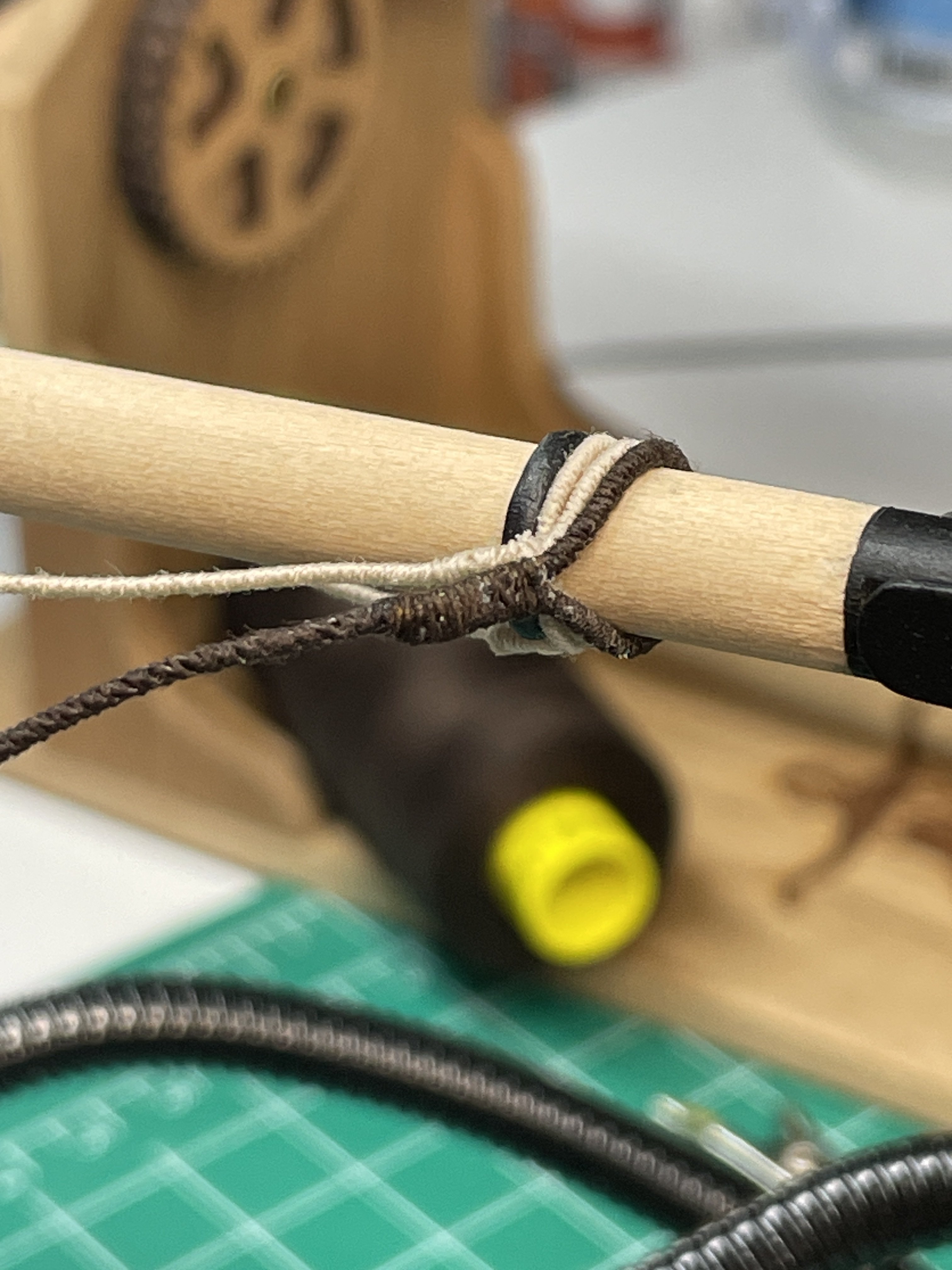

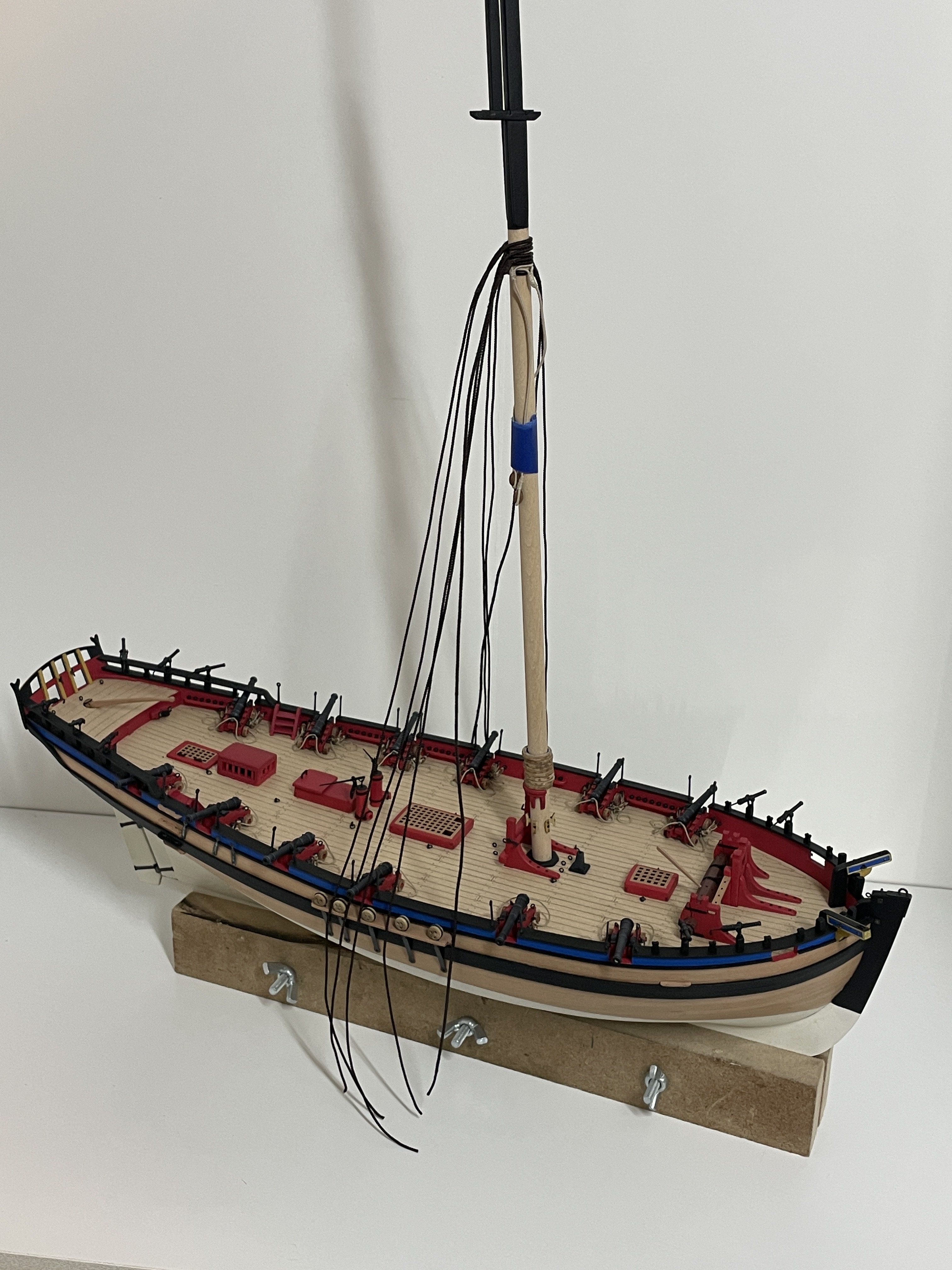

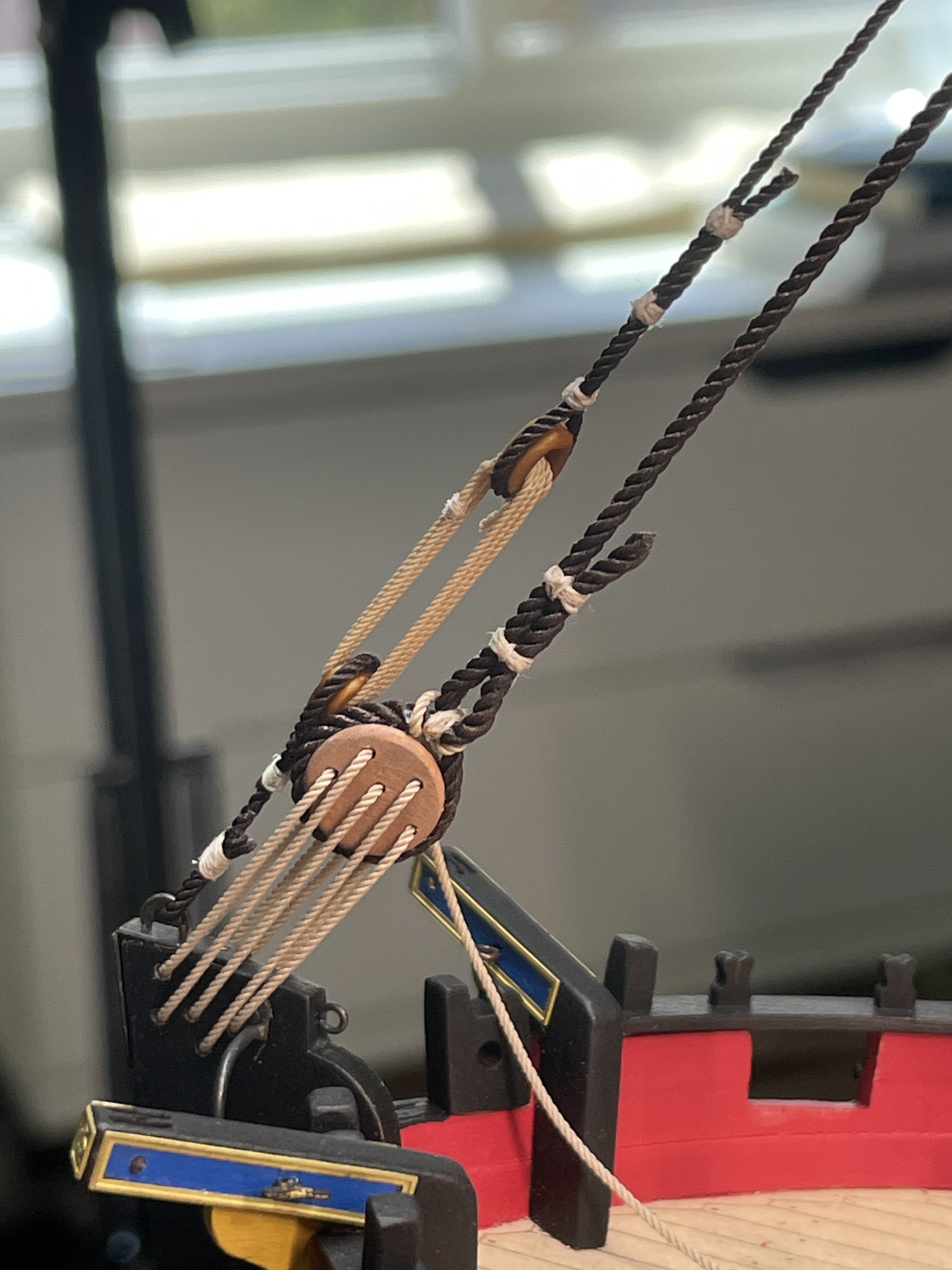

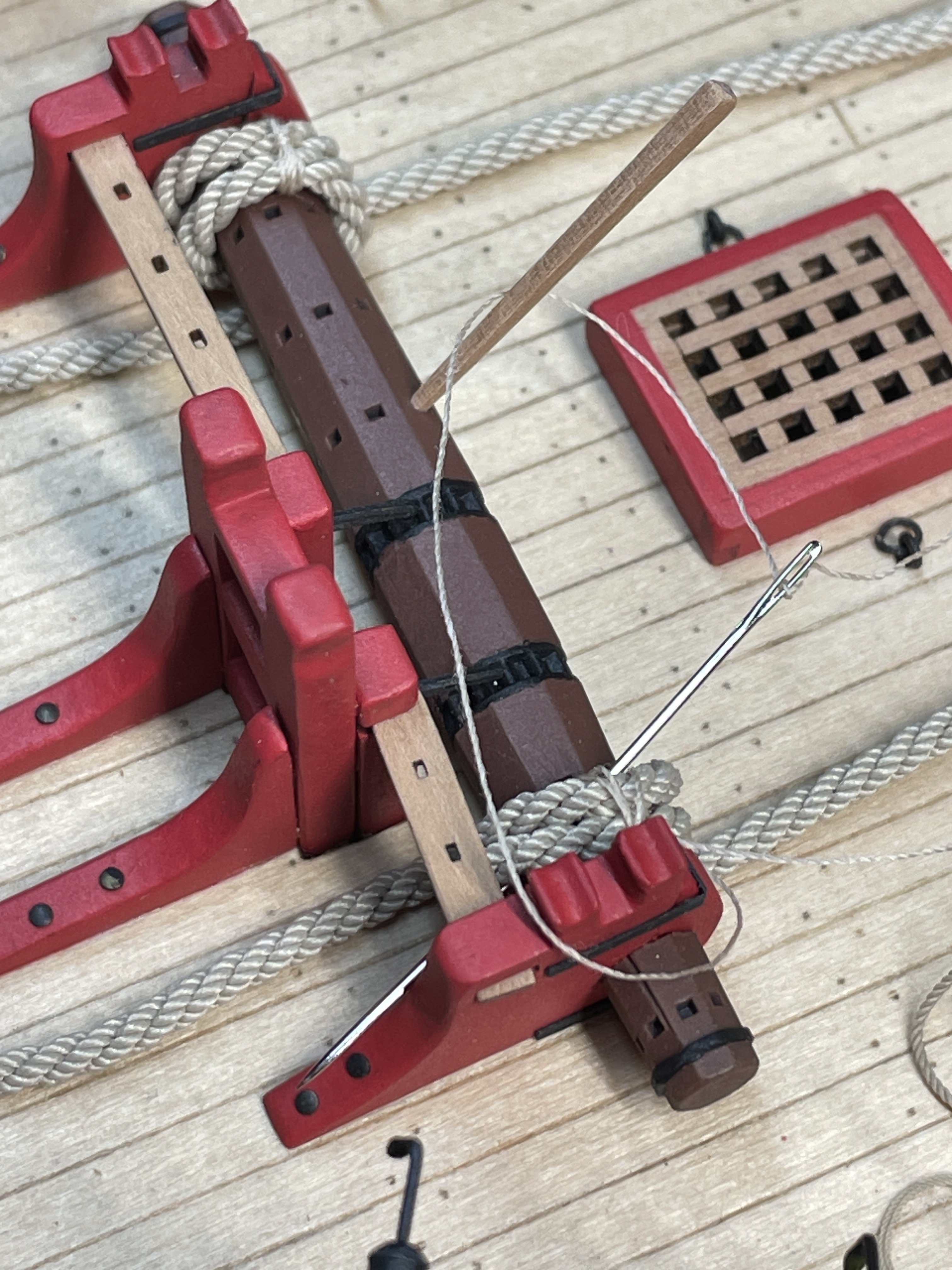

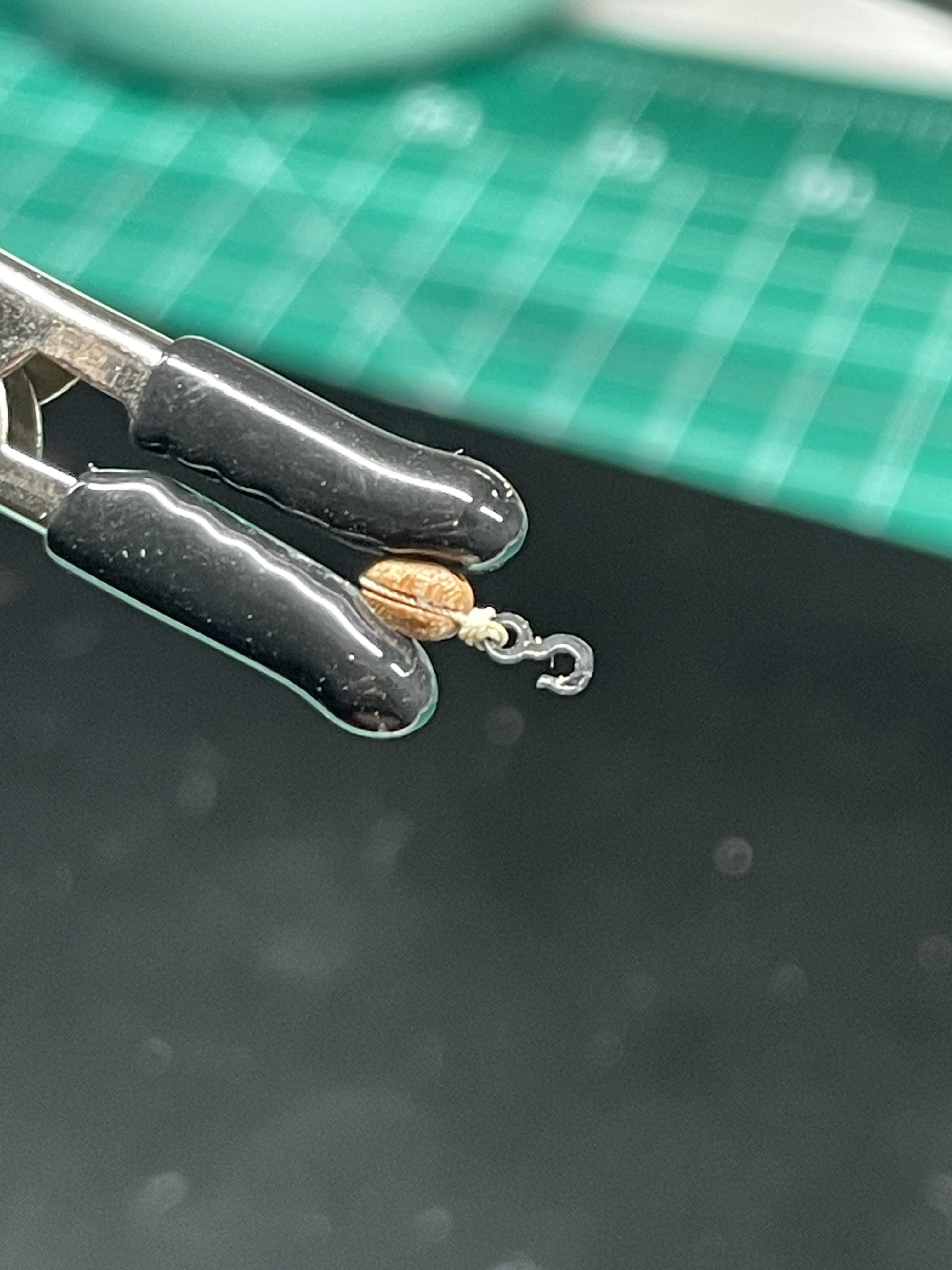

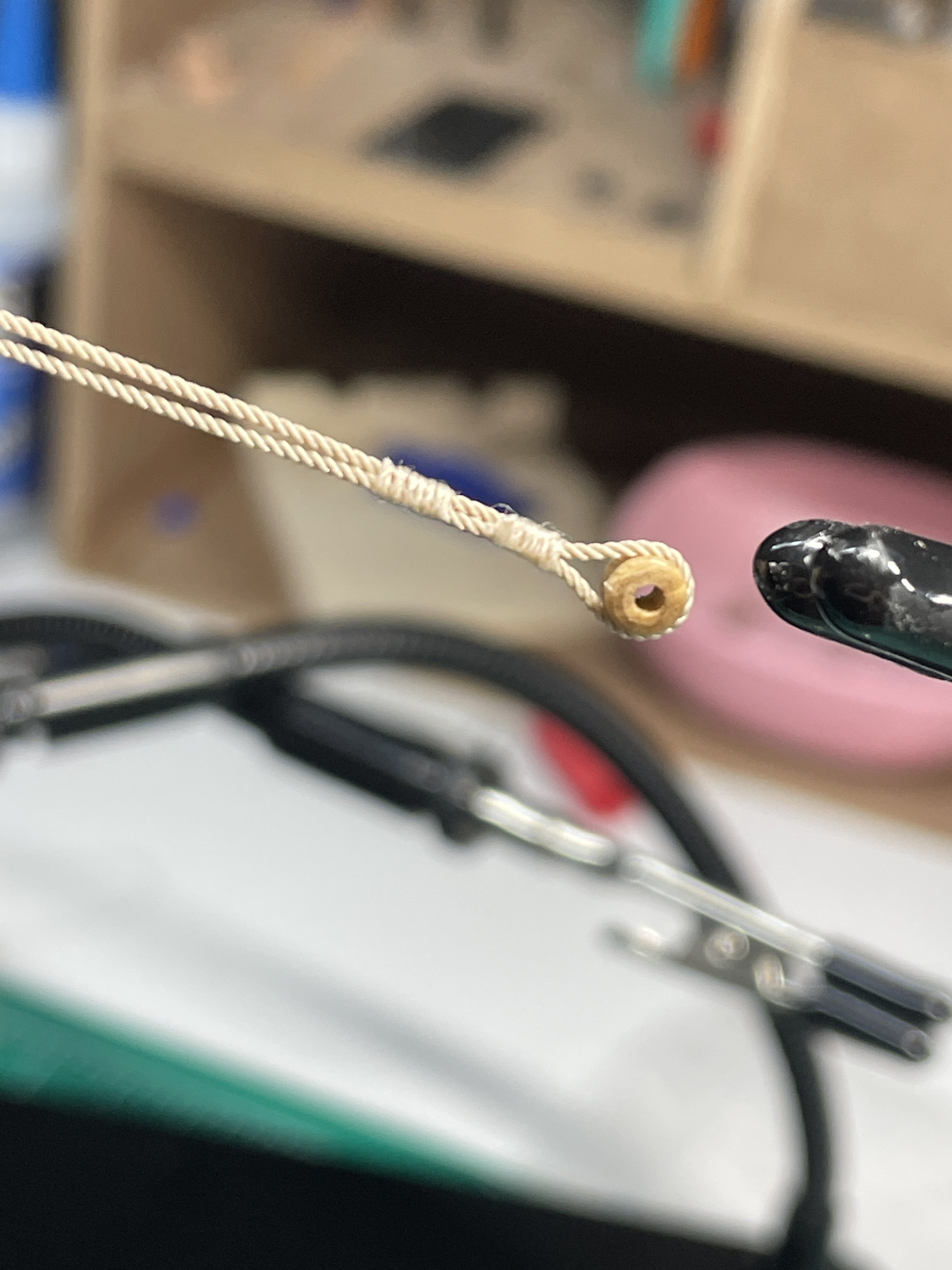

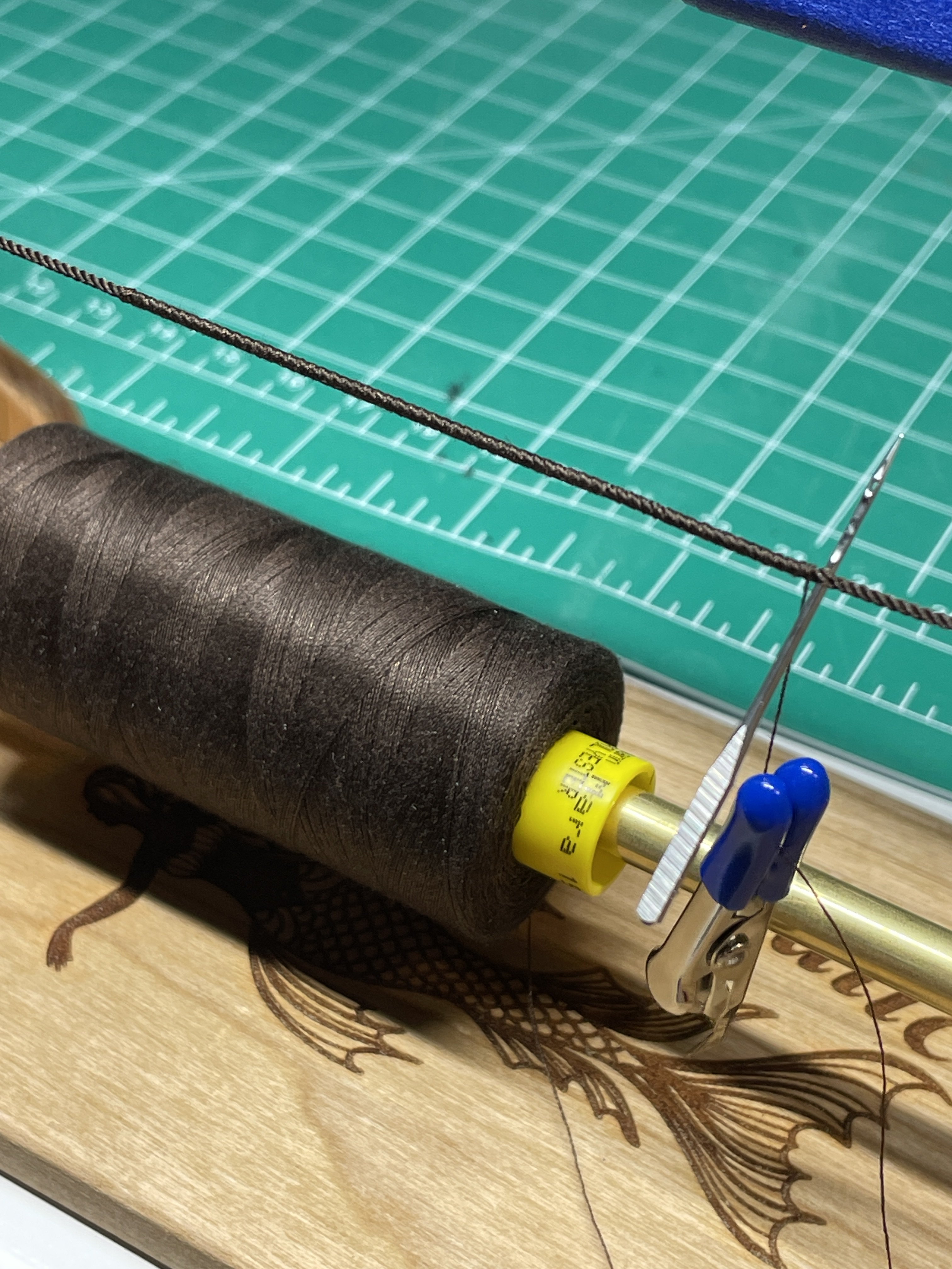

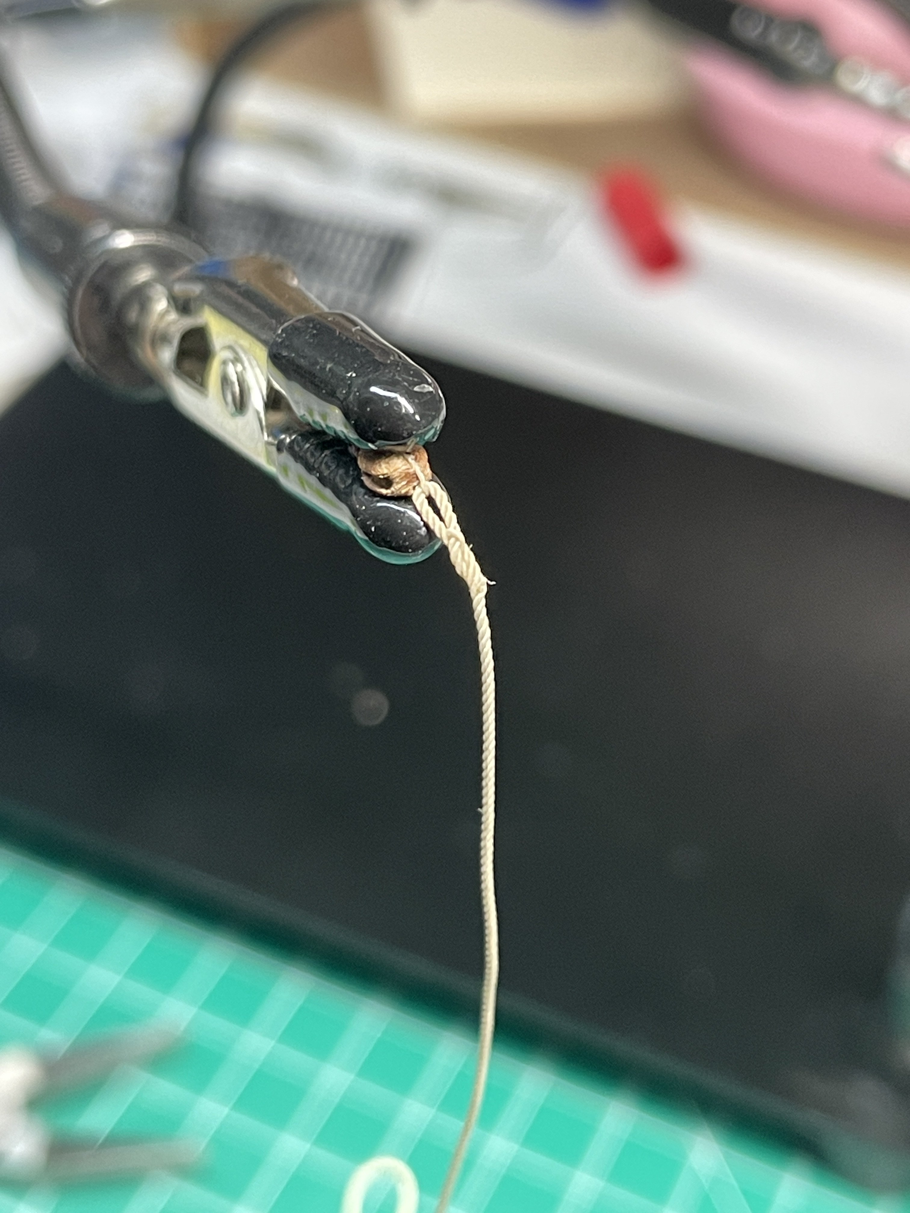

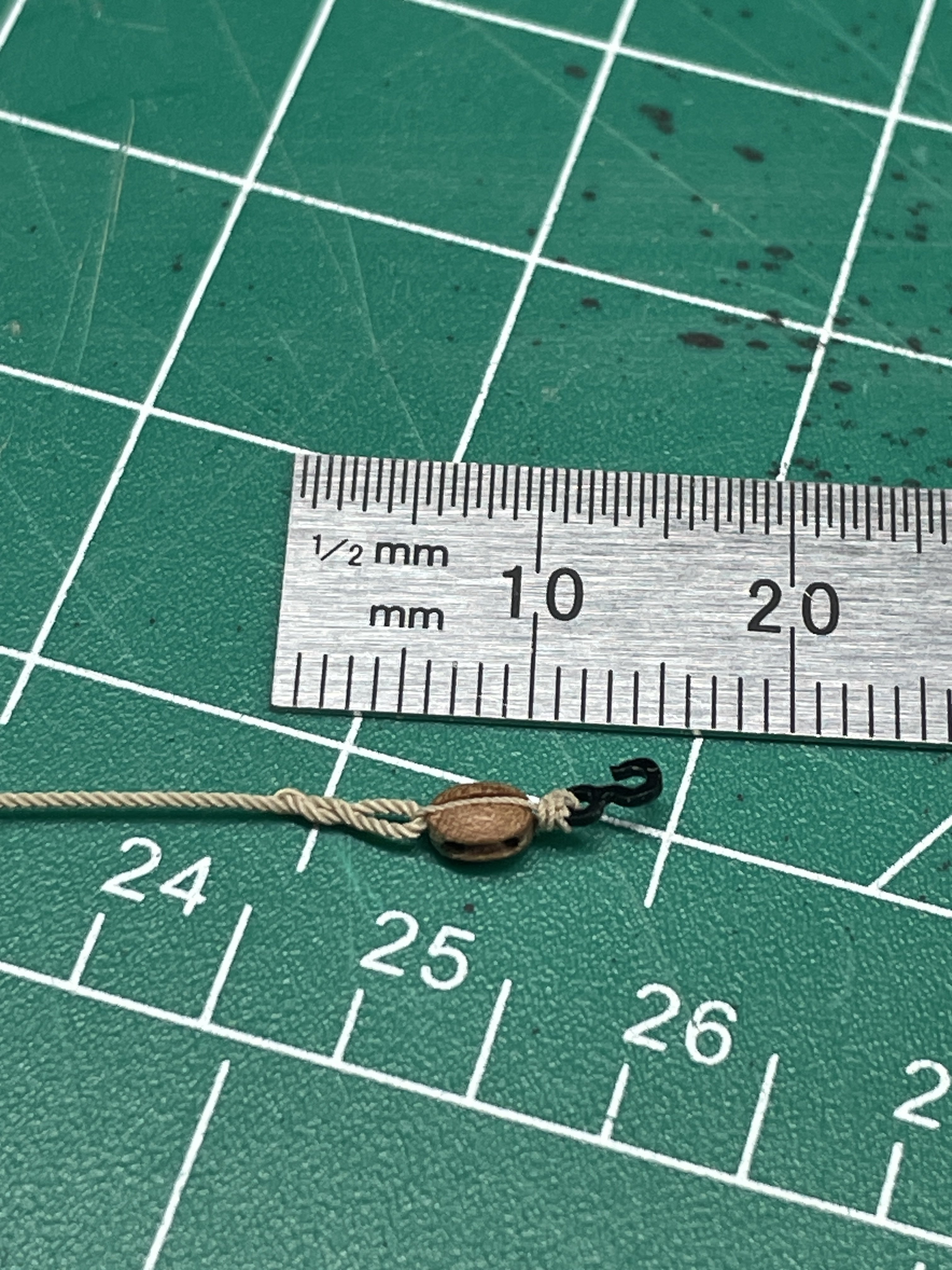

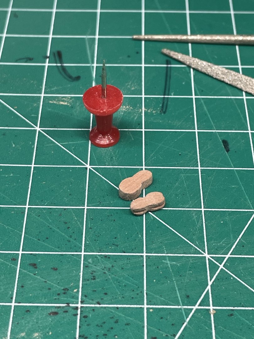

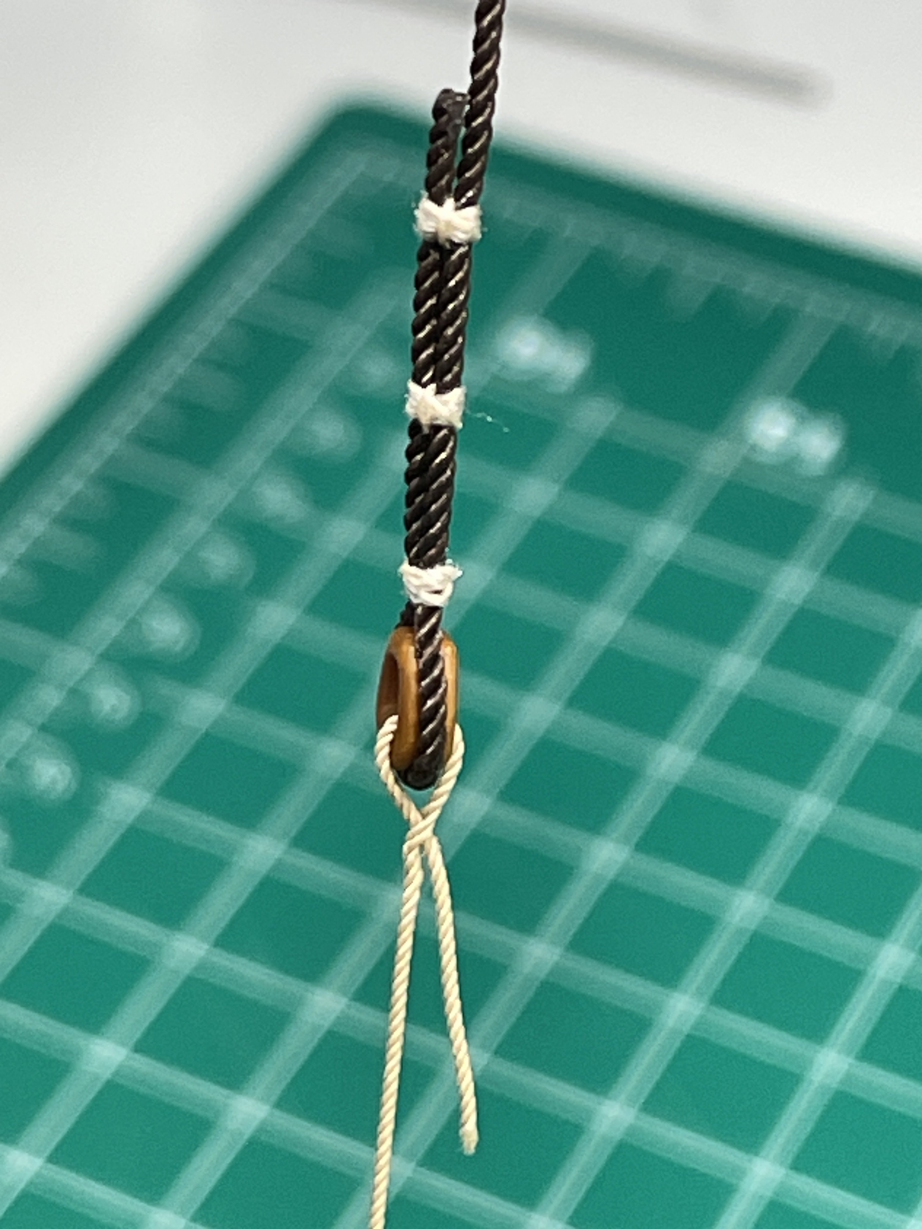

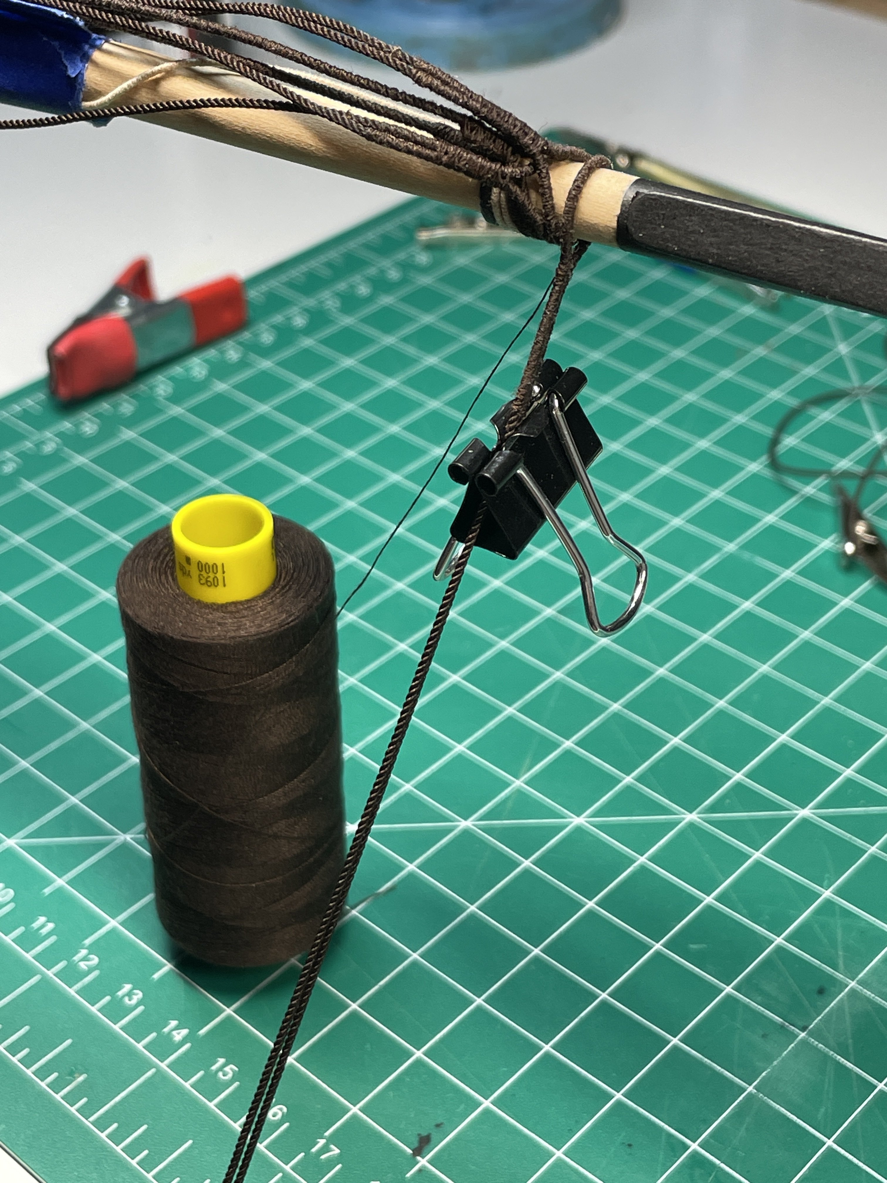

Continuing on, starting on the rigging. At least the beginning of it. Made the chainstays according to the instructions. Made the back stays out of some brass parts. Rigging up the boom and sheet. Rigging up the back stay pendants and the topping lift. I’ve also slipped on the shrouds after seizing them in my serving machine. I had some boxwood belaying pins that just needed the bases thinned down. I saw that thread about the fly tying tool used to seize blocks. I made one up and while it was quite a chore to keep all the ends where they needed to be, it worked quite well. I was putting hooks on the blocks so I had many parts to watch. Here’s the results. These are Syren 1/8” blocks and syren hooks, I think it was 4mm. .35 mm rope with Mara 150 thread. Putting the deadeyes on the shrouds. Next up it really will start coming together as the rigging starts to connect all the parts! It’s always very daunting to me but I do enjoy the results of all the work. Thanks for stopping by! Chris
