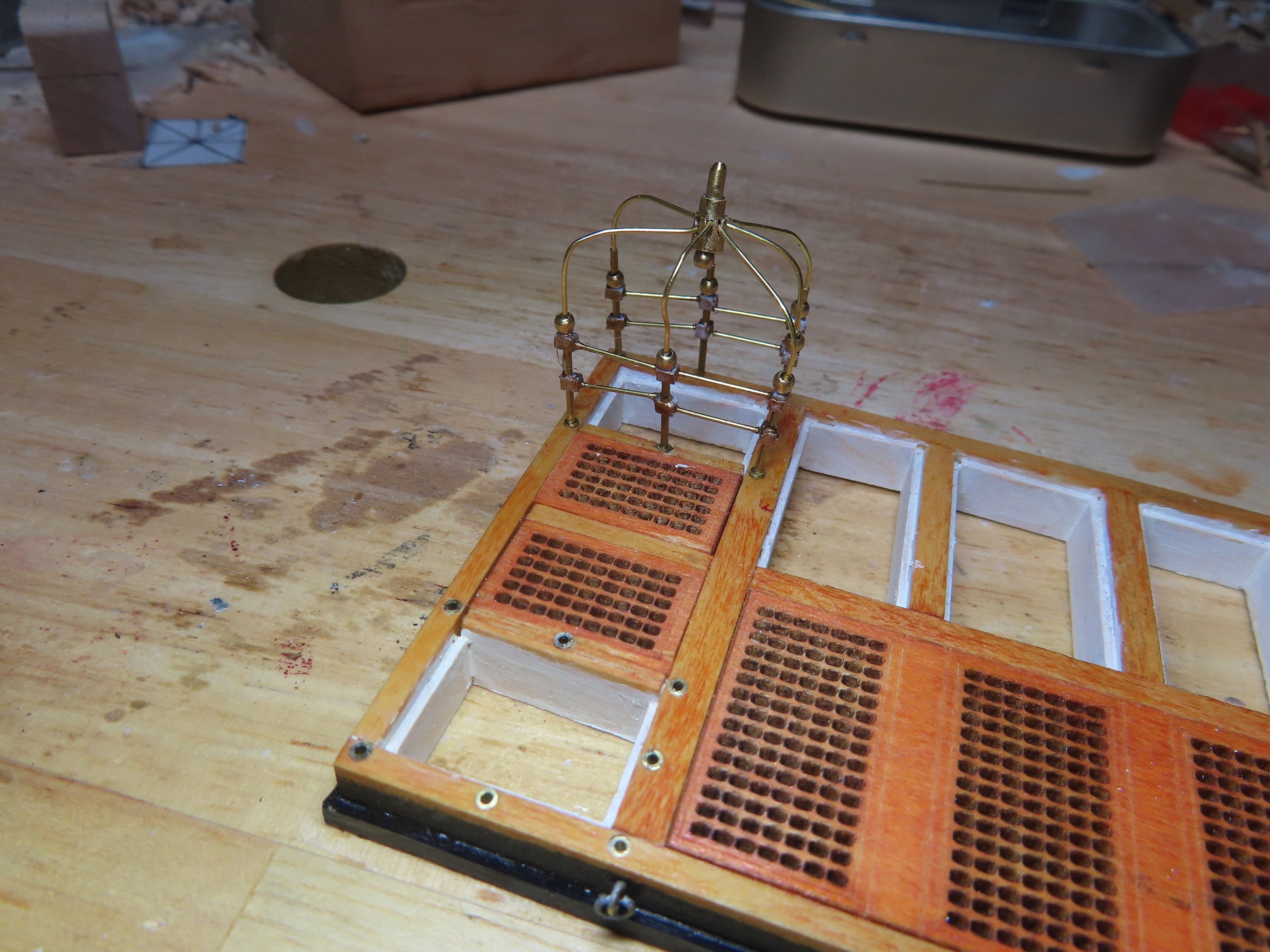

The second canopy frame is completed in one month, half the time it took me for the first one. This is one of the pairs of hatchways at the ship’s wheel. The other one is closed and therefore has no frame. The last two are on the main hatchway. They are a bit smaller and have only seven stanchions each.

That canopy frame looks nice Jon. Well done. It's a good idea to leave one of the companionways closed. I might steal that idea from you :)

Great job on your canopy frame! I love the way you overcame the problem of drilling the holes in the center! Keep up the great work!

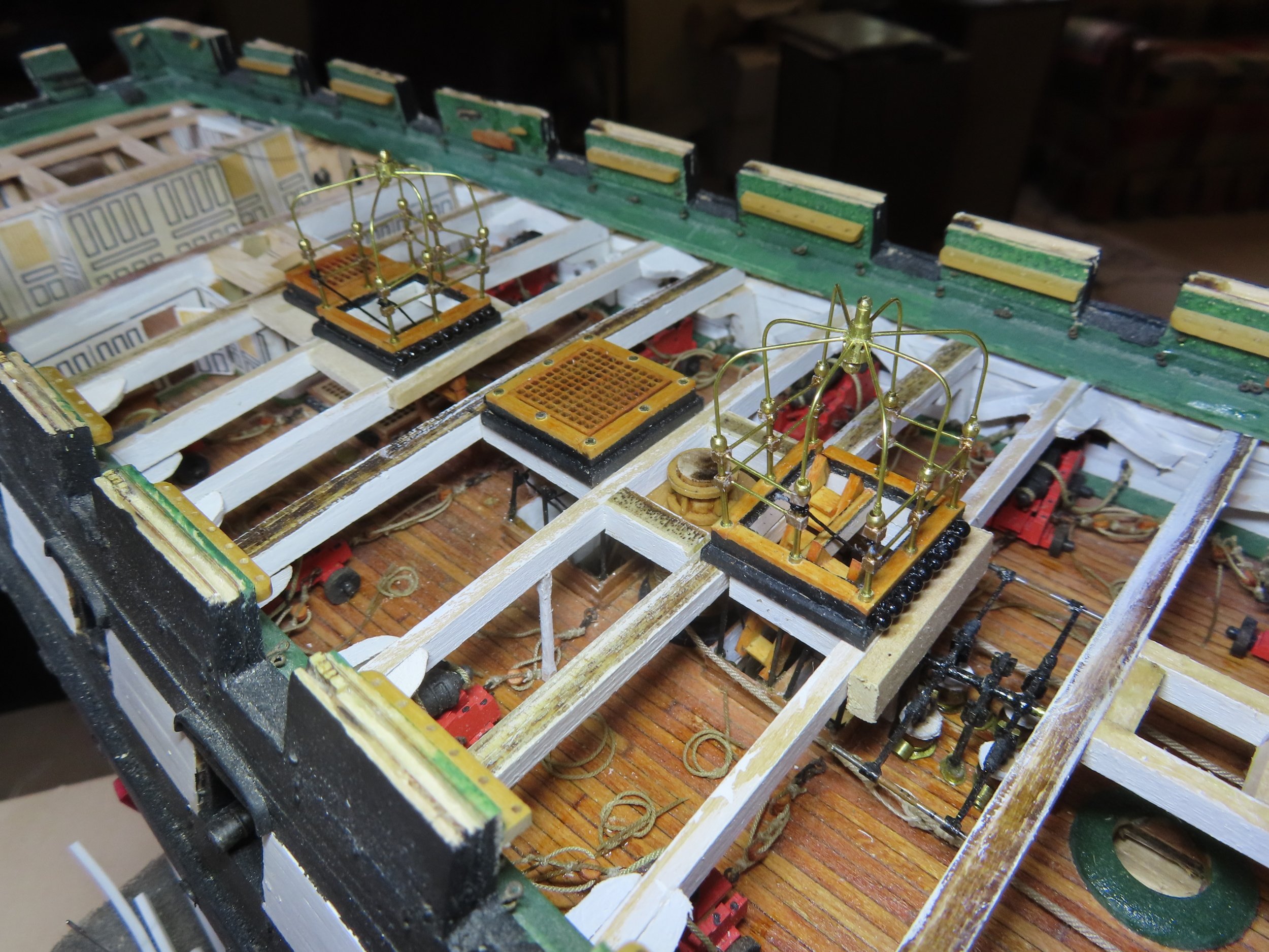

One more to go!
Finally, all the canopy frames (that I’m going to make) are completed. It only took me about four and a half months from figuring out how to fabricate these structures to actually creating them. They are done, not perfect, but done. The camera reveals all kinds of flaws, but after the rest of the model is done (in the near decade), those imperfections will blend in with everything else and most won’t notice them. The frameworks are only dry fit to the deck. I still need to install the ladders and rope handrails.

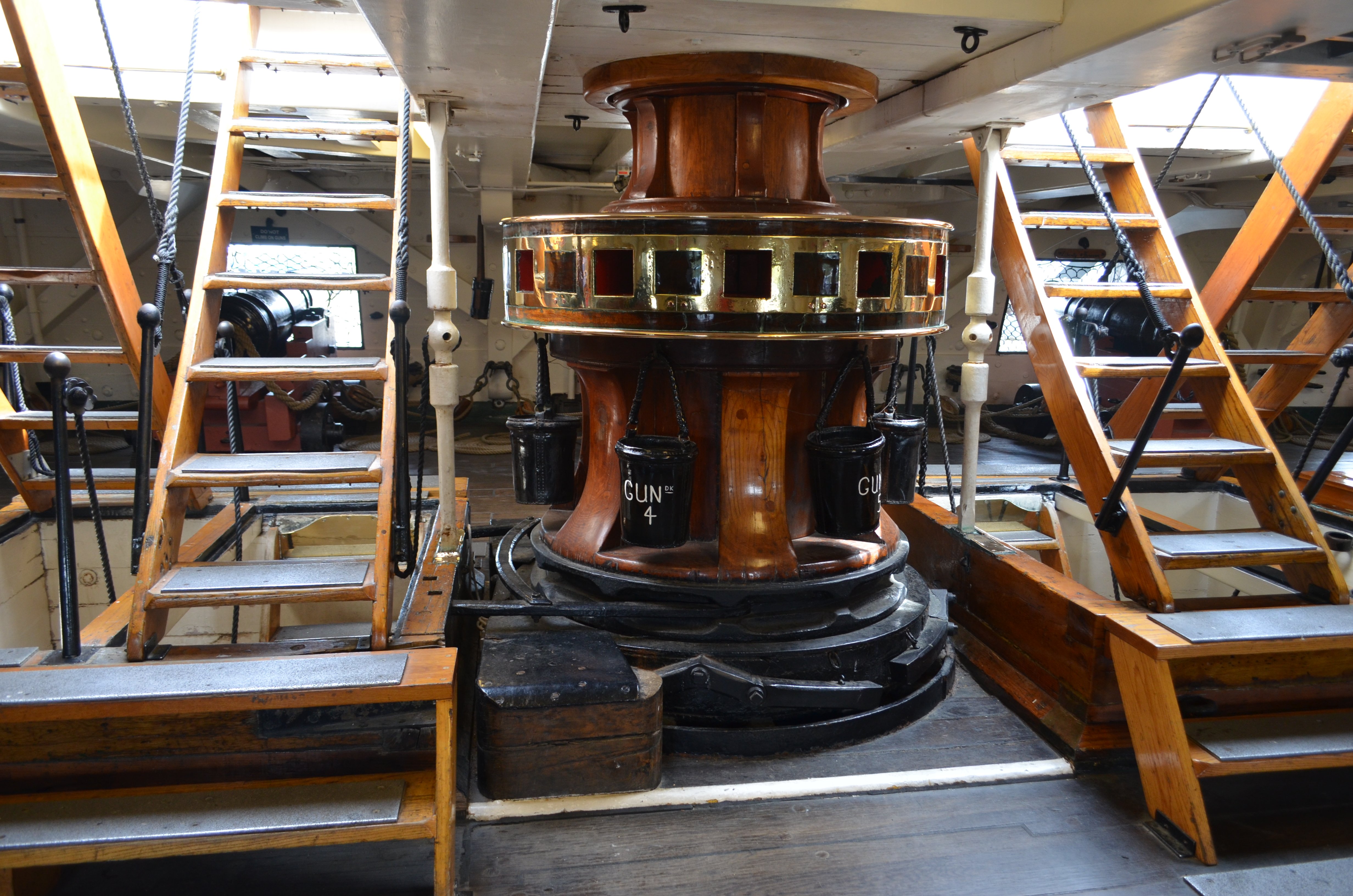

Companionway Ladder Hand Ropes

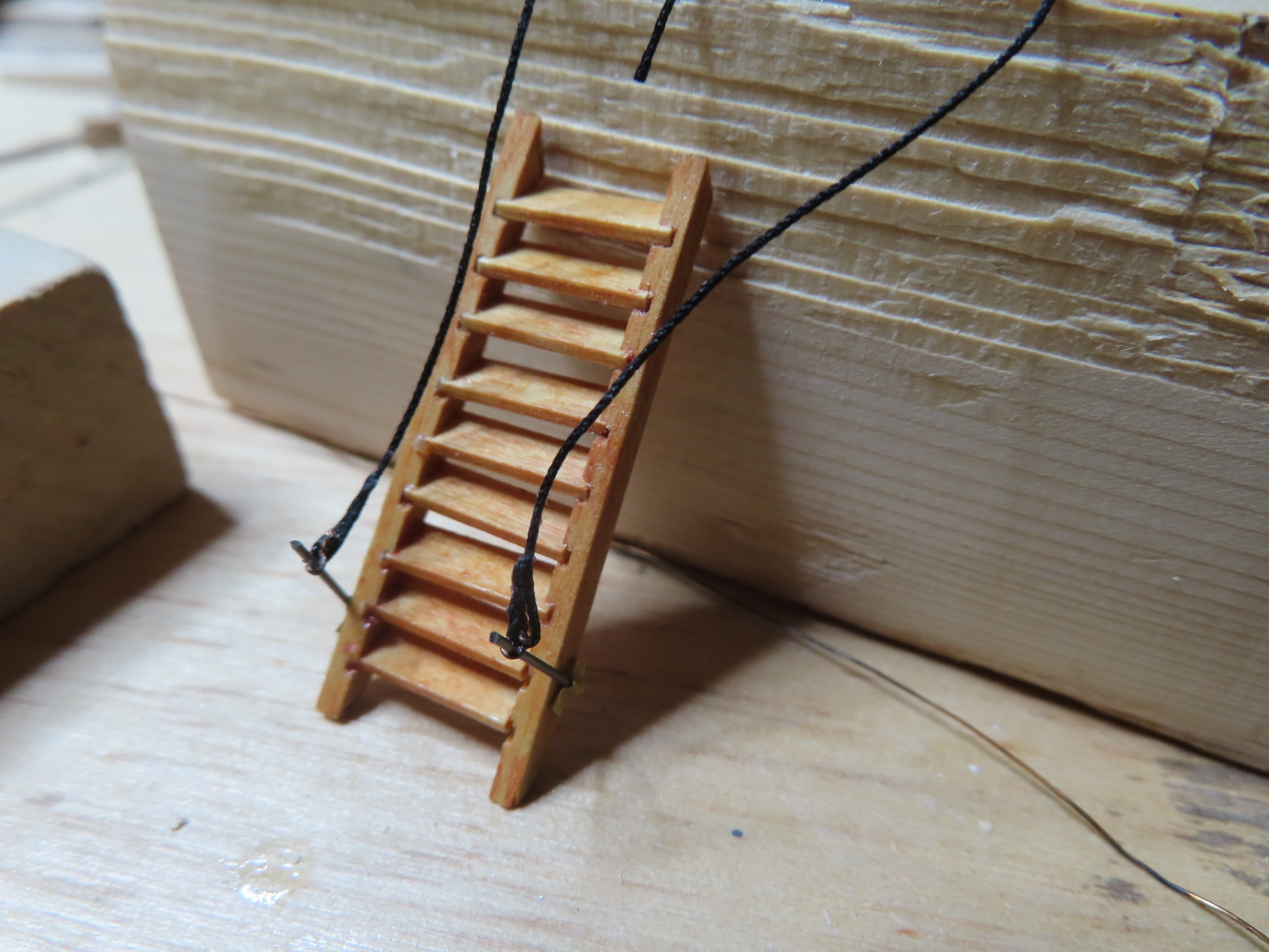

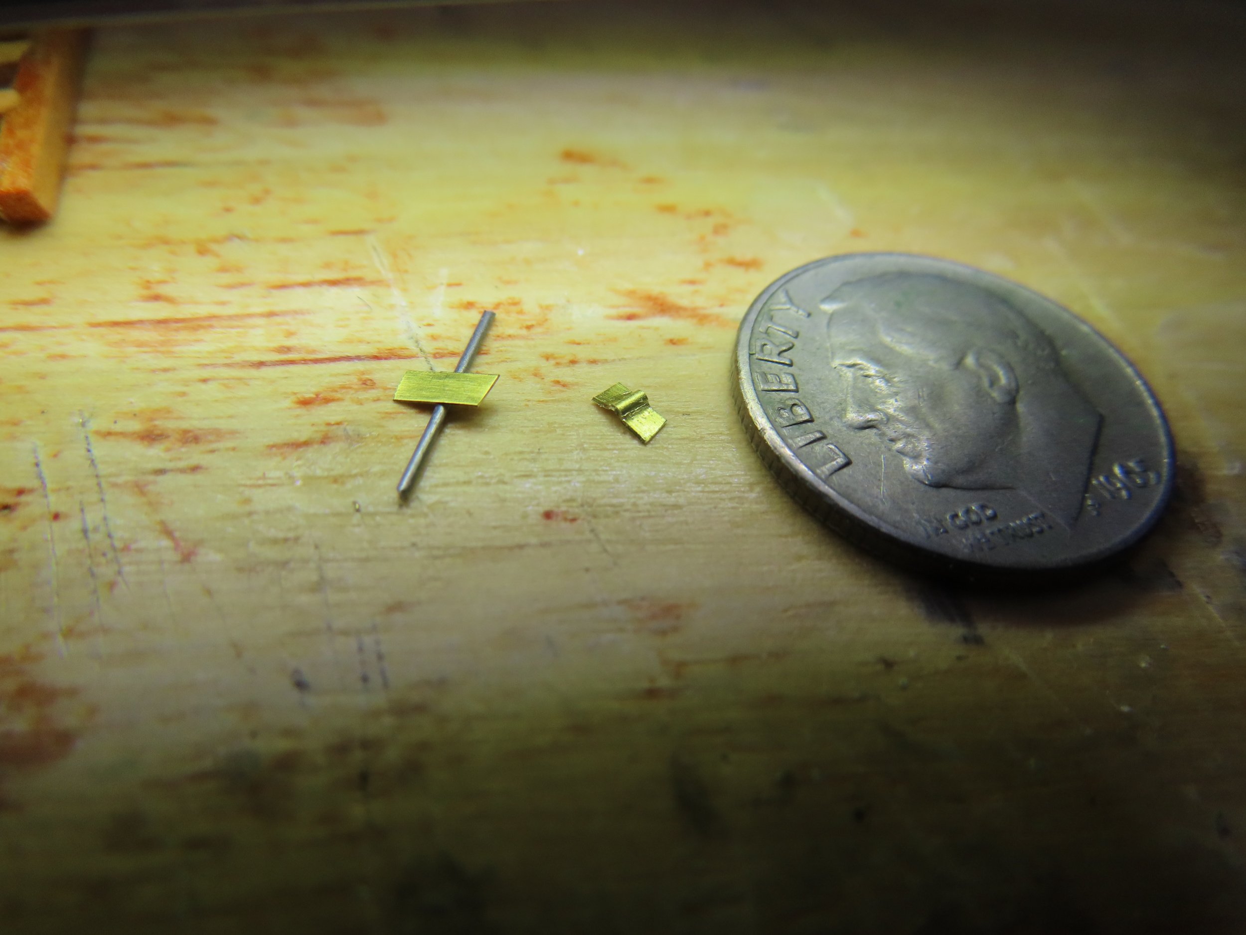

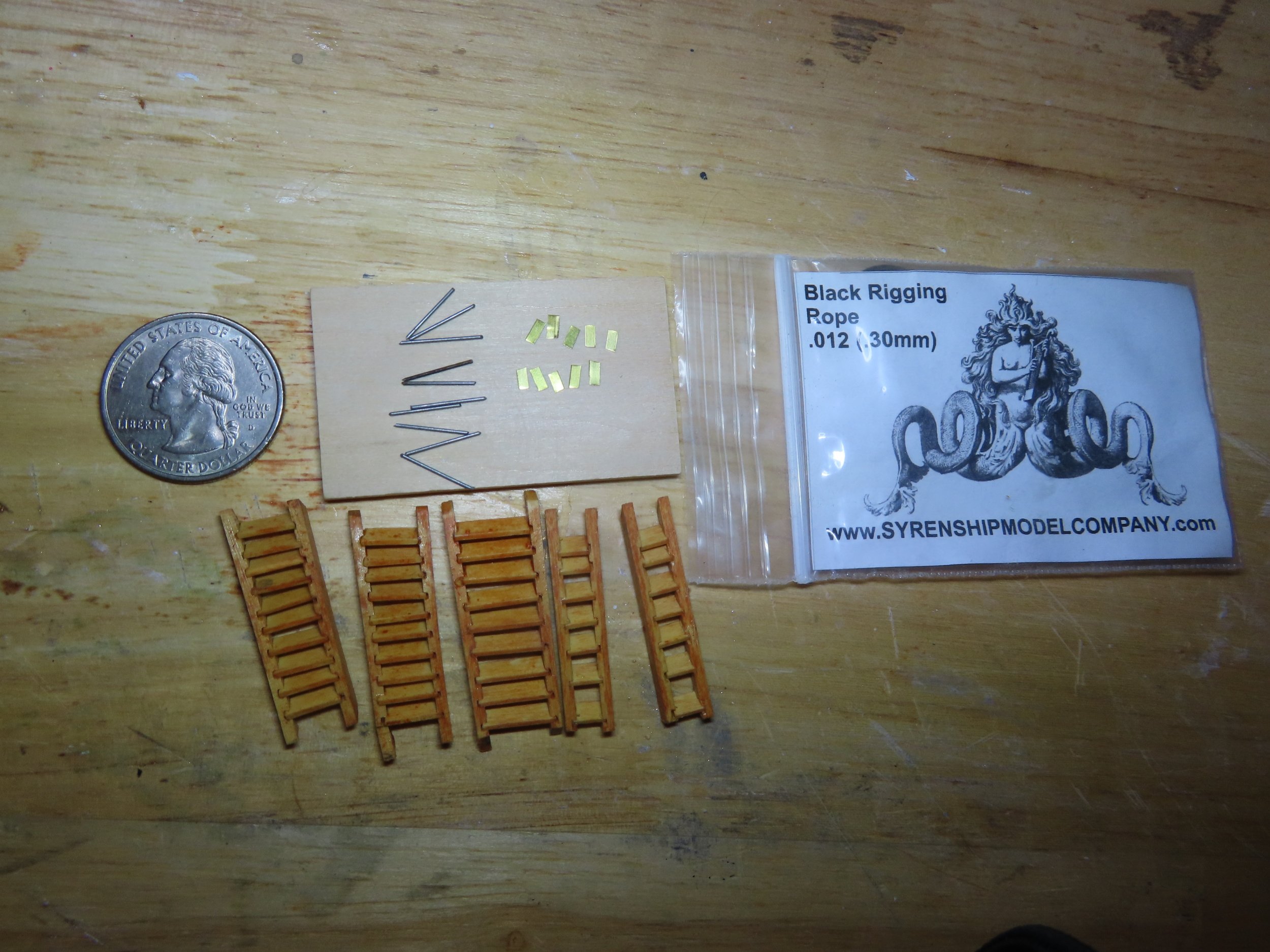

As I mentioned in my last post, I am adding the hand ropes to the companionway ladders going from the spar deck to the gun deck, which were made last year. At the base of the ladders, the stanchions anchor the hand ropes. Trying to maintain close to scale as possible (within reason) with the US Navy plans, I used 0.013” (0.33 mm) music wire cut to 3/8” lengths for the scale stanchions. Additionally, I deduced from the plans that the rope was about 1” diameter or 0.016” scale. Therefore, I used Syren Ship Model Company 0.012” (.30mm) black rope which I had on hand, for the hand rope.

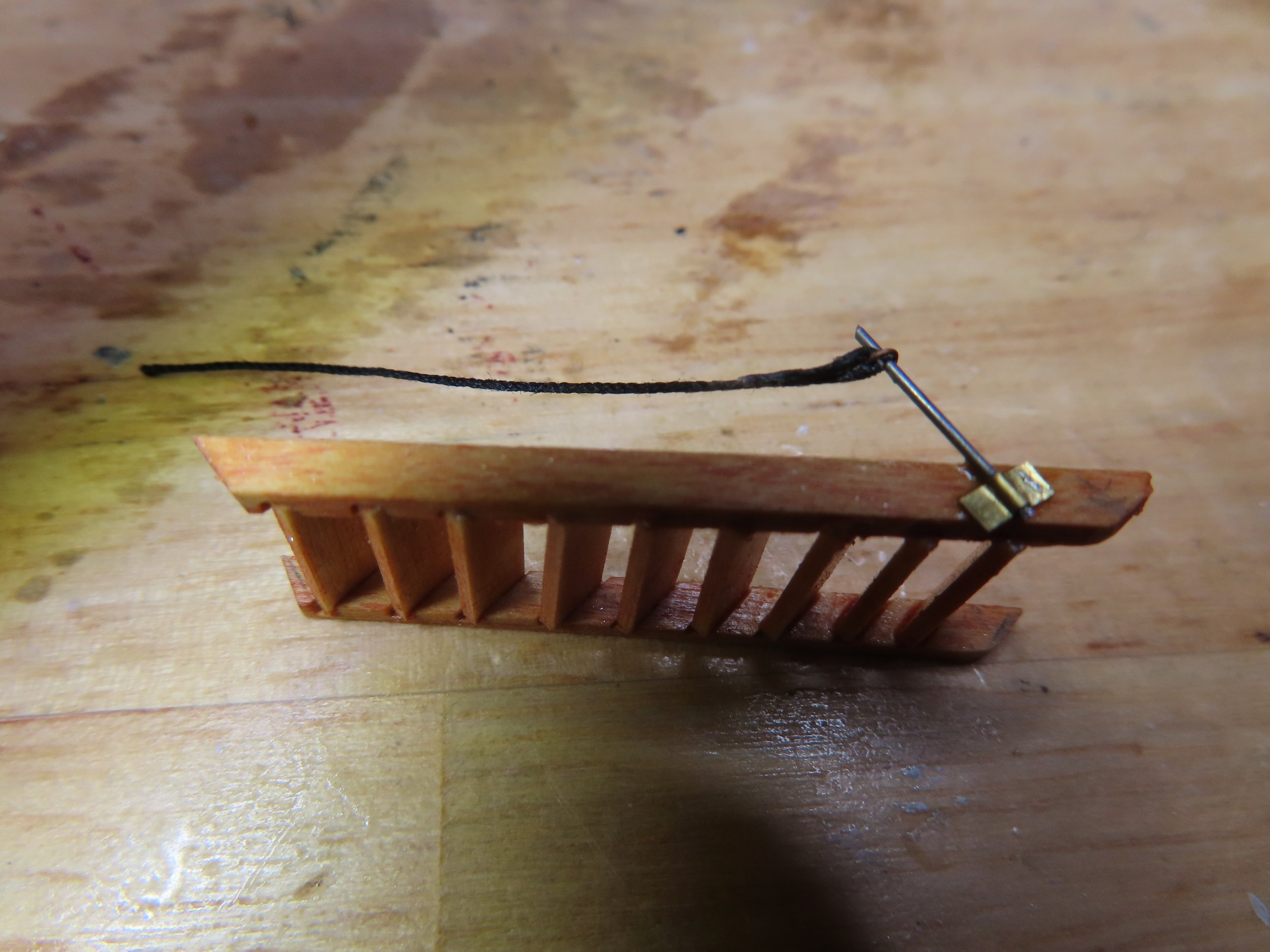

To secure the stanchion to the ladders’ sides, brass brackets were made out of .005” brass sheet cut into a strip and cut to length. These provided sufficient gluing surfaces to secure the stanchions.
I ran into a problem with the ladders for the capstan hatchway. I made them snug to the hatchway walls such that I could not slide the ladder down the hatchway because the stanchions made the ladders too wide. Therefore, I modified the stanchion attachment method. I filed a grove in the ladders’ sides for the stanchions to recess into. In theory this should have been simple, but the execution was not. Just the slightest nudge, on the stanchion and it would pop off the ladder. It took numerous attempts, gnashing teeth, time, and vocabulary that would have gotten me divorced if I had ever been married. But eventually, it got done. The upper ends of the hand ropes were tied off on the brass framework.

Well, the ladders look pretty #@*#!&^%# good to me, Jon!  Nice finish to them!
Gregg
Nice job Jon, the ladders look great. I can certainly imagine some of the words that helped get the task done. I am married and my wife is always asking if I really do enjoy what I'm doing. It often doesn't sound that way. Keep up the great work
