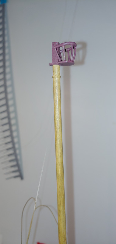

I had a few that were tight also, felt like something was going to break pulling them through. Since I couldn't find any sheed blocks to my liking I started fabricating my own out of styrene, the double blocks measure out approx 11mm and the single at 8mm. I did a mock up to check out the scale and looks good to my eye. Also made some modifications to the mast head along with making up the
crows nest, still undecided if I like it!
Michael D.

I like it very much!...recently I saw some pictures where we could see construction of crows nest and some other derails... here it looks a little bit different than Your variant...as I understood there need to be opening on both sides in front of the nest?... platform will be secured to the mast top?

Good day Michael,
Do You plan to leave crows nest as it is? in this shape,strait from the kit?...
it looks too plastic somehow,like casting from something...don't You plan to make it scratch or made some modifications to the original kit shape?
as seems to me ,there should be some specific,well recognized  shape of this part ... repeated on almost all contemporary drawings, but it is far not like kit shape🤔

Kirill I appreciate your constructive criticism on the crows nest, Heller did not supply one in the kit I made this one using brass wire as a prototype,( never really liked it) just to get a visual. This picture shows my mock up of binding the shrouds with snaking a line in between, now if I can pull this off when it comes time to do it for real I'll be shocked!!. A revised crows nest is in the works and thank you again Kirill for your input and pictures and anymore you can provide would surely help as all I have to go by are the Hellers instructions.

 I spent some time building a new crows nest out of brass and styrene and looks much better then my first attempt.
