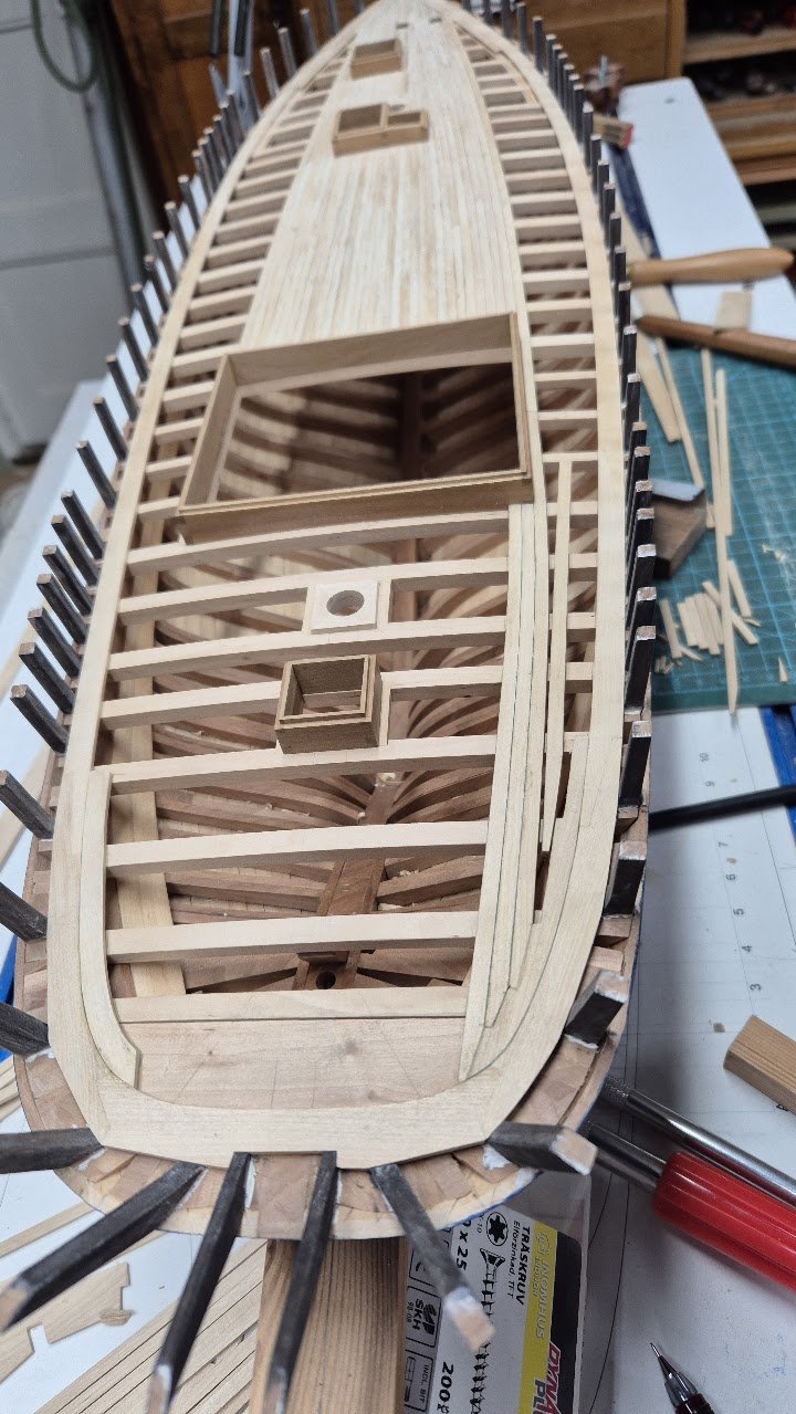

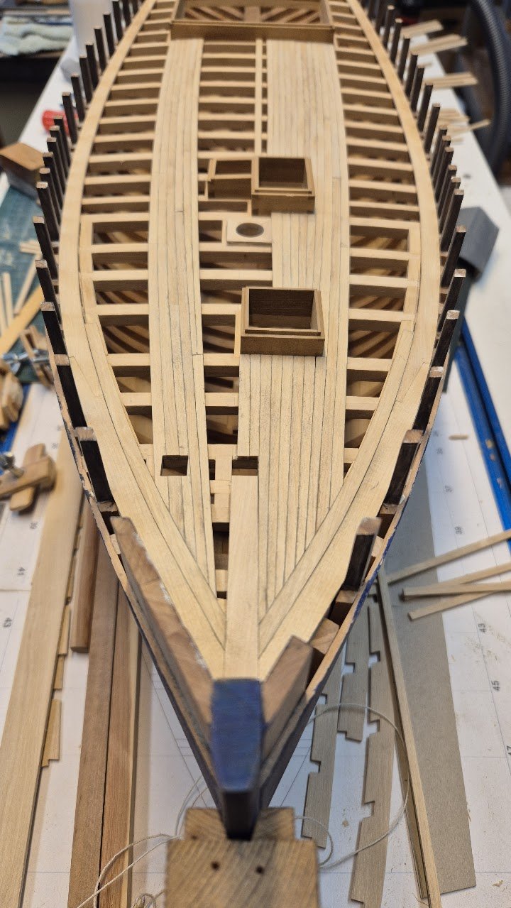

So, fighting my deamons, both real and imaginary, takes time.
But a quick update on the joinery I can give you (hopefully it still qualifies as "delightful", I guess John will be the judge of that).
Note though, that the aft three pieces are not glued in at this photo.
Then I got me a puzzle.
However there are some drawbacks in comparison to a regular "off the shelf" puzzle.
1. It doesn't state on the box how many pieces it is. In fact, I didn't even get a box for it.
2. The instructions are "sparse", and that is stretching it a bit. It only says, "Start outwards and work you way towards the middle". Not very meny clues in that statement.
3. There is not even a clear picture of what the end result should look like! No box art or anything. As Whitney sang "how should I know???"
Whish me luck guys!
On a slightly more serious note, the deck is not laid workboat style, i.e. straight laid. Instead it is laid yacht style, meaning a slight curve for a more gracious appearance.

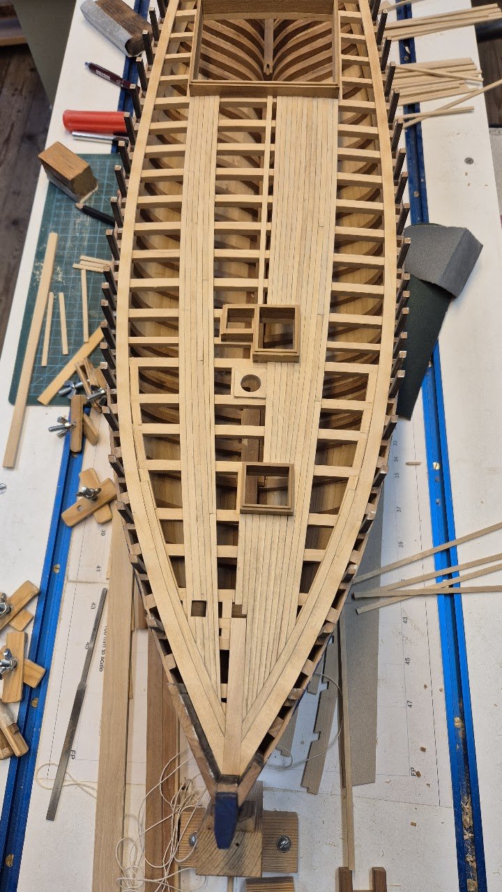

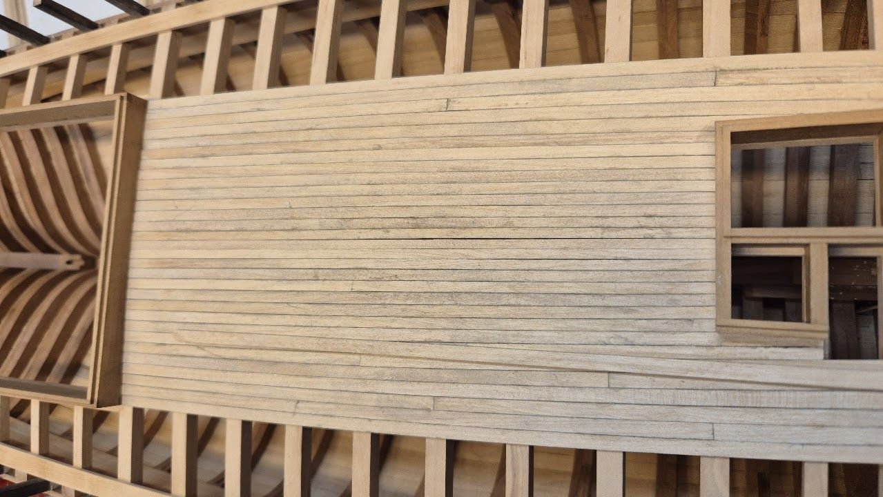

Greetings to all!
Just some progres pictures here. I am in for a treat trying to close the deck while keeping it fair and a smooth run for each plank.
Cheers!
Happy modelling!
Håkan

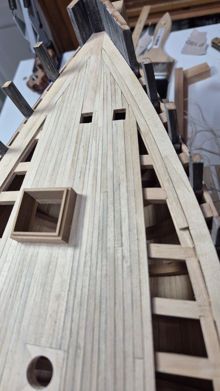

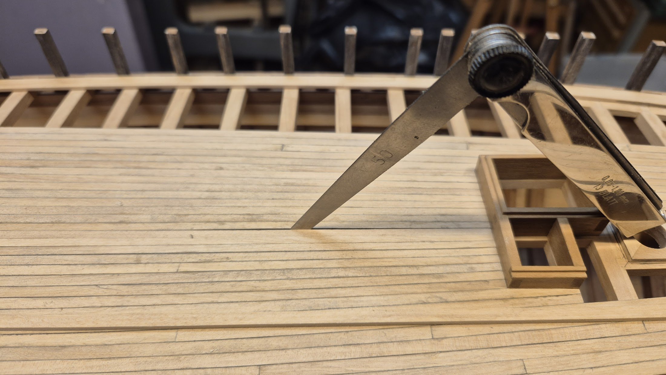

So, just a couple-three pictures to show what we all are so familiar with.
Here I'm closing up the deck between the main hatch and the forward hatch/companionway.
First try.
Doesn't look all that bad, right?
Well, here is the evidense that I can do better 😉
"50" stands for half a millimeter, (1/32").
2nd try, a little while later and no gauge fits in between.
Well, that was the easy part of the deck... next up I will close the foredeck. But that's a chore for another day.

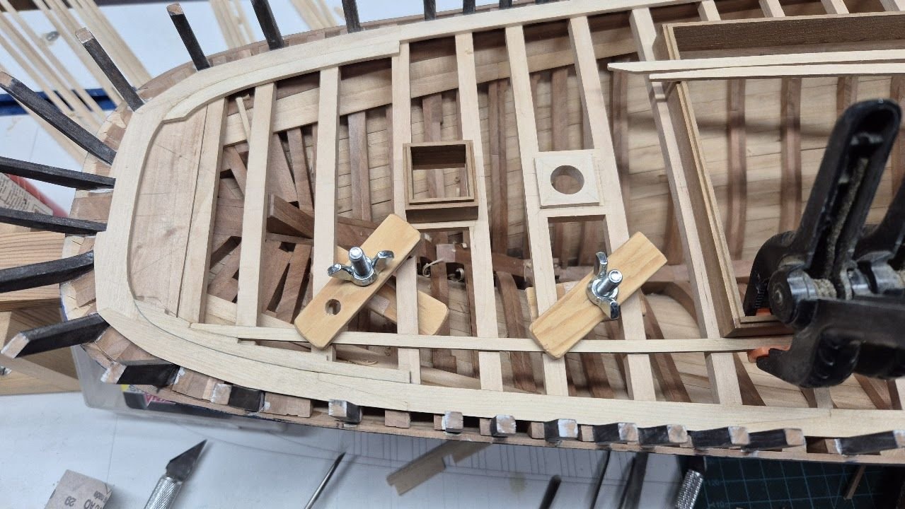

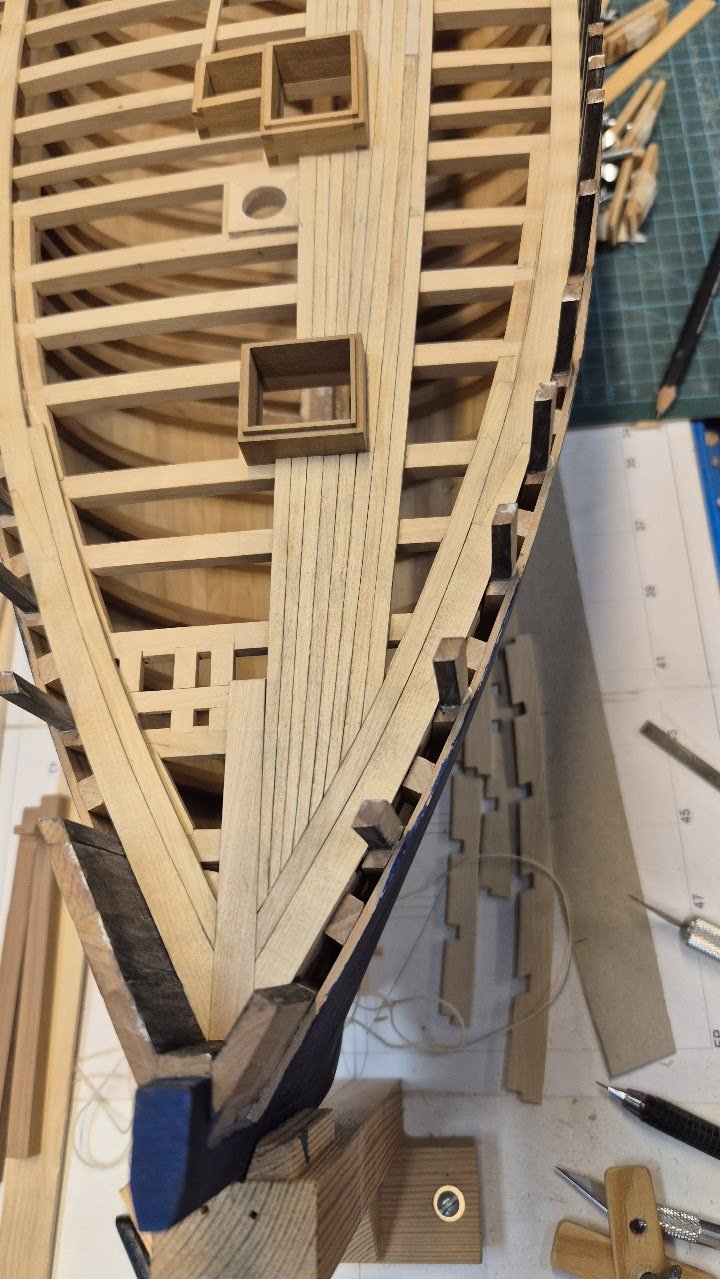

So happy to see an update from you!
Interesting contrast between the beefy beams and slim deck planks. Do you know what was behind that practice? Availability of wood? It probably triples the number of seams that need to be caulked, maintained, can leak, etc...
Happy New Year, let the new one be trouble-free and full of build progress! :)
Mike,
Gott Nytt År!
Respectfully
Mike, I just follow the book. In it it states that the planks are 120 mm wide, out of keroueng/keruing (teak look-alike). Sine they are laid swept I guess 120mm is quite enough to force into place. My skills att laying deck however, lacks a bit of finesse, will see how it turns out in the end. Probably will have to add a good amount of stuff on the deck to hide it...
