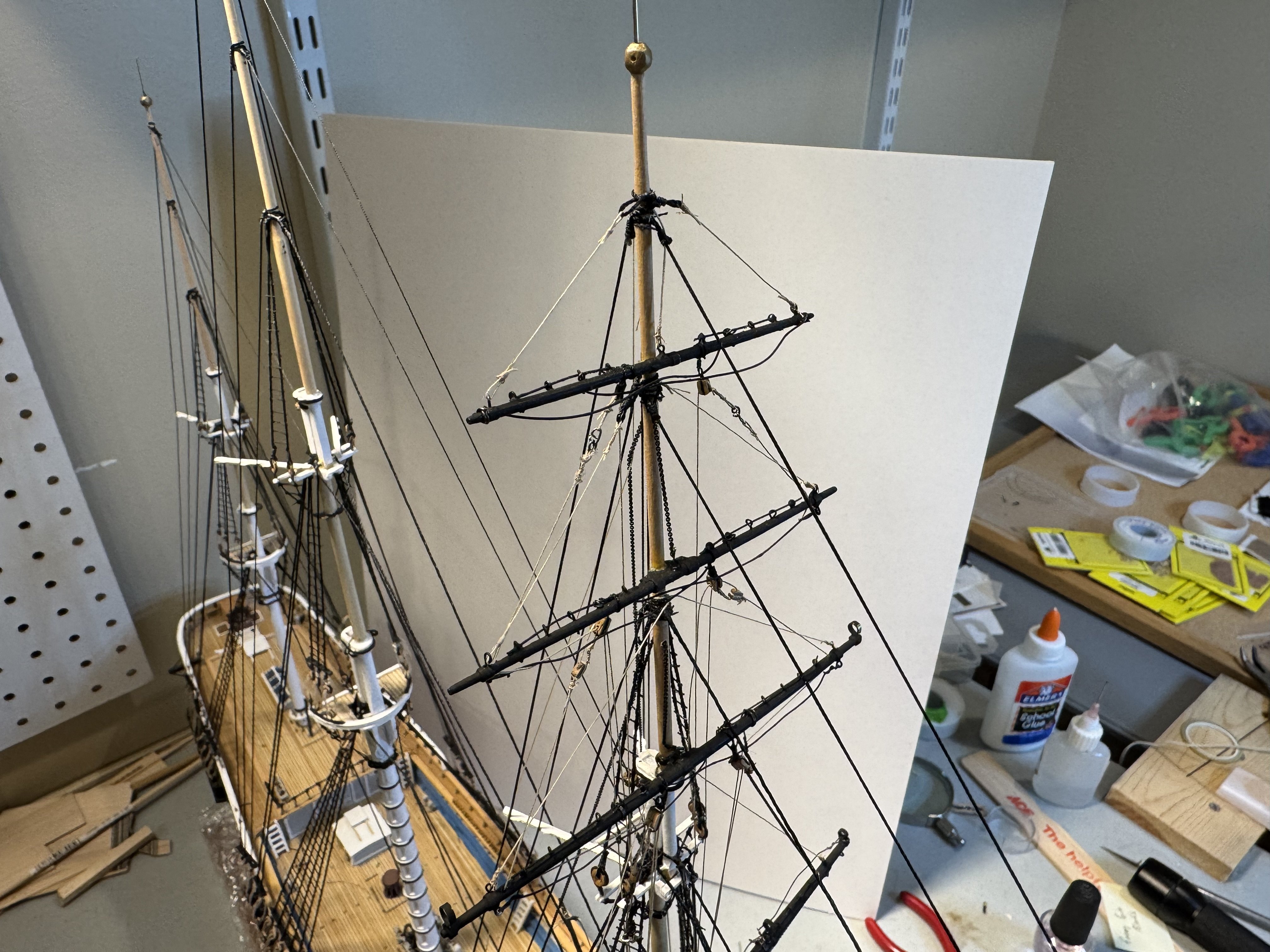

Still working on various pieces of the masts.  I've painted the lower masts as I believe these are completed.   I've formed the masts, drilled holes and made a number of brass fittings.   Still working on the upper cross trees.  I've used the suggestion to glue some brass on the bottom of the pieces to add some strength.   Shown below is my Makita "lathe".   Spinning with sandpaper to take round out the square basswood and remove material.

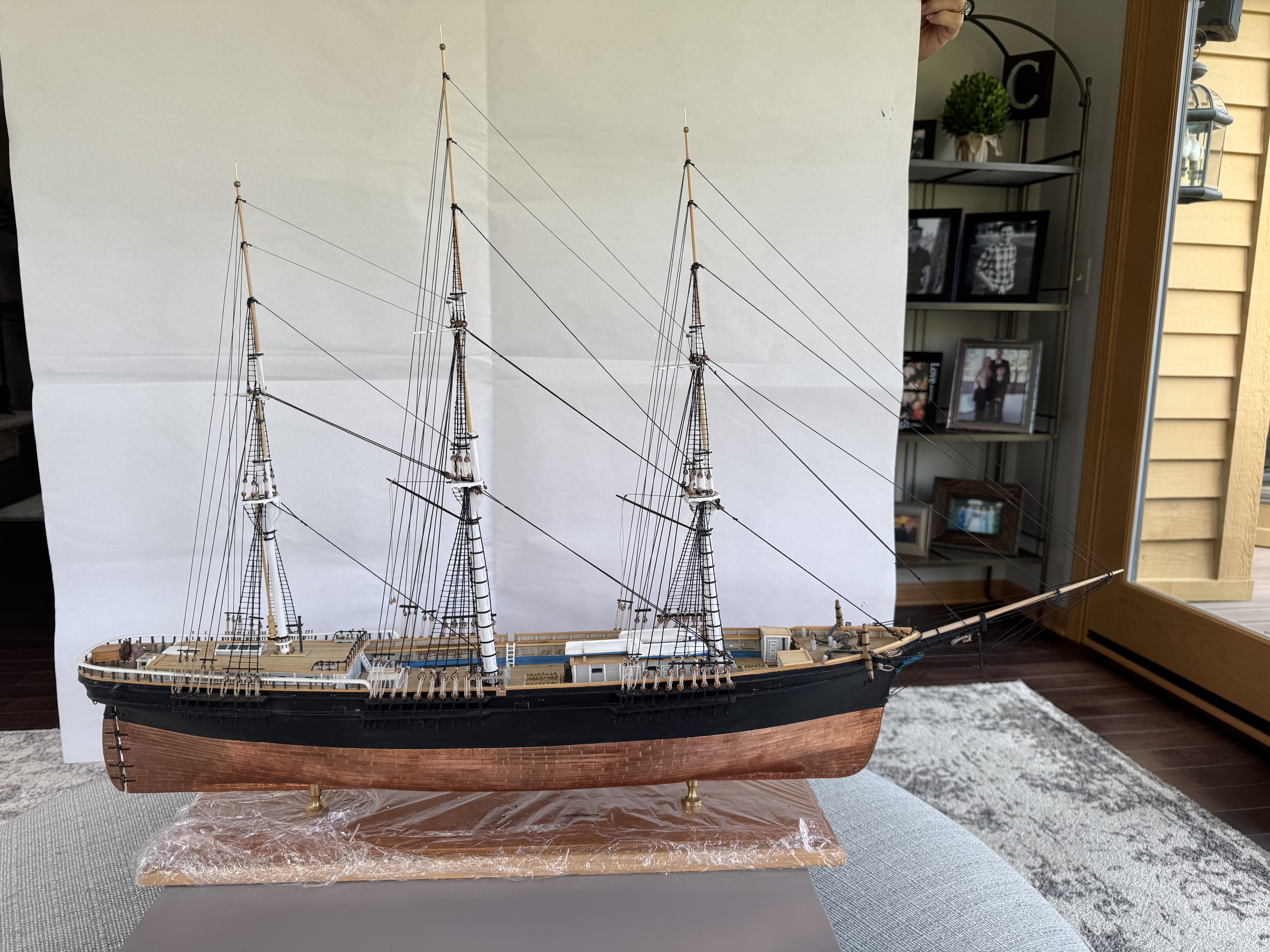

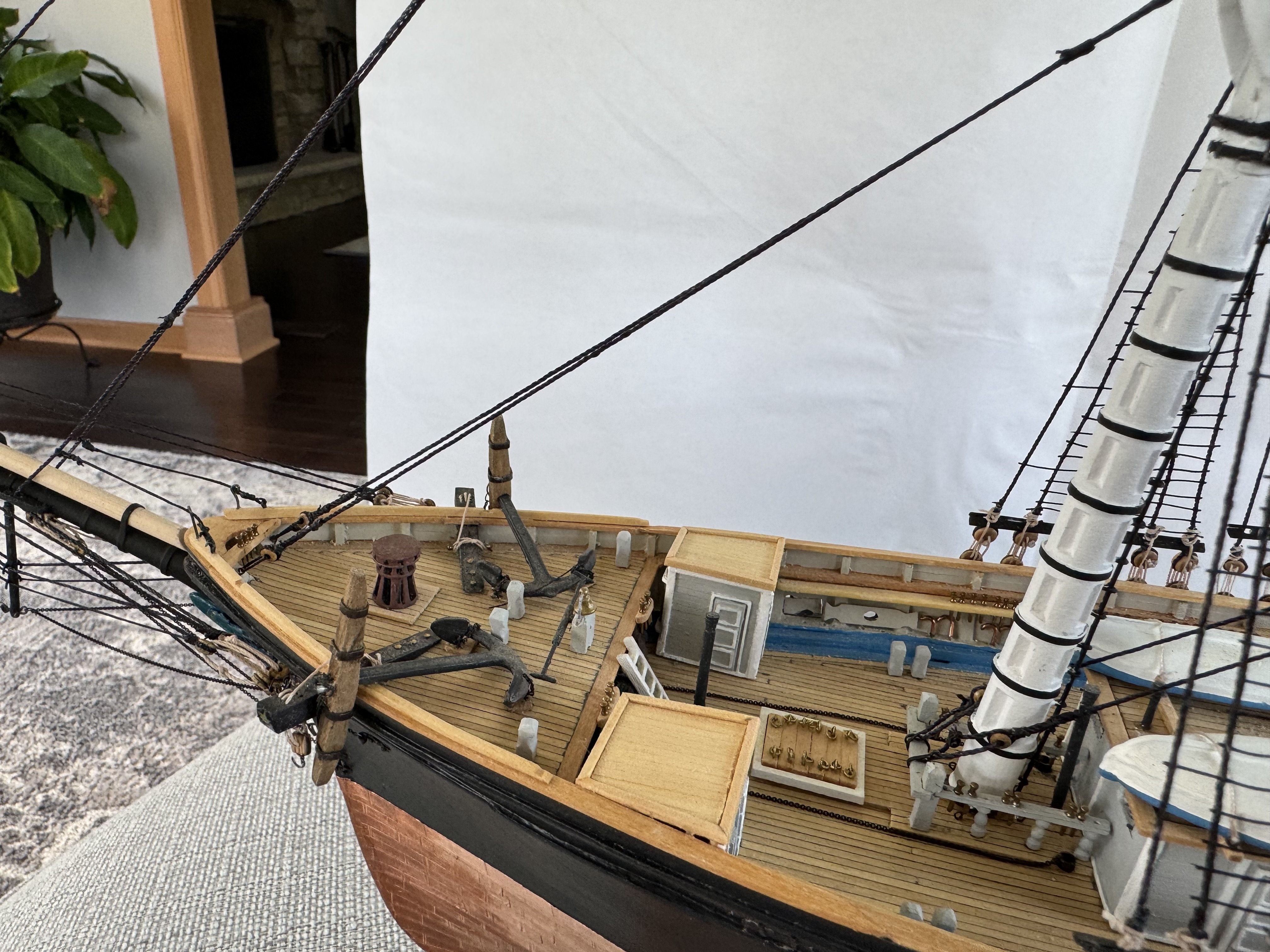

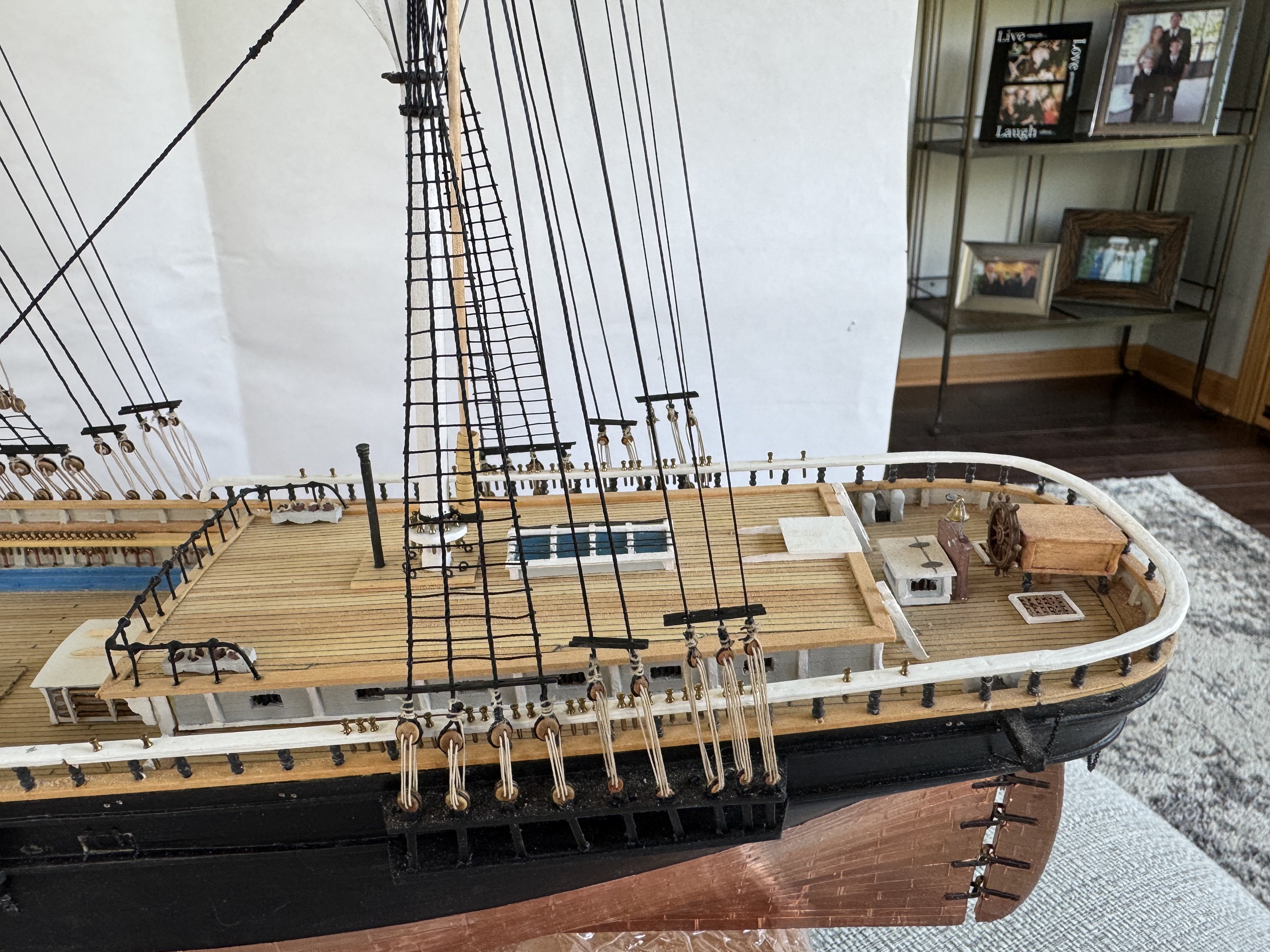

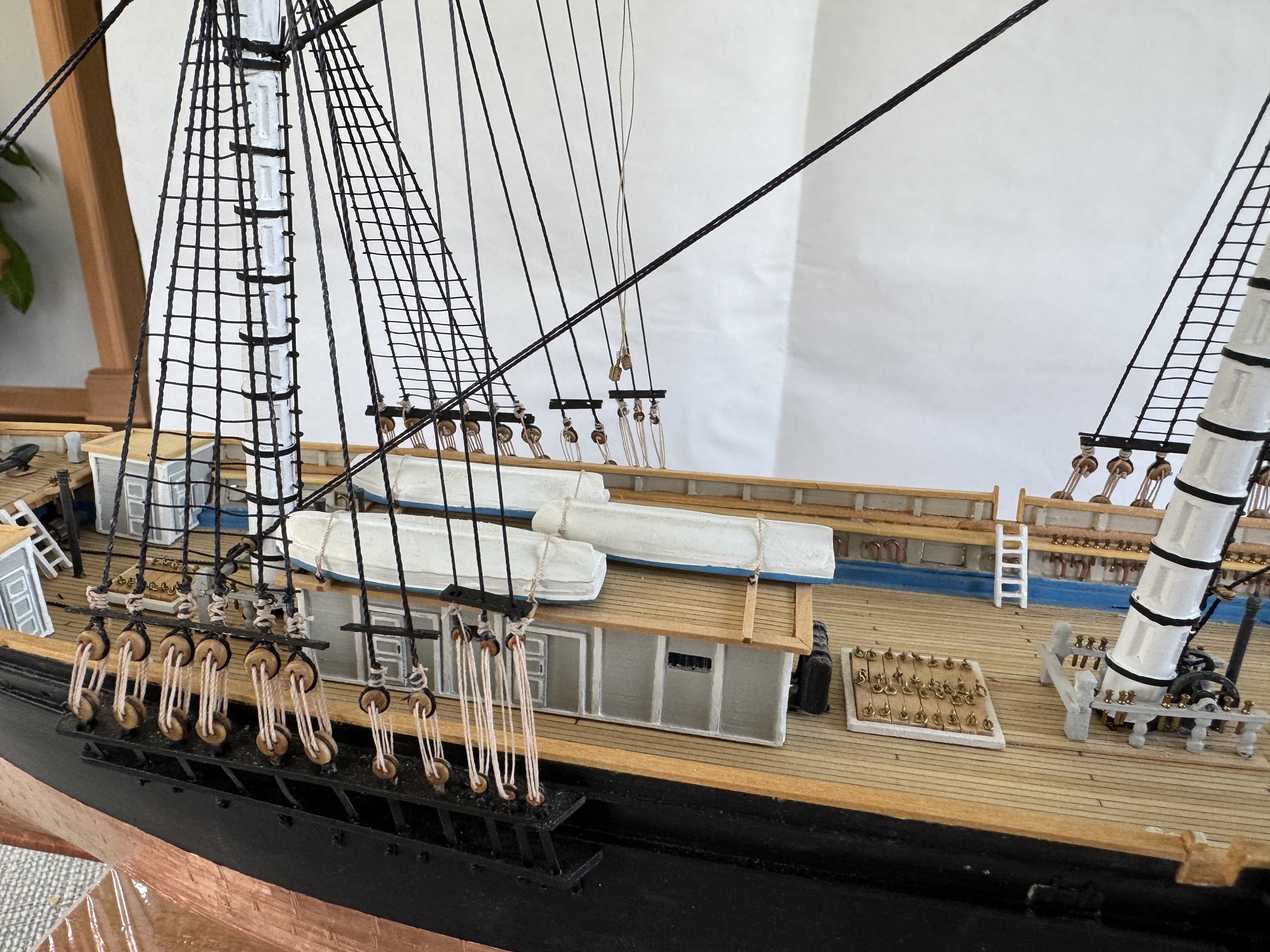

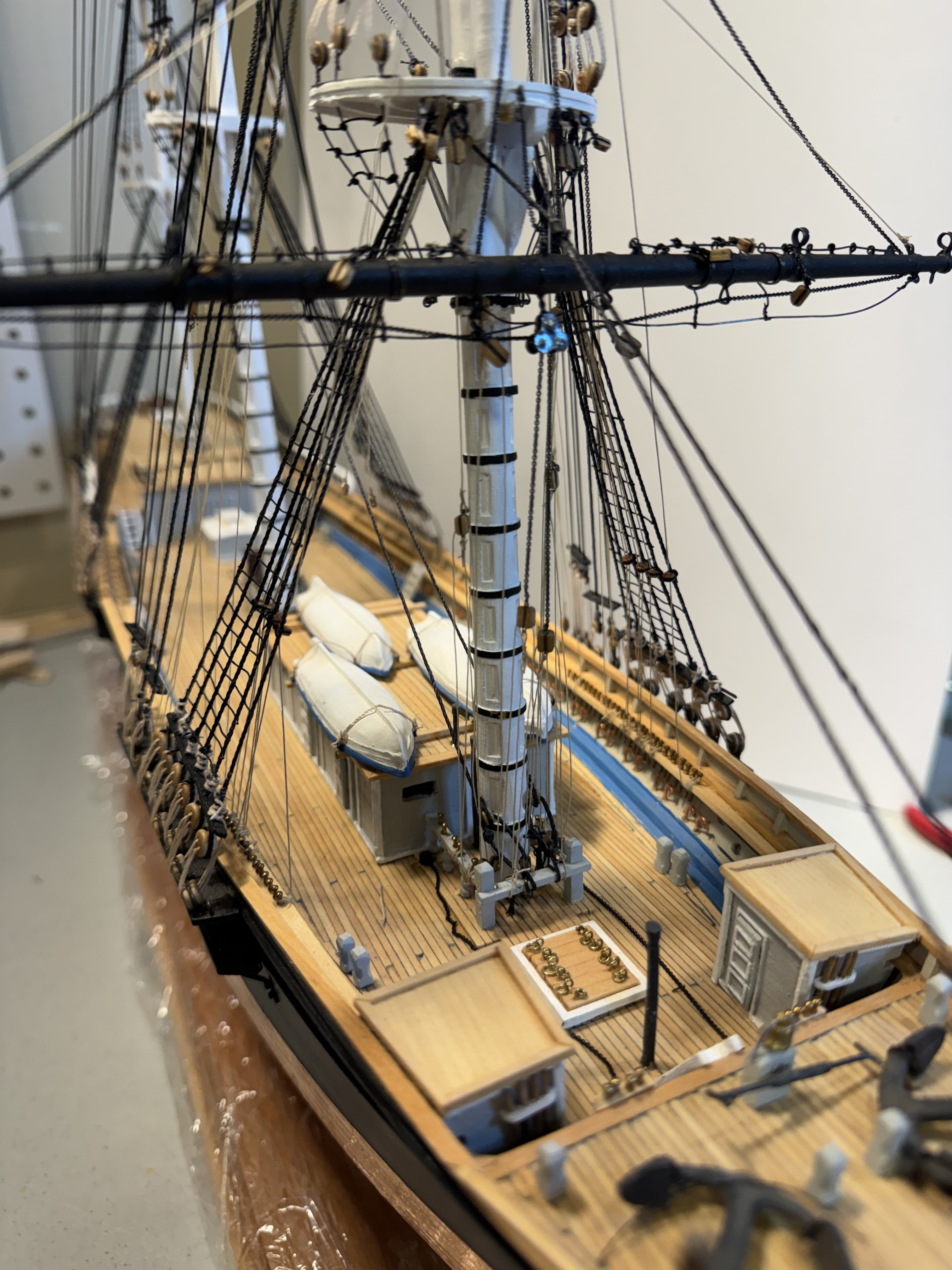

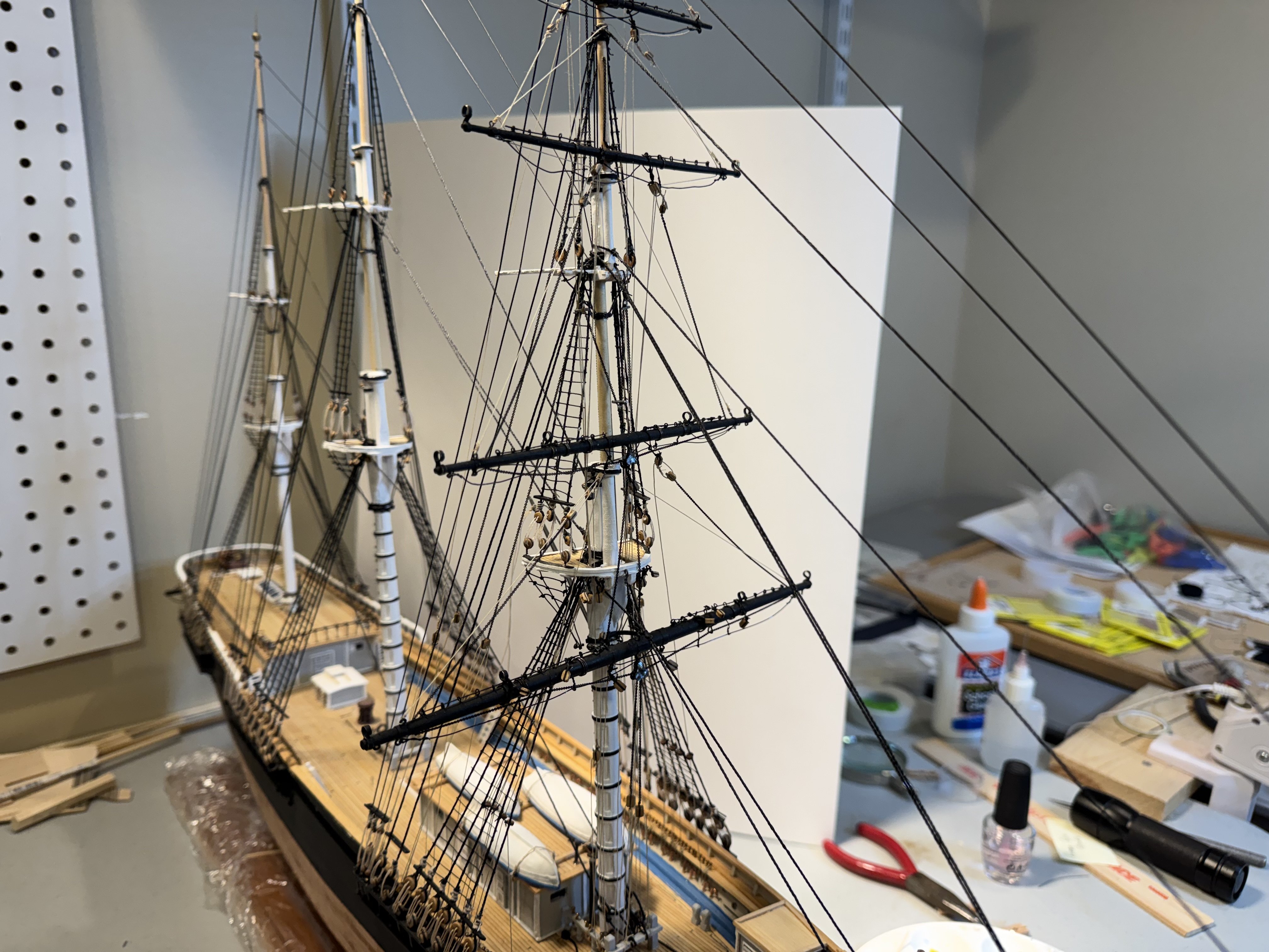

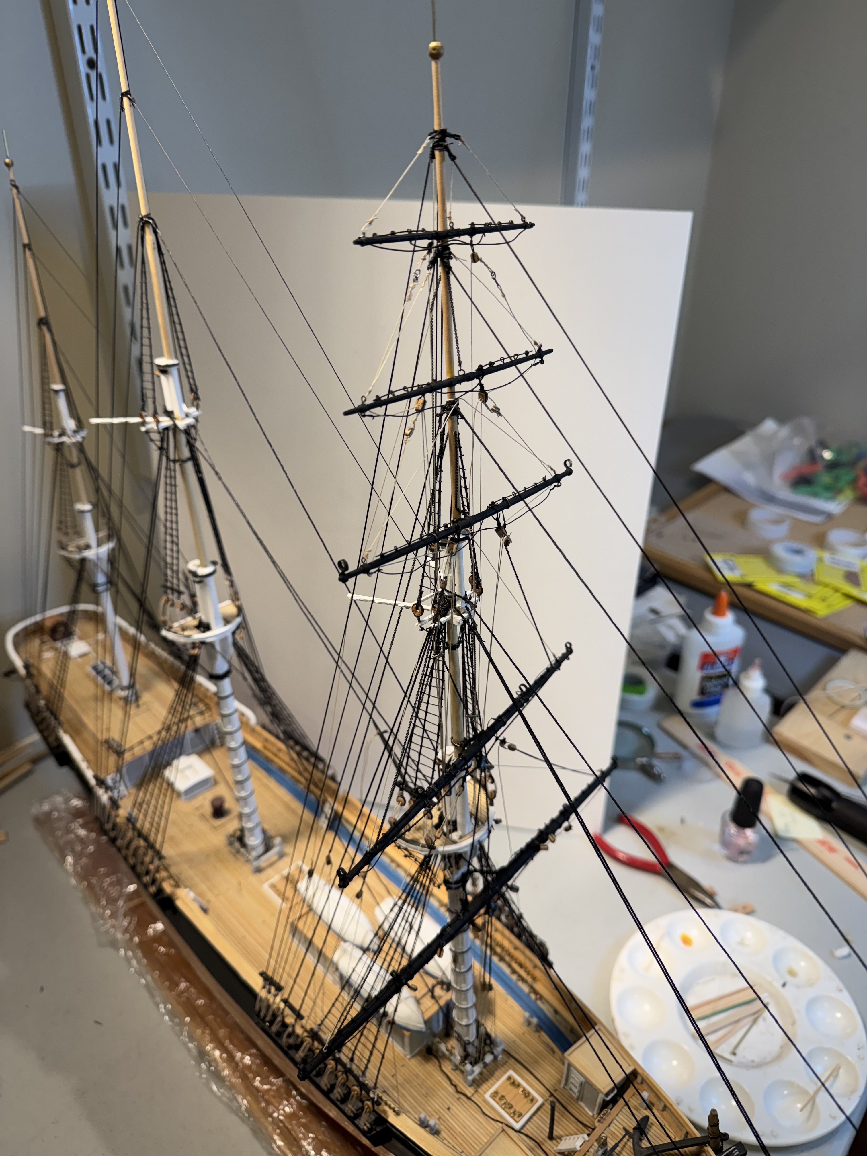

Been way to long since I've posted anything and as I have reached a milestone I have paused to take a few pics and get them into my log.   At this point the standing rigging is "complete"   I'm holding off on the trucks as it seems it may be easier to put those in on an as needed basis when the lines that go through them are put in place.   So now it on to constructing the spars and the hardware to attach them to the ship.
Current Build: Model Shipways 1:96 Flying Fish
Completed:
  • Model Shipways - Rattlesnake
  • Model Shipways - Phantom
Planning:
You've moved along impressively.  Nice clean work....she looks wonderful.
Rob
