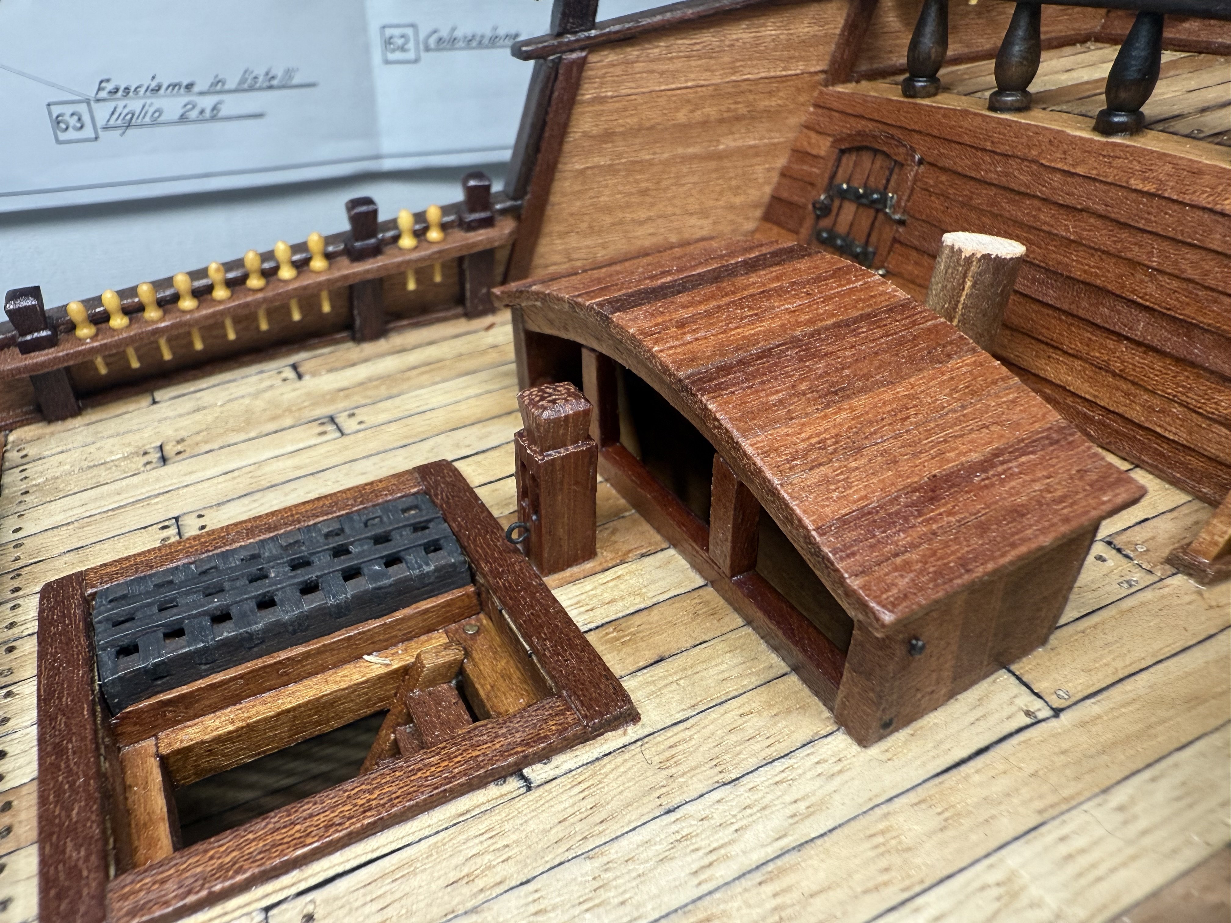

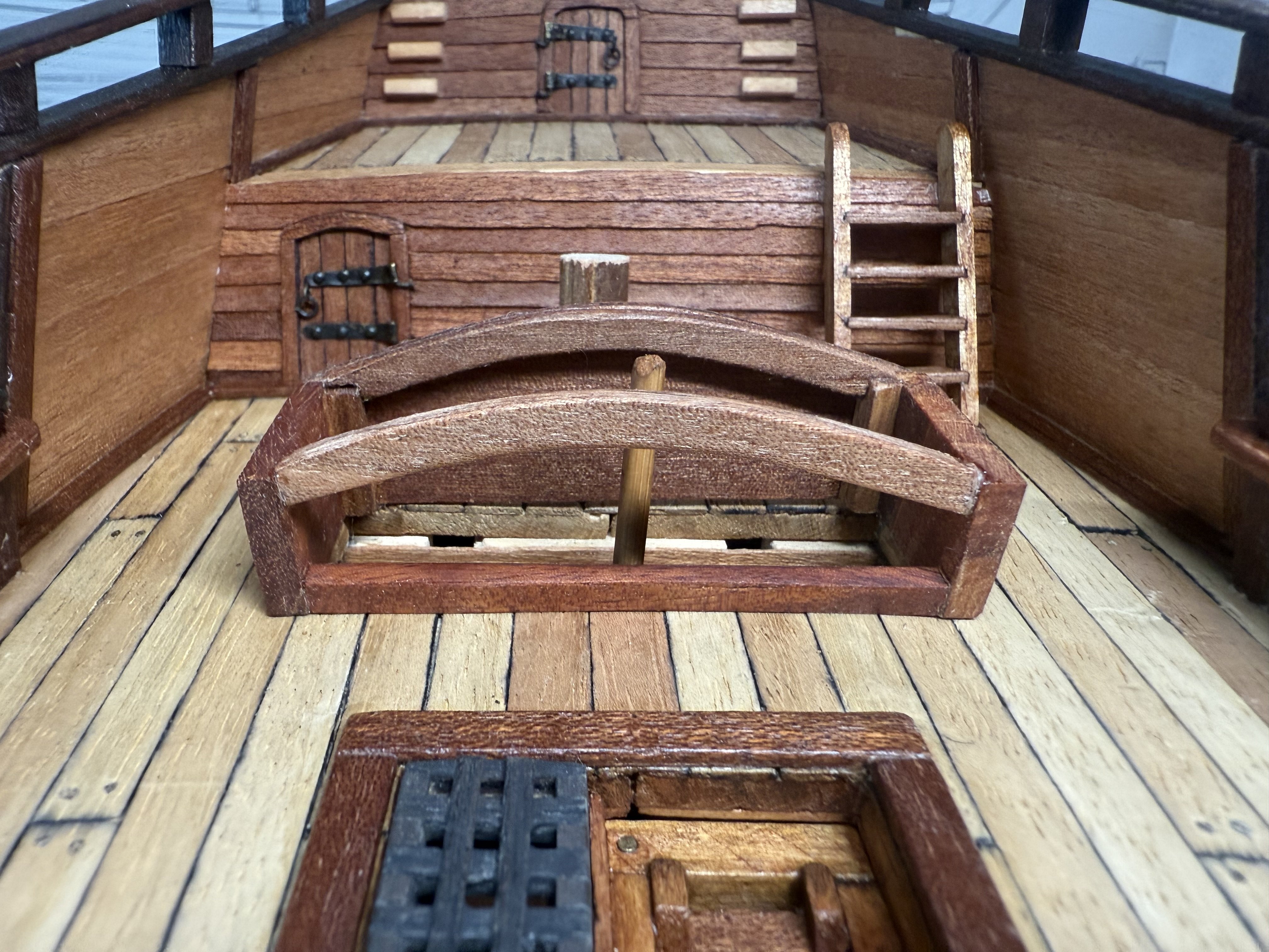

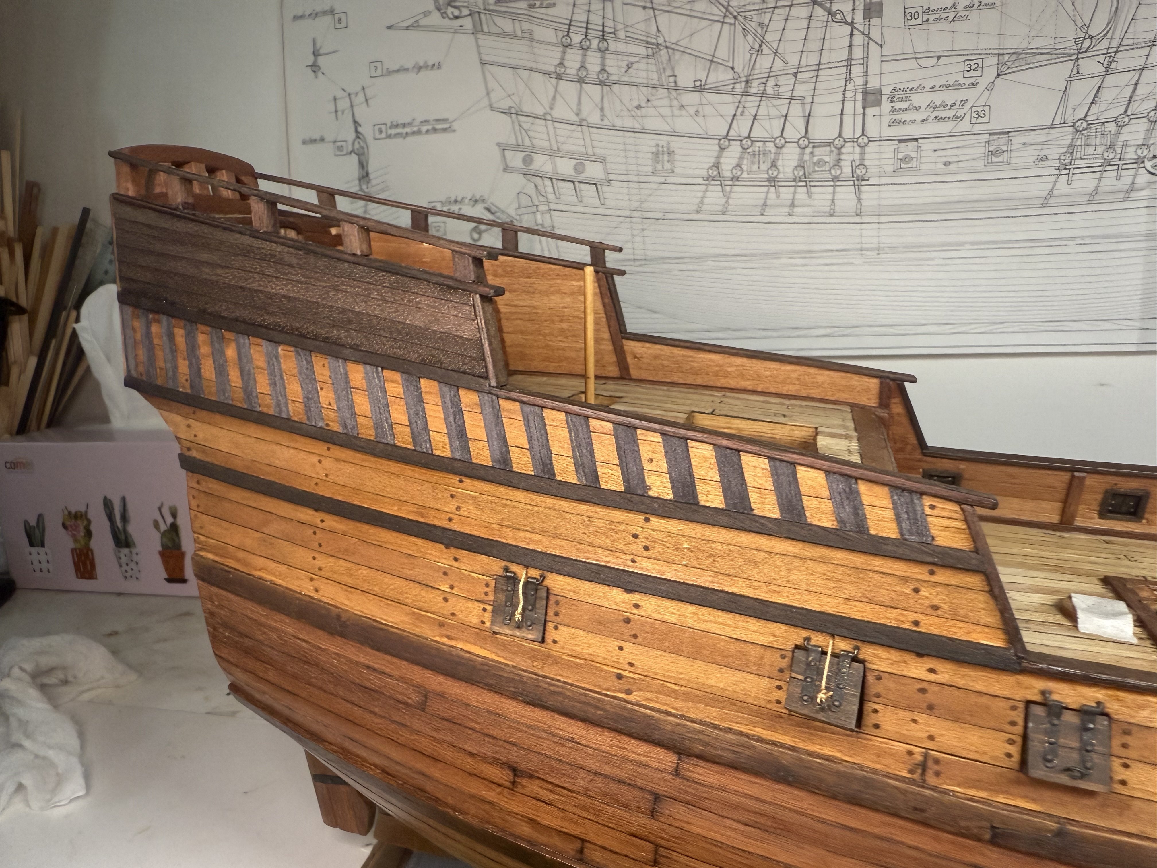

For the quaterdeck entrace of GH2, I am keeping the basic design on GH1 - basically an open entrance with more covering on both sides.

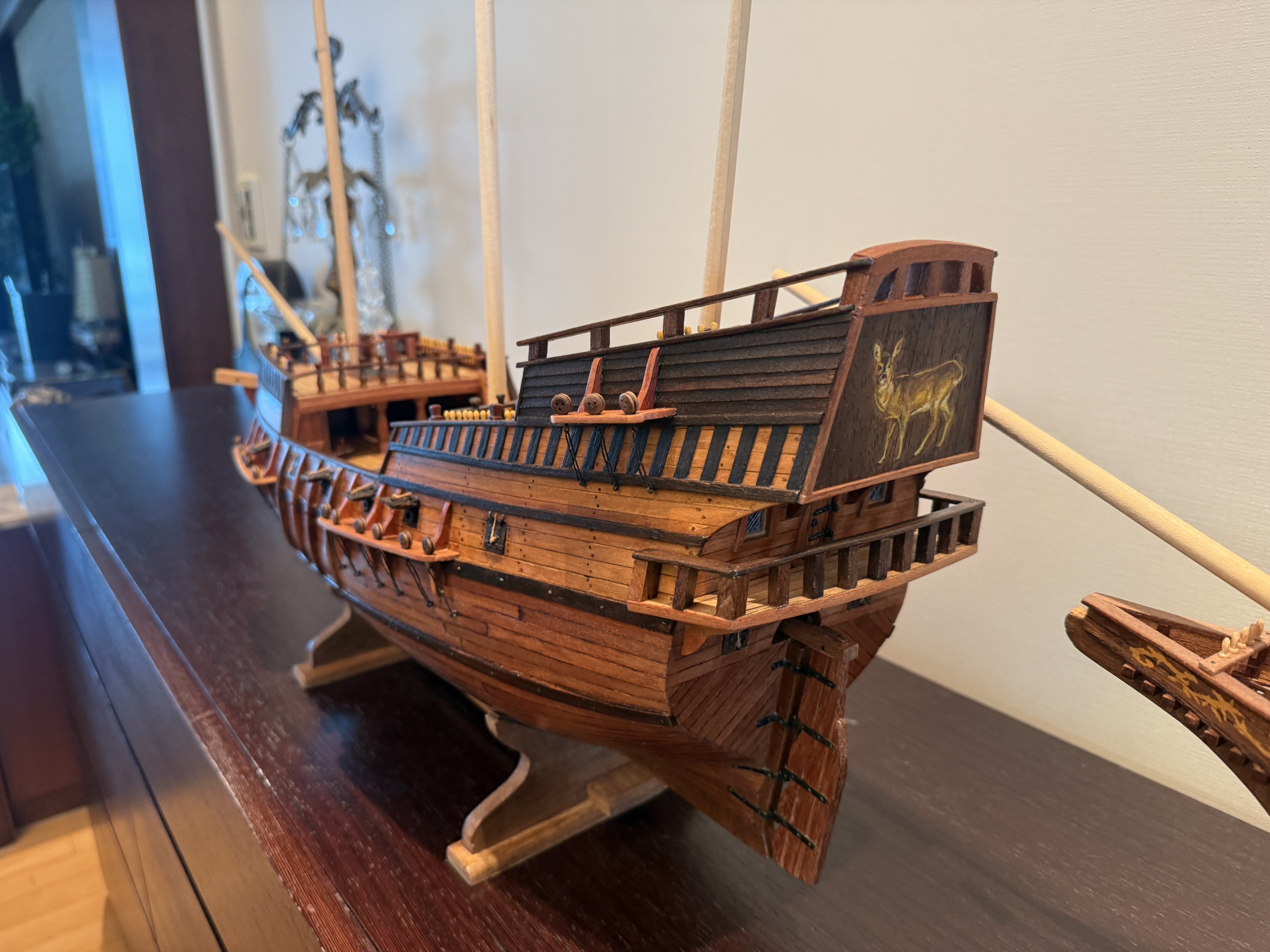

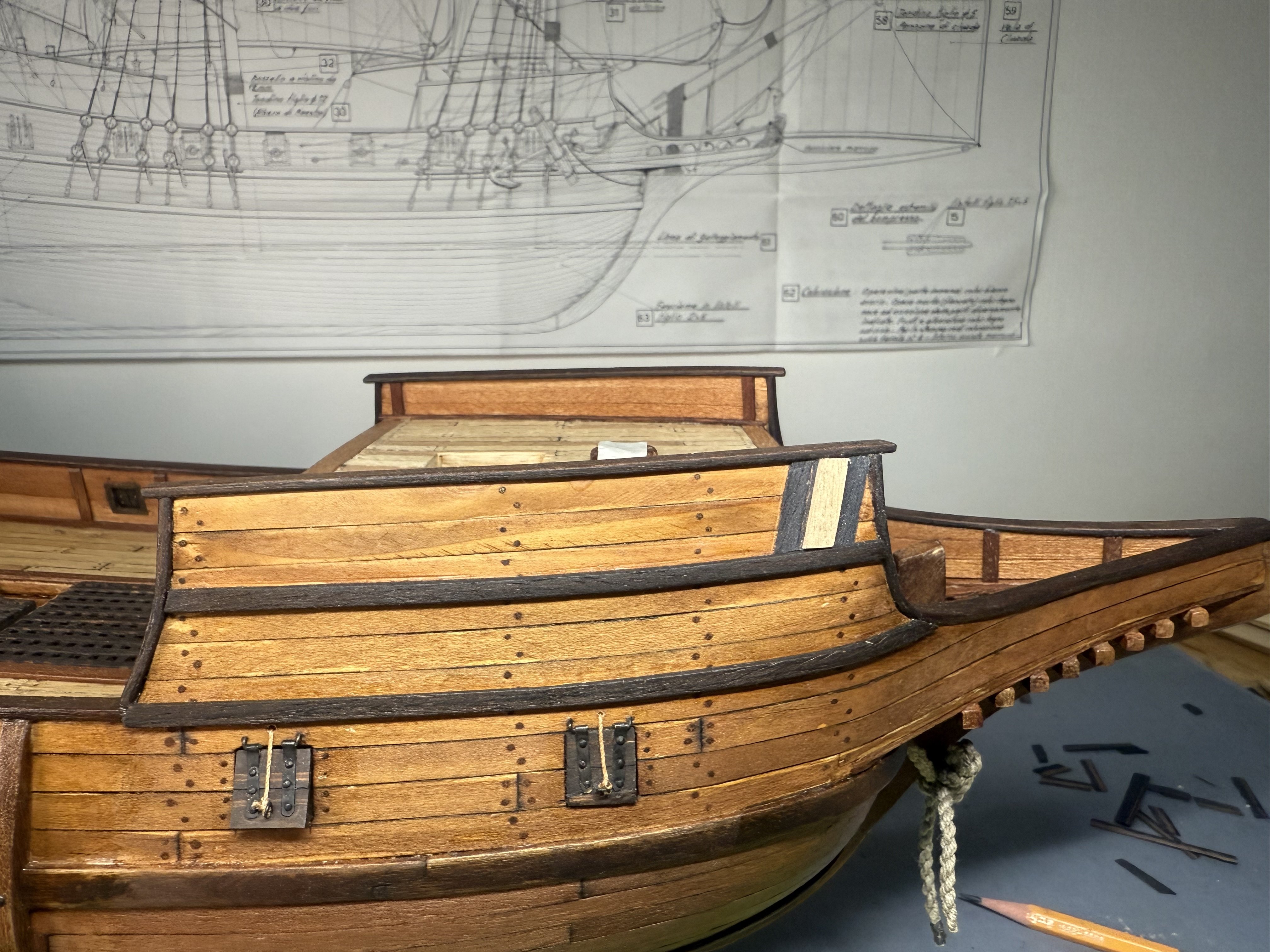

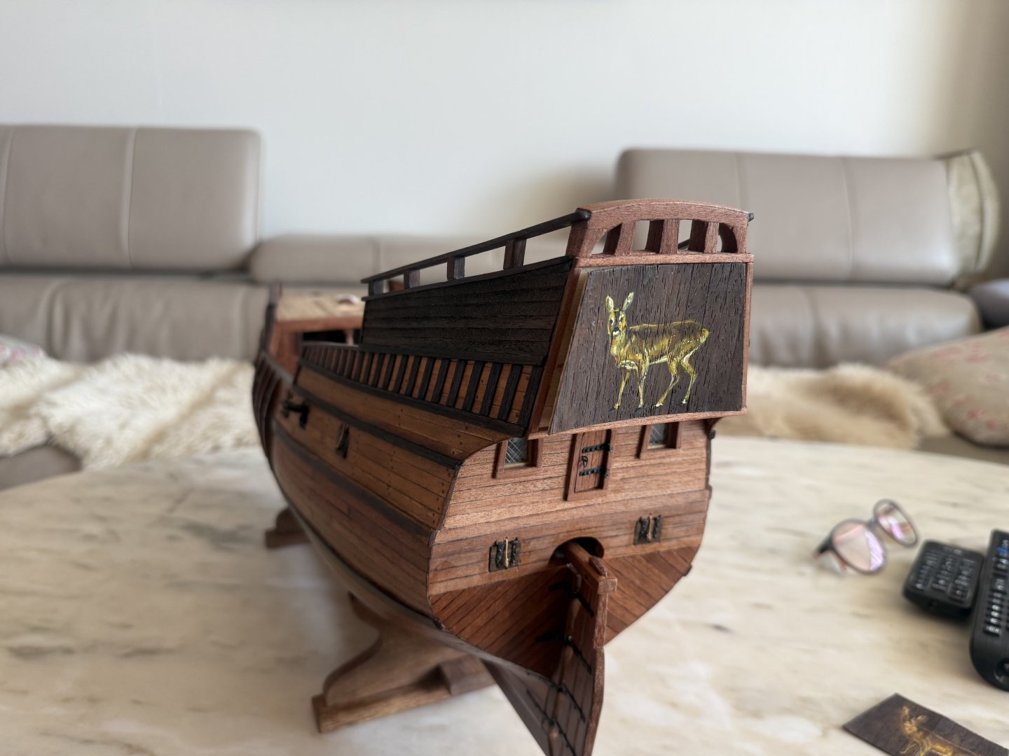

On GH2, I decided to go for a much simpler upper hull decoration, also giving more contrast to hull color vs. wale & decoration color. I used mainly thin ebony strips for the upper hull decoration.
Edited by Rock_From_Korea
Regards, Rock
Current project : Golden Hind 1:48 scratch build
Finished projects : HMS Endeavor 1:60 CorelKorean Turtle Ship 1:64 Young Modeler

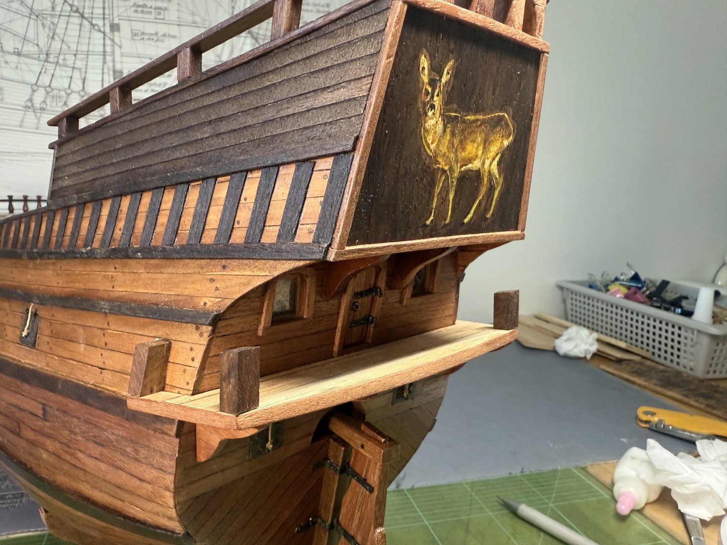

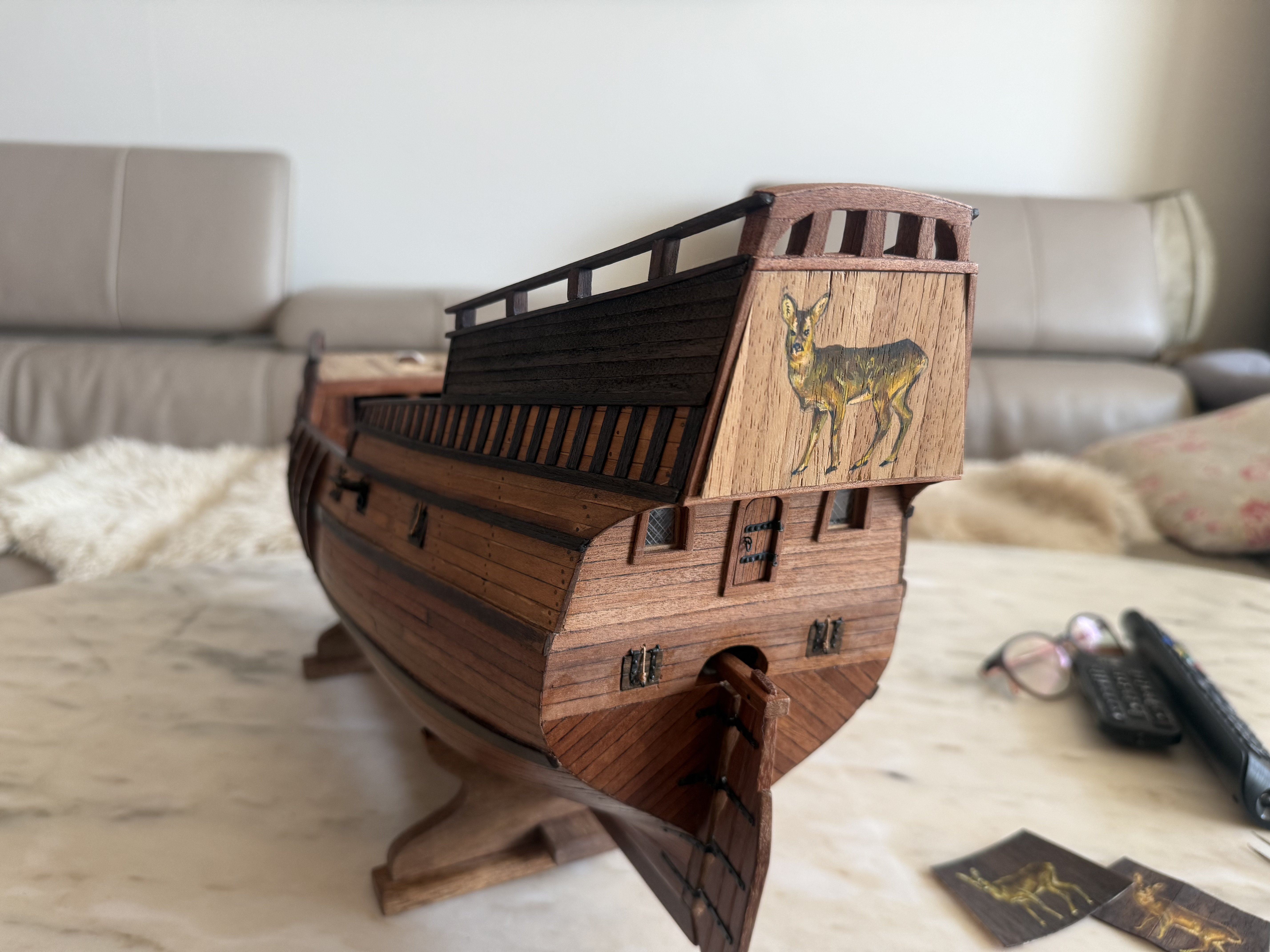

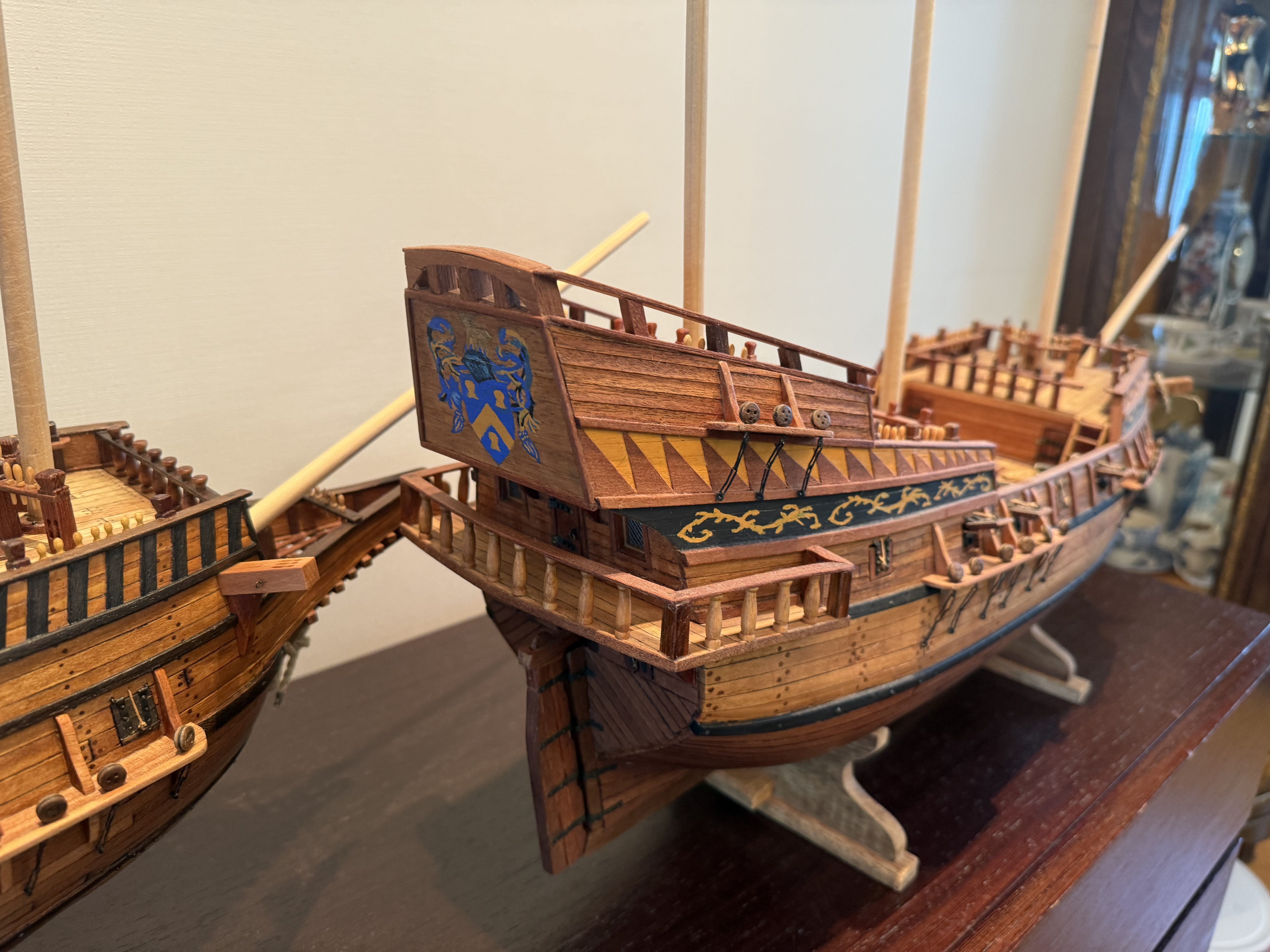

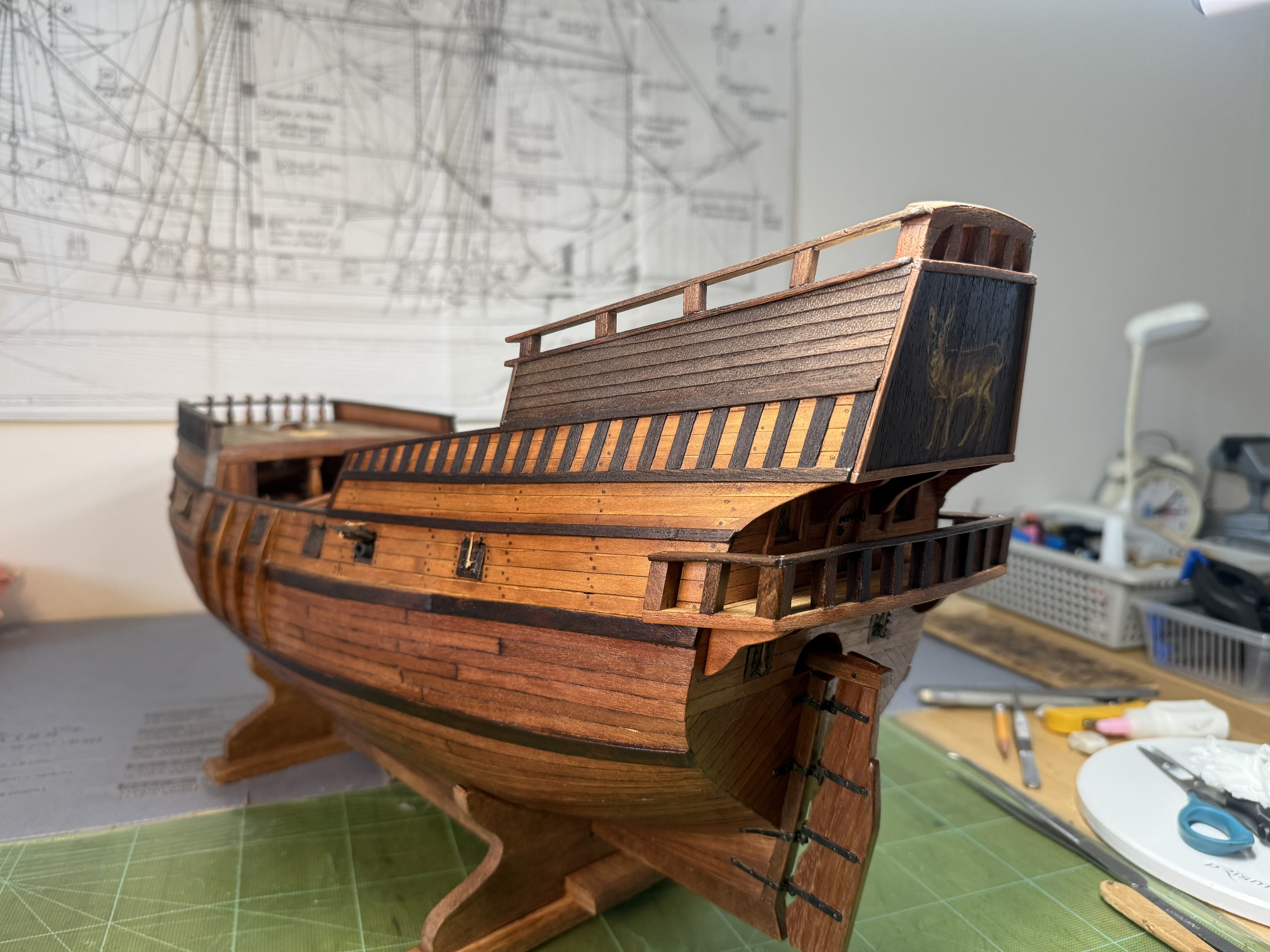

For stern painting, I commisioned my art student daughter to do 3 golden hind paintings. I chose one of them for GH2.
BTW, the smudges on the edge of the deer is my doing, not my daughter’s. I made stupid mistake while varnishing the stern picture.
For stern  balcony, I decided to apply a more streamlined and compact design as below.
The rail design of the bow area has been changed from GH1. All the subsequent rails will be done in this style.

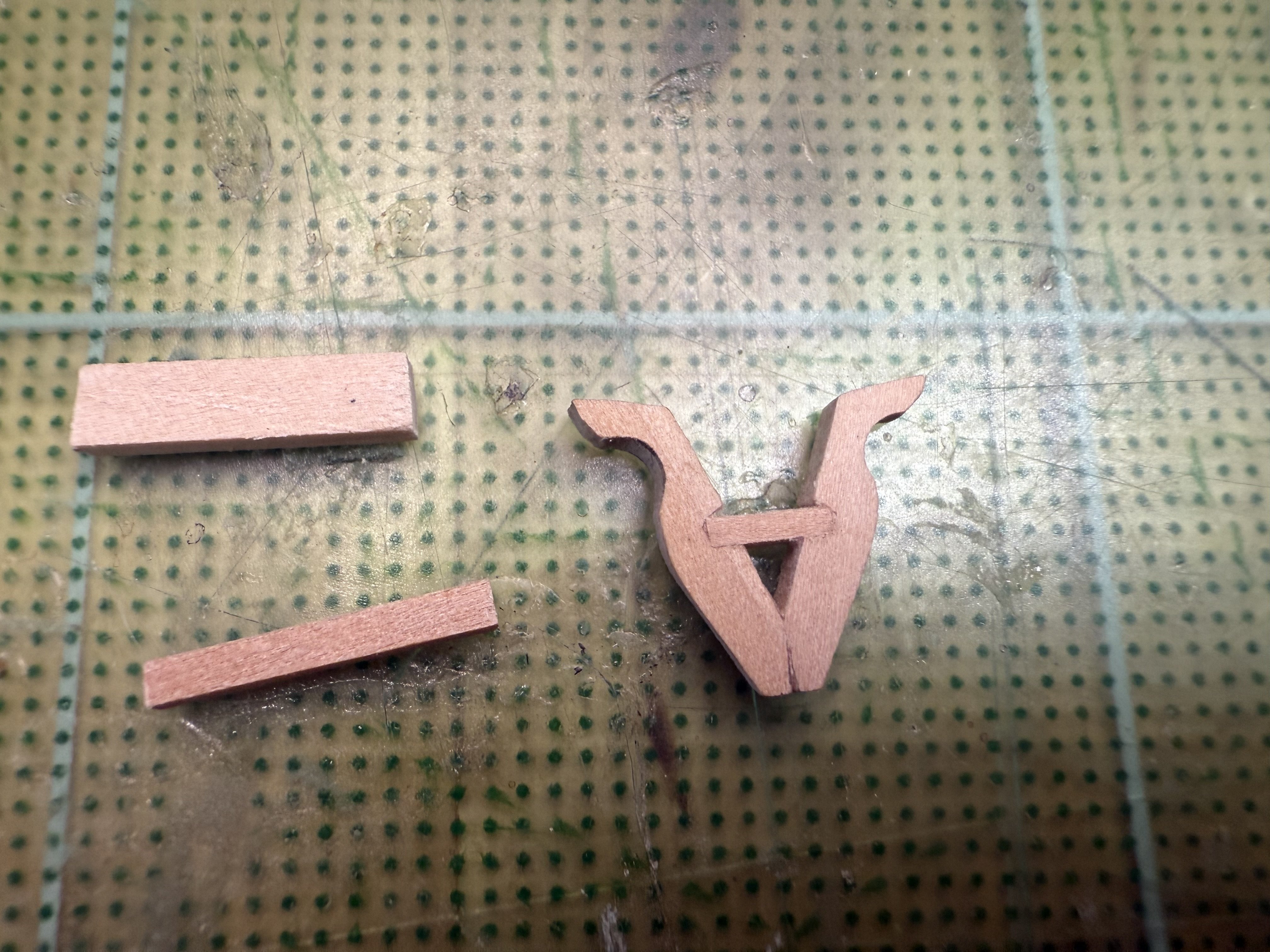

Hello shipmates~!

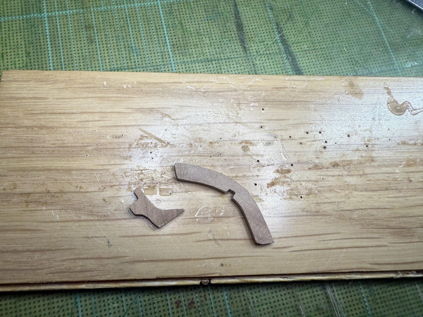

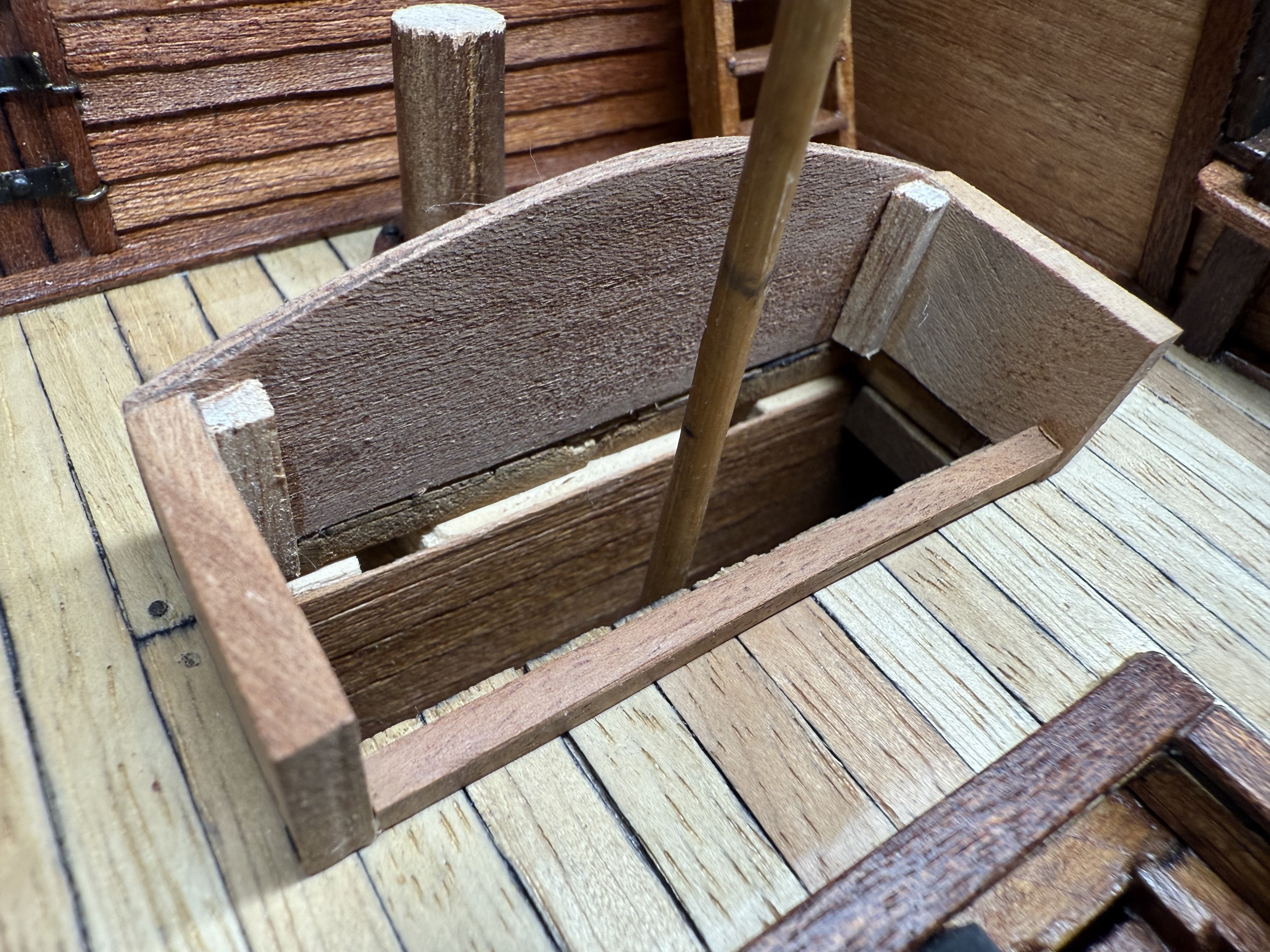

Some updates on GH2 (Golden Hind 2) where the methodologies I applied and/or materials I used differ from GH1.

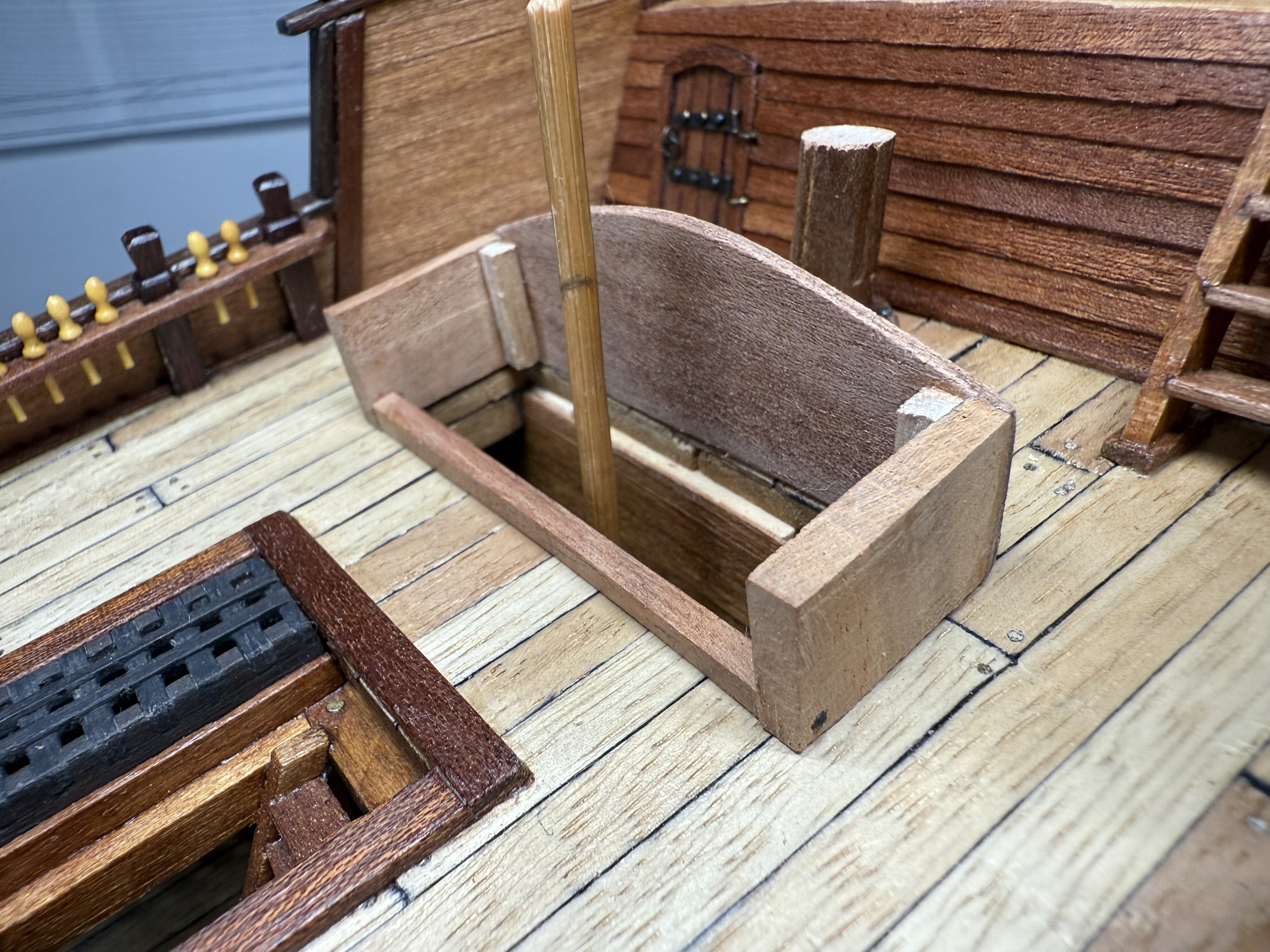

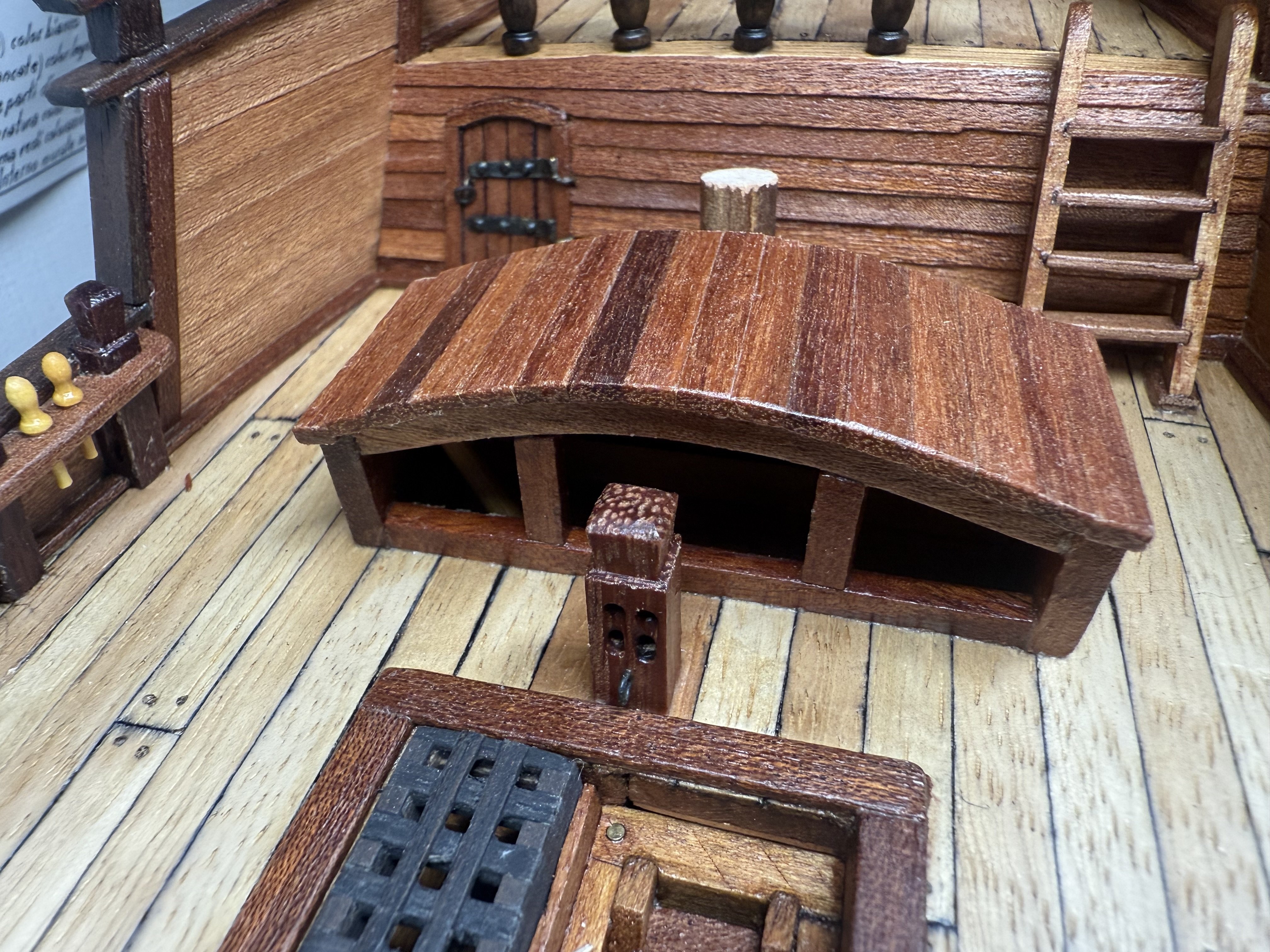

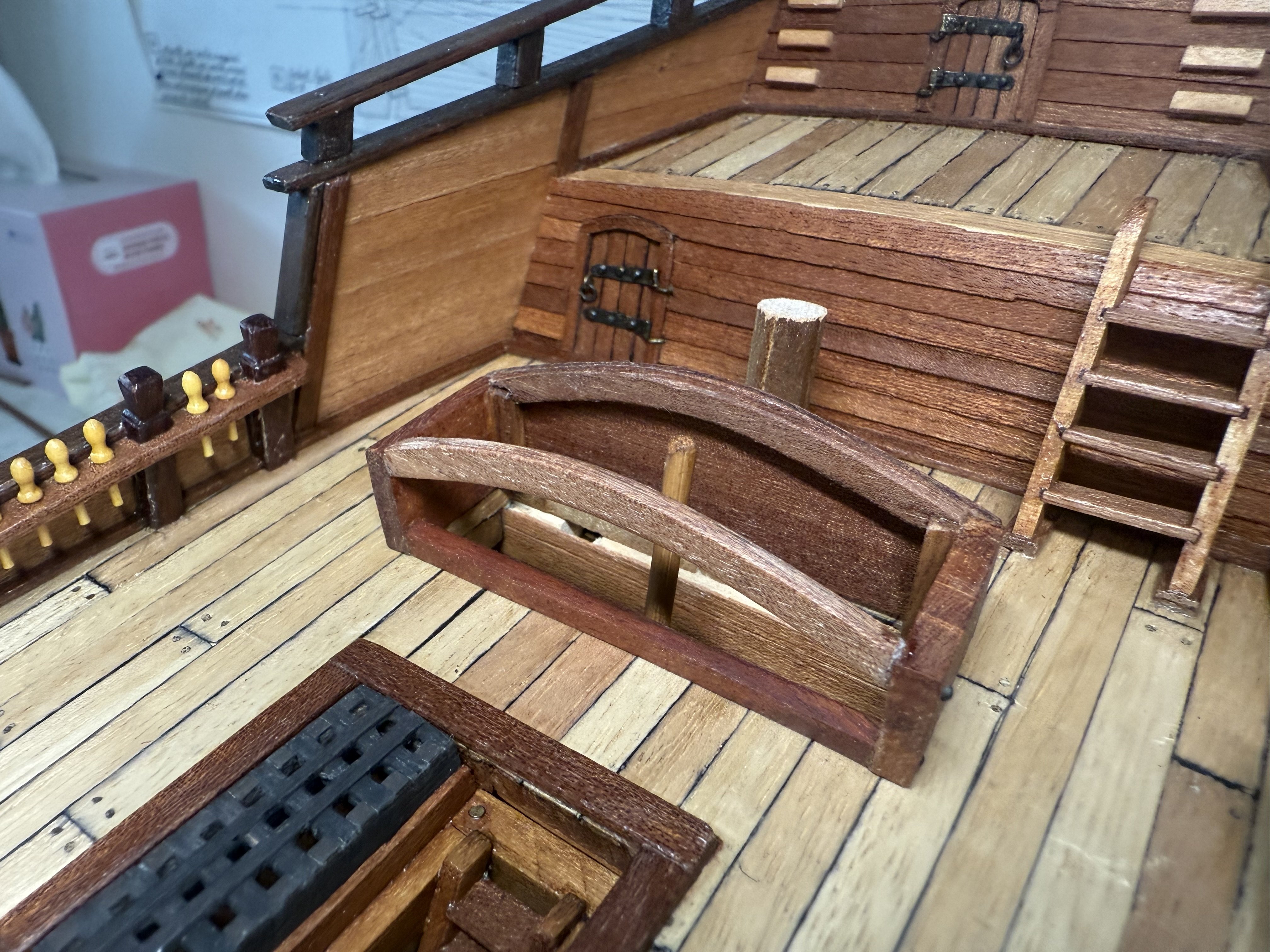

The whipstaff house design is more or less same as GH1, but I used slightly different methods to put them together more solidly.

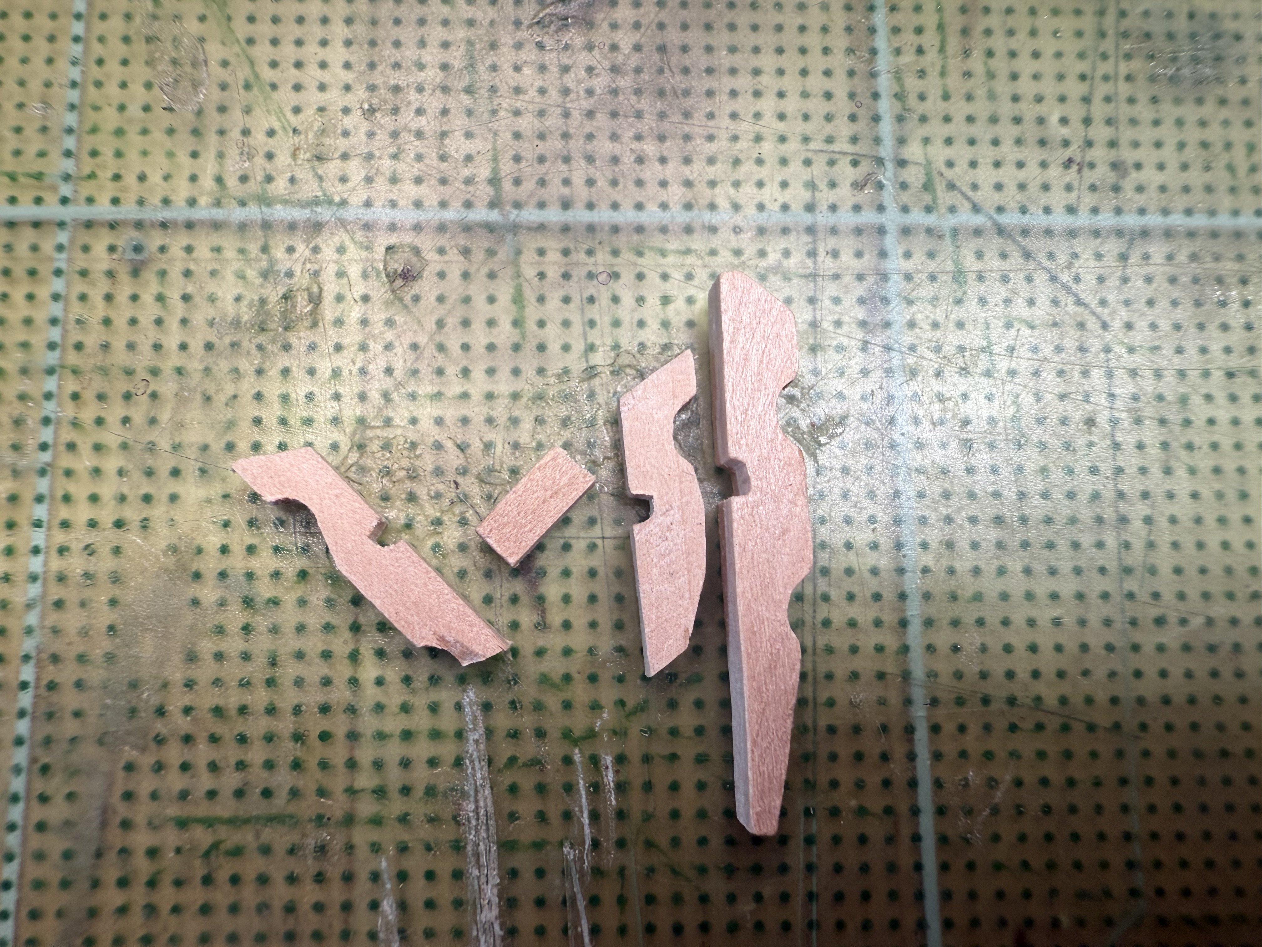

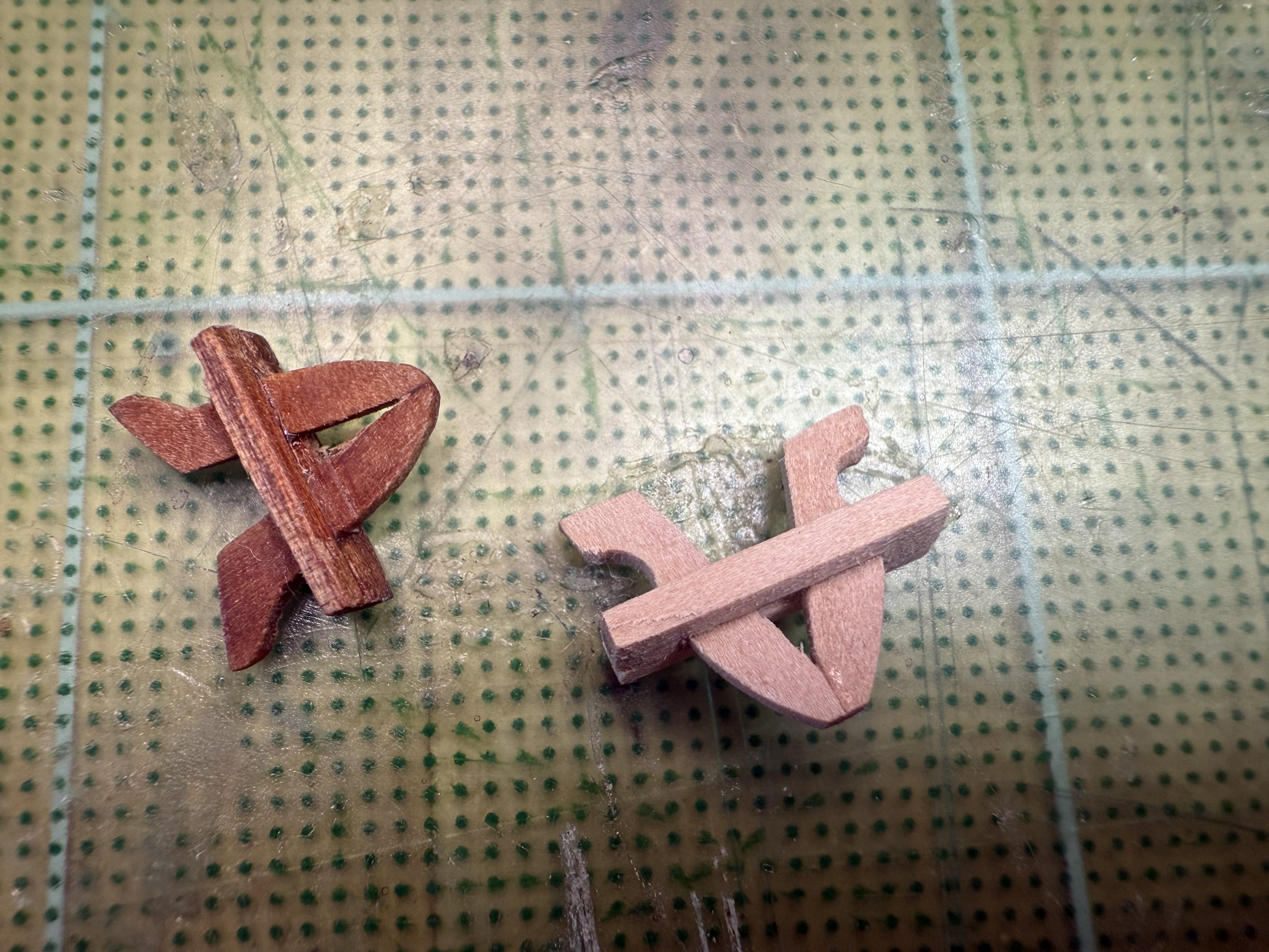

For the staghorn kevel, I was looking for a more solid material that could be thinner/smaller and still provide strong structural strength.

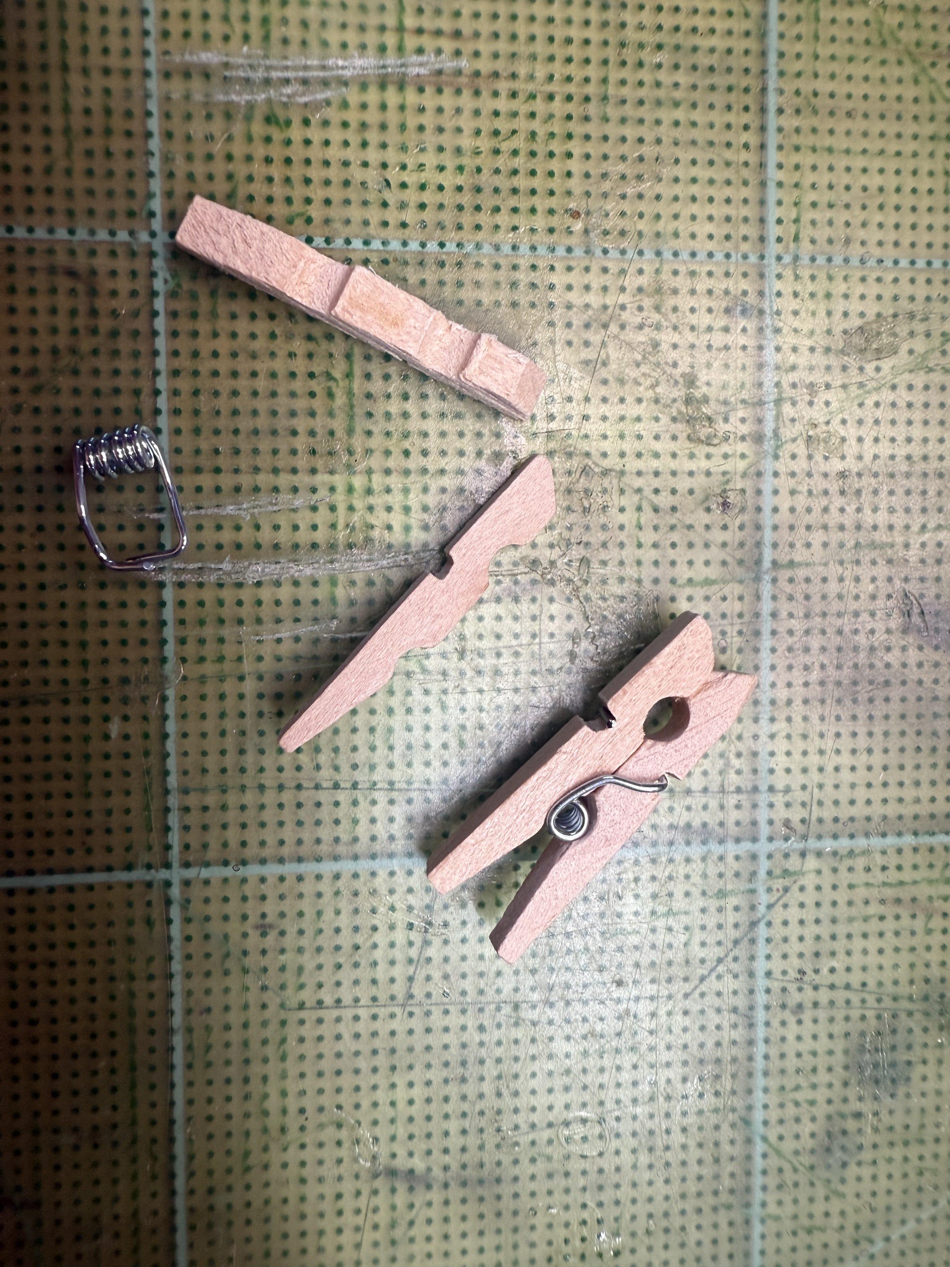

I accidentally came across a small wooden tweezer in a discount store that satisfied my original purpose but also provided me with basic shapes that I can utilize as is for the kevel creation.
As you can see from above picture, I used most of its original shape to construct the kevel. Saving me much time!
Slightly thinner and smaller ones are the new kevels.

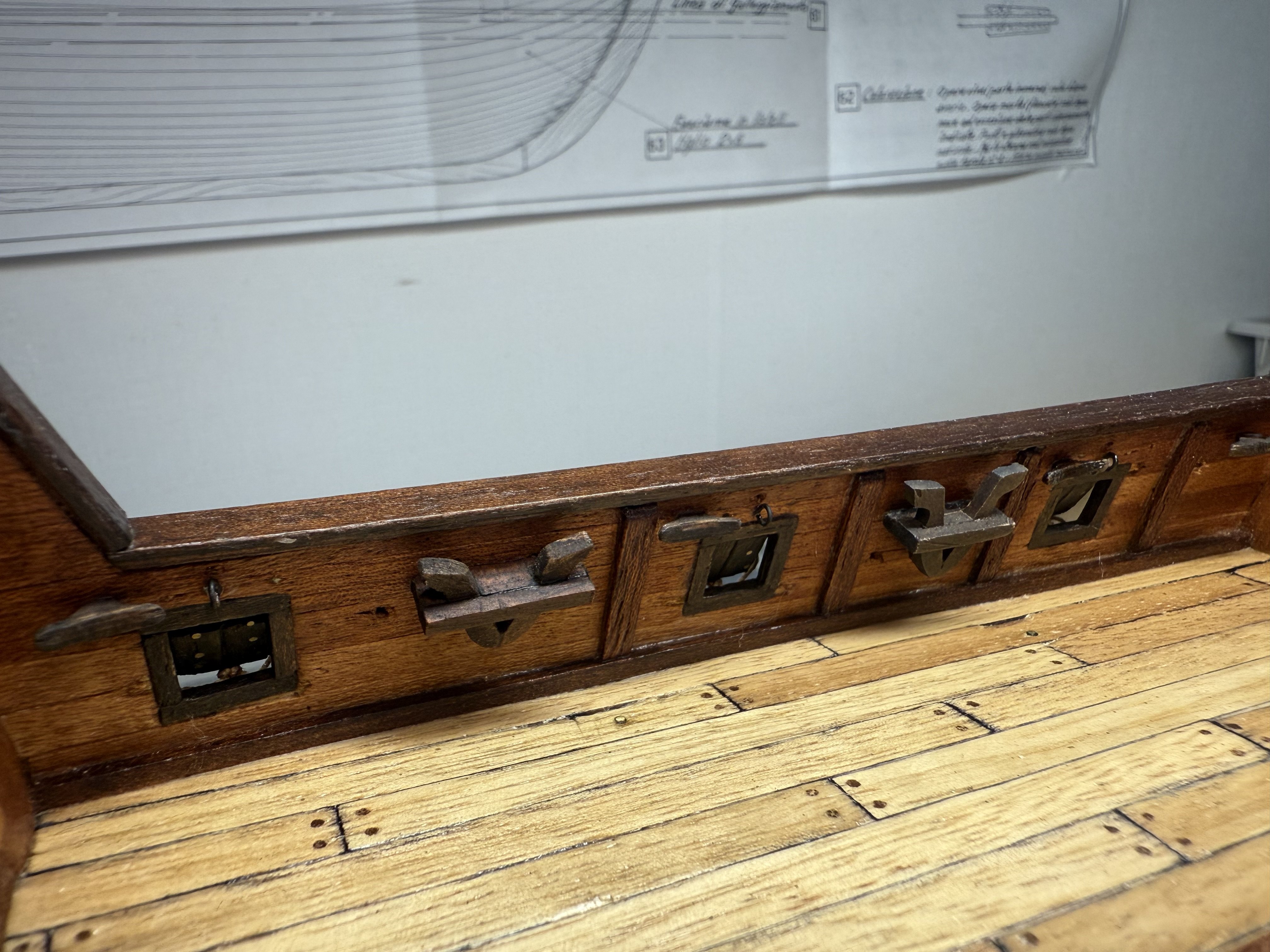

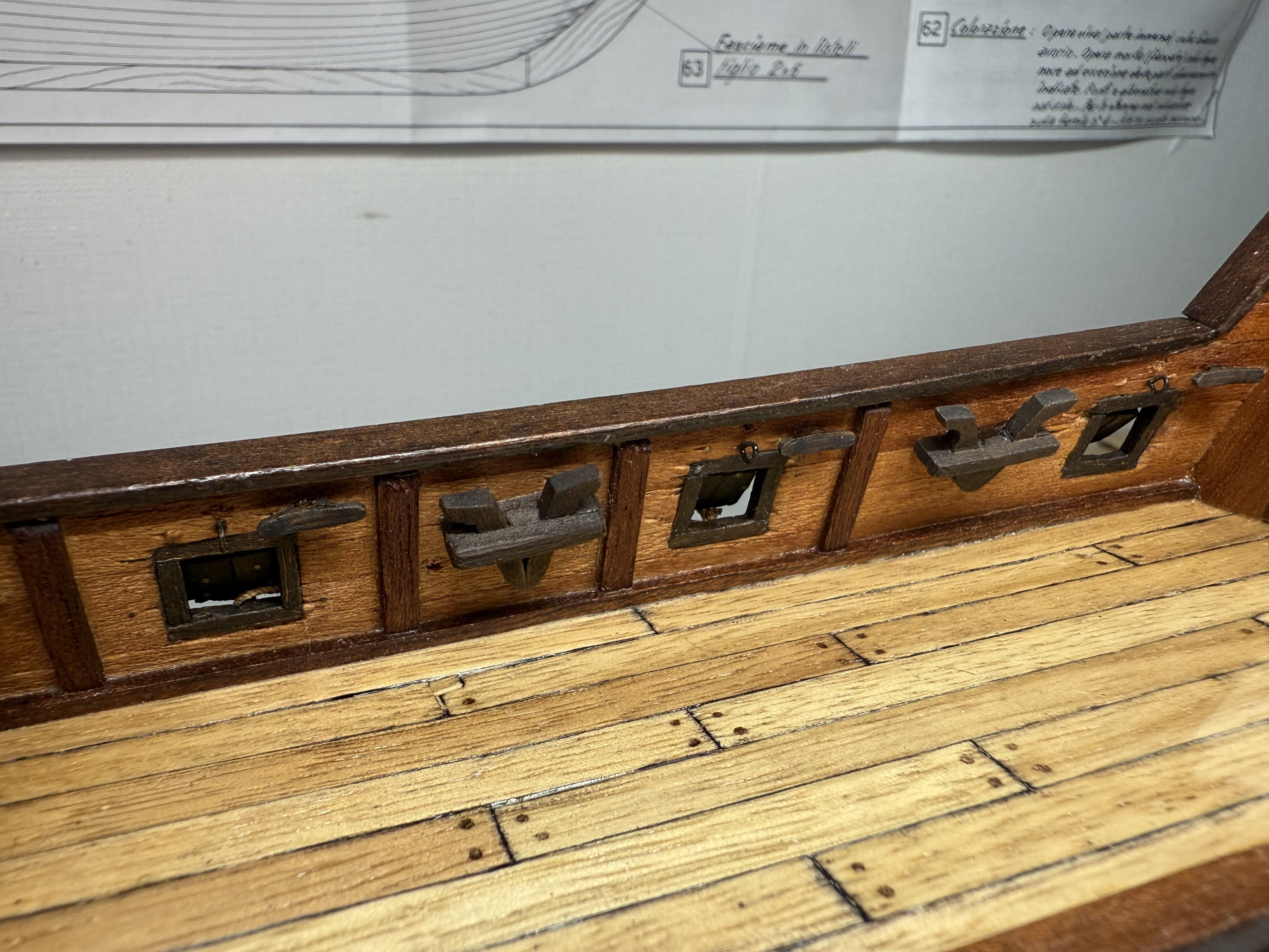

Hello shipmates~

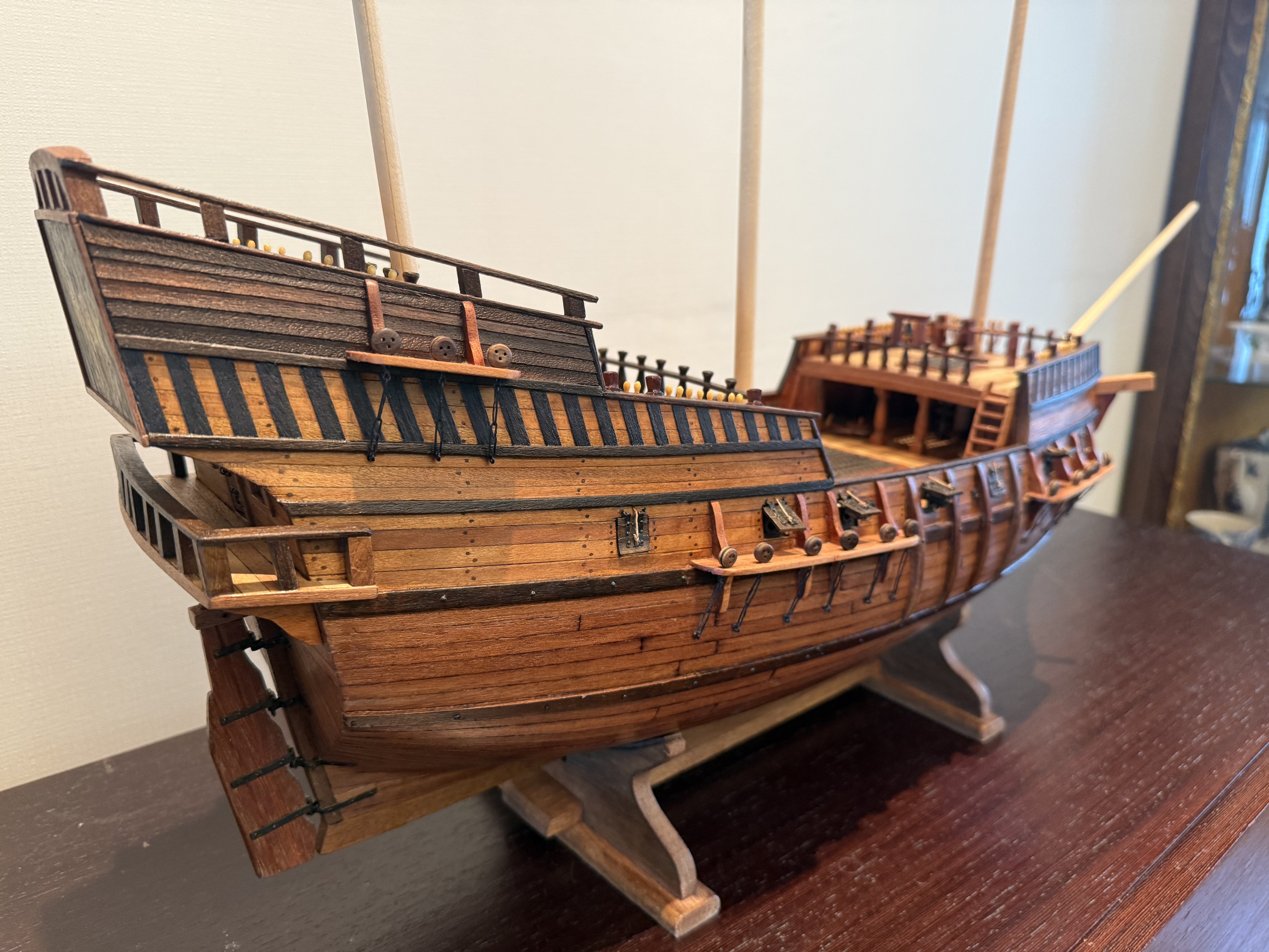

A small update today. With the remnants of the small wooden clips, I made portholes(not sure if this is the right jargon) for the lines that would lead inside (from outside) to be tied to the staghorns. Below are some pictures of the work carried out.
I have not applied this feature in GH1. But, I think I need to (or at least I will try to).
Also, there is slightly different feature vis-a-vis the weatherdeck cannons. I tried to render a situation where some cannons are stowed away.
GH2 hull work is almost finished. My next update will feature the comparison photos of GH2 to GH1 and the resumption of work on GH1 - masts, rigging and so on.

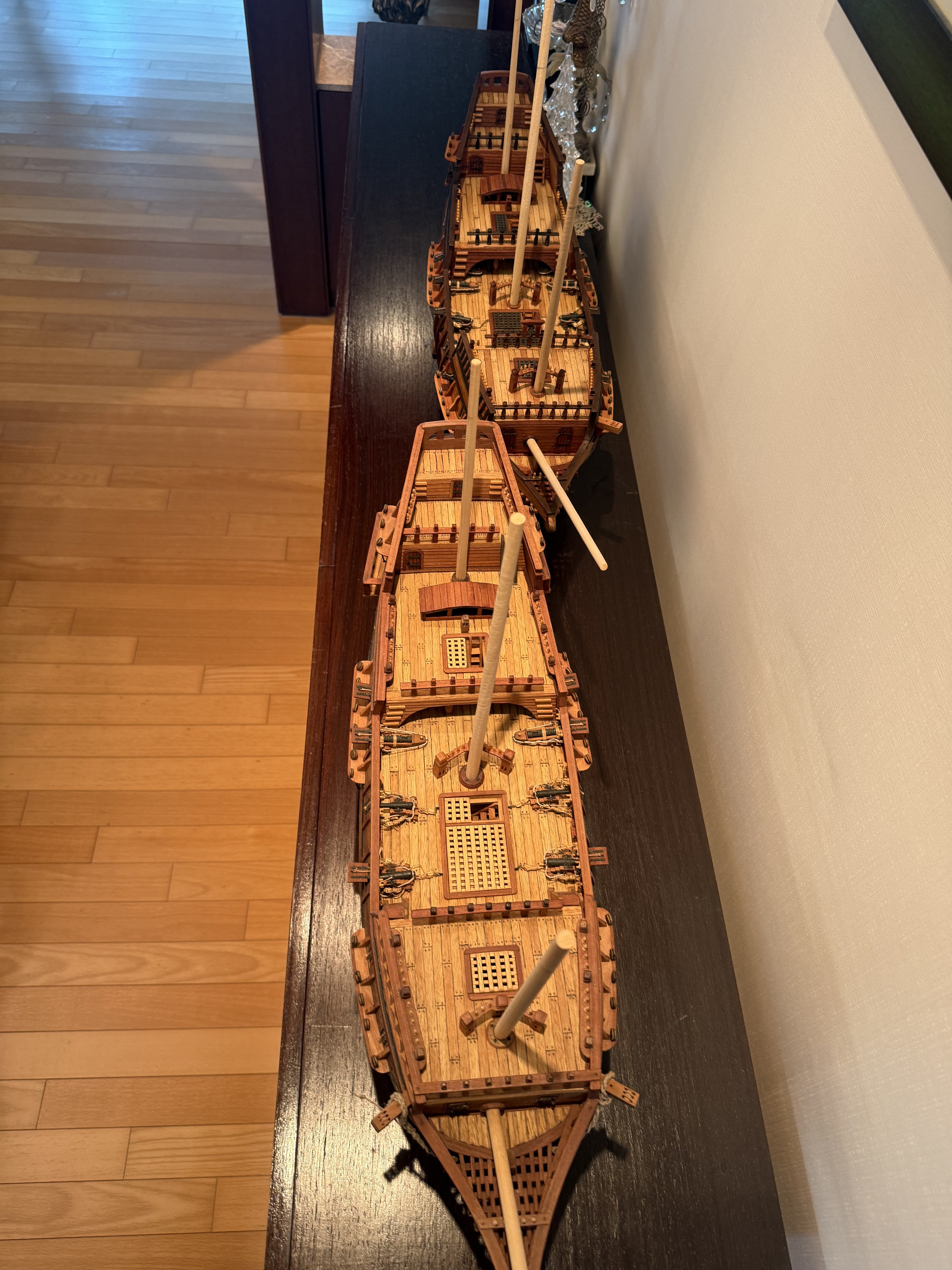

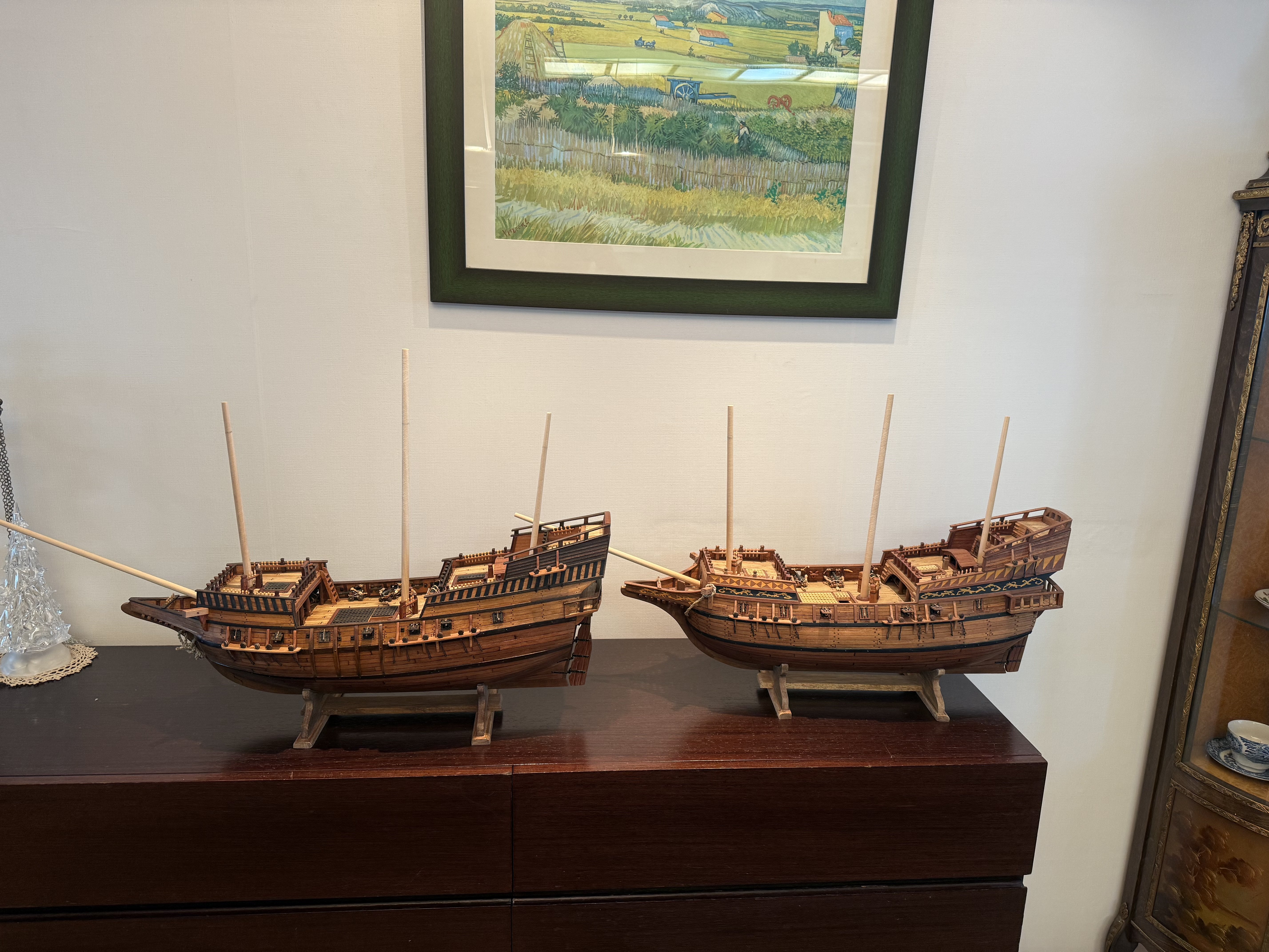

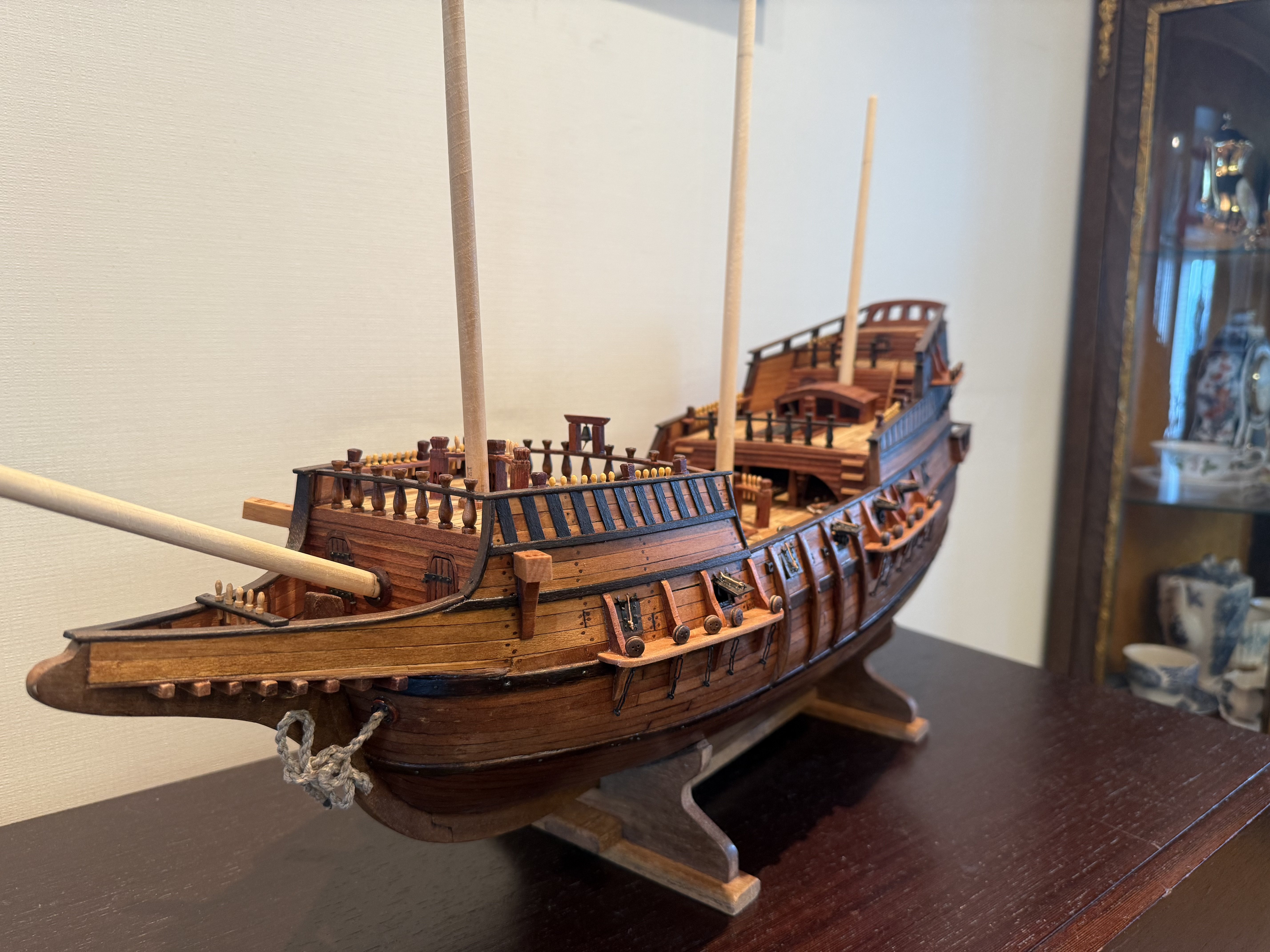

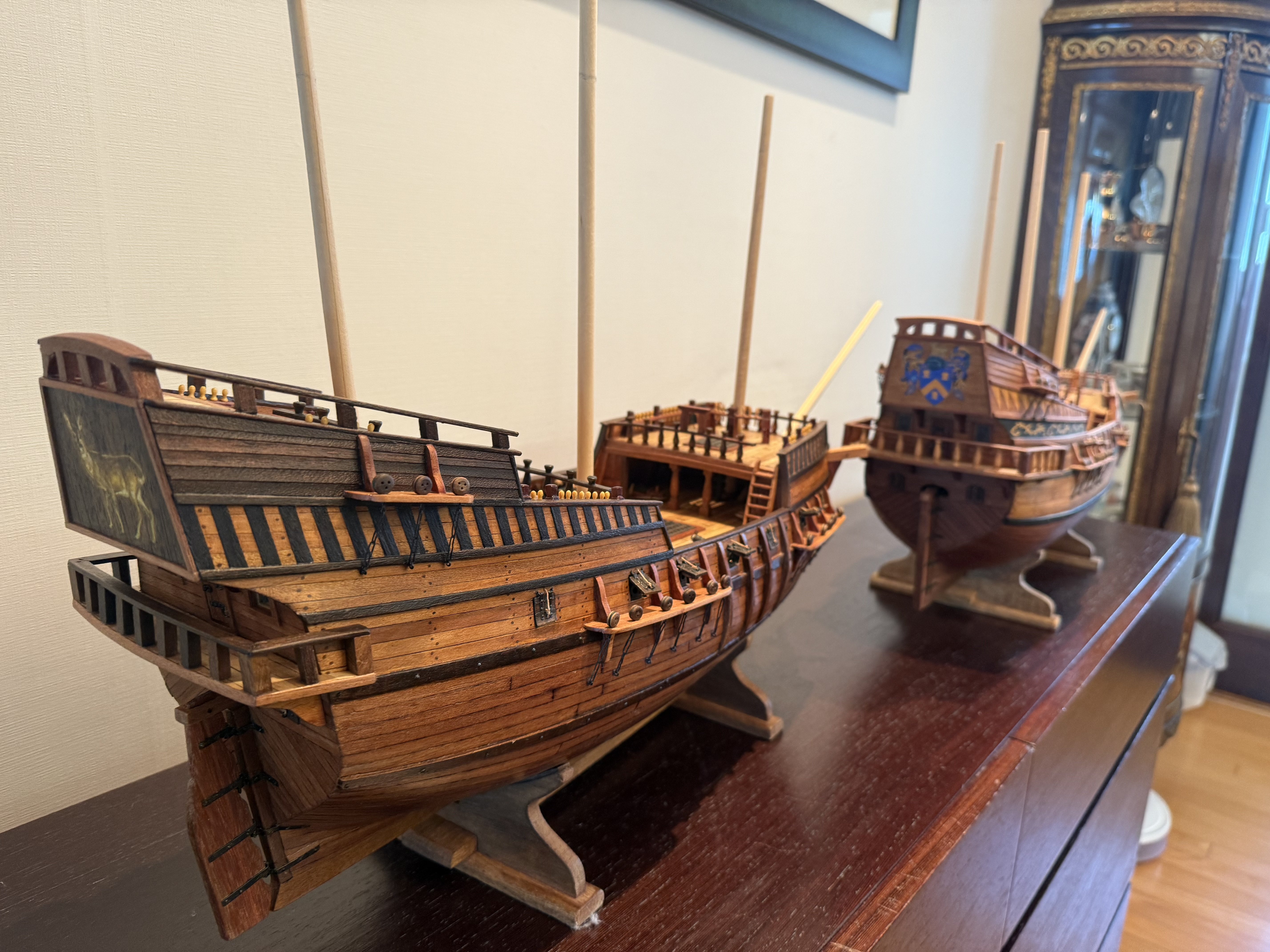

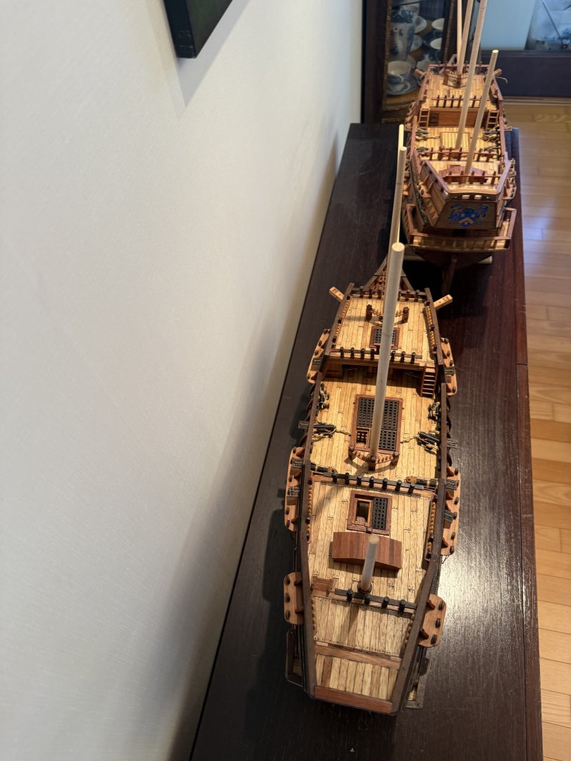

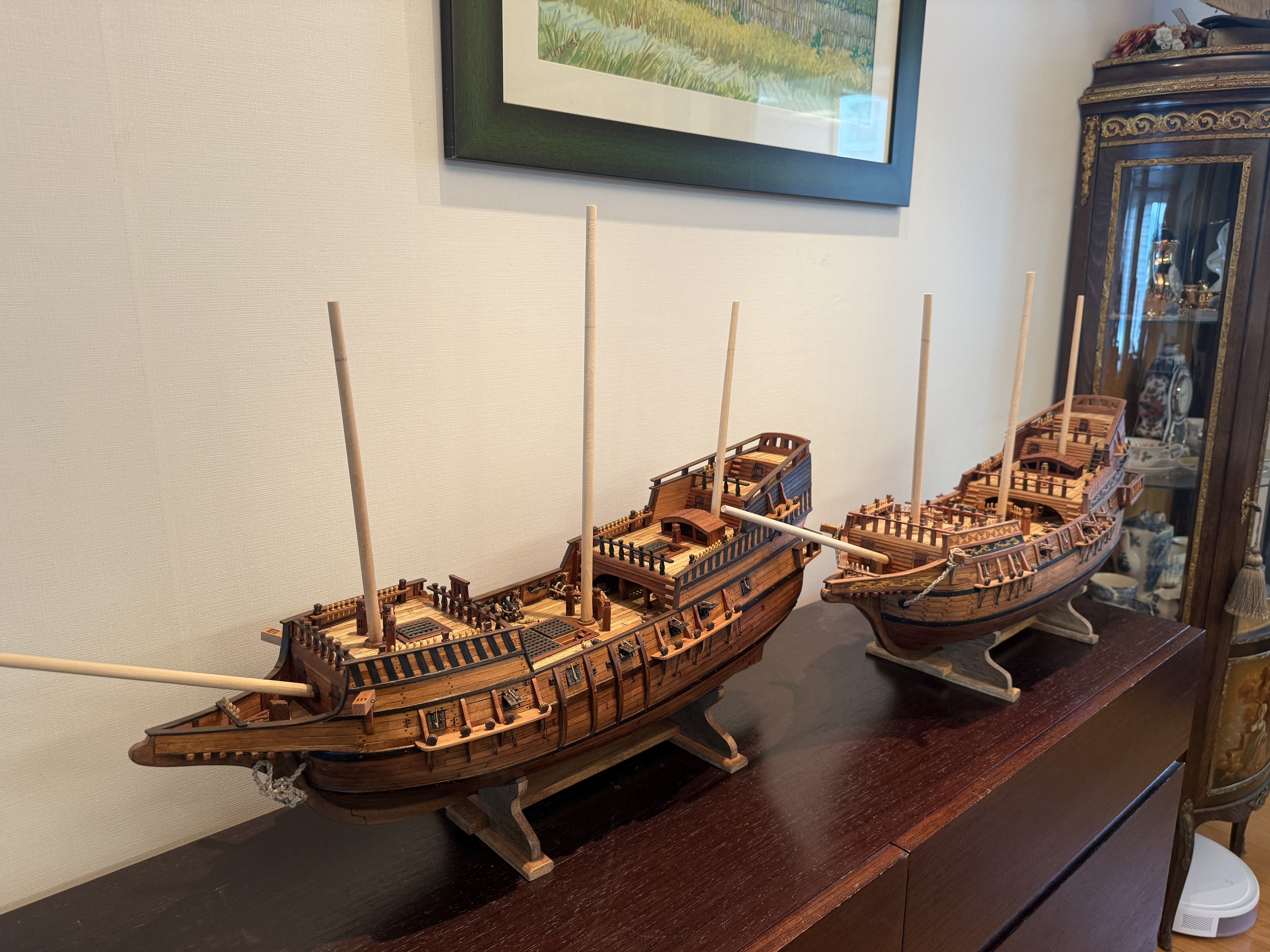

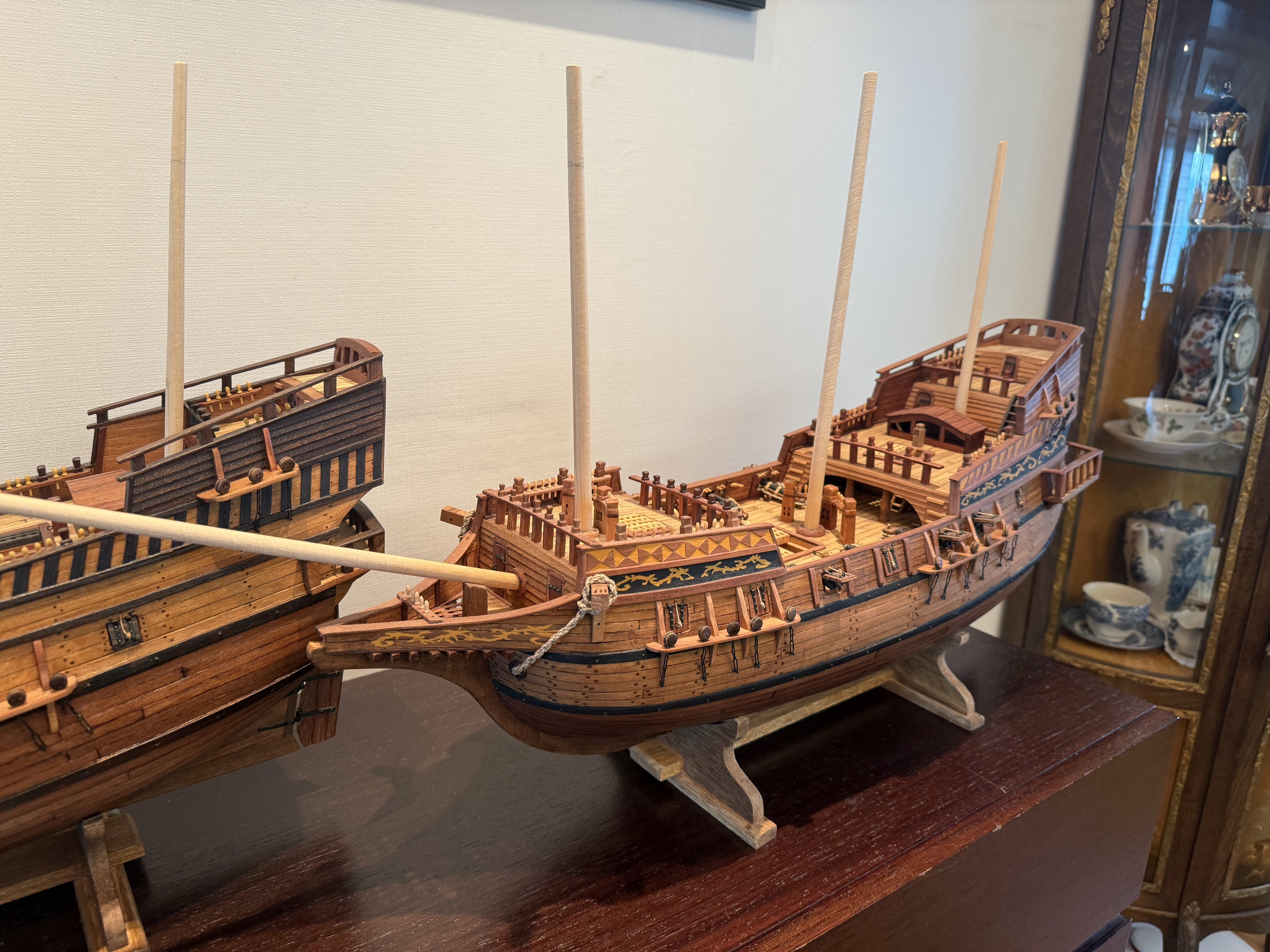

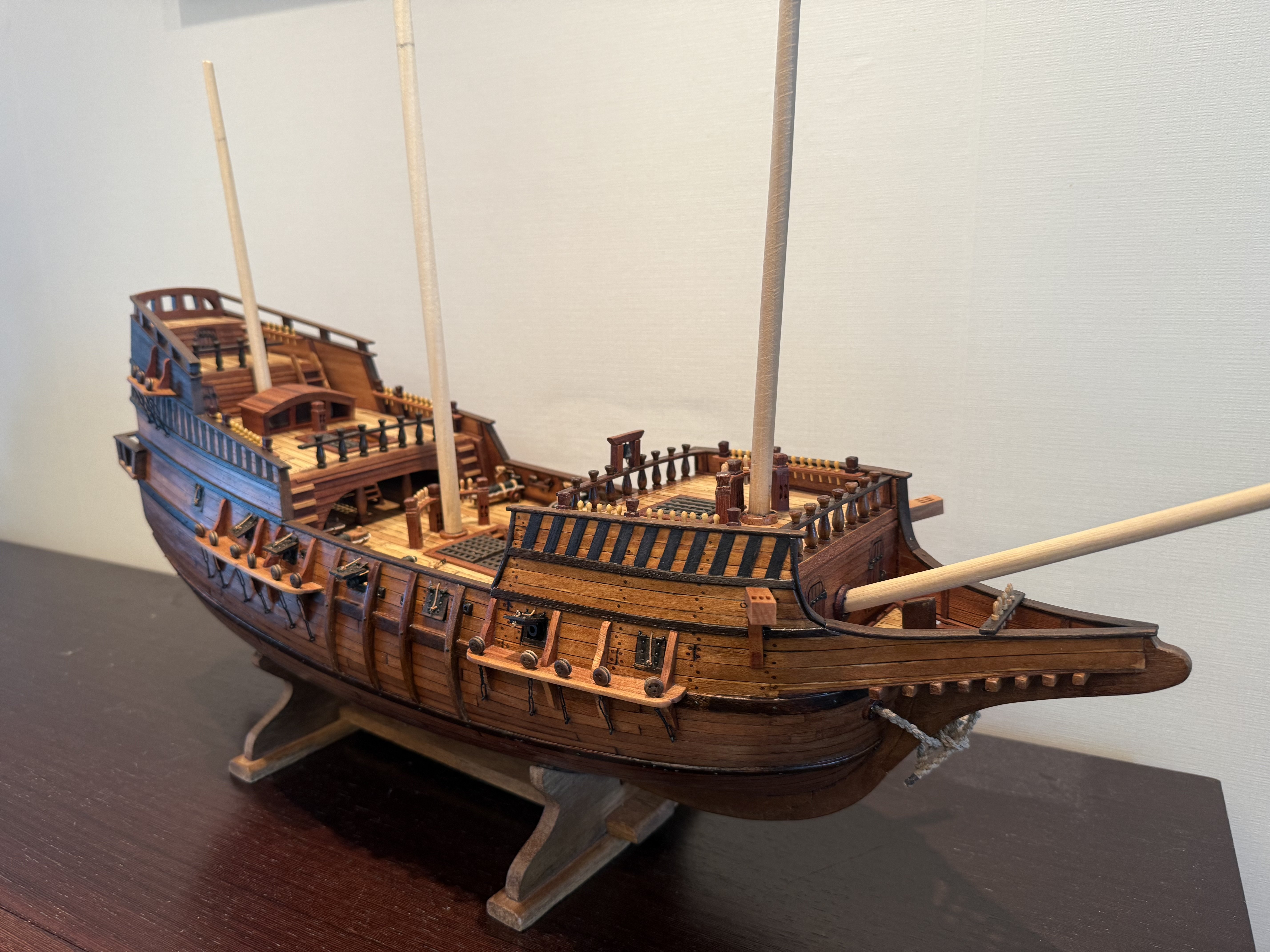

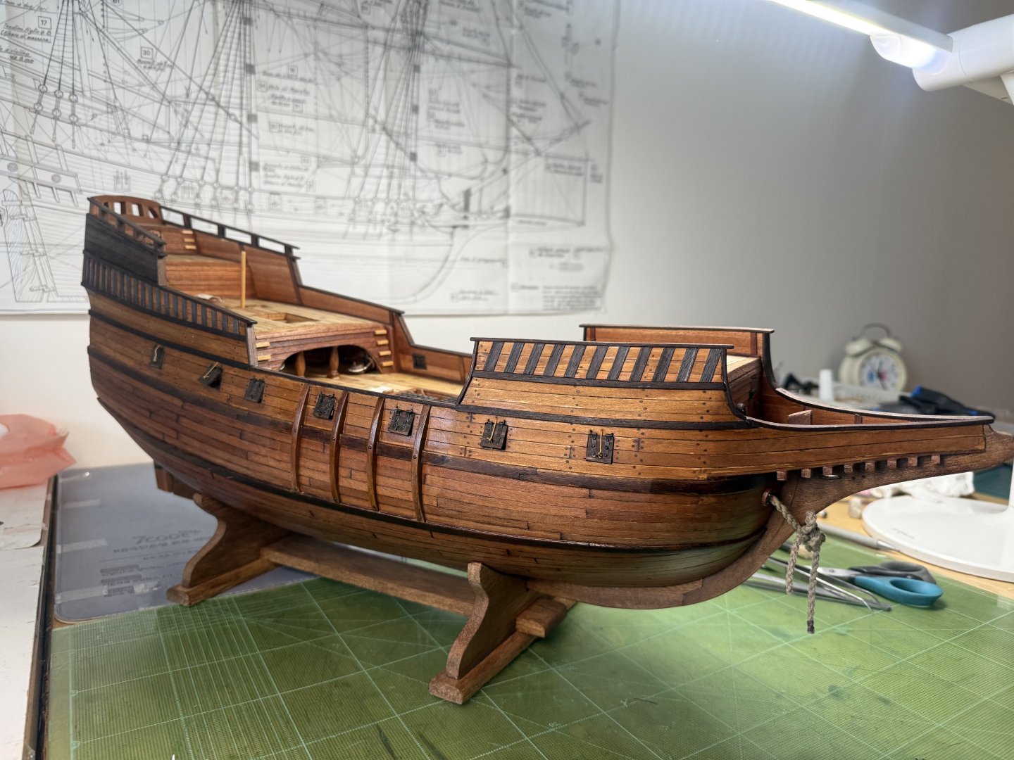

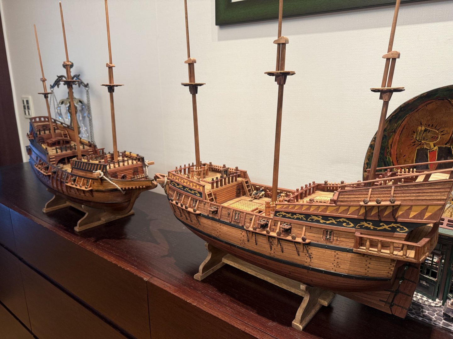

Hi all~

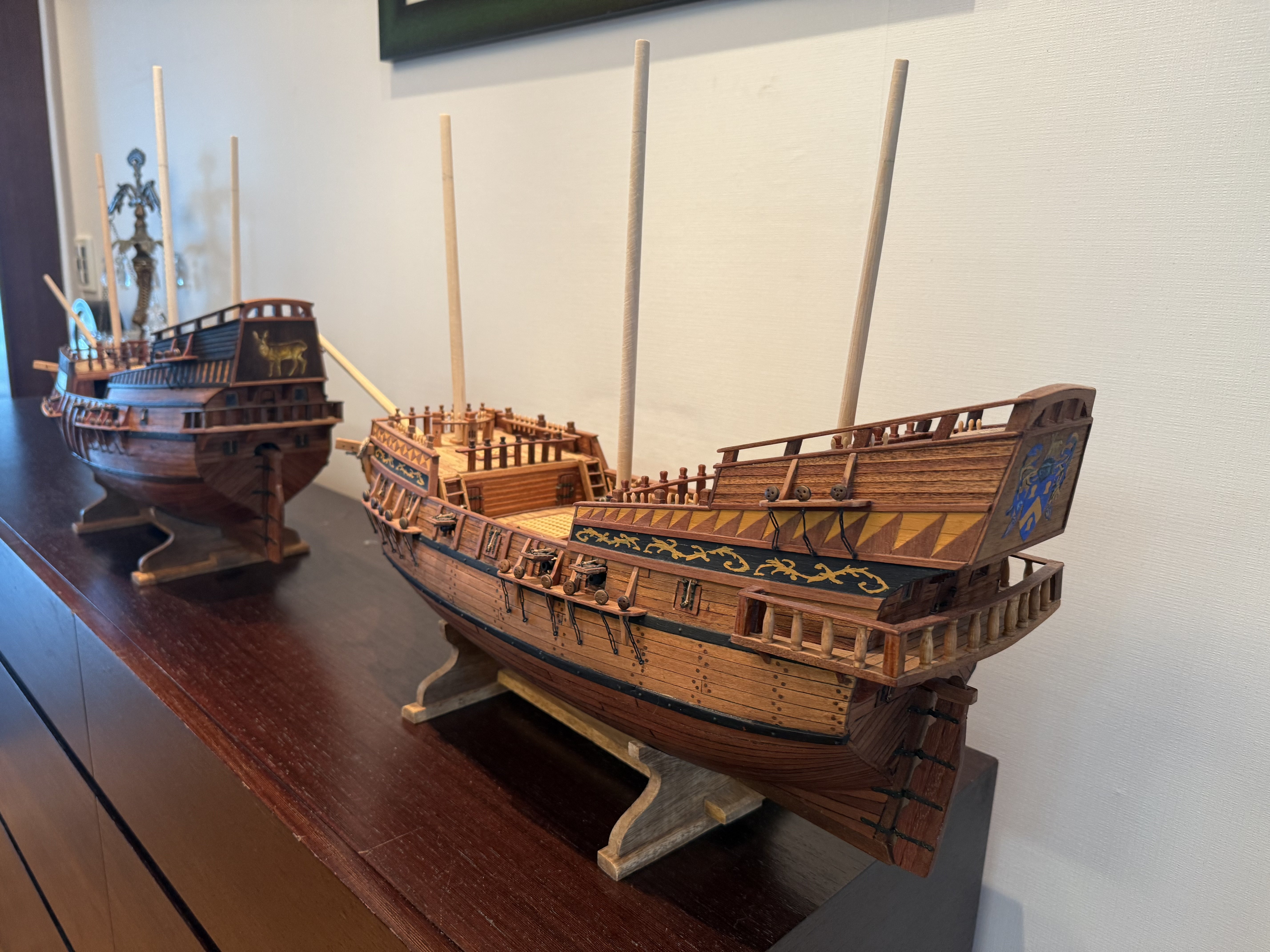

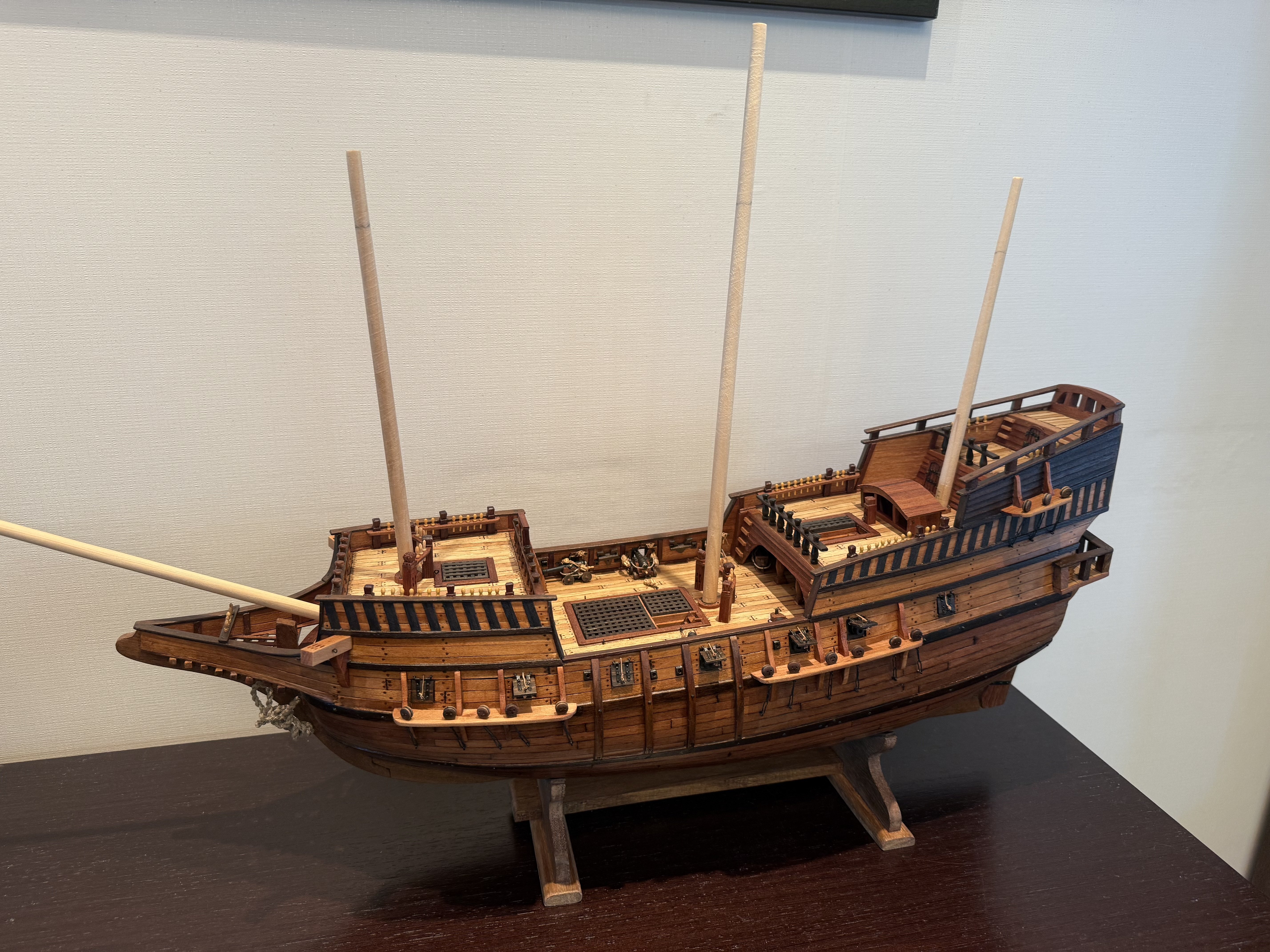

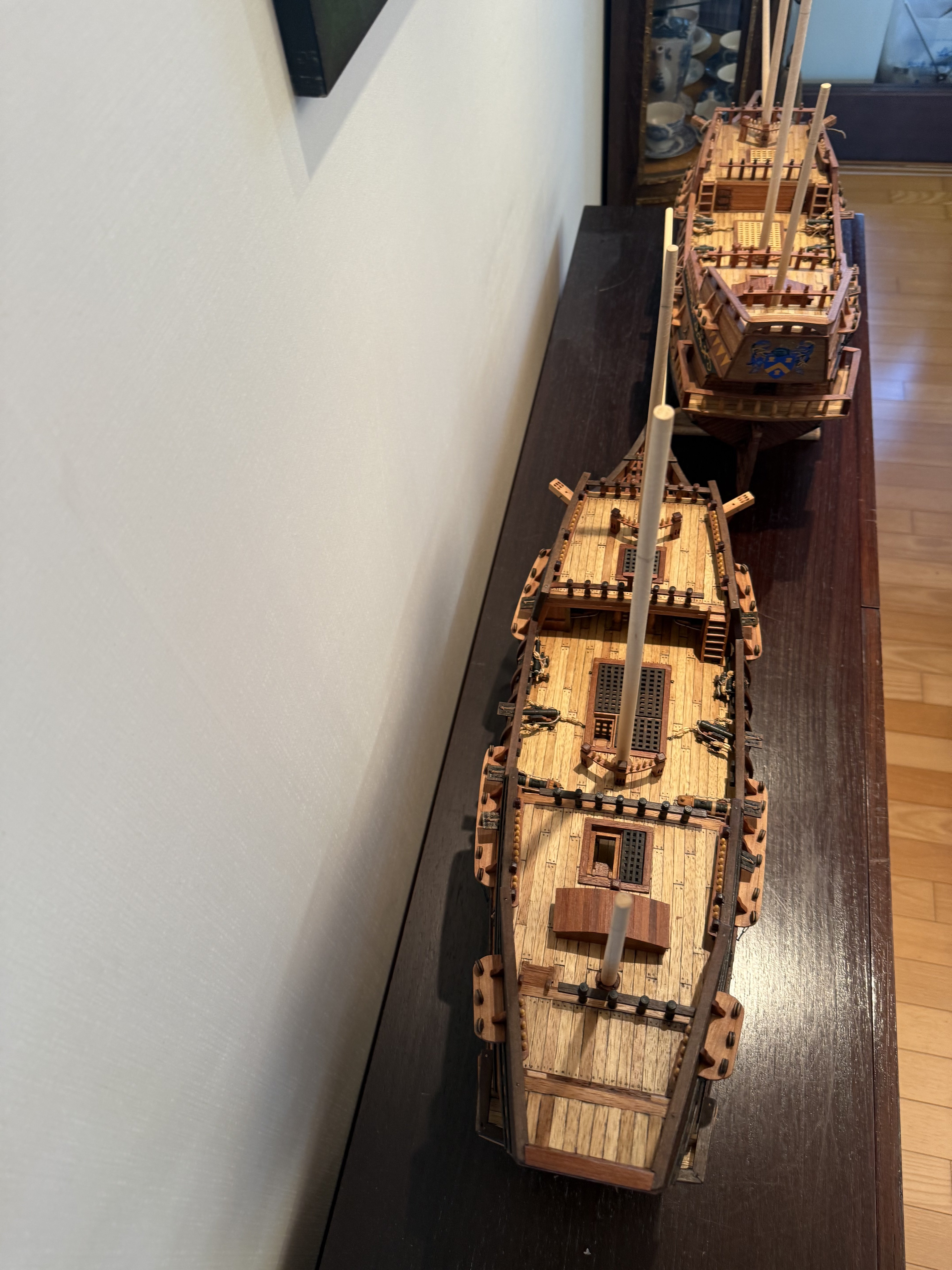

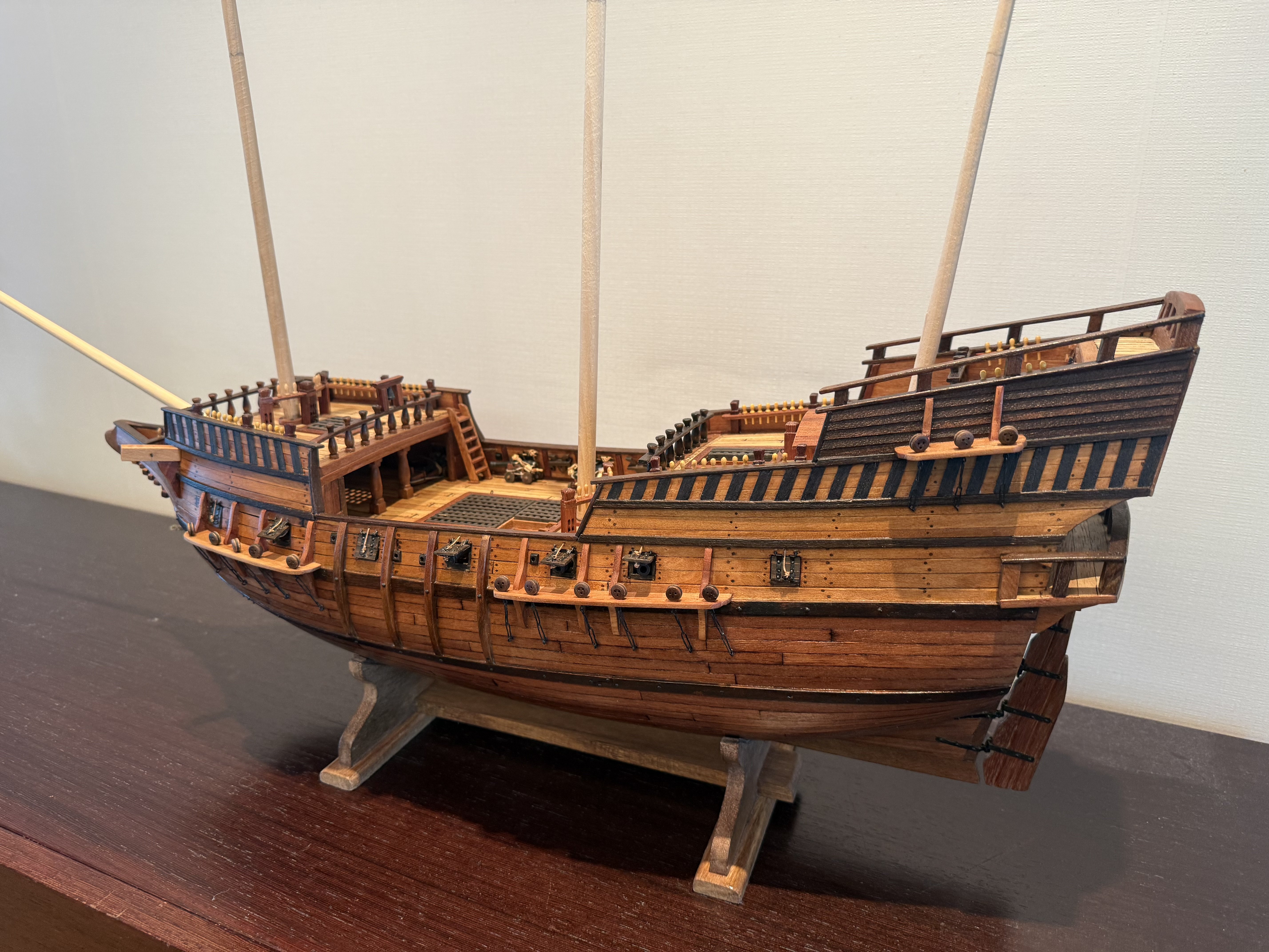

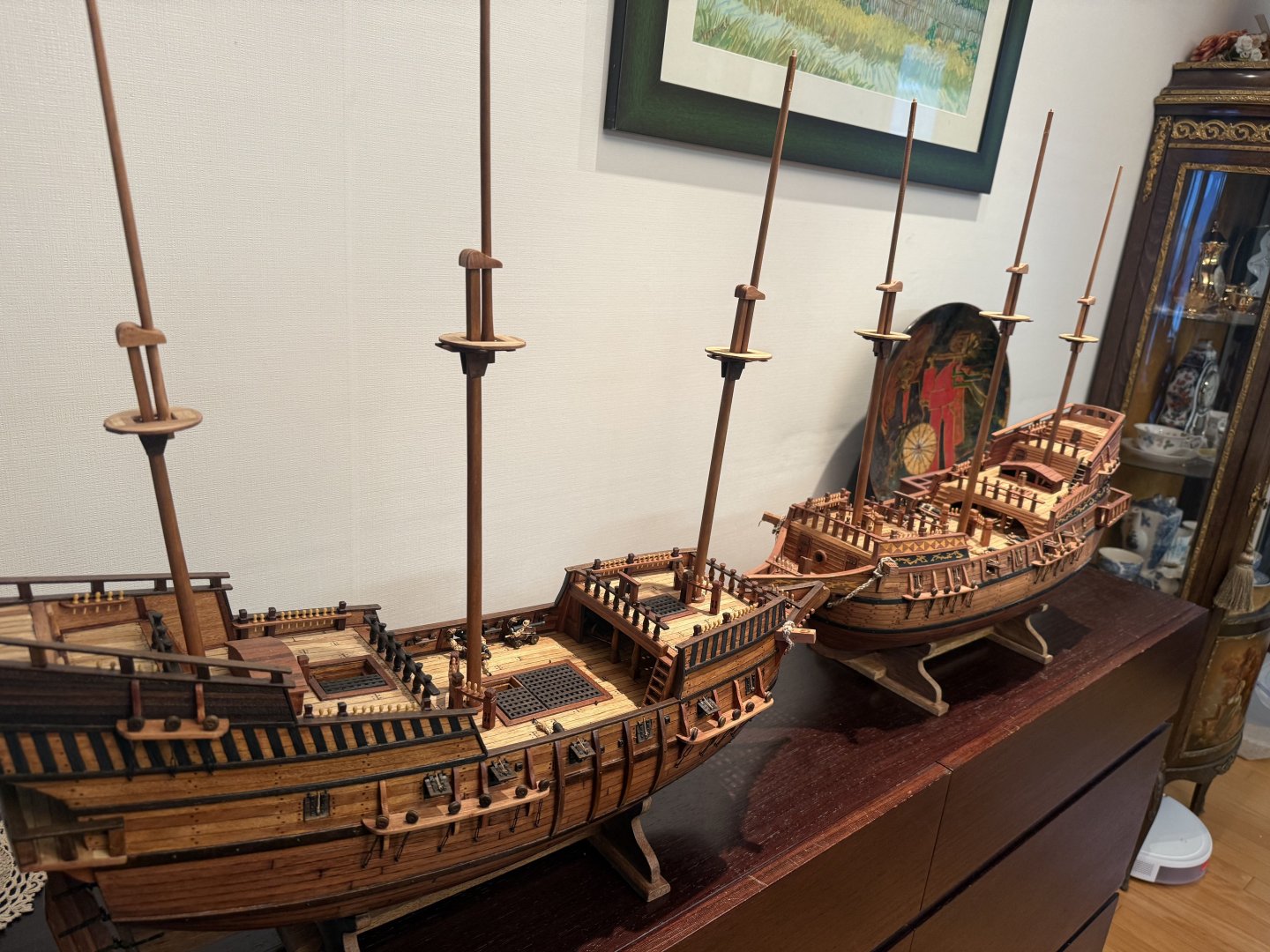

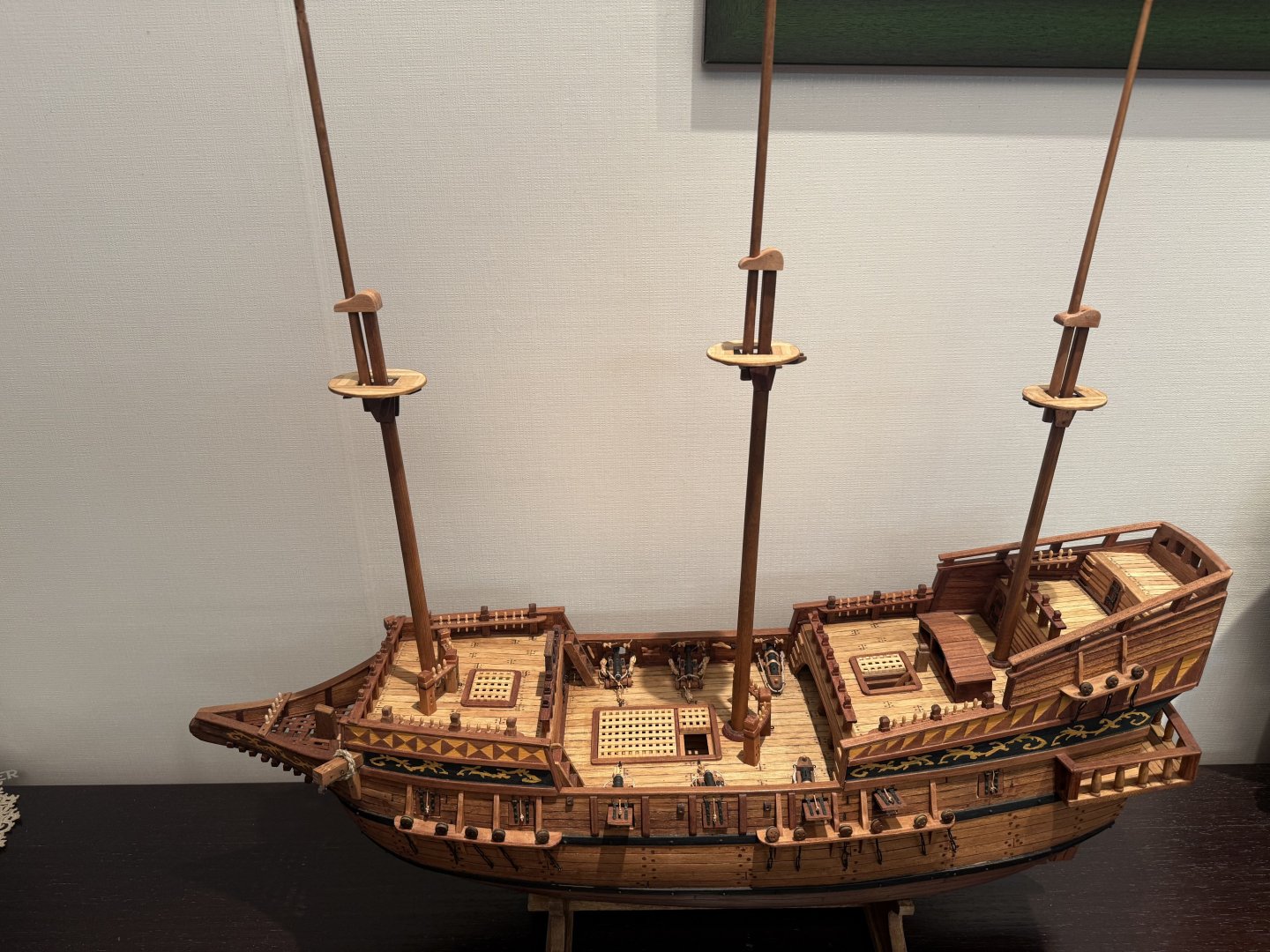

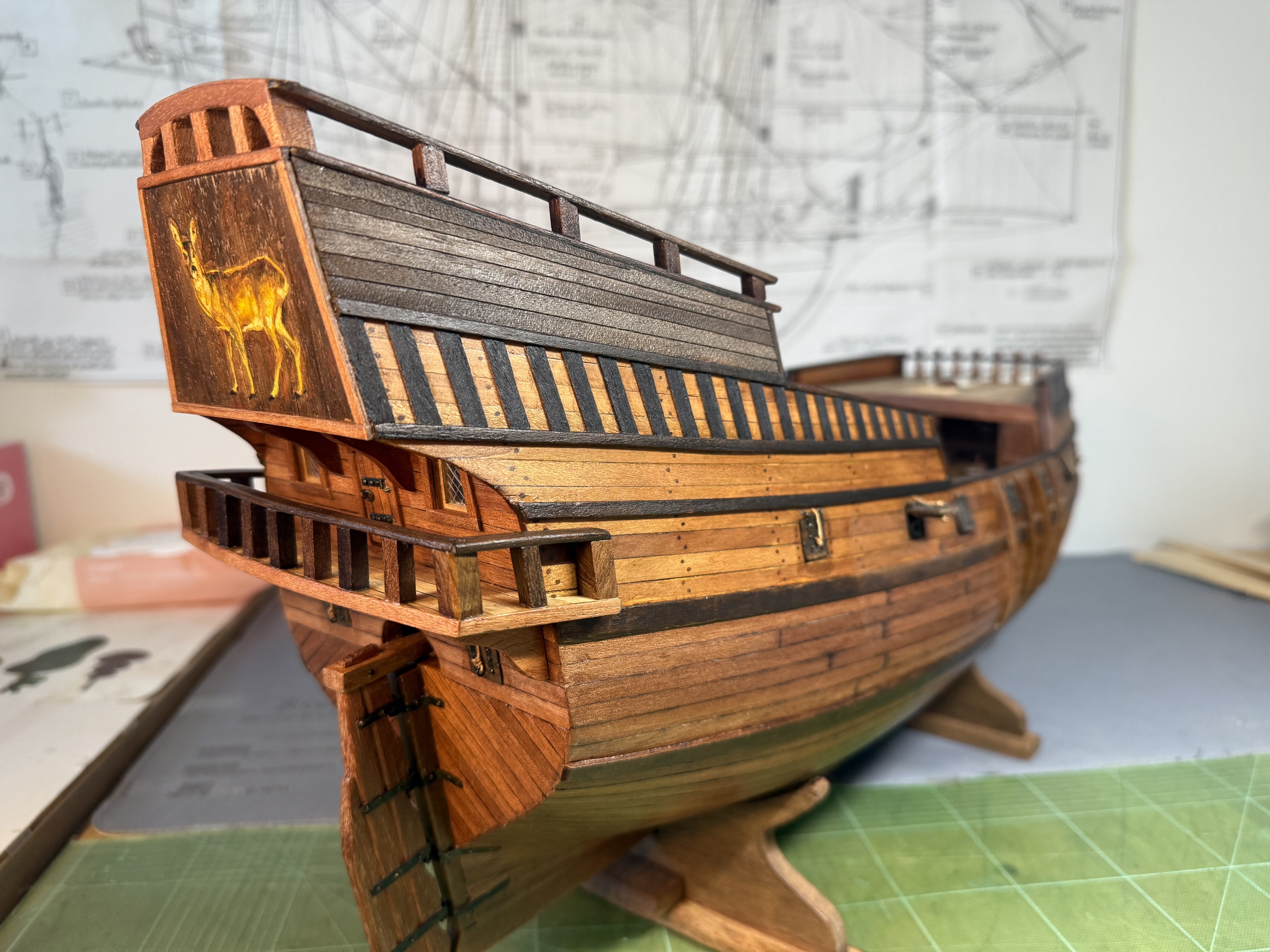

Finally, the hull work on GH2 is complete. Below are some pictures of GH2.
Comparing GH1 with GH2. GH2 is definitely simpler and darker than GH1. They both seem to have their charm.
Also, GH2 (as intended) has more contrast in color compared to GH1. Now, I am resuming the work on GH1 - masts, rigging etc.
Regards, Rock
Both look super nice. Each is unique and shows how there's more than one way to build models.
Good job on both.

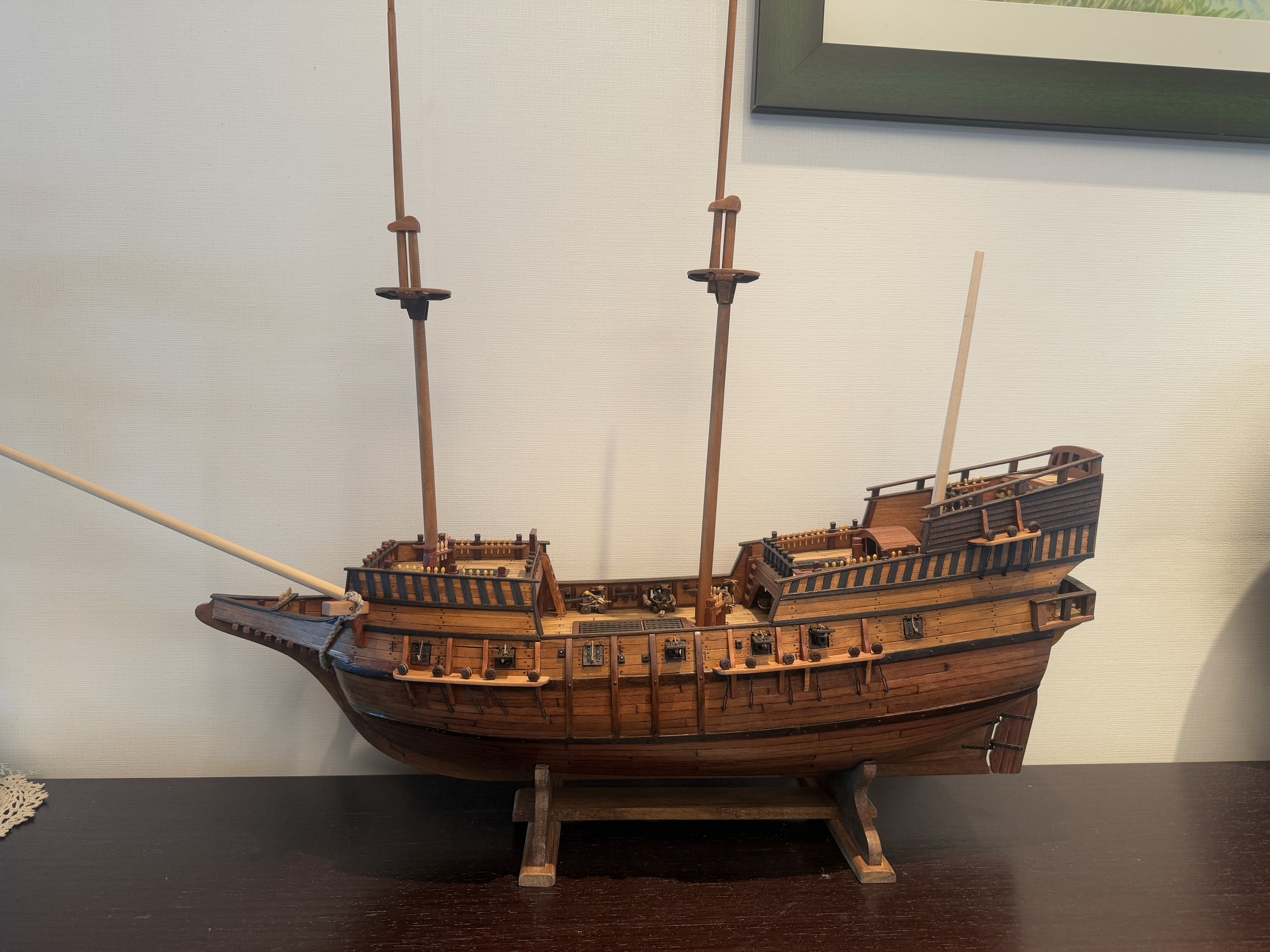

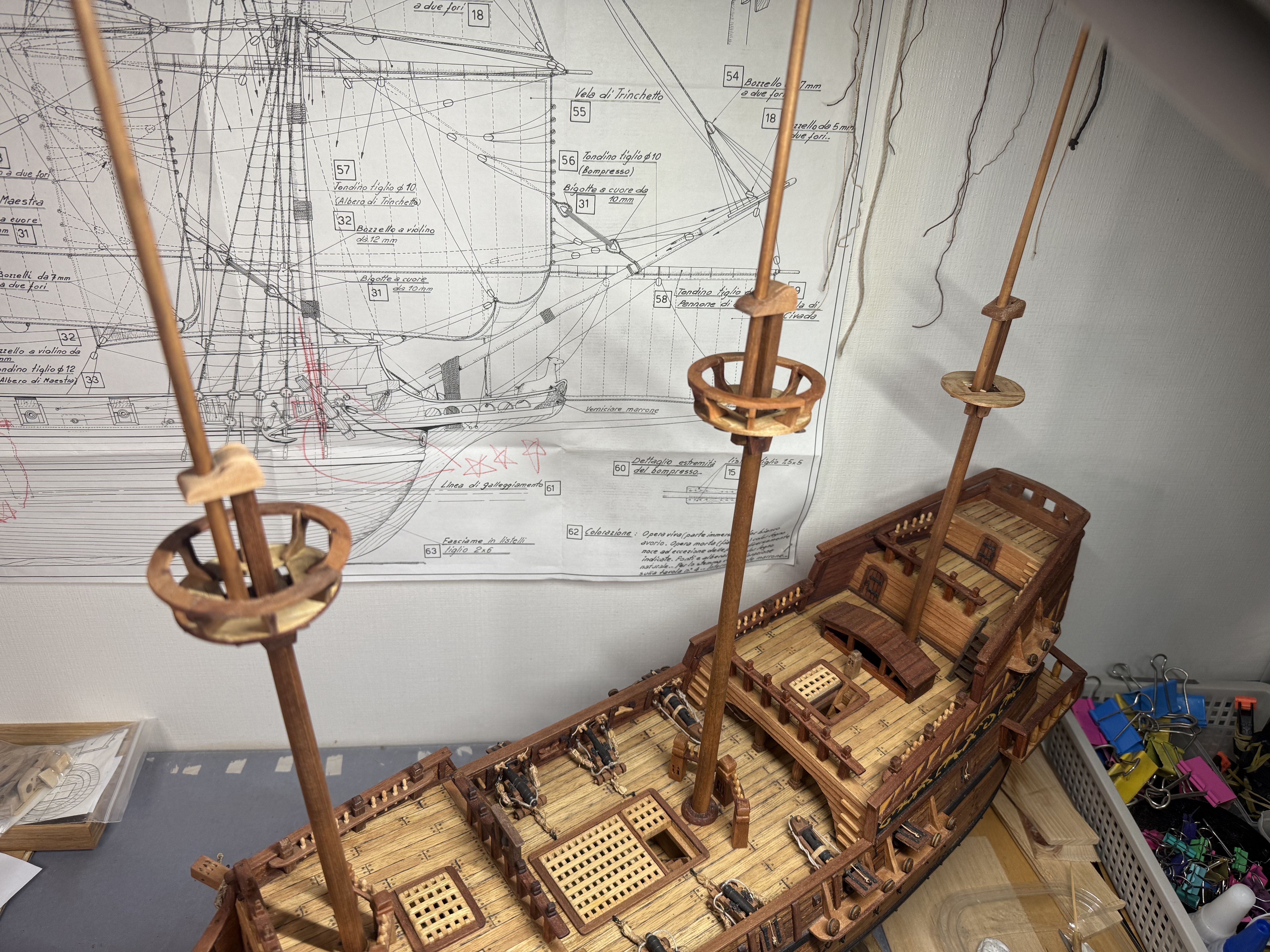

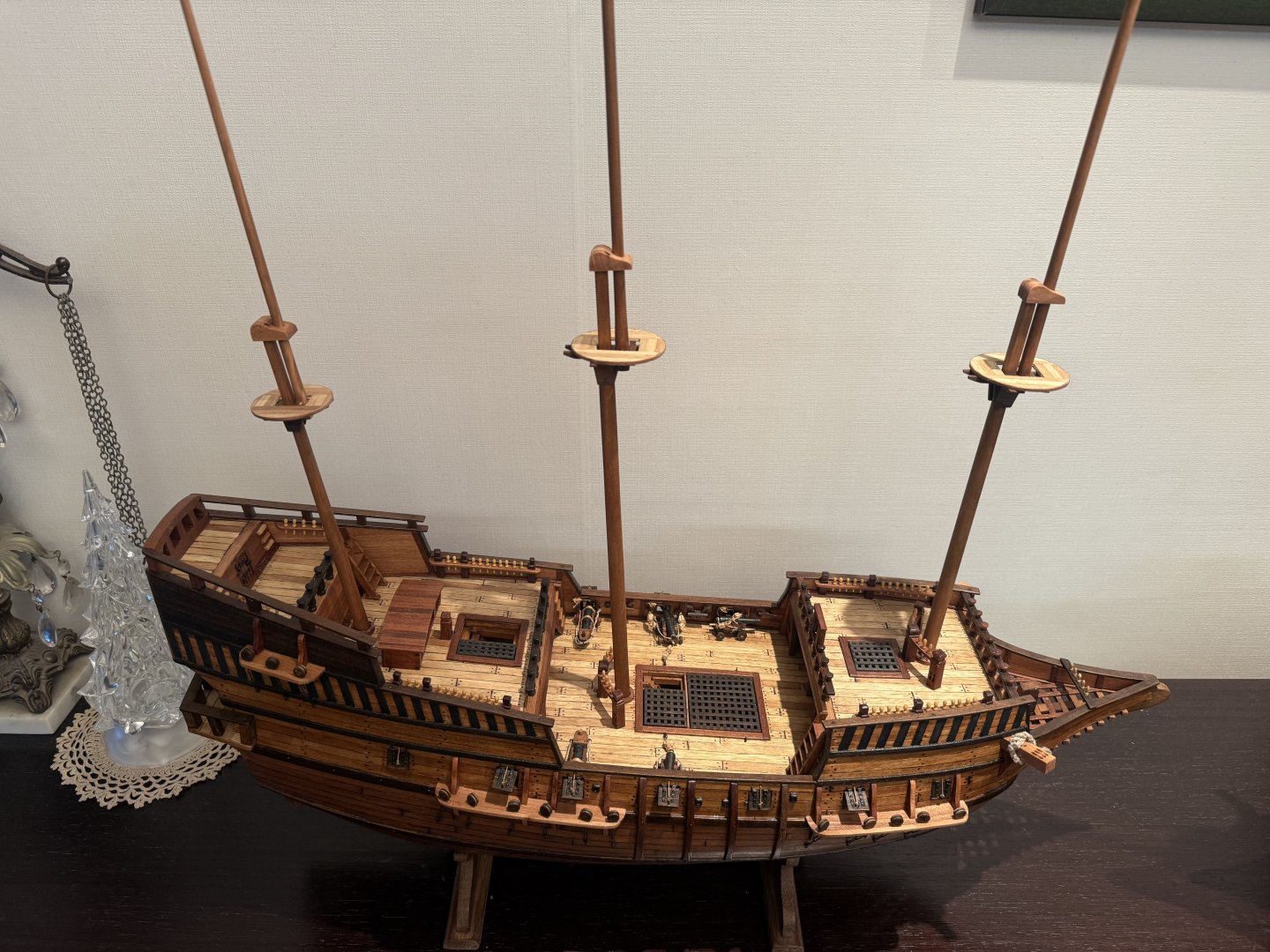

Hello shipmates!
I have resumed the work on GH1. First, I installed couple of stuffs that I forgot to incorporate in GH1 (like the ship’s bell). And then the mast work started.
Starting with the main mast, following are some pictures of preliminary works. The wood from wooden cloth hanger (from Ikea I think) proved to be valuable again - for the mast cap as well as the thin supporting structure for crow’s nest.

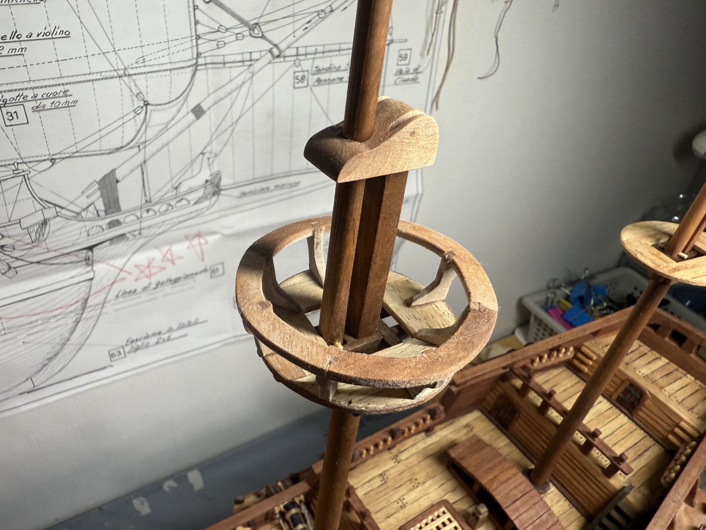

Moving on to the upper level of the main mast and mast cap, I realized that I almost ran out of the wooden hanger material from Ikea. And since there are no more broken wooden hangers, I had utilize a perfectly well functioning wooden hanger - for which I obtained wife’s permission.

Next, the deck of the crow’s nest. I decided to use quite different design from the plan in order to provide some room for rigging lines and etc. at the back of the crow’s nest. For this, I had to shift the whole structure a bit towards the stern, making the crow’s nest appear to be located more in the middle of the mast (instead of slightly forward protruding towards the bow).
Repeating similar procedures for the foremast.

Great  progress on this build.  Looks very nice. Thanks for the detailed pictures showing how you did the work.

Hi shipmates~

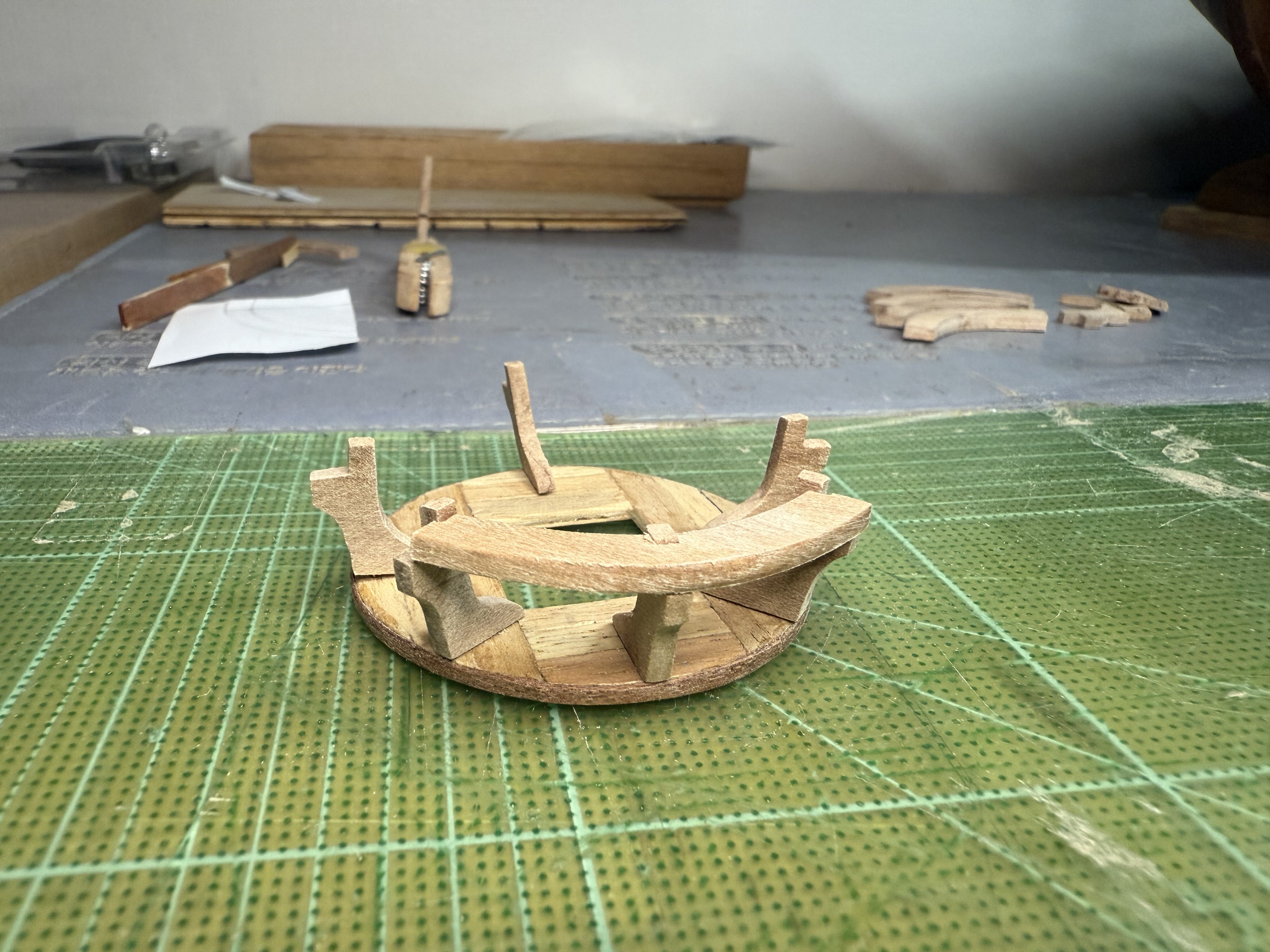

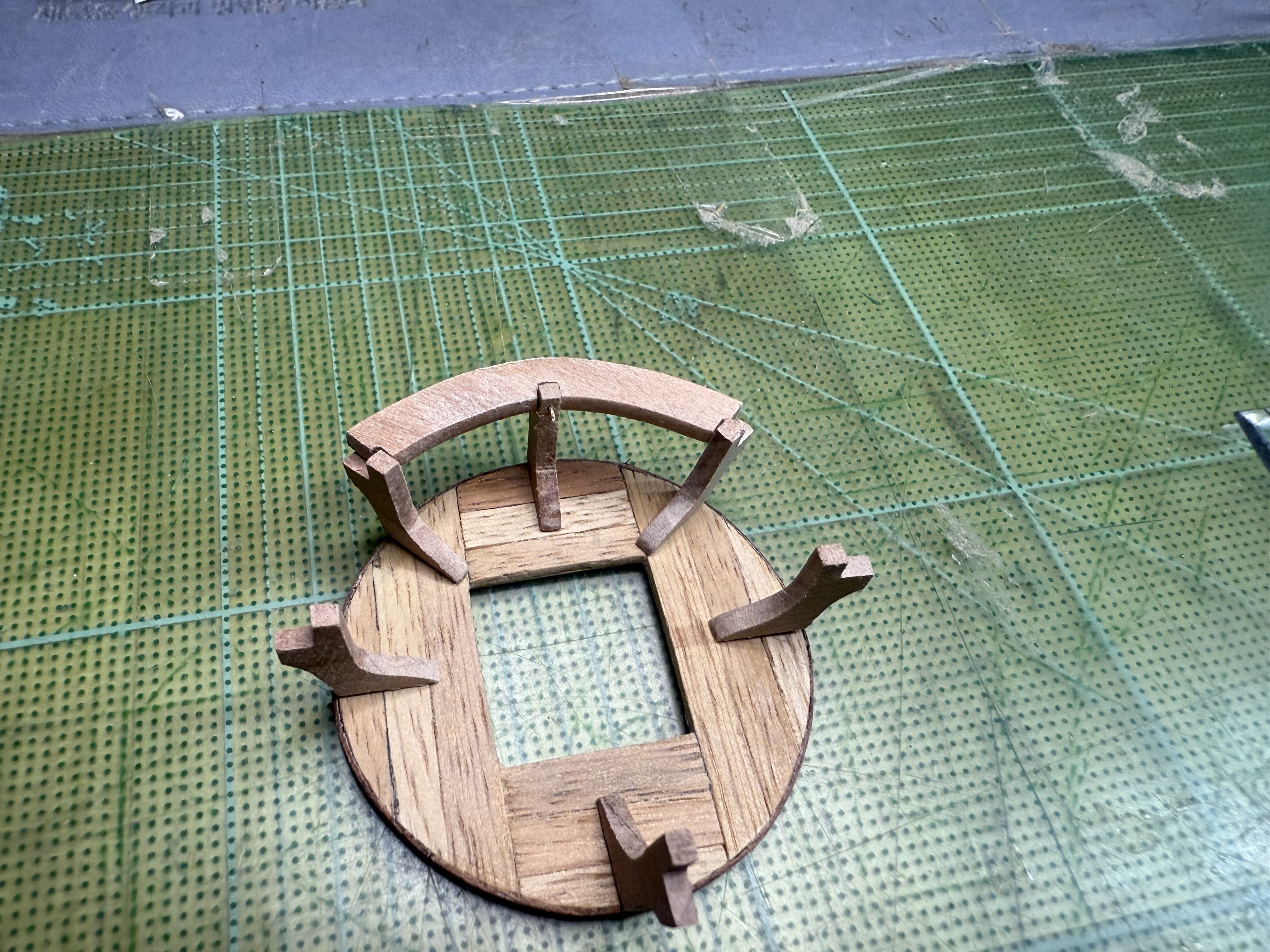

Relatively short updates on the progress of fighting top. Firstly, the process applied to GH1 has been replicated in GH2 as below.
Followed by mizzen mast fighting top work on both GH1 &  GH2 as below.

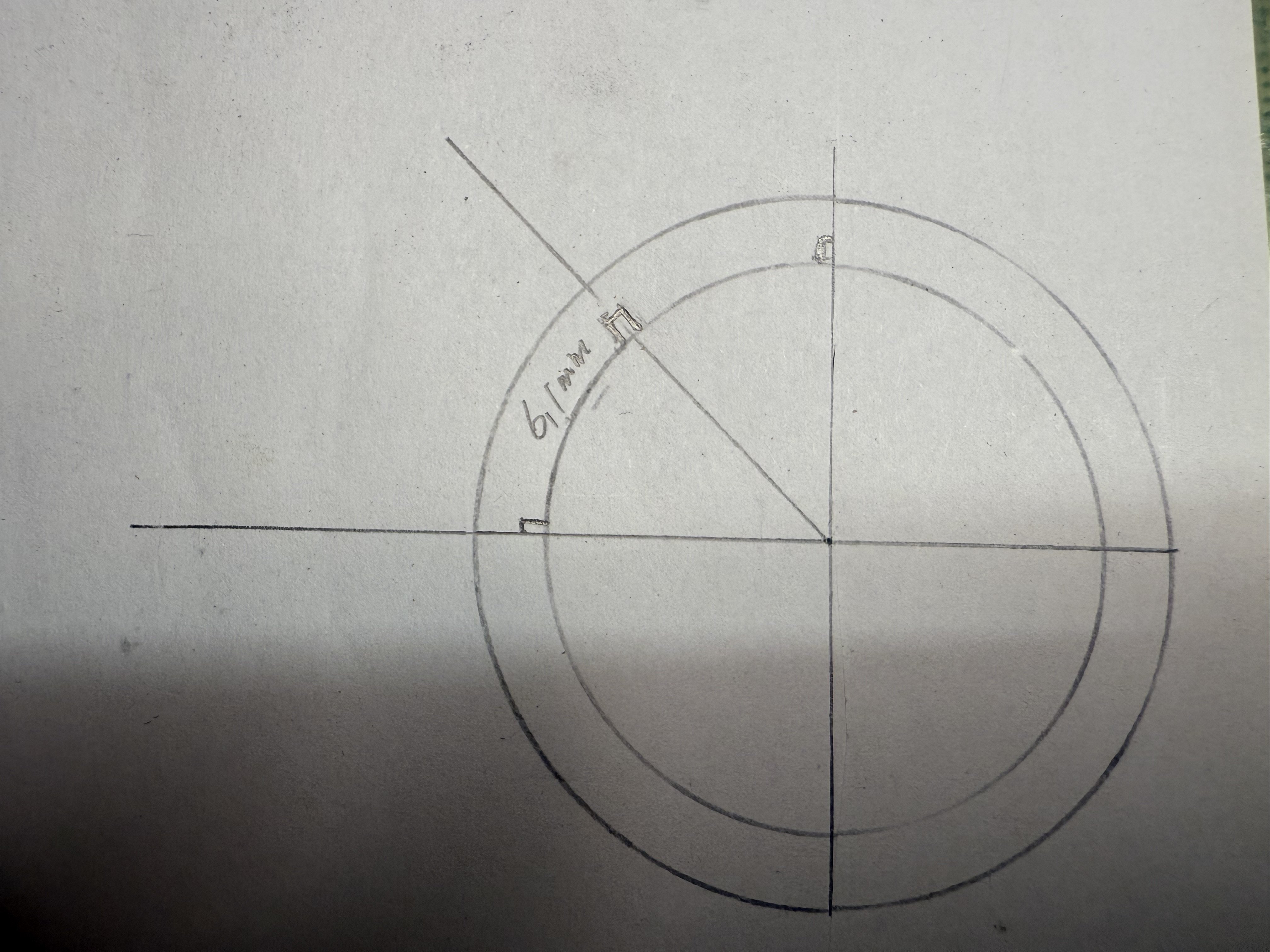

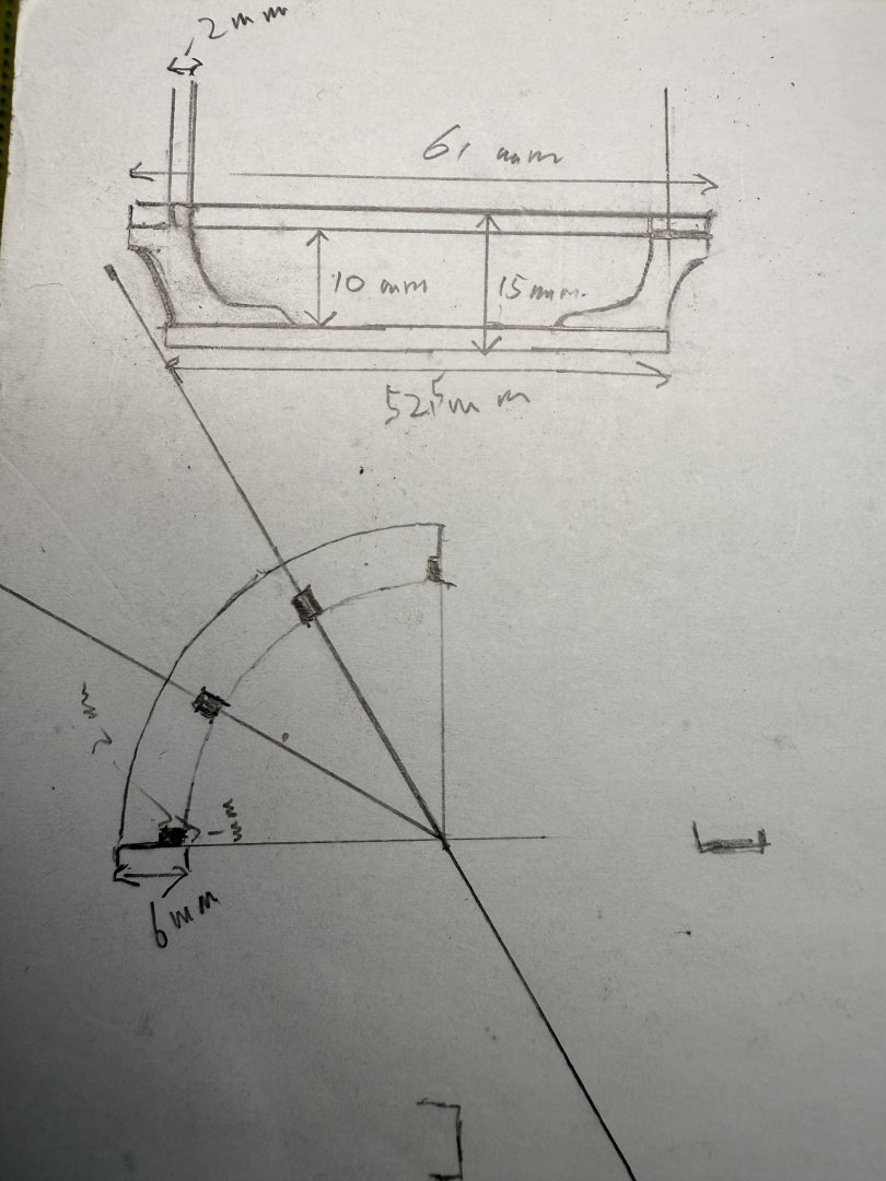

At first, I planned and designed the structure of fighting top as below.
However, I soon realized that the 30 degree interval between pillars was making the floor of the fighting top too crowded. So, I changed the design to reflect a 45 degree interval.
With the first templates made out of the wooden hanger material, the tedious work of making each pillar and quarter piece continues.
I was pretty sure that I needed to do some reinforcement work (possibly near the floor area) as there are just 8 pillars (instead of 12). But, the end result with just 8 pillars is surprisingly robust. So, no further modification seems necessary. Finished second fighting top and continuing with the tedious work streams.
