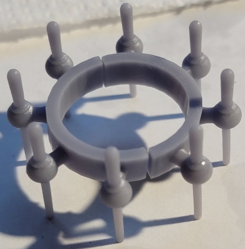

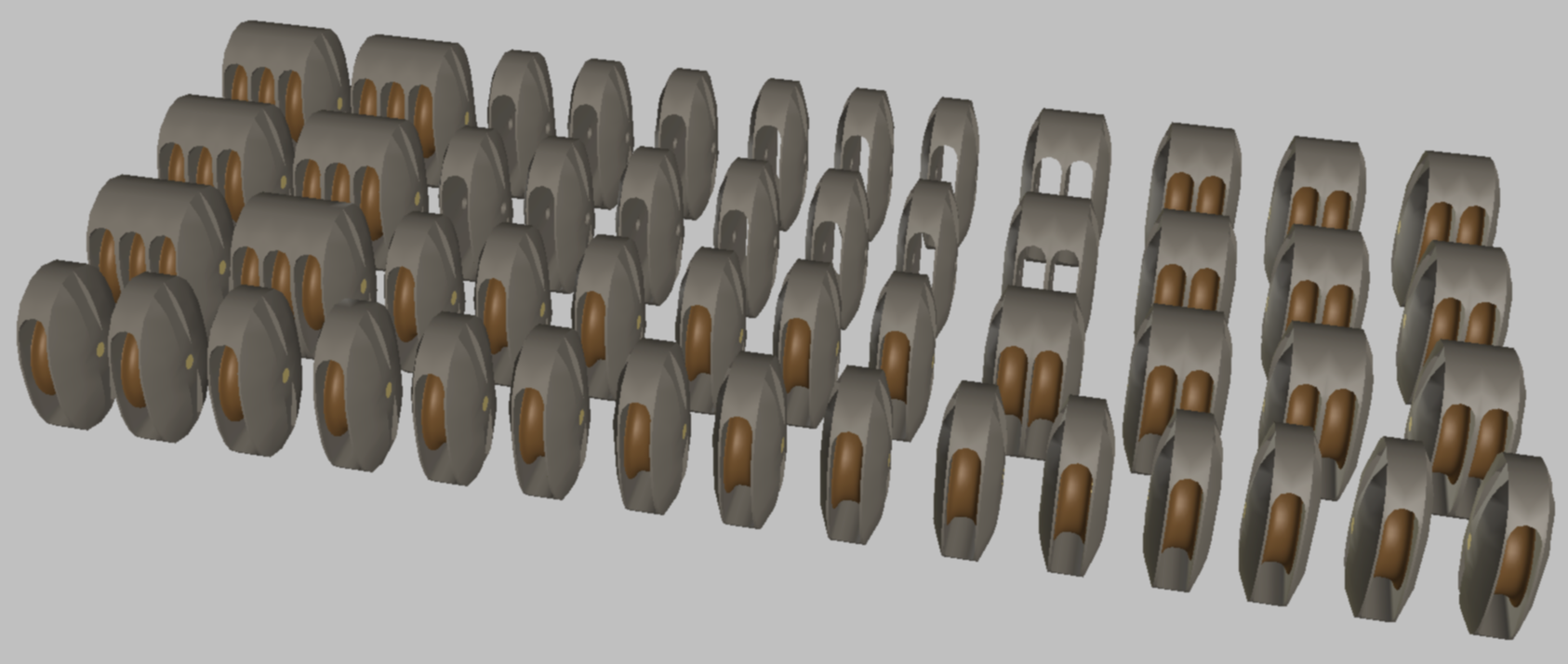

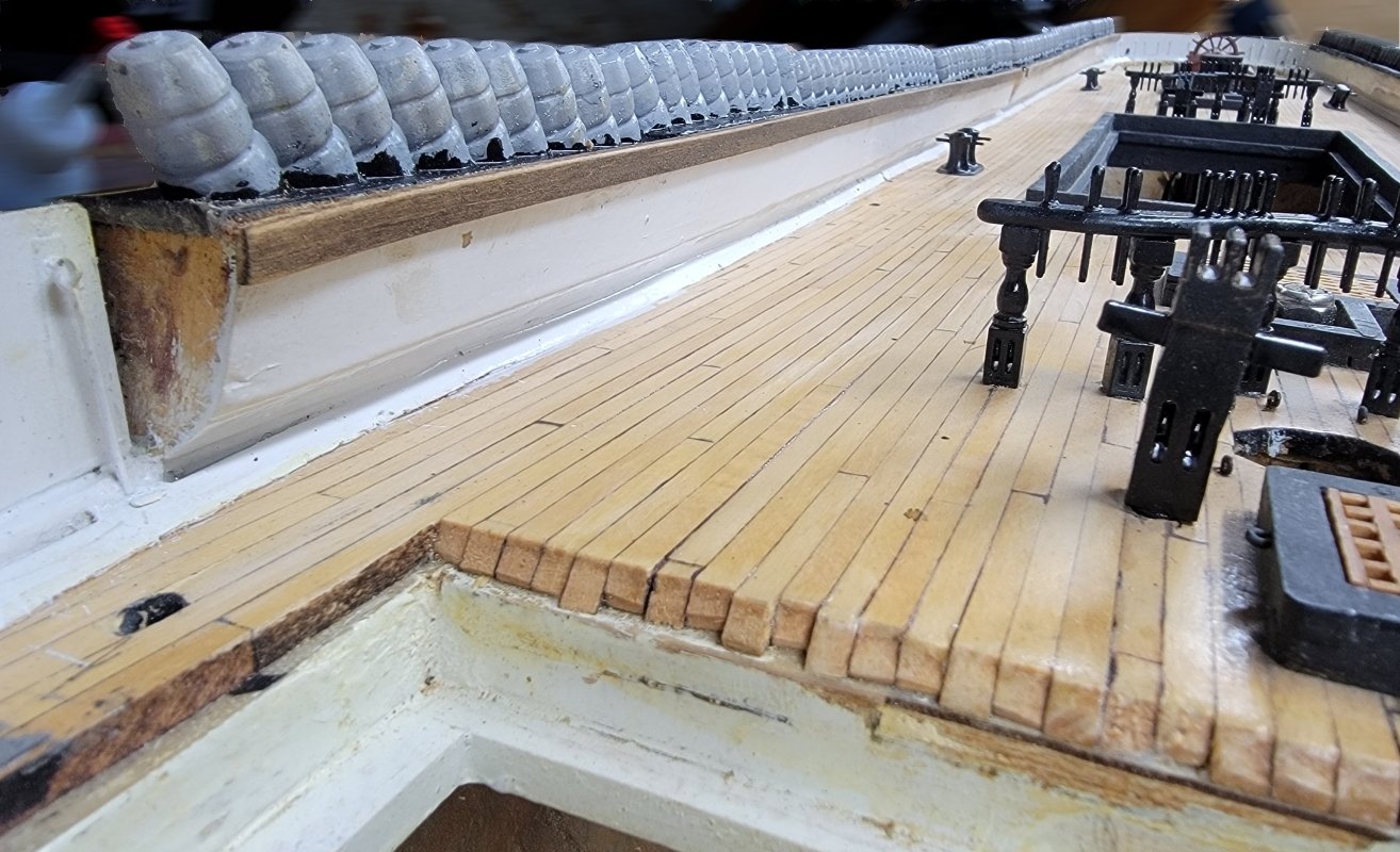

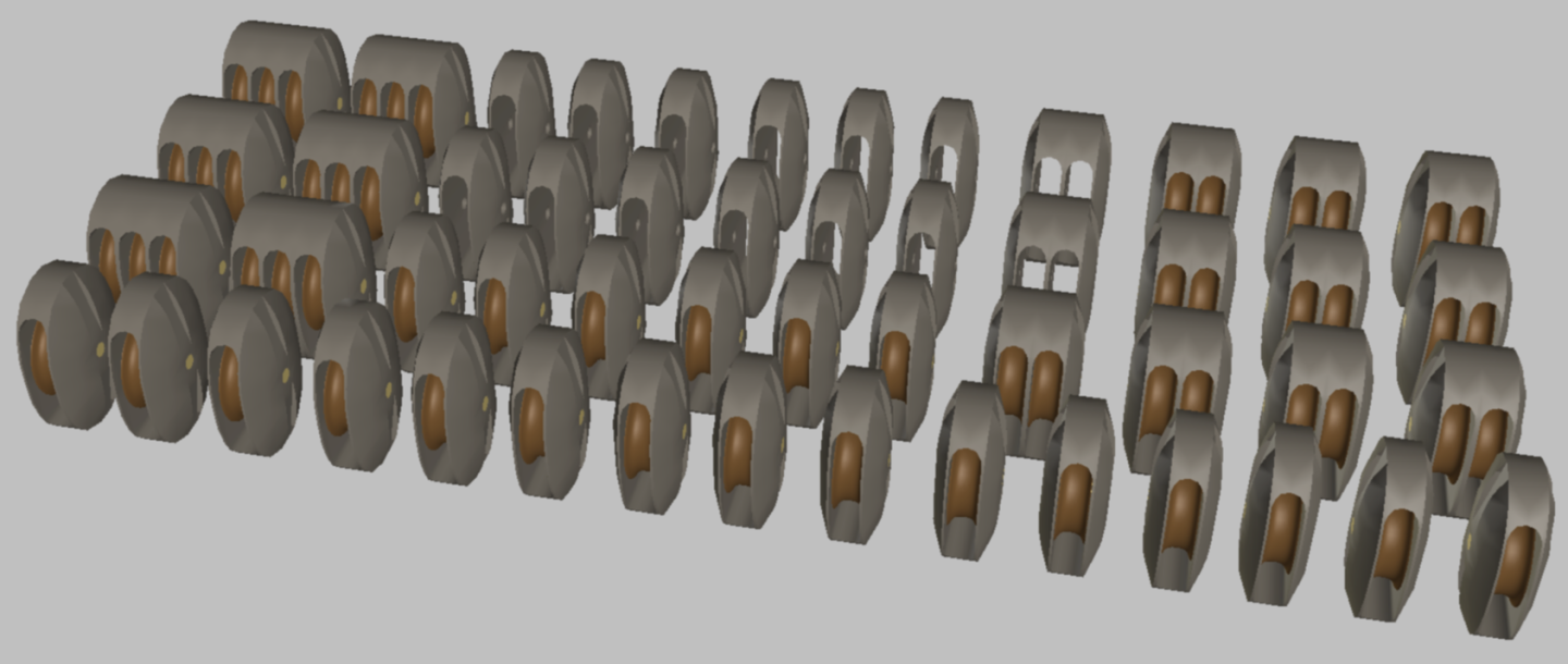

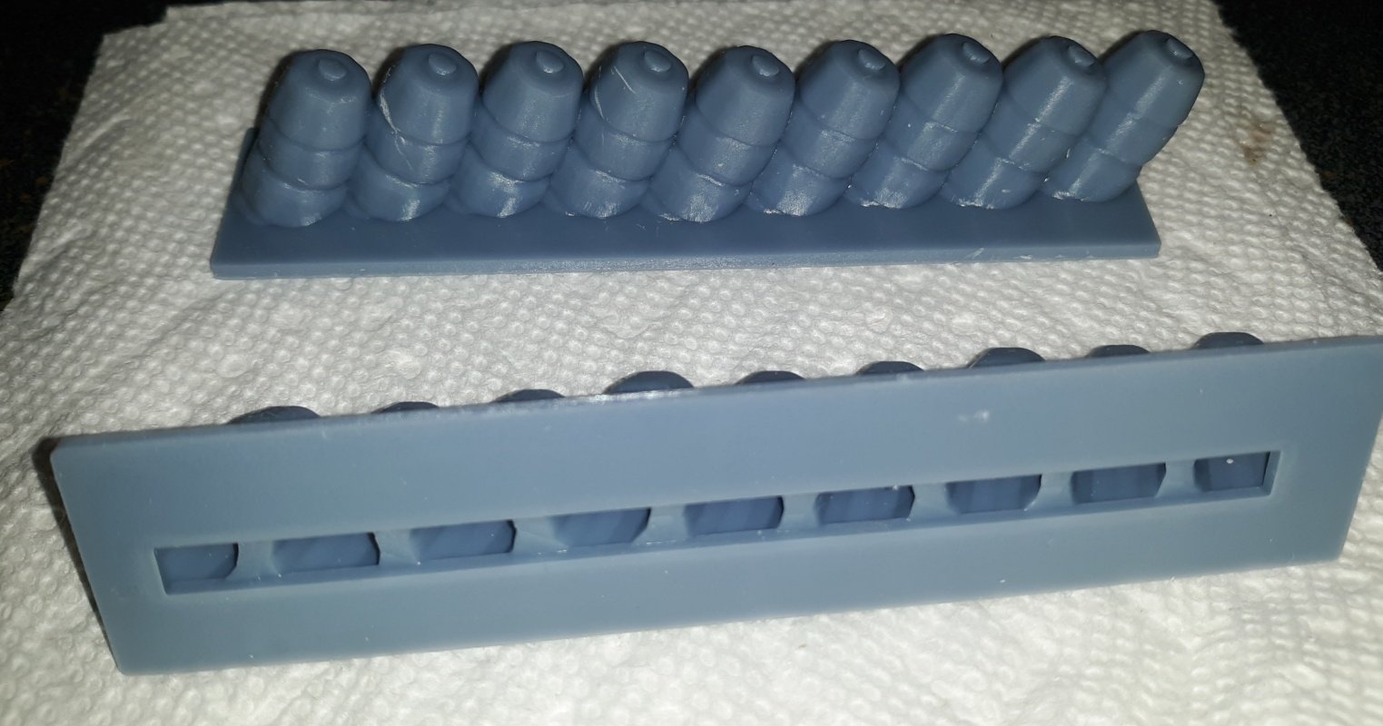

The resolution is high enough to get a good finish, but since it prints in layers there's going to be some lines and that butterfly wing texture.
It's as much or more dependent on the 3D model.  The gun tube I made from a 64-sided cylinder then applied a "smooth" feature to it after getting the general shape, which made it 192 sided, I think.  More smaller smaller polygons looks smoother than fewer bigger ones.  The trucks are 32-sided, and you can see the facets on them.
My models are mostly "low-poly" because it's a habit I got into making 3D models for a flight sim back in the early 90's when too many polygons would stop the sim dead in it's tracks.  It's akin to my programming from back then too when a 30 meg hard drive cast $700.
The pivot gun on the left is the "low-poly" tube I made years before I ever 3D printed anything.  The one on the right got a higher-poly tube which is much better visually.

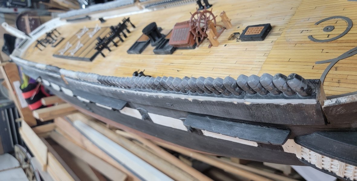

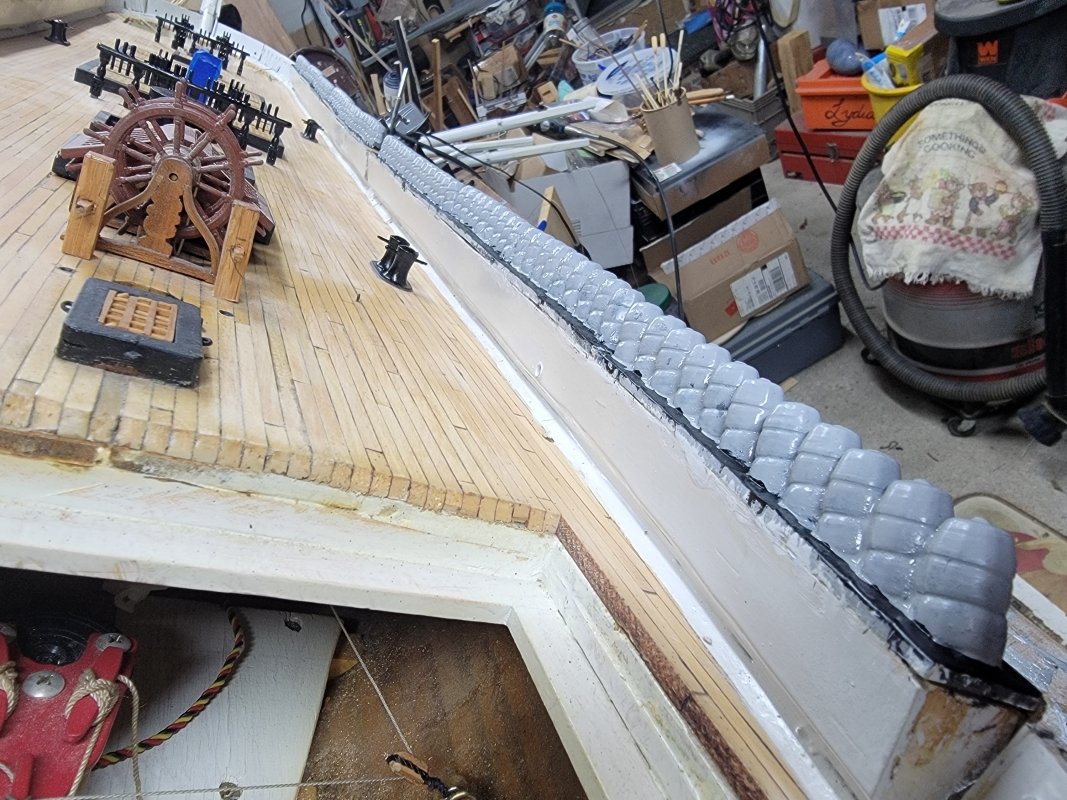

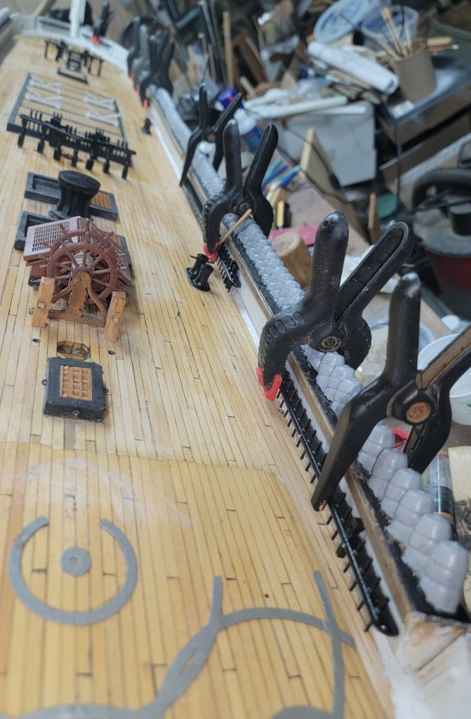

It's gotten too cold to pick up where I left off on Pride of Baltimore back in June, or even hang-out in the unheated shop for more than a few minutes; so I worked on 3D models for an item that's kind-of holding up starting on Constellation's rigging - pin-rails.

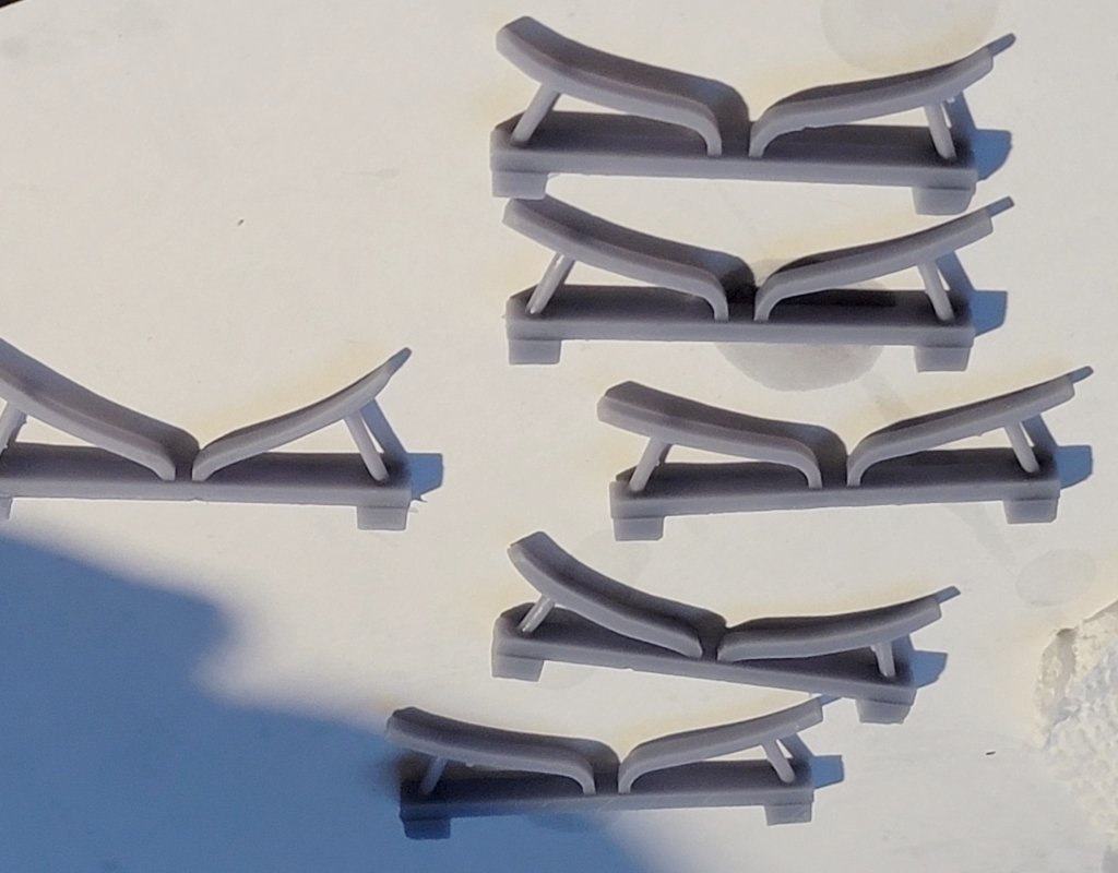

Here' the first attempt at the aft-most rails, which printed pretty fairly, though the left end of the upper one, and one of it's pins didn't do so well.

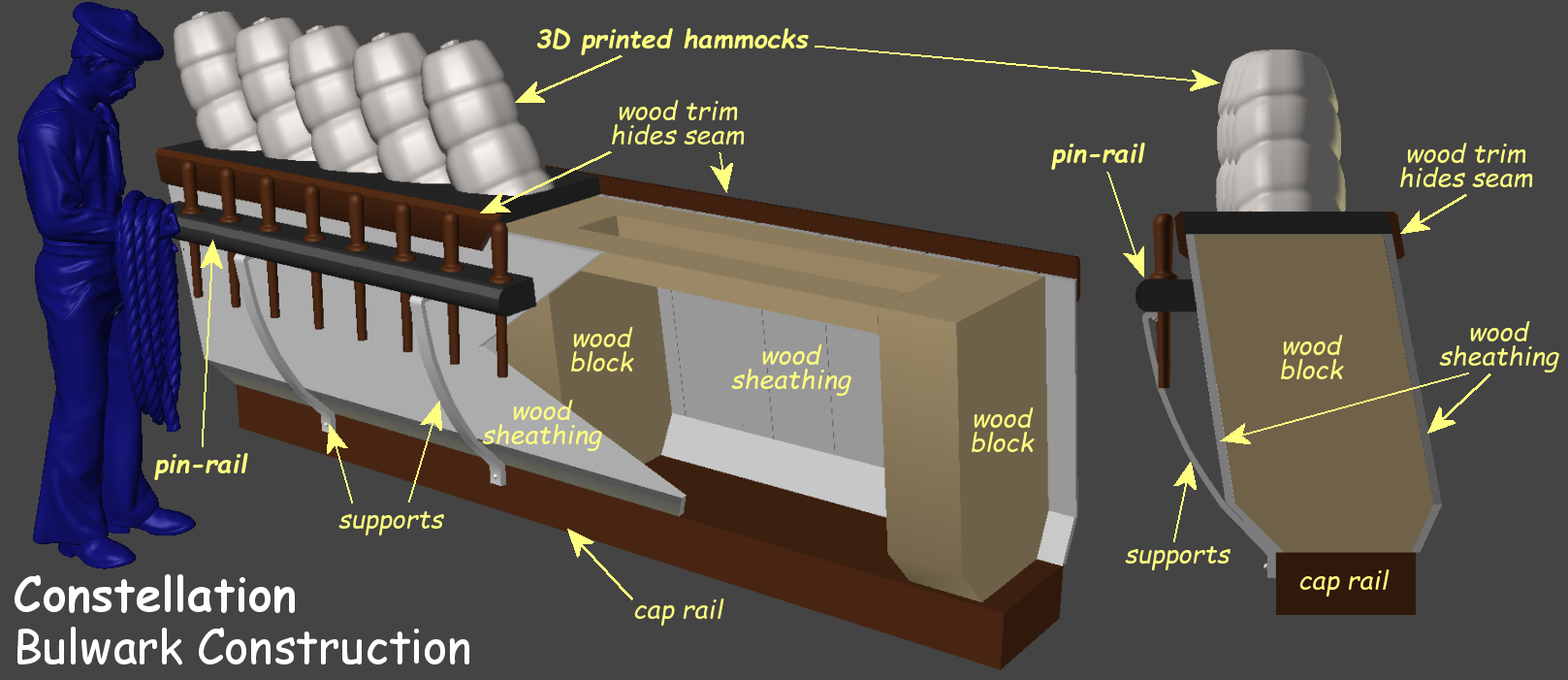

While that's repairable, when I modeled it, I forgot the bulwark it attaches to leans inboard a bit and forgot to model that angle on the back surface. Sanding that angle in would make the rail too narrow, so I'm fixing the 3D model and will reprint it.
The rails will be pinned to the bulwark where the wood blocks are inside it.
This pic shows how the bulwarks are constructed, as well as that inboard lean I mentioned.

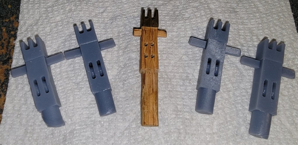

Half-an-hour-ish, and I've fFixed the pin-rail model to have the proper angle back-side, and set it to printing.
Five hours and some change later it came out perfectly.  See the angle?  Well there it is siting somewhere near where it will live.

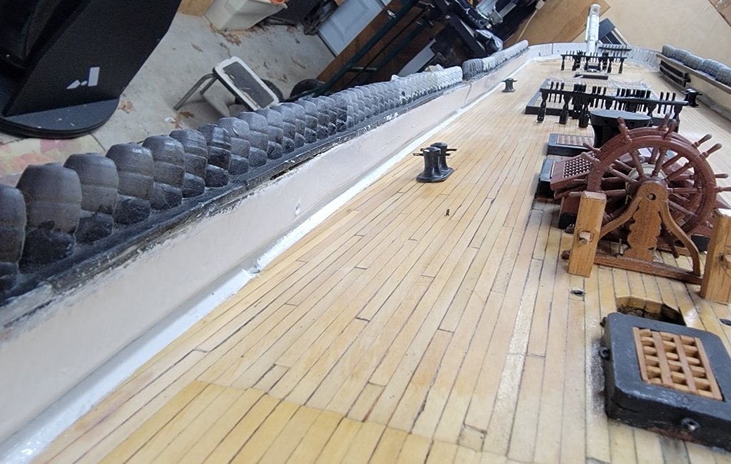

While that was printing I started making the midships pin-rail; the one closest in this screen capture.
In this picture from the 1890's, I originally though there was a caval at the aft end, but it actually appears to be a pair of meat tenderizers.
This wasn't going to fit in the printer, even at an angle, so I made each side in two parts, and angled them (not to fit, but make them more likely to print properly)

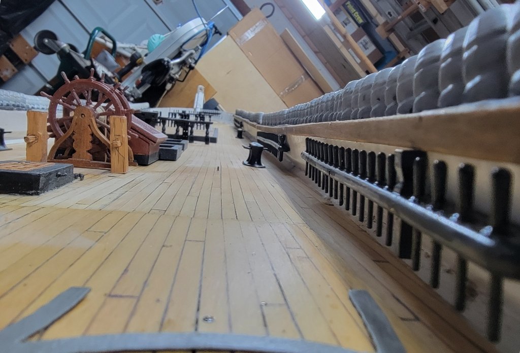

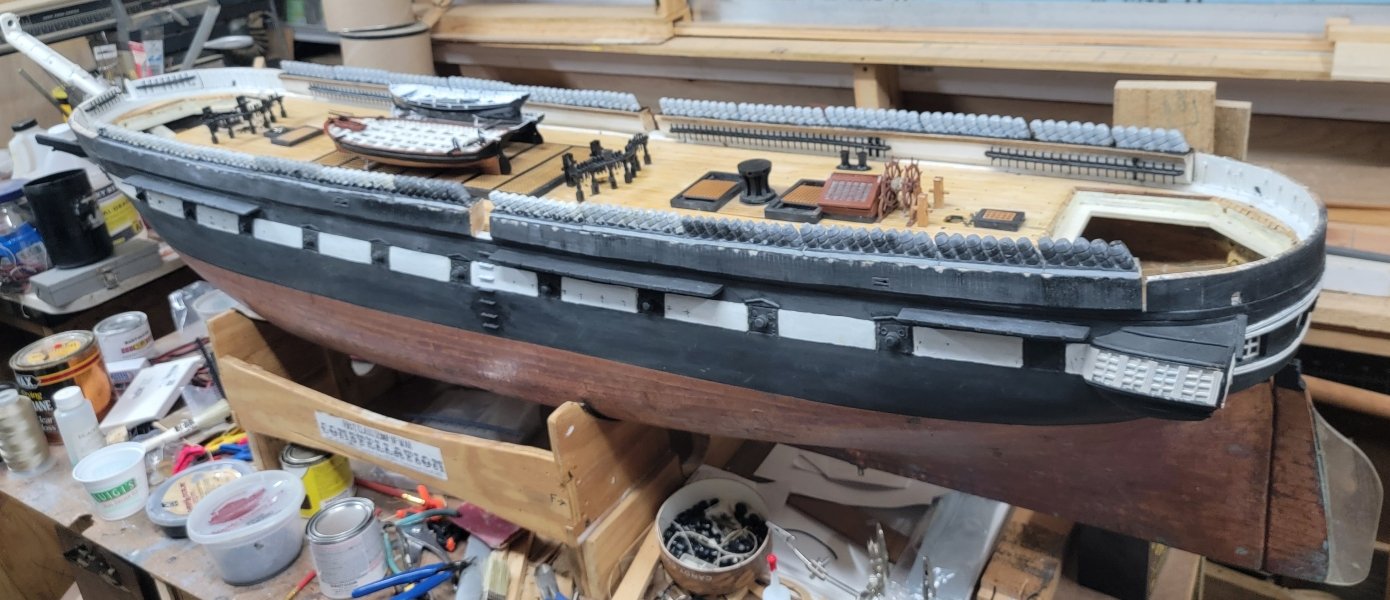

The midships pin-rail printed perfecly, and awaited the gloms of primer, paint, and clear-coat that will protect from UV while sailing in the Chesapeake Bay.  The forward pin-rails are on the printer as I type this...
con20241209c.jpg.9a407046eb2ca211e4d56e7aef5aa40a.jpg con20241209f.thumb.jpg.6dc32381458b19a323cb07ce36d6ad13.jpg
And here's the forward pin-rail
Edited by JerryTodd

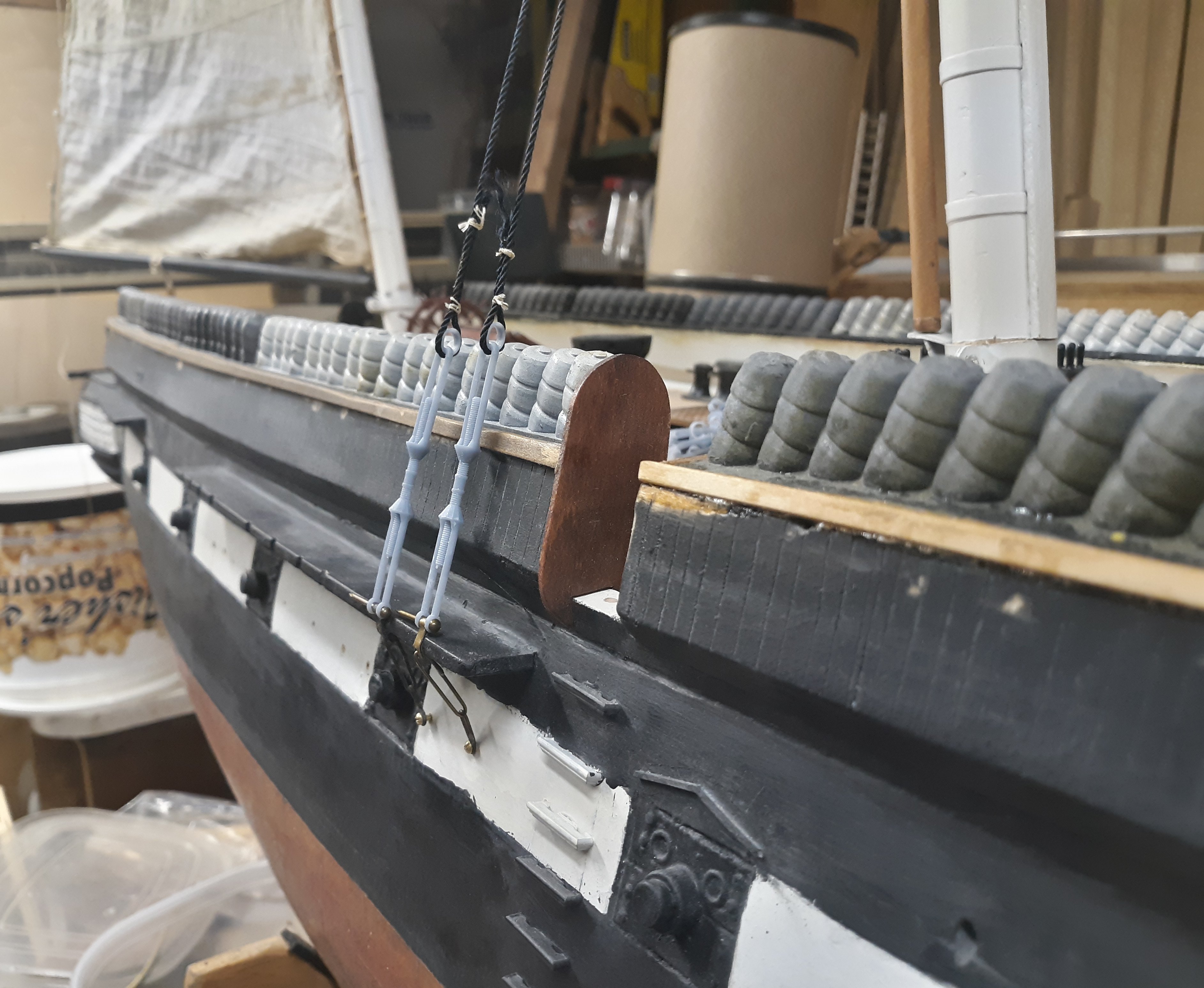

Wow..... looking good.  That's a major rebuild for sure.   Just dumb question...  will the printed pinrails be strong enough for the lines tied to them?
Past Builds:
Most of the lines made-off to these pins will be static and basically "for show,' they won't be under much stress.
I'm using a resin meant to be stronger than the stuff people use to print D&D porn figures.
The real test will be the rigging screws

Before I can begin rigging the bulwarks have to be "finished."
I'm working on one side at a time, and will do all this to the port side when the starboard side is done.
The hammocks were 3D printed on "trays" which were modeled slightly wider than the bulwarks to accommodate any irregularities.  This bit of overhang was ground off flush with the sheathing of the bulwarks using a sanding drum on a rotary tool.
con20220420a.thumb.jpg.89c765d1d1ffea3a5d9a4392f29fb8f4.jpg bulwark.thumb.png.a63ce7501909e2fddcd01401f1a6a8d6.png
I then painted the inboard side of the bulwark, then the hammock trays black.  I mixed some black into white paint to get a gray to paint the hammocks themselves, but I'll have to revisit that.
Any gaps between hammocks and bulwarks was filled filled with a paste of epoxy and sawdust, and a covering board of stained basswood was glued on to cover the seam.  This had already been done on the outboard side of the bulwarks.
con20250527a.jpg.74019a3e1c476576d0f6d3e21e1a958f.jpg con20231022d.thumb.jpg.426a9567497c4cb61c77a23d8abe54da.jpg
The pin-rails were already drilled for mounting pins, and those holes had to be transferred to the bulwarks, which I did with a pin-vise.  So here's the pin-rails sitting in place.  That covering-board's a little over scaled, and so are my belaying pins, so there's almost no room between the heads and the bulwark, so I'm going to pad out the pin-rails a little to get that room, before epoxying them in place.
The last item to "finish" the bulwarks will be the metal supports under the pin-rails.  These will be sheet brass and glued in place.  Then it'll be onto the port side.
Most of the time spent on this was waiting for paint/glue to dry.  In the meantime I painted the ship's boats and 3D printed cradles for them.  I also modeled new "crown-bitts" to replace the red oak one made years ago.
con20250523a.jpg.d3a0b1664ffb218fbf6e8b567d6d2433.jpg con20250525a.jpg.db4ae5600dc53b8b85591f1cfac947c3.jpg
I reworked my 3D model of the blocks to take 8mm brass sheaves, but I couldn't find anyone that had them in stock.  I printed the shells for those anyway along with non-working blocks with fixed sheaves for things like the halyards, that don't move regularly, as opposed the the braces.  I also printed smaller block for things like jib halyards, bunt blocks, etc.  Some of these will get 6mm brass sheaves for working lines like bowlines and the "dummy braces" on the t'gallants and royals.

If not for the clamps, you wouldn't know the pin-rails got epoxied in today, or Pride got some work done too.
Jerry Todd
Click to go to that build log
With the starboard pin-rails permanently glued and pinned in place, I ground the outboard port-side hammock trays flush with the bulwark.  It didn't take much because I was more careful to set them that way when I glued them on; I basically beveled their edges to line up with the bulwarks' surface.
con20250602c.jpg.c0baf944676a12a2558a94100d0eaa16.jpgcon20250531e.jpg.fed1f91b1395785a0775f80b1befada6.jpg
I cleaned up the dust and painted the outboard side of the starboard hammocks then turned the hull around on the bench.
The inboard side of the port hammocks were ground flush with the bulwark, cleaned up, and I painted the hammock trays and outboard side of the bulwarks black, and the inboard side of the bulwarks and waterways white.  The basswood trim pieces will come next.

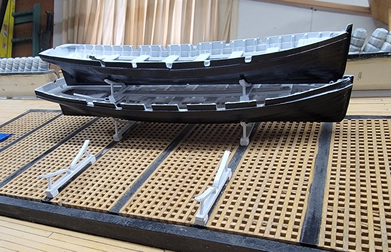

I glued the boat cradles temporarily to the main hatch with some PVA, but I bumped one and it flew off into oblivion.  I'd been working on a model for mizzen spider-band, so when I printed that, I tossed another set of boat cradles in with it.
con20250602e.jpg.5fa5bebe559fd1f4c8b37e27d17a63f8.jpg con20250602f.jpg.c83b80b062163acf82d1fd2bdc0496f0.jpg
