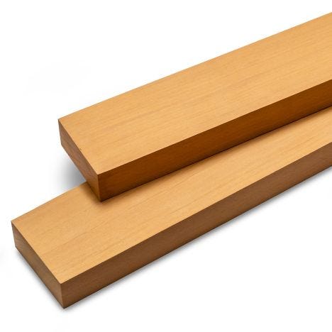

Has anyone heard of this wood. If so, would it be a decent replacement for Boxwood.
Its description says, "Izombe by the Piece - Fine texture and warm golden tones make Izombe pleasing to both touch and eye—color is very stable over time!"

I've not heard of this wood.  If you don't get any responses, I'd suggest ordering a piece or two and test it.
Past Builds:
It is in the Wood Database.
It is not yet an endangered species but may be getting close.  It comes from the Congo region.
Only an estimate of its hardness puts it about equal to Hard Maple.
The photo does not show that it has open pores, or obvious grain.
My read of it
Probably meets our requirements
It is likely to be a one off situation as far as being able to depend on continuing to source it, if you like it.
It sort of puts one in a dilemma.
     Buy one plank and immediately process it for look at scale.  Then hope it is still available for a larger order.
     Gamble with a ~> 100 BF first order and hope that is not something that you only use for hidden areas, jigs.
     Get enough for a project or two, then in a few years not be able to get any more.

Thanks all for your thoughts.
I'm thinking that I would be better of trying to find a good source for costello and swiss pear.  I may buy one or two boards just to see what it is like but would probably be better off with tried and true.
