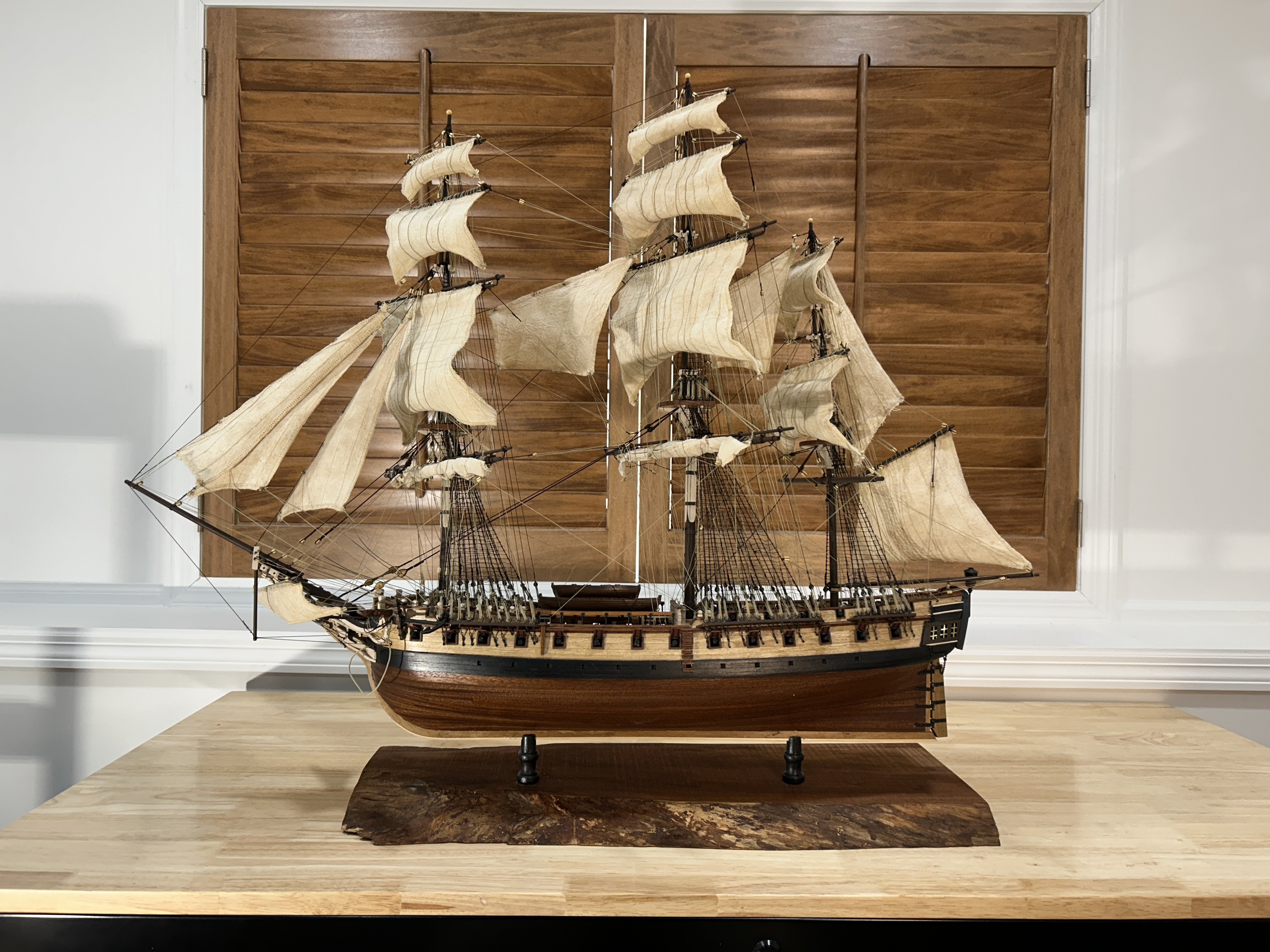

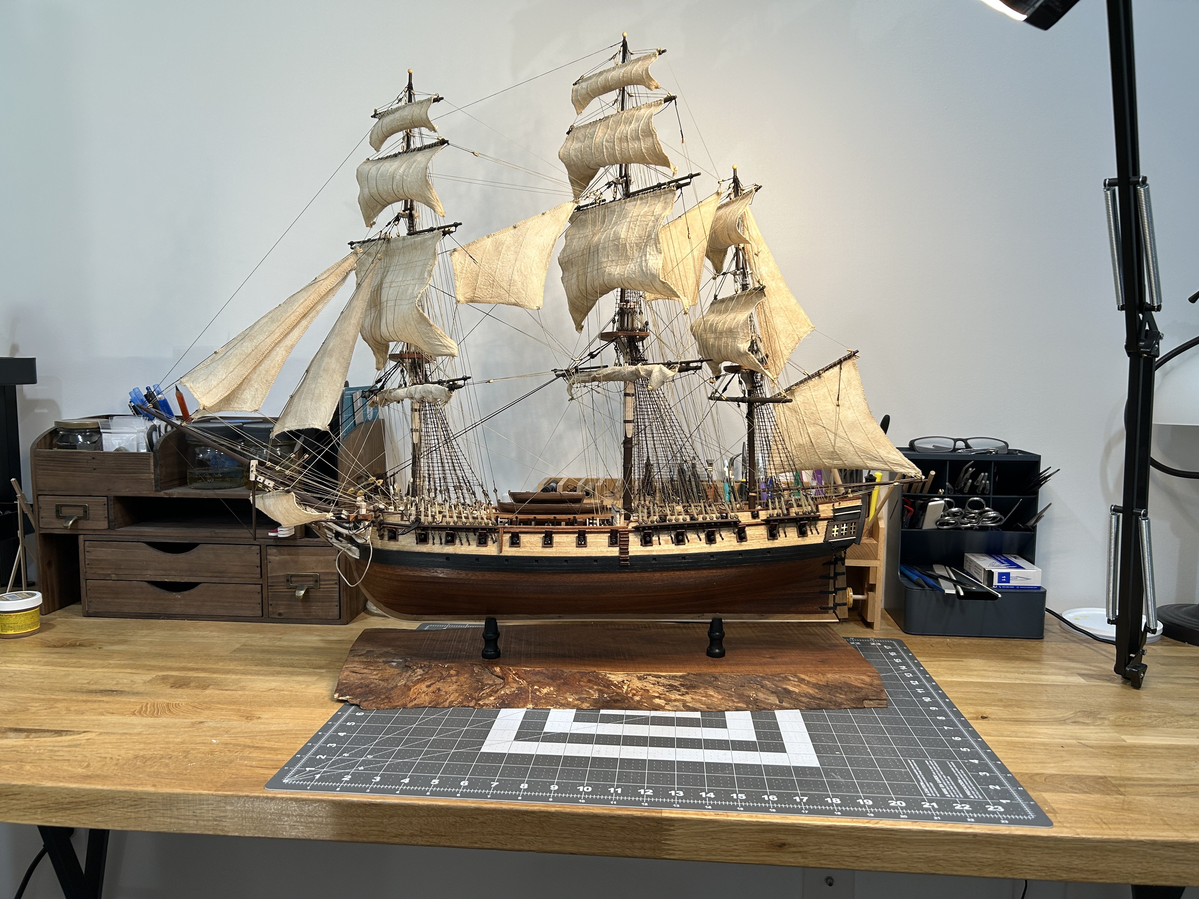

After two and a half years I have finally finished my Frigate Diana.  It took me awhile to determine how I was going to mount the ship.  This kit does not come with either a cradle for displaying the final model or for use during the build.  I built a crude cradle to use during the build, but I wanted to mount the finished model on a couple of pedestals mounted to a piece of live edge walnut that I already owned.  Unfortunately I didn't plan ahead.  I should have drilled holes into the bulkhead former to accommodate long pins when I could flip it over.  I didn't do that so I had to figure out a way to drill those holes from below with out flipping the model over.
The base is 1 inch thick, and the pedestals are about 1.5 inches high   I installed a 4 inch long 1/8 inch diameter threaded rod from the bottom side of the base though the pedestals leaving about 1.5 inches that are inserted into the bulkhead former.  The bulk head former is slightly less than 1/4 inch thick, leaving very little margin for error.   I did have a problem with one of the holes, luckily it was on the side that is not displayed.

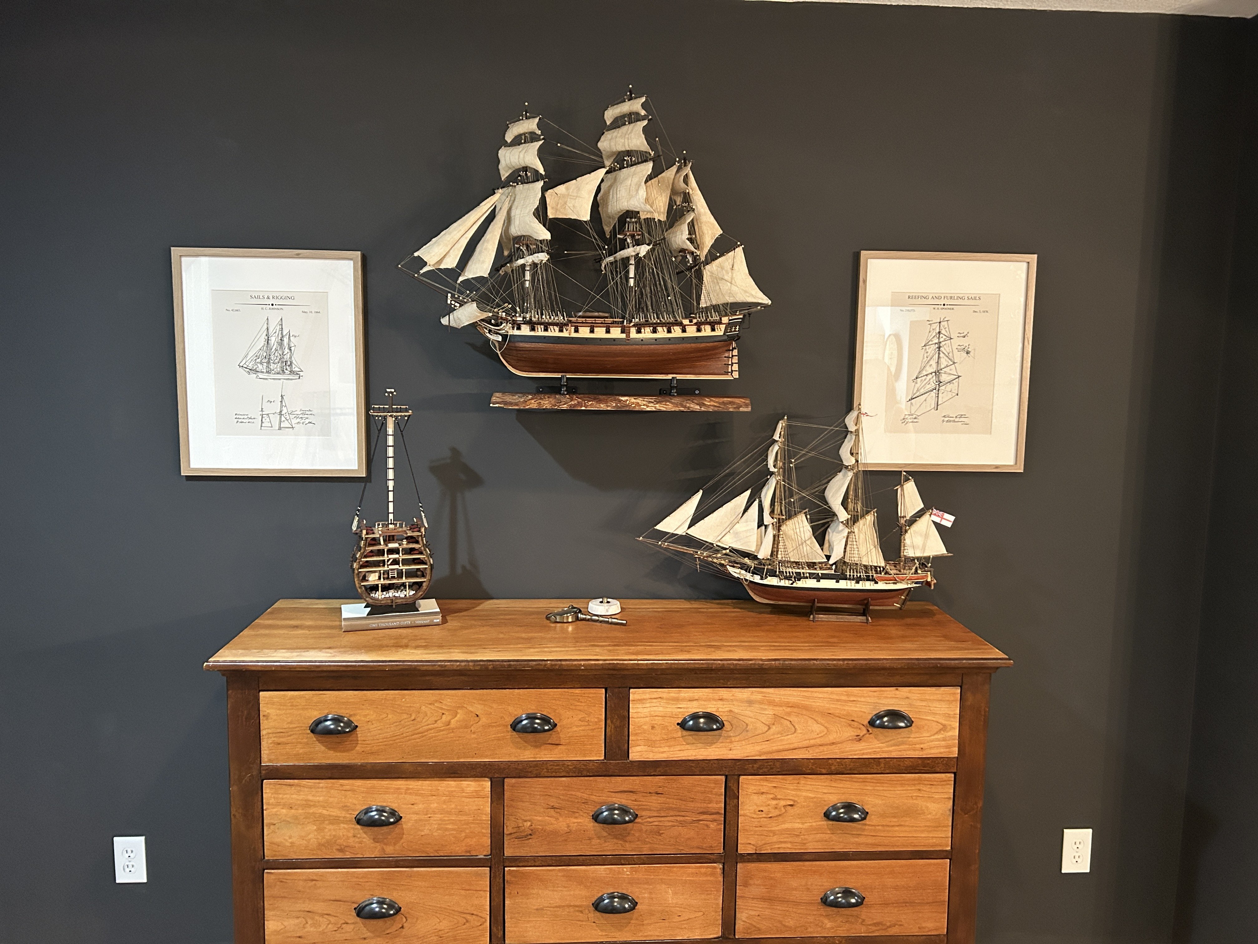

After being in this house for about 10 months so far, thanks to my wife we have found a way to display my models.  At the bottom of the stairs to our basement we have a niche in the wall my wife wasn't sure what we wanted to do with.  As an early Father's Day present she found a chest of drawers that had been refinished and we decided to use that chest as a way to display my models in the niche.  The Frigate Diana's base is mounted directly to a couple of shelf brackets.

Beautiful ships!  Nice job on the Diana.  Very very nice!
Your display area is amazing.  Tasteful and not overdone!  Your wife has a very good eye.
