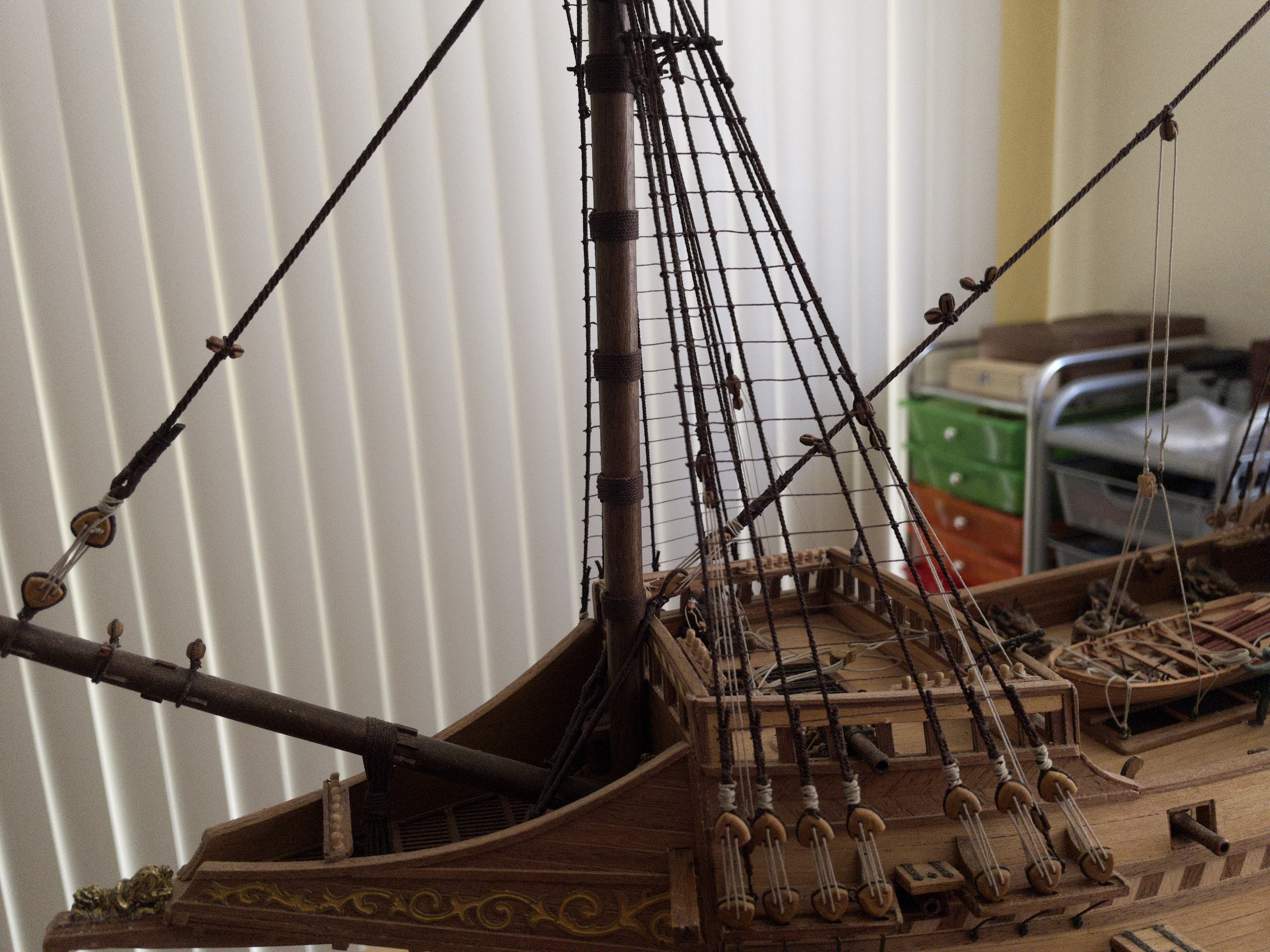

Futtock-staves and catharpins: With all the lower shrouds completed, it was time to tackle the futtock-staves and catharpins.  What a pain... at least for me.   I tried doing it with blocks but with so many knots, it is quite difficult to adjust.  The second approach (which may not be quite right for the Revenge) was to do the catharpins as described by Boubriot.  It involved treading a single rope between the futtock staves.  It looks easier on paper than done.
After several trials and failings, I settled on a variant.  Rather than having two passes every second shroud, I alternate 1-2, in a single pass.  It just holds in place better for me without constant adjustment.  The end result is a trapezoid pattern rather than a parallel layout.  After working several days on that...  I decided to just keep it.  Not perfect but it worked, move to the second one and be done with this.   Please pardon the deviation.

Mainstay Collar: Amati provided little information on how to anchor the mainstay.  Lennarth Petersson drawings (Rigging period ship model) were used as a reference.  A 2mm rope, the same size as the mainstay, was served and attached through the hole in the bow.

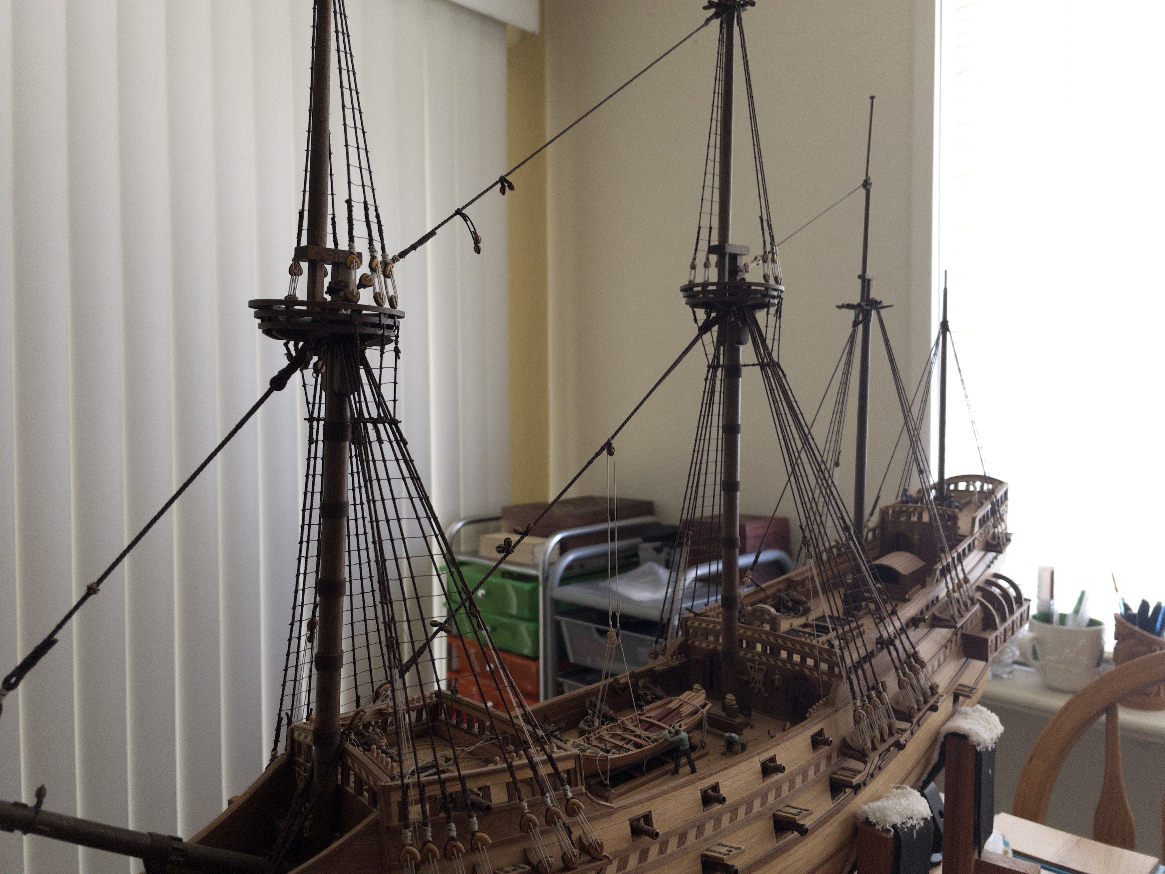

Ratlines and Stays: Starting to work on the ratlines.  Not as difficult as anticipated but... it will take a while.  A few everyday while doing other things. It is still quite hot middays, which limits my time.   Note: dark ratlines, rather than tan, were a choice based on preference.  I just did not like the tan... too much contrast.
The 2mm main and fore stays are quite big when compared to the ratlines.  The pendant/loop is made by incorporating a block into the cable before serving.  Here a before and after.

Was about to post progress on the Revenge but found a small mistake.  When I set-up the Stays, I pass-through the stays through the space that the secondary masts will sit ... obviously the masts do not fit anymore.  The STAYS had to be taken down.  No room for mistake there, it simply won't fit otherwise.  Luckily, it is just a matter of cutting the sizing and doing it again, passing the rope through the outer edge.  Dry fit ok now.
Beside this... more of the same - ratlines.  Knots 400 of ~1600.
Two steps forward, one step backward...  there are days like that!

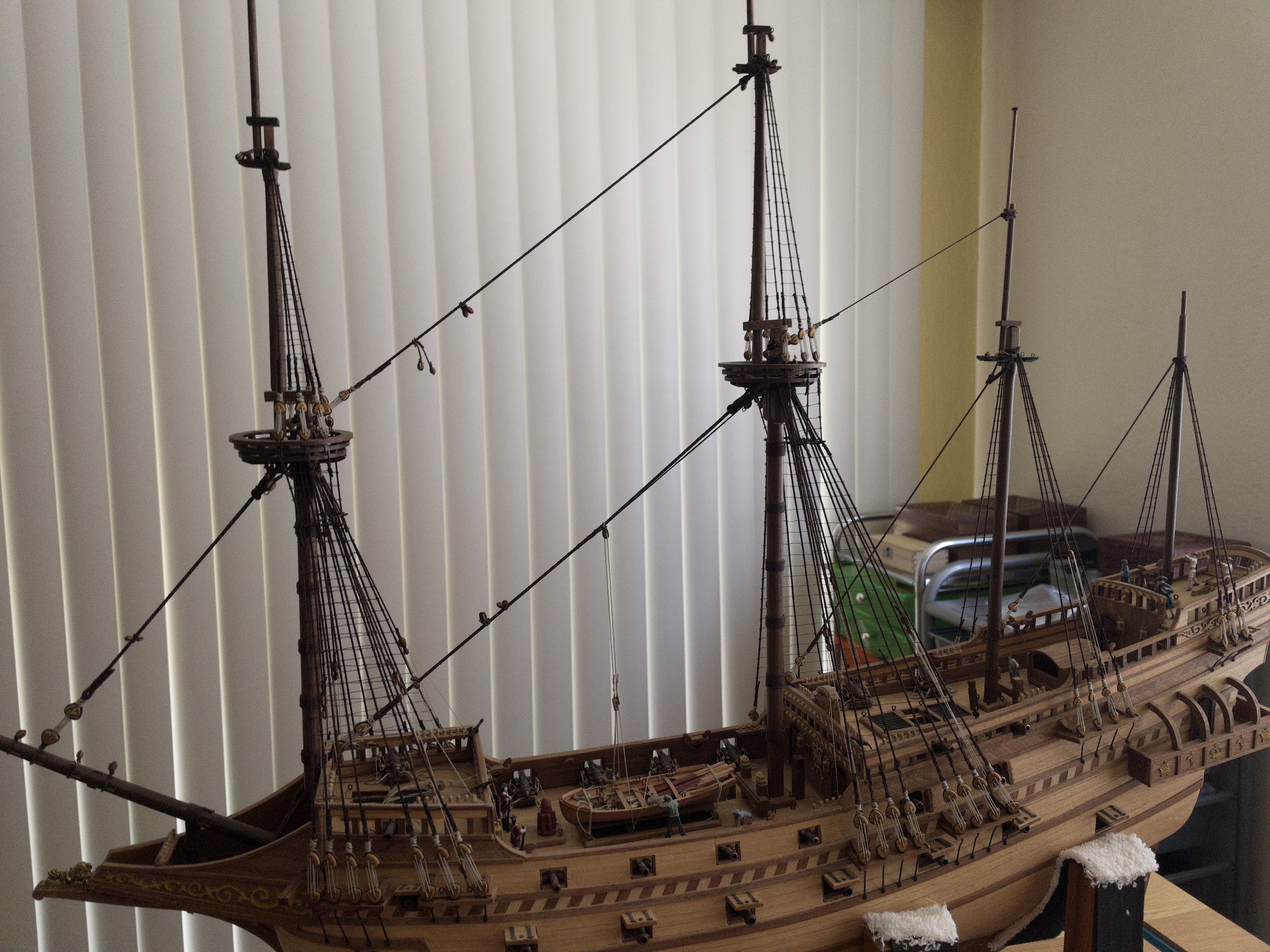

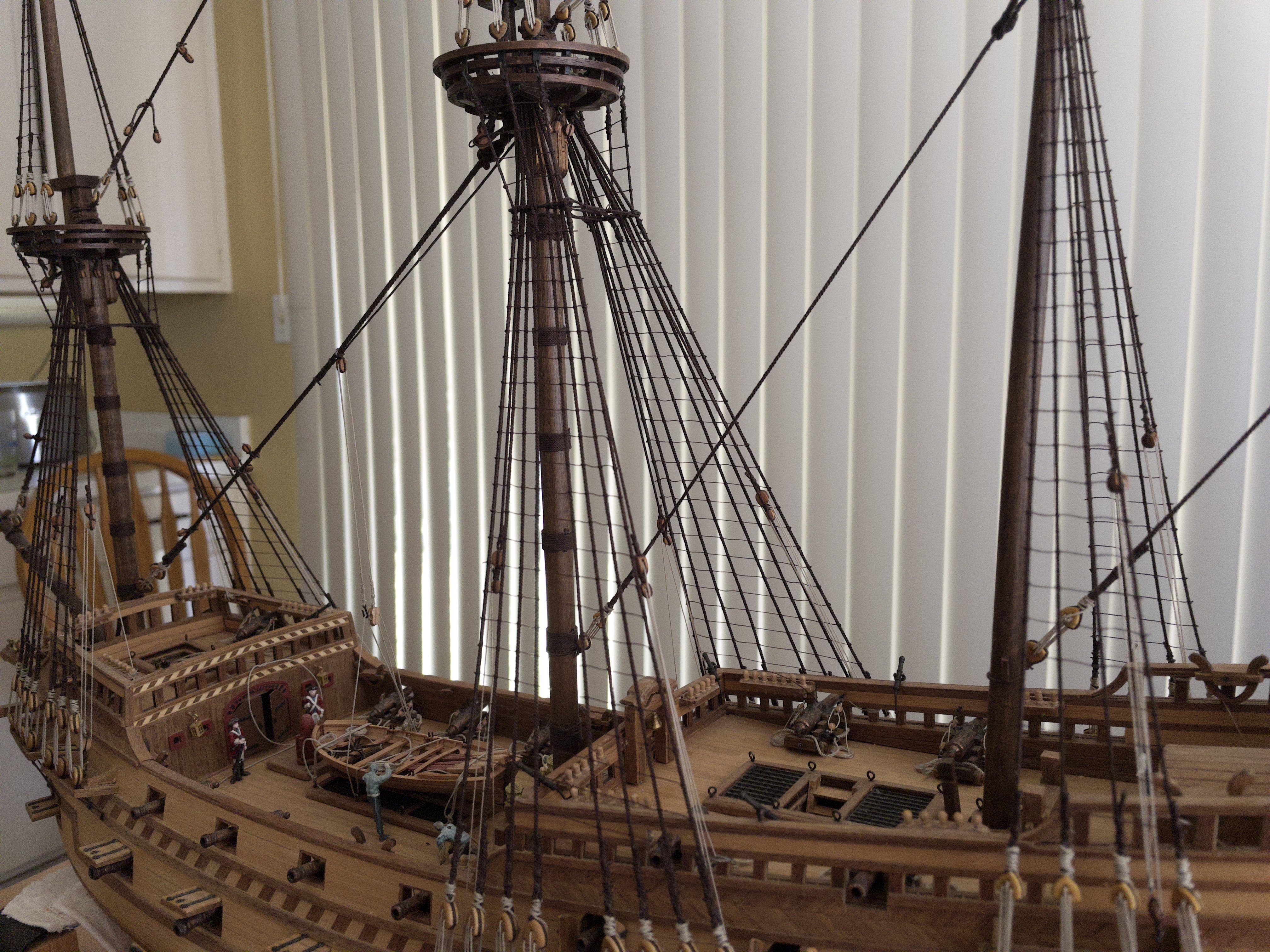

Shrouds and Stays: Except for the front one (rigging blues), all shrouds and stays are installed.  This is a very slow process for me.  It looks straightforward but it is not always... and somewhat lengthy.  Here's what it looks like:
Ropes: all ropes are made using a ropewalk, 15 feet at a time. A range at 0.25, 0.5, 0.65, 0.75, 1, 1.2 and 2mm (light or dark), it adds up fast. However, I keep running out of ropes of any given size, which means that I'm doing them often.
Serving: All first shrouds are served to full length. It's especially important to serve the end of the shrouds around the topmasts (crow's nest).  Serving makes the rope very rigid, so it does NOT compress as you add one on top of each other.  Similarly, all blocks attached to masts/cables are served too (not quite sure if they were actually done that way).
Rope to length: Installing the rope is ok but it has to be sized to length on the ship before finishing.  I usually set them a good 1cm shorter, since they stretch while installing.  I like to have good tension when possible.
Ratlines:  so many to do.
Finally, I'm getting "Rigging Burn-out": Can't do too much at a time without making mistakes.  Planning on taking a short break before starting on the spars... those look quite tricky to install.

Some remarks - laniard color , consider they used to be good tared , and color should be dark, same as shrouds colors, and while You are busy with ratlines, I hope You to take care about their thicknest, often we could see that people made them too thick/ oversised and thus ruining overal impression of the fitted shrouds ...and color of the ratlines - need to be the same as shrouds as well...

A few pictures of modern replicas - where we could see how triangle deadeyes fitted correctly and laniards tared as well - Mayflower, Duyfken, Half Moen
Edited by kirill4
Hello Kirill4, fantastic pictures.  I did not know that the lanyard/shroud color.  Great information.  Not sure I can fix easily now.
About the ratlines, at this scale 1:64, I'm using only 3-ply treats - the smallest I have. I did want to be very thin.

I'm sorry mentioned ratlines -it is no the case here , they are quite correct in size and colors  on your model! Sorry for mentioned ratlines...
As for the laniards of the shrouds, yes, there is steady tendency they used to be tared, and normaly should be the same color as shrouds... that what we could see on replicas and what is more interesting for us as modellers, autentic admiralty museum models , they all have tared ratlines and shroud deadeyes laniards ...practically they easily could be stained to the dark colors with suitaboe stains or deluted acrylic paints and fine brush justcright at places where they are fitted...

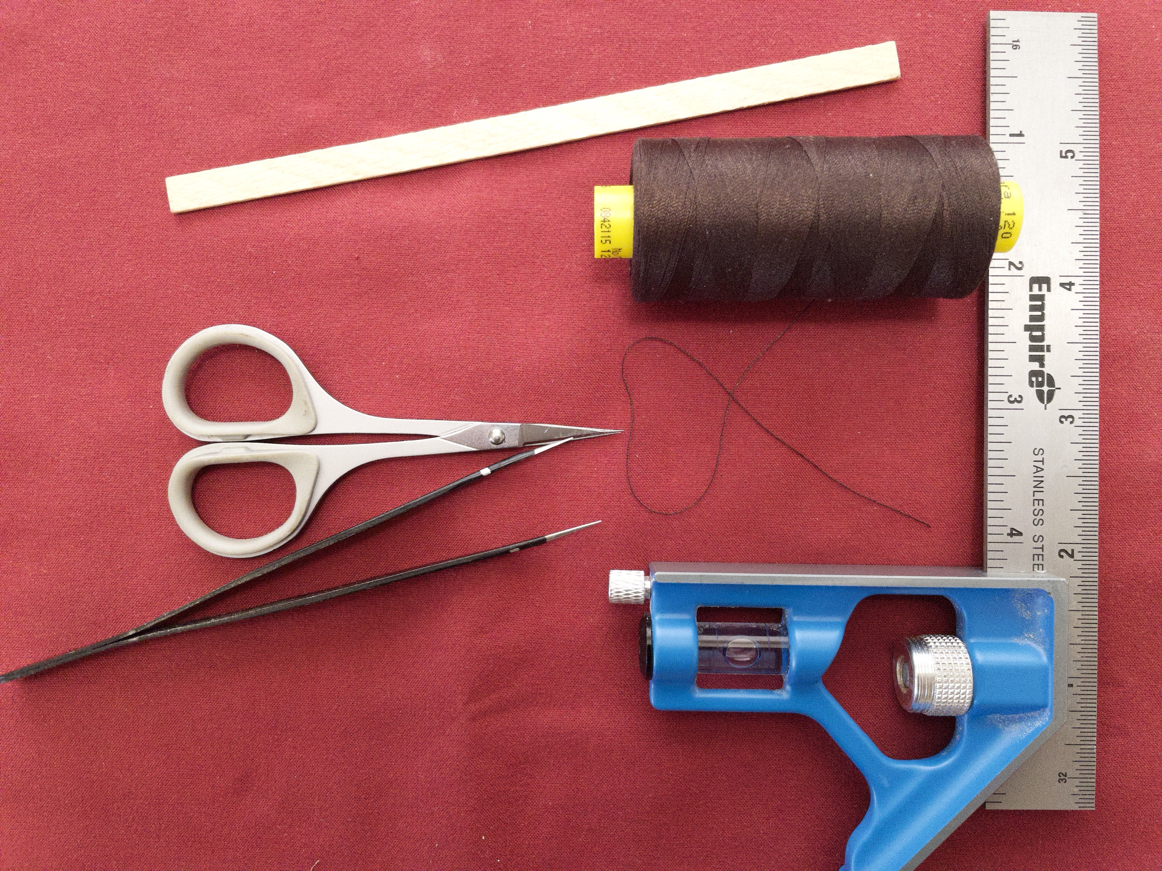

Ratlines DONE!.  My My that was tedious.  Took several months, mainly because I just could not bring myself to do it.  But the edge of starting a new ship motivates me to finish this one first. 1250 clove knots later... completed.
Saw several approaches to the ratlines.  For me, it was the simplest: a) tweeter and scissor, of course. b) a popsicle stick to adjust spacing as I go, c) a level to parallel to the water, and finally d) patience, a lot of it.  This allowed me to easily reach behind to make the clove knots.

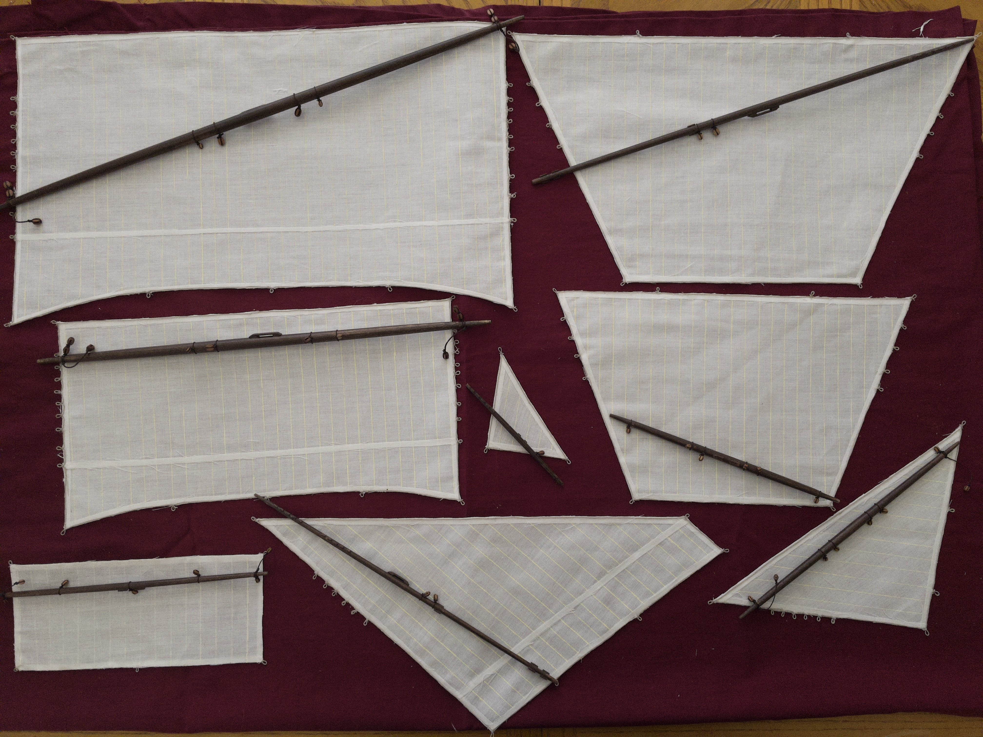

Next step, more rigging and the sails.  They were already made a few months ago.

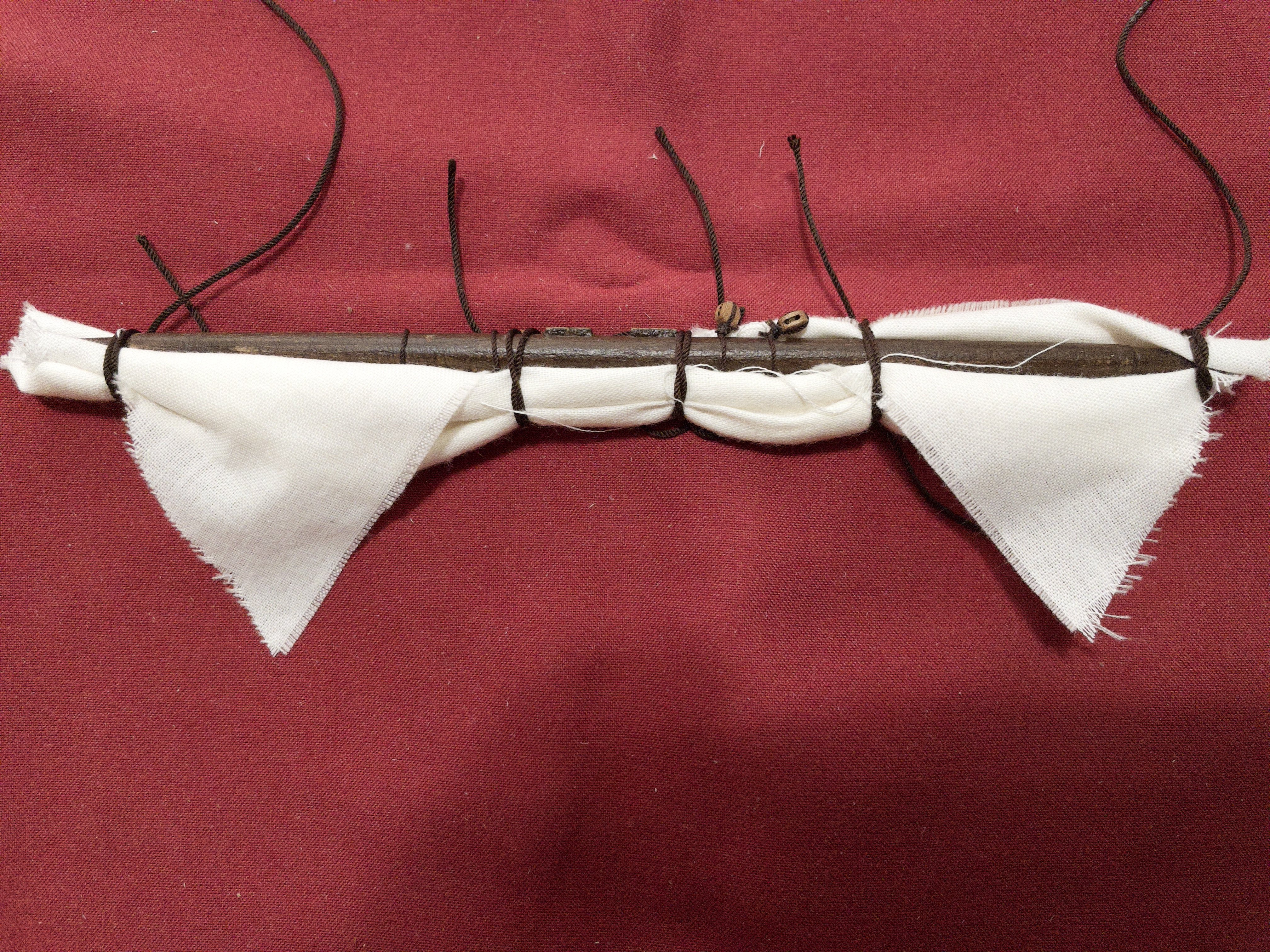

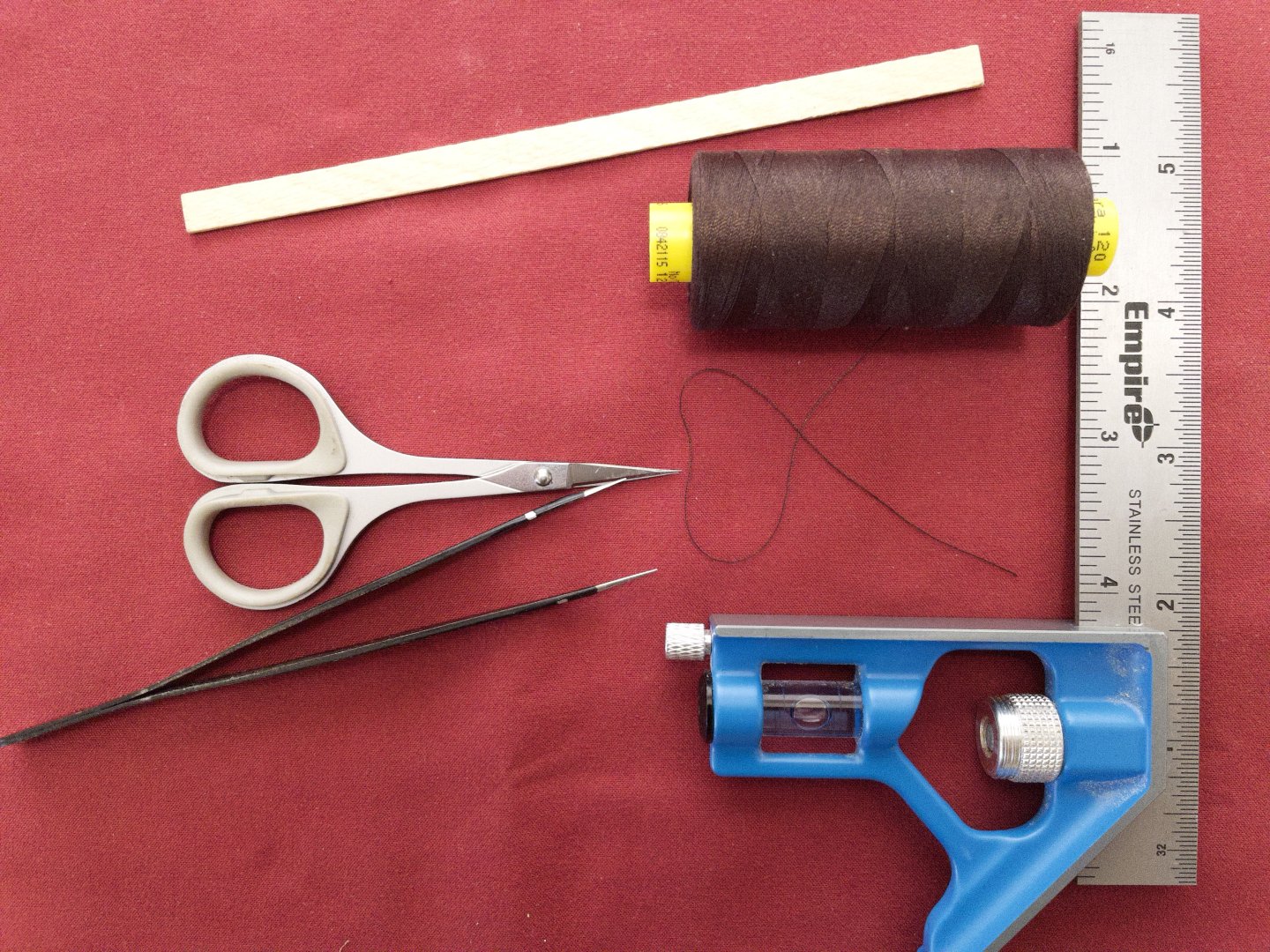

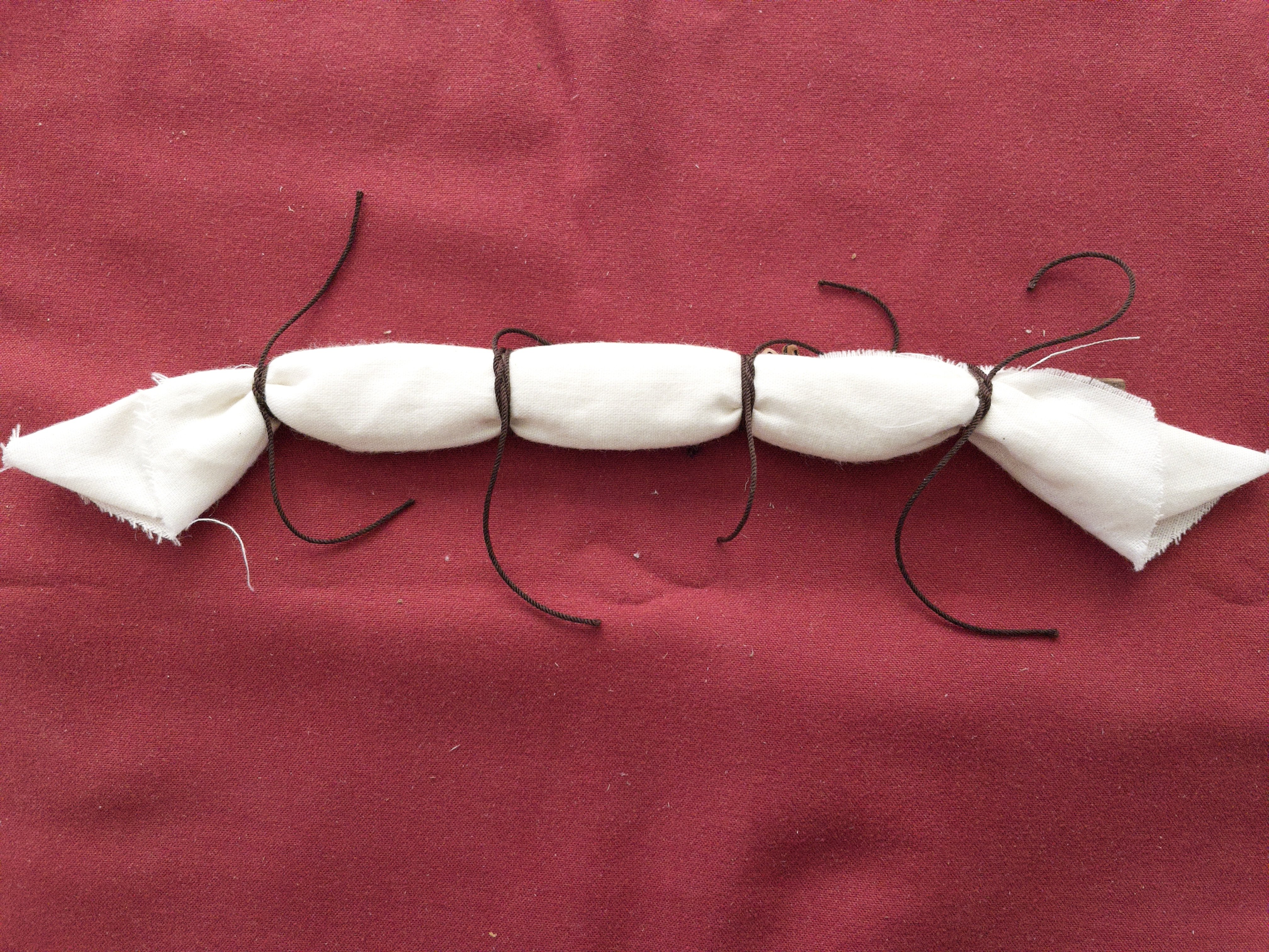

Furling top main sails: I cannot find much information about furling sails.  Tried a few folding approaches (hopefully I will remember this one hehe!)... this one seems close.    Am I on the right track?  This is using the full sail (the one above top left).  I don't really want to shorten them since they are all done now.
This is only a test piece, please don't mind the ties (too big and wrong color), am just wondering about the overall shape?
Let me know what you think?

Ok... I keep changing my mind.  I don't like a full sail display because it covers too much overall.  However, although I like furled sails... the material is too thick to have a good roll.  I may have found a middle ground that I will test later (need to attach the sails to the spar first): Display the model with sails set semi-furled as set when drying the sails.  Saw a couple pictures and I think it worth a try.

If you want to keep the entire sail I would go for this option.
My non-binding idea

I also really like furled sails, and am considering it for my Sphinx (although it seems almost too difficult for me)
Have you had a look at how @Landlubber Mike did it with his Brig Badger?
Technique how he did it:
https://modelshipworld.com/topic/3944-landlubber-mikes-technique-for-furled-sails/
Final result:
https://modelshipworld.com/topic/604-badger-by-landlubber-mike-finished-caldercraft-164-brig/page/5/
